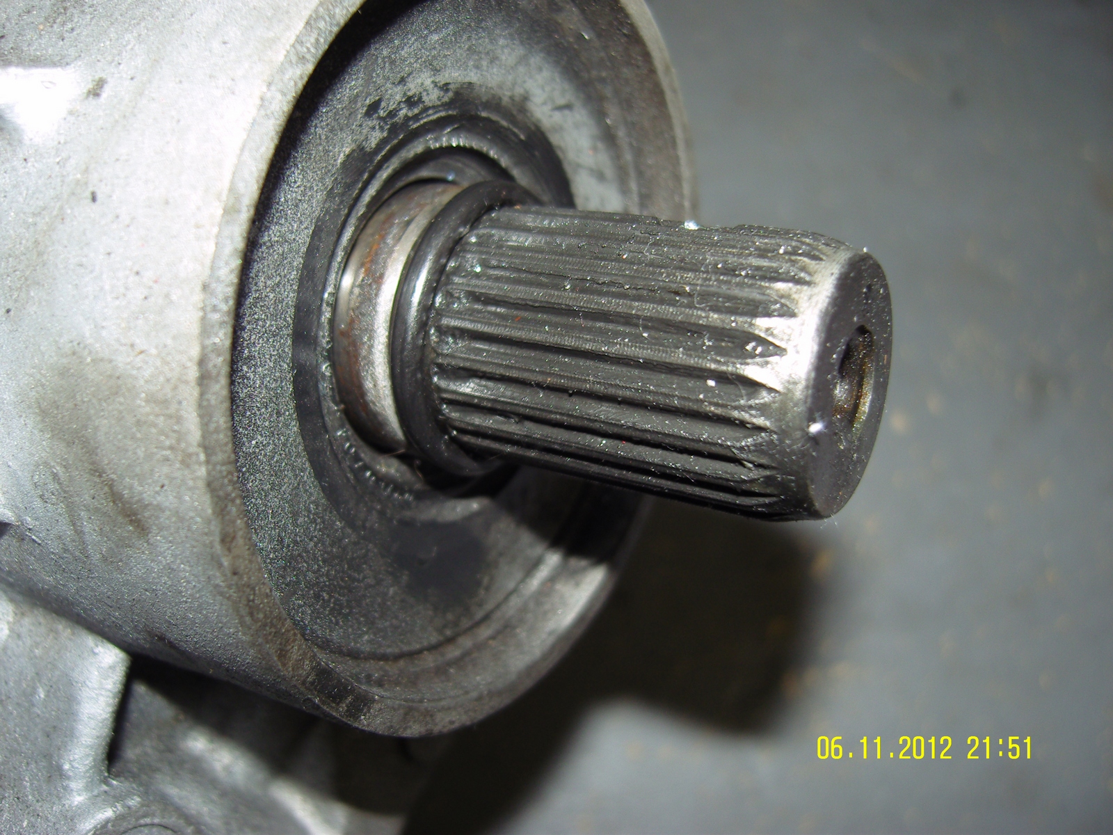

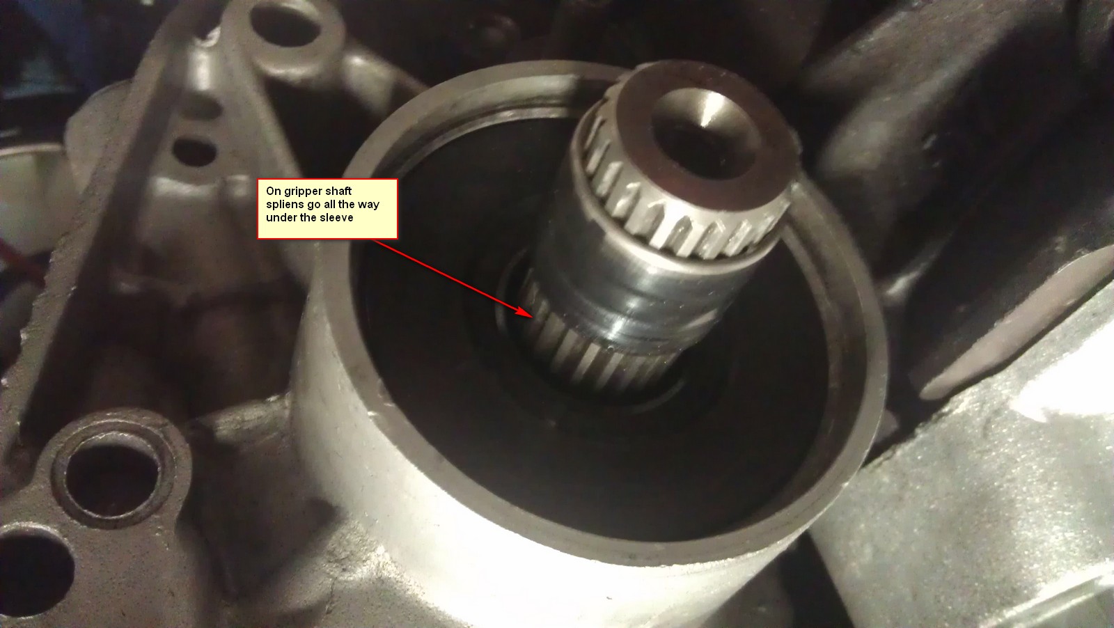

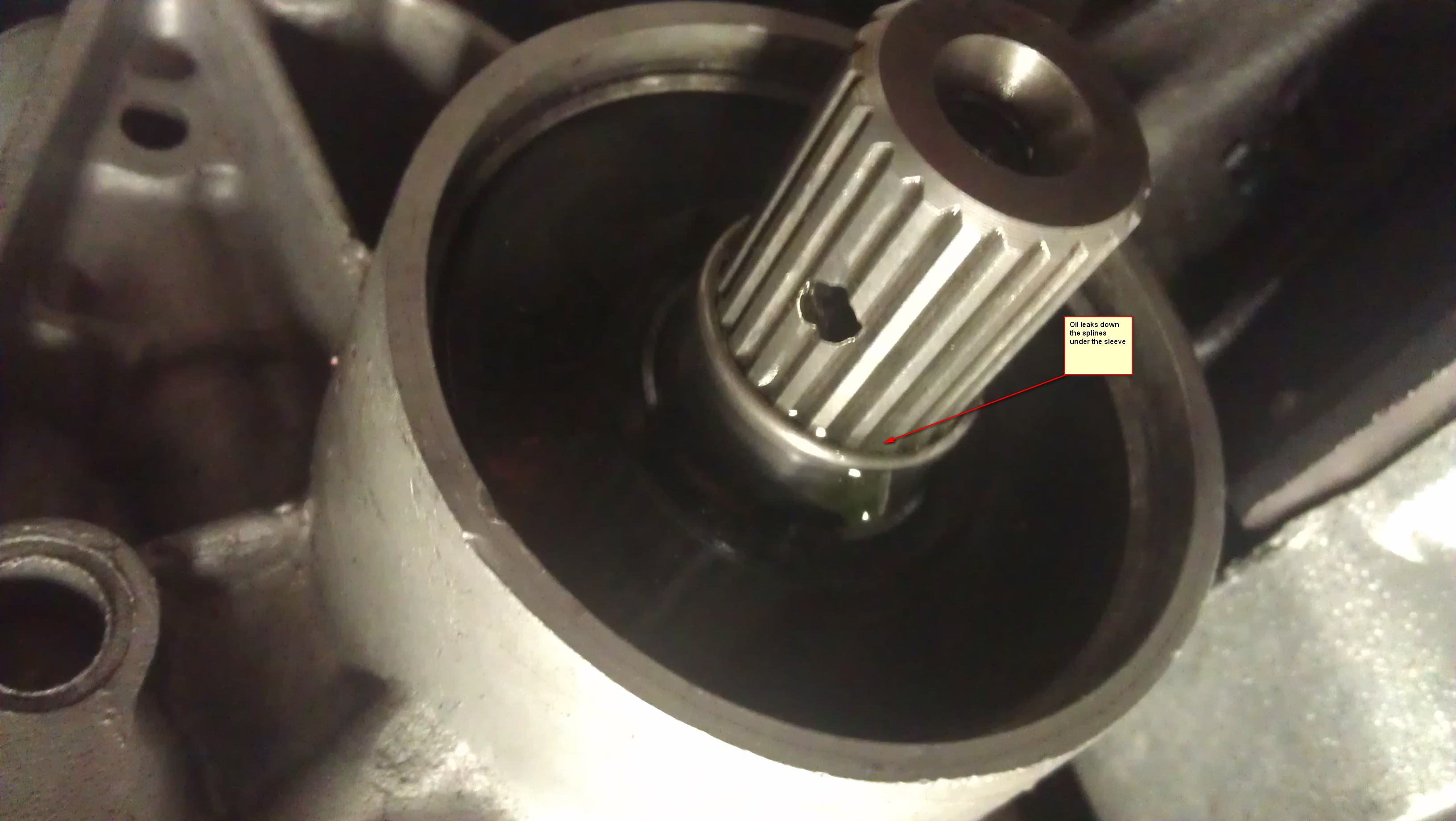

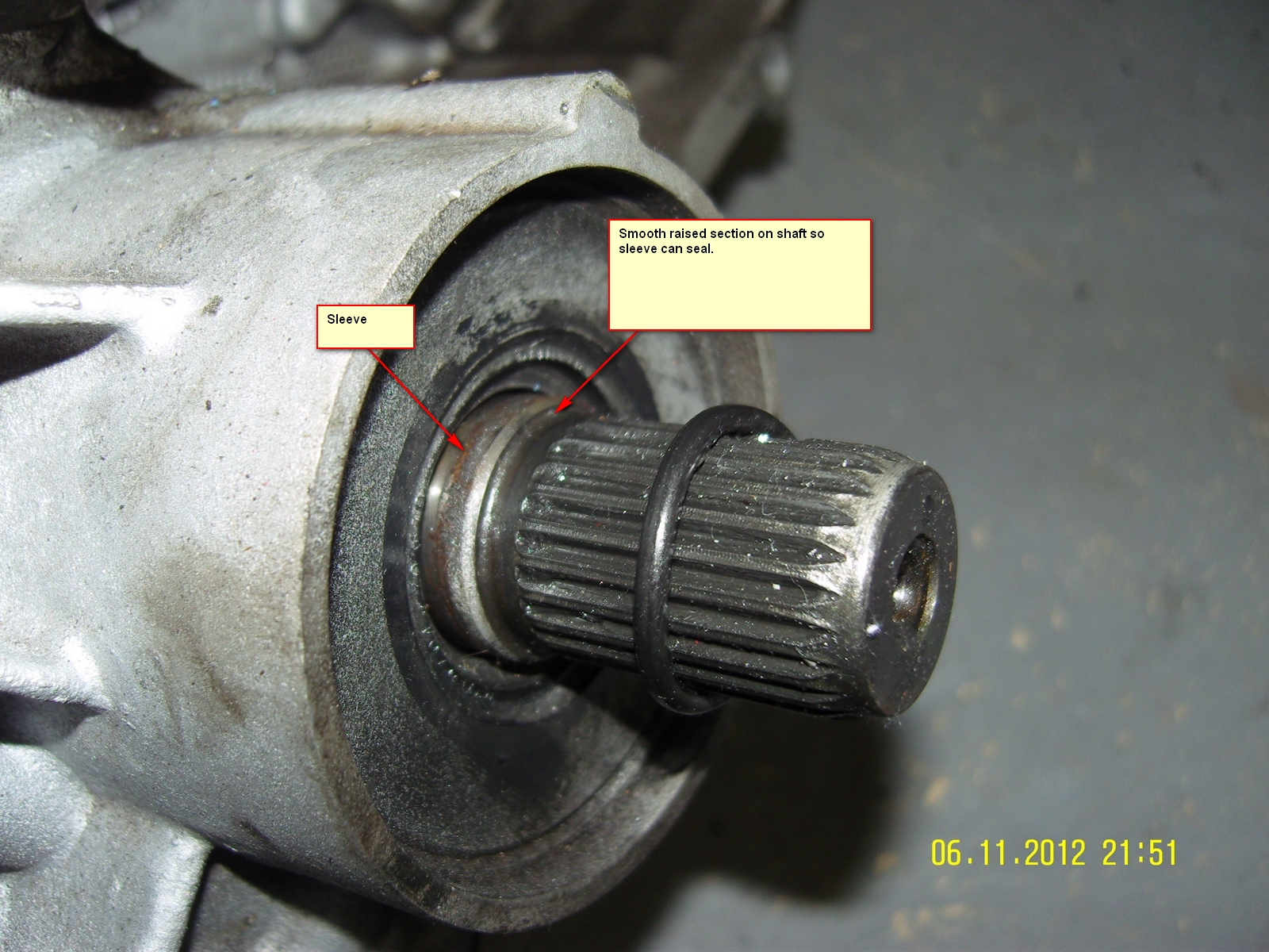

So My oil leak from the sump was masking an oil leak from the gearbox. Essentially the gripper has been machined incorrectly and leaks oil down the splines. The daft buggers have machined splines all the way down the shaft so oil leaks out underneath the sealing sleeve.
Renault Shaft
Gripper showing splines machined all the way down under the sleeve.
No O ring on shaft and oil leaks out under sleeve

I can't see how you can fix it short of a temp fix with silicone on the splines and im not paying 3 grand to use silicone to seal something up! It's machined incorrectly and I want my money back.

Not good that a simple thing like that was missed during design, a simple groove cut into the splines for a O ring that would then seal against the inside of the sleeve would be the easiest fix. But as you say after paying that sort of ££ for a diff having to make repairs isnt good.
That would not work as the splines go under the sleeve too, on the Renault design the section under the sleeve is a smooth tight fit to the sleeve..

That must be a secondary seal/cushion more than anything, there will be lip seal further in as there is nothing holding the inner CV tight against the box at all times. There would be O.E afaic
