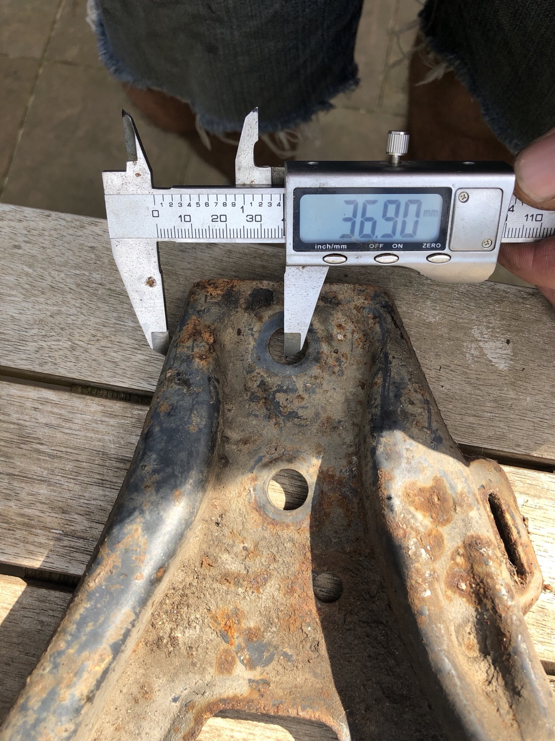

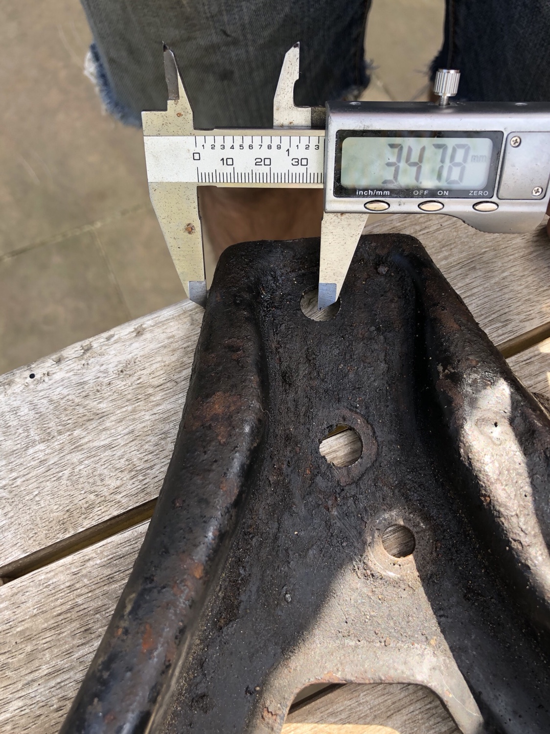

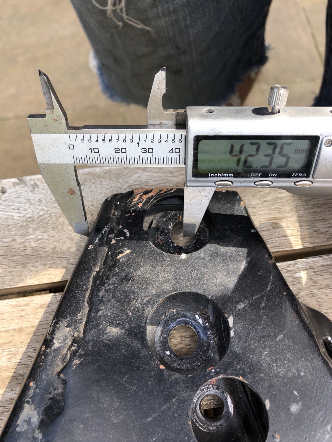

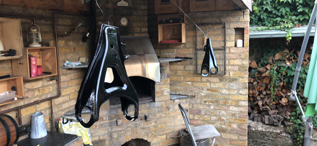

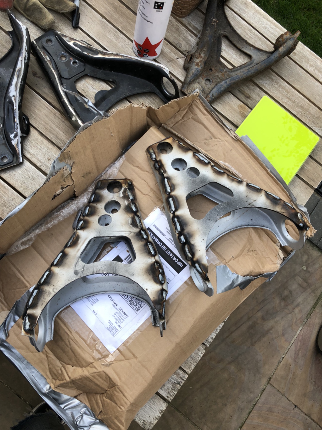

Think I figured out why my wheels wasn’t returning. Not enough castor. (I hope I am right)
When last year I bough new wishbones to strengthen I didn’t even realise there were so many different ones.
This is the original that came with the car:
this is the one I bough (supposedly for 172/182 sport) and had on my car currently
And this is the CUP wishbones
Difrence between what I had and Cup is 7.57mm !! Massive! No wonder the wheel didn’t have a tendency to return
So decided to quickly chop the old ones and reweld to CUP wishbones. Wait for paint to dry and fit back. Ready for Donnington on Monday!
Happy to report, it fixed 80-90% of the issues I was having. Now wheel has a tendency to return and there is nice weight to it in corners. Still not 100% not sure why. Perhaps it’s the feeling EPAS gives anyways. Will see how it behaves on the track on Monday! But look at the difference
Before:
after

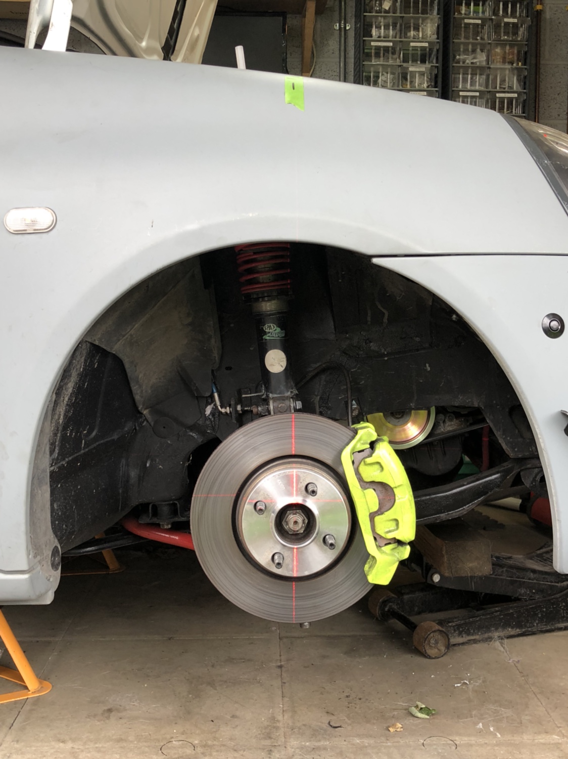

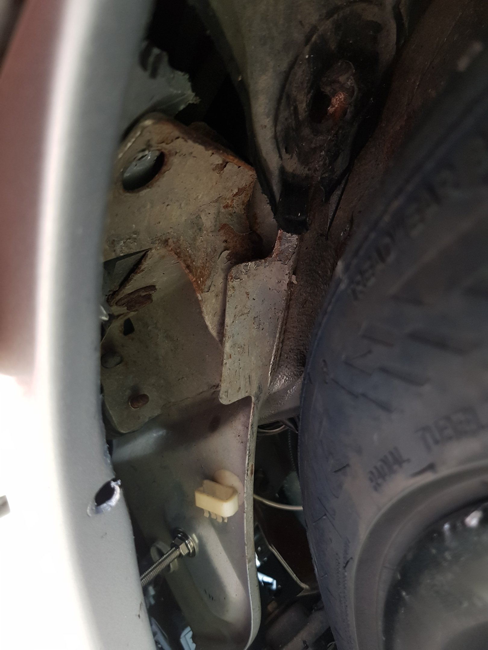

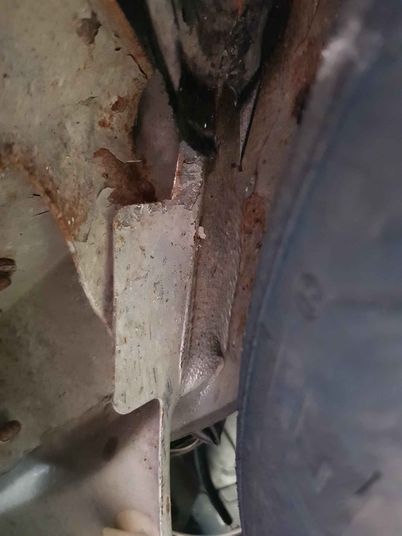

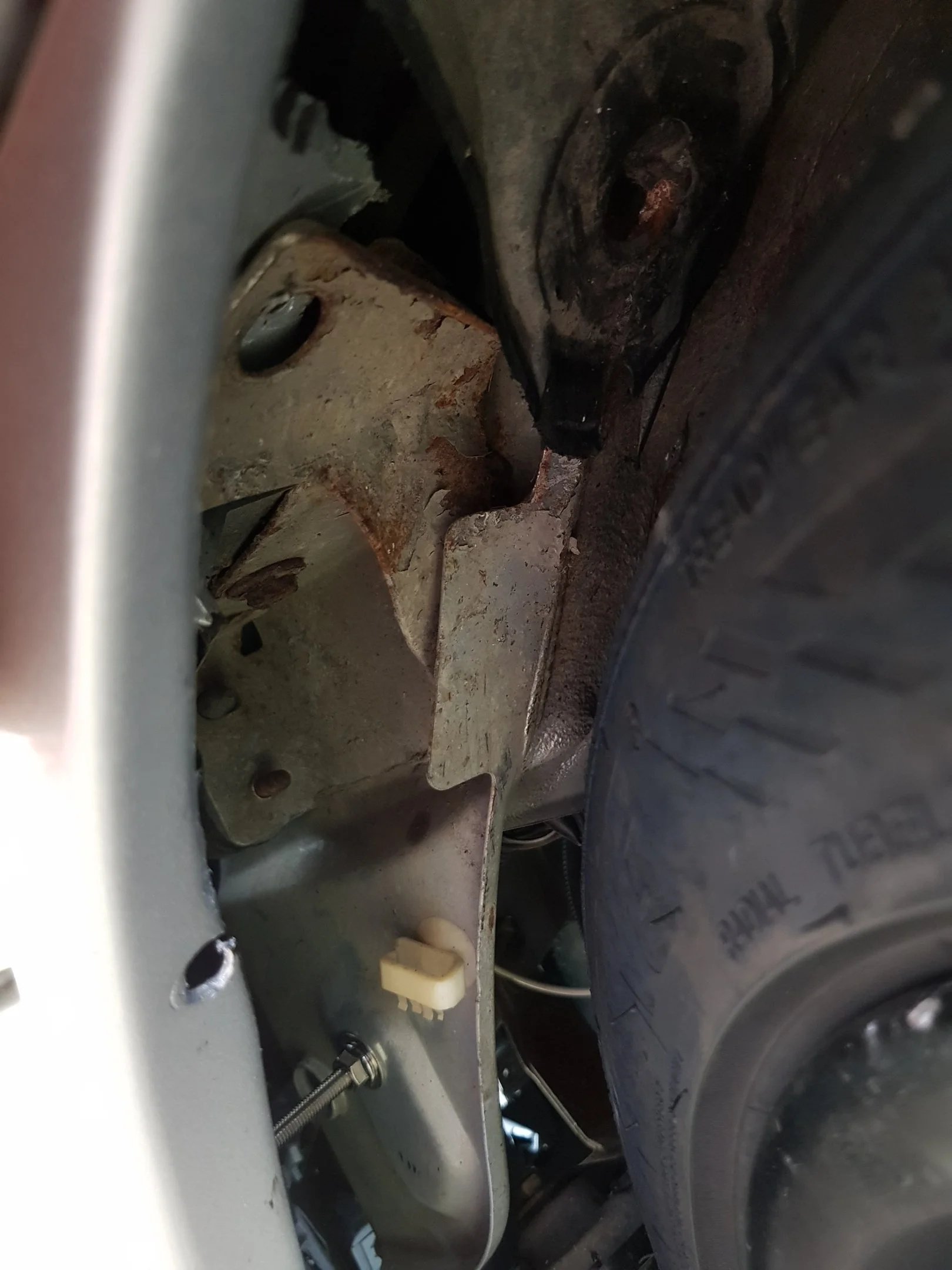

There's a peice of metal that hangs down on the inside of the front arches where the inner arch and wing rail are welded together, it will probably need grinding flush or hammering flat as in fast corners can scrape on the tyre and cut chunks out. 3 of us had to modify it at Cadwell
Got a picture by any chance?? Struggling to picture it
So right at the front of the wheel. I had to use a hammer to bend it out of the way so it wouldn't catch the wheel in hard cornering.

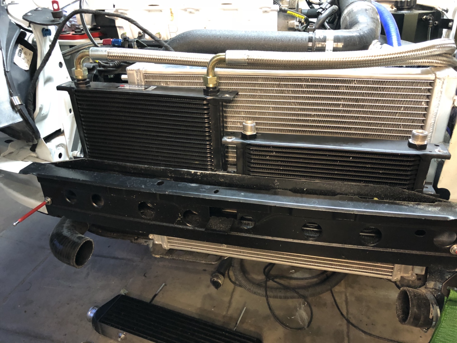

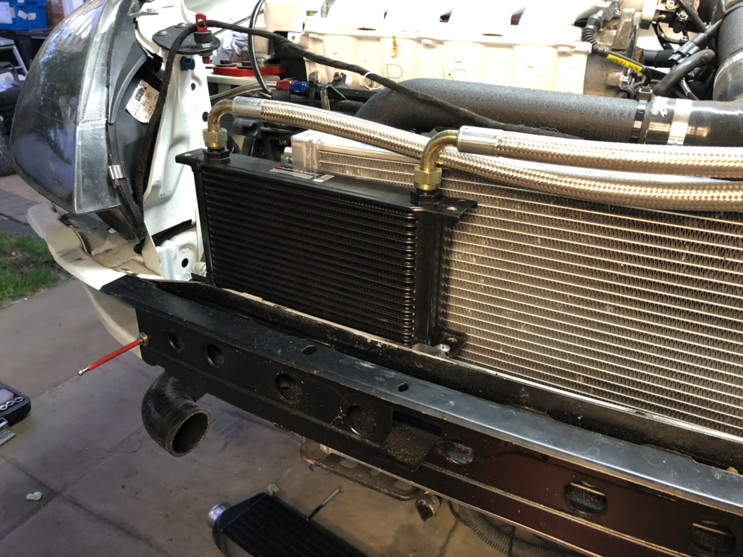

main issue was oil temperatures. after a few laps pushing hard, i could easily reach 128-130 deg. not comfortable with that so ordered a bigger oil cooler, 25 row. the one i have is 10 row mocal. also i am thinking the sensor scaling might be slightly off so gonna look in to that as well. funny enough, when i would follow a normal NA clio for 3-4 laps, temps would barely touch 110 deg. so i know its not just overheating but only when you pushing hard. my best time was 1:48

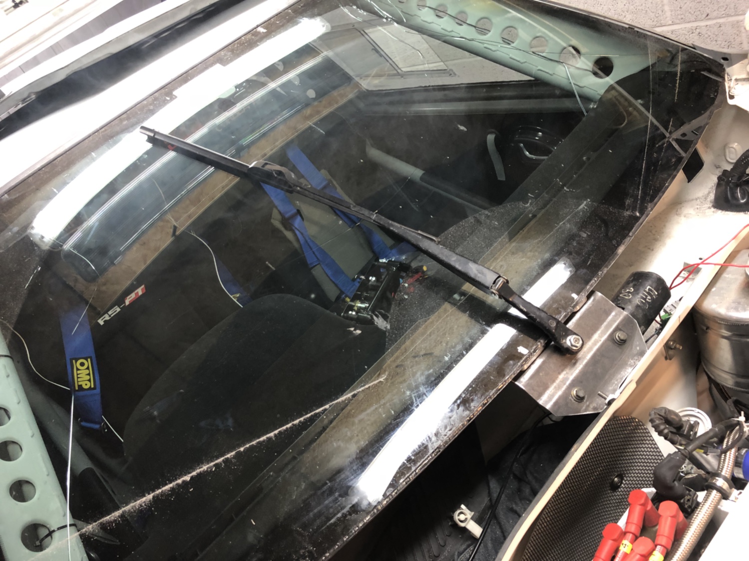

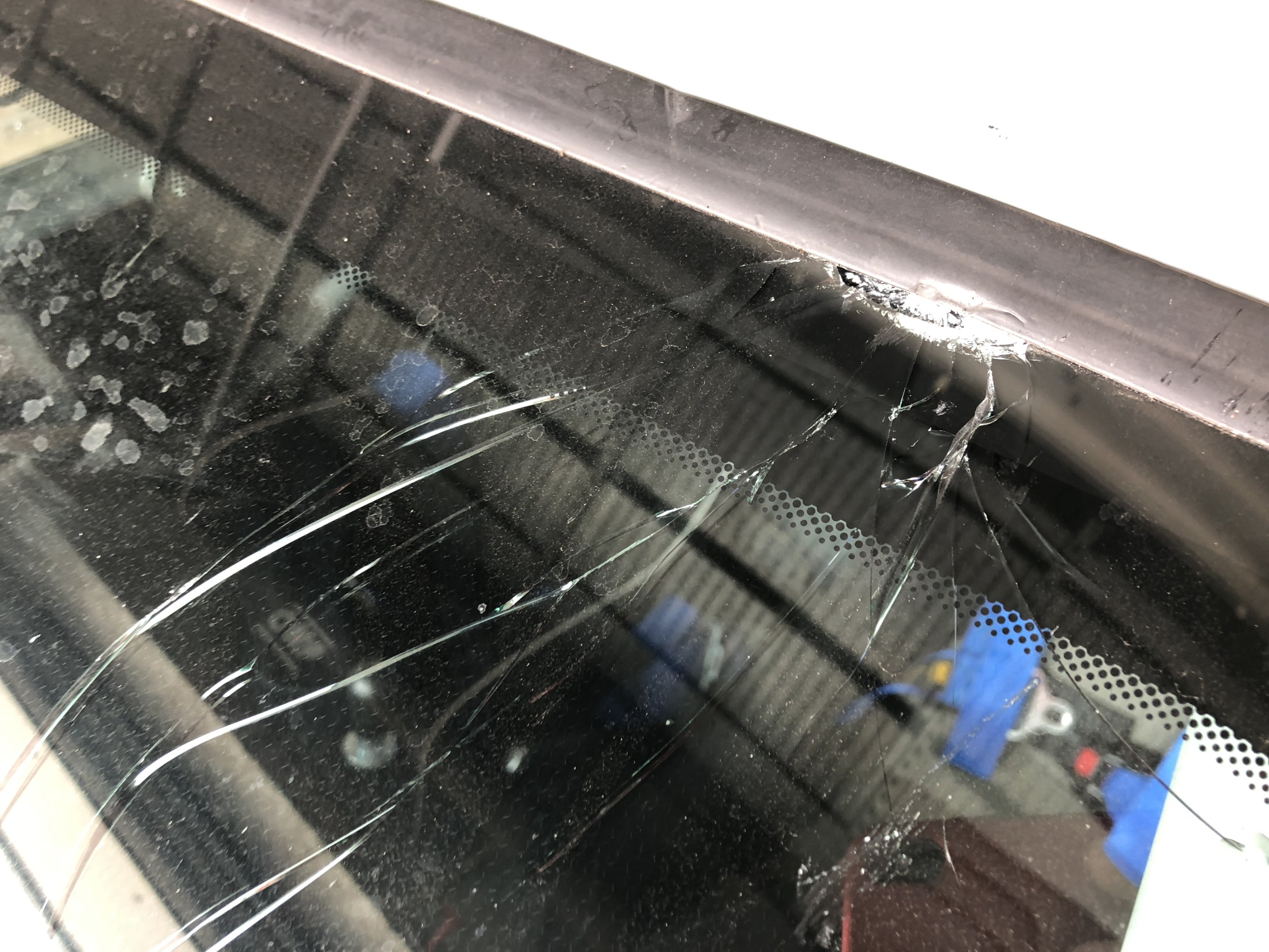

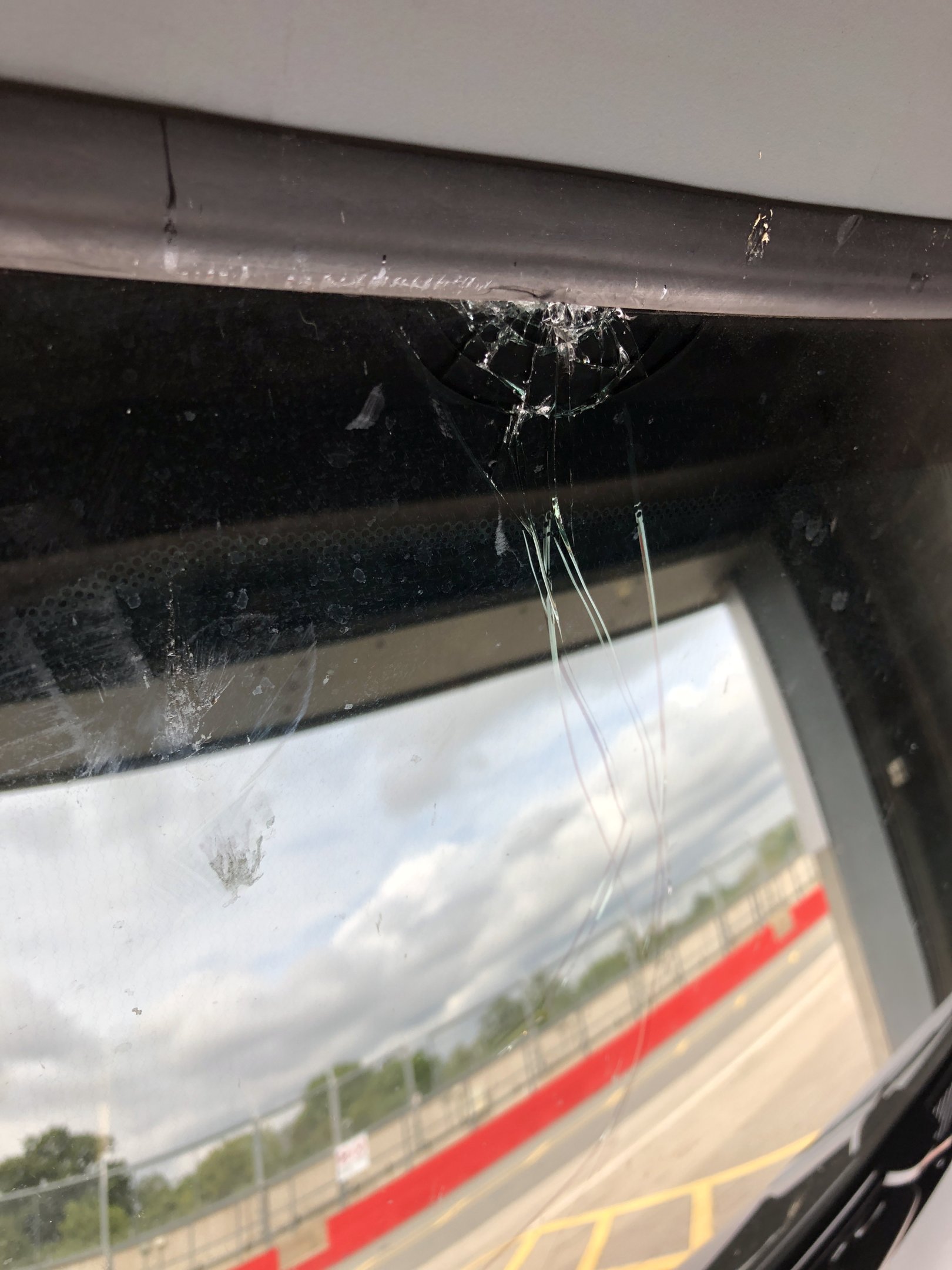

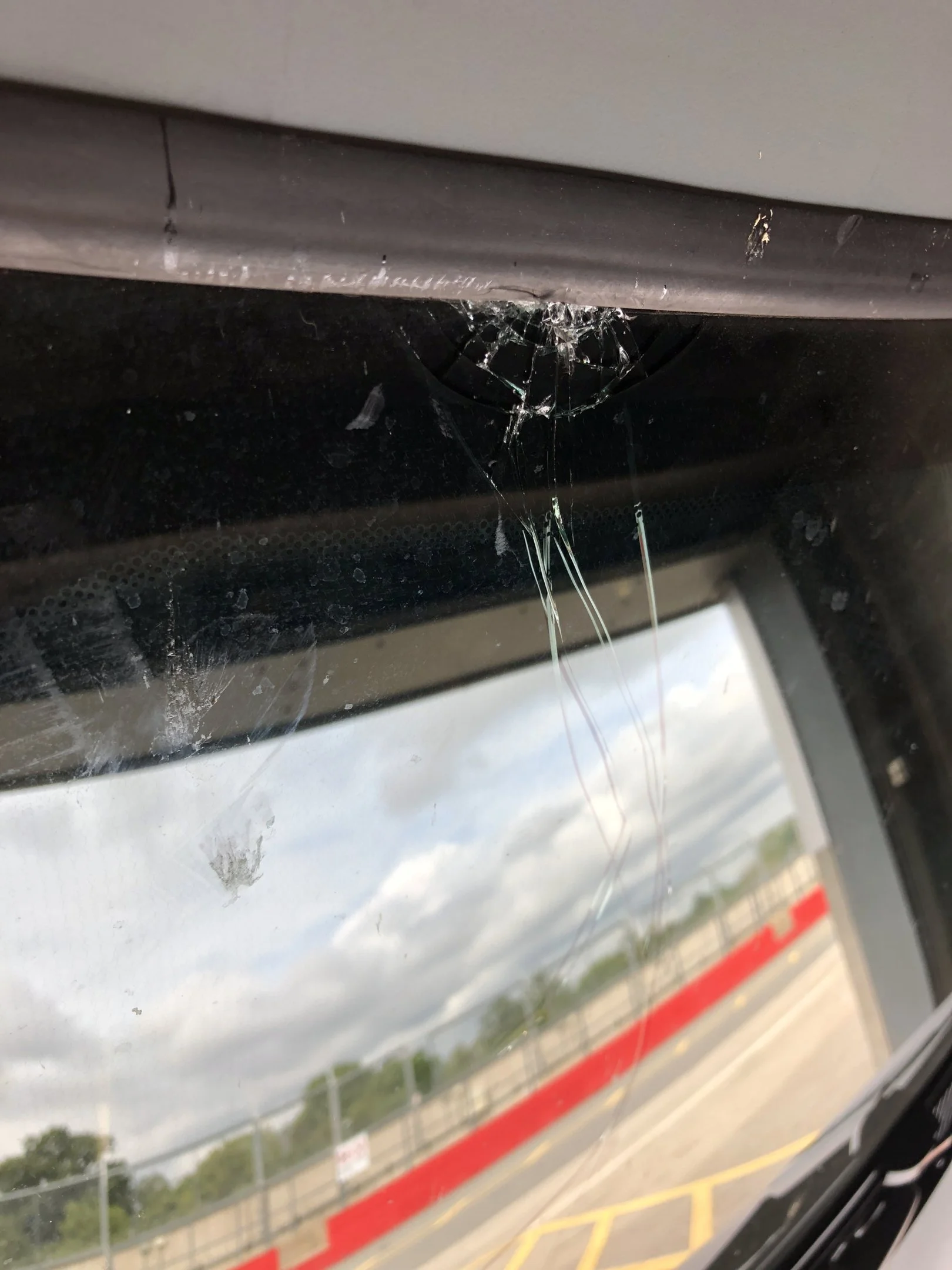

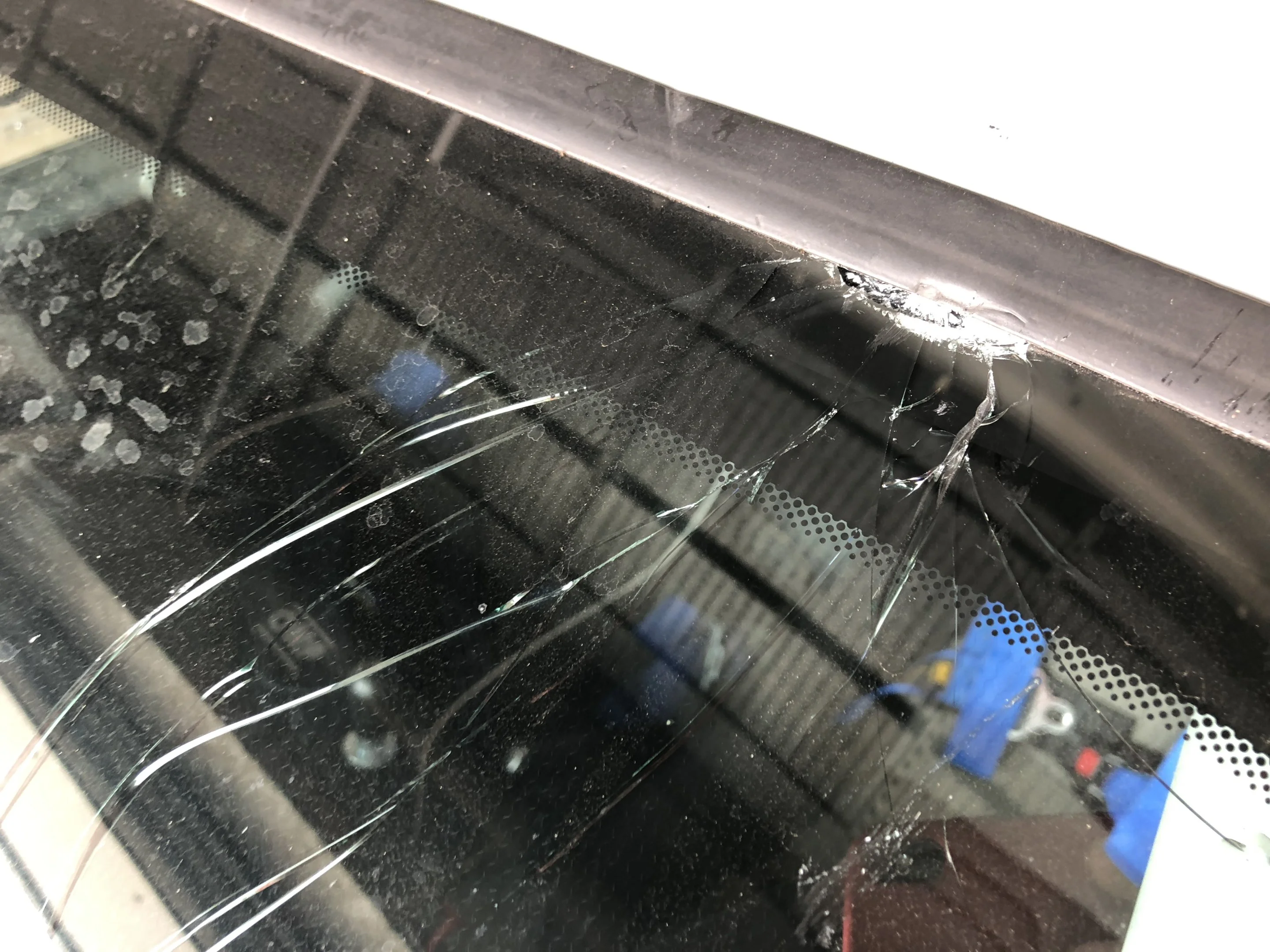

also i forgot to lock the bonnet on my second outing so this happened... f**k sake what a muppet! here goes £300 quid heated screen..
oh well only have myself to blame...

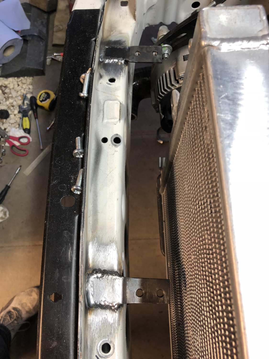

Got the new 19 row cooler fitted. Tried the 25row but just way to big. This is the biggest you can fit in that space. Should do the trick. Also will test the voltage of the temp sensor tommorow in the bench in a cup of oil to make sure it’s calibrated correctly
19 row vs 10row

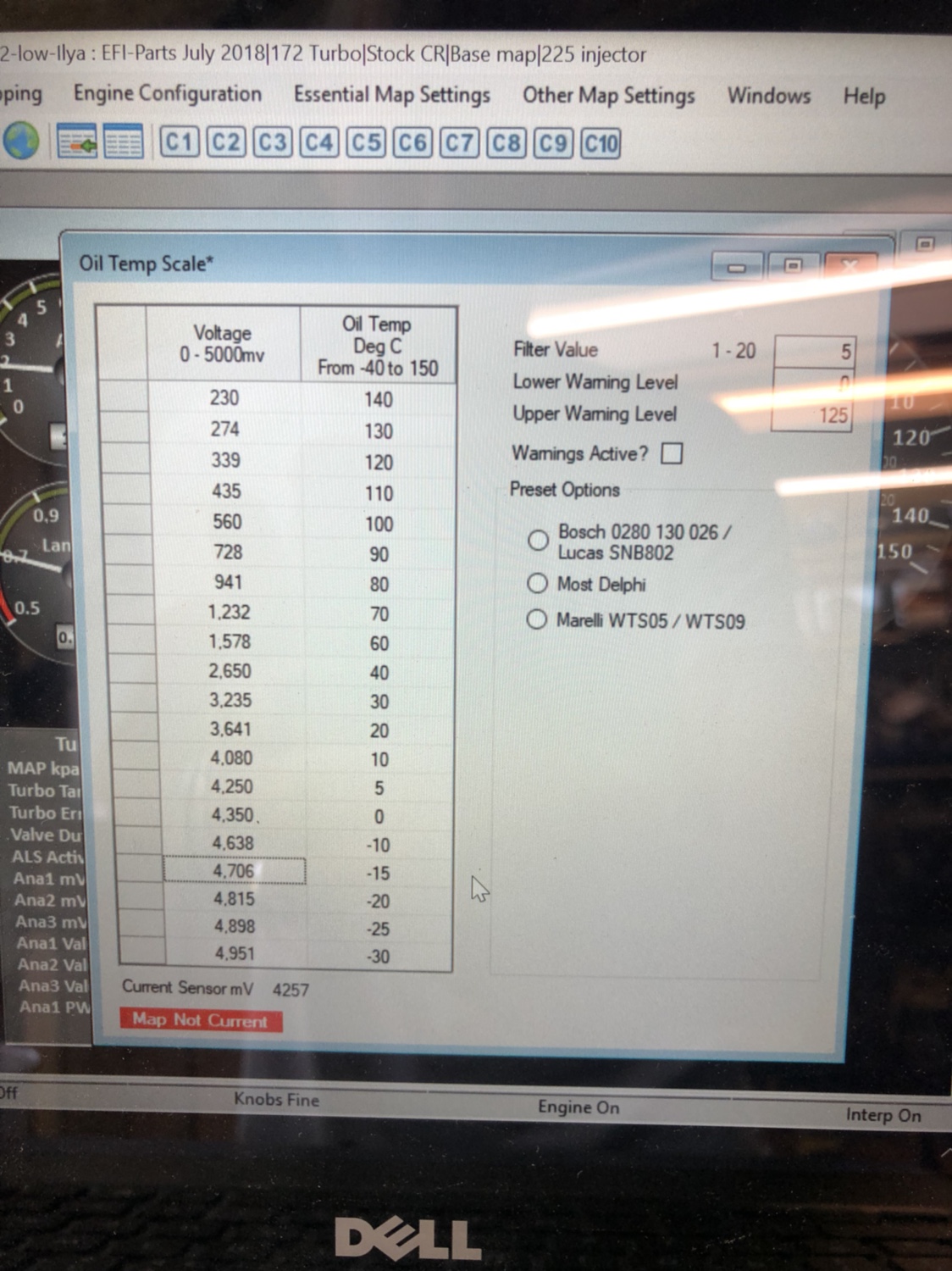

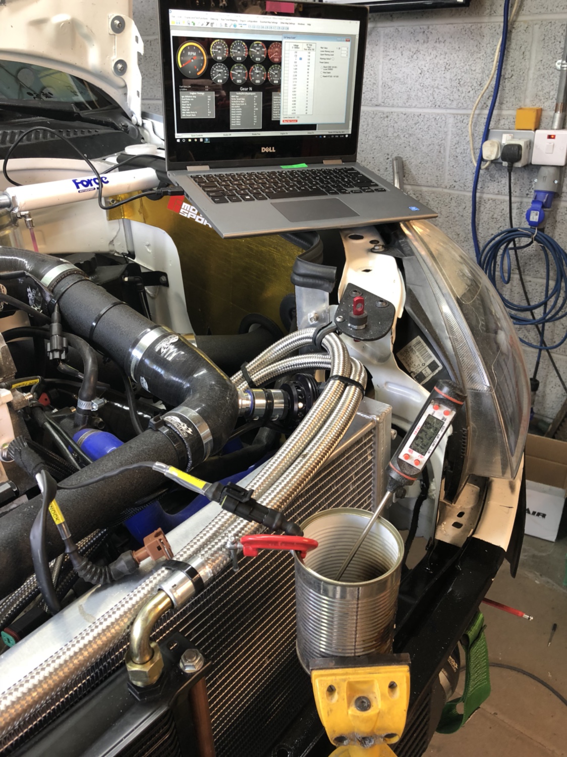

Been playing science today lol.
The correct way of scaling a temp sensor. Heat up in a tin of oil to 140deg. And record voltages as it drops.
Incase someone will find my science useful, here is the sensor I bough: https://rover.ebay.com/rover/0/0/0?mpre=https://www.ebay.co.uk/ulk/itm/163041712258
And here is the table of values. Below 5deg I have estimated it.
Tags: oil temperature sensor sender voltage scale calibration mv DTA s60pro

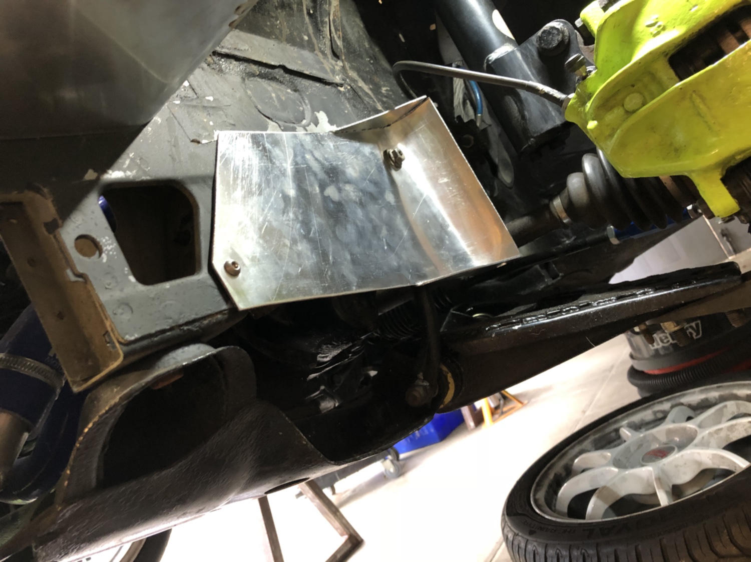

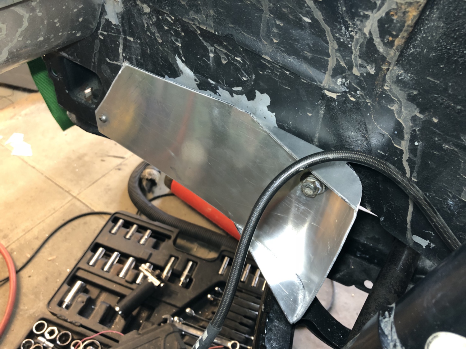

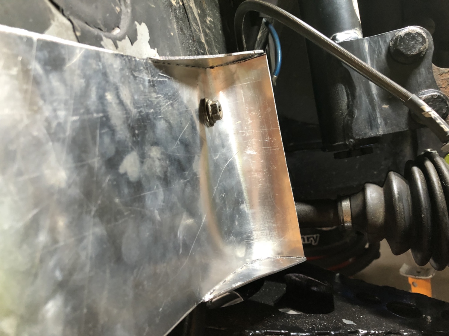

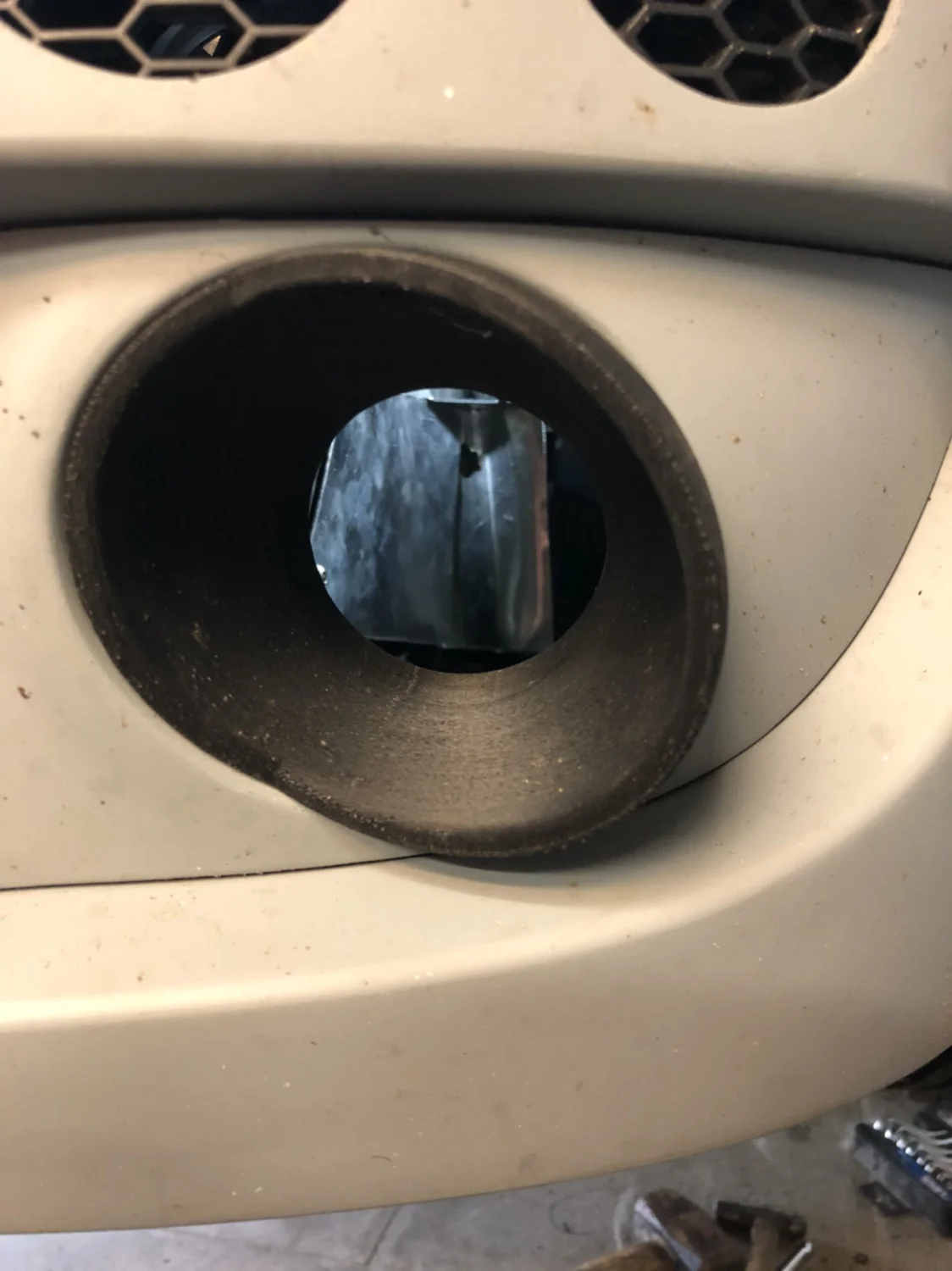

Decided that brake cooling was ineffective, well nonexistent. So decided to fabricate some deflectors. No idea how well it will work or if it will catch on anything but not gonna weld the ends just yet. Will test at rockingham on Monday first. Tested with wheels on full lock to lock and theee is still half inch clearance. Looks good tho..
Need some 76mm ducting to direct the air more efficiently
