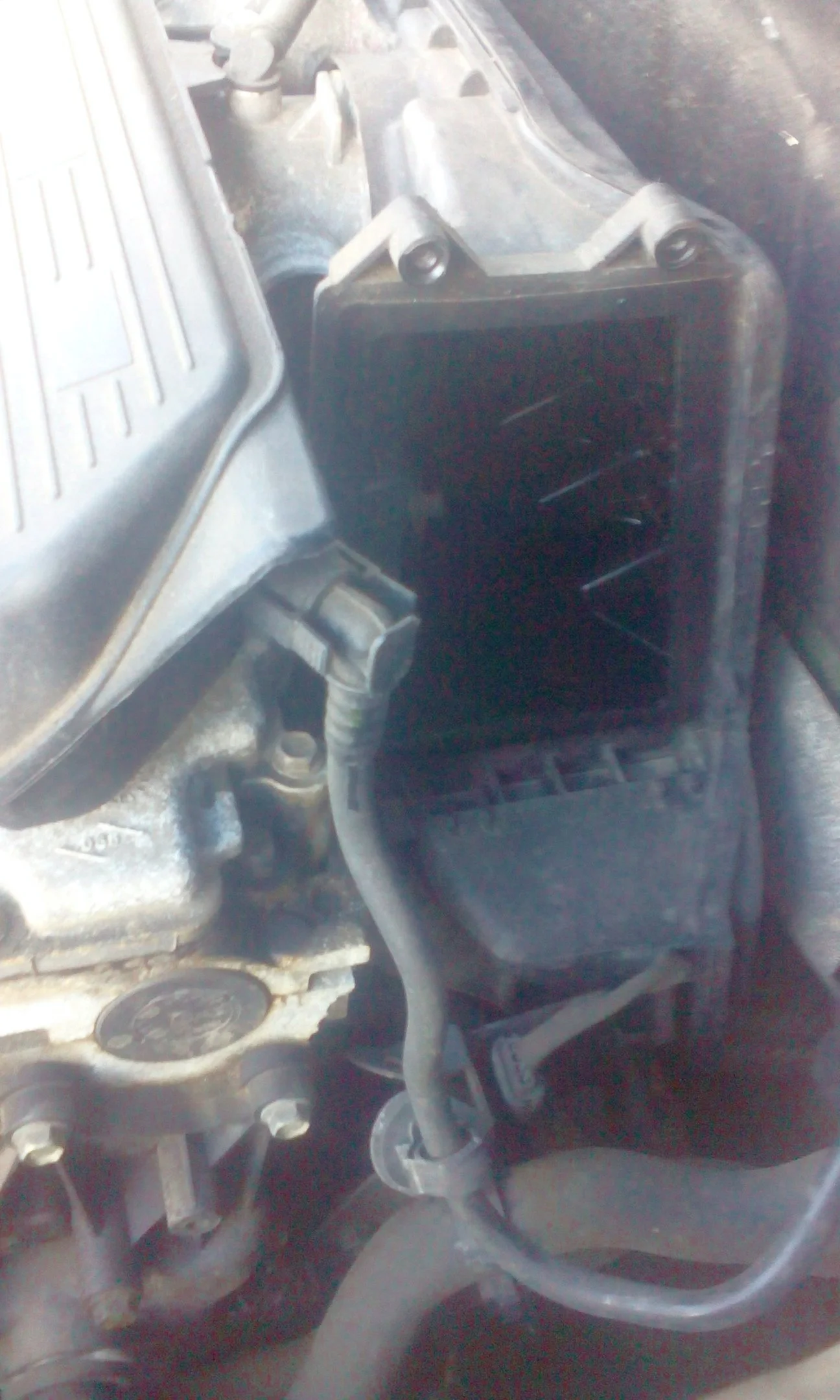

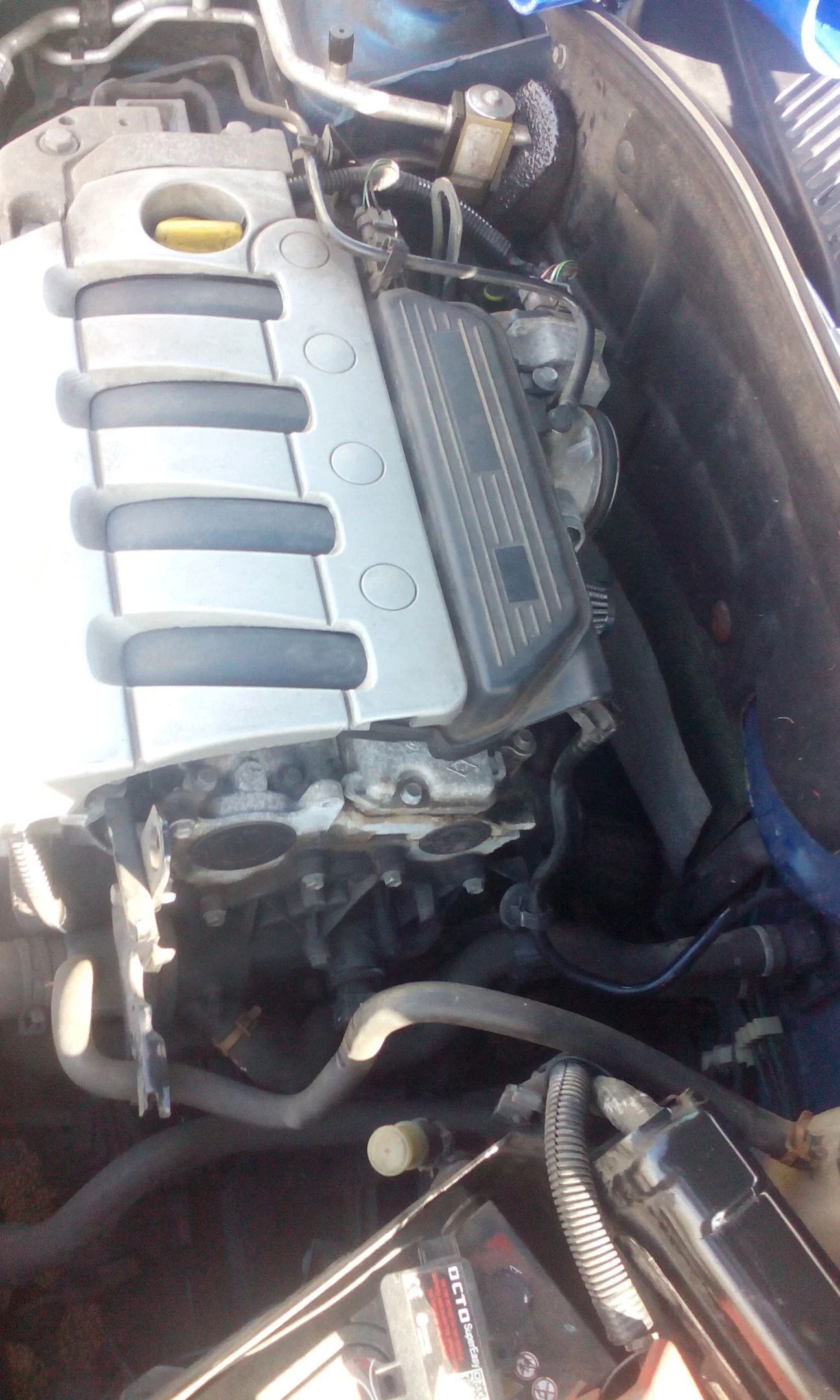

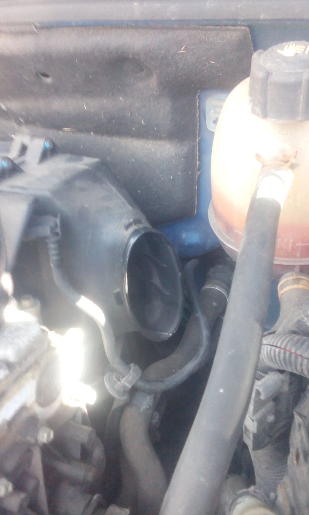

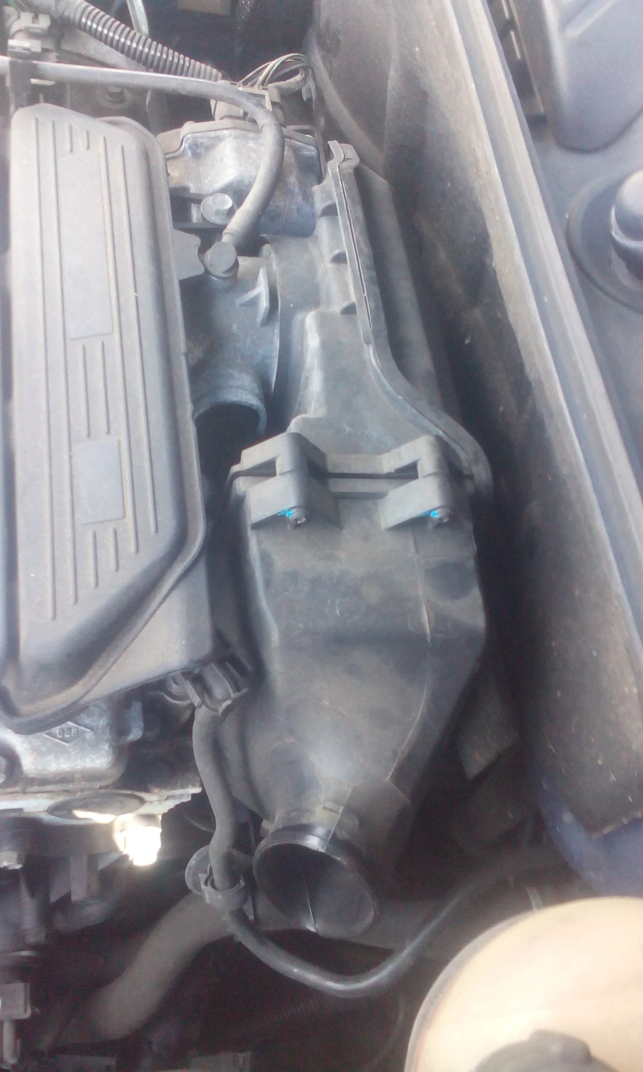

Got some pics, am I looking for something that connects to the oval housing or the square

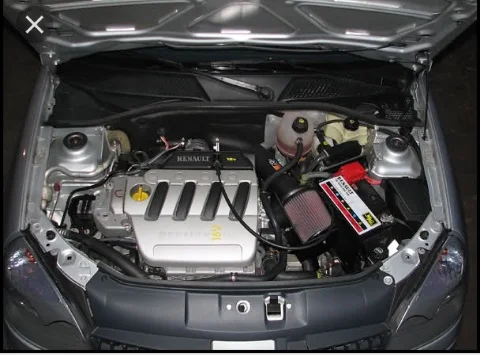

Bit of an update/research, found an old thread on here via Google of the kit too buy for my model, just don't know what one too buy. Photos and a video of noise results although I won't be driving it how he does
Any info on product appreciated, cheers
The changes in Ph on the Mk2 where body and interior related. They won't have changed the induction setup on the k4m so you are looking for any setup that claims to fit a Mk2 1.6 16v
You could even just measure the oval and buy a section of silicone hose a couple of jubilee clips and a generic air filter.
I looked into buying a bit of hose for the oval bit but it's 115mm so was quite expensive, see how cheap a kit I can get

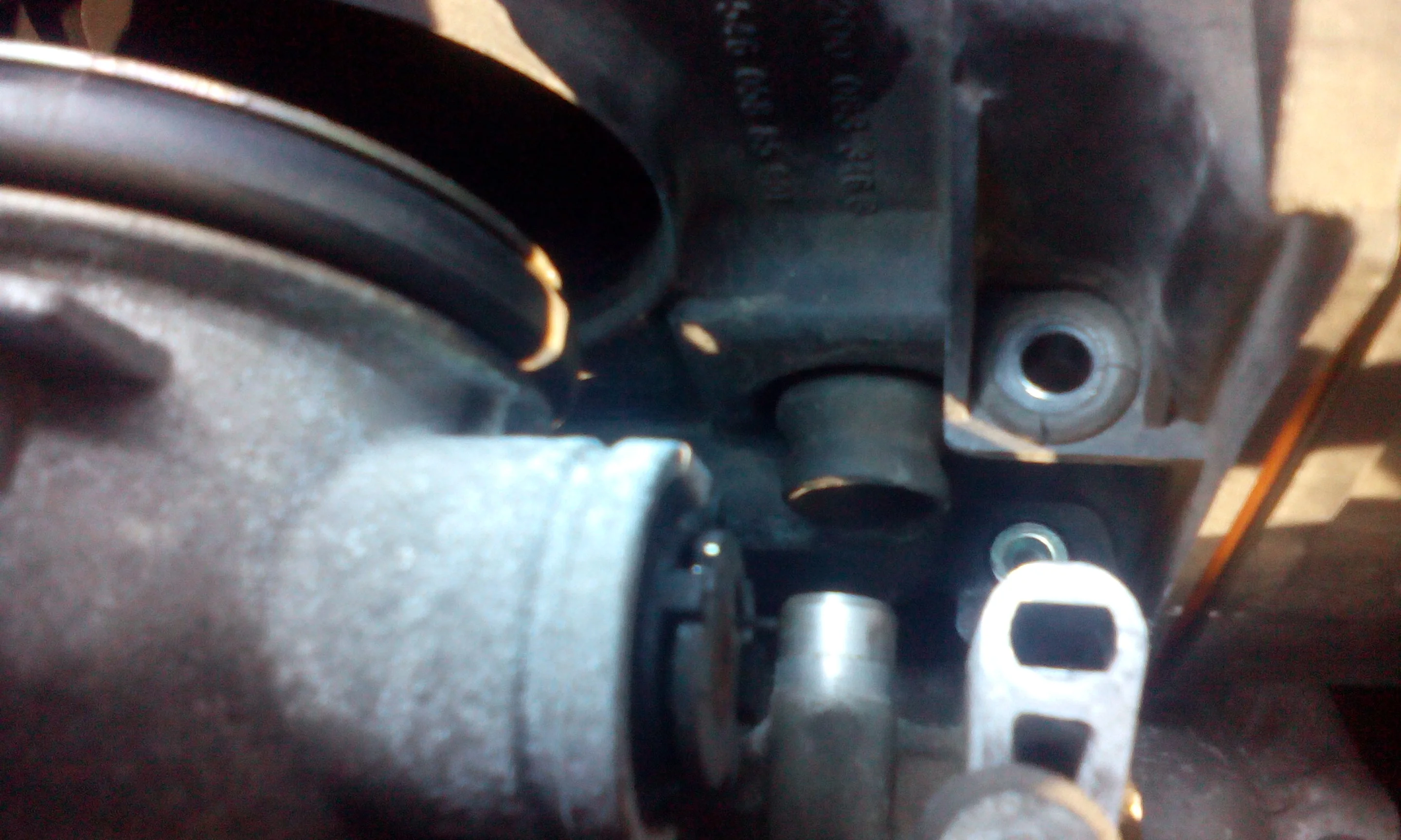

Going too bump an update, took some stuff apart today and as well as having the main air inlet which Is 85mm there is another small air intake which I'm guessing too cool the oil as there was residue around it, how do I get around this if I bought a silicone hose too go straight onto the block

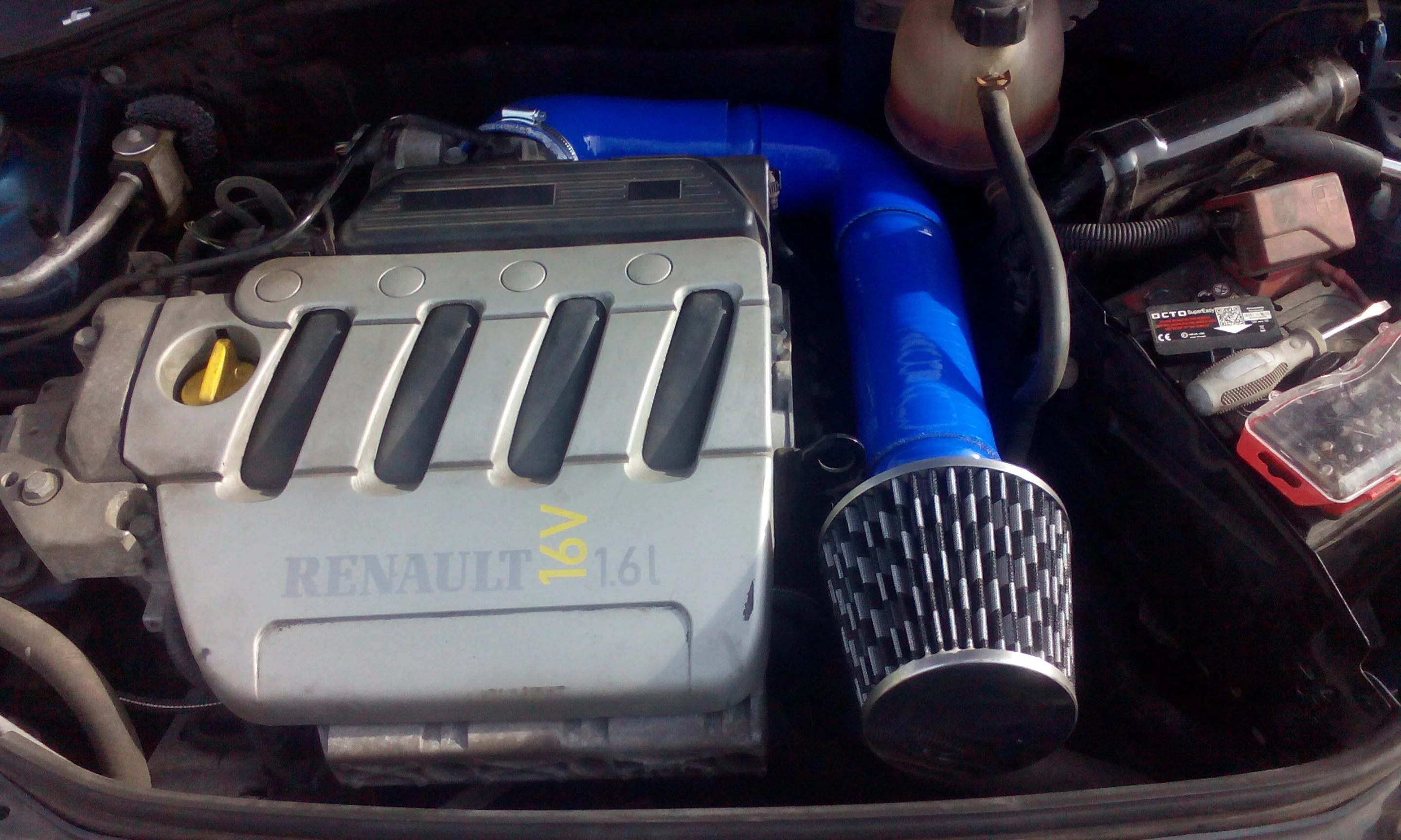

Decided not too buy a kit and do it with silicone pipes now, and I can get a t piece too solve the other inlet issue . And I can do it all in blue piping which I would prefer
Conkered this today
Stripped out factory airbox

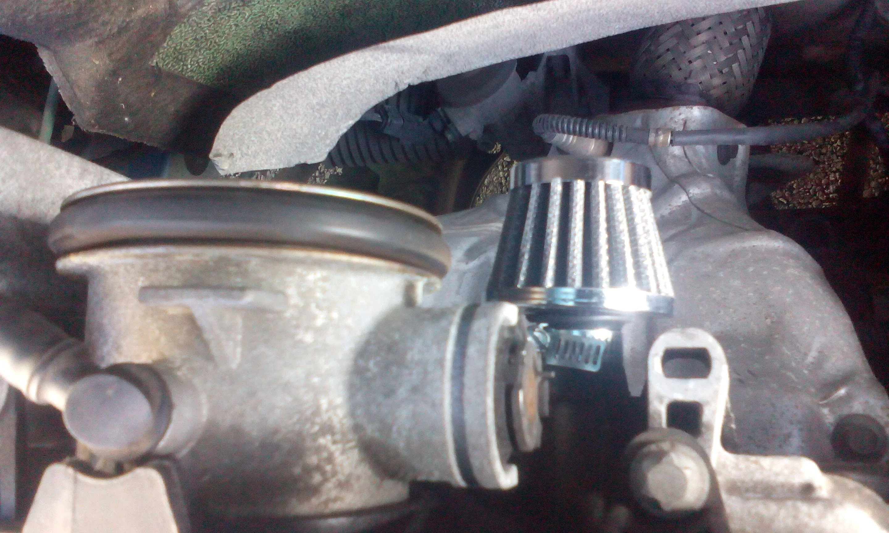

Installed breather for crank pressure thanks to @MonkeyKnifeFight for this solution
Then put the jigsaw together
Happy with noise and look results, no noticeable power difference but this Is just a project too clean up the engine bay.

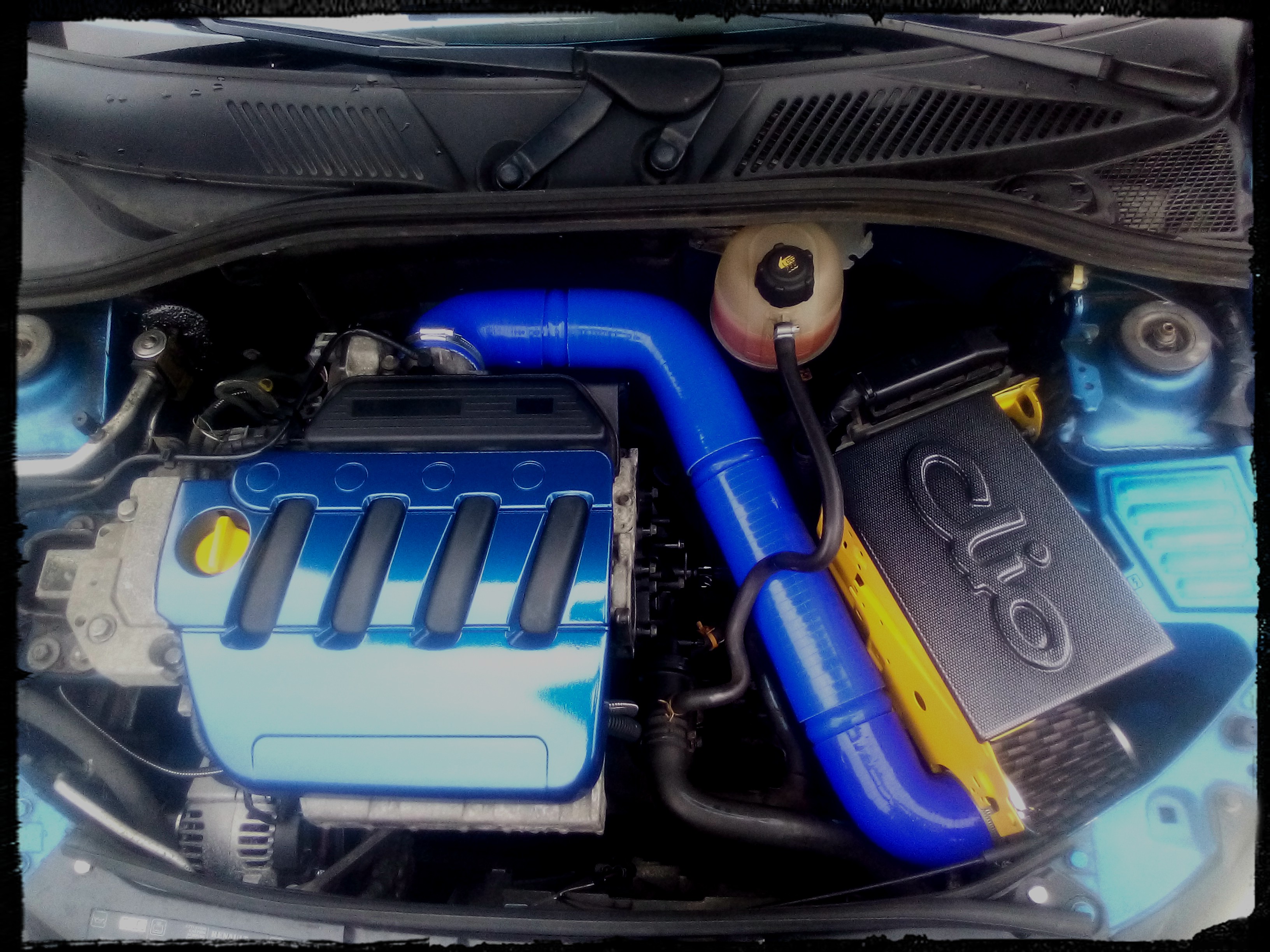

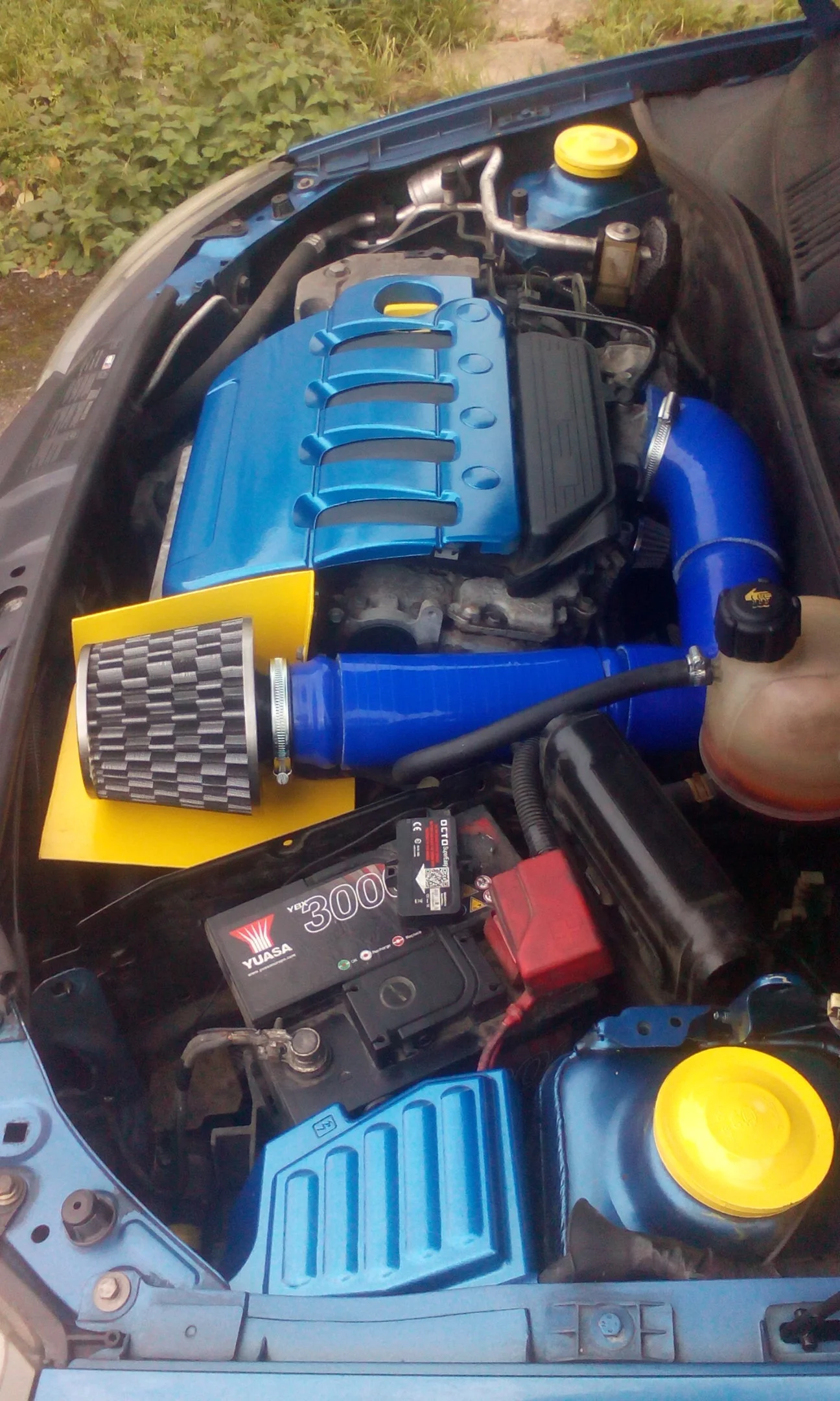

*little update*
After some advice given I fabricated a heat shield from some scrap metal for the induction kit, whilst I was at it I sprayed some other bits up and used some iron out too clean up underside of bonnet now looks like New, just want too spray battery casing yellow and I'm done
*Another update*
Finally got around too spraying battery cage yellow.
Also wanted too go with 1*2 look for the induction kit as it was also getting a lot of heat soak. Super happy 😁
