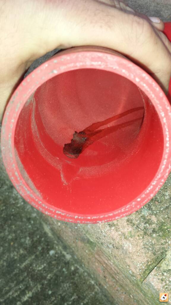

I've had my Pipercross oiling kit sitting on the side for a month - will make sure I use it this weekend! I wasn't aware of the need to do it so often!
What about things like non-foam filters, like K&N cones etc? I know they said to oil it, but i'm fairly sure it wasn't until you'd covered thousands of miles - that said, i took a quick peek and mine's filthy!

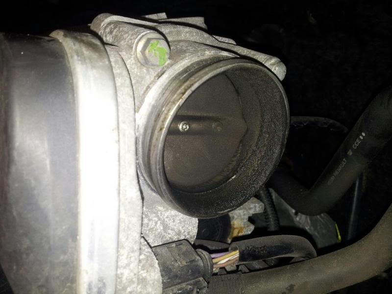

Well I'm glad I have a paper filter now, albeit a bit tatty but I know my TB doesn't look anything like the 2 in this thread.

can you see why i recommend sticking with standard paper elements? because it FILTERS, amazing!
Ive tried many many setups… and guess what, the paper filter won :star:
Engine seemed less torque-y with the foam ones , the tad little resistance of the paper one felt better on the throttle response (must not forget to mention that it's a V6 box)
and oh yeah; they FILTER better

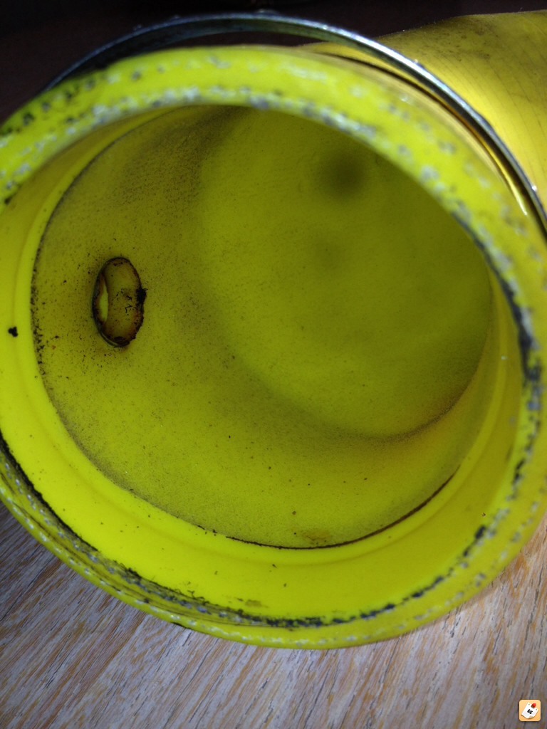

the mesh inside most foam filters is minimal and flimsy, but it does the job. I have use the RAMAIR filter with the 70mm opening on my 182, and a recent RR result had shown a +10bhp increase over the stock filter :) Also according to RAMAIR, the filter is pre-impregnated with the oil in between the 2 layers so doesn't need oiling until you clean it, not sure how true of a statement that is, but so far my TB looks nice and clean.

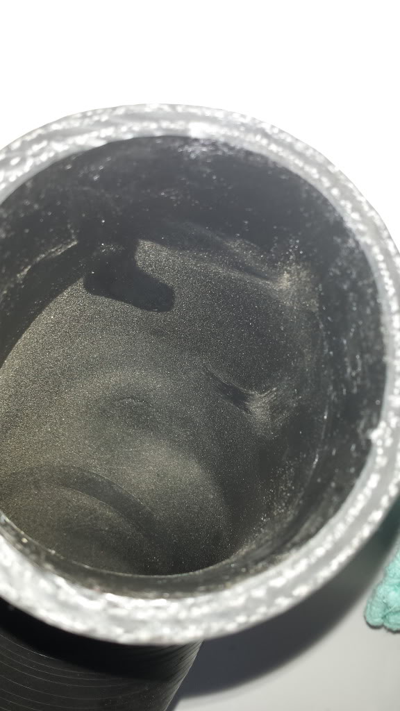

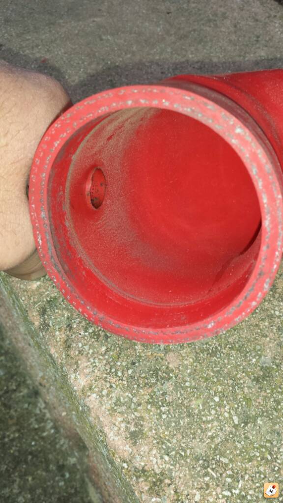

Most companies don't pre oil any more as the oil interferes with VAG air flow sensors - RamAir said it would be fine running without oil but those pictures obviously show otherwise
I've washed the cone and pipe but I've put my standard box back in for now with a foam filter.
My Ktec thing had done about 5000 miles and didn't look half as dirty as some of these though. :S

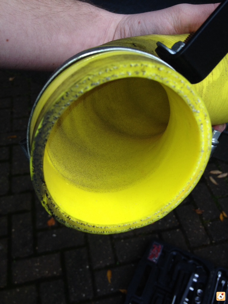

Just taken mine off for its second clean. Not sure if the residue is from before it was oiled for.the 1st time.
Going to get it power tested over next few months. Be interested to see if ive lost any power. Cant believe they dont tell you to oil these!
