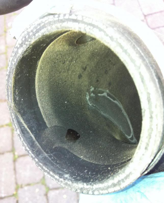

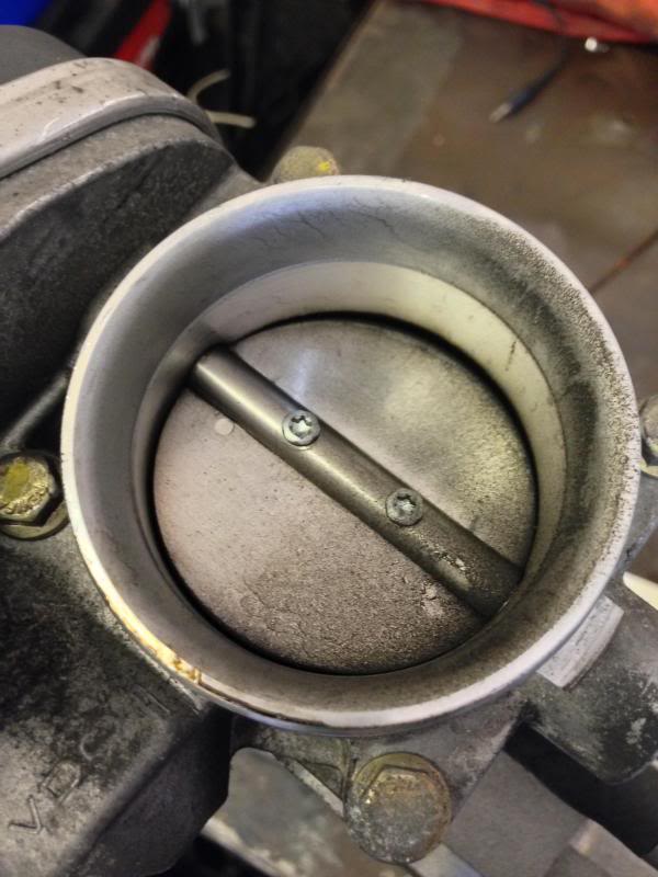

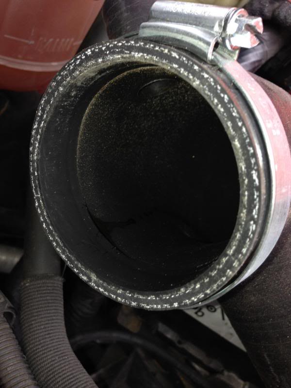

Thought I would post this up as its becoming a regular issue we are seeing at the workshop that will be costing you guys performance, reliability & the life of your engine, if you purchase an induction kit with a foam filter you need to keep it oiled other wise fine particles will not be filtered correctly, below are a few pictures (both of these kits had only covered a few thousand miles of road use) -
Simply applying air filter oil / retention spray will avoid the above issue's, As can be seen the filters should not be run dry as many company's sell them.
