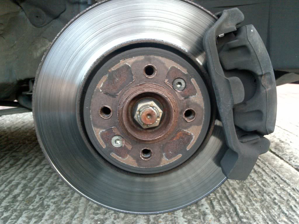

im looking at changing disks all round and need some info.
i found this info posted by Fred for the front.
undo torx screws on disc
undo 1 x 13mm lower caliper slider bolt and remove caliper
remove pads
undo the 2 x 18mm bolts holding the pad carrier to the hub
tw*t disc off with hammer
so im assuming i dont need to undo the big bolt in the centre of the wheel?
what info can people provide me with for changing the rear disks??
no need to undo the big bolt.
Rears are just the same pal, you need to find the correct torque to do them up though otherwise you will shag the bearings.
Its pretty easy really. common sense stuff pal.
