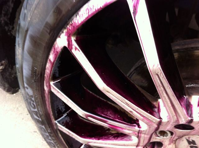

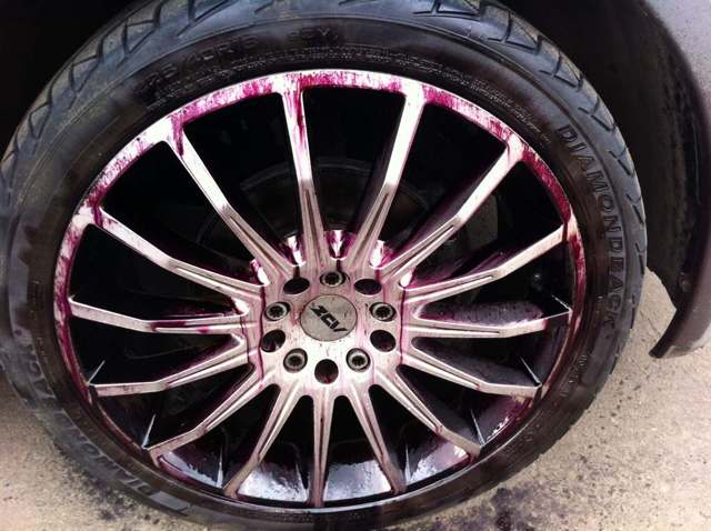

Is iron-x worth using on bodywork? Car is fairly clean without many 'visible contaminants'.
  Golf GT & A4 Avant
If it is a light colour then yes, regardless if you can see them or not, they will still dull the colour significantly.

With IronX, I noticed it was 'bleeding' out of a load of black spots, which are obviously very easy to spot (close up) on my white car.
But it didn't actually remove them.
So is it a case of apply more, or switch to claying? (Which ill do anyway)

Probably tiny splinters of iron behind the tar etc. Can also look like Black but it's just the iron dissolving.

Thanks, looks like ill have to invest in some.

hit it properly first time round with an iron remover, do the prep and seal with C5. car shampoo will be enough then to remove brake dust for minimum of 6months of track use IMO. is still working on our daily car 16months on

So IronX and C5 seems to be the agreed solution then?

Well i'd clean my wheels before using IX i'd also de-tar/clay etc before using X5. It really does have to be done properly.

ironx won't touch motorsport brake dust Tony trust me, Fairy power spray is the only thing that will (don't even have to scrub!)
