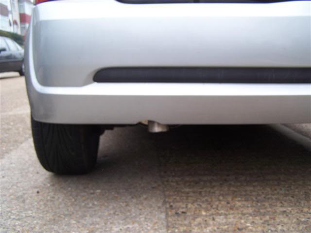

Is this Right ? K-Tec Stealth Mk2

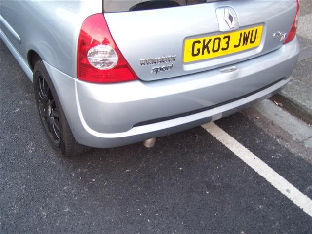

Surely a Stealth Mk2 isn't meant to fit like this ? (Ignore the cut in the bumper, it's from my other exhaust)
I had it fitted last Saturday and it just rattled non stop, we then spent hours last Sunday adjusting it and testing it with no luck at all.
I then got it booked in last Thursday at a local garage to see what they could do. They took it off, refitted it the best they could and even added a bracket between the backbox and the spare wheel well. Great, that stopped the backbox rattling but now it knocks on the back axle.
So i've got a couple of questions :
1) Has anyone else had this many problems?
2) Does anyone else's hang below the bumper instead of being 'neatly hidden behind the rear bumper giving a standard look' as described on their site?
I emailed K-Tec last Tuesday to check i'm meant to be using the Renault mounts and to check i wasn't missing something from mine, but i've had no reply so far.
Taking the cost of the exhaust and labour (about £400 now) i probably could have had a custom stealth system made cheaper and it'd be right by now !
Looks like its hanging too low, i.e the back box isn't mounted high enough, but also it doesnt look like its set back far enough.:S

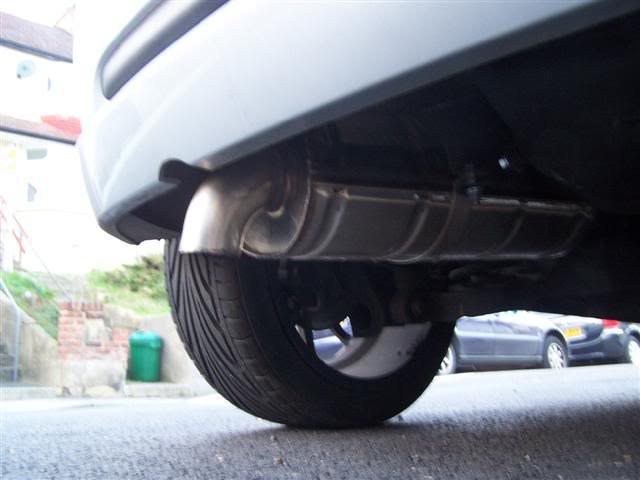

I have this exact problem mate, i'll post up some pics, got mine fitted a couple of weeks back. It seems to hang really low :dapprove:

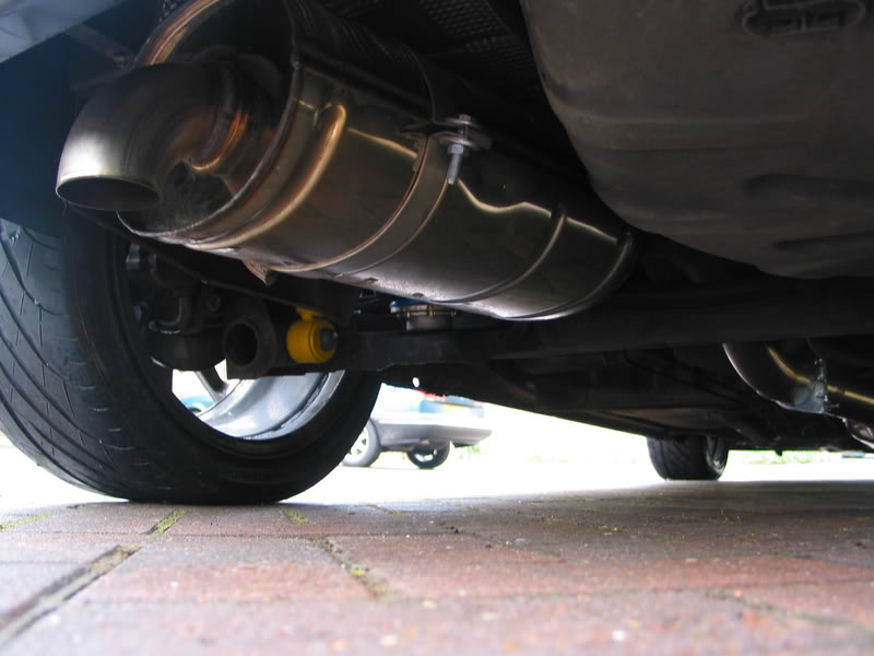

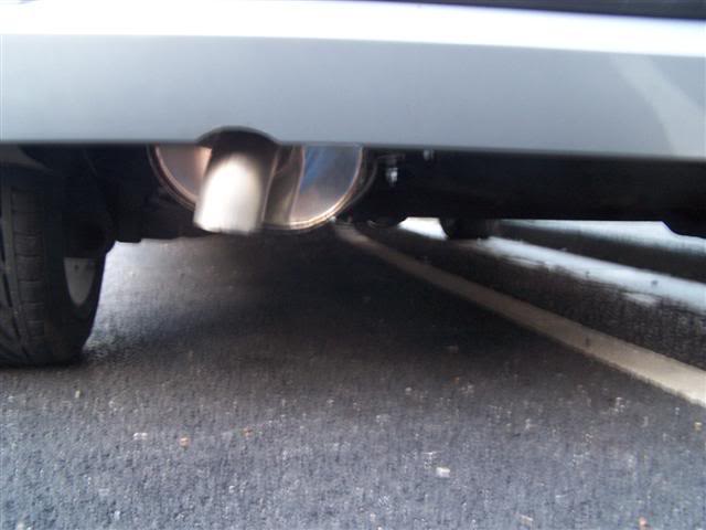

I got a new Renault bracket\mount fitted with mine, thought i'd stick a pic up. Is this adjustable then do we think ?? Surely more people must have come across this :dapprove:

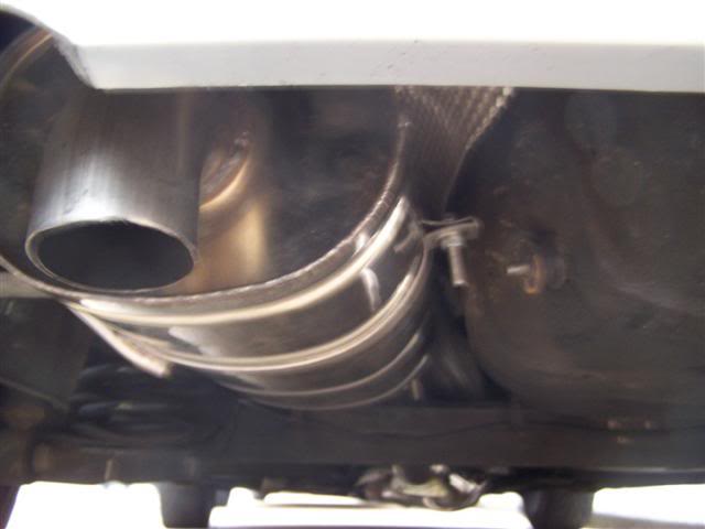

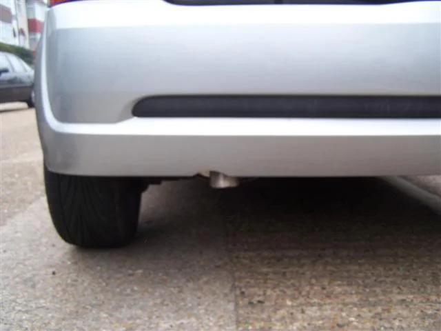

This is mine. It sits even better now it been tweaked a bit. The rear box has a hanger that is on a 'band'. If you rotate the band/hanger around the box that I reckon you should be able get it sitting right! I'll have a proper look tomorrow at mine if you're still stuck;)

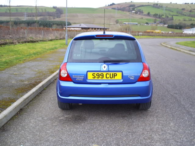

Here is my stealth,
Had it for a couple of months, sits up nice, never rattles or vibrates, well pleased with it.

you will need to bend that "band" after turning it to make it fit the curve of the rear box.
Yeh, I'm sure it's just a case of bend and rotating;) Shame I didn't fit mine as I could have been some help! I just got the garage to do it when my 'cat' problem was being sorted. I can ask the guys there what they did if worst comes to worst!

I reckon it's just been fitted poo! The zorst has to go over the rear beam then come down again. The amount it drops is dictated by 2 things, the height of the mount on the car (fixed at a set height with a rubber mount in it I think) and the position of the mount on the box. Either the mont on the car is in the wrong place (this I doubt) or the mount on the box hasn't bee positioned right! Rotate it lower on the box, this should lift it up!

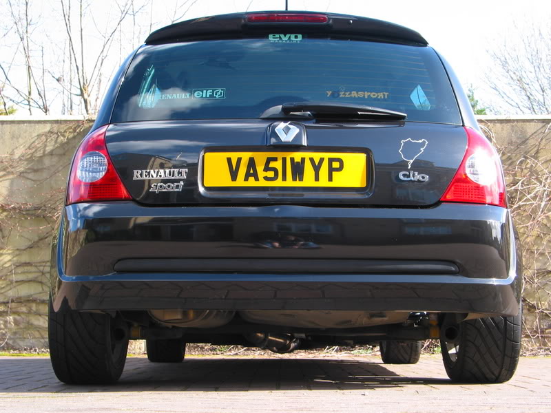

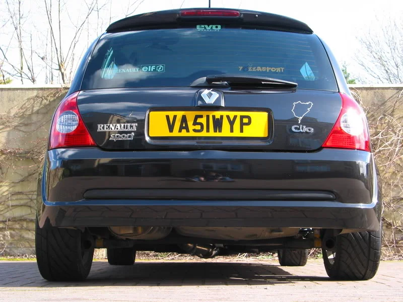

my stealth tucks up so you cant even see the pipe. the backbox is about 1cm off the heat sheild.
the downturned tial pipe end is at the same level as the bottom of the bumper.
took some wiggling etc to get it to sit that nicely though. worth it as it doesn't look any different at all from standard.

my 172 exhaust was similar, firstly i packed the bottom of the exhaust mount, this raised it up alot.
then i was getting the rattle from the axel.
it was a pain but basically you need to free everything off, wedge the back box as high as you can get it, tighen it all up and then see what happens when you let the back box go.
i ended up having a 2nd exhaust mount on my 1.4. did the job and all the rattling went.

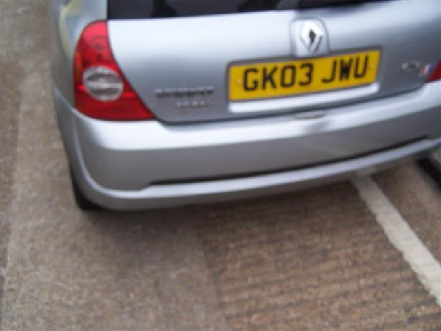

That shot is taken from a helicopter though right ;)
As long as you're happy mate, just showing it's not impossible, as after all it is meant to be hidden :)
