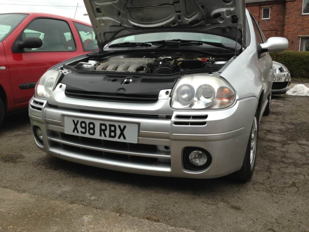

See where your front towing eye goes in? That front facing at both sides is colour coded on yours but from the factory they were jet black. Its a bit geeky i know lol but its a good way of knowing if someone has an original unmolested bumper. Managed to find this out because i had a genuine replacement bumper fitted and sprayed after a bump and mine is like yours colour coded and originally as bought new these were black.
Aha good to know thanks, not had any bumps I don't think, no indication of having one so could of been possible respray.
Cheers buddy.
  Ph1
Yeah could have just been a resprayed bumper to tidy up stone chips. I wouldn't worry tho mate she looks proper mint, total bargain as well :cool:

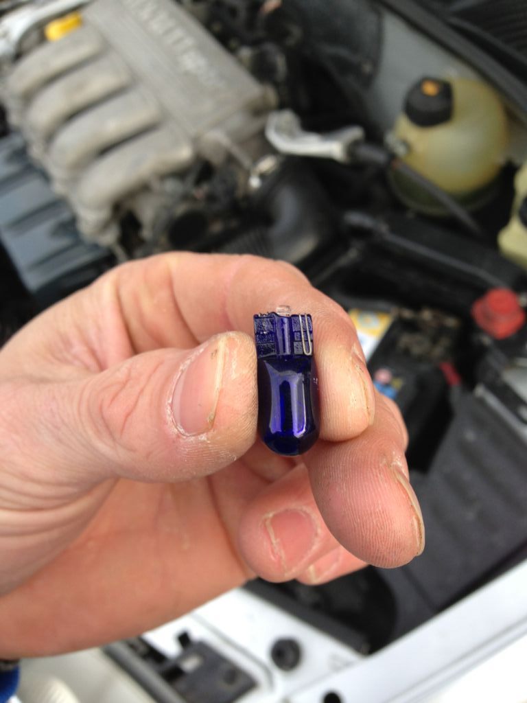

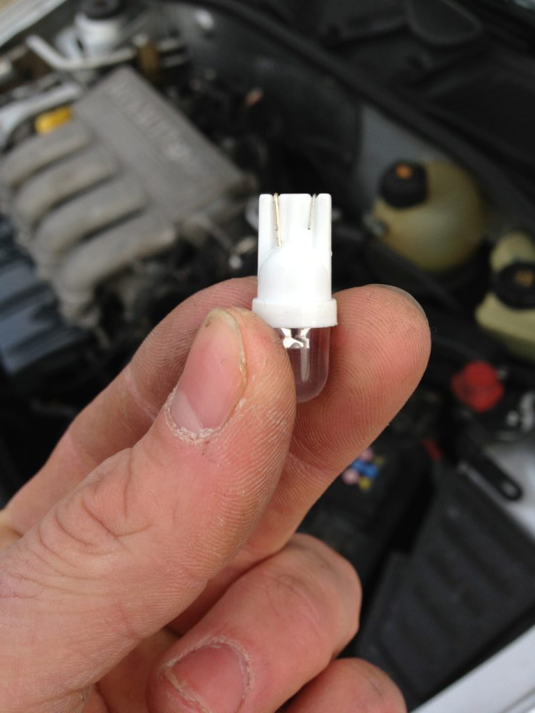

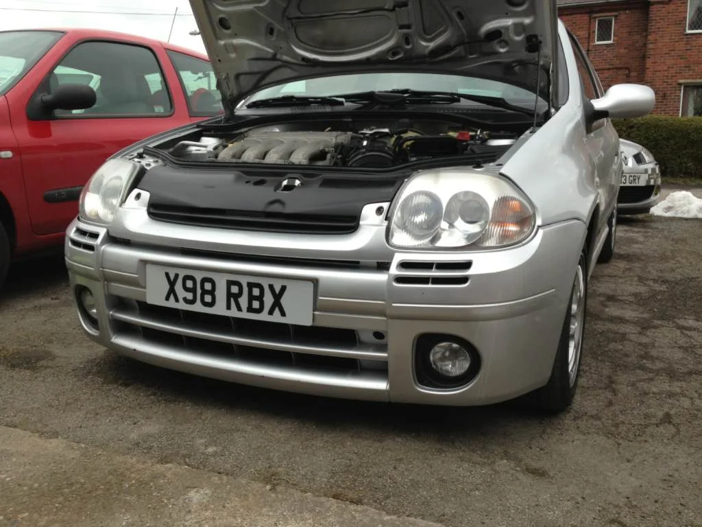

So today i Changed the sidelights as they were shocking.
Got some hid's on the way and going to polish the headlights :)

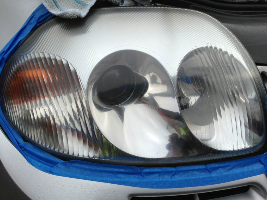

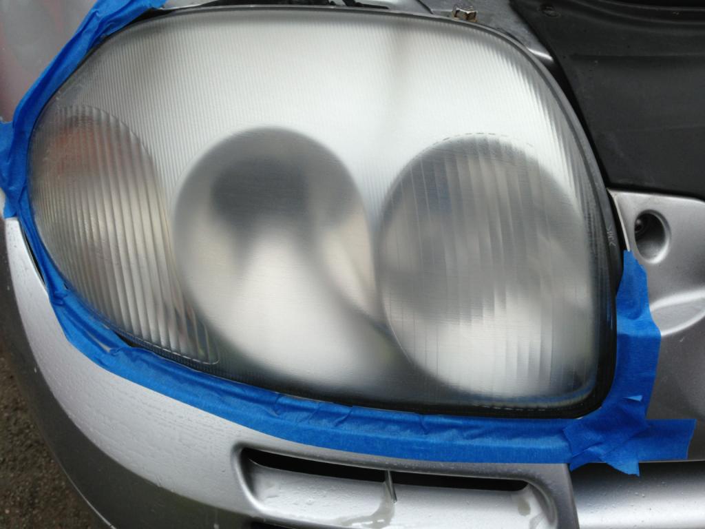

So today I decided to give my headlights a good sanding back and polish up, as they was scratched and hazed a fair bit. ( just an excuse to do them ;) )
I stated of masking the area of the headlight, filled a spray bottle with warm water and washing up liquid.
The process
Spray and wipe down headlight
Spray grit paper and headlight
800 grit sanding all over, wipe down
Same again using these different grit papers
1200
1500
2000
Wipe down and inspect headlight.

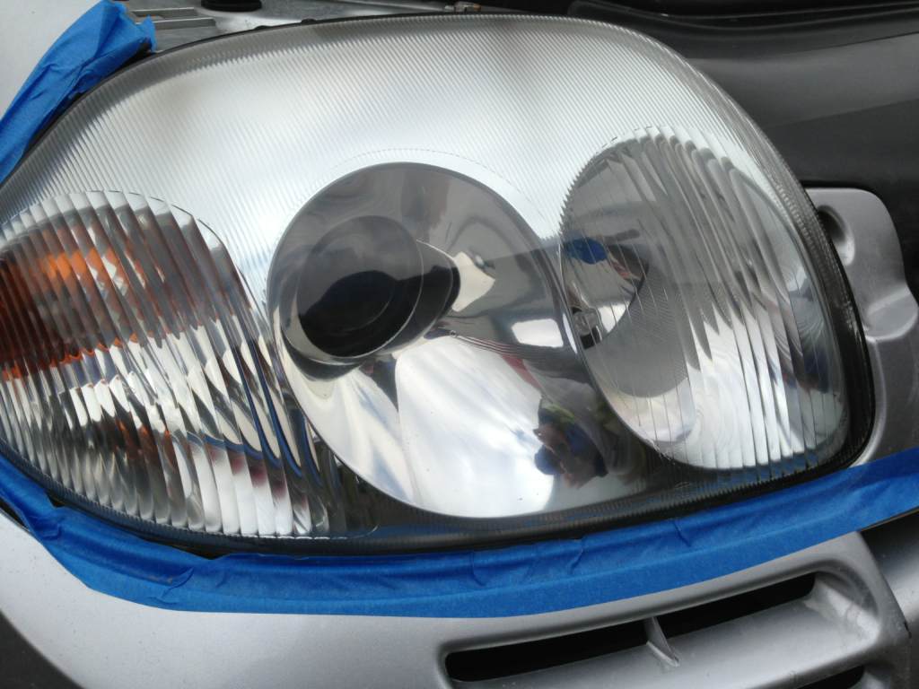

Machine polished with da, using cutting pad and megs Compound.

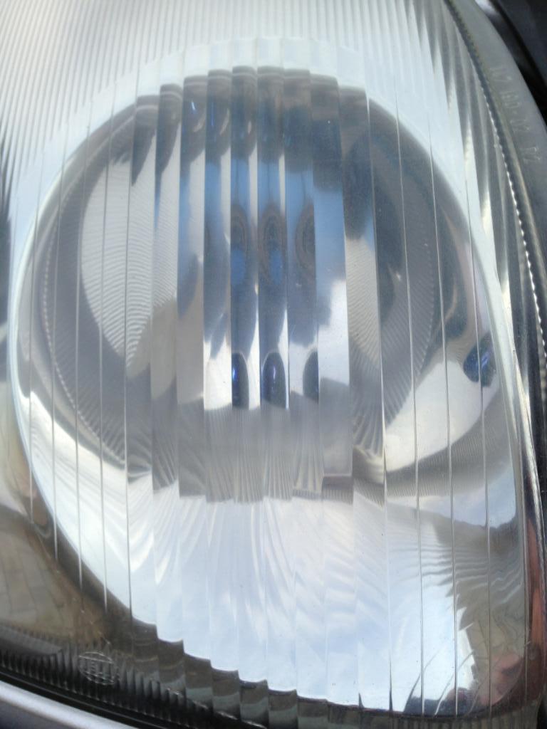

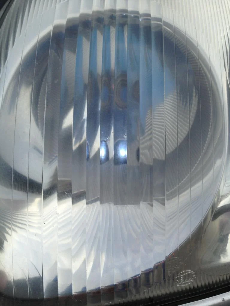

Here is the results
Before
During
The Finish
All an all quite happy with the finish and protected with bouncers 22, just as it was the first thing I dug out.
