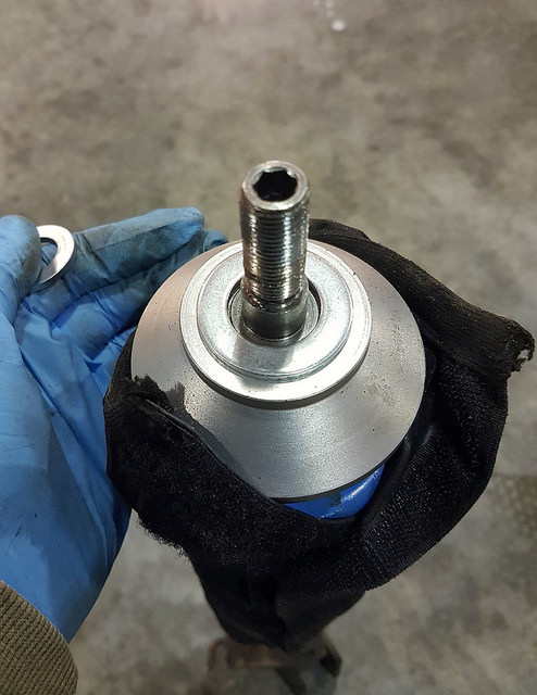

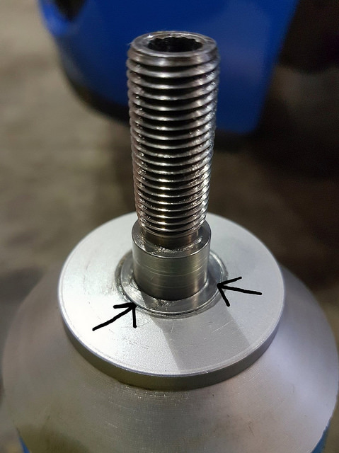

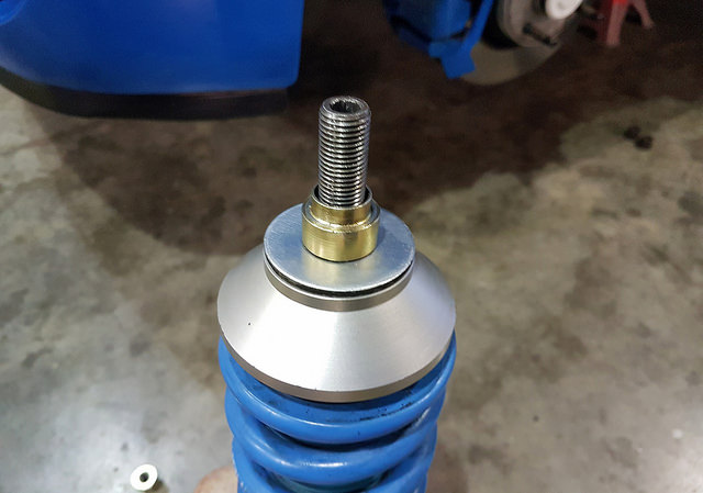

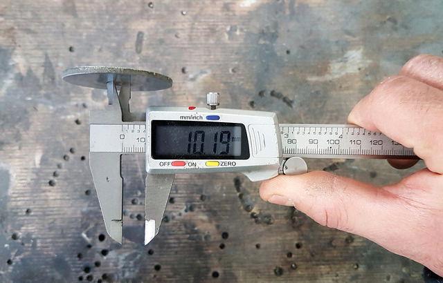

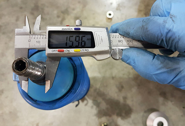

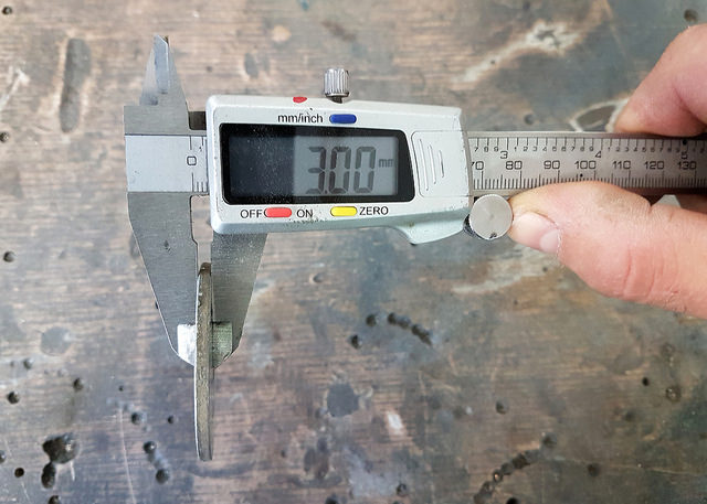

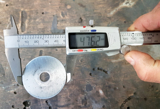

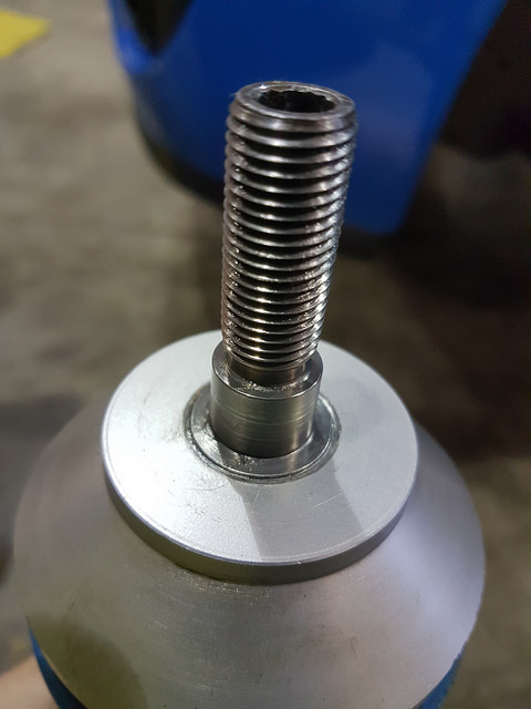

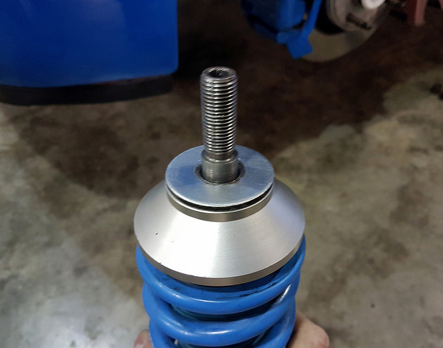

So i was getting annoyed with "top mount" knocking noise. I thought the bearing maybe sitting to high with both the 16mm and 22mm washers so i used my old rear bilstein washers and drilled them out to 16mm to try as ive seen others having one washer, some even having none.

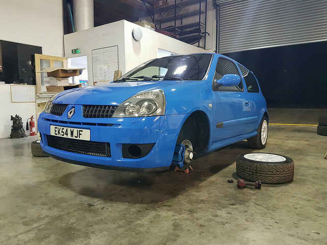

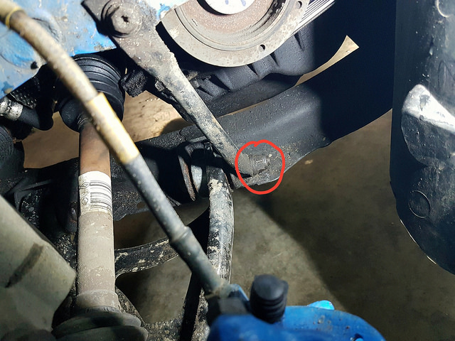

I tried this setup. Fitted the bearing, put it all back together. Drove around the farm and it still knocked! I can only hear it on the drivers side. So in i drove, jacked up, wheels off and head scratched. Decided to check everything was tight, suspension related as i'd done the recent suspension overhaul. Everything was tight and i was confused until i checked the front lower arm bolts. The nut that connects to that and the stabilizer arm (i don't know its real name) was slightly loose. I tightened it up, did the same on the passenger side (although everything this side was tight) refitted everything and test drove it around the farm...... and no knock! Great!!
The Culprit:

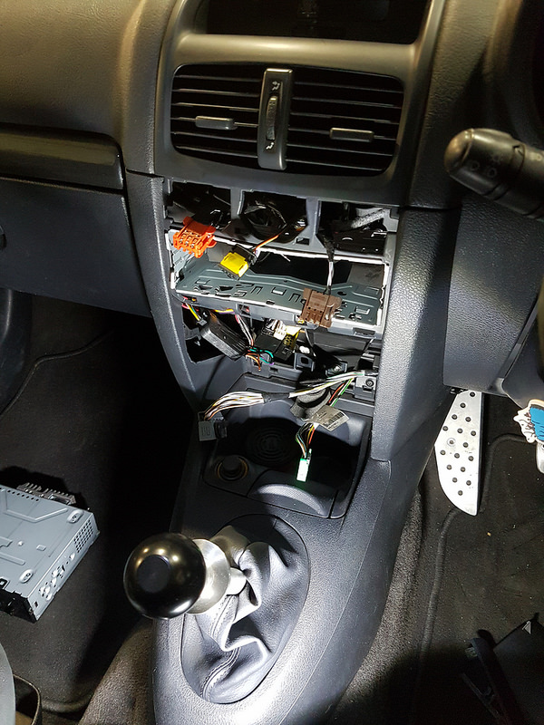

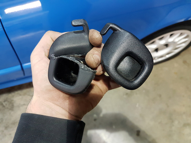

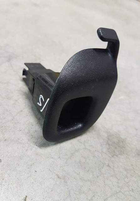

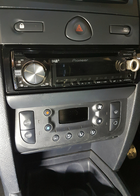

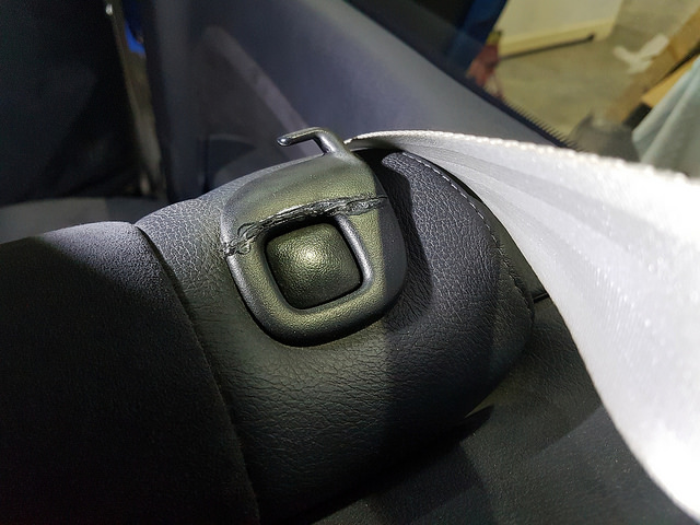

Earlier in the day i had my non sport stereo strip and replacement drivers seatbelt clip (mine had snapped and been bodged with superglue) arrive from @mossyv6. So i decided to fit these, being happy i found my knocking cure!
Just need a non sport climate control panel now to complete it all. Well ideally, id like a tunepoint. If i found one of them, then id get a standard non sport tuner list stereo but until then, i'll keep my current one for now.

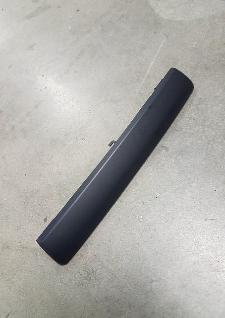

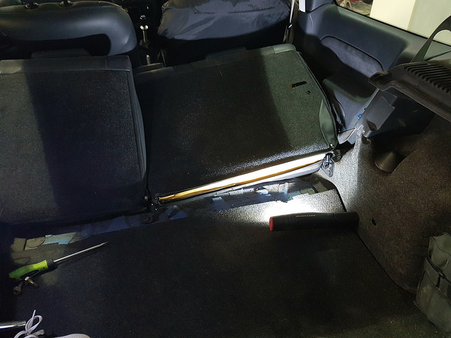

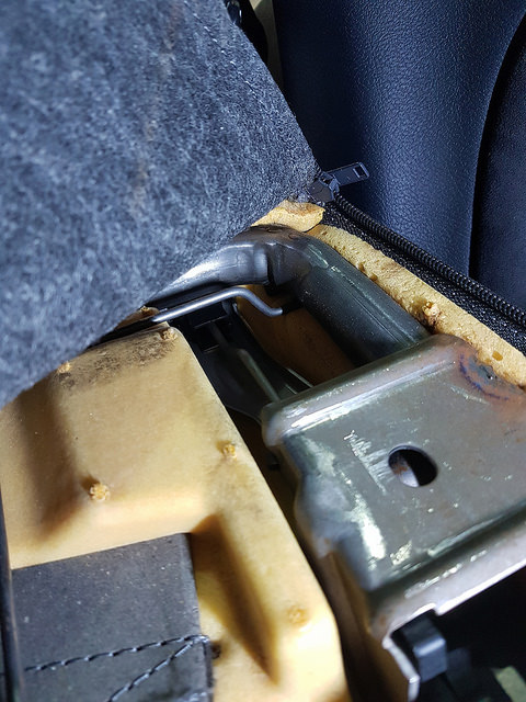

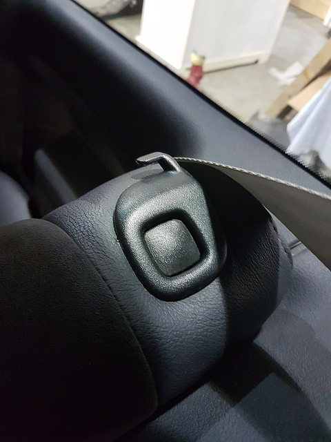

Next up was the rear seatbelt clip change. I used @mossyv6 guide which was very helpful. I did it all as described, but kept my rear seats fitted. It can be done this was as described in he's thread but i removed my isofix bar to get better access for the zips.
https://www.cliosport.net/threads/g...-trim-piece-replacement.812808/#post-11496575
With that, i put the tools away as i wanted to come back to work and change the modified washers to the original supplied ones from PMS. Reason for this is my modified washer didn't sit completely flush as there is a very small lip on the bilsteins and i would rather it all be correct as seen here:
This morning i got into work early to do the washer swap.
Drives great, no knocks, happy Jekyll :smile:

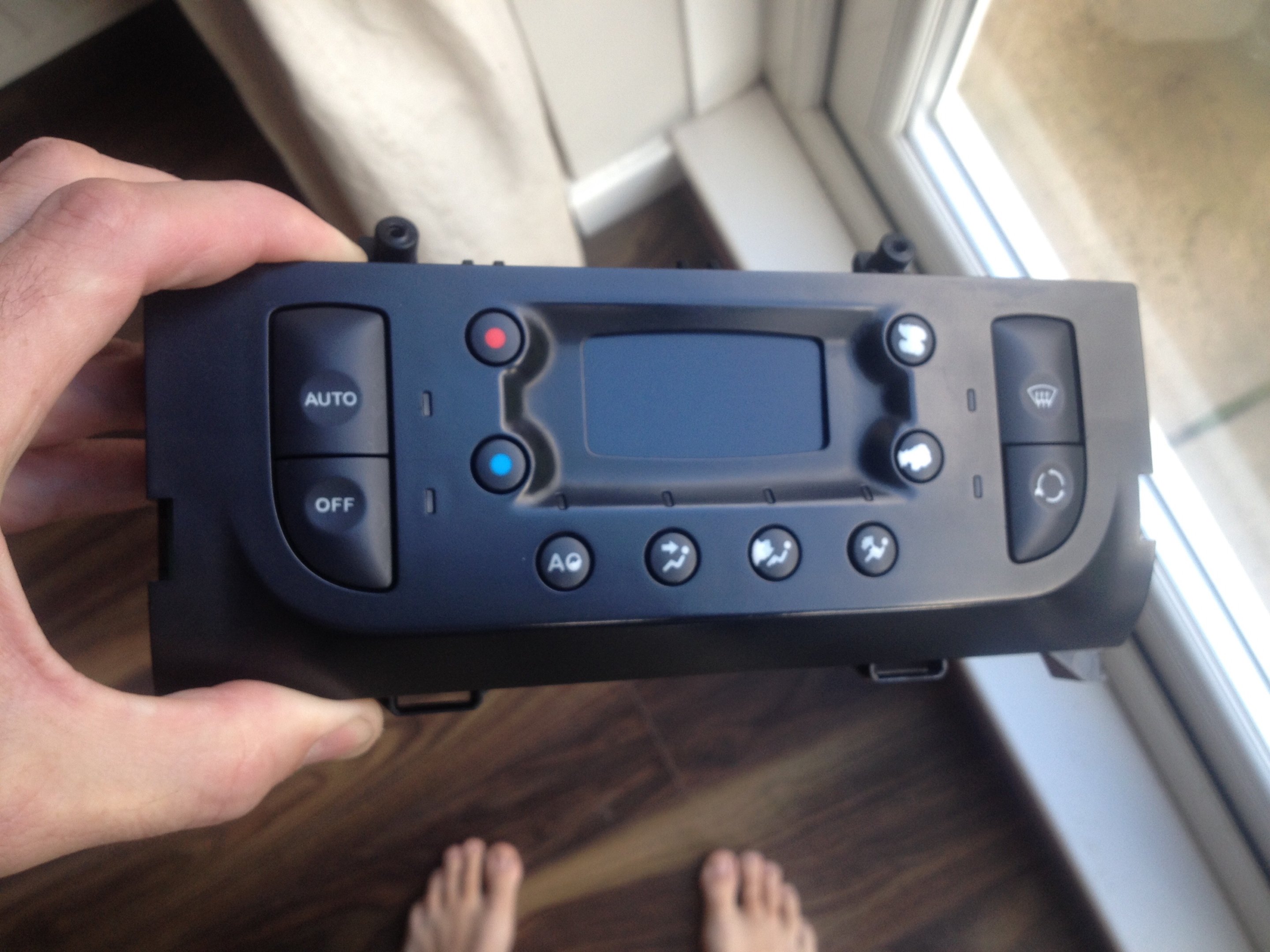

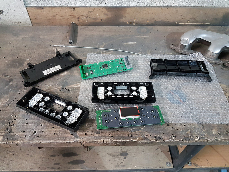

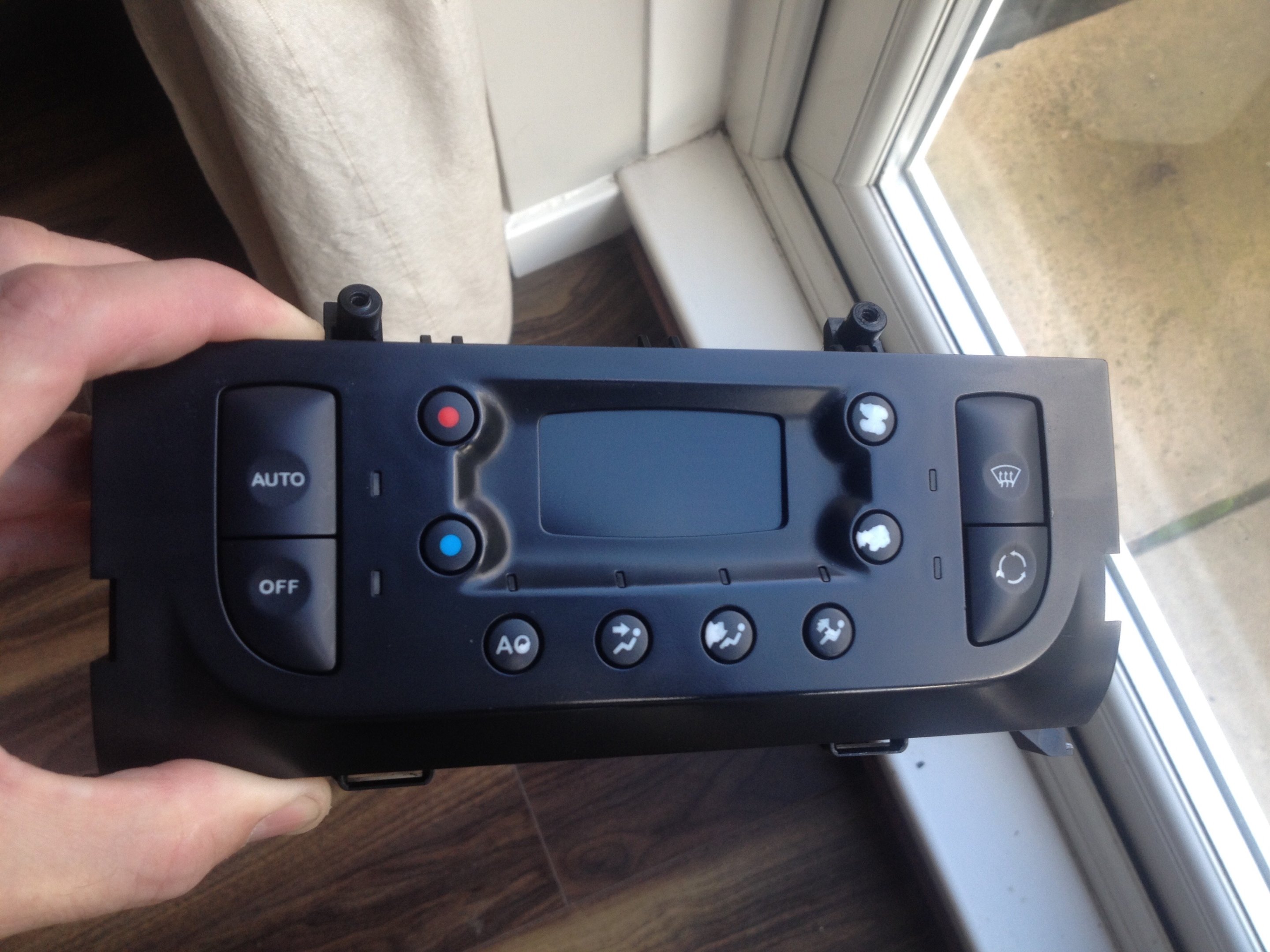

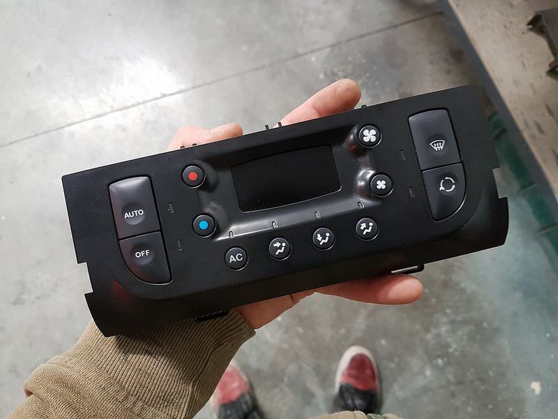

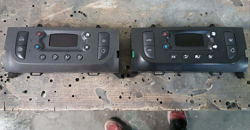

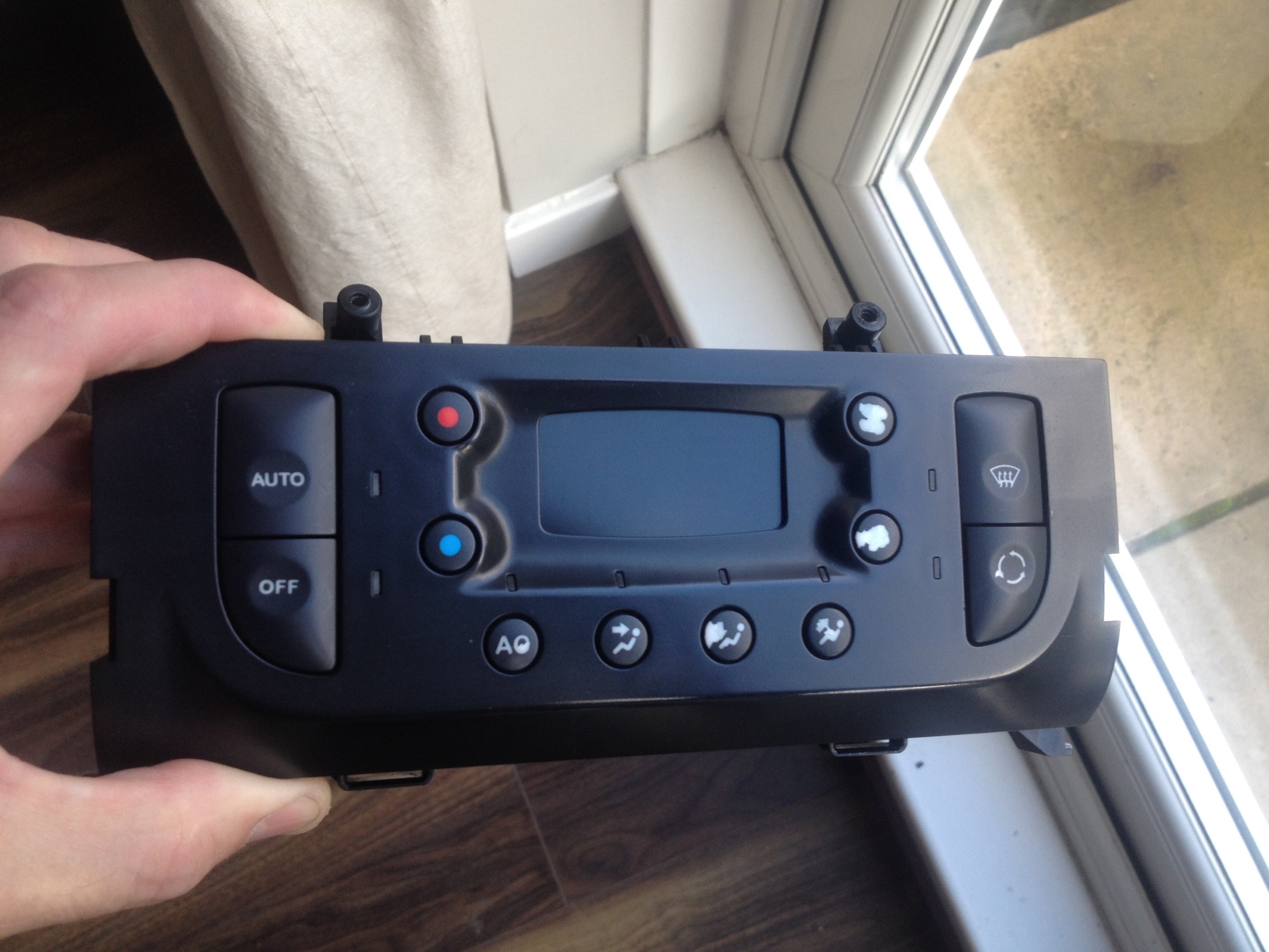

Just seen your after a non sticky climate control - I have one here but has no buttons in it as I used them on my previous racing blue. I will dig it out for you and get a photo if you're interested?
Its all good Paul, thank you. Your guide came right in handy. Probaly wouldnt have dome it without that tbh.
Yes buddy. If the buttons are easily swappable and it's in VGC I'll take it of your hands.
The buttons are easy to swap in the climate unit Mark. I did mine as they were all scratched off. Good work finding the knock.
This is it mate, looks ok to me. I have just put a set of buttons back in so it is a complete unit but will need changing as they have rubbed away.

Honestly Steve, apart from the removal of the isofix bar, its a really quick swap. Probably 20mins total if you follow the guide and remove the isofix. I only used a flat headed screwdriver and a 17mm socket/ratchet.
I did check your thread actually earlier. I will take a pic prior to swapping ;)

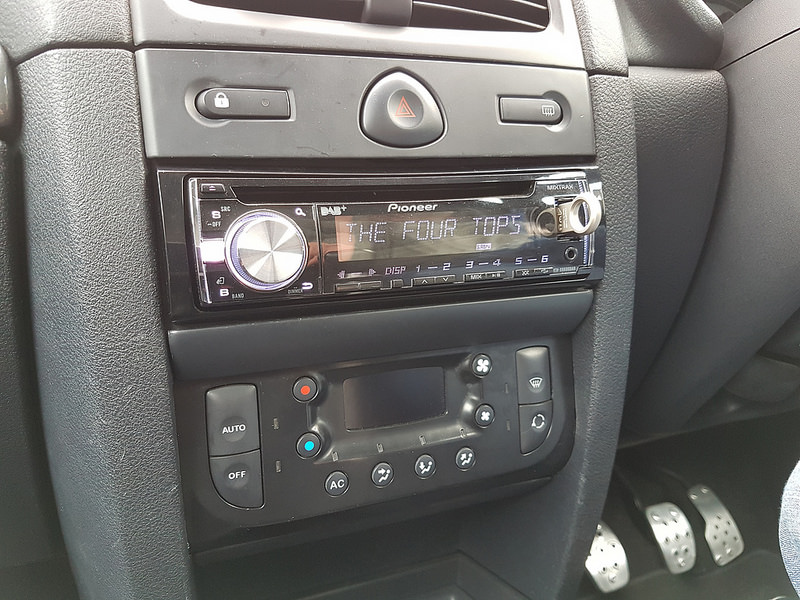

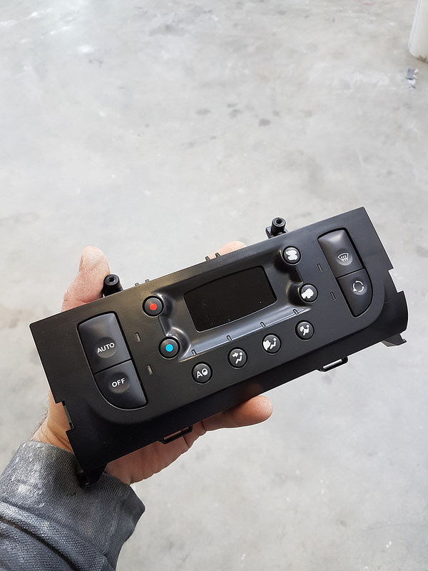

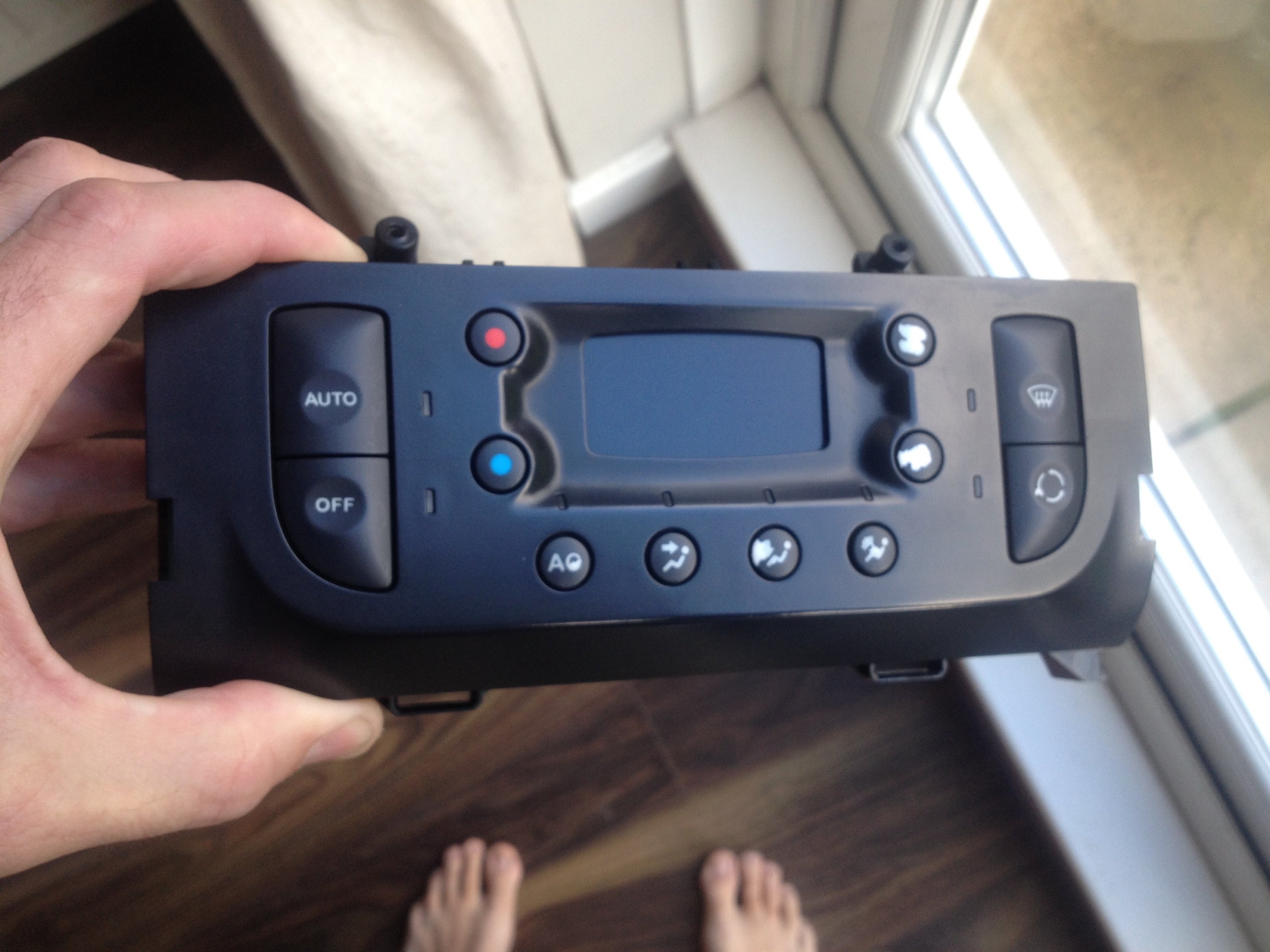

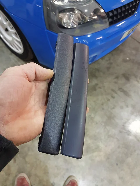

I got my climate control panel fitted that i received off @mossyv6. I swapped over the buttons from my one to make the best one out of both.
Works as it should. The only downfall is that its black. I thought it would be grey like the buttons. I'm not sure if non sports come with both. Either way its fitted and i got to admit i dont notice it mostly. That could be because were in winter season. If they do a grey version then i'll buy another one but this will do for now. No more tackiness!

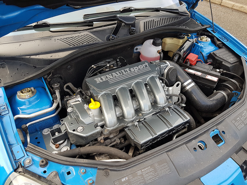

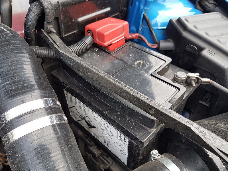

Going through my Flickr account and i found a pic of the engine bay. Not sure why i took it but, why not post it in here eh?!

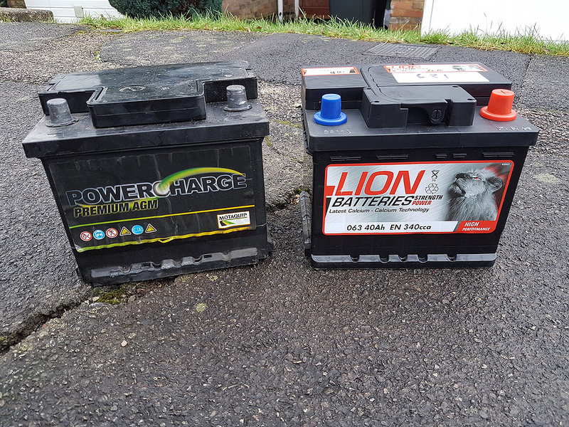

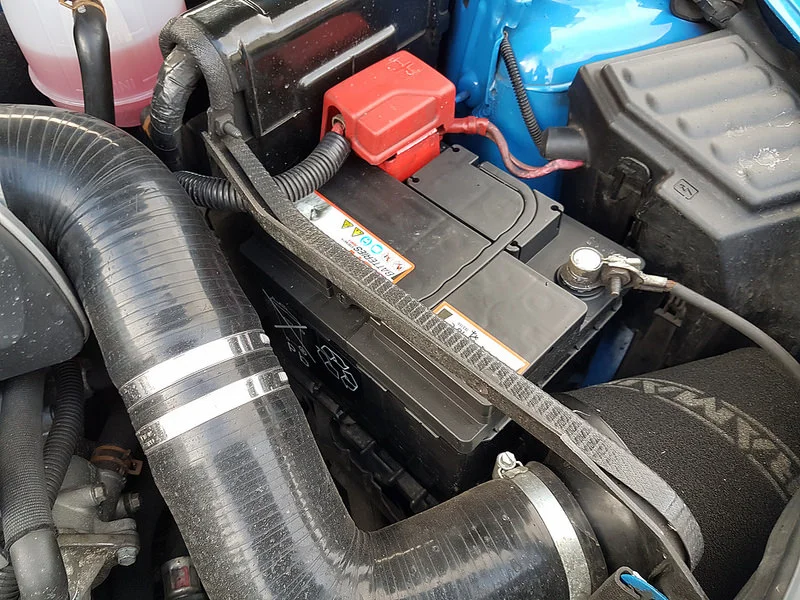

My battery was also giving up the ghost. Admittedly it was a bit weak this time last year but made it through another year. It had been giving the symptoms of getting week a couple of months ago when the trip computer would reset when it was cold. Then over the last 2 weeks the needles would hesitate on idle before firing up. Then the last week it was struggling to start up. So i drove to Euro Car Parts and ordered a new battery. Got to admit, i bought a cheapy one. I did think about buying a branded one but decided against it. Parked up outside, went online and ordered one with the discount code, waited 5 mins then went inside to collect it for the grand sum of £35. Went home and fitted it straight away. Got the trusty old halfords kit out with a nice cup of coffee in Robocup and set about swapping them over.
Old
New
Old Vs New
New fitted

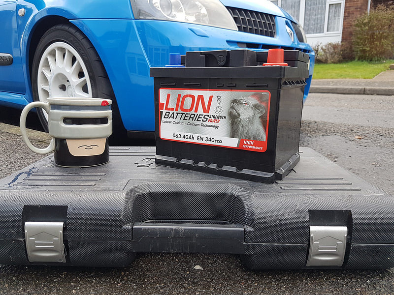

That Lion battery might be 'cheap' but it's still got a three year warranty.
So for £35 you really can't go wrong!

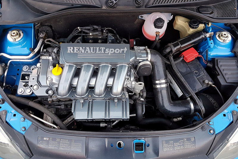

Did you do the engine bay yourself?
I have a powder coated inlet etc to go on my RB and want to clean up the rocker cover and maybe even spray it. How did you do yours?
