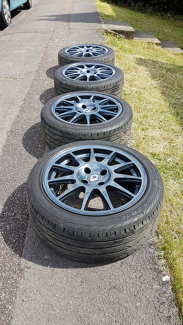

So for a while I've toyed with the idea of getting rid of the turinis and getting some 15's. Ideally I wanted a swap but nothing evolved so I put my turinis up for sale as @RyG offered me he's spare 182 wheels to bomb around in till I source my new wheels.
I wanted the normal 15's such as F1's, Pro Race 1.2's, 2118's (although these are more expensive as you would expect), etc but nothing was really out there. I did see a few for sale but they was either kerbed, too far for collection only or too expensive once i consider a refurb/new tyres. My turinis didn't take long to sell though and they are going this weekend to @Will16V.

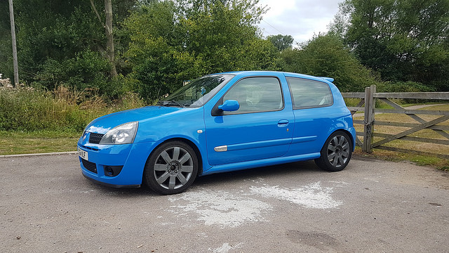

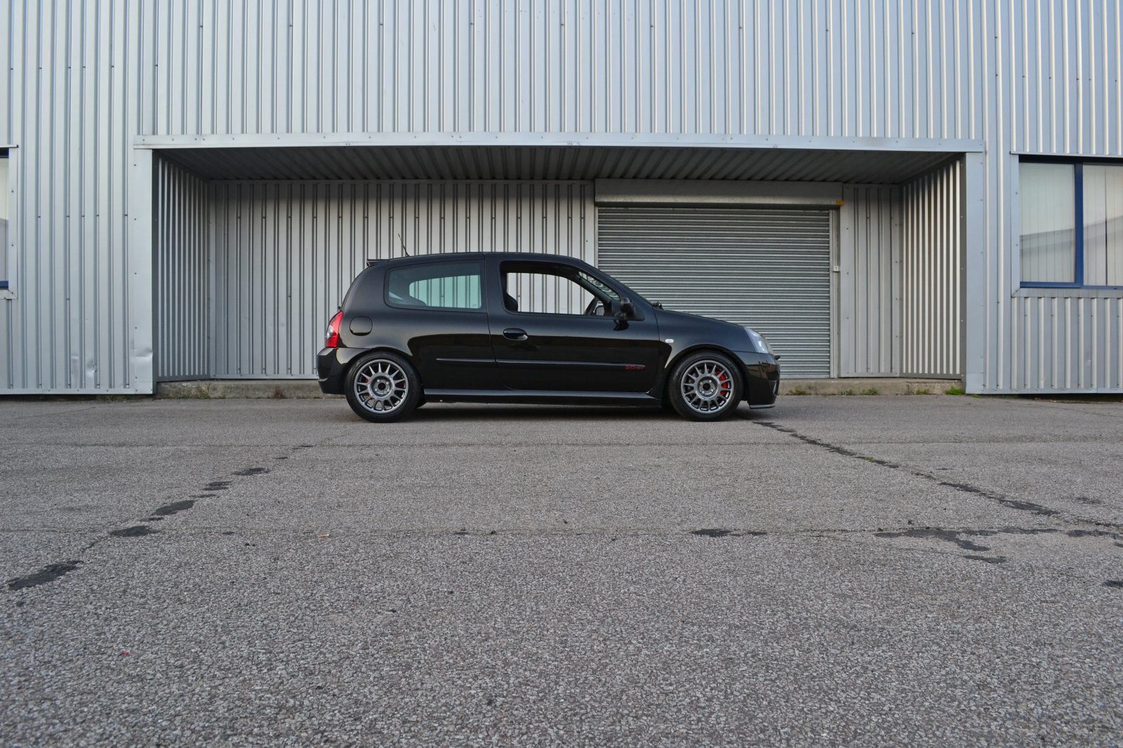

Turinis removed and standard 182 wheels on
Took this at work because it looked cool
Line-up by mark abbott, on Flickr

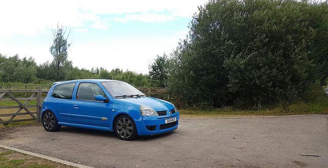

On the way home I hit this!
Naturally I stopped off and took a few pictures! Reppin' the standard wheels yo!

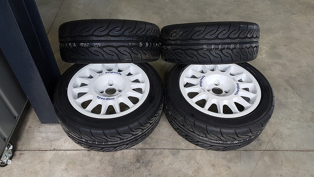

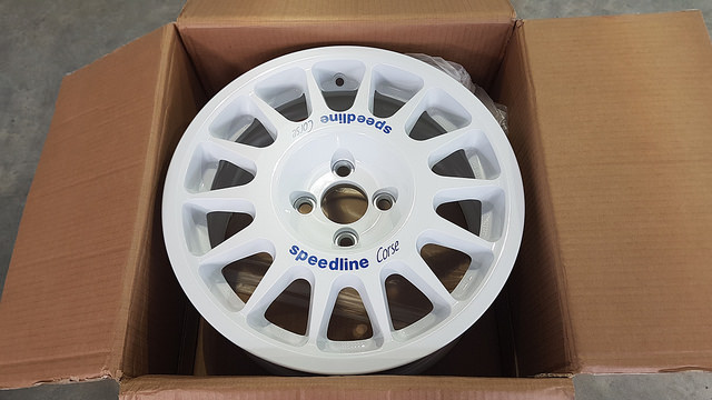

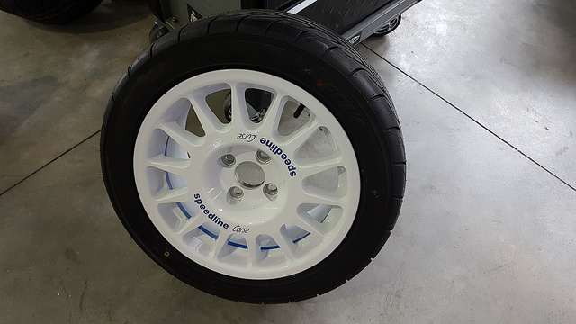

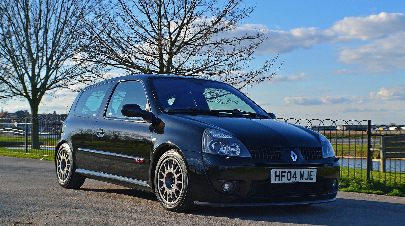

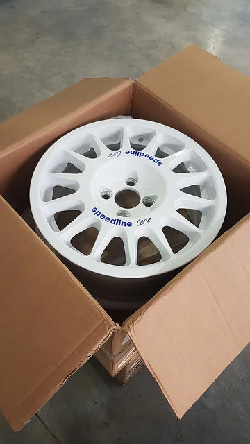

So after a thought of weighing up the cost of 2nd hand wheels and tyres, ive decide to buy new as i know they'll be straight and non marked. The wheel of choice are 2118's. I loved them on my old BG and they'll look ace on the RB.
I was deciding on whether to go with anthracite or white...
And i've gone with white. Although anthracite would be better from a practicality side, i can't help but think white looks so cool so sod it, RB with white 2118's it is! I also have a friend who know we have a mutual friend that gets a slight discount from Speedline and he actually knows my uncle quite well (small world) so he managed to get the wheels slightly cheaper and in a wider offset of et38 as opposed to the normal et43. Apparently this is quite rare and the normal stockists don't stock these. They are still 7" x 15". The wheels should be with me early next week.

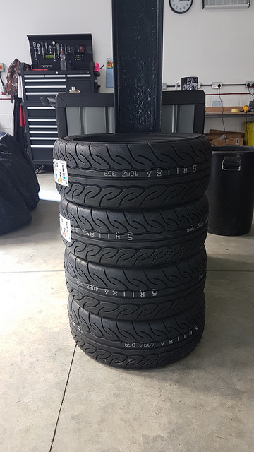

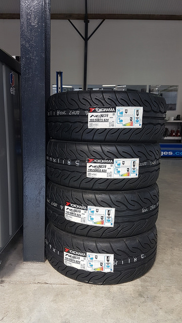

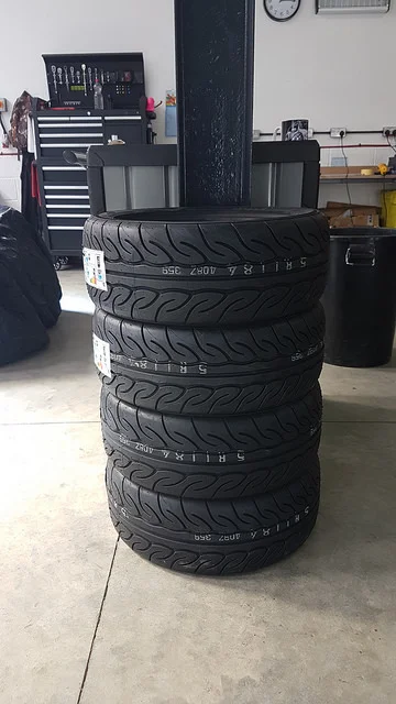

This morning i ordered new 4x 195/50/15 yokohama AD08r's of CSOC for the sum of £240 delivered! I liked them on my old ph1 and at that price, its a no brainer.
Lasty, Ive just purchased a new set of Gaz coilovers. I've never got the hate with them and i like there kits. We use them at work and they are pretty good. I've got the full coilover set front and rear. These will be here next week too. Cant friggin' wait to put all these on!

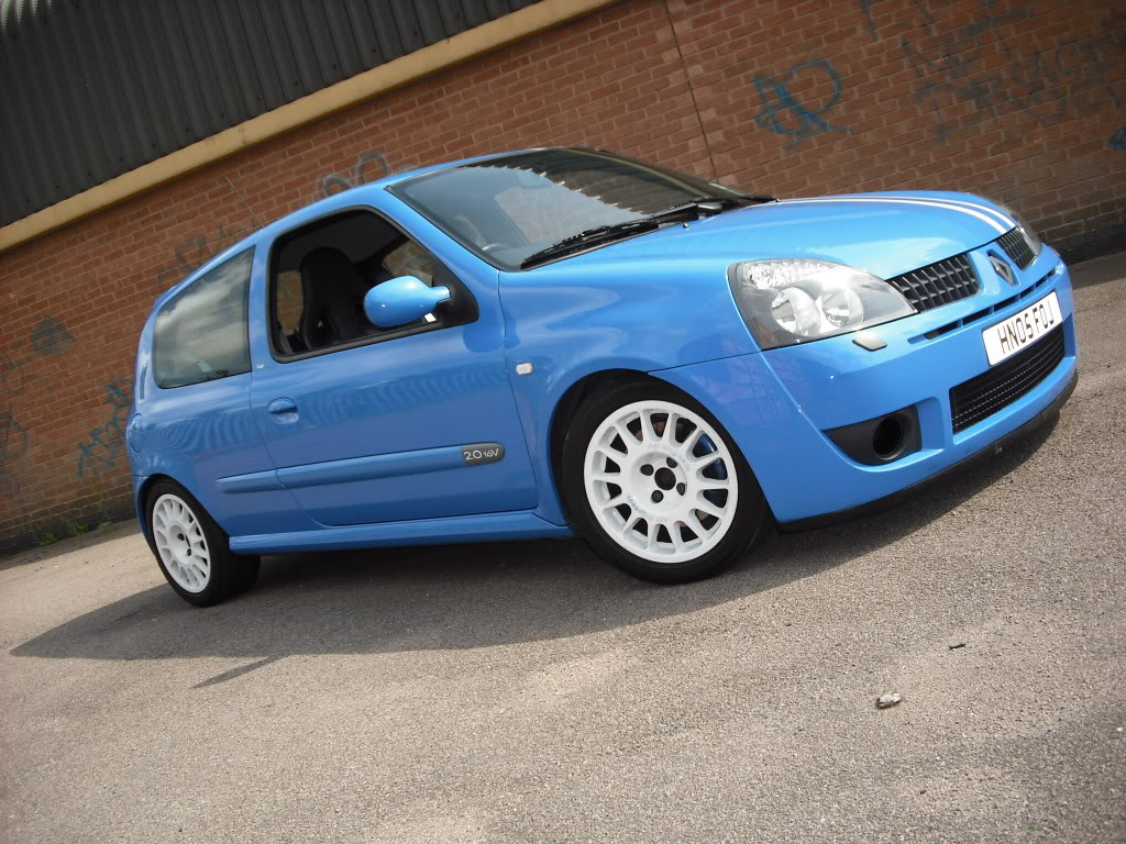

Love the white wheels Mark, when didi you change your seats they look good as well, :cool:
White on blue looks cool, good choice. Will look even better slammed on the gaz's.
I'm interested in the cooksports, let me know how much you're wanting.
I wish that was my car bud! That was a car just time show the difference on 2118s. I'm pretty sure that car had corsa vxr seats in it.

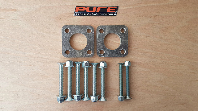

I want studs at a later date anyway. Was thinking of getting the DRA spacers (use bolts supplied to fit to hubs, then use your existing wheel bolts to do wheels up) then loctighting the tuds into that, then it the wheels on. Pretty sure this is what @Tim. does.
My ones are ET38 I believe. Cup racer ones.
I have H&R spacers bought from Venom Motorsport I think. They're either 20 or 25mm and bolt directly to the hub.
The PMS studs are then secured to the spacers with Loctite.
Makes swapping wheels so much easier, and I have a real penchant for doing so. My favourite current set are ET43 anthracite 2118s but I'm currently on gold ET38.5 Turinis. It's a little too much with the spacers so they'll probably be up for sale shortly.

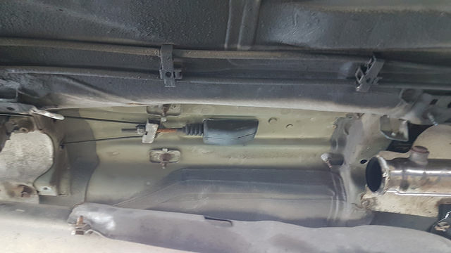

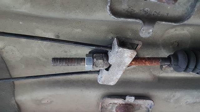

Got the car on the ramps as i wanted to adjust the handbrake as it was a little slack. After the adjustment, i used a plain nut to lock the cable

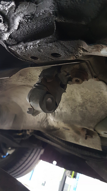

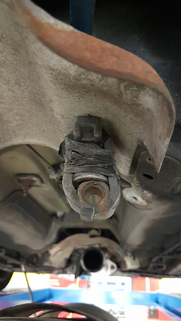

Noticed this "special" center exhaust mount :down:
Will order a new one soon.

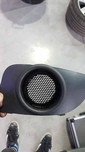

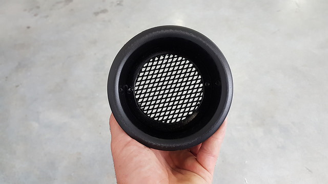

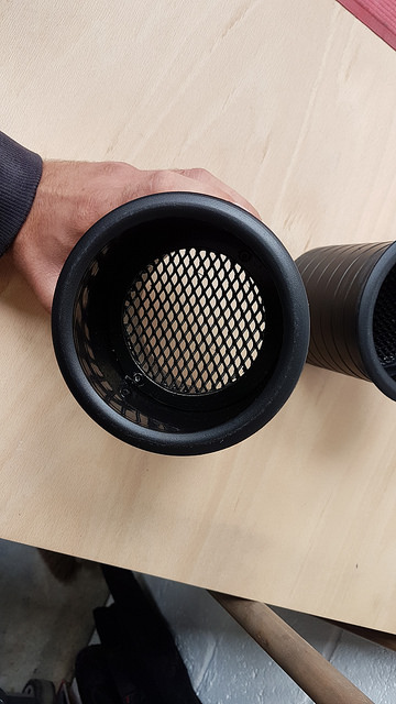

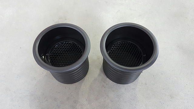

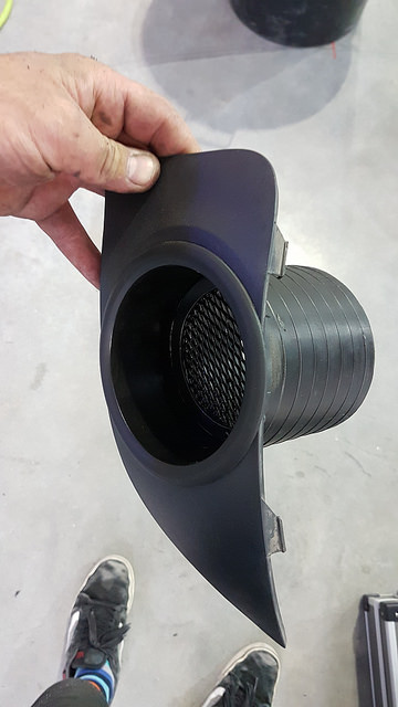

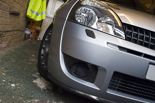

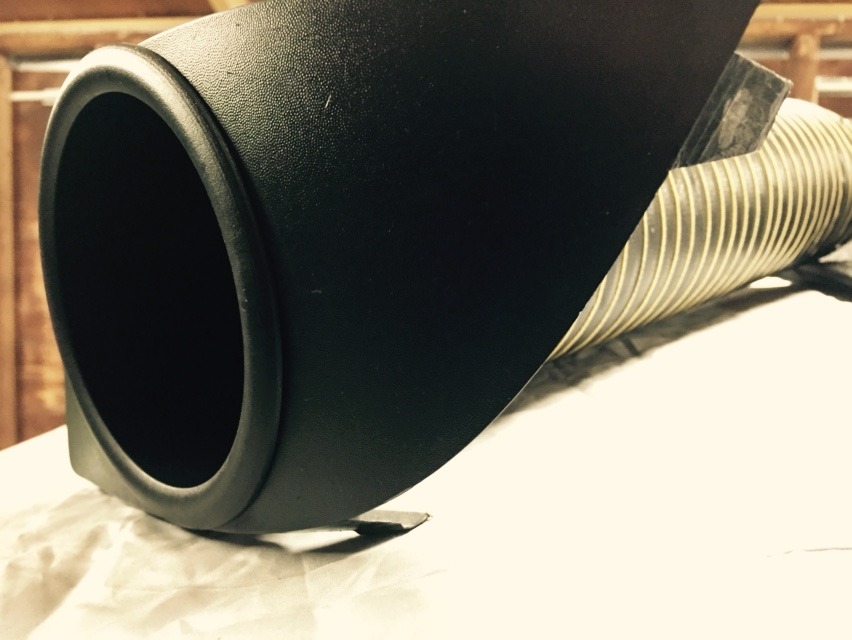

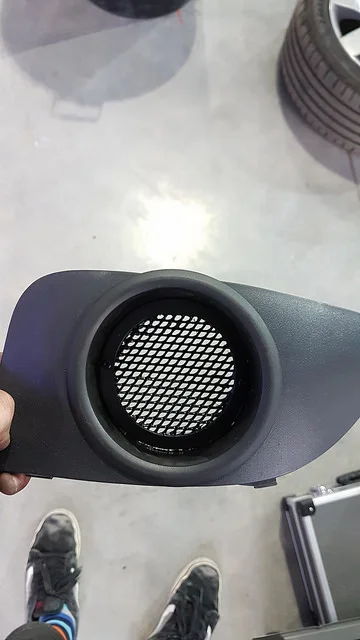

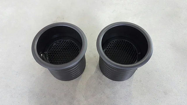

Next up was the brake ducts. This something ive wanted to do for a long time. I always loved Ollie's old cup with the mesh, but dont like the look of whats behind it and i like the look of the "Bass Ports" brakes but dont like the "tube" look, so i thought why not make the best of both!
Pics for comparison:

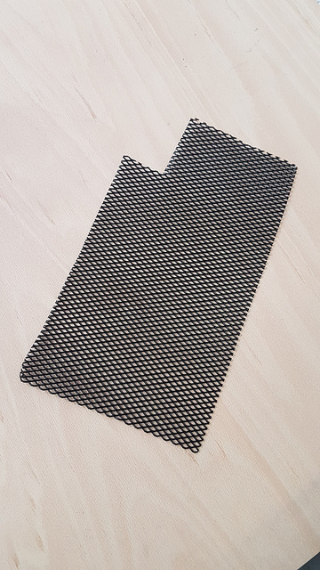

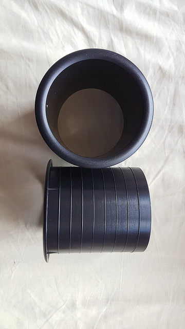

So i bought some bass ports (4"/100mm) and we had some mesh at work, which was gold so i sprayed it black.

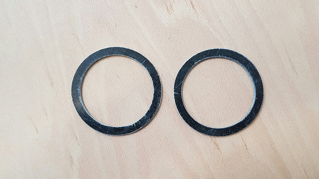

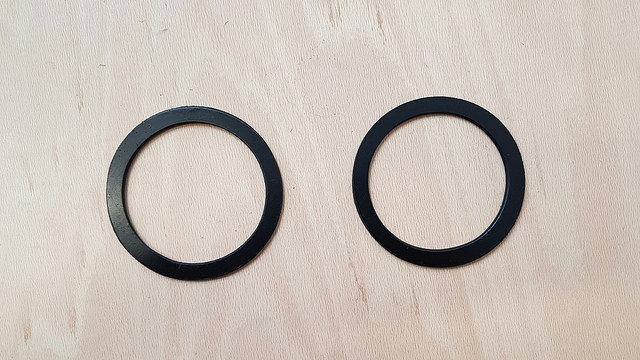

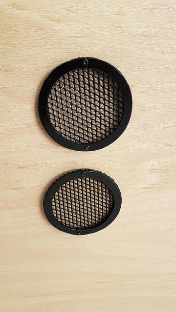

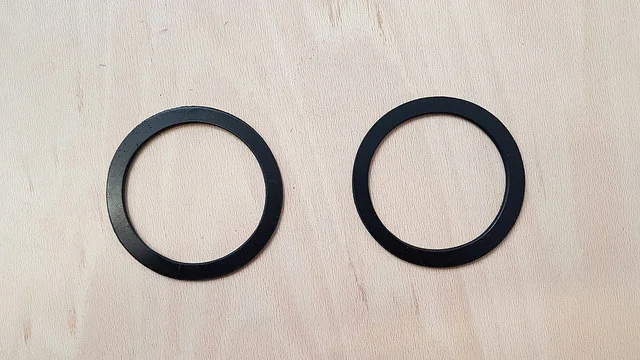

We had a bit of fibreglass at work so i cut a couple of rings out then sprayed them black
I cut 2 oversized circles out of the mesh for the ports and then i drilled and riveted the mesh to the rings then, used a grinder to trim the mesh into the rings outer diameter.

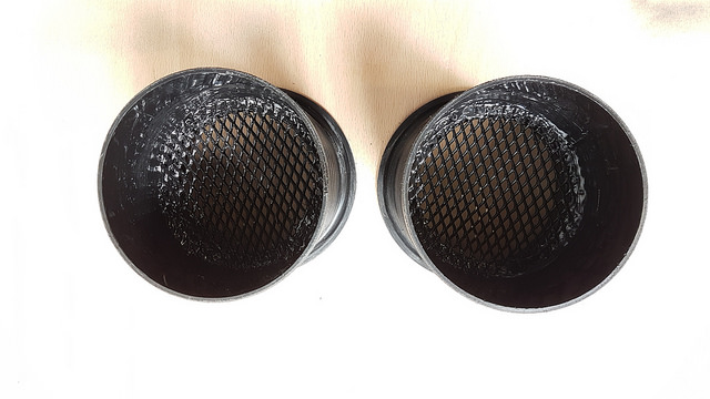

I then fed the mesh down the ports from the back until i was happy with were i wanted them which was the size of an aerosol paint lid from the front. One they was in position, i used some PU sealer for the back of the mesh to hold them in there permanent position and let them set to dry.
Complete
To say im happy with them is an understatement. I friggin' love them!! I gave them a good few coats of black and lacquer throughout the day too. :cool:

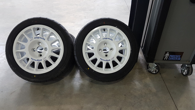

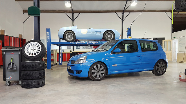

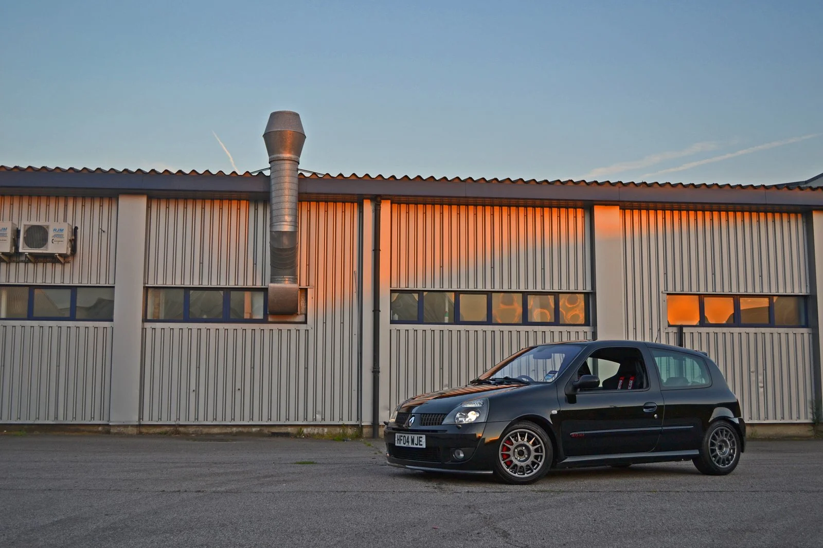

Wheels and tyres arrived so i promptly got them fitted together and balanced.

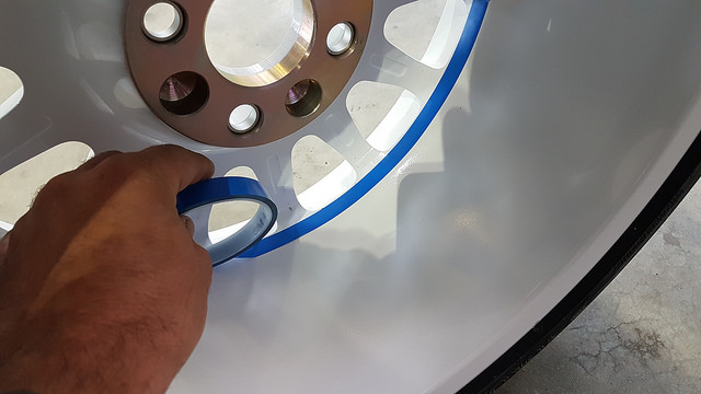

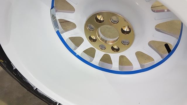

We had some blue 3M tape at work so i put a strip round the inside of the wheels like i did on my old BG. Still unsure atm. I think its because its a tad wide. Will look into getting some 6mm stuff. I can always remove it if i dont like it, but it breaks it up a tad. Once there fitted its actually not that noticeable until your next to them.
I then set myself up for the wheel change and brake duct fitting.
Nice update Mark, I like the work with the brake ducting in the fog housing, very functional but looks great too :)
