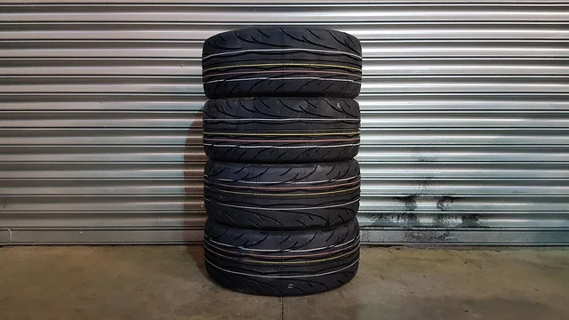

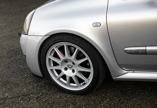

At least they still have a good looking tread pattern. Not as good as the AD08R's but still good looking! For the pics 😉

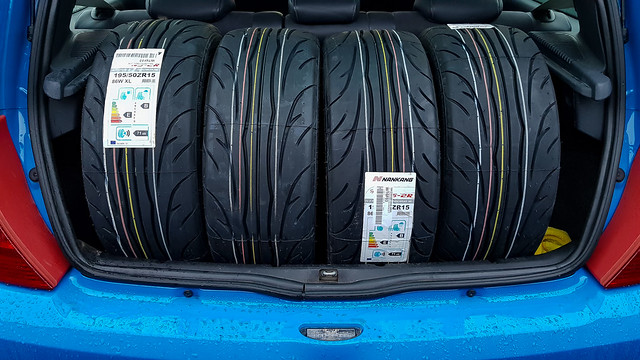

So as mentioned, i had decided on the NS-2R's for my next tyre choice. Ordered them with JJC through ebay and got 10% off so £234 delivered.

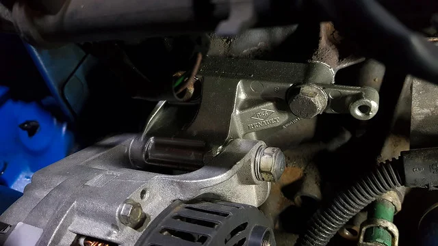

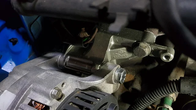

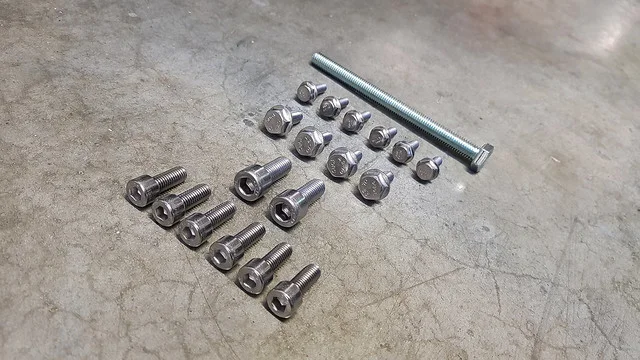

I bought some bolts for the engine bay as i wasn't happy with the button head ones and i wanted to replace them with flange bolts. Bought all stainless steel ones apart from the alternator bolt, which is just a normal zinc plated one. Whistle my homemade bolt was fine, i wanted a proper bolt.

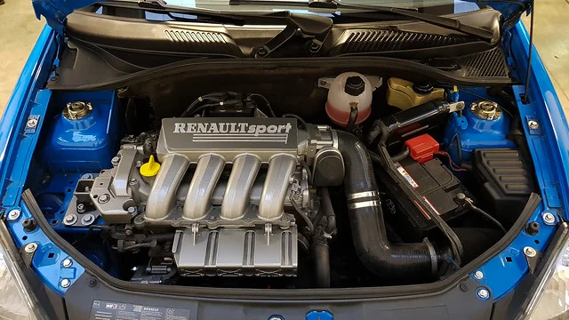

So i changed 6 PMS top mount bolts for new SS cap heads, Vibra Technics engine mount for SS cap heads, slam panel and wing/headlamp bolts for SS flange heads

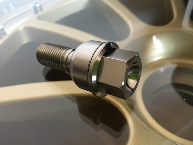

One thing I'd note though, is those bolts you've changed to SS cap heads. They would have been high tensile bolts, probably 12.9. And whilst SS looks nicer it obviously isn't as strong. May be worth a consideration for vital components like suspension. Headlights and slam panel obviously doesn't matter.
Thanks Martin.
I thought all cap heads was high tensile. 10.9 and above? I presumed I was changing like for like with the top mounts. Obviously I'll stand corrected as I'm no expert.
I thought it was just hex head bolts that came in a 8.8 (alternator) but seen as that's no real strain I didnt think that one mattered.
As you said, the other ones are not as vital.
I don't think there is a standardised rule, so it's always worth checking. If they are high tensile they will more than likely have a marking on the top of the cap head. If they are sold as stainless steel then I would say they are more than likely not high tensile. Or not as strong as the ones PMS/Renault provide anyway.
When I've replaced any bolts on mine I've made sure to replace like for like with tensile strength, and if I coudln't find them I had my originals cleaned and coated.
The ones you have may well be fine, I'm just suggesting it may be worth double checking, and if they aren't HT then you may or may not decide to swap them. I'm sure many people have swapped out for SS items without issue it's just something my brain couldn't live with haha!
Depends which grade you buy. 6AL-4V would be more than adequate.
These any good? I'm all a bit lost on it now!
They will be more than adequate mate. Not quite the yield strength of a 10.9 tensile steel hardware however more than up to the job of stopping your dampers falling off. That's the same stuff my wheel bolts are made from ;)
Ok mate thank you. I'll order them then 👍
Never dealt with titanium stuff before. I just presumed that all cap heads was HT at 10.9 and/or above. But because it's going into ally top mounts and then reading the above pist that @0ss posted, I want to make sure it's not going to give me issues later on if/when I need to remove them.
Titanium for the most part won’t react with anything in terms of corrosion. The only issue you can have is galling and micro welding of the surfaces if you were to crank the hell out of them.
I always use Finish Line Ti Prep on Ti fasteners and have never had any issues at all.
Most cap head bolts that haven't got A2/A4 engraved in the top will have 12.9 engraved, from what i've used anyway.
A2/A4 is the grade of stainless steel, short for 302/304 with 304 being classed as marine grade.
To be honest, all the lad on those mounts is not really on the hardware as all they really do is stop the dampers falling out when the wheels are unloaded. The stainless ones would have been fine id have thought anyway.

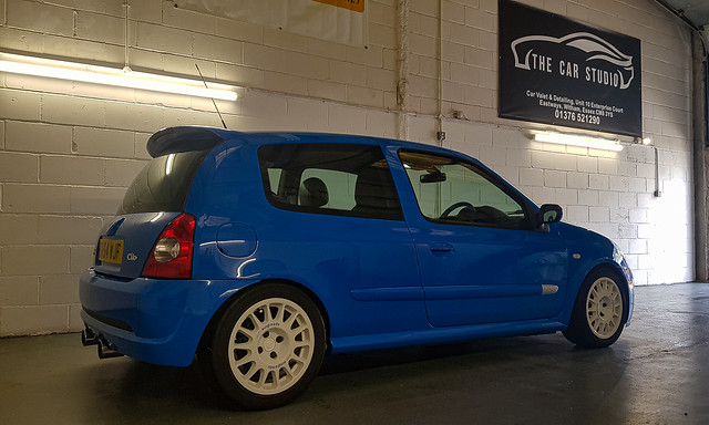

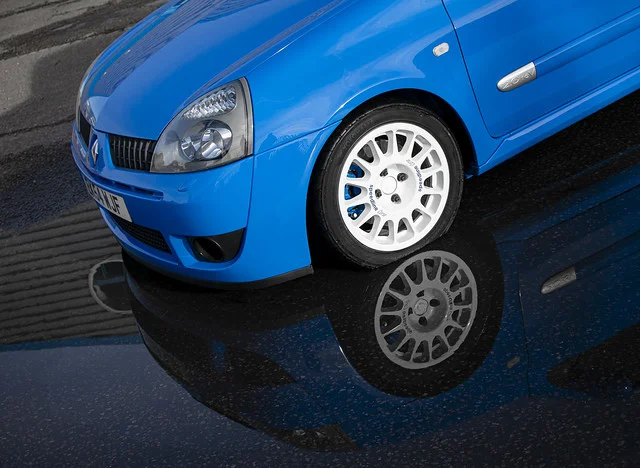

This is the nicest blue’est RB.
Sits so well and the wheels set if off perfectly 👌🏻
Thanks mate. We all know the 2118s work in many colour combos on the 1*2's but needs the right height and spacing for them to look better. Every now and again I think about changing the colour to anthracite as the white can be a pain to keep clean one regular basis due to being used daily, but then I see a few pics of it and think the white works so well and I talk myself out of it! This pic in particular (no real reason) makes me doubt any colour barring the current white.
Also, coming from you and how you are with the cup, that's a compliment, so thank you 👍
Yeah, don't change the wheel colour! It looks great Mark and it's one of the nicest ones I've seen in a long time!
Definitely keep as is. I'll never be a lead wheel fan, but it just wouldn't be right on anything else in any other colour
Definitely keep it as it is Mark. My favourite RS of all time! Much envy 🙌

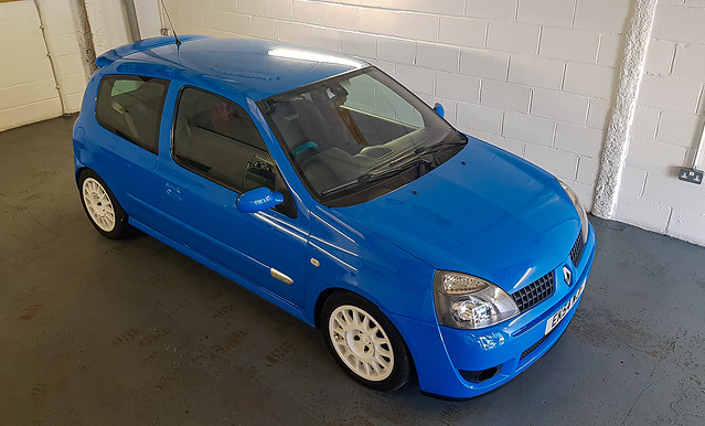

This was taken this morning when I got to work.

Point taken chaps, I'll stick with white 👍
I cant help but think a gloss black wheel would look great on this. However I agree with the majority that white suits it well.

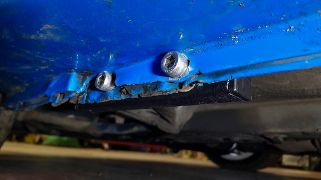

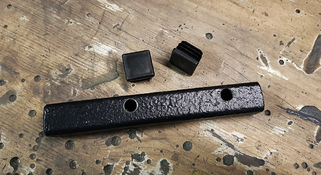

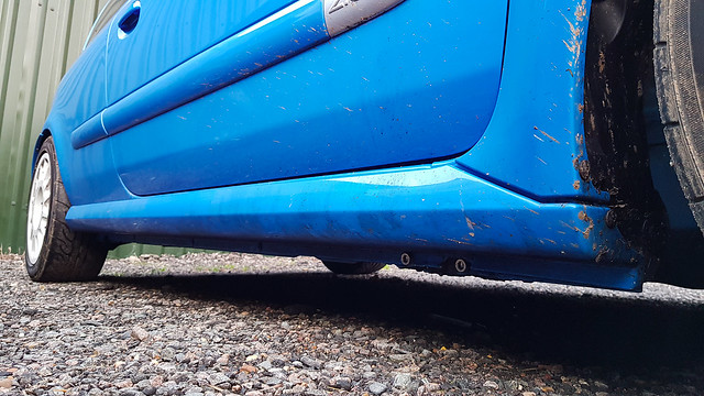

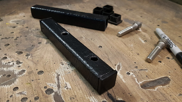

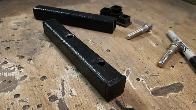

Another thing that i've been planning to do for ages is make some jacking beams. I did this years ago on my ph1 but they was welded on. This time i wanted to make them for the front (we all know the jacking points on these are made of cheese) but i wanted to make them removable should i need too. I used the existing holes that was in the sills too. I had some metal box section at work and i stone chip coated them with the leftovers from when i was doing some other bits at work. I bough the end plugs ages ago so make them look more complete and i bought some new stainless steel cap heads so they will not rust and look less obvious once fitted. I will colour code them with some RB paint i have, but will do this over the xmas period i think.

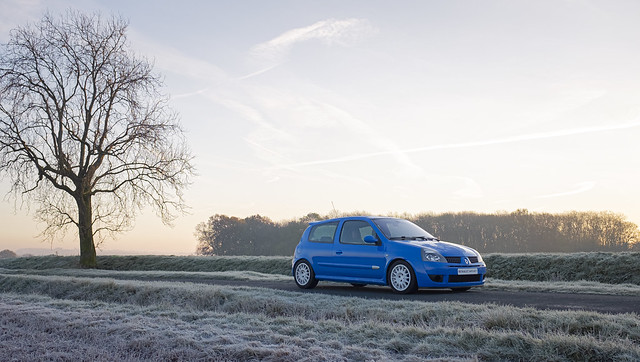

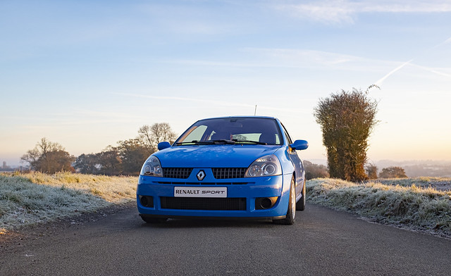

One day on the way to work, it was frosty but the sun was out. I had my little Fuji with me so i snapped away. These was taking literally just outside the farm, about 1 minute away but i think they came out decent.

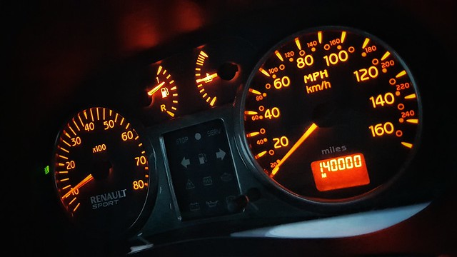

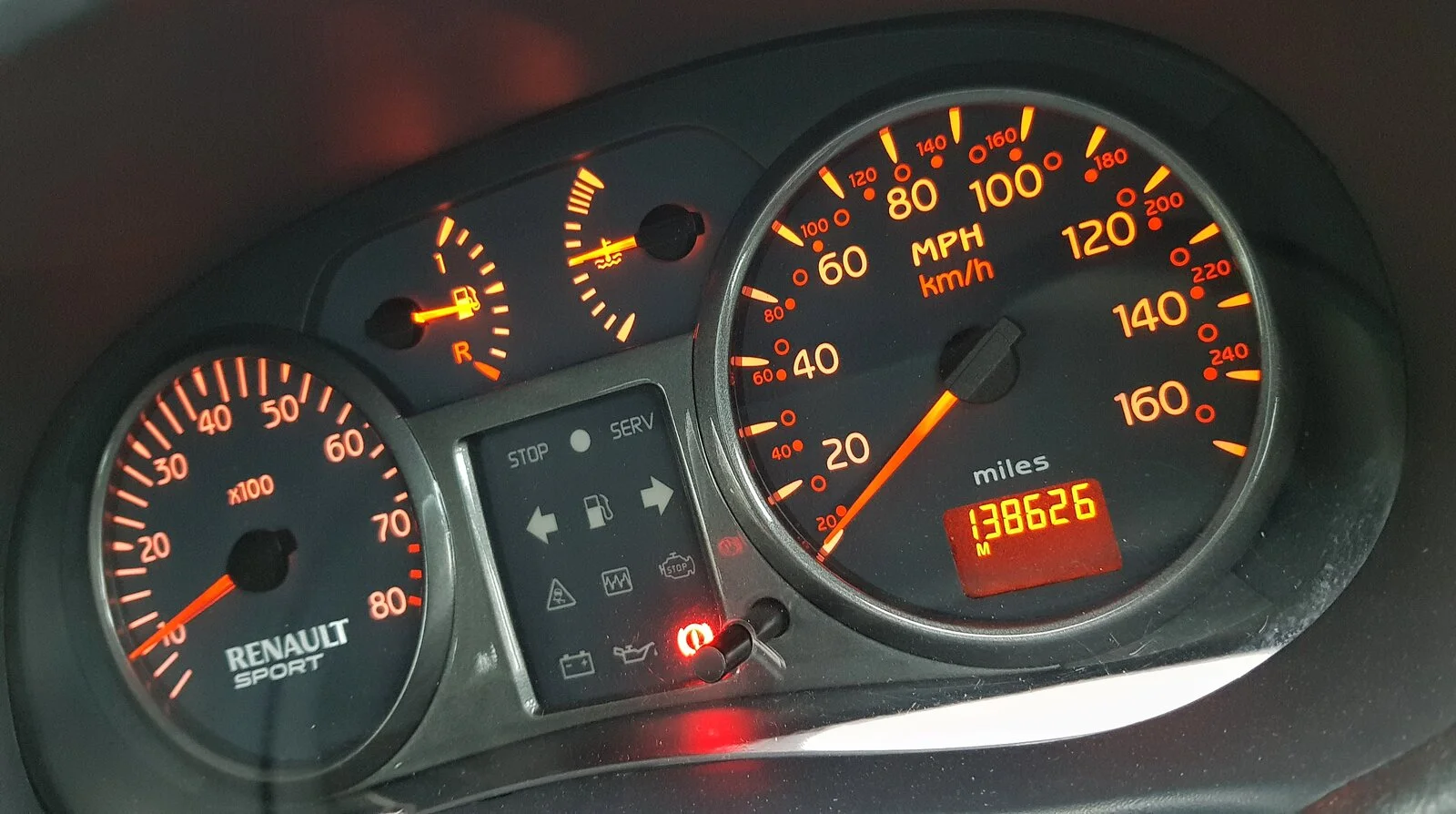

The RB recently hit 140k! Still got love for the old girl though.

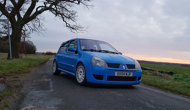

The RB was dirty-ish during these pics but as of today, its done another 270 miles since so its rather dirty now. I will was it but probably not until after xmas.

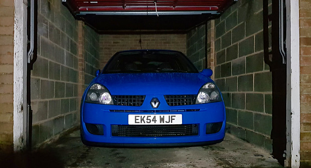

When we purchased our flat there was nowhere allocated to park. (Prices here are a lot for not a lot, so we was limited to what we could buy with what we had saved and could borrow) We applied for a council garage and a year later, one has become available. Means now the RB has more secure parking. May not seem a lot to some, but i'm very happy about this!

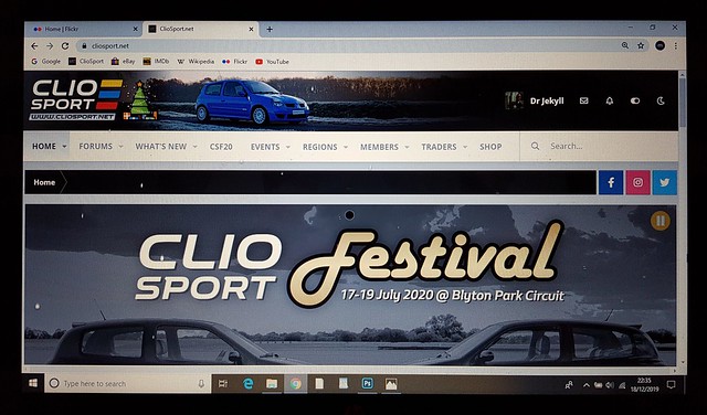

Lastly, while browsing on here last night, i noticed that one of my wintery pics is on the top banner. That made me smile!
