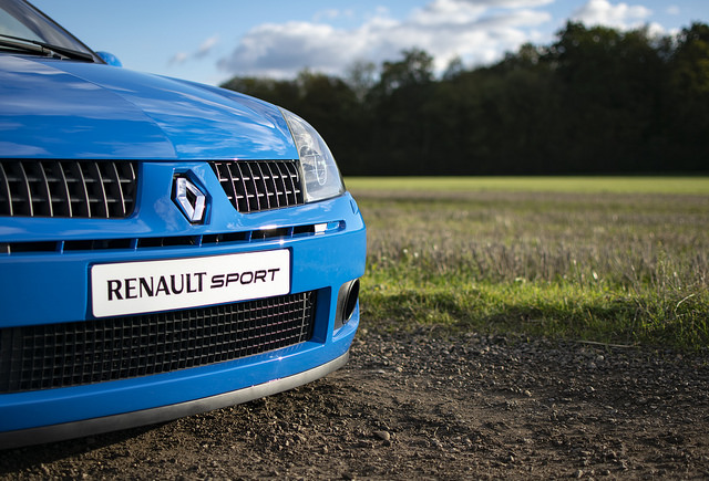

Few more bits done on the RB. Drove to work and did a few jobs. Was a nice autumn morning so i got a few pics while the road and farm was empty

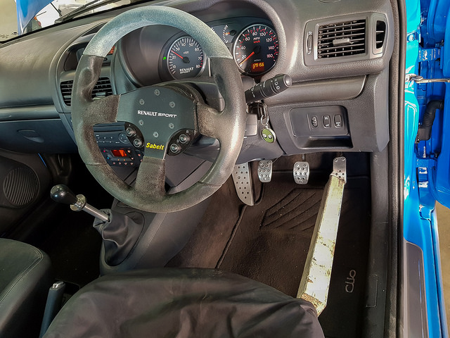

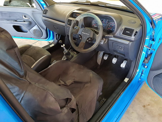

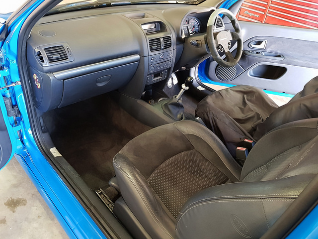

Gave the interior a much needed clean

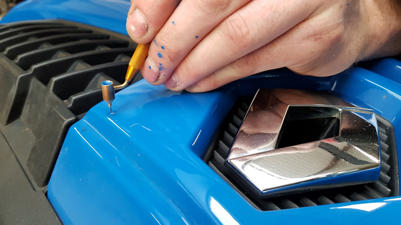

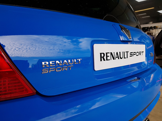

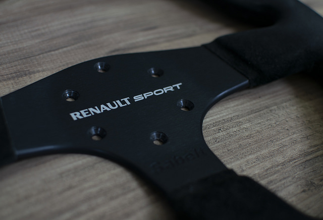

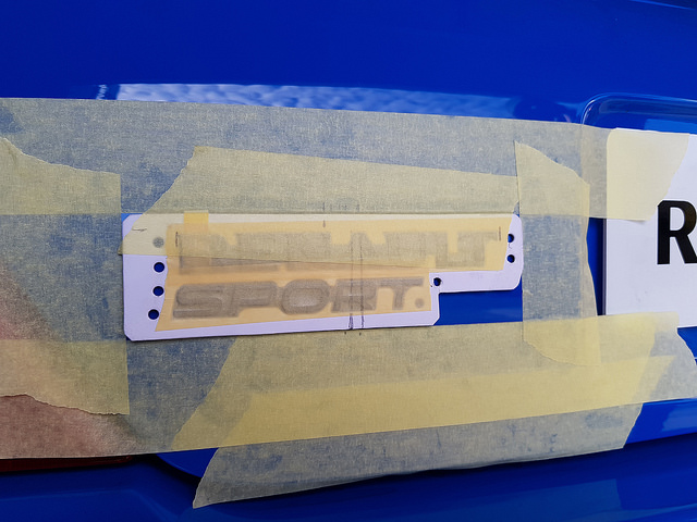

Then fitted the new renault sport badge. Its straight, and was marked out straight, but in some angles, it looks wonky. Must be where the boot is curved because its straight. Optical illusion!

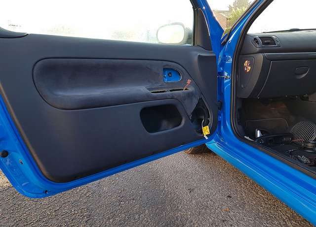

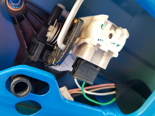

Sunday morning consisted of a few minor issues being fixed. When i locked the car, the boot wouldn't lock. A quick investigate turned out to be the catch not plugged in! Must have just missed that when it was all being refitted. Anyway, all plugged in and working as it should. Easy fix.

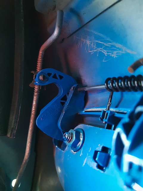

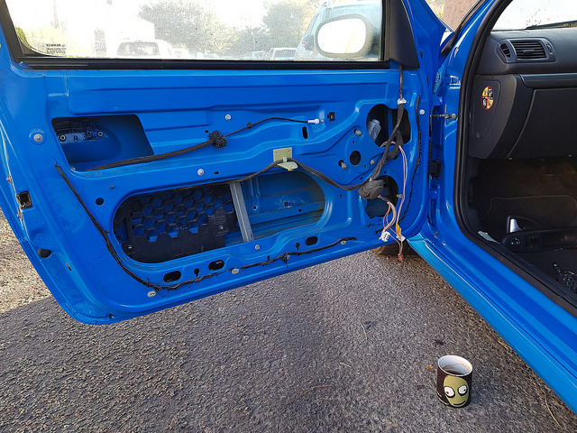

Next up was the passenger door. When locked, then unlocked, it would stay locked unless it was open from the inside. I could hear the central locking motor working so i thought it would only be a simple fix. So off came all the door card again to investigate.
After some investigation, it turned out the door pull rod wasn't sitting correctly on the clip (cant remember if was too high or too low) so it was recorrected. Once again, not a hard job. Took more time working out why, so another nice easy fix. Both doors and boot now lock, unlock, open and shut as they should.

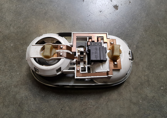

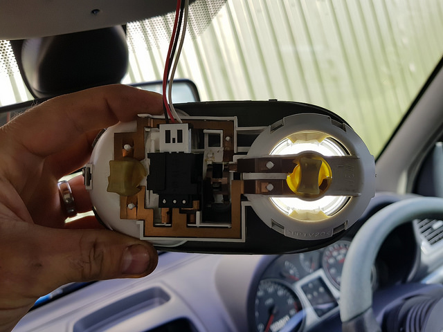

My interior light kept flicking. Turned out to be the bulb holder so i ordered a 2nd unit off ebay. Once arrived i fitted replaced the holder and now both bulbs work again. (Was the map one that was faulty)

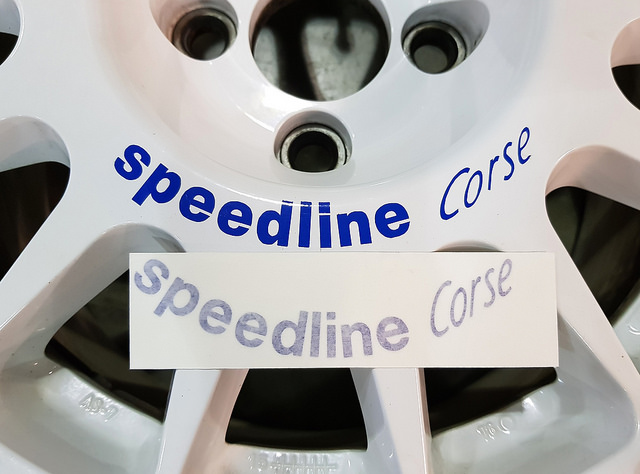

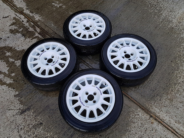

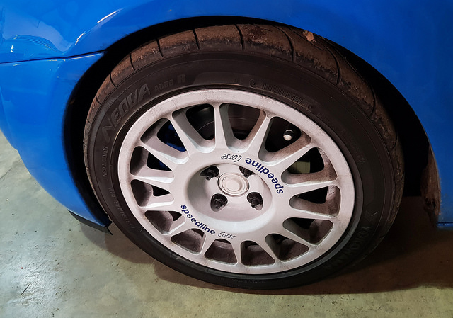

Managed to get in contact with Speeline and ordered some genuine 2118 decals.

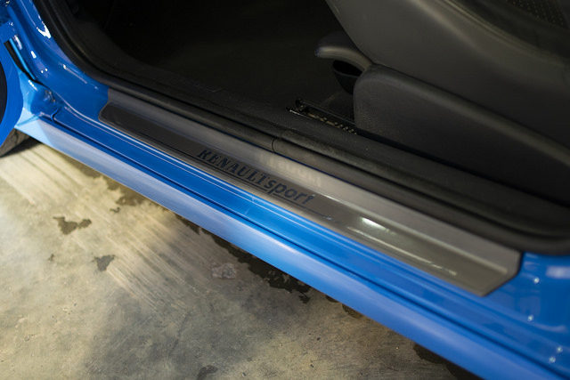

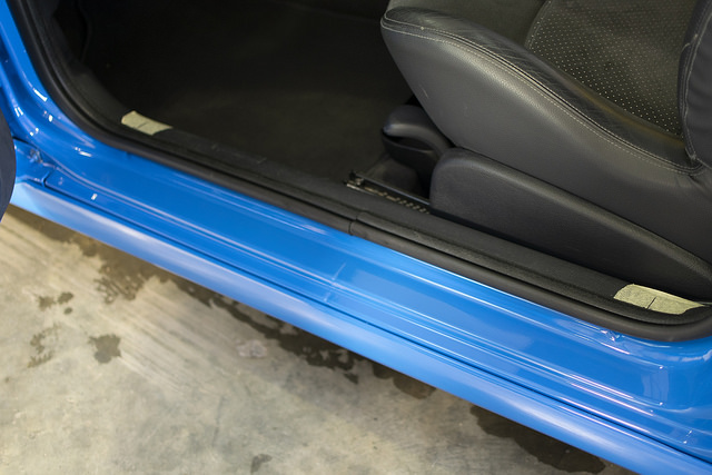

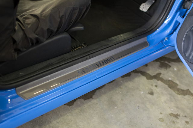

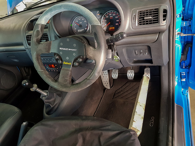

Refitted my kick plates, using double sided moulding tape. Used the tape lines that i marked from where the old ones sat so i knew it was in the correct position.

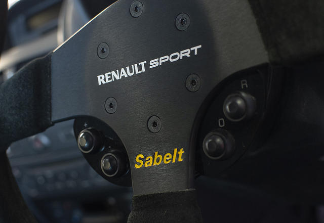

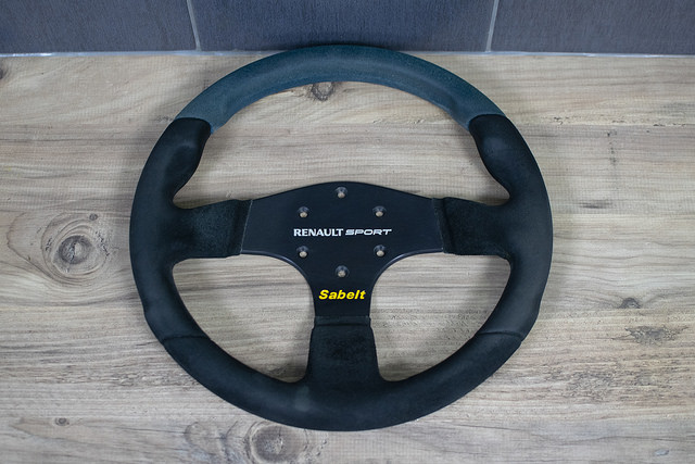

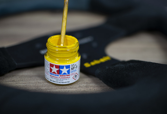

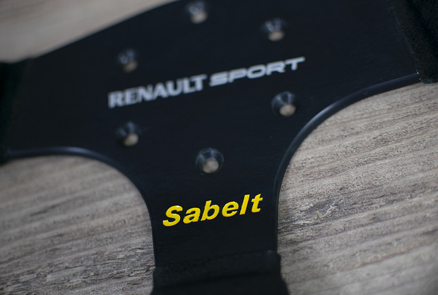

Then i decided to paint my sabelt lettering yellow again. What a pain in the arse job! Although its engraved, its not that deep so it was very hard to actually paint in the grooves, especially on the skinny parts of the lettering. Must have spent 1.5 - 2 hours on this. Got it good a few times then mucked it up on one letter, meaning i had to restart it again. Im happy with it now. Its not perfect, but very hard to get it so. I scraped off the over bits so its all yellow in the grooves now and not over the lines.
I much prefer it yellow again. Looks so much better and as it should be. Just need to get it retrimed now.

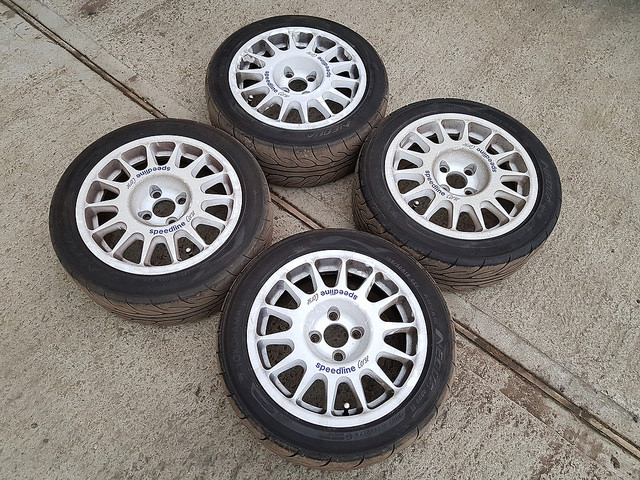

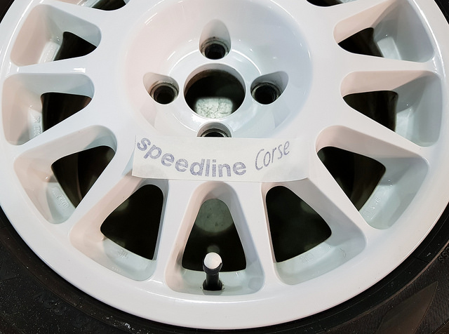

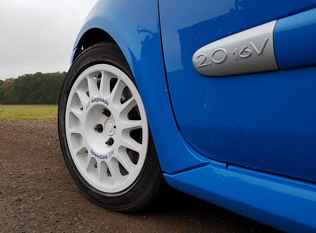

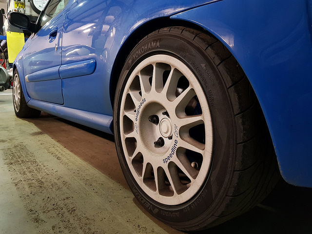

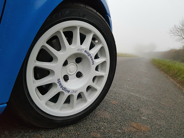

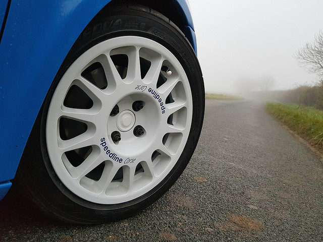

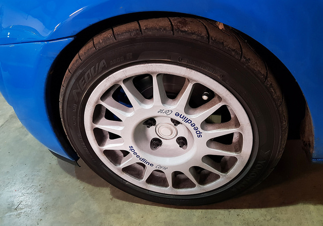

Then last night i put the new speedline decals on. They are smaller than the ebay ones but the lettering looks much better. Gave the wheels a clean prior to stickering too remove the
old residue
Fitted the new grill sticker too. Just need to source the other side now.
Wheels looking fresh on the way to work this morning

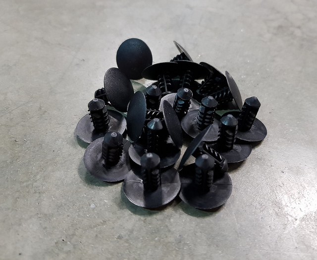

Tonight it refitted the bonnet sound carpet as my new push clips arrived.

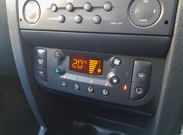

Not much has happened. We finally got the keys to our place so i have been back and forth doing up the flat we have and that's taken a lot of time up. Rightly so really as that is priority. Will look into getting a garage for the RB though. But in between that time, ive fixed a few things on the RB.

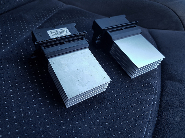

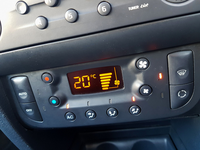

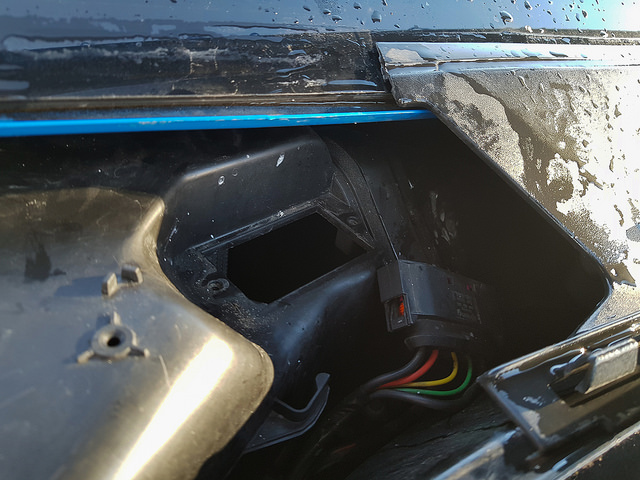

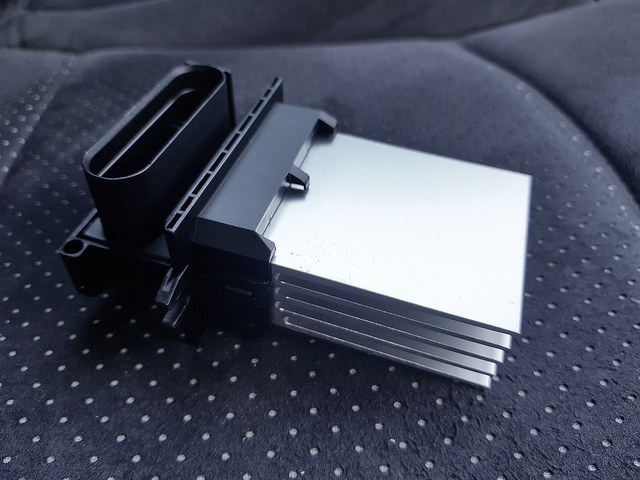

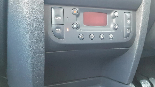

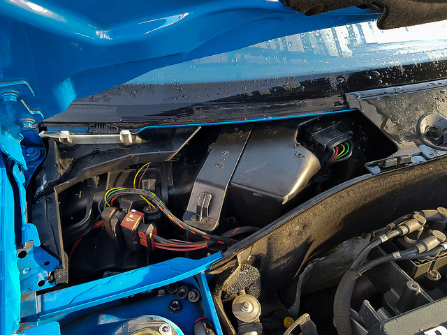

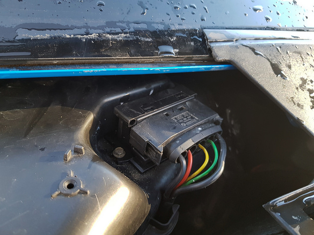

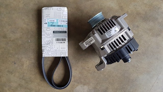

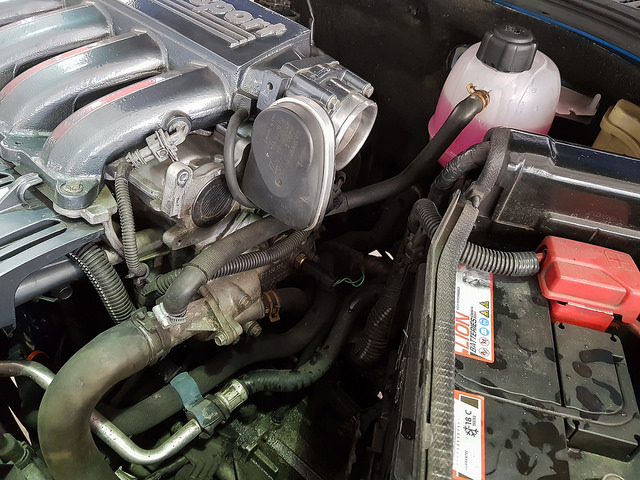

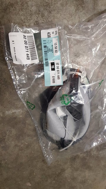

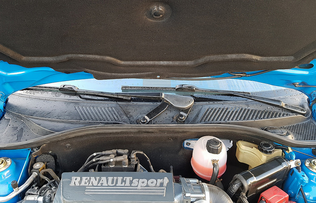

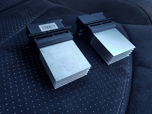

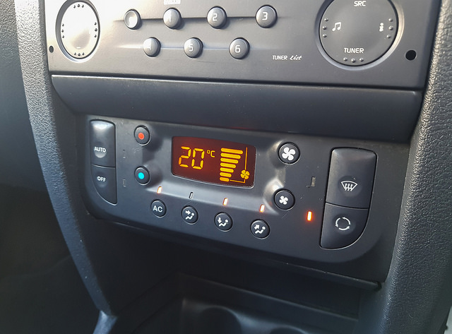

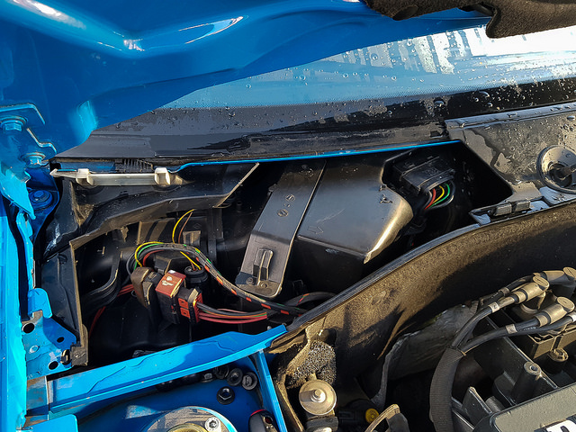

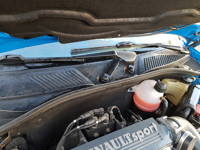

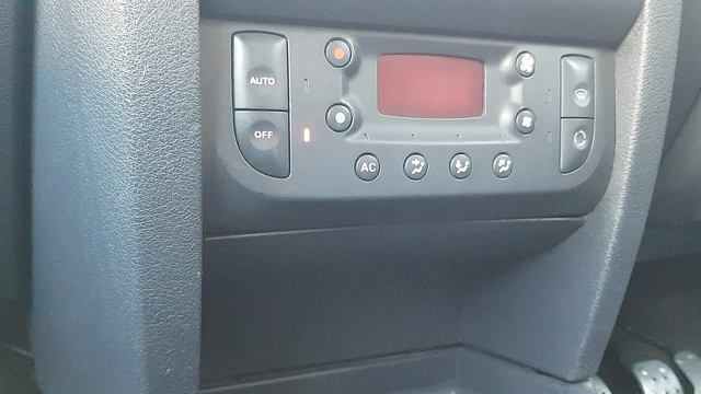

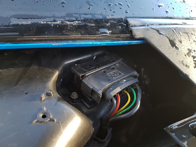

First up, i tuned the heating on one day and i had no fans. Would press all the buttons and the panel lit up as it should but nothing would blow out. This just happened on the way to work but by the time i got to work, my car was really steamed up. I had no option but to have the windows down to demist it. Not the best thing at 7am and 1 degrees but i had no other option! So i needed to fix it asap. After a search and post on the facebook group, it was obvious that it was the heater resistor. Knowing that renault would not get the part to me for a good few days, i got one from euro car parts as it was a common part. Wasn't a lot of money and i could get it that day.
So after a quick search, it looked like an easy job and it was. Simple plug and play. Took apart the wipers and scuttle panel to gain access.
Removed the old one, which was a genuine renault item.
Then fitted the new one.

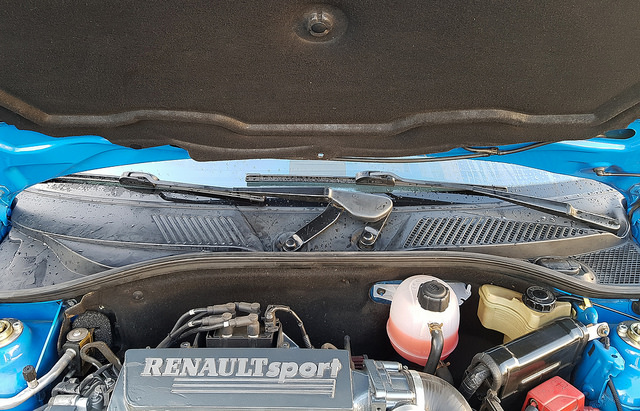

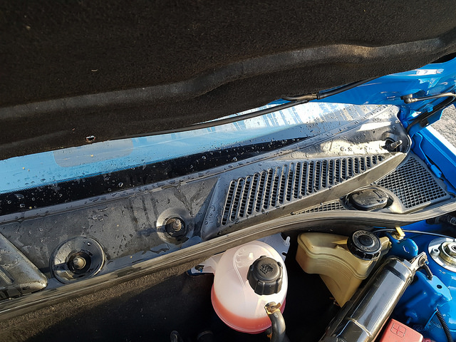

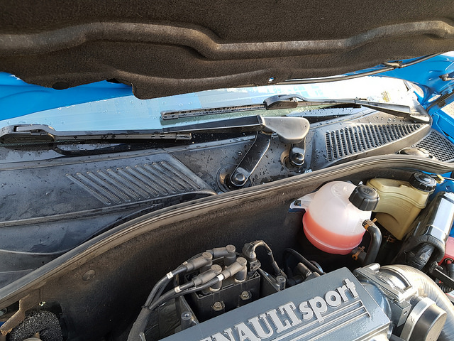

All panels and wipers refitted.

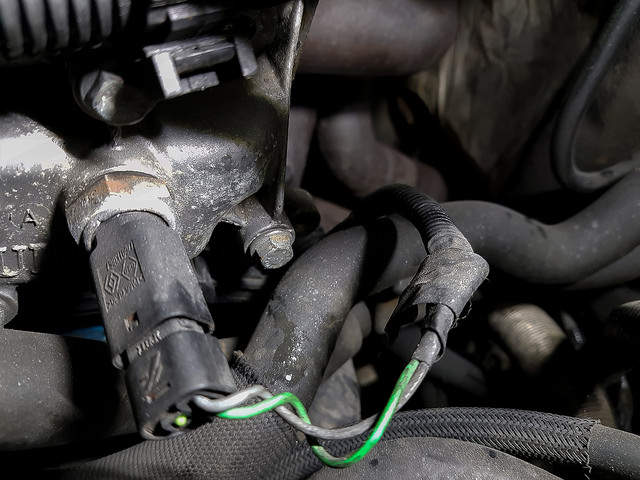

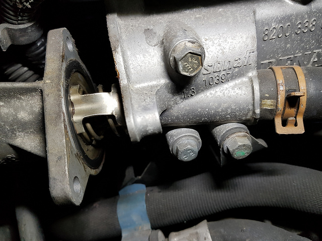

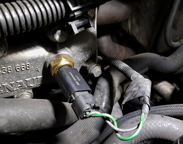

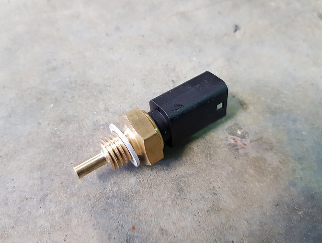

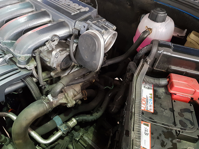

So that was fine for a few weeks but then i noticed my temperature gauge playing up. I let it warm up before i left work as usual but on the way home, i noticed the temp needle was nearly at the bottom of the gauge and then it would fluctuate. Got home and search which some said it was the coolant temp sensor, but most saying that it was the thermostat. So with black friday deals on at euro car parts, i ordered a new thermostat, coolant temp sensor and coolant and decided to change the whole lot. So i took it to work sunday morning and set about doing it. The car hadn't been washed in over 3 weeks, done 600 miles (ish) and we had some crappy weather in that time so while it was at work, it was going to get washed!

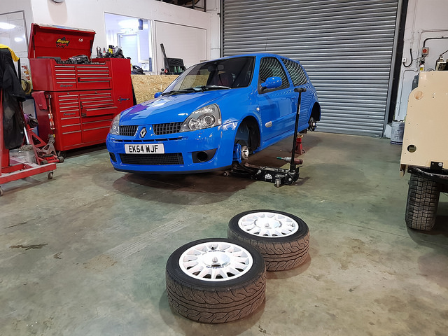

Car was jacked up and the wheels was removed for washing.

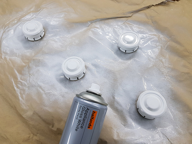

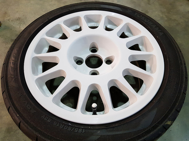

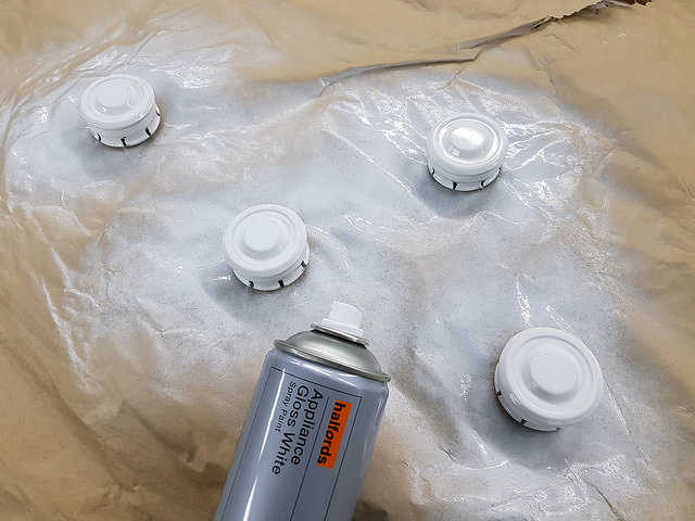

Something else i planned to do was repaint my center caps as i wasn't happy with the white. The guys at work joked about the colour match after i was moaning that i couldn't find it for the white 2118s, and they joked about trying just "gloss white". Well that got me thinking, so i bought a can from halfords and while the wheels was off, i gave them a scuff up, and repainted them.
Got to say, that its very close. Im certainly happy enough to keep it that way! So after trying all these different whites, it turns out that gloss white does the trick!

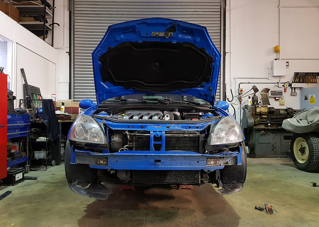

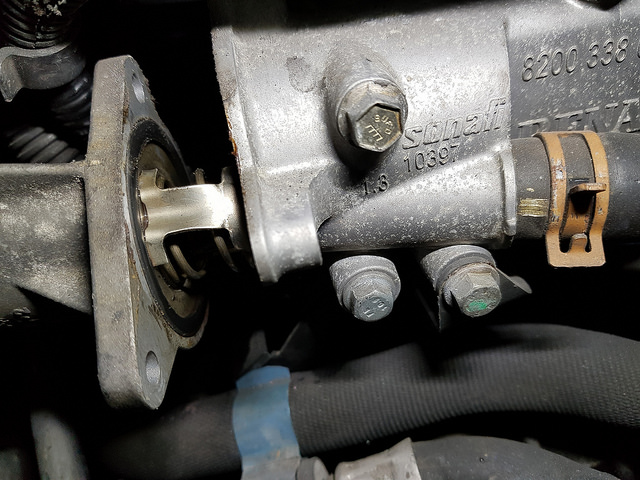

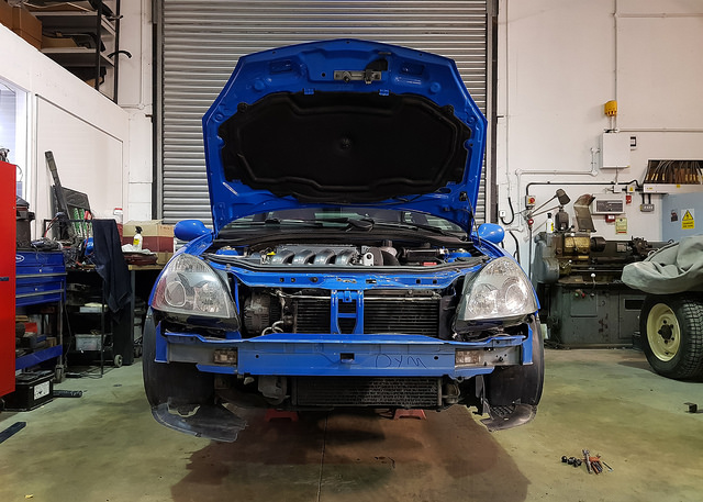

Then i removed the bumper off and started the coolant change process. The hardest part was getting to the lower hose clip. I have some long, long nose pliers which i wouldn't have done it without, but i did read up that you can buy some bendy hose long nose pliers. This would have made life easier but hey ho.

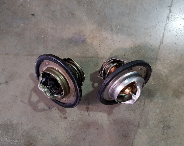

Drained all the old coolant, removed the old thermostat and used a watering can (i was indoors) of water to flush out the system.

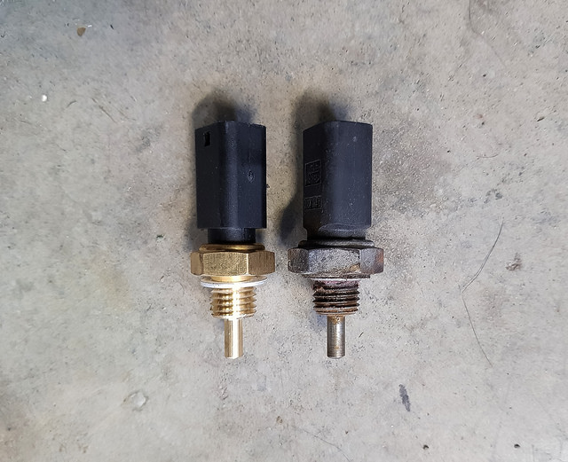

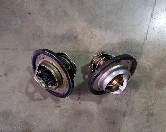

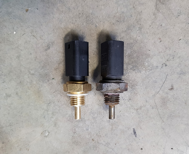

Comparison of old vs new. Old one was genuine renault part.

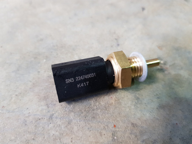

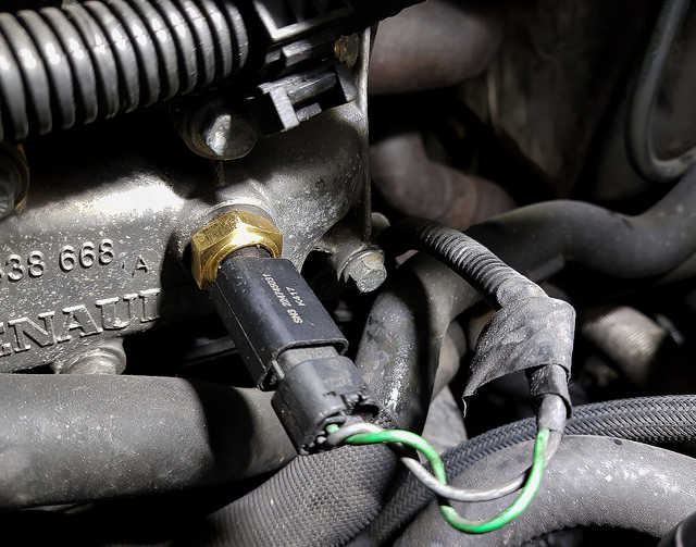

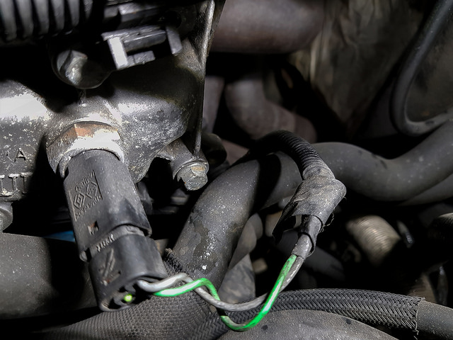

At this point i changed the temp sensor for the new one
Then i reattached the lower hose, fitted the new thermostat, opened up the bleed valve and fed in the new coolant until the system was full and then closed the bleed valve.
Turned that car on, and did the fans on full/2.5k revs with some wood strategically placed!
All worked as it should, until the fans kicked in. With everything all good, i was done for that job so i put the bumper back on.

With that all done, and my center caps all painted, lacquered and dry (used the booth to bake) i fitted them, fitted the wheels, lowered it off the stands and washed it.

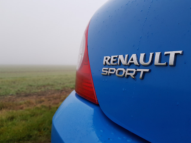

Then on the way to work on the monday morning, it was quite foggy so i saw this as another photo opportunity! (I cant help myself!) These are taking with my phone and aren't edited, only cropped. I love the first one in the road. As i was driving up, there was no-one in front or behind me so i quickly stopped, "angled" the RB, got out and got one shot and quickly got in. Was not even 10 secs but a car decided to come towards me so the quick, one take got captured perfectly with no one else on the road!

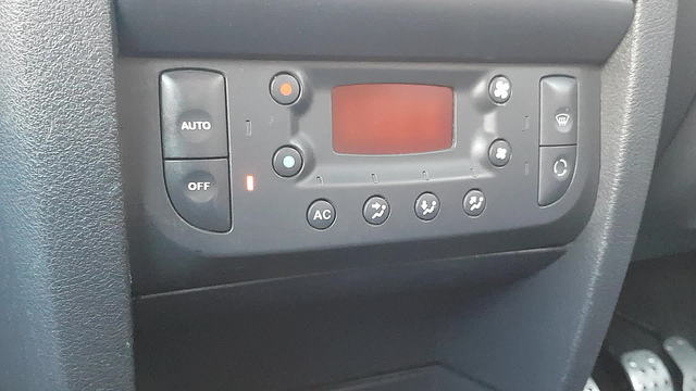

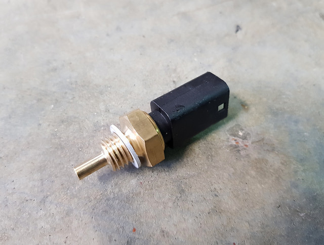

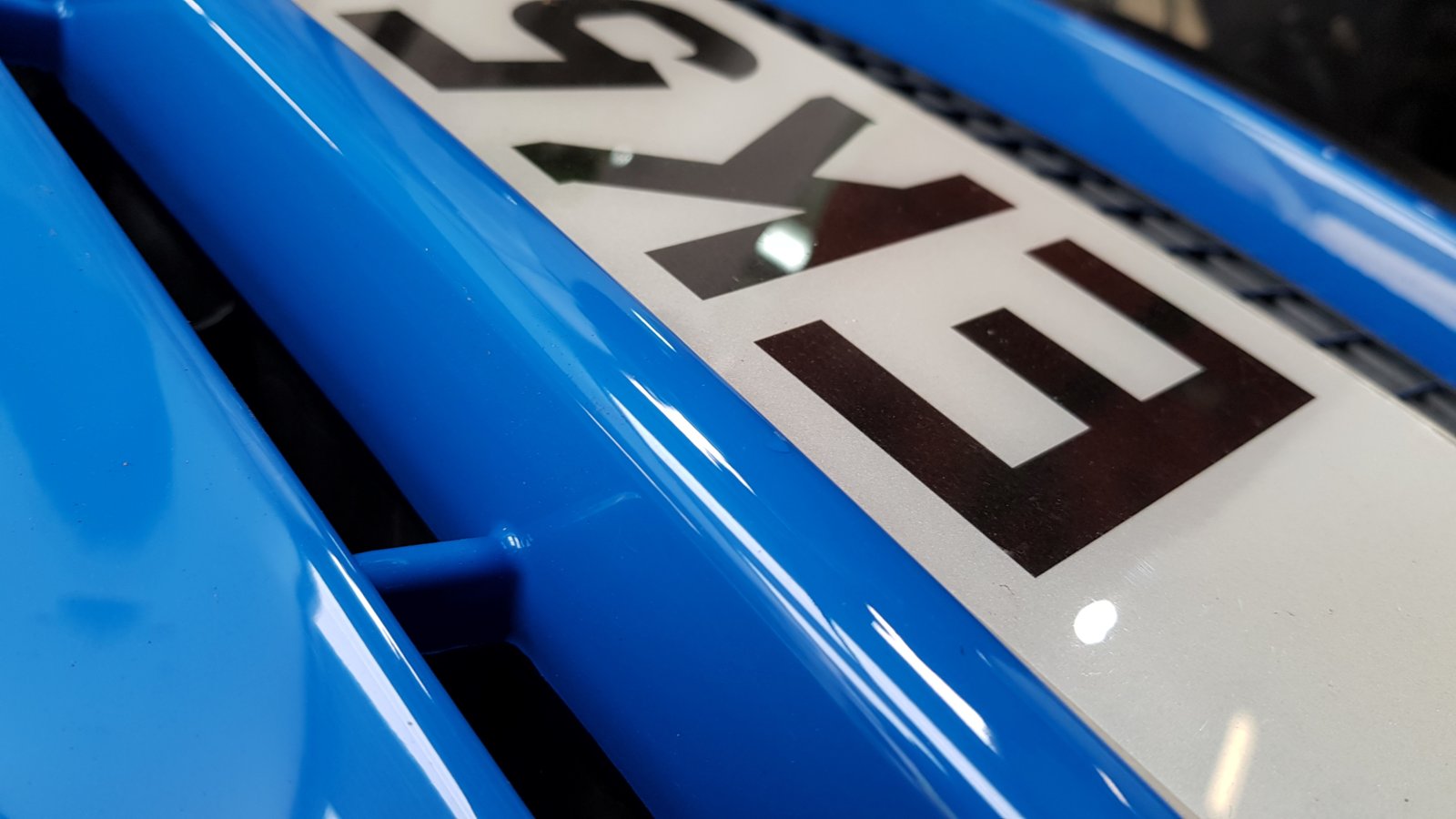

V2 plates made. I changed them to white and yellow paint to match UK plate colours. Got some pics but the paint reacted so redid them at a later date.

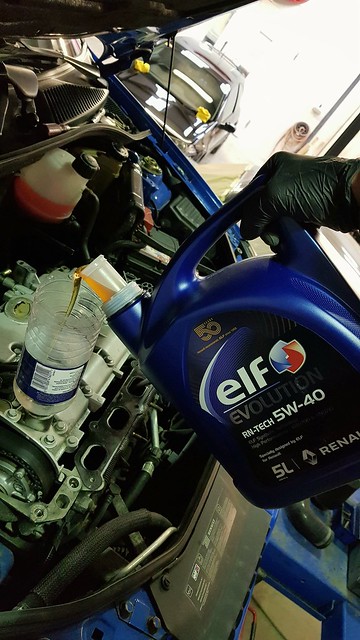

In april i did a oil change on the RB. The car had hit 133k at this point. I also repainted my engine parts (via aerosol cans) as my lacquer had cracked in places.

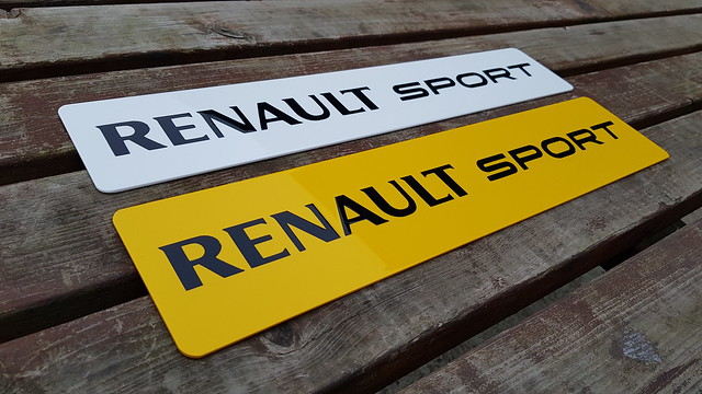

I made the final version of my show plates. These was done all in base colour and clear lacquer. These have come out fantastic and they seemed so popular that i decided to make a small batch which all sold! Most had the 3/4 front and some had full sized front and rear.

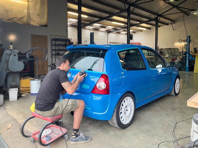

I wanted to get a bit more on top of my cleaning so i bought a few bits after i decided to buy a new car cleaning bag, seen as my trusty old fishing bag was worn out.
I then spent a few hours giving it a mini detail. I want to spend more time on it as its not perfect. This was due to my bad washing techniques i think.

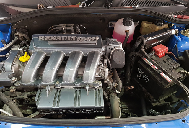

I also repainted my engine bits again, gave the bay a clean up and fitted some new stainless bolts to replace the rusty old ones. I bought a kit off ebay for the engine bay but im unsure if its a bit too blingy. I'll keep them fitted for now.

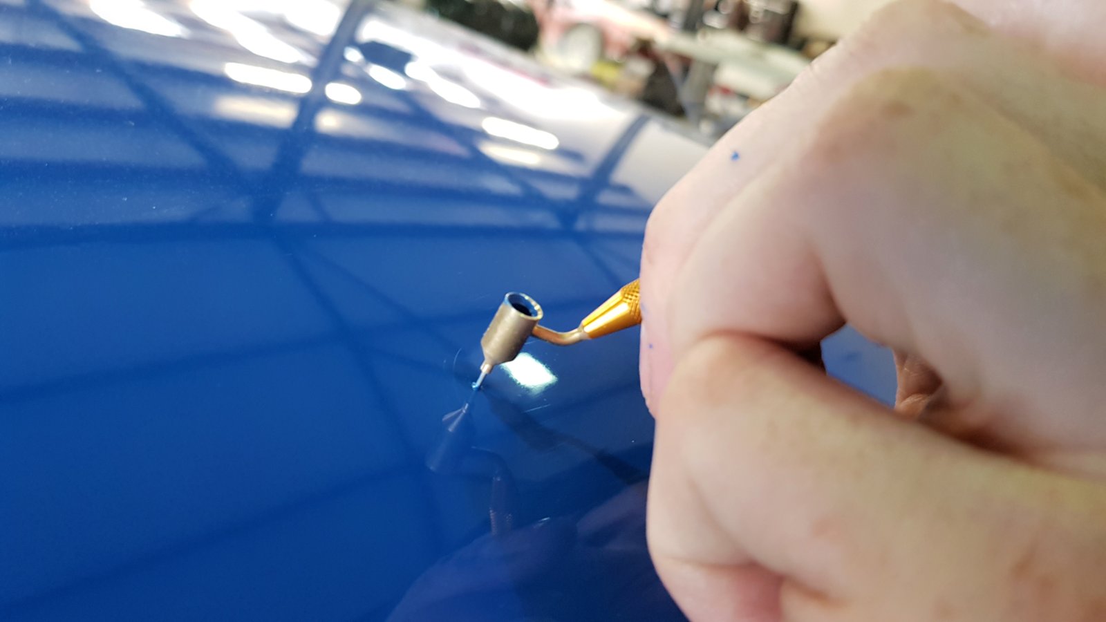

Pretty good bud. Few chips was had but i got a touch up pen. See above for pics.

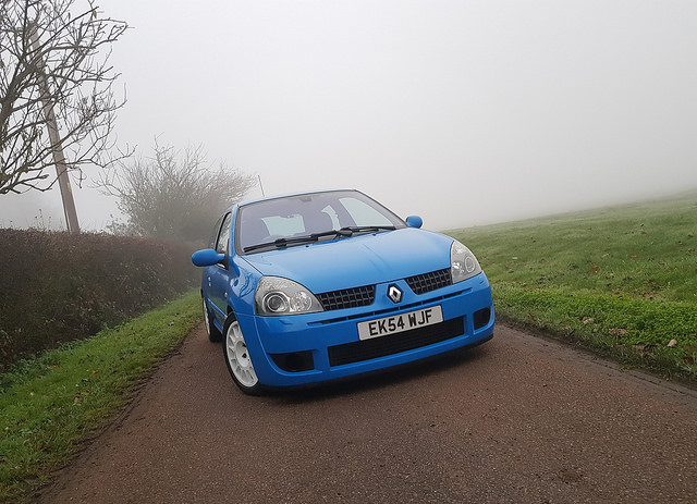

The photo in the trees with the fog needs blowing up and putting on your wall.
Yeah i like that one. Guys at work thought i was mad when i told them, but i saw a small window of opportunity and took it!

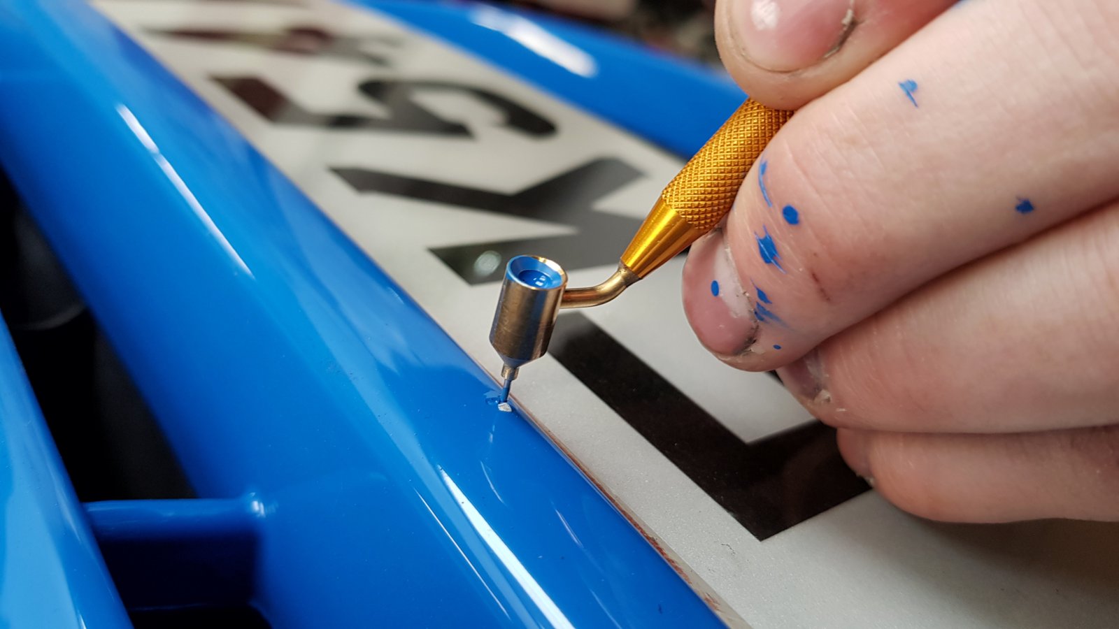

If you don't mind me asking, where did you get that touch up pen from? I've ordered it twice but got cancelled twice as well because of no stock.. Need one for stone chips myself! Thanks!
Some awesome shots there! Great write up.
Thanks mate.

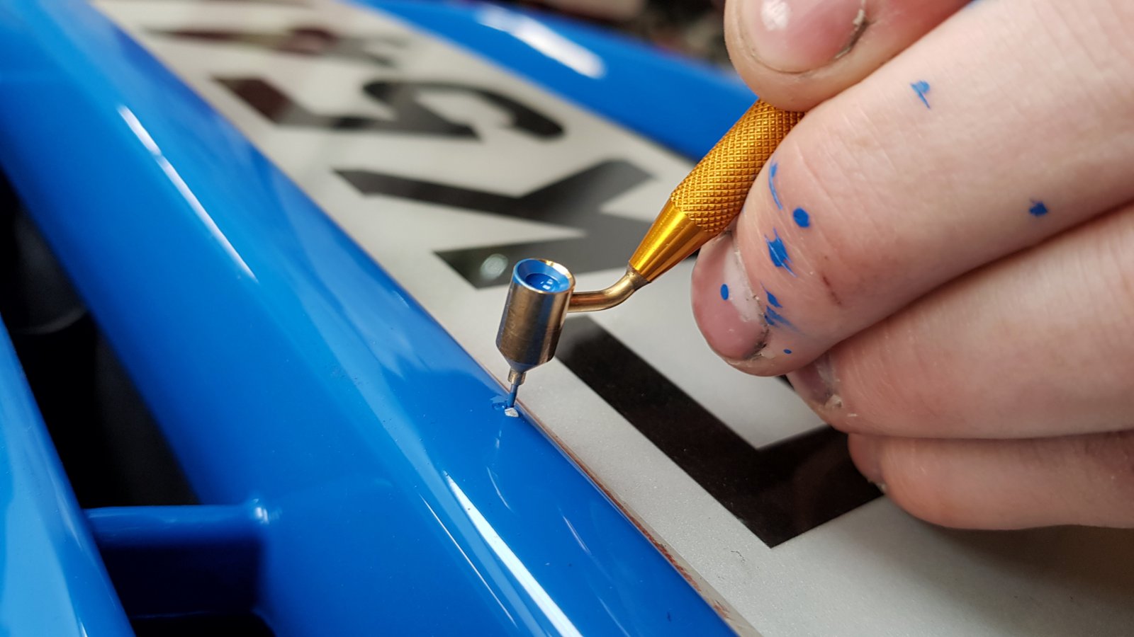

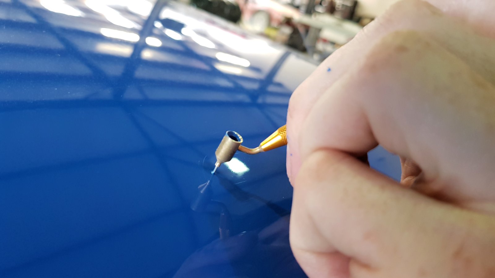

As for the pen, I got it from Amazon last year. Think it was £9 from memory. If you cam get one, I'd highly recommend it. It's a very neat way of doing it, better than a small brush.

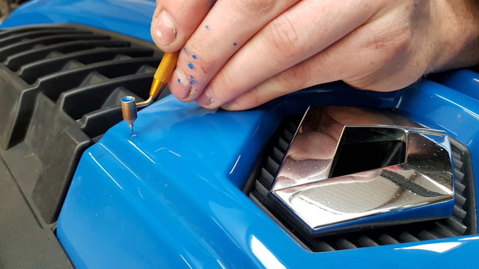

I forgot to add a few more pics of the touch ups.
Indeed i will be Paul. In fact, although delayed, we both bought our tickets this weekend just gone. Only going for the day though, no camping.

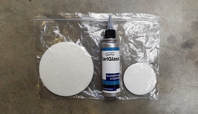

I've just bought some new glass buffing pads (flexipads rayon) and some ceriglass polish to try and clean up my front and rear screens. I'm not sure itll et did of the marks I made when I DA'd the boot before paint. Rookie mistake but we live and learn.
Are you applying lacquer too after the paint drops? I have a fair few stone chips itd be nice to fill. Seen people just use cocktail sticks before now
Nice update Mark! Shame about the gearbox mate but it's no biggie. This is easily one of the nicest cars on here.
Thanks! I'll have a look on amazon again, maybe they're back in stock again, seen them for sale in the US but with import fees and postage they were a ridiculous price.
Yeah that's a cheap mod regarding the cocktail sticks as it's got a nice point. A good DIY way of doing so.
Yes I added lacquer on the big ones, the ones on lower part of the front bumper I didn't bother with.

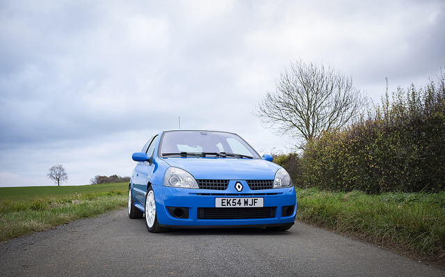

Gave the car another was and snapped away! I cant help myself!

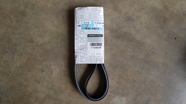

One thing ive been wanting to do for a while is remove the aircon. I never use it and im sure it doesn't work very well, if at all. It also tidies up the engine bay and makes belt changes cheaper. @renaultpartsdirect had a sale on so i ordered a new cup alternator and belt as i'll start getting bits to do the delete.
I also bought a genuine cat fitting kit as that was on offer too.

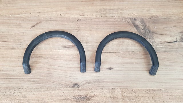

Managed to find a seller on ebay that was willing to break a rear bumper for the surrounds so i bought a set as one of mine wasn't in the best condition. Also bought some new stainless steel exhaust clamps to replace the cheapos that i currently had.

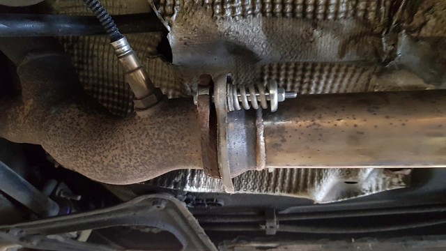

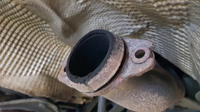

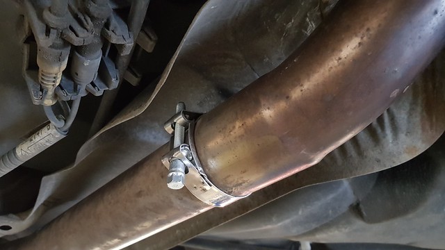

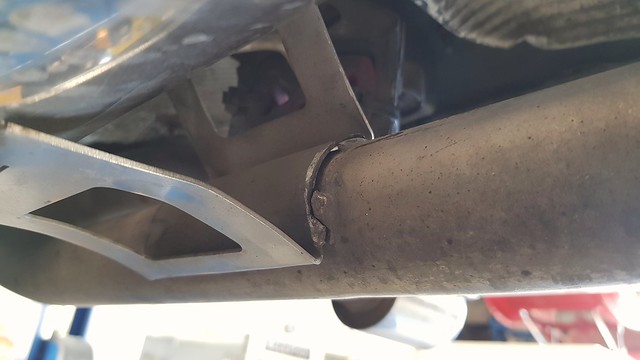

I've had a tinny vibrating noise on the exhaust for ages and i've checked the exhaust when it's been jacked up and couldn't find the issue. I thought it was the baffles inside that may be shot as when i loosely touched the tailpipes, the rattle would disappear but let go and it was there. I go the car on the ramp to change the exhaust clamps and cat fitting kit and after leaving i running to check the whereabouts of the rattle, i finally found it! I had a small crack on the weld on the back of the back box. So happy i found it as this has been bugging me for what feels like months!

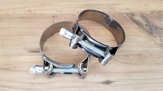

So i removed the whole system so i could weld the back box and also fit the cat fitting kit. Found another crack on the centre silencer bracket but that made no annoying noise. I cut the old bracket off and made a stronger on and welded that on.
Then fitted the cat fitting kit and new clamps
The old setup, which did me ok for ages to be fair.
New clamps on

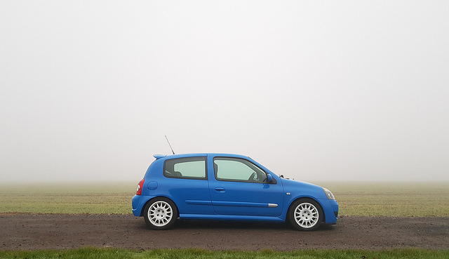

Then my wife Emily met me at work and we travelled up to Blyton together in the RB. Was a 3hr drive and we stayed in a Premier Inn in Scunthorpe (about 15mins away from Blyton) as we normally do. They also have a jet wash opposite at the local Morrisons so i gave the car a clean there. Used my buckets, mitts and shampoo and just used the lance.
I parked up in the hotel car park and dried and QD'd the car and left. Woke up to find my helmet valve caps had been stolen. 1st thing i noticed and its so annoying. So i went over to the nearest halfords and bought some temp replacement standard ones.
Went to CSF and had a great time. Both me and Emily did, as we always do. Was great to meet the usual suspects that i dont get to see often as well as some new faces! Got many compliments on the RB. Parked up next to @SiMunn lovely RB with white 2118s and i thought it made for cool pics. Of course i had to chuck my show plates on!

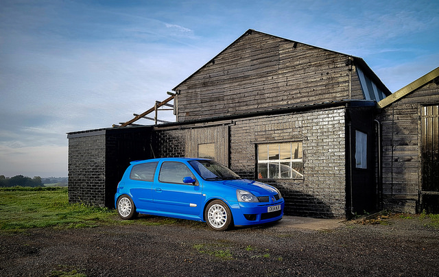

We didn't camp so before we left, myself, simon (above) and Charlie (Charliet_182_rb if you are on instagram) decided to get a trio snap. All cars was looking great so we thought it would make a cool shot!
And one just as i left. I really like this shot.

So with that passed, i'll now concentrate on the air con delete setup, maybe look into a decent RB tailgate if its fairly local, getting the front screen looked at, look into a 2nd gearbox as a fix, while i possibly get mine rebuilt, and a few other things which escapes my mind. Oh and i've ordered a new set of helmet caps, and turns out Emily had done the same too so i'll now a spare set! All in all, its a positive post/update!
