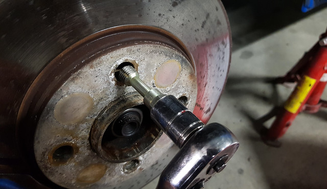

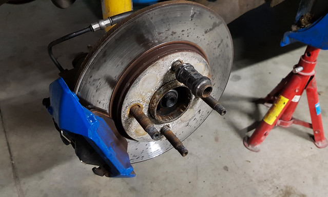

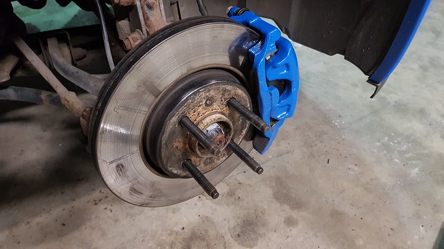

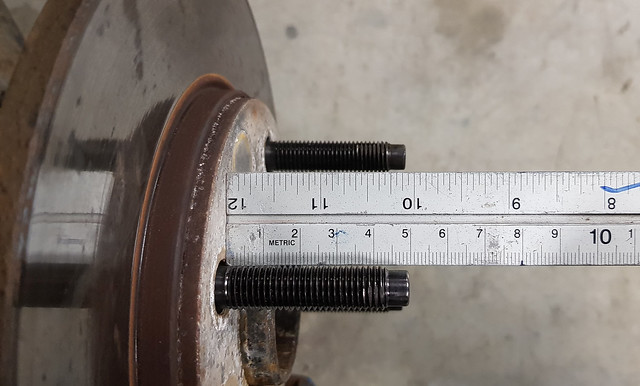

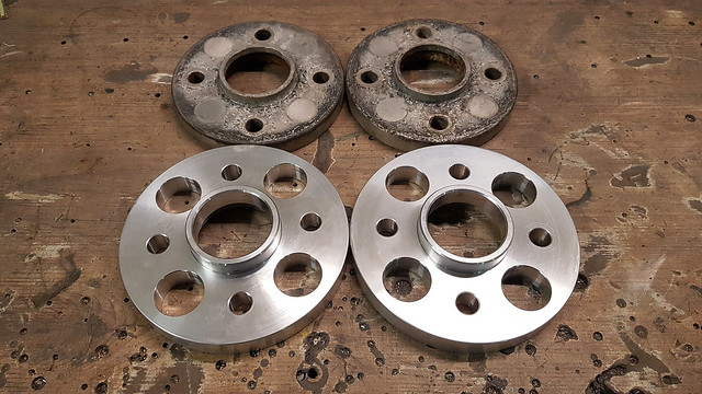

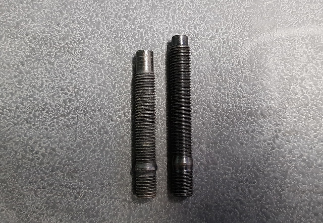

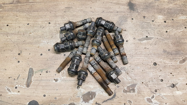

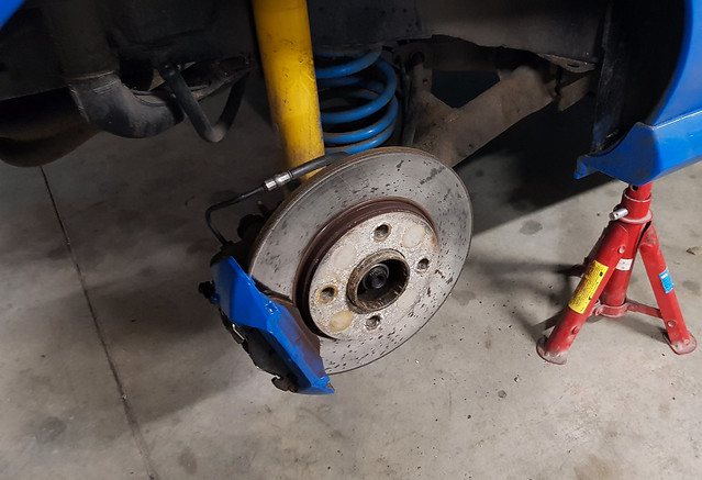

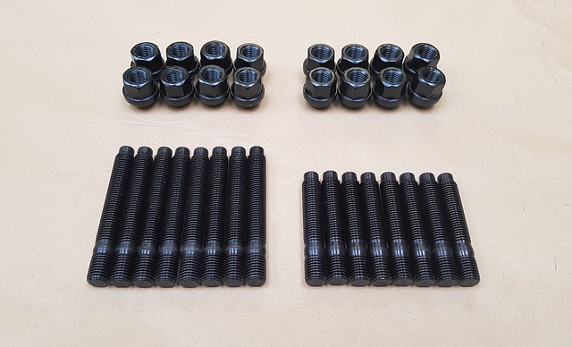

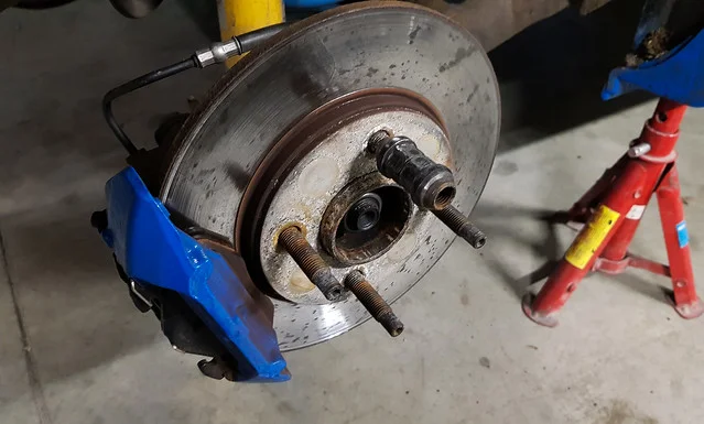

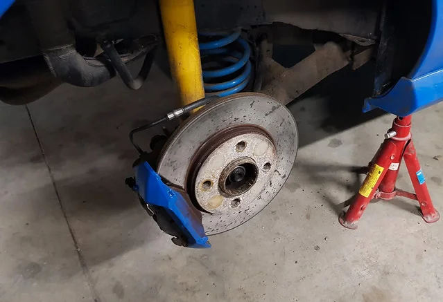

I've recently had a stud issue. I went to undo the wheel nuts the other week and they was seized onto the stud. I thought i was getting the nuts undone, but turned out the stud was being removed. I took it to work, removed the stud, re-loctighted it in and let it set. Went to try again, and once again, the stud was being removed. I thought it would just be easier to start again. When i was looking through my toolbox, i came across some A I Tech that i had. Totally forgot about them. They are the same thread/pitch but are 90mm long as opposed to my current 82mm. My current ones up front aren't the exact remaining length after the nuts as the rears so i was thinking the 90mm ones will help them be symmetrical but i wanted to go a bigger spacer just in case. Originally was looking at 20mm, but the ones i could find (branded) was over £100. Dont mind paying that for bolt to hub type, but didnt fancy that for normal ones. I had a look on PMS site and they have 18mm ones for £50, so i went with these as i know the do decent products.

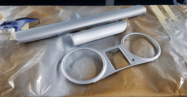

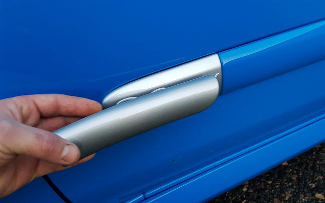

Painted my spare interior panels iceberg silver to match my door bullets.

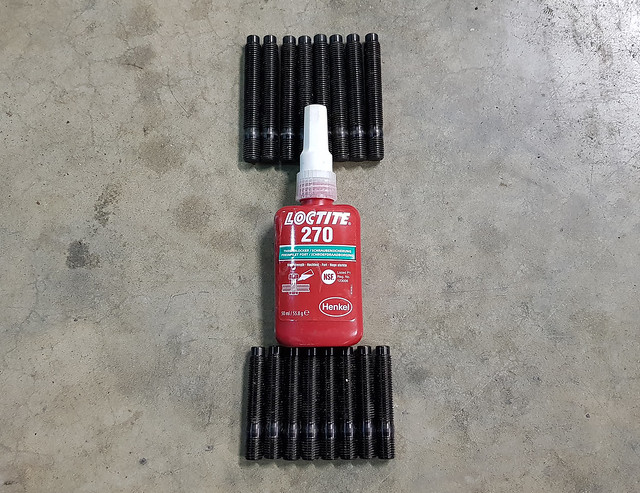

The A I Tech studs come in 3 sizes for m12 (70mm, 90mm and 100mm) so i ordered 70mm as its the closest to what i have on the rear (68mm) and some normal black wheel nuts like i already have.

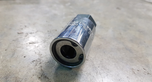

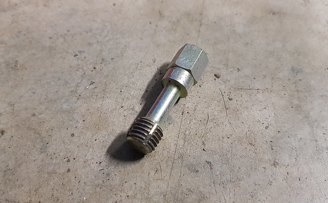

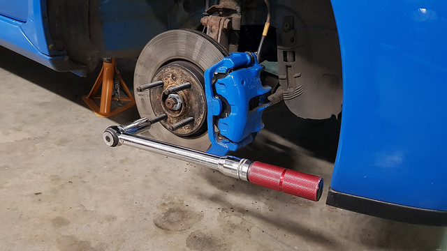

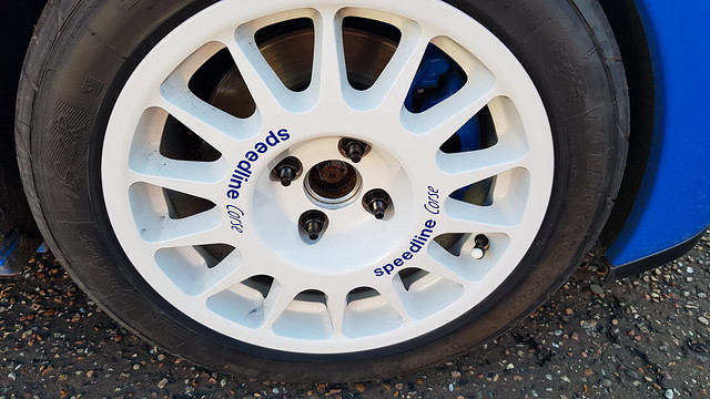

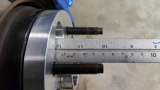

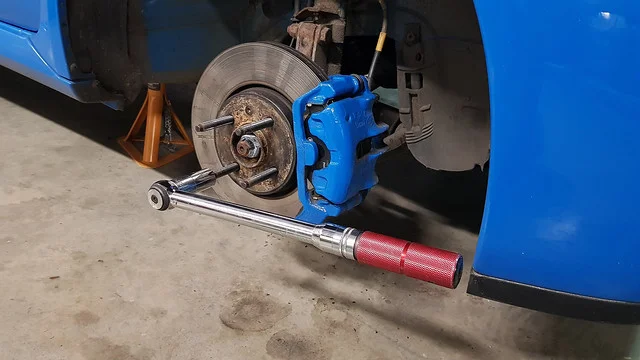

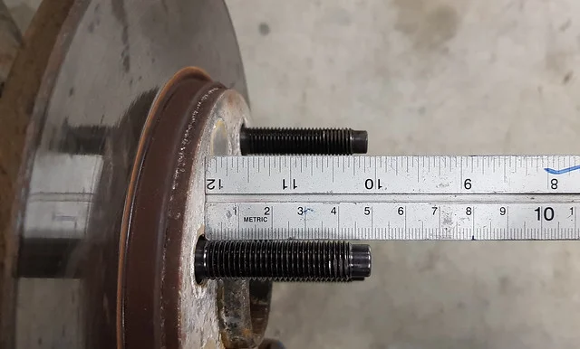

Set myself up friday night and fitted the studs. I did the double nut trick and removed the old ones and used my thread cleaning tool to clean out the hubs. I used some brake cleaner to get the last bit of crap out and then refitted the new ones. I used 270 Loctite for the threads and wound them in til they was home and then used a thread extractor tool and torque wrench and did them up to 25nm. I let them set overnight and went back to work saturday morning. I also trial fitted the front spacers and works out that with them fitted, i have 50mm of threads leftover, front and rear so they are now a perfect match. I also have some Carbon Collective ceramic coating for the wheels so i gave them a wash too.

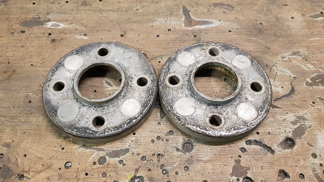

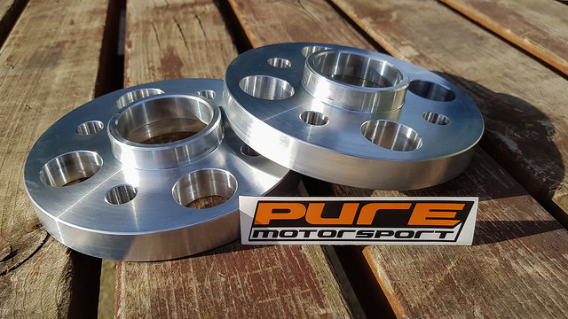

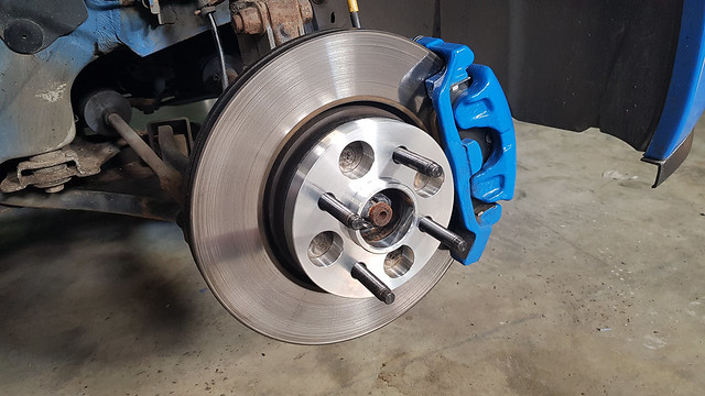

Old spacers removed and a comparison with the new PMS ones

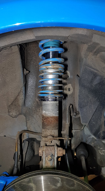

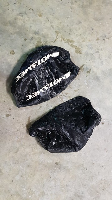

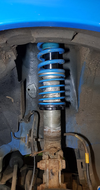

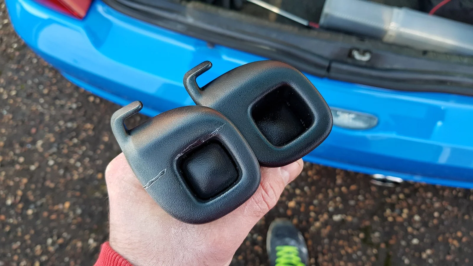

Took my coilover covers off too as they was filthy. Think they've done a bloody good job considering ive not removed them in (i think) over a year. One has a slight tear in, which has left some dirt on the bilsteins, so i think i'll buy another replacement set again. But looking at the coilovers, im happy with how the covers have performed.

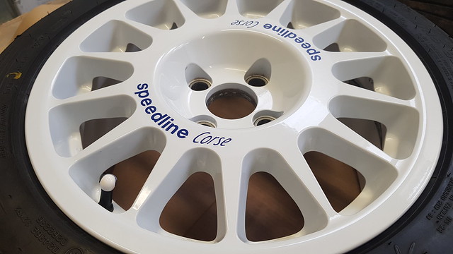

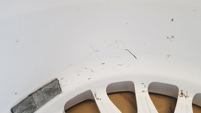

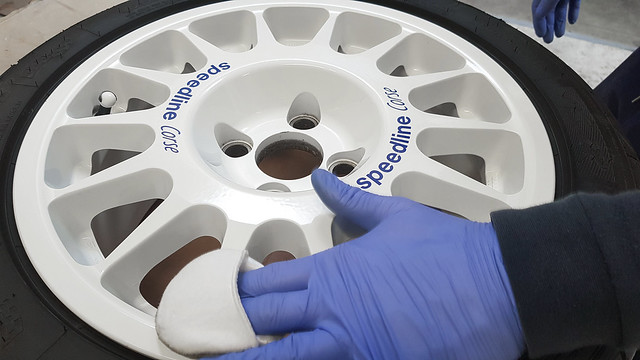

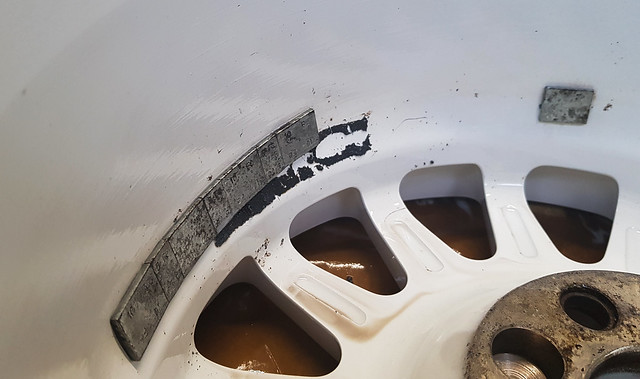

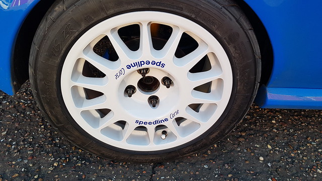

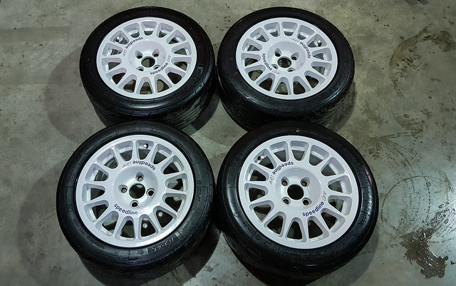

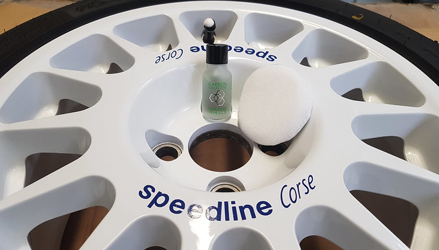

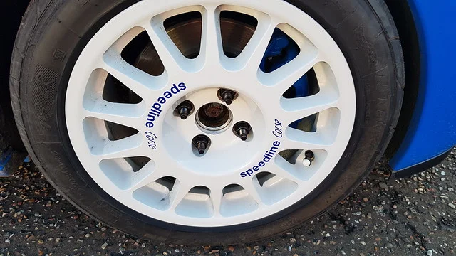

Came in saturday and made a start on ceramic coating the wheels. Annoyingly i found some scuff marks from where the tyre company had removed my old wheel weights. I used Autosmart tar remover to get rid of the old crap the best i could the polished up the wheels to remove the staining. After that i gave them a thorough degreasing and dried them up then applied the coating as described. Left them for 2 hours to cure.

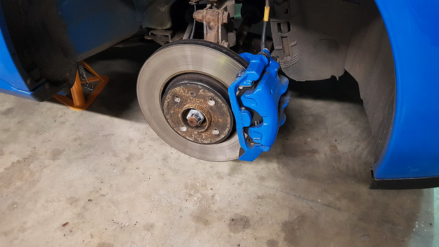

While waiting i took a wire brush and cleaned up my hubs and hub lips, and copper greased the spacers and fitted them.
Because the lip on the PMS spacers is larger than my old ones, the center caps dont fit properly anymore. This is a shame, but has also given me a idea to make some others. I might try and do some to make them more oe looking, so watch this space....

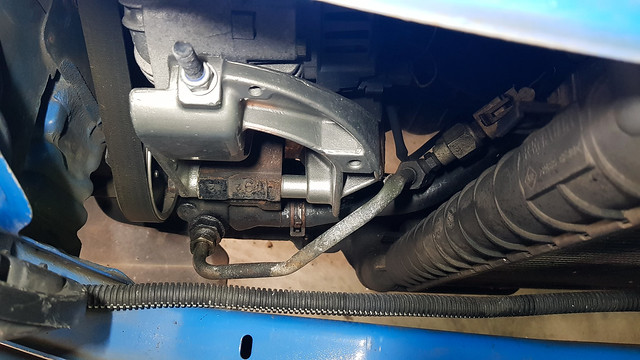

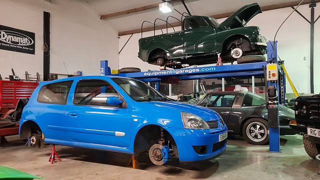

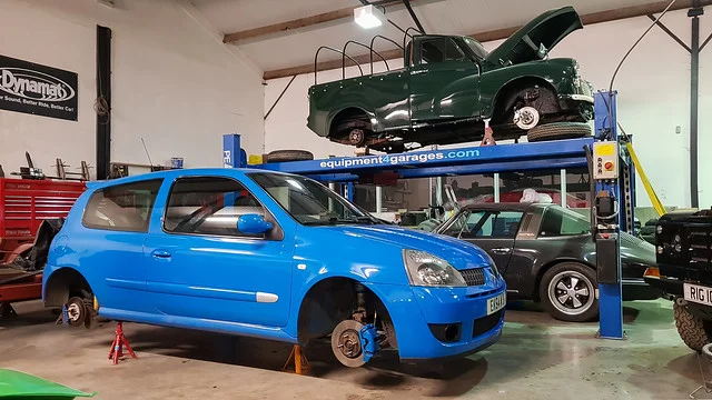

I took the bumper off so i could fit the 172 cup PAS pipe i have, but turns out its wrong. @MrBlonde was down tinkering and we was unsure what they are from. Thankfully the bend ive done on my current pipe work, with no leaks so i left it. I would like to change to a proper one, rather than a bodge, but it seems fine so i'll leave it for now.

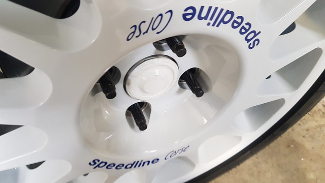

Pic of matching threads, front and rear.
With the bumper put back on, wheels back on and the car on the ground, we left. Managed to get a side shot of mine and steve's 182 together as we left too.

Bent PAS pipe is fine, my mate ran his like that for 40k. Then another mate went to bend his and didnt listen to us when we said bend it around something curved so you dont kink it... Put a massive kink in it and shagged it then blamed us for telling him to do it😑😂
Jekyll
A Ricardo Motorsport bodge that's still going strong 👌😁
Indeed mate. Only reason I changed was because I had the pipes here. Luckily my bumper takes minutes to remove, especially as it was already jacked up.
It's always nice to have the proper stuff, but your right, the RMB is doing good.

I wonder why the wheel studs came loose?
Jekyll
I didnt use the "loctite" brand so maybe it's not as high strength, even though it said it was?
These new ones are loctighted in, but only to 25nm, so I'm hoping that if I ever do need to remove them, it shouldn't be too hard. Previously I've done them up a lot more.
