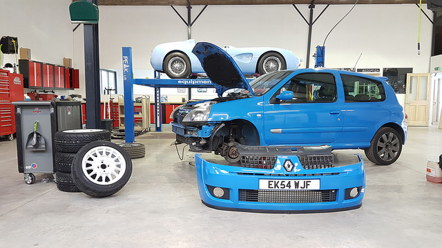

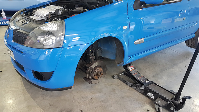

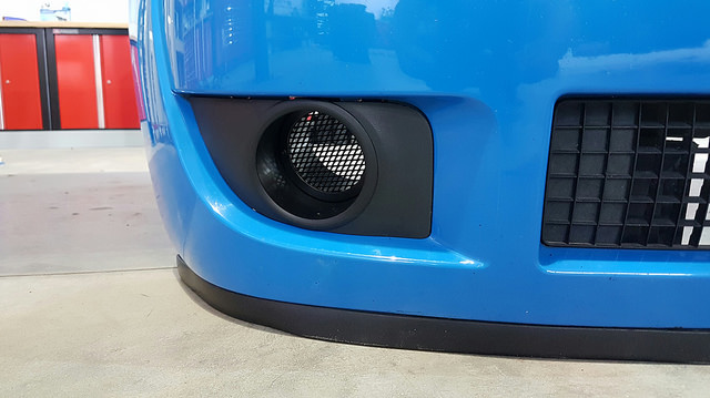

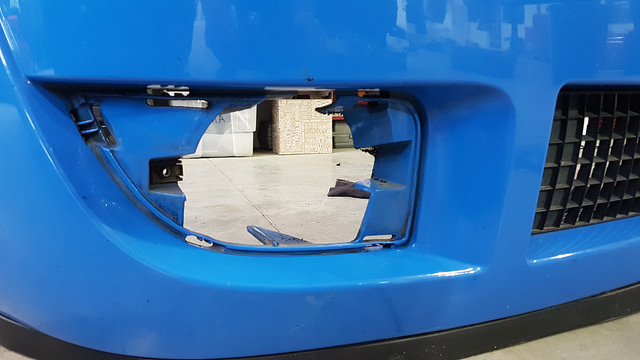

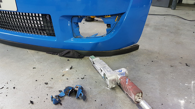

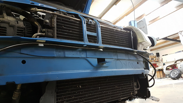

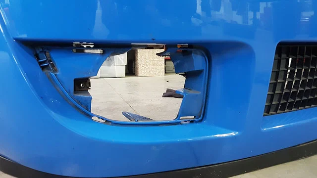

Bumper removed.

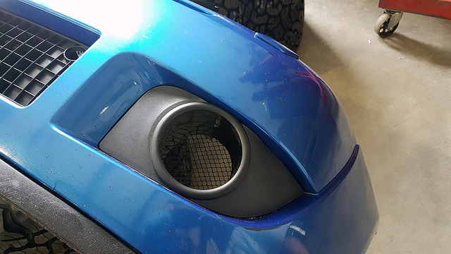

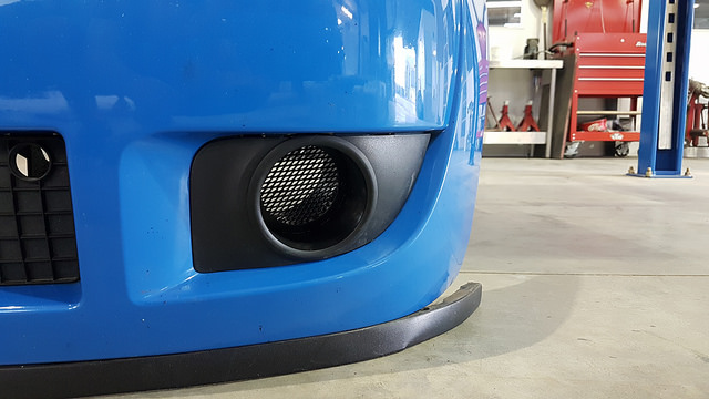

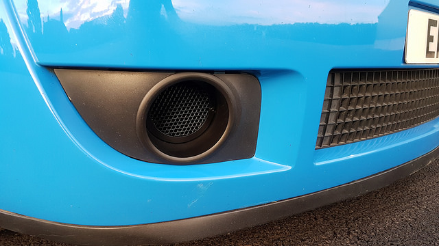

Now i know from reading a few threads about these ports that some trimming of the fog brackets need modifying. This doesn't bother me as the foglights wouldn't be going back in anyway, plus my bumper is far from mint so "if" i ever decided to re-foglight the bumper i'd just but another one.
Bumper hacking away!

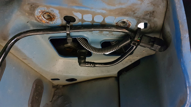

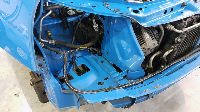

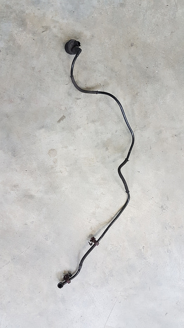

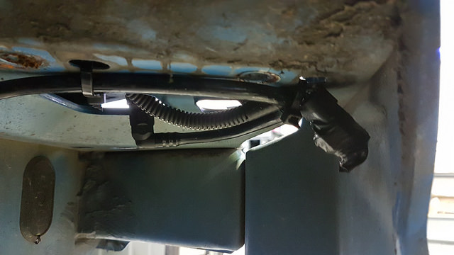

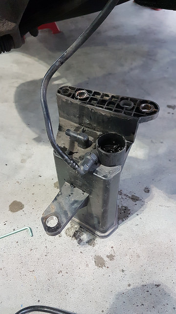

While the bumper was off i decided to remove the carbon cannister.

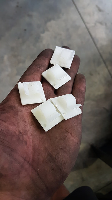

Thanks to @dann2707 for the guide! Also used these to tuck away some conduit wires
Carbon canister removed.

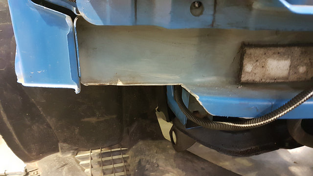

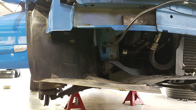

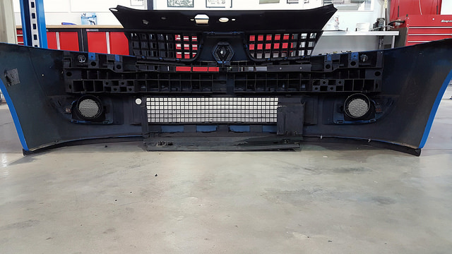

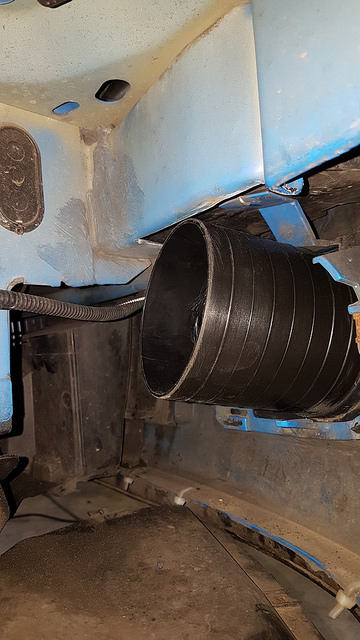

At this point i went to put the bumper back on but it was fouling. Upon investigation, it turned out the back of the ducts was hitting the chassis! Out with the grinder to cut a piece out to make way for the ducts! Had to do this both sides. Ive not read anybody else needing to do this so perhaps ive bought longer bass ports? Just a heads up if you want to still do yours on sunday @MrBlonde
I did think about cutting the ducts shorter but i didnt want to see the cold air feed that i'll eventually fit through the mesh. I'll figure this out when i fit it.

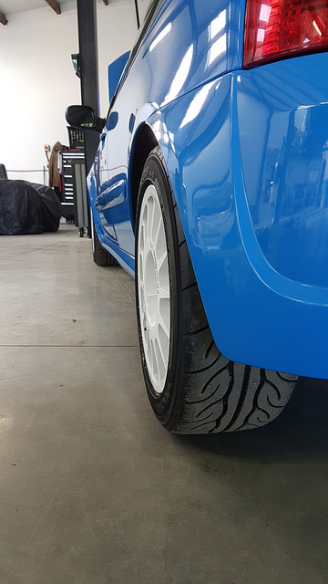

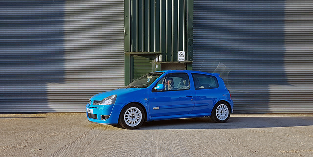

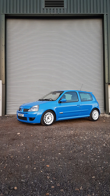

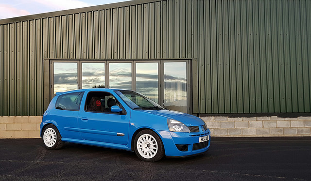

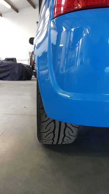

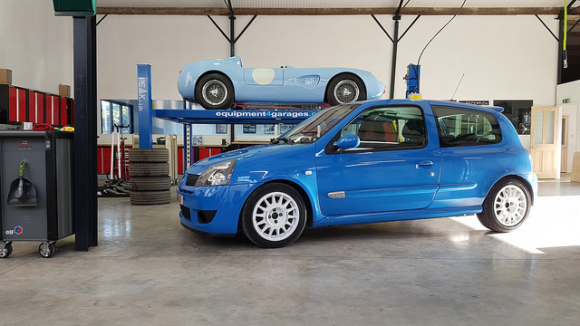

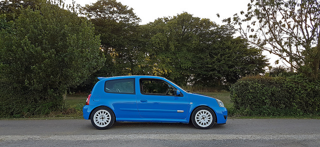

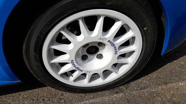

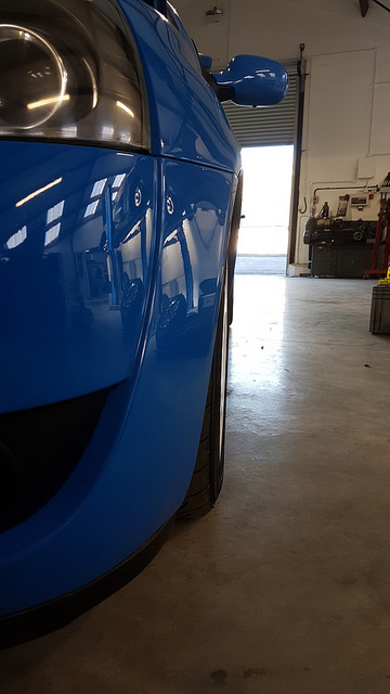

Fitted the wheels and photo whored it up!
These 2118's are the wider offset of ET38, not the normal ET43. They sit better than my old cup turinis of the same offset, which is weird? Anyway, i was originally thinking of getting 20mm front spacers and 10mm rear hub spacers, but now im thinking of getting 15mm front spacers and 5mm rear spacers (non hub)
Remember this is still on the cooksports/cu shocks setup. The Gaz coilovers are taking a tad longer, but i've been kept updated of the progress on them. Hopefully i'll have them next week :smile:

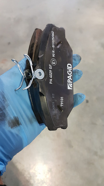

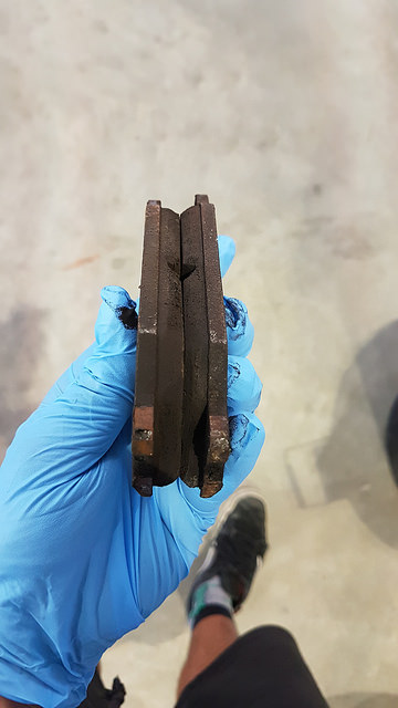

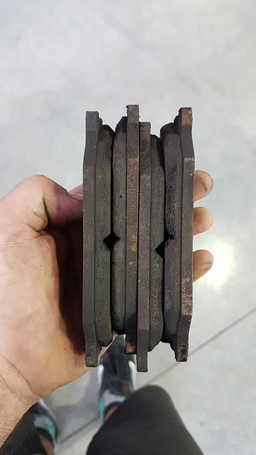

I also had a spare set of pagid pads that were brand new, it seemed. I decided to fit these for 2 reasons. 1: To see what they are actually like compared to the current DS2500s and 2: To see if it eliminated the knocking. Well the knocking is still there, could be gearbox mount related? Also there not as good as the ferodo pads, as to be expected, but they do give off less dust. Ill change them back next week or so.
DS2500s

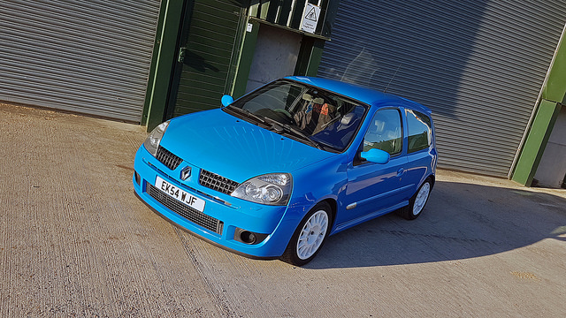

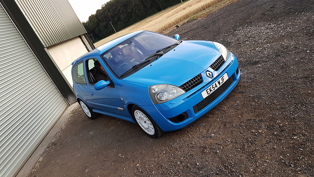

All refitted and a few more pics to end :cool:

Looks great
How you finding the tyres?
Double post
This a keeper i moght aswell ask?
I like the tyres Stef. Had them on the ph1 and was impressed with them. I also got them for £240 for the set, delivered! The joys of 15's!
And yes, this is a keeper!

Looks so flipping good, will look even better when you get the coilovers.
I also want some 2118's now!
Clio_fool
Wheels look very smart, excellent choice. I like this car very much, except for the cooksports they need to come off asap and be sold really cheap. [emoji6] [emoji23]

That looks gorgeous. Top work.
Thank you :)

Looks mint! [emoji817]
RB love from a RB brother right there!
Looks great Mark.
Reminds me of my old RB
The amount of times I looked at your old one for inspiration. I loved your old RB.
Haha, I'll keep you posted!
Lovely RB, looks spot on mate :up:
Thank you! :)

Looking great, bet you're happy you finally got those 2118's on! Look awesome in white too. :tongueout:
  Clio 172 Cup, Eunos
Beautiful combo with the blue paintwork and white wheels :stig: May have to try the Yoko's at some point in the future, heard some good reviews on them.
Stunning :up: that's the best word that can describe it........ I am absolutely loving those brake ducts, looks oem from the front!
I defo agree the car needs coilover lows to pull off the 2118's due to them being 15" but that's all in hand so it's all good in the hood!

Mark if you don't mind me asking bud. What did you use to make up your brake ducts?
I'd like a similar setup on mine!

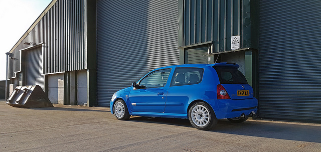

Had to go in central London on saturday to do a bit of work on a customers car. Took this as it looked quite cool.

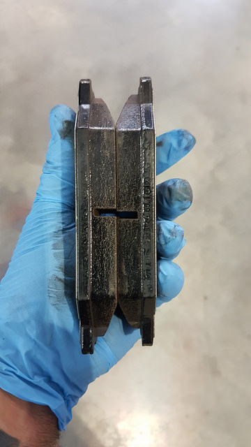

Gave the car a good run. The Pagid pads are actually better than i thought! They perform well and give off very little dust compared to my DS2500. This after 90 miles.

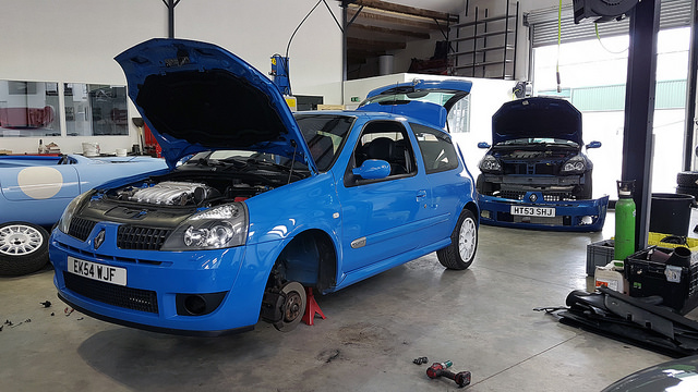

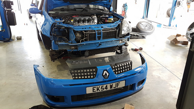

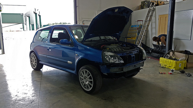

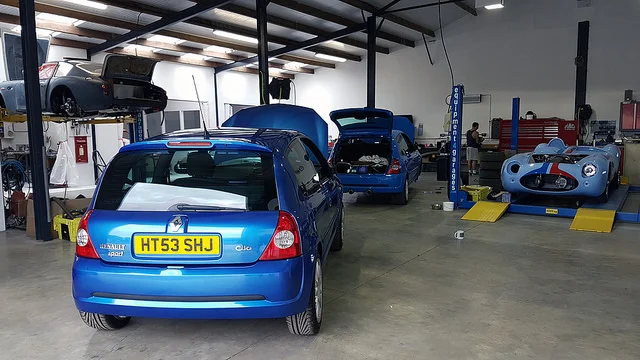

Me and Steve @MrBlonde took our cars to my work as we both wanted to do a few little jobs on both cars.

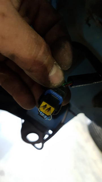

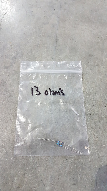

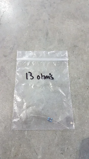

First off was to put a 23ohms resistor in my carbon cannister plug as i had the EML light on.
This worked for a bit but unfortunately it came back on. I plugged the carbon cannister cap on and plugged in the electrical plug (Ive read this also removes the light) and still no luck. I took out the resistor today and it looked burnt and upon further reading, i actually need this one:
http://www.maplin.co.uk/p/wirewound...&ranSiteID=TnL5HPStwNw-yB1tupP1amuf8ZMQso15GA
Will go to Maplins tomorrow and give it a try. Its a piss easy job to do.

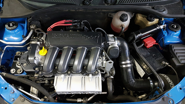

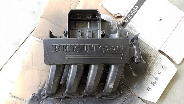

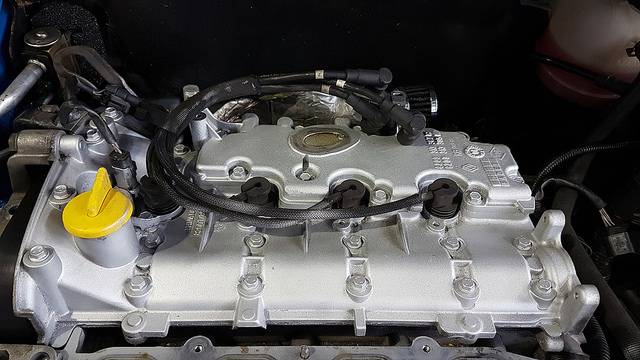

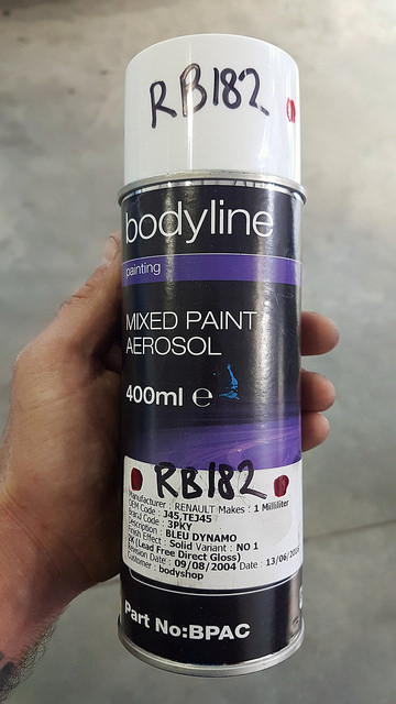

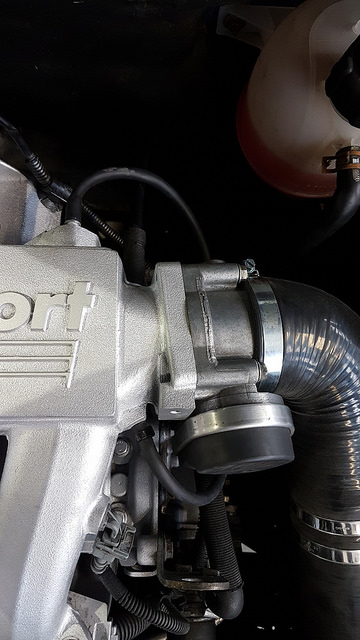

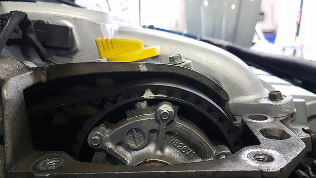

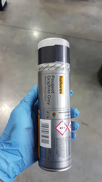

Decided that i wanted to paint my inlets as recommended by @LiquidYellDan as i didn't like the the all silver look.

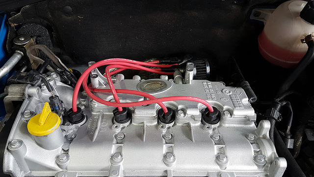

Timing mark...
It made sense while the inlet was off to fit the new red HT leads
Old.

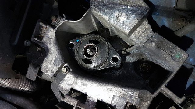

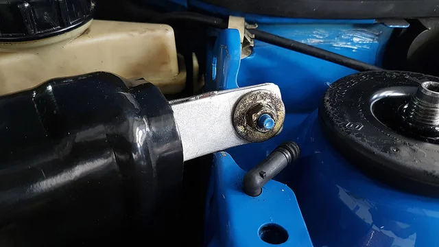

While the engine was being worked on, i wanted to check the gearbox mount as i though it may be the cause of the knocking im receiving. The solid gearbox mount was fully intact and looks in VGC so it wasnt that. However we did put a pry bar at the back of the manifold and did hear a knocking. Turned out the culprit is the shagged/bodged center mount so ill order a new genuine one and get it fitted asap.
And back to the painting
Unfortunately i didnt have enough to do the fuel rail guard.

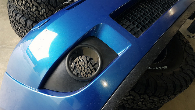

Steve was busy in the background making some bass port brake ducts

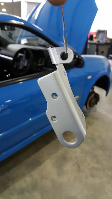

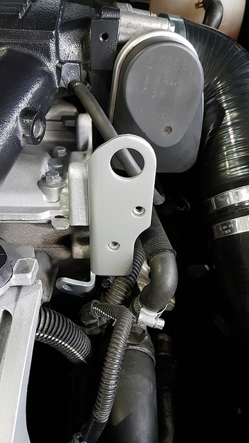

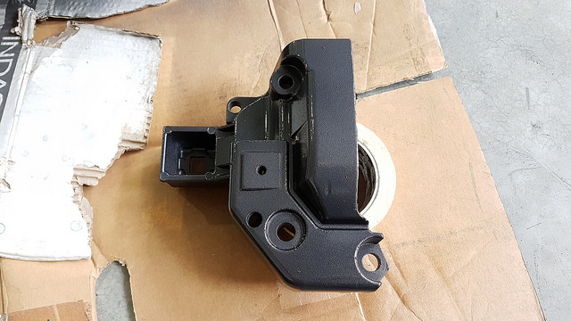

Decided to remove my old overspray and paint the engine hoist bracket
New HT leads fitted

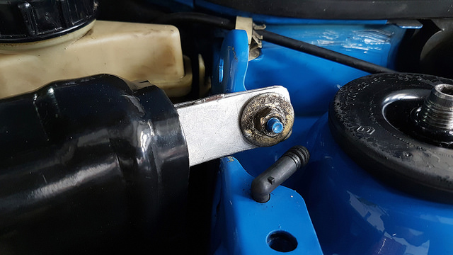

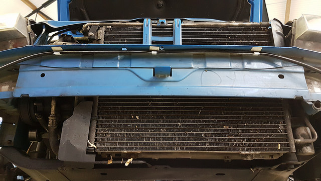

Made a quick bracket to stop the ECU cage flapping about
All painted and fitted up
It looks good, however im still unsure on the grey. I think id like slightly lighter so im going to buy this stuff as it goes further and its a nicer colour. Plus i can do the fuel rail guard too.
http://www.halfords.com/motoring/pa...s/halfords-wheel-paint-anthracite-spray-500ml

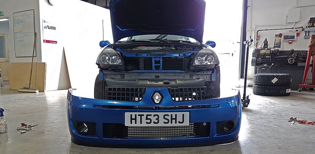

Next job was to change the headlamp bulbs as the ones i had were a bit dull at night. While the bumper was off, i cleaned the insides of the housings both sides. Luckily i had these bulbs spare in the box of spares that came with the car.
All done so we packed up and took a few pics

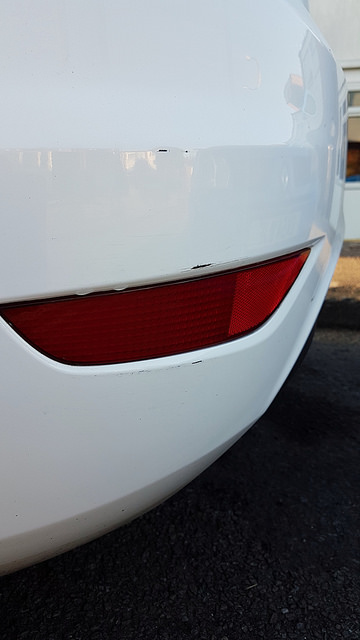

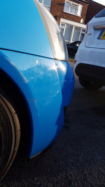

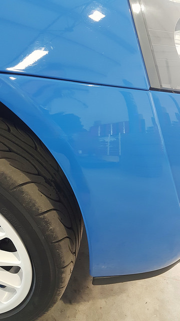

Pics of bumper scuffs
The black bits was actually done by somebody else a few weeks back (only 2 of the 3) but you can see the grazing
I had some touch up paint made when i bought the car so i used it with a little paintbrush to dab the black bits so its not so obvious.

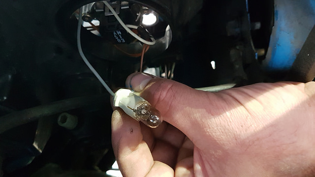

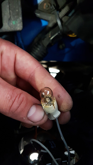

Bad news though, my NS bulb holder doesnt work. Upon inspection, it looks burnt so ive posted up a thread for a new bulb holder.

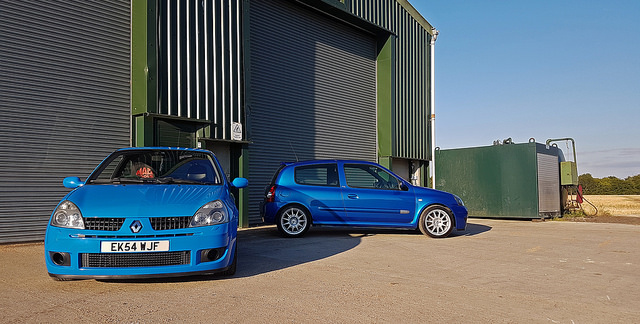

But, took a cool pic of the RB sitting there and another of Beamish the farm dog admiring it :smile:

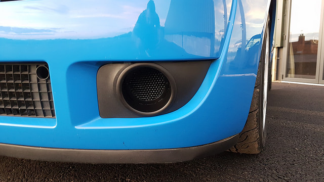

I love the brake ducts! Rather proud of myself!
@RMDavis all they are is bass ports that are 100mm/4" wide.
http://m.ebay.co.uk/itm/Monacor-MBR-100-100mm-Bass-Reflex-Port-Tube-/142026244109?_trkparms=aid%3D222007%26algo%3DSIC.MBE%26ao%3D1%26asc%3D20150519202351%26meid%3D91085d71c6df443e9ae59ab54bdb2136%26pid%3D100408%26rk%3D1%26rkt%3D2%26sd%3D201475761432&_trksid=p2056116.c100408.m2460
I had the mesh and fibreglass at work already.

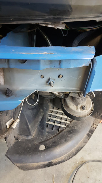

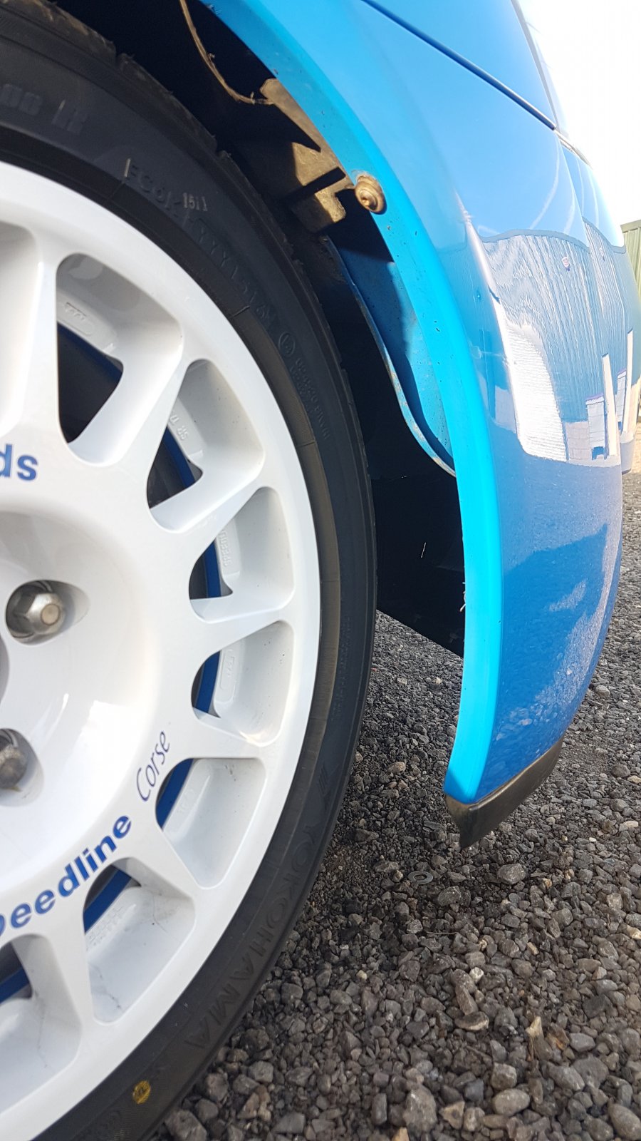

Thanks guys for the comments! Today when driving to work my drivers inner arch decided it didn't like being there so it gave way. Thankfully it hit a van behind me that was so close up my arsehole so my loss, he's gain! But now it means my brake ducts are actually working as there's no arch blocking it. And because I've removed the carbon canister and fogs there's nothing in the arch well now.
Will do the other side I think as I've removed parts from there too, just need to relocate the horn. It's also temping me to add quick release to the bumpers even more so now!
