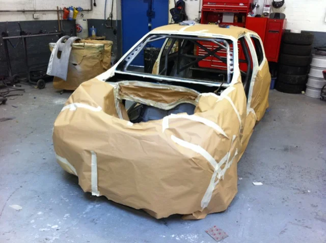

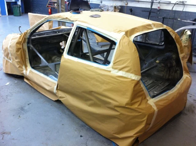

Well this is how the car was left last night. Wrapped up ready for painting.

Recieved the car back today from Ollie & Panelwise.
Over the moon with the work quality, the guys really went to town on it!
Now the fun begins, calibration is due on the 31st with Mr Faulks!!
  Saab 93 Aero Wagon
Note the lack of dents in the roof Chris...:rasp:
Im dead chuffed with the results. Turned around in under 4 working days as well.......it would have been painted Friday but we were short of that particular paint (two pack semi matt black).
We also removed a considerable amout of sound deadening tar and unwanted metal work, most notably the reinforcement strip in the drivers footwell and various brackets. These we removed the proper way, by drilling out the spot welds rather than just taking an angle grinder to them (much to Mikes disappoinment ;))
Anyway, its now back into Tom's and James' domain so (hopefully) serious progress gets made over the next 7/10 days!
