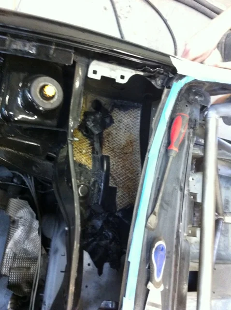

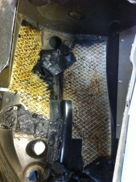

After you guys left my resident painter/spot weld remover attacked all the remaining unwanted brackets in the 'boot' area.
Plan for tomorrow is to dispose of some missed sound deadening tar on the inner quarters, finish (hopefully) scotching up the front floor and cage sections and get the masking underway. Oh and finish DA ing the wheels.
Want it painted Friday!
  Saab 93 Aero Wagon
These are purely slave wheels. Don't expect to see these on track!

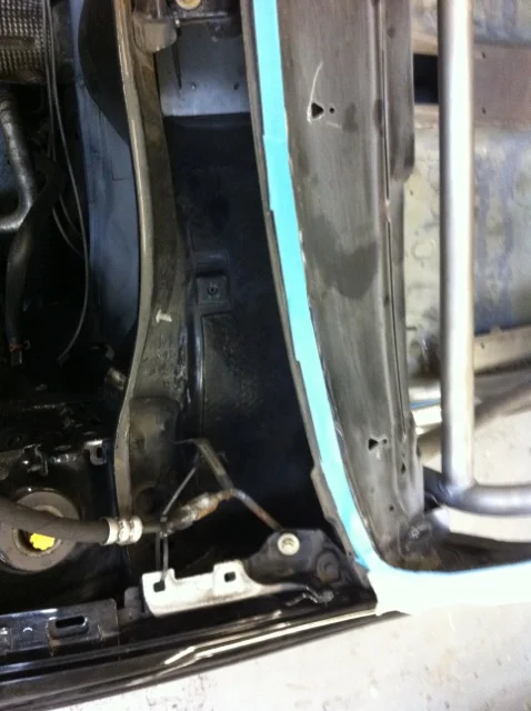

Well after lots of prep the interior is nearly ready for paint.
It's amazing how many brackets and how much sound deadening are/is scattered over the interior.
Thanks to the help of a razor blade and DA wielding Budgie the inside of the roof was keyed up and the remaining tar residue removed.
Meanwhile the Sir known as Dave was let loose on the shot blasted 2118's with a mini DA to finish getting those ready for the new colour....;)
Big thanks to these guys for helping tonight.

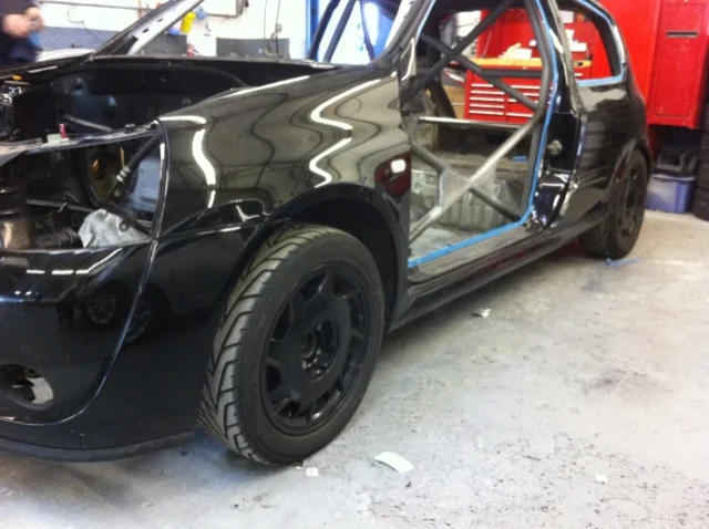

Painting is delayed until Tuesday :(
Believe it or not we don't have enough of the paint. As its going semi matt black and we don't actually keep that much of it (its not often you use 3 litres of it on one job).
Masking should be done by the end of today though. Annoying as it would have been done today!
