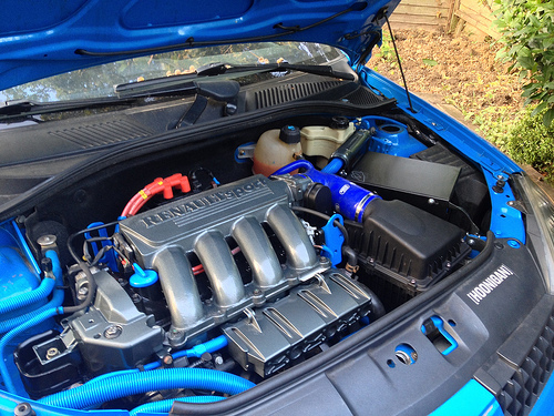

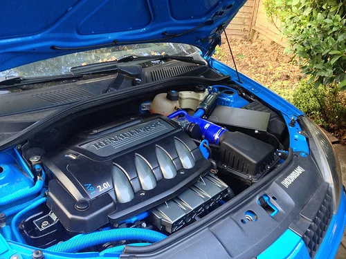

That looks great, Jon - the colours work really well.
Cheers Andy, I'm glad you agree as I won't be changing them now
I'm watching your project thread with interest as I can't wait to see some updates
still cant get over how much i love this engine bay! was chatting about it last night!
Haha well I'm glad I gave you something to talk about mate

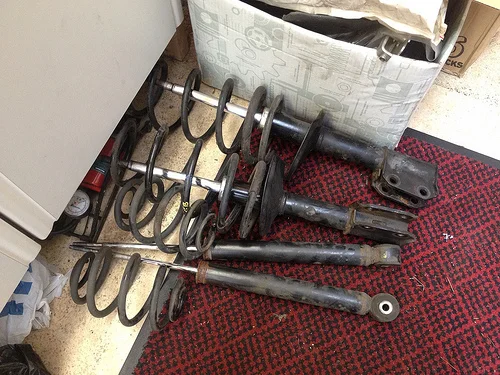

So I managed to get onto the suspension side of things at the weekend... If I'm honest that's all I was supposed to be doing in the beginning but then I saw the engine bay thread hence my reason for tarting that lot up!

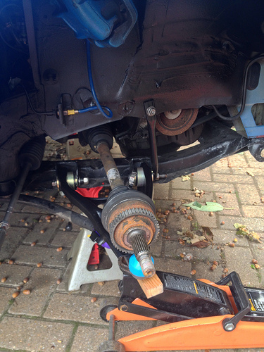

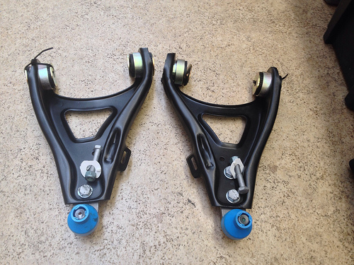

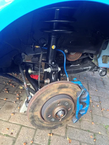

Built up the wishbones with the new style Powerflex black bushes and Lemforder ball joints:
W/bones by
Jon_KTM, on Flickr

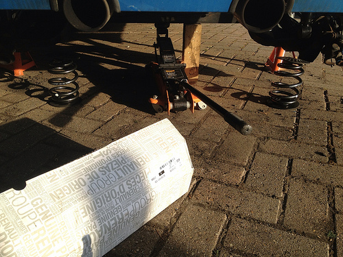

I decided to support the wishbone in what I thought to be the position it might end up in when on the floor whilst tightening up the bolts. It was a bit of a work up to get the damper lined up with the hub but better than the bushes being constantly stressed in the wrong position.
Lower arms by
Jon_KTM, on Flickr
In hindsight I could have had them a bit higher when I tightened the bolts as when it was on the ground the wishbone is practically level with the floor. So for anyone doing this with Cooksport springs fitted you need the wishbone level!

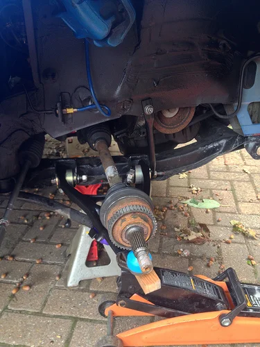

All built up with Lemforder TREs and Eibach camber bolts:
Built up by
Jon_KTM, on Flickr

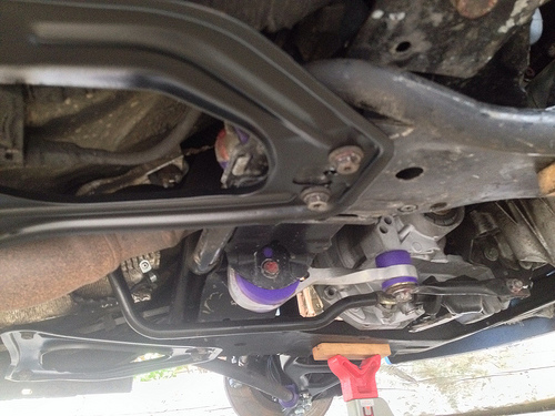

And whilst it was on the stands I fitted the Powerflex dogbone and powdercoated subframe support brackets:
Dogbone by
Jon_KTM, on Flickr

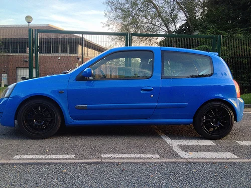

And finally sitting on the deck! With my track wheels on as I've lost enthusiasm to rub down the Cup alloys at the moment...
Cooksport by
Jon_KTM, on Flickr
I think it looks great on the 15's now, as before the arch gap was horrendous :dead: As you can see I didn't quite get the tracking right, toe-in FTL.
