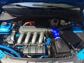

JonC219's RB182Cup
And it will come back looking like this;)

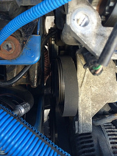

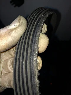

Changed aux belt, guide and tensioner whilst I had everything off and changed the PTFE gasket to standard...
Aux belt/inlet gasket change by Jon_KTM, on Flickr
Aux belt change by Jon_KTM, on Flickr
I didn't enjoy the lack of room! :(
Aux belt by Jon_KTM, on Flickr

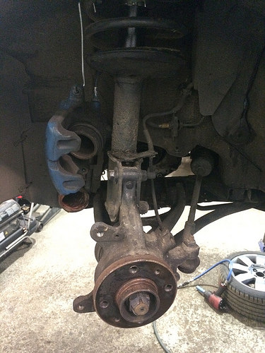

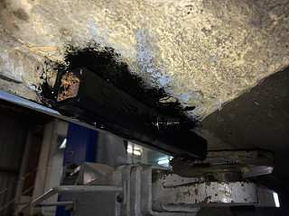

Glad I did it now as I noticed this when it was off :S

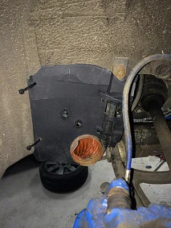

Whilst I was down there I decided to put back the small arch liner deflectors that sit next to the lower arm as I didn't like all the crap being thrown at the belt whilst driving.
Brake duct by Jon_KTM, on Flickr
Modified to fit the brake ducts

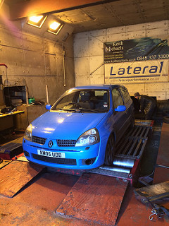

Then went to the annual Surrey RR meet on Saturday as organised by Jon ( Saner ) on here
Was a good turn out and Martin ( v800mjh ) turned up and ran his 135i which gave some impressive results ;) think you should bring it Saturday to be honest mate :p
I know Kyle ( Kyle 86 ) was well happy with his 172 Cup pushing out an impressive 191bhp, think the only Clios with more power had ITB's? Correct me if Im wrong!
Surrey RR by Jon_KTM, on Flickr

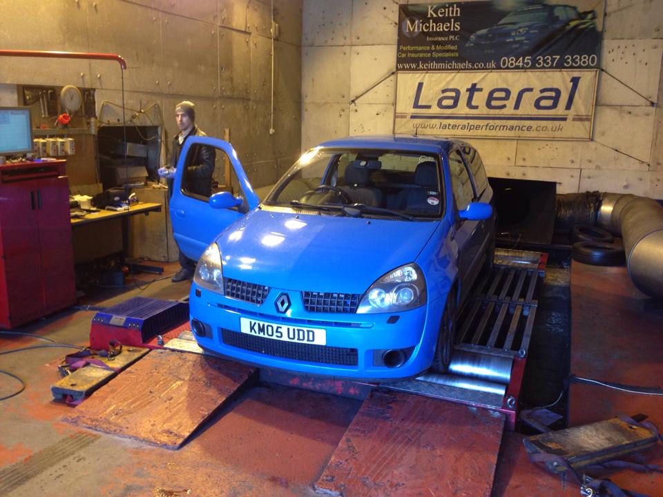

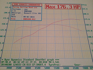

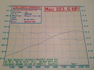

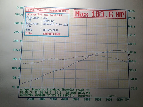

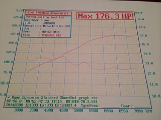

Wasn't the best result unfortunately. I was hoping for at least the same as last time with the addition of matched inlets this run.
RR Graphs by Jon_KTM, on Flickr
Comparing the AFRs to last time
It looks as though its running too rich which could explain the starting issue as well. So Im going to borrow a set of injectors from Martin as I suspect mine have finally had enough:quiet:

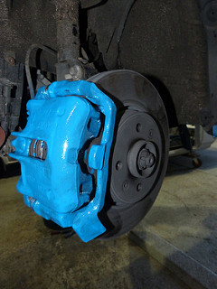

Front brakes before by Jon_KTM, on Flickr
After
Front brakes painted by Jon_KTM, on Flickr

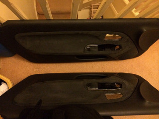

And finally Martin brought along his old dash top and alacantara door cards for me :D so the door cards will be going in once I collect the rears from Bedford and the dash top will be a bit of a side project as I plan to make a gauge pod and flock it
Dash top by Jon_KTM, on Flickr
Door cards by Jon_KTM, on Flickr

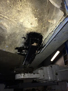

So next job that needed tackling was the cheese front sill jacking points. Having seen the thread on here using a bit of box section I got to work :)
Jacking point by JonC219, on Flickr
No before's but they won't be bending now :clap:

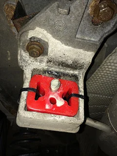

I also swapped the old Powerflex EXH008 mount for 2 EXH001 mounts with the holes pre-moulded. Took a gamble as I wasn't sure if the exhaust was going to sit right but its's perfect now
New mount:
Powerflex exhaust hanger by JonC219, on Flickr
You'll see a pic of how the exhaust now sits in a minute. Much improved.

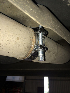

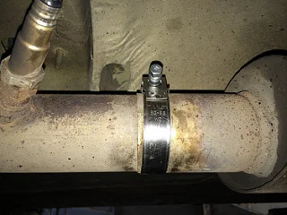

Whilst I was under the car I swapped the old U-bolt exhaust clamps for some posh Mikalor clamps ;) even though I'll be the only one to see them at least I know they're there!
Mikalor clamp by JonC219, on Flickr

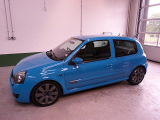

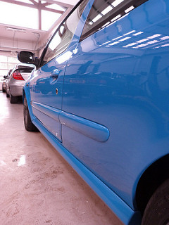

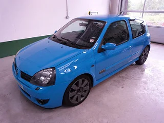

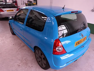

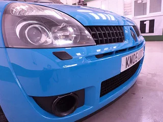

After pictures of the detail...
I didn't get any during pictures as I just wanted it done! Likewise none of the swirl marks close up but they were not good.
Process was complete decon the day before so Iron-x, Oblitarate, clay, APC all over including shuts etc and 2BM with AF Lather and Halfords sheep skin wash mitt.
Then drove it to my work and gave it a quick once over with the pressure washer to get rid of loose dirt on the way. Inside and taped up then used the rotary with 3M fast cut and 3M yellow polishing pad. Then used the DA with the 3M blue finishing pad and AF Tripple.
Topped with Tough Coat and plastics/tyres dressed with Carpro PERL (really like this stuff, can be used on so many things!). Glass Rain-X'd and exhaust tips shined up with AF Mercury
Detail May '14 by JonC219, on Flickr
So pretty happy with how it turned out :) only bad thing is it now shows up all the car park dents/chips in the paint that I hope to get sorted this year when funds allow :(

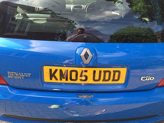

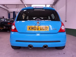

I also finally attached the 197 RenaultSport badge. Back end looks so much better for it IMO
RenaultSport Badge by JonC219, on Flickr

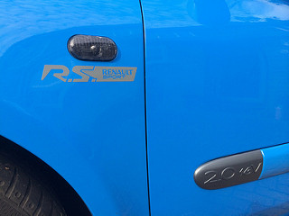

And managed to stick on the newer style RS.RenaultSport stickers I got from @N2Grafix a VERY long time ago!
RS Sticker by JonC219, on Flickr
I like them a lot as they blend in with the anthracite bullets/wheels and darker wing repeaters quite well. My mate didn't even spot them til I pointed them out

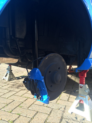

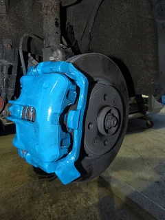

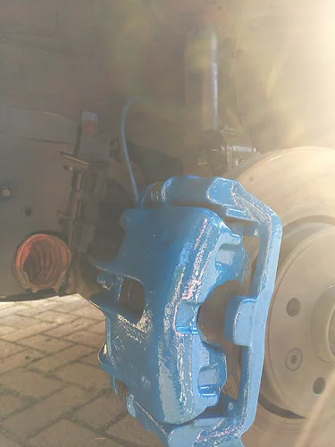

I managed to do a bit more to the Clio in the last few weeks. Thought I'd give the calipers a fresh coat of paint and detail the arches, looks a lot better under there now.
Arch detail/Caliper refurb by JonC219, on Flickr

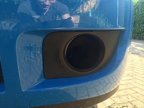

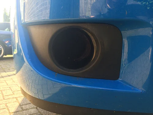

I also took a hacksaw to the brake duct trumpets in the fog light recesses. I prefer the more subtle look without them stuck on the front.
Brake ducts take 2 by JonC219, on Flickr

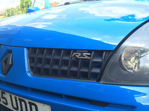

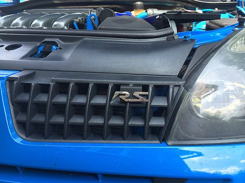

Finally got round to putting the 200 style RS grille badge on the front of the Clio, only took 10 minutes of thinking, another 10 minutes of cutting and filing and it was on and secured with a discreet zip tie
RS Grille Badge by JonC219, on Flickr

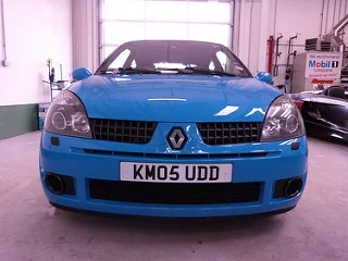

  182, 205 1.9 GTI
By looking at the workshop where you work, I don't suppose you work at Whitney Barn do you?? I use to work in the one next day that the car sales own. Small world!
Car looks good btw!
Nice build mate. Enjoyed the read fella and looking forward to your updates
Cheers mate :smile: Got a few more pictures to add so going through them now!
Car looks good btw!
Alright Danny, that's right I worked at HSC next door but left at the end of November last year! You weren't the one with the other RB 182 were you? You must know Connor as well then, he works at HSC now and I'm good mates with him.
Cheers bud it's looking a bit different now though :smile:

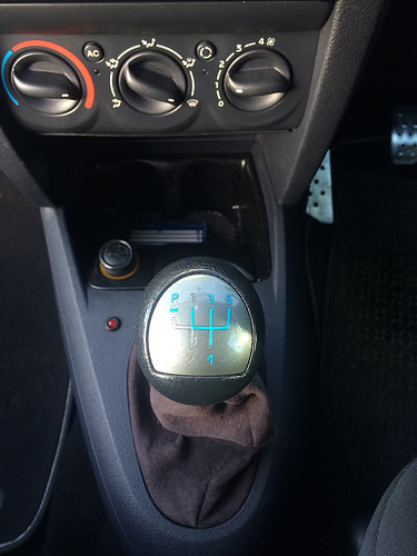

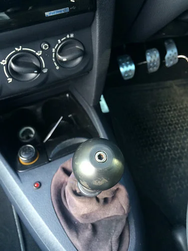

This weekend just gone I put on my full race gear knob, #becauseracecar
Before:
Upload-3 by JonC219, on Flickr
During:
Upload-4 by JonC219, on Flickr
After:
Upload-6 by JonC219, on Flickr

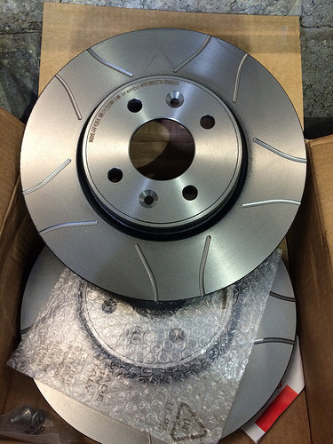

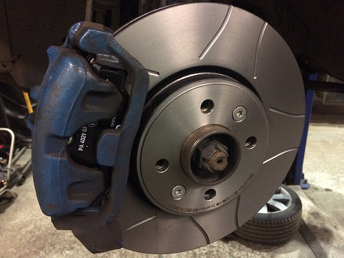

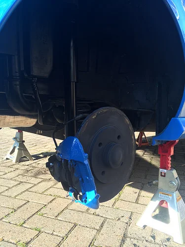

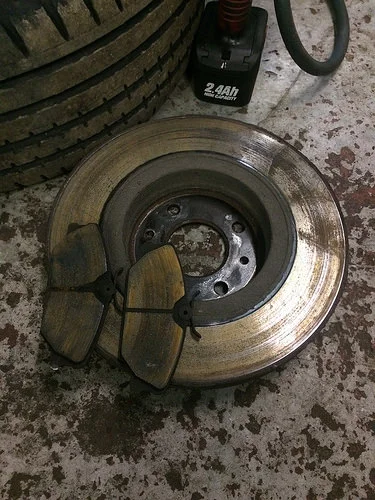

Chucked on my Brembo Max discs from George @g172. , if you need brakes this is the man you talk to!:up:
And a set of bog standard Pagid pads for the road
Upload-2 by JonC219, on Flickr
All off, hub cleaned and sliders re-greased. Caliper suspended with my patented caliper holder :wink:
Upload-7 by JonC219, on Flickr

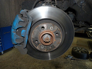

Old cr*p:
Upload-8 by JonC219, on Flickr
The pads weren't actually too bad but the discs had a monster lip on the inside edge, poor pedal feel.
And shiny new:
Upload-11 by JonC219, on Flickr
Pedal is a lot better even though they still need bedding in so happy once again :grinning: will be swapping the pads out for M1155's when I go out on track for the Season Opener at Bedford.

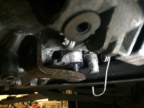

I also tackled my leaking selector seal once again, HATE this job.
Upload-12 by JonC219, on Flickr
