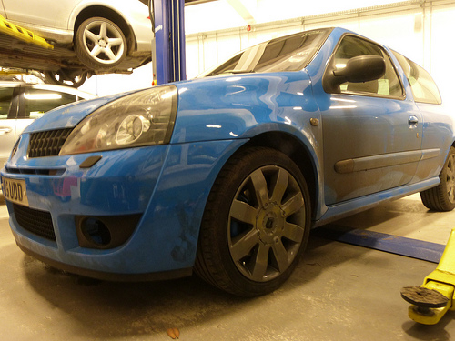

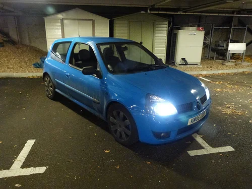

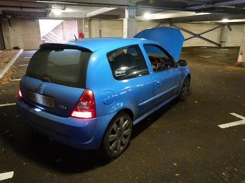

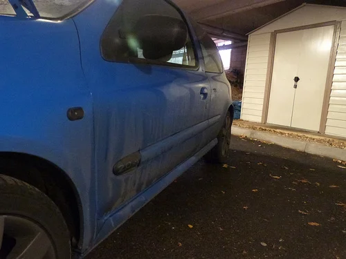

Here's some pictures taken today. This is how she currently sits, in all her dirty glory. I haven't got any drive to clean it at the moment as the swirls are horrendous. I'd rather hide them with the dirt!
Car Park by Jon_KTM, on Flickr
As you can see, it's HANGING. It won't be getting cleaned for a while as I'm planning on spending 4 days over the Good Friday bank holiday correcting the paintwork and protecting it with a nano sealant (not into waxing anymore, too much effort!)
And yes, the stickers will be going... I'm also having some bits resprayed so the wing mirror covers will be going back to RB, reason for the wrap is to cover some horrible scratches on the O/S cover

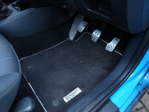

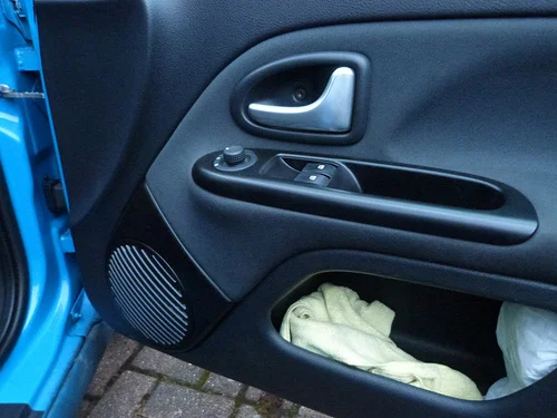

Some interior shots, just as filthy:

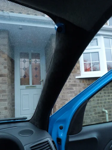

Alcantara A Pillar by Jon_KTM, on Flickr
Satin black door speaker/handle by Jon_KTM, on Flickr
Sill by Jon_KTM, on Flickr
RenaultSport mat by Jon_KTM, on Flickr

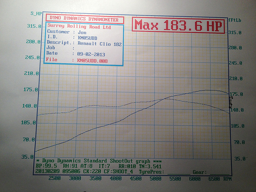

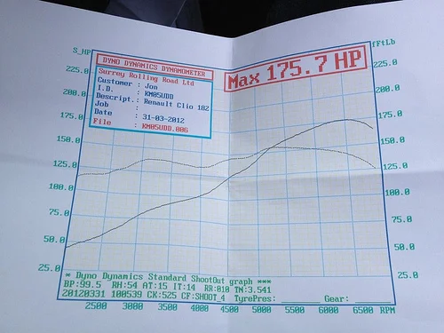

Lastly here is a dyno printout from Surrey RR in January 2012:
Surrey RR Jan. '12 by Jon_KTM, on Flickr
Only thing not on the car at that point was the decat. It was also run 'as is'. Had been 4+ months since the service and the only preparation was a top up of VPower!

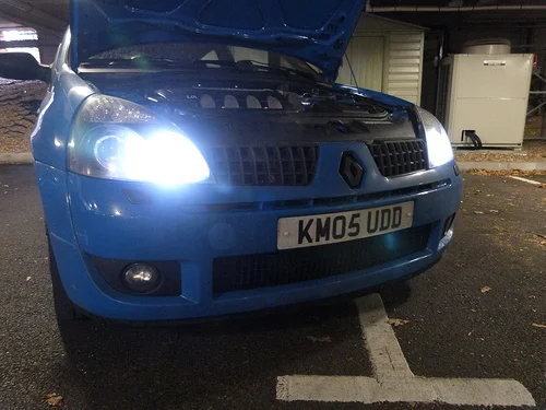

-172 black insert xenons

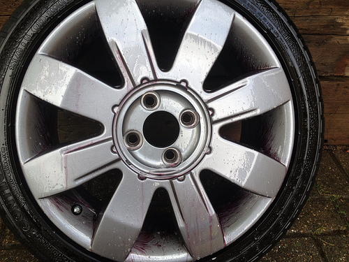

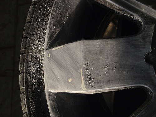

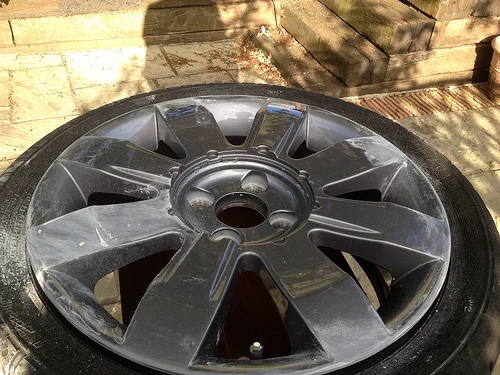

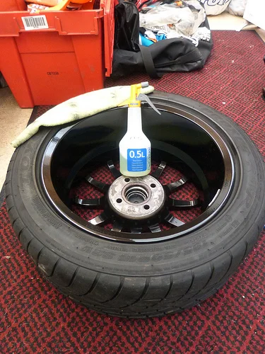

In light of the upcoming track day, I decided it would be best to protect my recently purchased Team Dynamics Pro Race 1.2's :p
For this I chose the Gtechniq C4, as I'd been swayed by all the hype on here plus I wanted something that was actually going to last against hot brake dust! So that meant a normal wax type coating was out. As a bonus this should hopefully last longer than a wax, and be easier to clean with just a pressure washer.

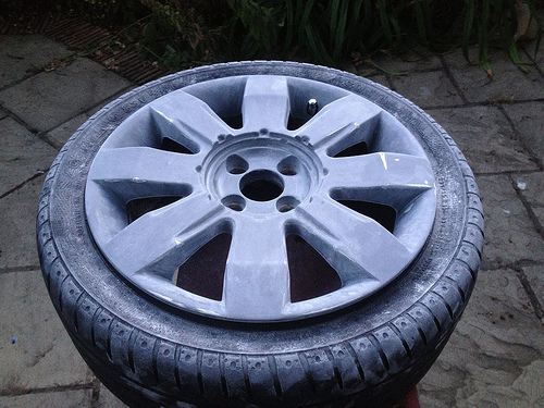

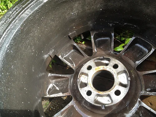

Started off with cleaning off the storage dust/cob webs from the wheels. I bought them 2nd hand but I'm sure they've only been used the one time like the previous owner said they had. Very clean already!
So here is the products I chose ...
Eraser & C5 by Jon_KTM, on Flickr

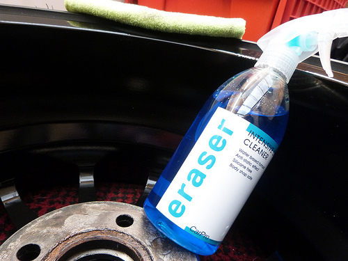

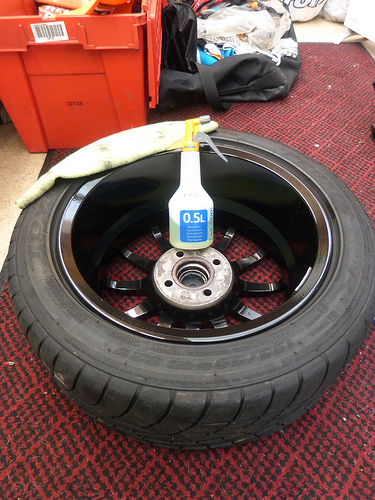

I'm fairly new to nano sealants and detailing in general but knew the nano coatings needed a good clean base to attach to, so opted for the Carpro Eraser
Decided all they needed was a quick wipe down of APC to get the worst off
APC by Jon_KTM, on Flickr
After this Eraser did it's thing
Eraser by Jon_KTM, on Flickr

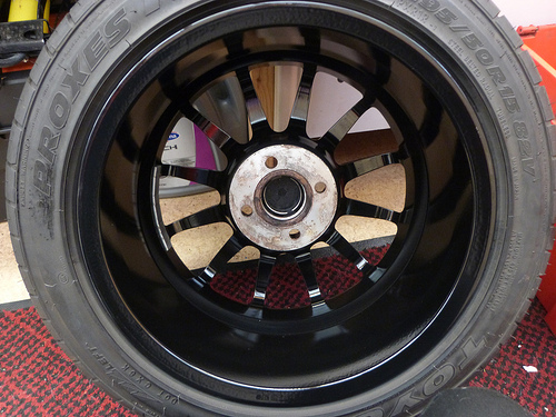

I didn't get any photos of the C4 application as I was trying my best to get it right! But here is a couple just after whilst the coating cured
Back by Jon_KTM, on Flickr
http://www.flickr.com/photos/73856634@N04/8354397622/in/set-72157632453902174/

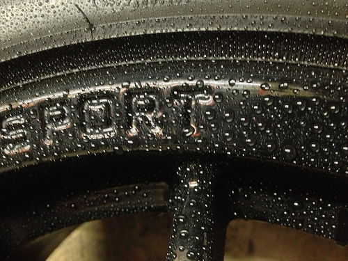

After 24 hours I grabbed a beading shot, if it stays like this for nearly a year I'll be more than impressed!
Beading. by Jon_KTM, on Flickr

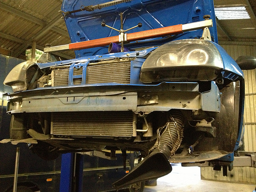

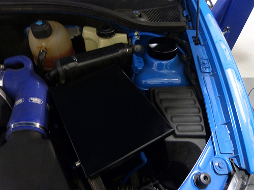

Instead of going down the induction kit route, which I may well do in the future, I decided to keep the stock airbox for now.
I knew it had a KTR foam panel filter already in it, but when I took it out to clean it I wasn't best pleased with the quality. The rubber seal was ripped and tbh it didn't look very well built from the beginning...
So I ordered an ITG foam panel filter! Was much better quality. So that was the filter side of things covered, now to sort out some decent air flow.

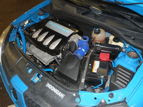

I made a CAF to fit the standard airbox, running from the bottom grill so this meant the acoustic valve was no longer needed, so that went!
Anyway, here is some photos and a write up of what I made...
These are the bits I used:
1 x 76MM BLACK SINGLE LAYER DUCTING (PER METRE)
1 x BLACK SIDE AIR SCOOP INLET/OUTLET
1 x REVOTEC DUCT JOINING SLEEVE 90MM ID (Pair)
Homemade CAF (1) by Jon_KTM, on Flickr
You can see it snakes its way down past the headlight much like the standard air feed
Homemade CAF (2) by Jon_KTM, on Flickr
You can see the secondary air feed on the left. I left this standard as it already gets a fair amount of cold air from the headlight area
Homemade CAF (3) by Jon_KTM, on Flickr
I cut off the old air pipe and cut off some of the hard plastic connector to make it wider so the air had a cleaner path into the 'box. I used black silicone, one of the heat shrinks then finished it off with insulating tape as it can get messy and my advice is too do this with 2 people as it's very hard to hold everything in place whilst using a heat gun!
Homemade CAF (4) by Jon_KTM, on Flickr
I drilled some small holes in the air duct and used small zip ties to keep it in place on the lower grille. I also drilled out the grille under the towing eye slot to aid in air flow. I need to neaten it up and square up the holes but tbh I can't be bothered whilst its cold!
I've just got to adjust it so I can get my tow eye in easier for the upcoming trackday as it's slightly in the way at the moment
Link to air inlet - http://www.merlinmotorsport.co.uk/p1...duct_info.html
Homemade CAF (5) by Jon_KTM, on Flickr
I had to use a bit of heat mat just behind the air scoop as the air feed touches the A/C pipes, which when used get hot ironically!

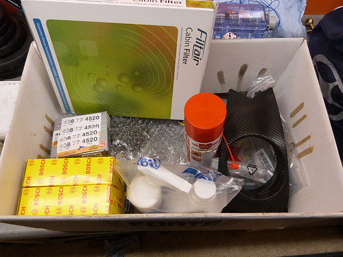

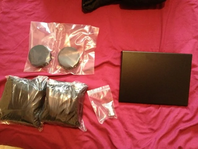

Some bits turned up today :)
Bits from M.A.D on here, battery cover and top mount covers anodised black. And a lambda extender for when I fit new lambda's during the service
I won't say what's in the other packages cos it will ruin the surprise ;)

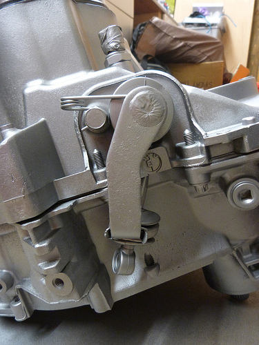

UPDATE:

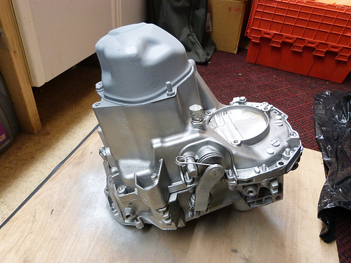

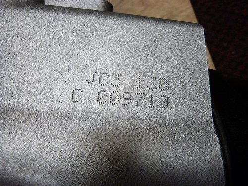

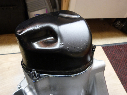

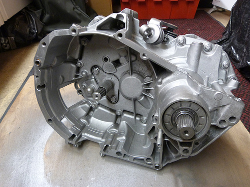

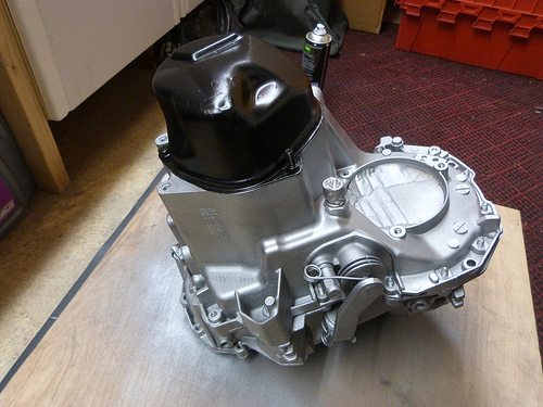

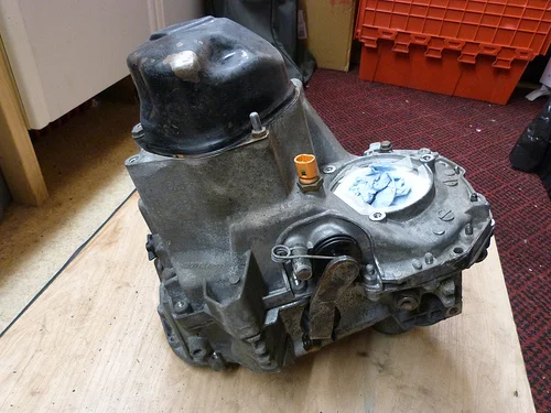

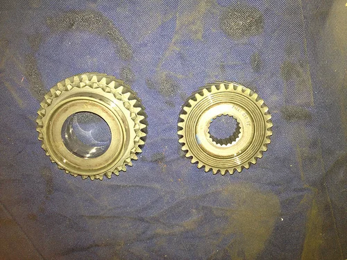

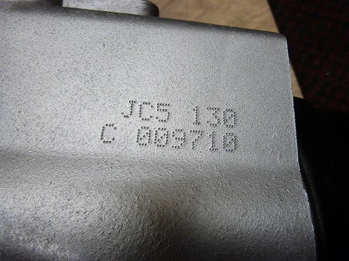

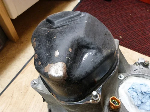

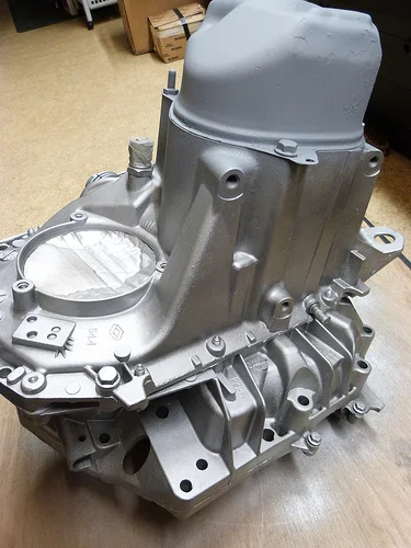

Knowing my gearbox had a nasty crunch whilst changing at high revs, I decided to source a new 'box as the Bedford trackday was fast fast approaching. I didn't fancy the idea of having an issue on the day so thought I'd tackle the problem by not only getting a new 'box but also giving it a full refurb by Martin at Agency Transmissions after the numerous recommendations I saw on here! :cheers:
So popped up the motorway after a phone call and found a JC5 130 gearbox from a 172. From a lowish mileage car with no reported issues, but I'd already decided I was going to get it refurbed anyway so no worries either way.
I sent the box straight away and after a couple of days got a phone call from Martin who informed me 3rd gear was quite worn along with most of the synchros. So he did a full refurb which included synchros, bearings, gaskets, seals and forks. I also inquired about a longer 5th gear for reduced RPM at motorway speeds. He said there was a gear he could put in for this, however after some miscommunication over the phone this wasn't the case, as I'll explain later :dapprove:
I recieved the 'box back a couple of weeks later looking like this:
Gearbox Before (1) by Jon_KTM, on Flickr
Gearbox Before (2) by Jon_KTM, on Flickr
Gearbox Before (4) by Jon_KTM, on Flickr
I figured why should the inside be so shiny and new and not match the outside?! So out came the spray paint and I set to work smartening it all up...
Couple of during...
Gearbox During (1) by Jon_KTM, on Flickr
Gearbox During (3) by Jon_KTM, on Flickr
And after, much better!
Gearbox After (2) by Jon_KTM, on Flickr
Gearbox After (3) by Jon_KTM, on Flickr
Gearbox After (4) by Jon_KTM, on Flickr
Gearbox After (5) by Jon_KTM, on Flickr
Gearbox After (7) by Jon_KTM, on Flickr

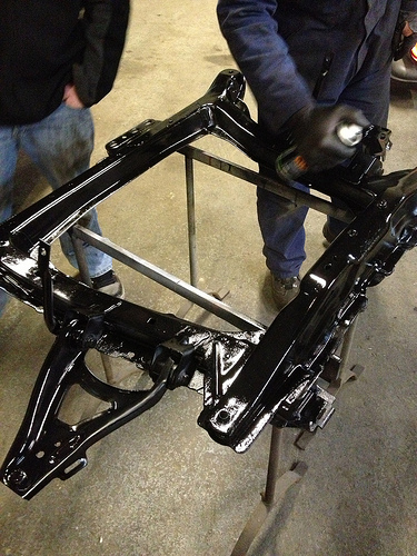

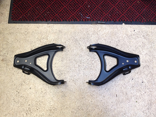

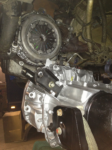

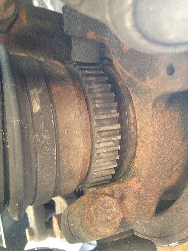

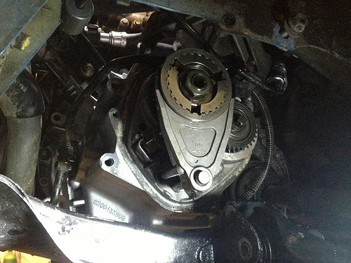

Last weekend I got to work swapping them over. Lucky having a Dad who owns his own Commercial business!
I decided to remove the whole subframe (never again) as I was fitting Powerflex inner ARB bushes at the same time. And figured it would be a good chance for more paint! :eek:
Subframe by Jon_KTM, on Flickr
She did look very sorry for herself up there
Ramp by Jon_KTM, on Flickr

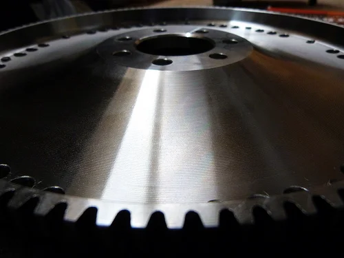

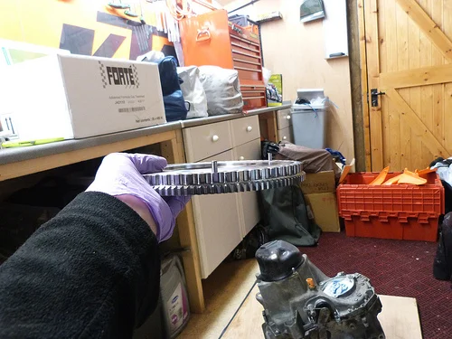

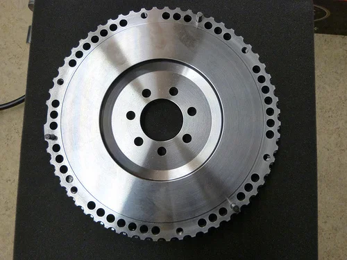

As far as the clutch goes, I figured there was no point going for something fancy as I'm only running standard power with the basic mods. I went for a Valeo clutch kit, but went for an upgraded flywheel by way of Ktec's billet lightened flywheel (Yes I know they're silly money but never mind...)
Flywheel by Jon_KTM, on Flickr
Flywheel (2) by Jon_KTM, on Flickr
Flywheel (3) by Jon_KTM, on Flickr
Its a real shame it's gota go inside the gearbox, it's a complete work of art! Looks amazing with all the machining lines all over it. And as you can see from the last picture, it is very lightweight, as anyone who has tried to hold a standard flywheel at arms length will testify!
Final pictures of the clutch and flywheel in place and gearbox making its return journey
Gbox refit by Jon_KTM, on Flickr

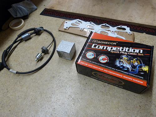

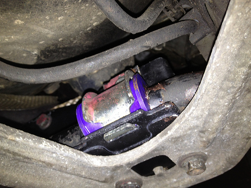

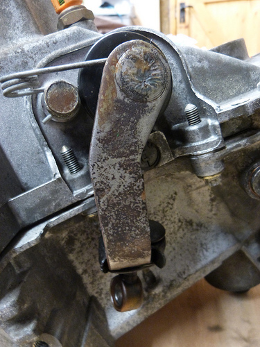

I also fitted a new clutch cable, and noticed it looked a bit different with extra weights at the clutch release arm end. I can only assume this is an updated part in an attempt to combat the heavy clutch the 172/182's are known for, who knows! :S
Final pics of the Powerflex bushes in situ and the new clutch cable with the other service bits I'll be cracking on with in the next update
Powerflex inner ARB by Jon_KTM, on Flickr
Ktec Racing by Jon_KTM, on Flickr

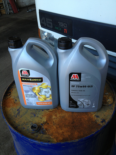

As Opie had a small deal on Millers oils and £1 delivery I thought I'd treat myself to some trick engine oil for the service, and opted for Millers on the 'box as well
Millers by Jon_KTM, on Flickr
Final thoughts are, what a transformation! I haven't 'given it' really yet, but the clutch is a dream now. Sooooo much lighter than it was previously. I can only assume the combination of new clutch and updated cable has really eased things up. The refurb has also been money well spent, the gearbox feels amazing to change gear and is the best I've ever felt, coming from an equally poor 'box of a 106.

The flywheel also seems like a worthwhile investment. Revving the engine whilst in neutral seems to be a lot quicker and freer. In both gaining revs and dropping down. In gear pace seems much improved as well, so not such a need to drop it down a gear for day to day driving which is refreshing. If you have the extra cash I'd say go for it :)
As I said about the 'longer' 5th gear earlier, this is where I had a small hiccup. I quickly noticed that cruise control worked in all other gears except 5th, where the new gear was.
After a thread on here, it turns out the gearbox speed and wheel speed sensors have to match predetermined values. Not good as I ideally wanted to keep cruise, it's not a track car yet!
There also seemed to be a small issue with the revs. It was revving higher than it used to, not lower! So a quick phone call to Martin confirmed that he ahd misunderstood my intentions for the gearbox, and he had fitted a 'race' 5th gear with a shorter ratio for track work
Cant fault him though, he is sending down a standard 5th gear for me to swap over, then I can send back the 'race' gear for a refund, top man :clap:
Anyway, congrats if you got this far. Thats the update this week. Next on the list is a fairly comprehensive service and check over in prep for the Surrey RR meet this Saturday and Bedford the week after.

Had the trip down to Surrey RR yesterday with the organised meet on here.
Here's my results:
Surrey RR 02.13 by Jon_KTM, on Flickr
Pretty happy with how it ran, gained 7.9HP and torque is up around 6ft/lb's. With the RSTuner map it also seems to have smoothed everything out, including holding onto the power at the top end. Changes from last time include:
-Millers Nanodrive 5W40
-Magnecor KV85 ignition leads
-KTEC billet lightened flywheel
-NGK PFR6E-10 spark plugs
-RSTuner remap
-Cleaned and oiled ITG filter
-Milltek decat
So yes, happy happy :)

Revised clutch cable looks beefy. Hoping it will make my clutch feel lighter after its changed too.
Thanks Guysy, trying to crack on with is this year. As long as I do one thing every couple of weeks it won't take long!
And it was fine removing it, bolts weren't siezed (but I was using air tools). It was getting it all back in which was the fun bit! Just need a million pair of hands and then I forgot the heat shield for the steering rack and it was so tight to get to the bolts with it all up in there I had to drop it again slightly. Ended up leaving one bolt out so held in by 1 nut and 1 bolt.
And if you're still on the original clutch cable it will most likely free it up no end. Mine didn't feel stiff when I got it out and operated it by hand, but next to the new one it was really bad!
Yeah I'm hoping it all goes well when I get round to doing the job, I expect lots of swearing but hopefully I'll get there.
Yeah I think its on the original so the refurbed box, clutch kit and cable should make things much better after the change.

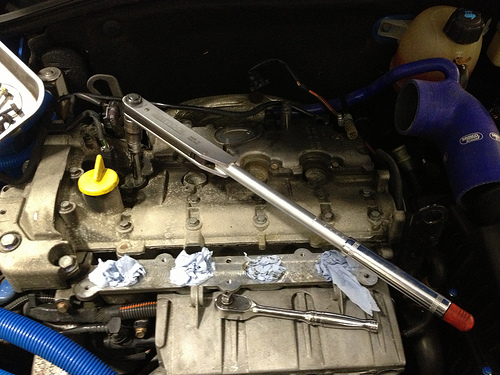

2 weeks ago I performed a full service ahead of the Surrey RR meet. Just going straight onto the pictures...
Service Bits by Jon_KTM, on Flickr
NGK by Jon_KTM, on Flickr
S.plugs by Jon_KTM, on Flickr
Magnecor (2) by Jon_KTM, on Flickr

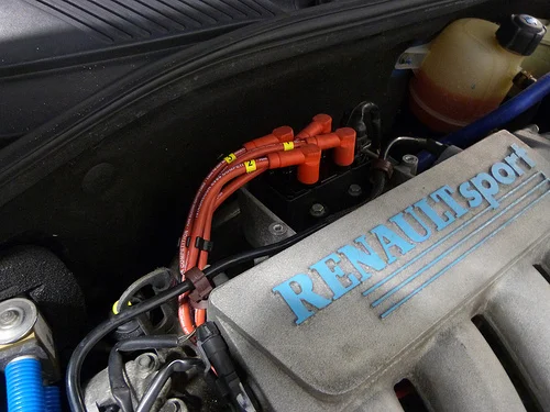

Magnecor KV85 ignition leads fitted along with the correct spark plugs (Bosch Iridium plugs before hand). Pollen filter changed, Millers Nanodrive 5W40 used, and ITG panel filter cleaned and oiled
M.A.D. Bits by Jon_KTM, on Flickr
Also fitted the M.A.D. battery cover and top mount covers, finished in anodised black :)

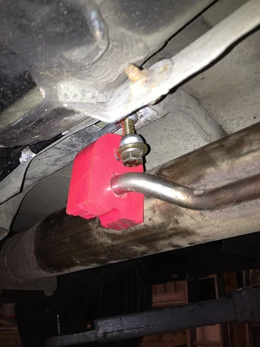

Got fed up of the standard center exhaust hanger breaking under the immense weight of the Milltek, so following the thread on here regarding the rear exhaust hangers and Powerflex bushes, I made a center one in the same manner!
Clio by Jon_KTM, on Flickr
Clio (3) by Jon_KTM, on Flickr

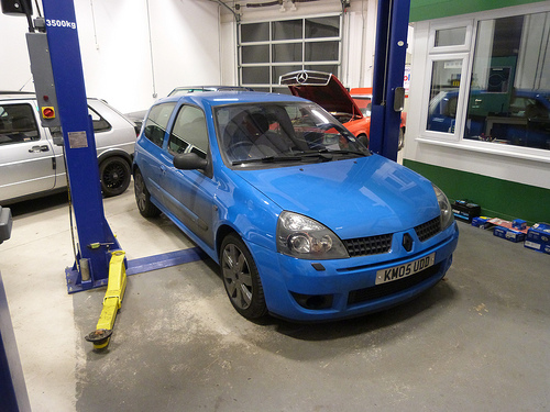

In the workshop, all filthy dirty, still not washed :(
So in summary, this is what happened to the Clio:
Pollen filter
Genuine oil filter
NGK PFR6E-10 plugs
Magnecor ignition leads
Coil pack
Battery cover
Top mount covers
Lambda sensors
All in all, judging by the RR graph I posted earlier, it seems to have made a noticeable difference in both the real world and on numbers, so Im very happy with it :)

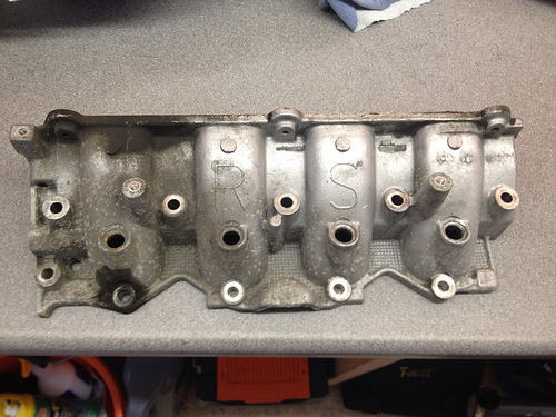

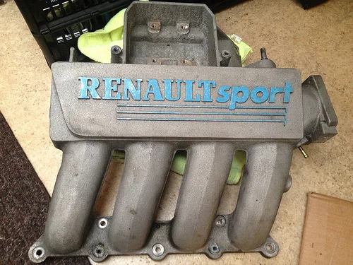

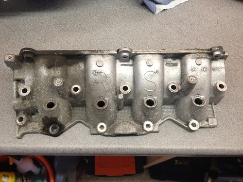

Right well I figured this is well overdue an update. The Cup is currently off the road for the month so I can get a few bits and pieces done to it.
List this month is:
Matched inlets
Lots of bits to powdercoat
Few bits to paint
General tidy up
Refurb alloys
New Cup shocks all round including Cooksport springs, Powerflex lower arms, new Genuine top mounts
Powerflex dogbone
And finally a bloody good detail as it's hanging.

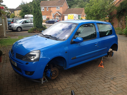

Few pictures...
Axle Stands by Jon_KTM, on Flickr
RS Inlet by Jon_KTM, on Flickr
Top Inlet by Jon_KTM, on Flickr

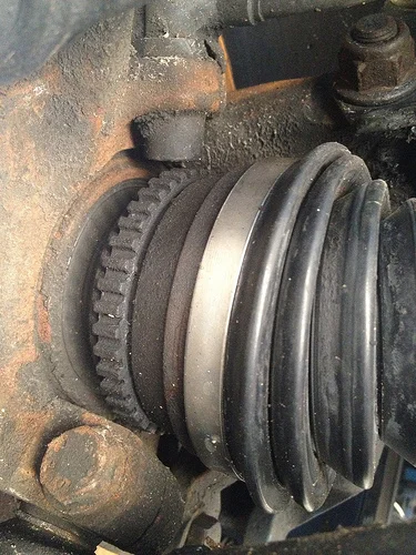

This is the state of the passenger wheel after the CV boot decided to split, horrible stuff.
CV Grease by Jon_KTM, on Flickr

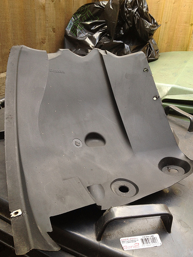

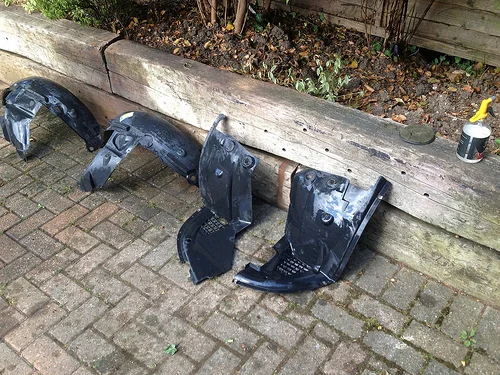

​Arch liners getting a clean with ObliTARate then dressed with Carpro PERL:
ObliTARate arch liners by Jon_KTM, on Flickr
CarPro PERL by Jon_KTM, on Flickr
During the weekends work I noticed I had a non-Cup driveshaft on the passenger side. As far as I'm aware it's only the ABS ring that's different (can someone confirm?) so I'll be ordering up the right ABS ring from Reluctorrings.com and fitting it when I can be bothered.
Non-Cup:
Non-Cup Shaft by Jon_KTM, on Flickr
Cup:
I also noticed the wishbones I bought from Renparts had the non-Cup caster rather than the increased caster so hopefully that will be sorted by the end of the week and I can send a few bits to powdercoat and get the bushes in.
Non-Cup Wishbones by Jon_KTM, on Flickr

As I'm now waiting for bits I decided to tackle the wheel refurb, I've only curbed them once in the 2 years theyve been on the car and luckily it had only knocked off the paint rather than dented the alloy. So hopefully a decent rub down with the sandpaper should do the trick.
Alloy Refurb by Jon_KTM, on Flickr
I'm not changing the colour as such but will be spraying them Rover Stone Grey as this is the closest match to the original Cup colour as I could find. I toyed with the idea of BMW Sparkling Graphite but felt it just looked a bit to dark against the RB.
So that's it for the moment, hopefully I'll get a chance to rub down the rest of the wheels during the week and then get a couple of coats of etch primer down at the weekend.

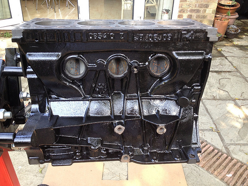

On a side note, I picked up this early F4R block from Dan at SJM a couple of months back
F4R Block by Jon_KTM, on Flickr
This is it painted after being dipped and checked.
I'm hoping to build up a high compression ITB lump for when this becomes a full on track toy in a few years. If anyone has a Ph1 head in decent condition please contact me!

Mail me your address so I can send the inlets back to you at the end of the week please. I'll have a look at the head for you if you want?
if you don't mind me asking how much roughly did the refurb cost on the gearbox? i got a crunch going from 4th to 5th and then it whines when i accelerate. Car is looking Very nice, love the colour
Emailed back to Andrew. And yes when I finally find a decent one no doubt ill be sending it to you for a few things ;) are the inlets finished now?
Hi Matt. I think it was £300ish but I can't quite remember. It had everything done to it though so won't be anymore than that. Worst cost was the courier! Added £100 to the bill :(
