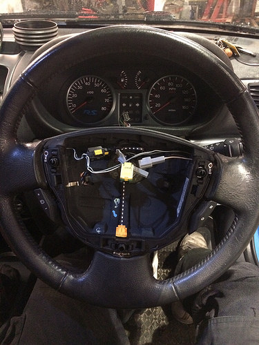

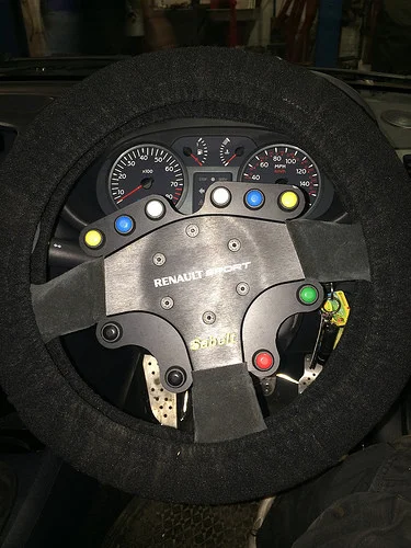

So yesterday I had a bit of fun with the French wiring:coldsweat: and my new Sabelt :smile:
Always wanted to change the standard Cup wheel not just because it looks a bit crap but the melting was getting obscene. On warm days my hands would be black from all the rubber stuff coming off it. Not good.

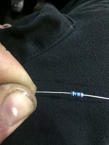

Last weekend I played around with the electrics so I could get an idea of what to do this weekend (it was successful) so Friday I grabbed the resistors I needed and got to work yesterday!
During:
Wheel by JonC219, on Flickr
Resistor (1 of 3 for cruise):
And finished!!:
I'll try and get a picture in the day light with the cover off (mechanic by trade so have dirty hands hence the cover)
Basically the bottom buttons are cruise related, the top buttons are mirrored both sides so the yellow is horn, blue is flash lights (I always seem to click high beams on instead of flash so came up with this) and the white is one wipe of the front wipers (as the French don't have that feature on the Clio)
At the moment the flash and wiper isn't wired in as I need to get some of this
http://www.ebay.co.uk/itm/400810412201?_trksid=p2060778.m1438.l2648&ssPageName=STRK:MEBIDX:IT
being that they don't go through the steering angle sensor and will need room for the wheel to turn
Will hopefully have something sorted next weekend but for now I'm more than happy with how it turned out. I'll try and get pictures of the back but I will be trying to neaten it up a bit as it's not up to my OCD yet.
Stupidly forgot resistors for the airbag though so will be borrowing someones Clip or taking the wheel off again at some point...

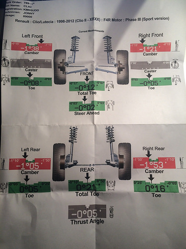

Got the tracking done...
Geo by JonC219, on Flickr
Only toes adjusted this time around. I know the guys well so I can put it on the machine for nothing so will change to the track wheels and get a shim on that left rear to even up the camber. Then get the camber on the front matched up to 1.5 degrees neg and double check the rear once it's all back together.

Yours is very similar to mine Jon. My camber on the OSR is more than the NSR, same with the toe. I need to find a 1.5mm shim for mine to correct the toe and a 3mm shim to correct the camber.
I'm getting a shim from PMS when they send my RARB so hoping to get it all on at the same time then will double check everything on the machine again

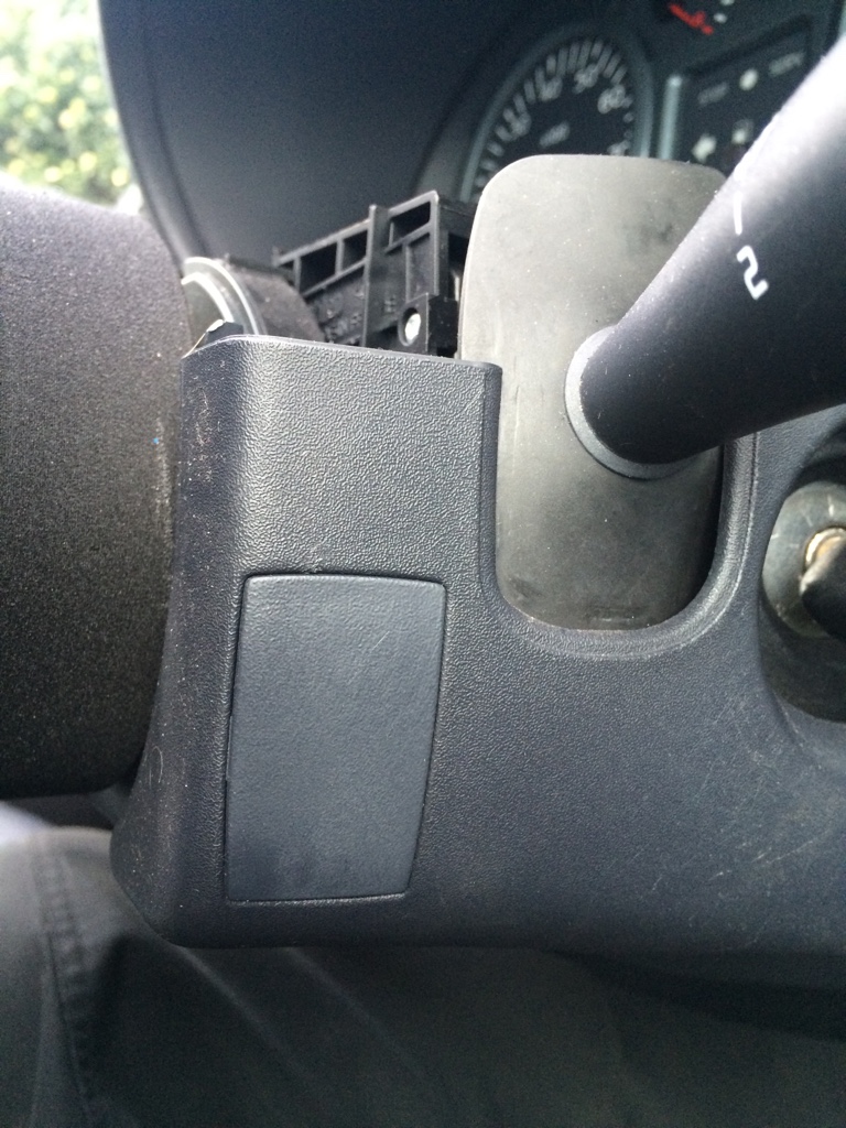

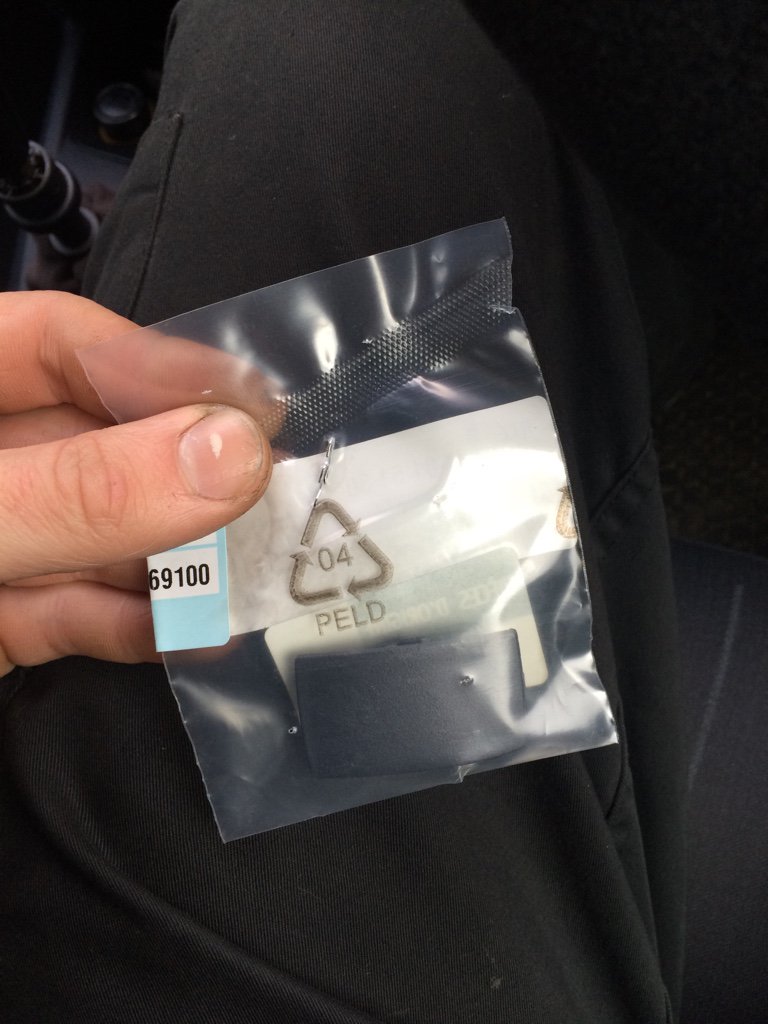

So today I took this
Added this
To get this!
It's the little things :)

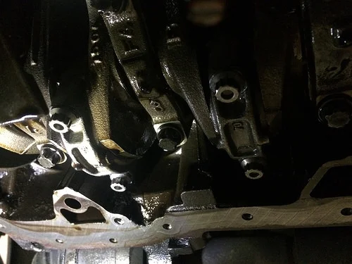

First up was a full service, which was a perfect opportunity for the ARP bolts to go in:nut:
ARP Bolts by JonC219, on Flickr

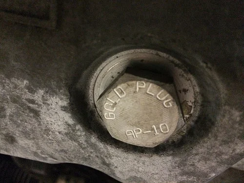

Replaced the sump plug for a gold plug from Opie, can't hurt for a bit of extra security
Gold Plug by JonC219, on Flickr
It has a shallow hex so perfect for the Clio sumps:up:

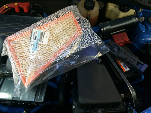

Genuine Renault air filter chucked in to replace the POS Crossland that was put in temporarily:down:
Reno OEM Air Filter by JonC219, on Flickr

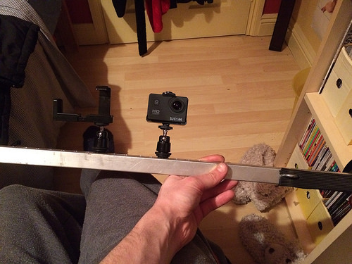

I also rigged up my new camera into the home made camera mount
Camera Mount by JonC219, on Flickr
I've kept the iphone holder on there so I can get some front and back shots at the same time should I wish:cool:

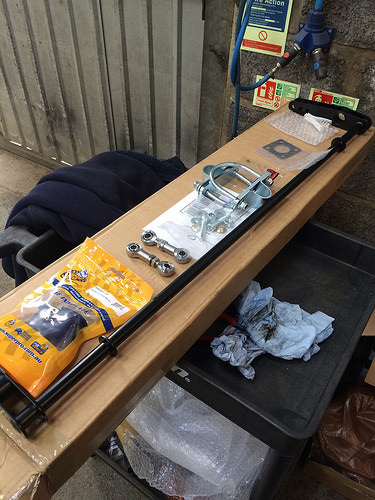

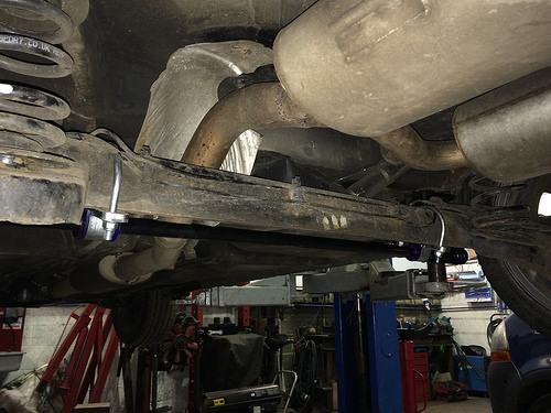

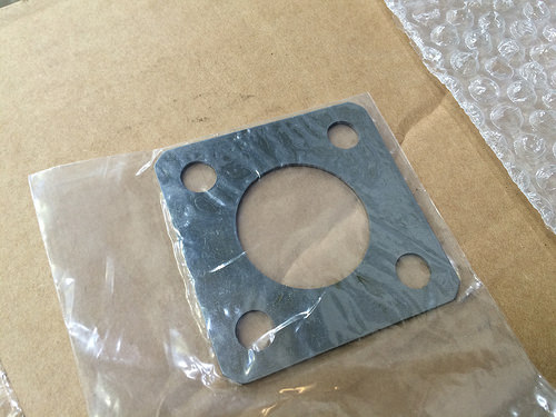

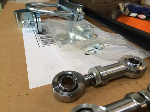

Went for the 19mm PMS RARB in the group buy and also got a half degree shim for the rear to even up the camber left and right
PMS RARB by JonC219, on Flickr
Half degree PMS Shim by JonC219, on Flickr
The hardware looked absolutely brilliant. I love a bit of machined bling :tonguewink:
Encountered a couple of stubborn bolts but nothing a bit of penetrating fluid and brute force couldn't solve. After an hour or so had both the shim and RARB in place, set to soft for now
PMS RARB Fitted

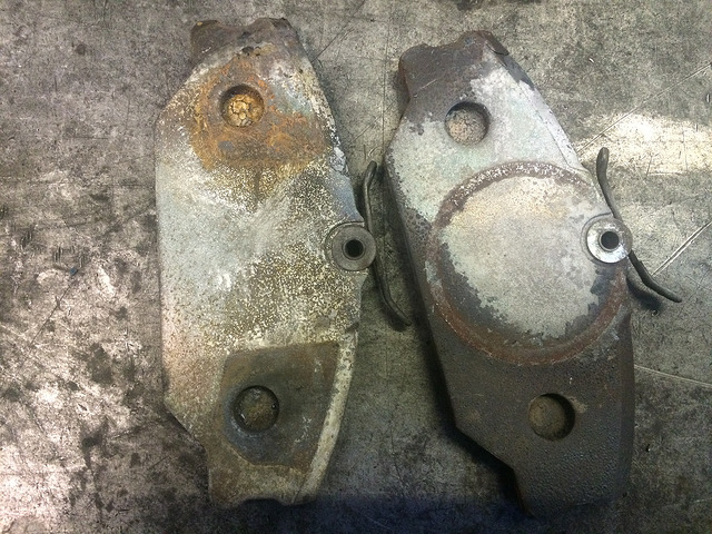

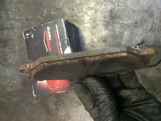

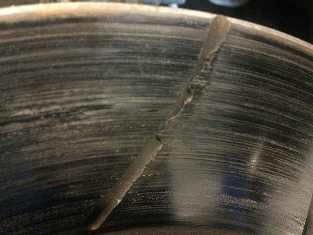

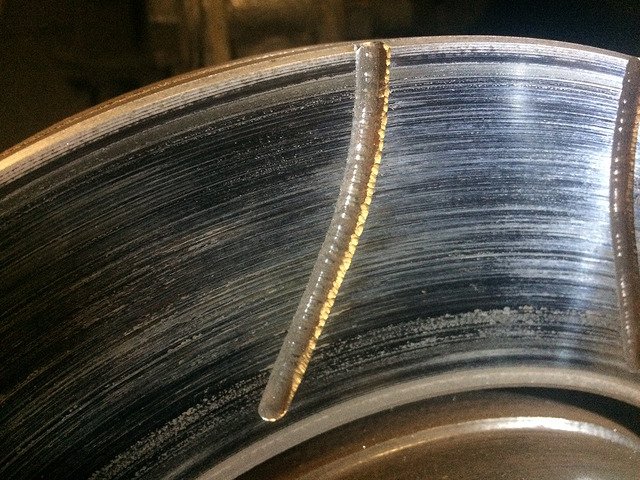

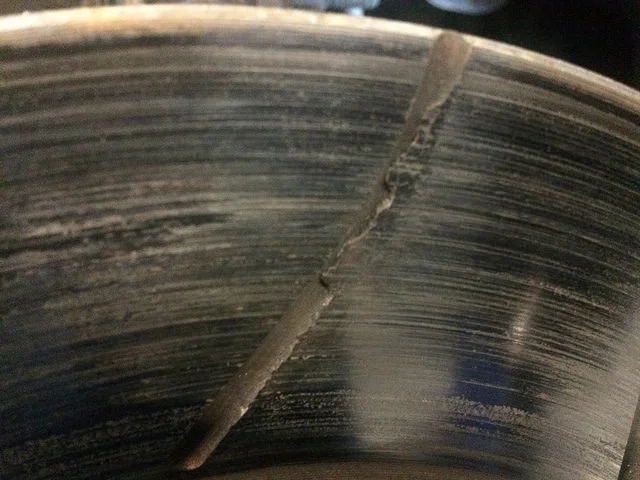

Unfortunately I had to take it easy from about 3pm onwards as I noticed the brake pads! They'd done well all day and I feel I'm happy with the performance. Just the Brembo Max discs have now eaten the M1155 pads!:weary:
182 by JonC219, on Flickr
They got baked...
Quick clean with the dremel and a set of standard cheapo Pagid pads chucked in
Even though I was happy with the M1155 I might upgrade to the M1166 for next time. Can't beat the cost IMO but I am in talks with George @George@RTR_Parts with the possibility of DS1.11 pads but we shall see
