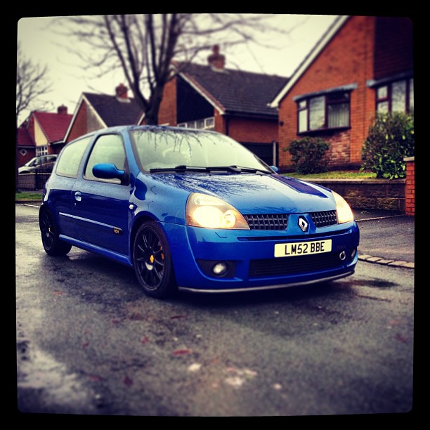

Hi guys & girls,
It's been a while since i've posted on here and a good 7 years since I last owned a Clio Sport. However over the last couple of months i've had a burning desire to go out and get another little hatchback purely to use for track days!
Got it at a pretty cheap price with ok spec.
02' Clio Sport 172 Cup
91k Miles
Black Cup Wheels
FK Coilovers
K-Tec Stealth Exhaust
ITG Carbon Induction Kit
Carbon Fibre Front Splitter
And uprated pad's (Not sure which)
All for £1600
Picked her up today.
No great plans for the car to be honest other than i'll change the cam belt, the previous owner said this had been done but couldn't find the receipt so for peace of mind i'll do that and change the bushes all round to tighten things back up.
Modifications planned
New Tyres (Recommendations taken)
Braided Brake Lines
Uprated disc's and pads (Recommendations taken)
De-Cat
Other than that I probably won't spend much on the car other than maintenance and anything I break on the track.
1st track day booked - Nurburgring, May 2013

Looks good.
Looks a good one, bargain price as well tbh! As people have said regarding parts it depends on how far you want to go.

Nice looking car. Where did you see it advertised? I'm looking for one at the moment.

Mint car, well looked after. I know Pete has taken good care of it since buying it off another mate of mine. Enjoy.

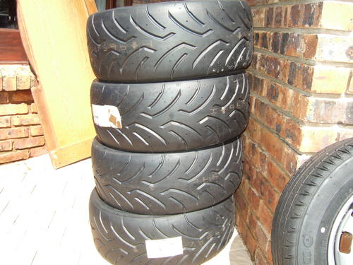

I'm putting AD08s on mine, other options are r888s, Federal RSRs (some have had disentegration problems with these), Dunlop Direzzas.
These are all totally different tyres:
- the AD08 & Federal 595 RSR are high performance road tyres
- the R888 is a proper R-spec semi slick
And which Direzza are you talking about?
Lol. I know they're different tyres, but all of them are a blend between road legal and strong performance when on track. Just some are more to one end of the scale (road), others to the other end (track). Which unless I'm mistaken is what the OP asked. And yes, the Direzzas were in reference to the OG3 Tony has pictured.
