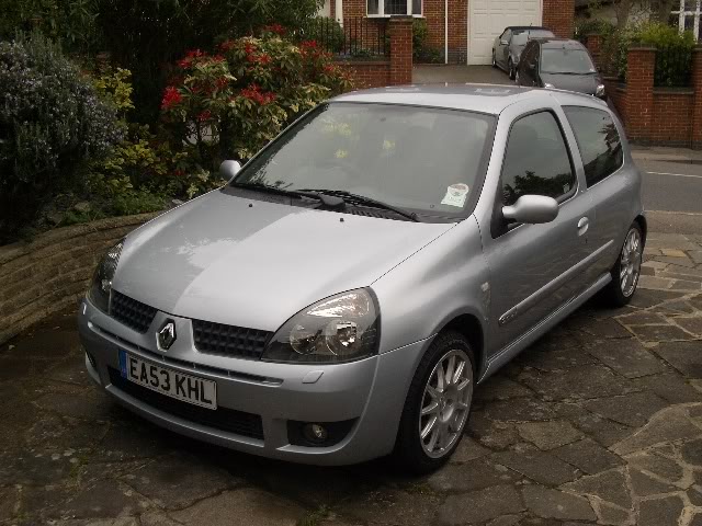

...£50 on cleaning goodies, then spent best part of 4 hours cleaning the outside of the car, and..... I'm still not happy with it! :rolleyes:

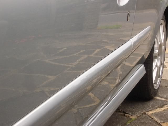

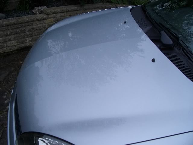

Shiny Bonnet, 7 out of 10 -
Reflection in Rear 1/4, 9 out of 10 -
Over all finish, 7.5 out of 10 -
