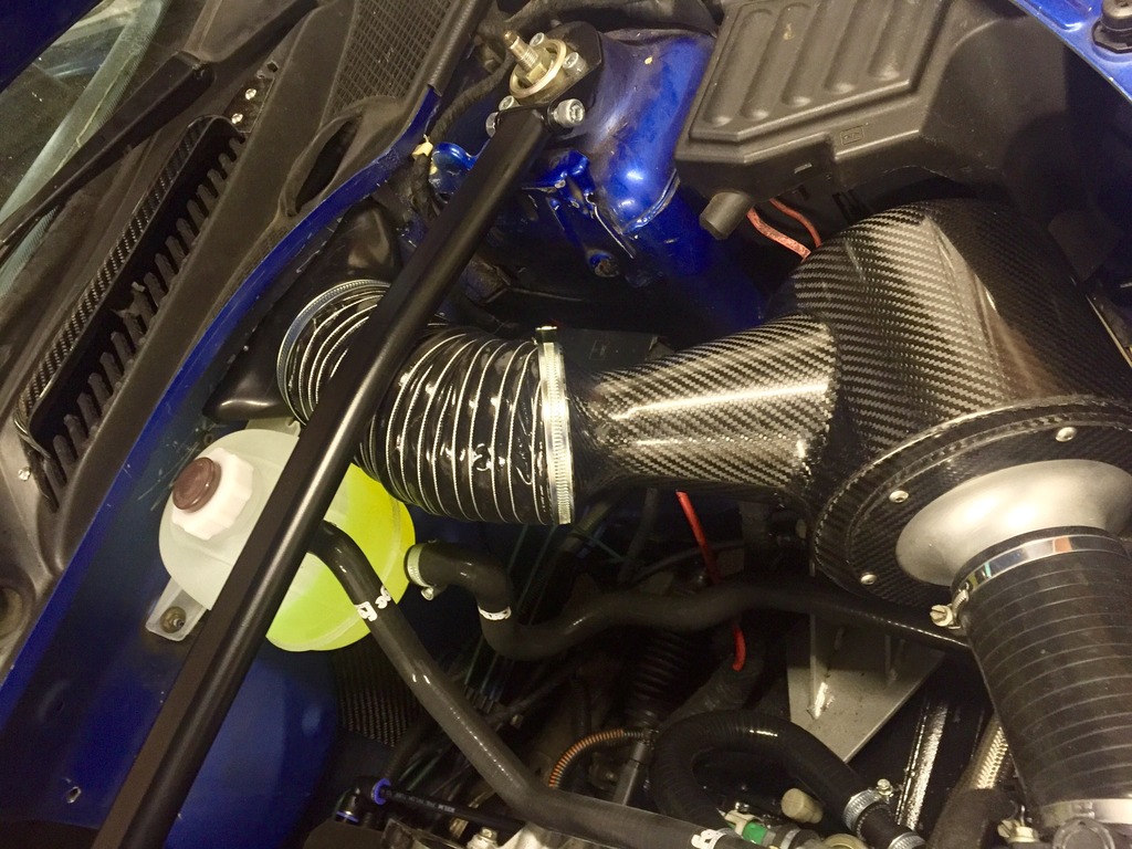

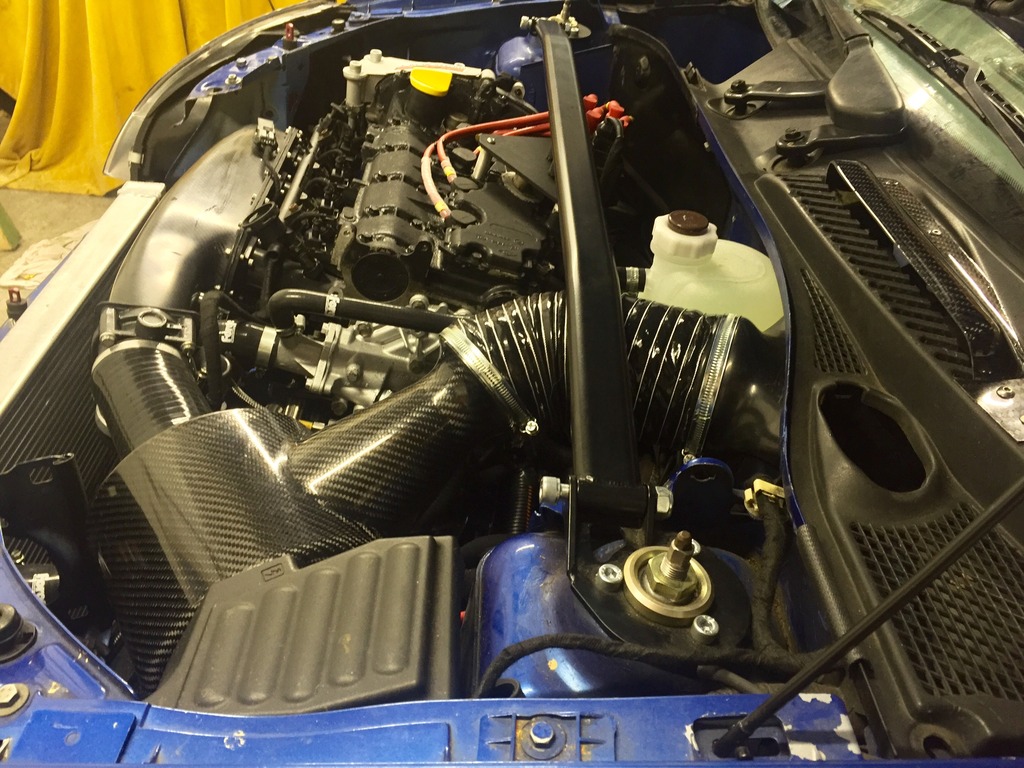

Would your induction not be better facing the other way towards the headlight though?
Thanks mate :). Idea is to take a feed upto the scuttle panel. Work in progress. Lol

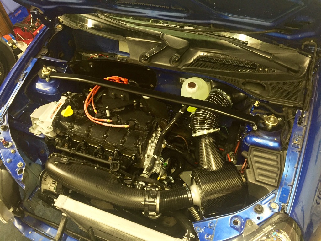

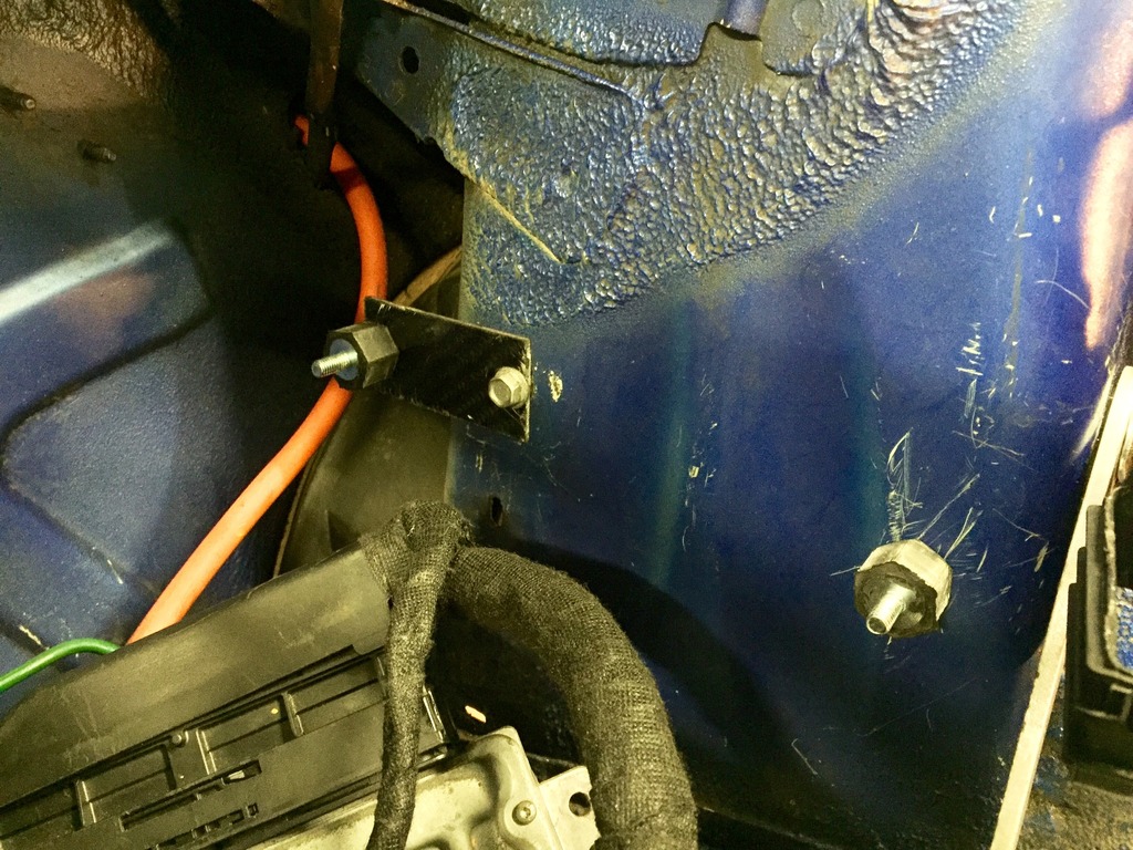

How did you mount the ecu @Chambers_RS ?
Picture is above for you. I will be adding another mount just to keep it more solid.
Like the idea of that! Using like a scoop intake?

Will use some kinda scoop yeah still looking into ideas. Will be making progress soon tho.

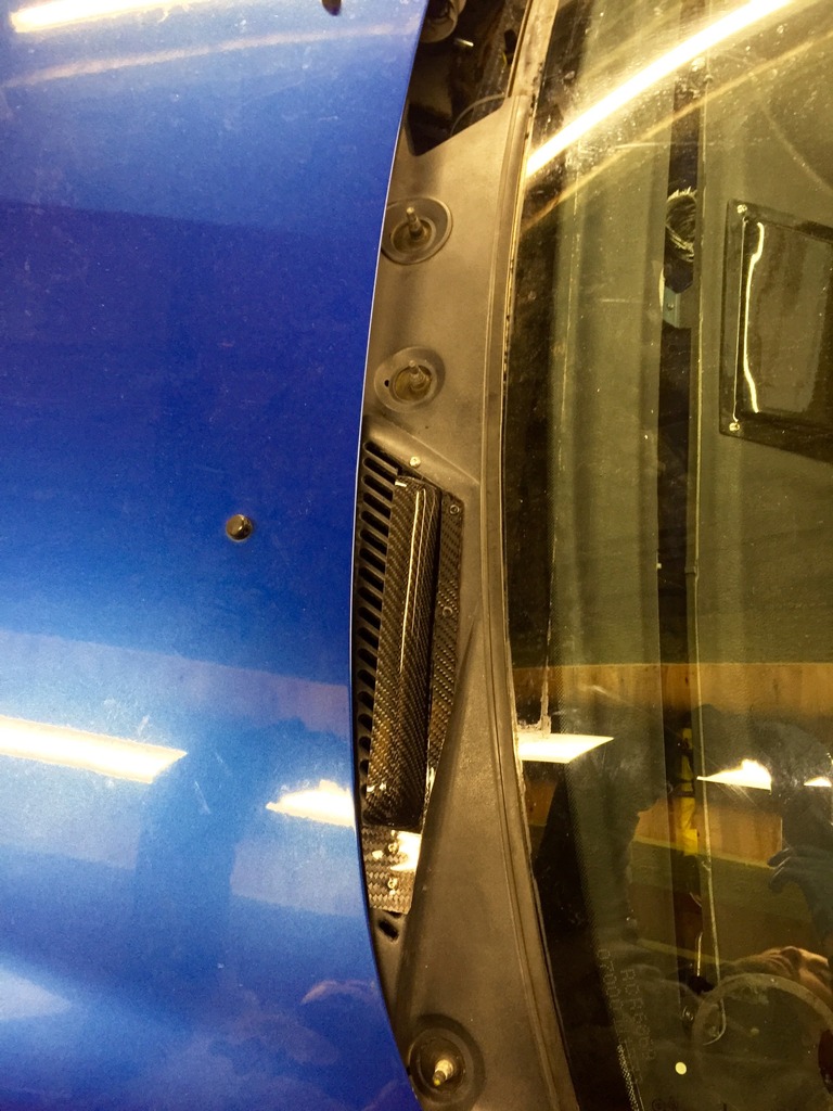

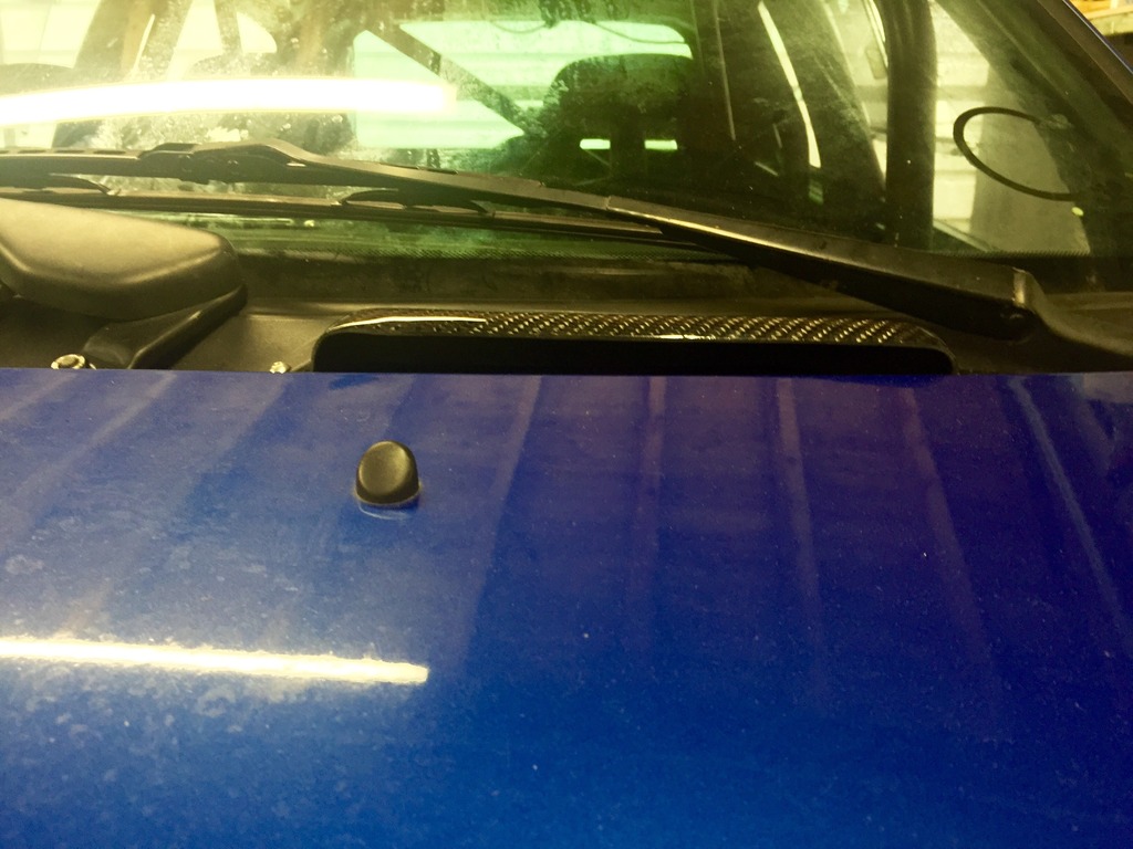

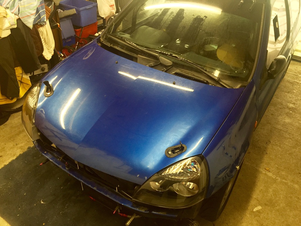

Been finishing off my intake today. Unsure on how well it will work but i like the look of it :smile:
I've used a fog machine to blow it over the bonnet and seems to work but with the car not running couldn't test it fully. I also managed to get some fluids in it and bleed the brakes.
Looks fooking awesome mate!! Looking that good it's got to work!
Chambers_RS
  Clio 172 Cup&Leon K1
Thanks mate. Considering it's made up of a civic type r tegiwa scuttle scoop and a Leon ITG radiator scoop it looks alright lol

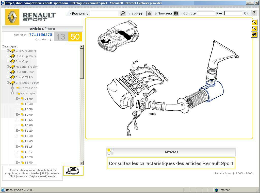

Has anyone any info on what vehicle it's off .
I have a friend at Renault and is trying to look it up.
Was it a special Motorsport division or Renault sport ,and do you have any idea on where one of these scoops can be purchased from @@Chambers_RS

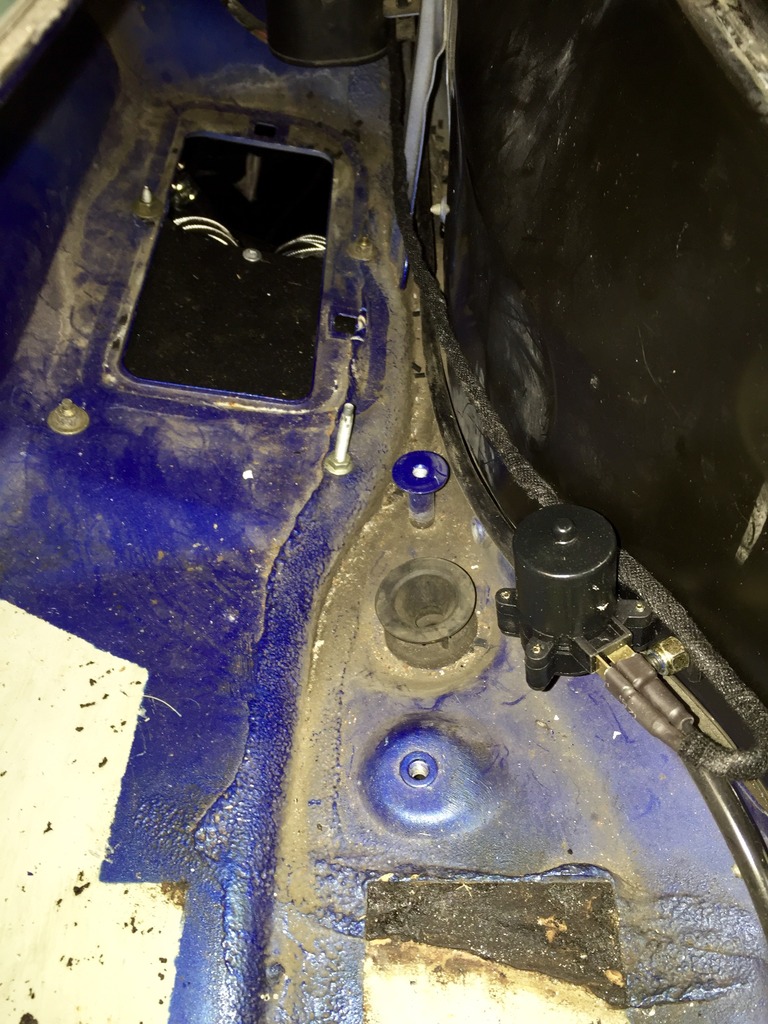

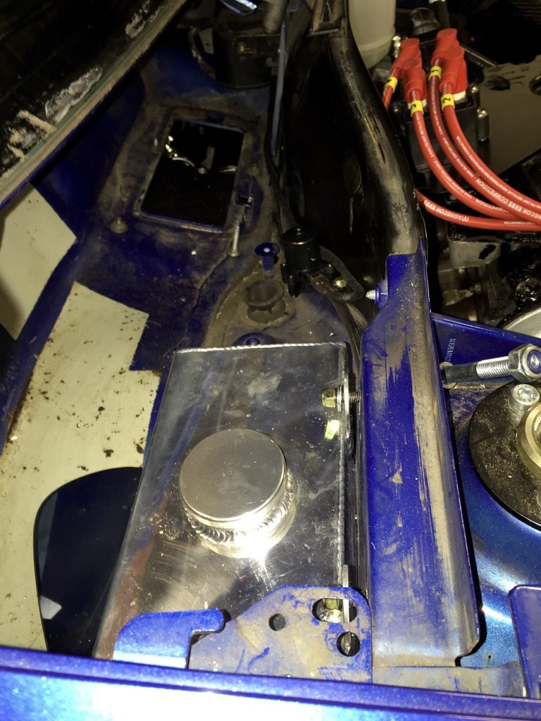

So I made a start on the new washer bottle and pump.
New location and pump
Isn't finished and excuse the dirt lol

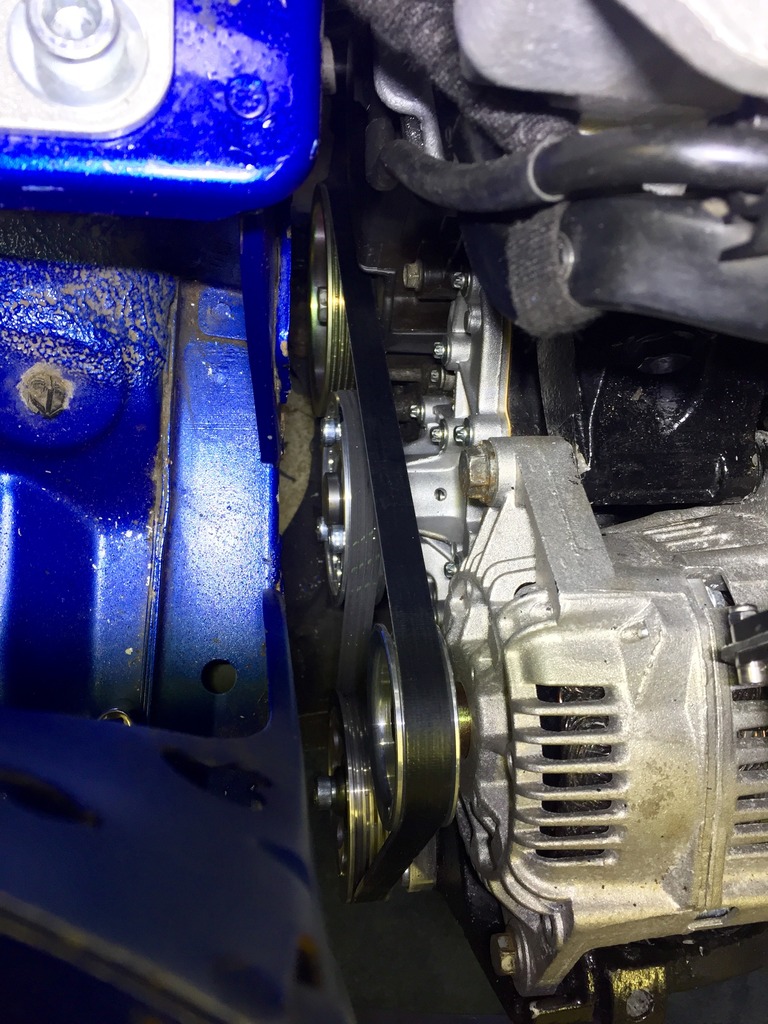

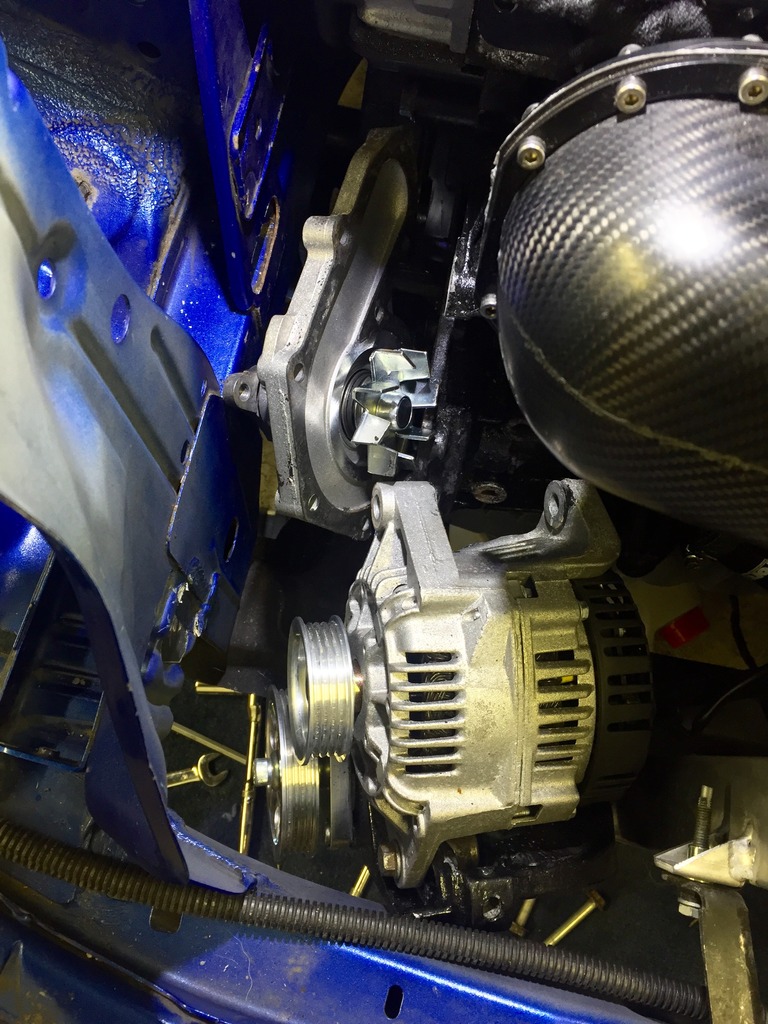

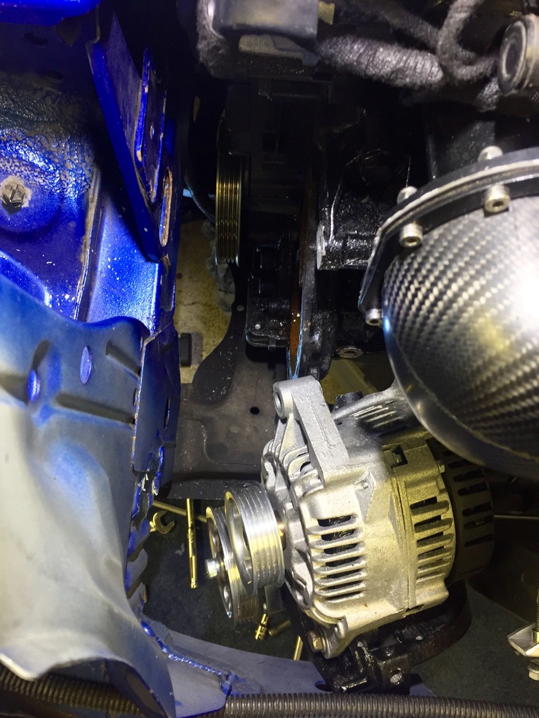

Was off work this weekend so set about changing the water pump. I order the Valeo pump that PMS sell. I checked repair times on autodata and when I saw 4.1 hours to change it wasn't really looking forward to the job.
Spoke to a few Renault specialist in my area they all said to loosen the engine mounts and push it to the passenger side and the pump will just squeeze out.
Anyway all I did was undo the 4 bolts to the alternator bracket and the top alternator bolt, pulled it all forward and the water pump was out in 20 minutes happy days.
Course this would of been harder if I still had PAS lol.
10 minutes to clean the old gasket off and 25 to fit back together and tension the belt it was done. Happy days.
