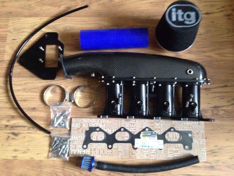

No it's the silicone hose that joins the air filter to the tb that I'm on about with induction length mate.
So I decent length hose before the airfilter is what I need then? Haha. With the 20v engine you only need about 100mm to keep the airmass happy and reading right.

Yes mate. I believe the length of silicone hose supplied with the rs2's was there for this reason.

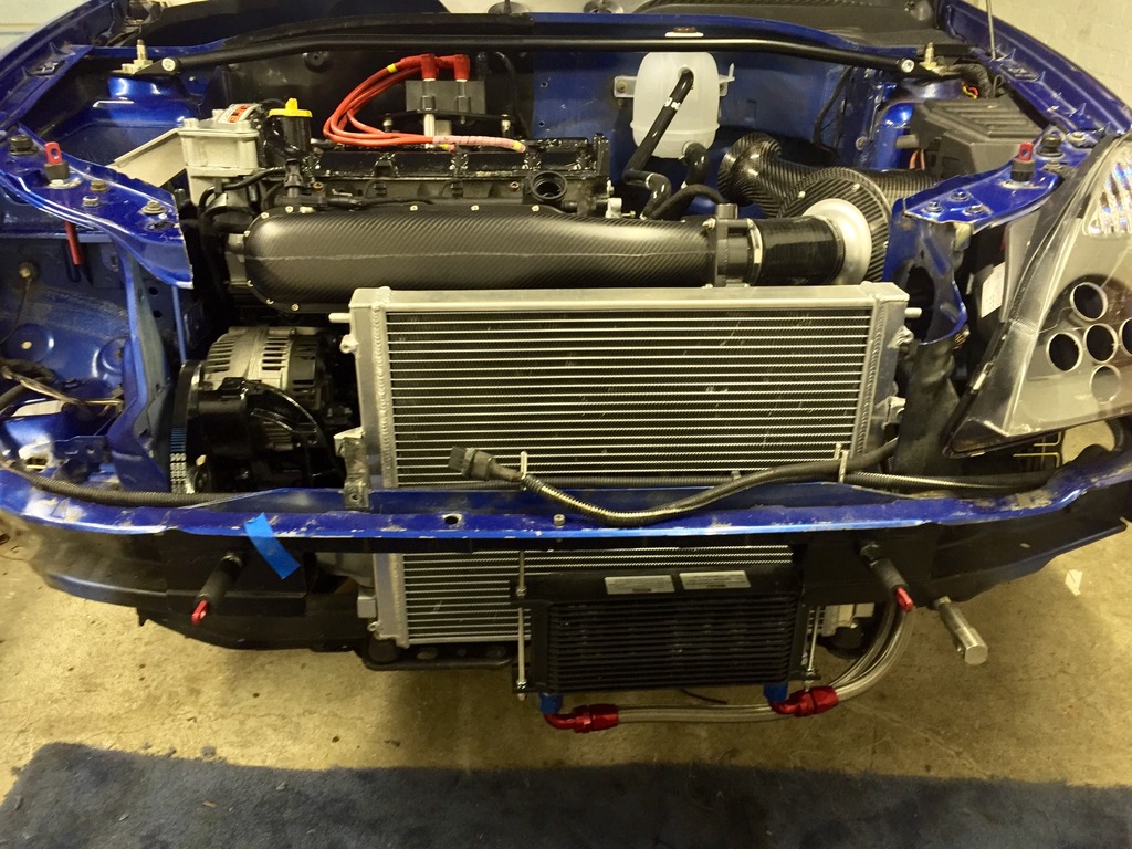

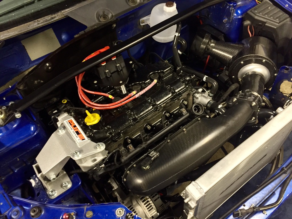

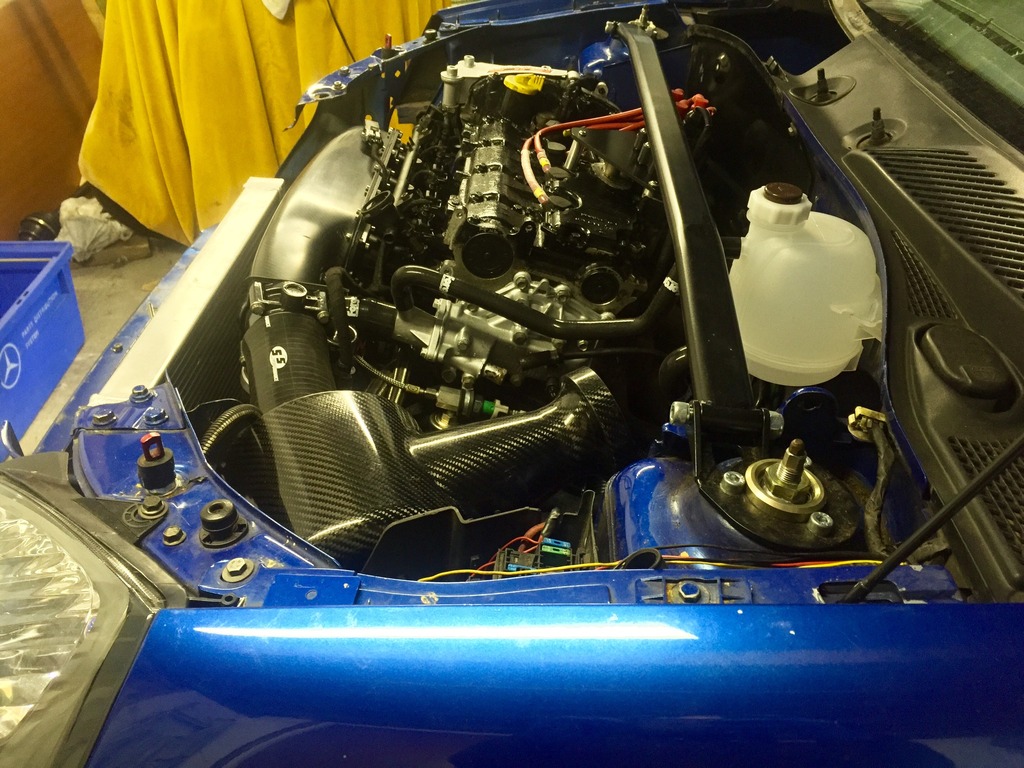

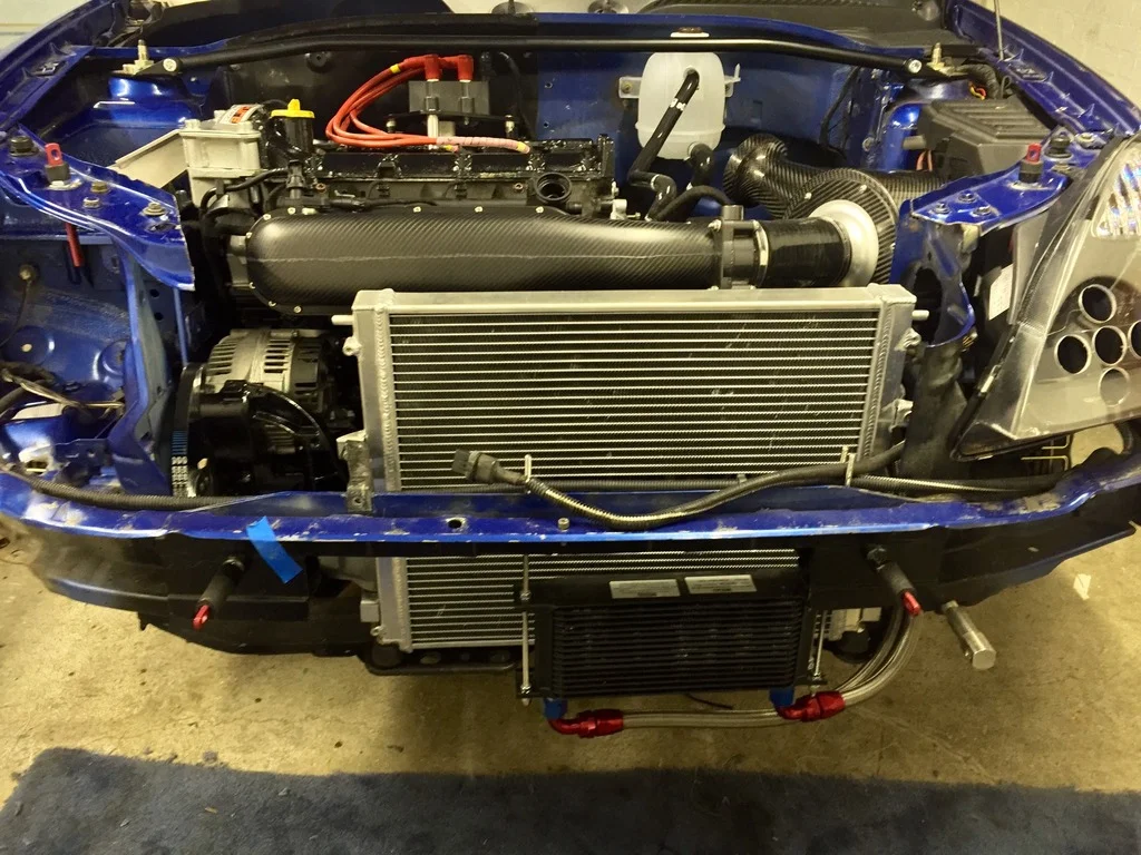

Yesterday's progress.

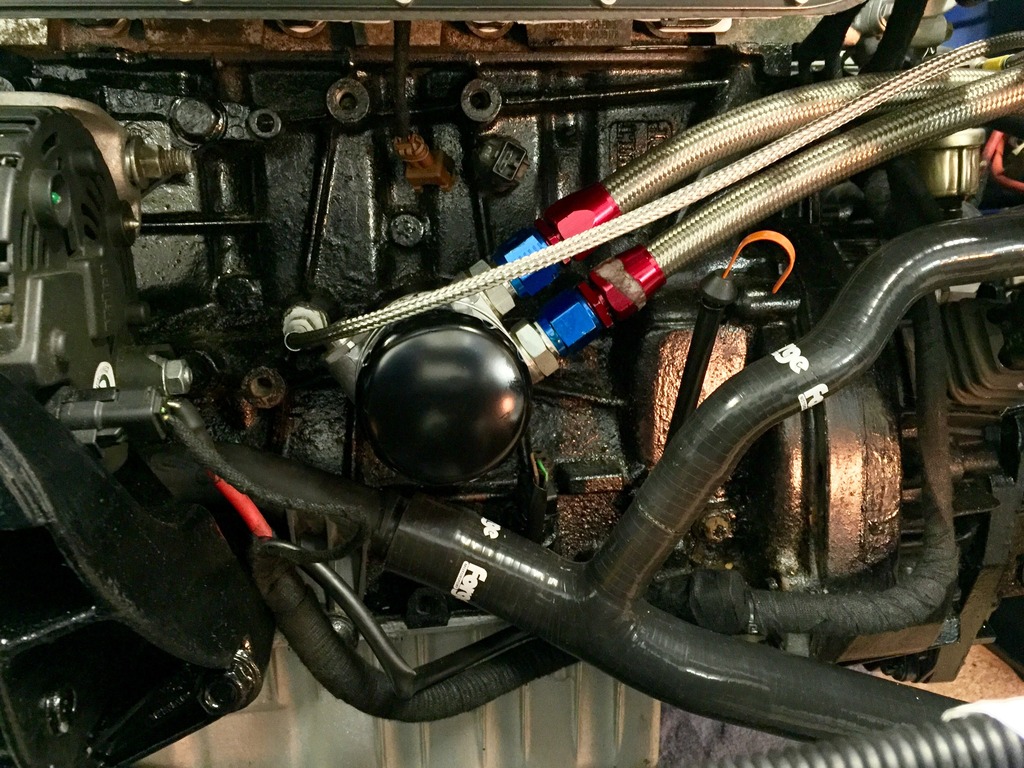

Fitted the oil cooler hose and lobbed on a new oil filter.

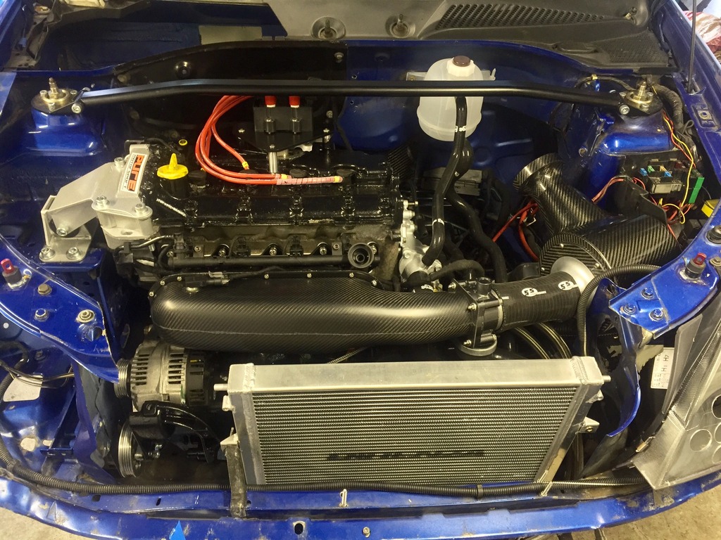

I dug out my ITG and also found my strut brace lol wasn't looking for it but would never had found it if I was so fitted that on aswell.

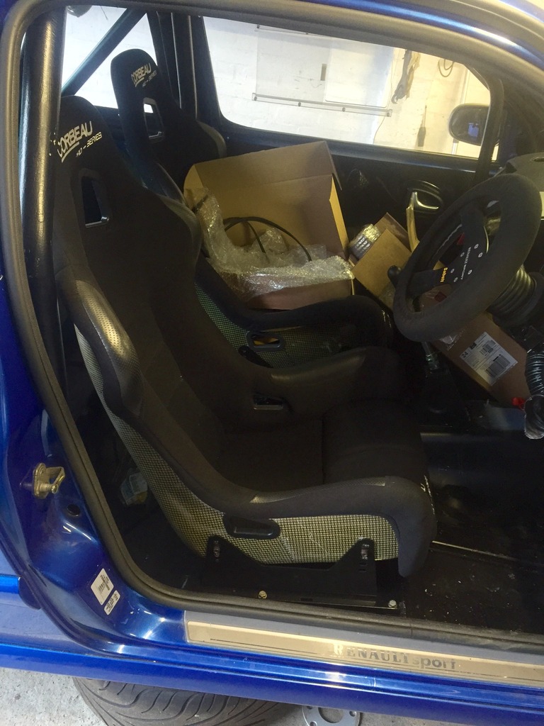

Also fitted my VBD xtra low seat frame. Now my seat doesn't rest on the cage and I don't bang my head on the cage when wearing my helmet.

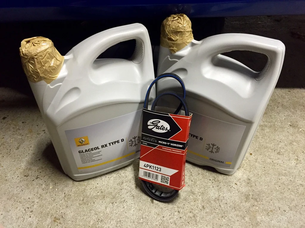

Only update at the minute is I finally got my alternator belt sorted.
Waiting on a few bits to arrive to finish off the engine.

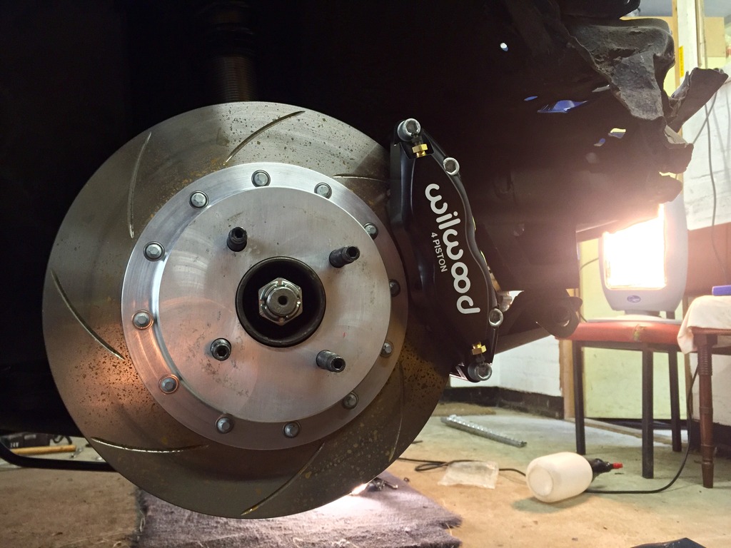

Had new bearings pressed into my hubs so I can fit the shafts and get it back on its wheels to fill the gearbox up with oil. Can also fit the brakes whilst I'm there thinking about it.

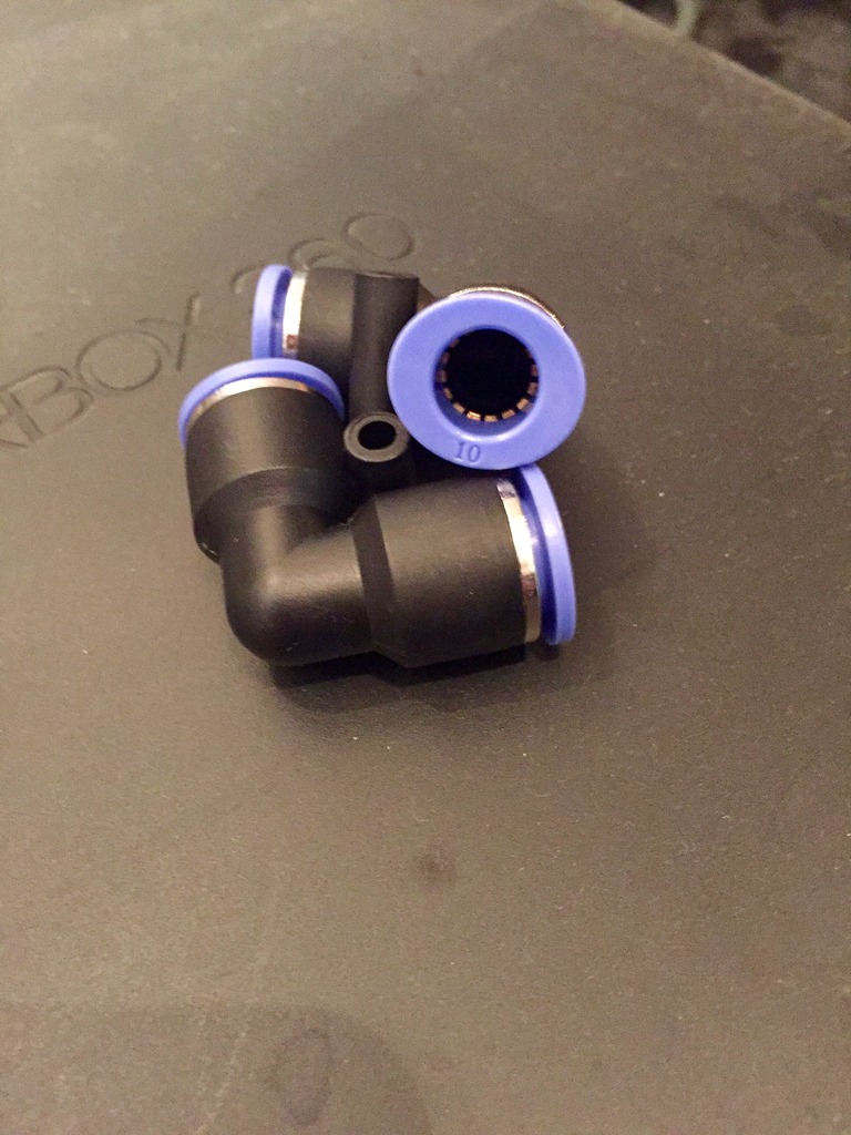

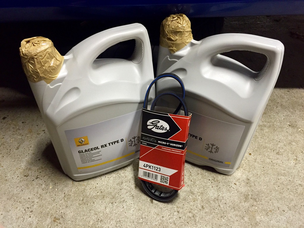

Got these so far that I've been waiting for
Renault antifreeze and push fit vacuum connectors to finish off the brake servo pipe extension.

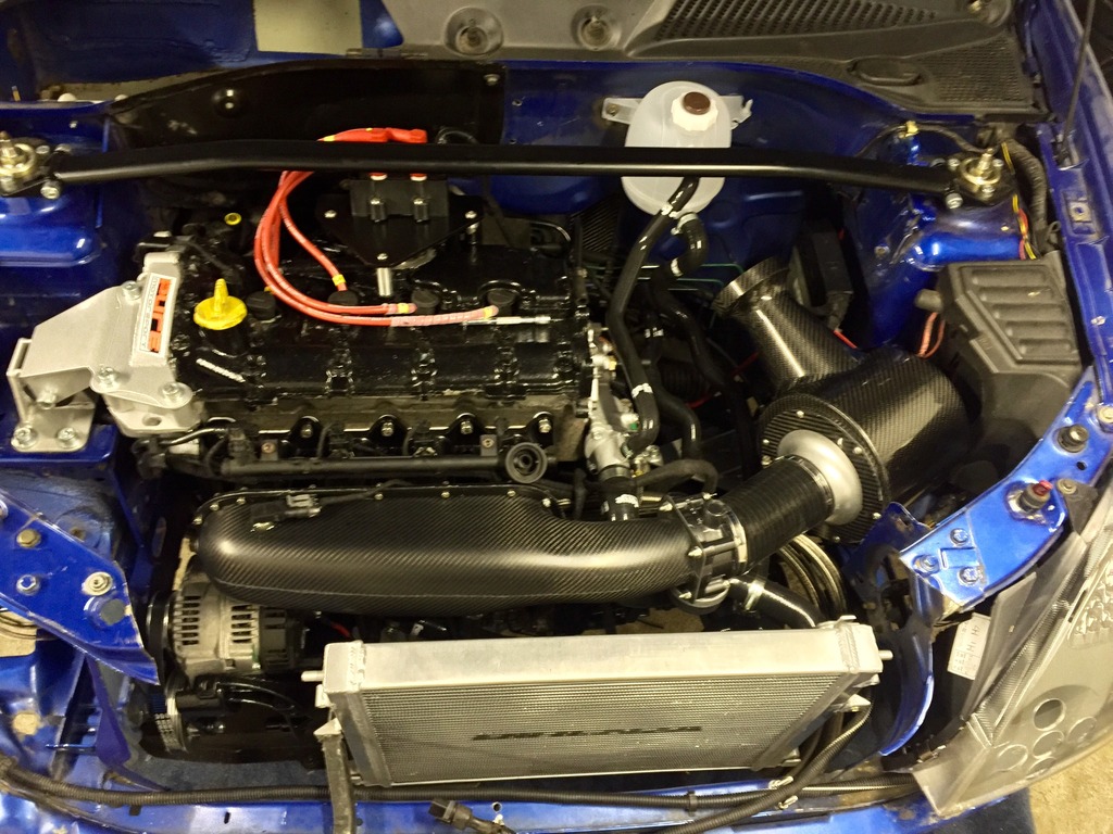

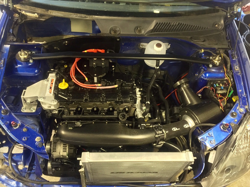

He's going to take the air feed from the scuttle panel mate as it's an ideal place to take it from. The Clio 16v/williams Grp a cars used to take theirs from the same place.
Like the idea of that! Using like a scoop intake?

I currently run standard airbox with upgraded filter and have direct feed behind me headlight. Find it works fine and allows me to run cooling from the fog light.
