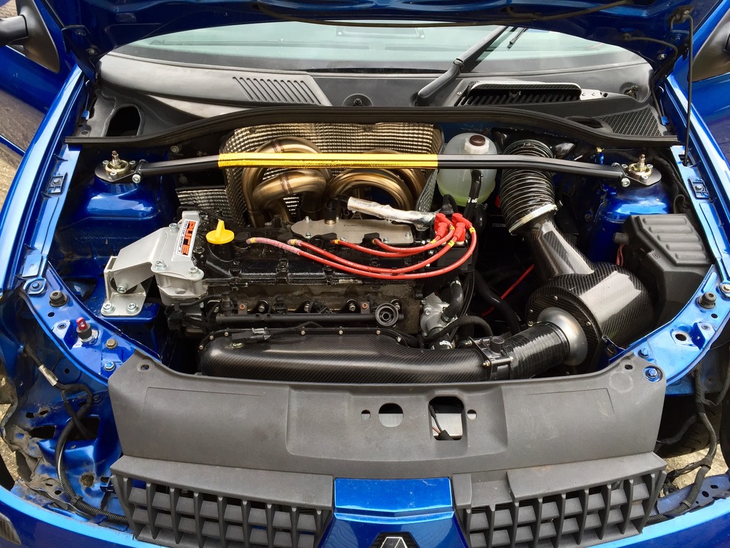

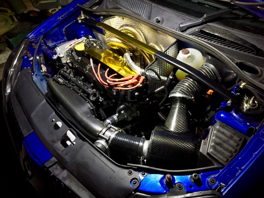

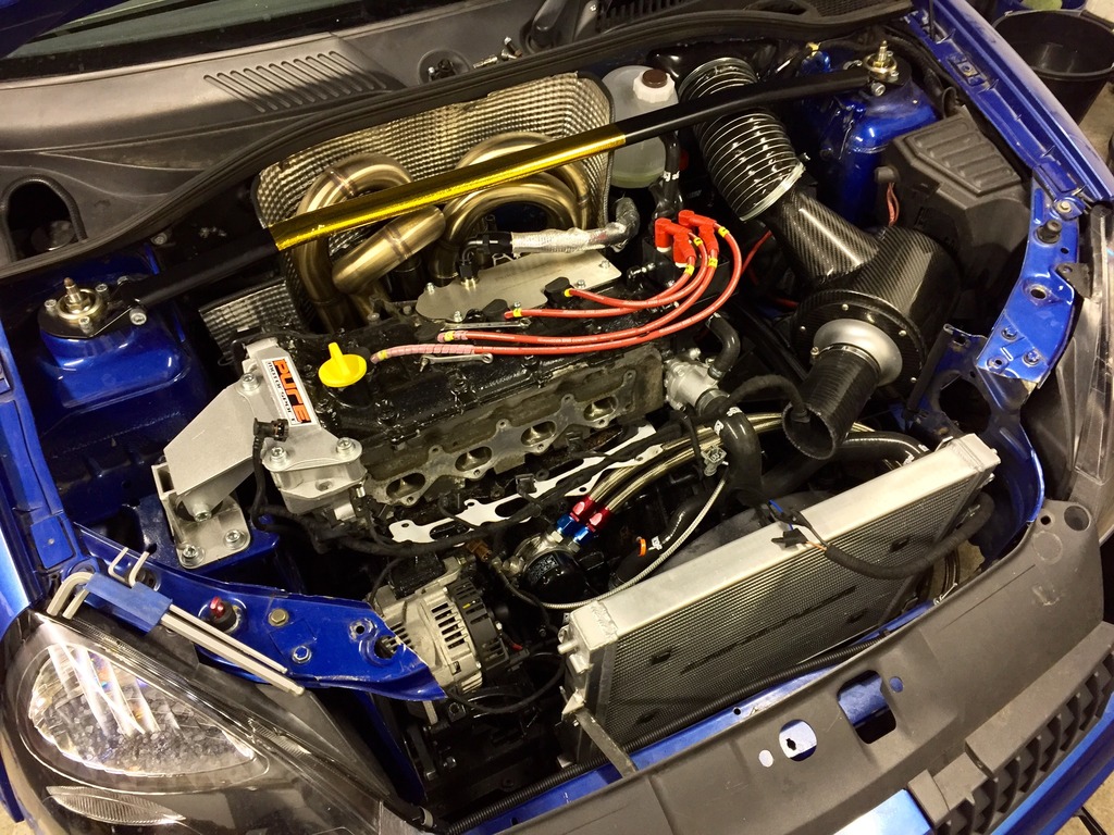

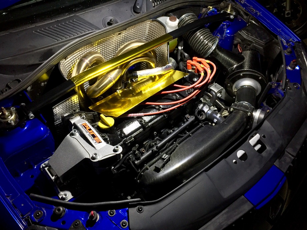

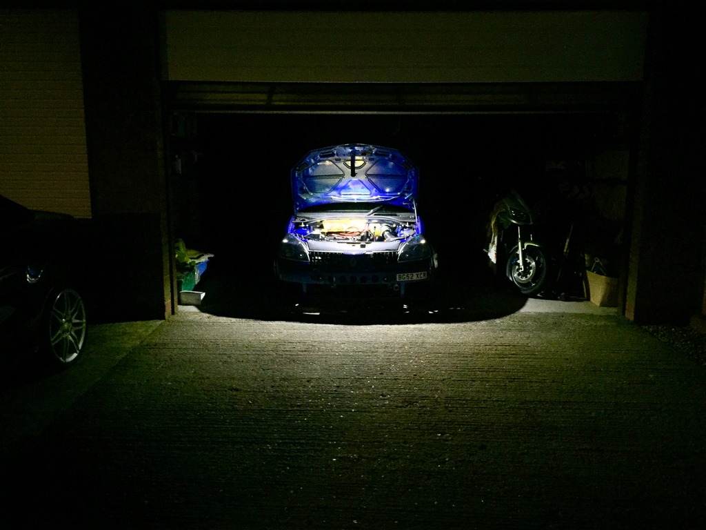

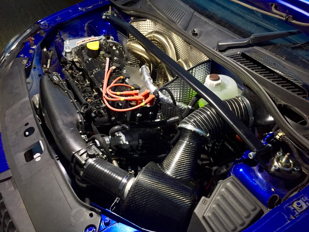

Got a few loose ends tide up last night. Bit more heat protection done, catch can sorted and few bits turned up today.
Gunna smoke test the engine and exhaust to check for leaks tomorrow night or Saturday

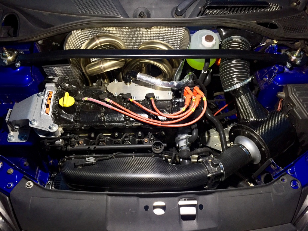

You might have given that manifold a clean or something it looks a little dull!!!! :tonguewink: Lol, looks stunning mate, hope all goes well
Anyone know what a good engines oil pressure should be? Slightly concerned mines reading low!!

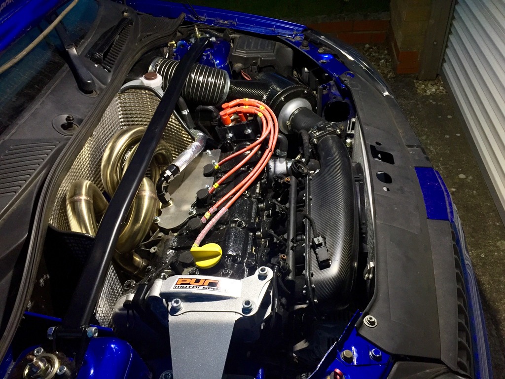

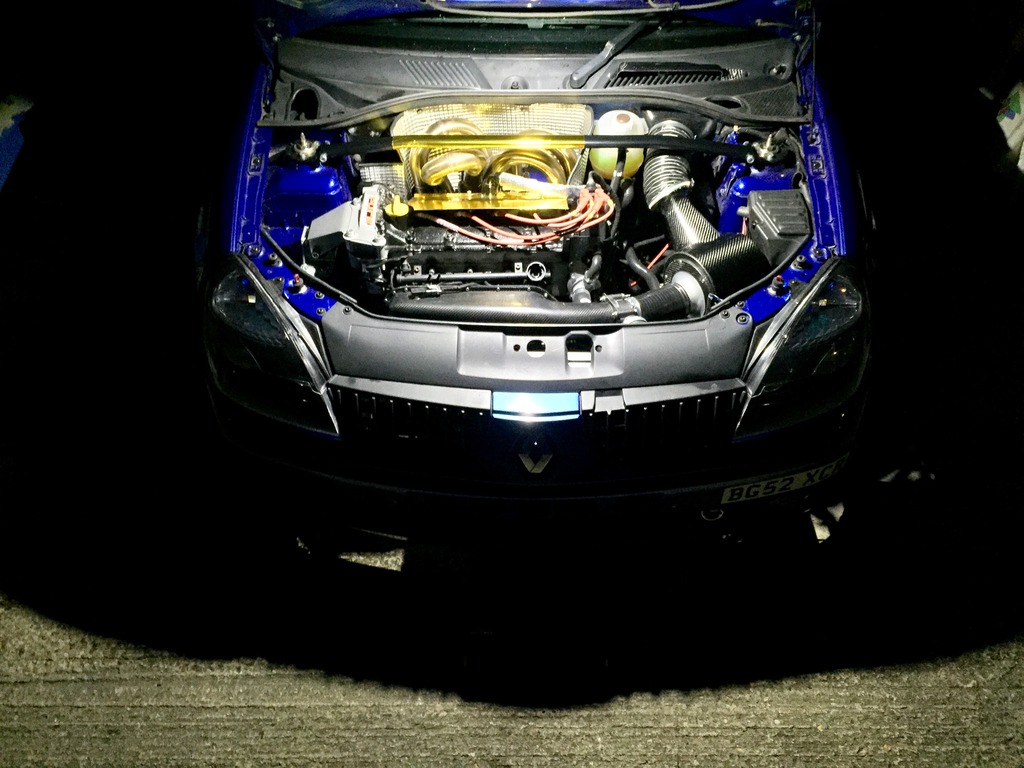

Did abit more heat protection.
Also making a new shield for the plug leads.

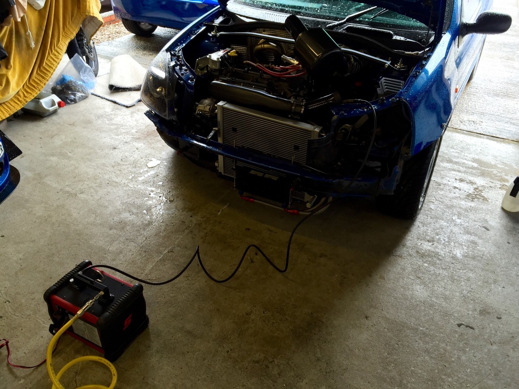

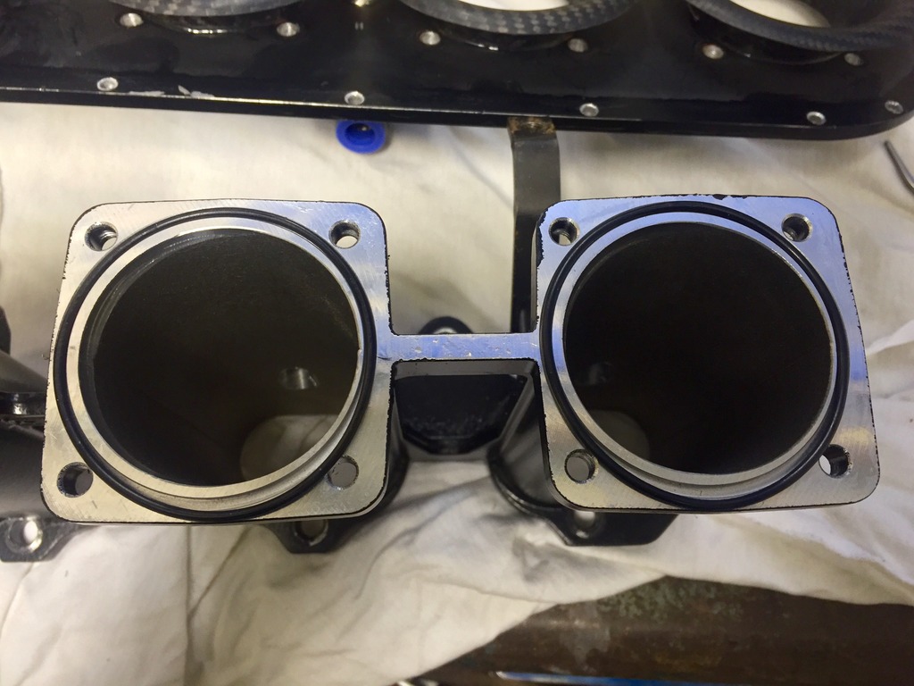

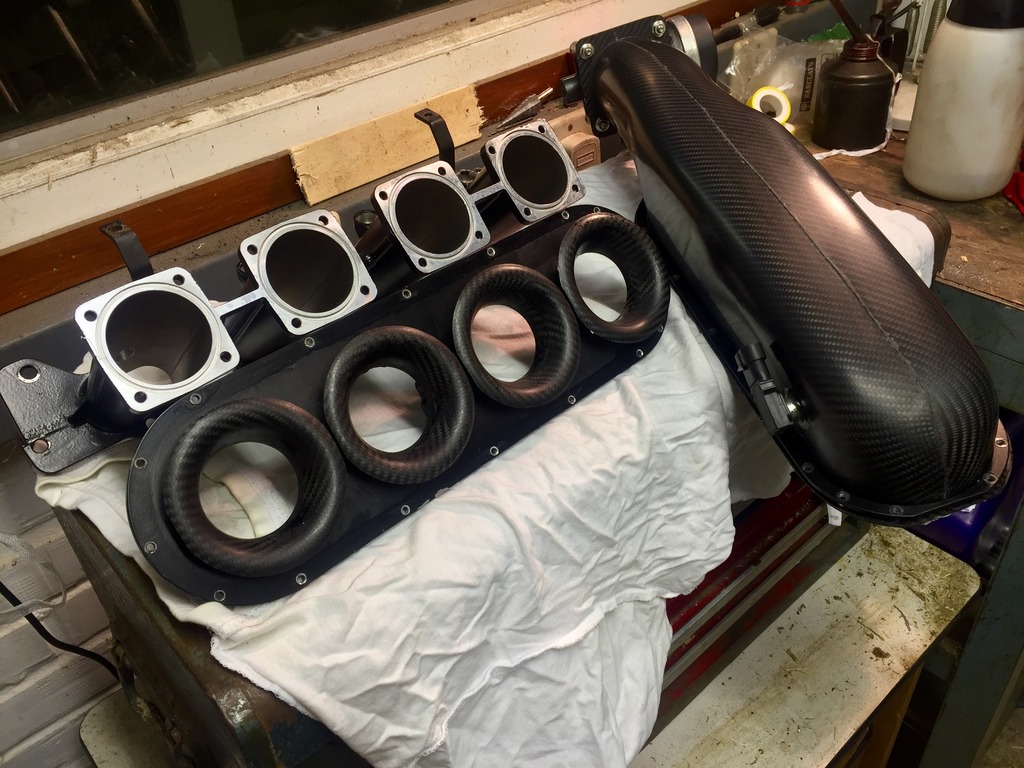

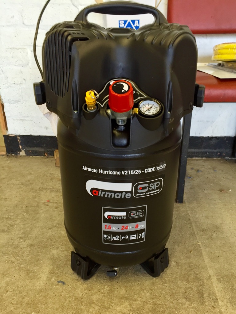

The car seems to be sucking in air as sometimes it idles at 2K. It might be down to the timing but I want it to be spot on before it goes for mapping, so I brought an air compressor and borrowed a smoke machine.

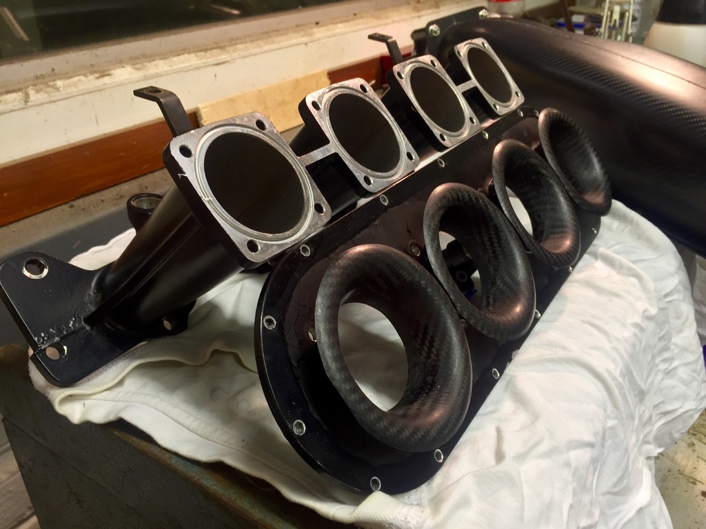

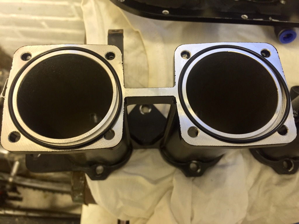

Turns out the rs2 is leaking and the insulating gasket onto the head is rubbish as that's leaking aswell.
So whipped it off and took it apart
Turns out these seals leak
The brake servo take off leaks and the main Orings don't seal or fit strangely.
So gotta sort these issues out and try again!
annoying issue to have but hopefully should be a quick and easy fix with some new O rings etc. Still have engine bay envy, intrigued to see how the PMS manifold helps aswel

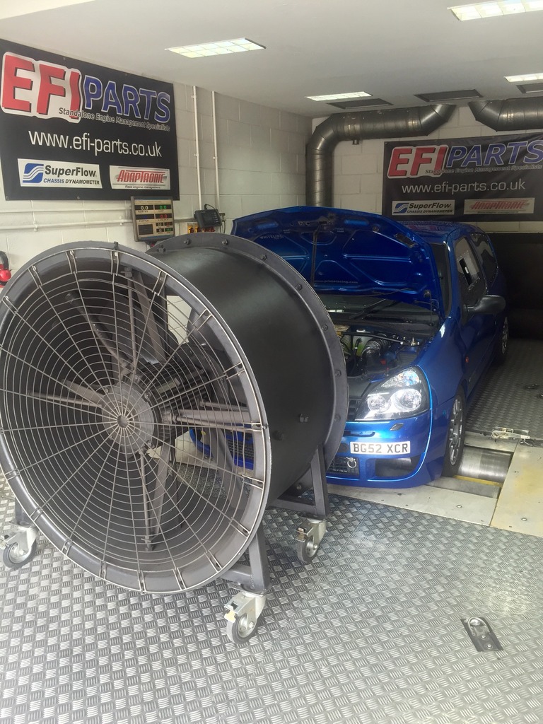

Thanks all for the comments and kind words, makes it all worth it :up:

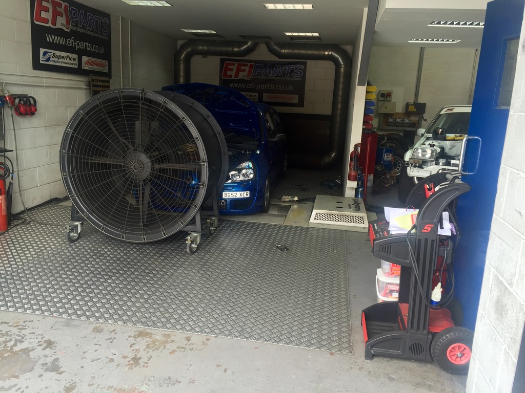

Figure wise I'm not too interested it's how it drives for me. And it drives really really well, I'm really happy how Chris at EFi has mapped it.
It made good power, little lower than I thought but it made really really good torque and holds torque across the Rev range really really well. The timing I've had set had the opposite effect to what I thought, really improving the torque low down rather than upping the torque abit and upping the bhp.
I'd rather it be this way than smashing a big bhp figure, I'd rather try something different than go with the the norm also. I know what's needed next and will maybe look to upgrading bits over winter, but only if it needs it. The way it drives with the suspension mods and LSD on road it's awesome.
I need to raise the Coilovers and get it tracked then abuse it.
I guess that means it didn't make any more power than an RS2 with a standard exhaust manifold.
Thing you've gotta look at is the over all package. The timing changes the whole characteristics of the power delivery. Even Chris at efi was surprised and hadn't done it before with my mods.
I've never said who or what timing I've had as mark ask me not to mention it. I trusted mark with the timing and he trusted me not to say which Is how it should be.
Mark is the only one I'd show the graph too as he did the hard work, I did that out of respect for marks talent. Chris at EFi was happy with it, I was happy how it drove and mark was happy with the graph. That's all that counts surely?
If I want more I know where I can go, which is cams and higher rev limiter, (Chris at efi 'a suggestions) as the timing is making awesome low down grunt and holding the it through out the Rev range.
If anyone needs a figure 'pub speaking' it's not far off 200.
