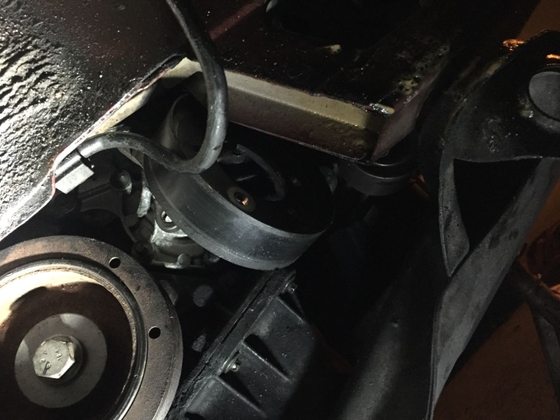

i postet a quote before. How did you get so much space between engin and body shell? Did you remouve the Mointing for the gearbox too?
Hi,
1265313
Sorry mate.

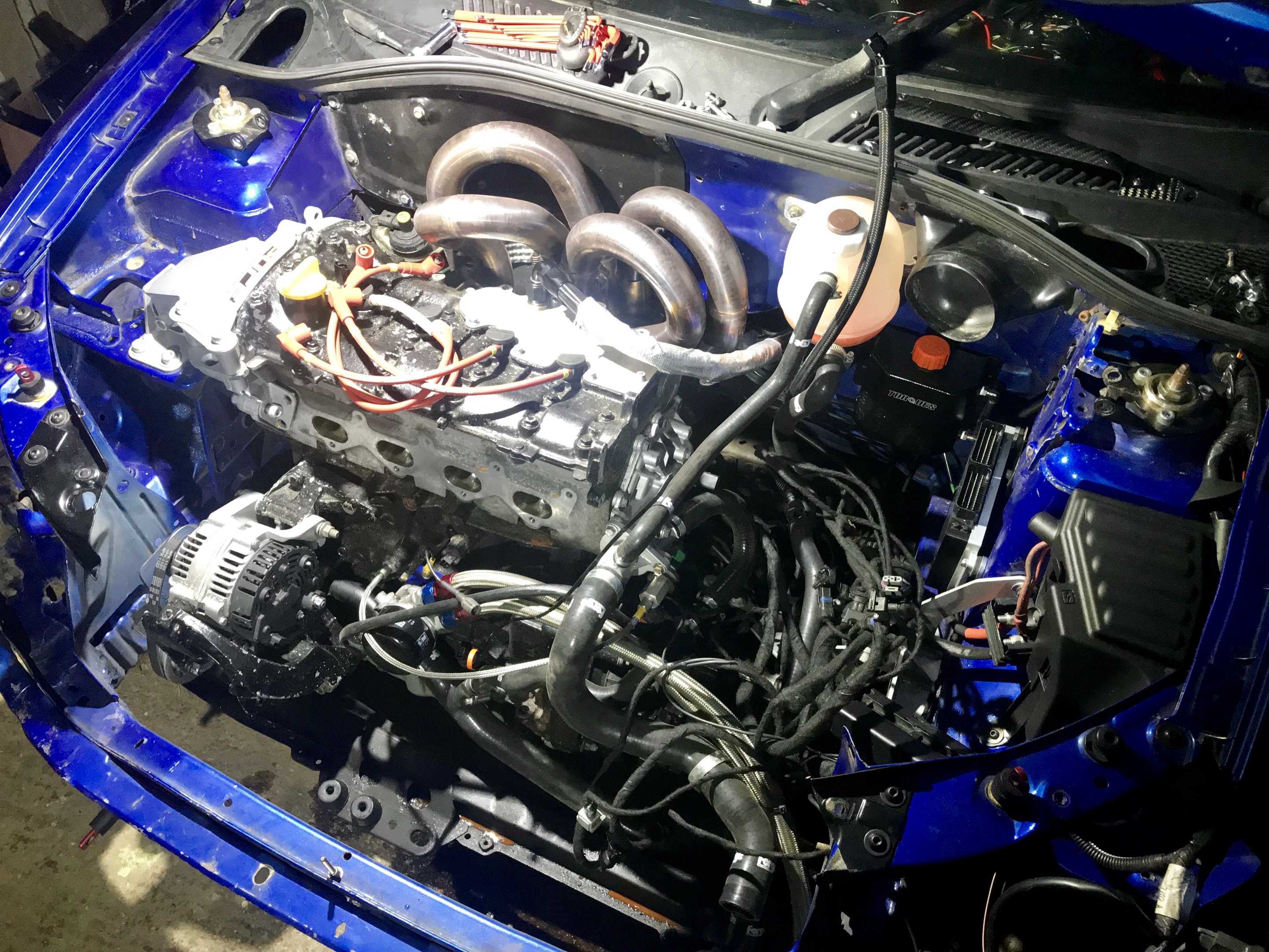

I just undone the alternator mounting assembly and moved it all to one side.
Think if your running PAS pump you will struggle to do this tho.
I didnt have that much space! Running at the original Pas and alternator, and there is no space to remove the waterpump pully after loosen it.
I need 3 mm more space. This was the reason for the question. With the gearboxmount there is no posibility as per my opinion to move it moir to the gearbox side. But than ive seen your pic.
With a trolley jack under the engine, undo the top engine mount and you should be able to lower the engine just enough to get clearance.
Sorry didn't want to disturb the Topic.
Wasnt possible like that :( (Lowered also the subframe)
Well undo the gearbox mount and crossed fingers :D

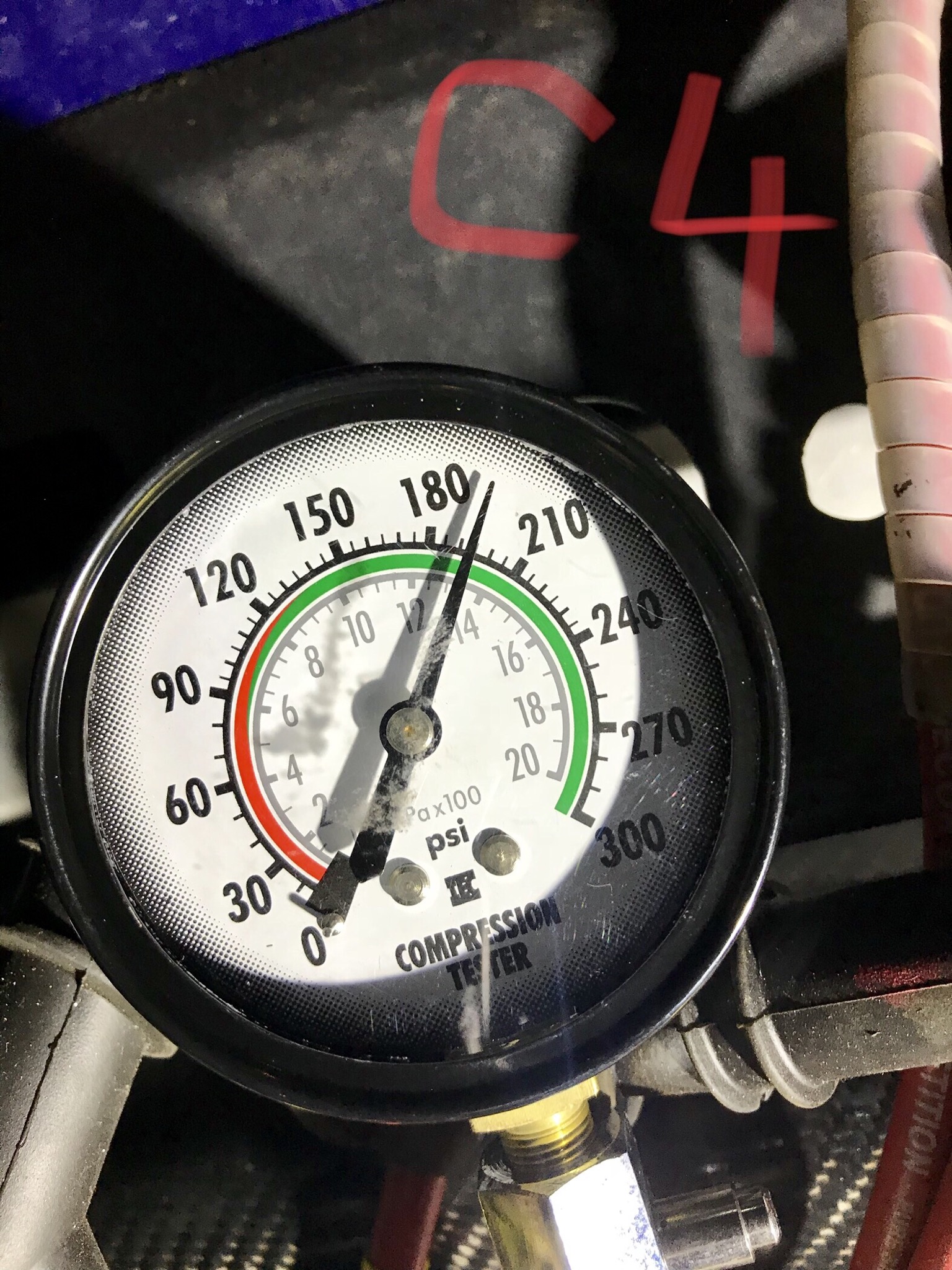

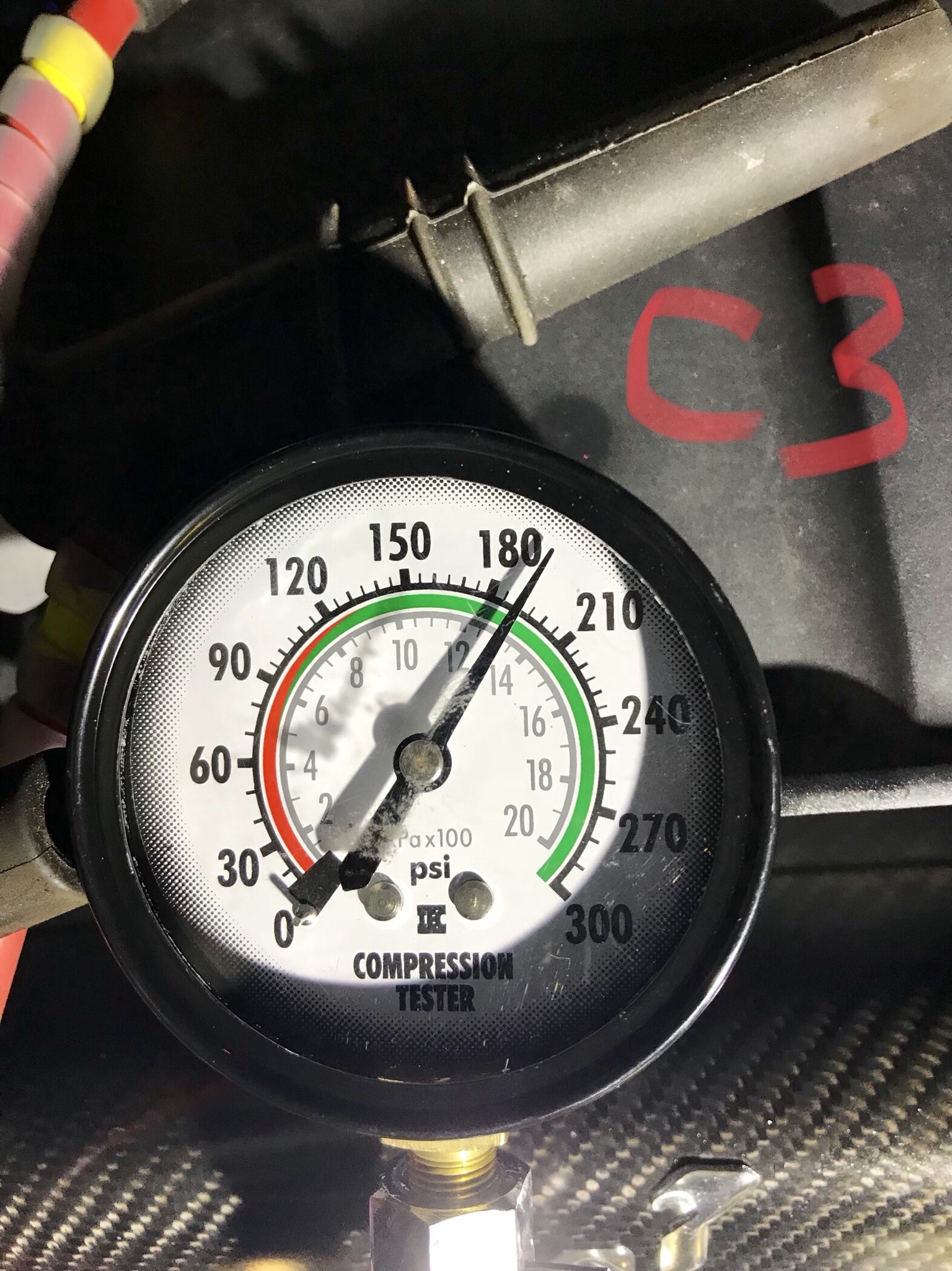

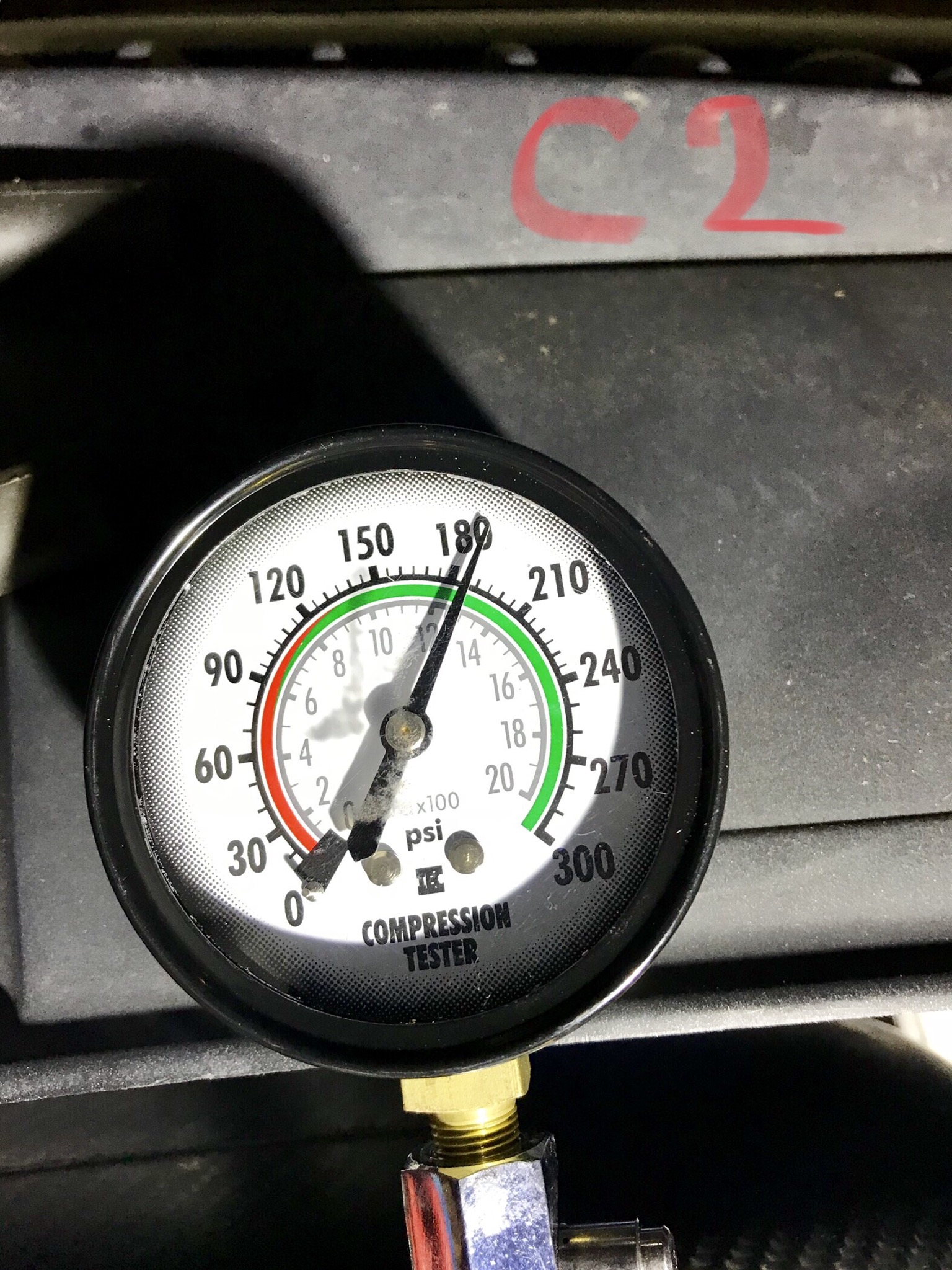

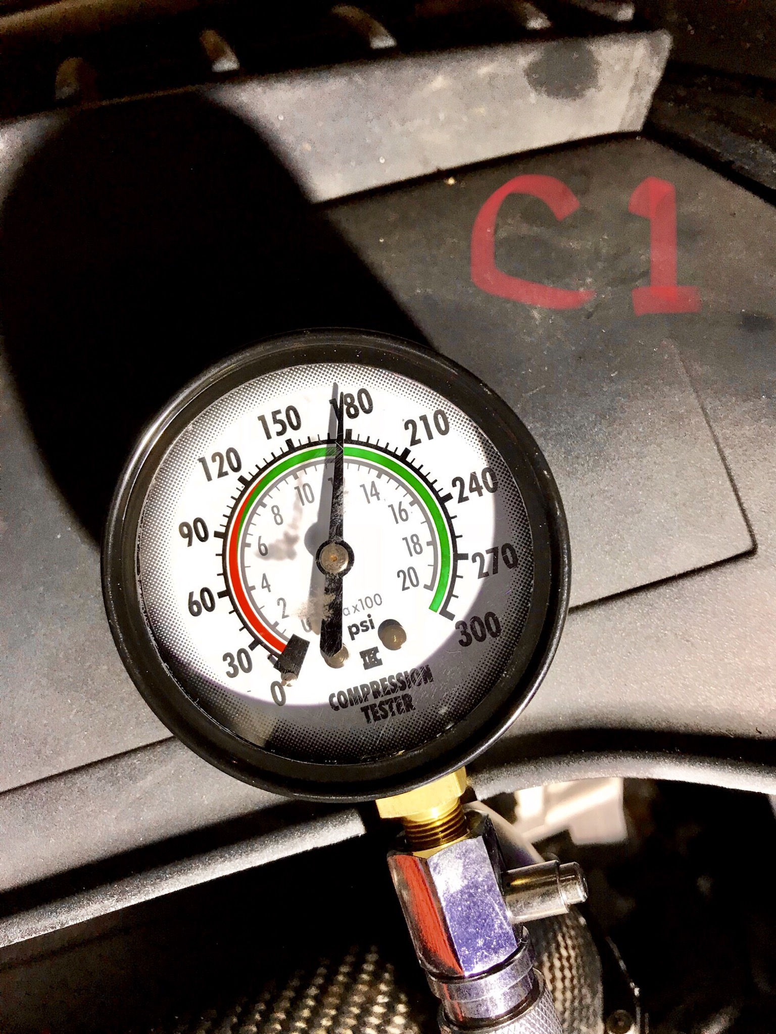

Hmmm compression test came back ok presuming my scores are good for an F4R engine?
If so it’s Back to the drawing board.

So Chris at EFi check the throttle body was working ok, which it was, he also checked the air filter setup wasn’t causing a vacuum and restricting flow, which it’s wasnt at all. I’ve checked compression and the RS2 and found nothing wrong.
Only thing left is to check is the timing but can’t see how that would be out or how I’d check it actually as I only have the standard timing tools.

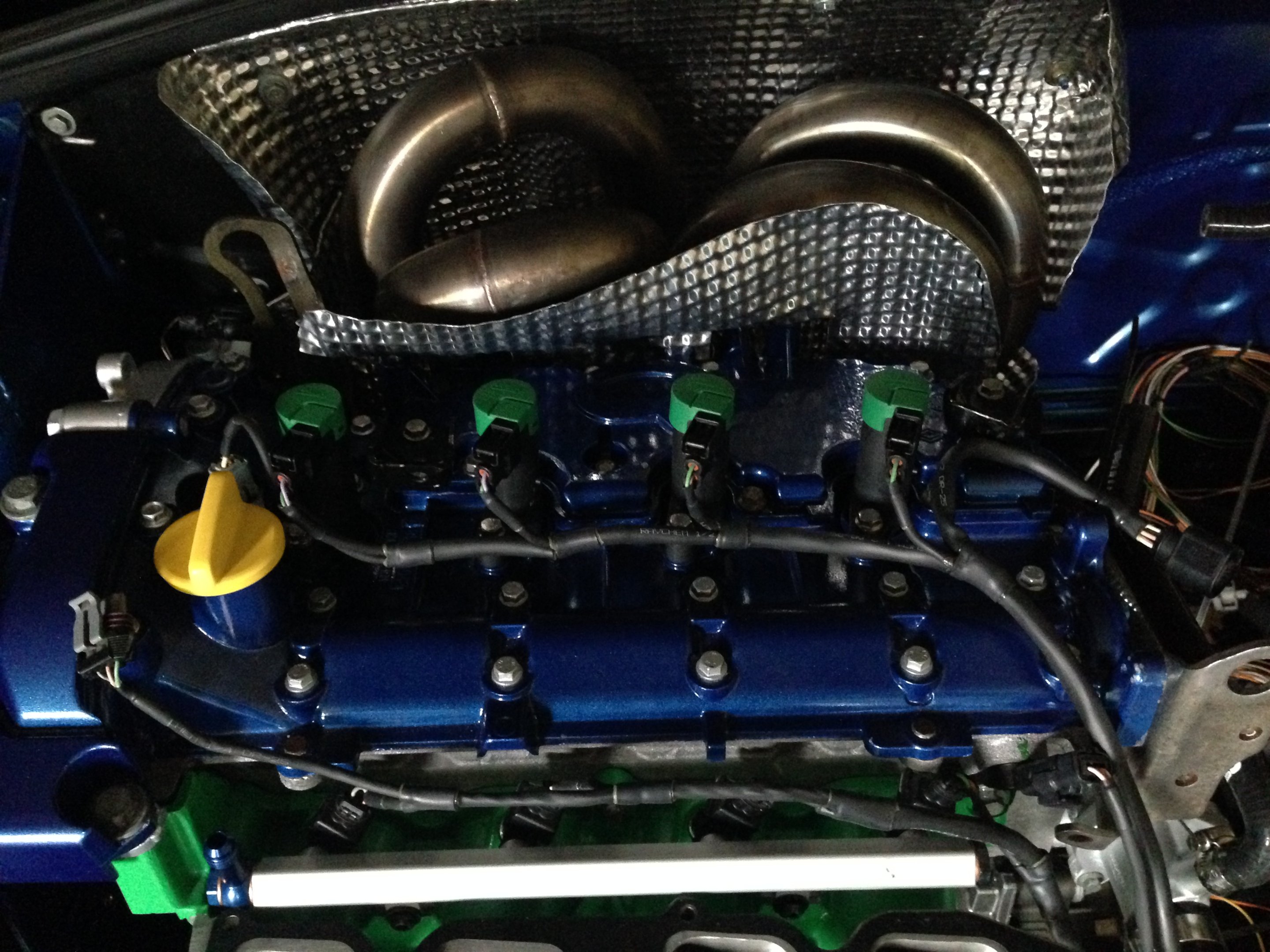

How much heat does your manifold give off? How many things do i really need to worry about protecting 😂.
Looking forward to seeing what this does with bodies
Nothing has melted with the heat shield that I made. It’s nothing major but can feel the heat on the bonnet after a hard stint on track. Lol
