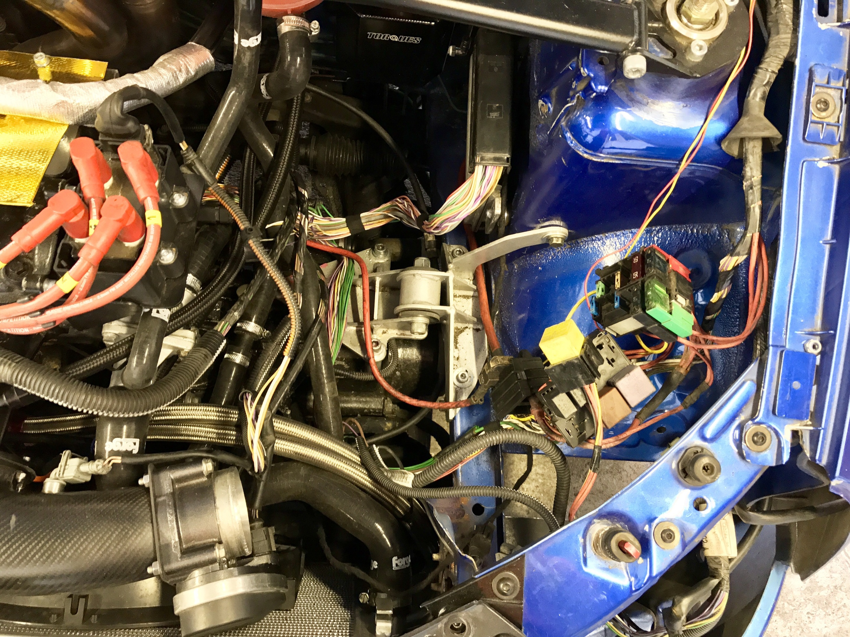

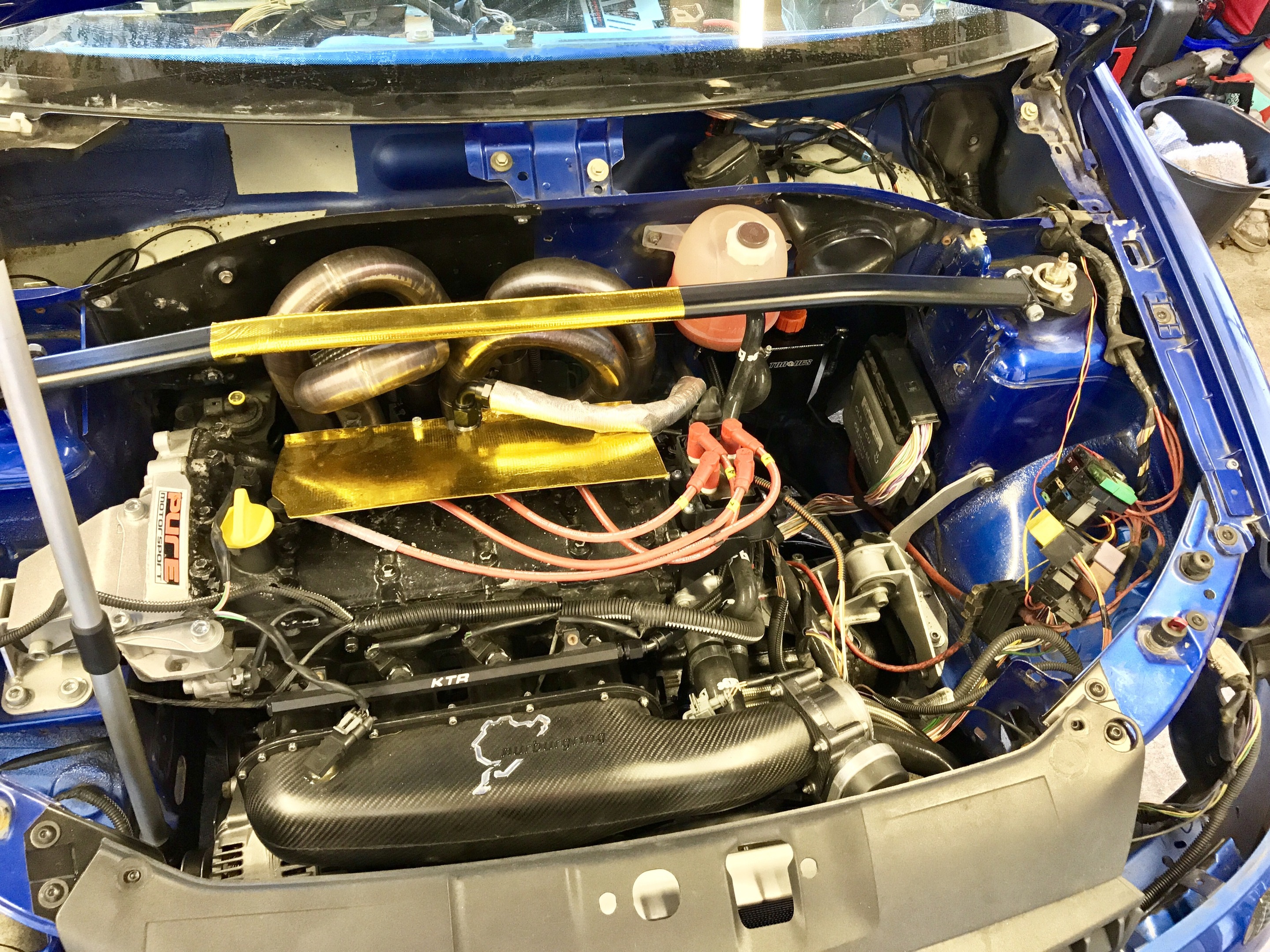

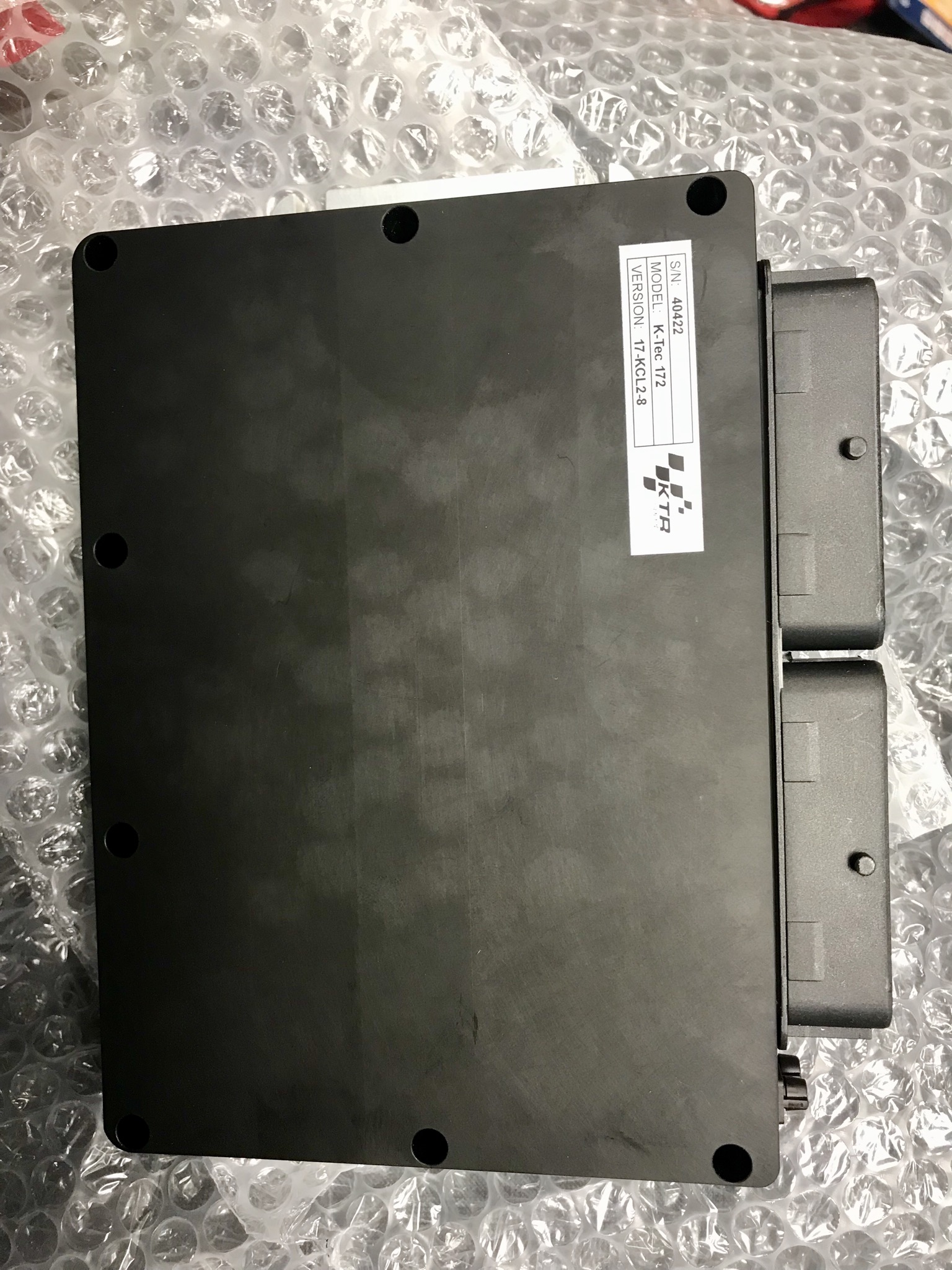

Just fitted the spare ECU, UCH, barrel and decoder ring and now I have the exact same issue on my spare ECU set :rage::rage::rage::rage::rage::rage: It ran on this spare ECU set with the Standard map but doesn't now so I guess it was the UCH at fault at all
Had another look over the car today still f**k all I can find. Looked again for broken wires, double checked all fuses and swapped all relays over and still no progress.
I've got 12.46 volts everywhere, only place I can't get 12v is the fuel pump as that's not priming.

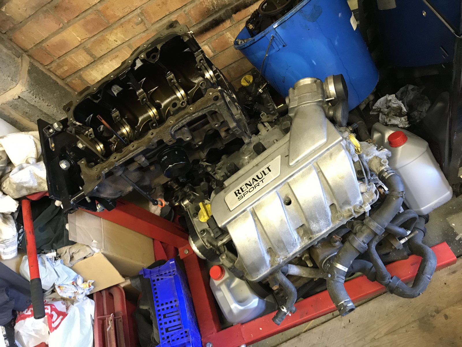

Anyway this is pissing me off so I decided to go and collect this instead.

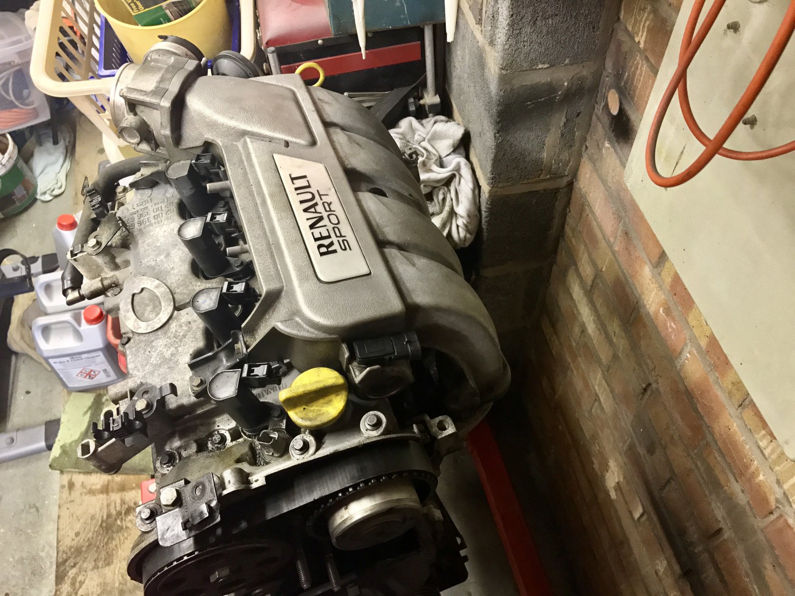

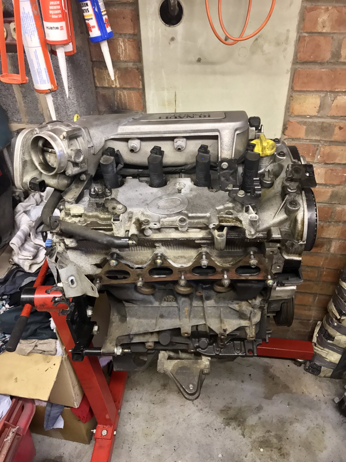

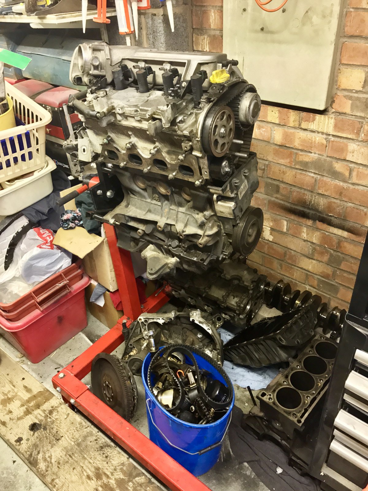

Clio 200 engine :smile:
Started to get my self familiar with my spare 172 engine few months ago, so I've completely dissembled that now and put the 200 engine on the stand.

Clio still hasn't fired into life. March was the last time it started and ran.
Starting to get withdrawal symptoms from track days. Lol
Anyway I've swapped the looms over and swapped relays for new items and still have no joy. So I'm looking at all other options now as I've had enough of it lol.

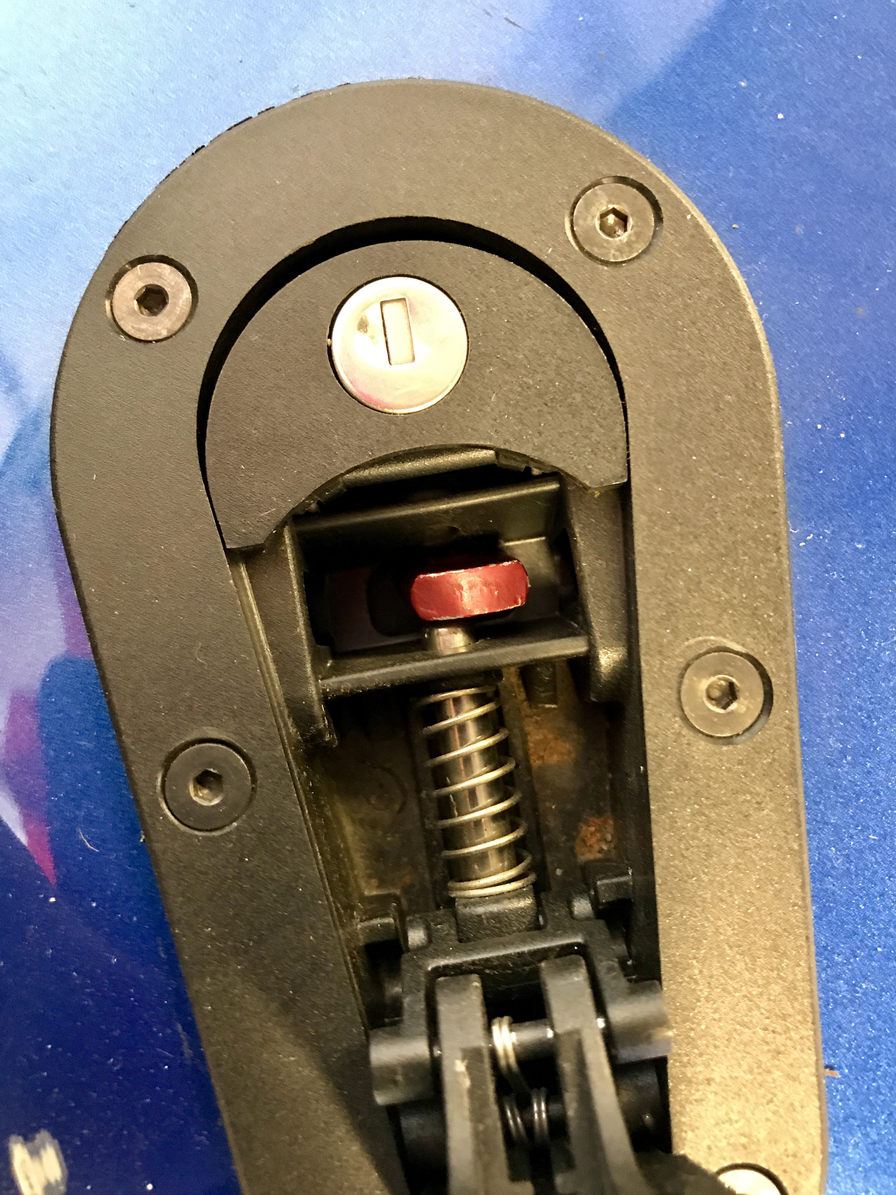

I tried to close the bonnet too as it's been propped open since march and now have an issue with one of the aero catches
:confounded:
Looks like there might be a slight warp in the bonnet maybe, try leaving it closed for a bit might drop back. If not, bit of brute force and ignorance will sort it :wink:
Isn't the pump not priming a immobiliser thing ?
As a test, why not run a 12v direct supply to the fuel pump ?
Sent from my SM-G955F using Tapatalk
Yeah defo is, I've got a electric probe that I've used to supply 12volts to the pump and the pump works no problem but still won't start and will only crank 3 times still. Guess there's no spark either.
Yeah I'm sure brute force will help :laughing:

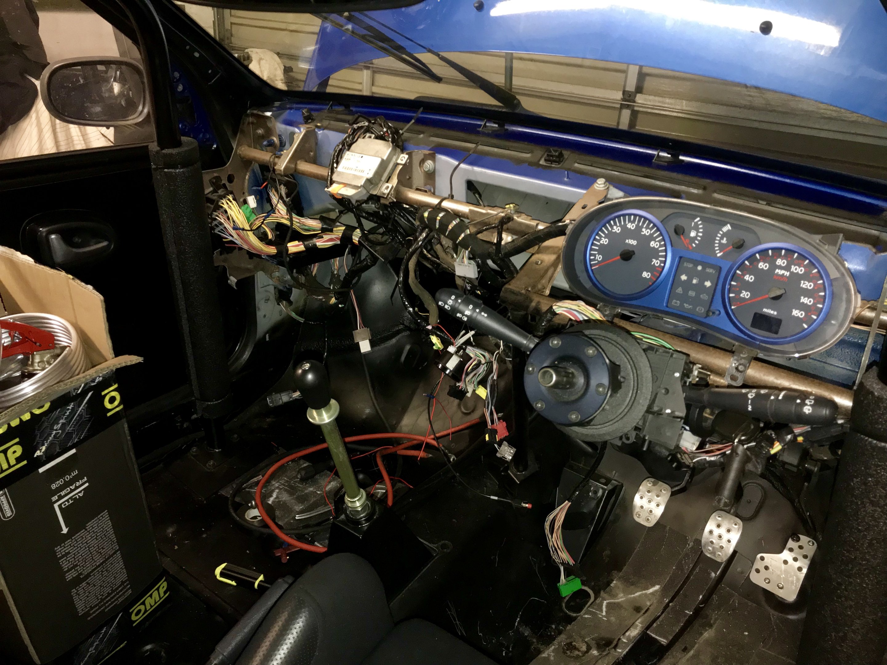

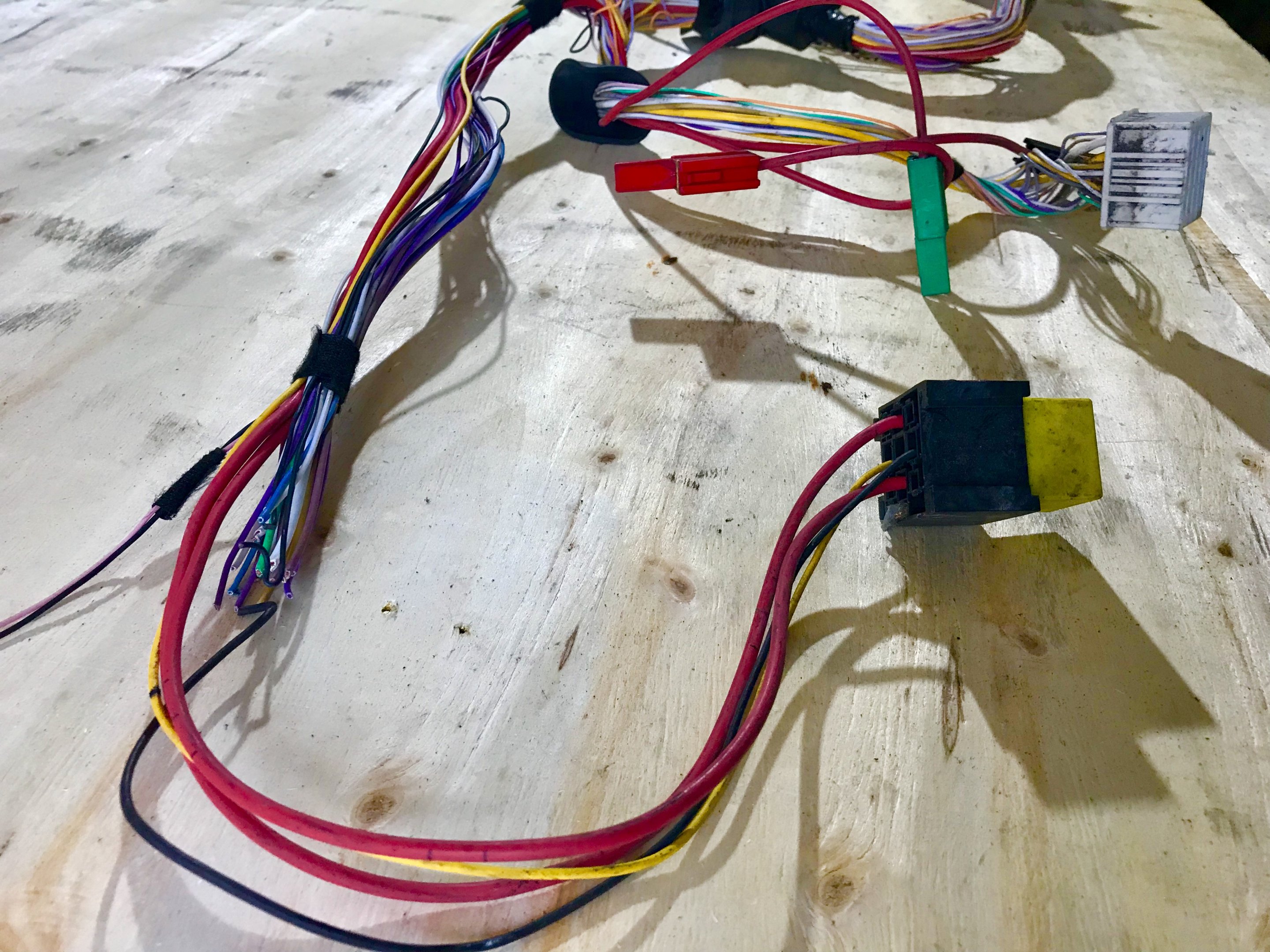

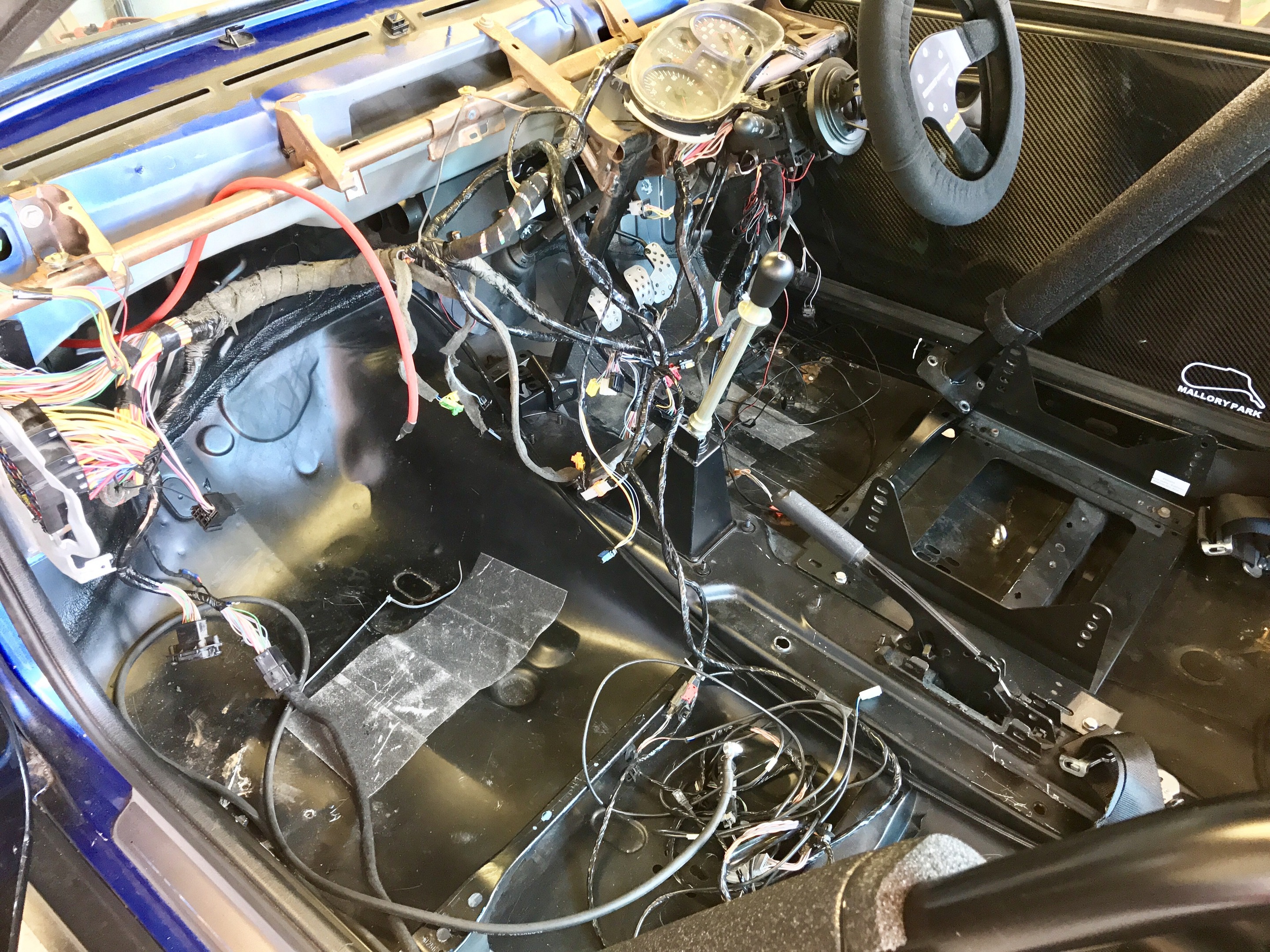

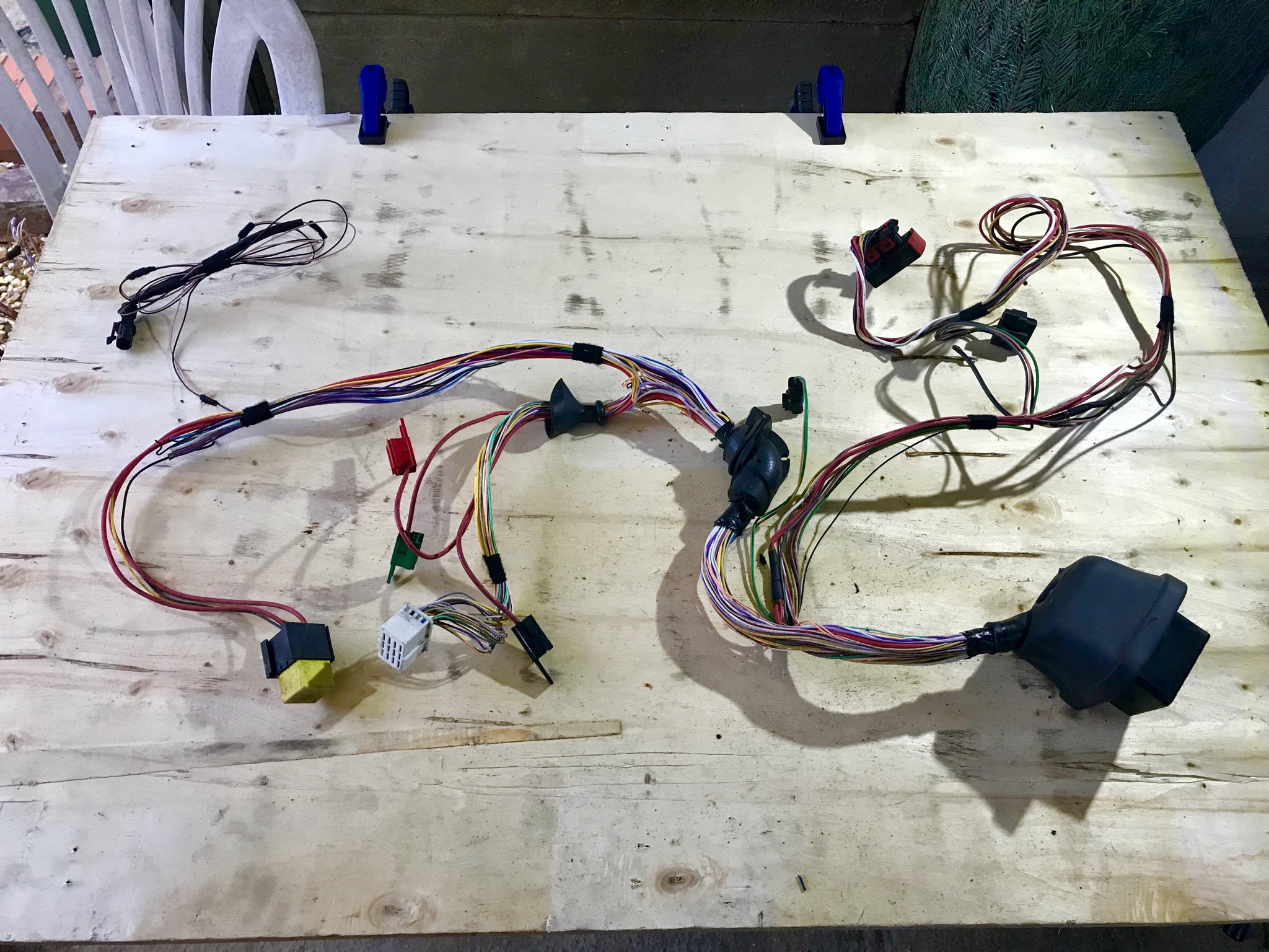

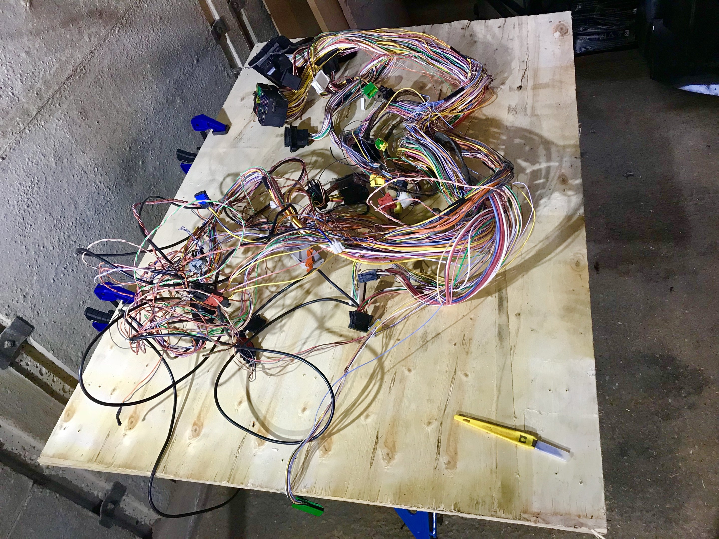

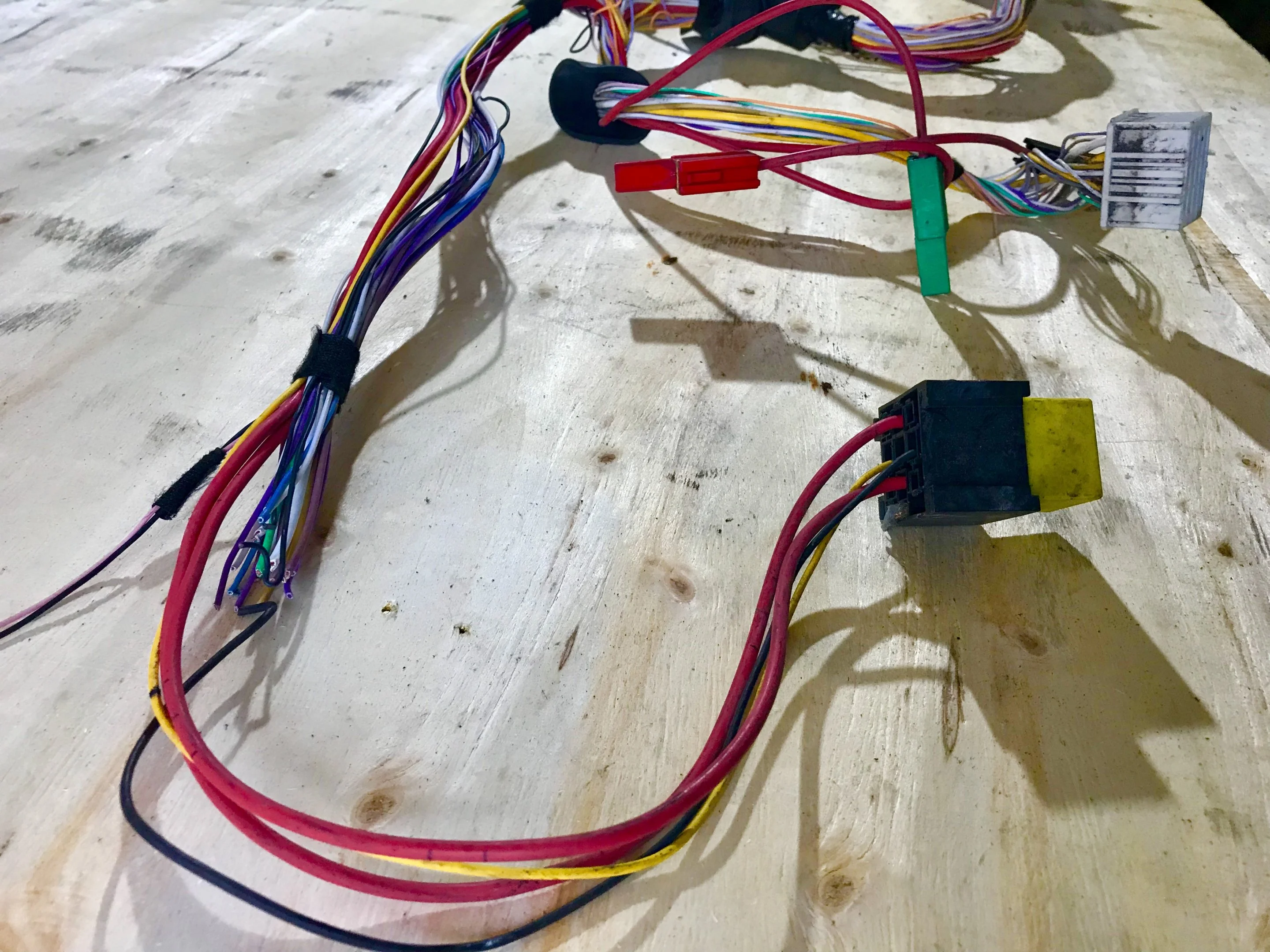

Made a start on the wiring today :astonished:

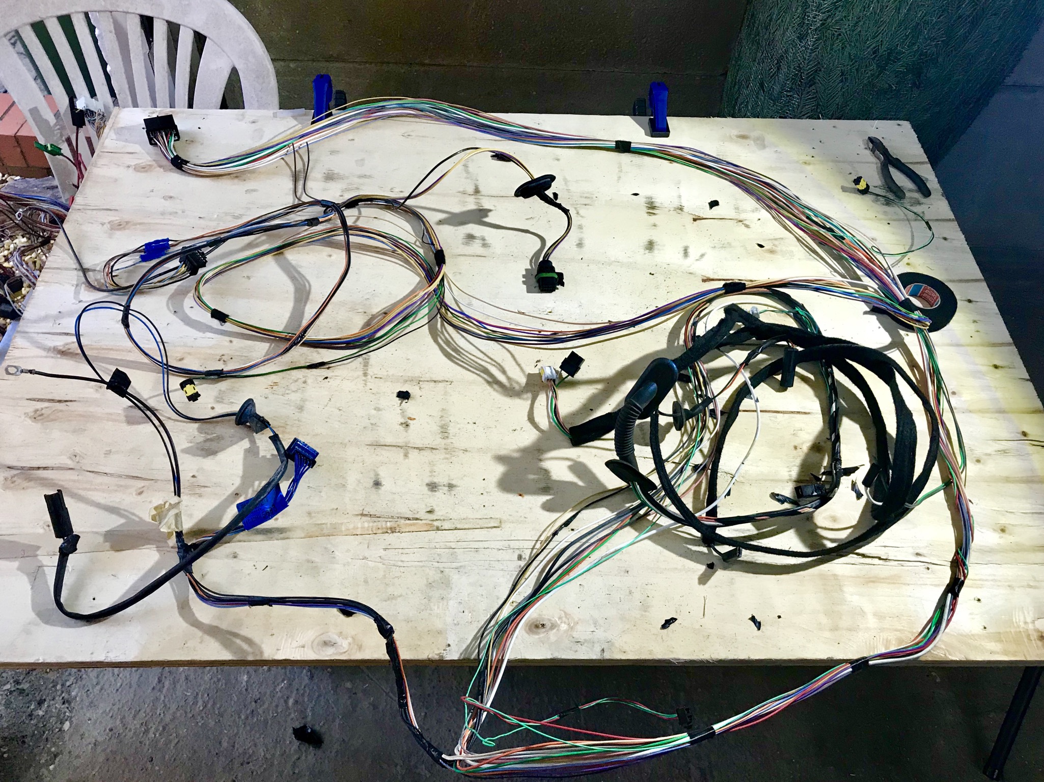

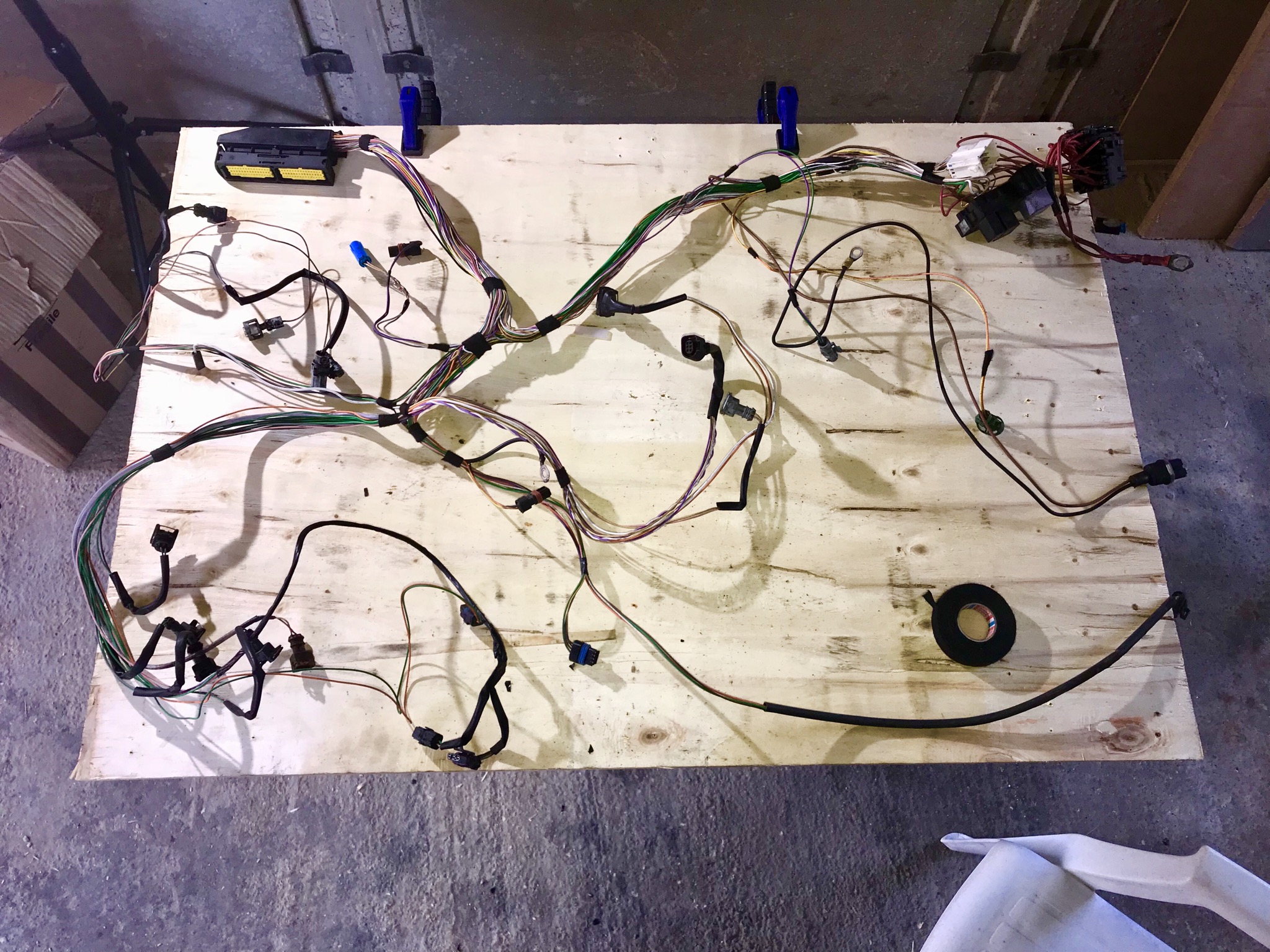

Stripped all the s**t off that’s meant to protect the looms, both engine looms, dash interior loom and rear half.
Engine loom just slightly tape together.
I need to test fit the loom and make sure all the plugs are in the correct place and fit around the RS2 inlet manifold.

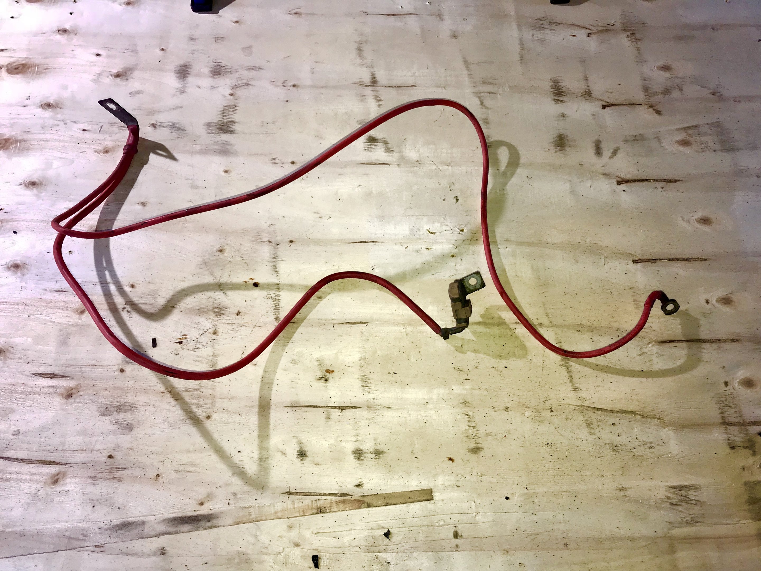

I need to make a new starter power cable.
Engine loom with the bulkhead fitting on, its had what I think is the headlight wiring cut 🙈
I hope it’s the headlight wiring anyway lol.
Cut wires

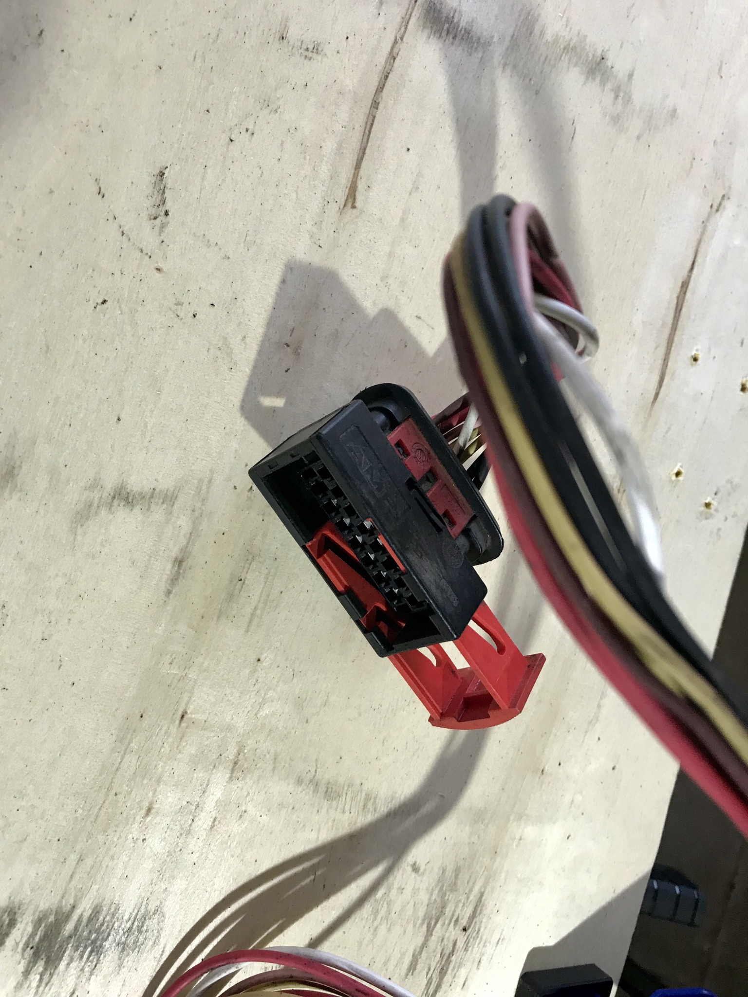

Can someone confirm this is the heater blower motor plug?
Rear half
Again need to refit make sure everything will reach and work out what’s not needed.

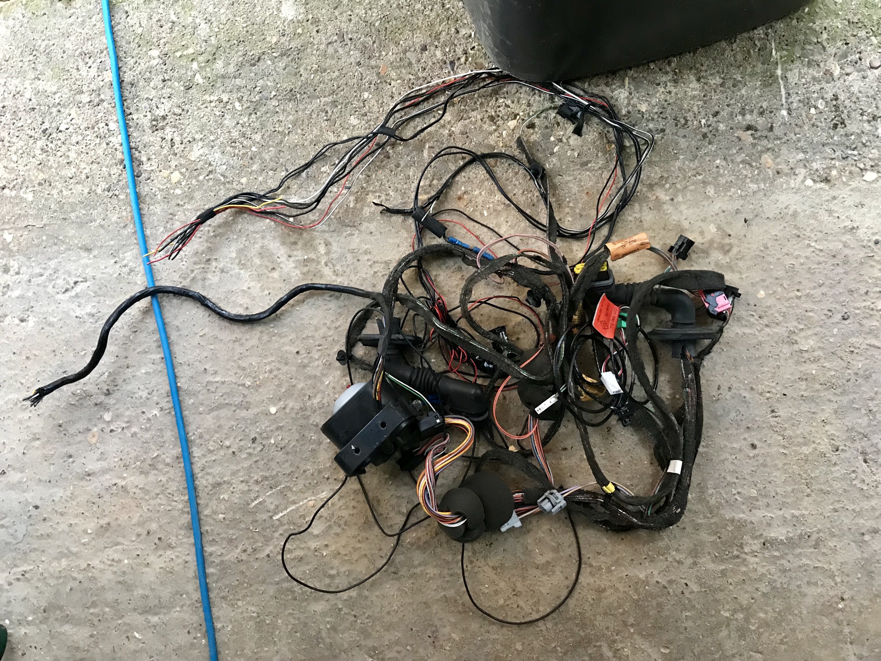

Scrap pile so far which I did from memory as I wasn’t with the car 🙈
Then it’s case of starting the dash loom

How hard was it to sort out all the loom and stuff mate? Something I really want to do at some point.
Massively time consuming 😂
Just taking all the tape and plastics off the looms is a job and half in its self. I was doing it away from the car aswell so trying to remember what plug is for what added a bit of time (especially when I haven’t looked at the car for 3 months or so)
Defo worth doing if it works, even if you don’t remove any of the unused stuff just having it tidy when you’ve got mods/conversions helps the ocd 😂

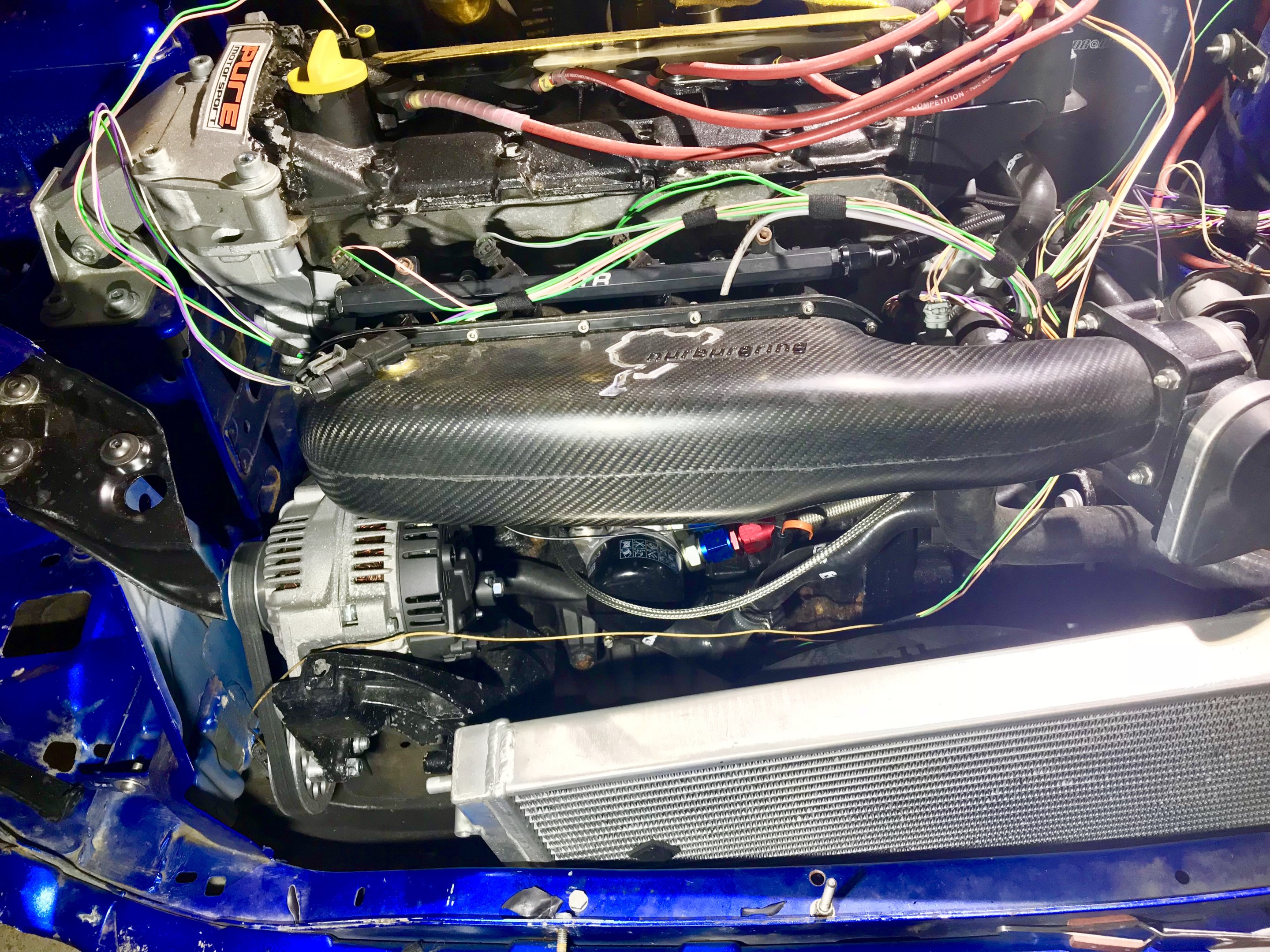

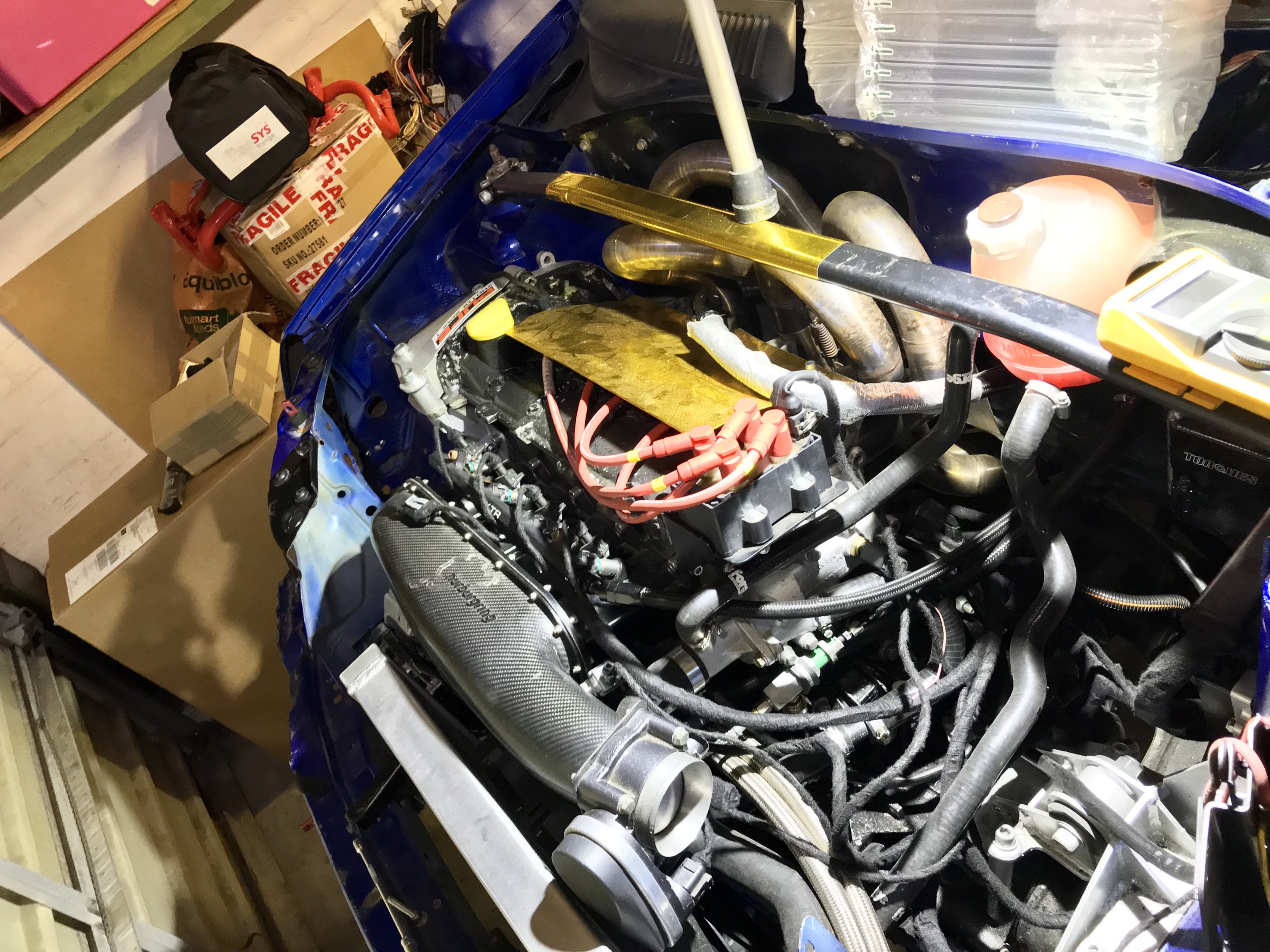

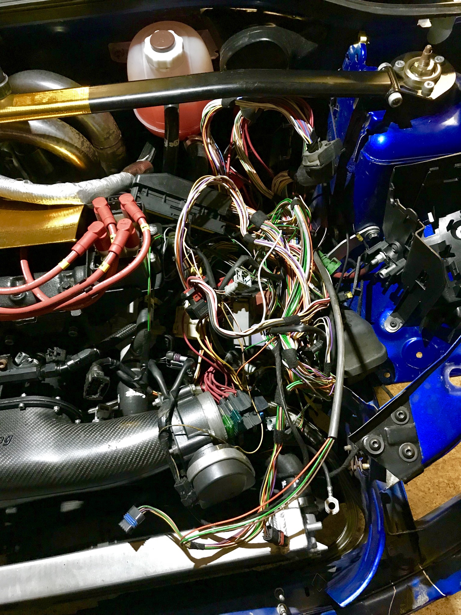

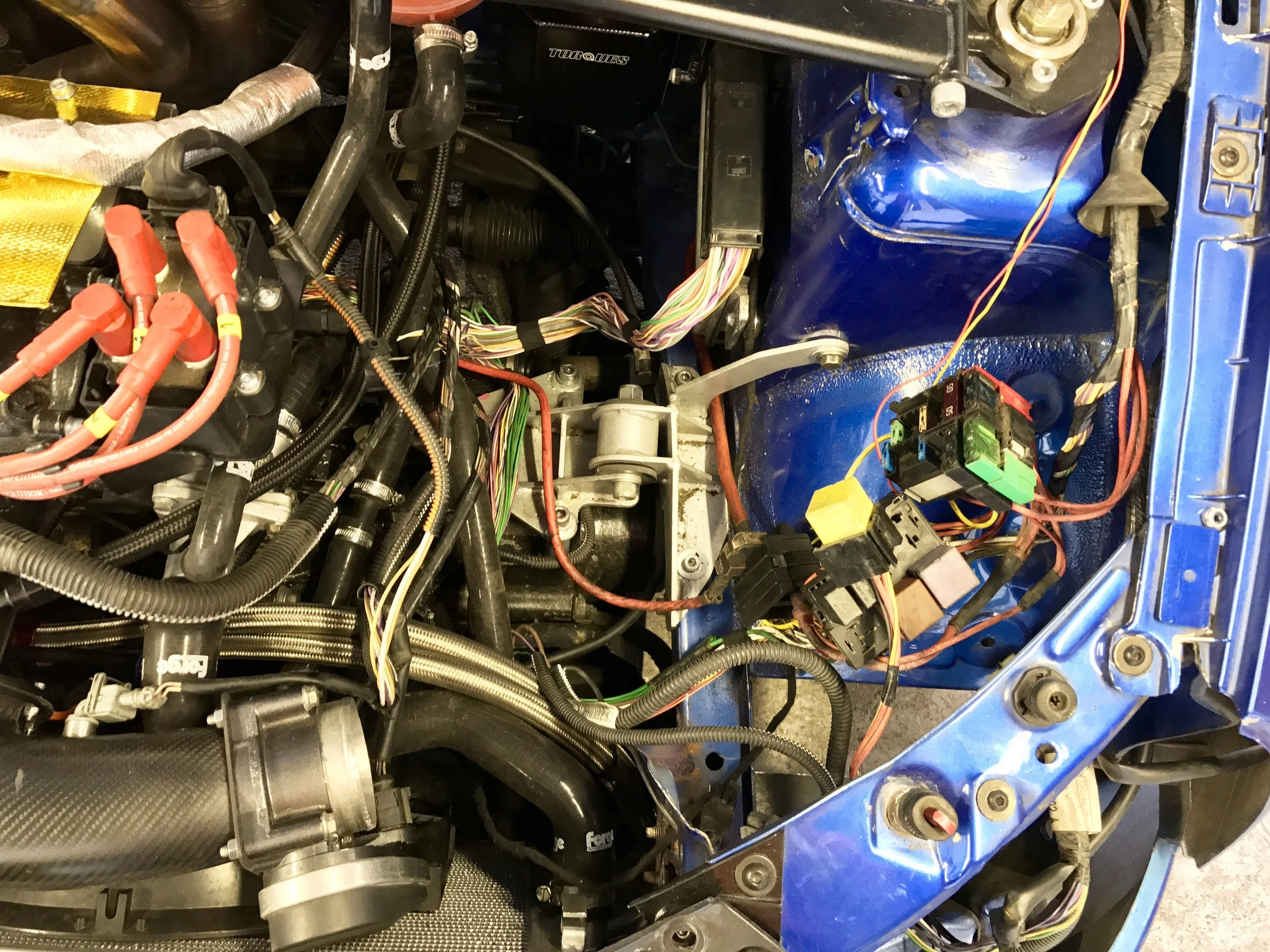

Pulled the engine loom out the car last night.
Only broke the. Starter motor in progress tho 🙈
Pulling the loom
Loom out. I like how the bay looks with no loom.

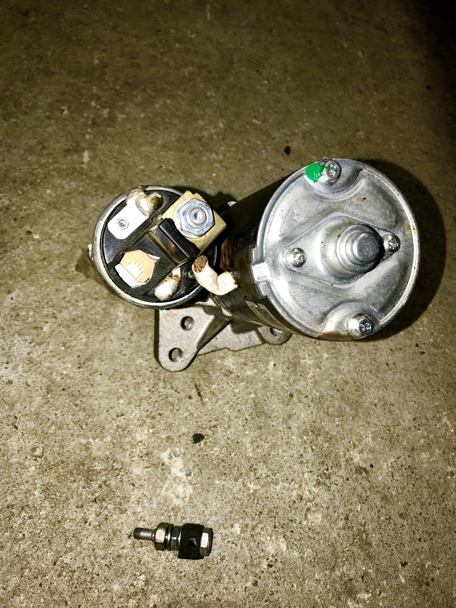

Starter terminal snapped off. Plastic went brittle.
Tonight’s job is getting the new loom back in place ready to be rewrapped and trimmed.

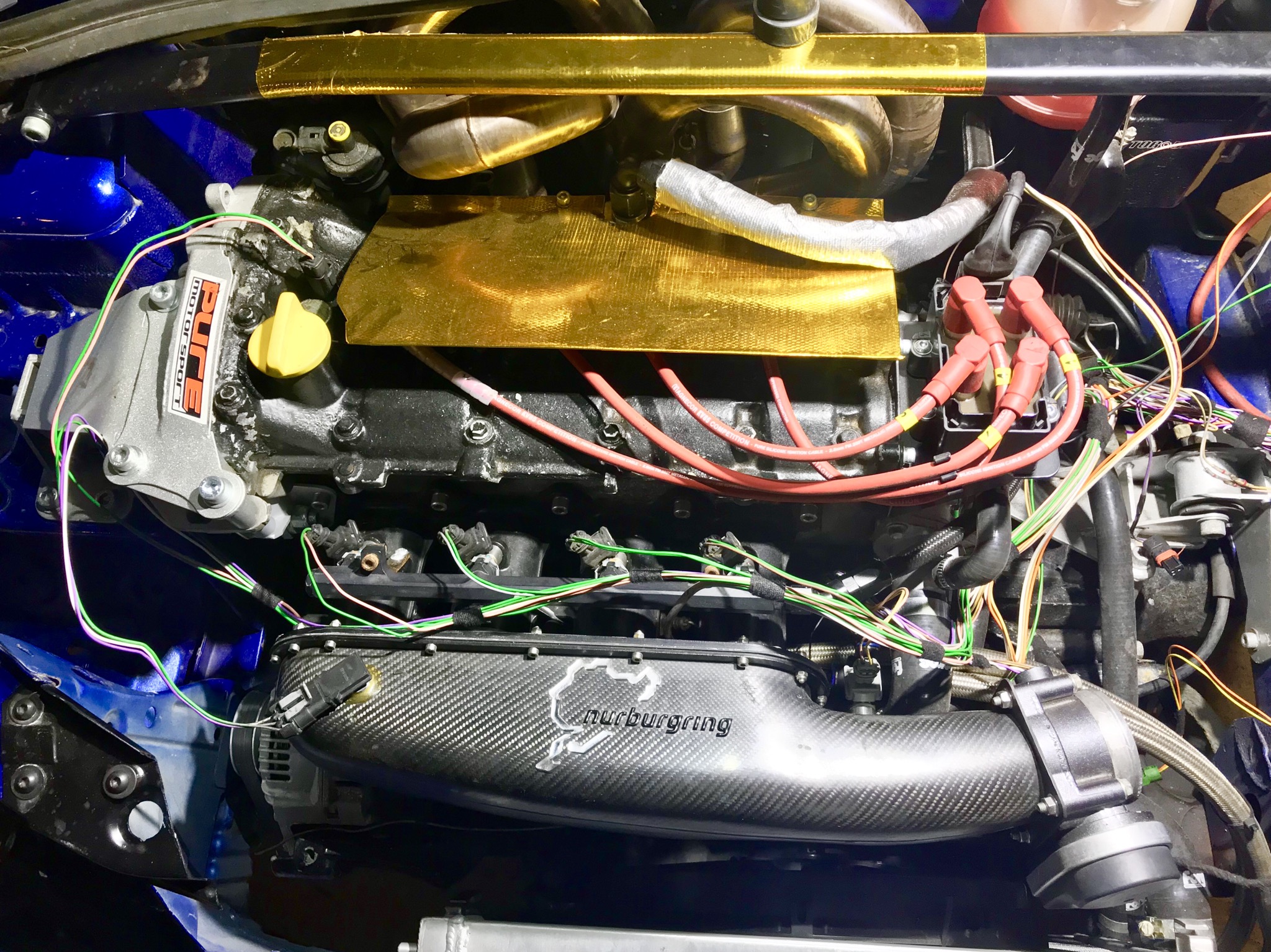

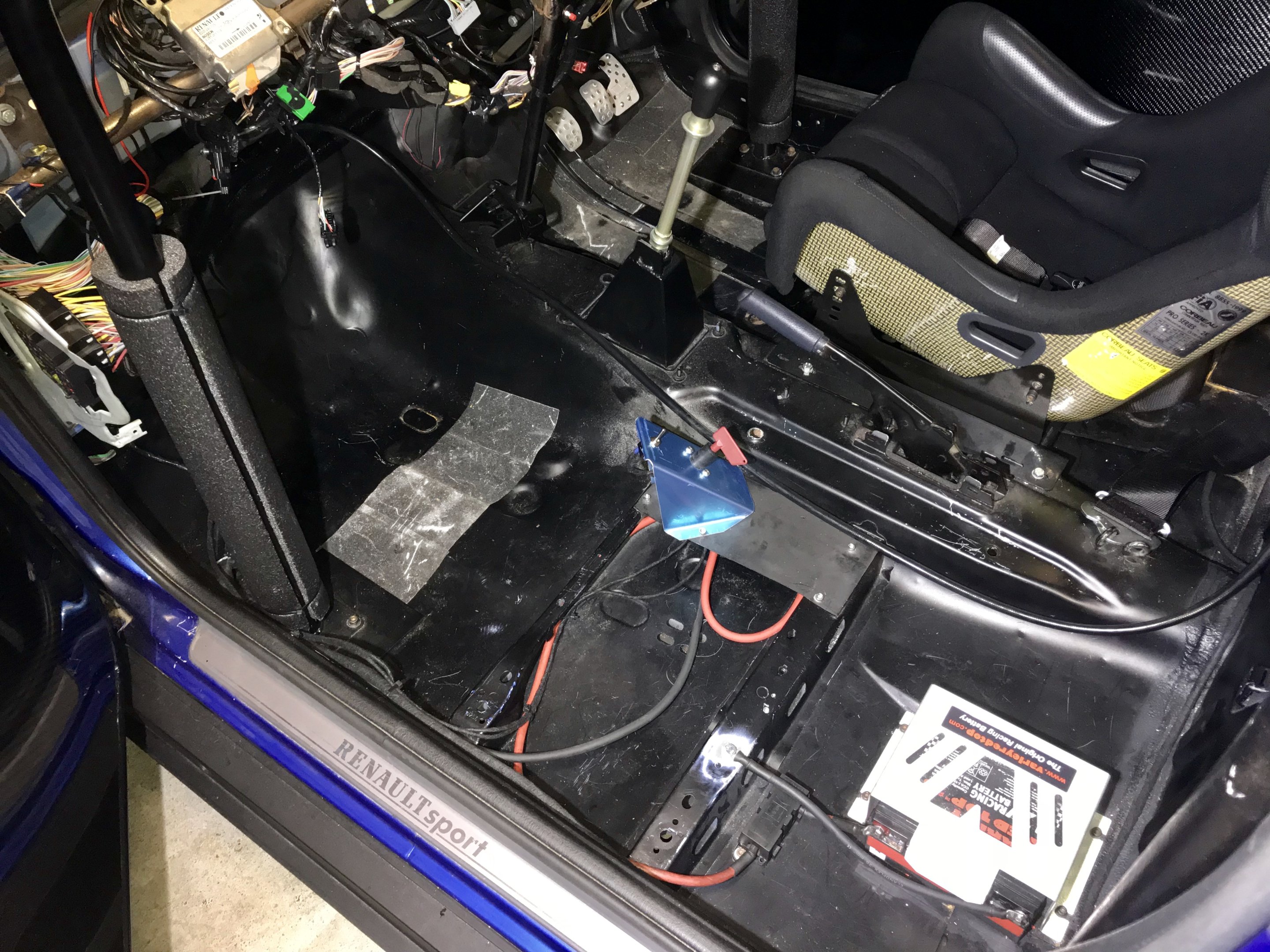

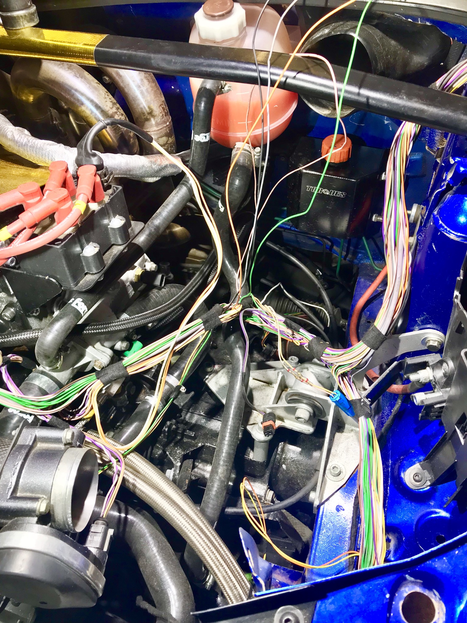

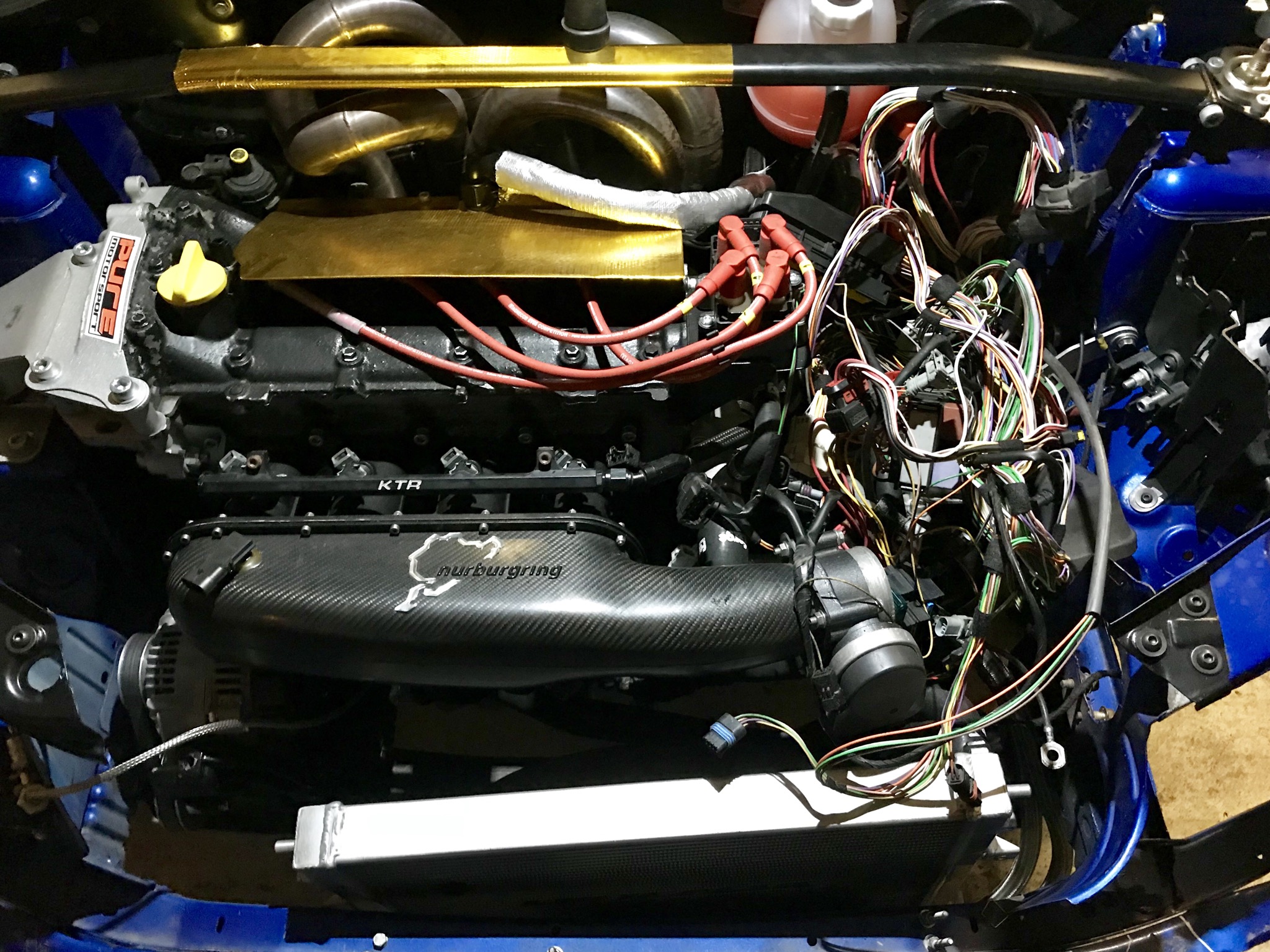

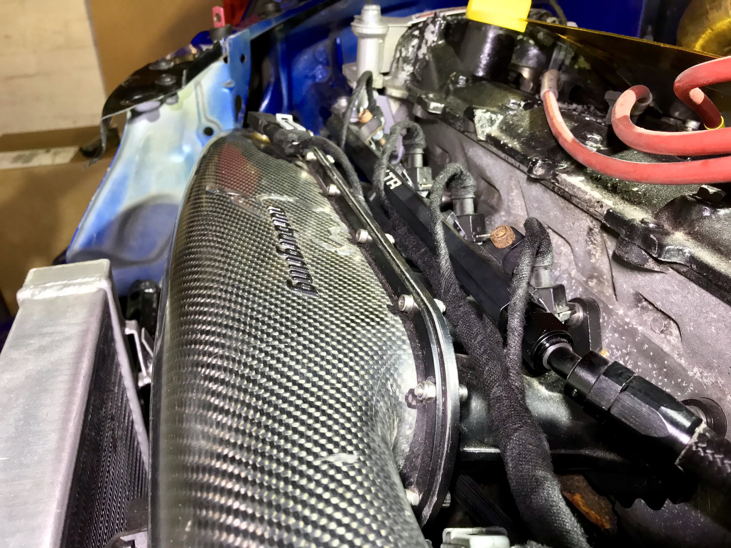

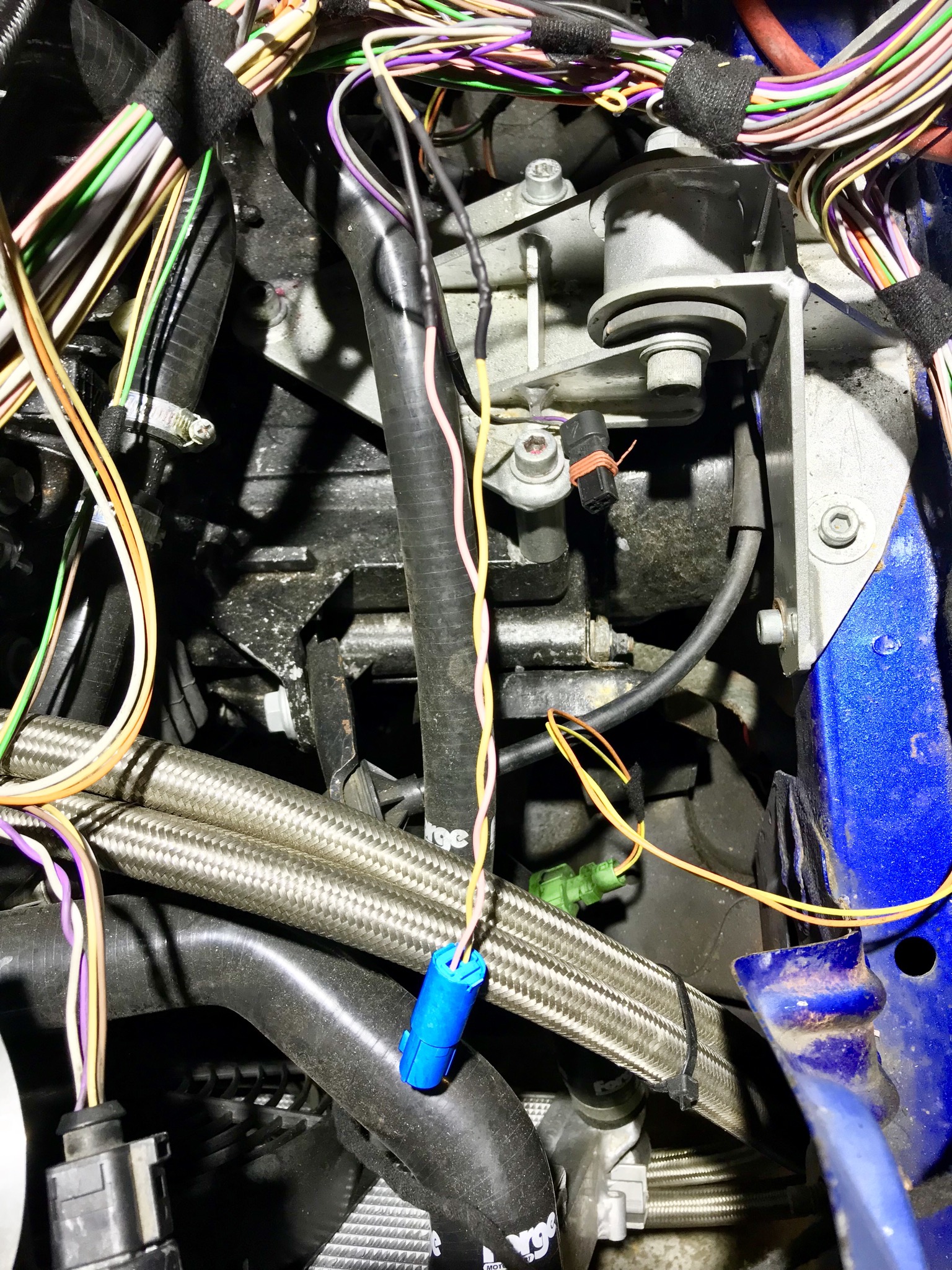

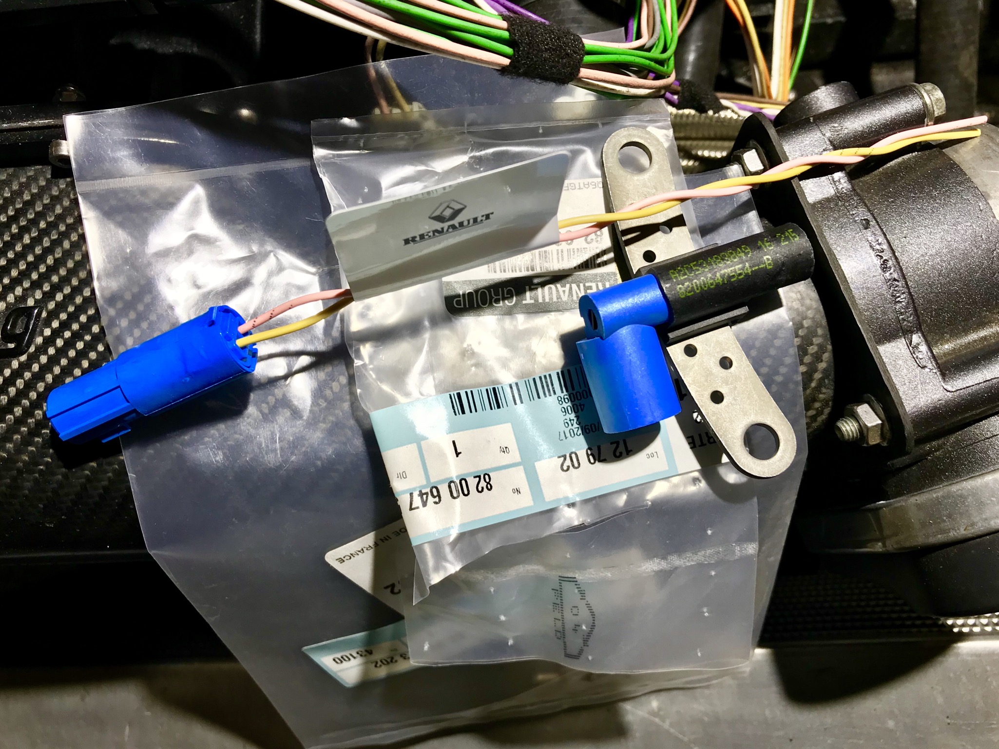

More wiring last night.
I soldered on the new type cranks sensor plug and fitted the new crank sensor, plug the rest of the loom in and tidied more of it up.

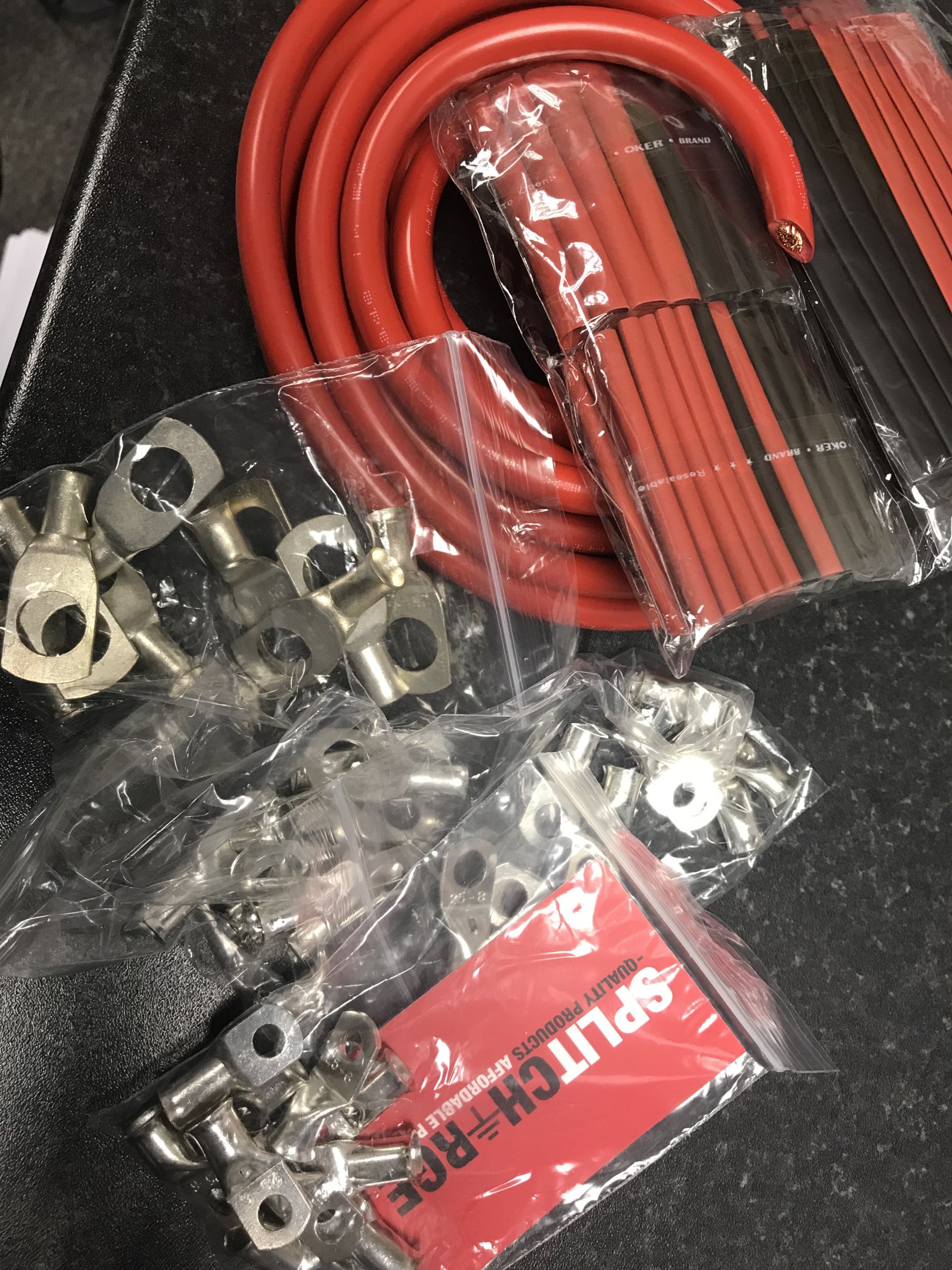

I need to get the starter power cable etc made and order some heat proofing sleeves to progress any more really.
Only pictures I took last night.

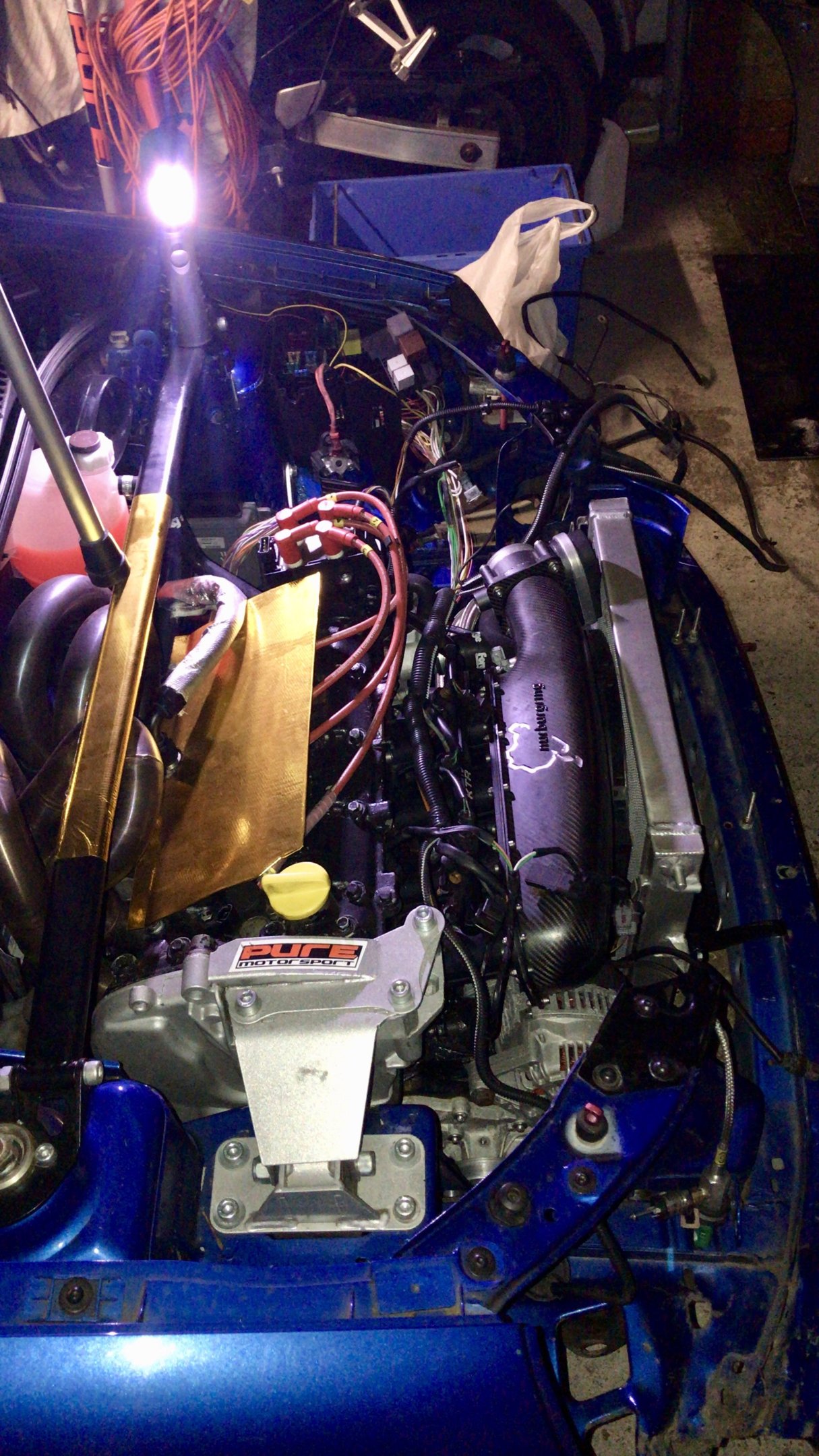

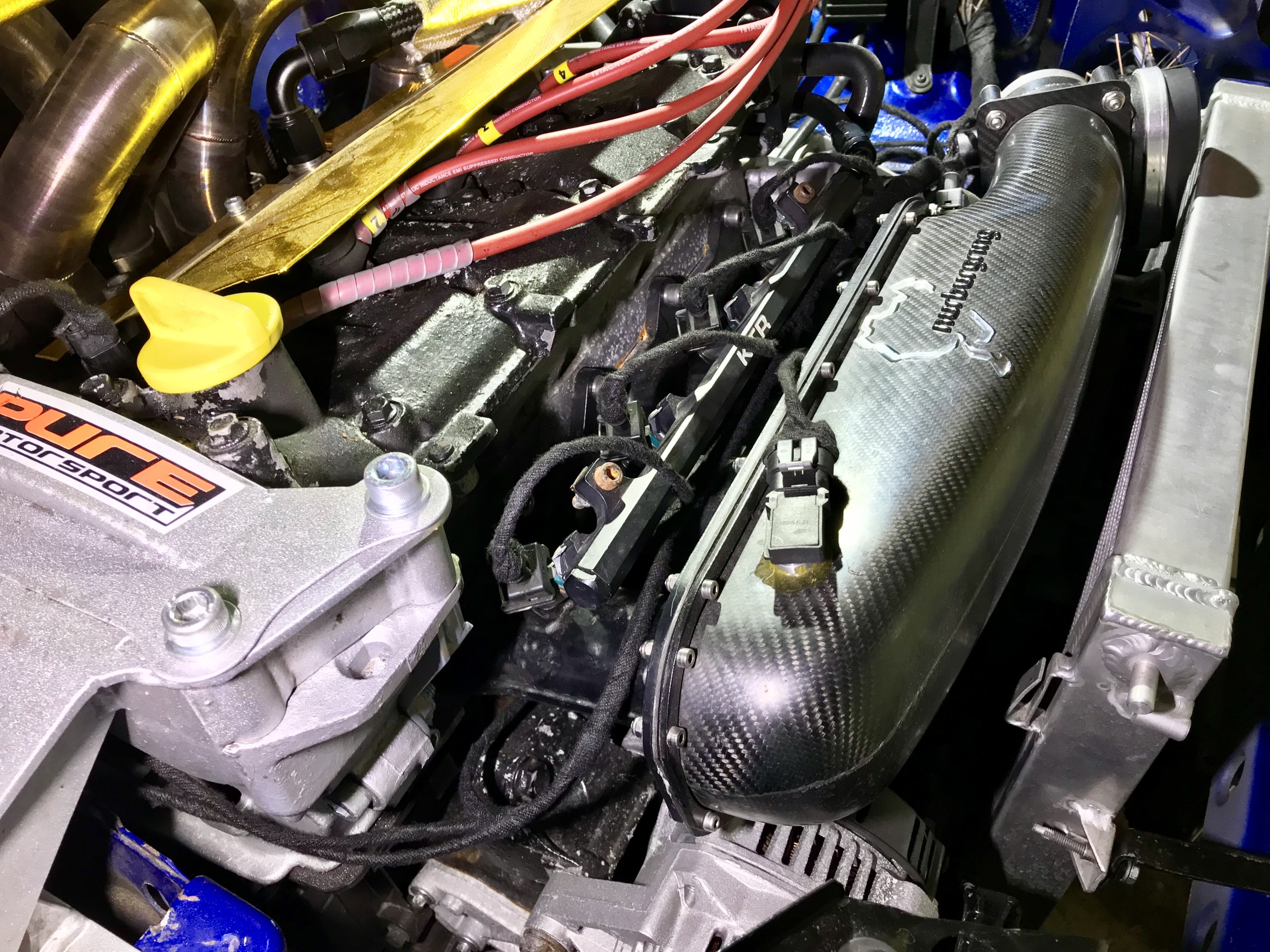

Nearly finished off the wiring loom
Deadline is looming now it booked in for mapping 🙈
To do list is mighty large still tho :confounded:

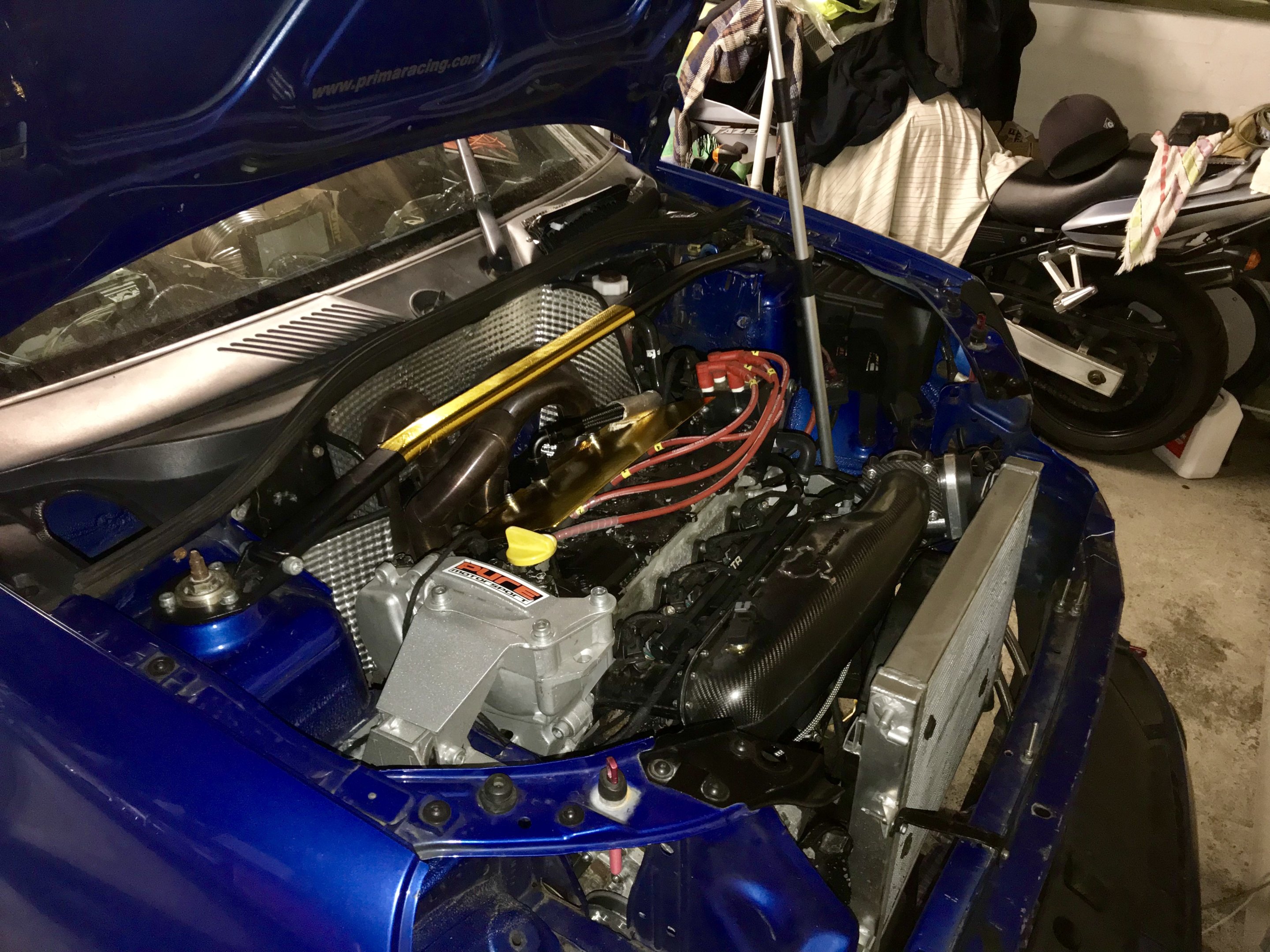

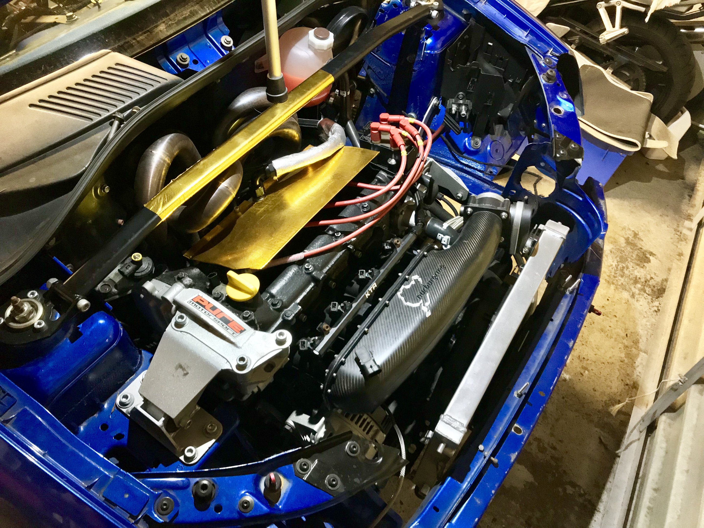

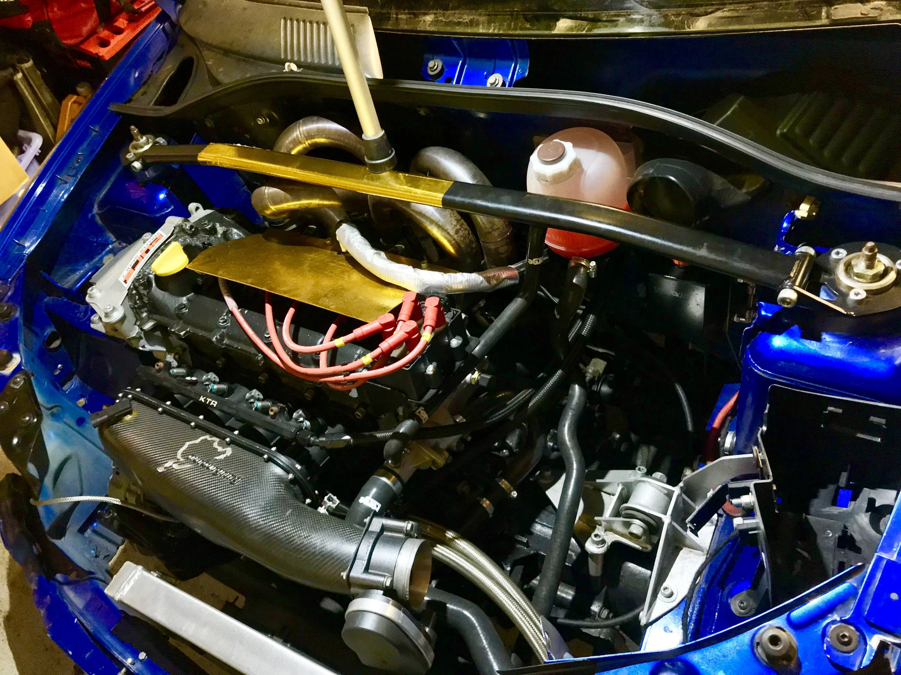

Slowly getting there.
And as time is running out and I know the car runs and starts I’ve decided to leave the interior loom as it is, well just tidy it up. Once it’s mapped I’ll strip my spare loom down properly. Need to look at getting my new dash fitted too.
