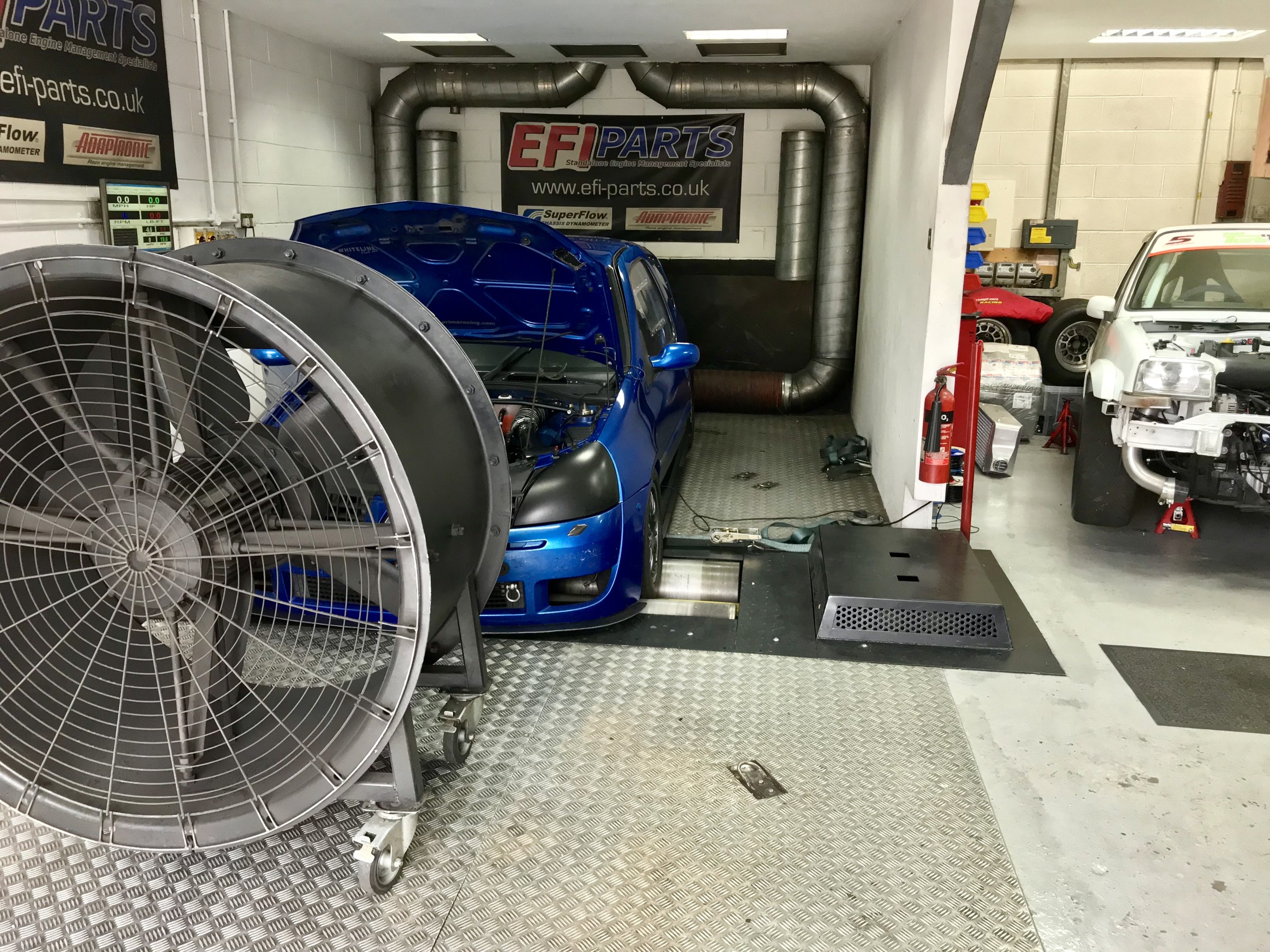

So. Bad times. Yesterday didn’t go very well at all.
Straight from the start the front lambda was not working at all so Chris couldn’t map off that, no worries he said he’ll map it like a race car but it’ll never pass mot 😂
Chris started mapping and done everything upto 2K and all seemed well.
He then started mapping higher up the Rev range. He did 1 full bore run which caused the fan belt to squeal it’s tits off and it pulled really s**t figures.
So we sorted the fan belt before it come off.
Chris did more runs with more s**t figures.
I could see Chris was thinking there’s problem here as he remember how torquey it was last time he mapped it. We did some digging and found the VVt was working correctly.
With the engine idling we unplugged the VVt solenoid and when we plugged it back in it was activating the VVt at idle!! So Chris dived into the Gen90 and found the VVt output wasnt working and had to physically move the pin in the wiring harness to spare output.
Not impressed considering this is brand new Gen90 ecu direct from Ktec.
So after a few more runs and Chris desperately trying to find an answer mapping or ecu related. After yet more runs Chris and I decided it must be engine related either compression is down or timing is out so unfortunately had to leave mapping uncompleted.
I don’t think the timing will be out as it’s barley been used since done. I’m hoping it’s down on compression just to have an answer of why.

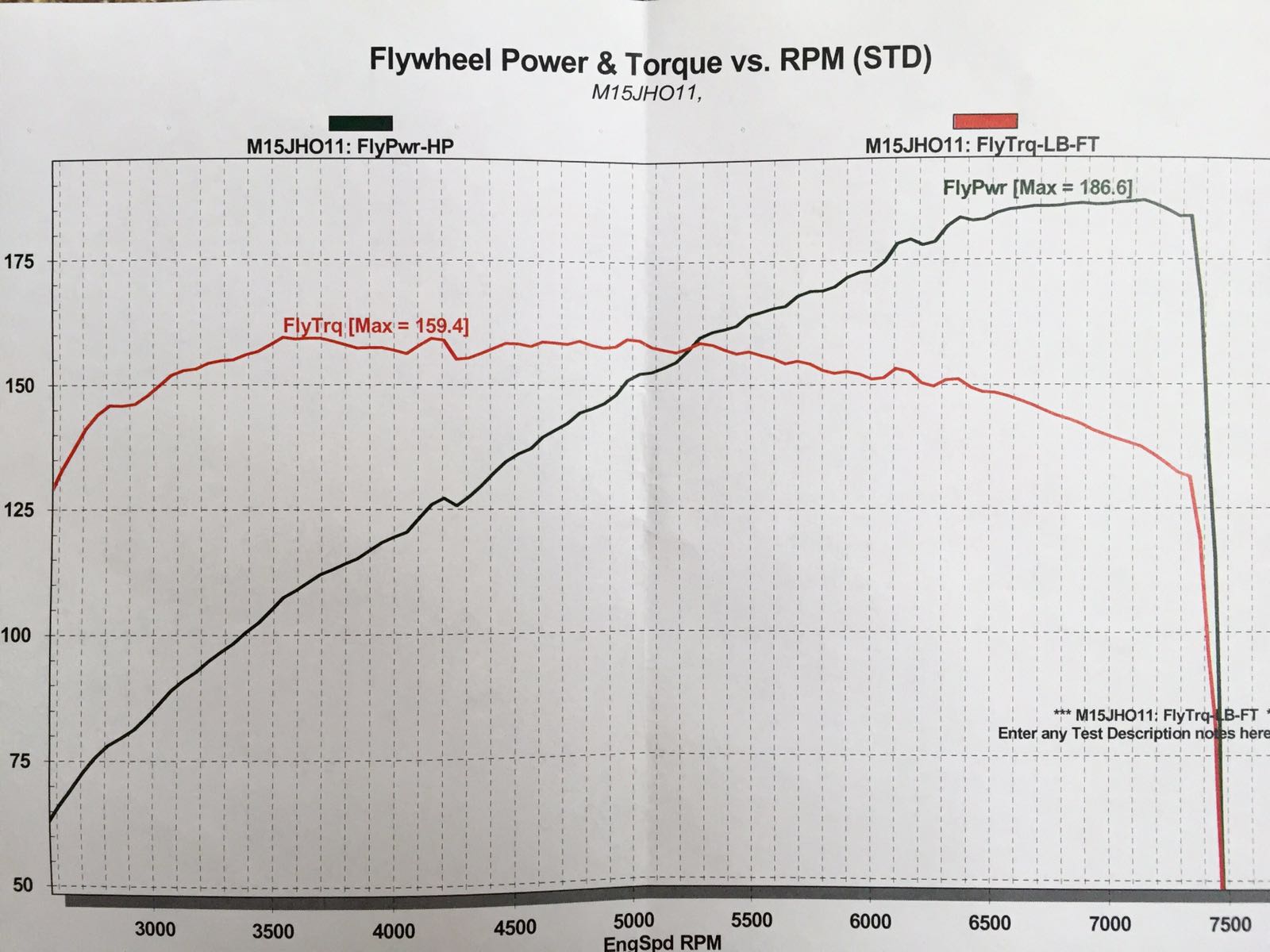

Anyway highest figure it pulled was 172bhp and 153ftlb which is about 20 down on each, I didn’t get the graph printed and can’t find my old one either!
I did share my old graph with @NorthloopCup but don’t suppose he will still have a copy.

I can send it to Scoff then and see if that graph is up across the Rev compared to yesterday’s graph.
If my thinking is right, If it’s down on compression the whole graph should lower through out the Rev range and if it’s cam timing it’ll be up/down in random areas?

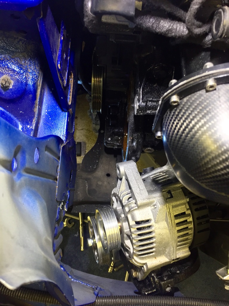

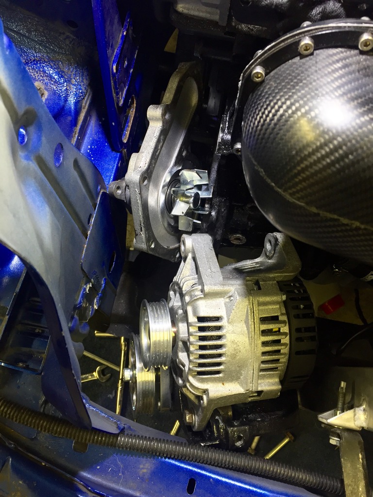

Was off work this weekend so set about changing the water pump. I order the Valeo pump that PMS sell. I checked repair times on autodata and when I saw 4.1 hours to change it wasn't really looking forward to the job.
Spoke to a few Renault specialist in my area they all said to loosen the engine mounts and push it to the passenger side and the pump will just squeeze out.
Anyway all I did was undo the 4 bolts to the alternator bracket and the top alternator bolt, pulled it all forward and the water pump was out in 20 minutes happy days.

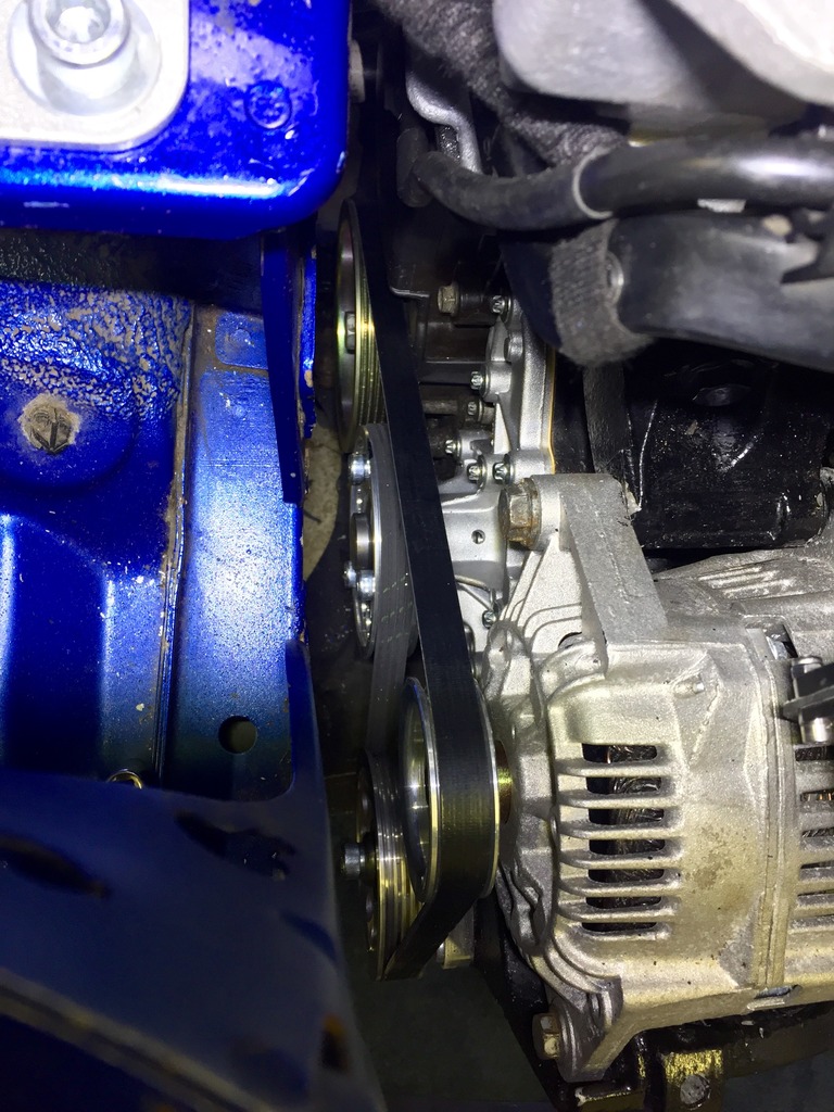

10 minutes to clean the old gasket off and 25 to fit back together and tension the belt it was done. Happy days.
