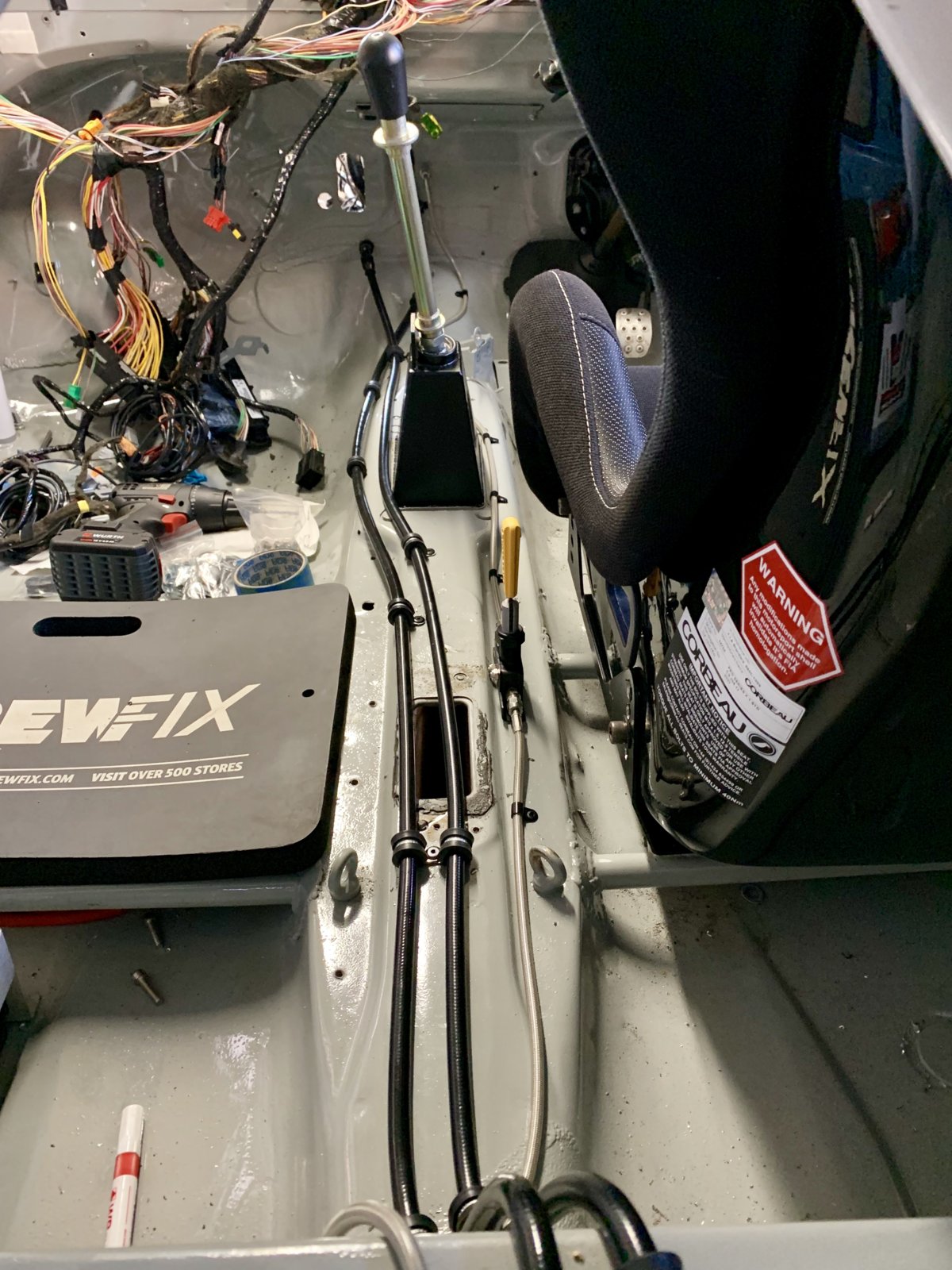

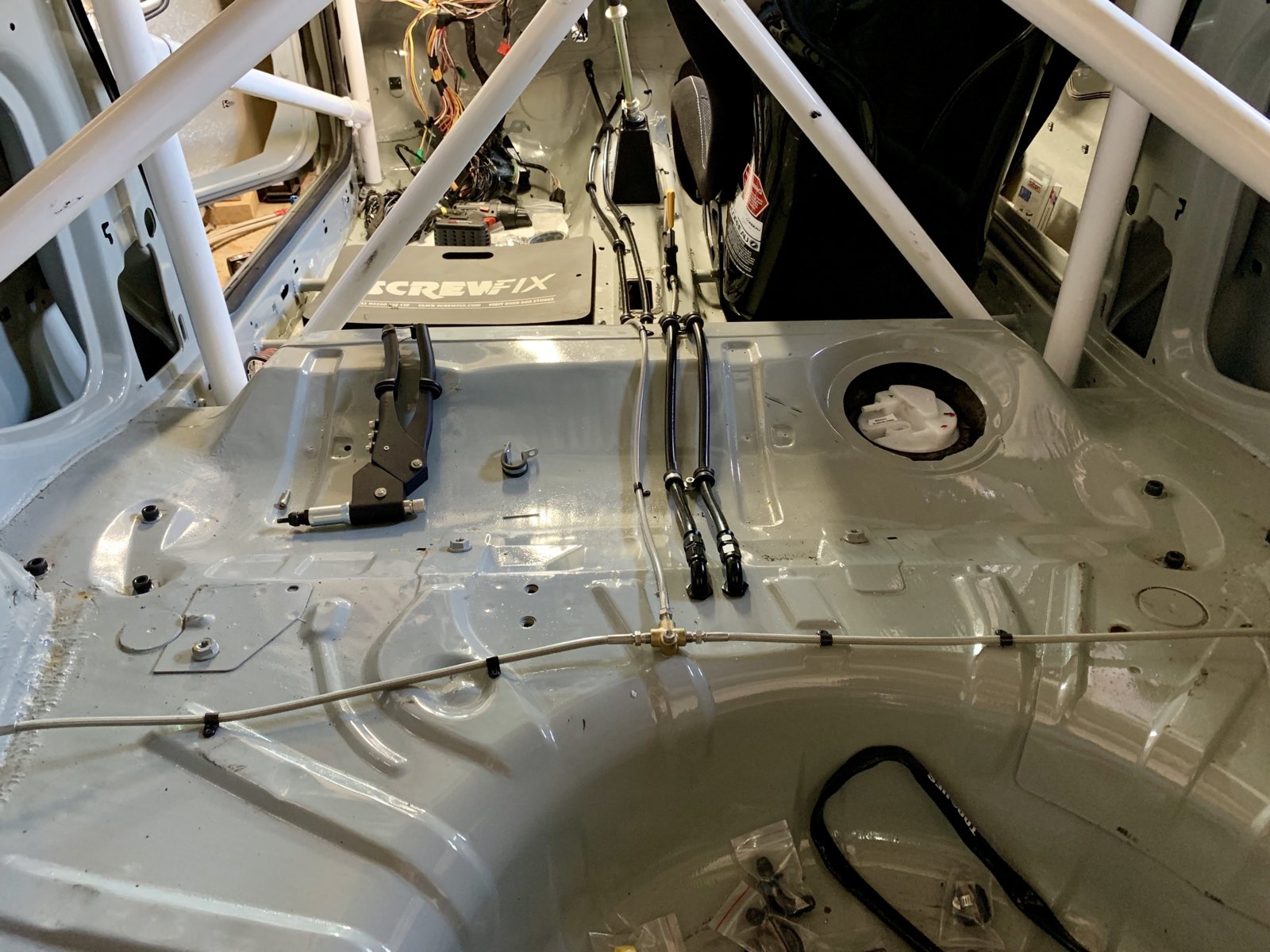

I braved 10 minutes in the garage today to rivet down the brake lines and mount the bias valve.

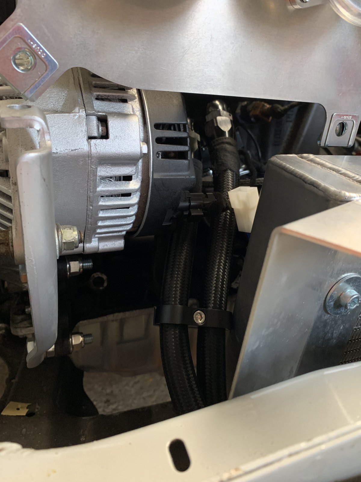

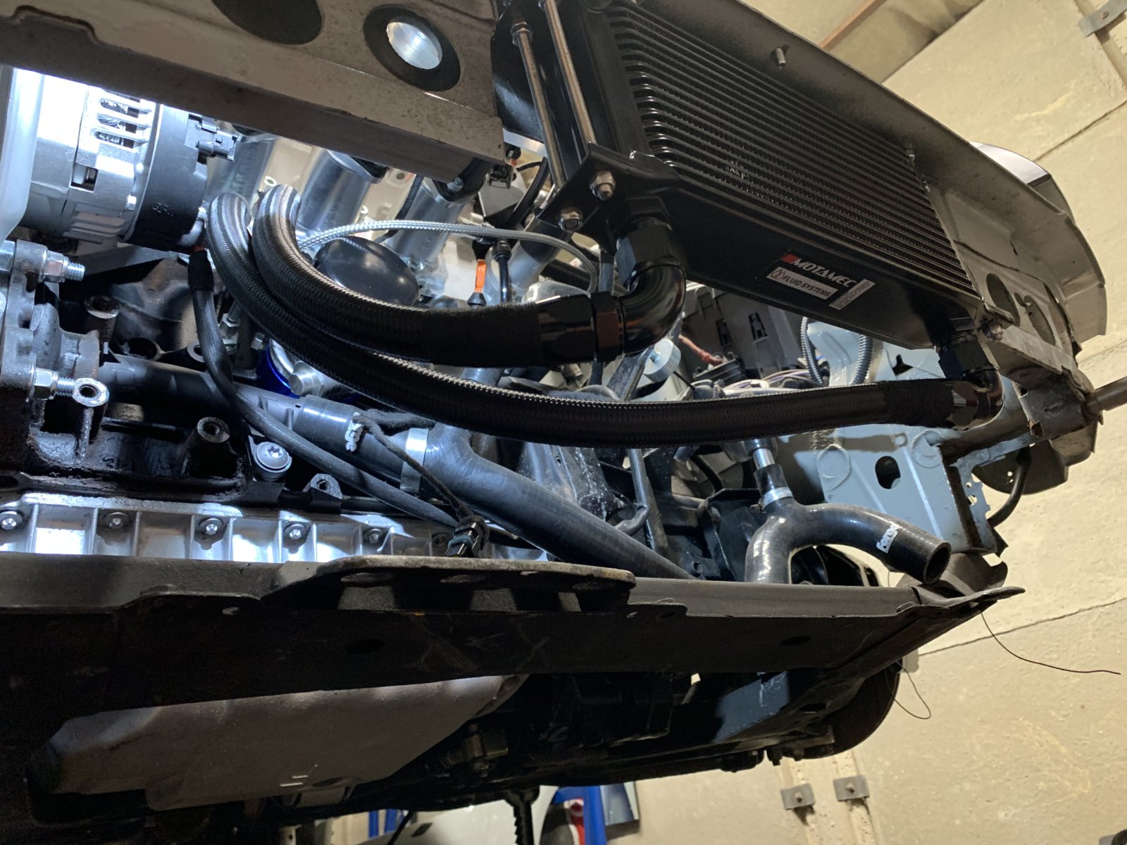

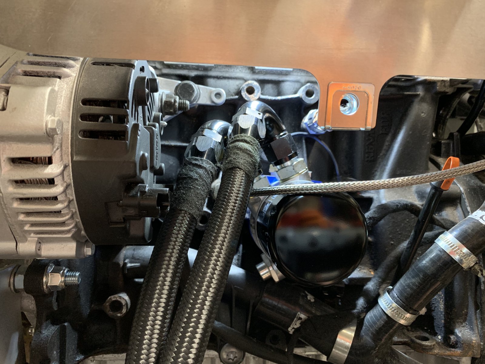

Made new oil cooler lines tonight as wasn’t happy with the original ones off the blue shell.

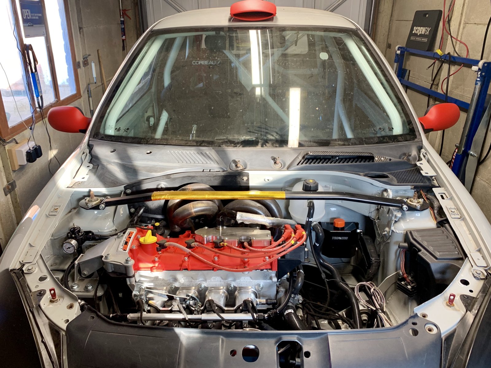

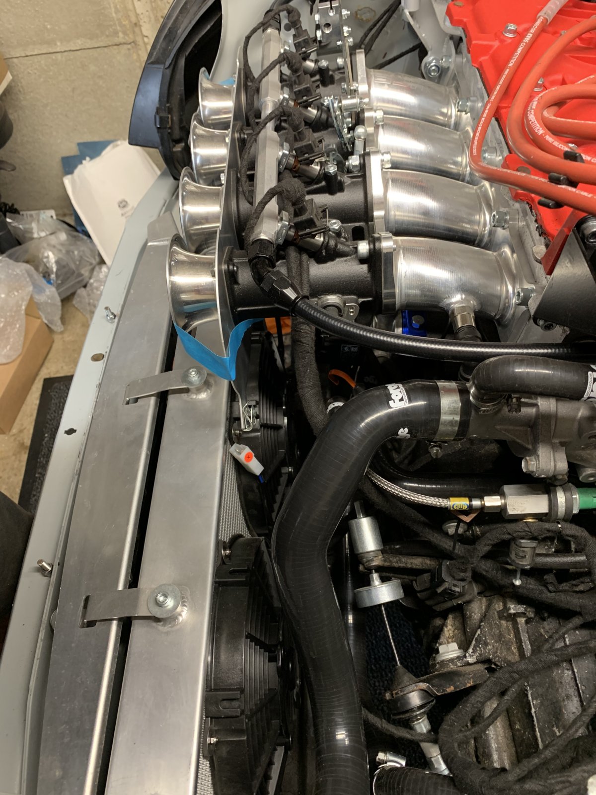

I also made the brake servo vacuum line to the ITBs and tighten all the coolant hose jubilee clips bar top and bottom rad hoses. This must mean we’re getting close to putting fluids in the lump.

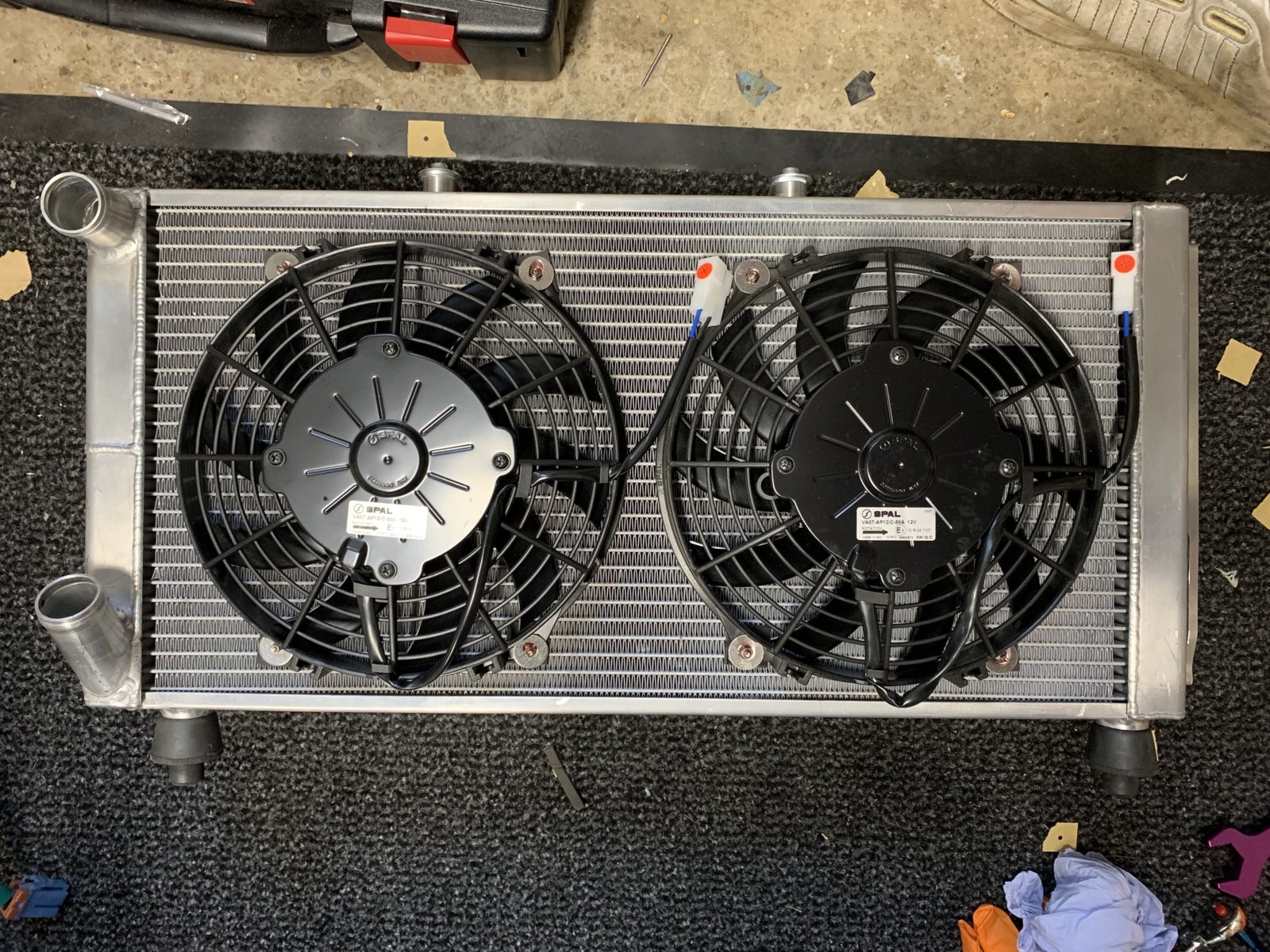

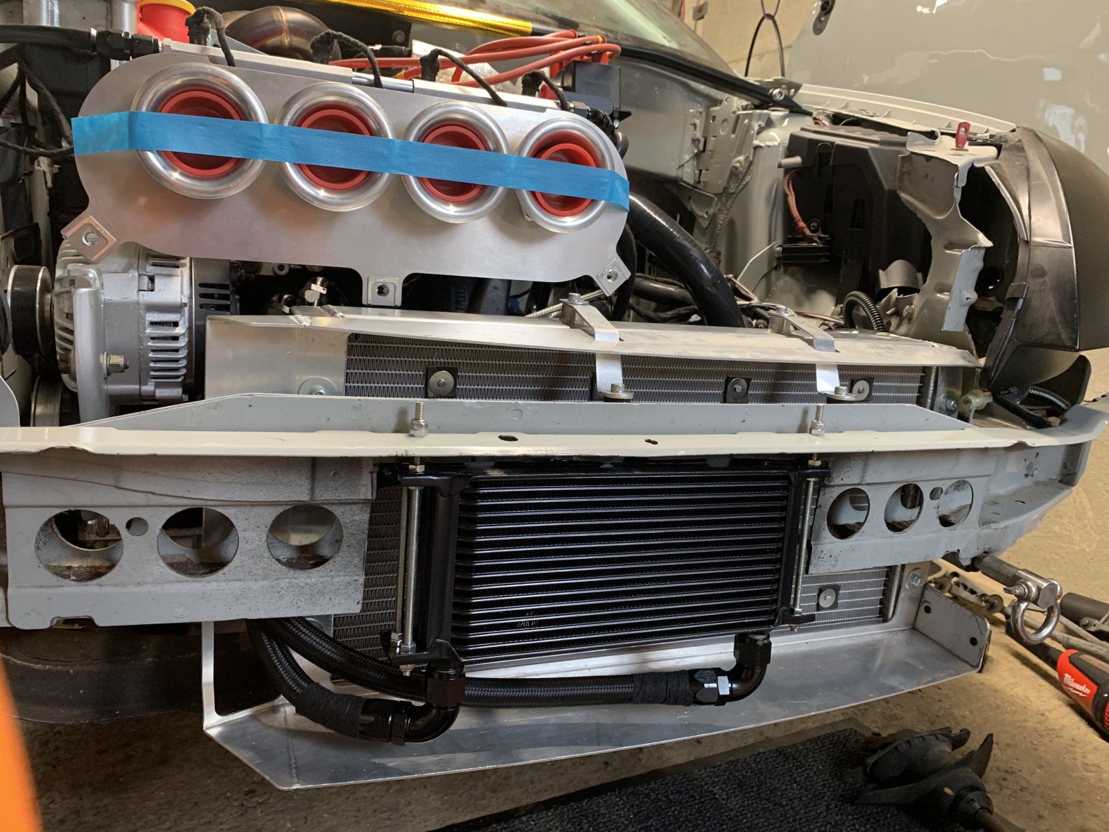

Oiler cooler, rad and fans all done now.

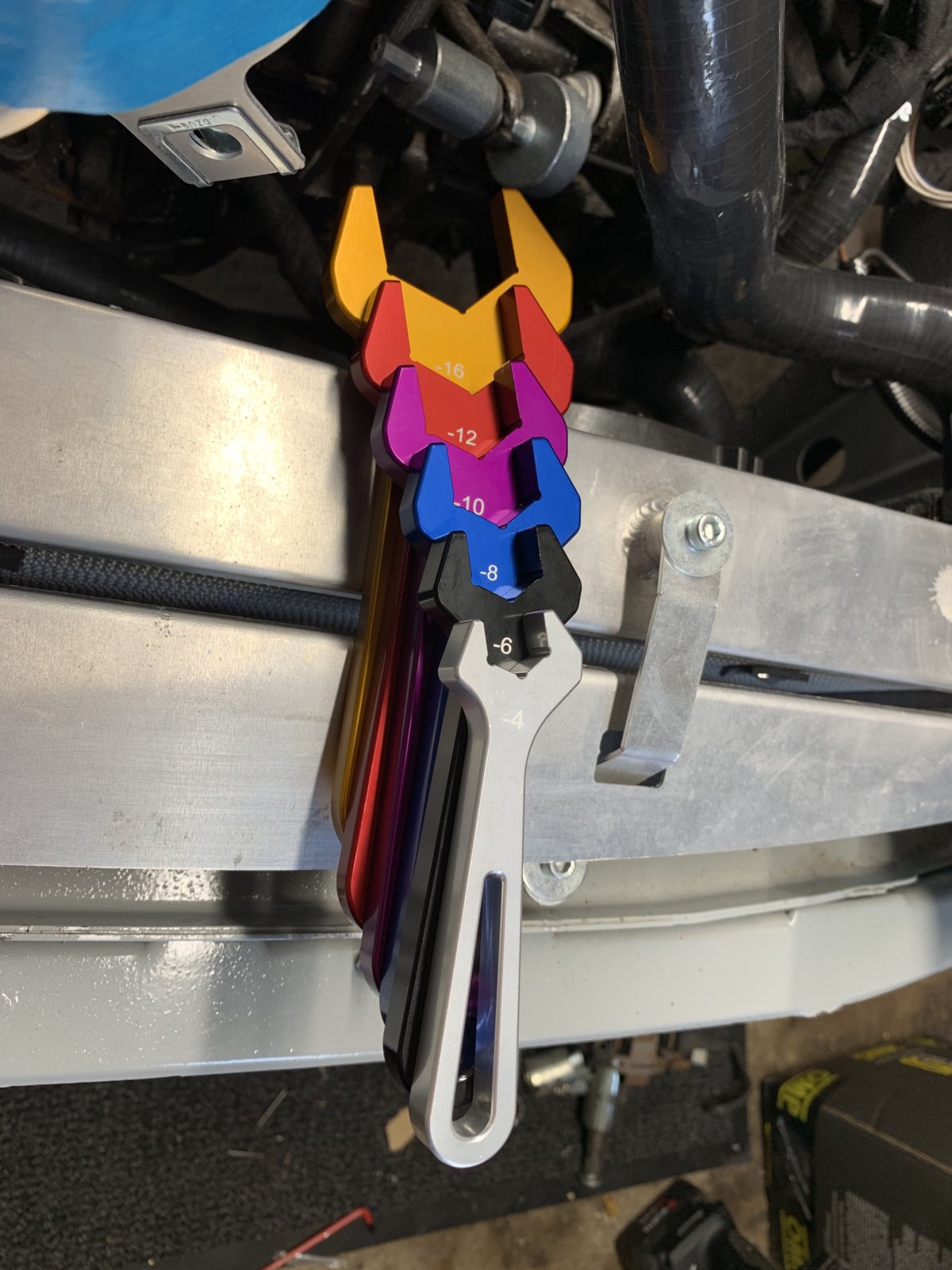

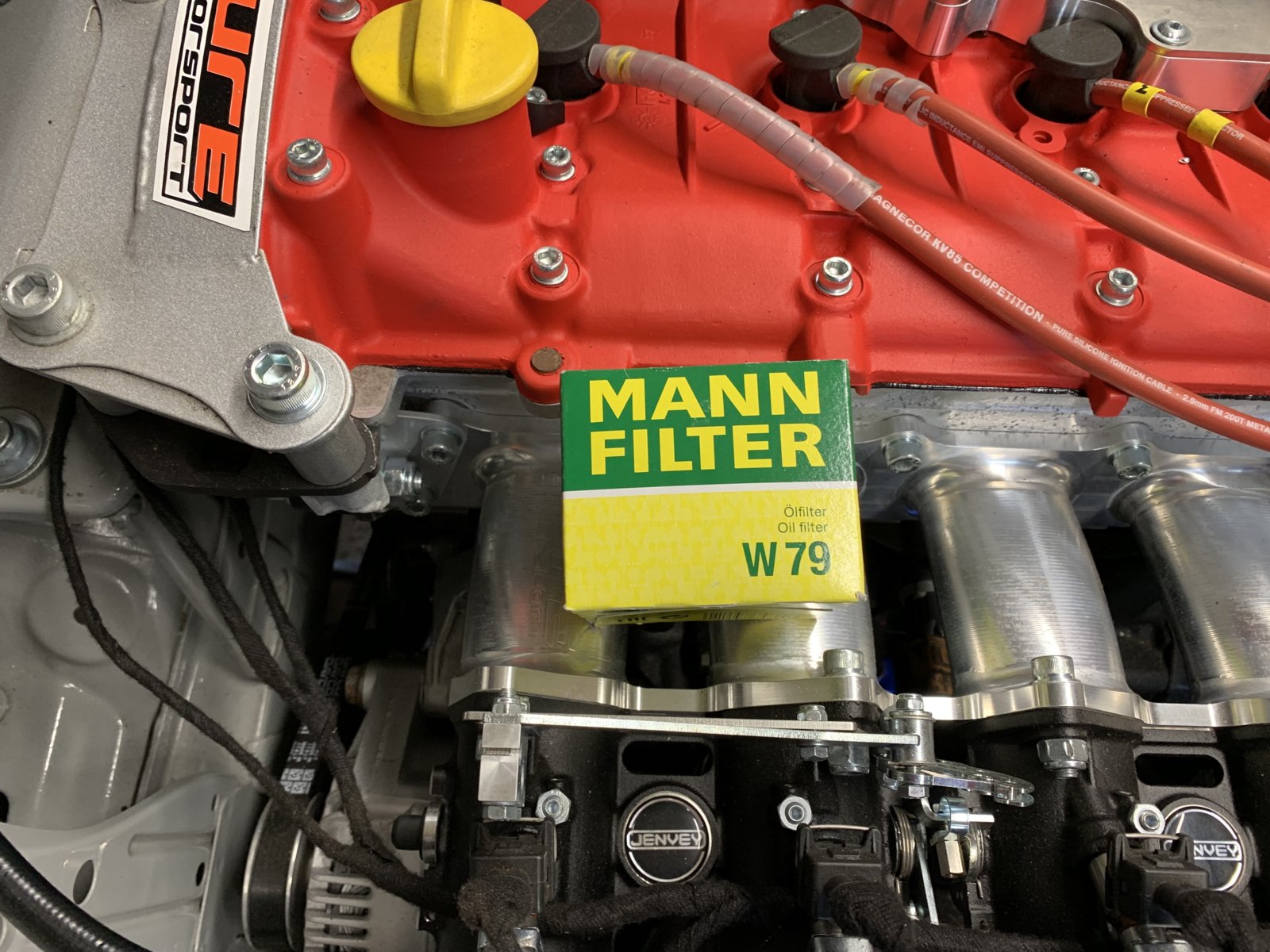

I brought some proper AN spanner’s to make life easier and fitted the larger oil filter to make it easier to remove.

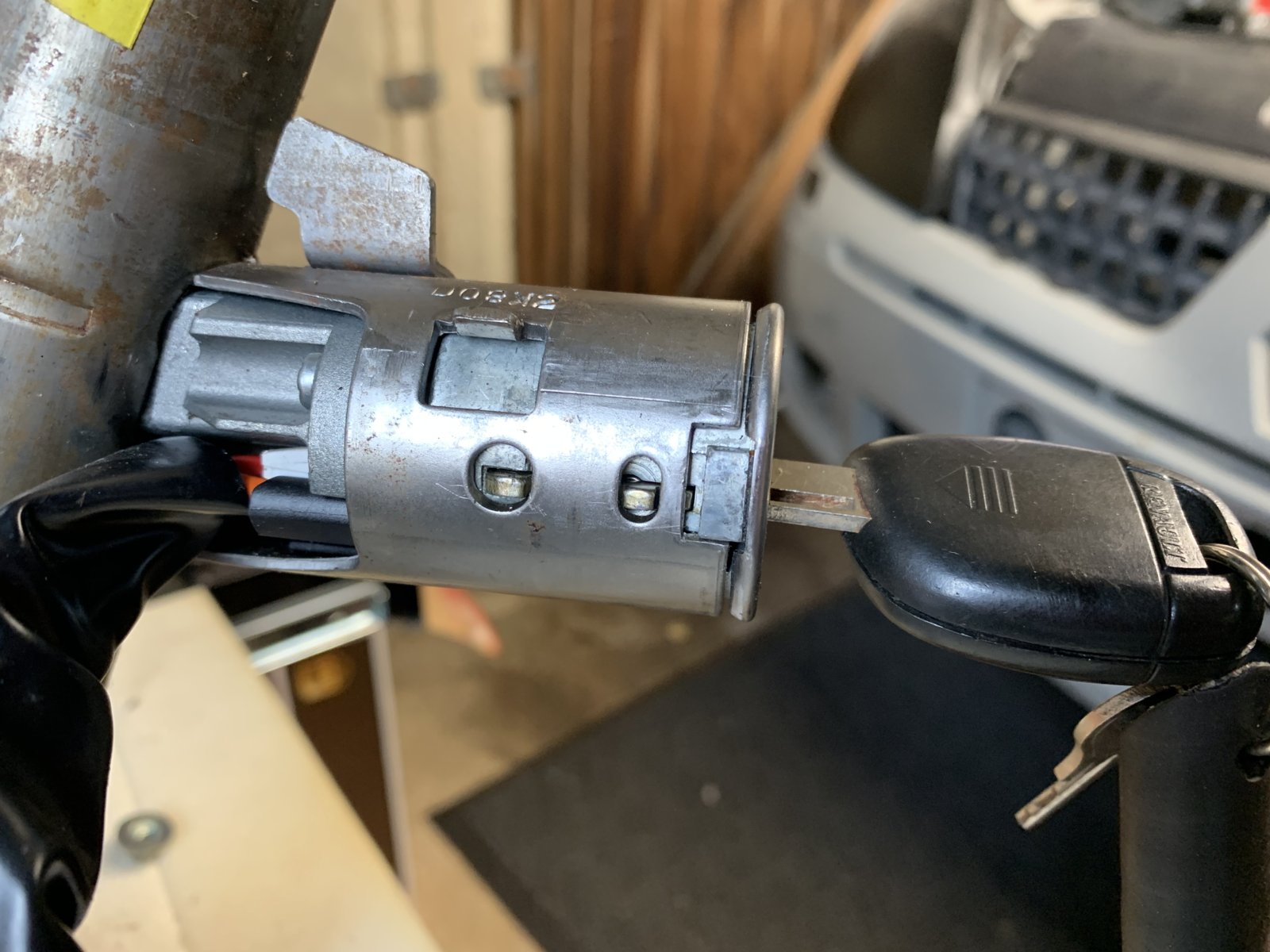

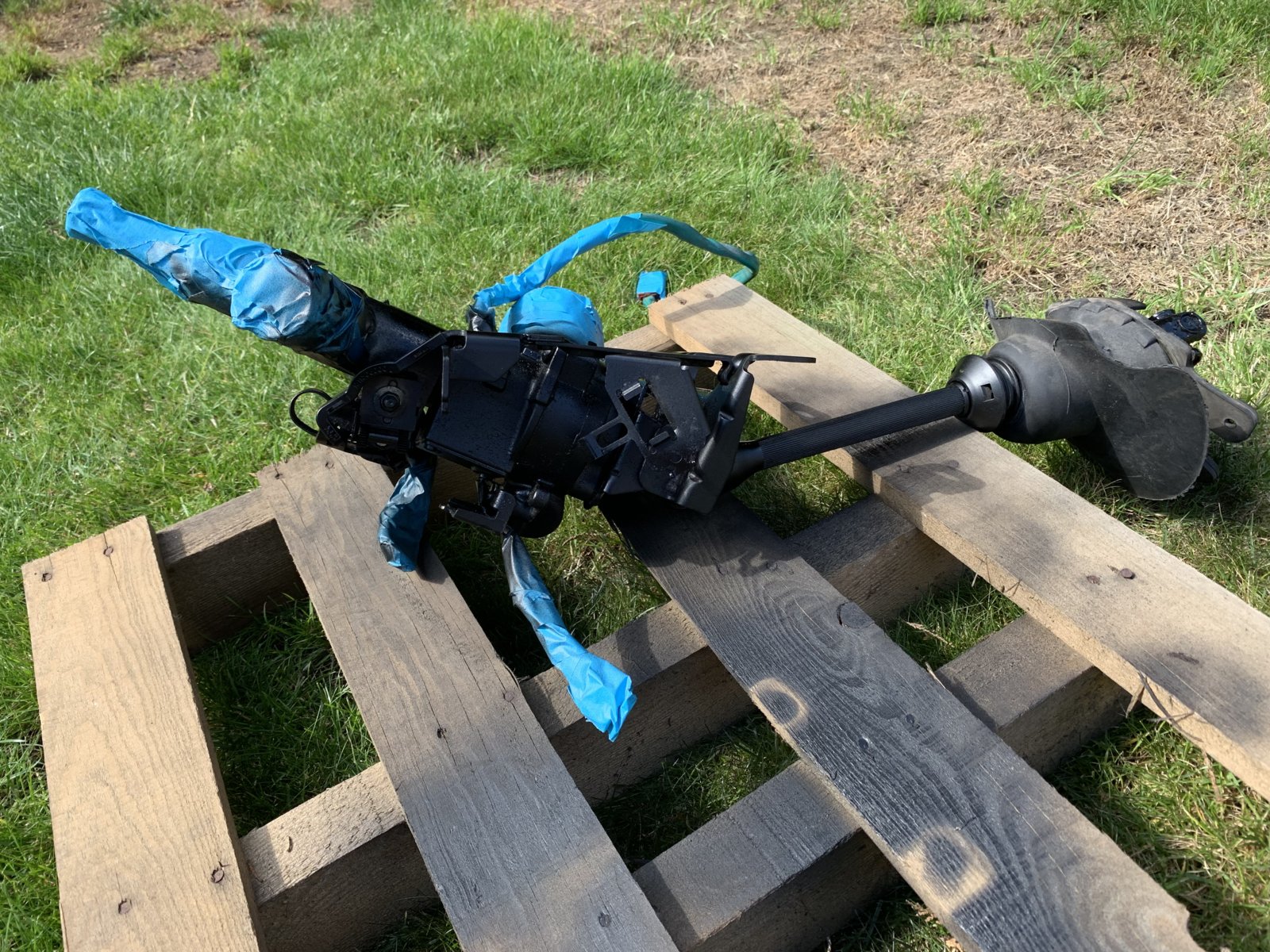

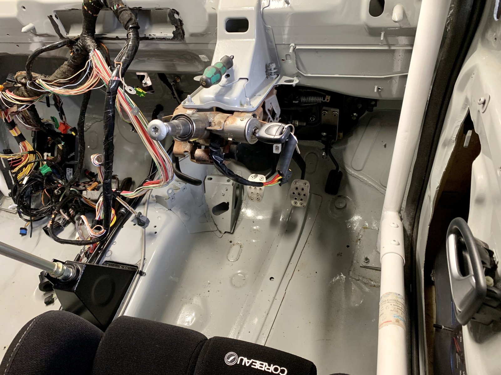

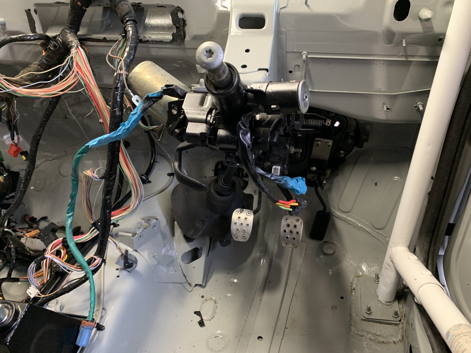

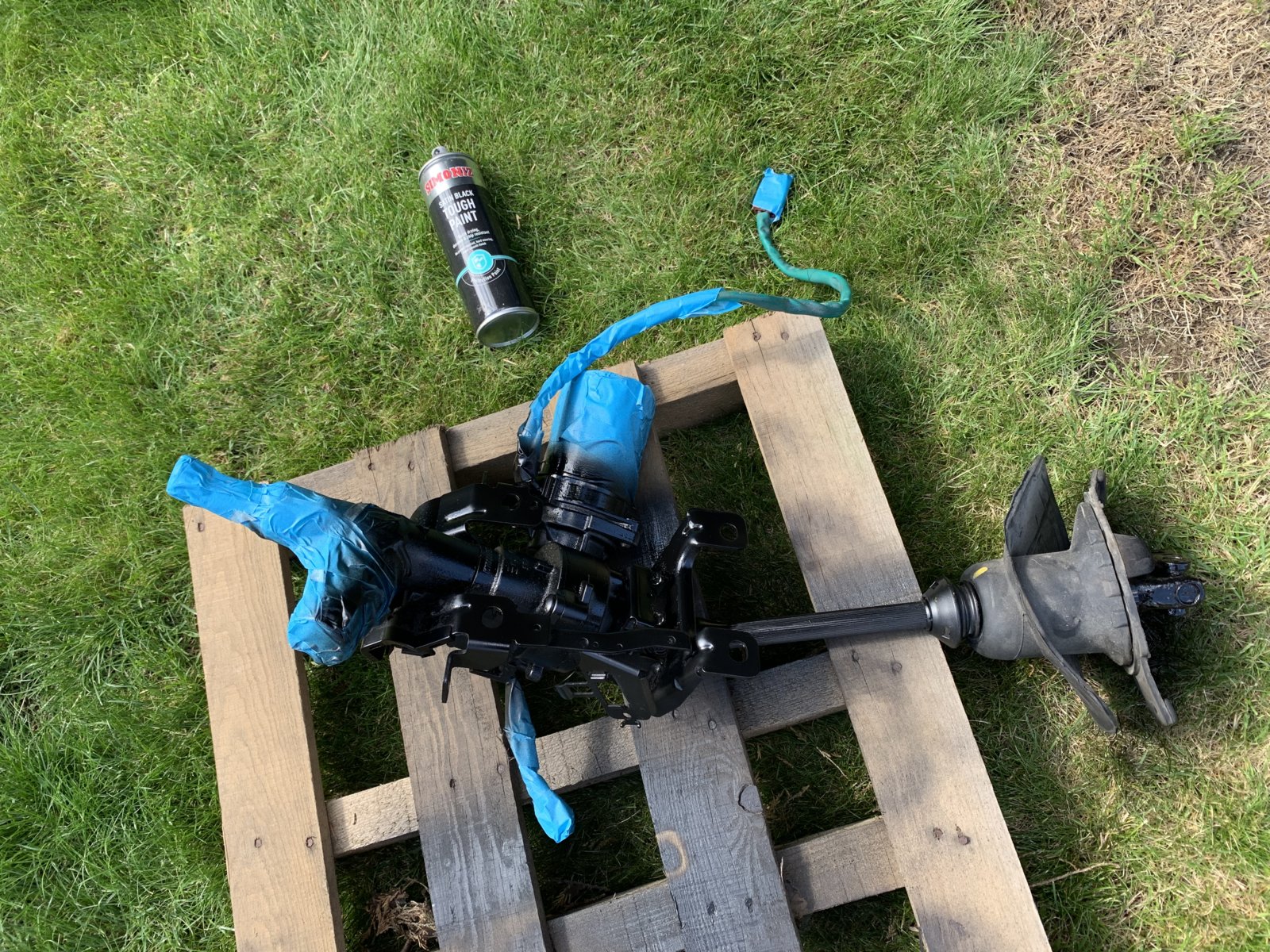

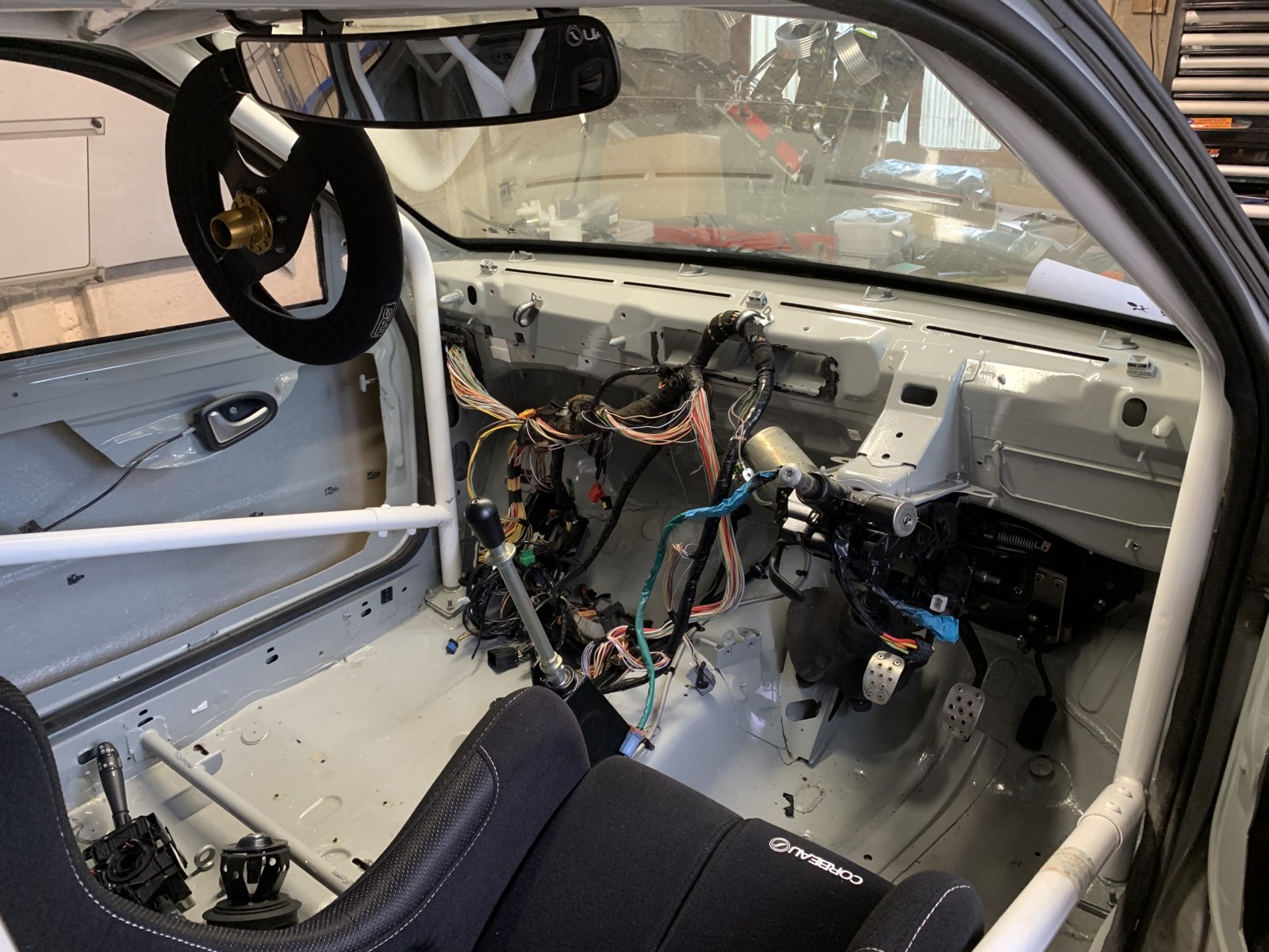

Also started tided the inside up and started removing the steering column.
Can someone confirm how the ignition barrel comes out please ?
Looking forward to seeing this up and running! Im very envious of the engine bay ?
For ignition take out the small torx screw, then as you turn the key to start you pry a couple tabs underneath

Did you bend the fins and pop threaded bar through for the fan mounts?
I brought these off eBay
181987543815
Thought they’d be s**t tbh but turned out alright. I don’t like the plastic pull through mounts as I’ve had them break and the fan move on a track day.
All I needed to do was make 1 fin round, if that makes sense. Used a small flat head screw driver, made a tidy job of it.

Yes, I’m not a fan of the plastic ones either and find they aren’t very tight either

There is a load of meat left on that column that could of gone, I guess you still need the key though?
All looking like its progressing well though.
Thanks bud.
Your right about the column, it’s not attached to the rack yet as it’ll be out again shortly ?
Need to mount the dash and ecu etc and then remove some of the weight lol.
Regarding the key, I’m not 100% sure what I’m doing yet, I keep looking at yours and how tidy the loom and ecu is, and it’s making me wanna go that route which I’m in process of researching and fire emails out, but my plan currently is wire it all up with the standard loom and Gen90 and make sure the lump turns over ok.
