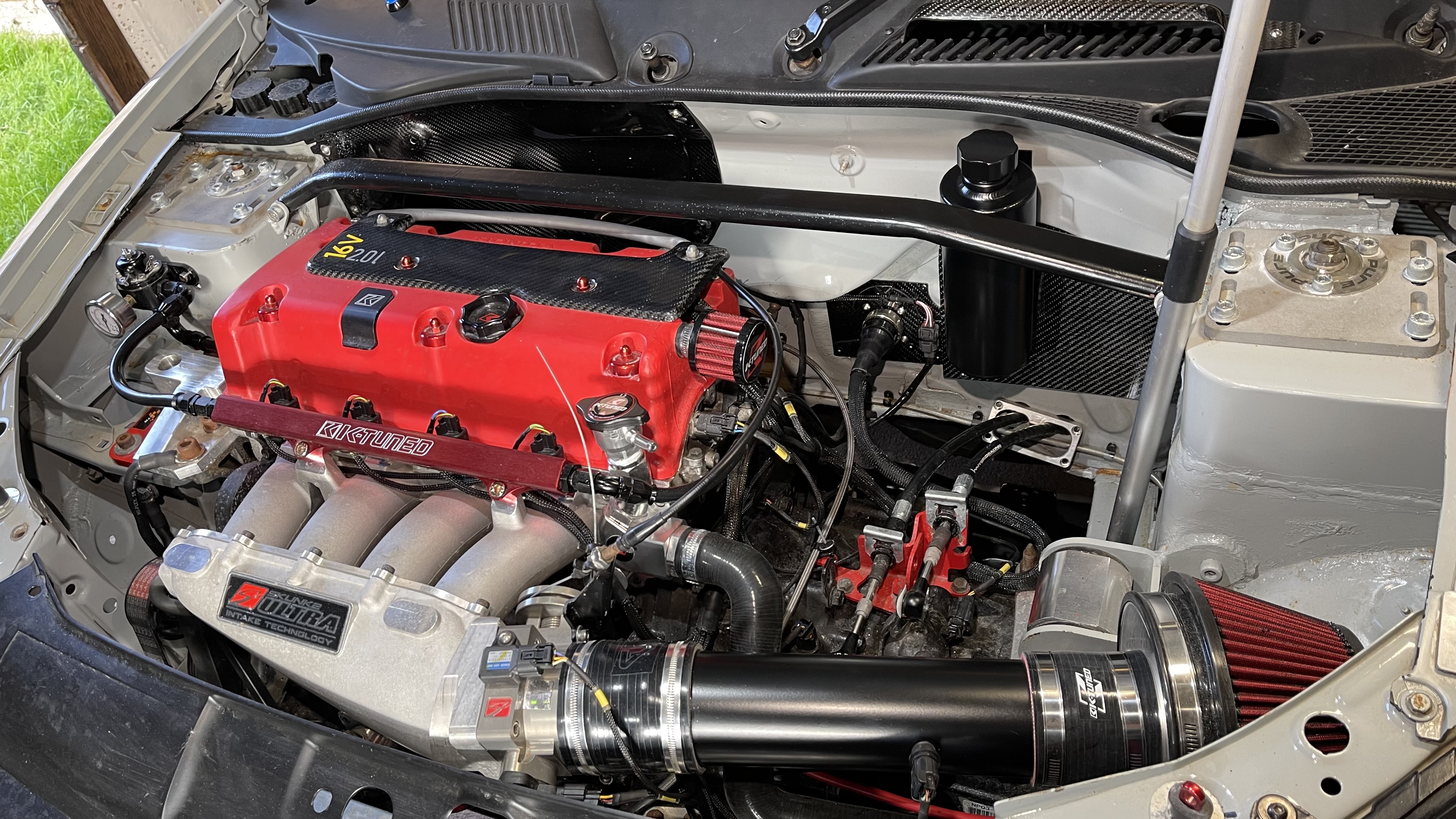

Well in chambers mate buzzing for you - that feeling of getting it running!! I will hopefully see you at a track this year - we should organise a day somewhere for all the swapped lads #kswaptheworld and all that 😎 I’ve still got loads of bits to do but the end is near 🤟🏼

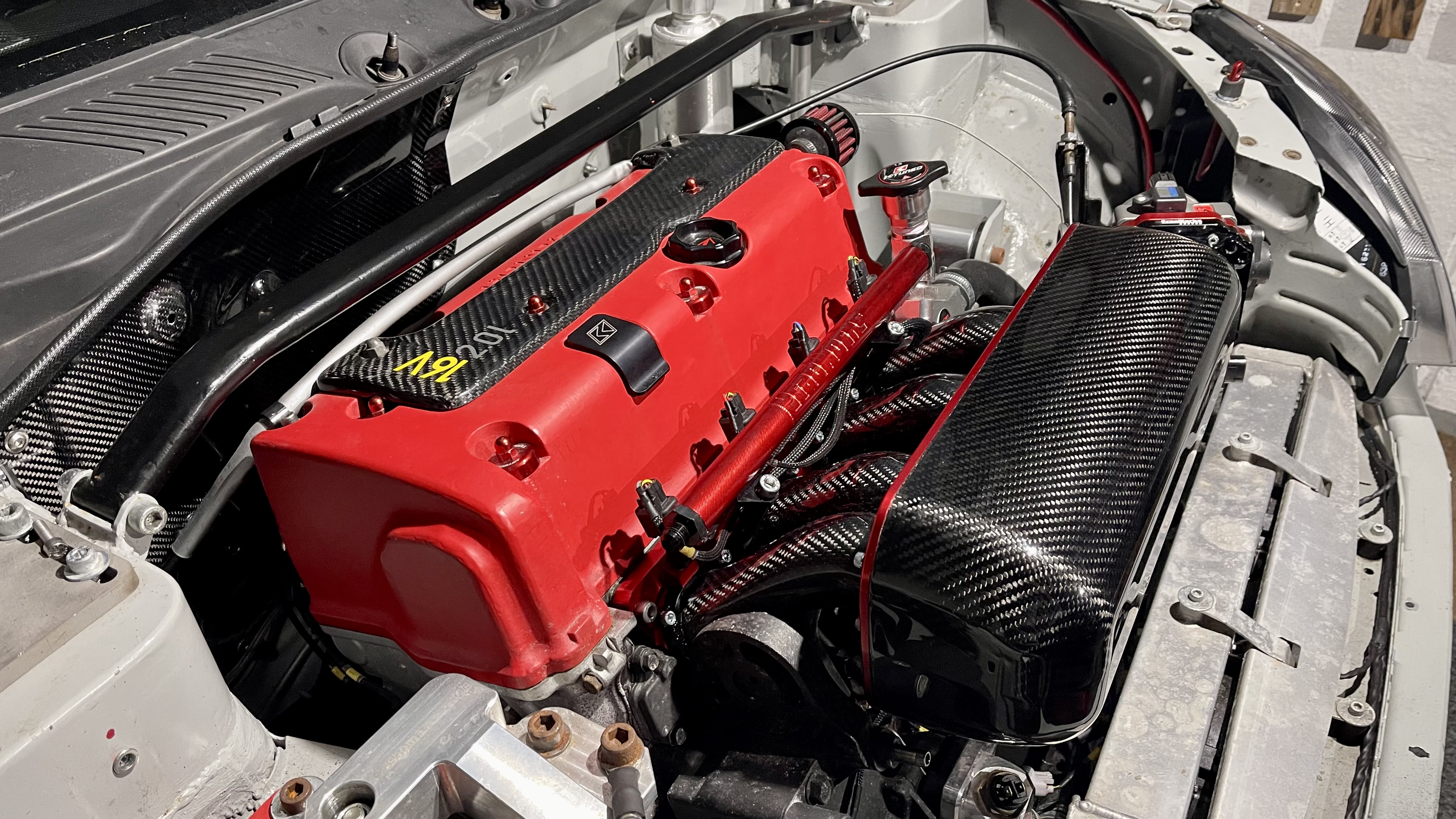

Manifold looks lovely mate

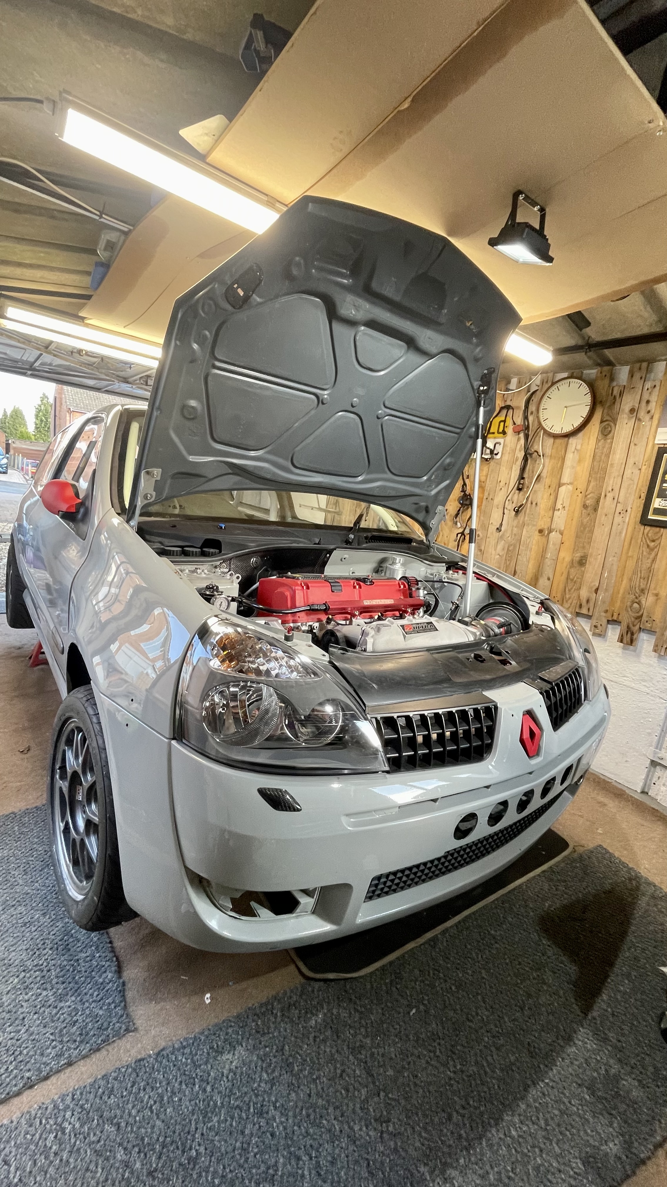

Not sure where I got to with this.
So I’ll bang some pics up, but main points
carbon inlet was sold as didn’t fit without a hole in the bonnet. Exhaust done. Wiring etc done. New PMS wide track suspension done.
Not finished still 😂

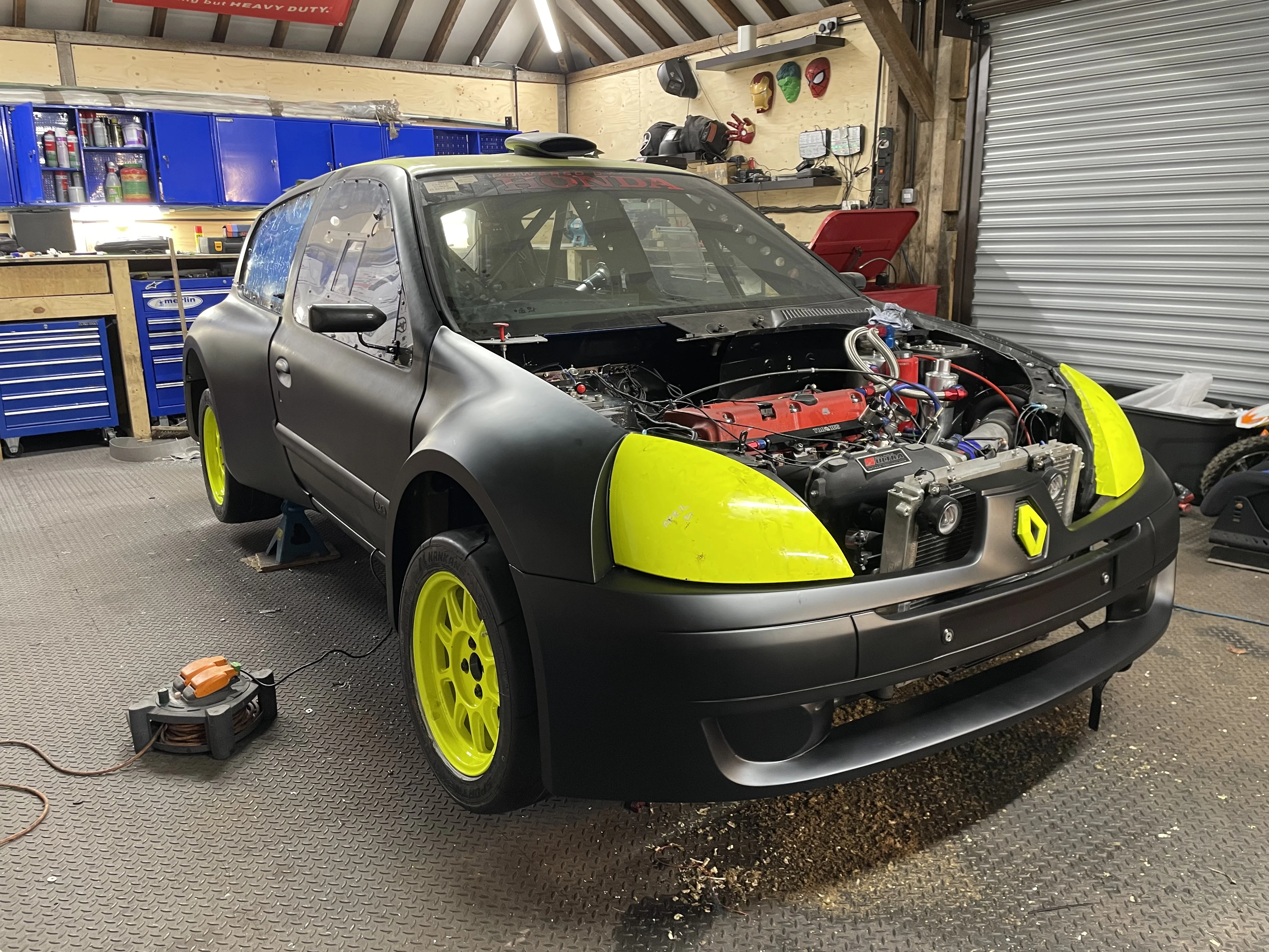

Yeah abit. Idle is like 2k and soon as I press the throttle it dies. Almost like a vac leak but There’s not. I’ve calibrated the TPS several times aswell
Are you running standard ep3 idle control valve as mine was seized was a b*****d on idle
And mine sounded like it had a air leak!!!
Yeh mate really common for them to seize.. soak with wd40👌
Mine also siezed from me not driving it for a while. Simply removed it and did the above to release it and it was all good mate
I’ve cleaned it out tonight and it’s made a small improvement but still have the issue of when I press the throttle pedal nothing happens and it dies. Any other ideas I should check out ?
That’s a pain!! on the skunk mani have you blanked all vac ports off underneath? You tried squirting with brake cleaner round inlet while running to see if engine note change ?
massive pain 😂
yeah ports are blanked off on the skunk inlet. 3 underneath and the breather pipe, that’s them all I think ain’t it?
the idle valve has helped and I got a new battery just incase but it still cuts out randomly and now won’t restart if the revs have dropped of choke.
going to smoke test over the weekend for leaks but it’s so strange as it’s just developed this issue
