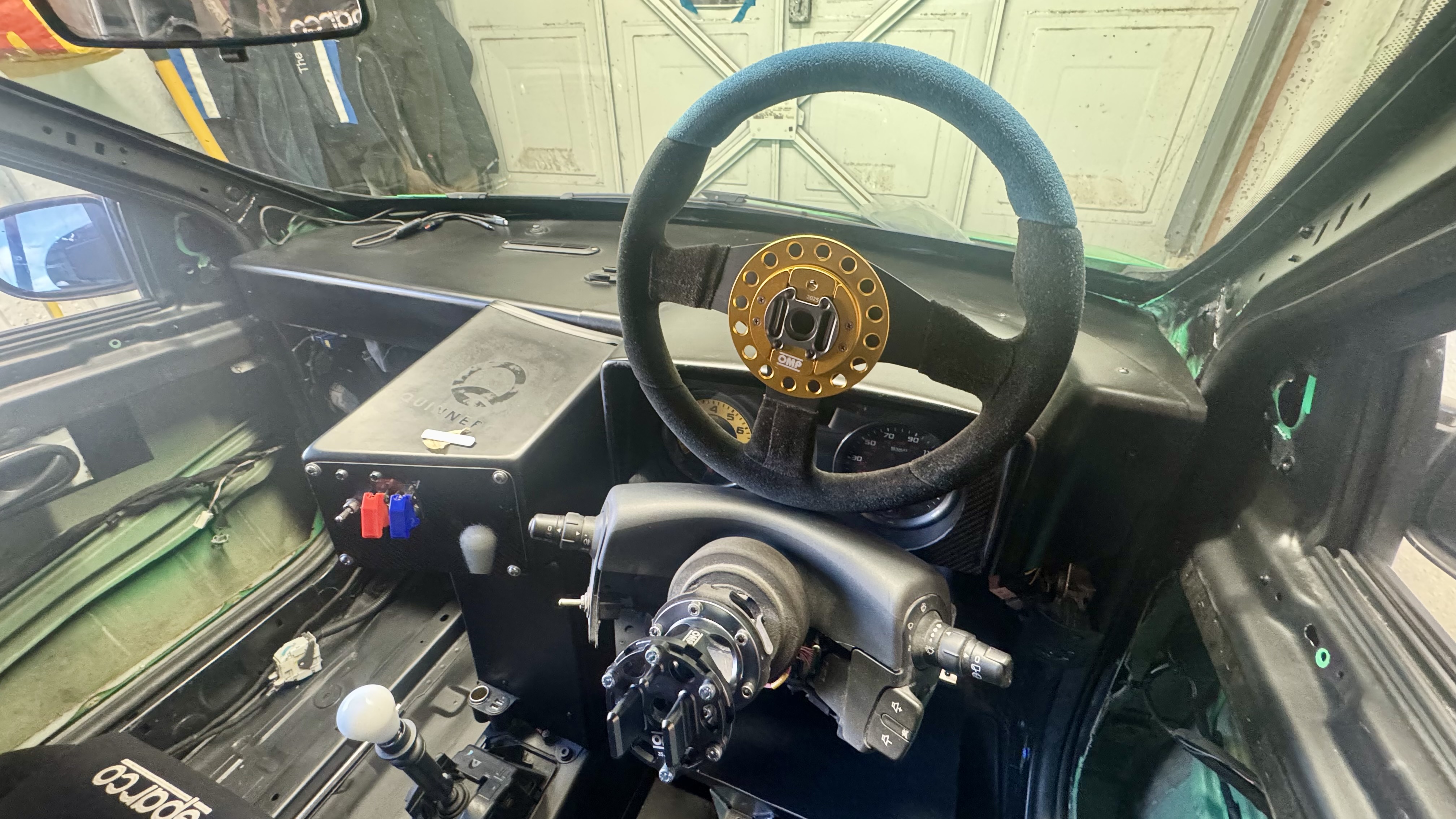

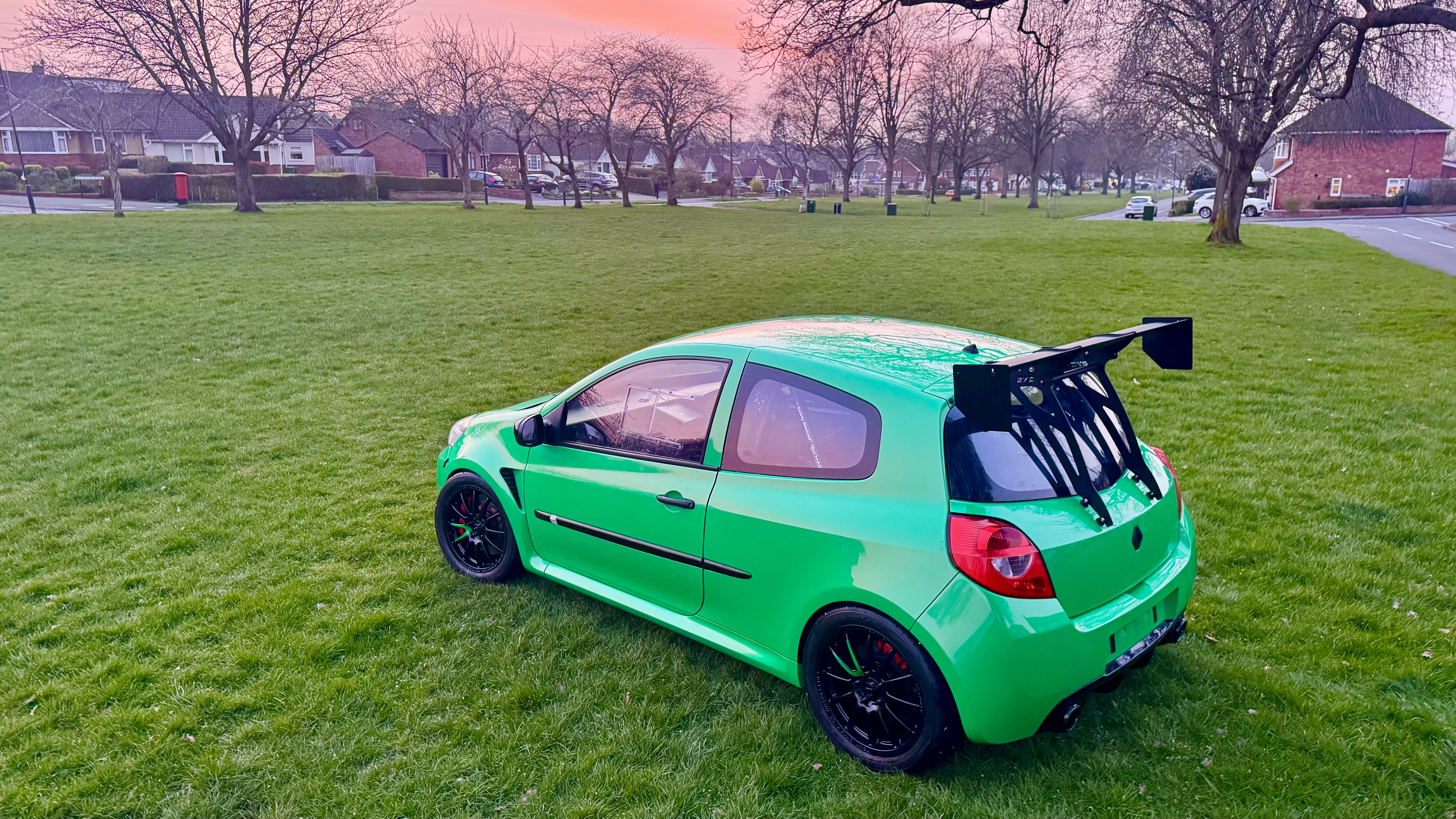

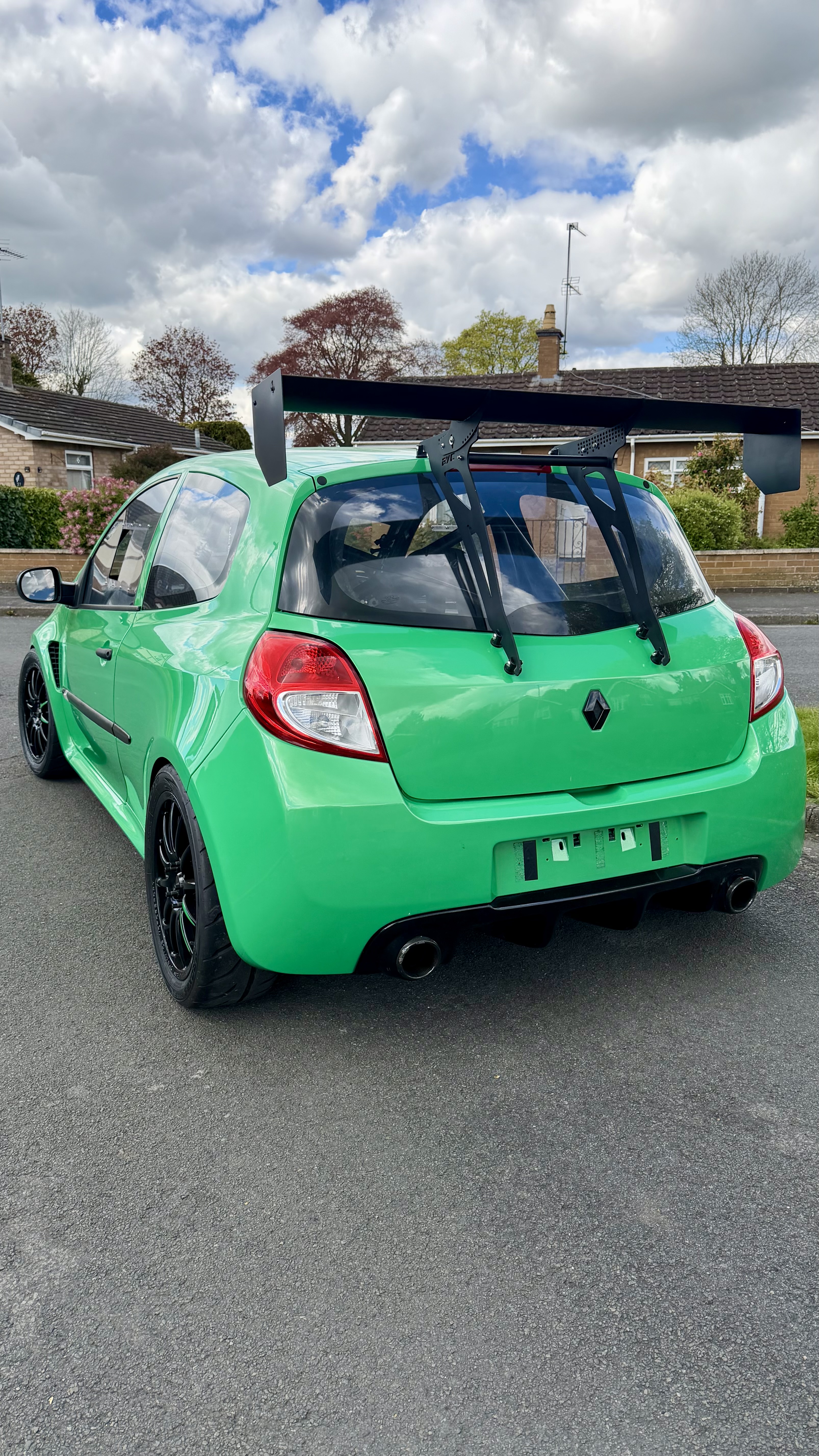

Changes being made now it’s done a track day.

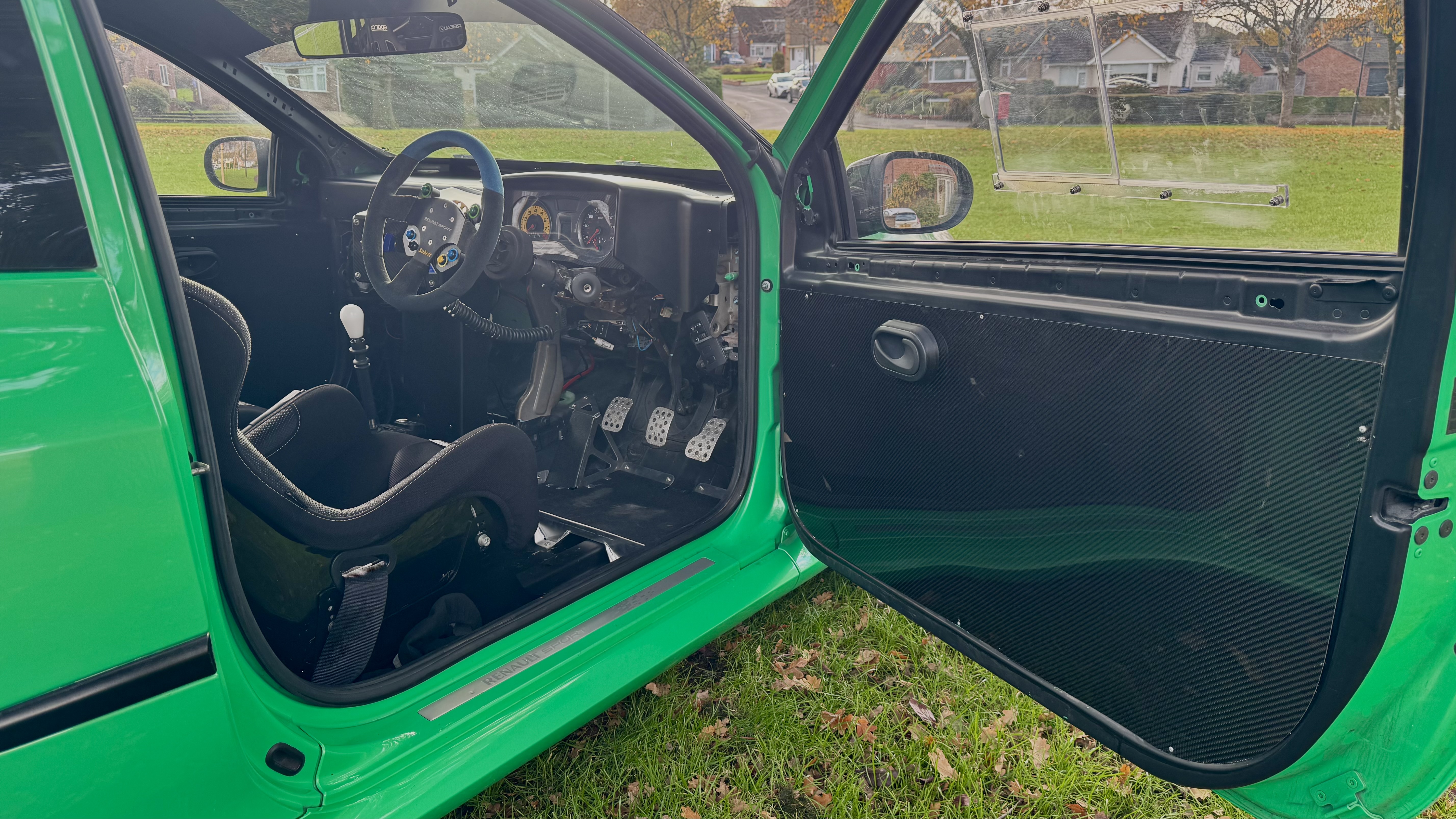

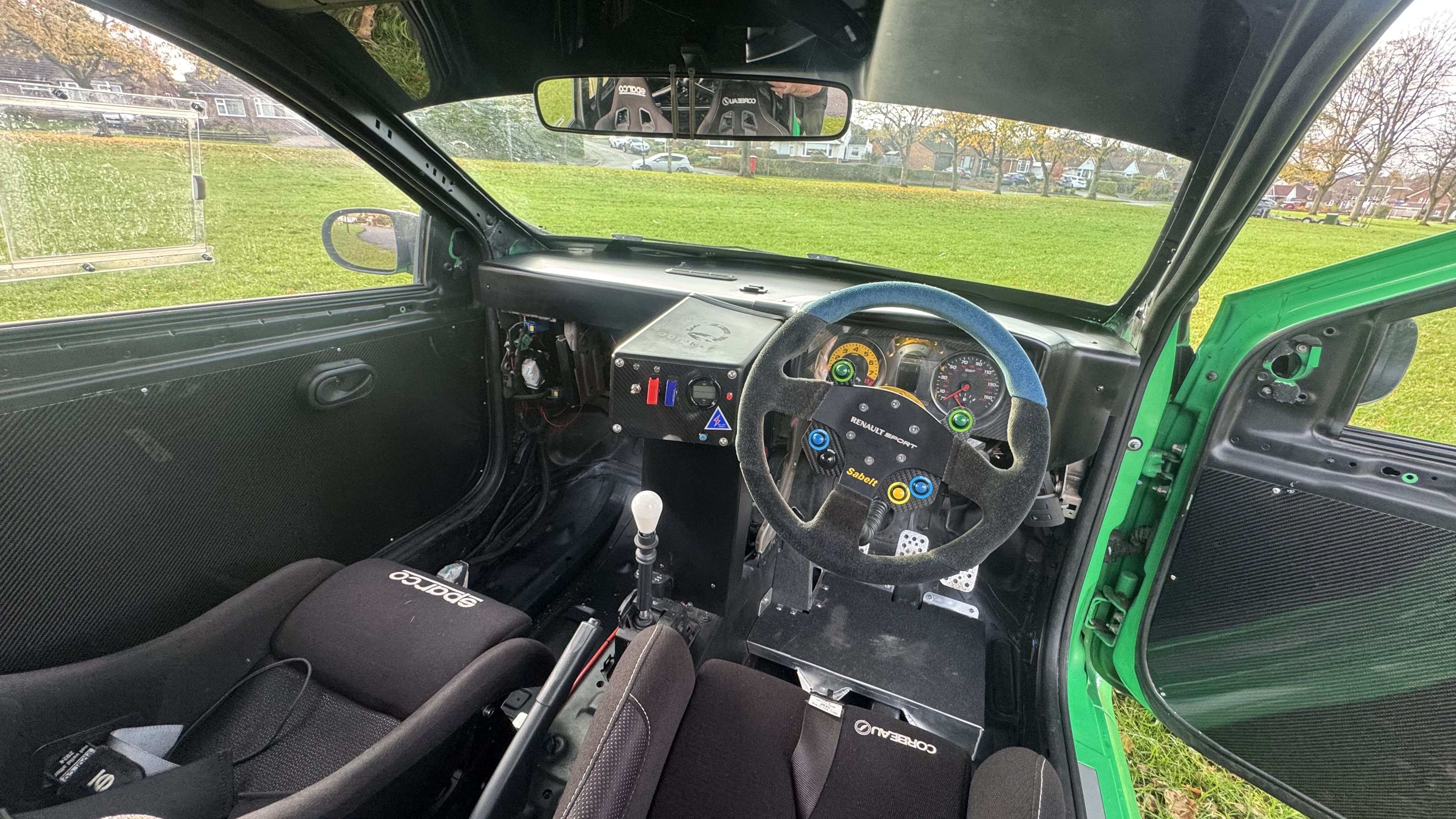

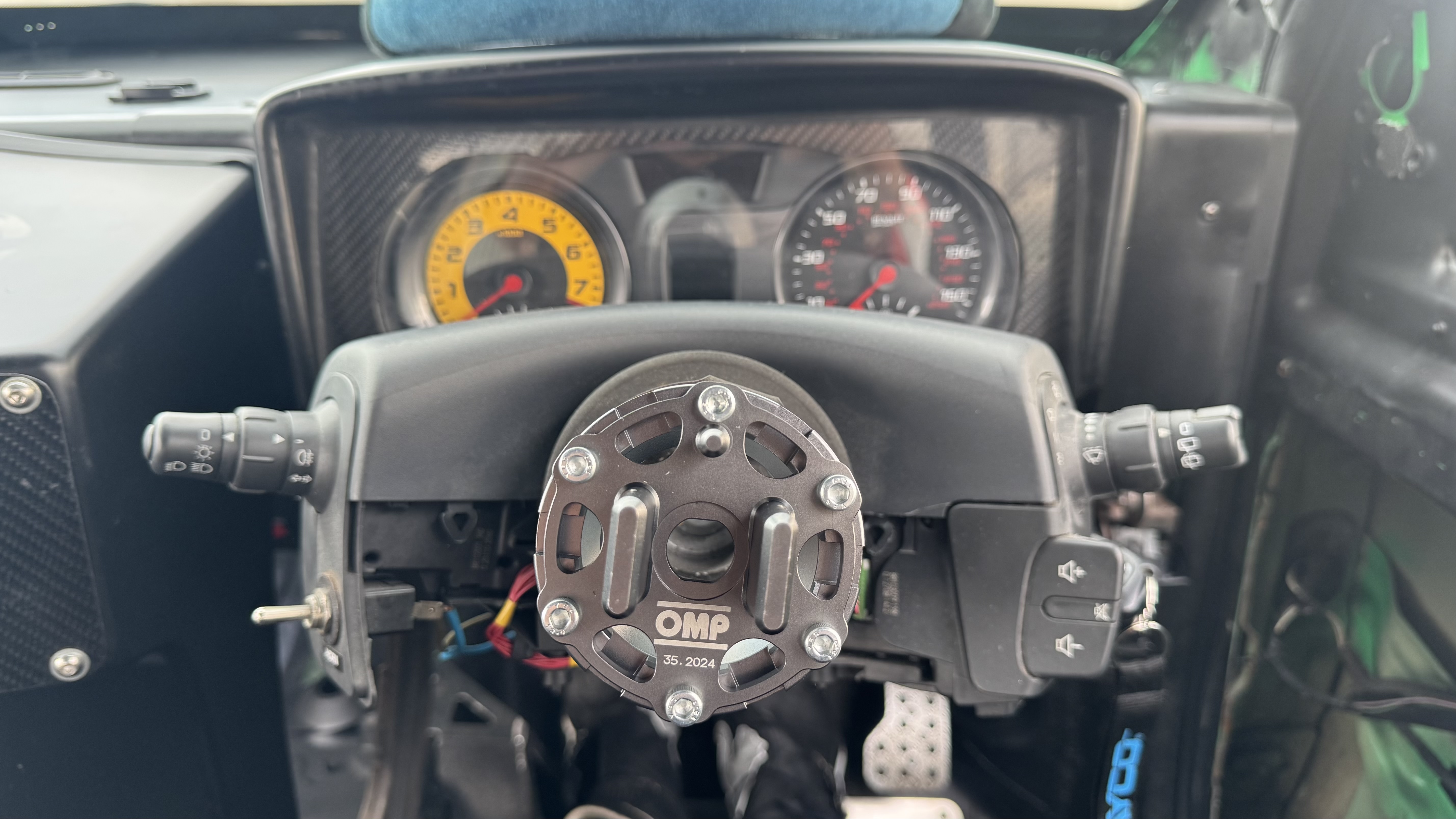

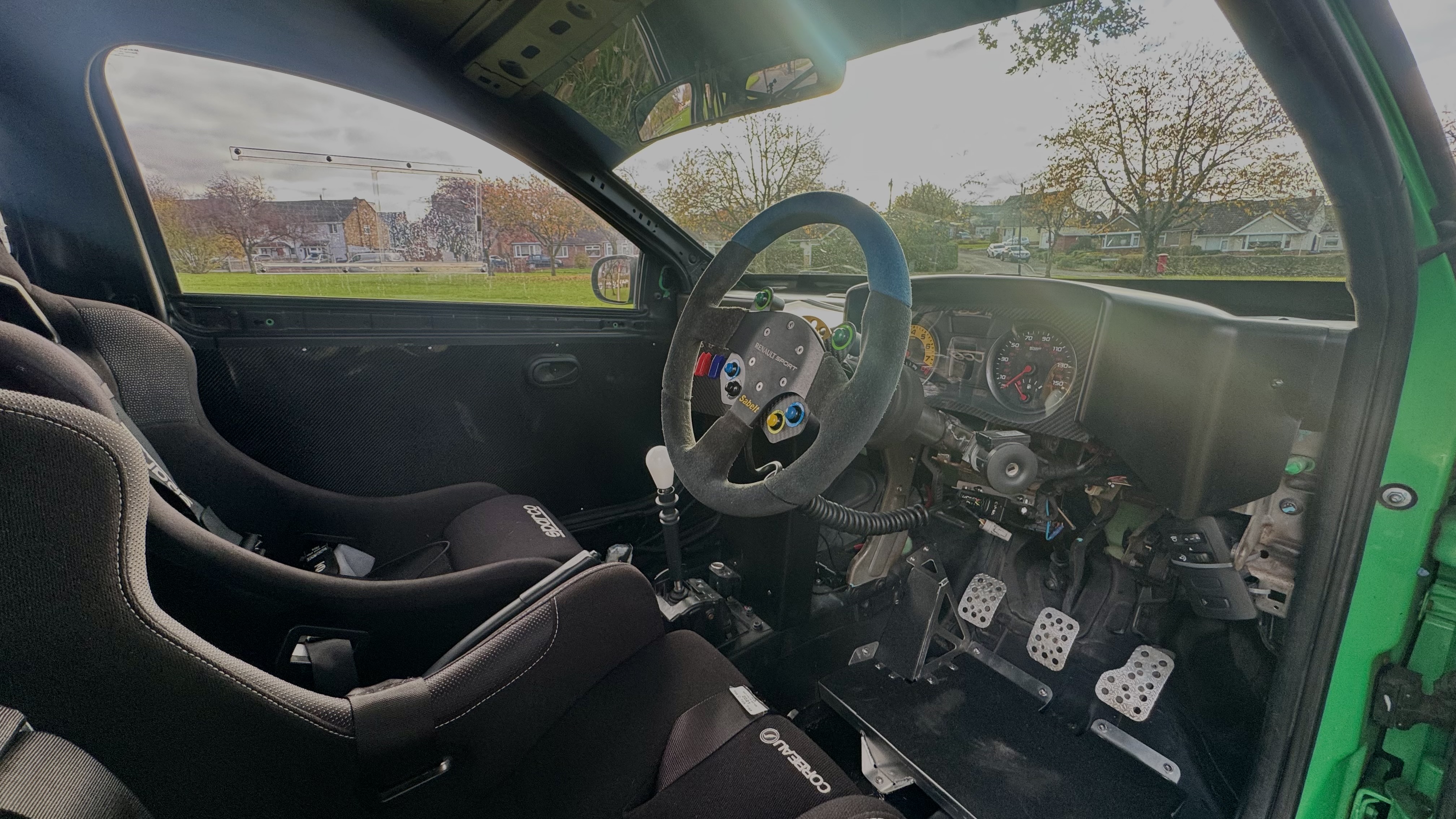

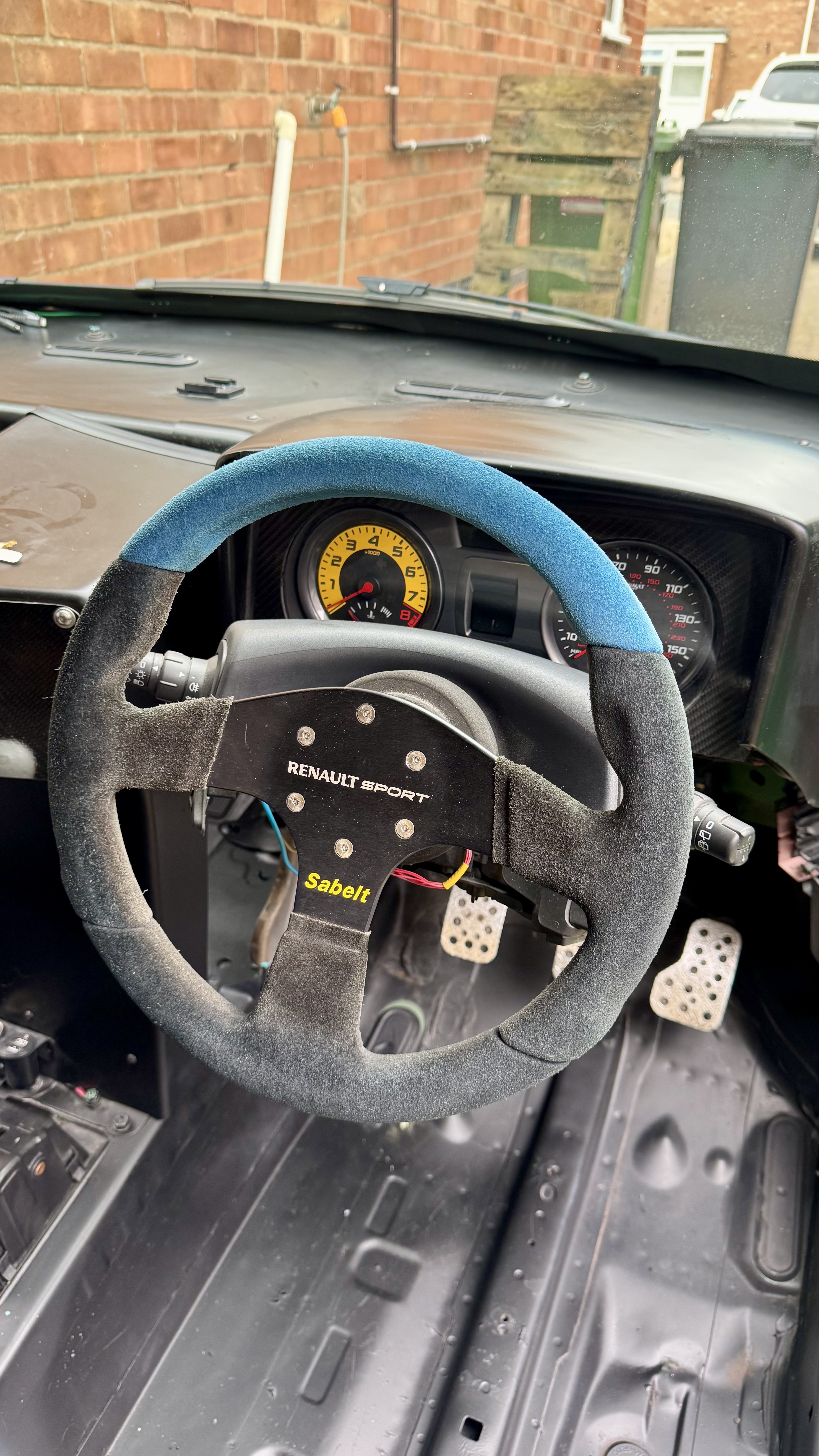

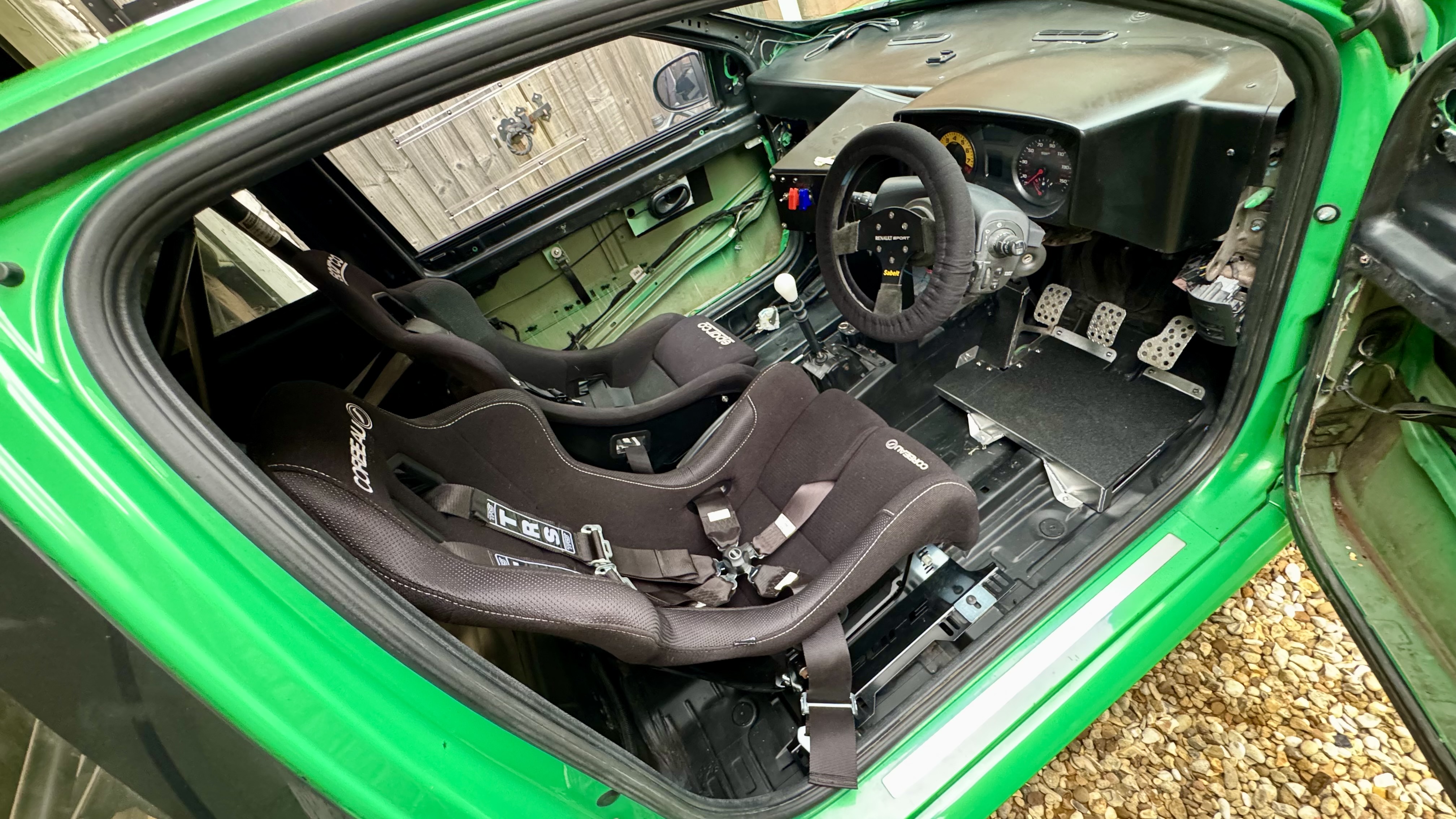

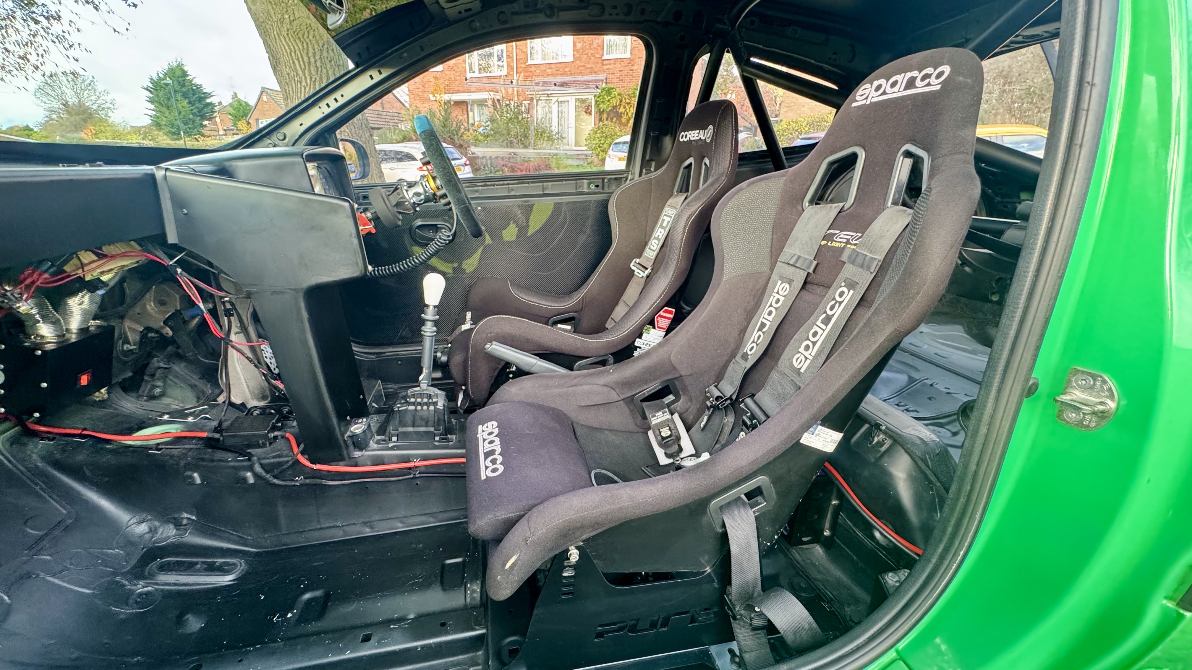

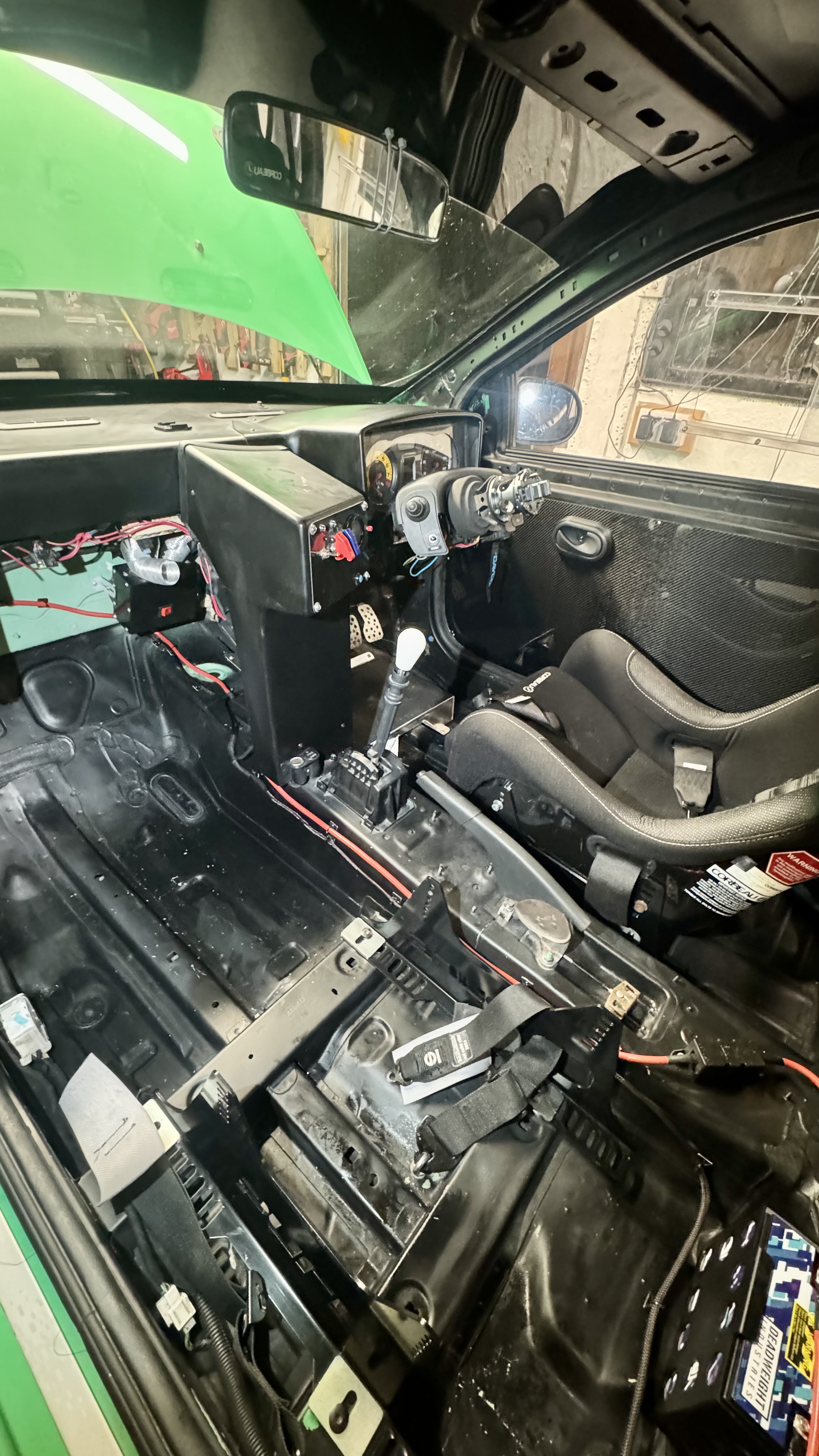

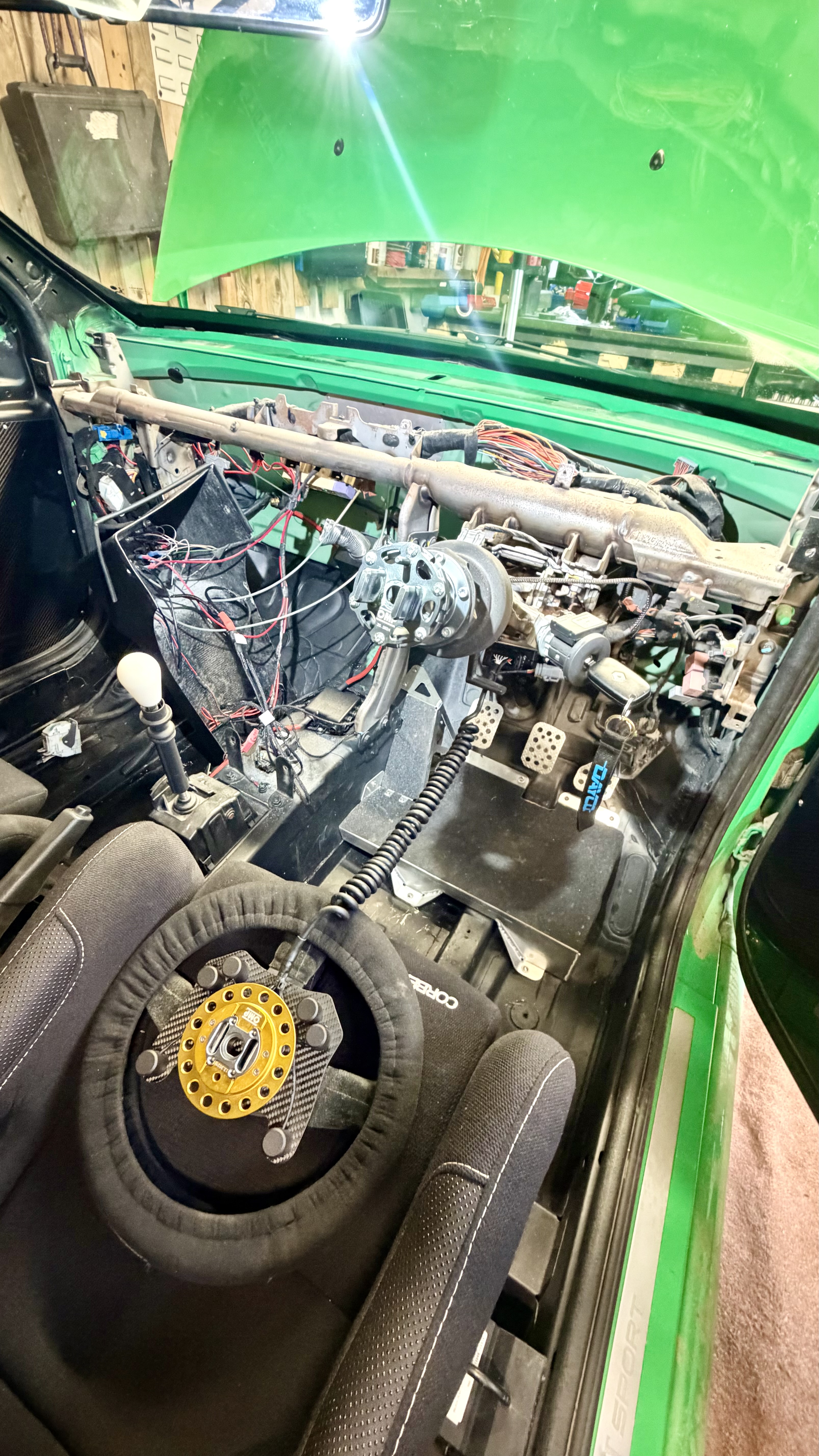

Before the track day I tidied up the interior, put my seat in and got the steering wheel in the correct position. Oh and the big wing.

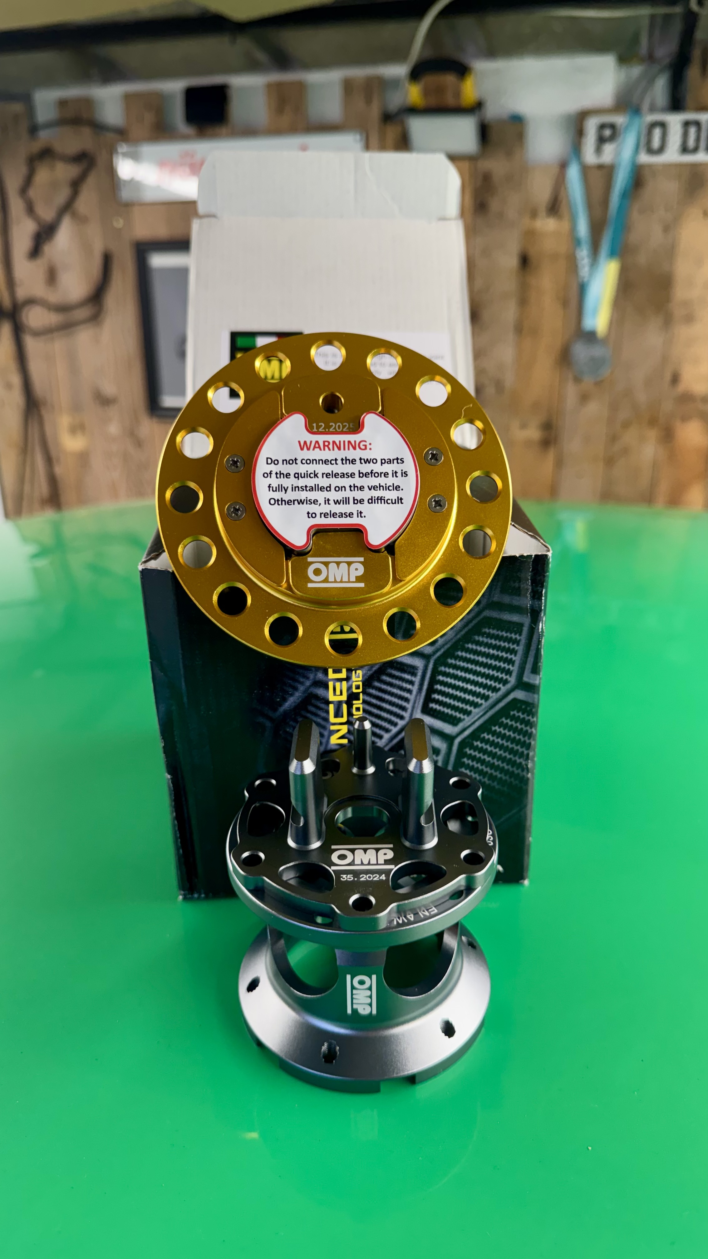

Fitted PureMotorsport seat mounts and foot rest. OMP snap off boss and 60mm spacer.
Rest of my PureMotorsport delivery that still needs unpacking.
As it was my first time driving a MK3 chassis (and this actual car) I wanted to test it as it was.
So spec of the car as I’ve purchased and altered the interior is.

Interior
RenaultSport Sabelt steering wheel
OMP snap off boss
OMP 60mm spacer
PureMotorsport foot plate
PureMotorsport bucket seat mounts

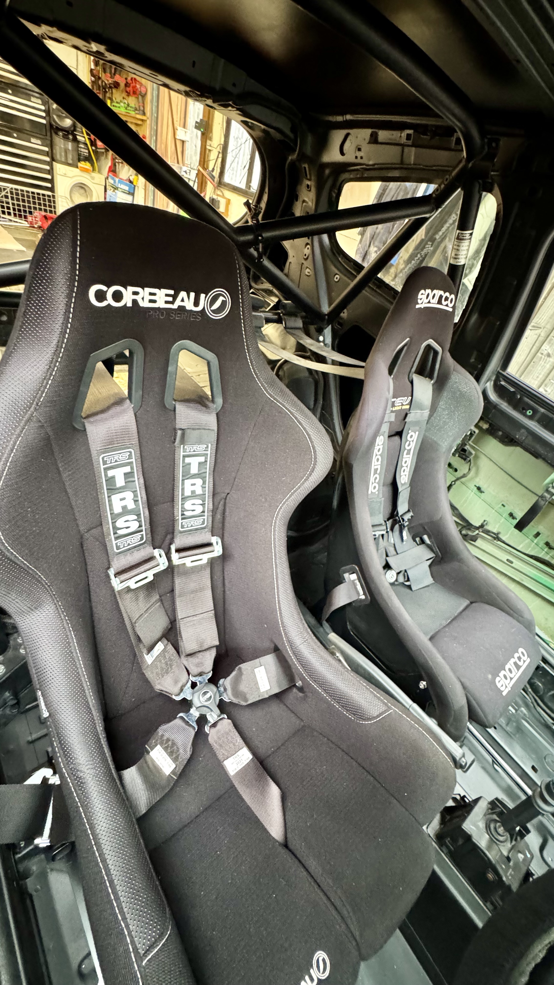

Corbeau Pro Series bucket seat
TRS drivers harness
Sparco Rev bucket passenger seat
Sparco passenger harness
Full CMC lightweight race dash
Race tec switch lightweight heater
Loom thinned
Mark Fish Motorsport Safety Device rear cage
Plastic lightweight windows all round

I’m yet to confirm all of the modifications but the car was mega on track overall.
Handling wise it was great.
Brakes mega.
Seat, steering wheel and foot plate all mega.
The 200 electric column feels real good, much better than the mk2 DCi units.

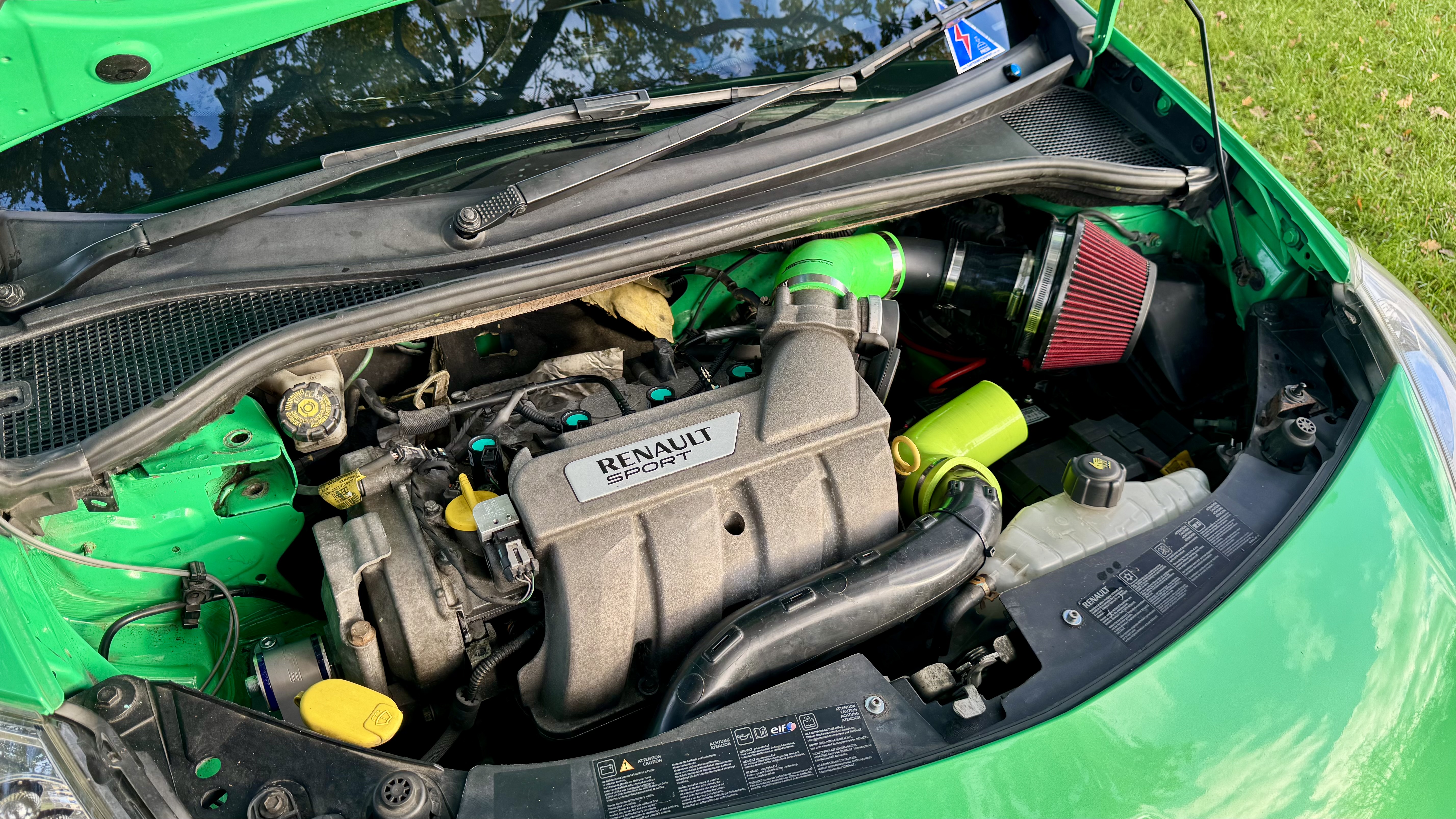

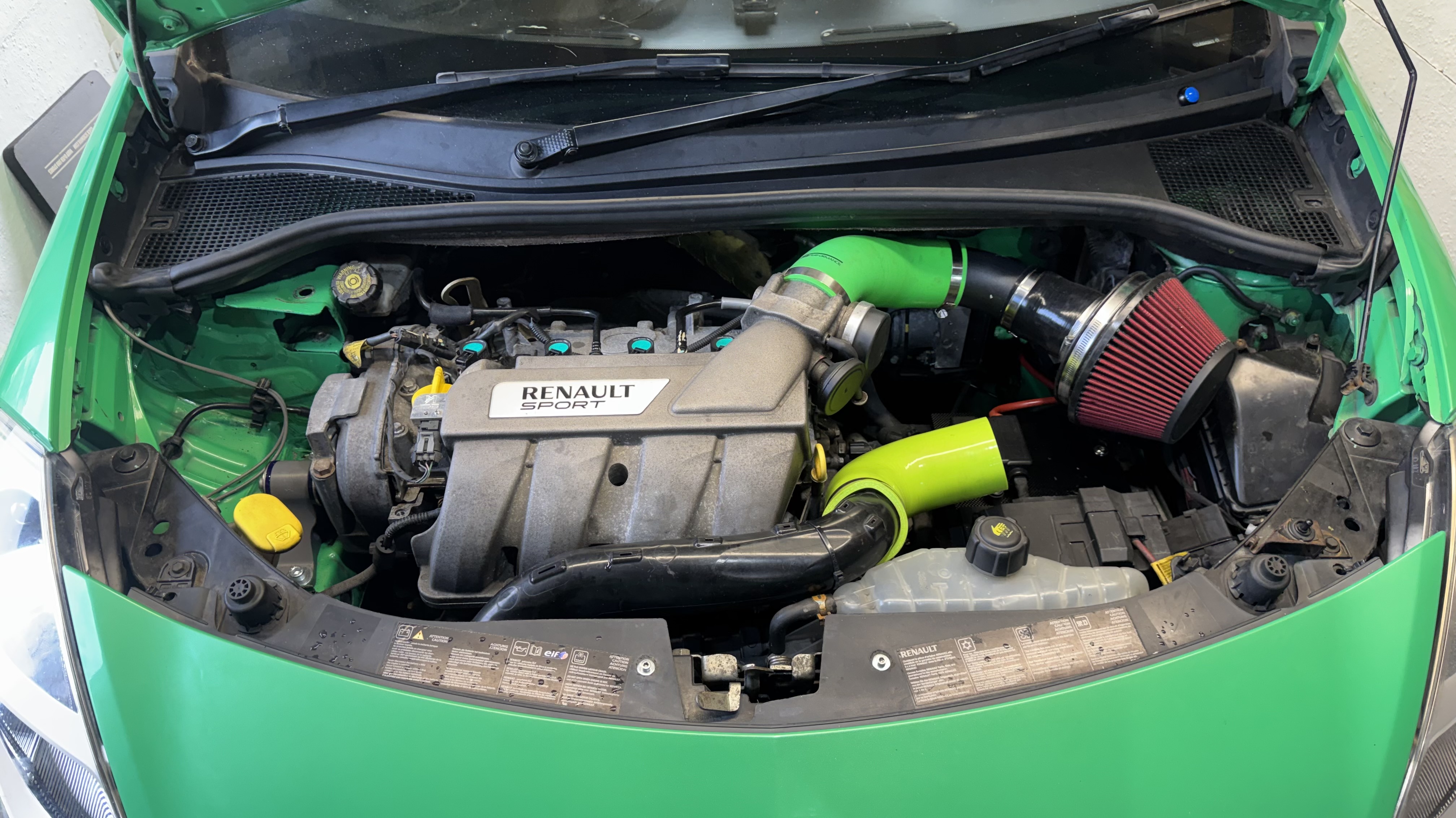

Engine pickup from low down wasn’t very good at all. Maybe down to the rubbish air filter on it. Any suggestions on this?
The standard shifter tower “feel” isn’t nice. It has nylon gearknob on but the actual plastic unit bolted to the car seems to flex.
Again some suggestions here would be useful

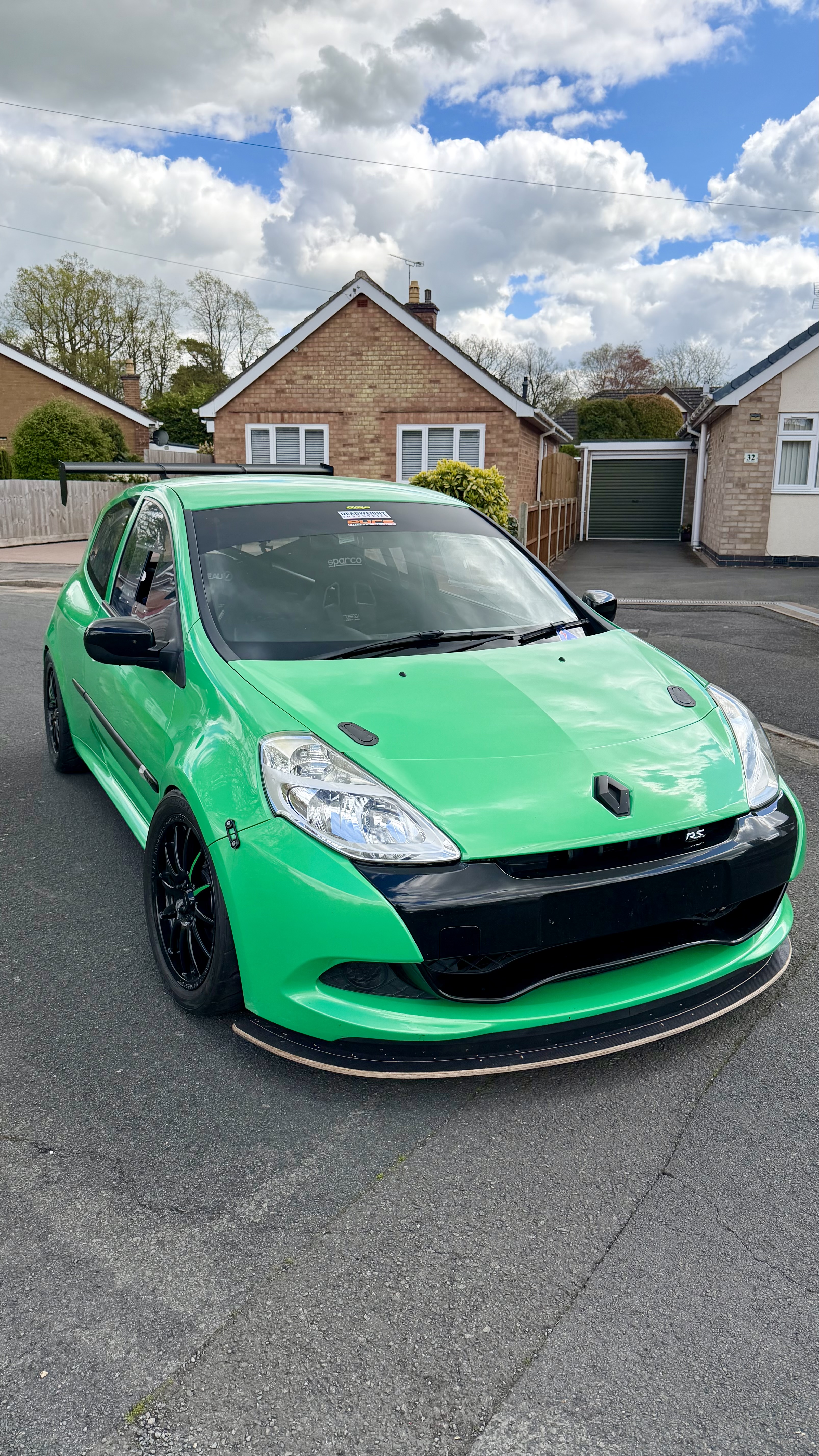

I really don’t like the front splitter, splitter rods, JDM bumper catches or the Fake aero catches.

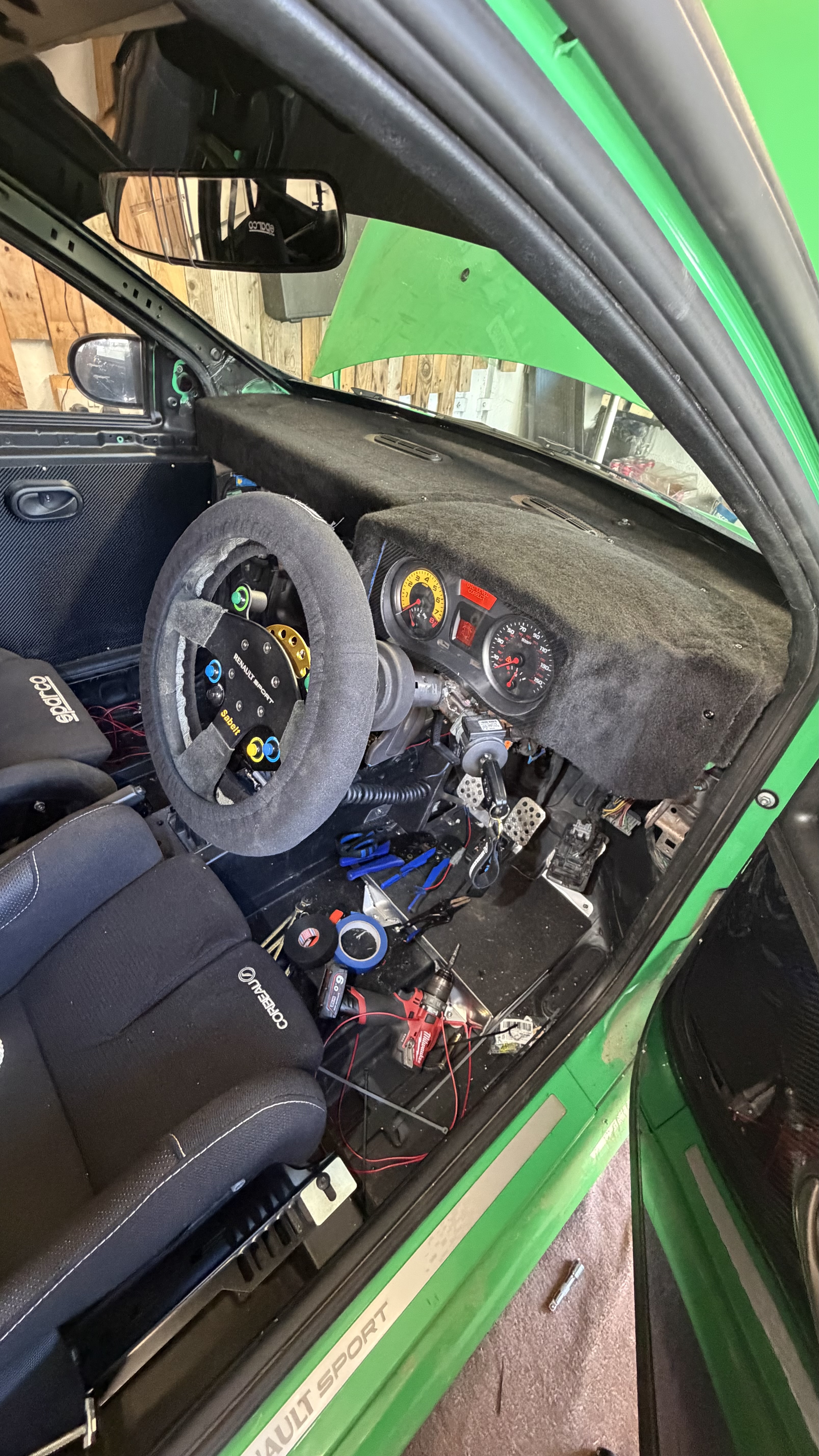

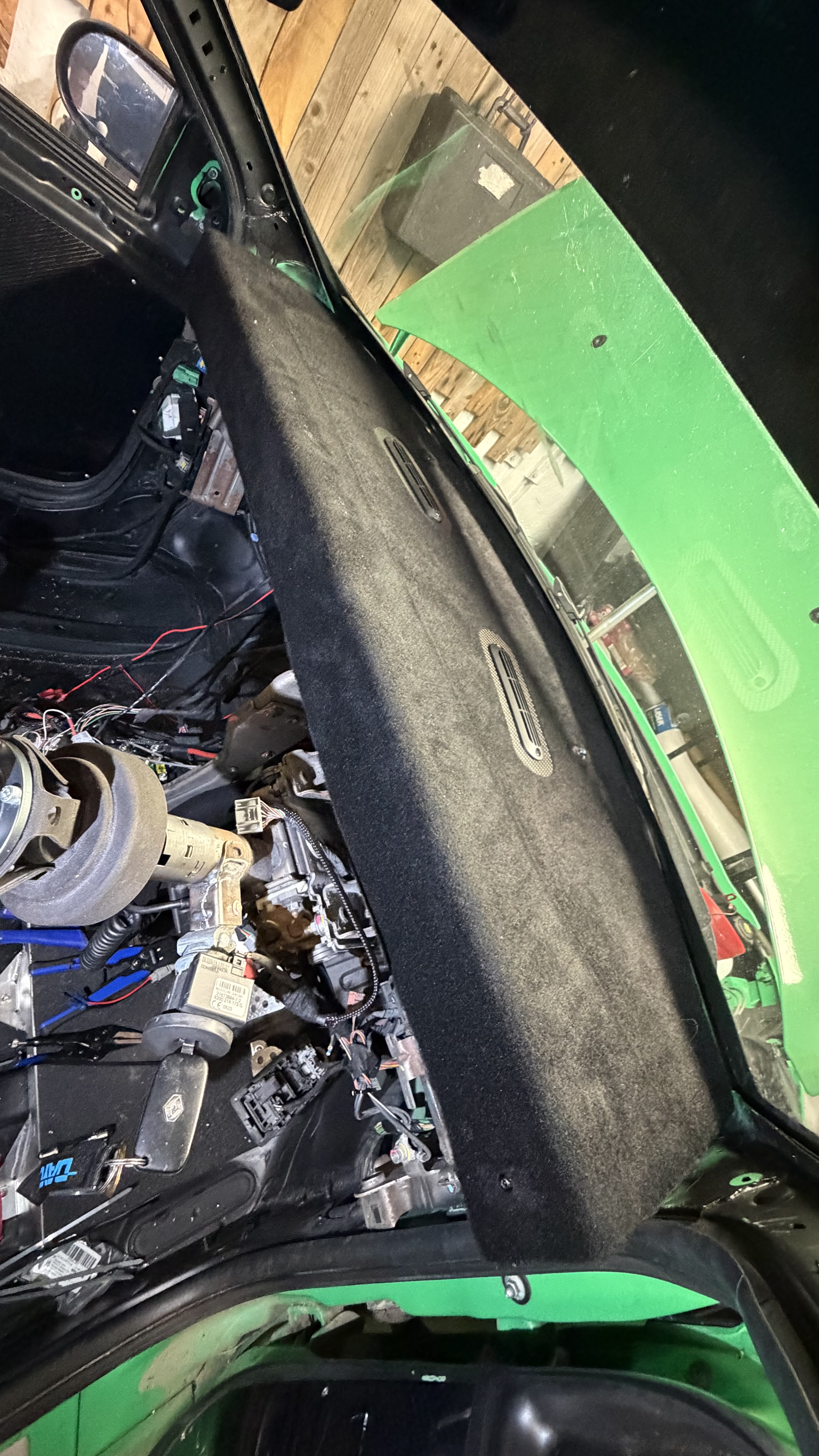

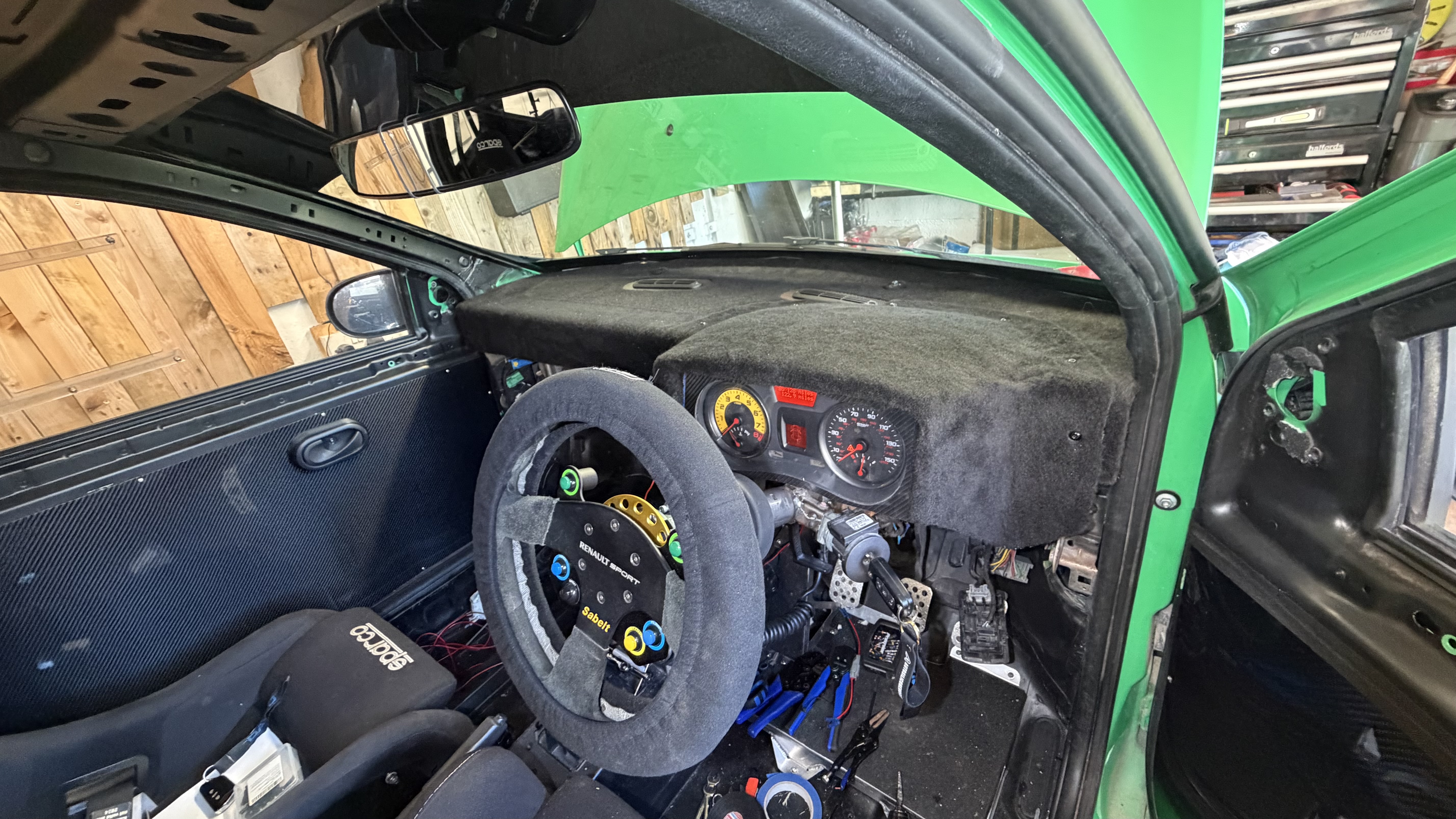

This race dash that’s in it is to low, so the stalks and surrounding plastics cover the coolant and fuel levels. I’ve already ordered the fix for this, just waiting on it.

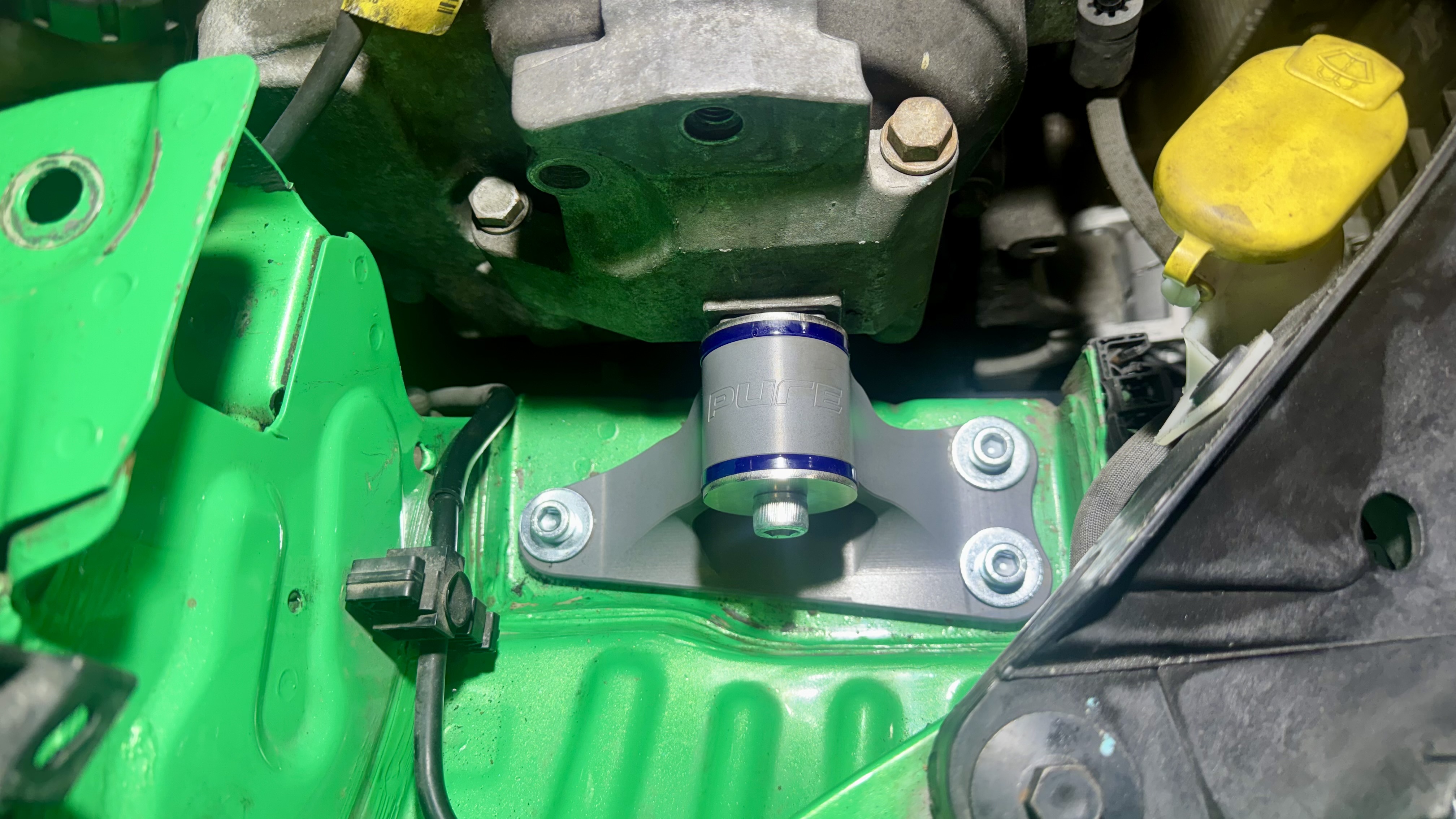

Engine mounts feel sloppy and you get the Powerflex floaty and flex feel in the wishbones.

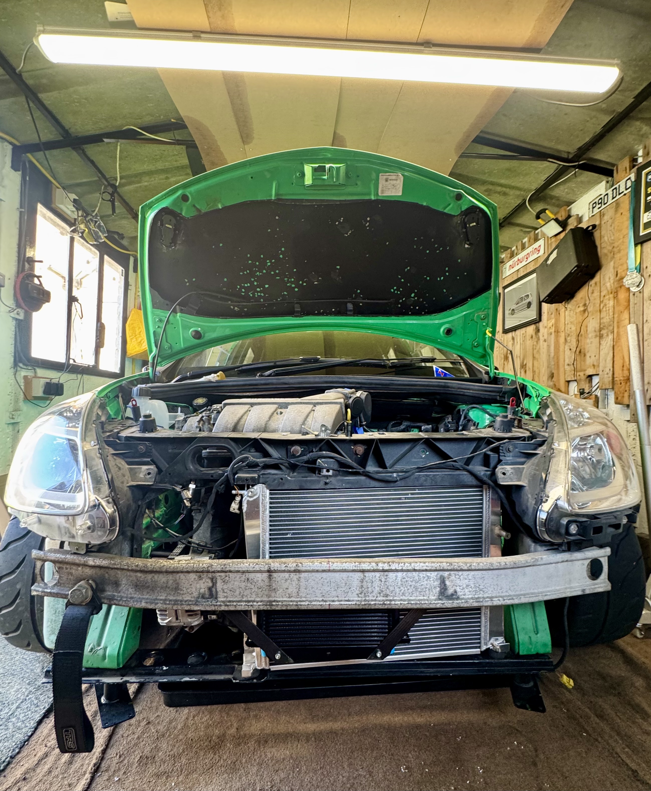

More jobs ticked off.
PMS mounts fitted

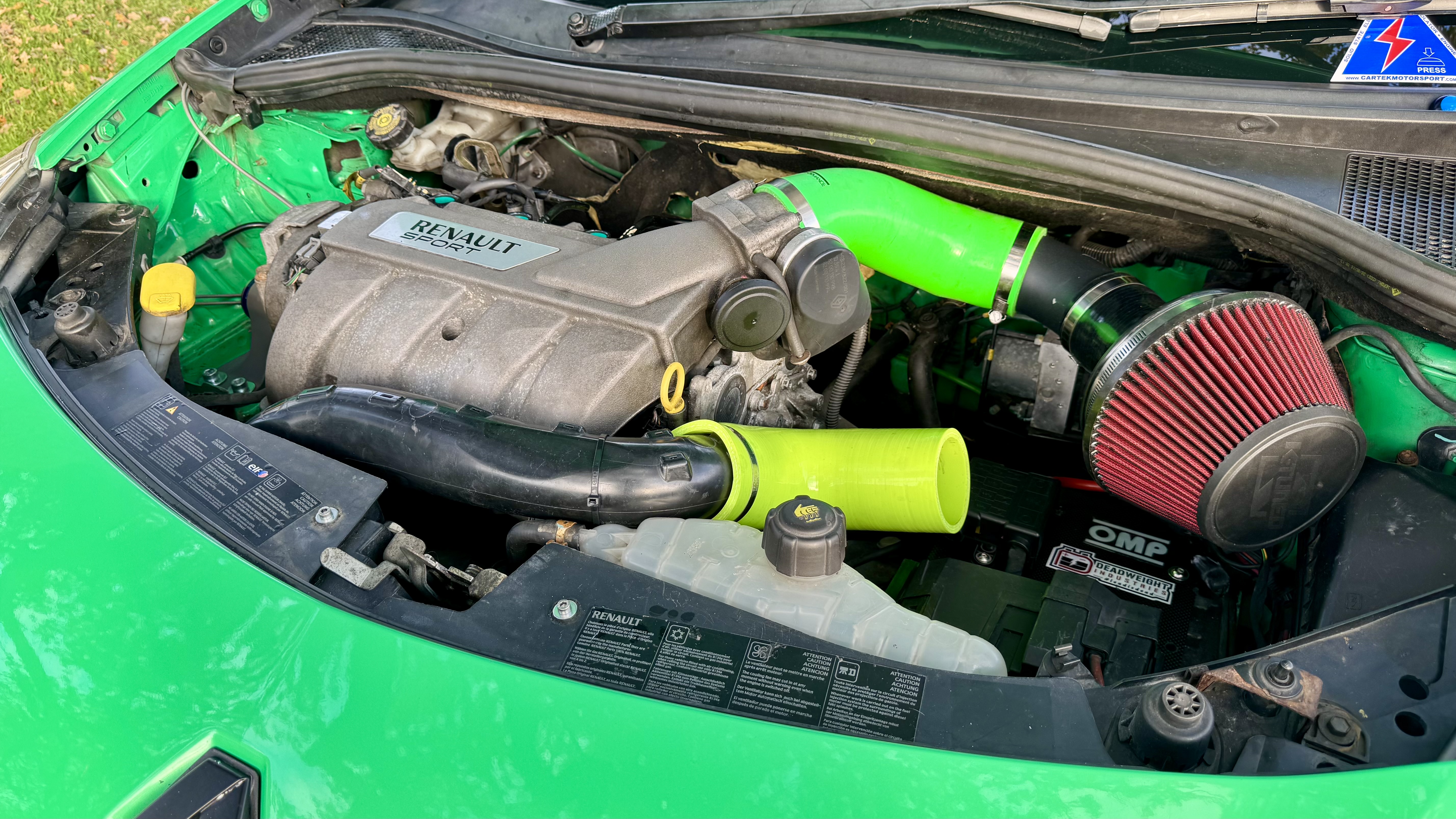

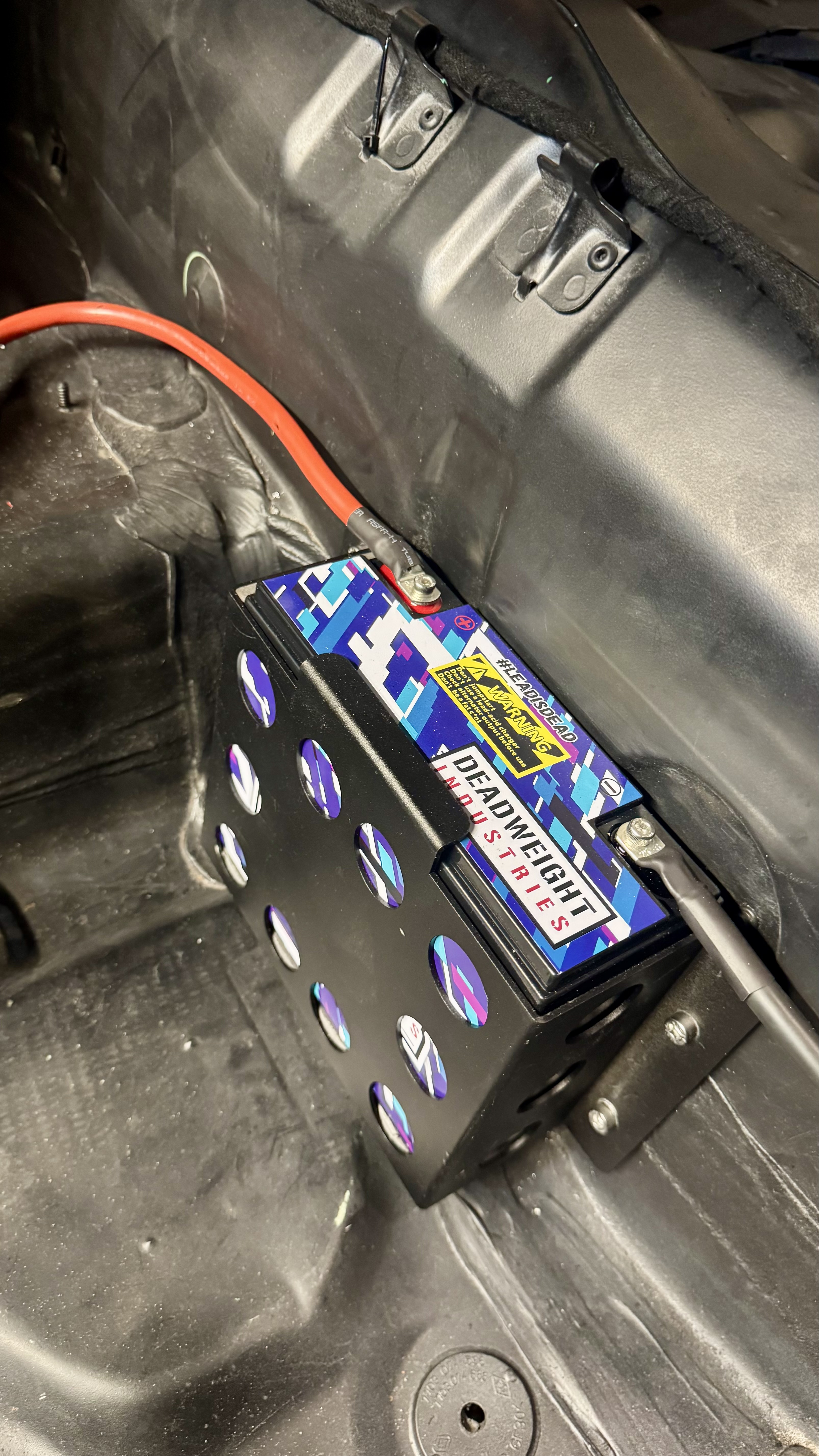

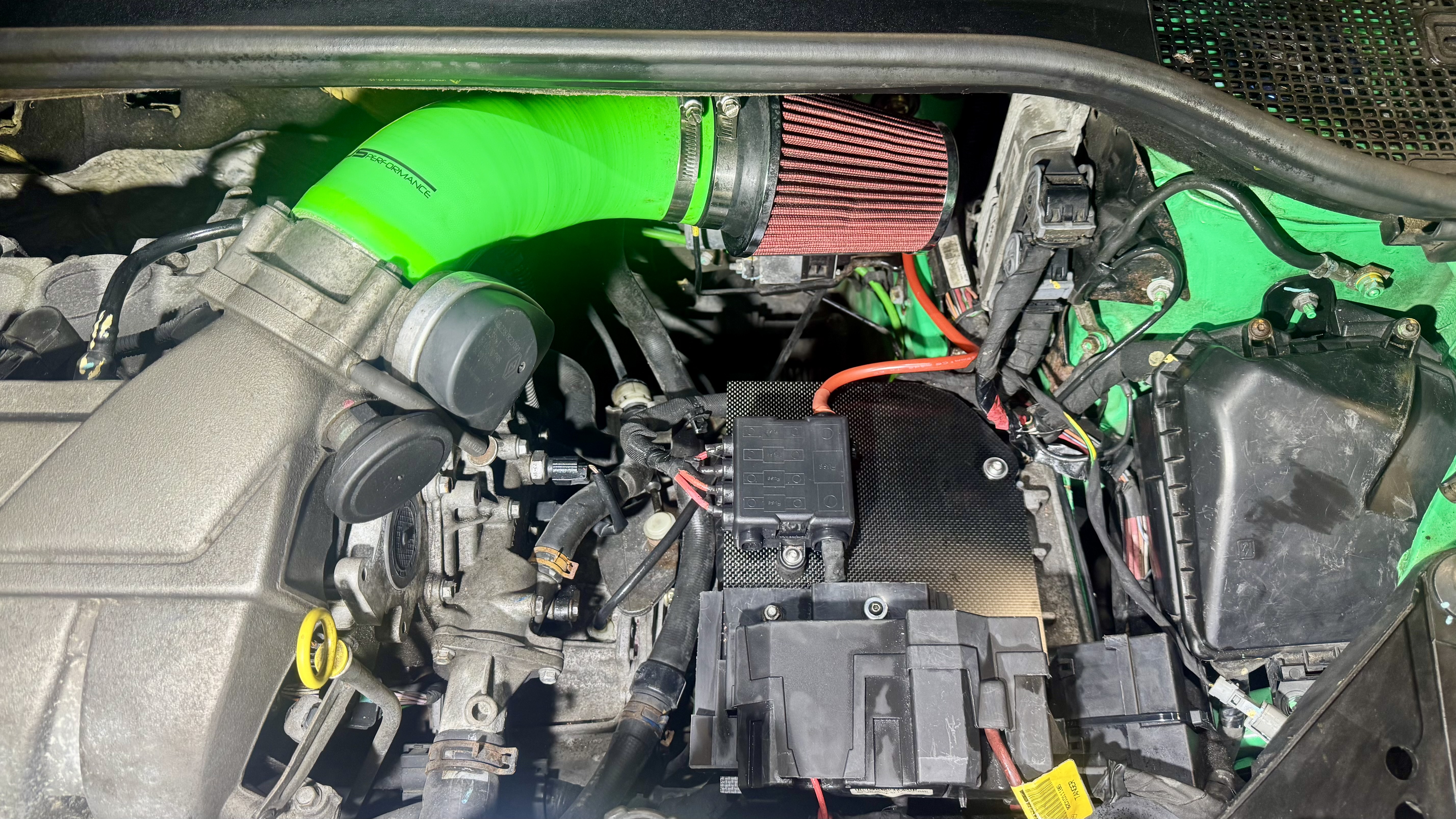

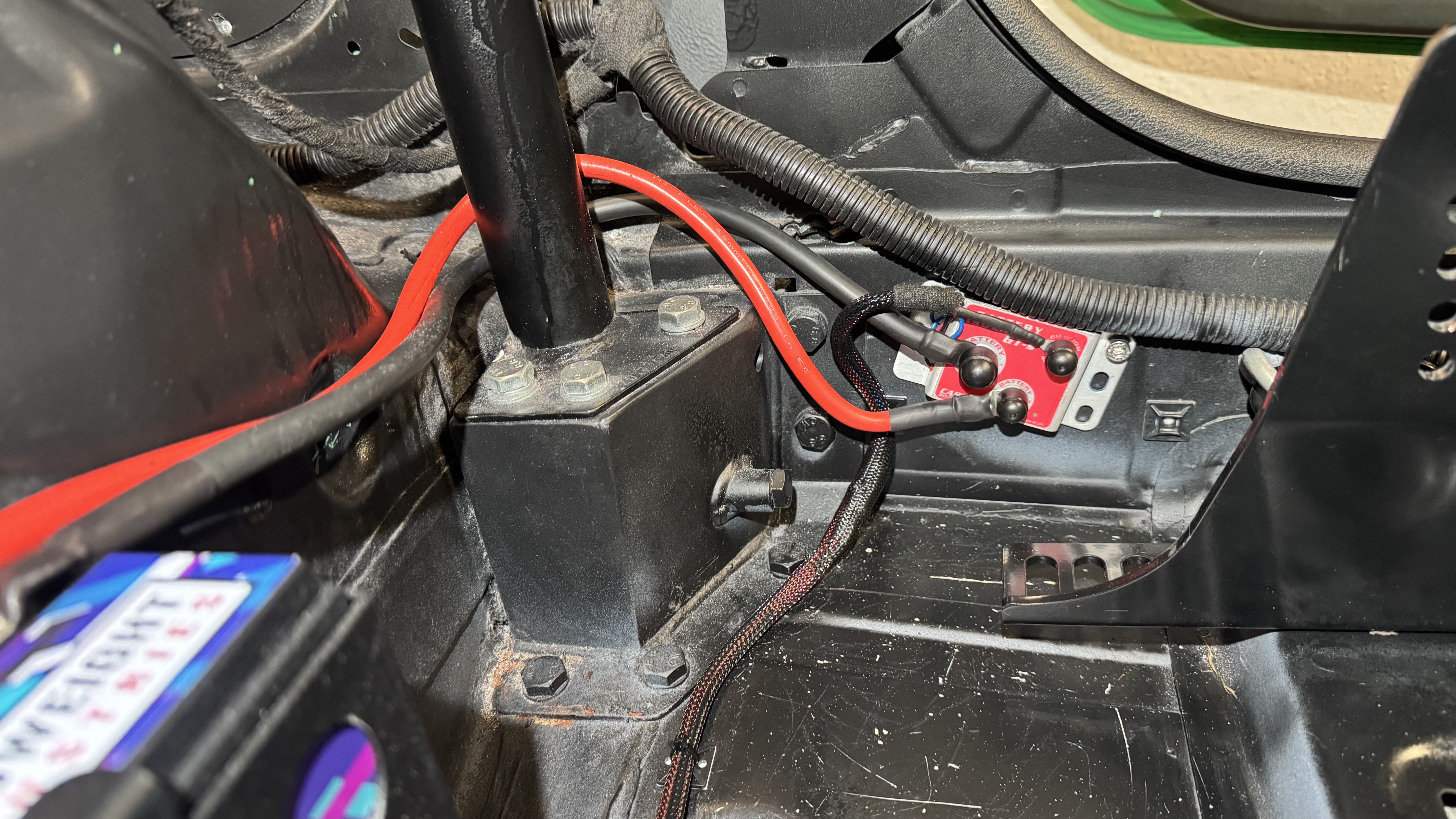

Battery relocated to behind the passenger seat along with the fuse boxes relocated in the bay.

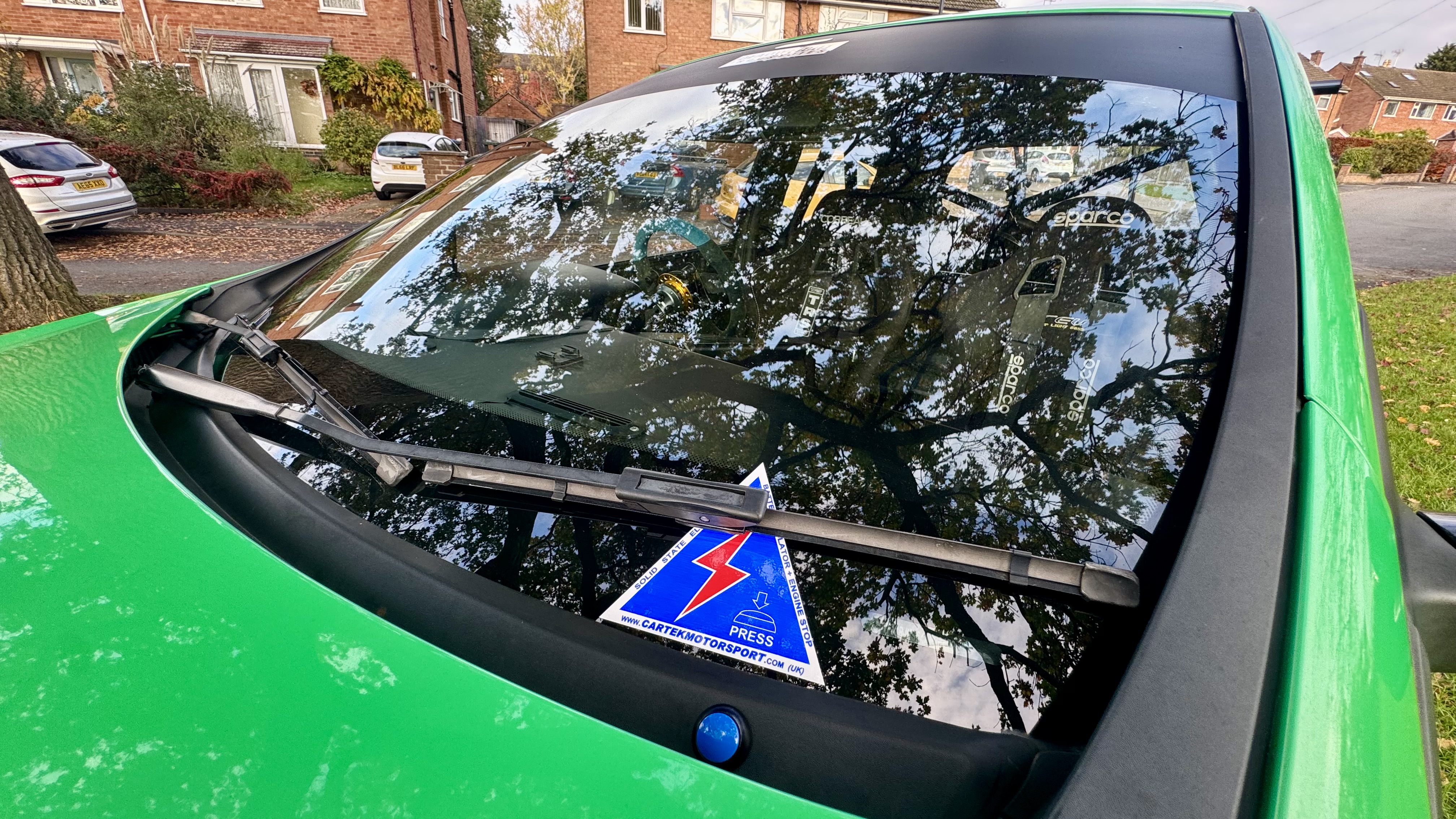

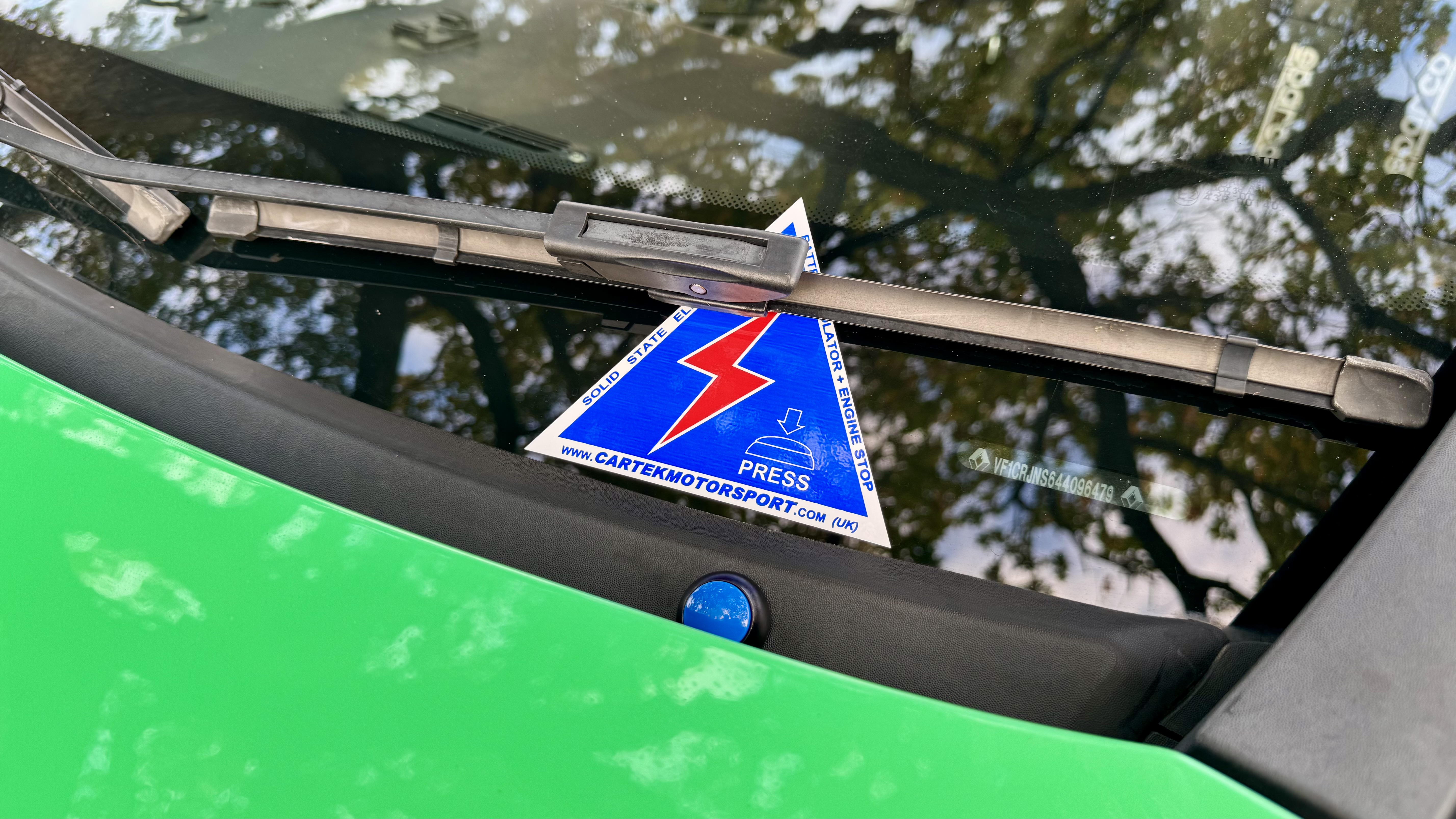

Cartek battery isolator and oil pressure/temp gauge fitted.

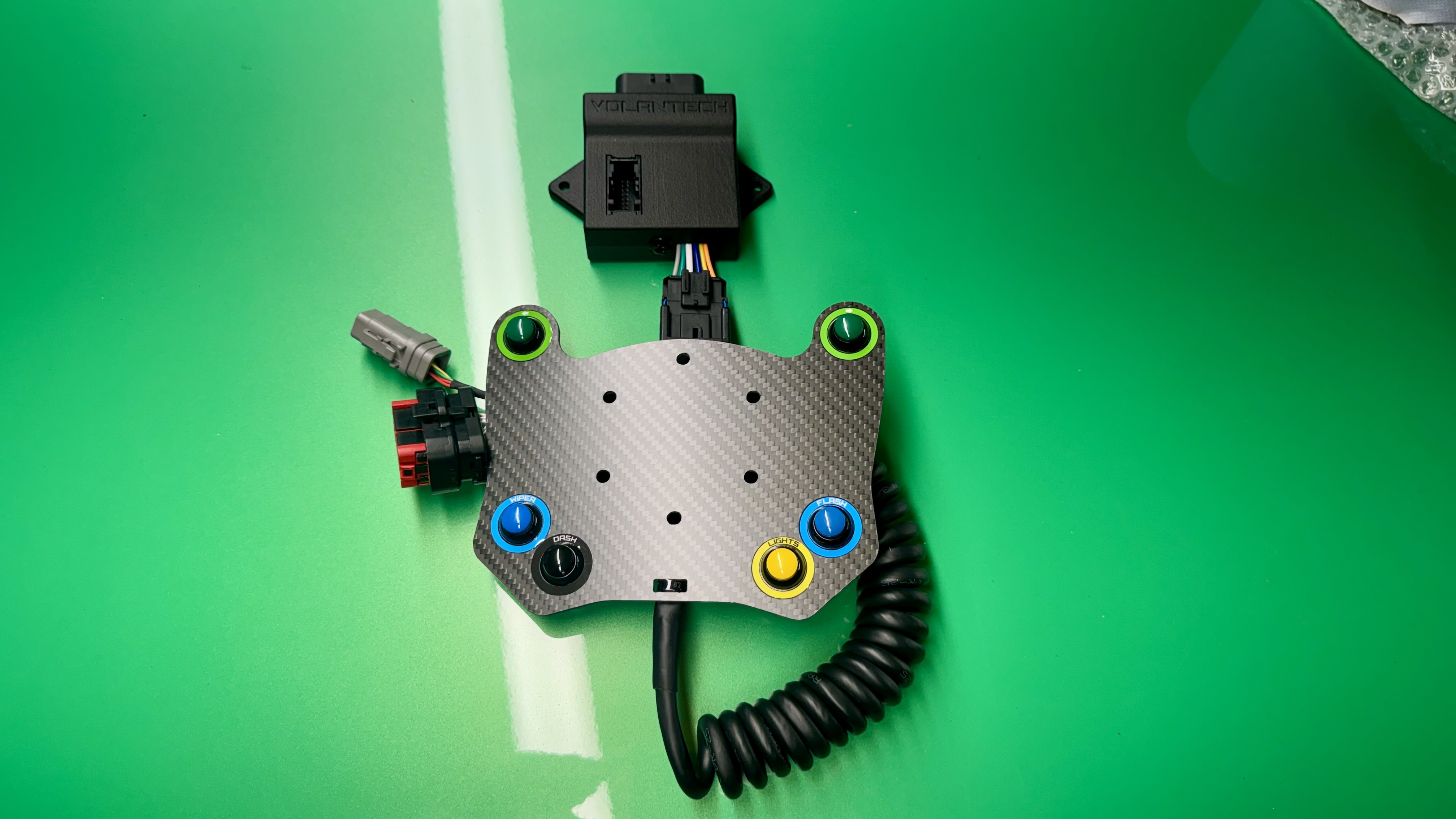

Stalk delete from Volantech with carbon button panel

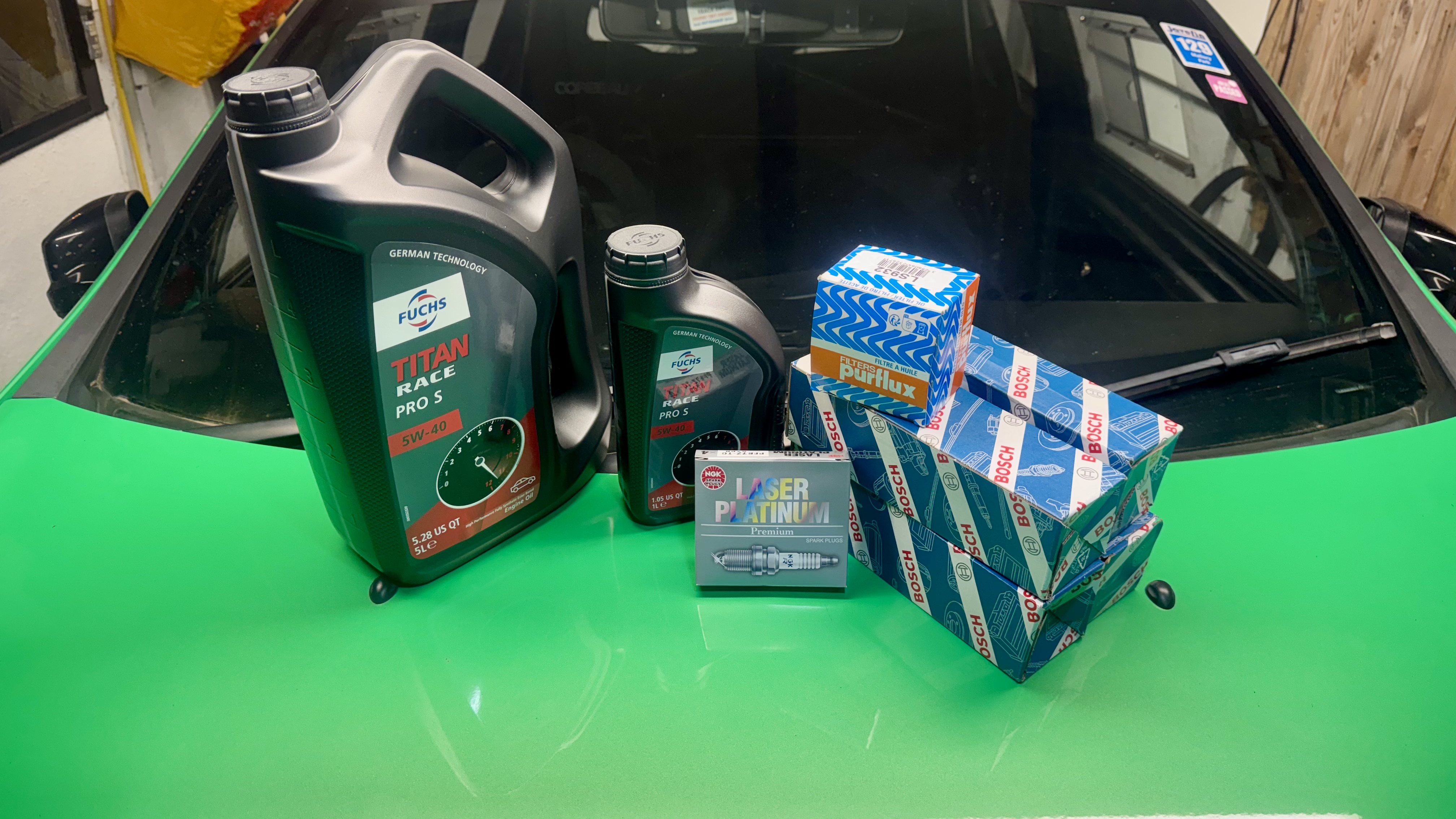

Oil
Change, plugs and coils too.

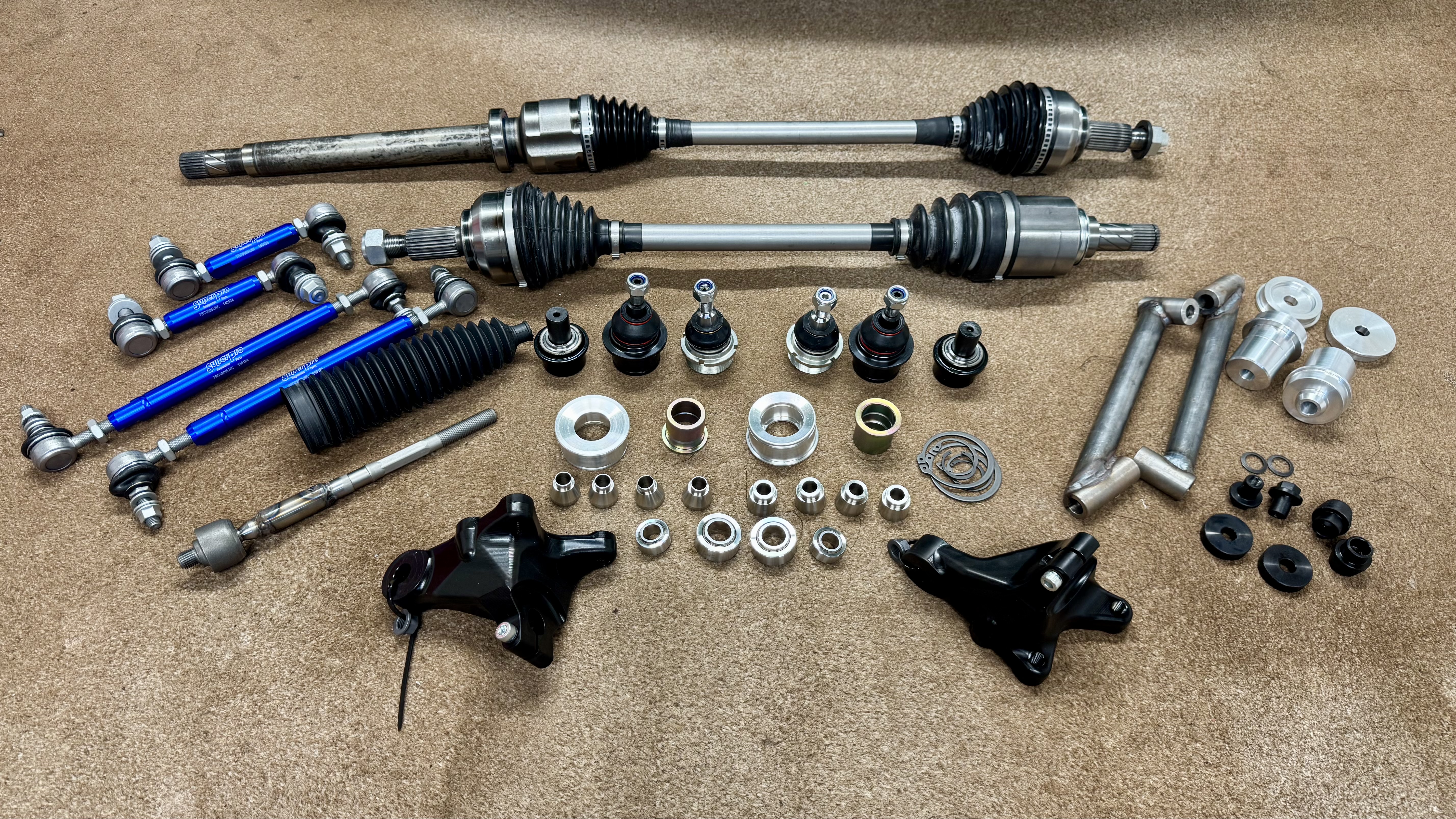

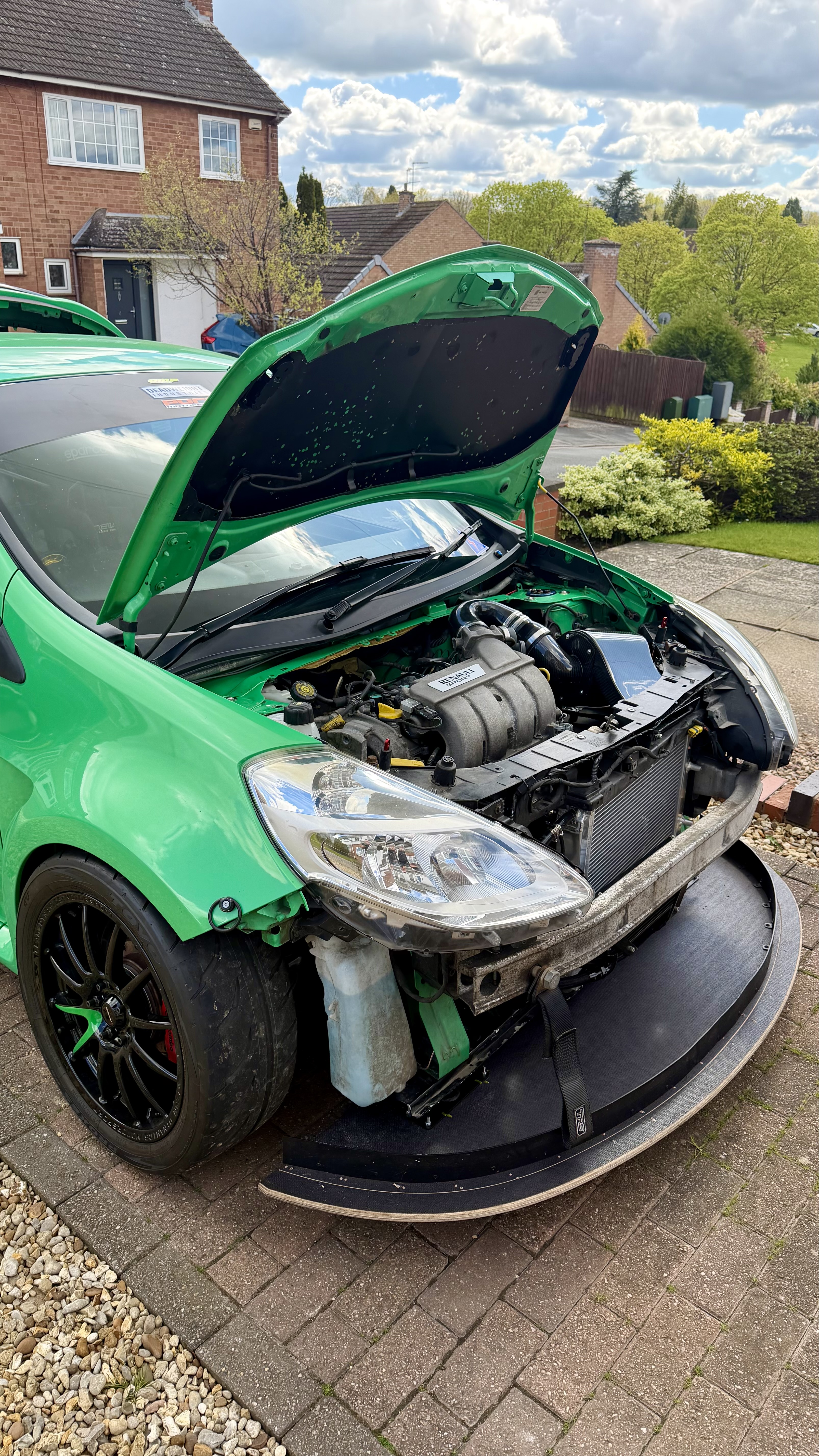

SW motorsport splitter, mounts and cup racer replica subframe brace fitted.
Also broken the air filter so had put the Ktuned filter on for now.

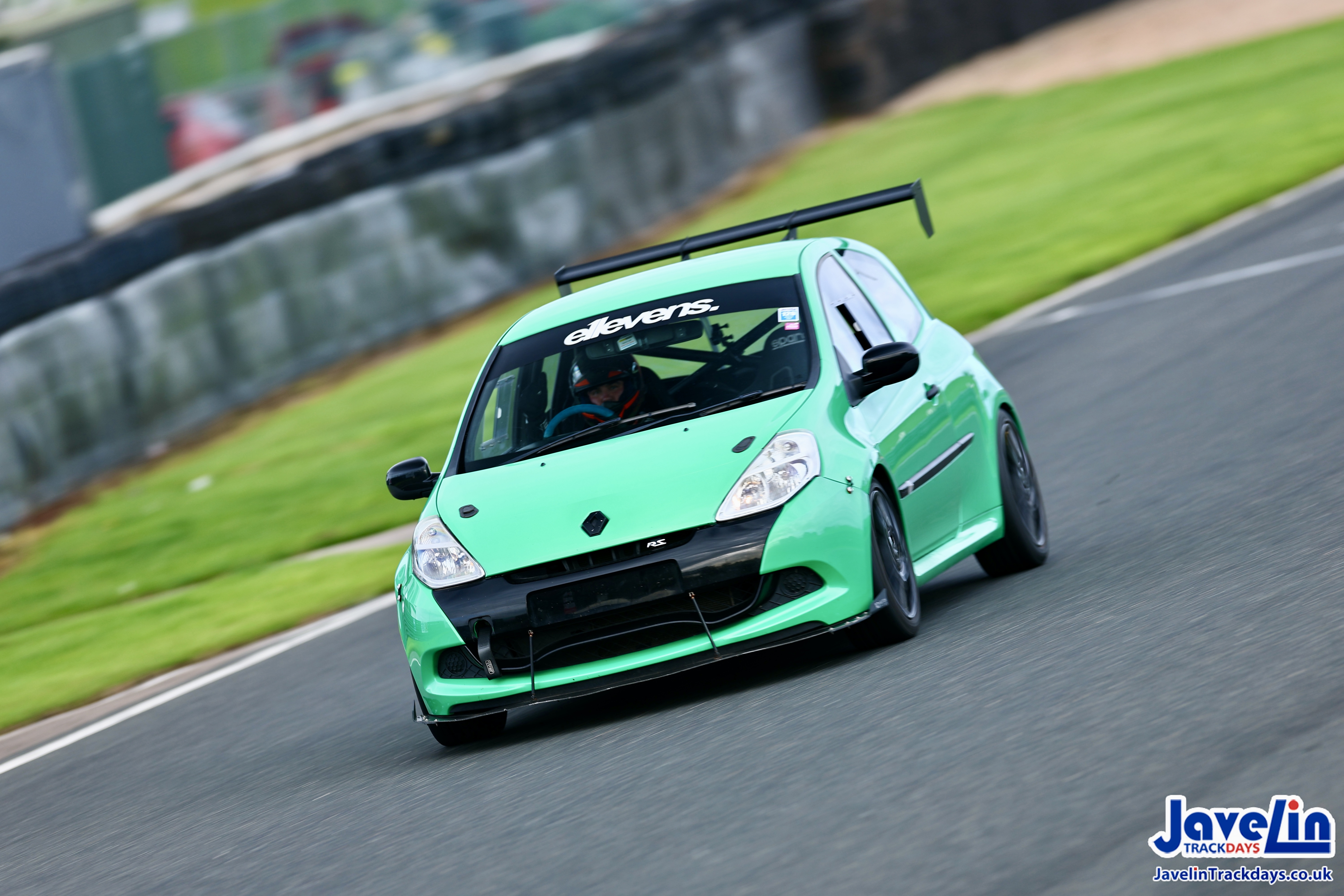

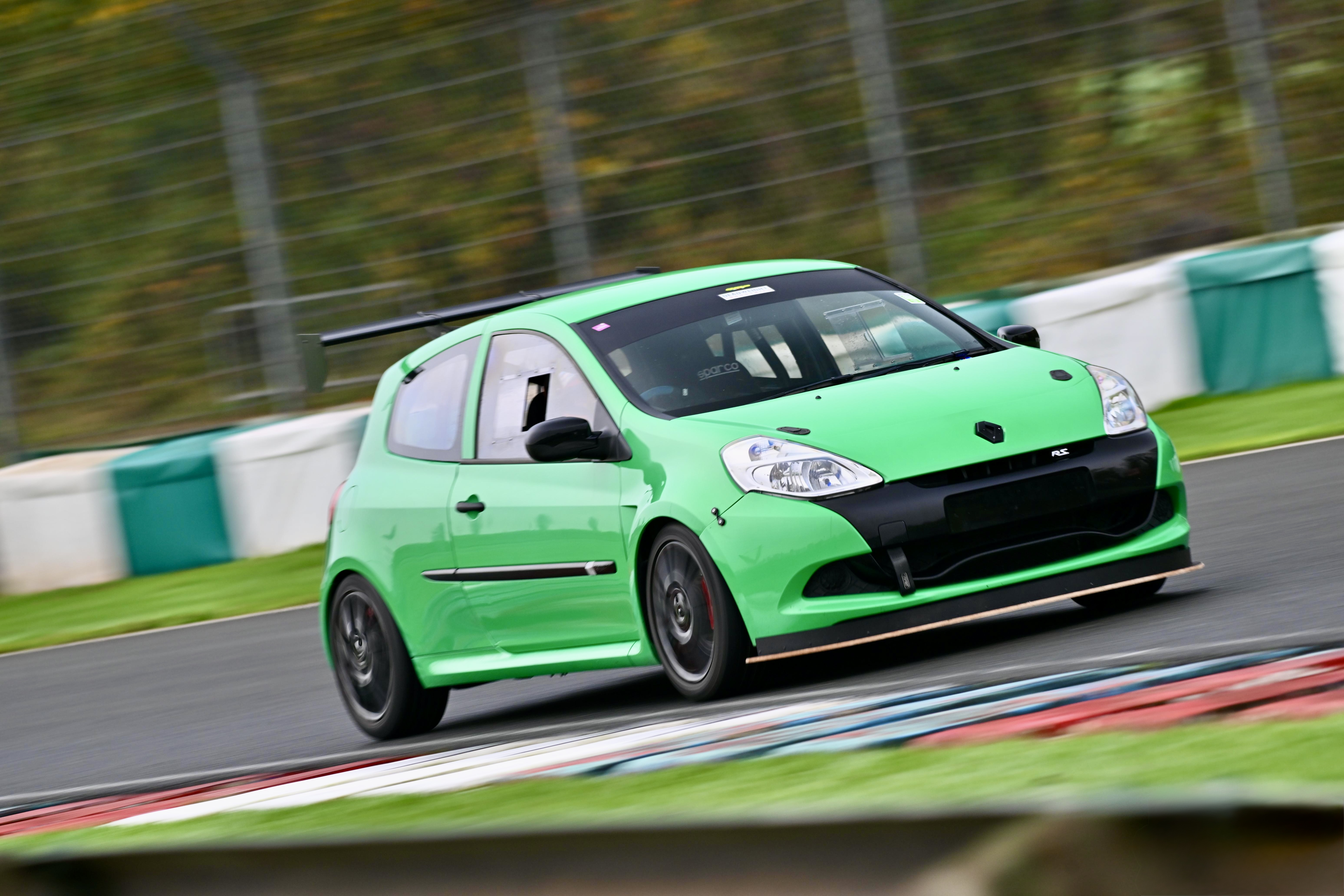

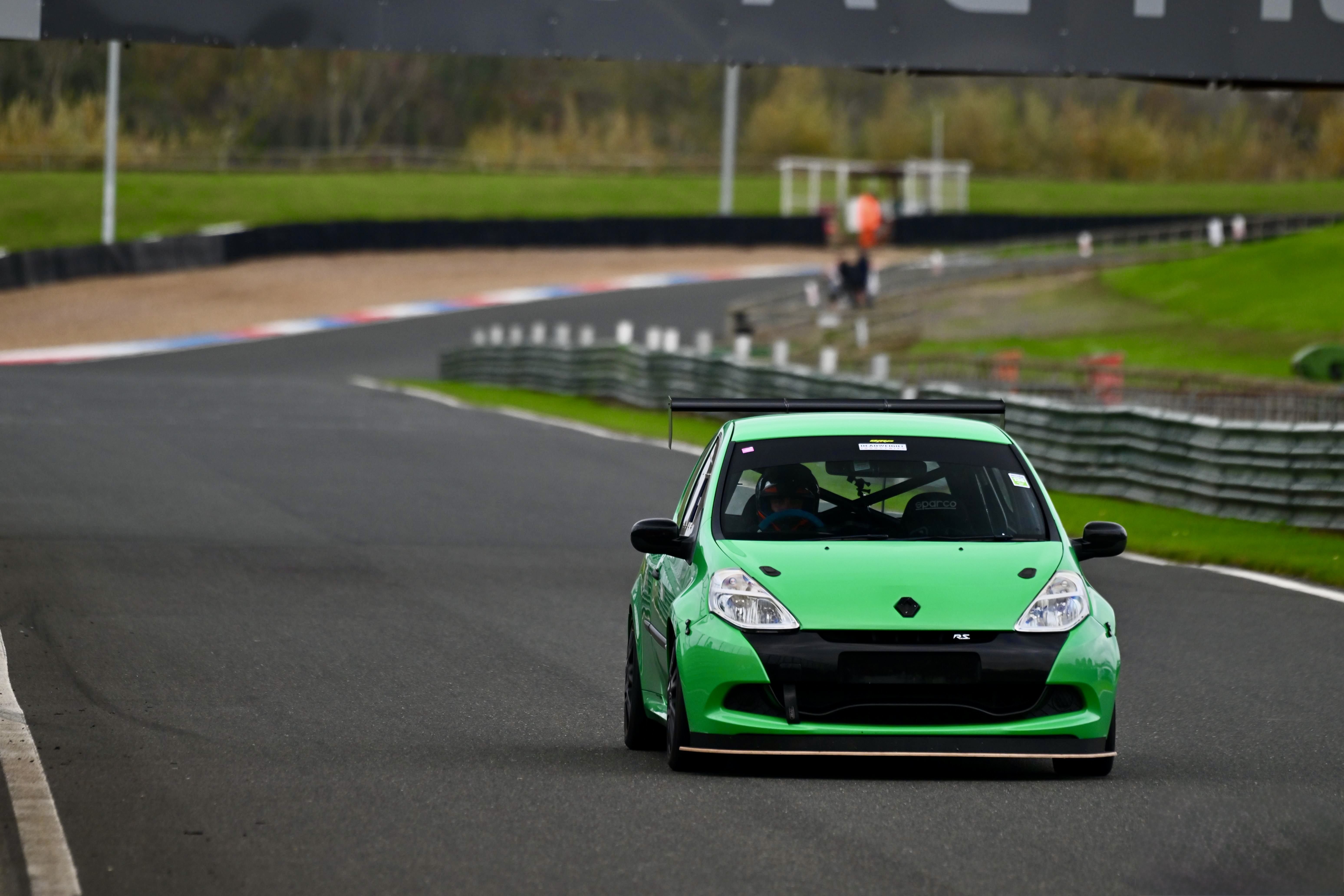

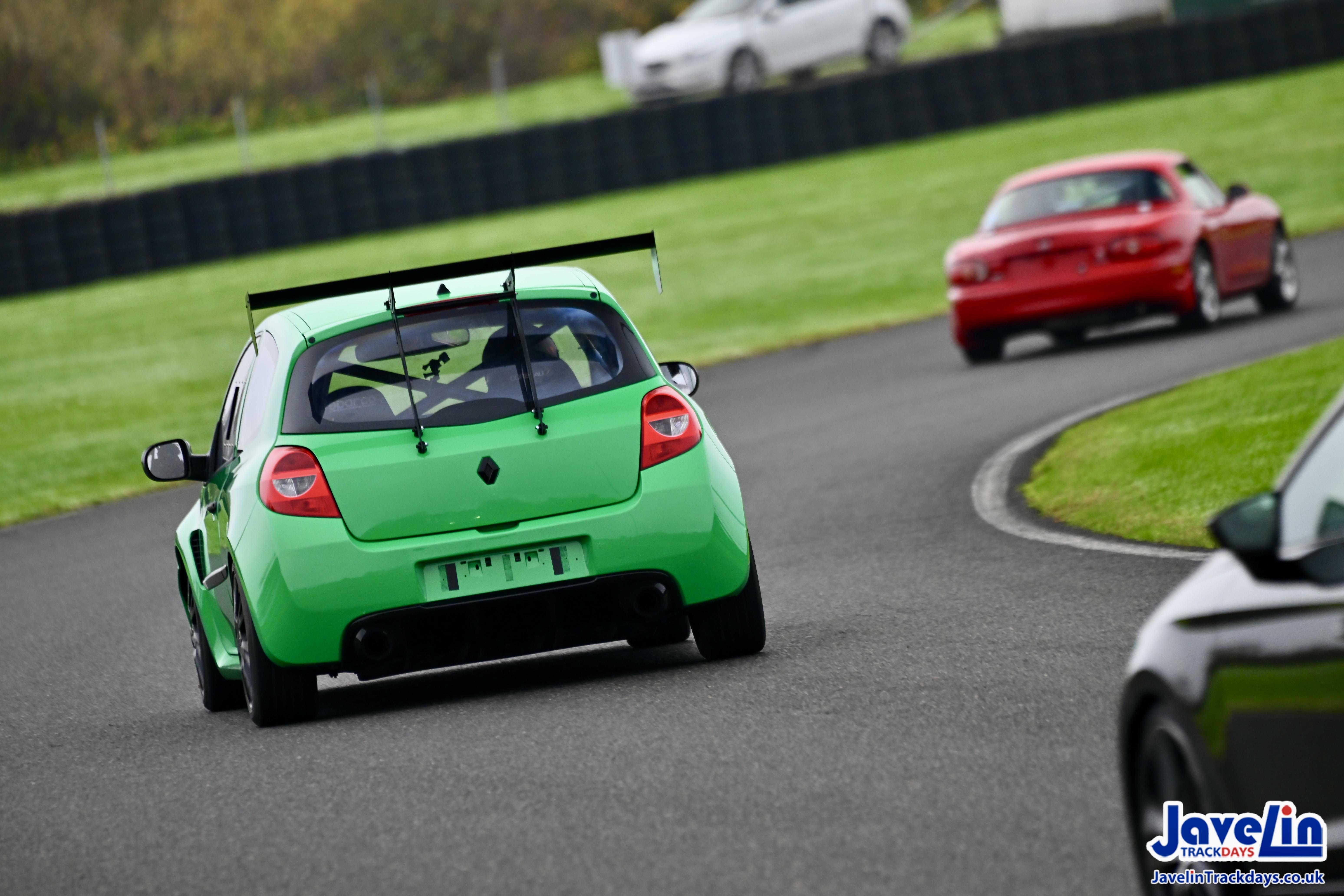

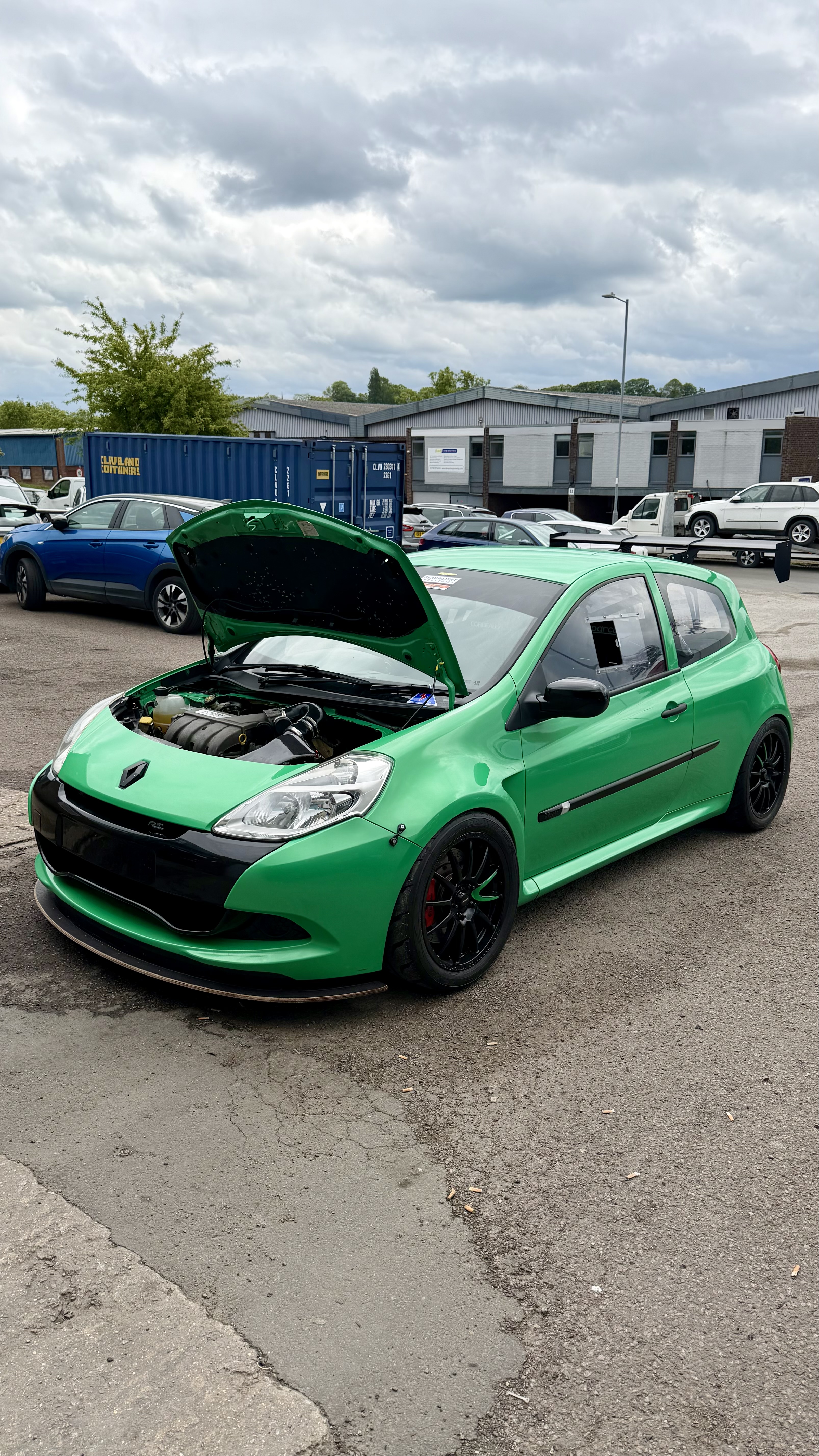

9th November I managed to get on at Mallory Park and the car survived the whole day.
Was much busier than the last track day being a Sunday but really enjoyed the car.
I really need some sticky tyres as the conti road tyres aren’t up to much on track.

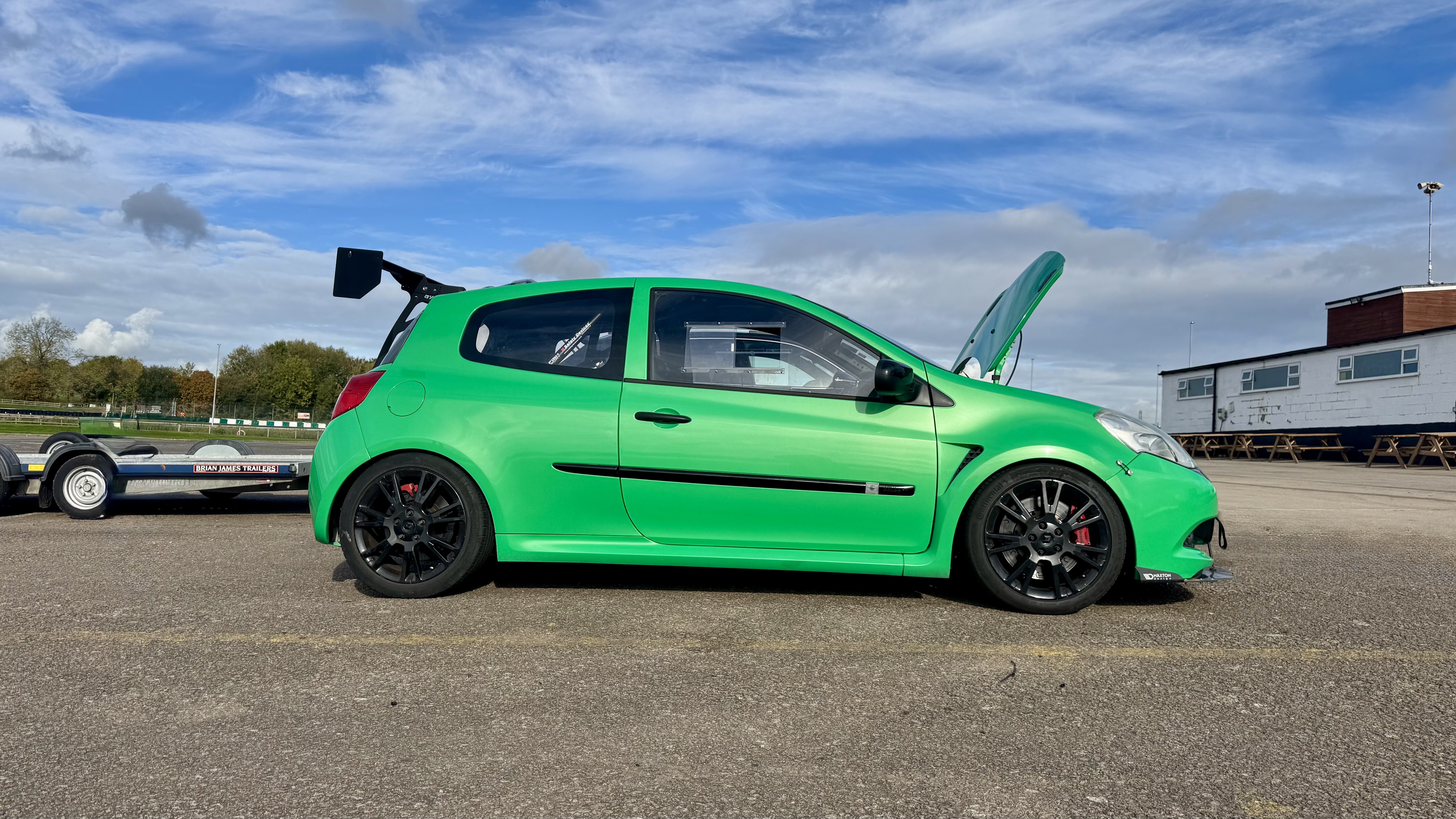

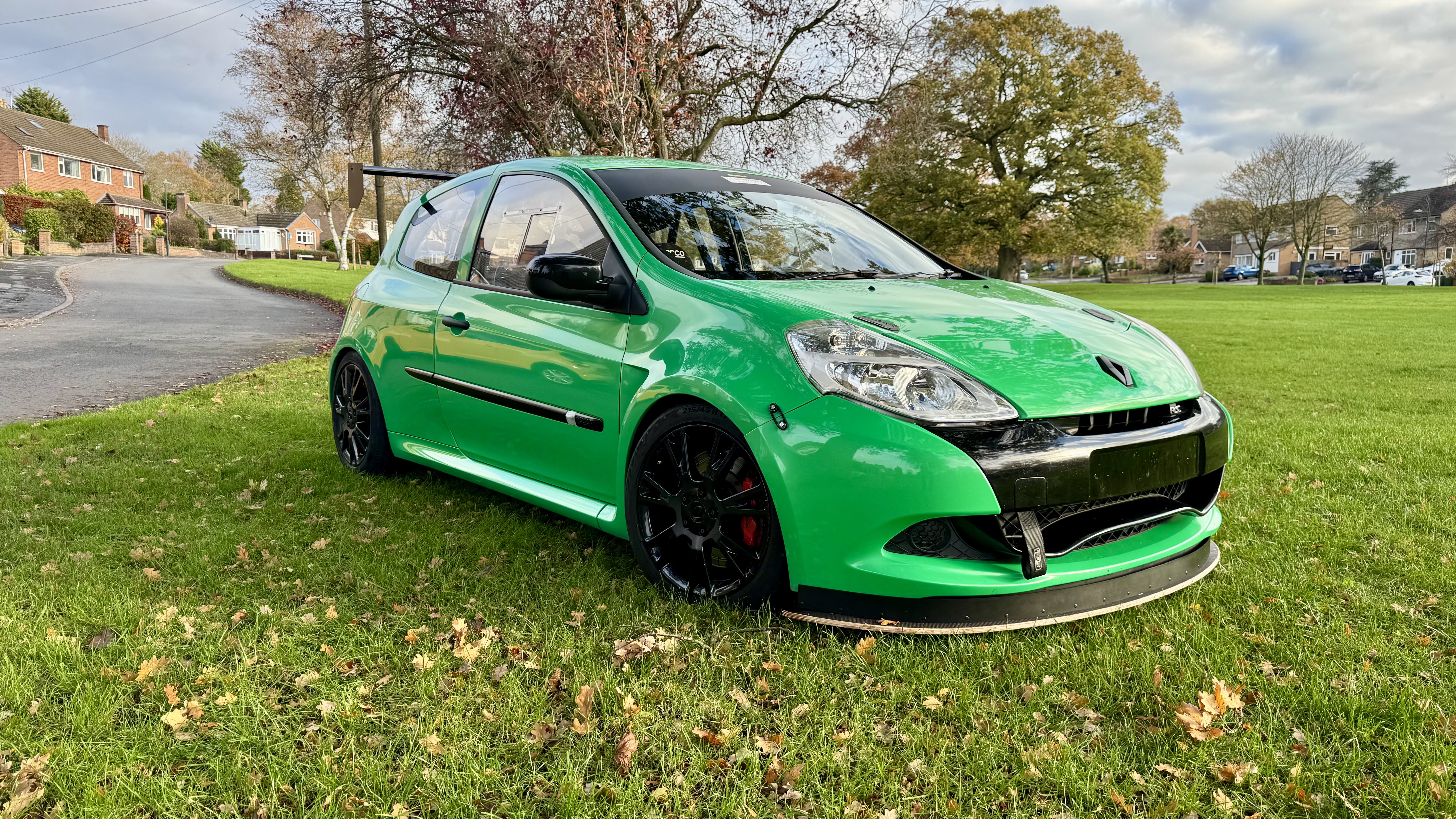

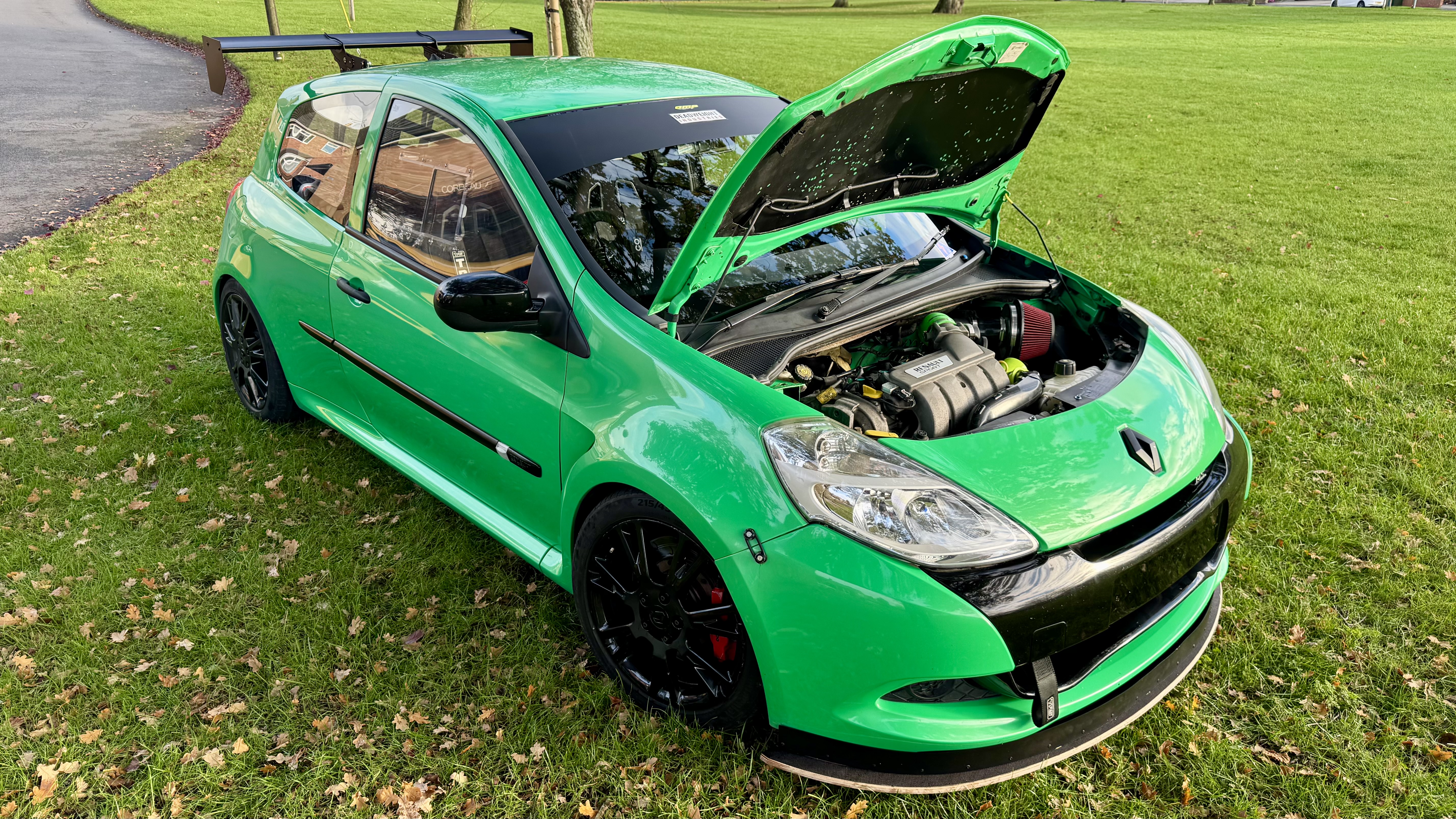

I love how the colour of this stands out so much anywhere.
Few pics
Will be refreshing the front end over Xmas ready for new year.
Looking good, move the wiring inside the cage leg though, you don't want the power cables between cage and bodywork...

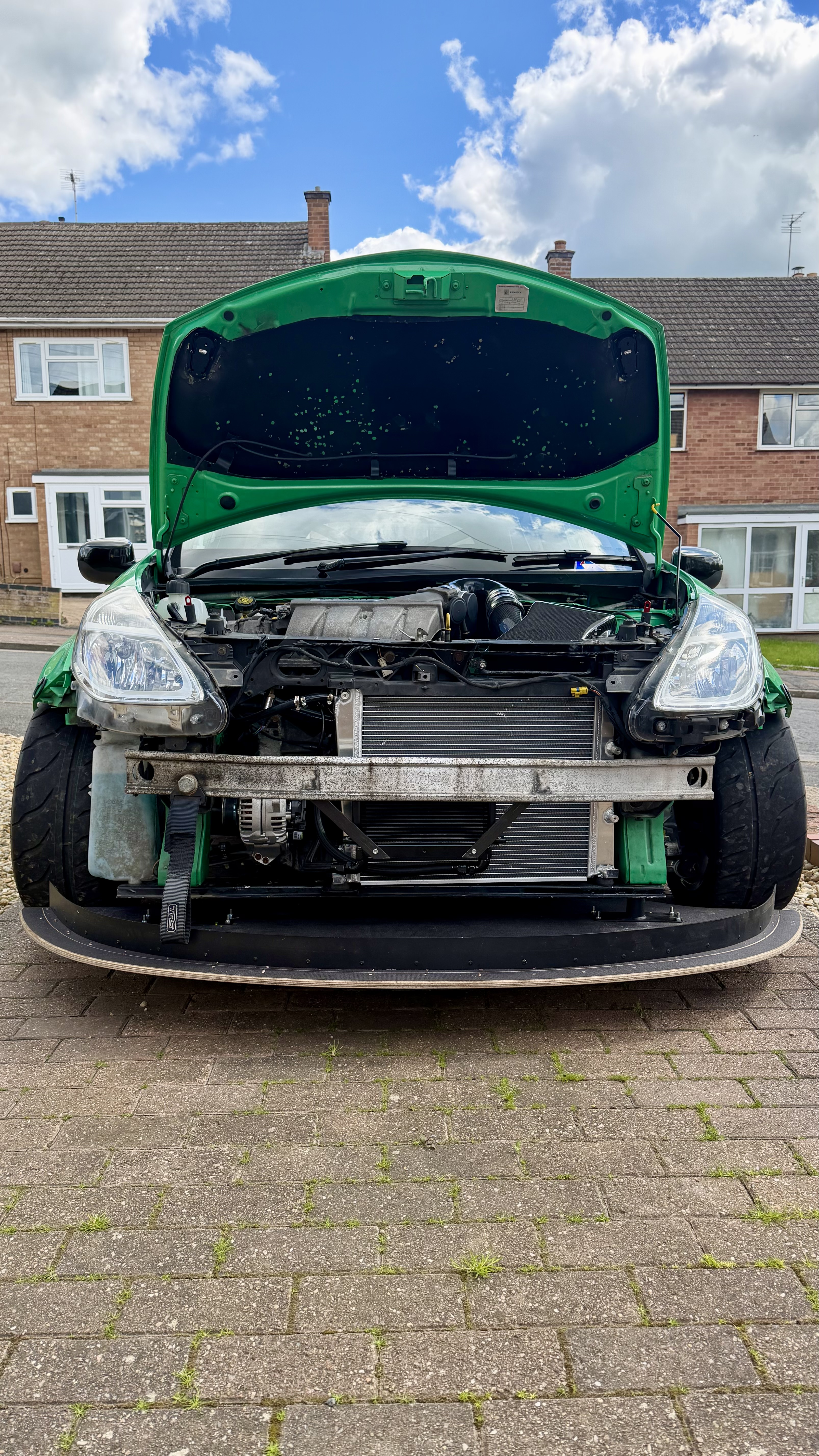

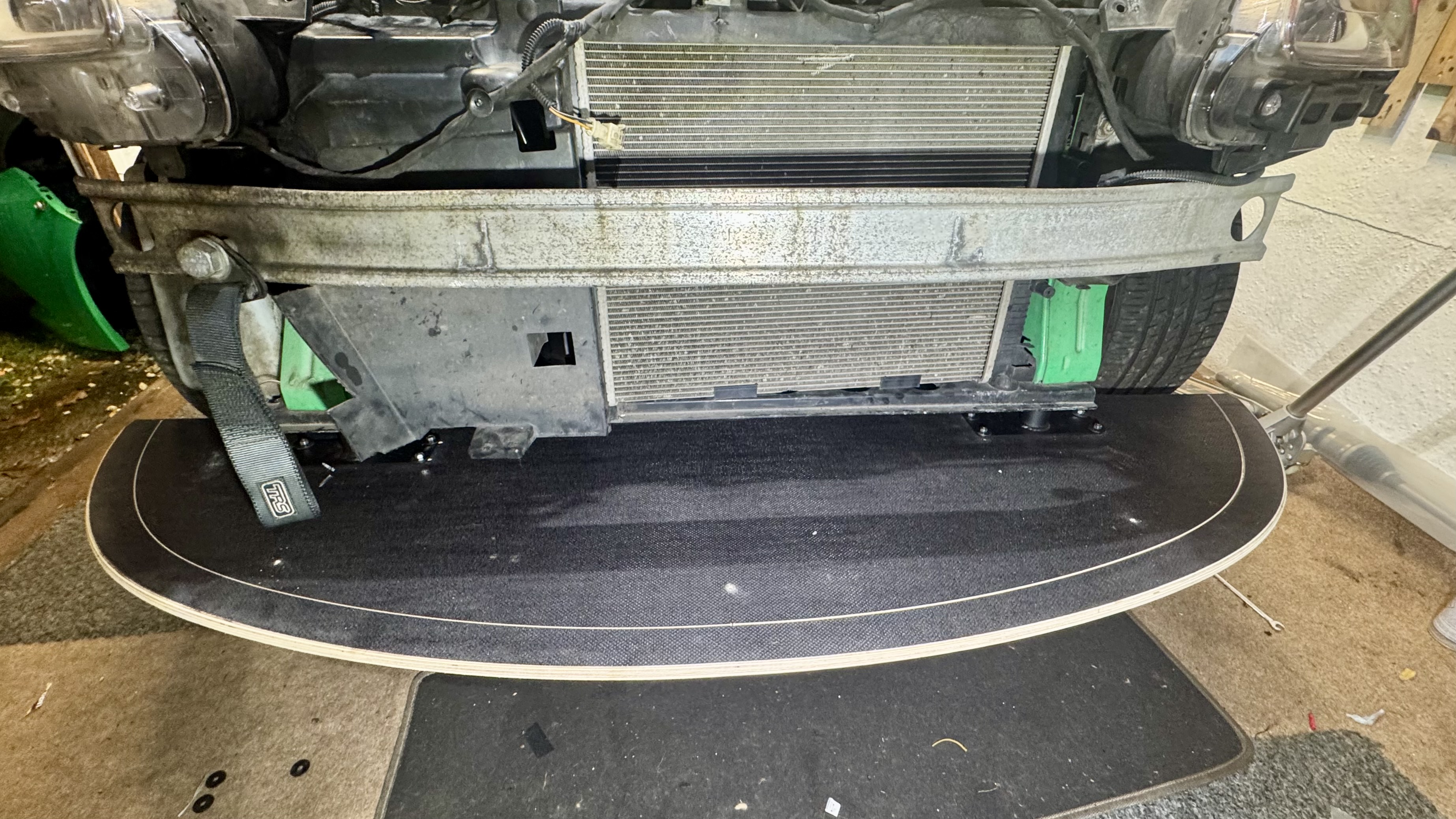

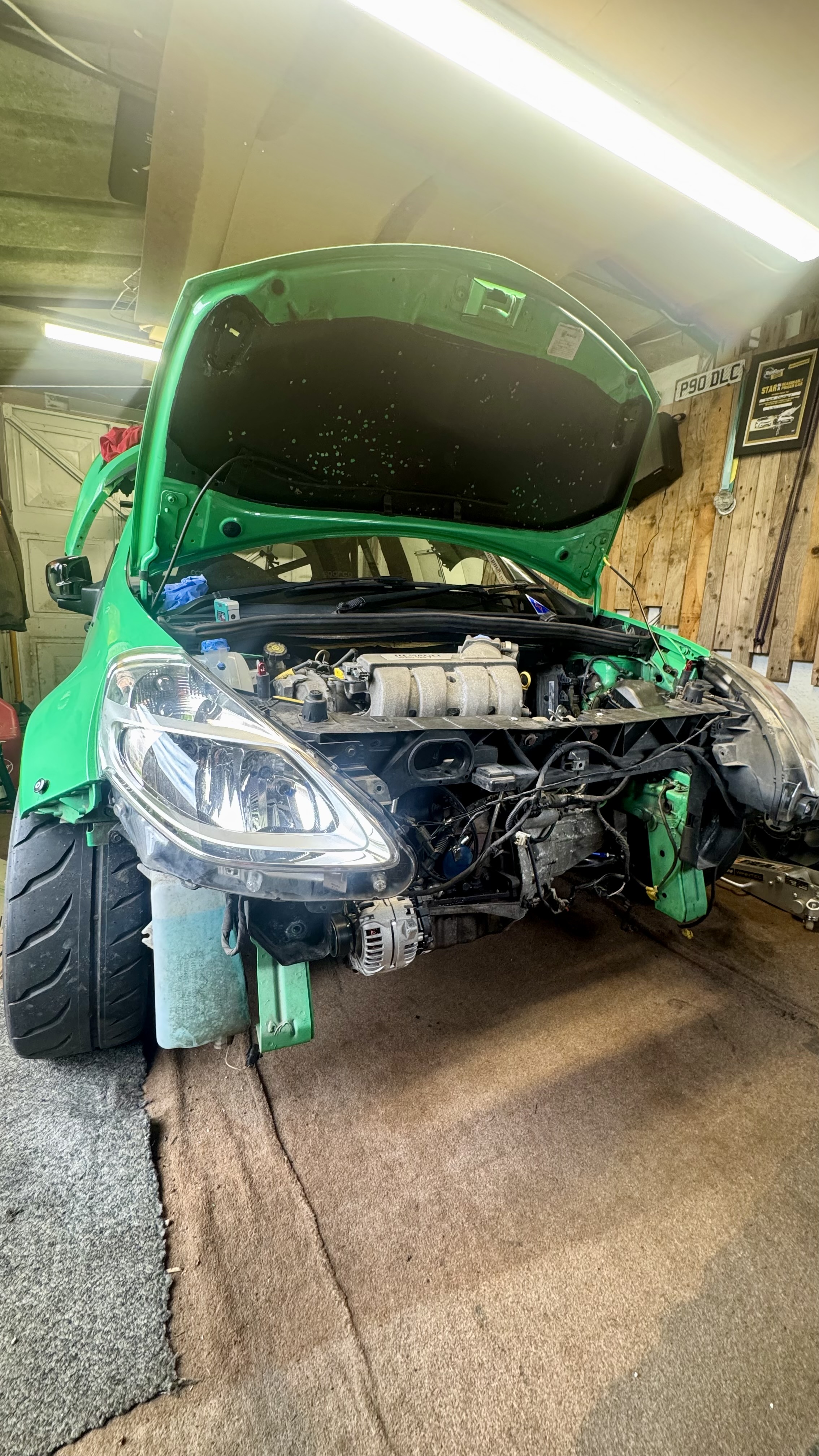

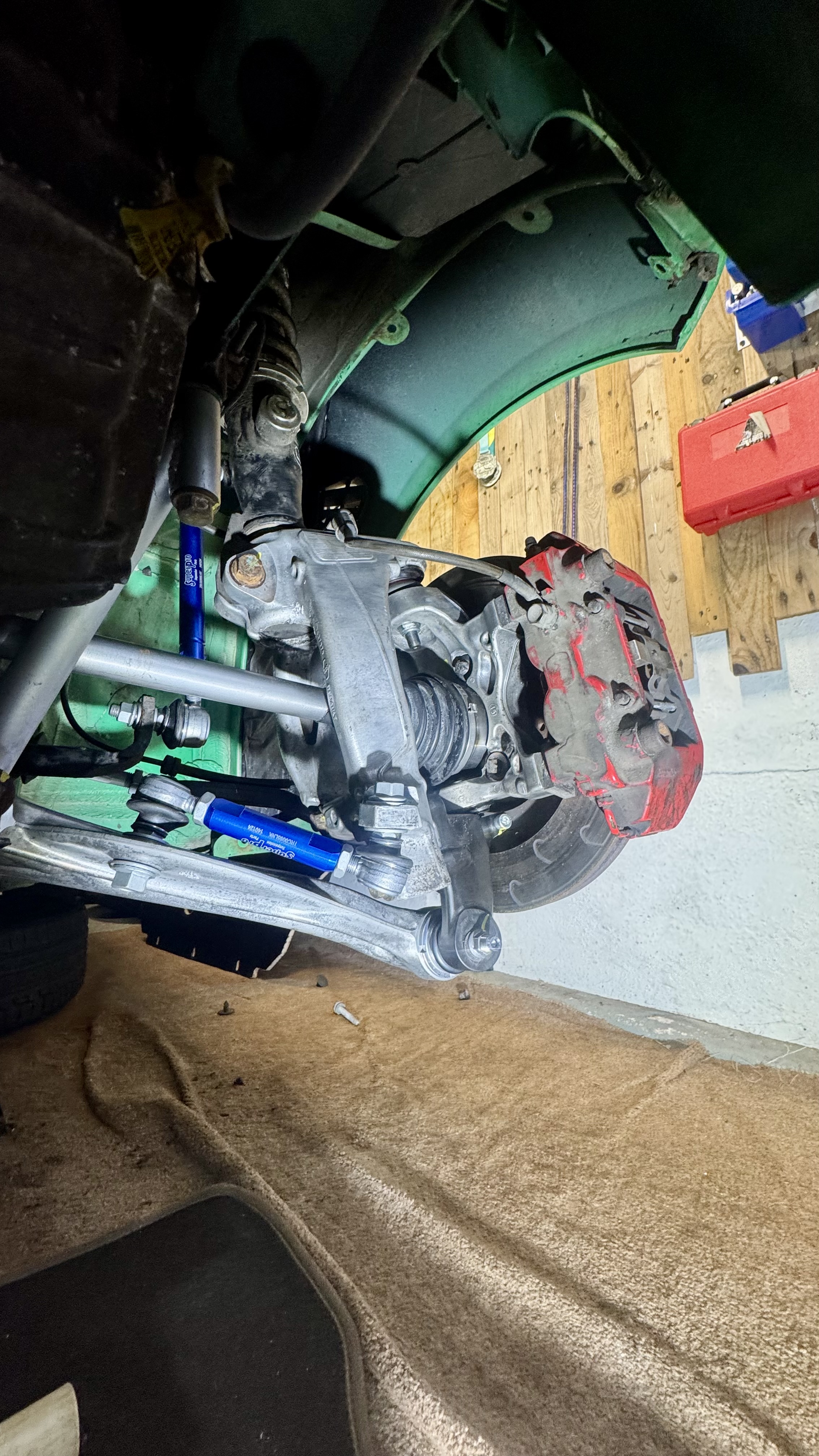

You see in the first pic, the anti rotation link is set to 173mm long as PMS advise this on their site and the wheel is sat against the bumper, popping it off when I turn the steering wheel.
Second pic I’ve set the link to 185mm roughly and have a little gap between the tyre and bumper.
When I was adjusting it, the hub rotates in the bottom swivel joint. I’m hoping this will be ok and save me having to cut the bumper and wing like the CUP racers do.
