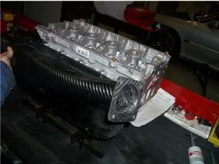

A few of you know my car has been at Angelworks for a while now but it's nearing completion so I thought I'd share sopme sneaky shots of the plenum set-up that's going on. This is a complete one-off and has been designed and made by Ben and his contacts.
K4M....

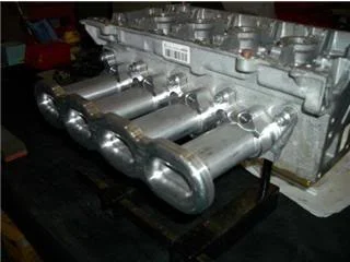

Inlet and injector set-up
Another veiw
Now, this is how it would have look had we had enough room ro use the Formula Renault plenum but the thermo housing is in the way so Ben's making an alloy one to get around it.

I'm a bit confused as to why you'd be doing this to a 1600 cc Clio, mini-valver. Would you not have been better getting a 172 and taking it to Andy for some off the shelf cams and bodies?

Basically the F4R has been done to death and theres no real 'package' as such for the K4M. The S1600's make 220bhp on a single TB so I thought I'd have a bash at making one for the road. I'm doing breathing first then I'll see where I go from there after its been mapped and run abit.
No idea's on costs yet but I will be putting up prices as this is something Ben will be offering once we know it makes decent power, is driveable and mostly reliable.

I imagine it will be very linear then stupidly steep from 5ish onwards because of the short inlet tract.
That's exactly the reason I'd rather do this than go F4R..... Building it is half the fun!

Nice velocity stacks mate. Are they off the shelf or custom machined?

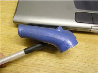

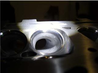

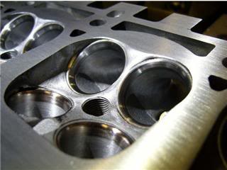

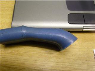

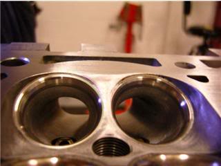

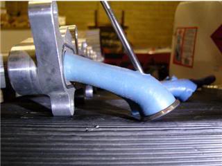

Heres some shots of the headwork. The mouldings show the before and after flow work, Ben will explain more on this as it baffles me!
The head is basically re-designed from standard and looks s**t hot!
Before mould-
After mould, then the tract it will take from the inlet manifold-
A few shots of the 3 angle seats and work to the bowl-
Hats off to Ben!
