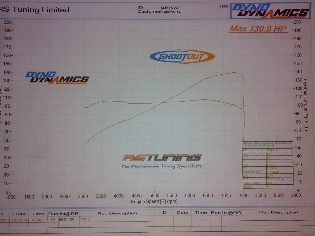

Will do an update tommorrow. The car has been mapped at Rstuning, will take photos of the graph and do some bits on the car in the morning.
Made 140 bhp in 4th, which on Pauls rollers is impressive. The car drives so much better now, pulls cleanly through every gear. Hit 130 with ease on the way home, torque and power are SO SO linear which is really weird being a 1.6 with, comparitive to standard, wild cams and short runners!

Took a pic of the printout to how the power and torque curves. The car pulls really well low down, shown by the linear as feck torque curve, drives brilliant around town. 140bhp peak may not sound much but the car feels really eager and happy to be revved, love it. After all, it may have taken a while but its still 30+ bhp from cams, headwork and a plenum!

Nice torque "curve" lol... are you sure you've not had a dci transplant? ;)
Can't wait to see it mate!
It´s really a nice flat kurve, but I wonder that its maximum is only 147Nm, when I did caculate correctly (1FtLb=1,355Nm)...

Yeah Im'm running the Cat cams 704's Oliver. The Dbilas one has longer runners than my plenum, I expect thats where the extra torque comes from! Mine are really short, with the cams being more peaky than standard, I'm impressed that I make just over standard torque from 2000 RPM!!

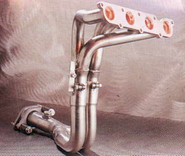

What do you think of it? This will become my new exhaust manifold. A Supersprint 4-2-1 manifold originally for the valver, already redesigned for a F4R engine that a friend had in his Clio Mk1, so I need only weld on the K4M flange....

Id run a decat, Id only have the 182 cat for MOT purposes as its a peice of piss to change, being a small pipe directly under the car! That manifold looks good, I'd be a little worried about getting a link pipe made to fit to the original centre section though! Which way are you planning on doing that?? For the K4M flange, did you get a cnc copy of the gasket made?

...That manifold looks good, I'd be a little worried about getting a link pipe made to fit to the original centre section though! Which way are you planning on doing that?? For the K4M flange, did you get a cnc copy of the gasket made?
What you see on the picture is only the upper section of the manifold, the entire manifold for the valver looks like this:
The upper double-Y section sticks in the lower Y section, an it will be connected to the cat by a flex-hose that´s directly weldet an no flange, so that the lower Y section an the cat is one piece. (not like it´s original and shown on the picture)
I made a model with the main dimensioning taken from the gasket. The flange was then water-jet cutted on a CNC-Machine. I can make a picture this evening.
