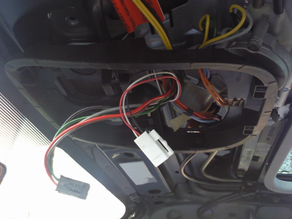

I started off by removing the motor and loom for the sunroof (I'm still in 2 minds on what to do with the actual glass yet, more on that later though).
This is what I was left with after the roof lining and interior light was out...

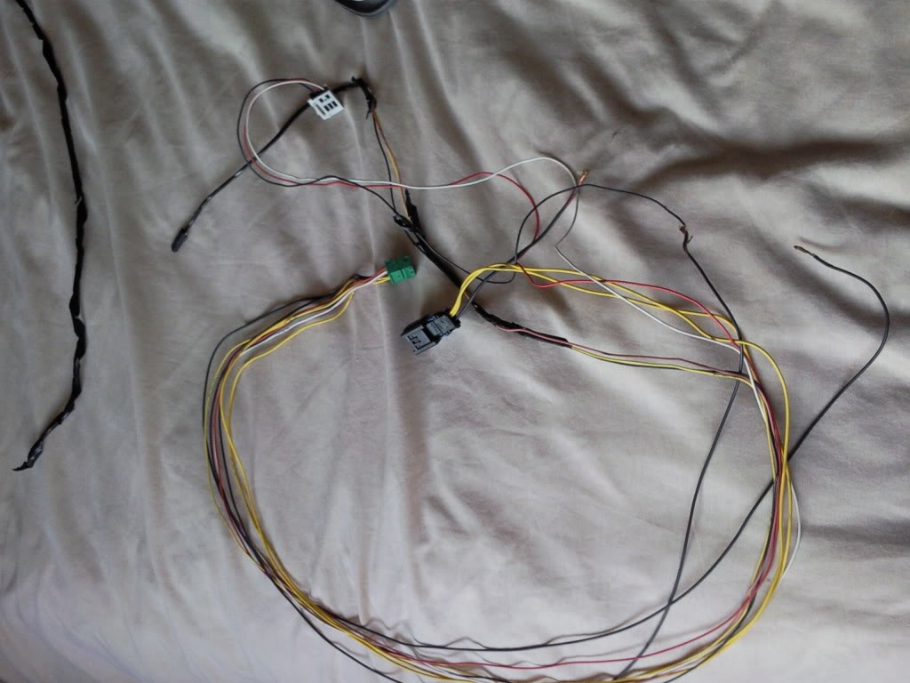

So, removed the motor and all the loom which goes from behind the dash to the sunroof/light area. I want to keep the interior light (Or some sort of one) so I removed any wiring from the plug that I didnt need.
Original....
All the crap removed...

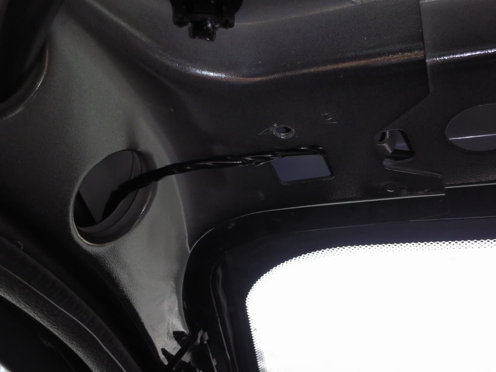

So, routed the interior light wiring where it will be as hidden as possible and plugged it in, checking it all worked. Any bits that are exposed will be covered in blck flexible conduit, not just left taped ;)

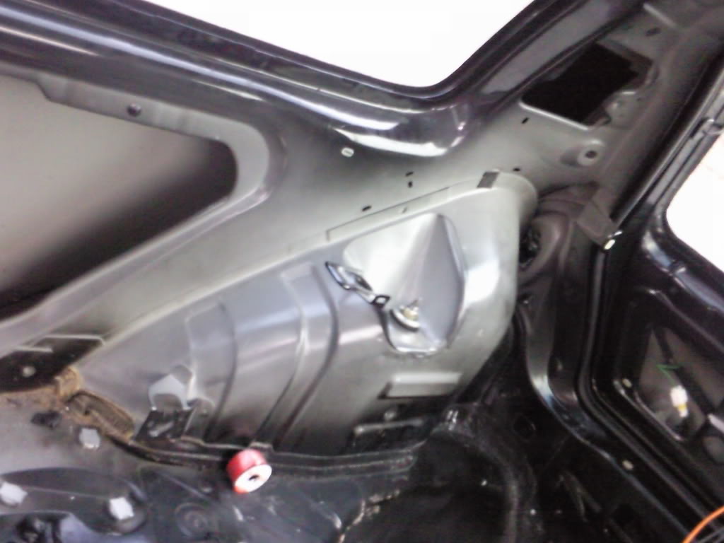

How the roof looks now the motor and all un-needed loom removed....

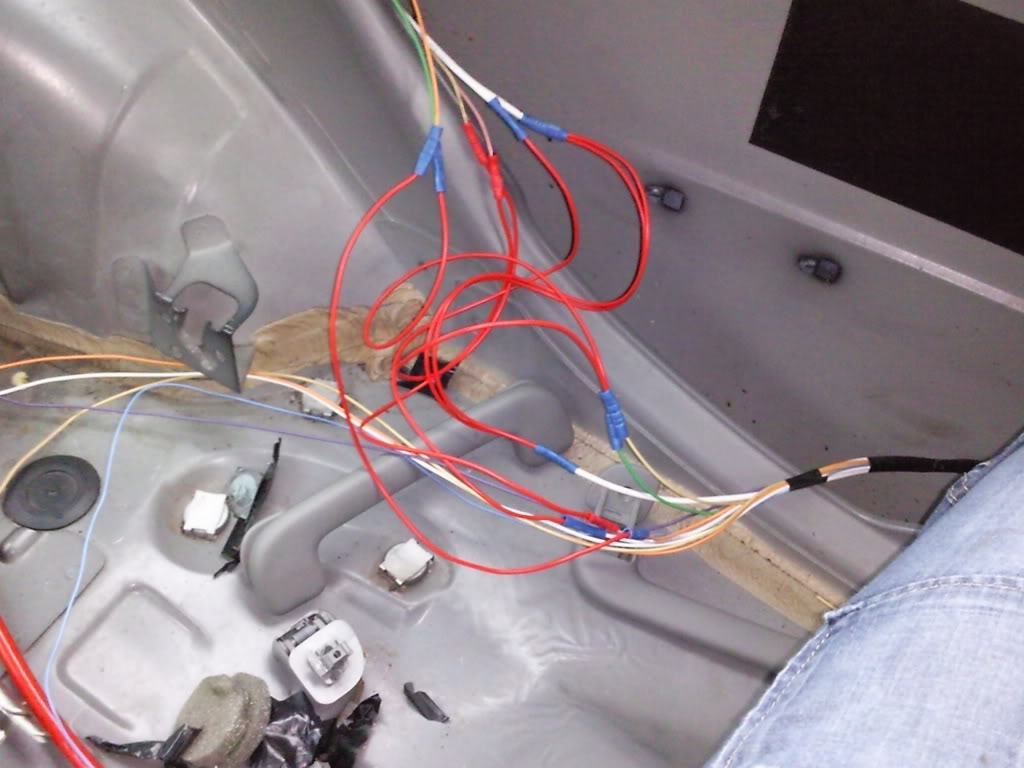

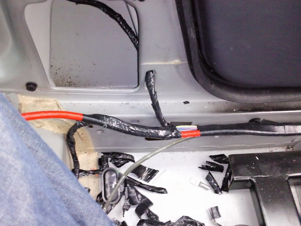

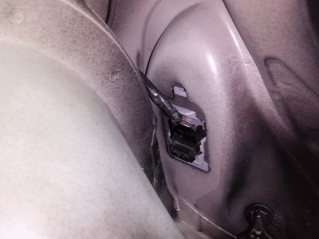

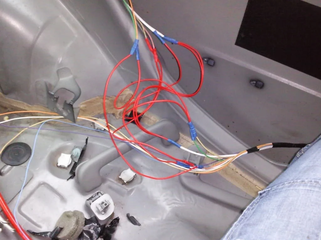

The rear of the car when stripped IMO, looks a mess with how the wiring is routed. When the car is painted, I didnt want loom draped everywhere so I starte to hide the interior loom. Again, everything will be flexi'd, not just left in tape. Where ever possible aswell, I removed bts of loom and switches I wont need.

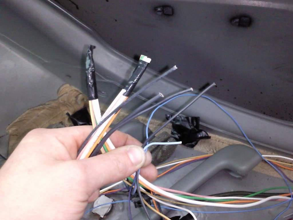

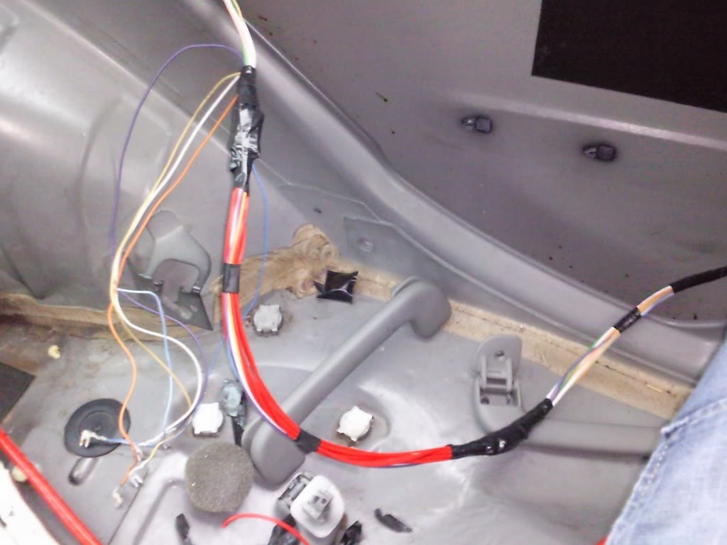

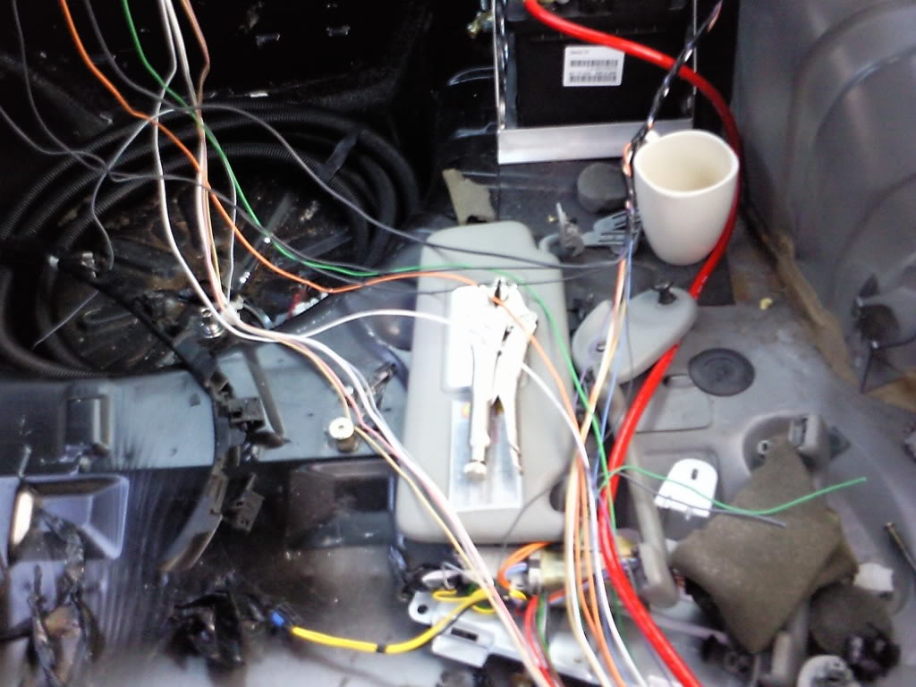

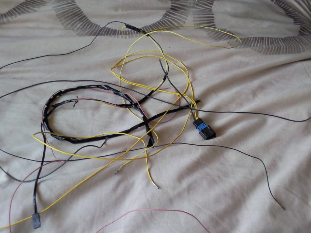

So, I cut the loom in half and un wrapped it. Working from a wiring diagram I stripped back the wiring for rear speakers, door shut switches, spare earths etc.
After a while getting the looms through existing holes (I have carbon door cards to go in and a big sheet of carbon to cut to suit any apertures in the rear so avoided anything I can blank off) The arches looked like this

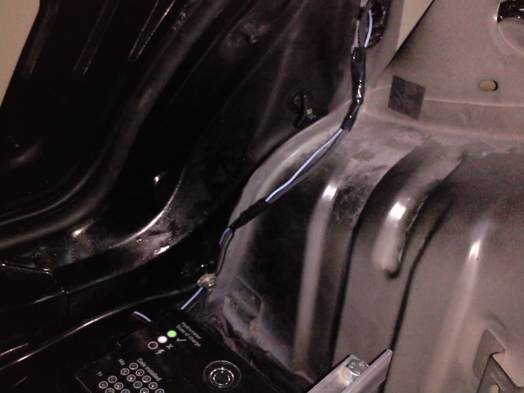

The side with the battery tray in, has the earth and number plate light behind it, I fed the wiring through a hole behind the battery and will have to flex the wiring which feeds the No. plate light. Not a problem because a) The battery hides it and b) its the main earth point for the rear light originally so made sense to use it.

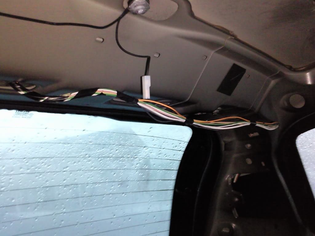

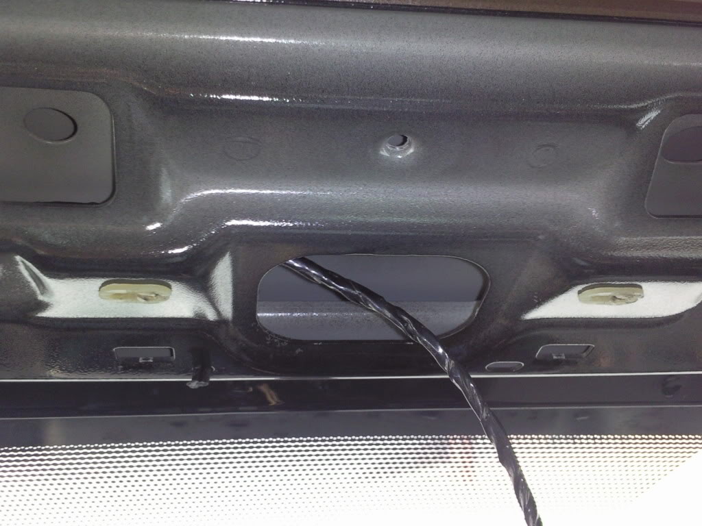

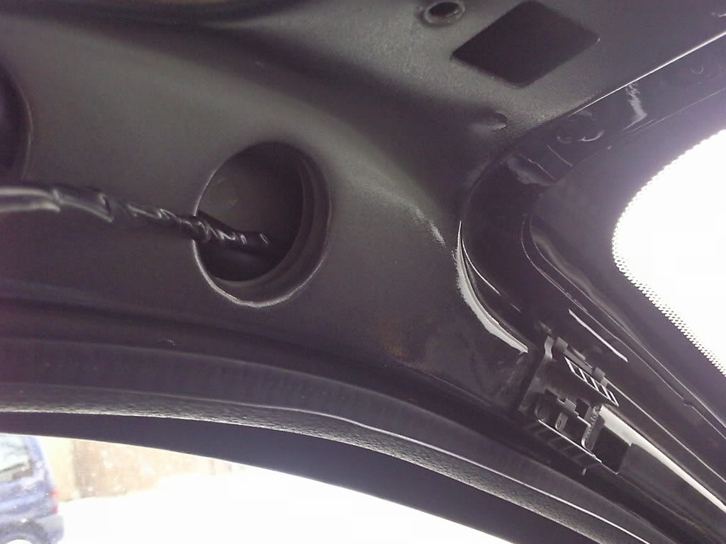

Theres one length of loom that I cant hide easily, which runs across the roof above the boot, which feeds the boot lock, high level brake light etc etc so I'll flexi it and tie it neatly to the panel, when the inside is painted, you'll not notice it because it's out of sight but will be neat enough anyway.

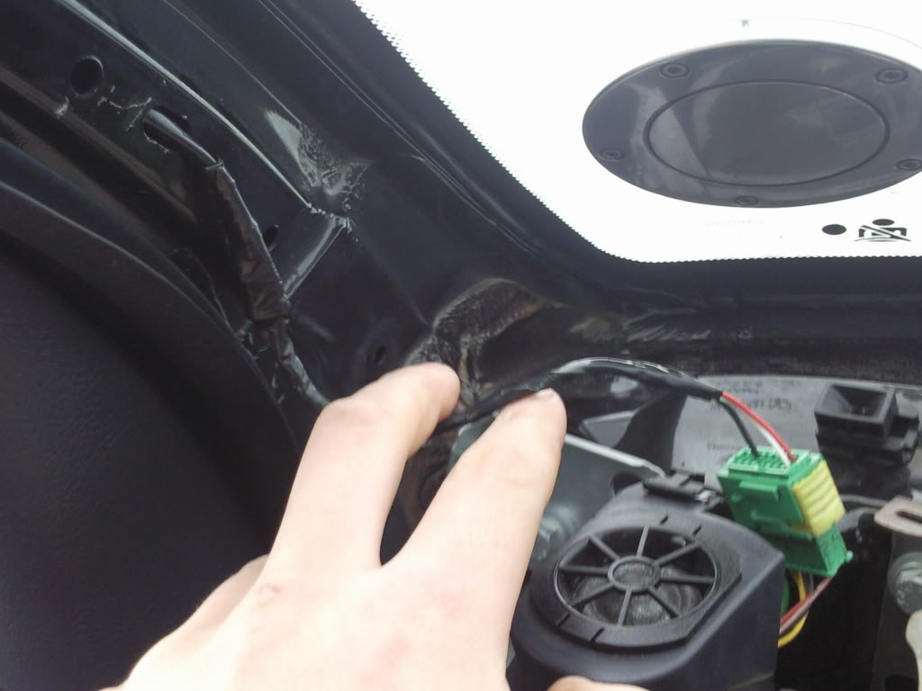

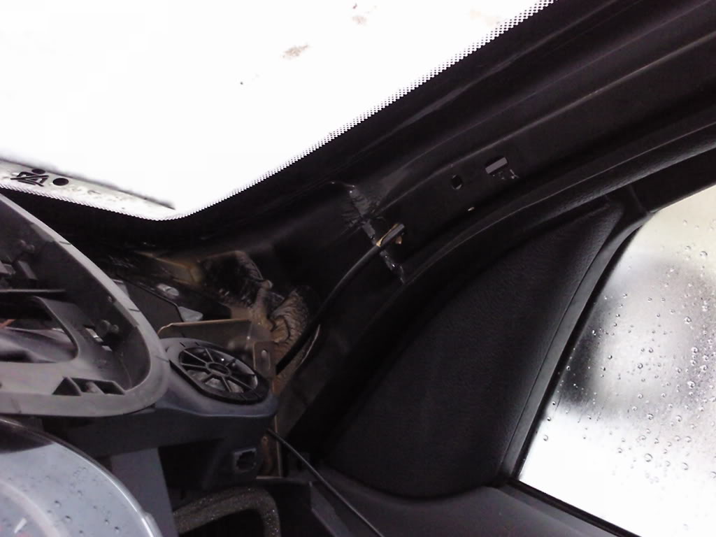

I cut the aerial cable and fed that through the panel gaps inside the car too, neatens the insde so much without any loom anywhere!
