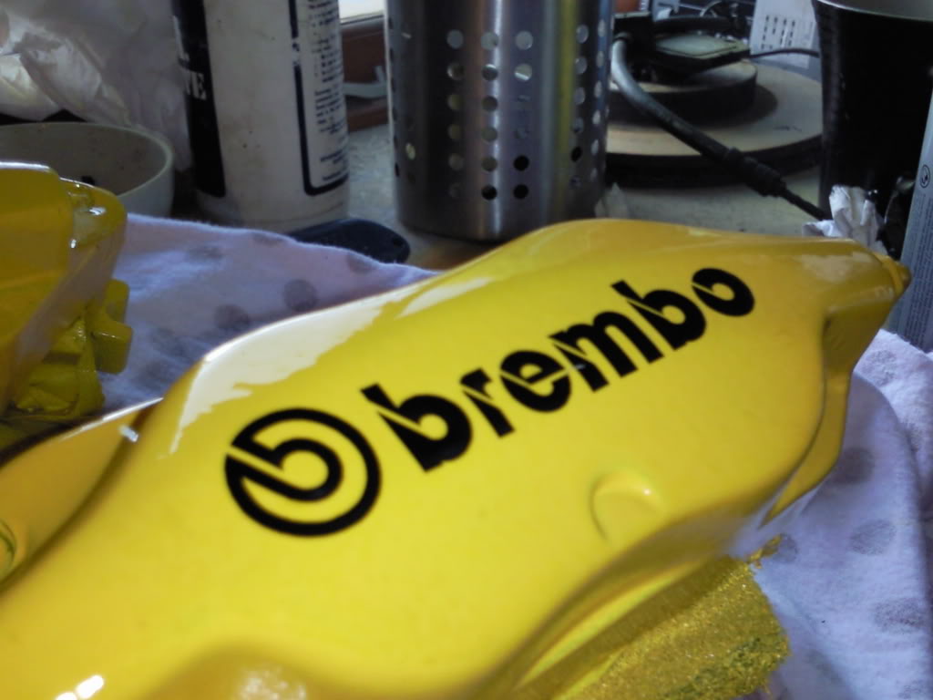

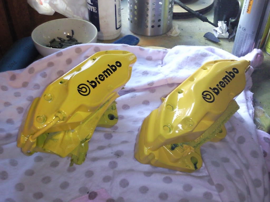

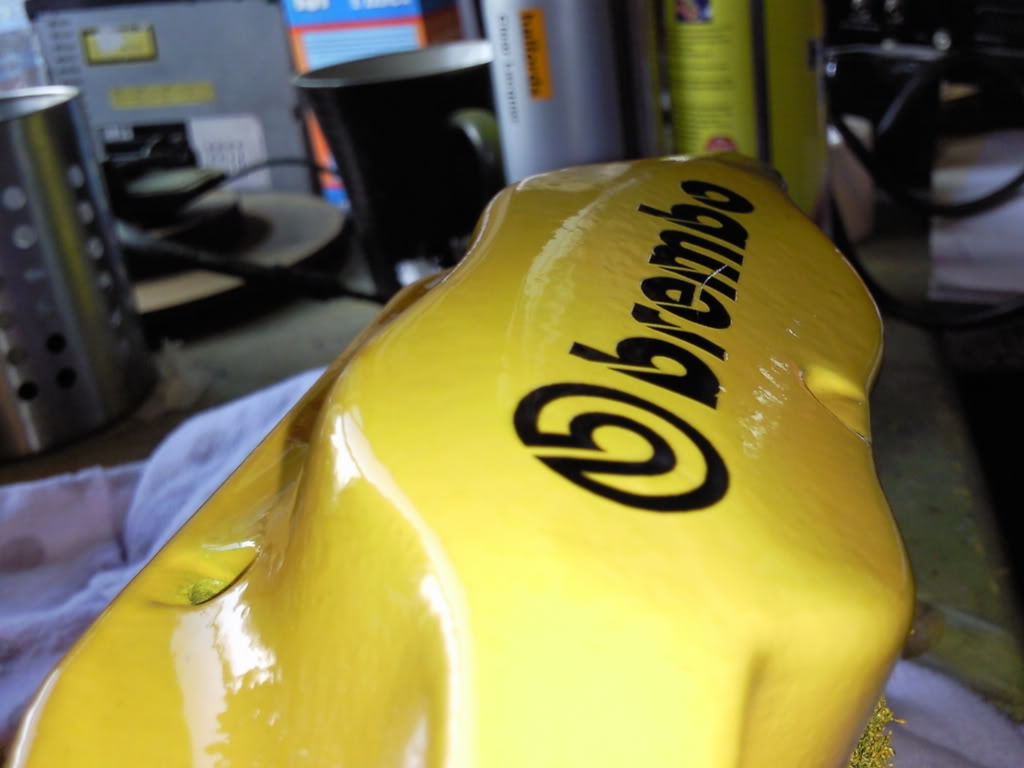

Made some decent progress today, nothing massively exciting but its definatly moving in the right direction now. Started the day by putting the final coat of high temp lacquer on the calipers, the plan was to fit them this weekend but I'm STILL waiting for my spacers to turn up! Ah well, next weekend for that I guess.....
So, the calipers look like this now, all I need to do is un mask everything, new bolts through (2 piece caliper) and new bleed nipples when the lacquer is dry....

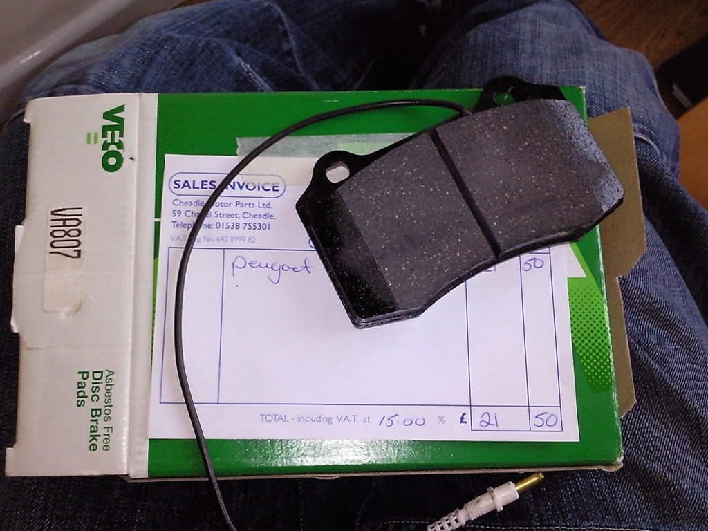

Collected my cheapo "set-up" pads from the loack factors too. Going o use these in the calipers when I bleed the brakes to get them spot on, then swap to some fast road/track pads. £22 for the fronts, CHEEEAAAPPP!

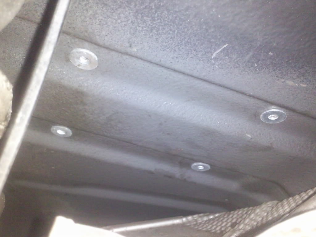

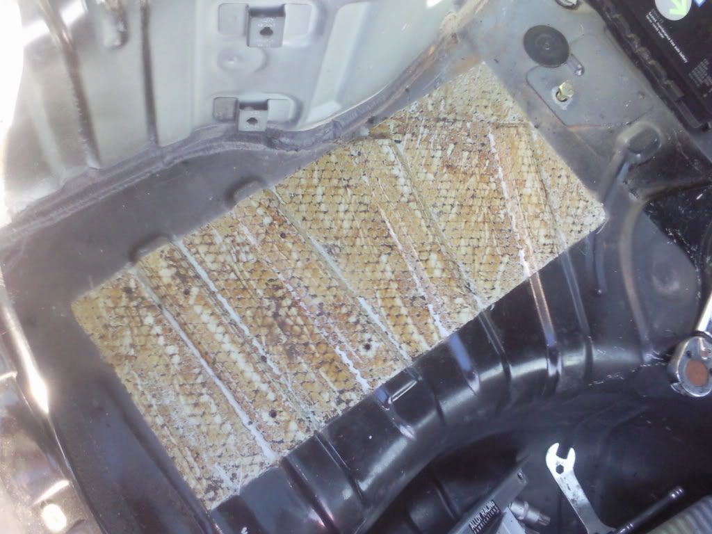

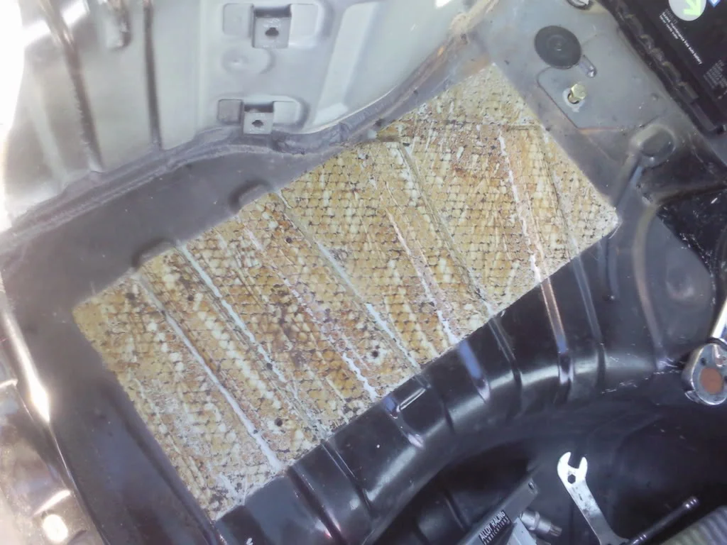

Then decided to crack on with the rest of the tar in the car. I bolted the battery cage over the patch in the boot before FCS as I had no time to sort de-tarring it all as you'll know if you've been following the thread. I was cursing myself getting it off as when I put it on, there was no exhaust :eek:
Cage out, and a shot to show where the nuts were, above the backbox and heatshielding...

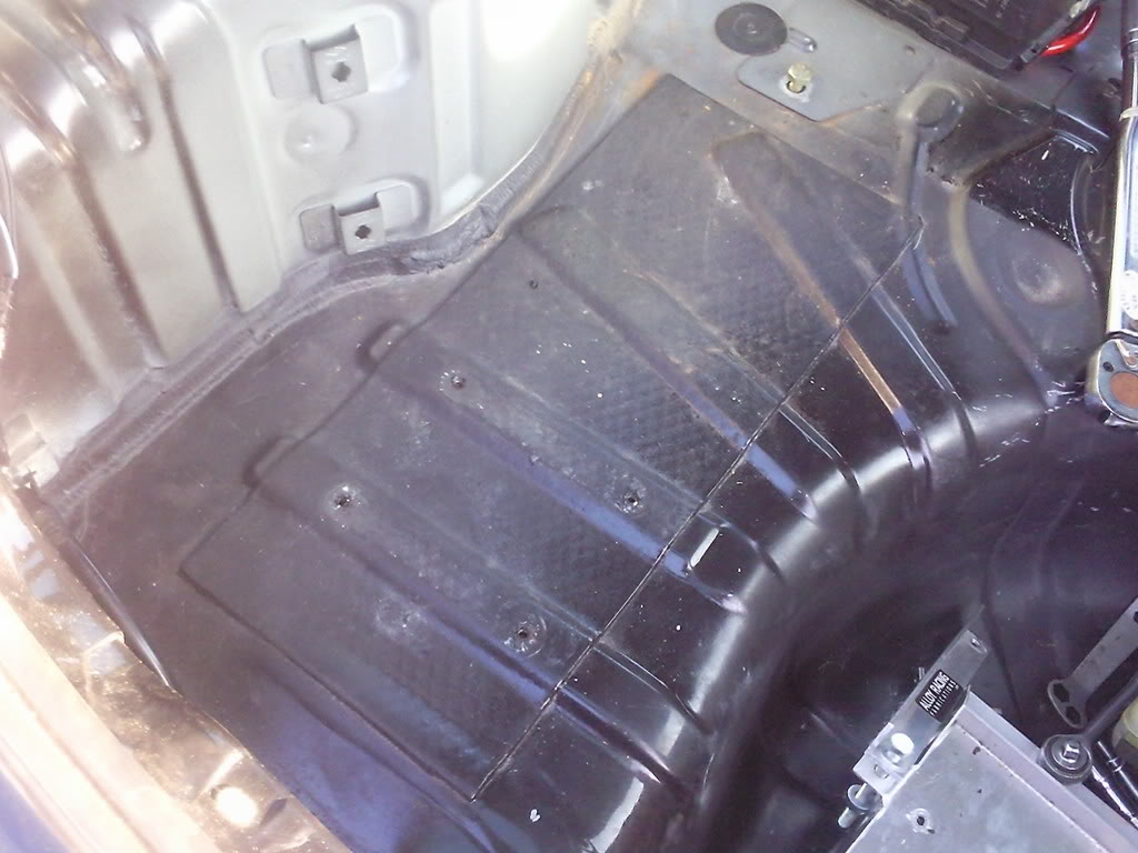

Anyway, minced the tar off from their and in the rear quarters...

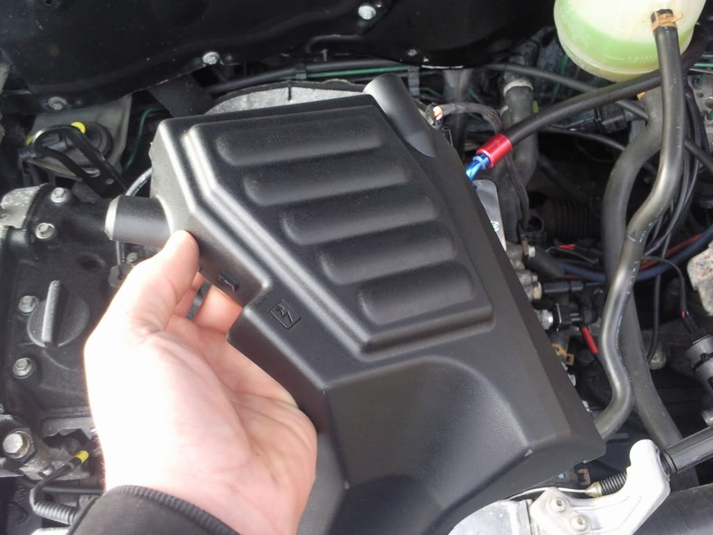

Next job was fit the fuse box cover I picked up from the Kev's after they got me one from Renault. I needed an excuse to visit the anyway ;)
Anyway, I snapped the clip on the lower half so ragged it out and I'll get another, lol.

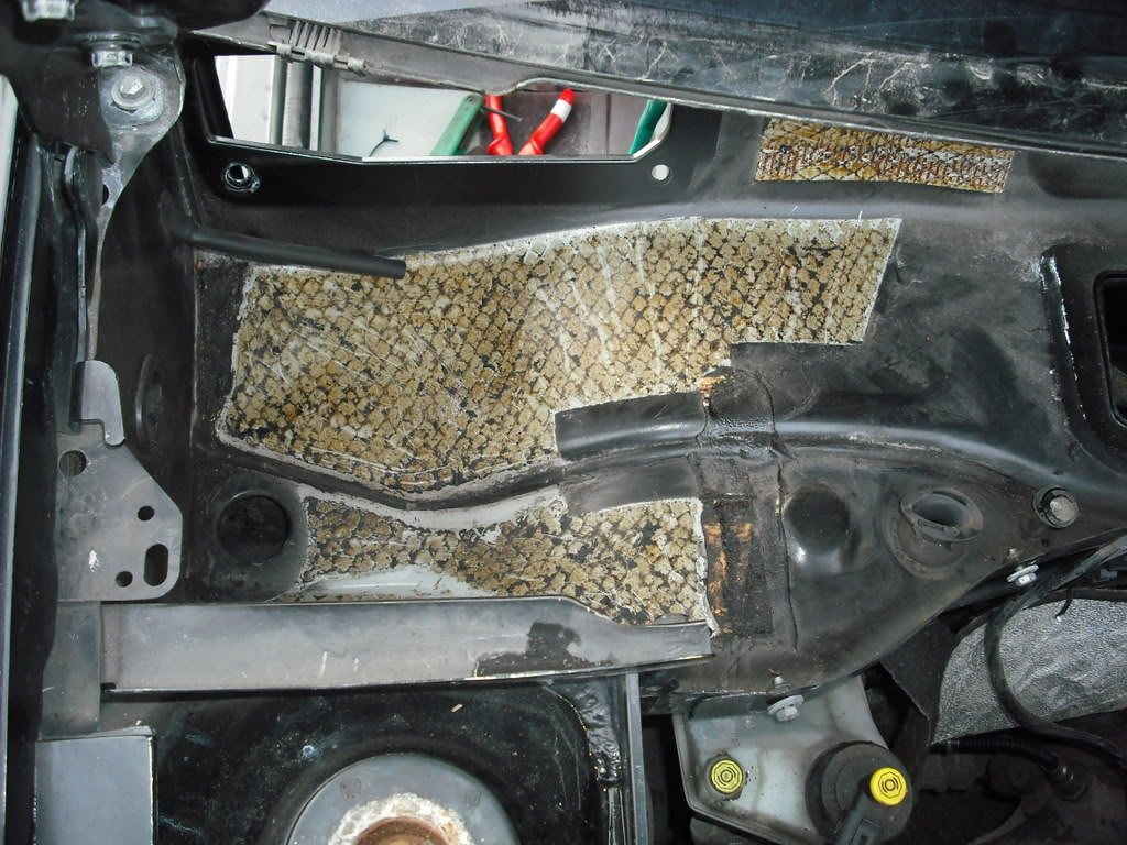

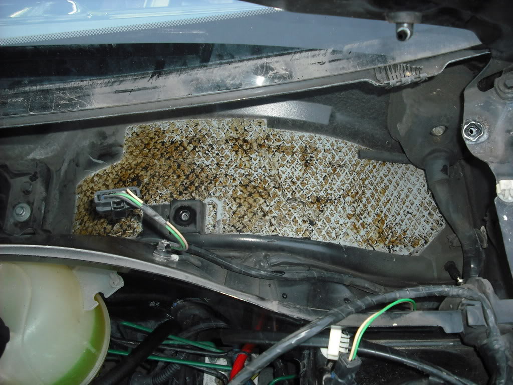

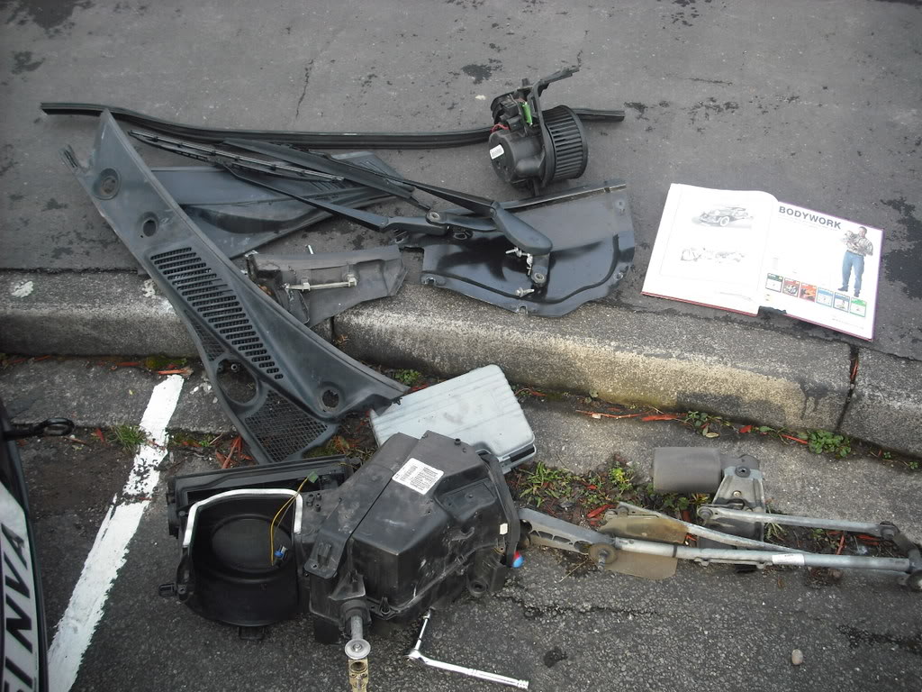

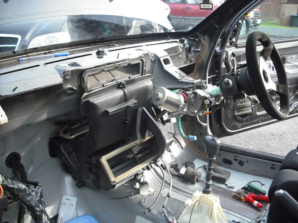

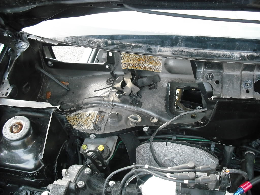

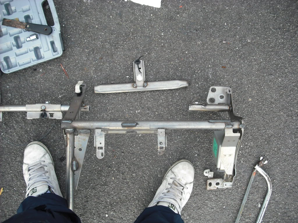

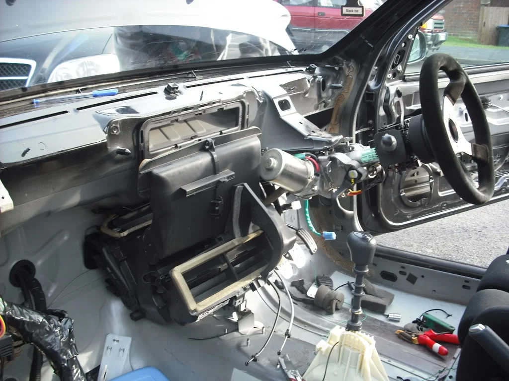

Carrying on with the tar, I knew there was some under the wiper mech and under the blower assemly in the scuttle area. I wanted to remove the blower stuff anyway and replace with a non-AC model since I've ripped that out. So, removed the dash bar from inside and cut away another un-needed section....

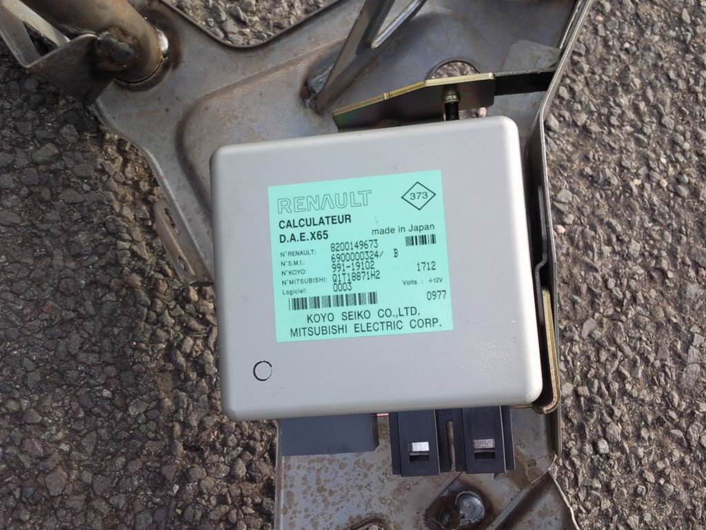

Anyone know what this is? Left the Haynes in the car and CBA to go fetch it. And dont say calculator.

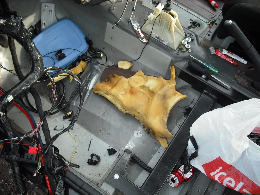

I had some more foam deadening crap to remove from behind the air distributor on the inside too so got that out when I dropped it out to get the blower assembly out of the scuttle...
Had a nice pile of bits building up too, even had a threat to be sued off some old bint who claimed she could trip over it, which was nice.

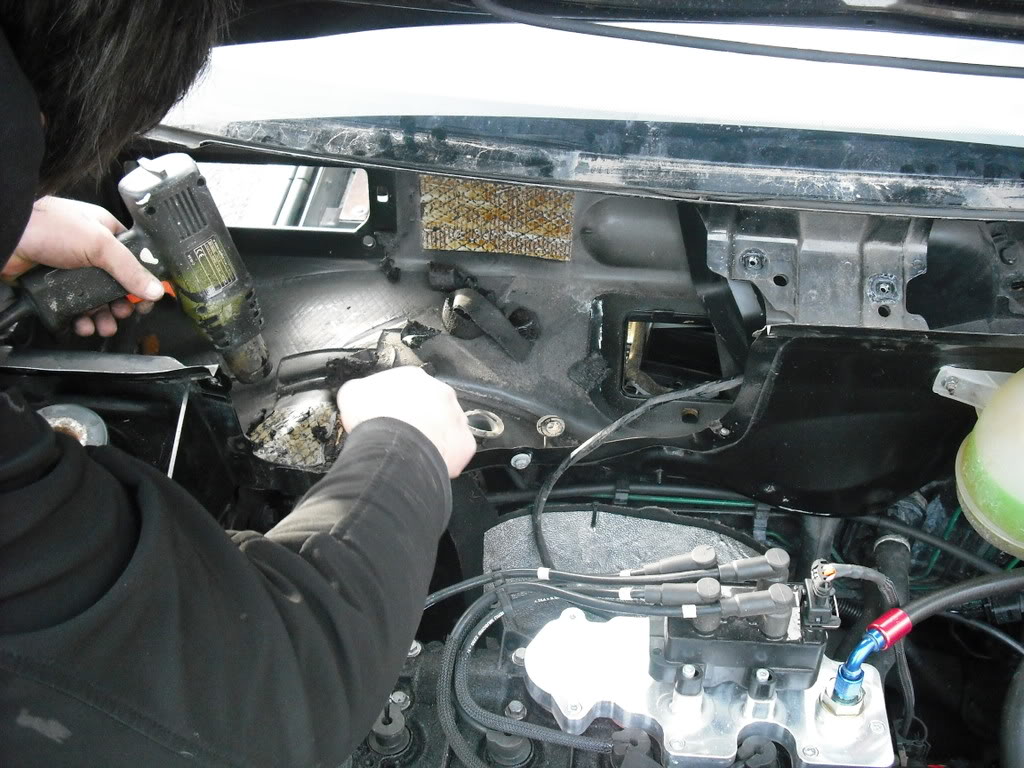

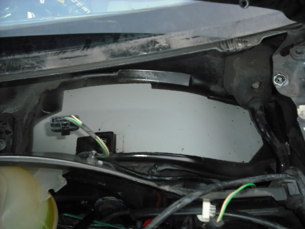

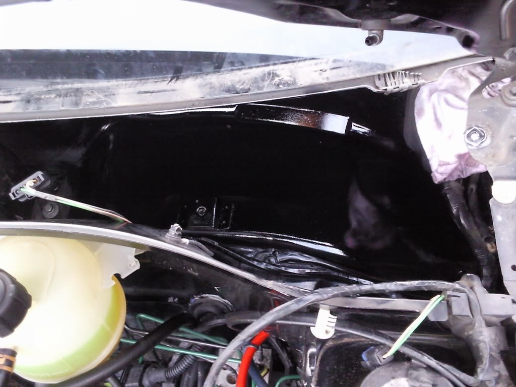

Next, got the heat gun and scraper out on the tar in the scuttle, comes off so easy this stuff, just a wipe with white spirit after and its done.

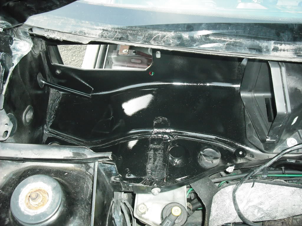

Then gave the whole area a rub down and a few coats of satin black to keep any tin worm out where the scraper has dug in getting the tar off.

Good progress mate, you planning on binning the aircon/re-circ box?
Need a fan from a lesser model WITHOUT Re-circ, Base model I got my dash from had re-circ. You need one off a cup, its like a little snail shape

Yeah thats why I ripped it out, gonna roll without heaters for a few weeks until I can find one because getting that out was a bit of a ballache and would mean removing everything again if I put it back in.
Cup specific?? I need the heater panel without AC switch too!
Re. wiper set-up, funny you should say that. Thought about it earlier but didn't want you to go all Ph-reebone on my ass so have another motor in mind, lol.

Im not sure if its only the cups but they deffo have what you need. The main part of the heater box (interior) can go back in. just bolt it down from the scuttle side with the plastic fan inlet, then when you get a fan just whip the scuttle off again. Im not sure how the cups etc run the speeds. the resitor is on the a/c type fan.
