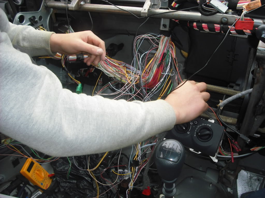

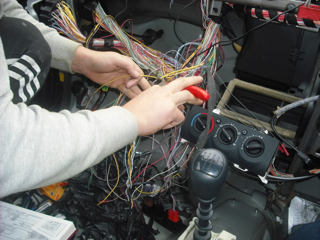

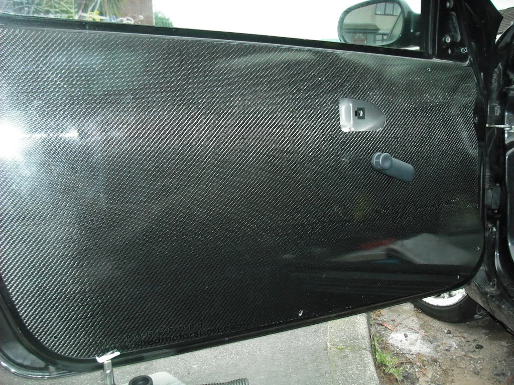

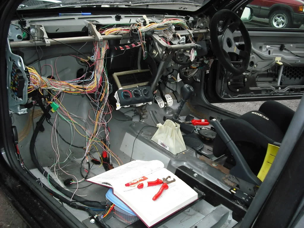

Today I was going to trial fit the CF door cards in the front and whack the windy windows in. So, took the door card off and started to strip the door loom, leaving only the central locking. ONce I'd started though, I couldnt stop and stripped both door looms, radio loom, speaker loom etc from the main car loom.
This was easy, just time consuming! ONly got a few pics as I was on a role and TBH, theres not much to see! Tommorrow I'll get the cards in so they'll be some progress worth looking at.

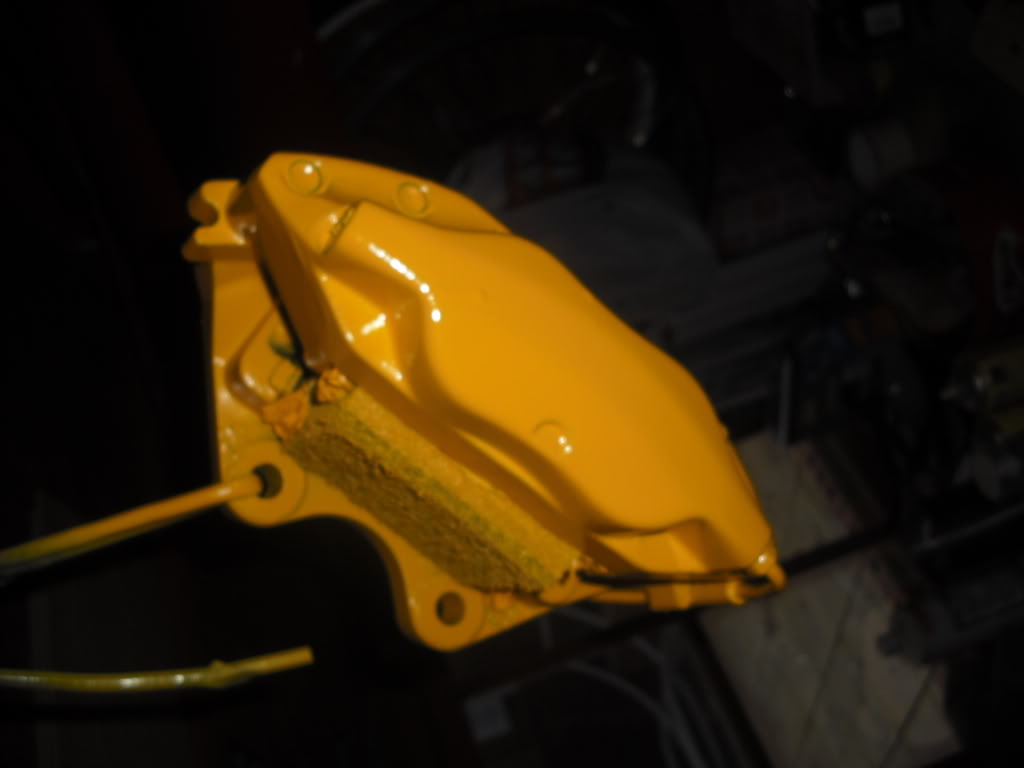

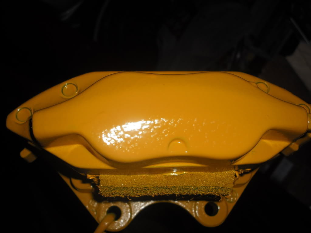

One caliper is finished too, so I'm going to fit my Brembo decals (Massive thanks to 197Gaz for these!) and get some shots of that. The other one has nearly been thrown through the window but its nearly done now, they need SO many coats its unreal.

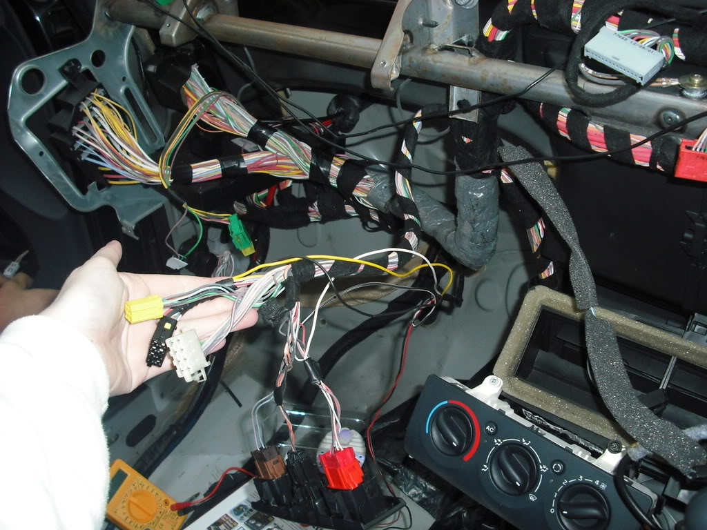

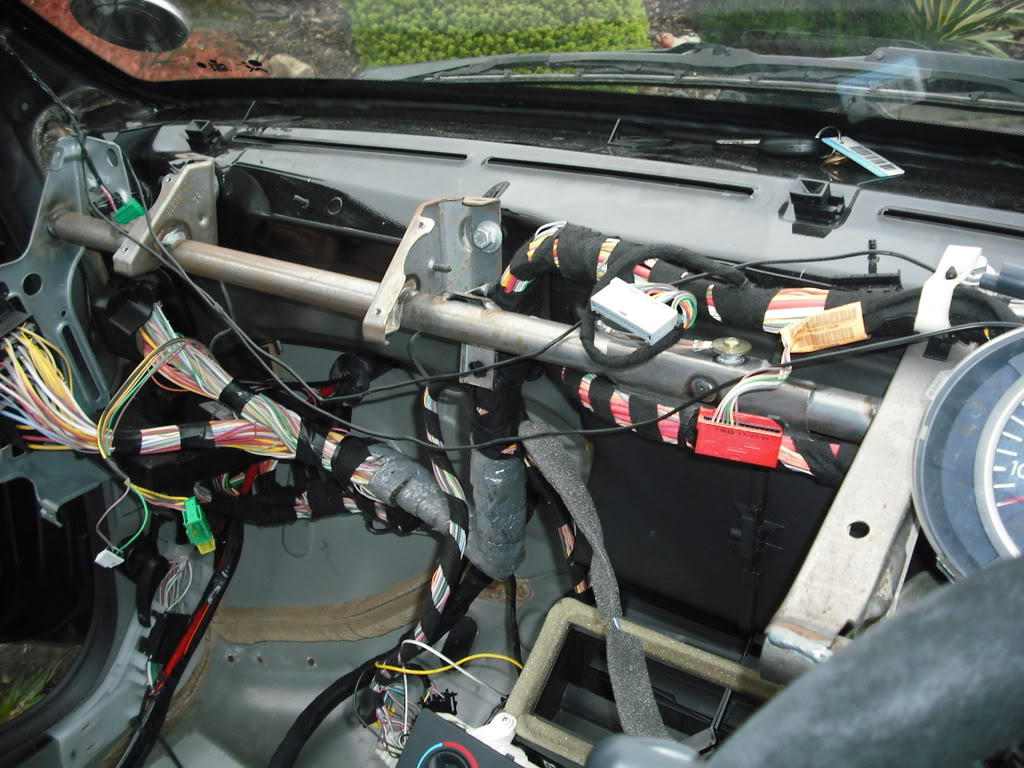

Dash loom when I started....

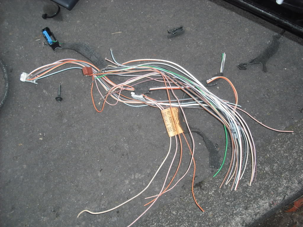

The ISO wiring which was being removed...

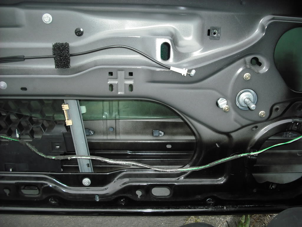

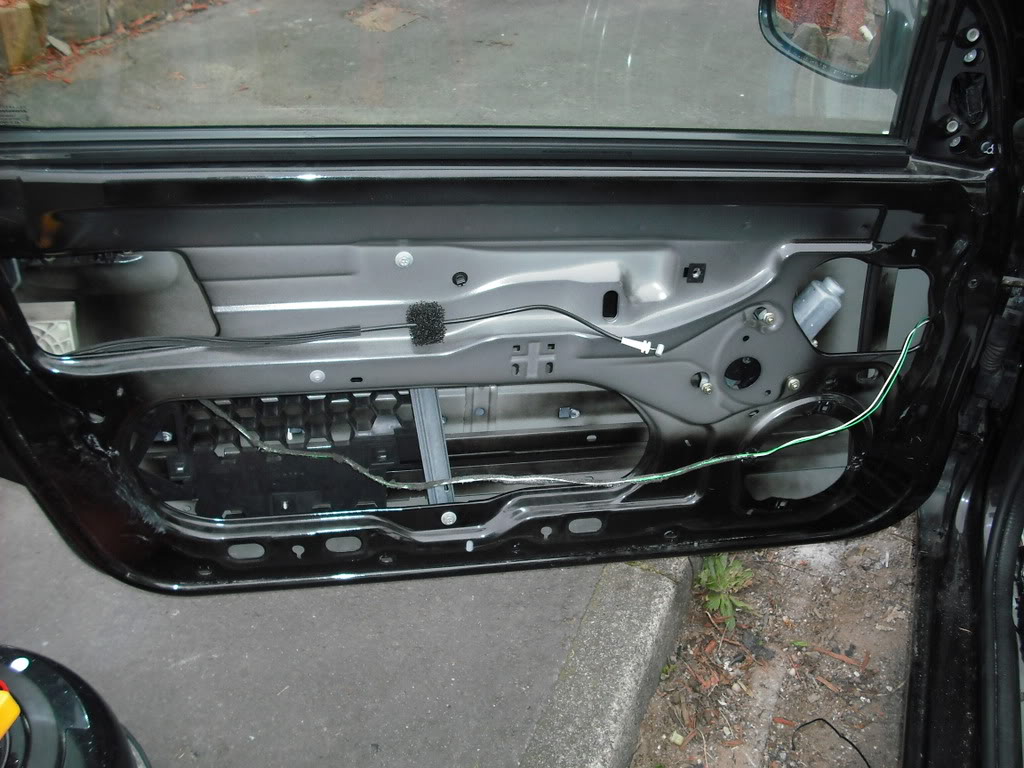

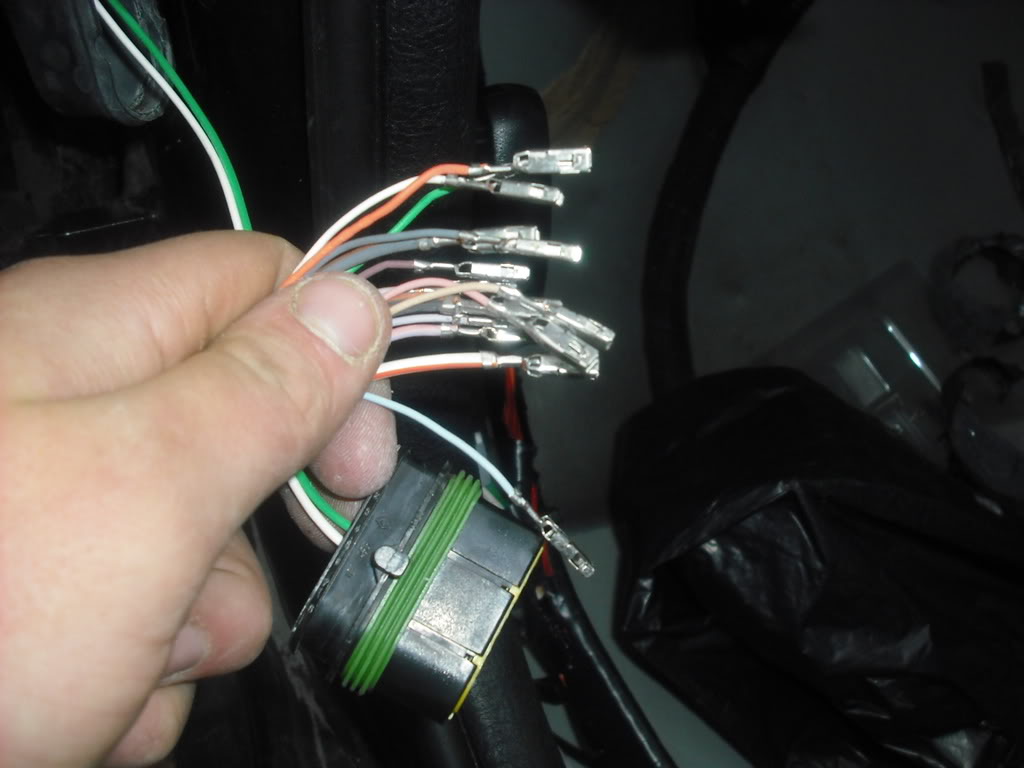

Door loom wiring removed form the plug, the green and white wires are the central locking feeds.....
Chopping stuff....

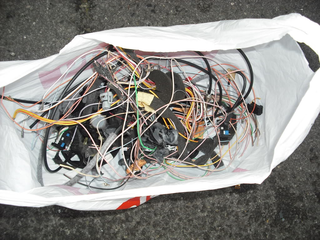

This is one half of the door loom wiring, I've filled a carrier bag nearly now but I'll weigh it all tommorrow when it's all comepletely out!

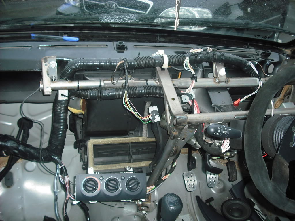

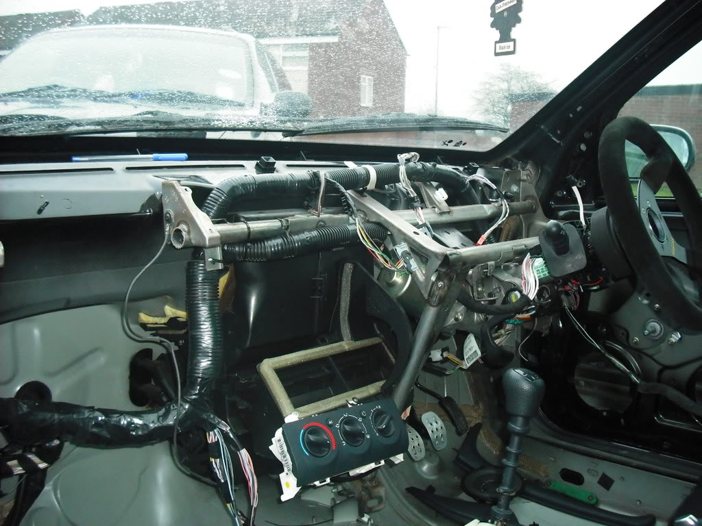

Basically now the whole radio loom, steering wheel stalk, display wiring, window loom, mirror loom, airbag loom, and speaker/tweeter wiring is gone. The clock will still work though :eek:

I've probably saved a few kilo's overall with taken out so much loom, it looks neater and I have an iPod!

Hammerite smooth (aerosol type), its super thin so you just have to give them dust coats. It runs so easy, just let it run and keep giving it coats and the runs dissapear. No idea why, I'm not arguing with science ;)

Can you do us a favour Dave, take apic of you speedo, i want to see how you've mounted it, see if i can fit a ph2 into my ph1.

How do you mean fella? My dash is going back in so its just cable tied to the dash support bar ATM!

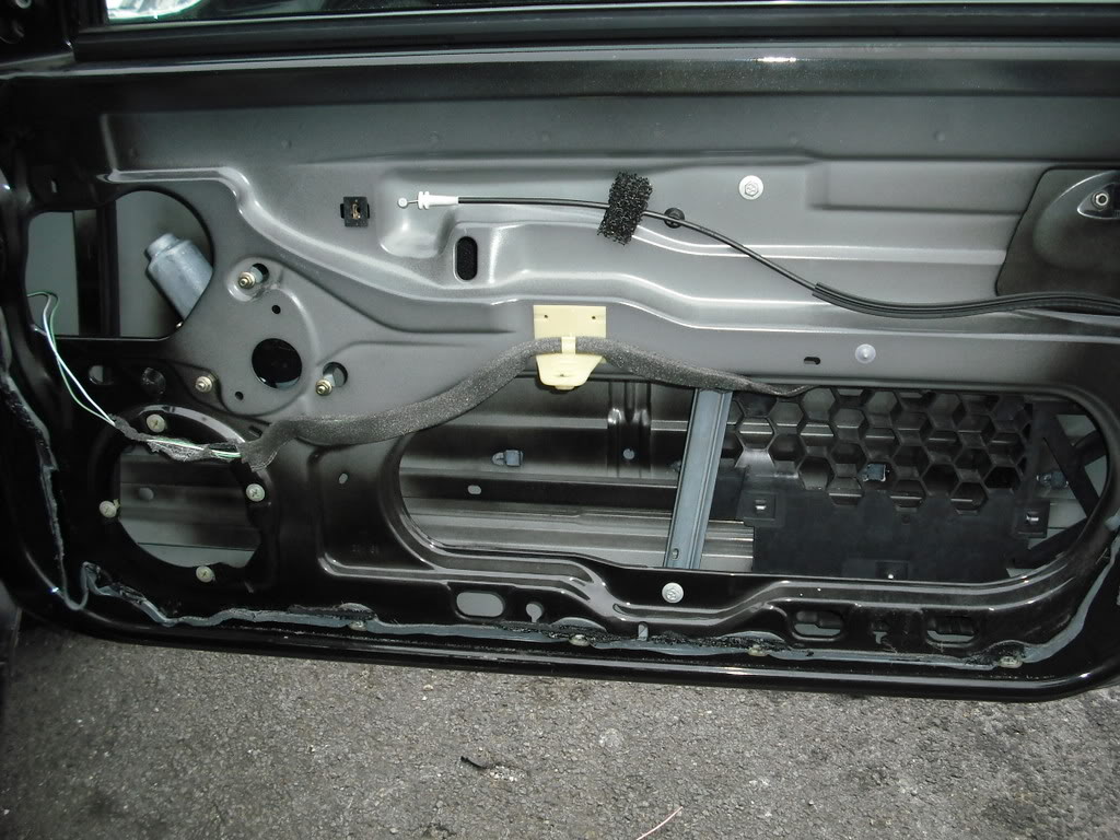

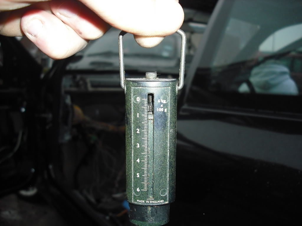

So, started the day by finishing removing the other side door loom form the main car loom. Got all this out and cleaned the door skin up so I could start removing the electris window mechanisms.
This is how much I've removed, just from the doors and stereo looms!

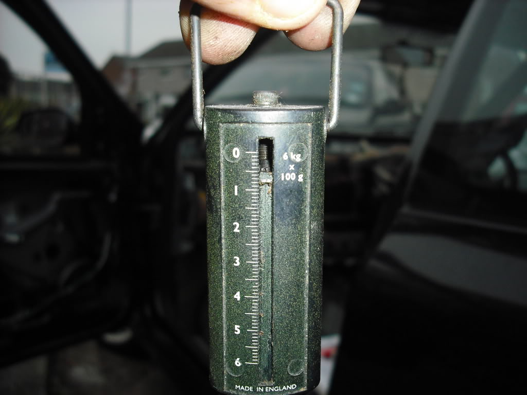

The weight of it...
Not bad really, combine this with the weight saved on doorcards and electric windows too, should be a decent difference.

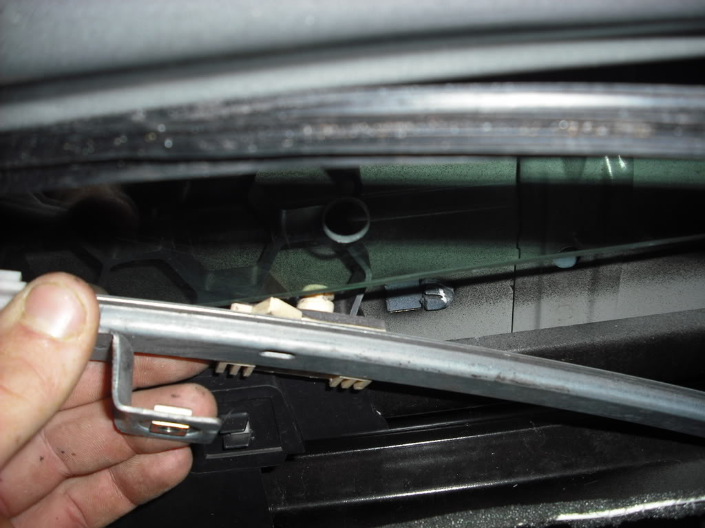

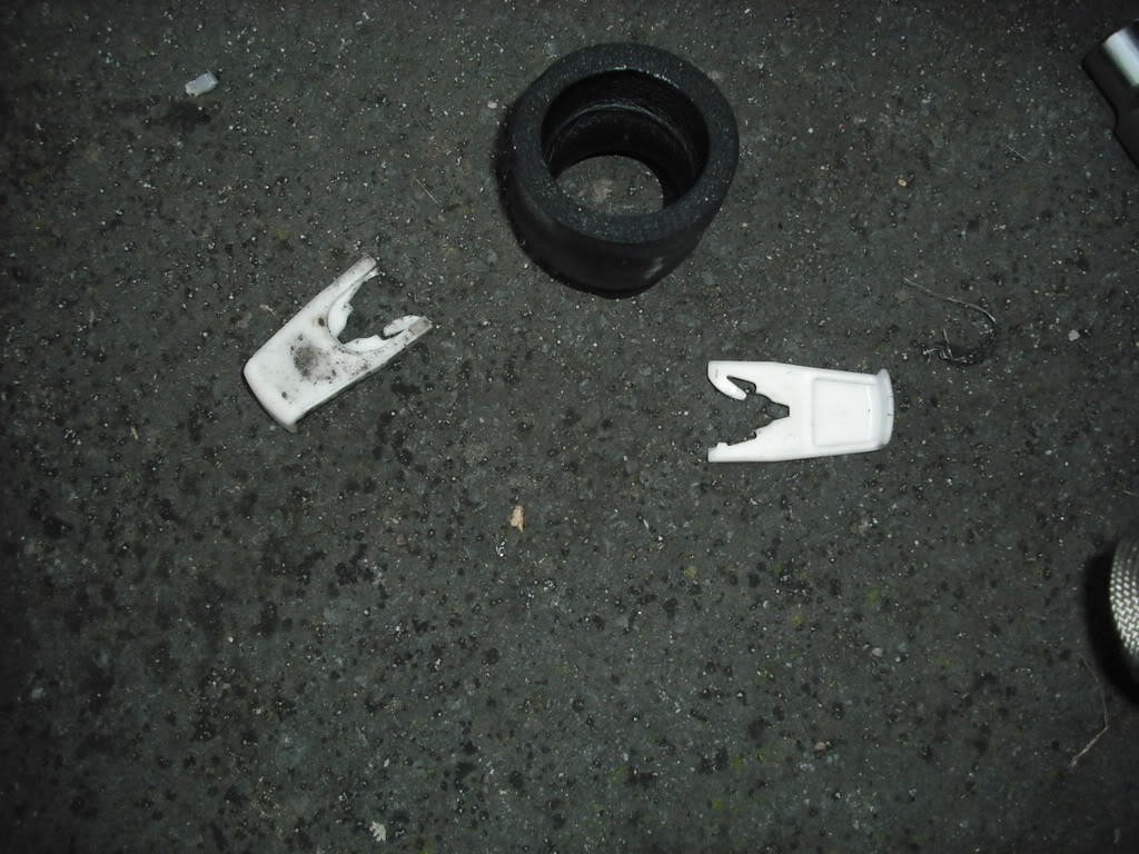

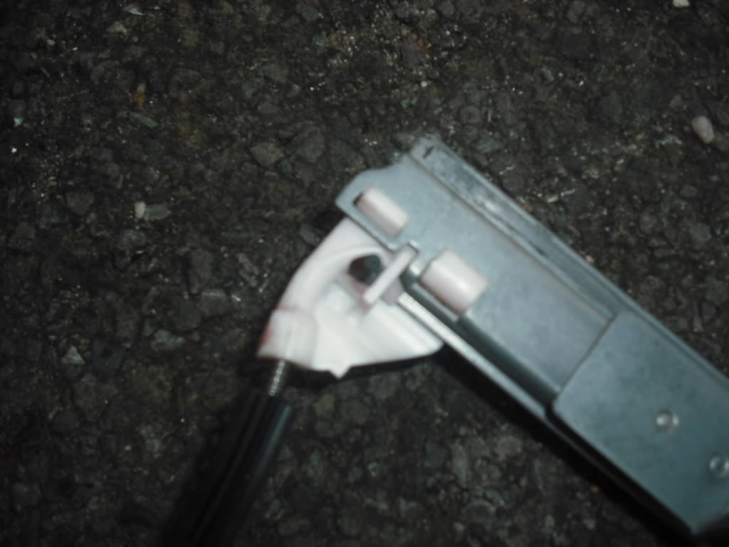

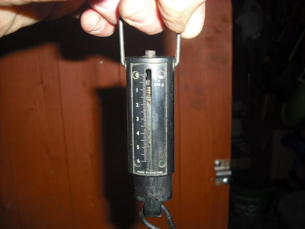

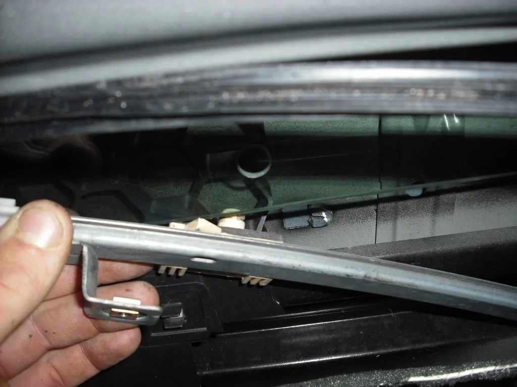

Tooke the motors out and got my manual set-up out. Just to note, if anyone else does this, the mechanisms aren't universal, left hand side only fits left and right only fits right. I found this out after I'd pissed around with the window runner and the fiddly little clip. The end with the prong on goes towards the top of the door....
The weight of one manual window mech....
And an electric one...
So a Kg saved by swapping the mechanisms alone!
Anyway, put the manual ones in and after snapping 2 of the clips, got the nack of it :eek:
Boths sides in...

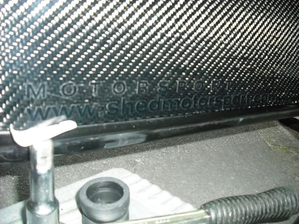

Went and got a door card and offered it up, just because Im a style *****, lol. I'm not fitting them until the inside is painted for obvious reasons!

A few pics of the unfinished calipers too, now they've had plenty of coats, I'm going to let them dry over the next few days, the flat them back, stick the decals on and laqcuer them!
