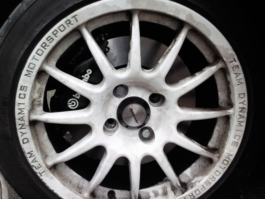

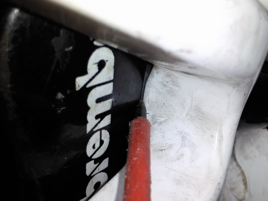

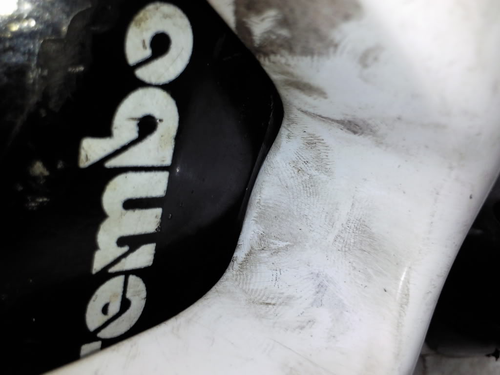

Fitted them today with the 10mm spacers and longer bolts, used 4mm washers behind the caliper and it leaves it bang over the centre of the disc.
They fit but FCUK me its close, lol. Think I'm going to run with some 12mm's to give about 2 1/2mm clearnce from the wheel to caliper. Yes, the wheel needs a clean but TBH, thats way down on the list of things to do.
If I made some brackets to space them away form the hub 10mm and used a 300mm disc, I'd probably get away with using 7mm spacers but thats a) Too much hassle, b) More cost and c) Pretty pointless.

Uber close - eek.
Looking good, sugar.
I as going to say that Brembos should be red, but I actually like them black. Although your wheels are 10x cleaner than mine :eek:
