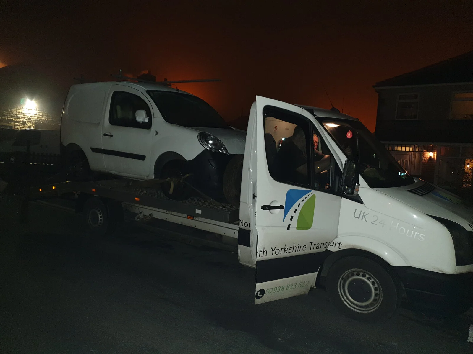

Collected on the back of my mates truck this week

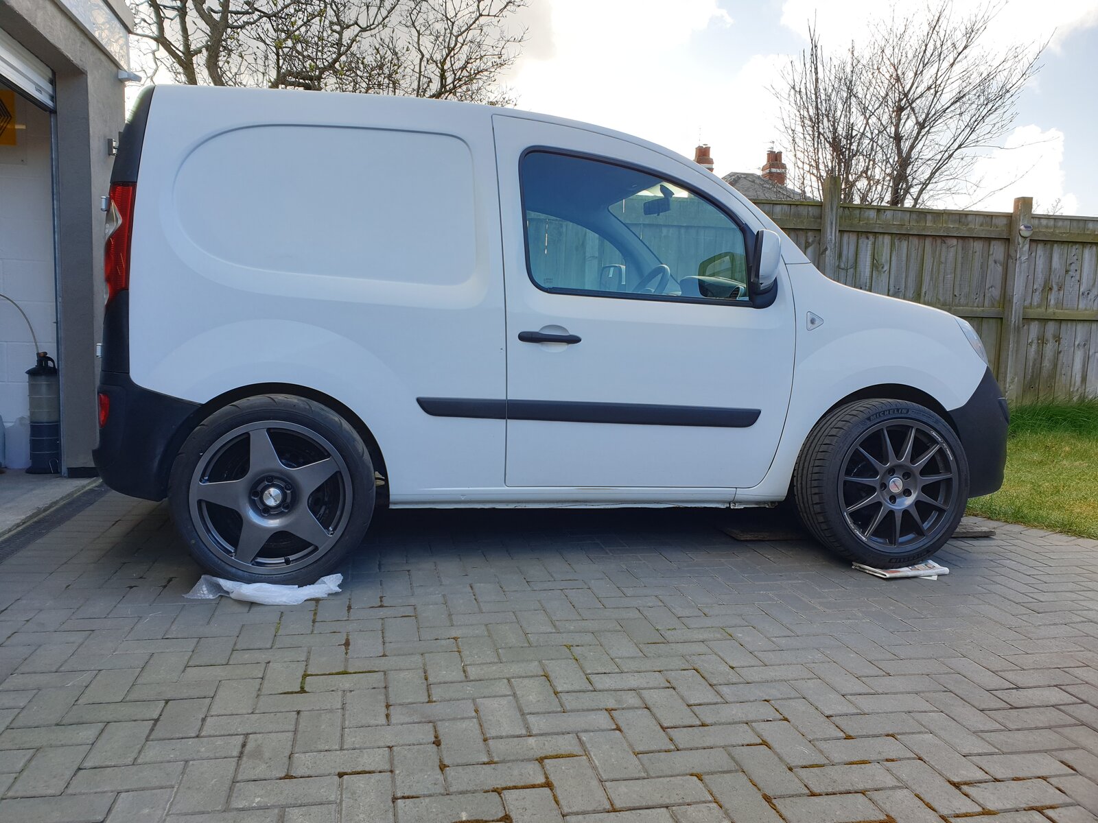

Short arse

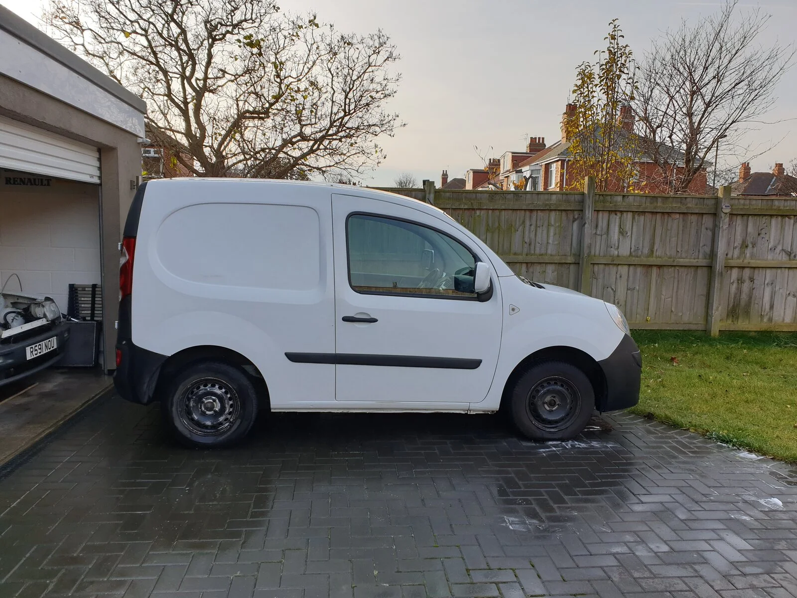

Cleaned up and roof rack removed and pushed into position.

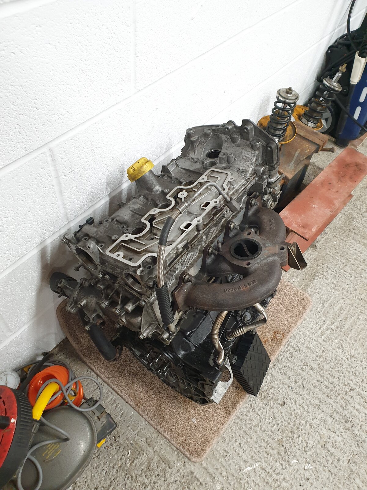

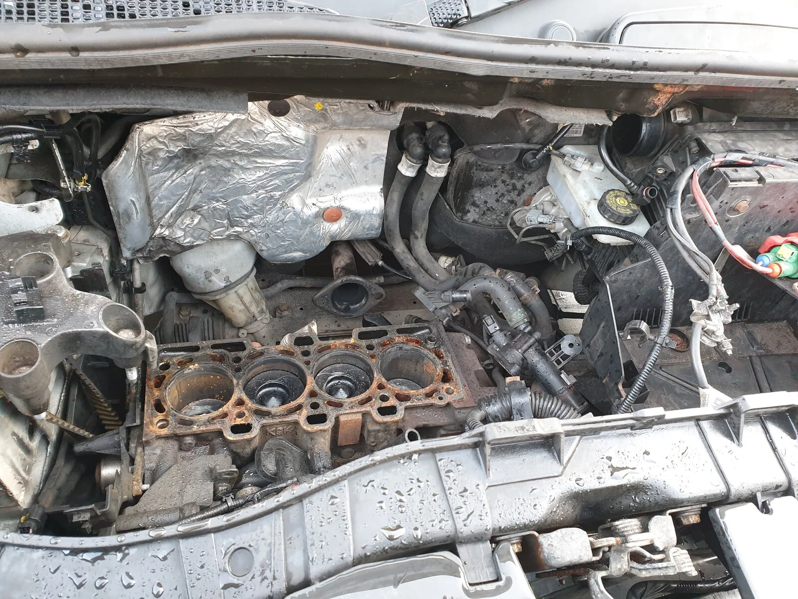

Current engine bay half a dci lump with melted pistons on cyl 1 & 4 :LOL:
Had a good look round and the subframe looks pretty identical to meg2 or clio3. Meg rs track control arms, hubs and brembos bolt on as one as already been done, so handling should be great. Mounts look identical to megane, so in theory a meg lump and ndo box should go in (pk box fits).

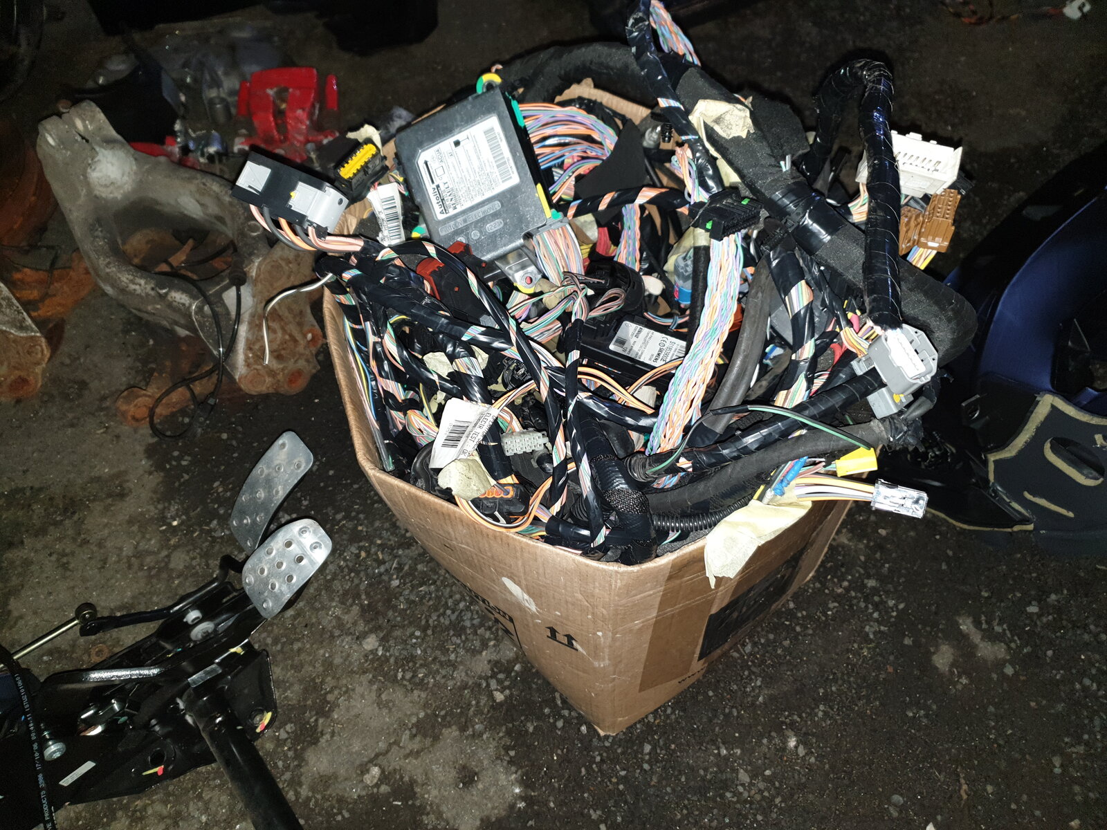

Wiring may or may not be tricky, however i have been thinking about this, and there is a few options, if all else fails standalone ecu and stack dash.

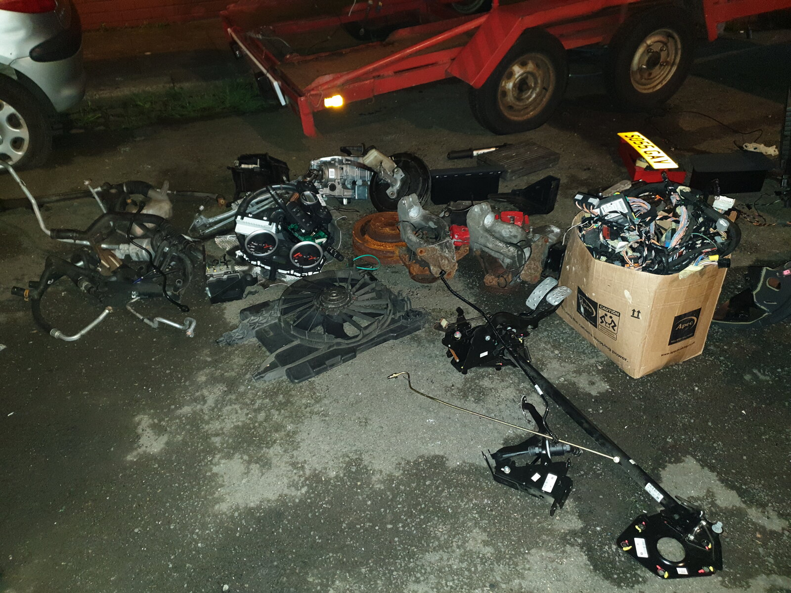

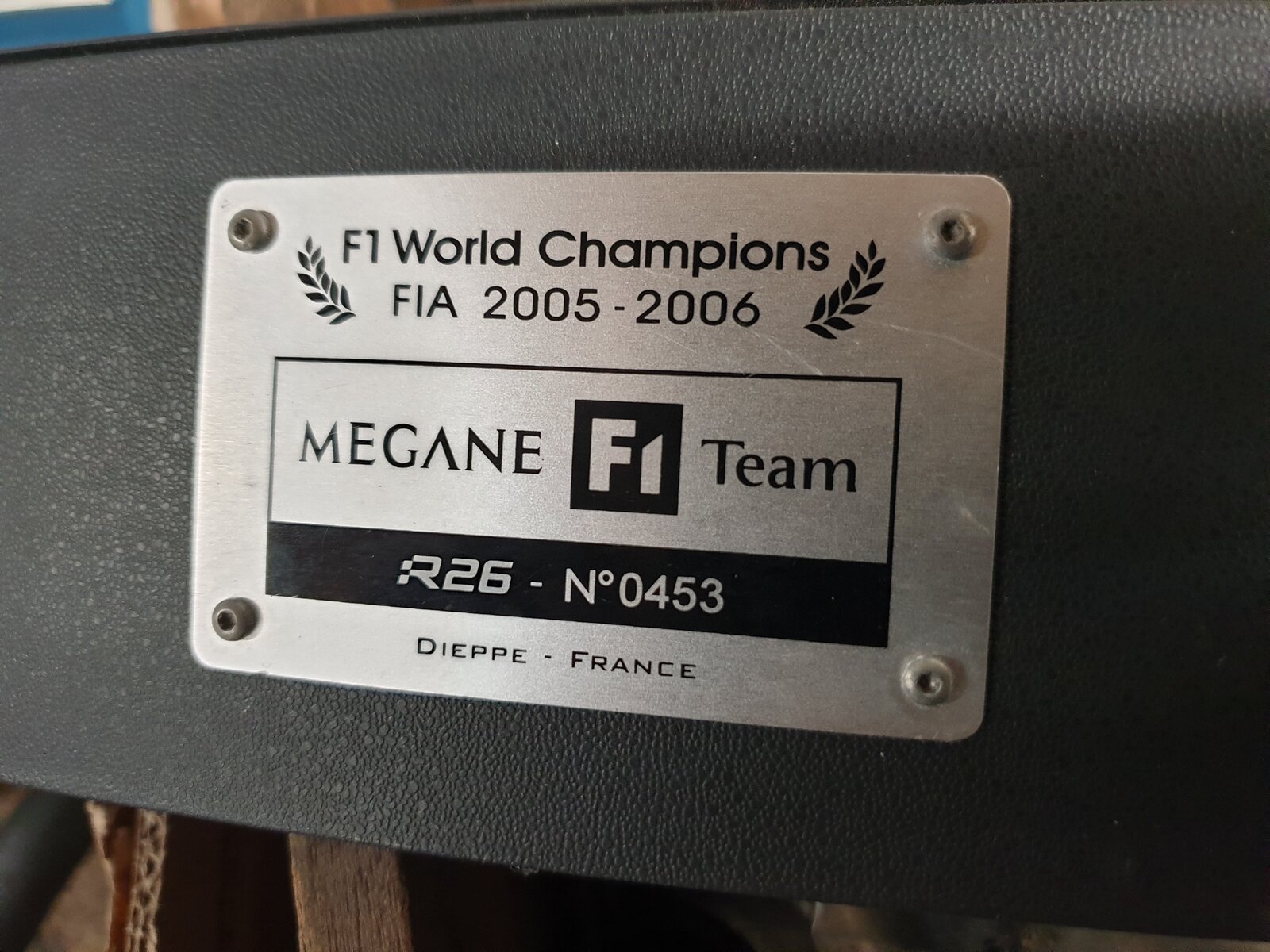

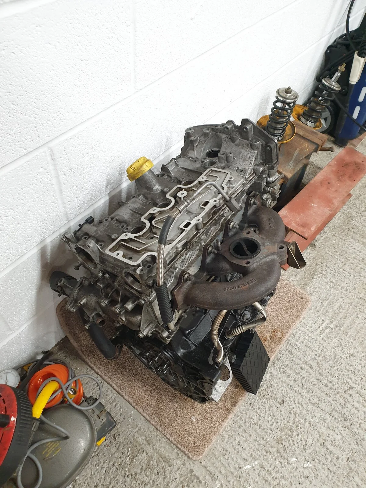

Engine and r26 number 453 has arrived to strip for parts.
Engine has wossner pistons and pec rods, currently fitted with rs250 head, but will be reverting back to stock to get it fired up. Bought a 19t turbo, and 3" scorpion decat. Should see a bit of progress once the weather picks up.

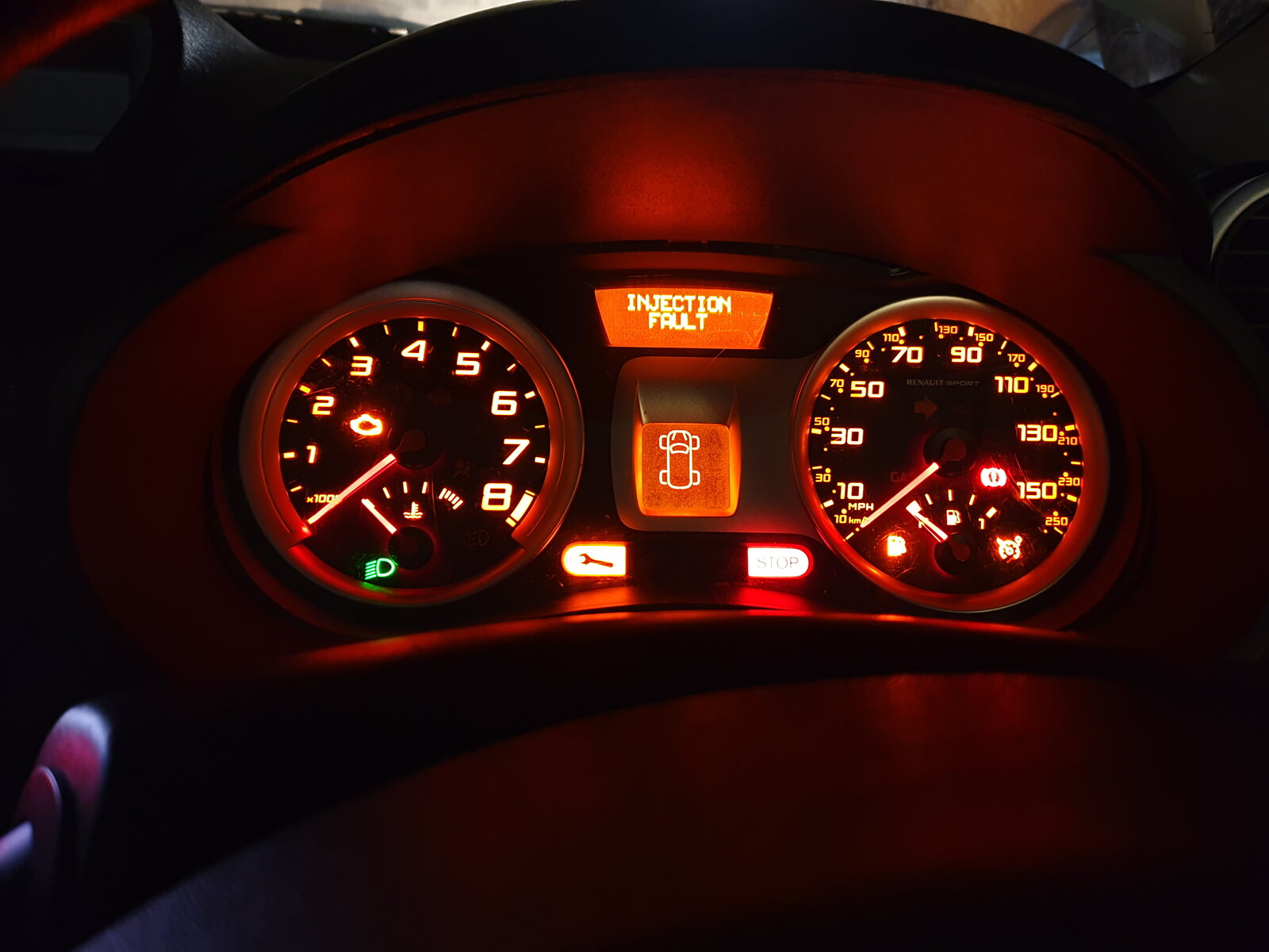

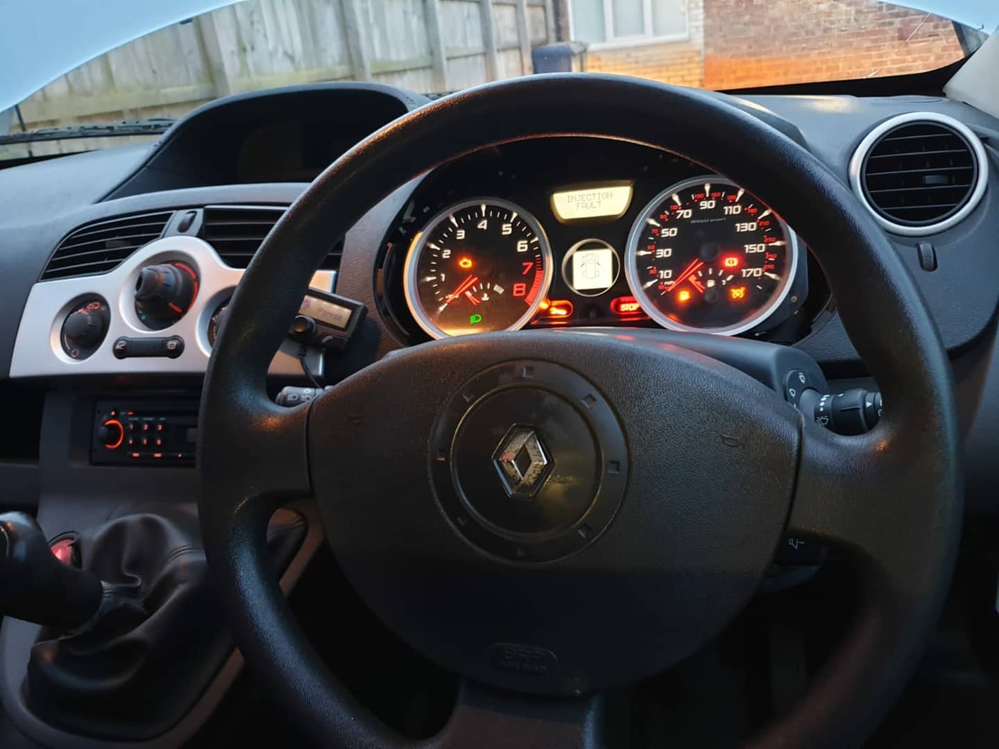

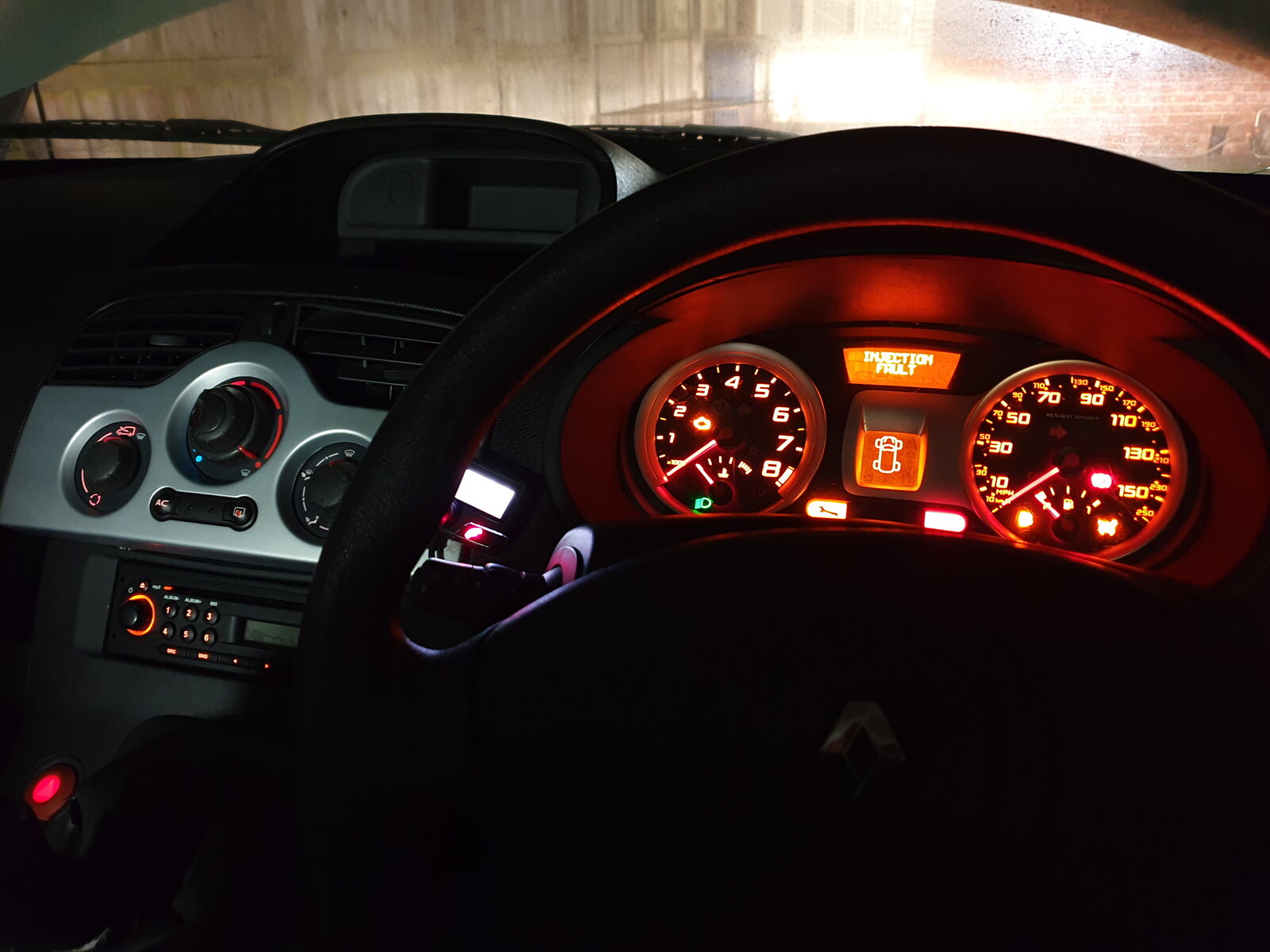

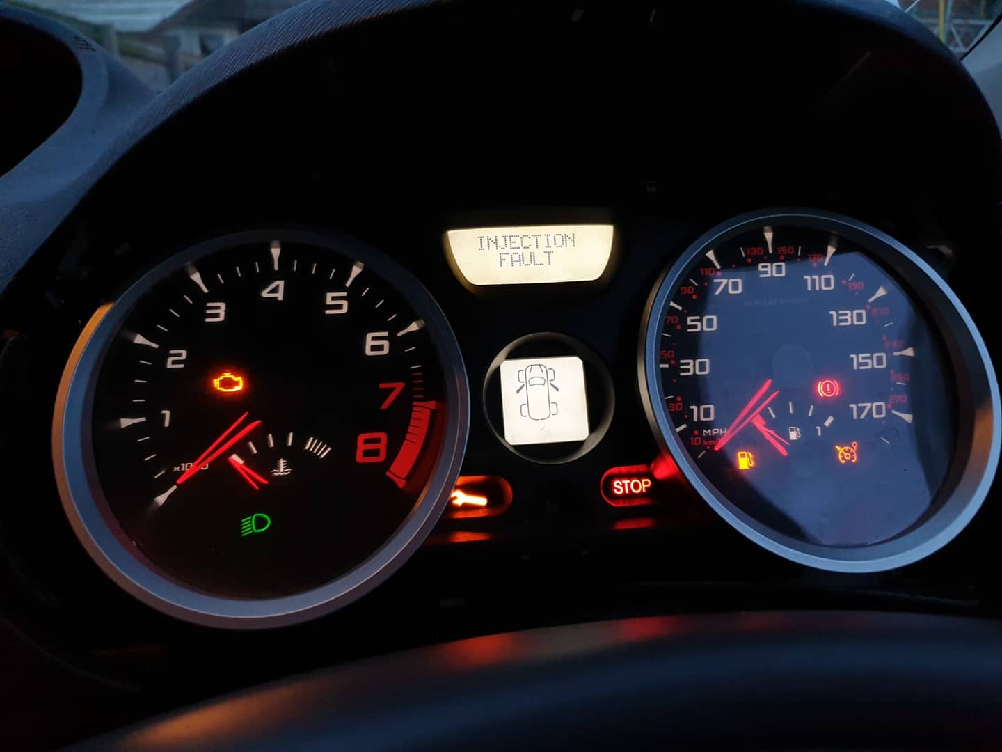

Had a spare ten mins so tried the R26 clocks in. Plugged straight in, and everything thats possible to test with no engine in works as expected. When opening the back doors the boot open symbol lights up. Every warning light on as nothing is plugged in under the bonnet :LOL:
The only downside is the dash cover would need a little trim to be refitted. Clio3 clocks go straight in so have bought a set and will try them in.
I reckon this might be able to be wired up a bit like a meglio, which is going to be a doddle if thats the case.
