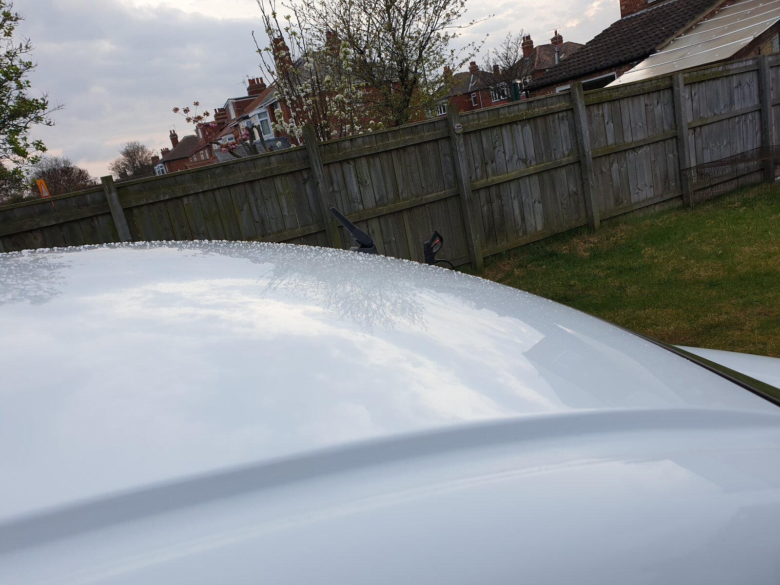

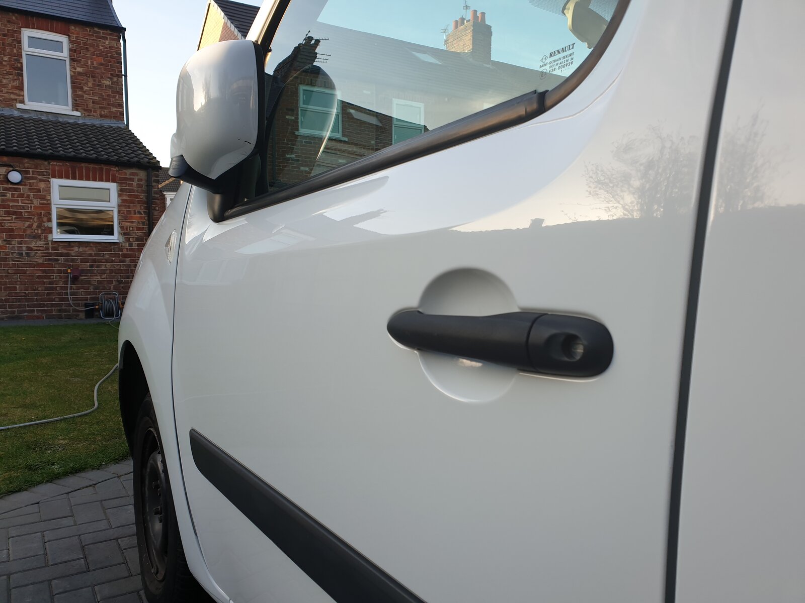

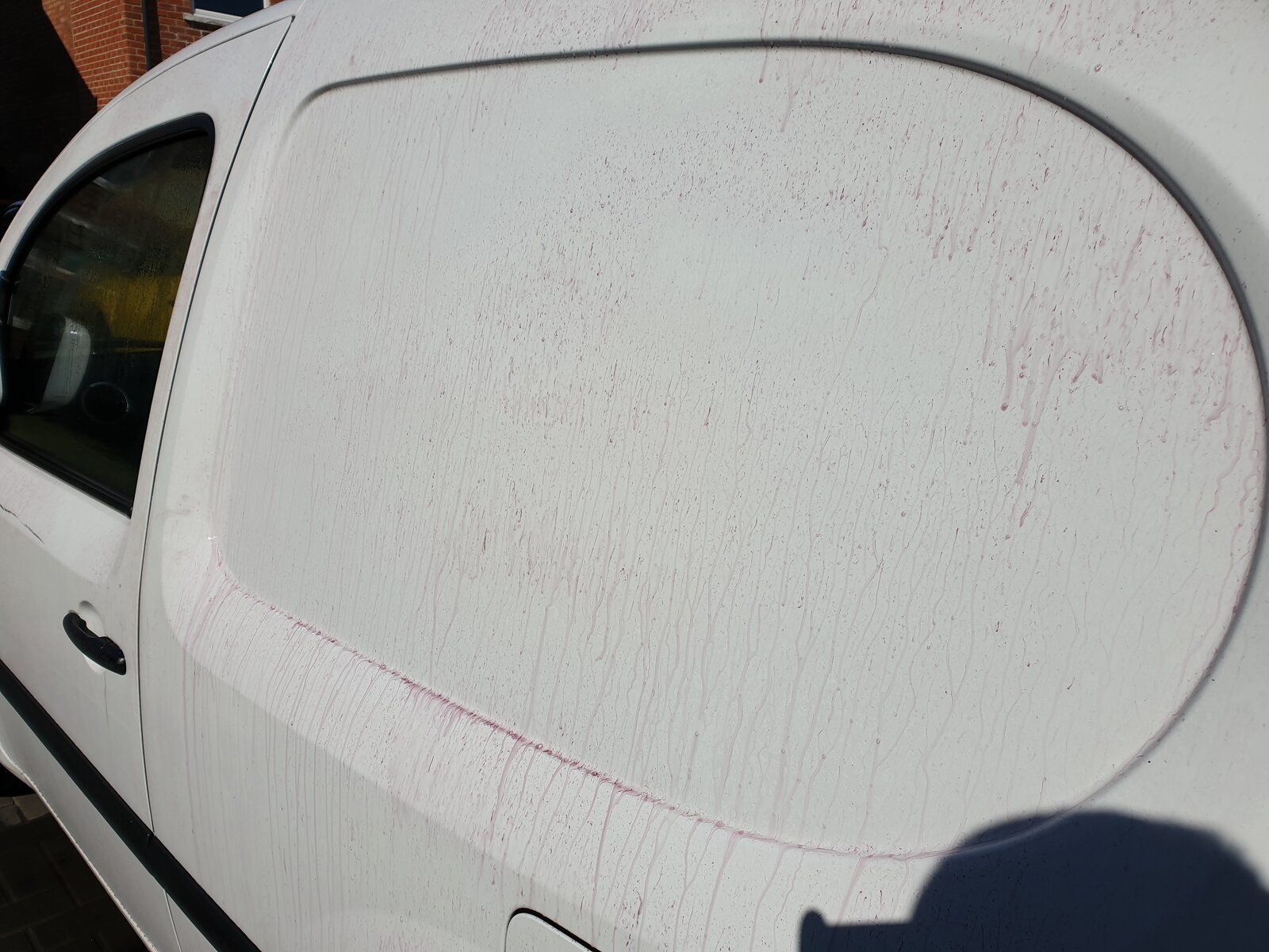

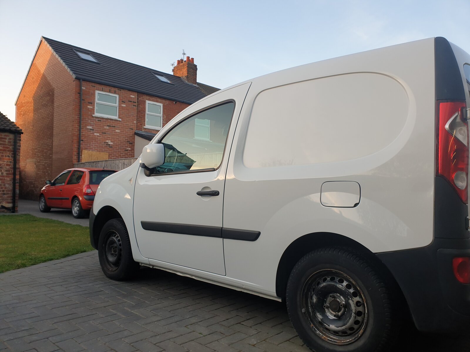

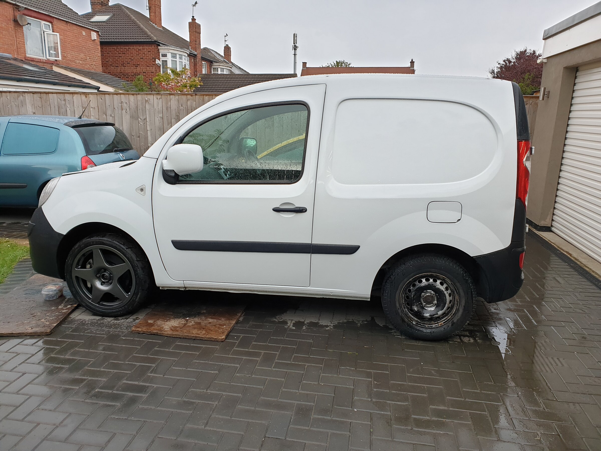

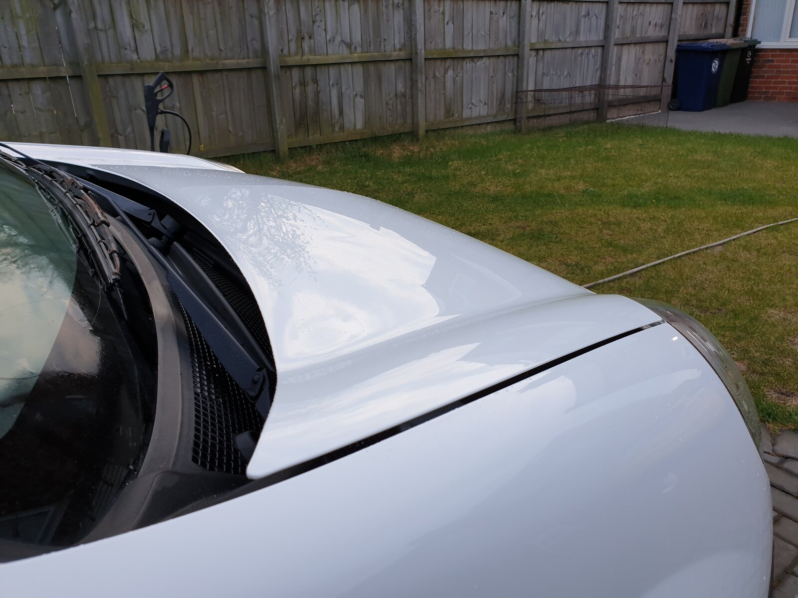

Nothing happening today so took advantage of the nice weather and cut/polished the passenger side of the noddy van. It had a big scuff on the passenger door, which came out easy after a couple of passes.
Fallout was horrendous on it, needed a good coat of Korrosol
Products in stock
Came up pretty mint to be fair
Just the rest to do now:LOL:

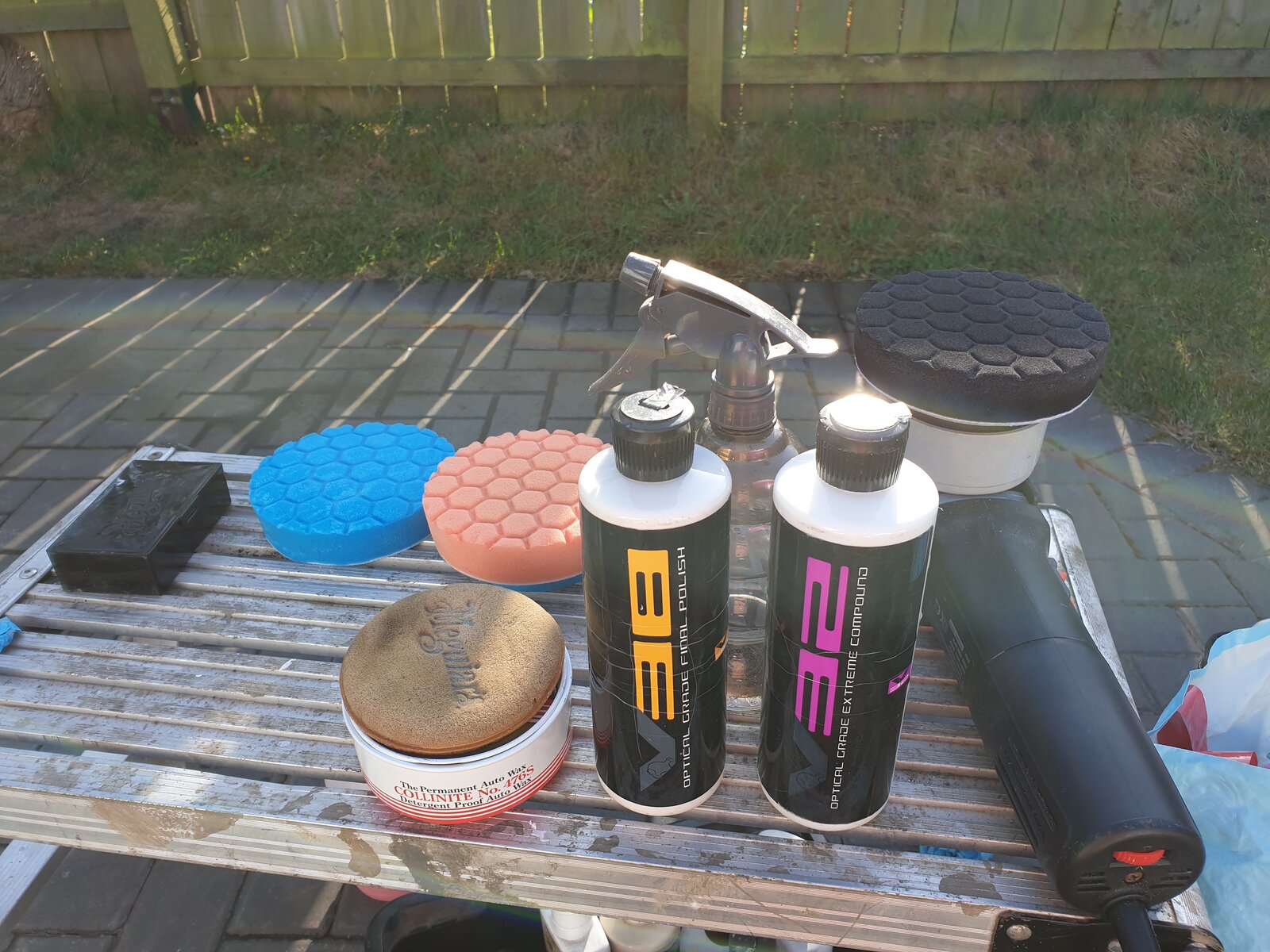

Machine polished the rest today. For a small van there is a lot of panelling, 8 hours later and the rest is done. The fallout was horrendous on every panel, its had paint before to my suprise, the back doors are not the best but good enough. Overall it looks decent though.

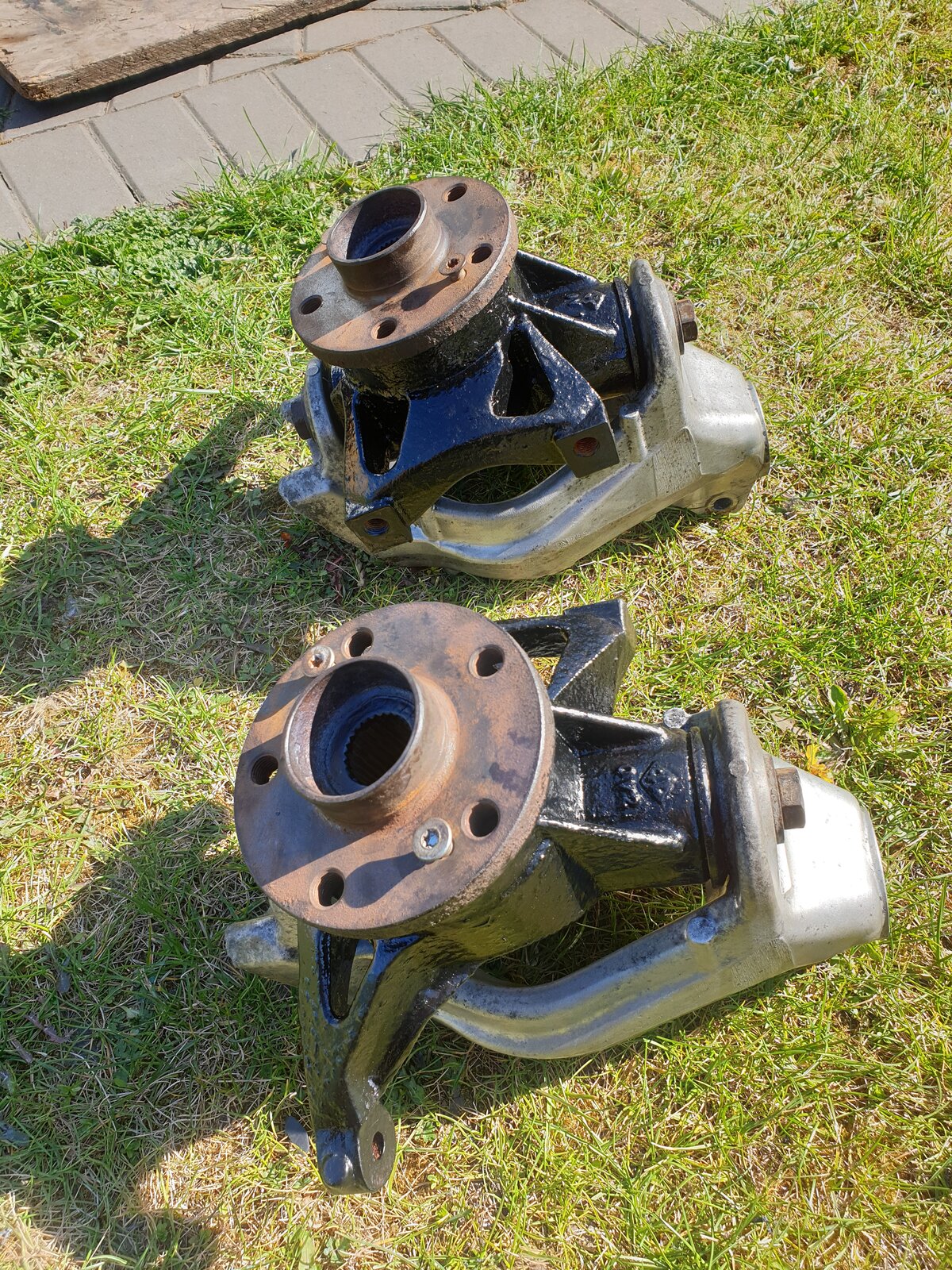

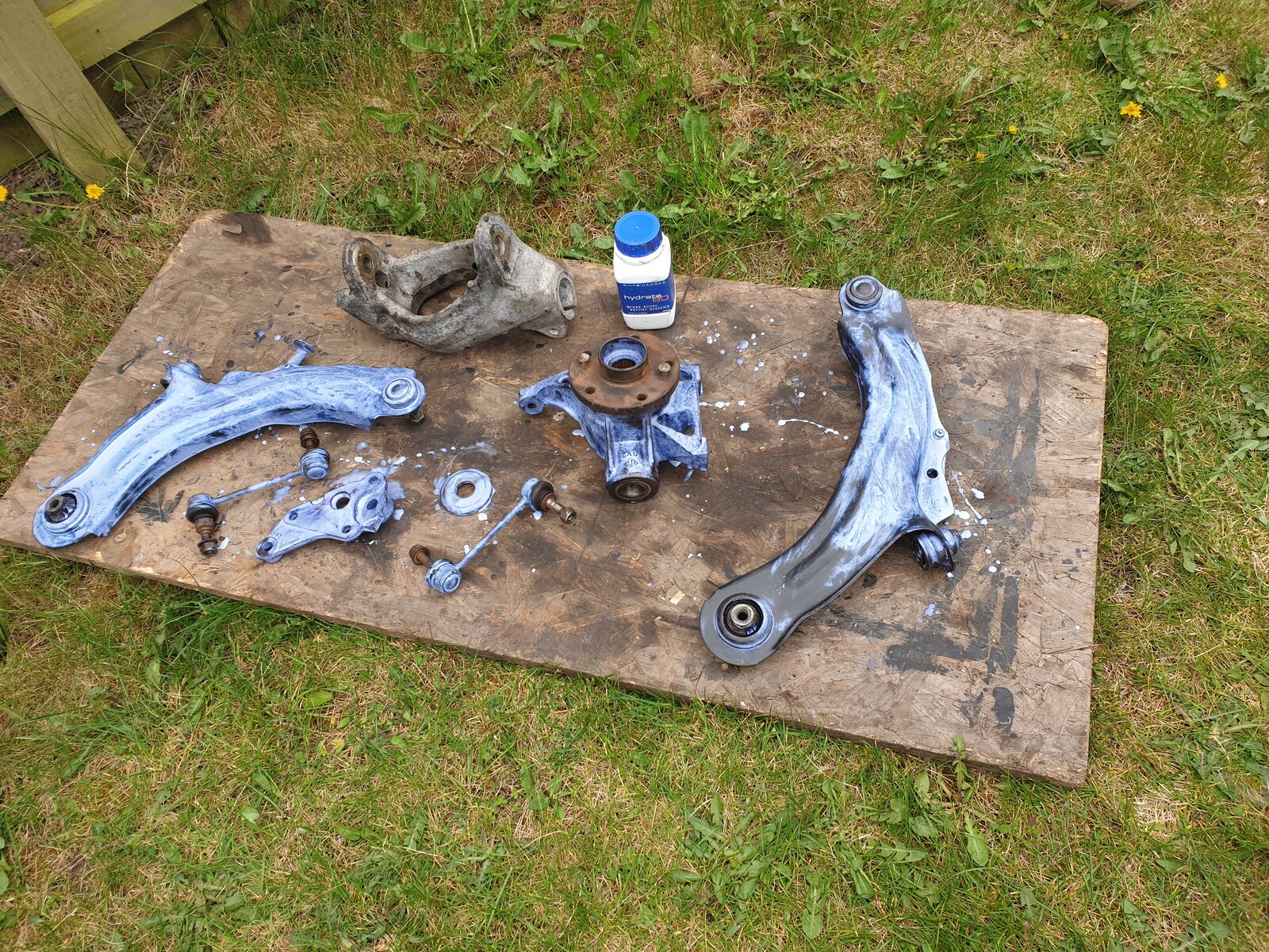

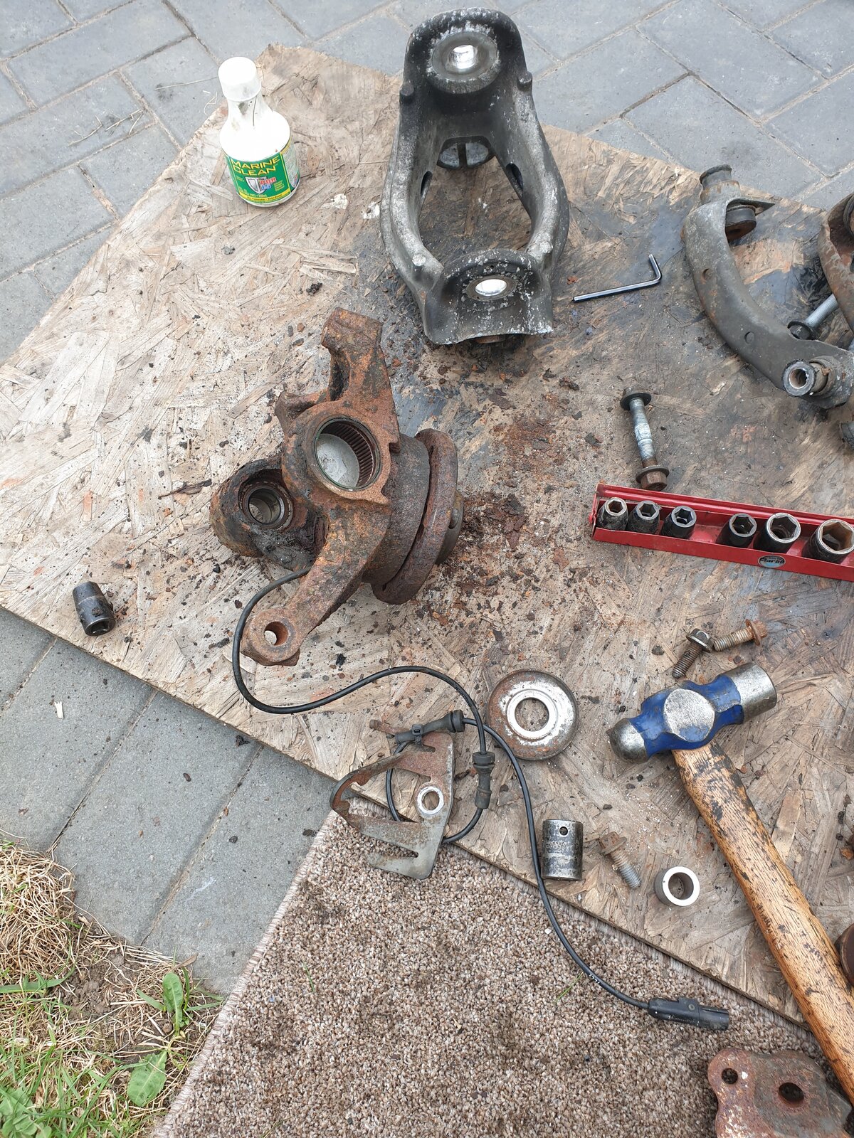

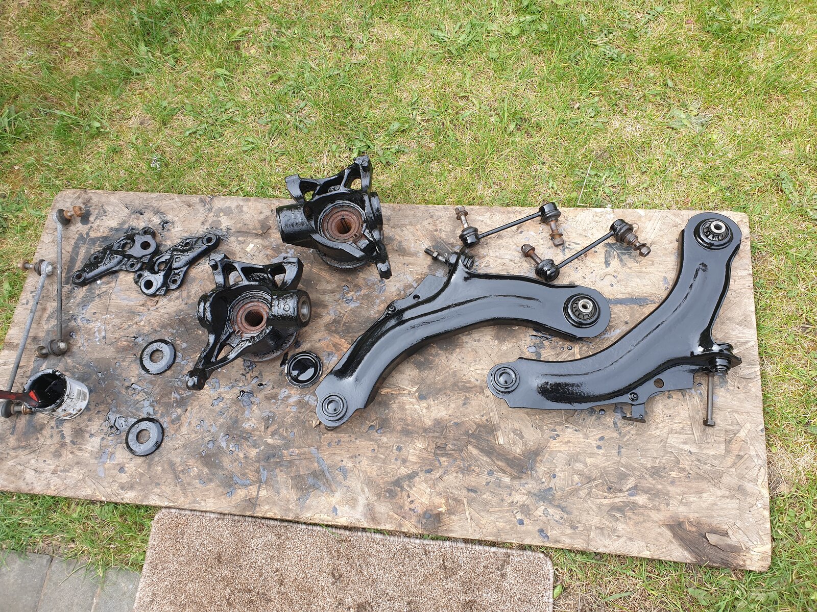

Started prepping the meg suspension and hubs ready to fit.
Swivel bearings were a little bit tight. Ive done a few sets of these over the years and a piece of piss to do. These look to be original, they were absolutely fine no play, simply regrease and refit. Grease bolts on order to fit for future maintenance.
All the bits were looking a bit shitty but essentially all the balljoints and bushes are fine and will be easy good enough for a few more miles. Give them a wire wheel, hydrate 80 and a coat of ten year old hammerite i found in my lockup, will do

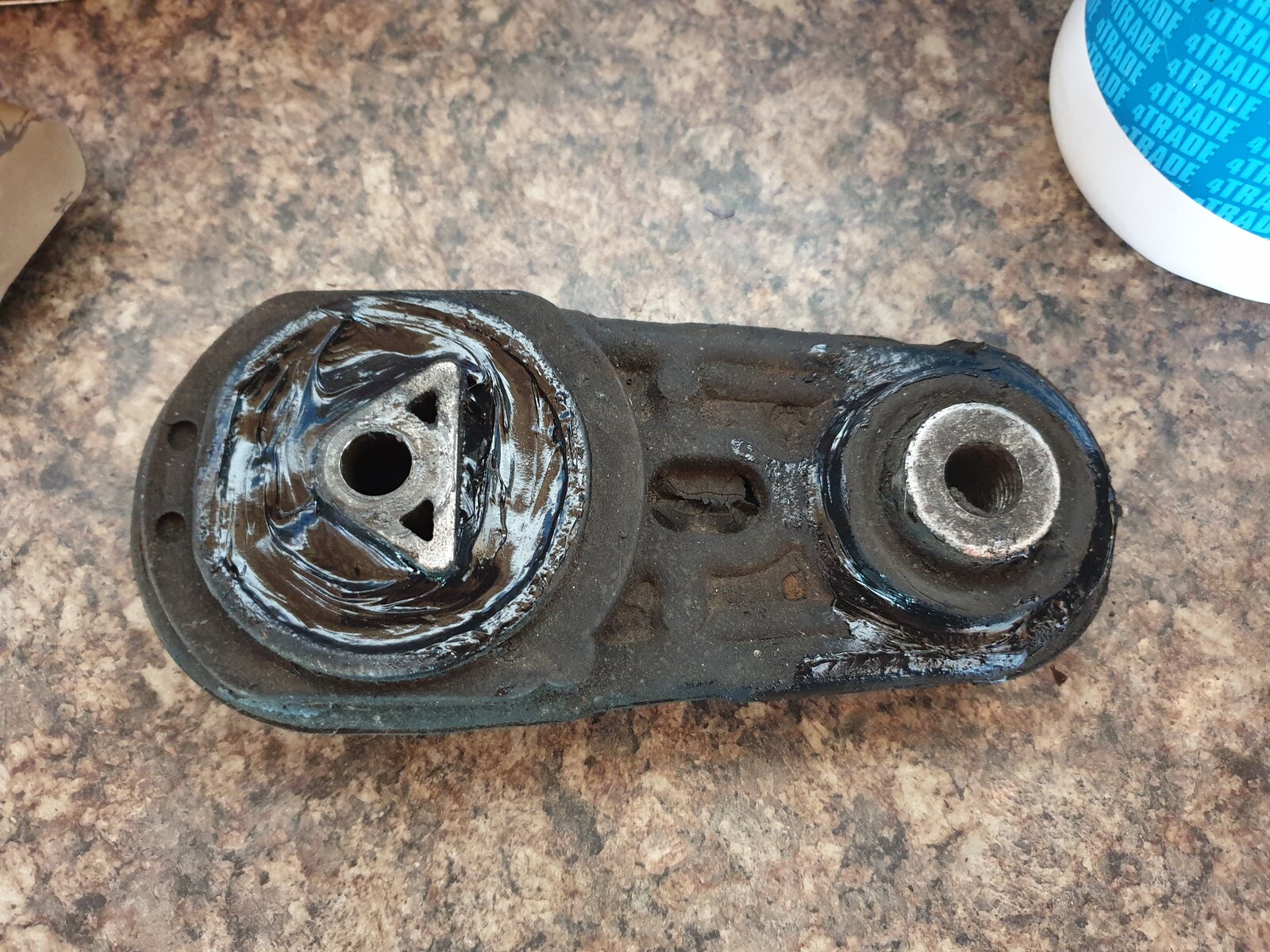

Pikey pu sealant filled dogbone.

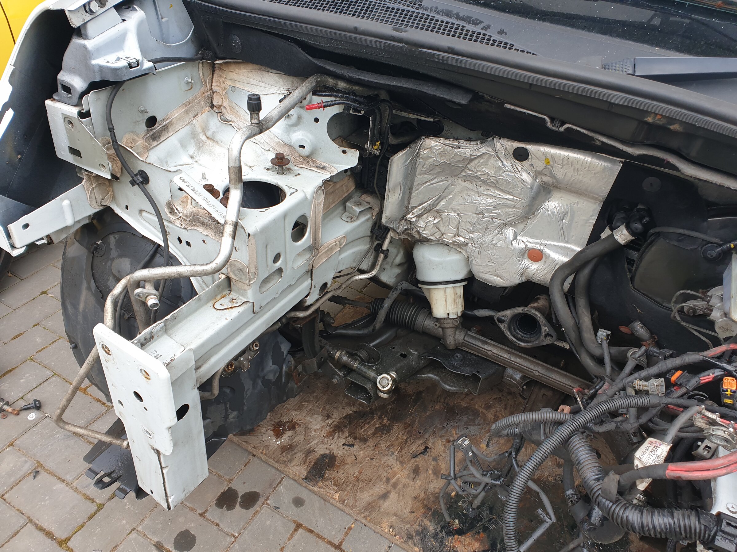

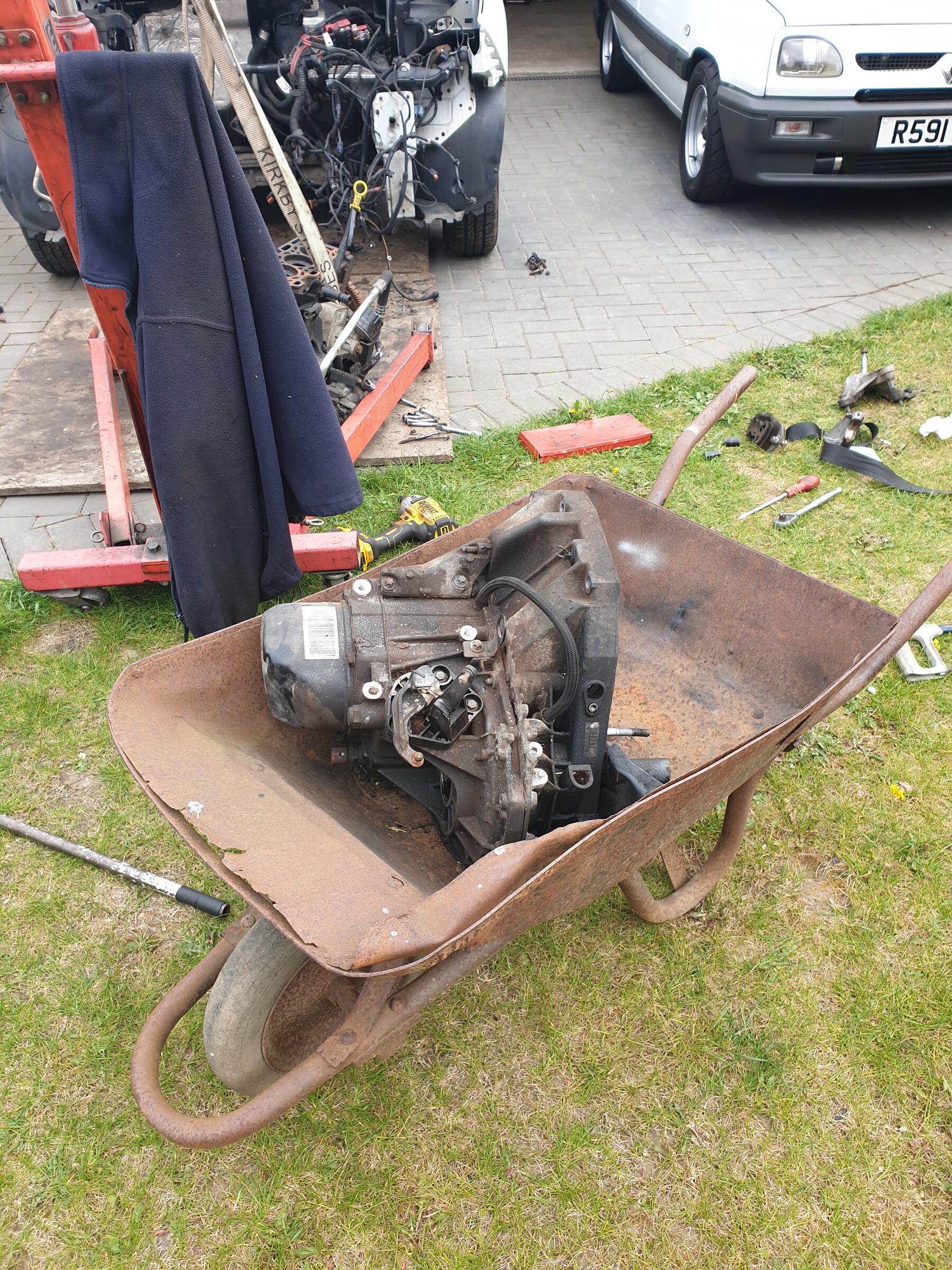

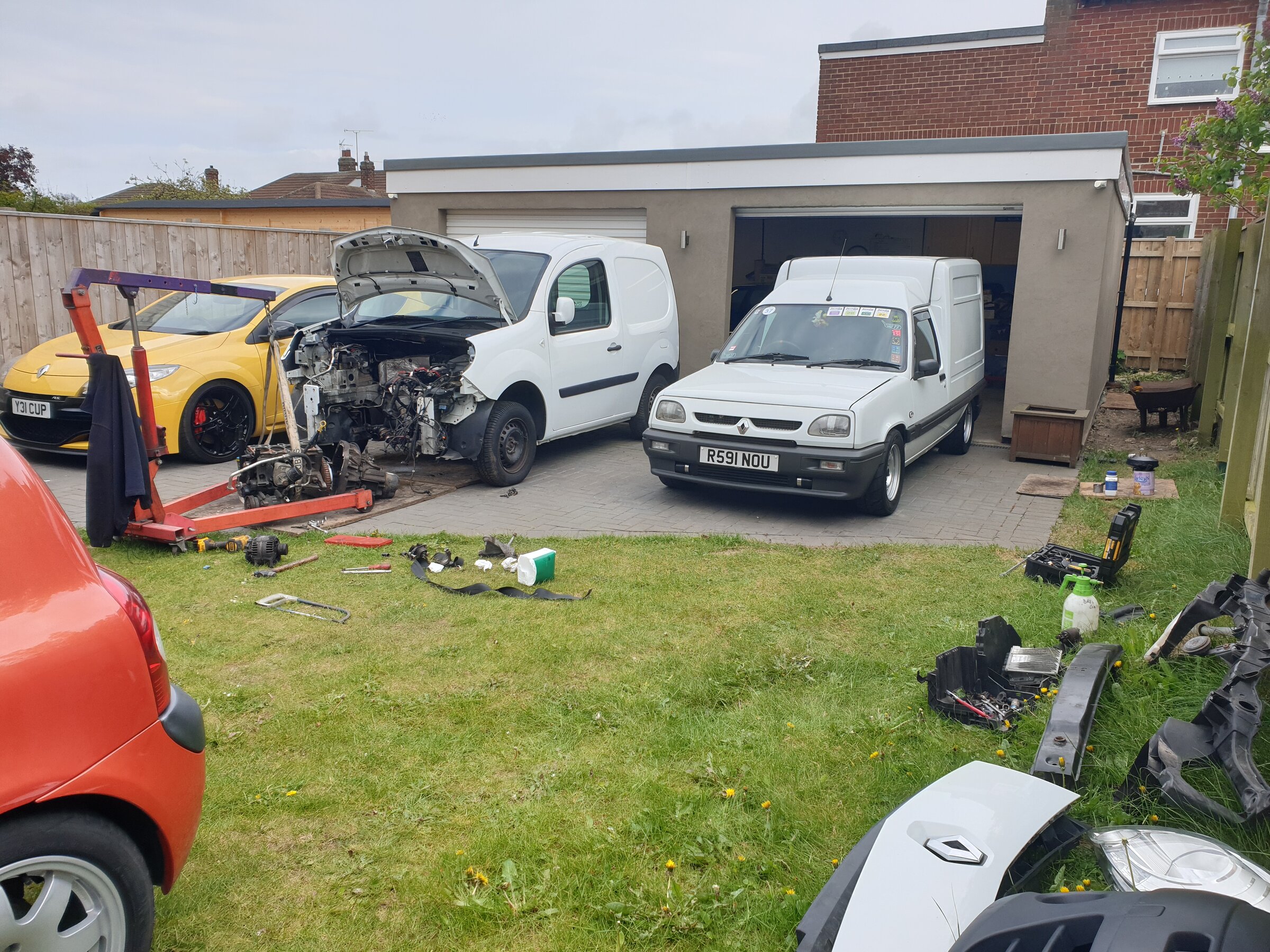

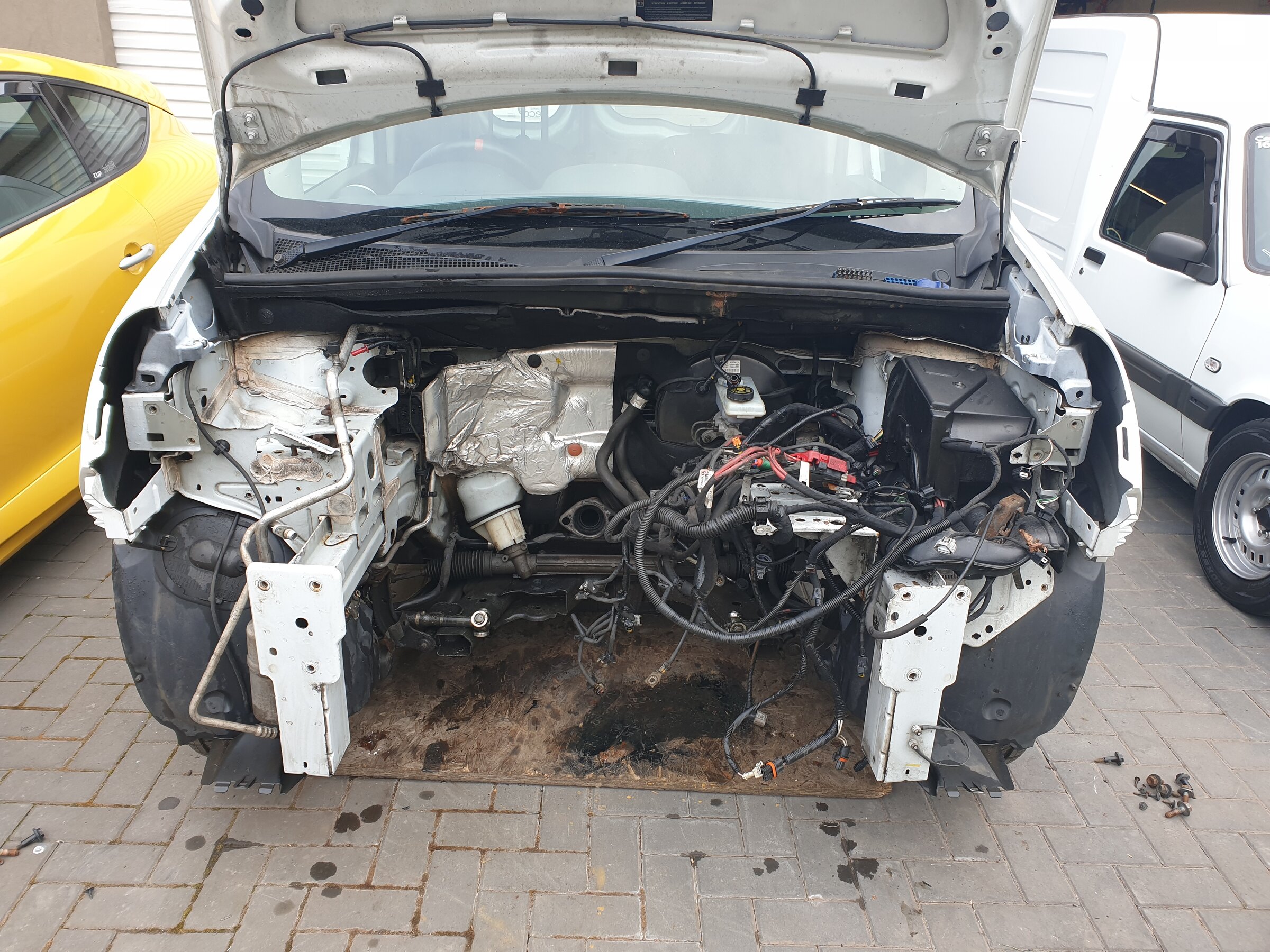

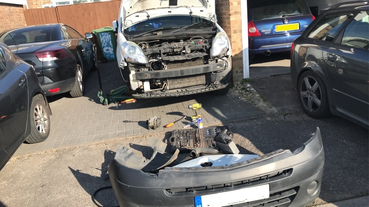

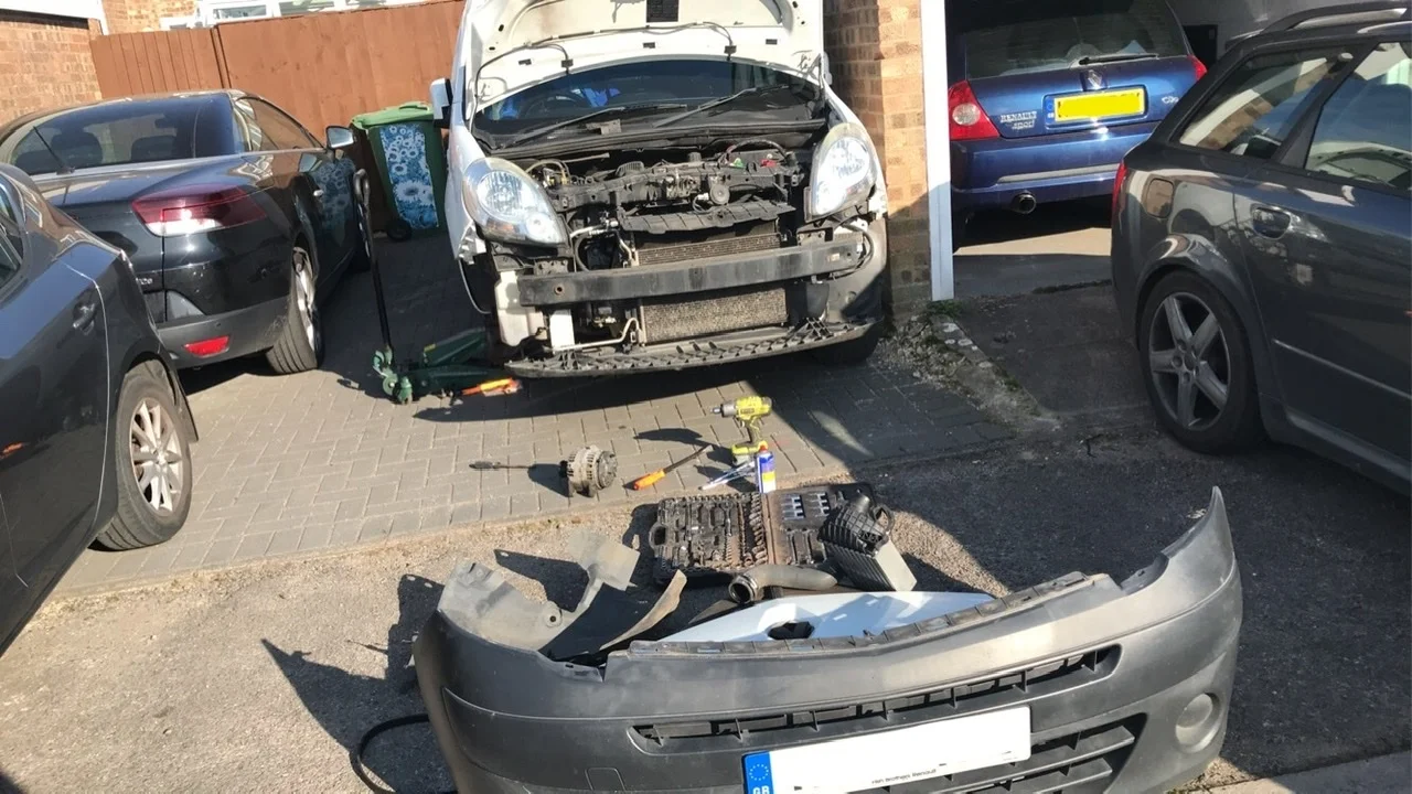

Bored yesterday so pulled the knackered diesel out. Started by removing the front end and remaining ancillaries, not much to take off as head was off.

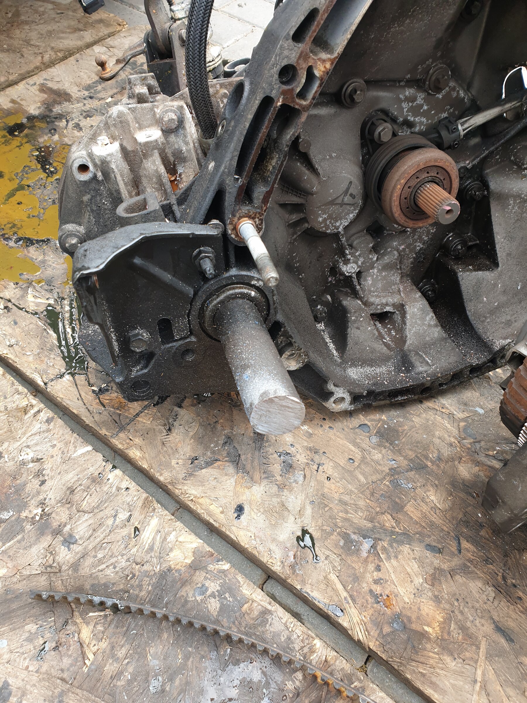

I had planned on selling the gearbox, drained the oil and it came out like bum wee, out for the scrapman
Could not be arsed jacking it up to pull a shaft and want to keep it rolling so got the hacksaw to cut it, its only a hollow shaft, wont take long.
15 mins later and we are through the solid shaft :cautious: good job im used to this after years of hand cutting when i was a joiner
Gear and cars all over as usual
Split the engine and box on the deck, pikey wheelbarrow to take the stuff outside for the scrap man. Good workout lifting the block into it, nearly went through the rotten wheelbarrow base:LOL:

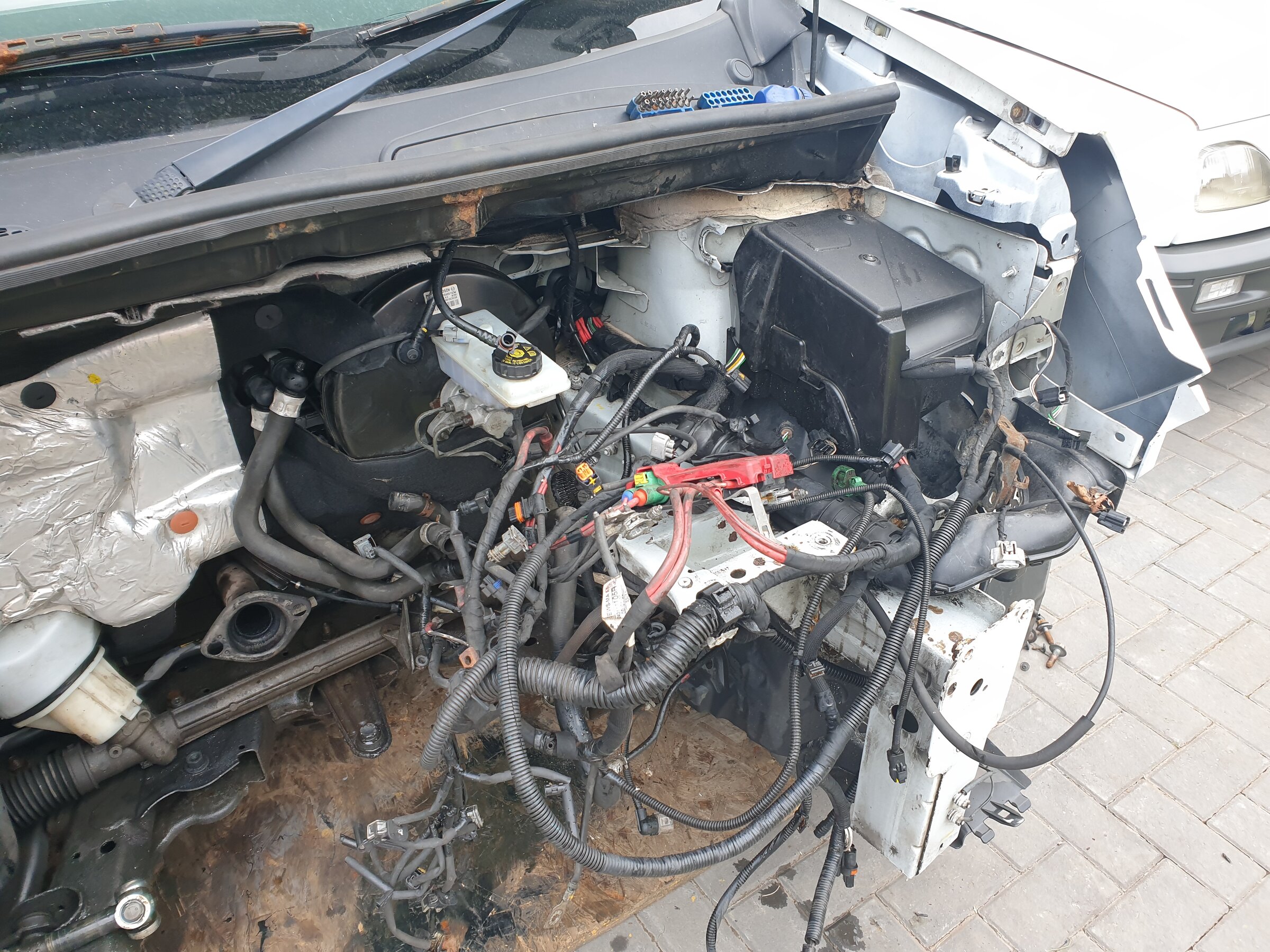

Engine bay quick clean up with apc and a brush, came up alright. Very similar to mk3 clio/meg
Rats nest of wiring to sort out later. Can i f**k be arsed changing the full loom unless totally necessary. I can get the r26 sagem s3000 virginized, if that does not talk to the uch/upc then its getting an immobiliser emulator. If i have no joy with that, my mate has offered me a nice standalone ecu.
Job for another day sorting this

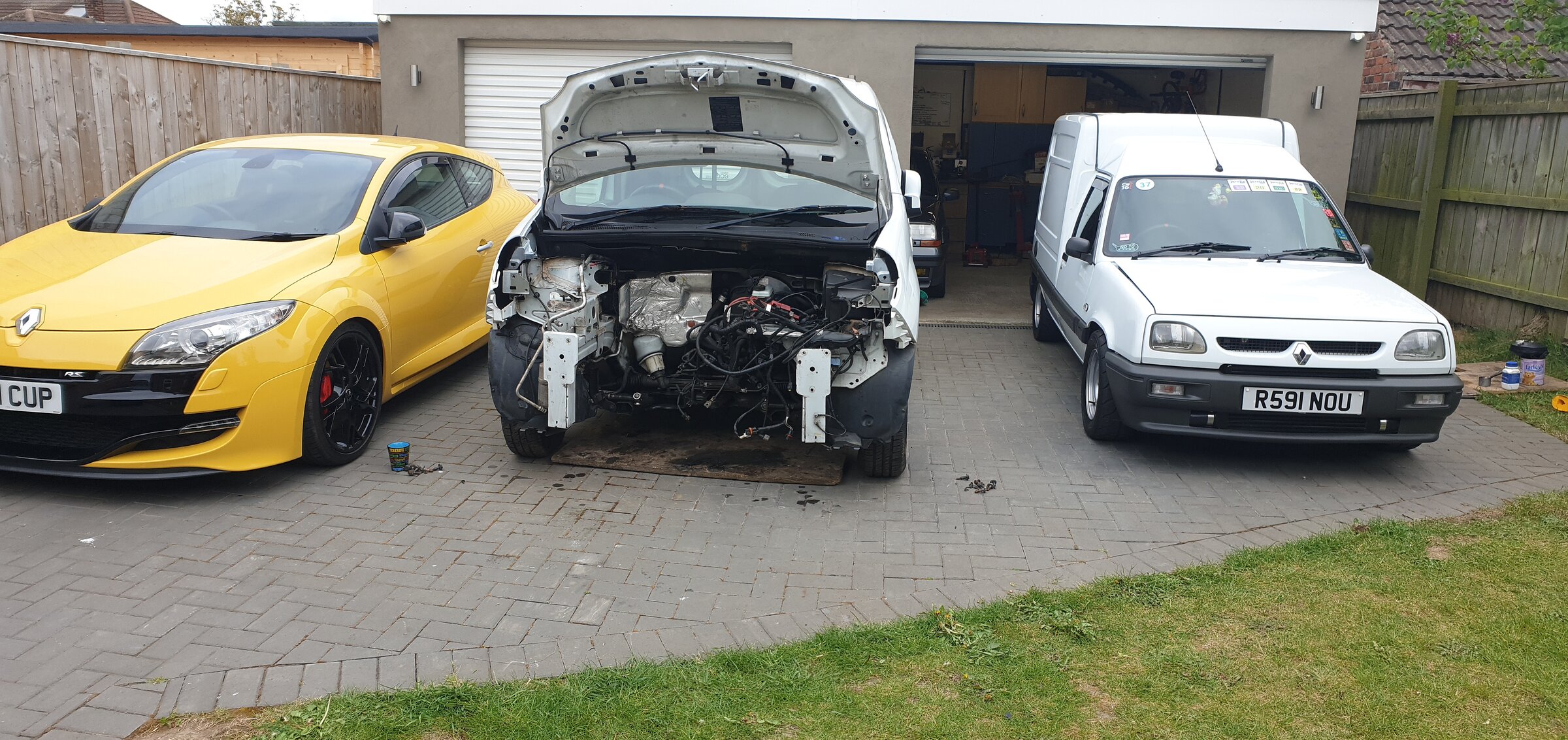

Pic of racevan, project racevan, and 250cup that does the shopping run occasionally
Anyway the pikeys rudely awakened me chucking the scrap onto the pickup this morning at 7:30am. Took two of them to lift the bottom end, weak!!
Front end looks so high now engine is out, it offends my eyes. I have Kangoo H&R springs on order, brand new r26 shocks in stock, hubs, brembos, wishbones prepped. Should see the front end done as soon as they arrive ;)

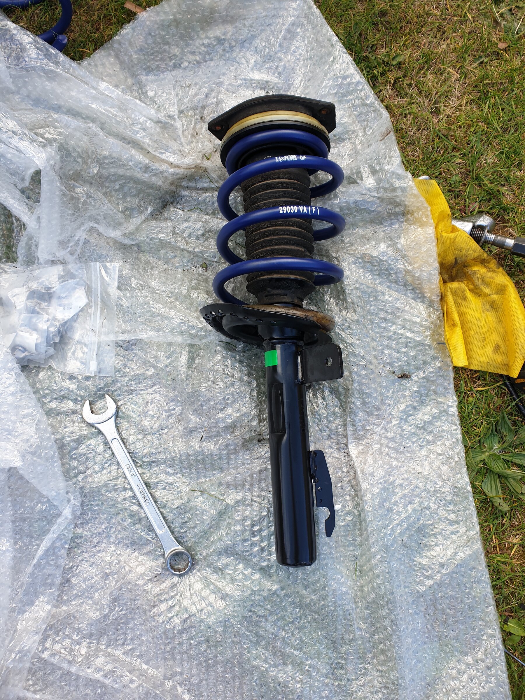

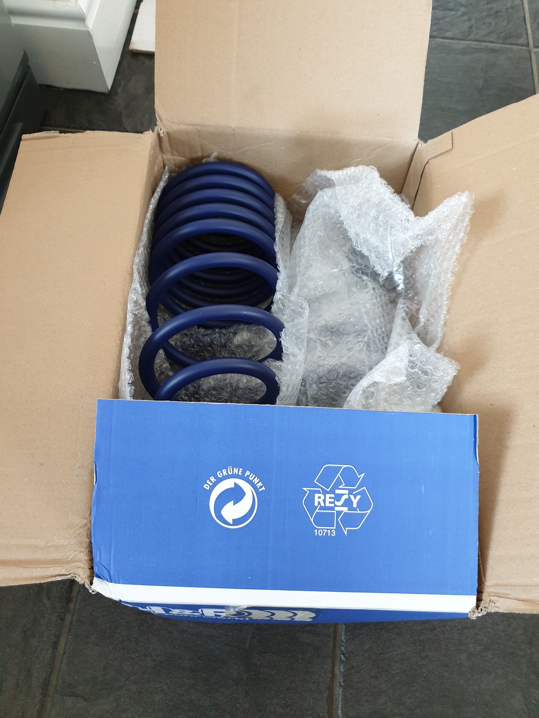

Knock at the door earlier and the H&R springs arrived from Germany in a week, miles faster than most Royal Mail parcels!

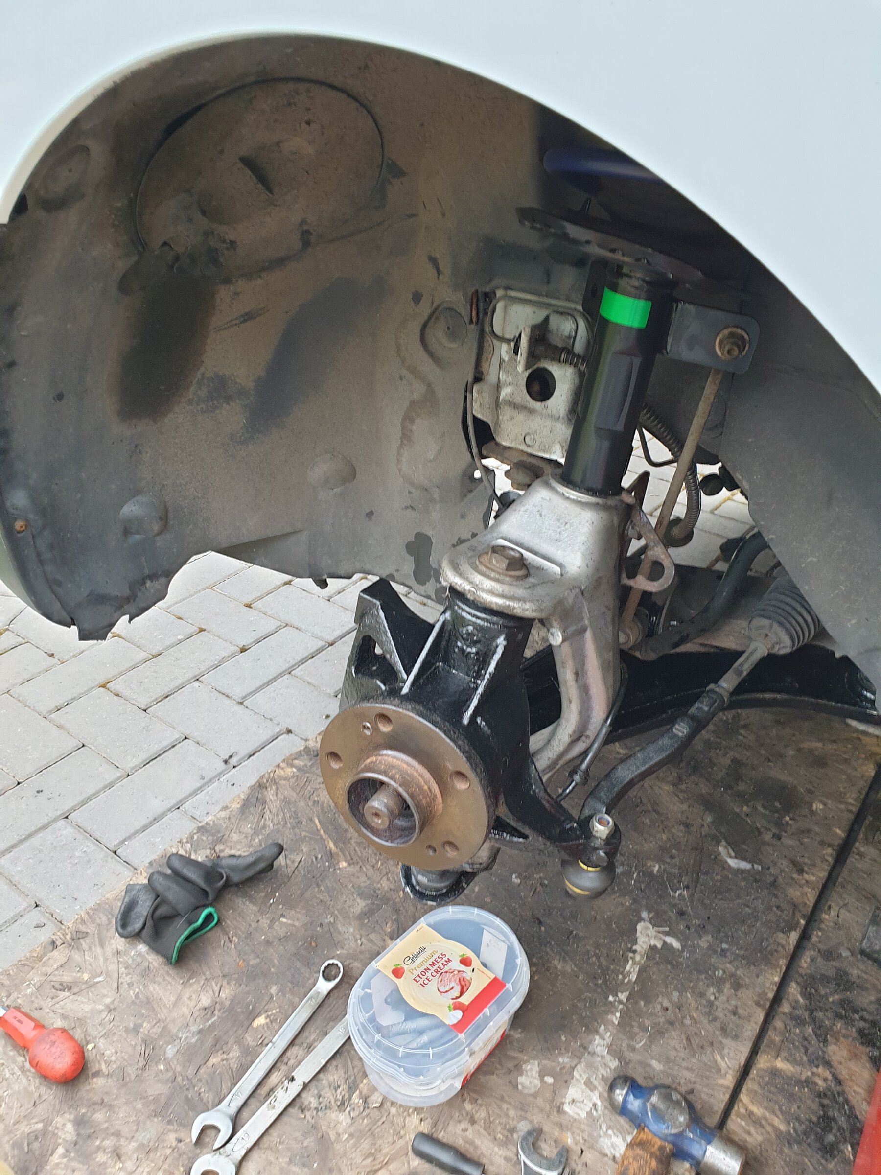

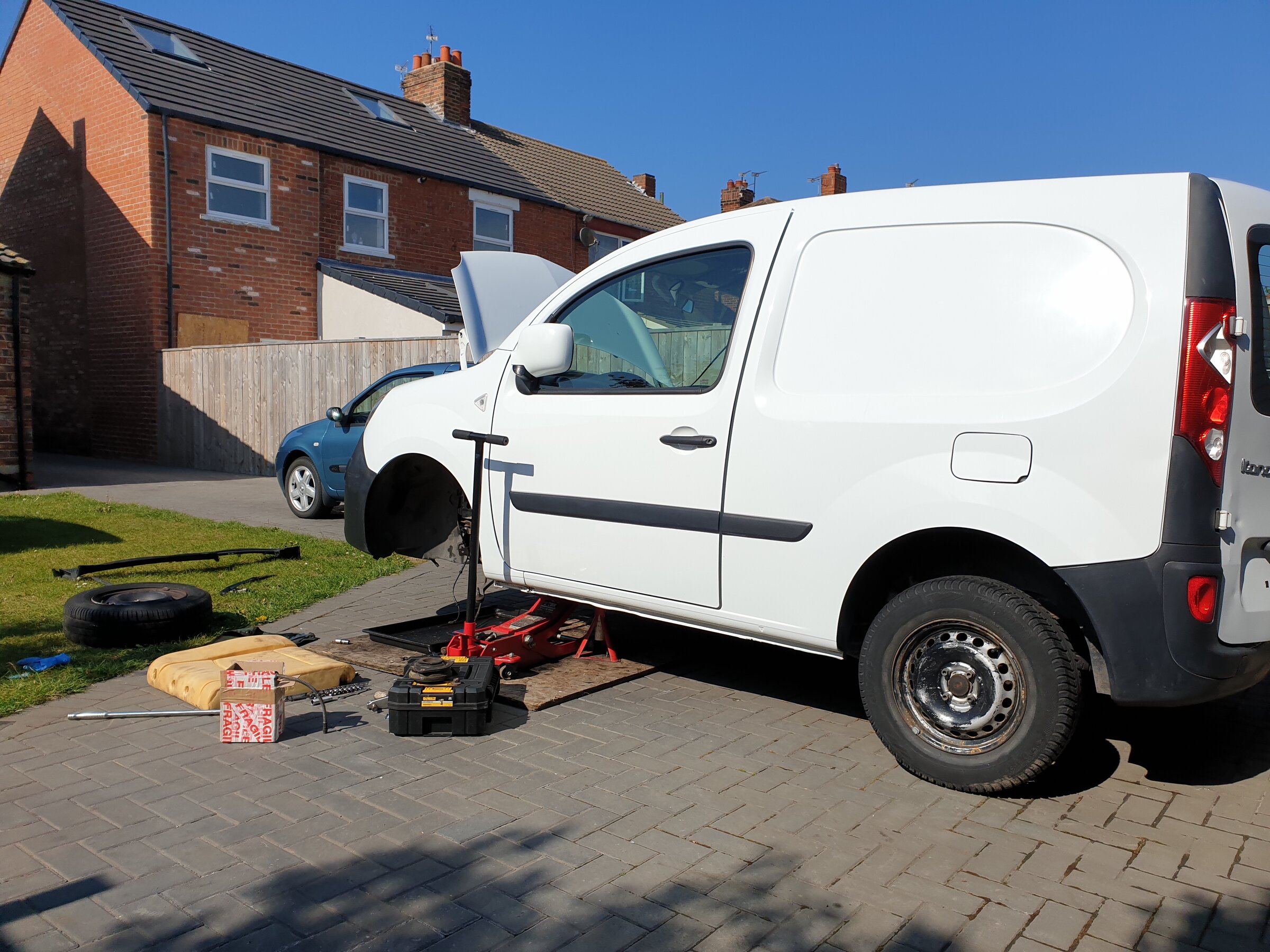

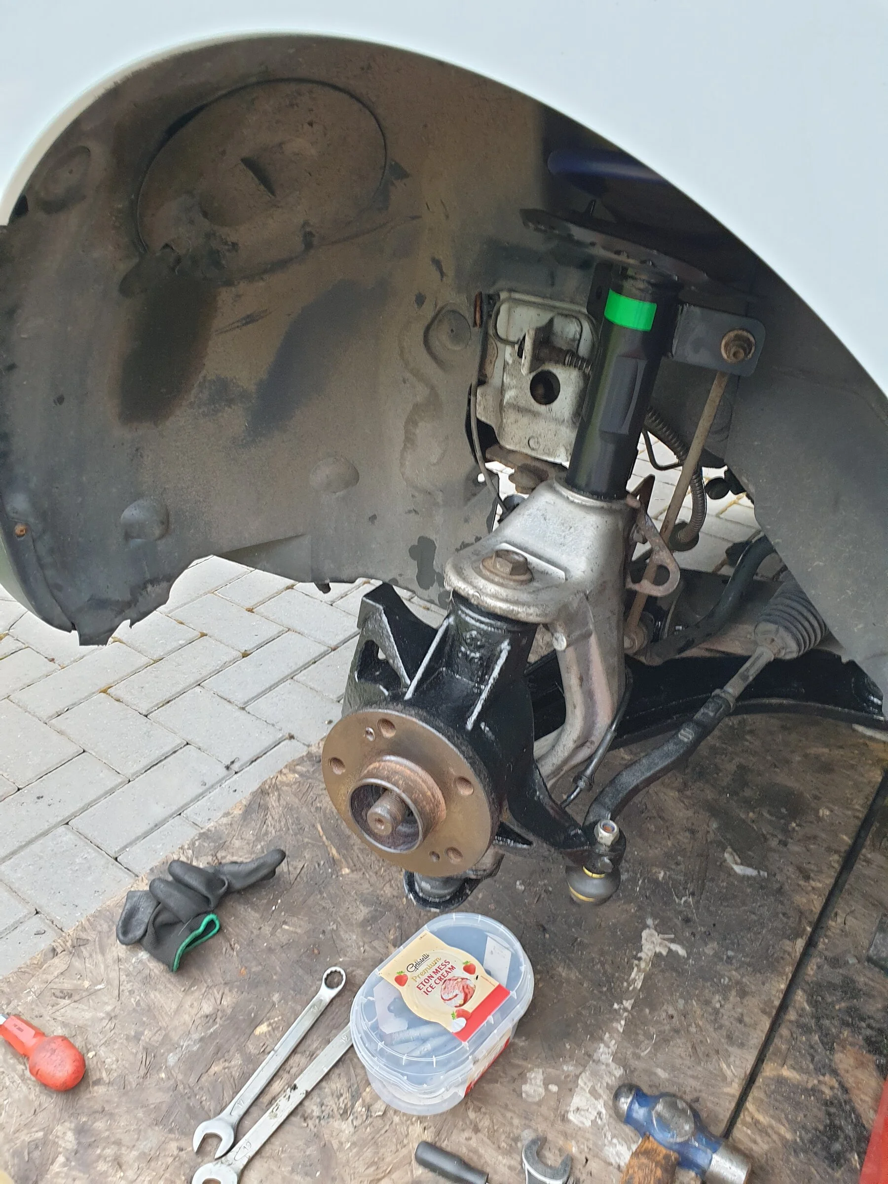

Started pulling it to bits

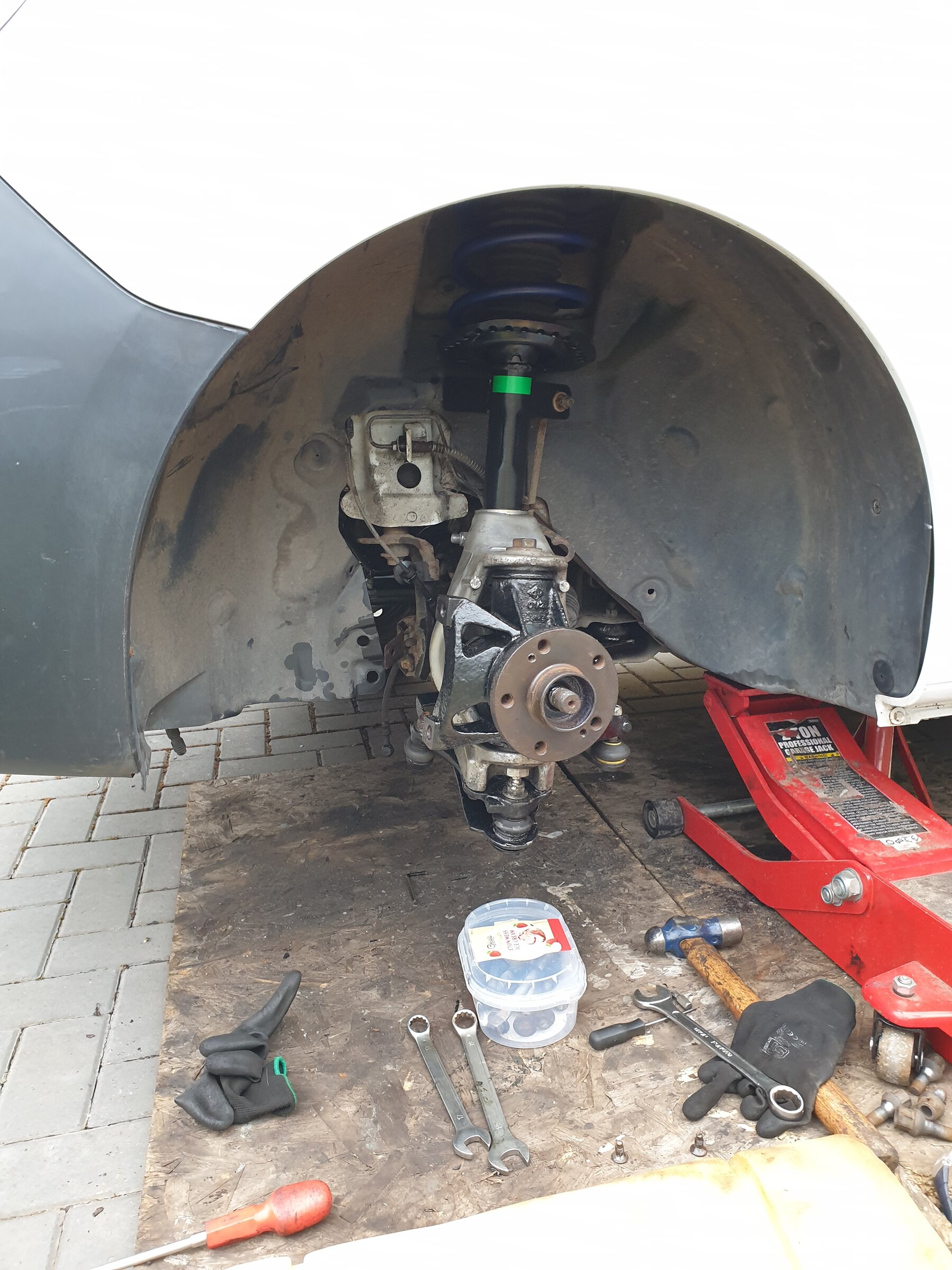

Fitted on fresh R26 shocks
Wishbones and hubs on
Brembos on, flexi hoses fitted and brembo hc 312mm discs fitted. Discs have had a sacrificial dusting of black to keep the rust off whilst stood. Started pissing down so no pics, calipers are zip tied on due to bolts not arrived yet.
Still a high rider as no engine in and only one side done. If im not happy with the rideheight then it will get a set of Bc's up front once its up and running.
Mrs has told me to keep away from her track wheels, might need to sweet talk her :LOL:
Get the other side done tomorrow if weather is alright.

Around £160 delivered for the H&R's, good quality and seem quite hard on the front too. Not done the back yet, on the never ending list.
Both sides of the front suspension are done and its rocking an old set of ph1 225 alloys whilst stood.

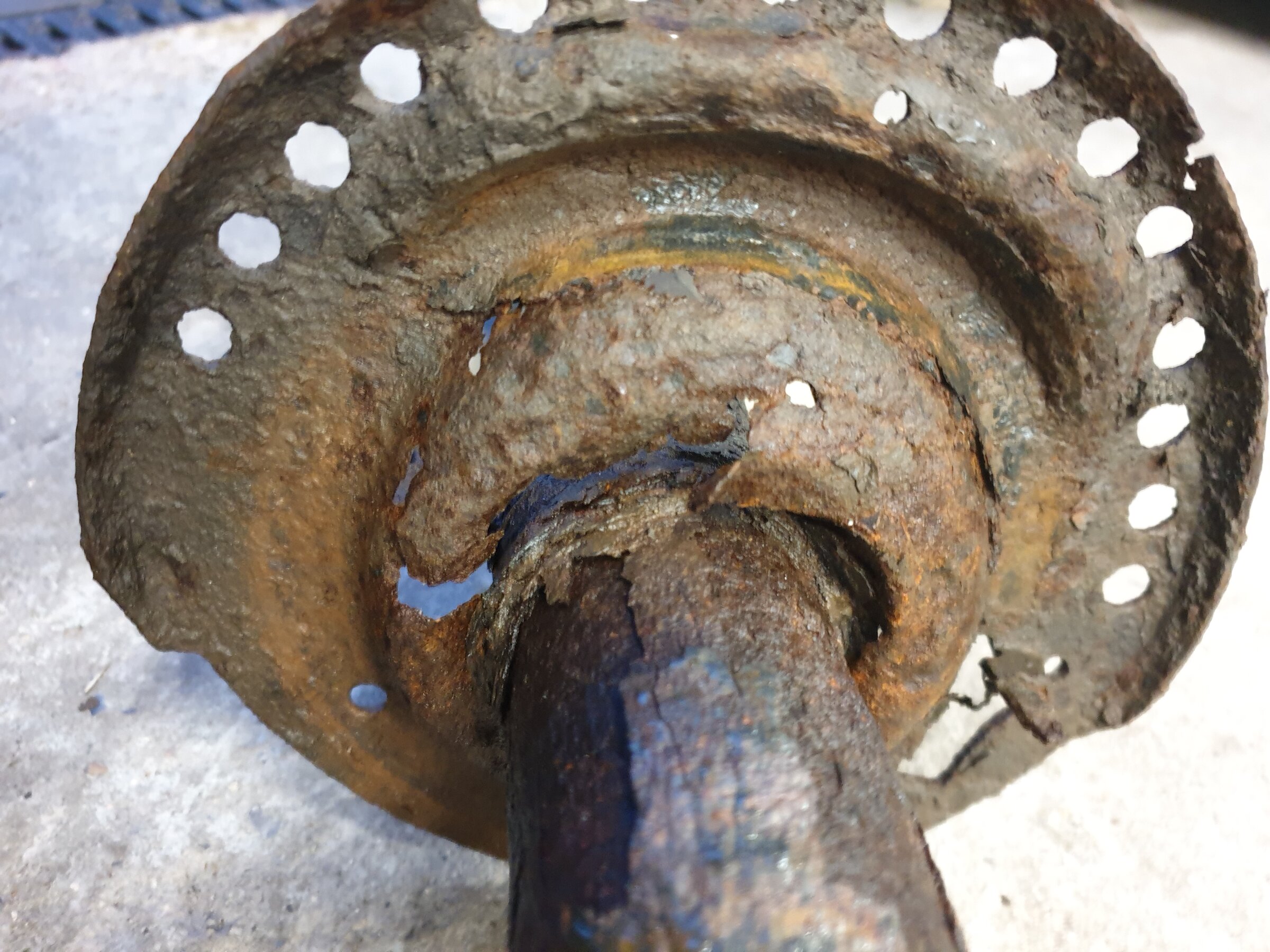

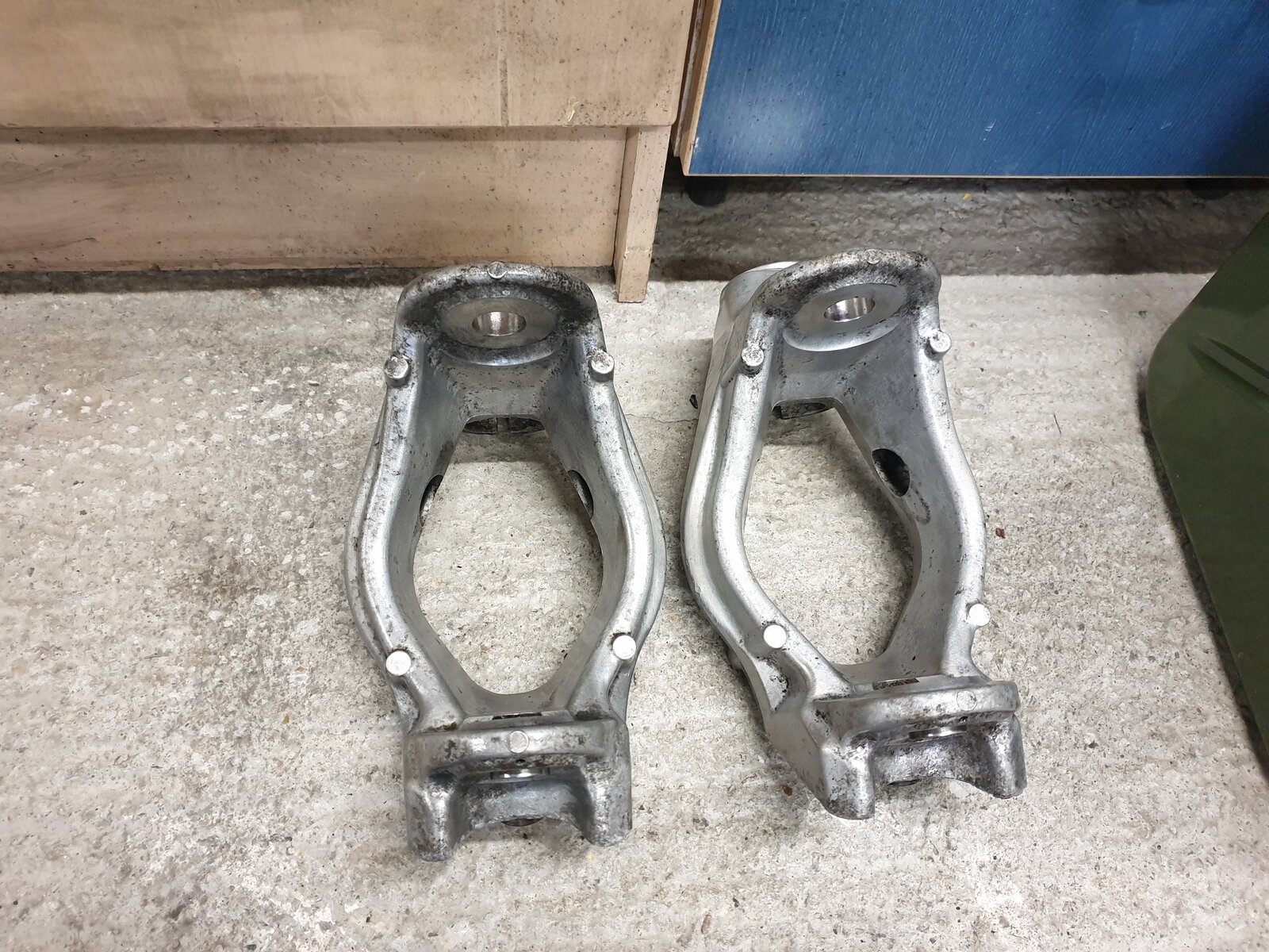

Found this beauty when stripping the drivers side front suspension down, daylight half way round where the spring cup joins the strut body. So close to failing, only 9 year old and still mot'd.
Arse was nipping a bit when gunning the strut to hub bolts off incase it let go..worked fast as f**k to get it stripped :LOL:

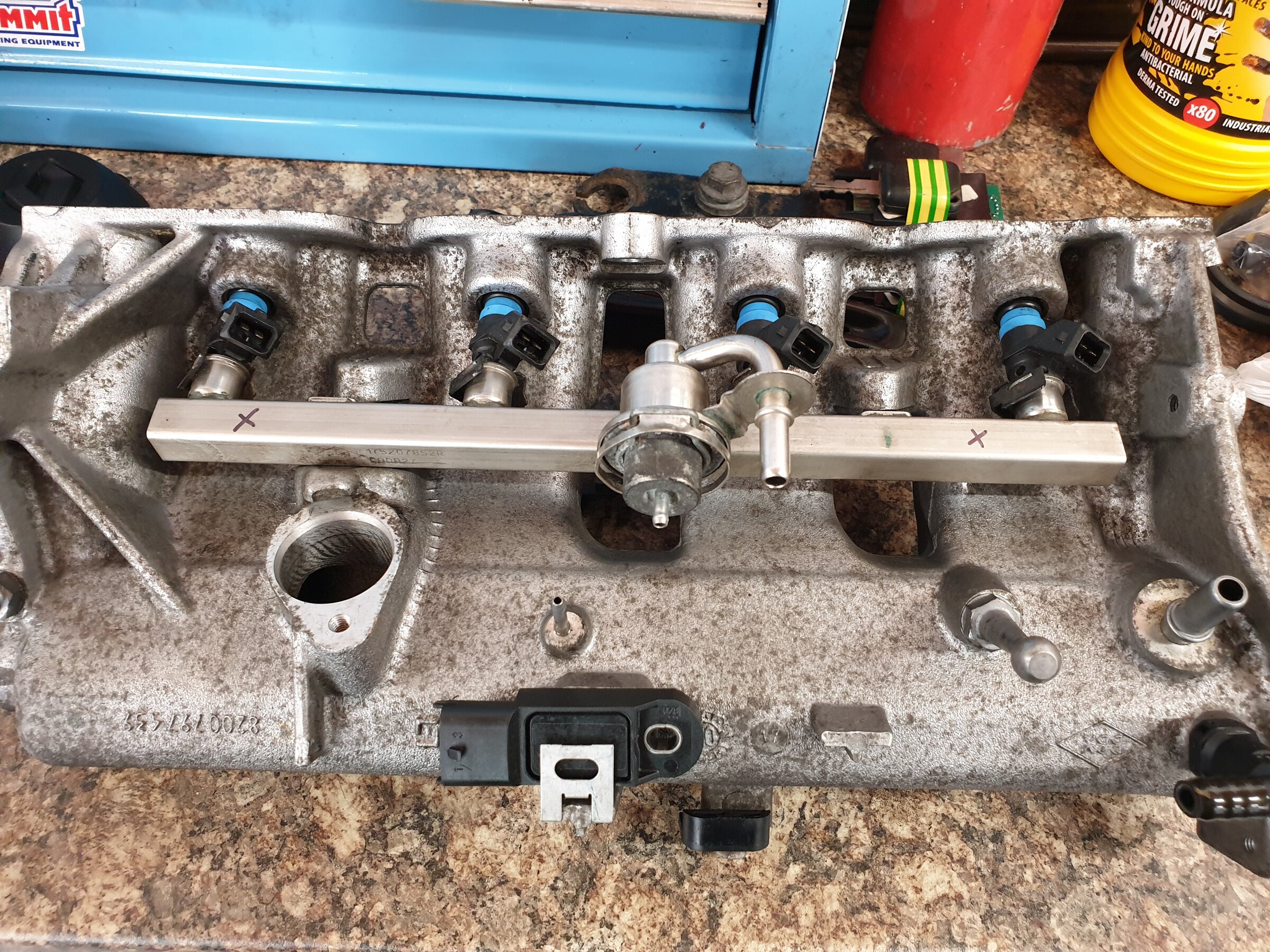

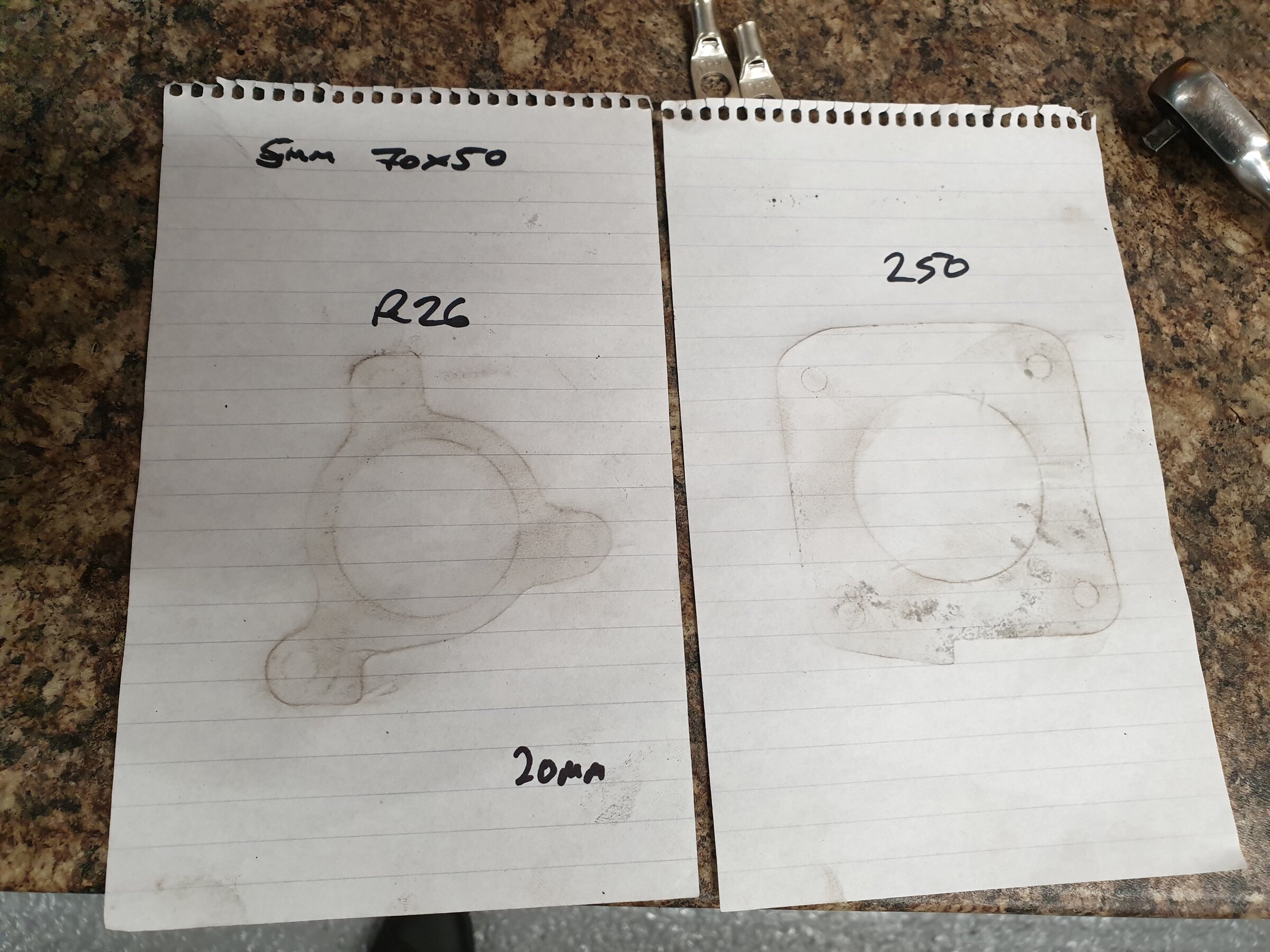

Found the rare 250 inlet manifold. Need to make an adaptor plate to suit the r26 throttle body.
Fuel rail will have the reg removed, inlet and outlet fitted and traditional fpr fitted on the fuel return with a proper fuel system.

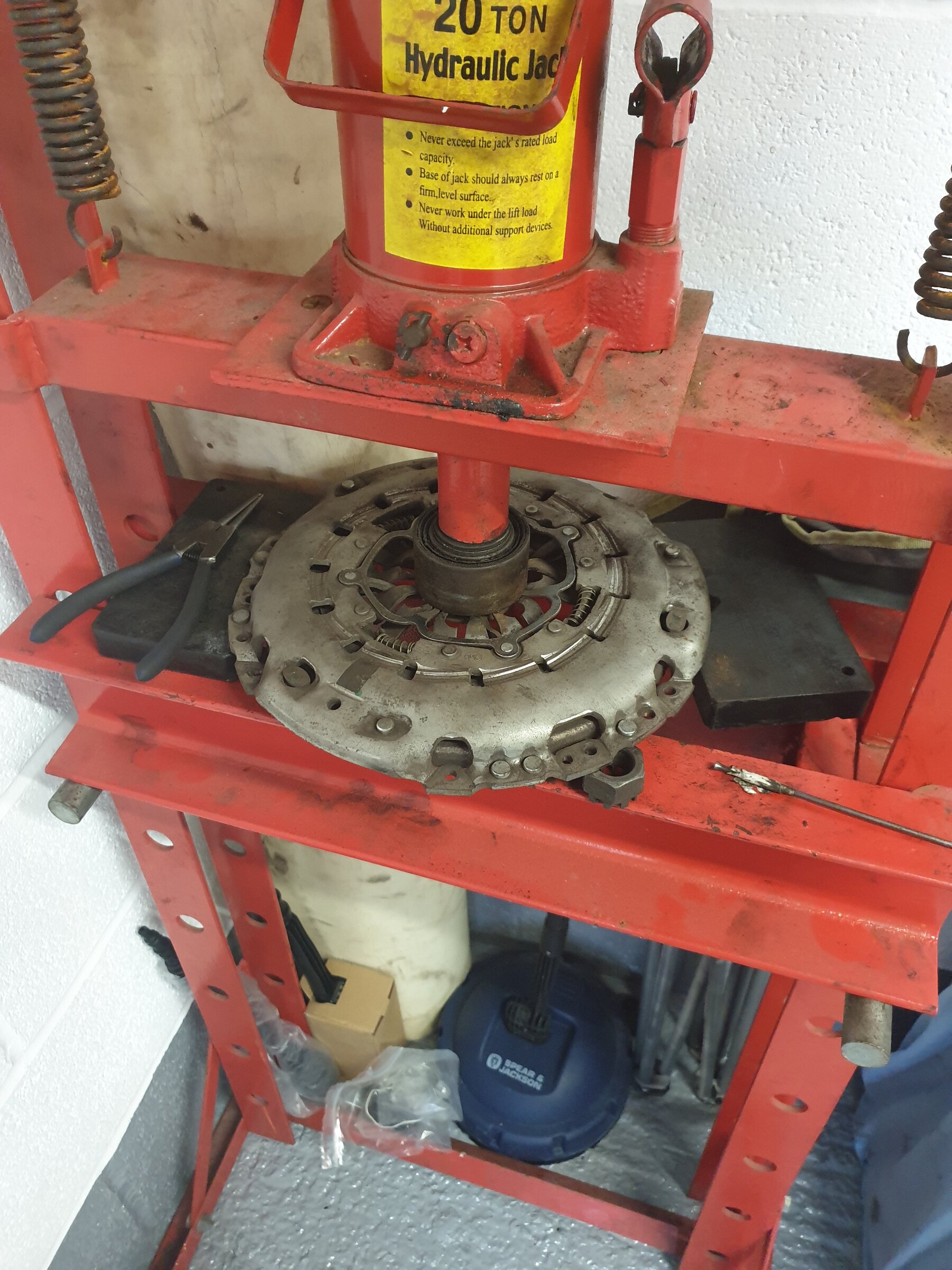

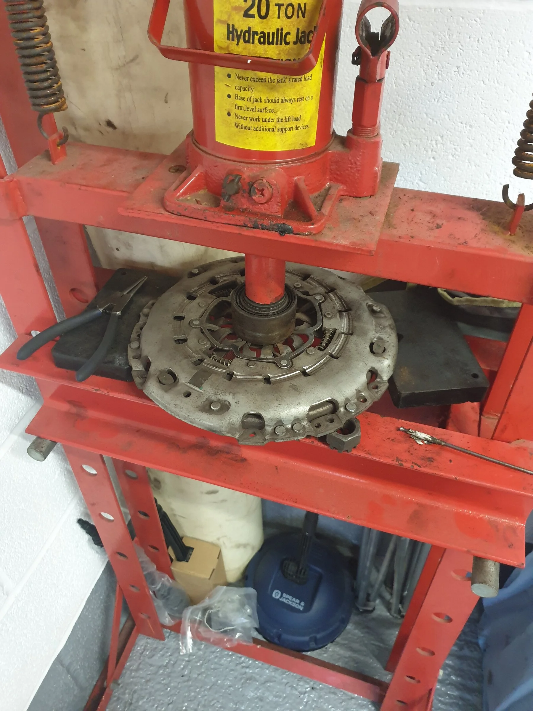

Went to fit the clutch, and noticed the crank seal is knacked so got one on order. Borrowed the genuine knocker tool to fit it.
Reset the pressure plate ready for fitting with the press.

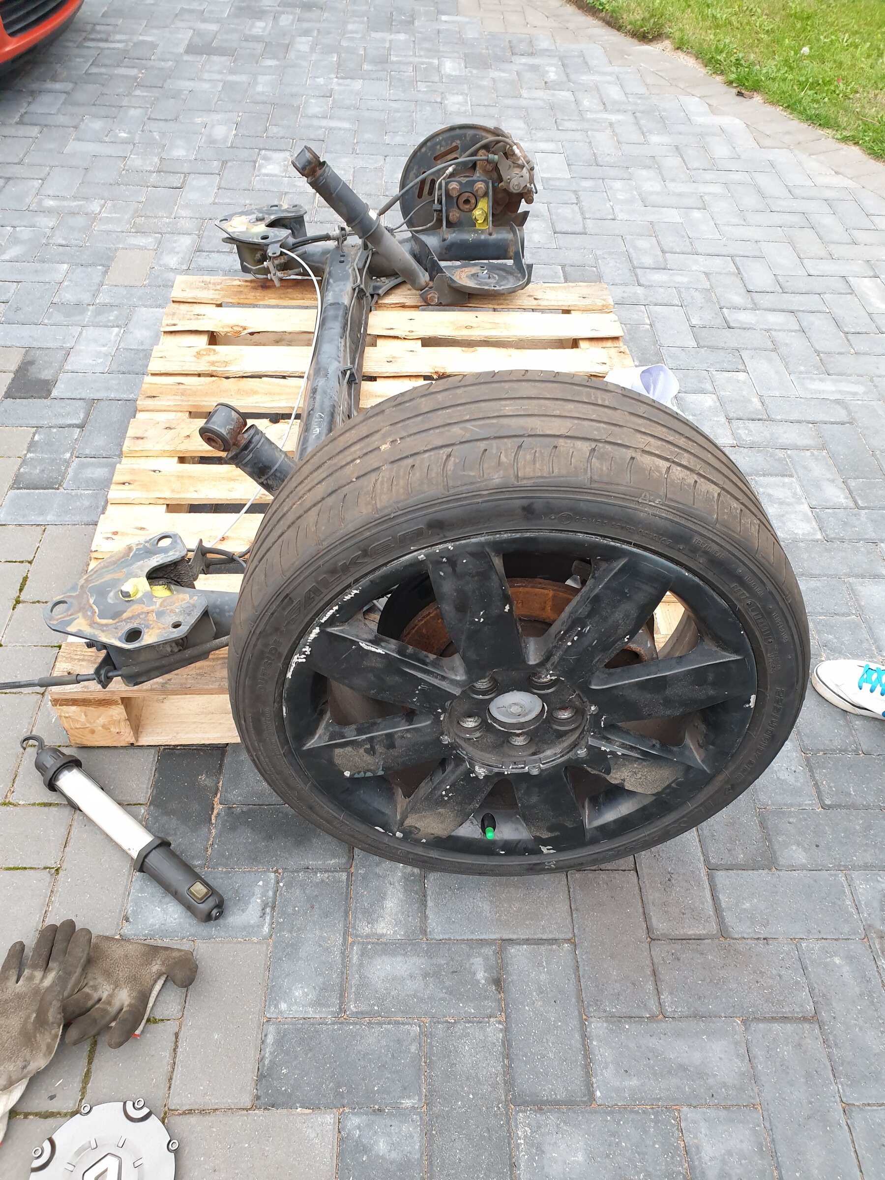

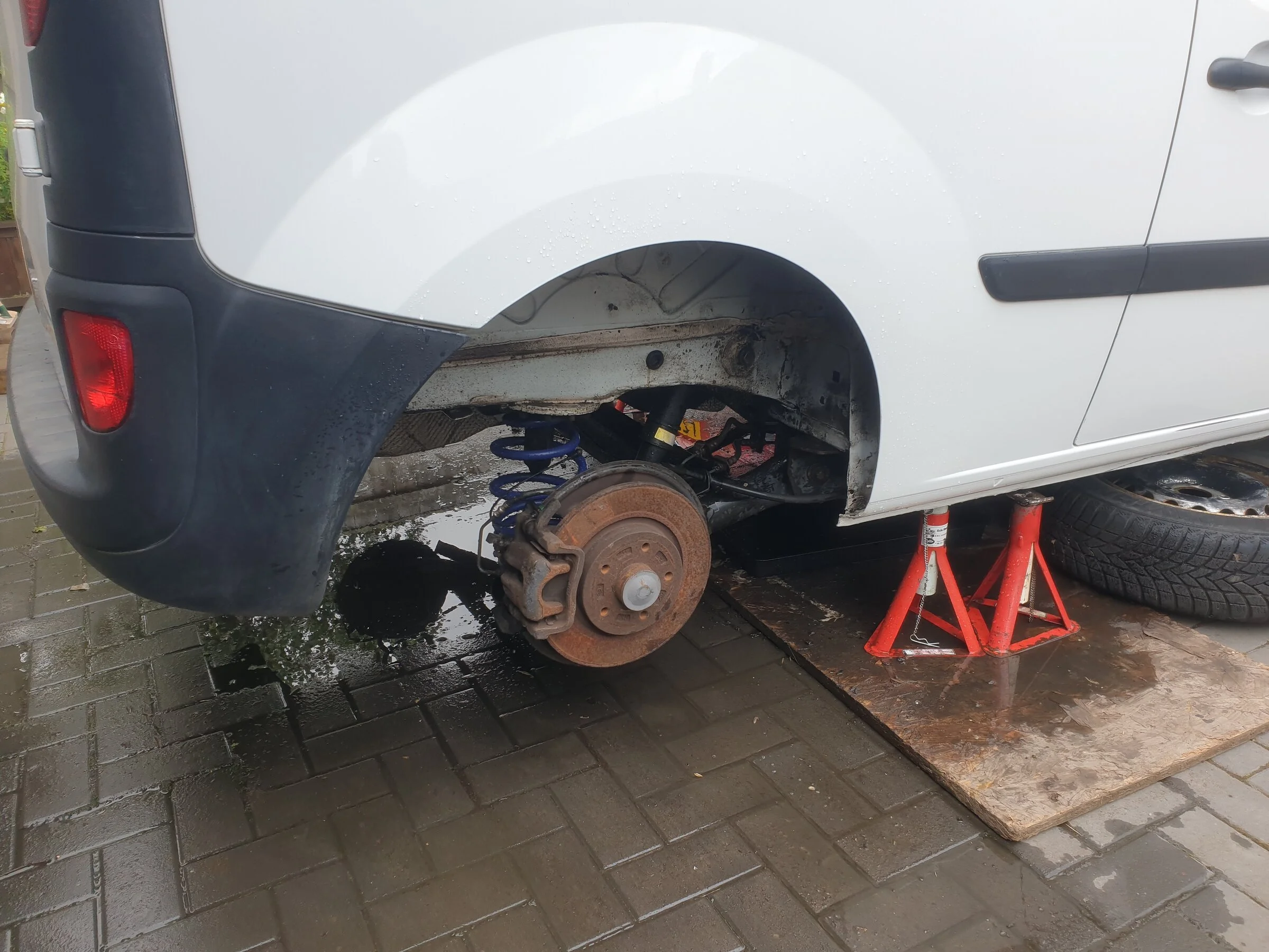

5 stud rear beam has arrived today. Might get it on this weekend and get the brakes bled up.

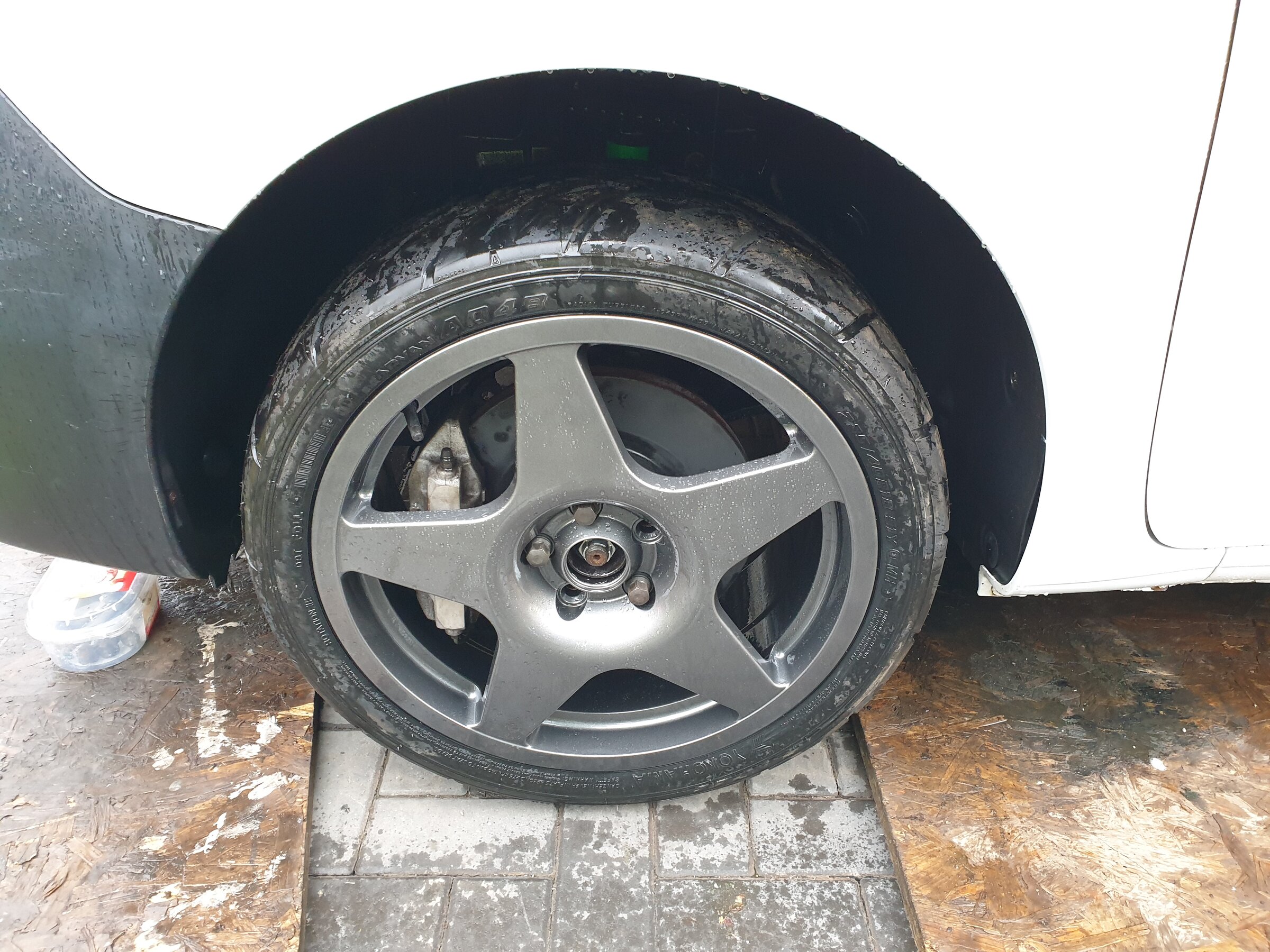

Rear beam fitting time. Best check wheels fit i guess.
Ahh thats a no then, fouls the handbrake cable and the fecking centre of wheel fouls the caliper
Measured up the hub centre protrusion and its 20mm, so ordered 10mm slip on Pms spacers to suit meg2 and longer bolts to suit.
Wait a few days for spacers to arrive, try again and it works.

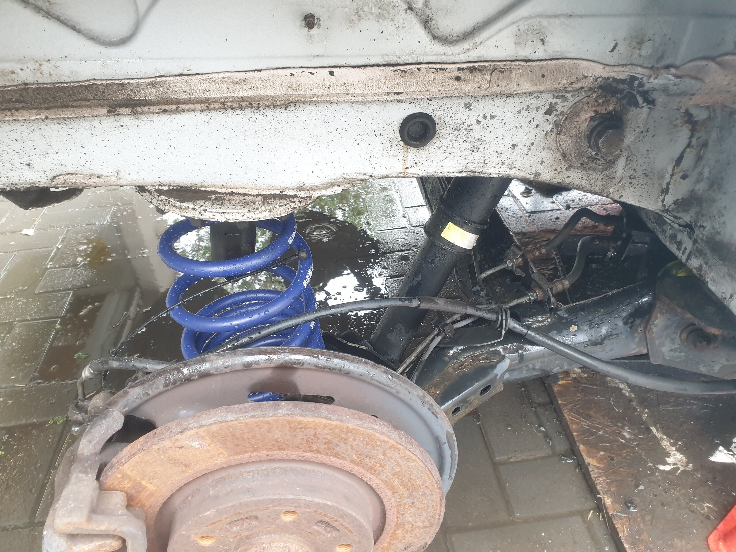

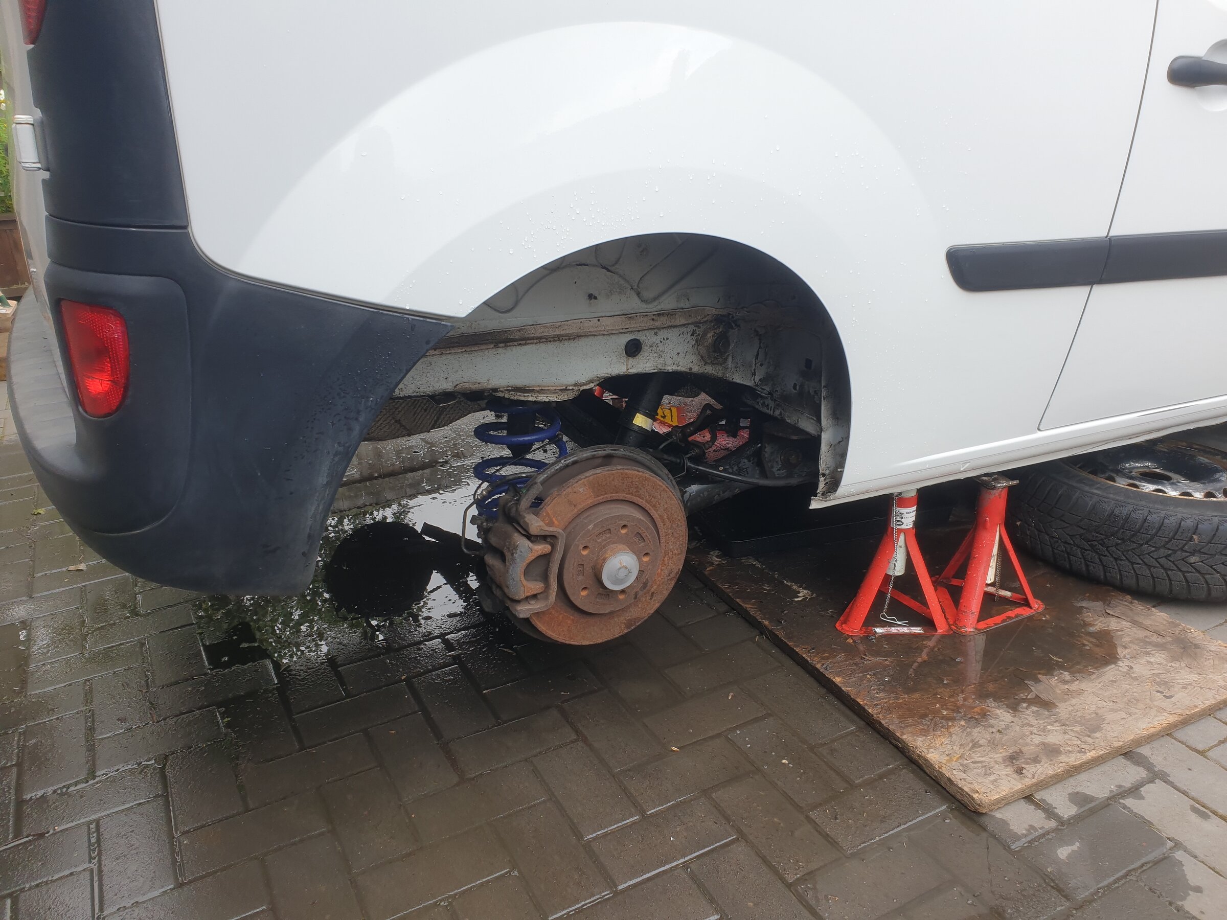

Whipped beam off and stuck the new one on and fitted the H&R rear springs.
Cleaned arches too. Discs and pads will be getting replaced once its on the road, will leave the rusty ones on for now.

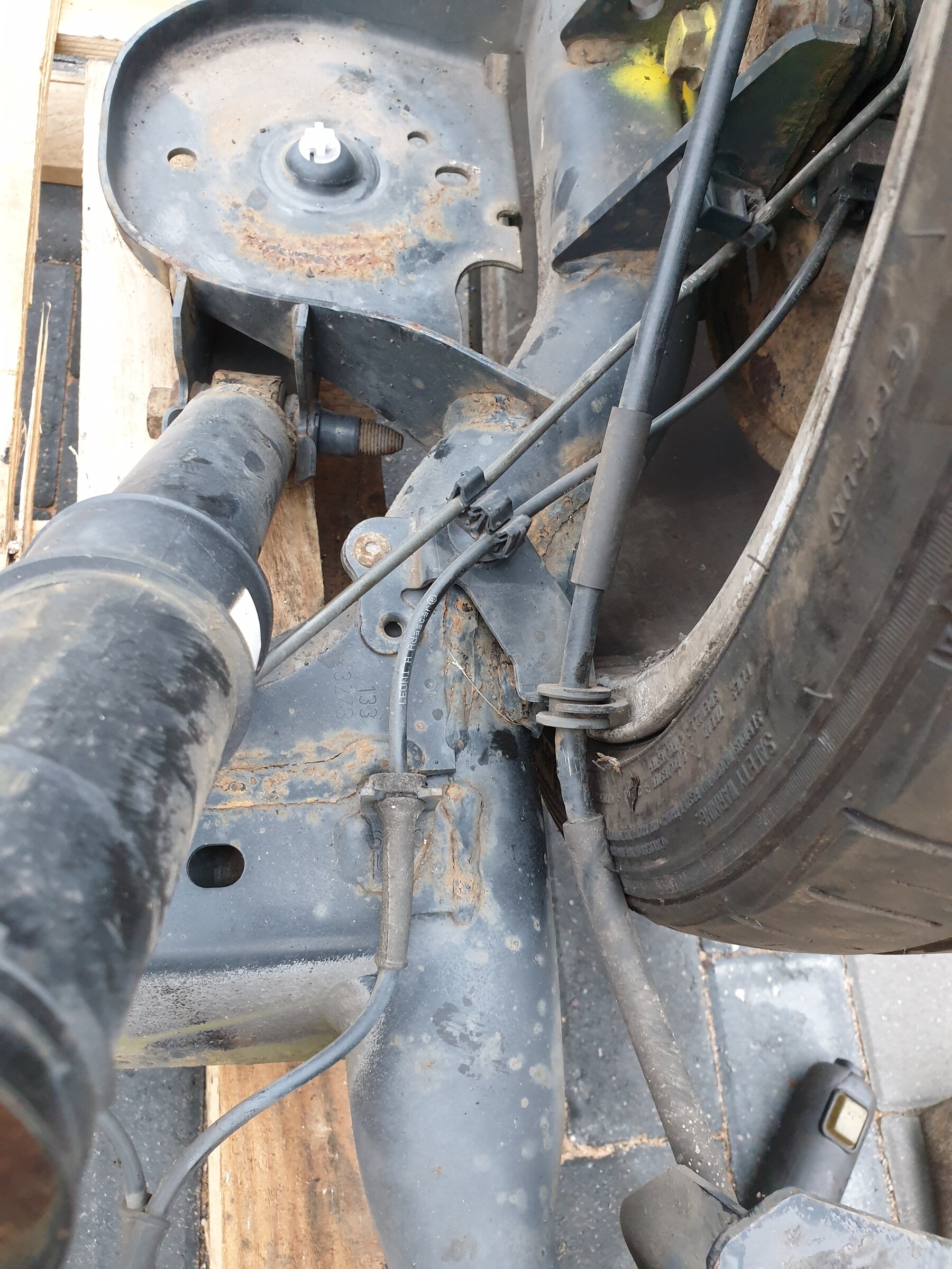

Small issue with the handbrake cables, the beam is off a normal length Kangoo ML so the handbrale cables are about 18" too long :poop:Two solutions to this - if Ren made this model with rear discs then can order cables to suit, if not i will shorten these cables.
Wheels are only on as sacrificial whilst its sat doing nothing on the drive so just need it to roll. Needs to be lower but will see what its like with an engine and box in.

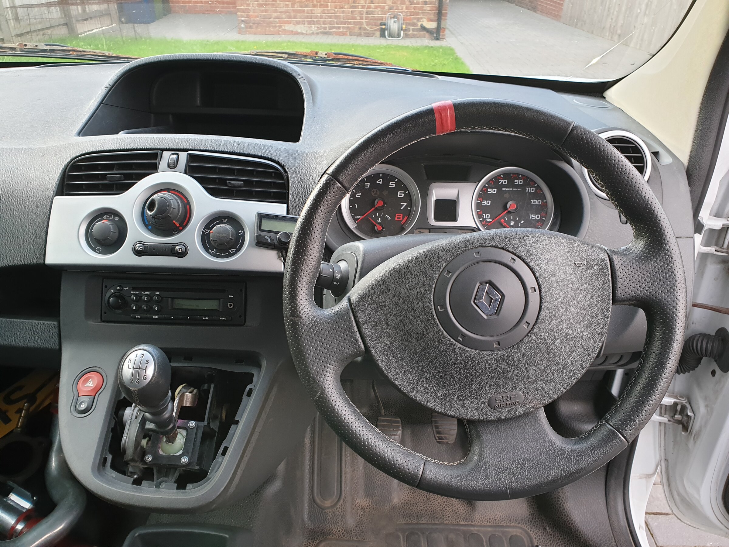

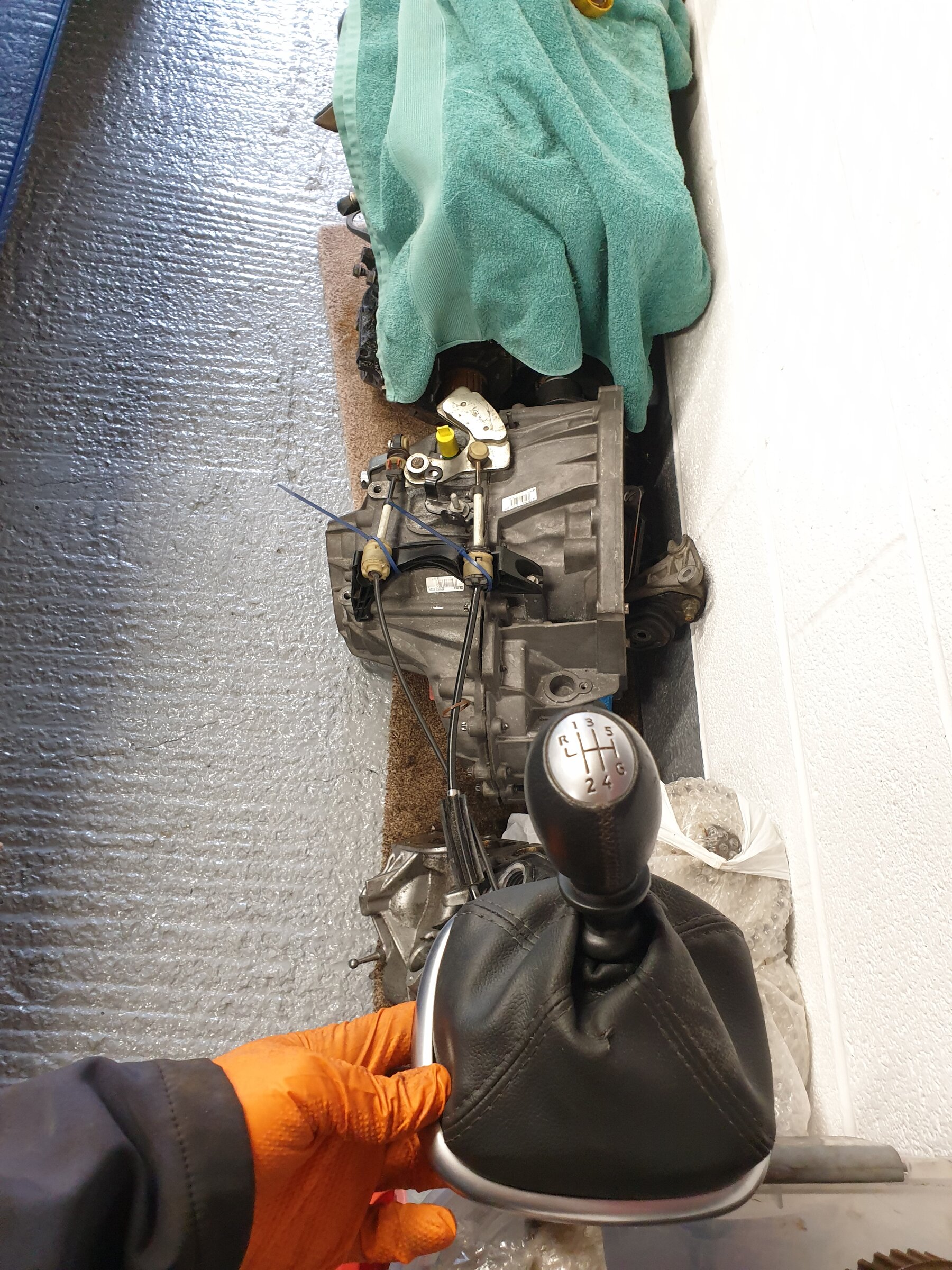

Been looking for a 6 speed shifter for a Kangoo and they are quite thin on the ground as most are 5 speed. As its a dash mounted shifter needed the proper one really.
Sniffed one out on ebay in Latvia, off a lhd model. Was fairly expensive but stuck an offer in which was accepted. Took a gamble with this as for lhd (assumed both the same from checking part no's) and was not even sure if it would work on the 250 pk gearbox.
Arrived today and after the rain stopped finally got some motivation to get off my arse and do a bit.
Hooked up the shifter to the 250 box and can report it works ok and can select all 6 gears so thats a nice little win
Pulled the old shifter out and fitted the new one, ballache as cables run under the heater box, stripping dash trims off etc.

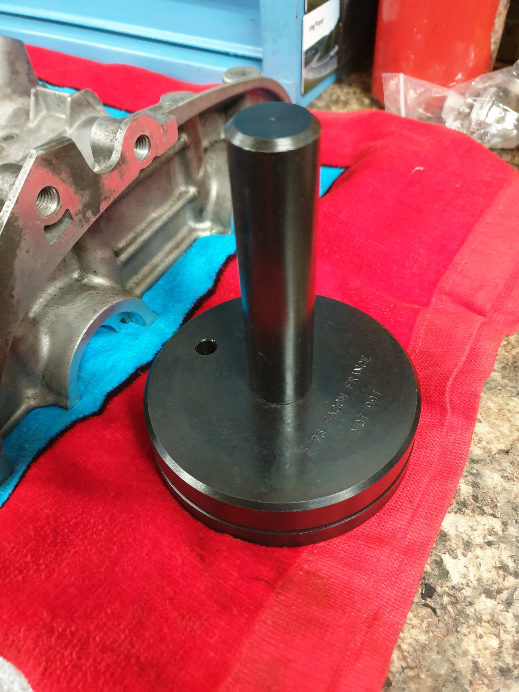

Crank seal turned up too so used the genuine knocker tool to fit. No pics as forgot but works great, no pissing about.

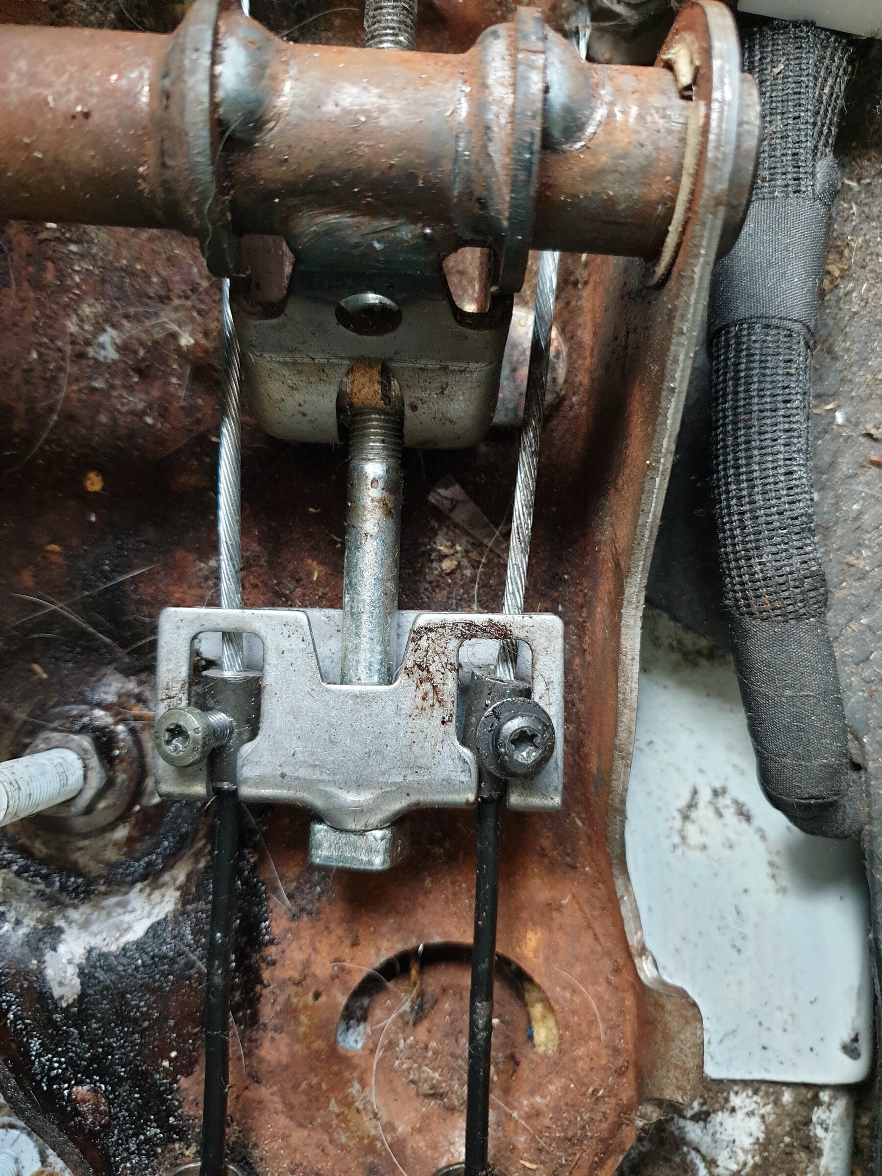

Next job was to mock up handbrake cable length. From what i gather they never specced rear discs on the compact model which leaves the ml length handbrake cables to suit the calipers about 12" or so too long. So need custom handbrake cables really. Outer sheath is the same length as it meets the rear floor behind the fuel tank.
Cut down the inner to suit, and made some clamps. Back yard engineering style, used an old head bolt, drilled the length, then drilled the side and tapped for an m5 thread/bolt. I seen similar stuff done on the kit car forums when looking, and to be fair it works great, tested by repeated ripping the handbrake up and the clamps have not moved. Will prob eventually get proper cables made up now i know the length is correct.

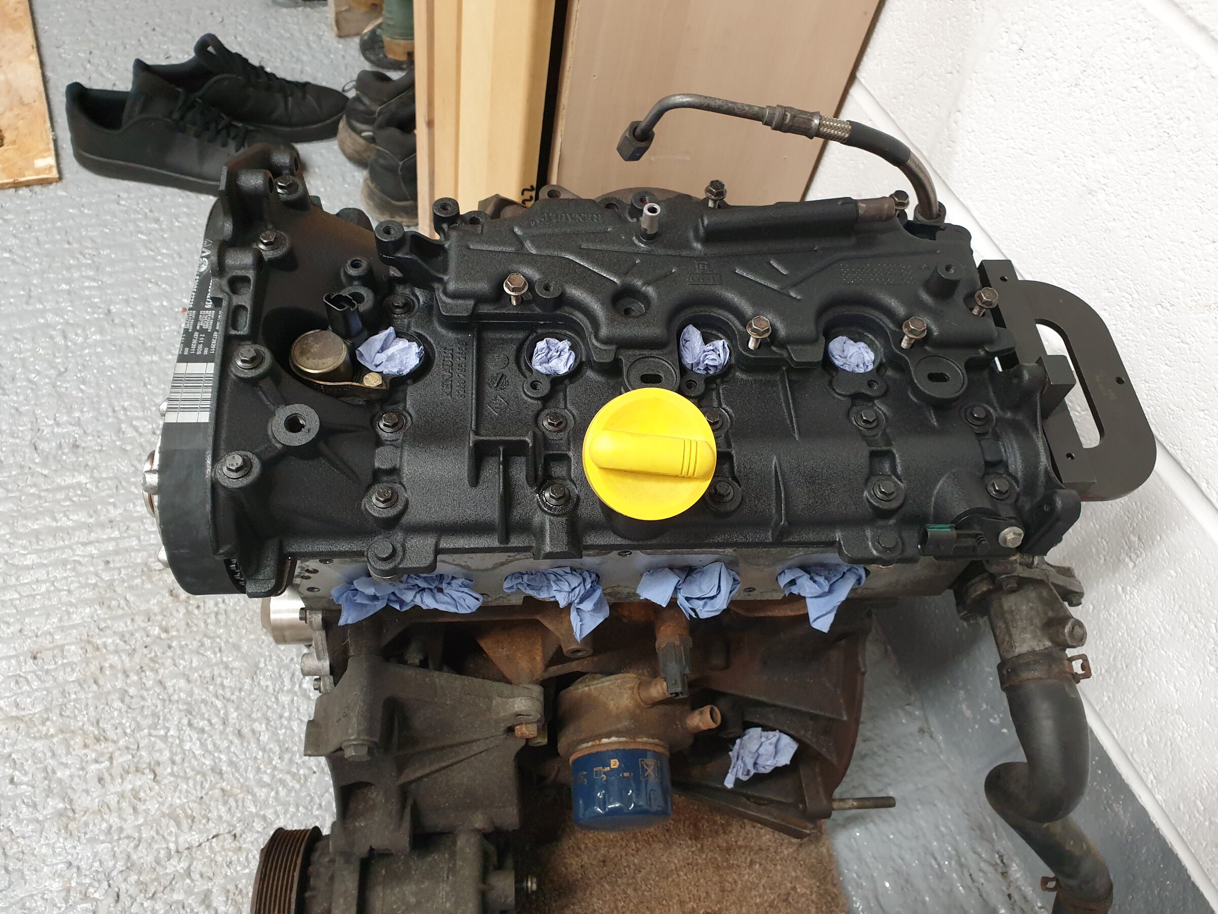

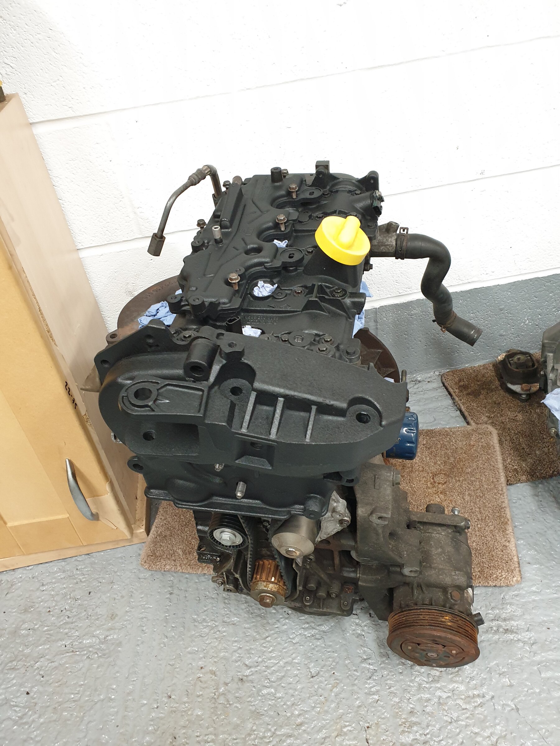

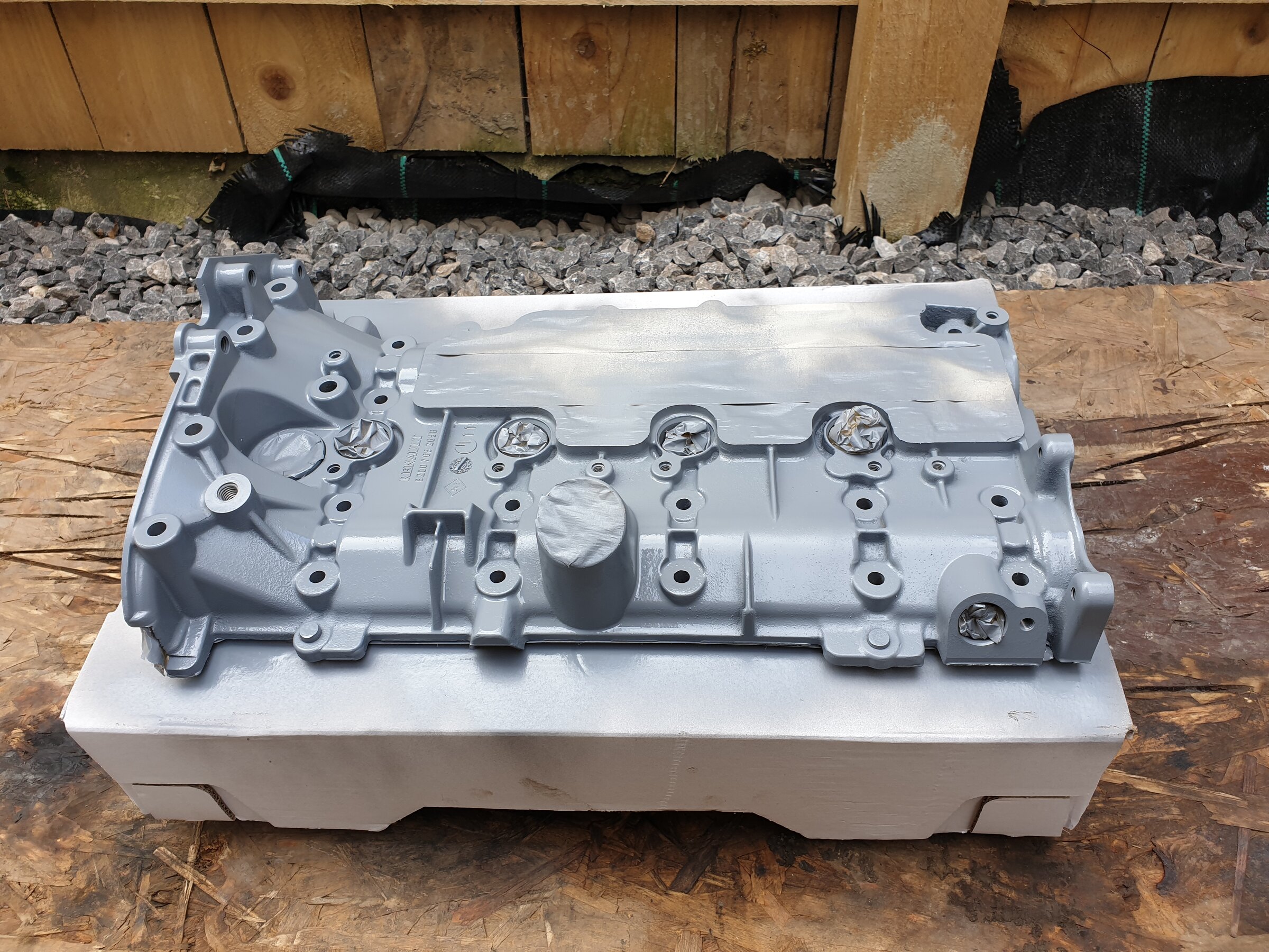

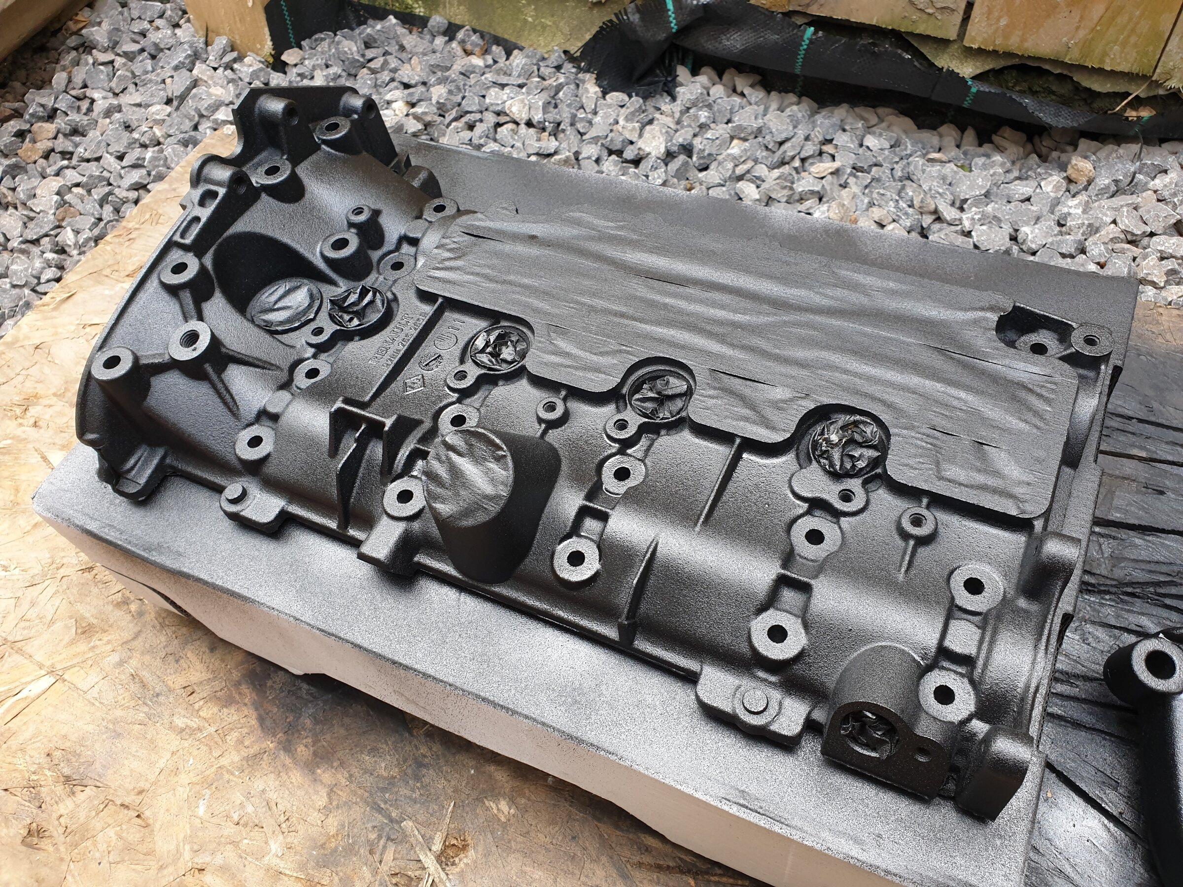

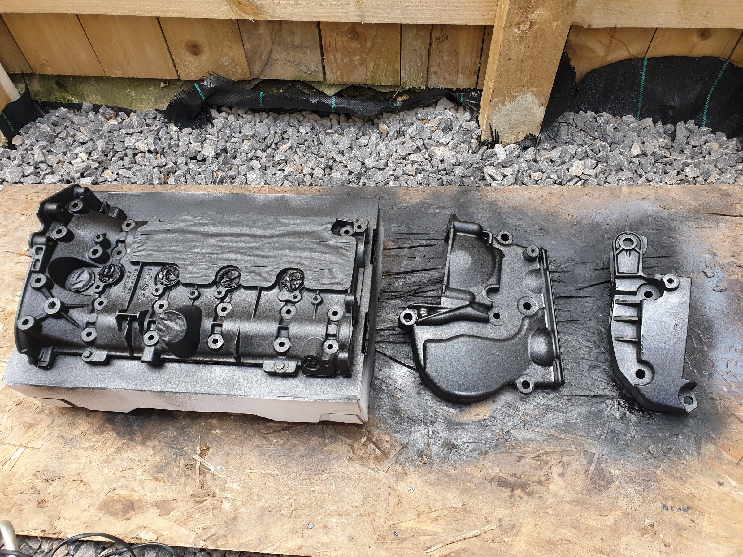

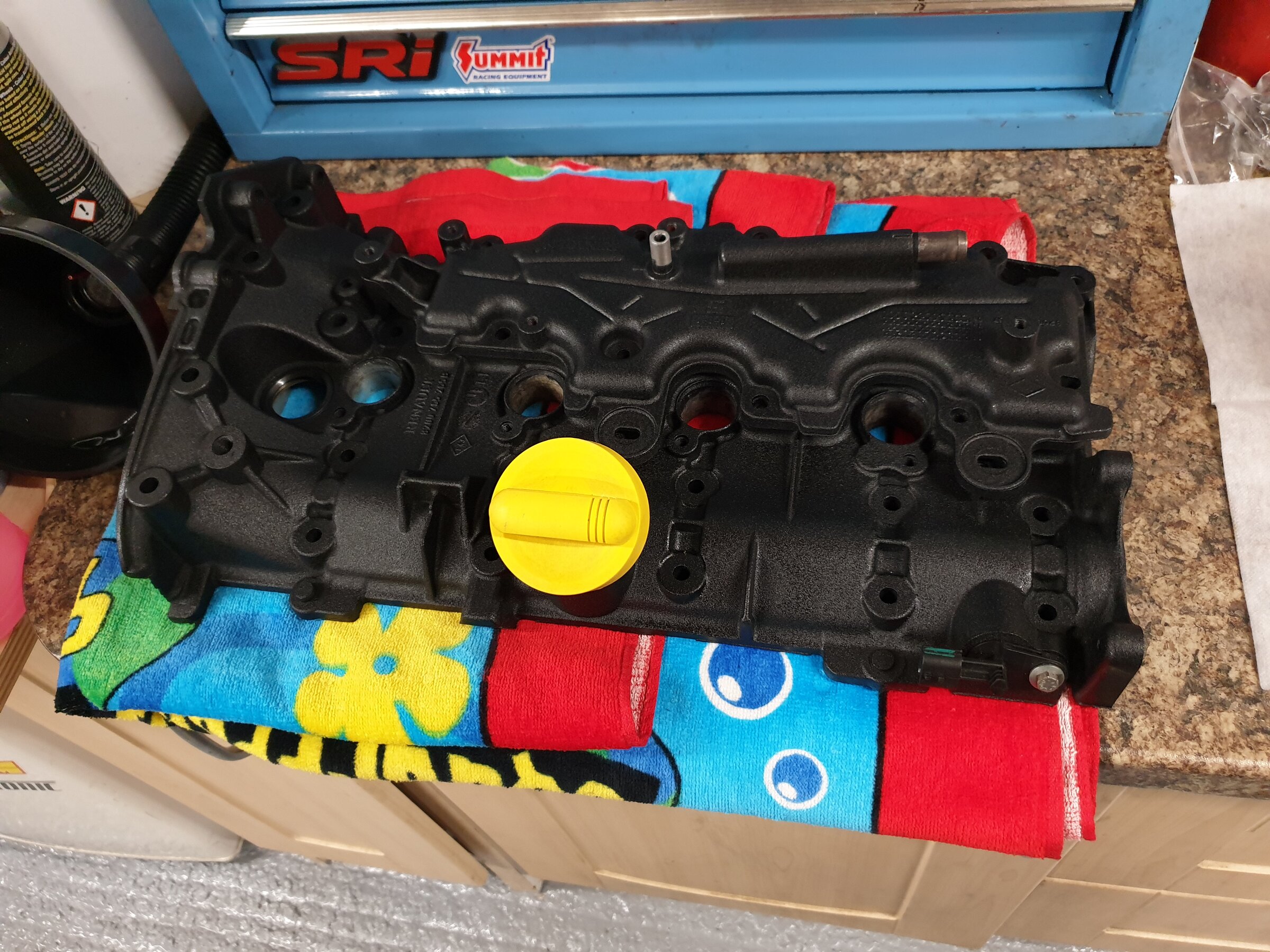

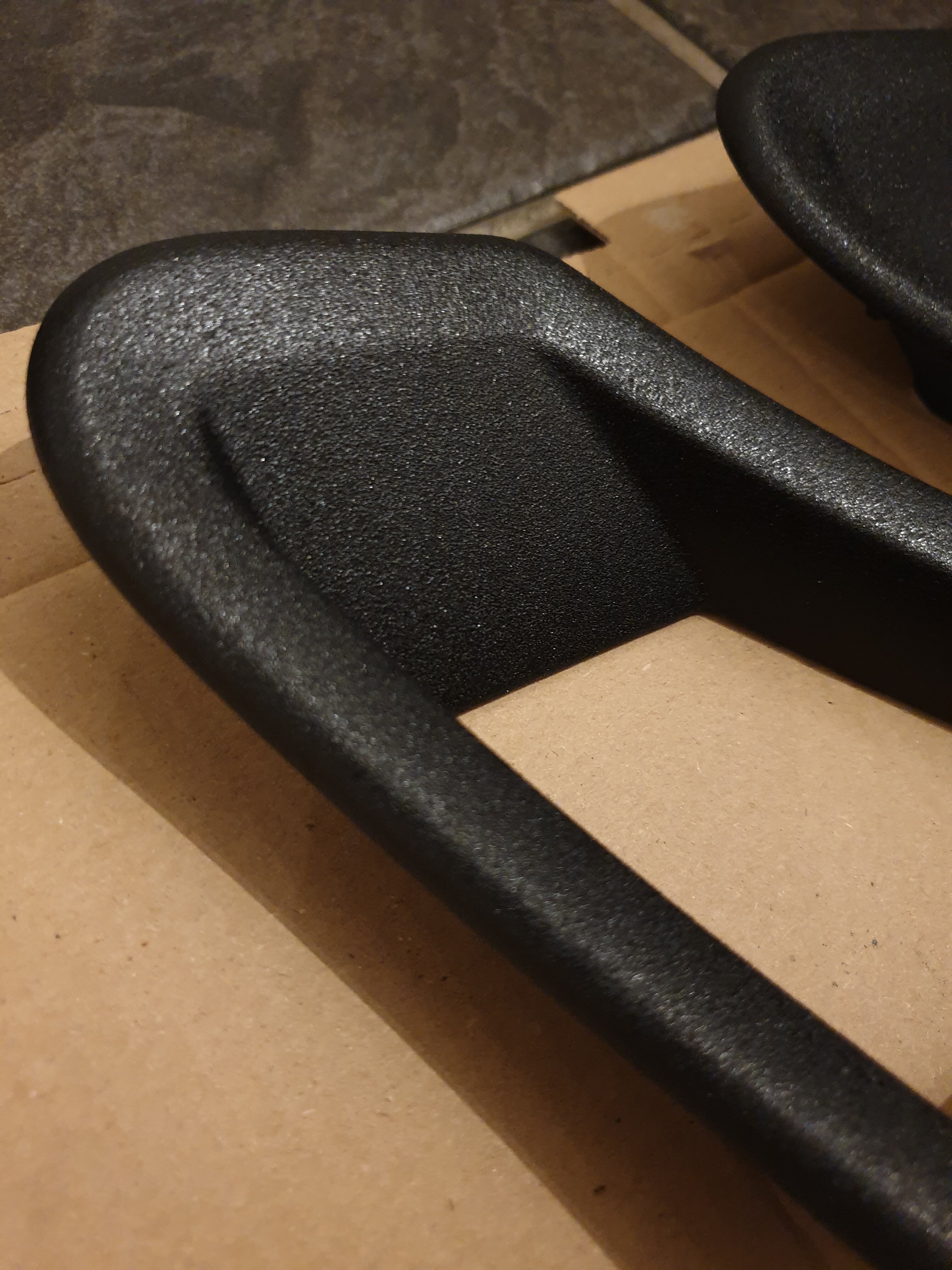

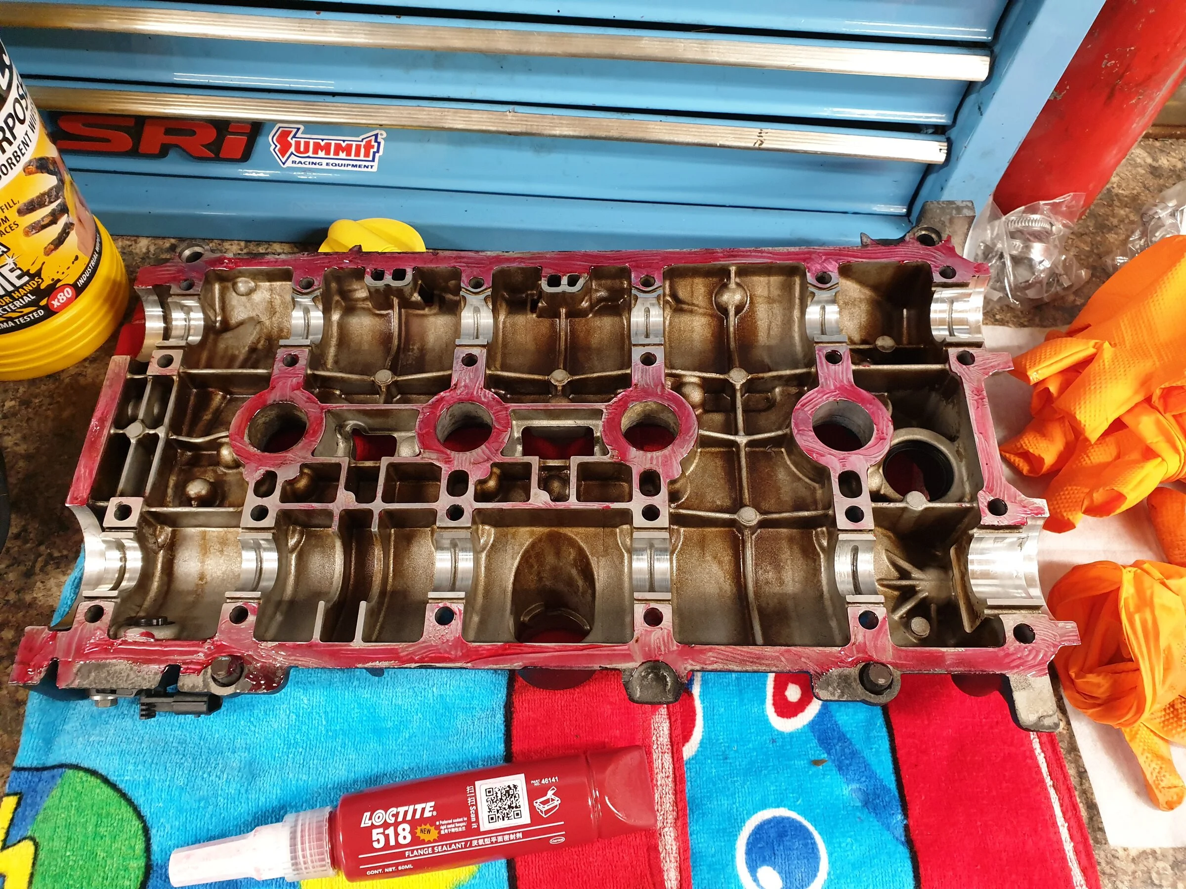

Started cleaning a few bits up on the engine. Cam cover, breather plate and a couple of other bits got a once over.
Etch primed
Bedliner paint ftw
Oil filler cap looks a bit bright might need to tone it down a little :LOL:
Planned to build engine up last week but was a lifter short. Start again in a couple of weeks.

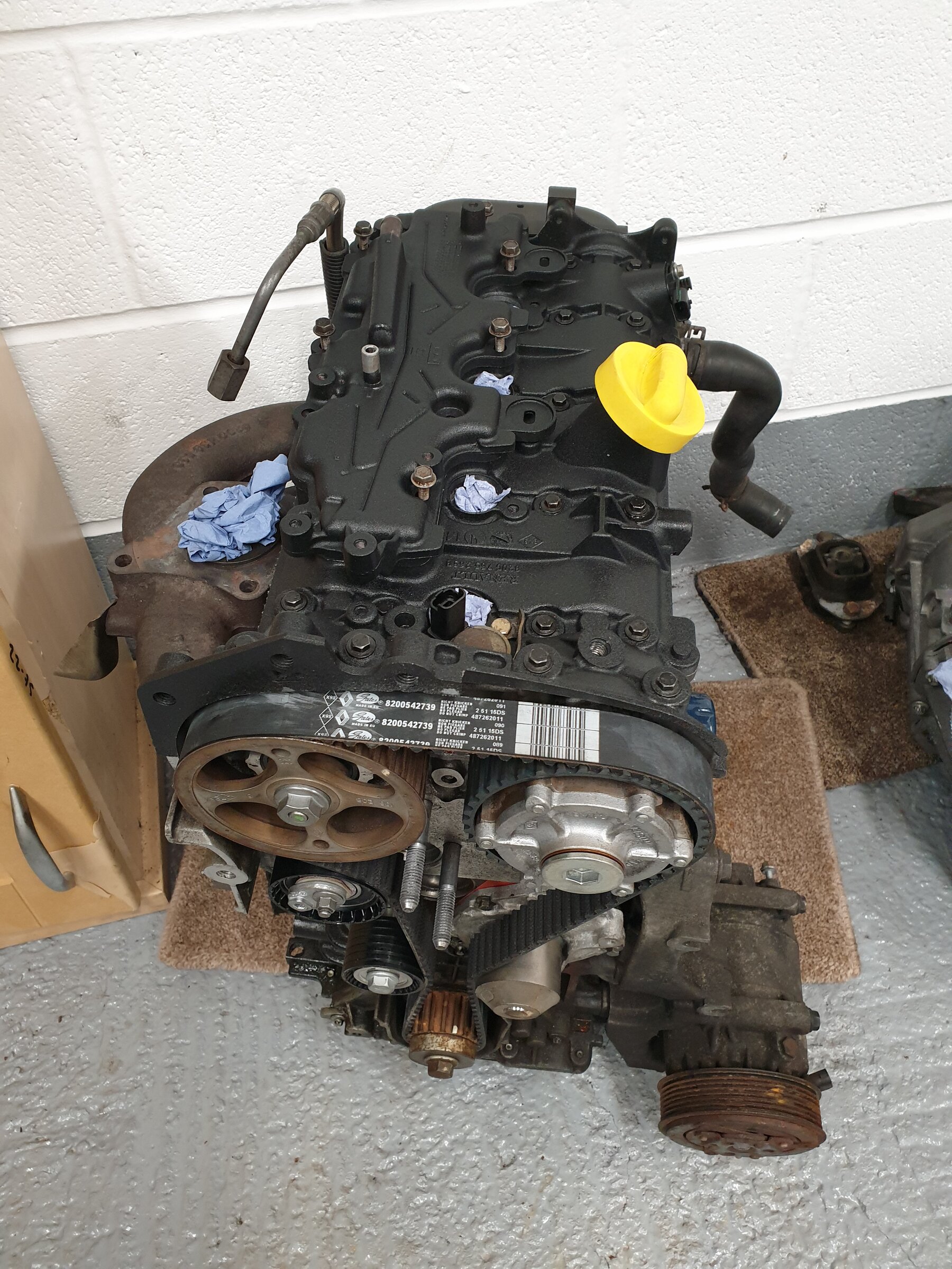

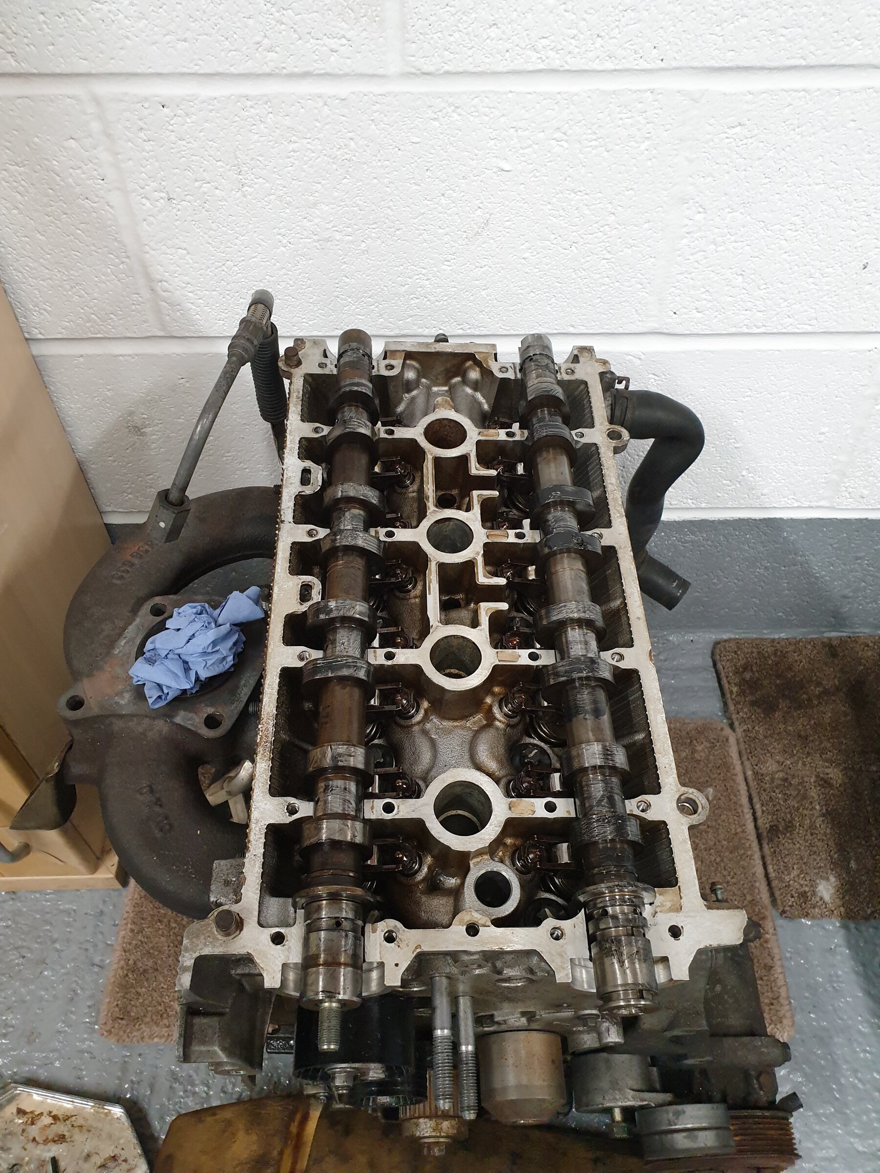

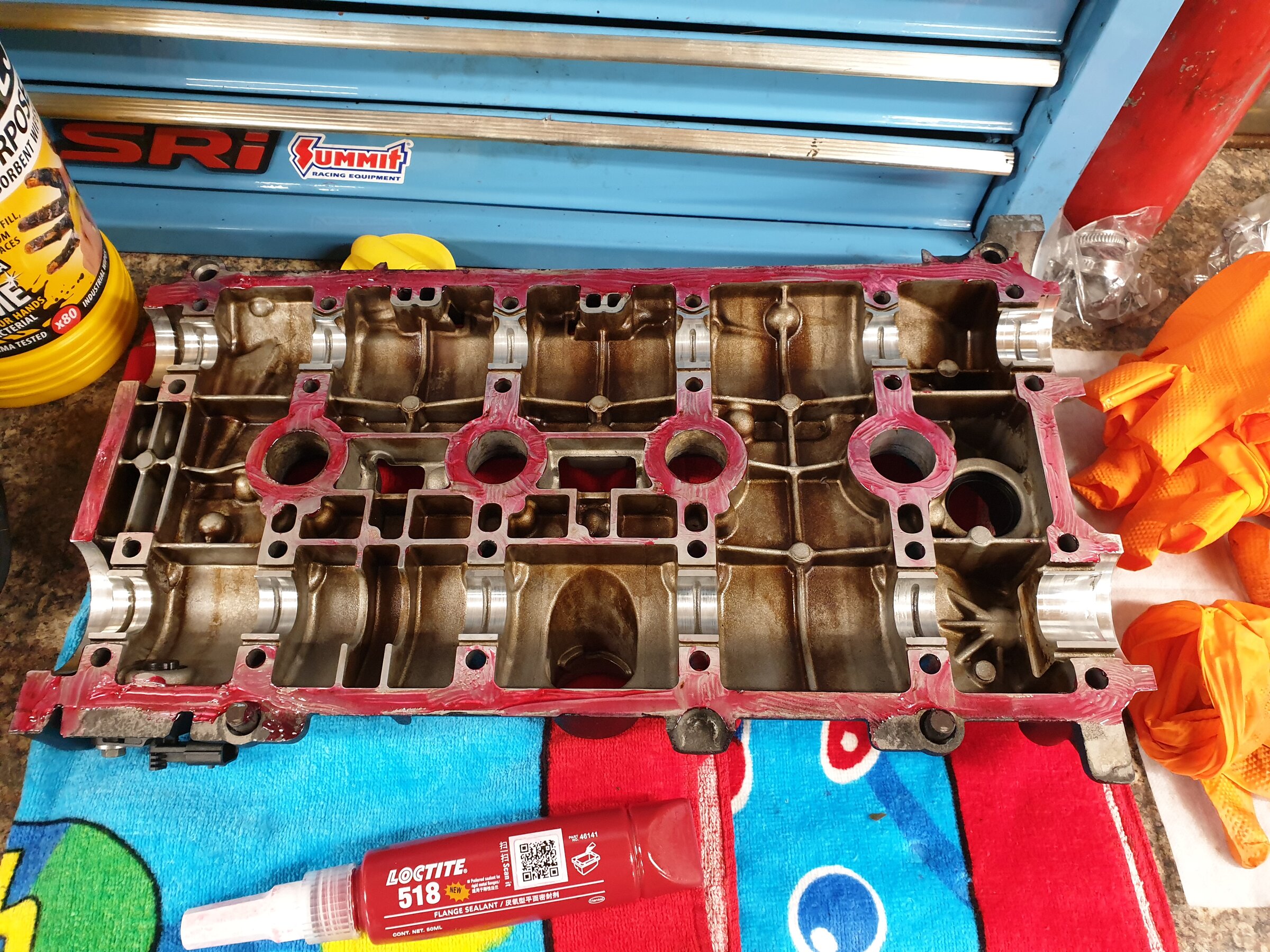

Late one on the engine tonight as the new tappets turned up.
Engine is a bitza, 250 head on R26 bottom end with wossner pistons and pec rods. Slipped a set of 172 cams in whilst cam cover was off, be rude not to ;)
Not using vvt at the moment but stuck a fresh 172 dephaser and vvt solenoid that i had in stock, to save messing about trying to delete the vvt.
Usual bollox, new belt kit, water pump etc.
Its pinned up at tdc & horseshoe in, not set cam timing yet as ran out of time and need to order a new crank pulley bolt, i could prob reuse this but as they are pennies ill bosh a new one on.

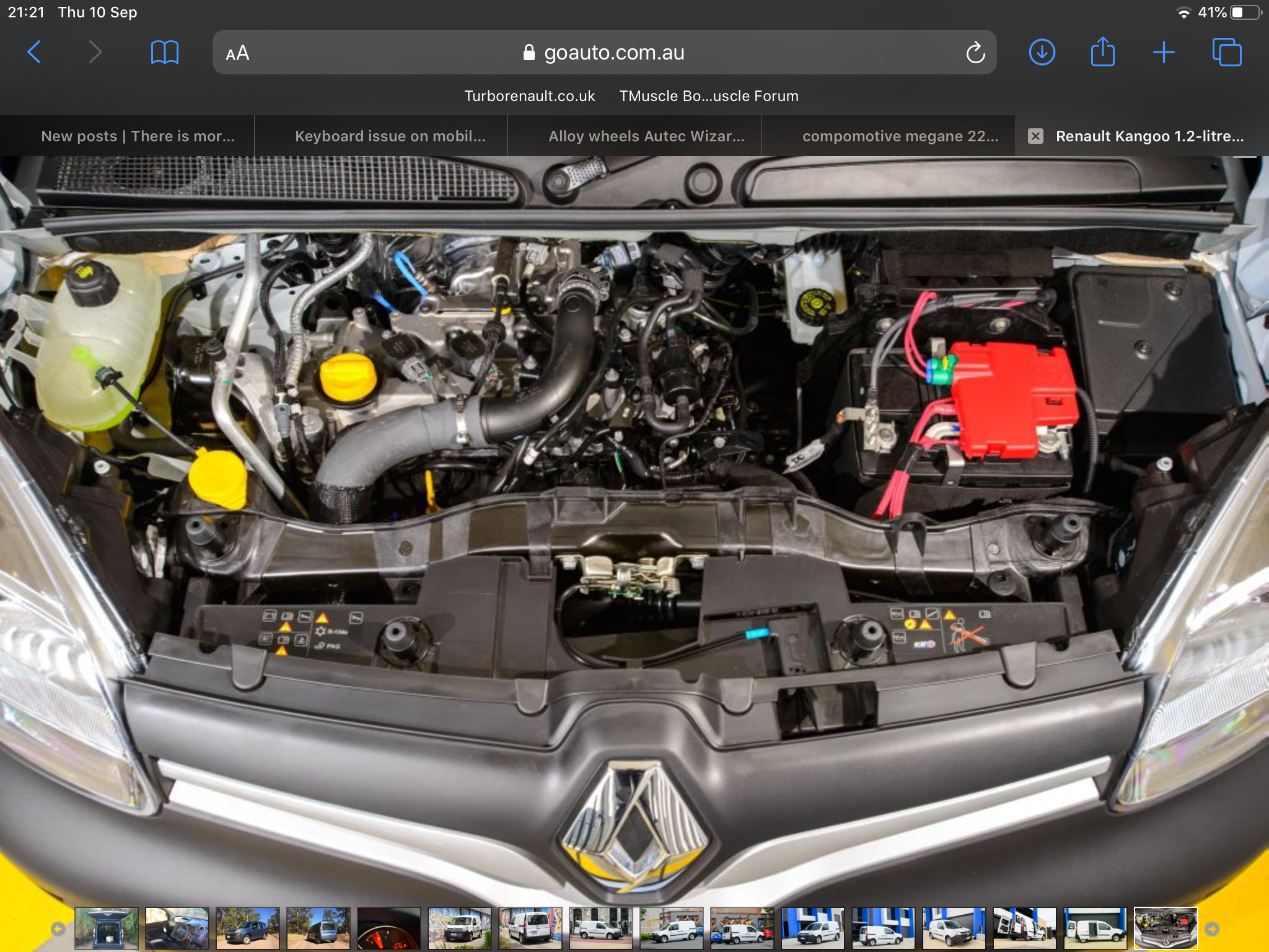

Seen some inspiration the other day too. Turns out that they done a 1.2 turbo model on the current Kangoo in Aus, not sure if it was a one off from Renault as a demonstrator as no real info out there about it. Looks alright though, i reckon the newer clio 220 edc might fit and meg rs280 lump, if you had deep pockets.
To be continued ;)
To be continued ;)
in Australia (and possibly other markets) they swapped the old 1.6 na for the 1.2 TCE 115, could get it with an EDC box too!

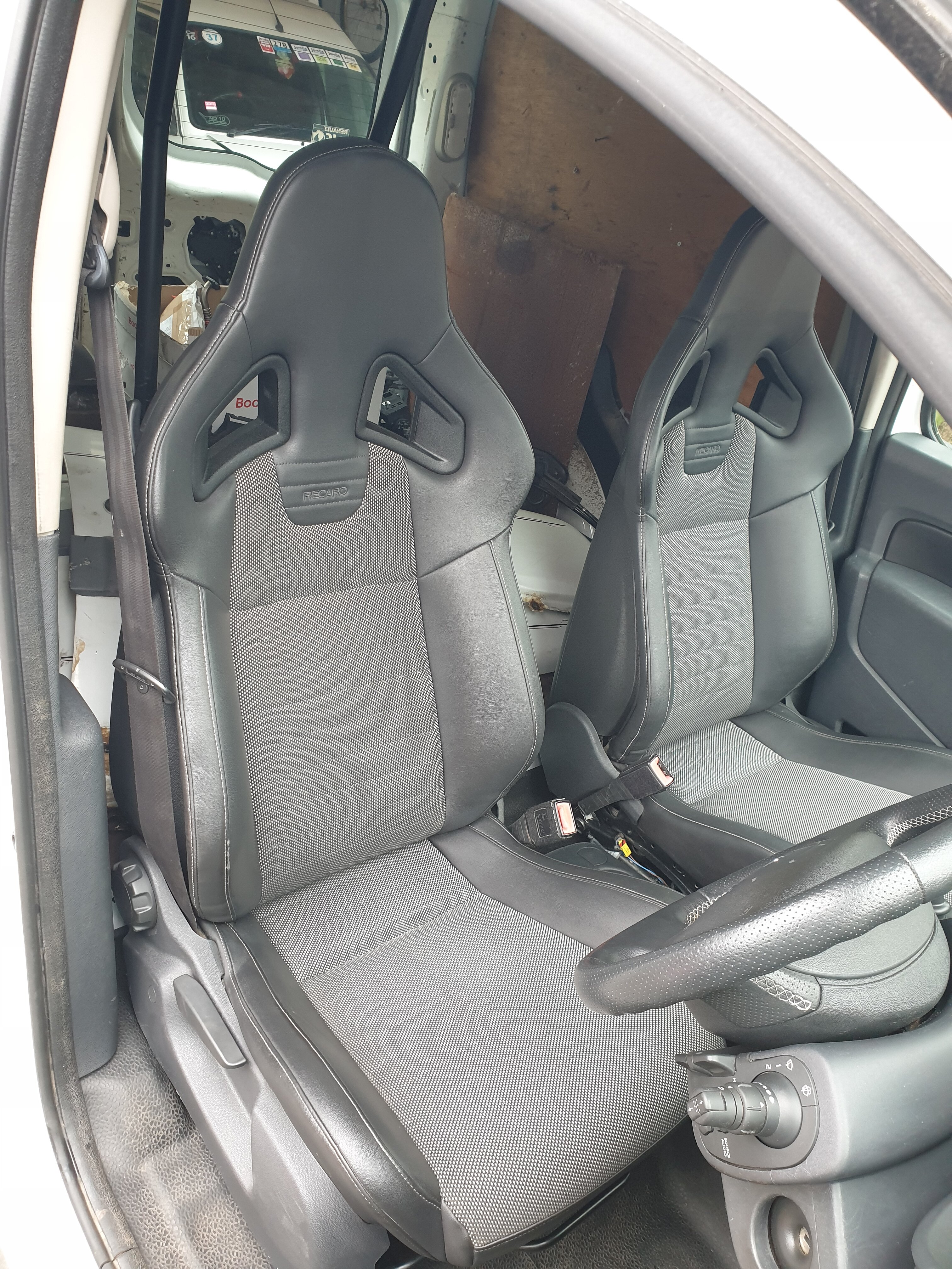

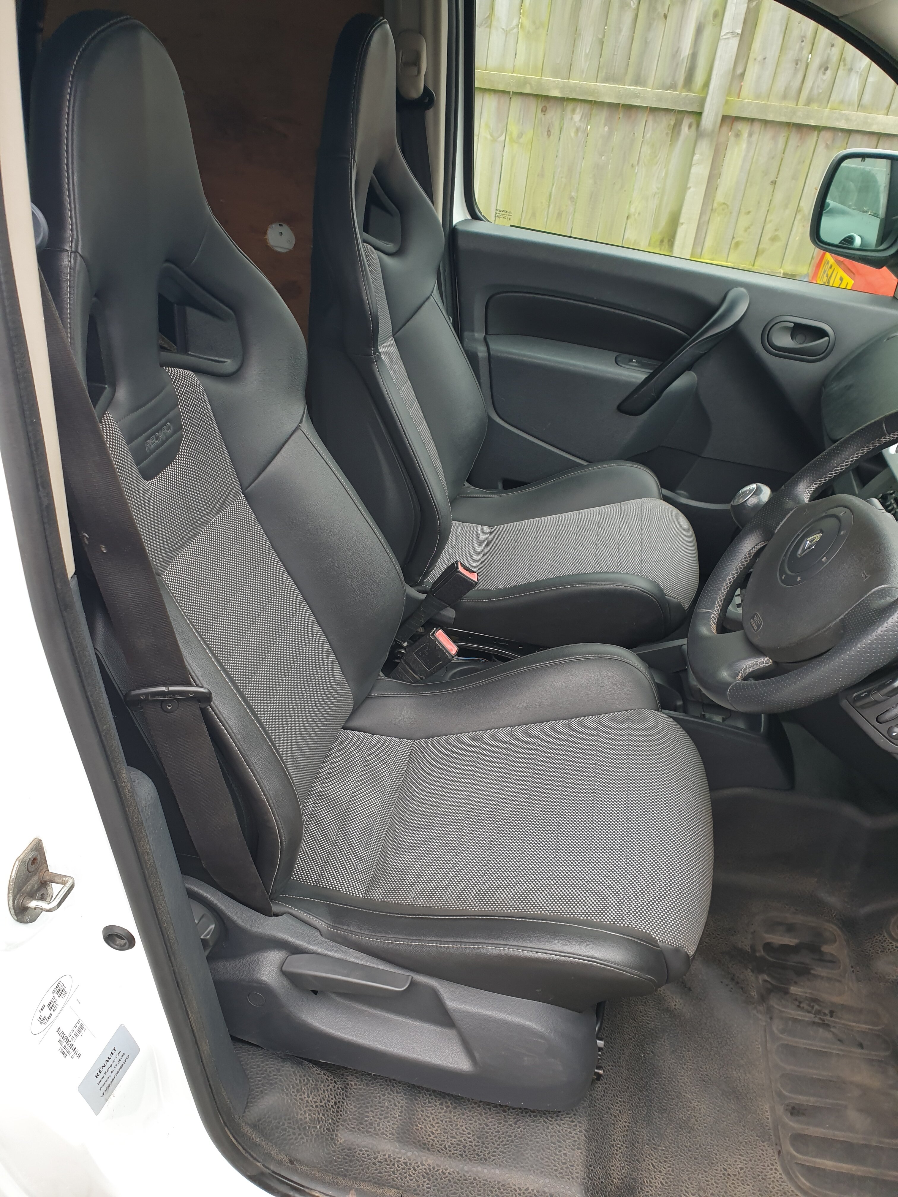

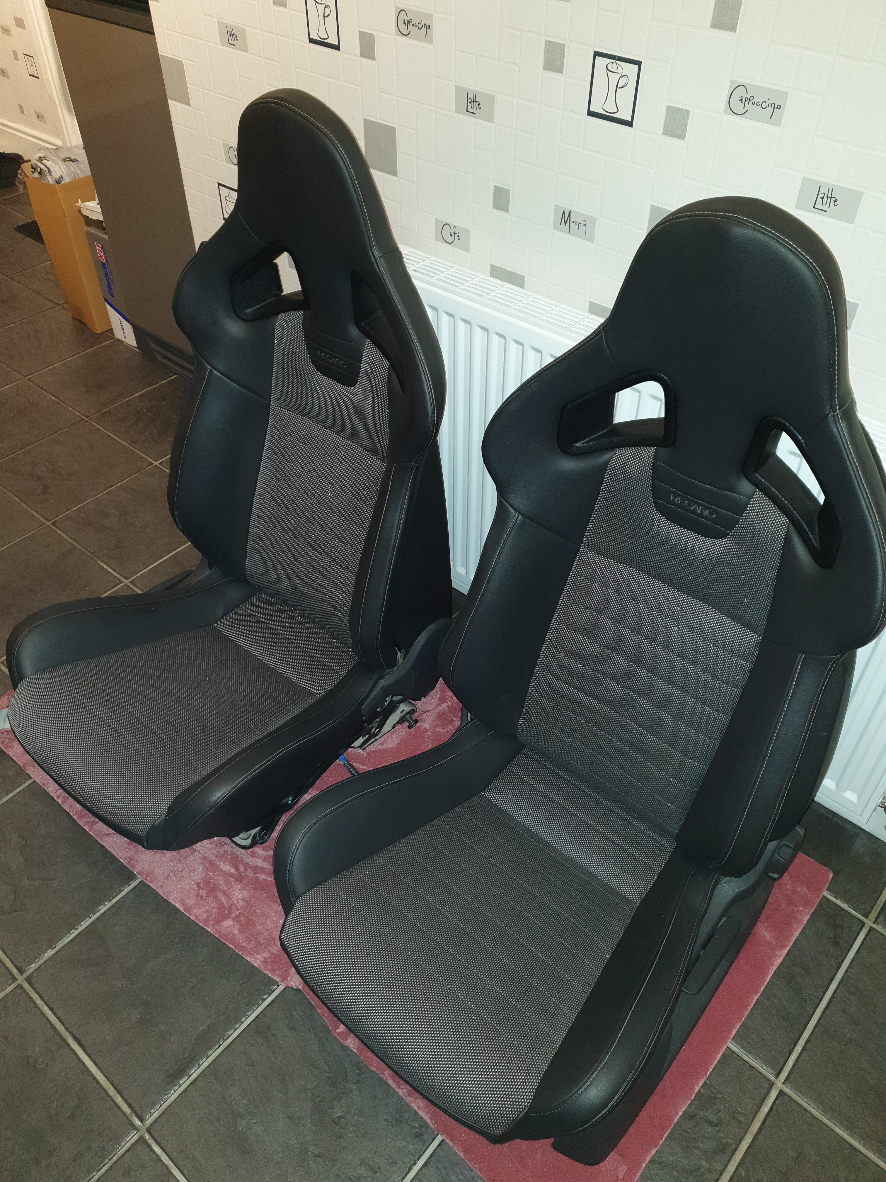

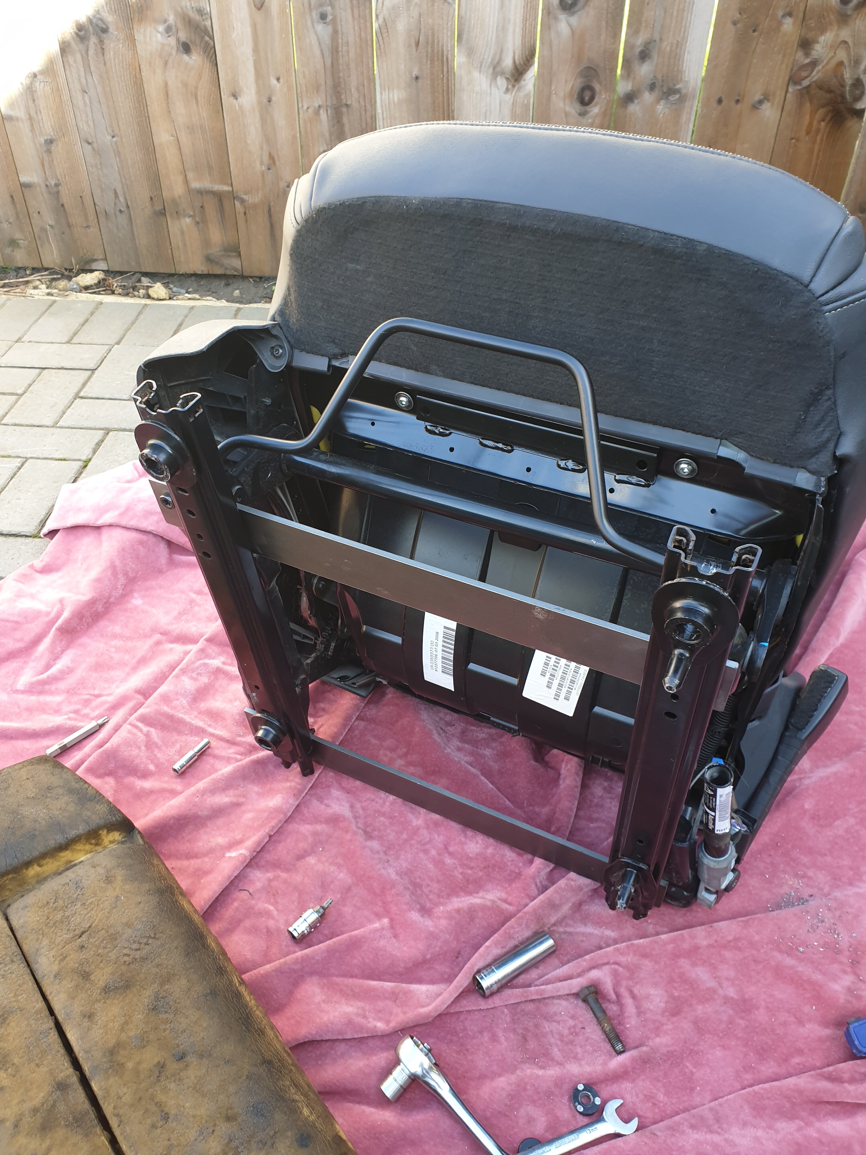

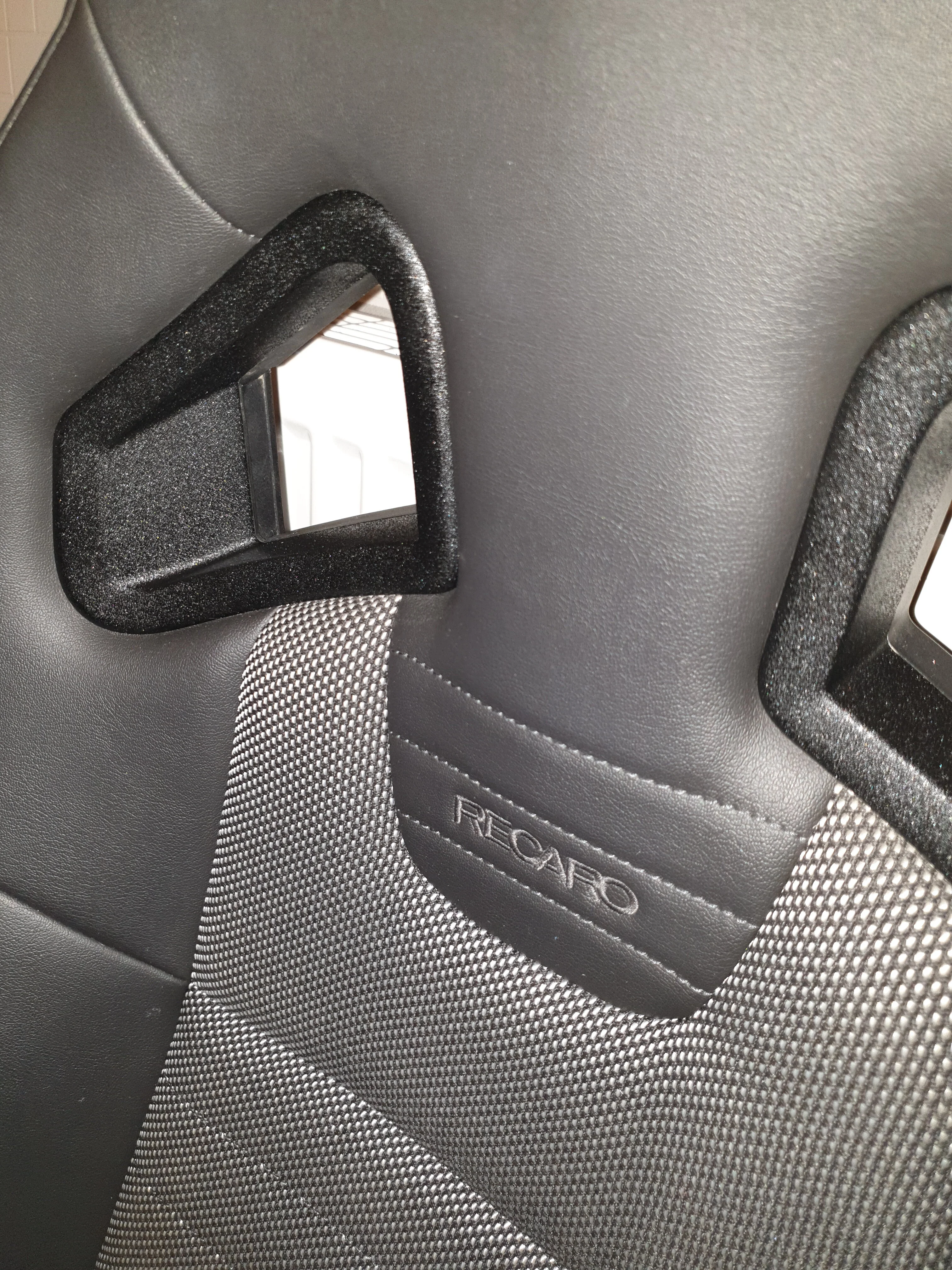

Bought a bargain pair of corsa d vxr recaro cs off ebay that needed some loving but priced very well. Give them a good wet vac and had to repaint the harness inserts as they were poorly painted arden blue.
Prepped and painted in my fav bedliner paint;)
Fitted
Sat in the kitchen for a few days drying out

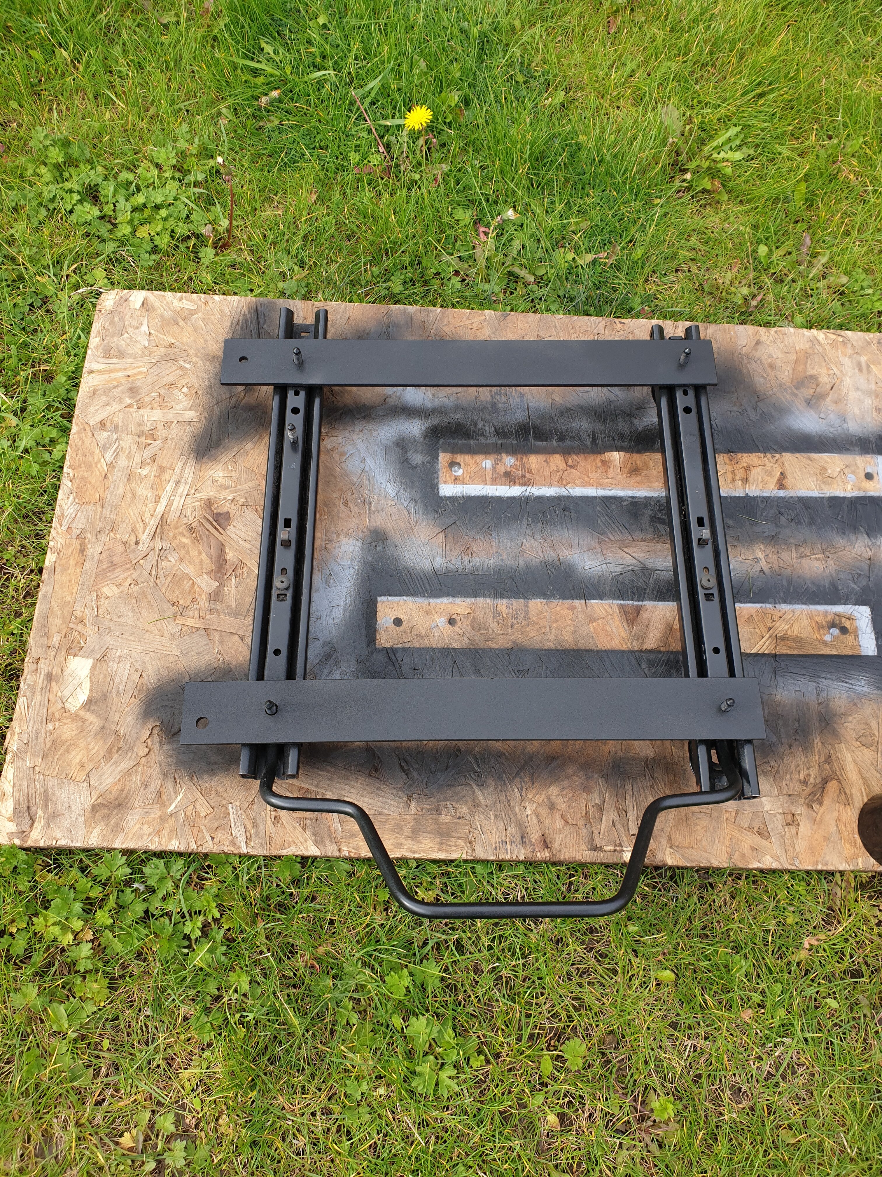

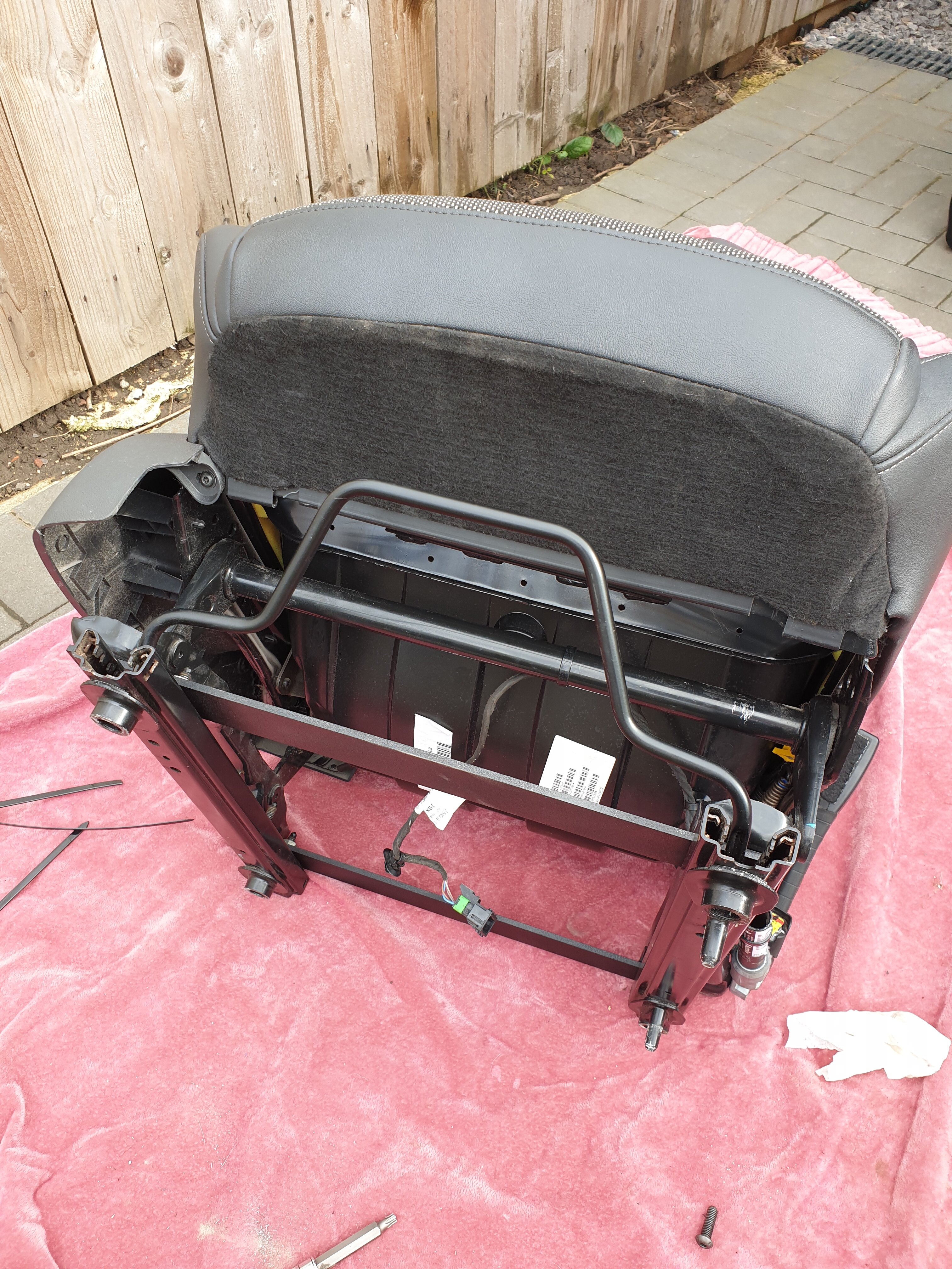

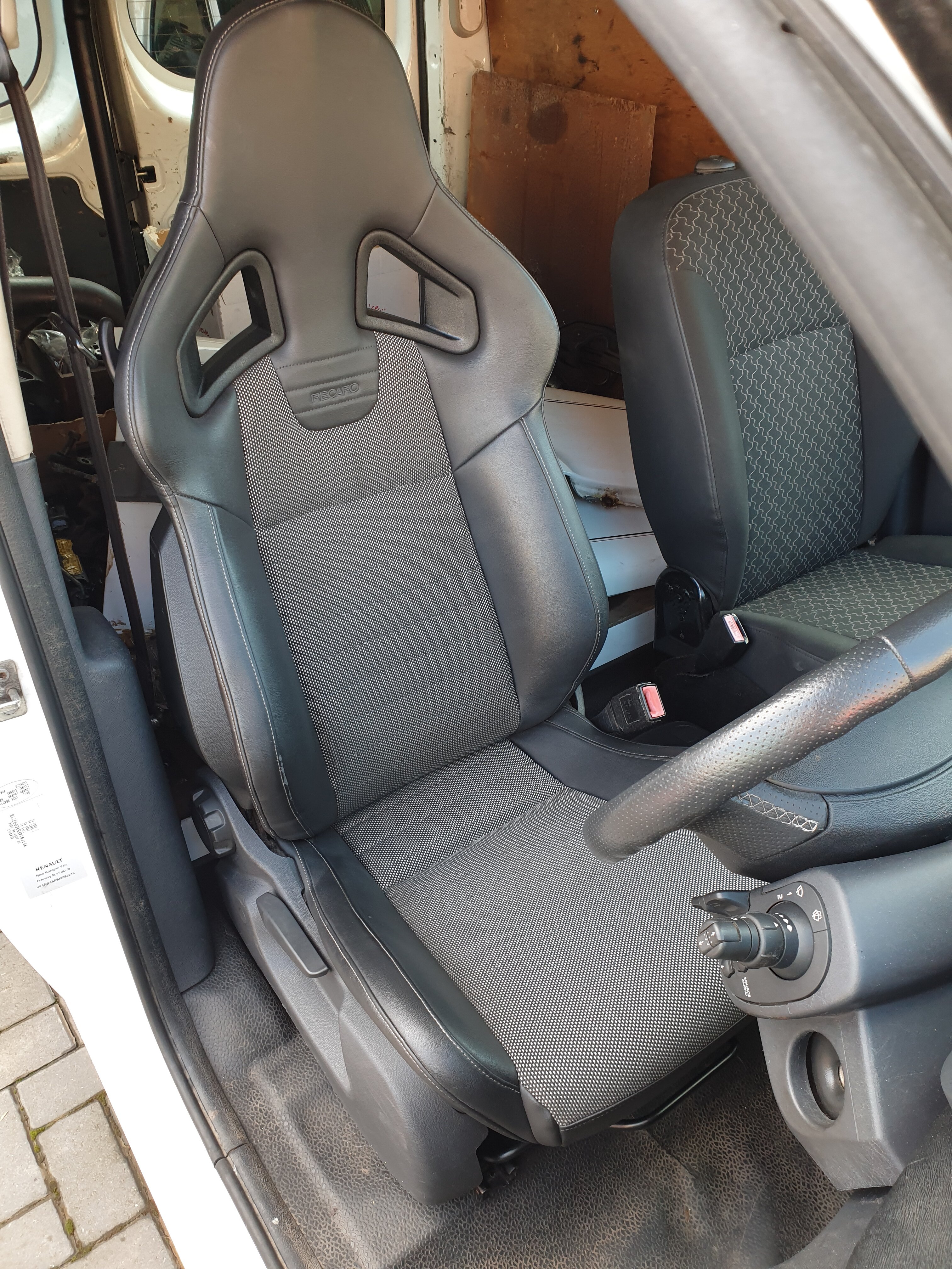

Reckoned up what would be needed to make them fit, the base is flat yet offset on the recaros with the corsa runners removed, and kangoo runners are flat as the seat unbolts off them. Took a few measurements then ordered a couple of mtrs of 50mm x 5mm flat bar to make a basic subframe to adapt the kangoo runners to fit.
Cut and drilled plate to suit, small mods done to kangoo runners and trial fitted.
Test fit to check seat placement and all good, height and forward/backward adjustment retained.
Removed, modified passenger side to suit, etch primed and a lick of bedliner paint.
kangoo pre tensioner wiring fits straight into the vxr pre tensioners so retained them, can always program them out with clip if they give any errors.
Fitted, Seatbelt bolts to original Kangoo seat, luckily the recaro base has a mounting point for seatbelt on the base so simple bolt on.
Seating position is great, with it right down on the height adjustment its a lot lower than stock. Really pleased with how they have turned out.
