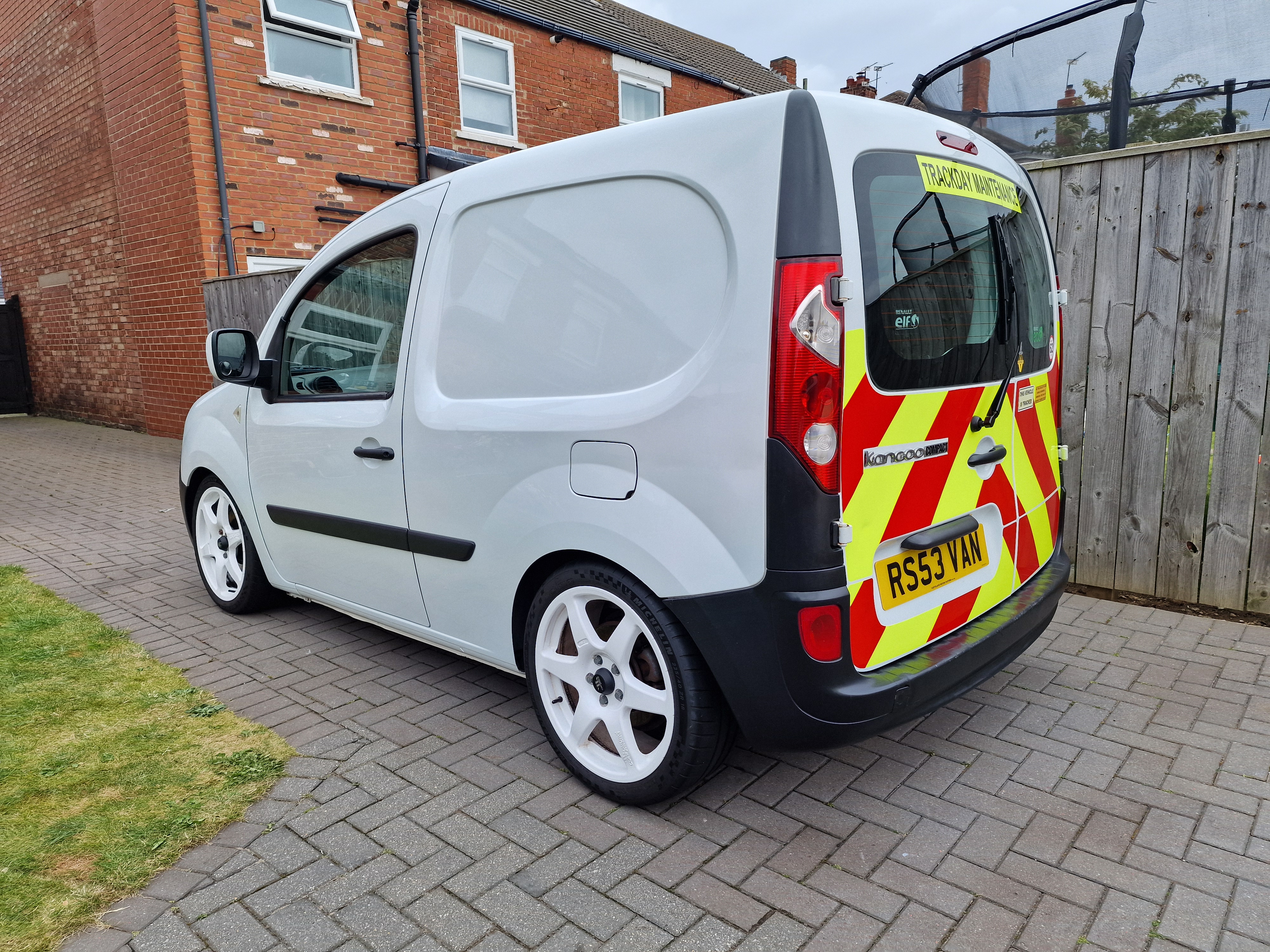

A few months ago in my old job i had a 68reg Kangoo, got it with delivery mileage brand new. Noted pretty crap in diesel form, and handling average however i had heard that the underpinnings were very similar to meg/mk3 clio, and confirmed when having a look underneath briefly.

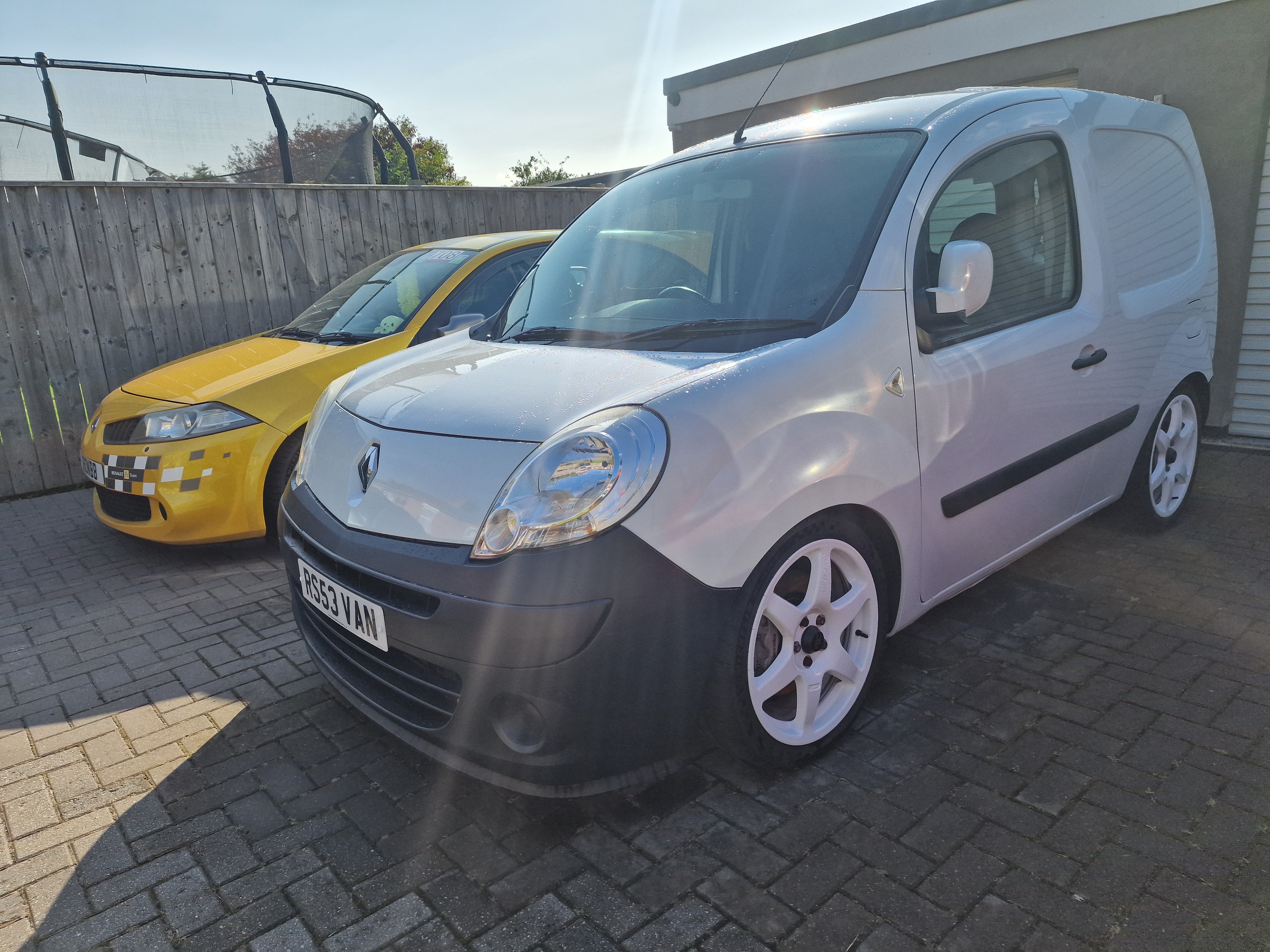

Said van
Returned when i left the job, good riddance to tracker and 62mph speed limiter. Thought to myself that it would probably be sound, with more power and better handling.

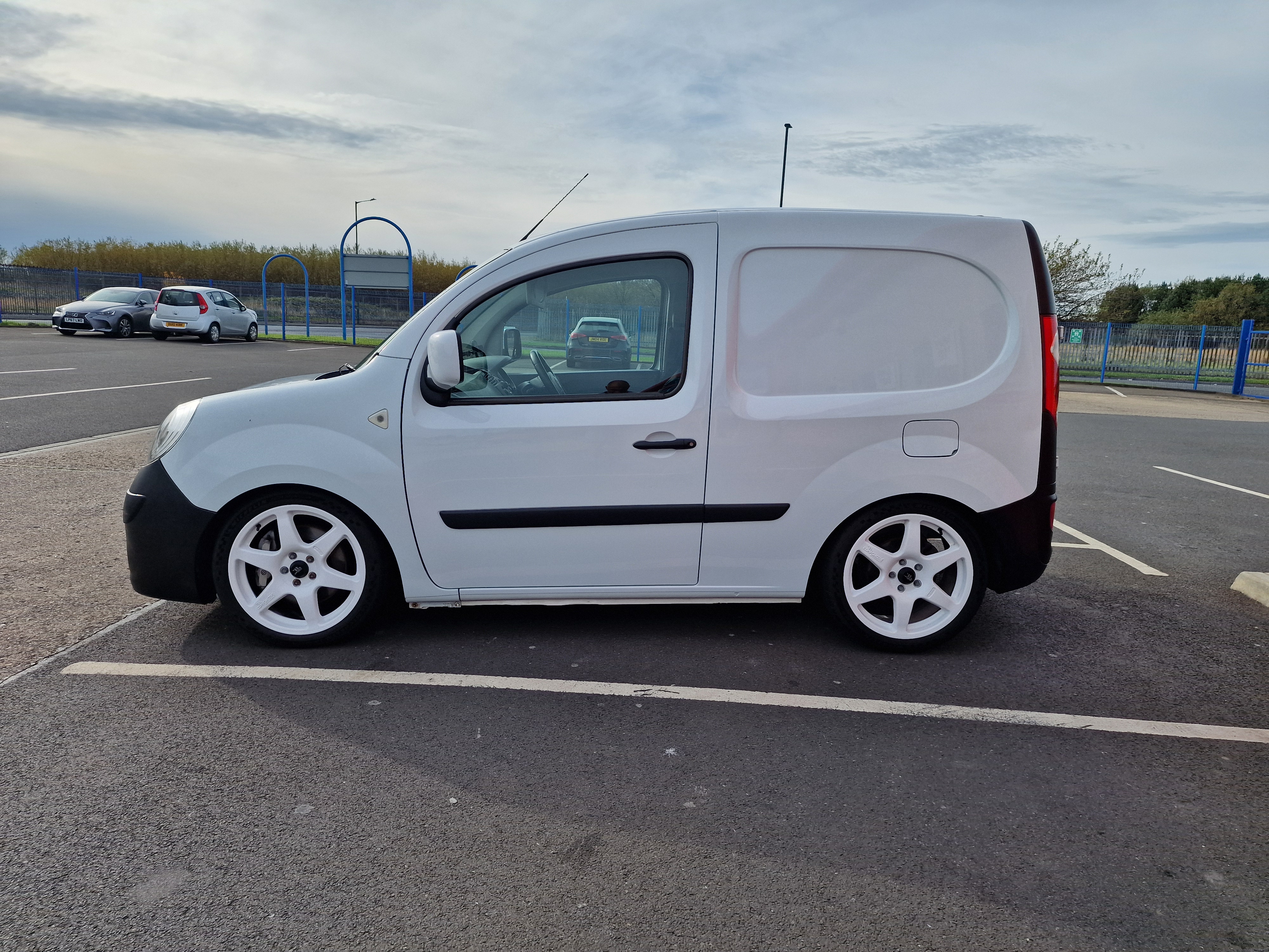

At the time i still had my old Kangoo 172 (Racevan2), which was leagues ahead. Lacked a bit of straight line speed, and deep down im a turbo man missed the turbo torque so sold which stuck some money back in the pot.

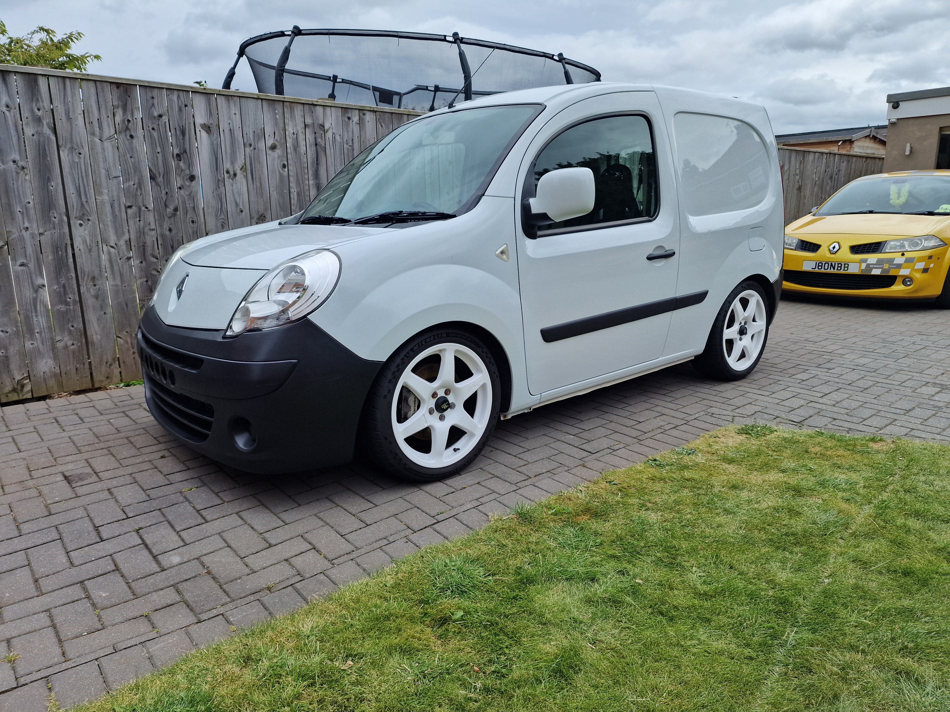

Collected on the back of my mates truck this week

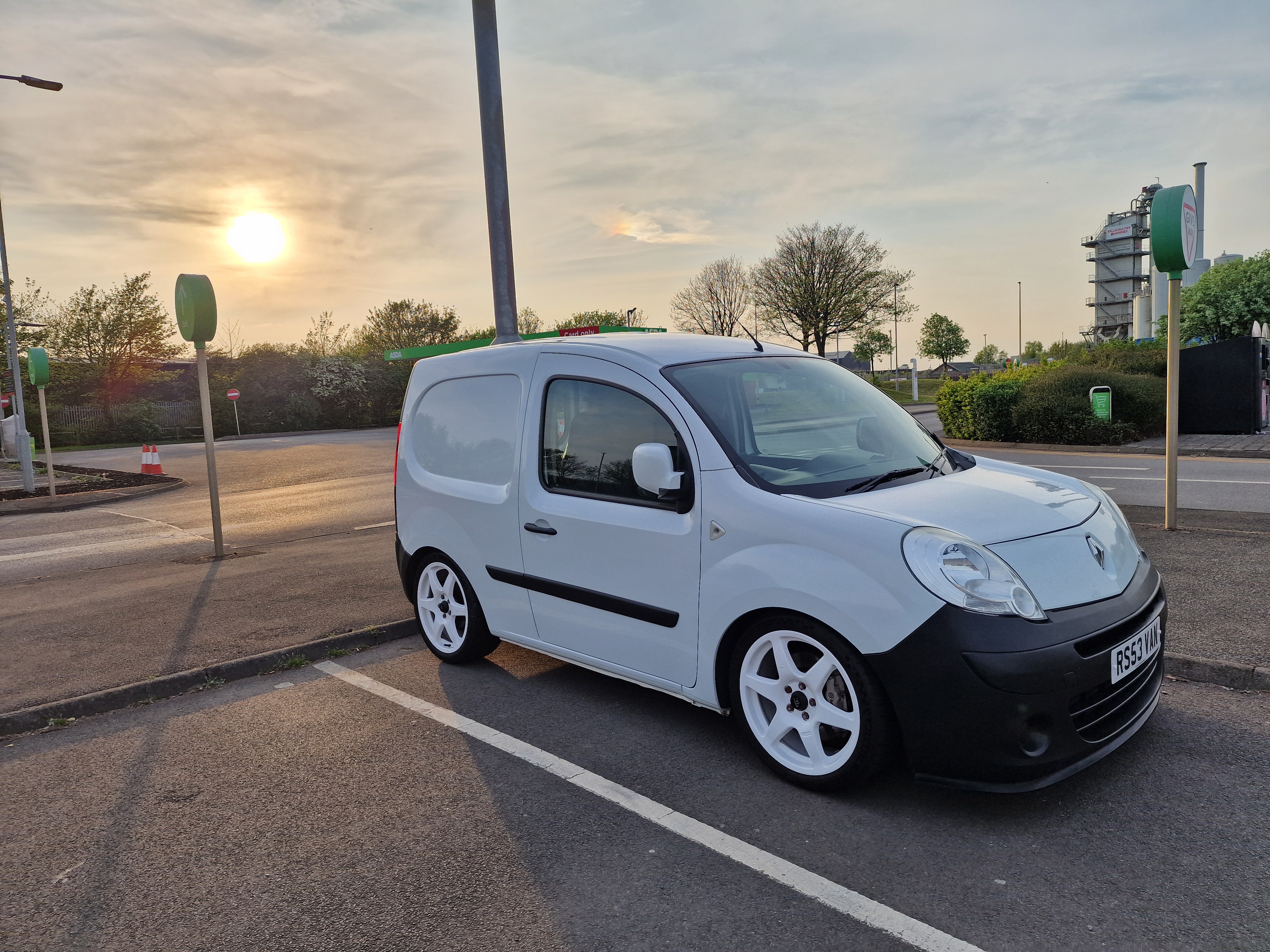

Short arse

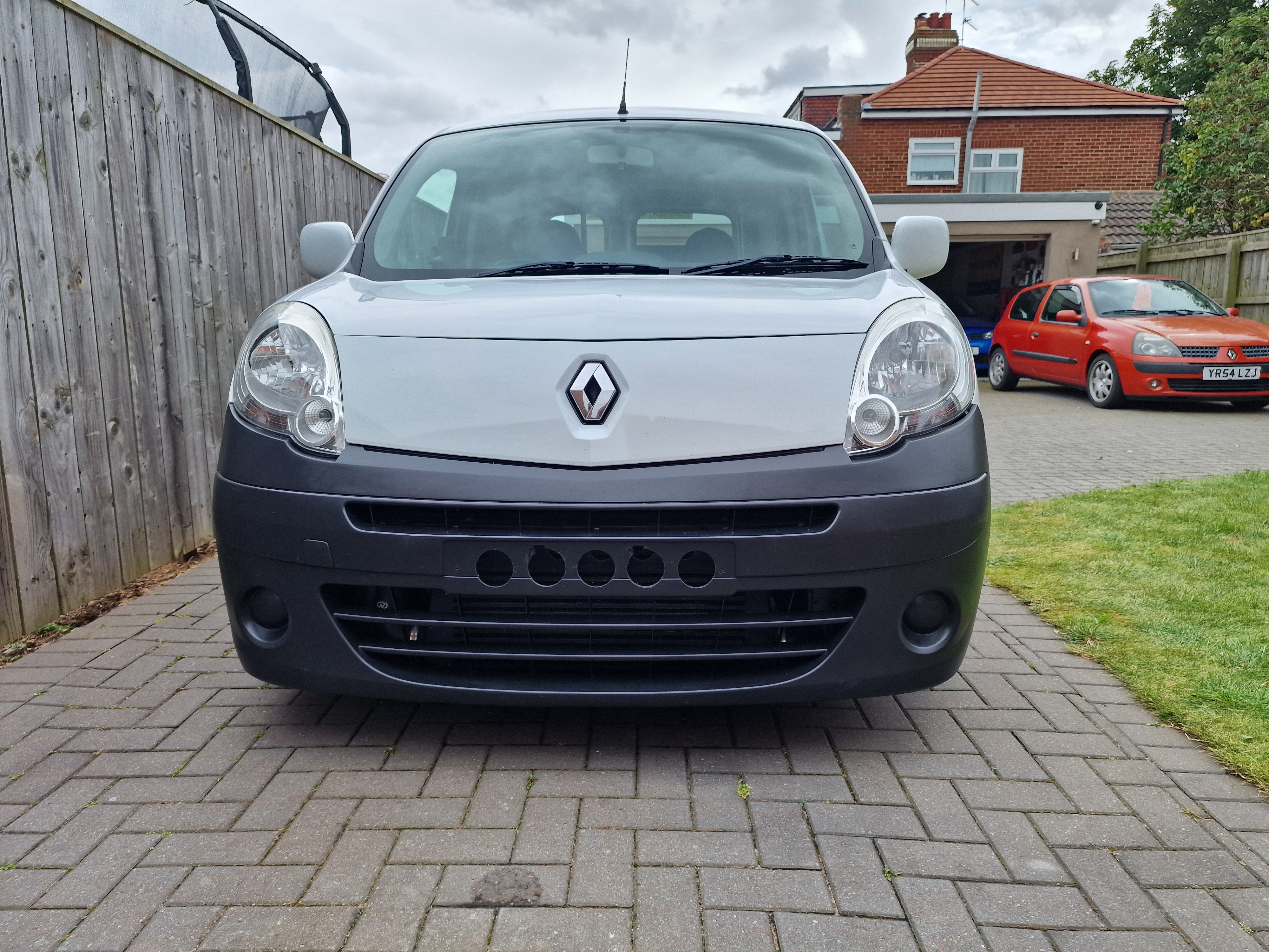

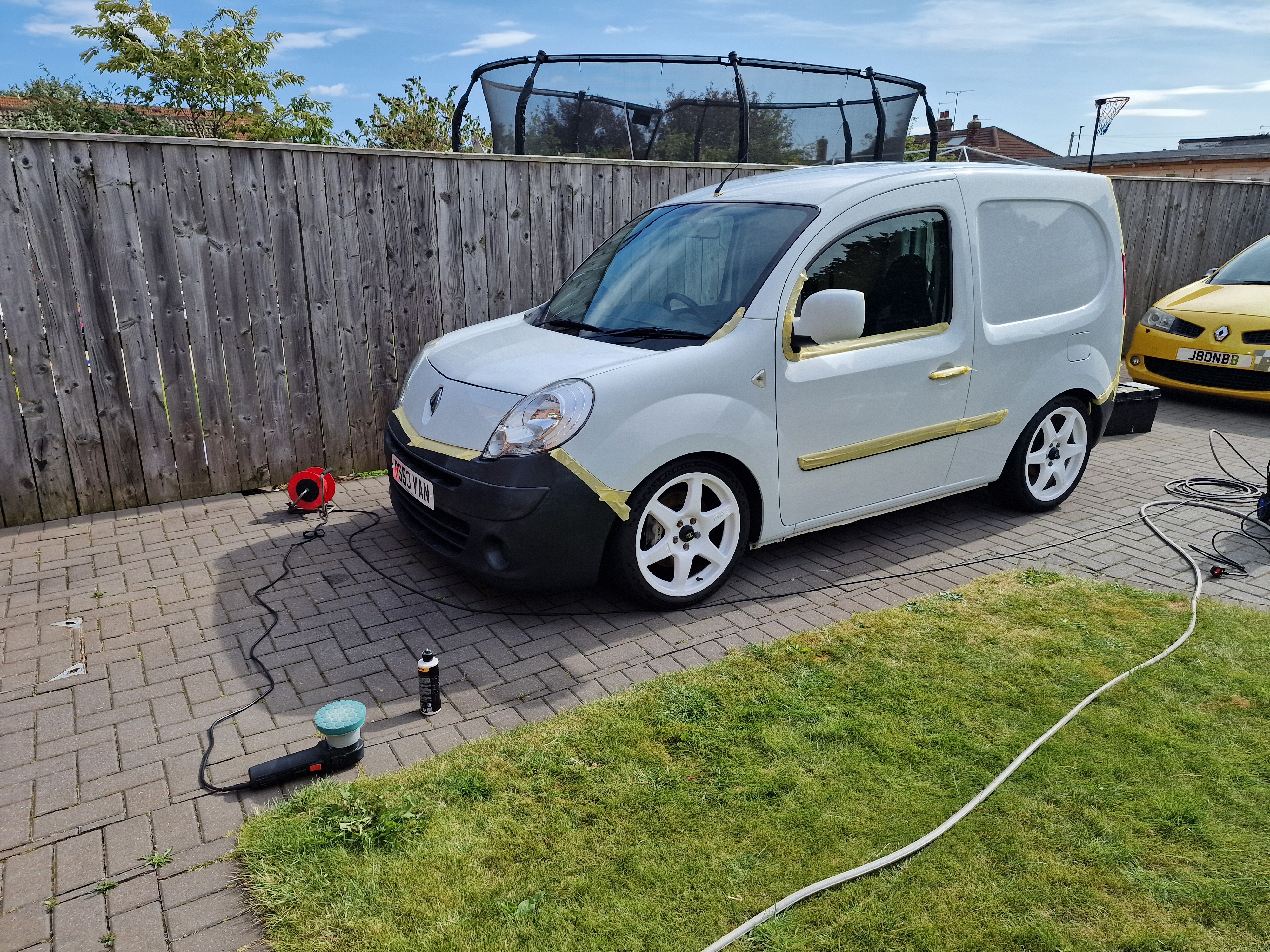

Cleaned up and roof rack removed and pushed into position.

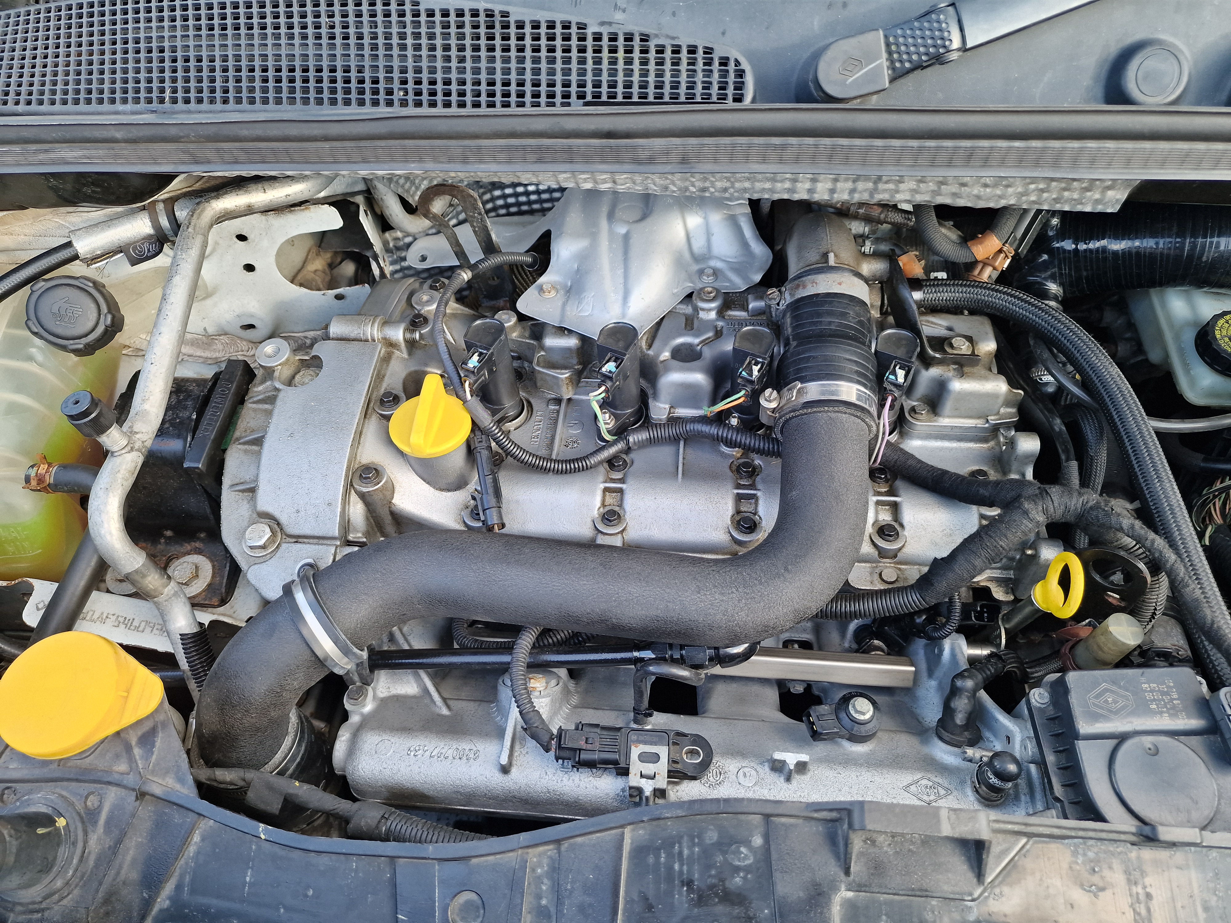

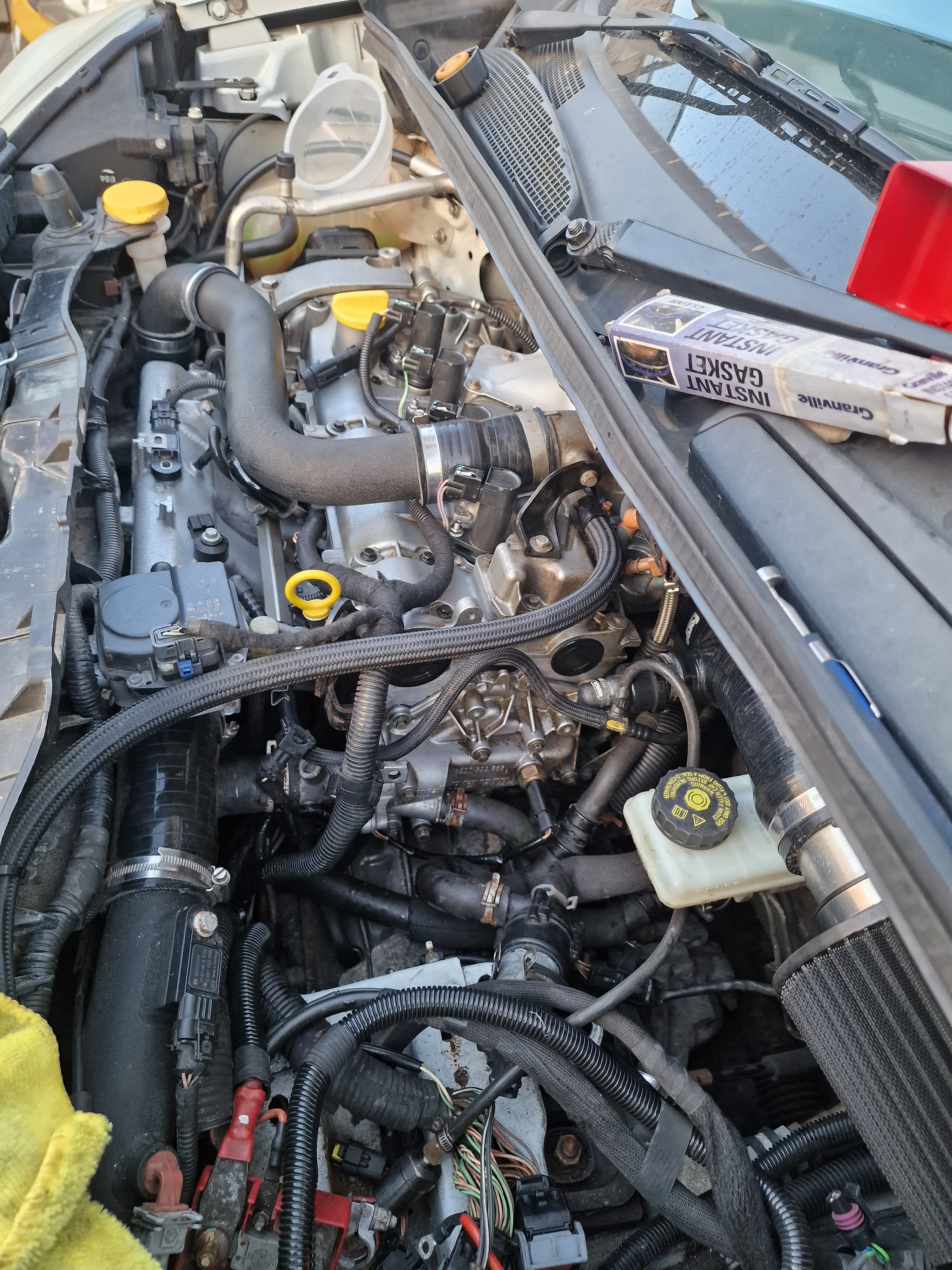

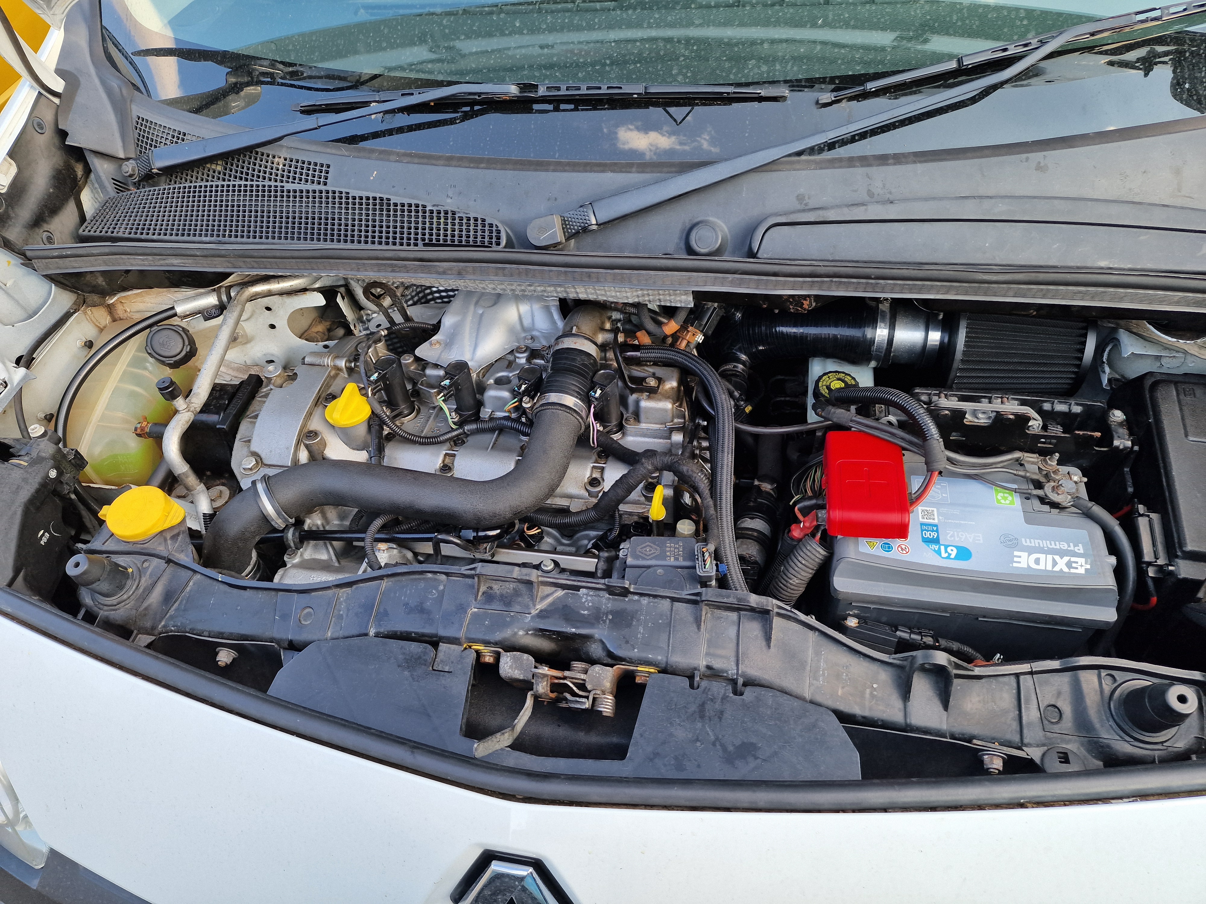

Current engine bay half a dci lump with melted pistons on cyl 1 & 4 :LOL:

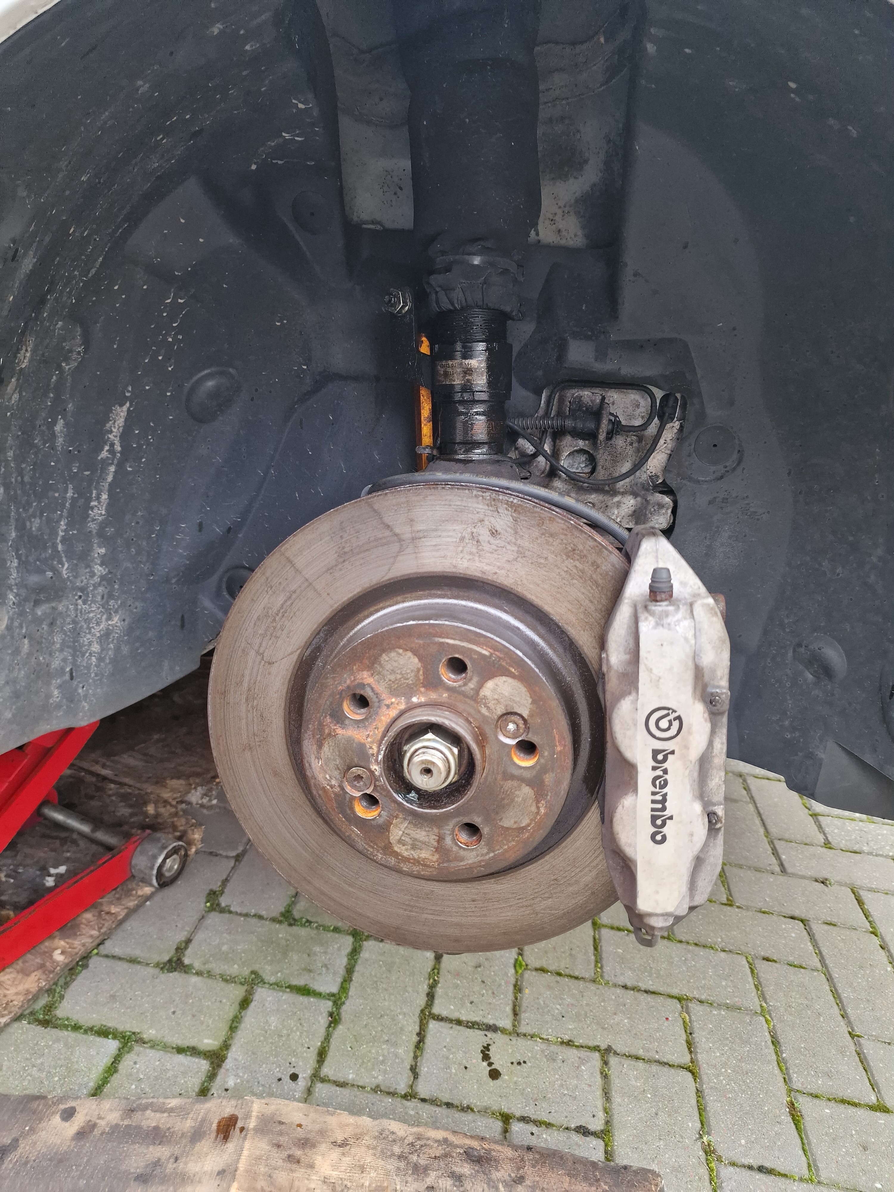

Had a good look round and the subframe looks pretty identical to meg2 or clio3. Meg rs track control arms, hubs and brembos bolt on as one as already been done, so handling should be great. Mounts look identical to megane, so in theory a meg lump and ndo box should go in (pk box fits).
Wiring may or may not be tricky, however i have been thinking about this, and there is a few options, if all else fails standalone ecu and stack dash.
