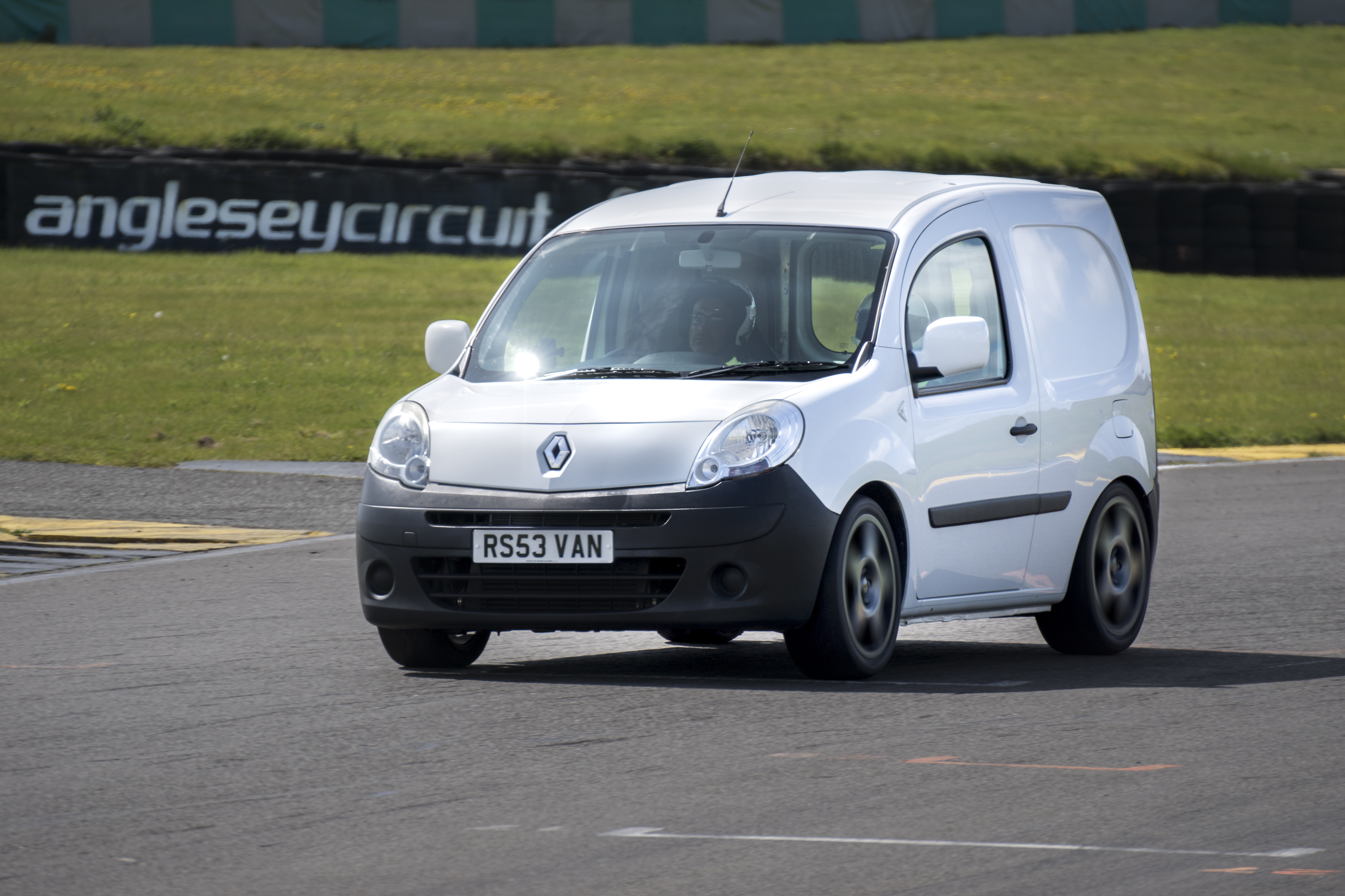

Kangoo Compact (aka Racevan3)
Brigsy
  T.Turbo
Love it, proper mental little micro machine. Really hope it's at CSF (y)
For such a small chassis, how do you find it handles with that much power?
Cheers mate. It seems to just be like a meglio with a frock, wheelbase is 200mm shorter and 170mm shorter than 182.
Lsd pulls it about a little on camber on the roads which keeps you on your toes. It struggles with traction at higher torque levels compared to megane rs even though weight is similar. Overall, not bad have driven more lairy fwd. Feels pretty quick.

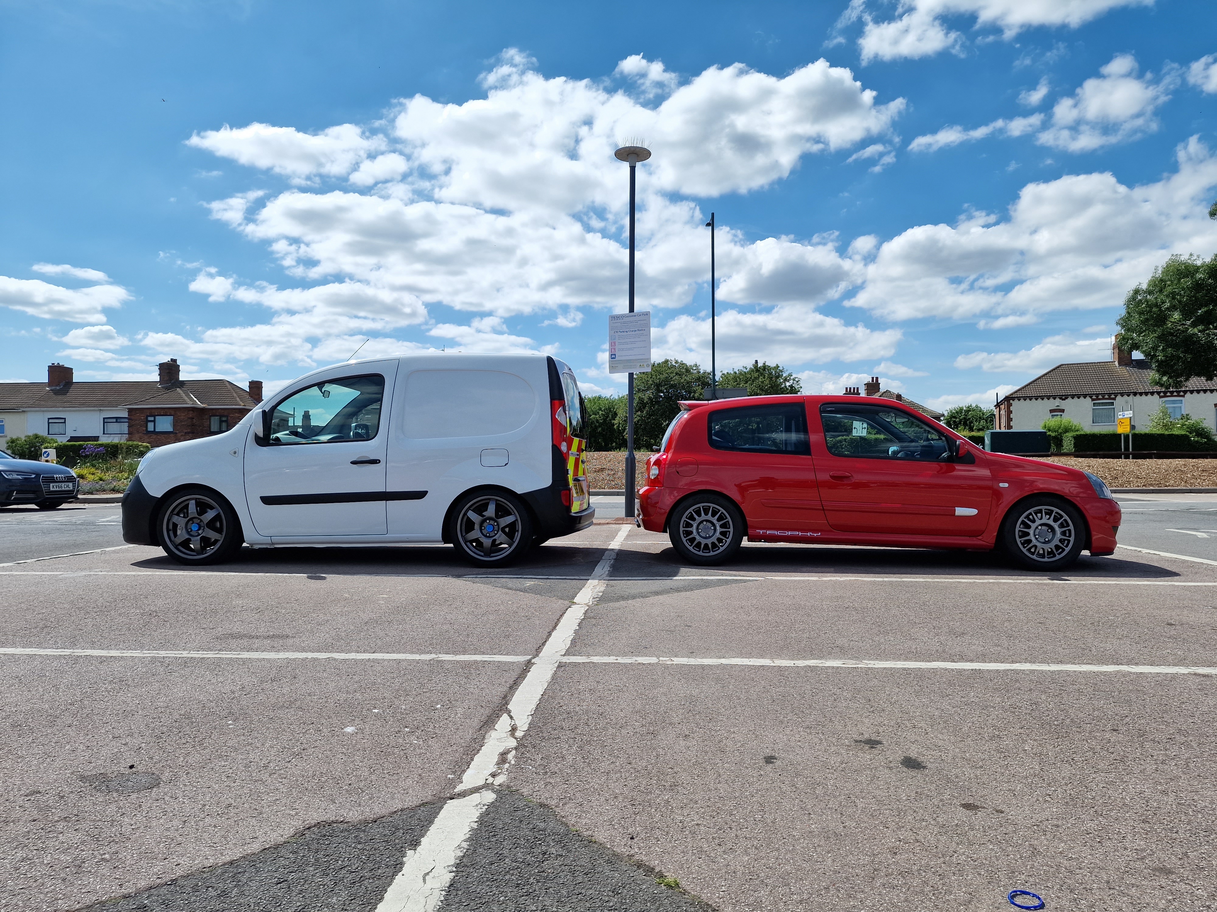

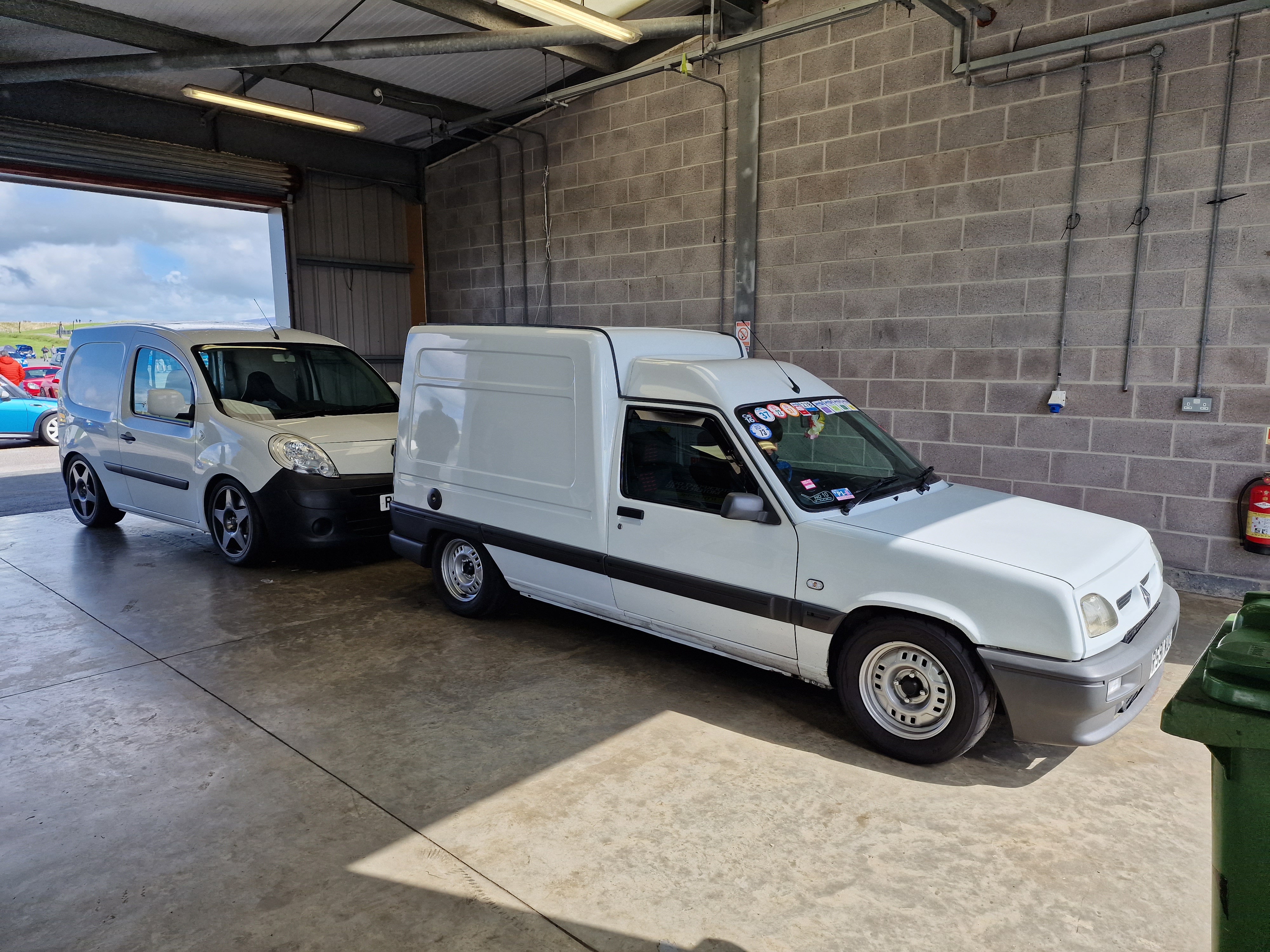

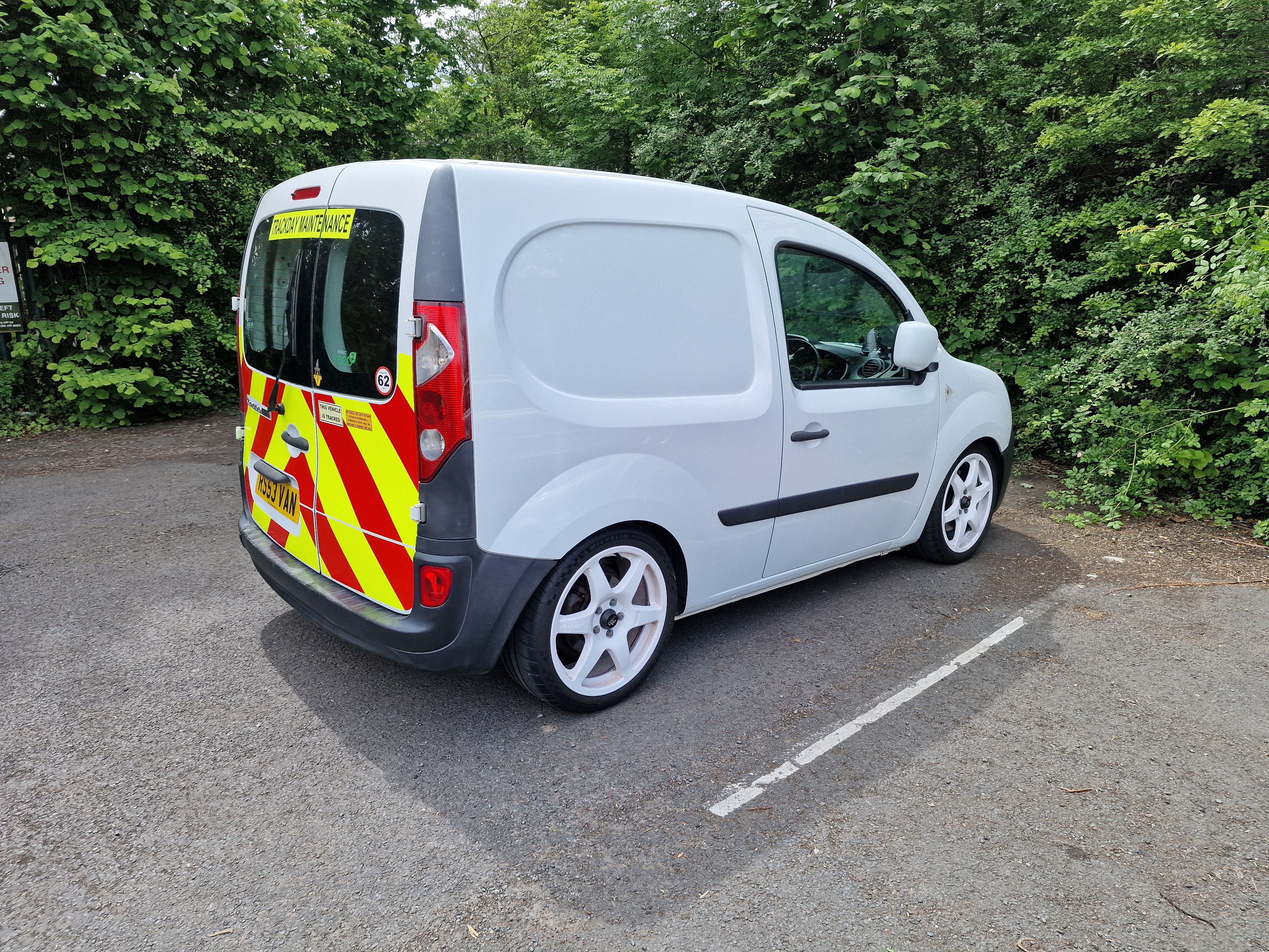

Cheers mate! Its mad that its shorter than a 182. Pic of them back to back. Collar me for a passenger lap at CSF, be first shakedown so will see how it goes. Hopefully well:LOL:🤞

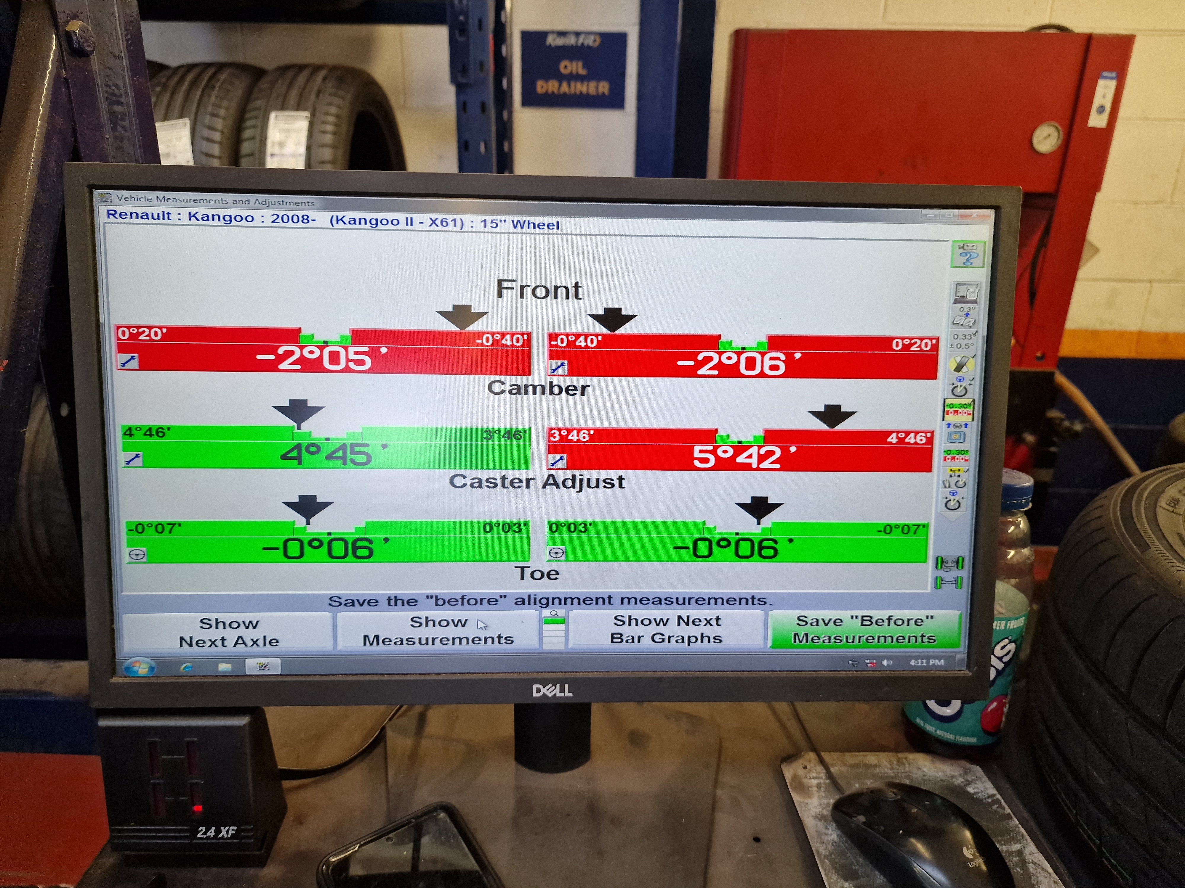

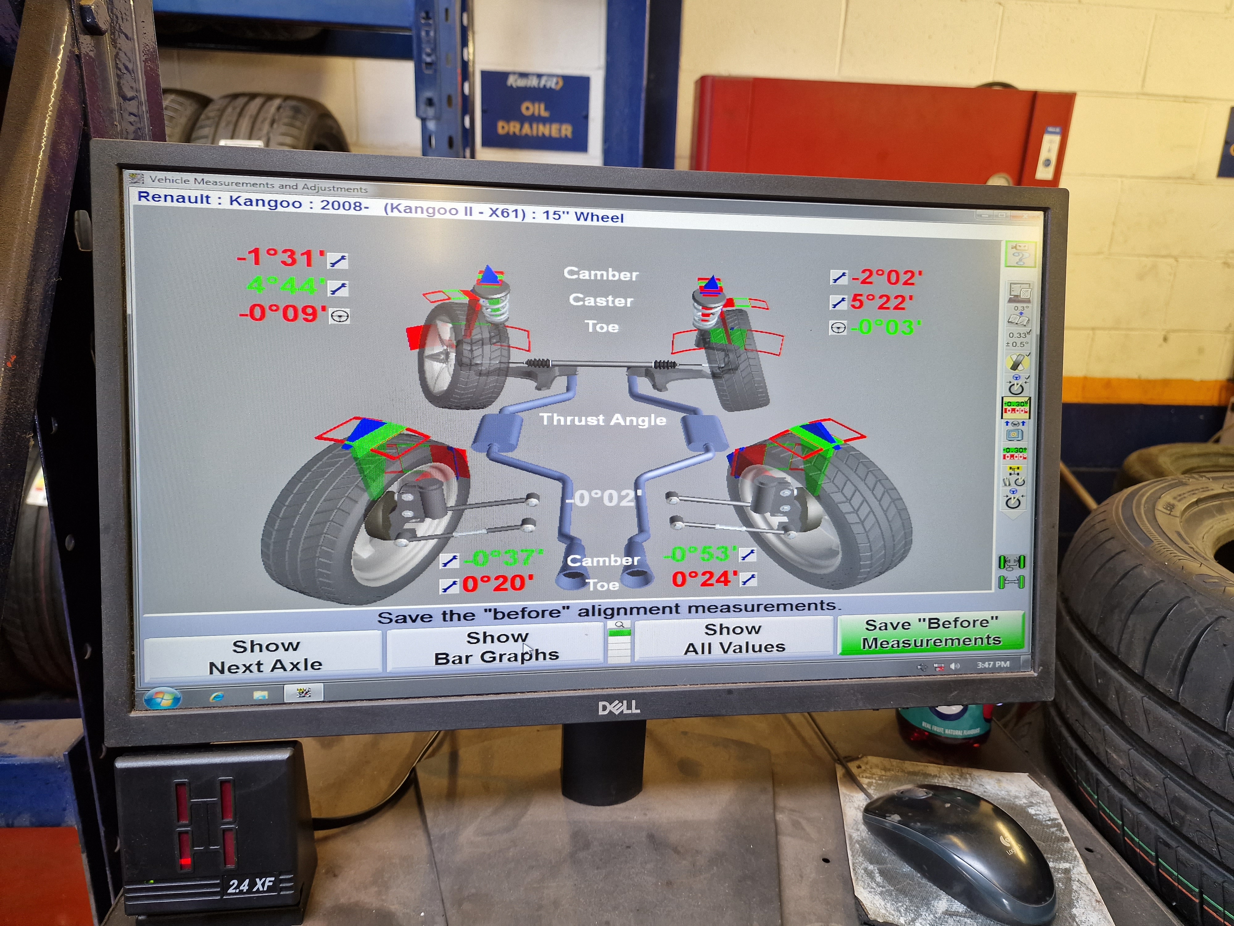

Camber and toe was miles out initially and it was wondering a bit on the street. Not sure whats going on there but must have settled a bit since last geo.
Spiced up the front a little for Anglesey. Drives true again and straight on boost. Not tried cornering too much due to traffic, have chucked it into a few roundabouts and turns in nice, where it was a little understeery before. I was always a bit dissapointed with the understeer considering rs perfo hub setup but we will see how this goes.
Castor still a bit out but cant get nothing on that on current setup.

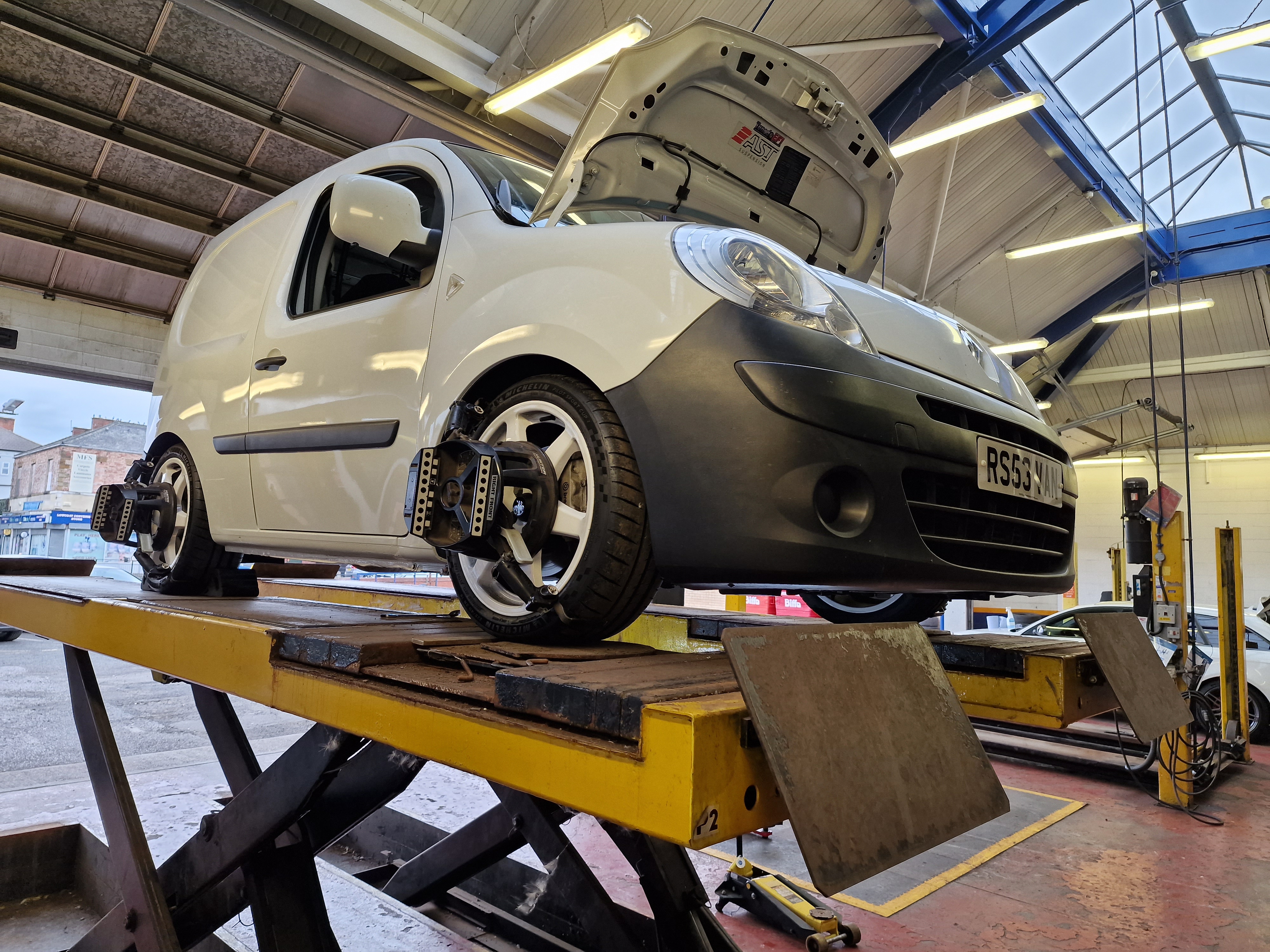

Got chance of some lift time Wed afternoon at a mates garage. Oil and filter change done, michelin ps5 fitted to the comps and geo done on the hunter.
Camber and toe was miles out initially and it was wondering a bit on the street. Not sure whats going on there but must have settled a bit since last geo.View attachment 1655693
Spiced up the front a little for Anglesey. Drives true again and straight on boost. Not tried cornering too much due to traffic, have chucked it into a few roundabouts and turns in nice, where it was a little understeery before. I was always a bit dissapointed with the understeer considering rs perfo hub setup but we will see how this goes. View attachment 1655692

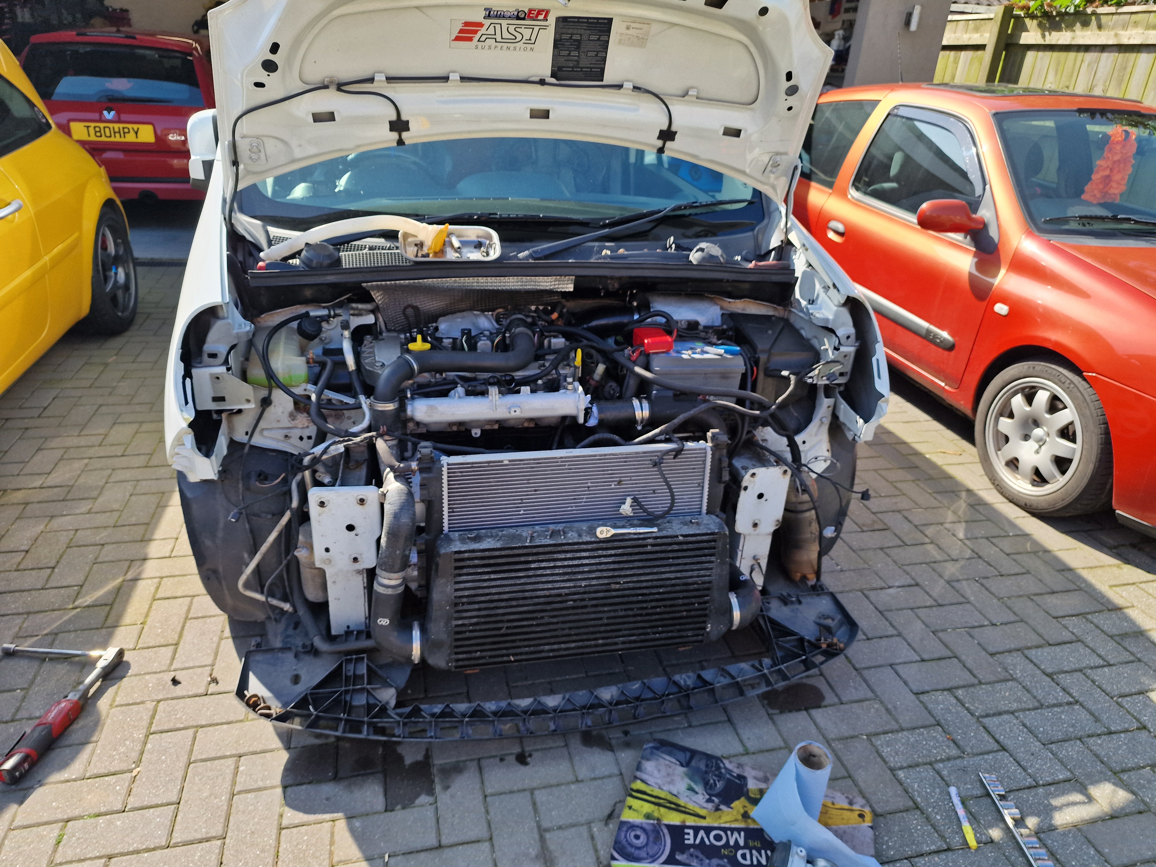

Updates.

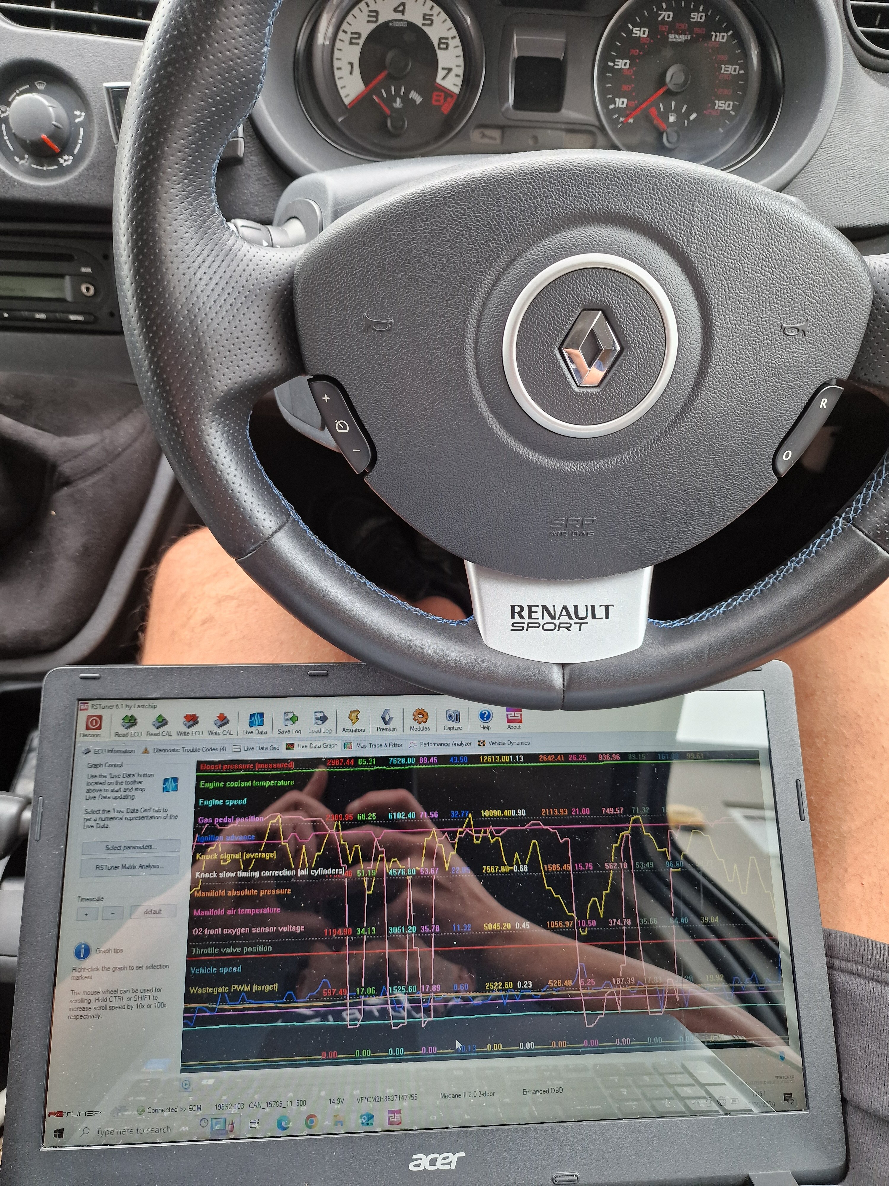

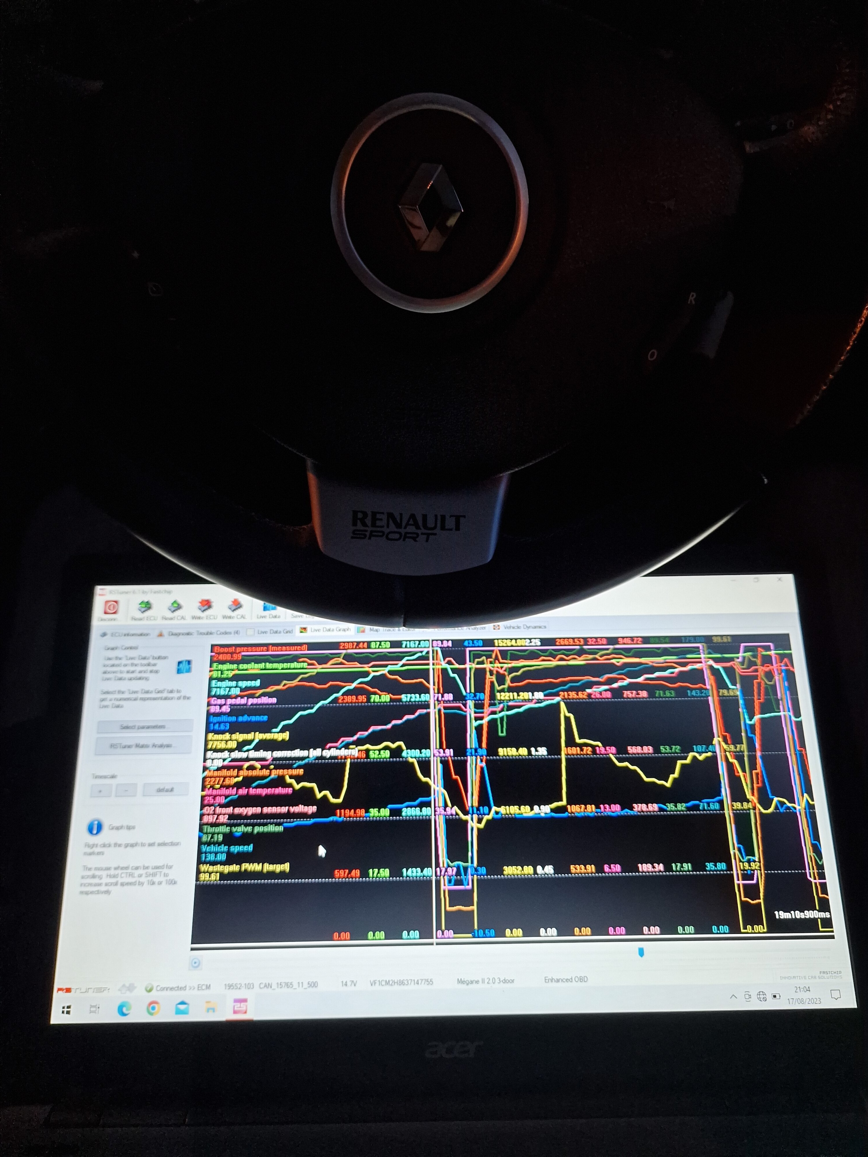

More datalogging, still had a slight overboost situation up hills/max load. Ive knocked 1.5 turns of preload off the acutator to lower the base pressure and done extensive datalogging on the road late at night. 100% confident its bang on the money, 22psi tapering to 19psi under full load up hill and 11.7 afr tapering to low 11s up top.
Got a fine as forgot to pay the merseyflow on the way back from efi. Could have took a better pic for £22 :LOL:

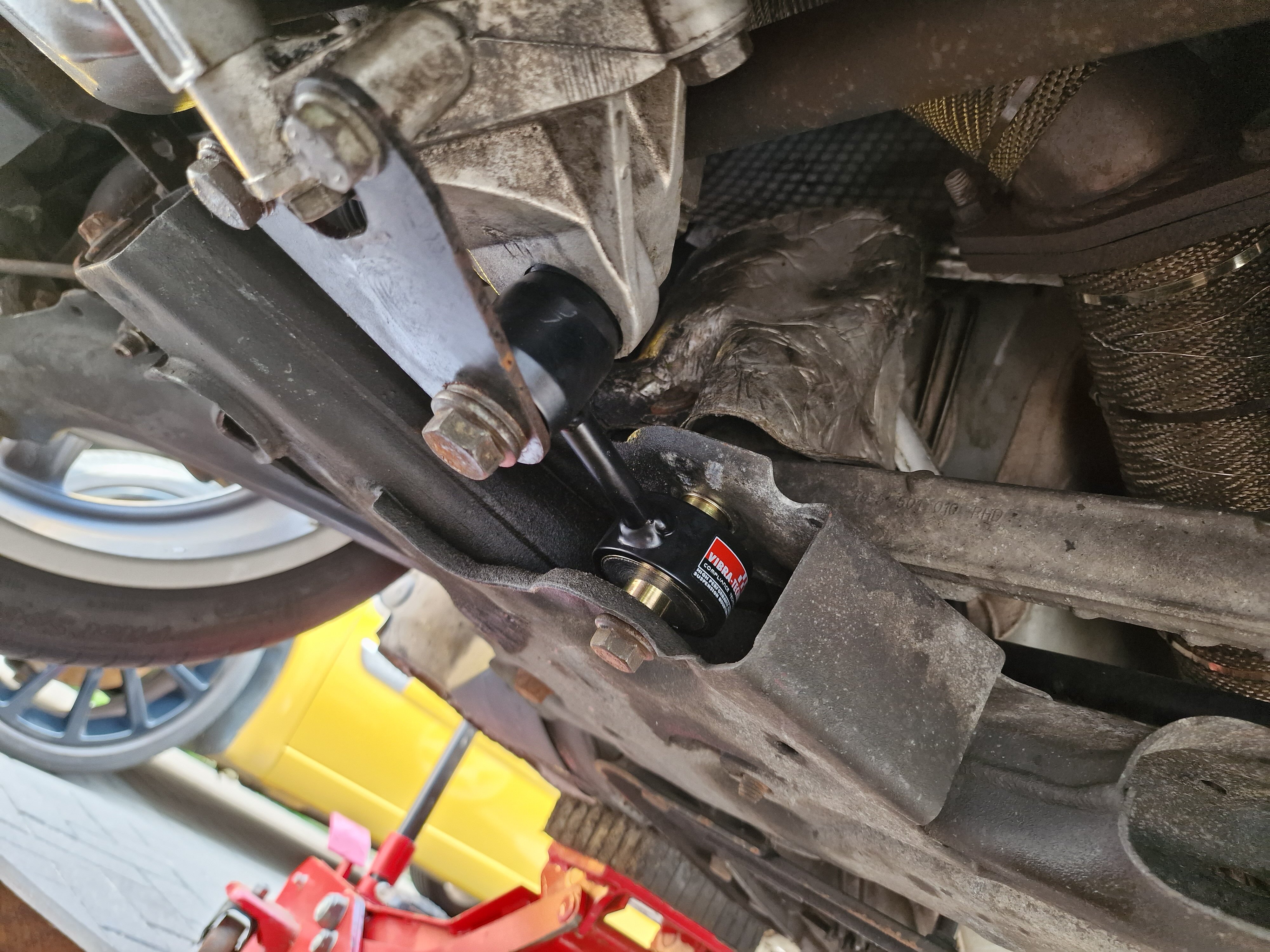

I was running an evol dogbone and the bushes had fallen to bits on both sides and causing a knock in reverse. Bought a posh vibratechnics dogbone and fitted that.

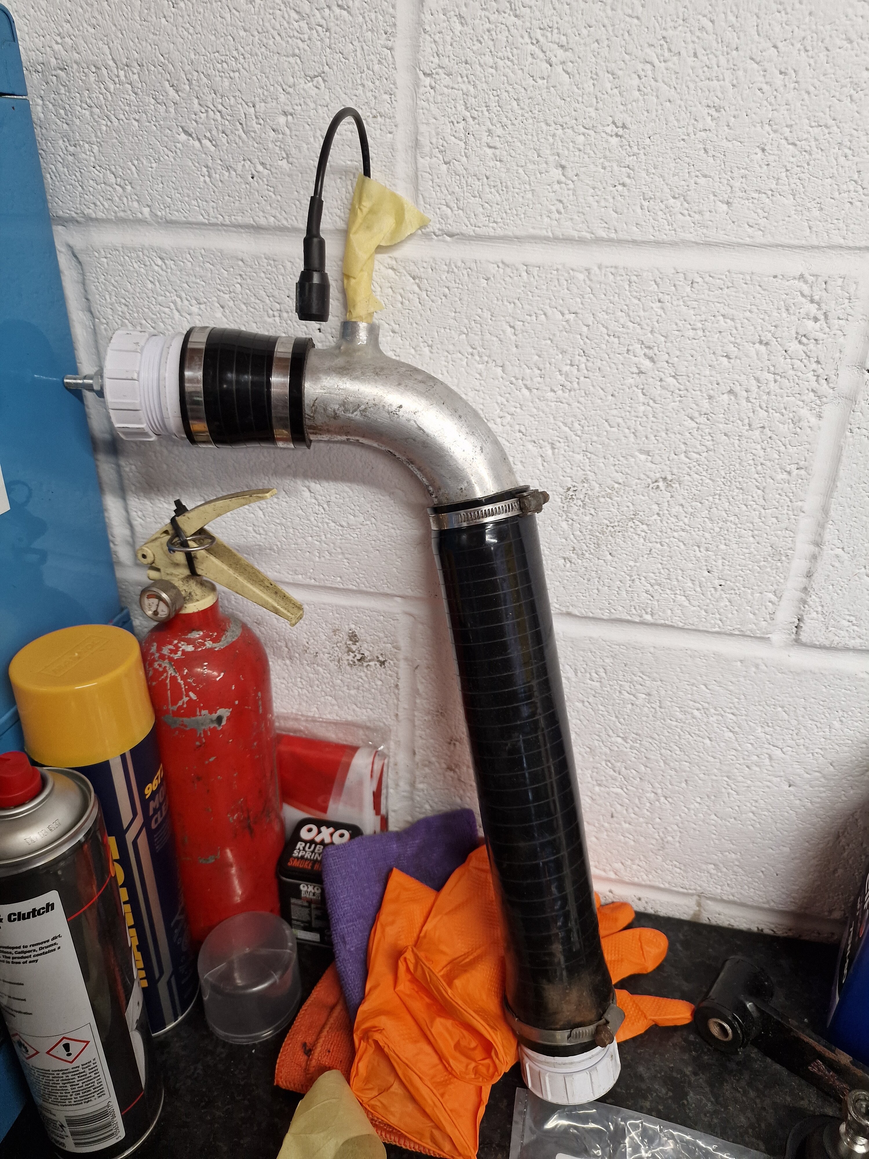

Finished off my spa intake temp sensor. My friend alloy tig welded it for me. Pressure tested all good, sensor threads sealed with locktite 577. Fitted, works good.

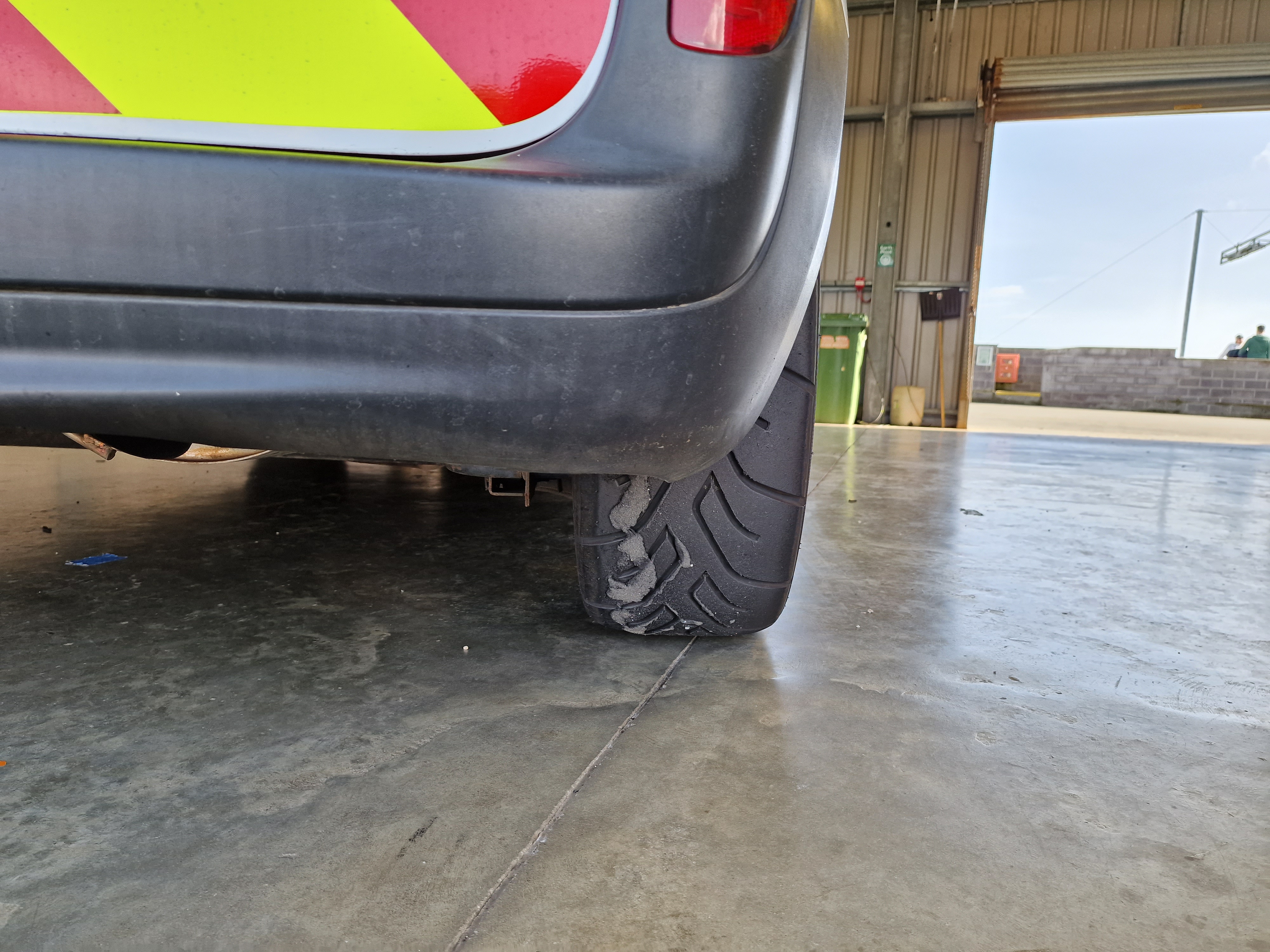

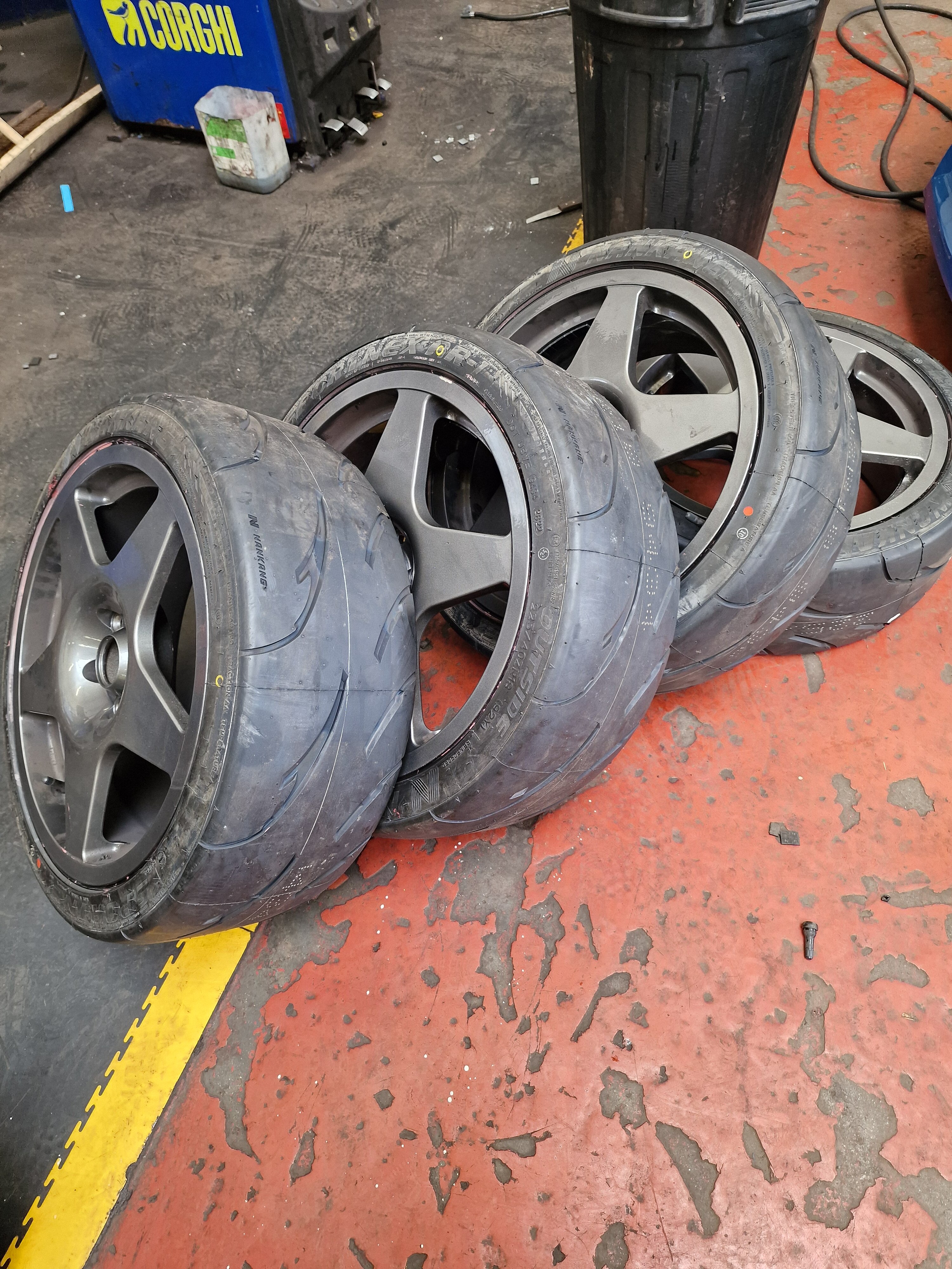

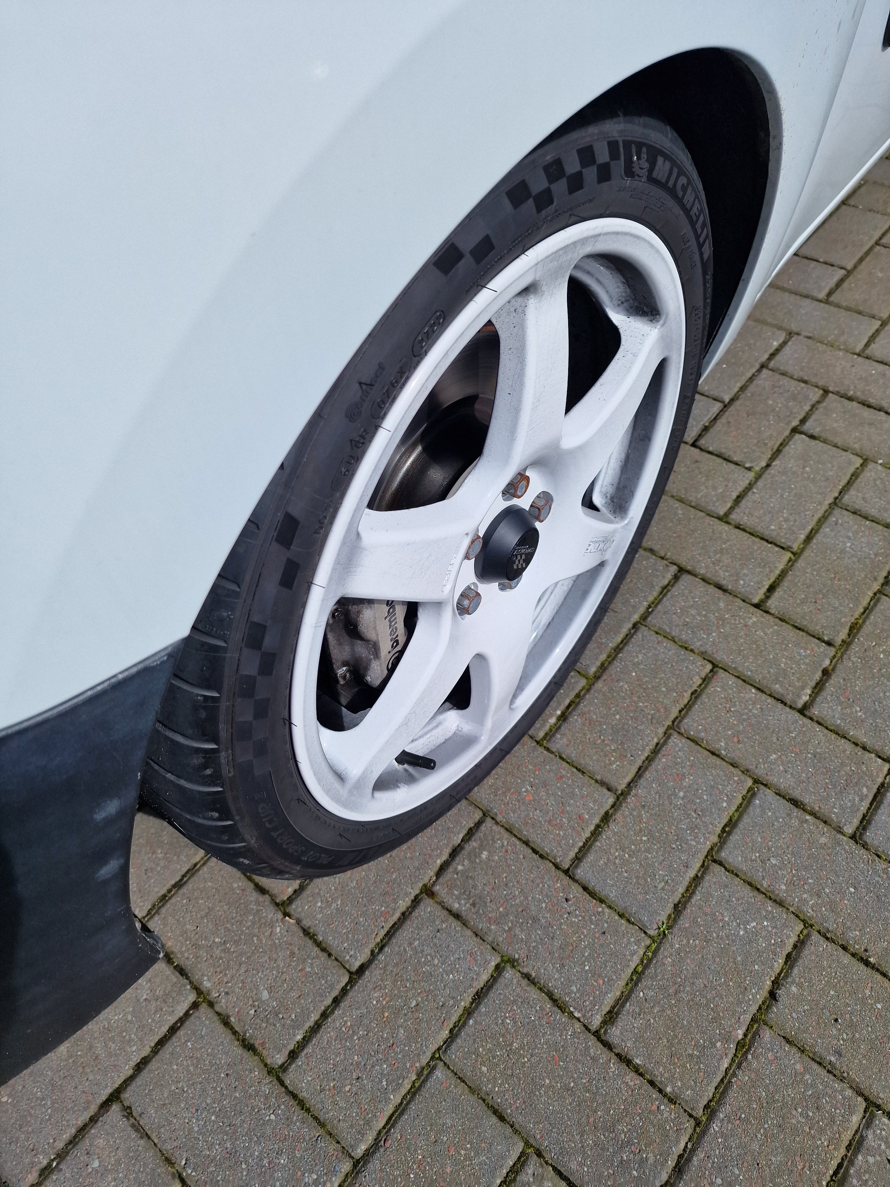

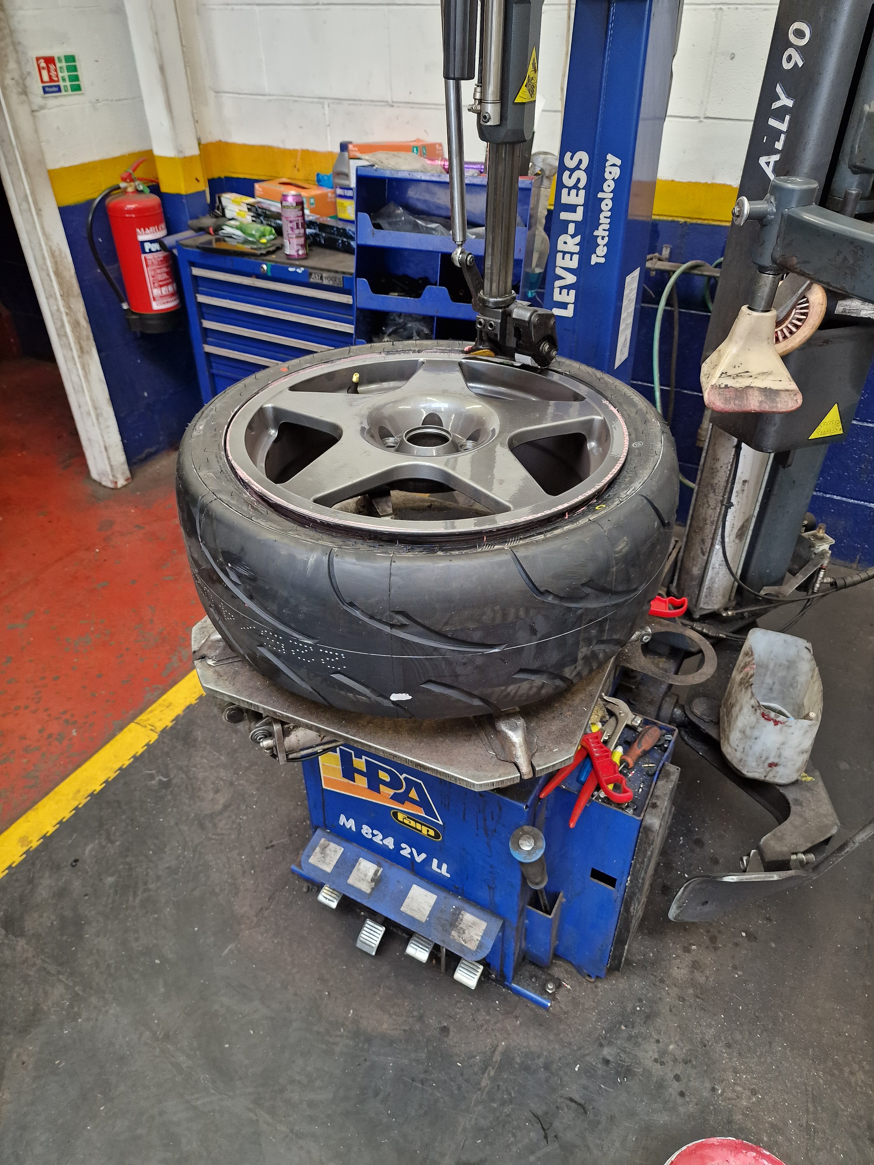

Fitted the technomagnesio/A048 M/H compound semi slicks in prep for CSF. Looks mega like compomotive mo5.
Also changed rad for new oem renault so no chance of it getting hot. Its been road tested today/datalogged all good.

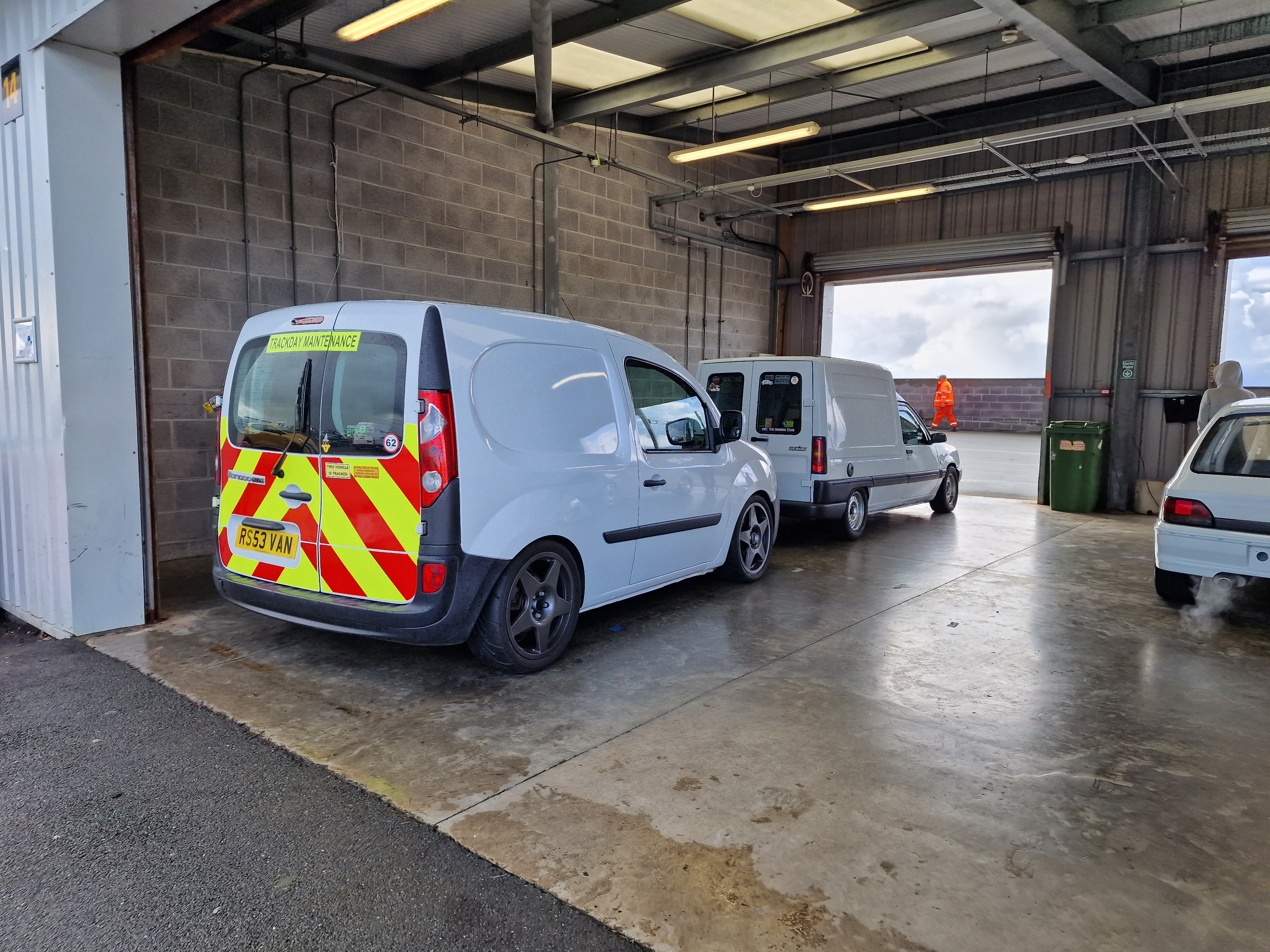

Csf done and pretty successfull overall, the stars finally aligned. 600 miles on the trip, 3x tanks of fuel and 4x track sessions on the pm.
Sat ready to go with the Extra.

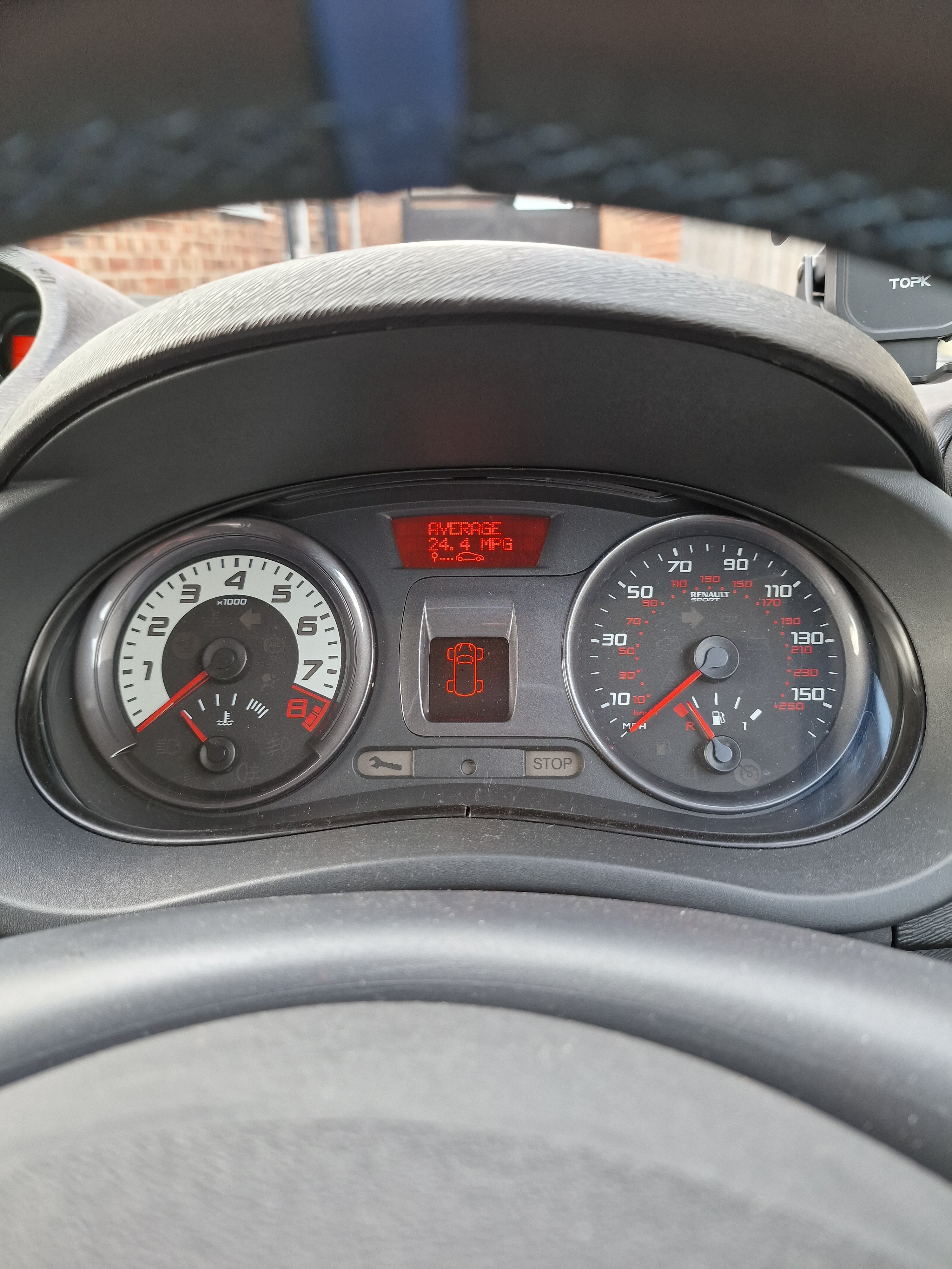

24mpg overall, not too bad. It was drinking it on track so assume it levelled out on steady return journey.
Give it a once over and all seems to be good. Have refitted the white mo's with the cup2s as more road friendly.

Both vans were epic mate. My lad thought they were mega, as did I.
Cheers mate! Was good to catch up.
Had mega fun in the Extra catching you up at the back end of the day. Back end looked lively on it!

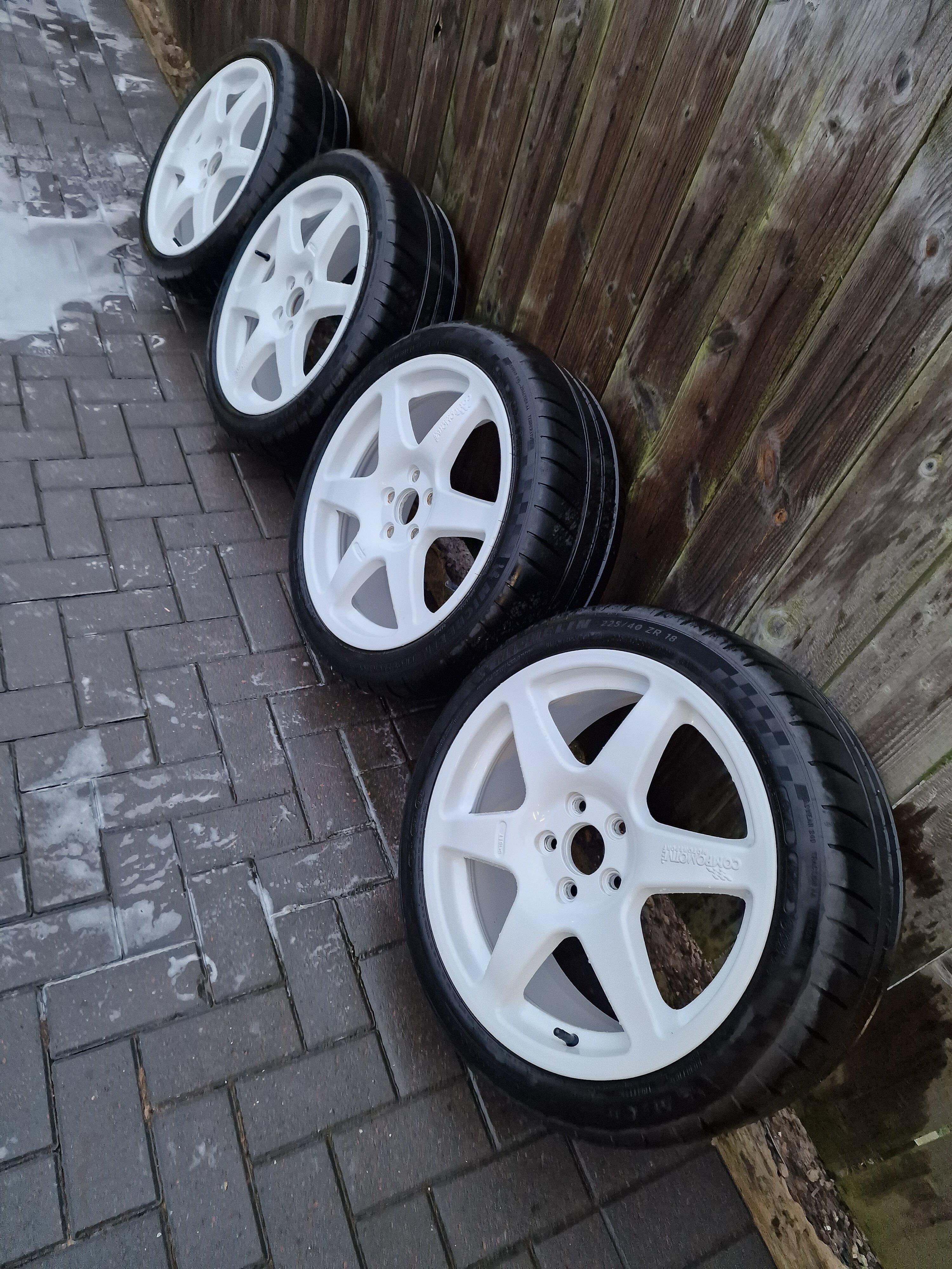

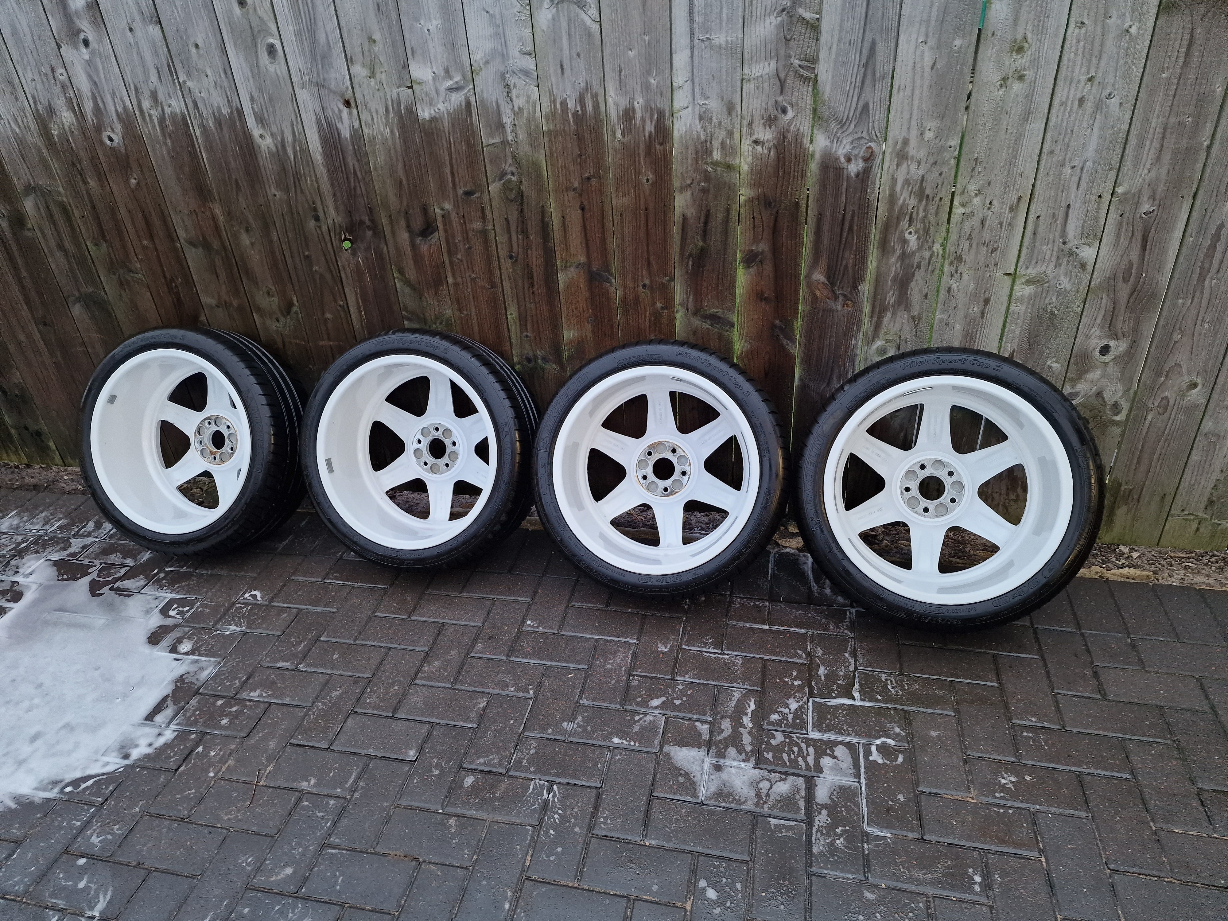

Jacked up and ph1 225 wheels fitted, ds1.11 front brake pads removed and stock brembo pads fitted. Discs coated in xcp rust block to stop excessive corrosion. Coilovers and other parts coated in xcp whilst up in the air for corrosion protection.
Looks gash but saves sitting outside on the cup2's.
Compomotives cleaned inside and out. Some savage fallout off the ds1.11 pads, a decent dose of BH autowheel removed 99% of it.
Bagged up and on the wheel rack in the garage until next spring.

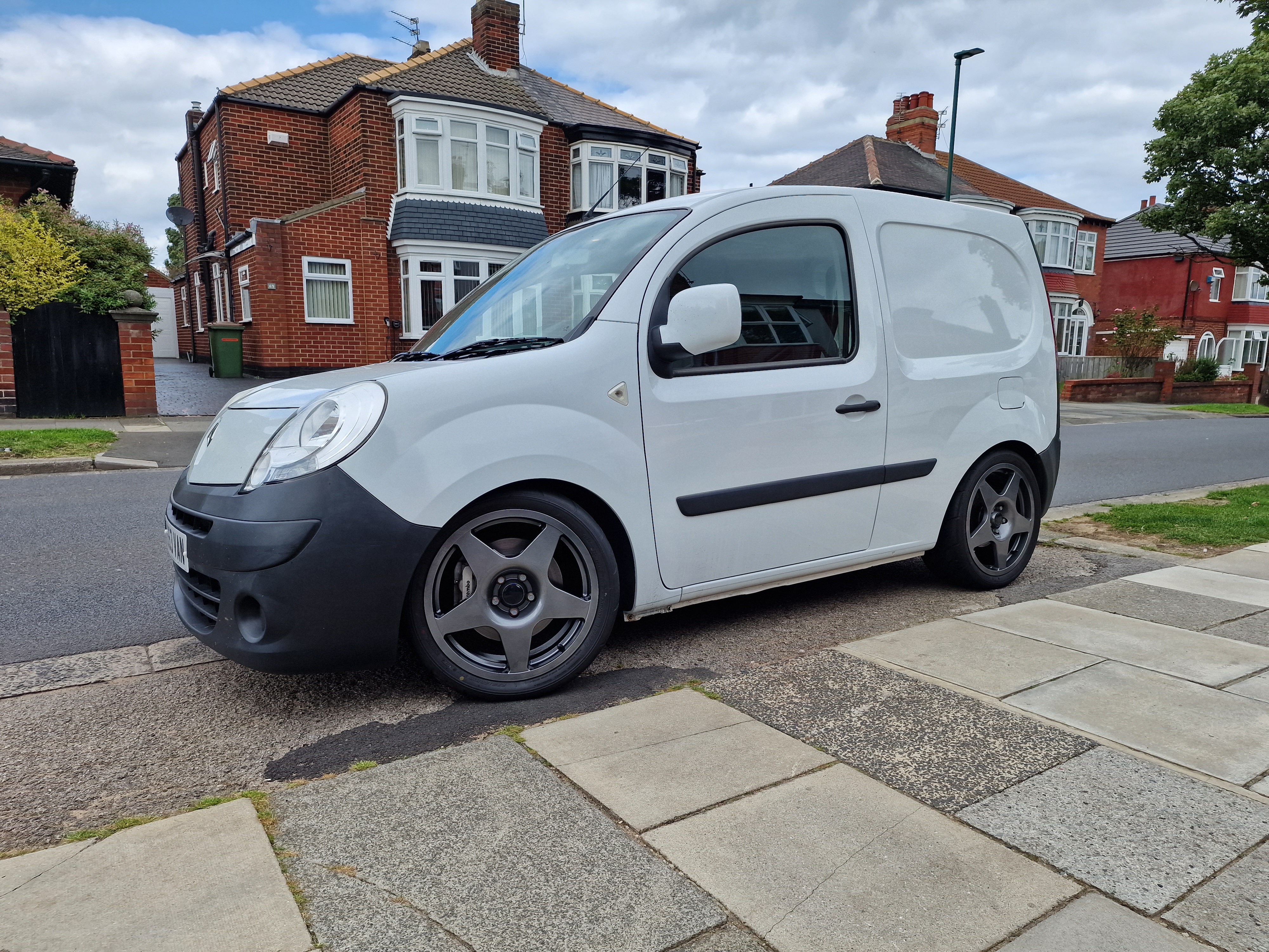

After coming off the road in October last year the Kangoo is taxed and back on the road.
Started straight up no hesitation today first crank. Jacked it up and changed wheels for the white compomotives. Whilst wheels were off checked everything over for mot, all looks OK.
I had coated all suspension and alloy underbonnet components in xcp rust block before winter hit so no changes really. Even give the discs a good coat of xcp to keep them right and there was only a slight bit of surface rust on them, so worth doing if your laying a car up outside to save the thick rust forming that takes ages to clean off.
I did however suspect the rear calipers were binding a little before i took it off the road as it hardly moved after CSF, so whilst rear wheels were off i give them a once over. The pistons were slightly tight winding back initially - worked piston in and out a couple of times with some red rubber grease to lube and they seem fine. Cleaned up pads, sliders etc whilst there and refitted.
Taxed and drove it to tesco for some fresh momentum 99 and a 30 mile trip to makro.

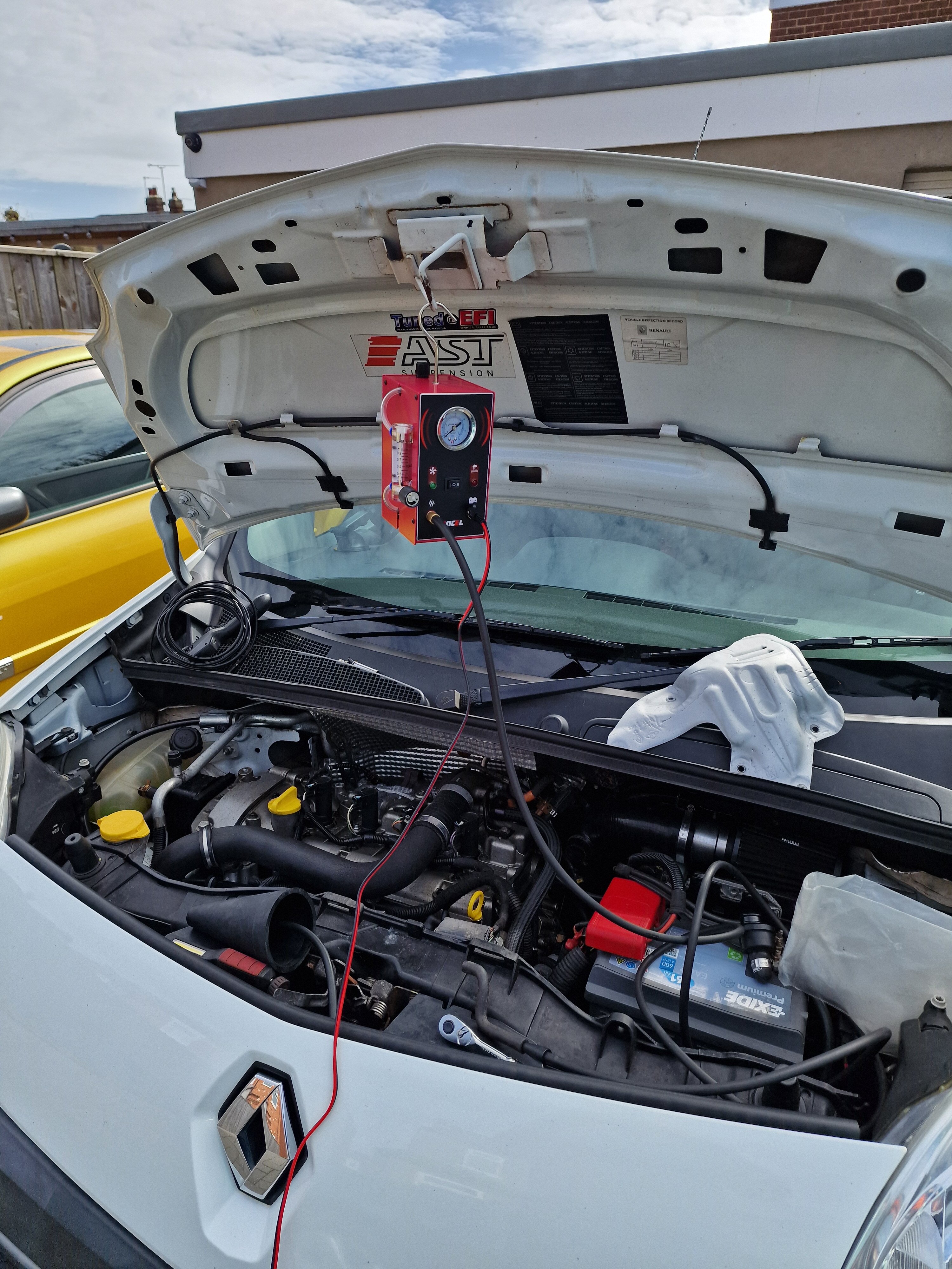

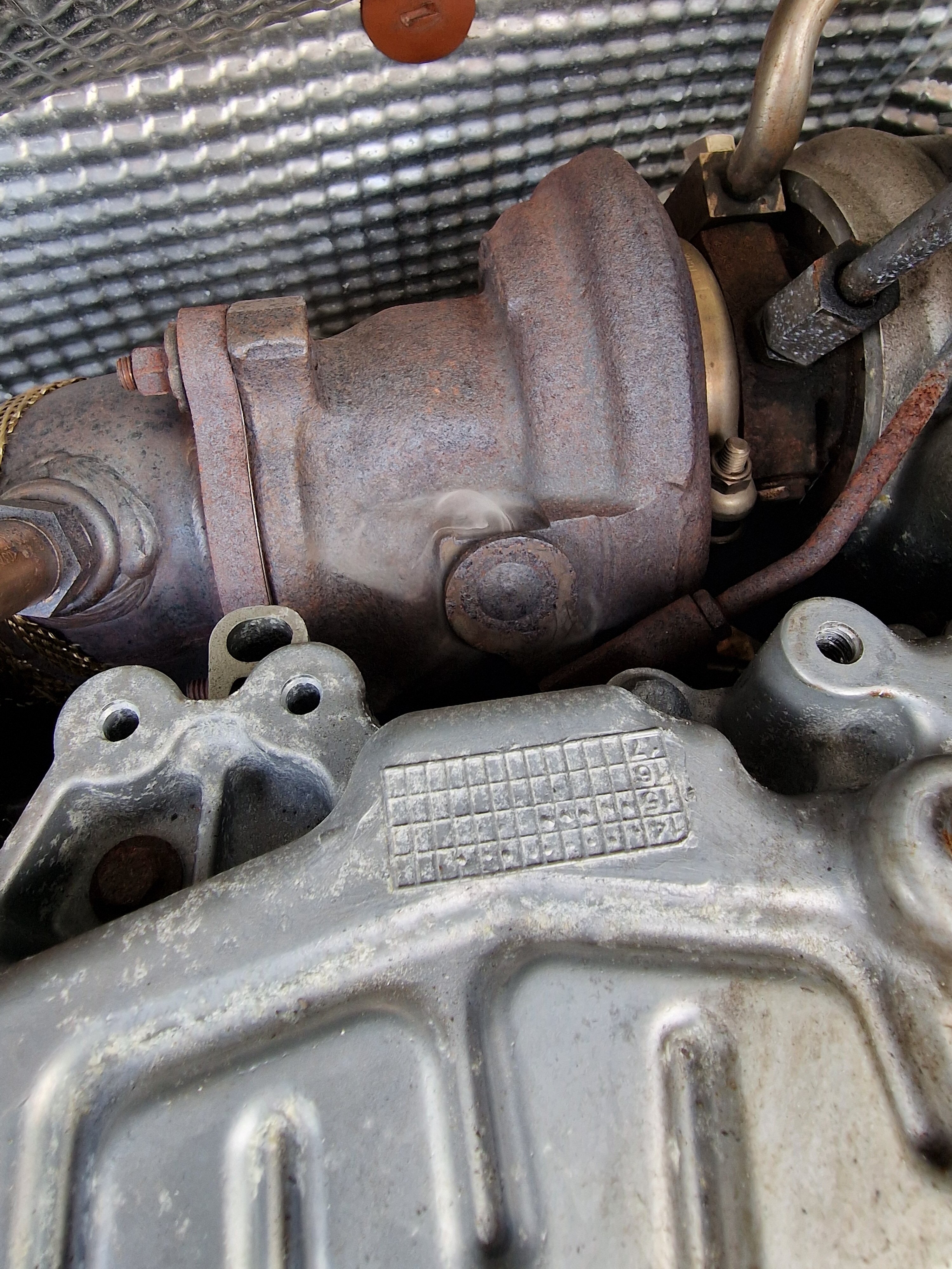

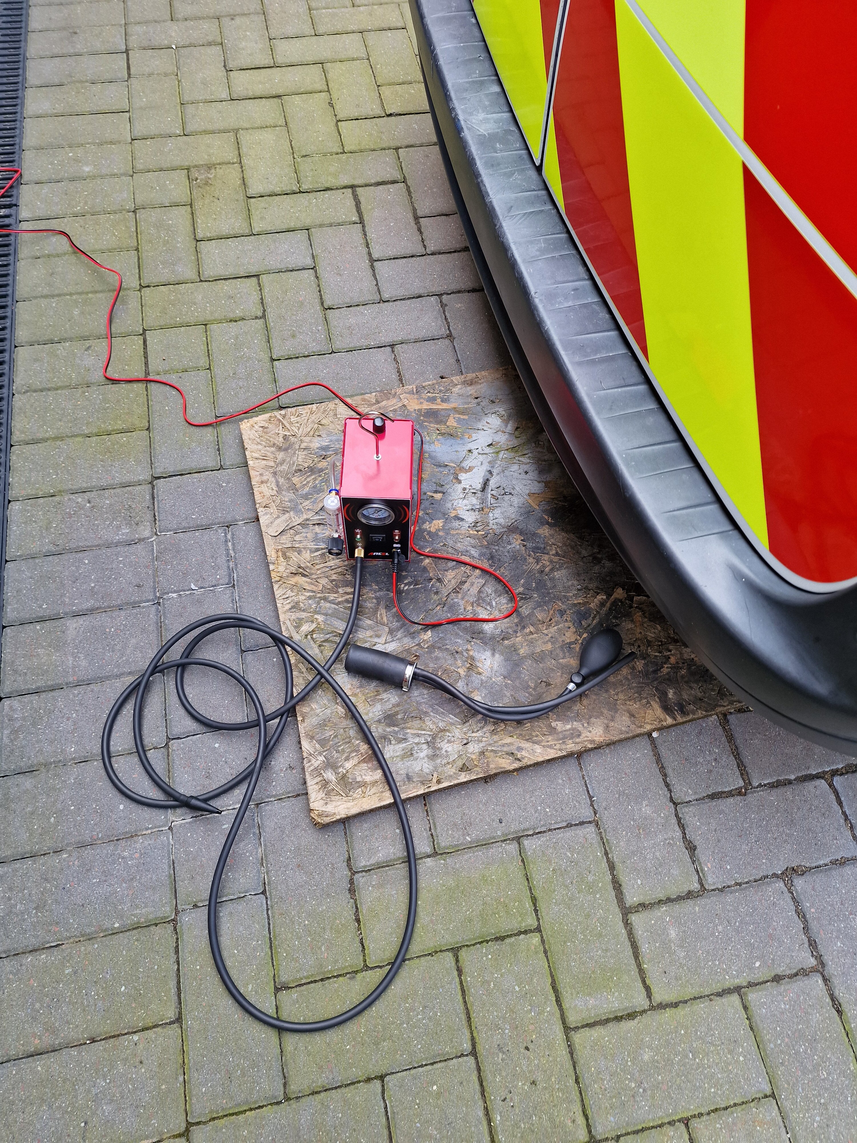

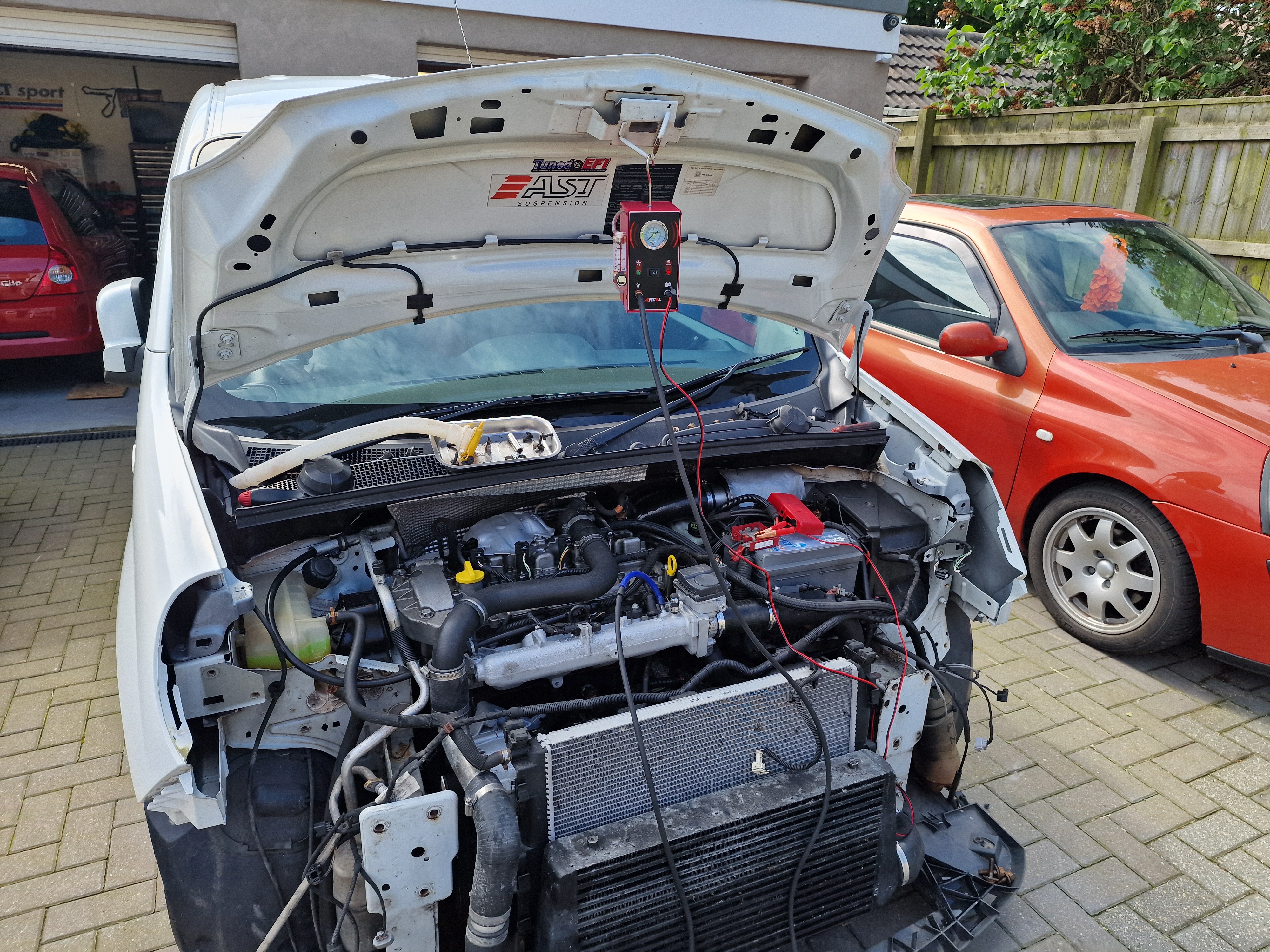

Ive had what sounds like an intermittent exhaust blow for a little while and nothing immediately obvious when looking. To do sone diagnosis - bought a smoke tester. Uses Johnsons pink label baby oil to make the smoke :ROFLMAO:
Its acutually a fantastic bit of kit. I stuck the inflatable bung in the tailpipe and smoked the exhaust out. Looks like a minor leak on the decat where it was welded up at the support bracket and the wastegate pin leaks as expected - they all do that. I think its one of the stainless gaskets causing an intermittent whistle noise from cold so will continue to use until it rears its head.
Smokin
Inlet/boost cct check.
Do you even vape bro
As above - fantastic bit of kit for turbo cars. Id have bought one years ago if id have realised how easy it is to leak find over high pressure test. Still - both tests have their place so will continue to do both where necessary especially on boost circuit - as any leak will cost you power.

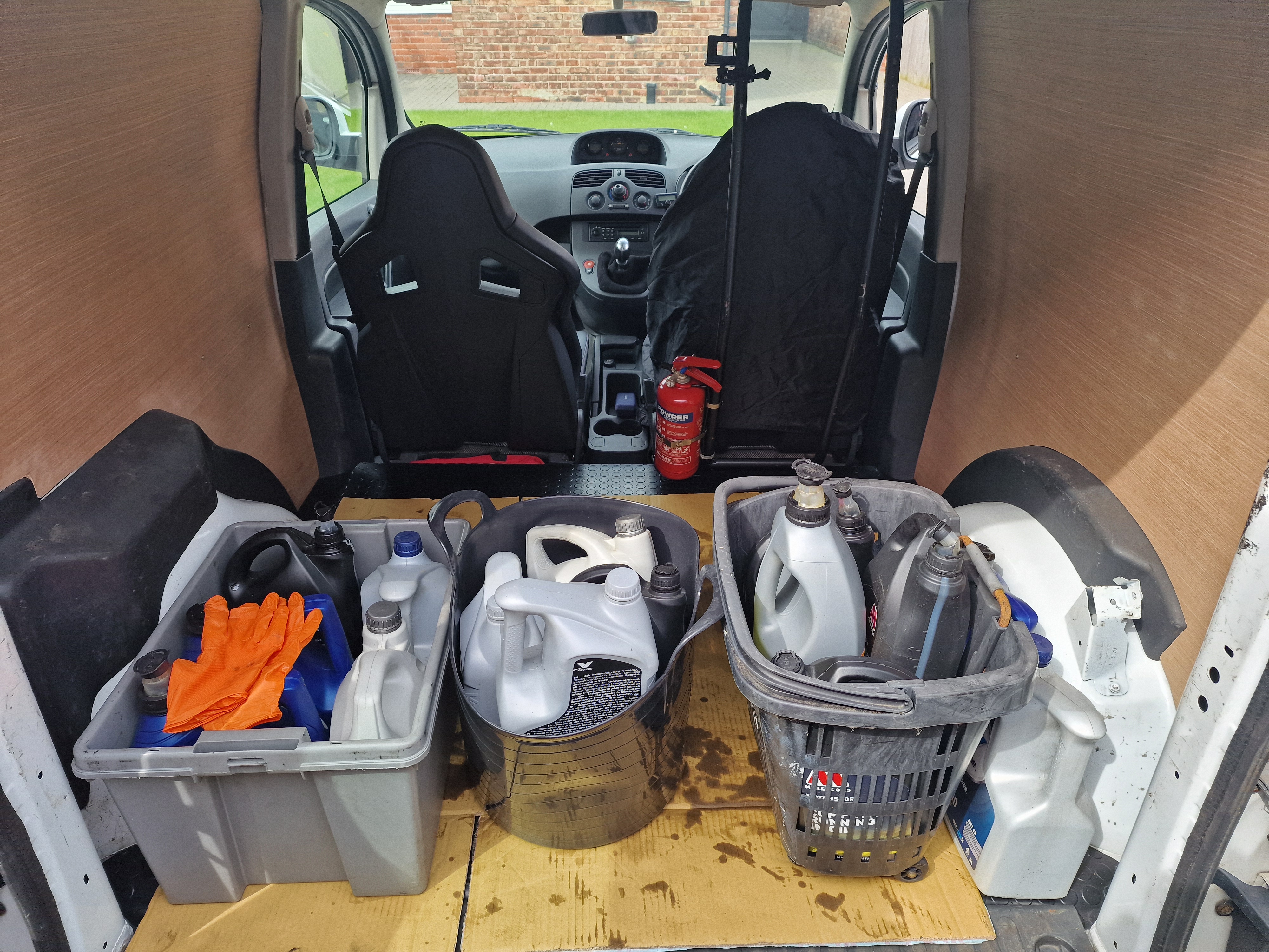

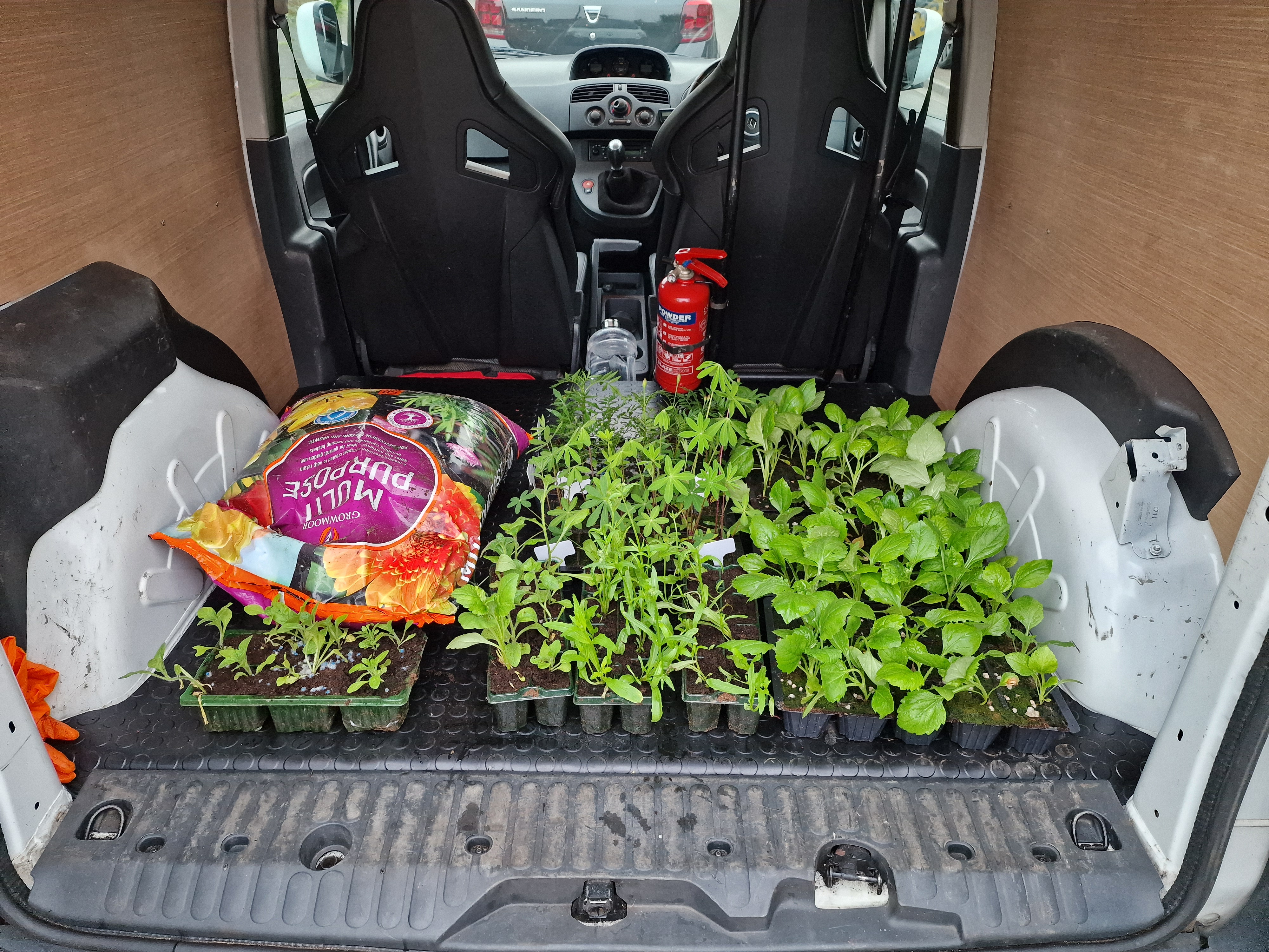

Also used it for an oil disposal trip - had around 75ltrs id accumulated over a short period.
It has its uses - albeit small loads:ROFLMAO:

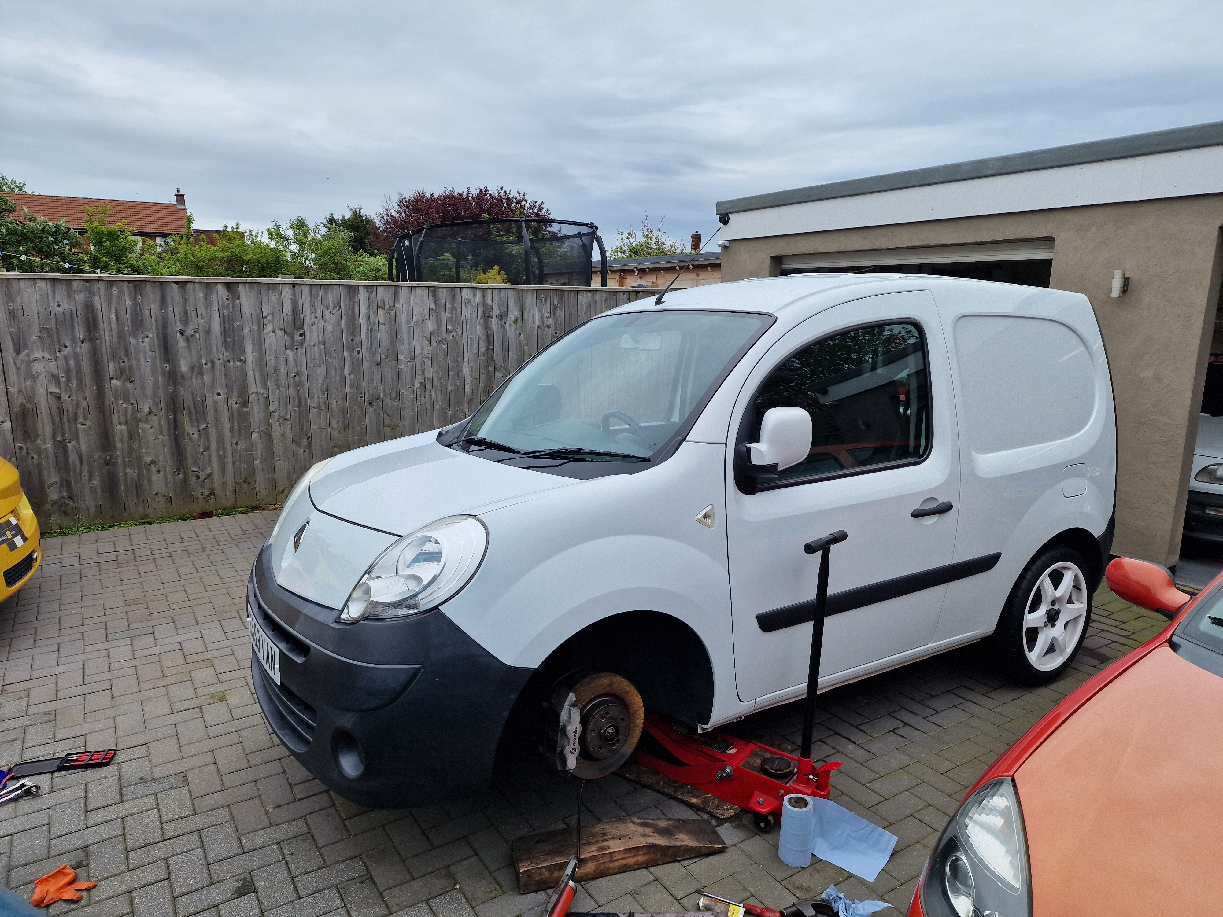

Got a set of Ferodo Ds1.11 pads for the front so fitted them on Sunday morning.
Ten min pad change.

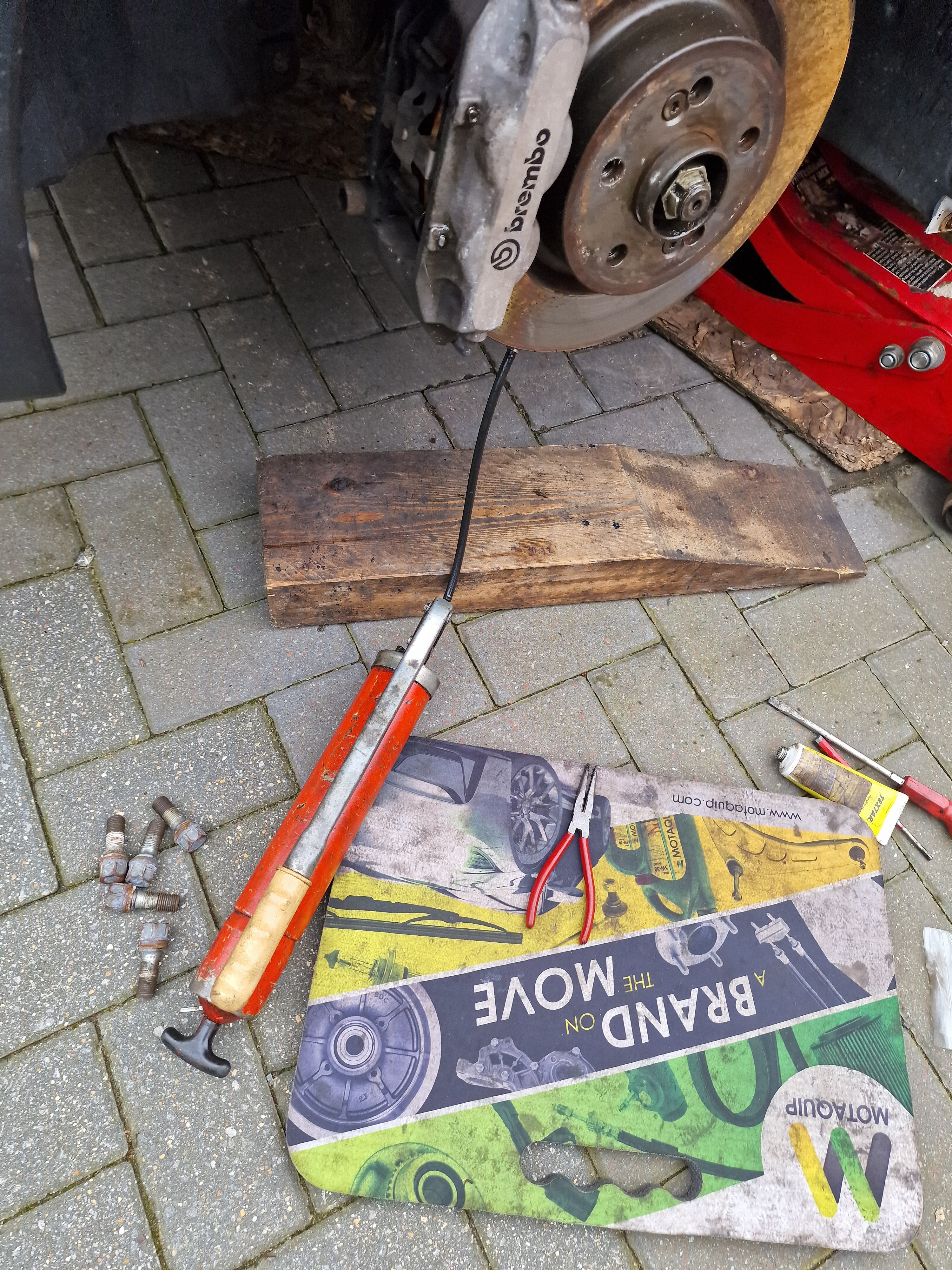

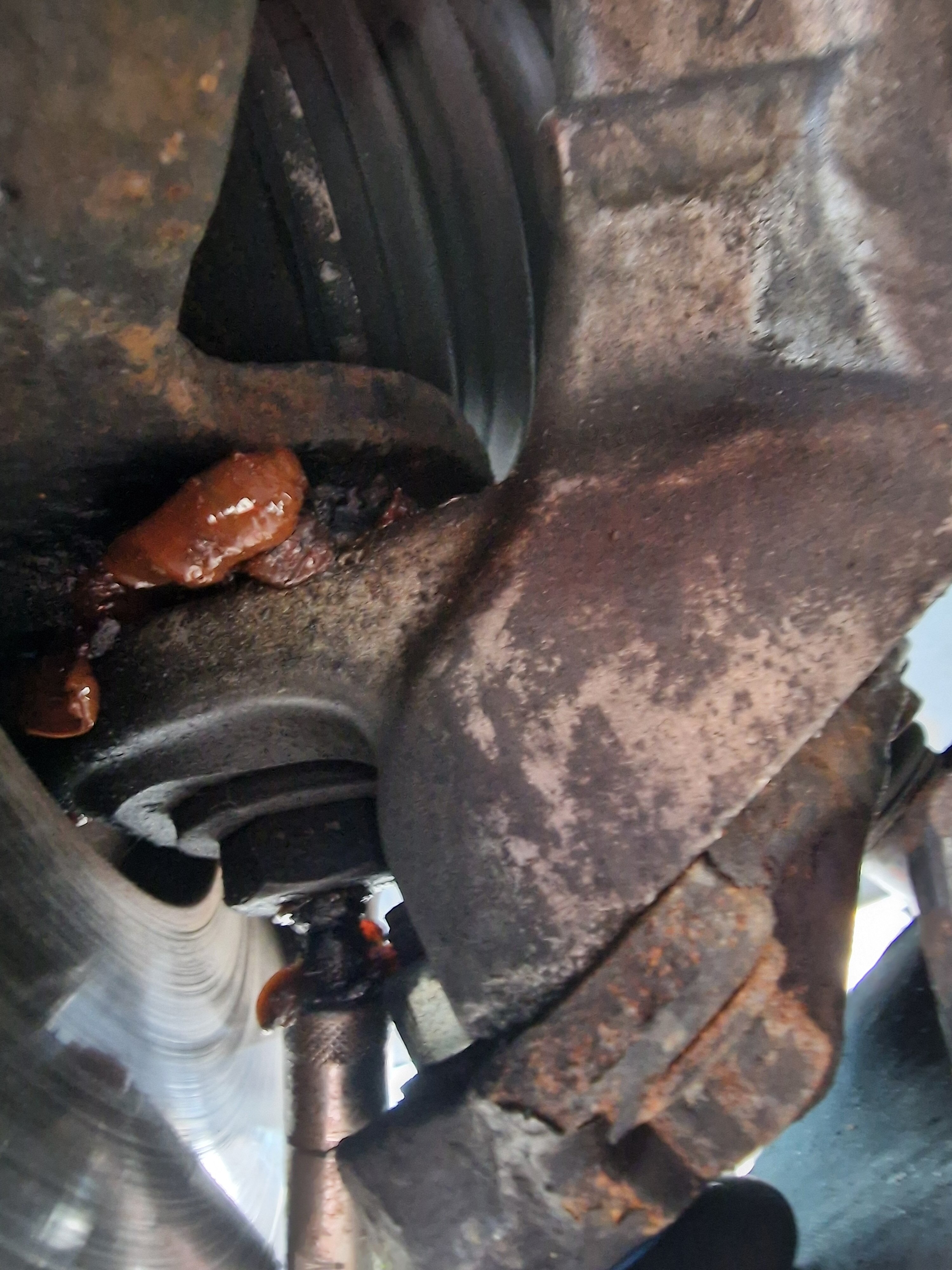

Whilst in the area i greased the lower swivels on the perfo hubs via the grease bolts. These are an essential mod for mk2 meg to keep the swivel bearings right, do it once a year and you wont have any issues, and steering always feels a bit better when done. I have found that the passenger one always suffers with grease washing out and a bit of shite comes out each time.
Grease nipple in action.
Grease flushed through.

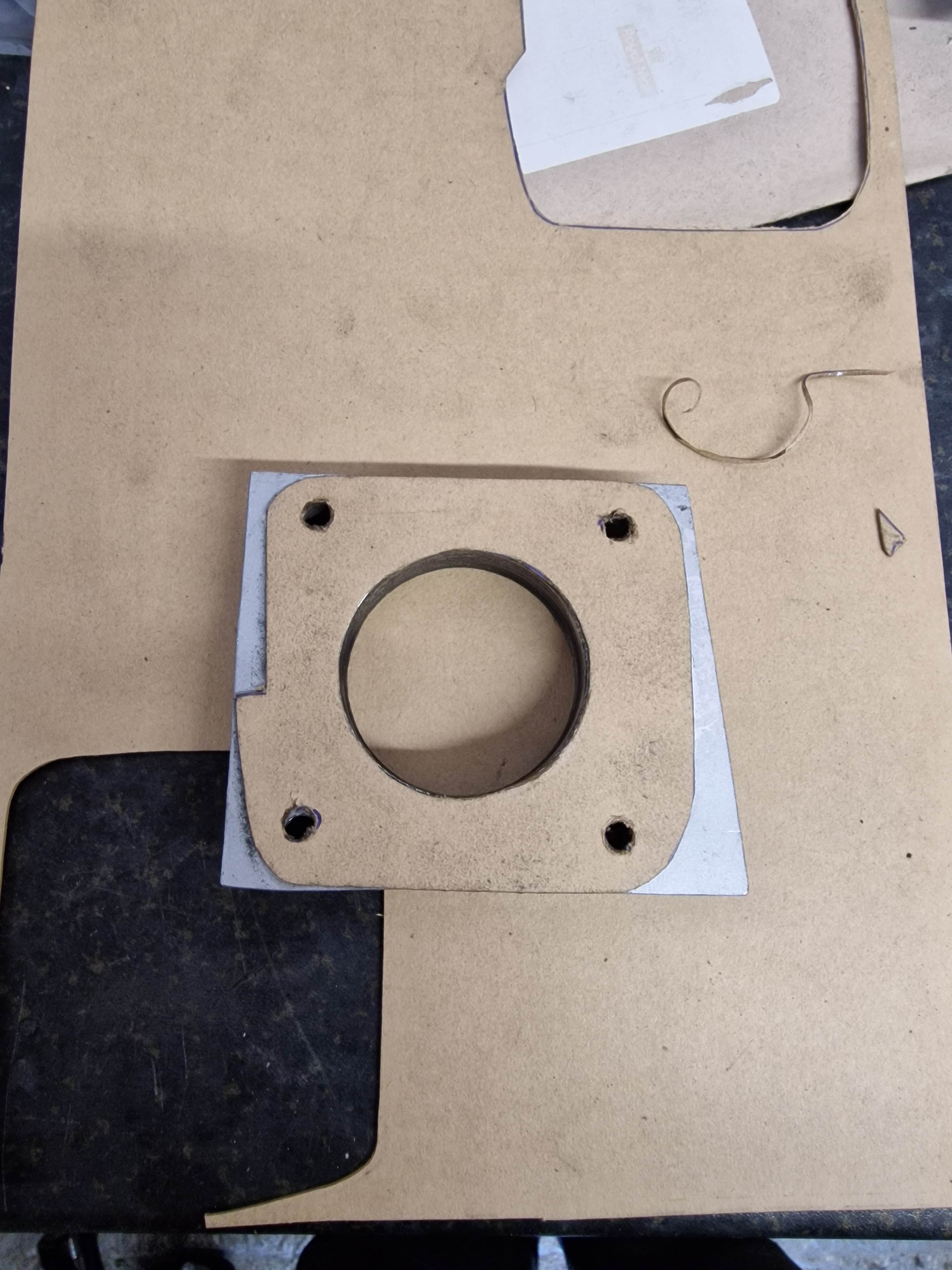

Ive never been happy with my homemade throttle adaptor and have a lead on a cnc machined billet alloy one to replace it but need to wait a few weeks for it to arrive. Opted to fix it to make it useable in the meantime until new one comes.
Front off in 20 mins.
On inspection the bolts holding the adaptor to inlet had worked loose causing the issue. Dug out the gasket paper and made a new gasket.
Posh gasket paper instead of cornflakes box.
Refitted and smoke test to check for leaks, passed no problems. Started up and no more screeching.
Smokin.

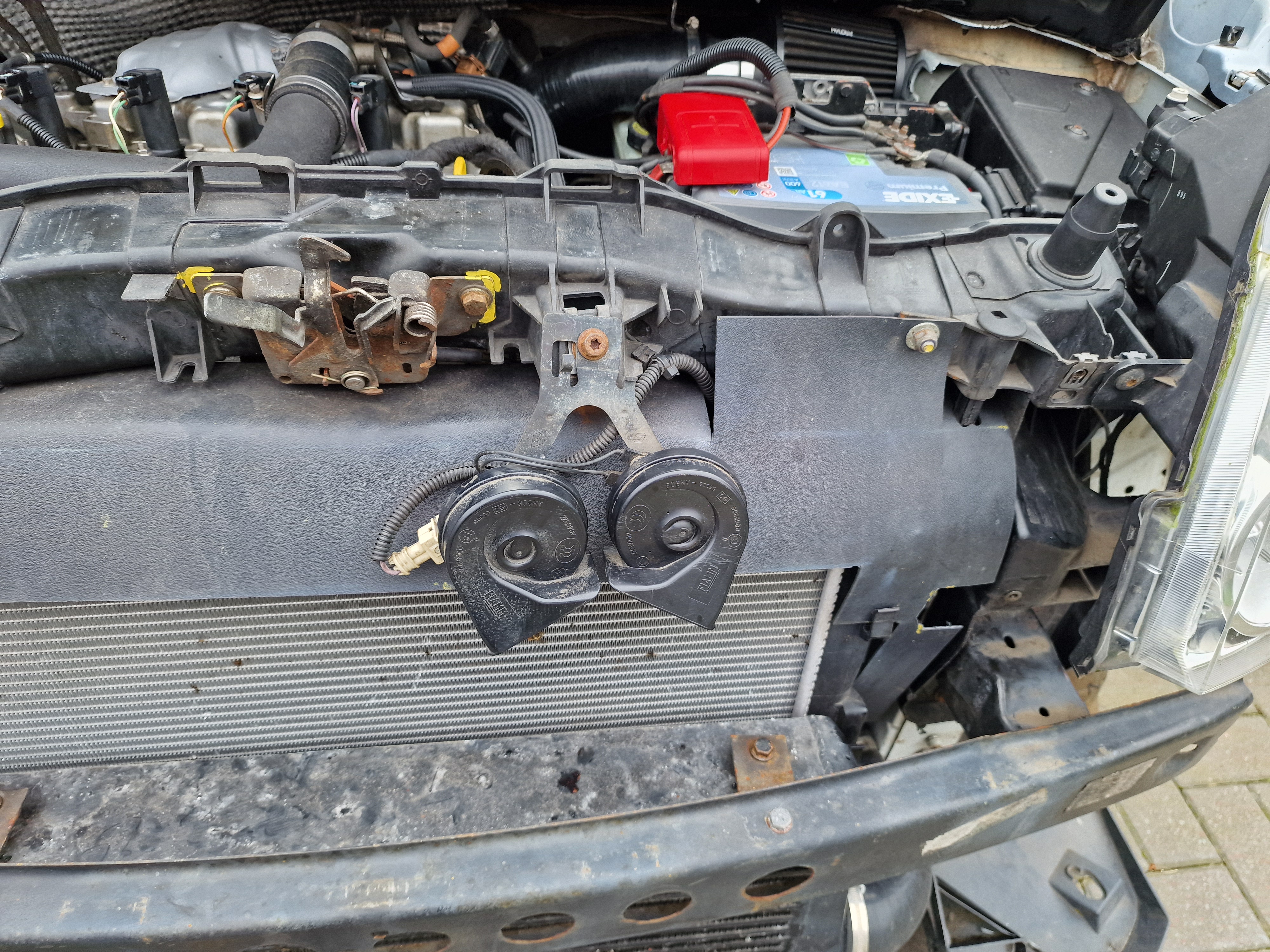

Whilst i was in the area i replaced the pathetic single horn to a more manly dual horn that @Crayola kindly donated a while back.
Small van loud horn.

Next step was to road test. A few quick pulls to check boost pressure and afr with Rstuner hooked up to datalog. All good, feels stronger in the mid range again.
Rstuner in action, great tool.

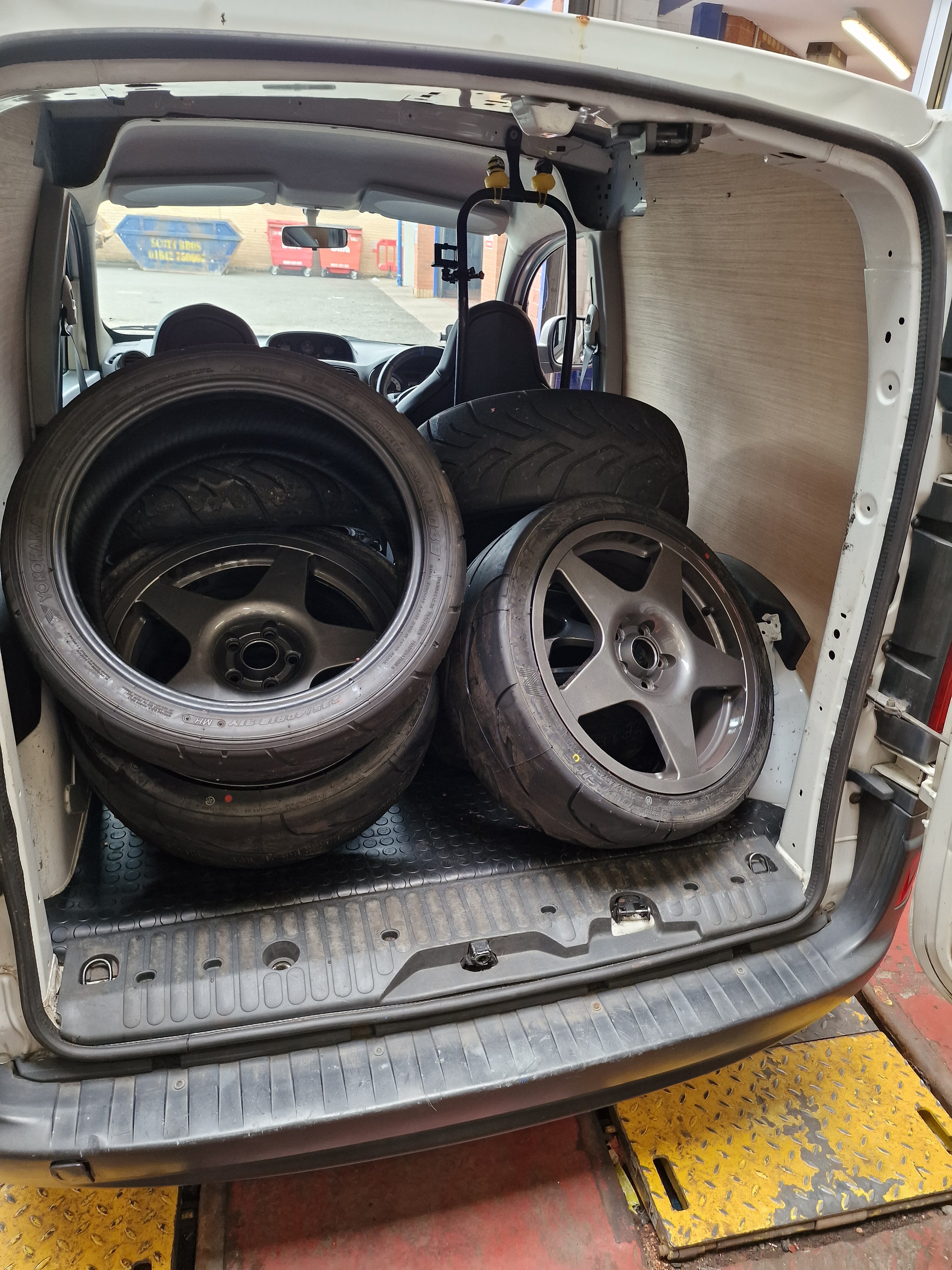

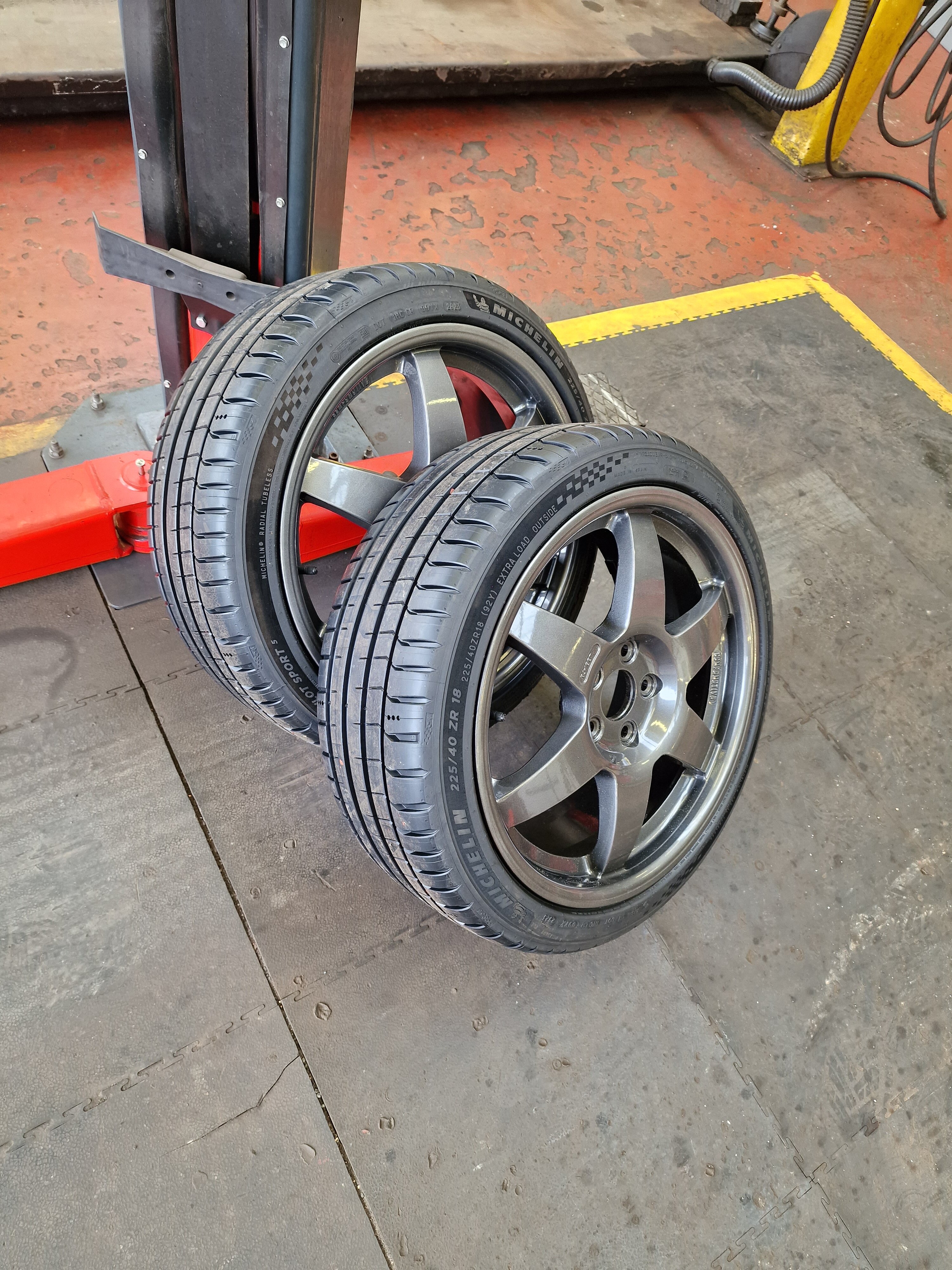

With it running good again, i loaded my track wheels in to take to my mates garage for new set of Ar1's.
Fresh rubber.
Earning its keep.
Good to have it sorted again. Might book a trackday for it after CSF.

That smoke machine is seeing loads of action. Great work again 👍
Cheers mate. Wish i had invested in it years ago, makes leak finding super easy!

Updates.

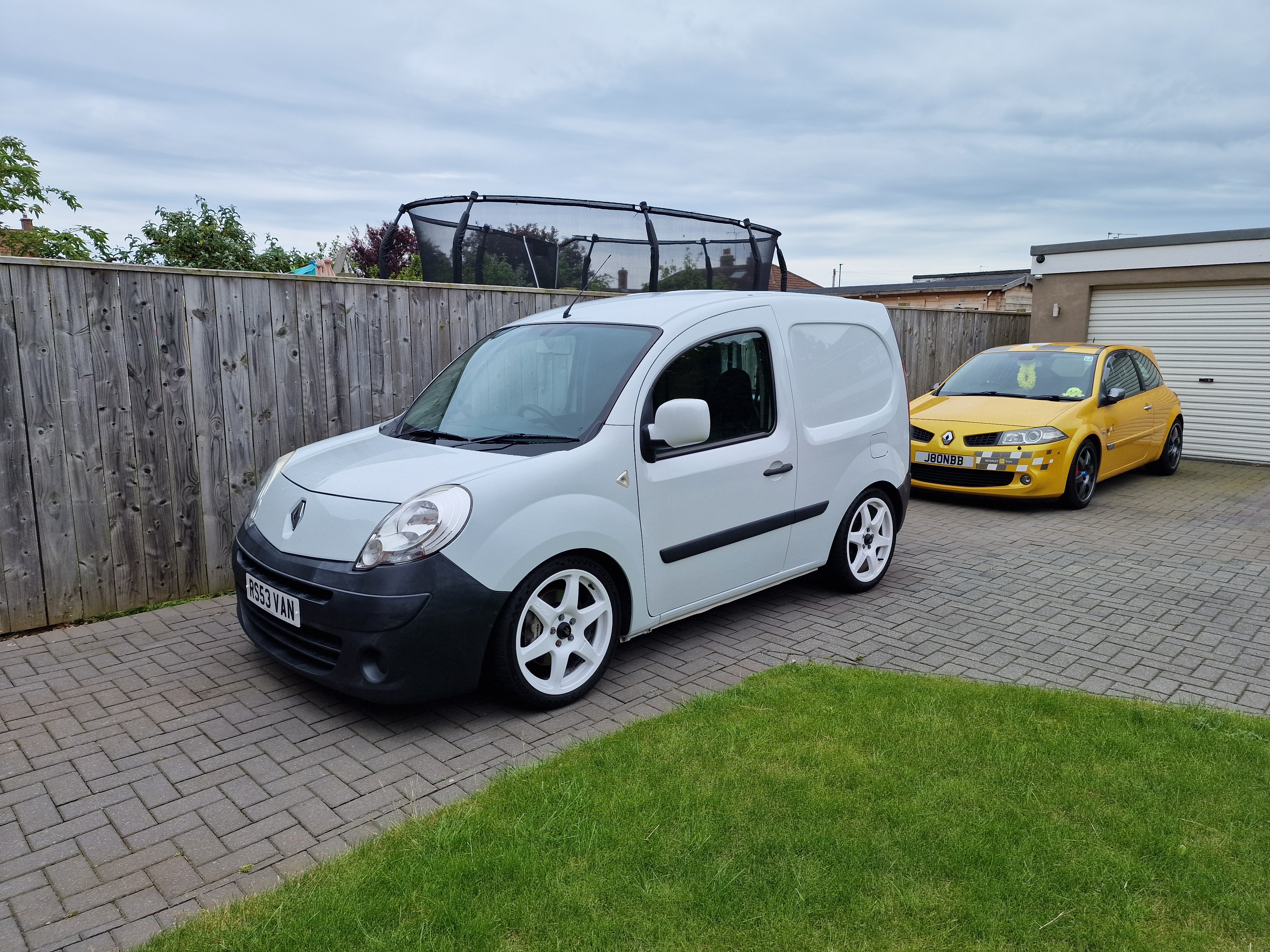

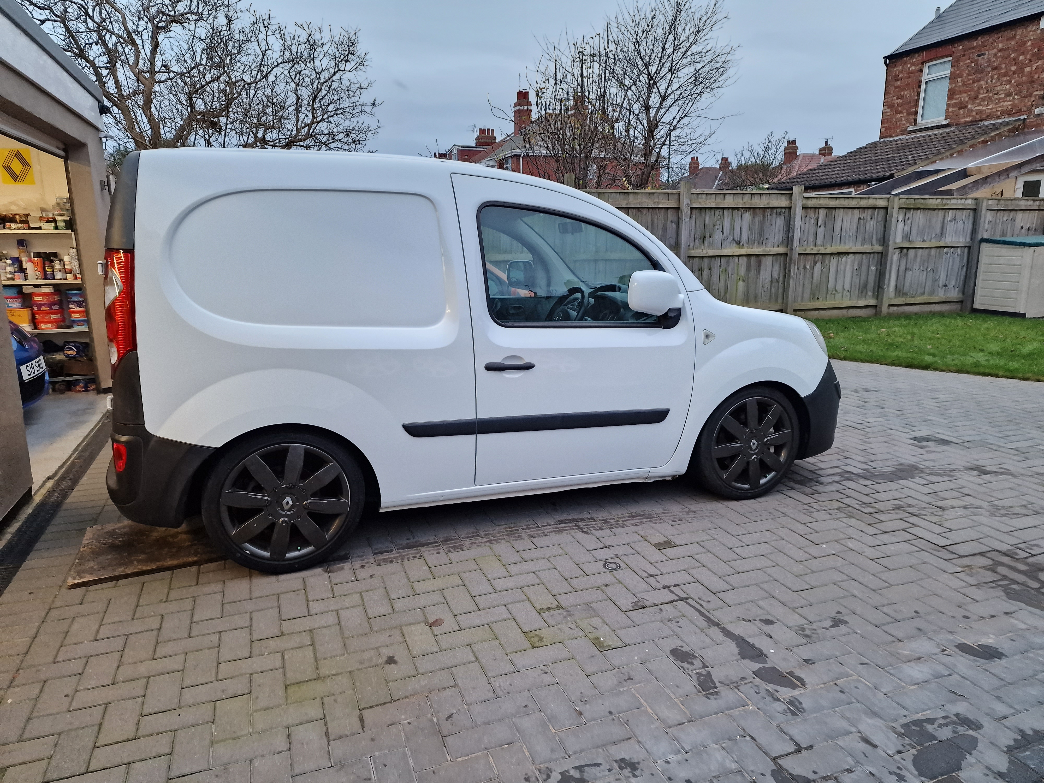

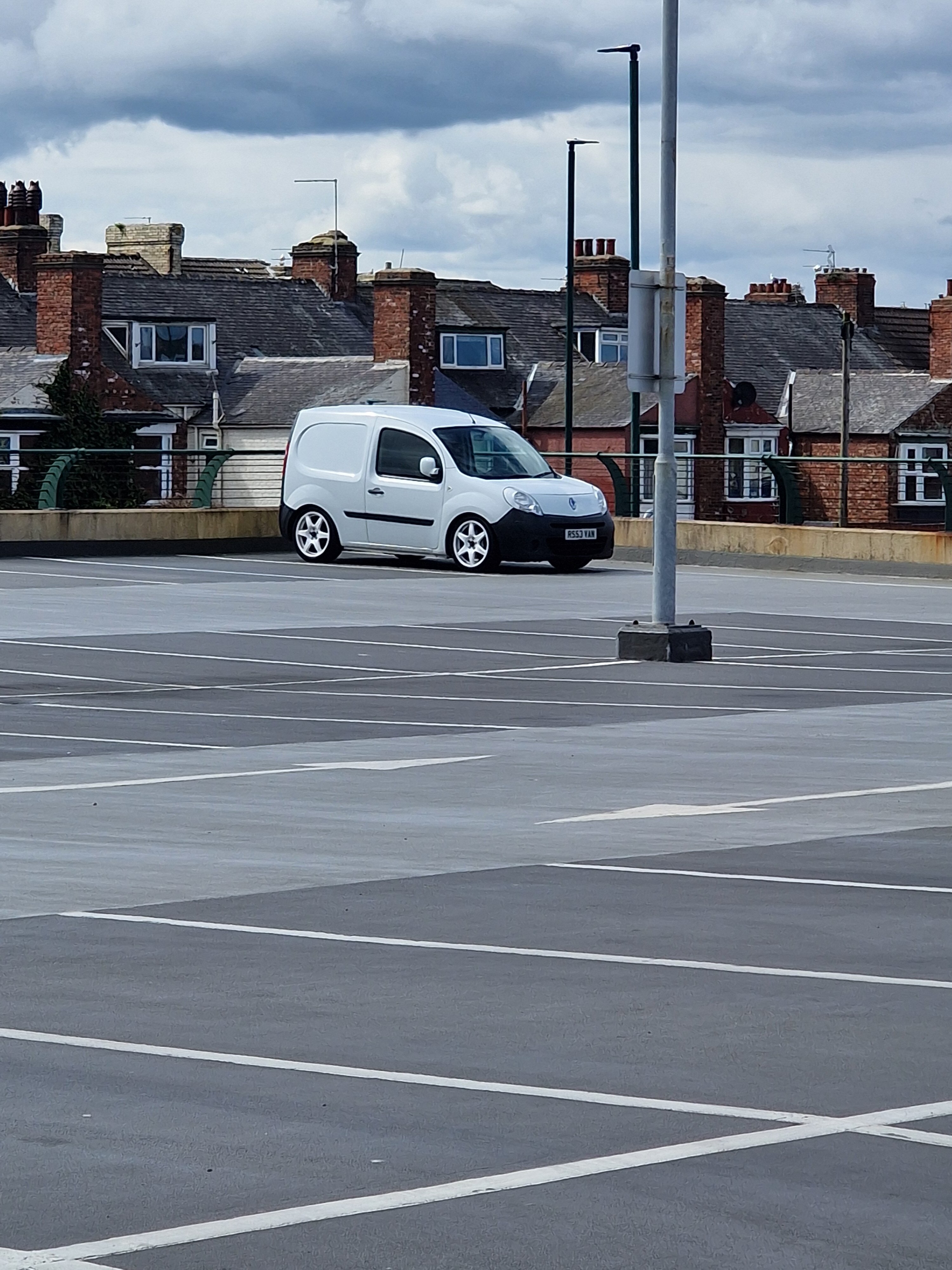

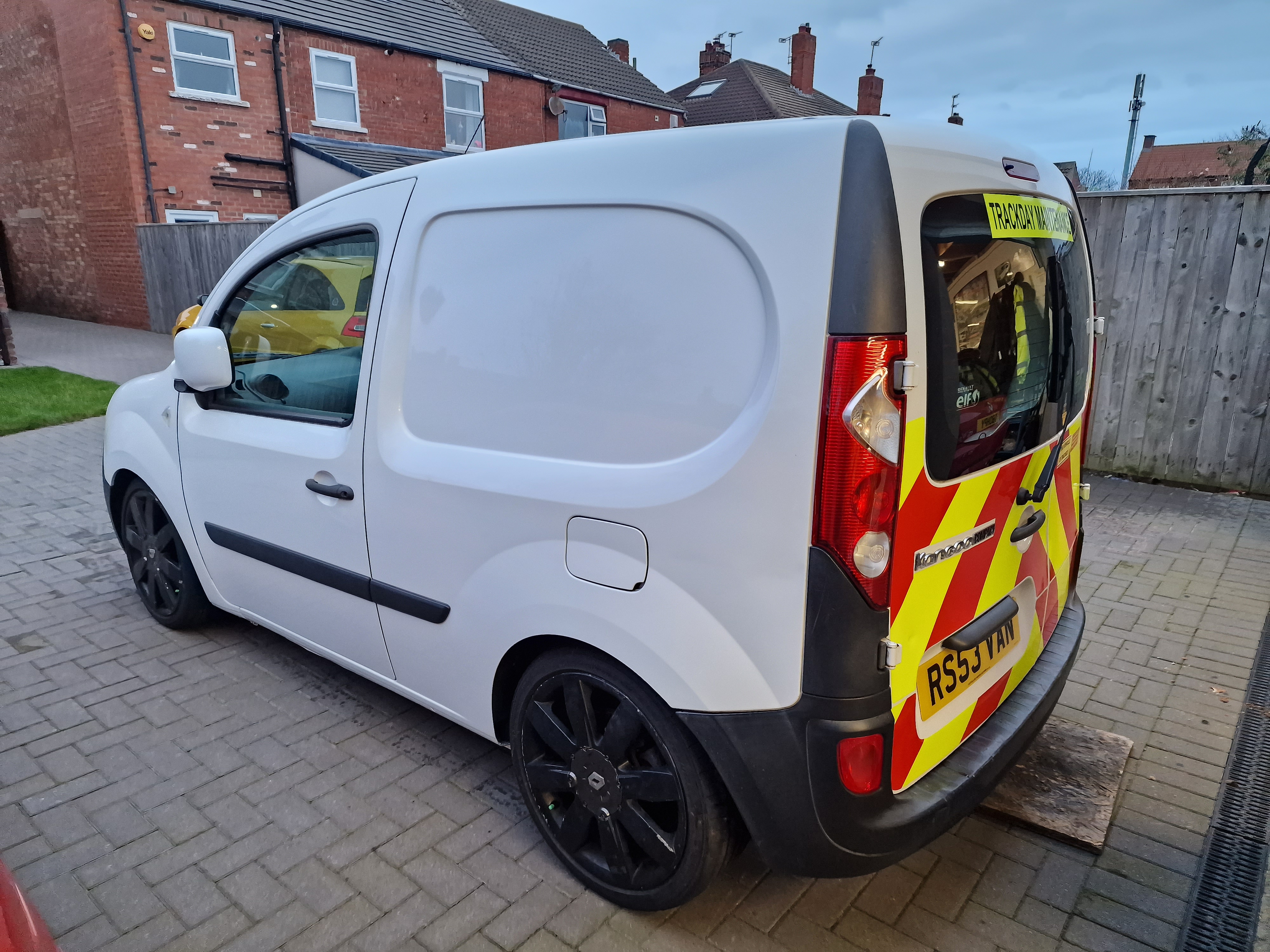

Kangoo not moved for a couple of weeks, had a few bits to pick up today so took it for a run out.
Anti Social parking as usual.
Work van nothing to see here.
Perfect vehicle for the task.

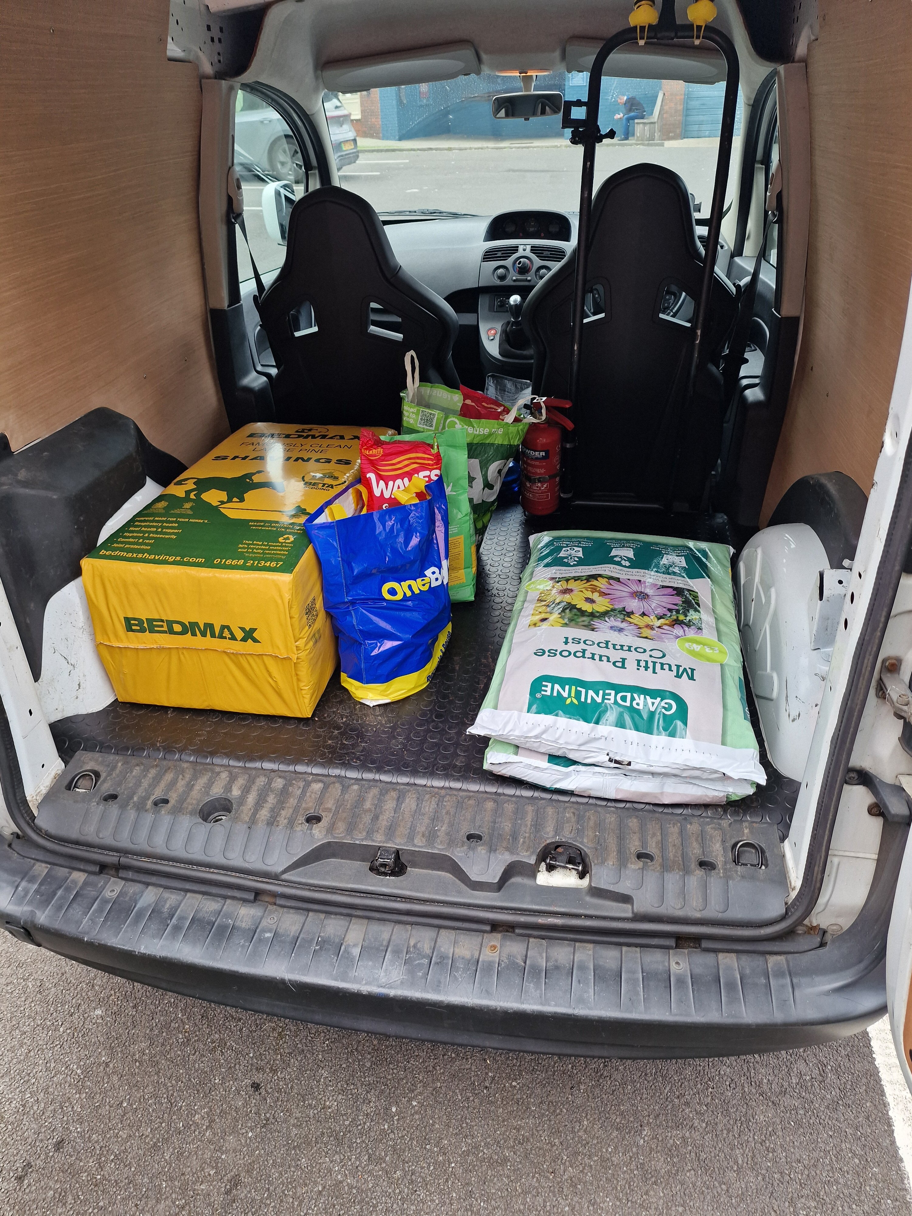

At max load capacity.
