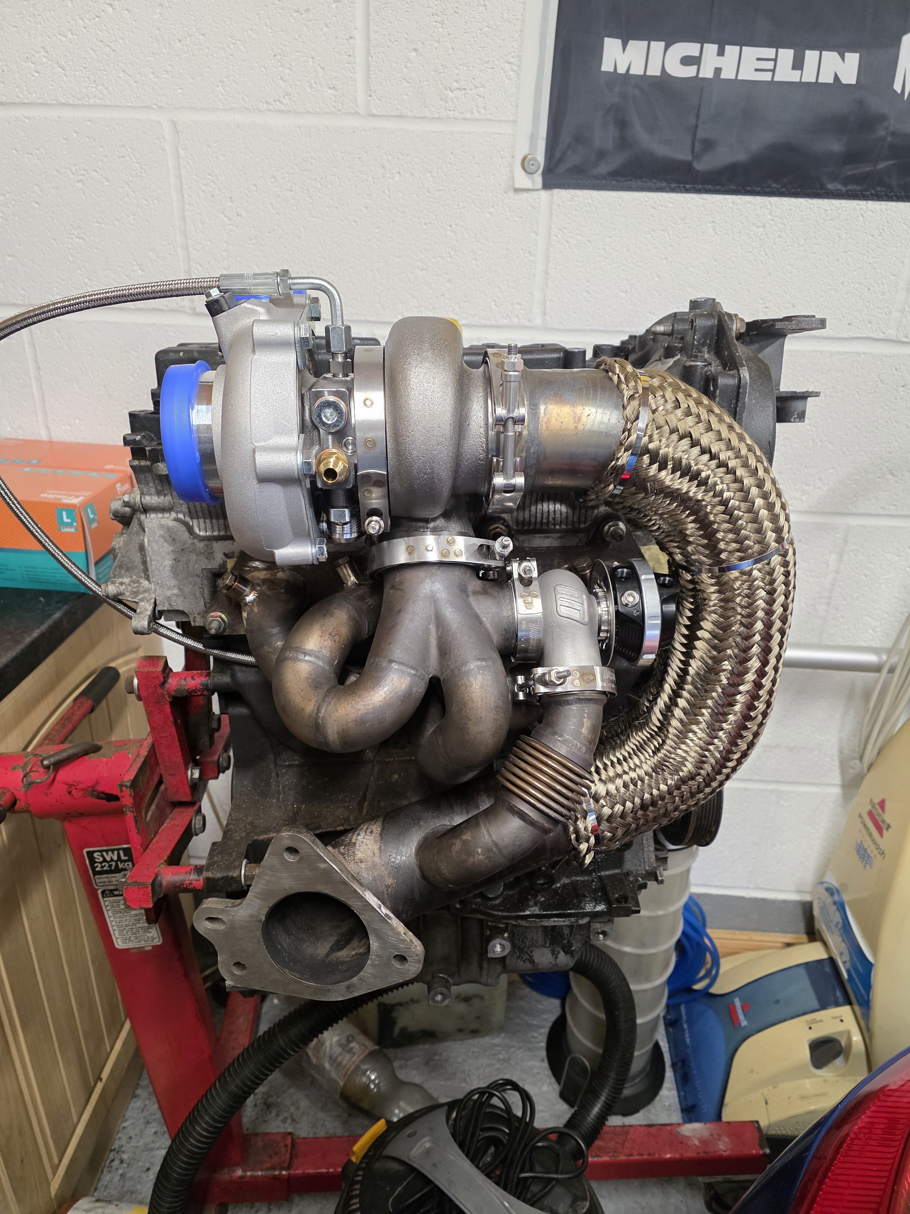

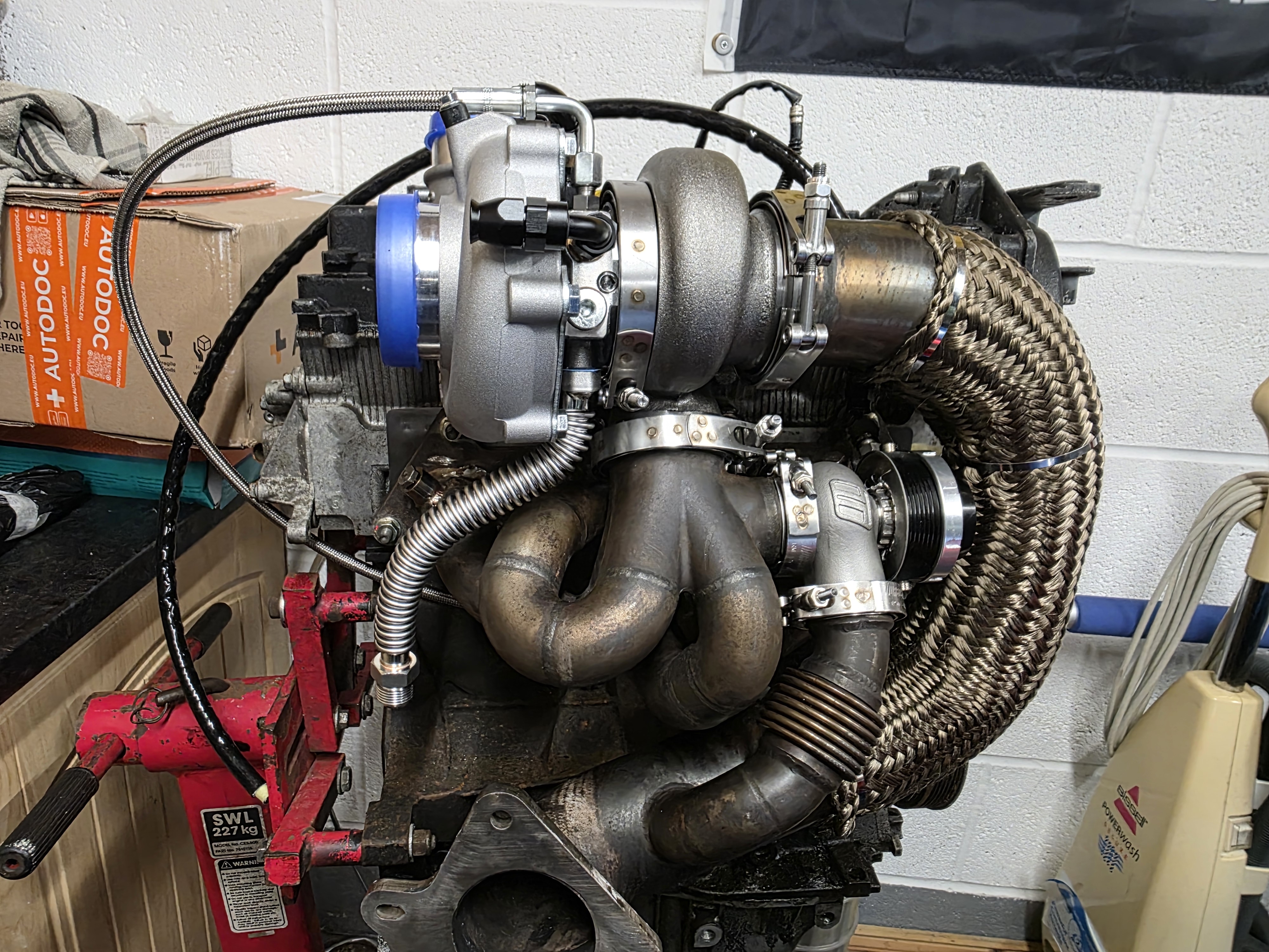

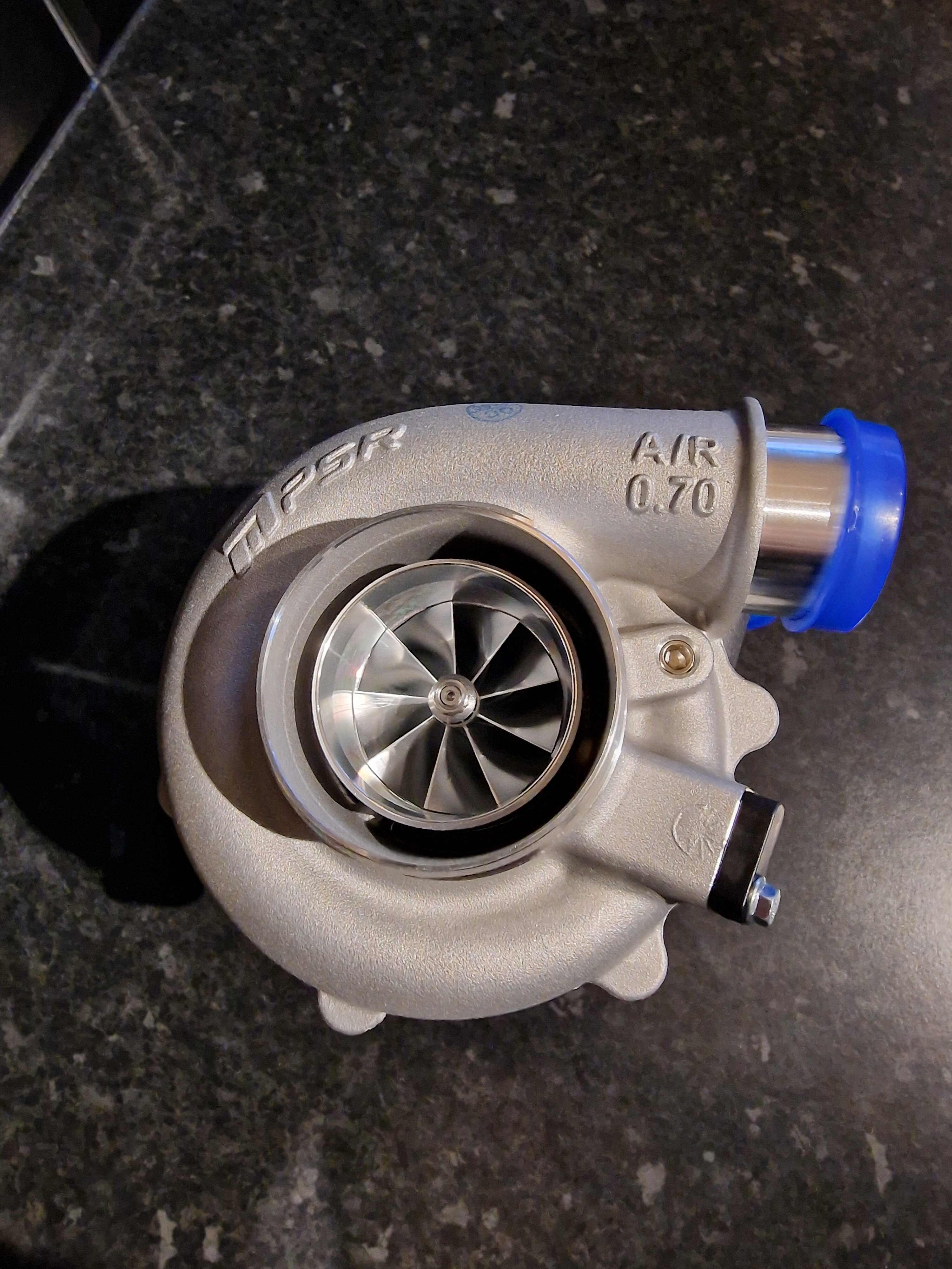

A crack habit would be cheaper than owning this but i might aswell send it. See if my own engine build will make the numbers.
There's the new Gen 2 G series now too.
Do a G25-700.
350-700bhp range.
Cheers mate ill have a look. I think 400hp will be the sweet spot on the street but be nice to have an efficient setup to make good numbers on high boost.
It's a f**king riot with a standard turbo... Let alone a Garrett 😂
Honestly needs no more power but ill send it regardless :LOL: Cant wait to see what it goes like on a g series setup.

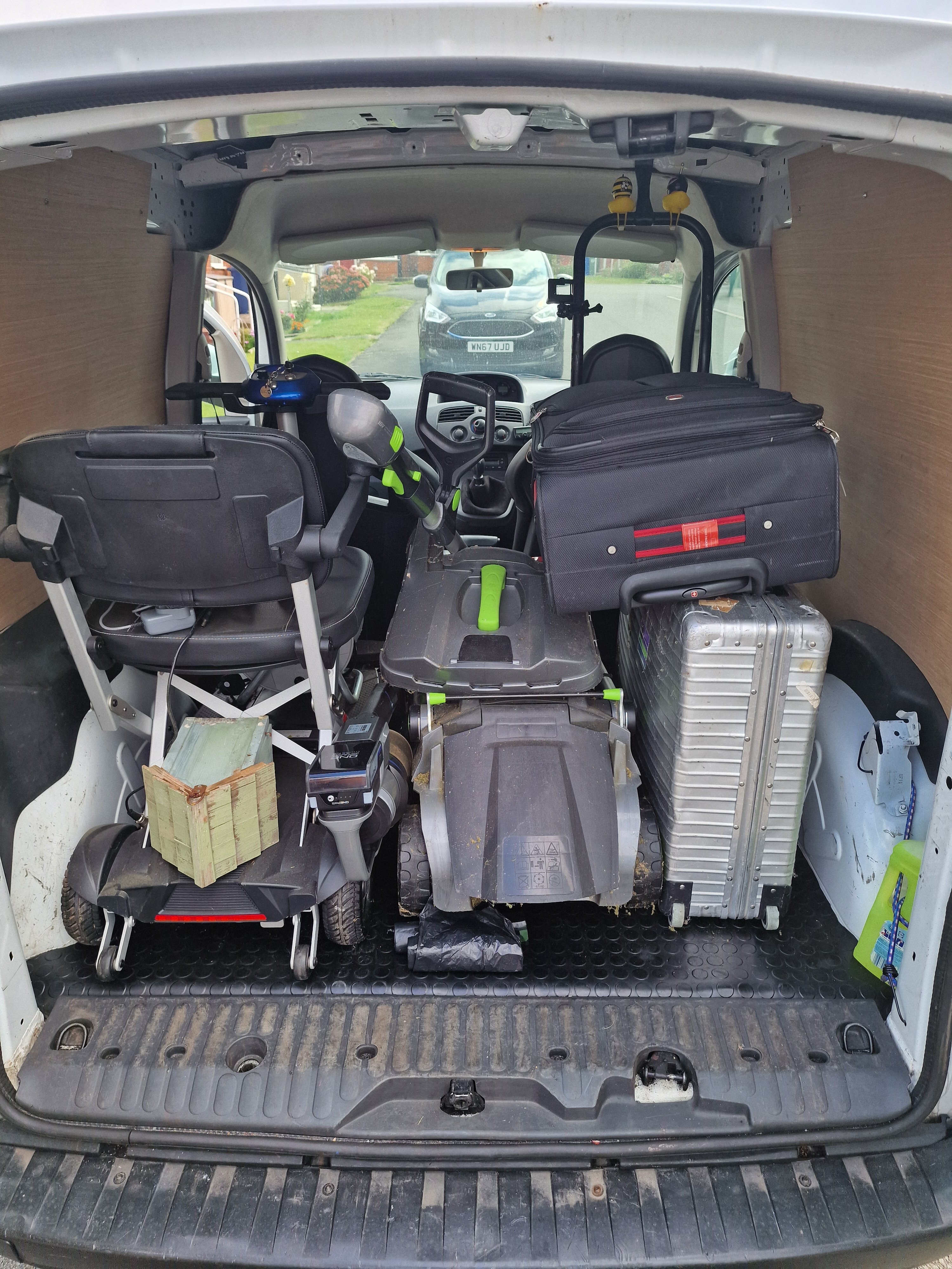

260 mile round trip. Easy driving apart from lack of air con.

Used the Kangoo to take my track wheels down to local garage for tyre swap. 4x 18" wheels and 4x 18" tyres is a bit of a squeeze :LOL:

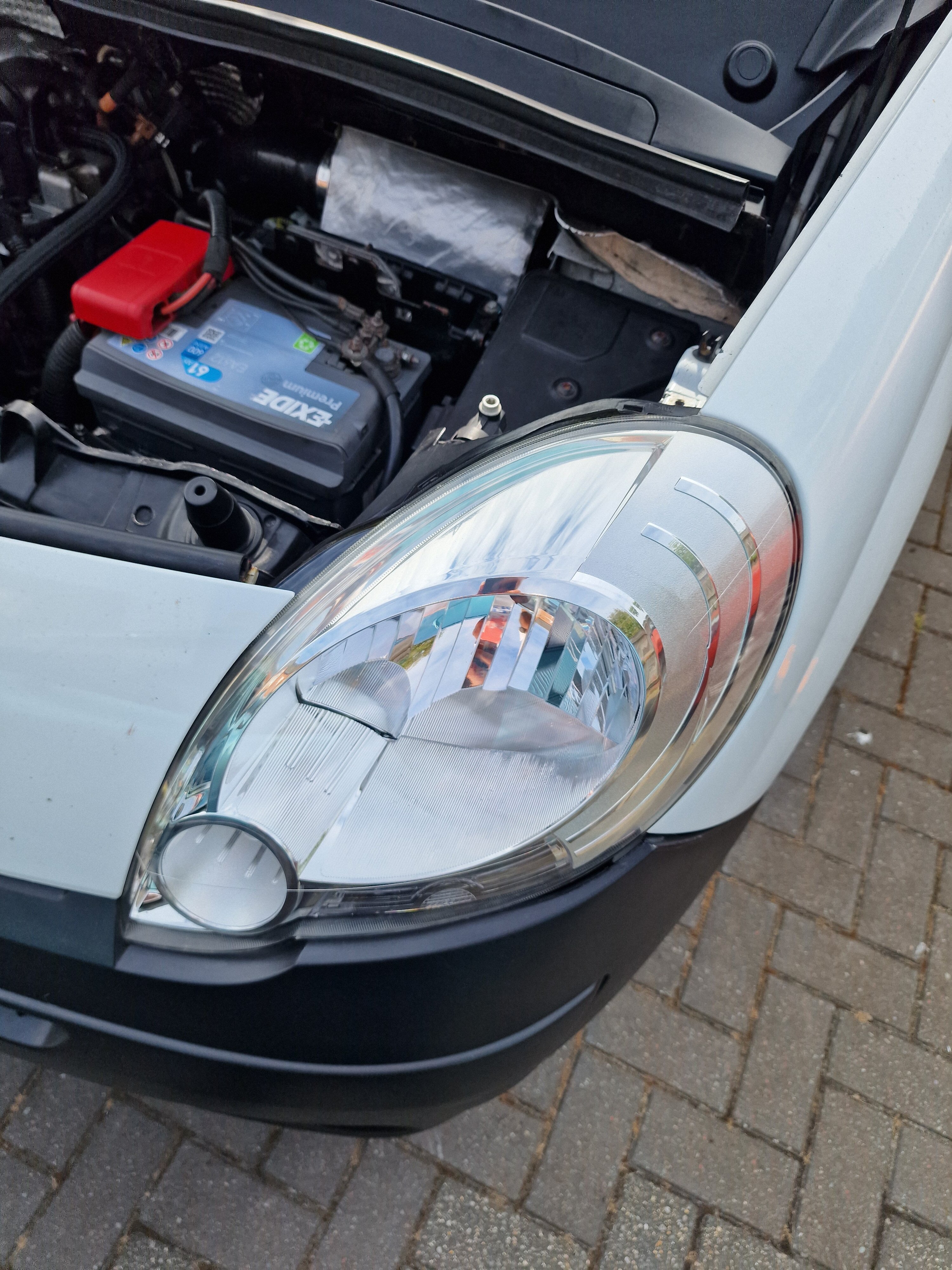

Kangoo headlamps were starting to yellow/uv fade on the top. Not the worst but longer you leave it, the harder it is to get them nice again.
Hard to get a pic but on their way at the top.

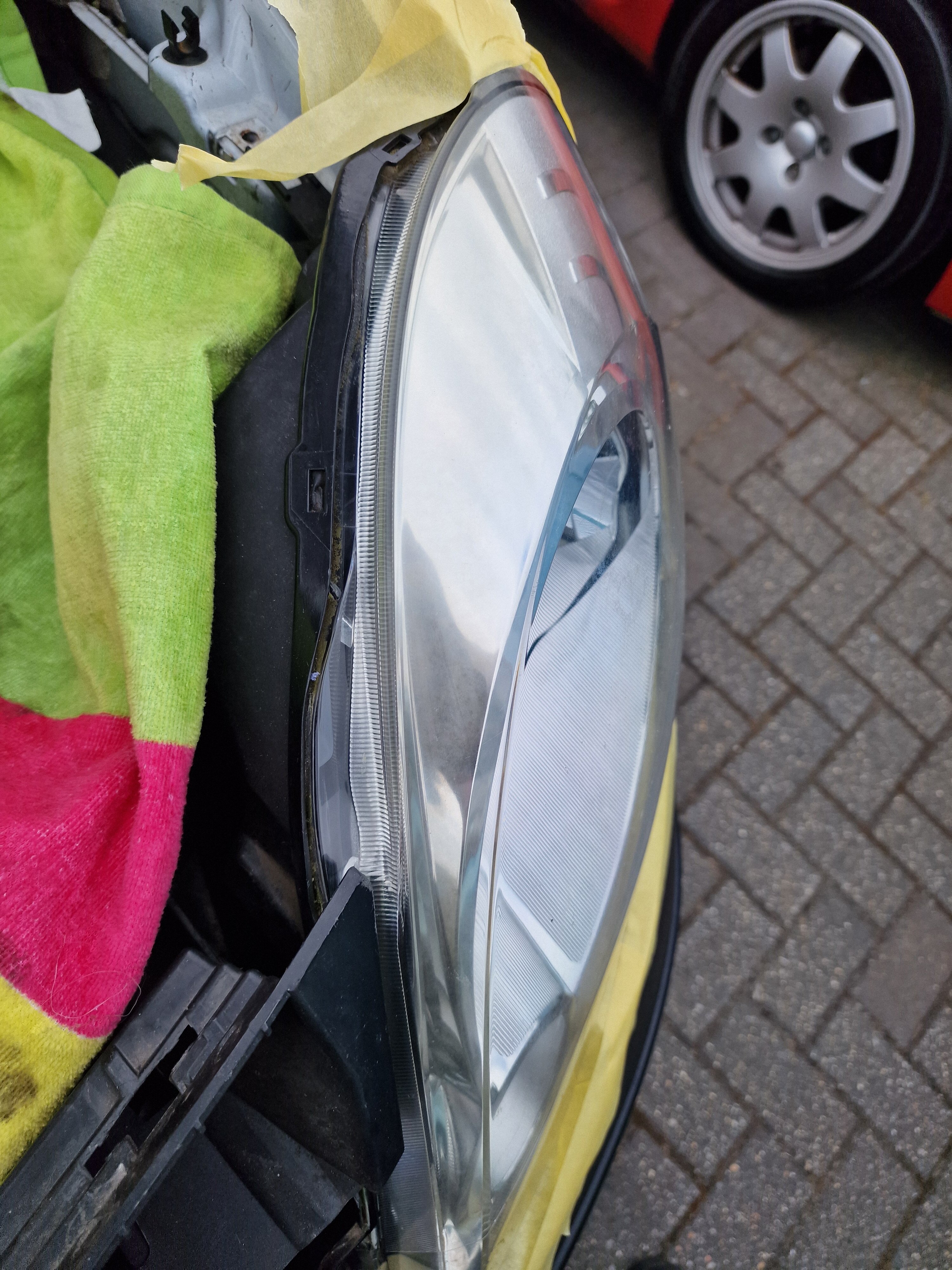

No wetsanding required, panel wipe, cutting compound / medium pad on da polisher, followed by final polish using finishing pad.
15 mins, done.
Used a ceracote trim wipe on them to protect from uv.
Whilst the wipe was still wet i done the scuttle panel, as the wipes go quite far if your fast.
From faded grey to black again.
