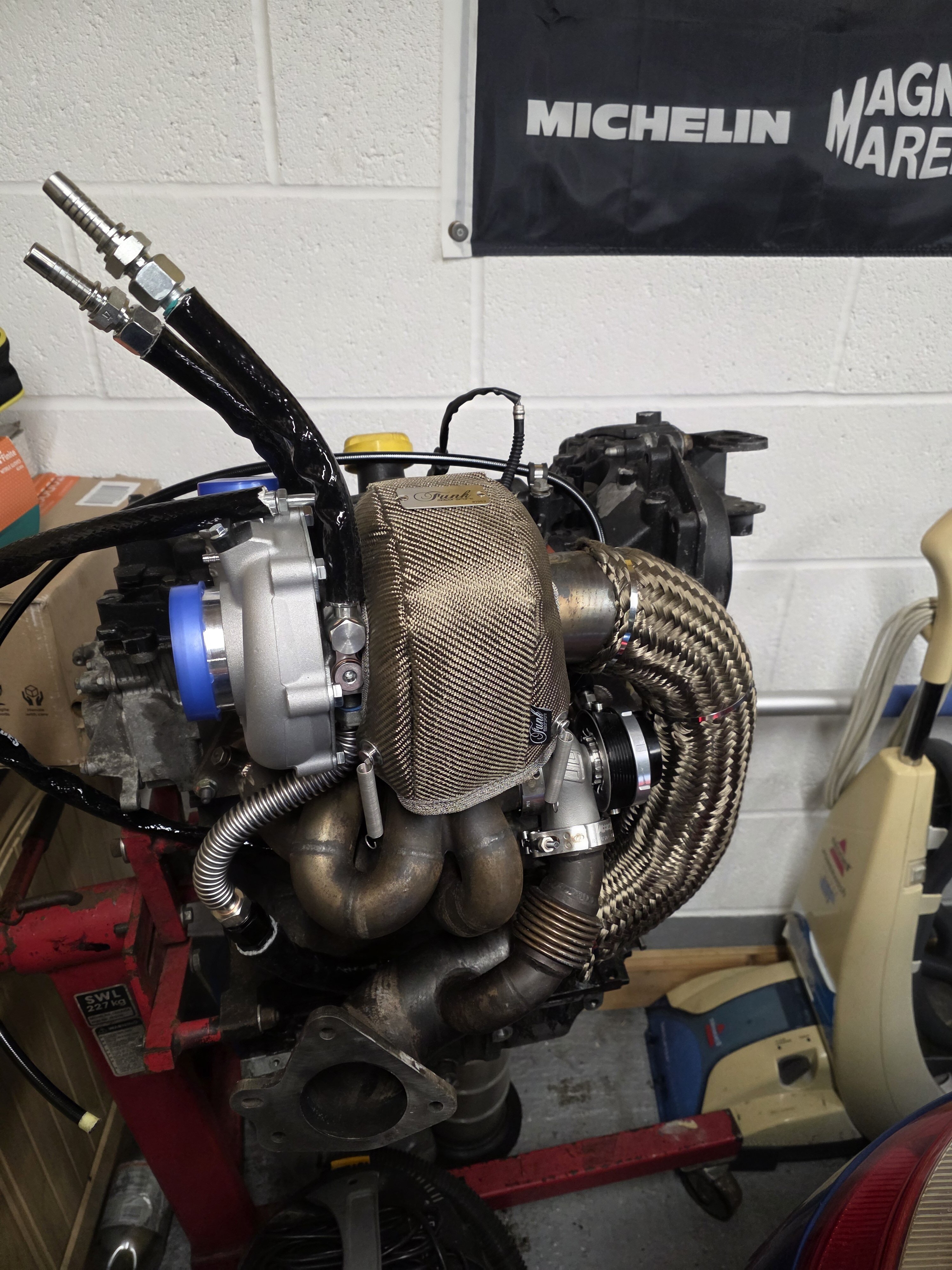

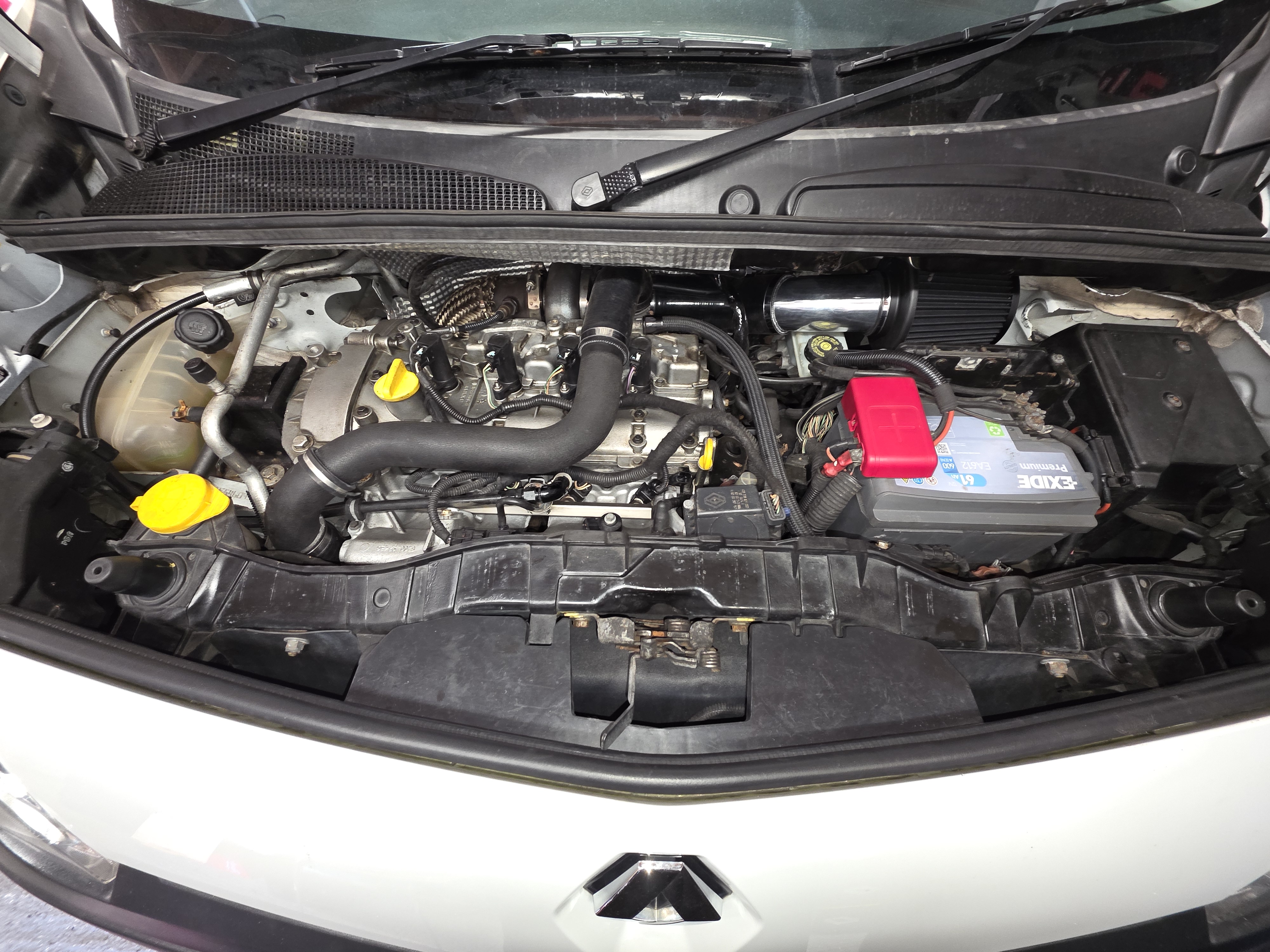

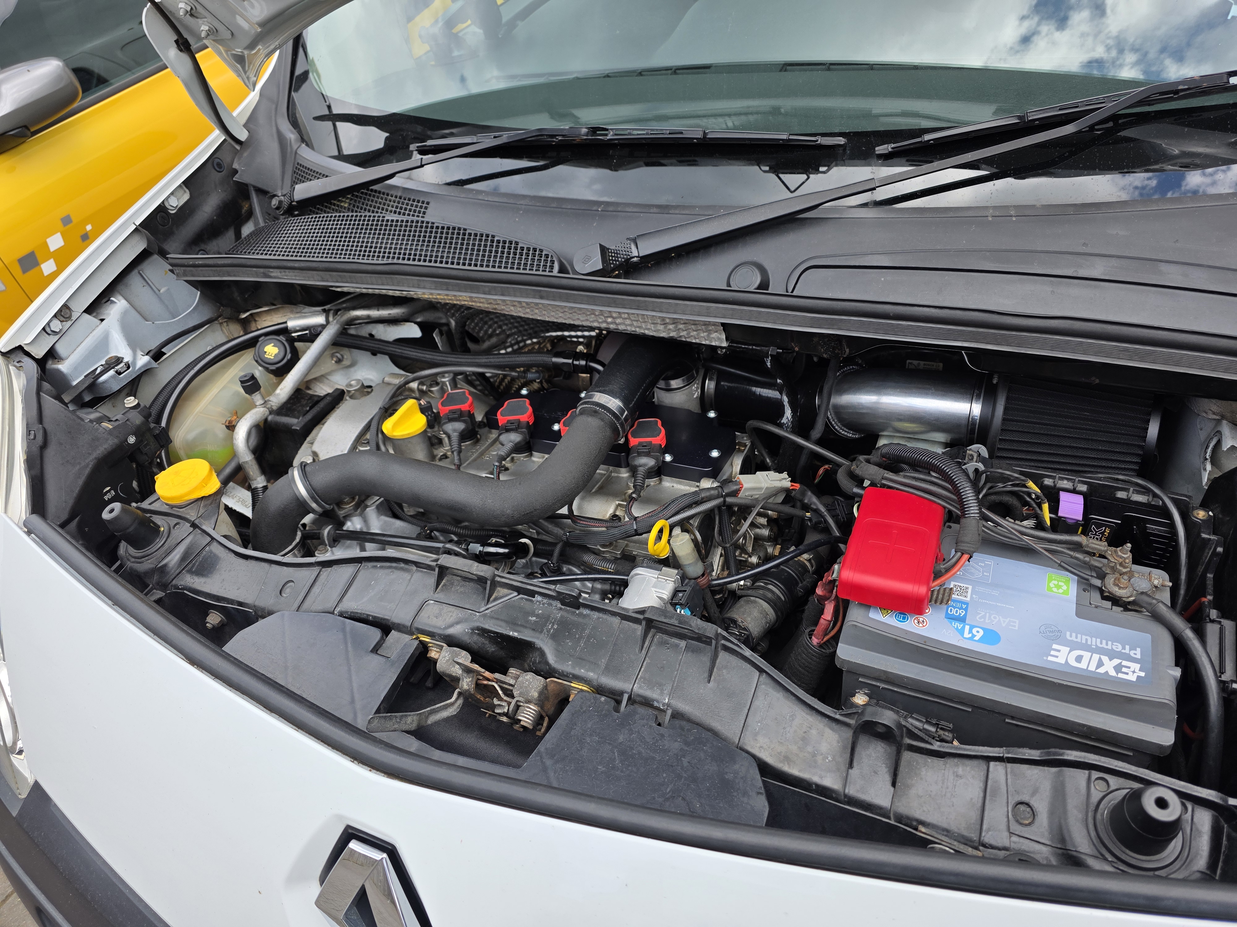

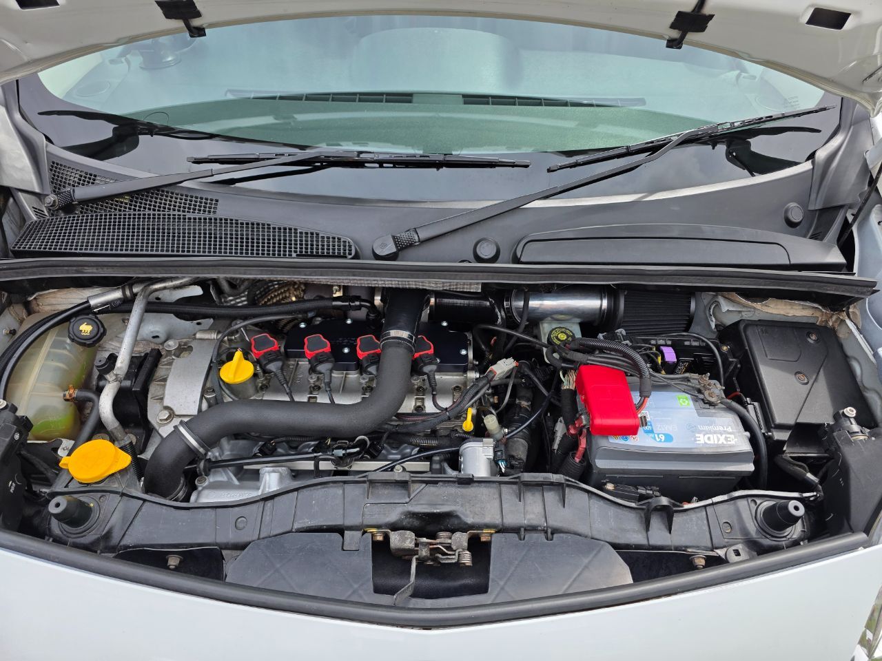

Had last week off work so cracked on fitting the new g25 660 turbo setup.
To recap mocked up on the spare engine.

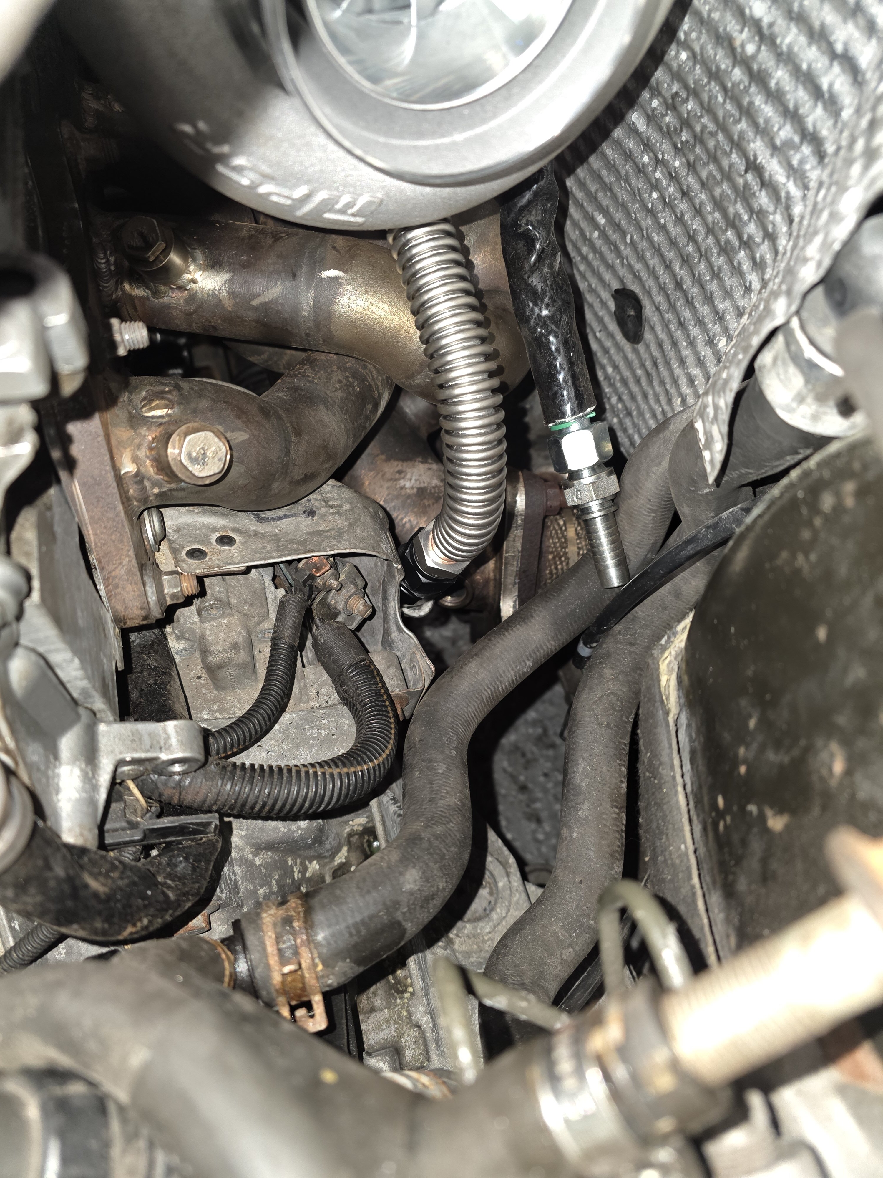

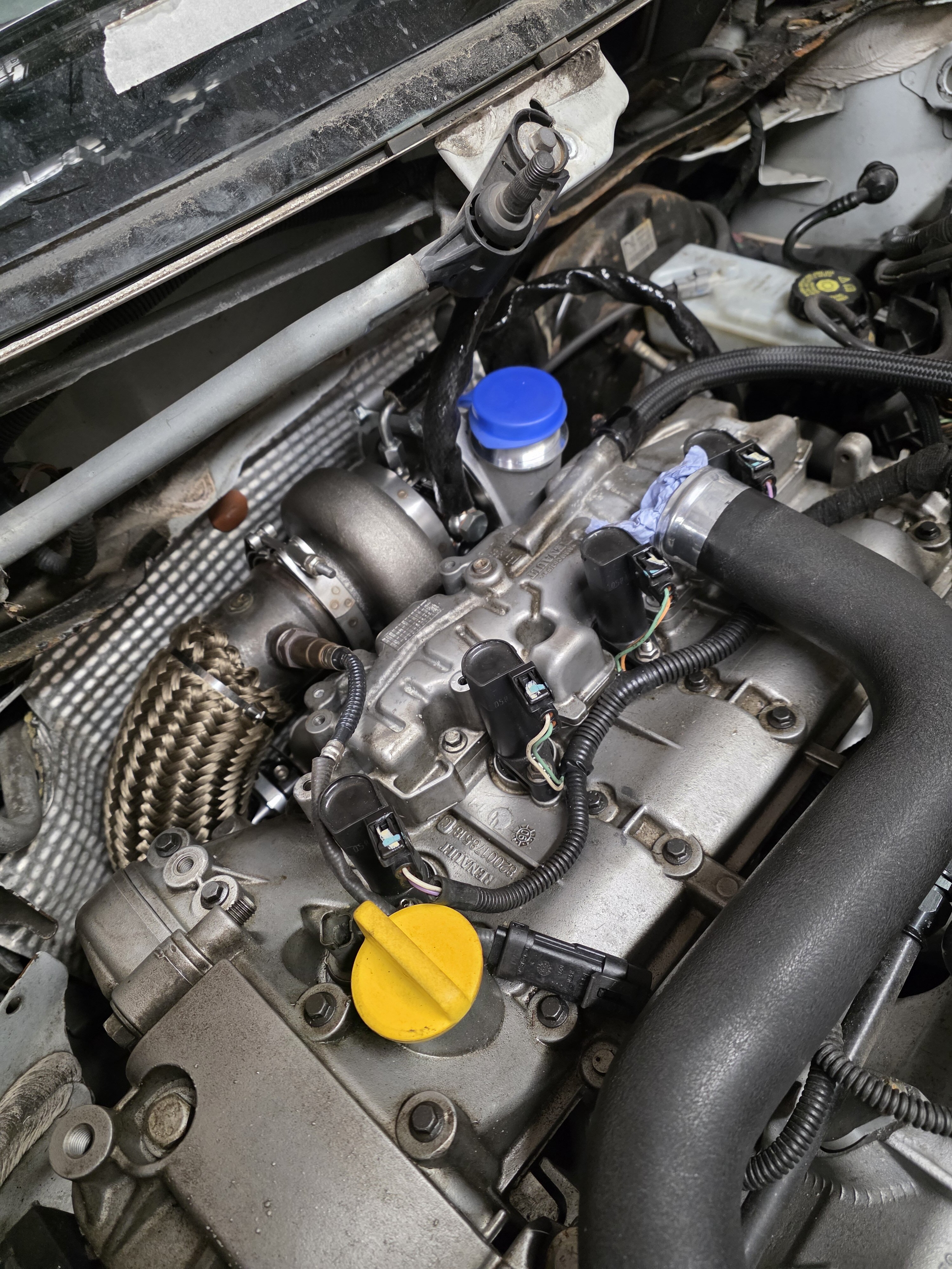

Started by stripping the 20t hybrid, manifold and downpipe off, oil feed and return removed. Plenty of room with scuttle removed. Turbo first, then manifold, then downpipe out via the top.
Fitting the new setup was reverse of the above. Oil feed in, downpipe in then manifold, external wastegate on then turbo.
External wastegate in situ. Fiddly to fit even though on vbands.

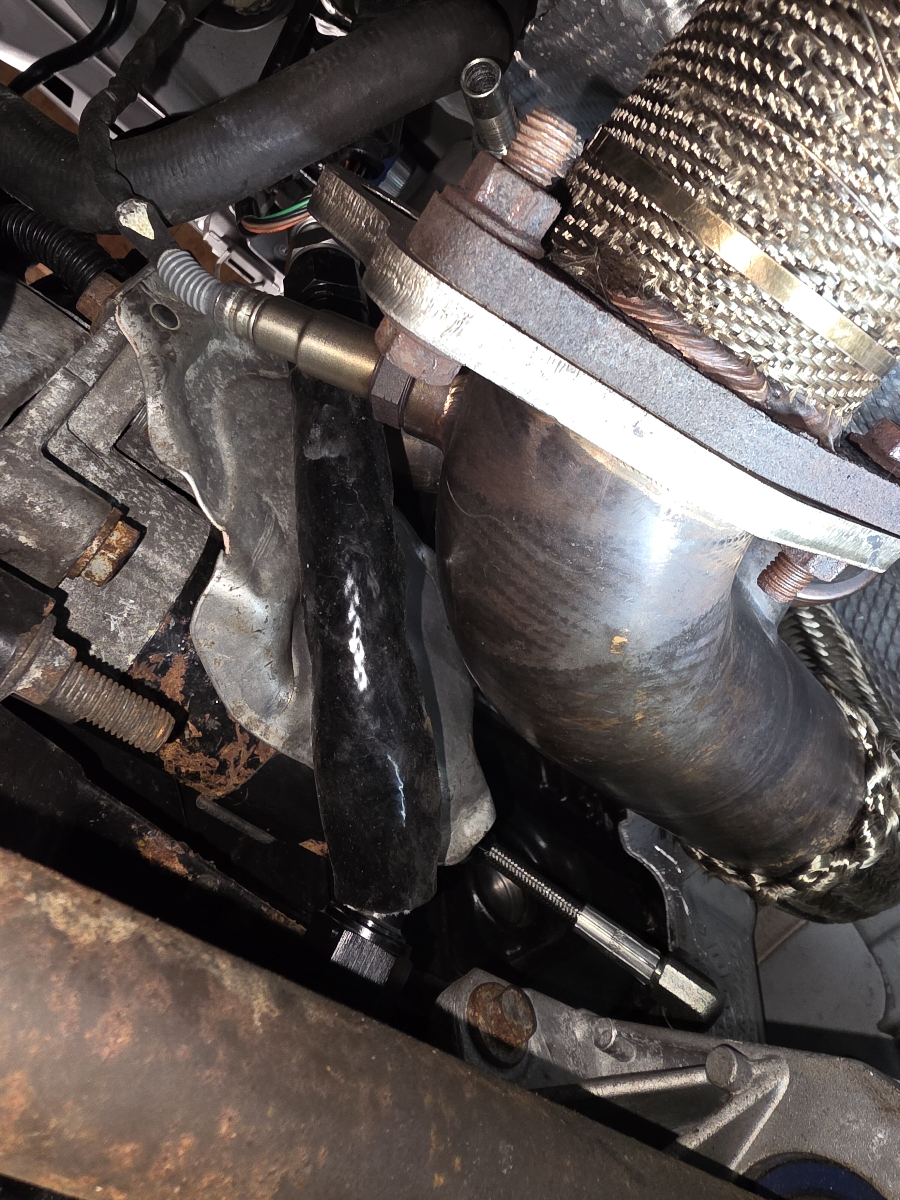

Starter motor heatshield was tight and required a bit of clearance adding with deadblow hammer to clear number 1 exhaust runner. From what ive seen a few people dont refit it, but we do stuff right here.

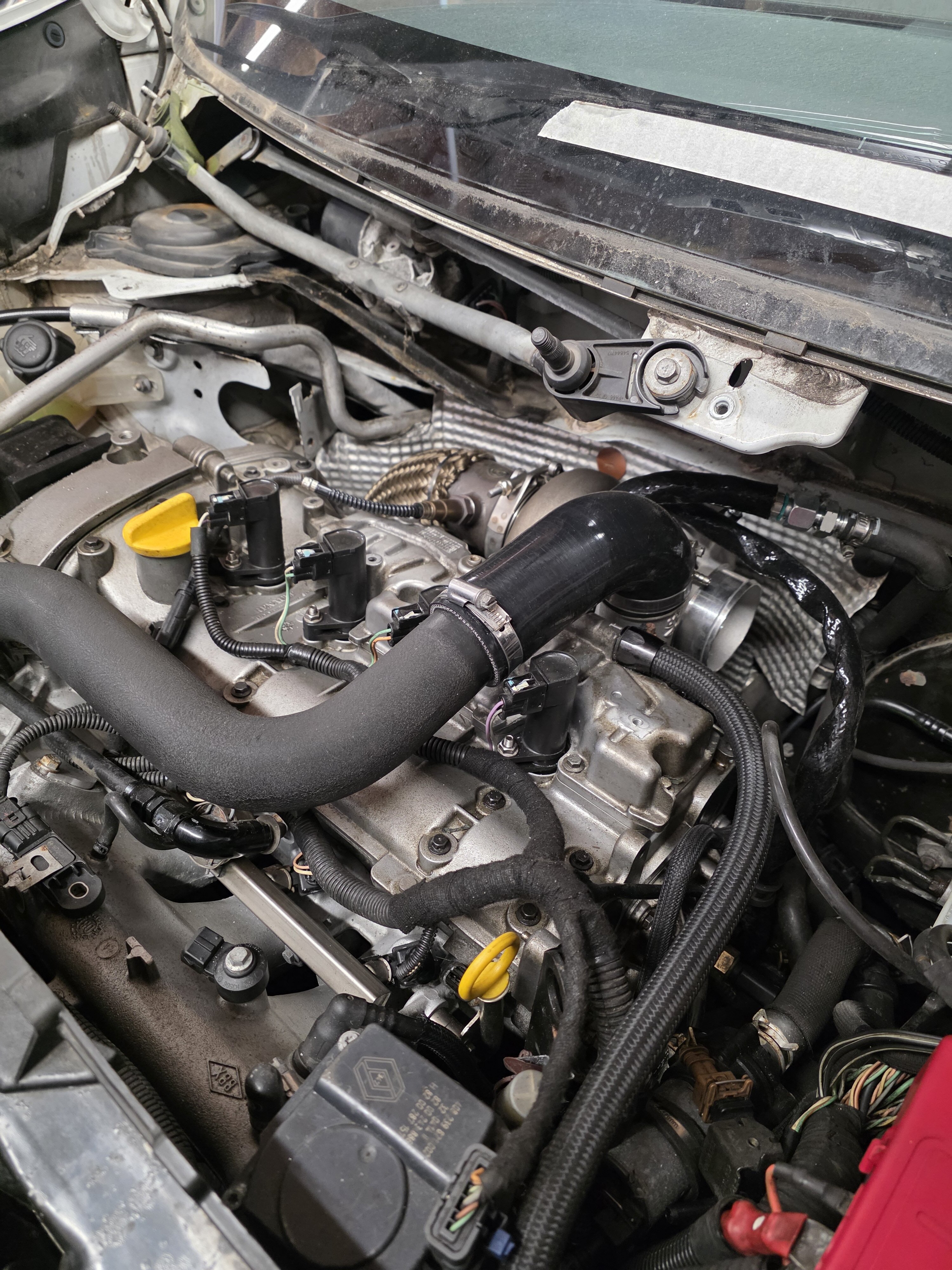

Oil return fitted. Its tight but adequate clearance off downpipe. Might wrap the last bit of the downpipe for added heatproofing

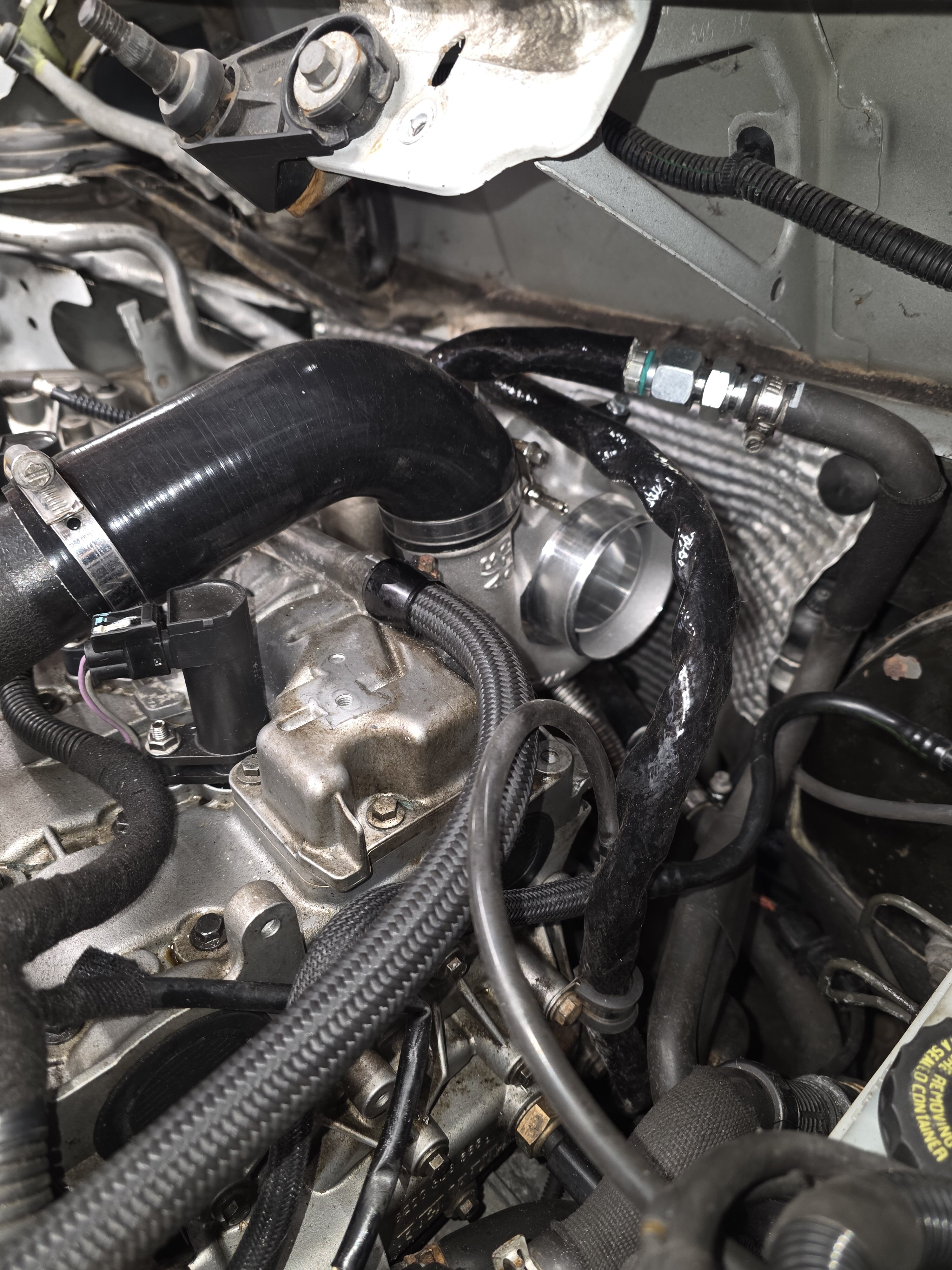

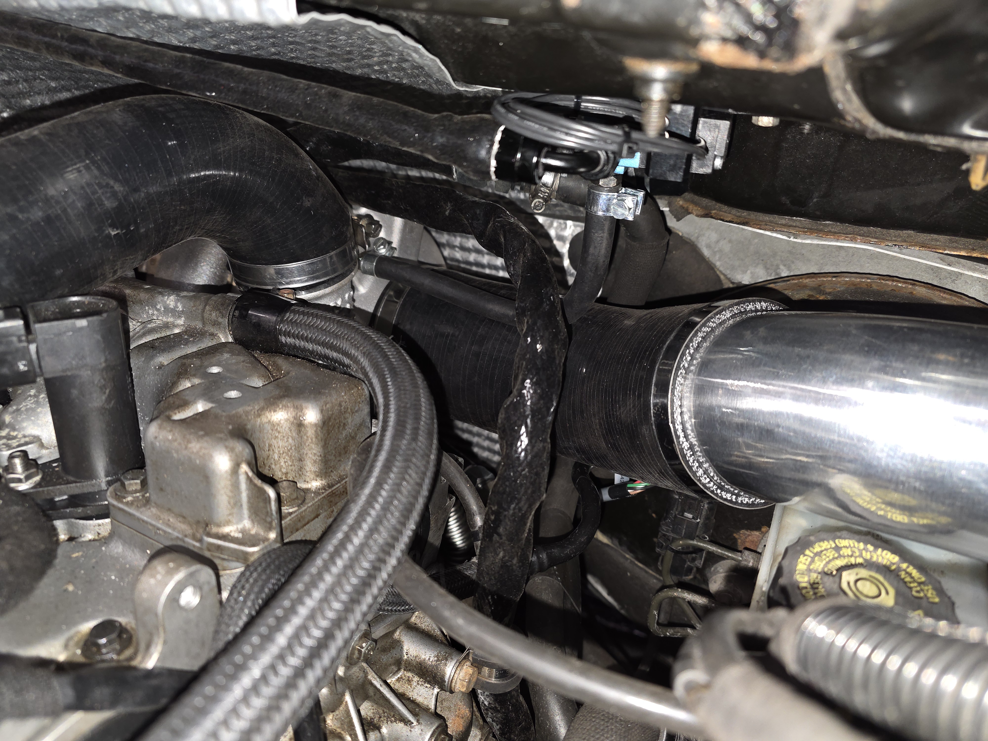

With that done onto boost hose and coolant lines. Trimmed a 90deg silicone hose and the coolant lines are plug and play.

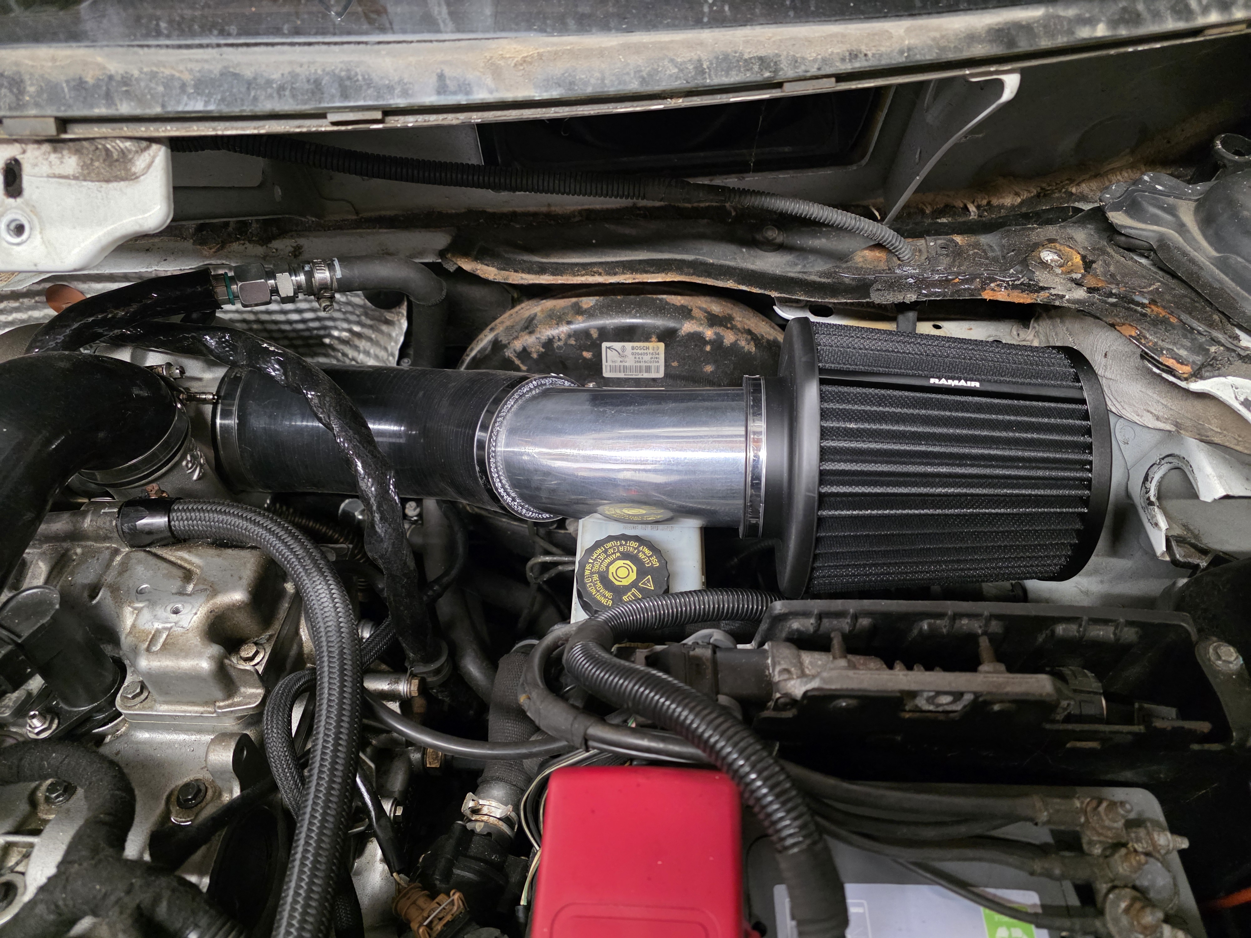

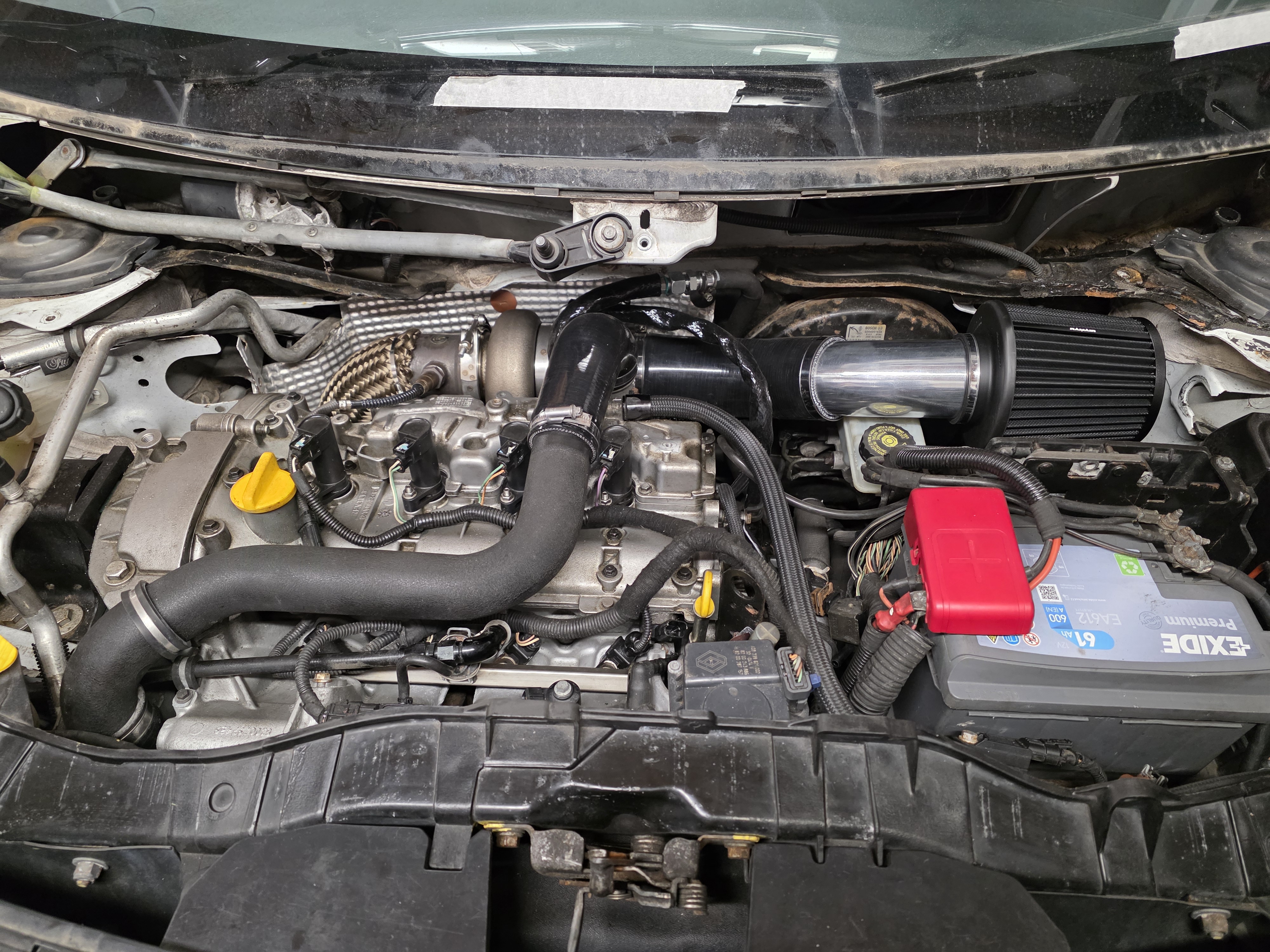

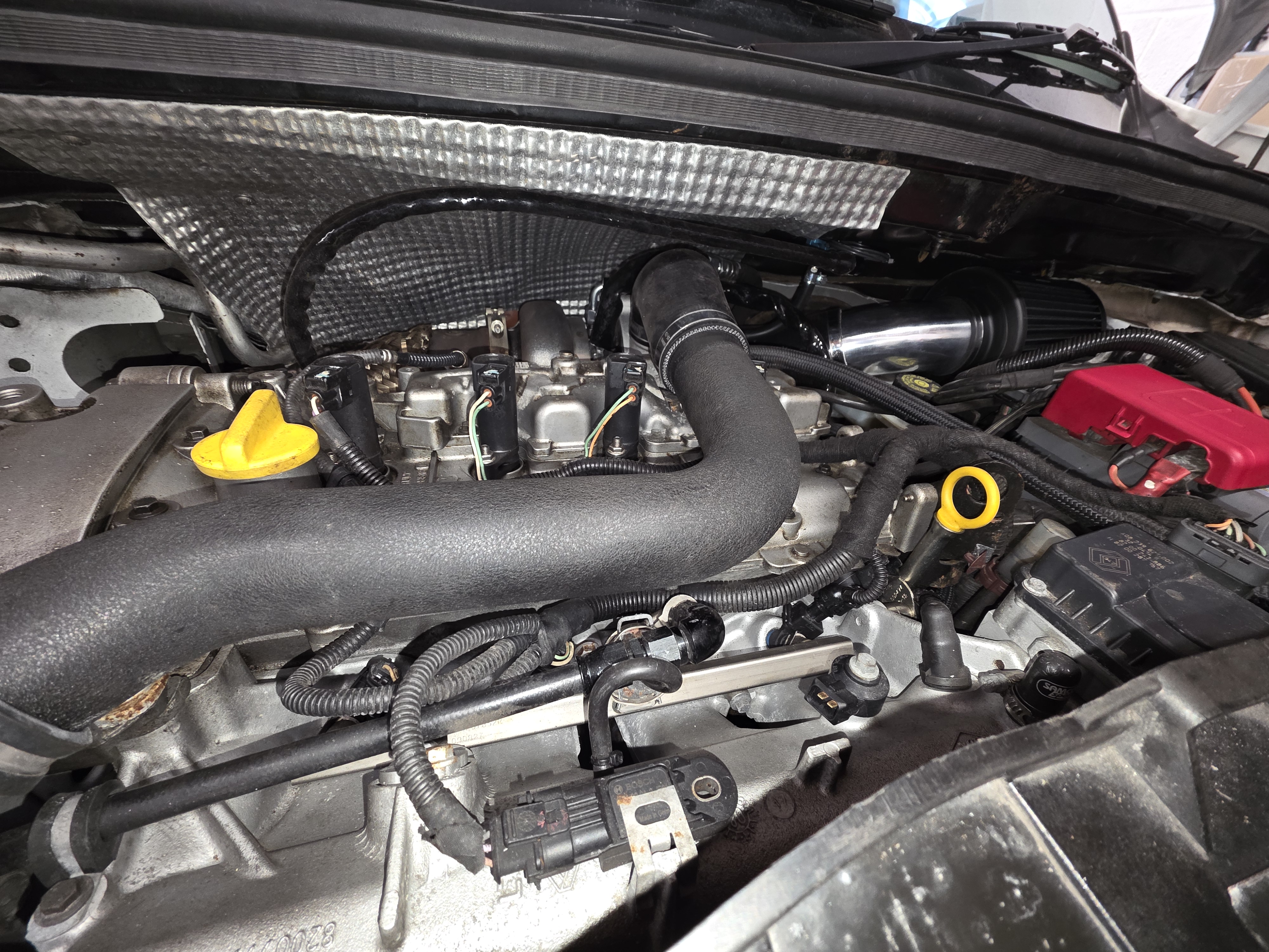

Next job airfilter/induction. 70mm 45deg silicone hose trimmed and 45deg alloy pipe cut to fit. New ramair filter to suit larger bore
With that done i offered the scuttle panel up. Plenty of room.
Mac valve fitted in preperation for Ecumaster Black. Opted to bolt to the scuttle as no optimal place on engine, and the an line is not very flexible but necessary for heat protection.
Done.
Primed up oil system with coils and injectors unplugged, with turbo oil feed into a bottle to check flow. All good, fitted to turbo and primed turbo with more cranking. Reconnected injectors and coils and hit the switch.
Fired straight up, check for leaks and none. Sounds totally different to the stock manifold/hybrid.
Around 1.5days of work steady away, so not too bad to do.

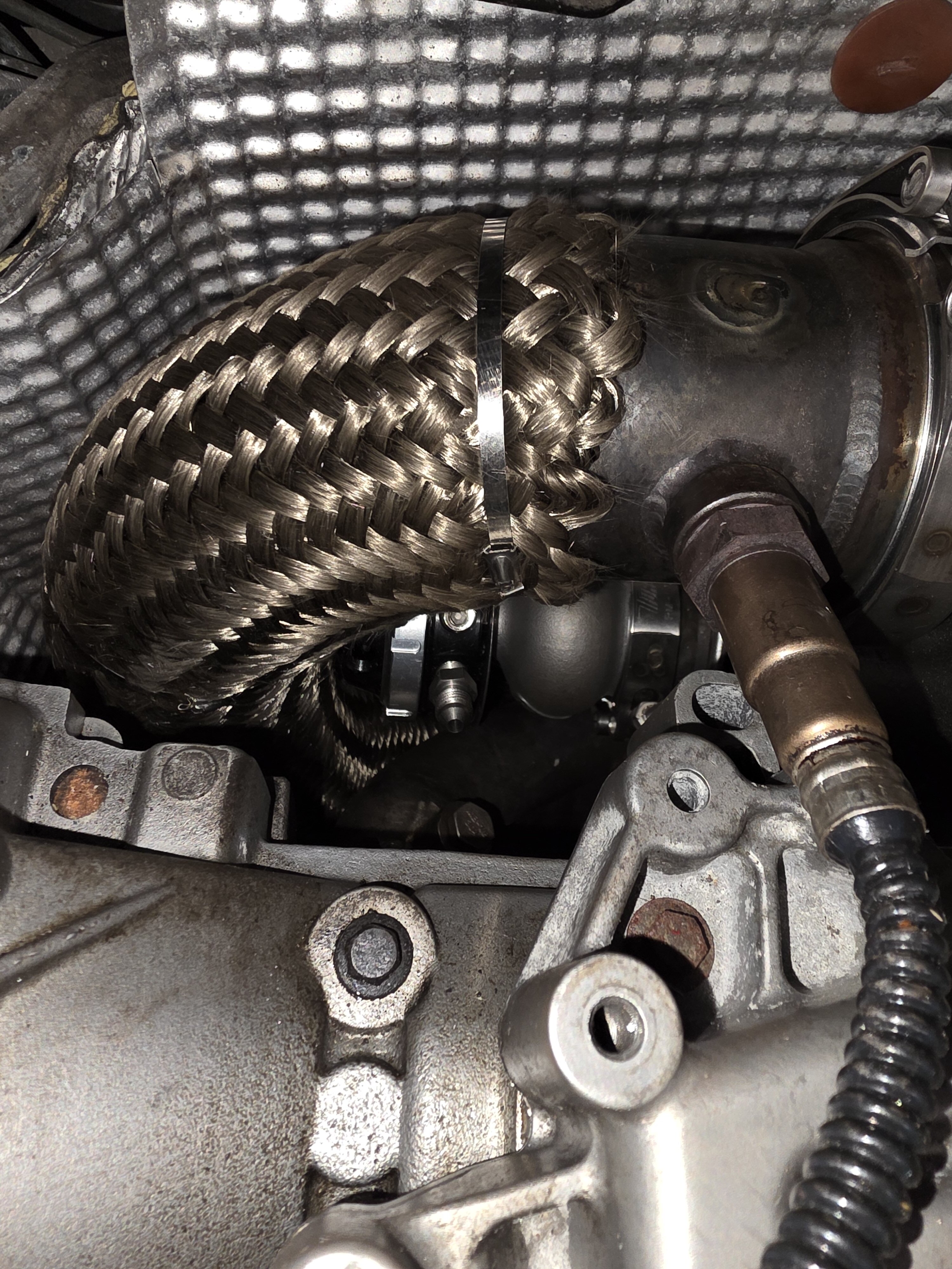

WIth that done, taxed and out for a test run.
Test drive went well, heat wrap on downpipe smoked like fcuk for a bit but sorted itself out fast. As im on the old map for the hybrid, i cant give it much stick but it spools well and is responsive, seen 7psi around 3500rpm iirc.
In the words of the mrs, it sounds unbelievable. Worth doing for the sound alone.
Ive done 50 or so miles and no issues. Onto ph2 which is ecumaster black install and modified inlet. Aiming for mapping in 6-8 weeks.
Thanks for reading!!

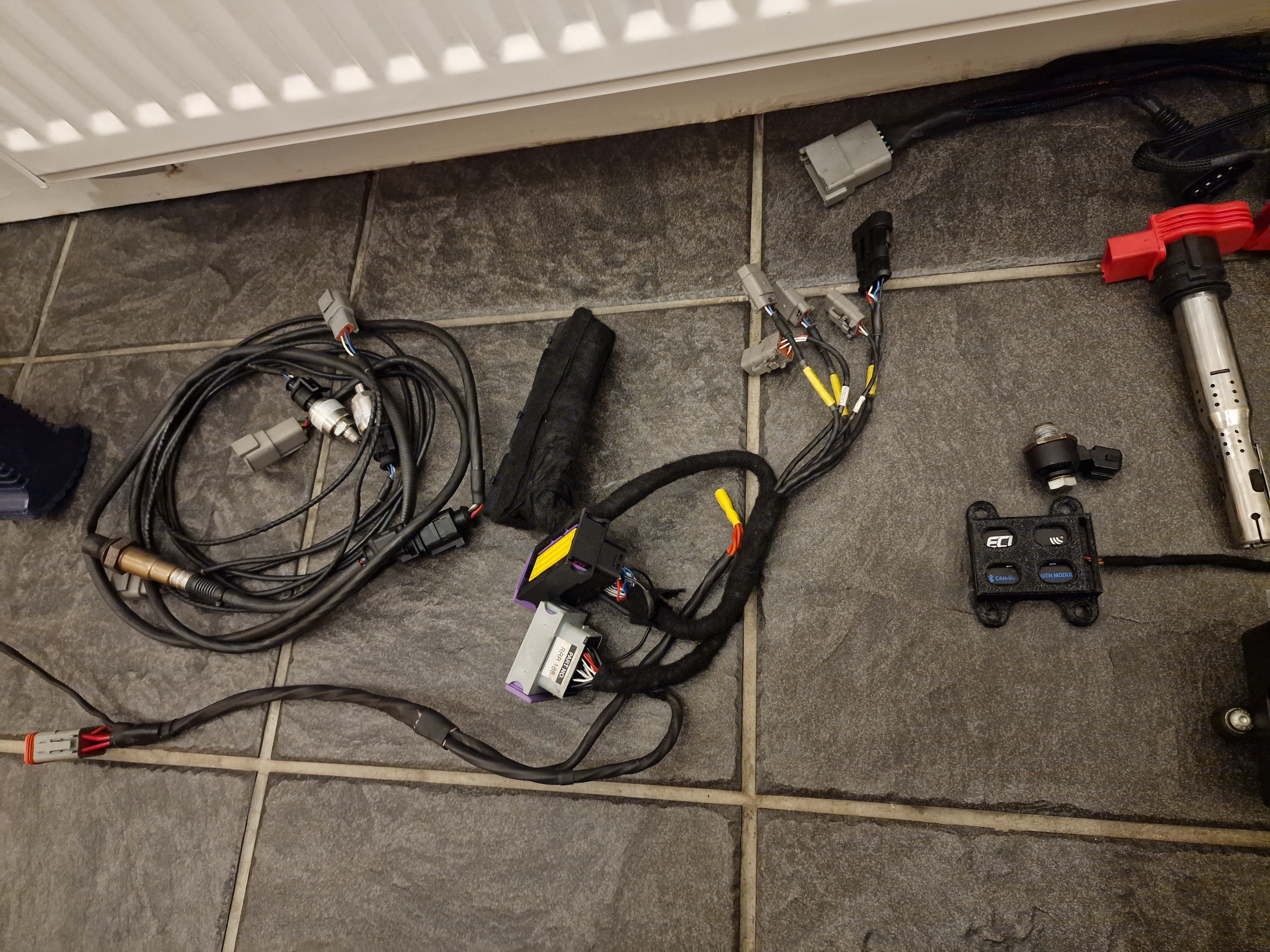

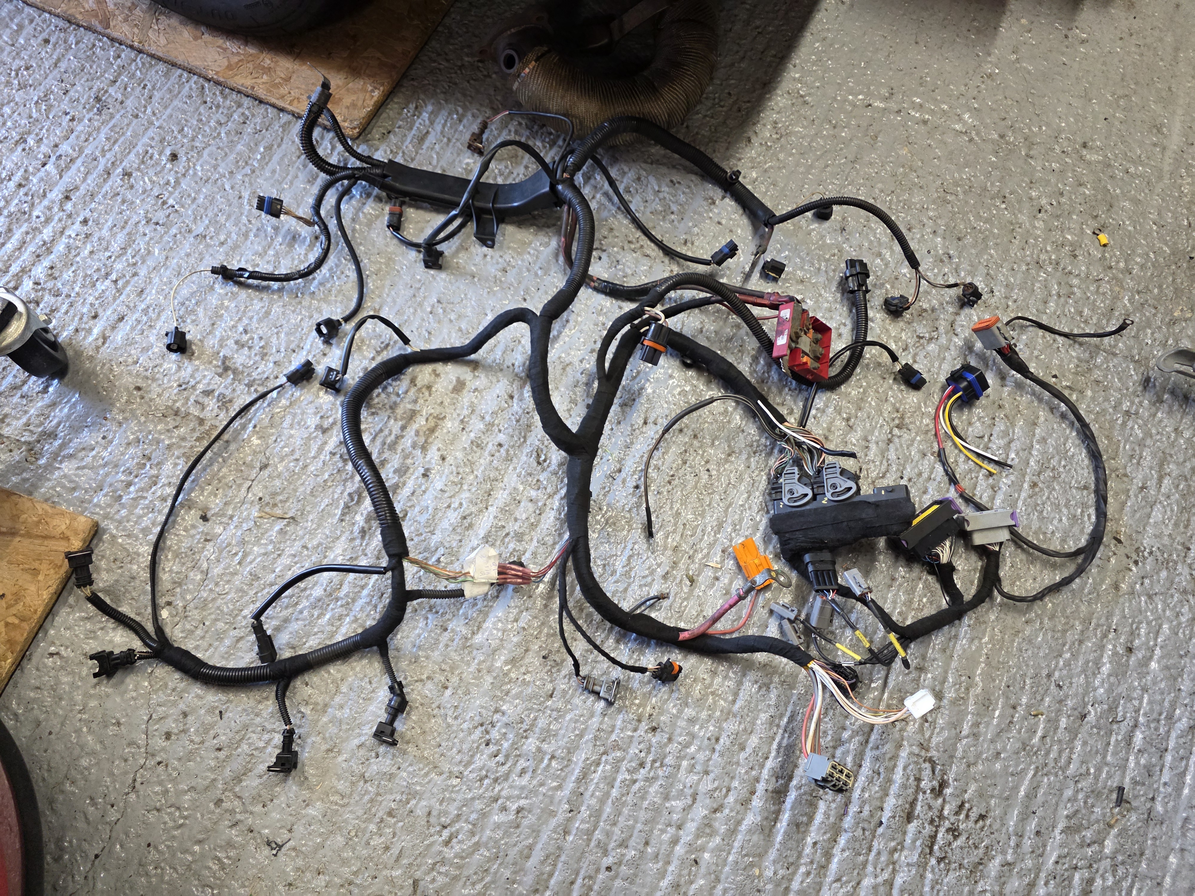

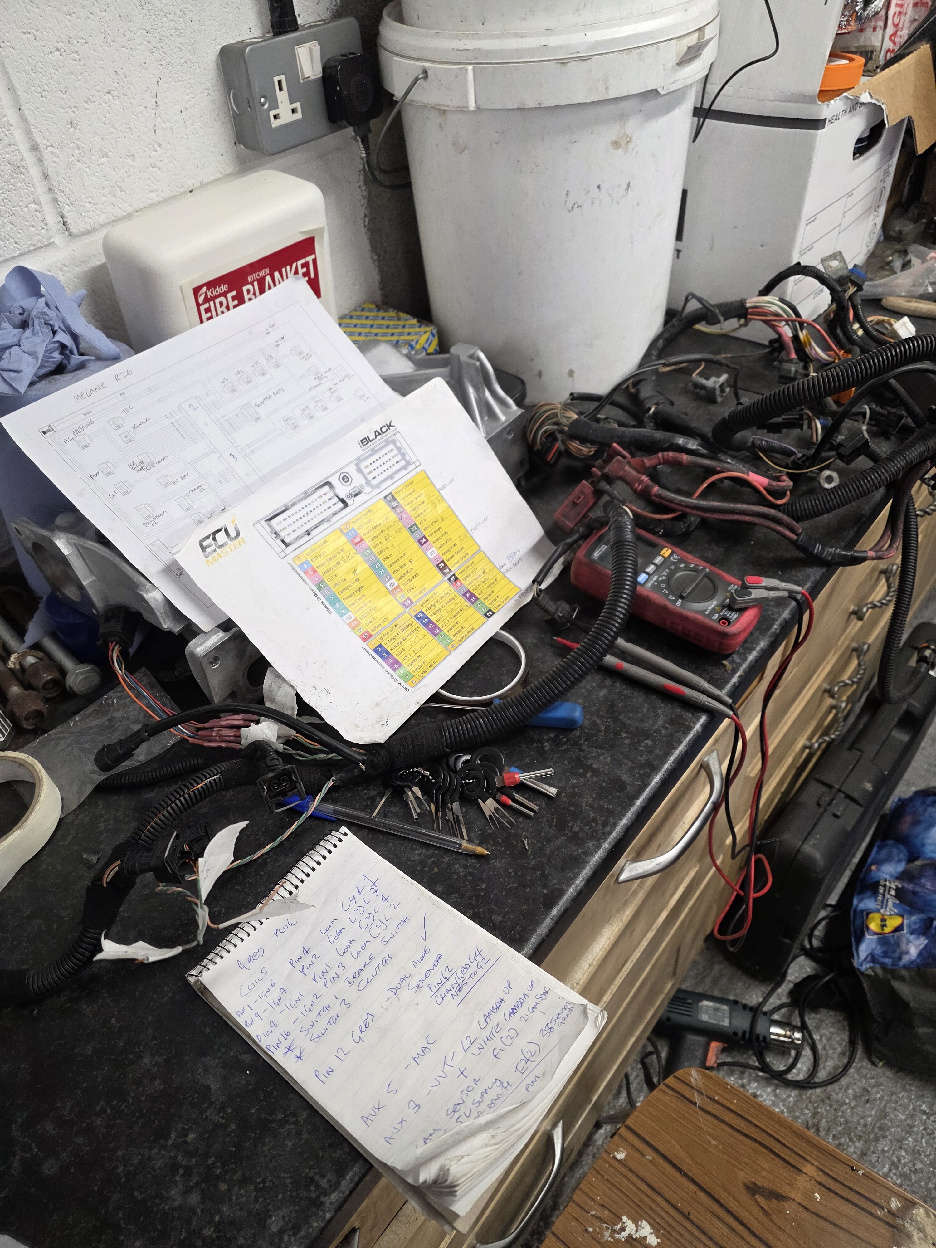

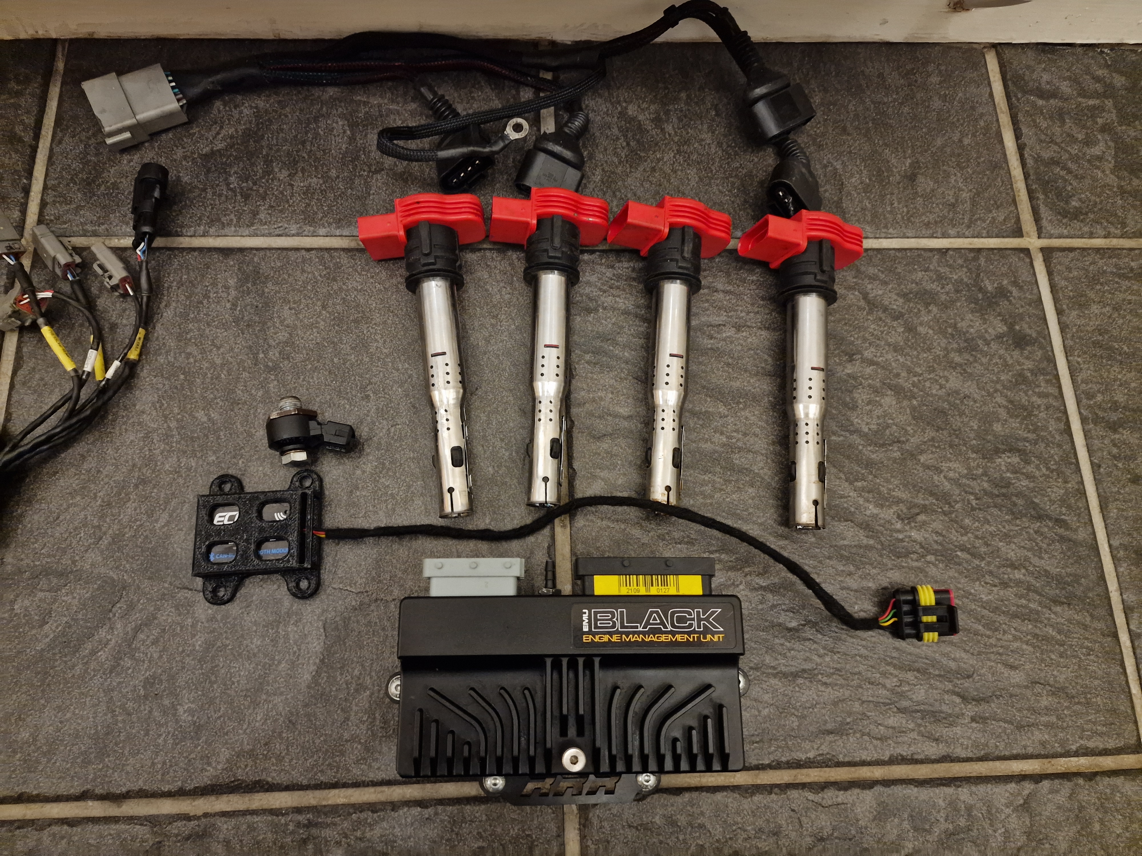

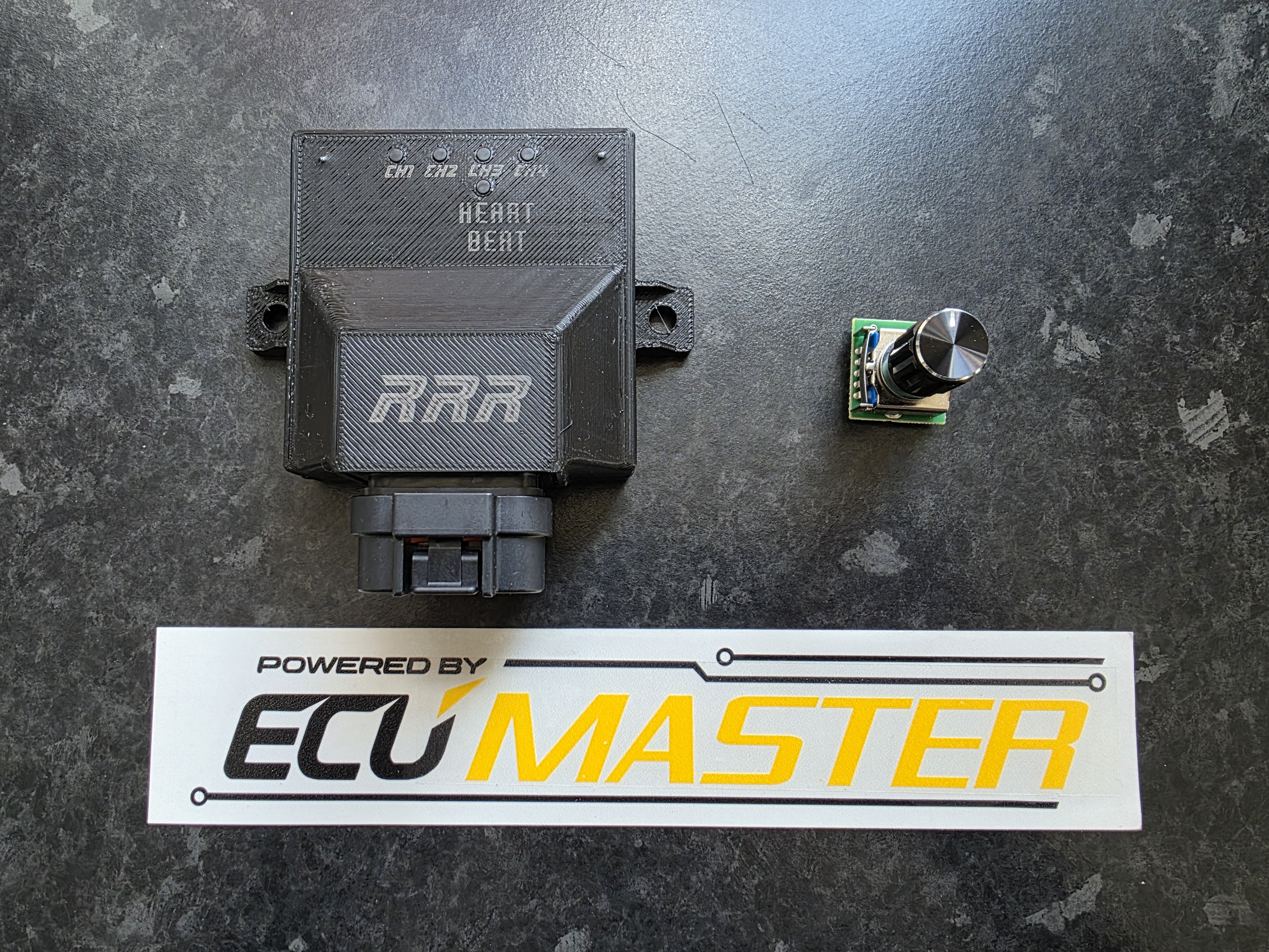

Made a start on the Ecumaster black wiring. 3 years ago i bought a RRR clio 197 pnp adaptor and a few bits.
197 clio wiring is pretty close to meg2rs but different at the same time. I looked at loom options and considered fitting the 197 engine loom, but would need rewiring at the upc plugs to suit megane upc and boost solenoid wiring. Meg 2 loom needed vvt and cam sensor wiring adding, and loom thinning out a bit to remove wiring not needed. As i have a few meg looms here seemed like modding one was the obvious solution.
After digging out all the parts and examining the pnp adaptor to see it was potted on the connection side, meant simply adding or removing wires would not be possible. Also i had no map to see how the inputs and outputs had been setup, or idea on how the pnp was wired so had to validate all connections. A few hours of tracing what goes where was necessary to avoid any future aggro. Probably should have just built a new loom from fresh as would have took the same amount of time but nevermind..
Simple stuff just time consuming.

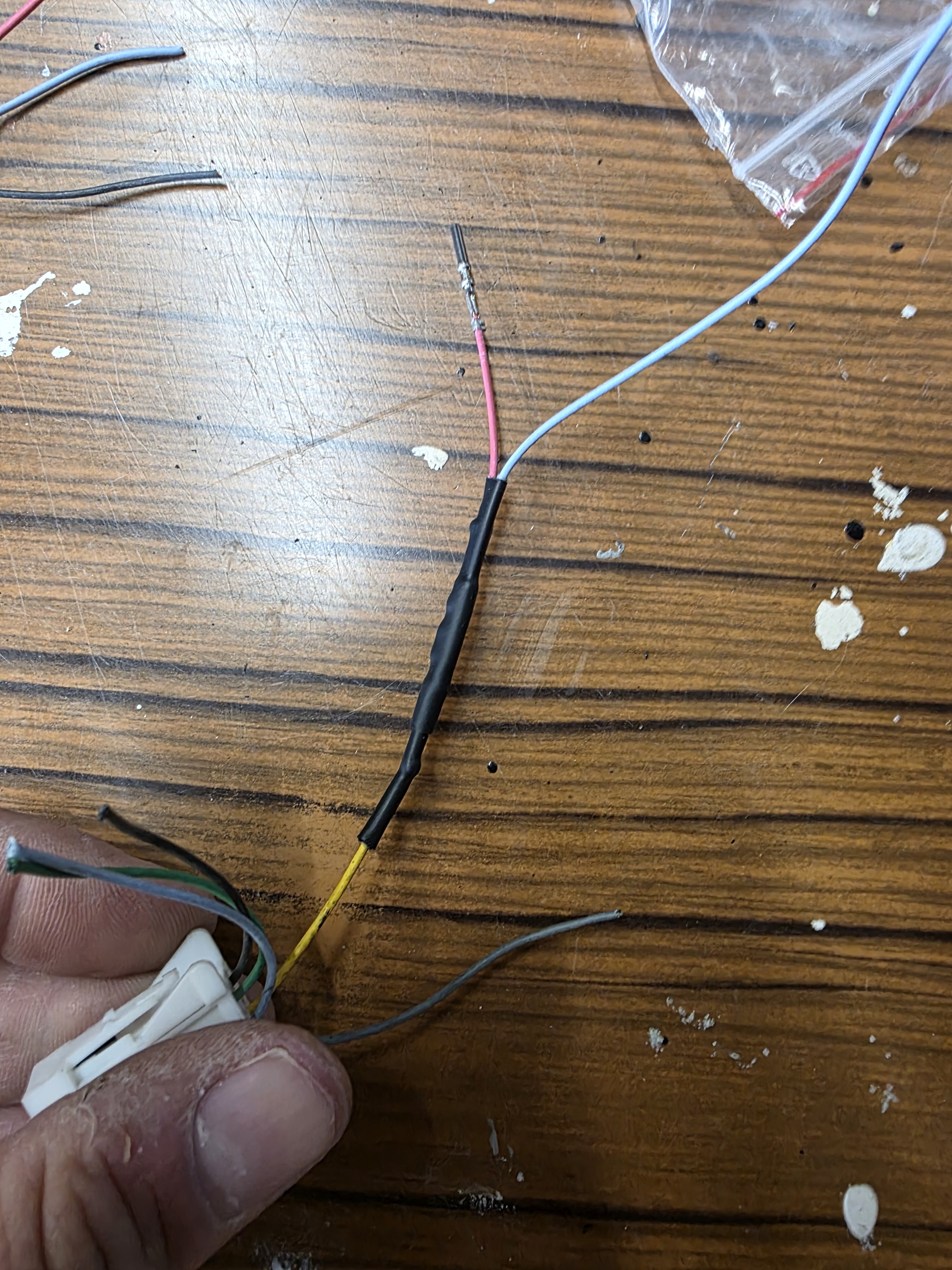

I depinned and swapped a few wires about in the oem ecu connectors, moving the megane n75/boost controller wiring to a spare aux that was wired in the adaptor. Oem map sensor wiring is not used so the 3x wires have been repurposed/ repinned for cam sensor. The upstream lambda wiring has been repurposed/pinned to suit the vvt solenoid as again not used as running lsu 4.9 wideband lambda straight to ecu.
Also binned oem coil wiring as i have a subloom for Audi r8 coils wired to individual coil outputs. This is much better than the oem coils that are wired in series, which divides the total voltage across them, increases total resistance, and maintains the same current through each component hence giving a shitter spark / small spark plug gaps required. Oem meg coils are also pretty crap when wired up individually where r8 are good for a lot of boost.
Enough tech anyway - a few pics

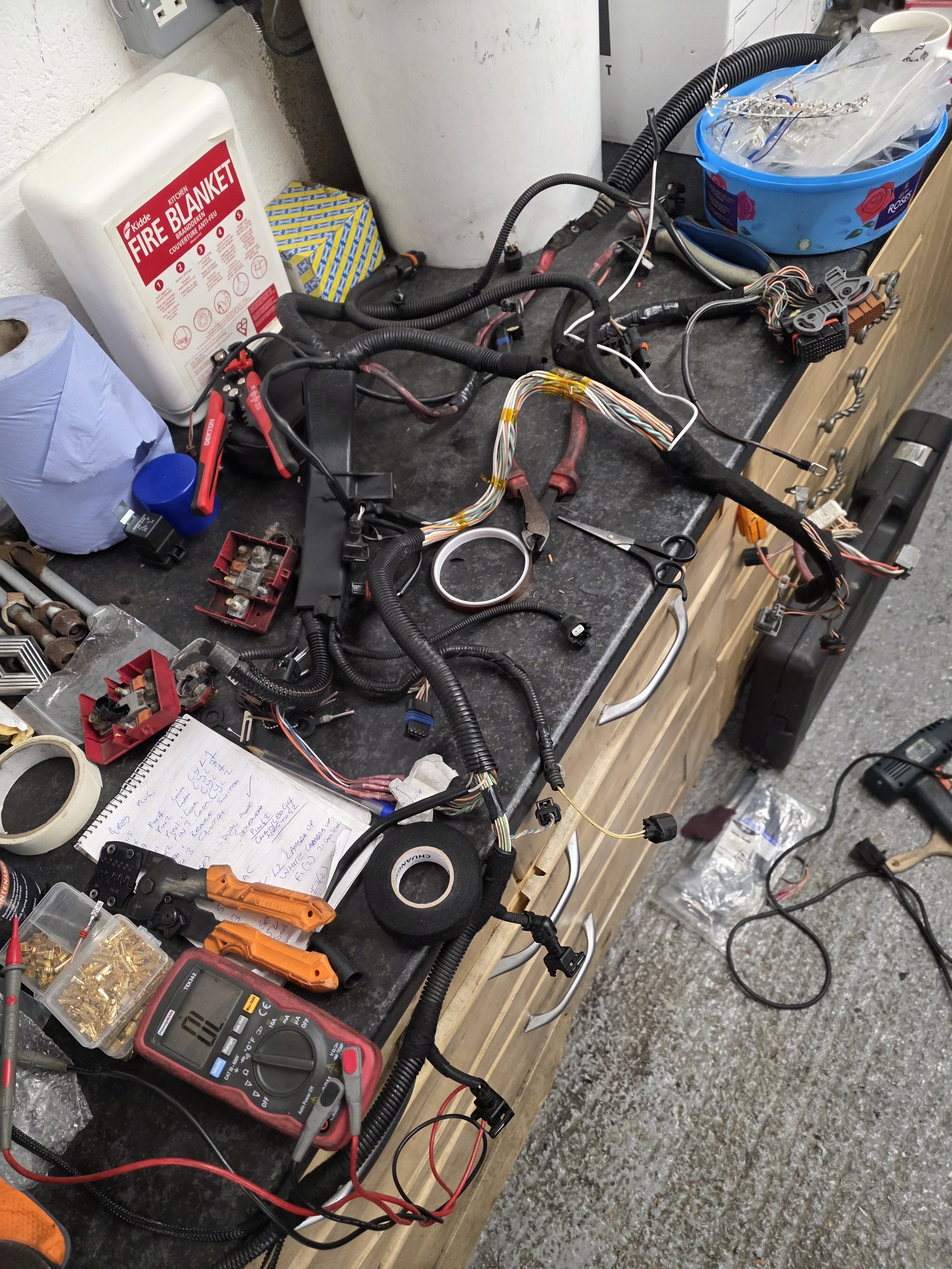

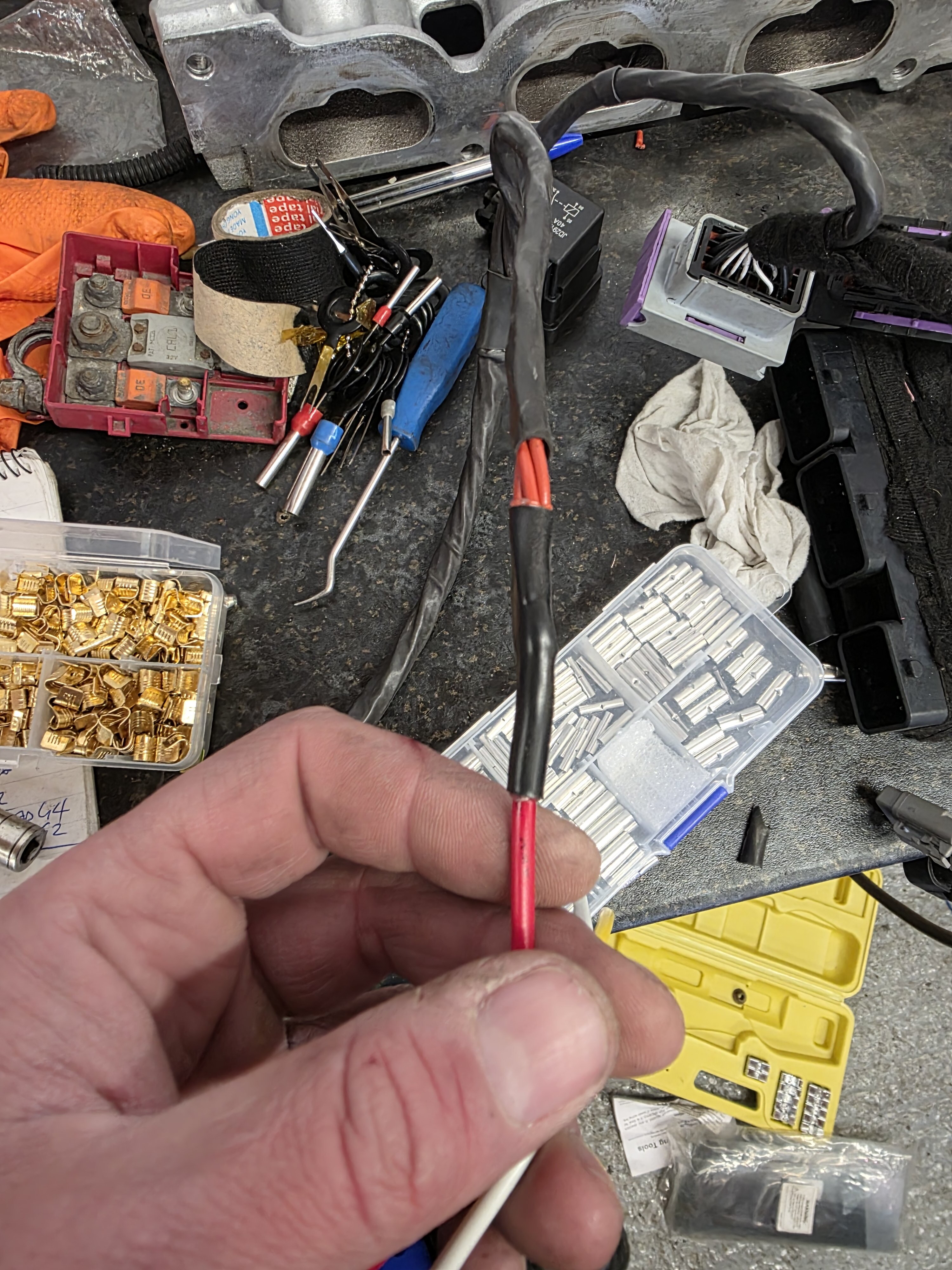

All oem tape removed to check loom condition, and retaped in tesa cloth tape.
Done a load of connections including 4 way splice for coil power. Dual wall glued heatshrink makes a solid connection.
Its pretty much finished. Throttle body needs wiring, was unsure on length required so will do it in situ. Neutral switch wiring and reverse light switch to sort, i need to repurpose the connector for reverse switch off the current loom.

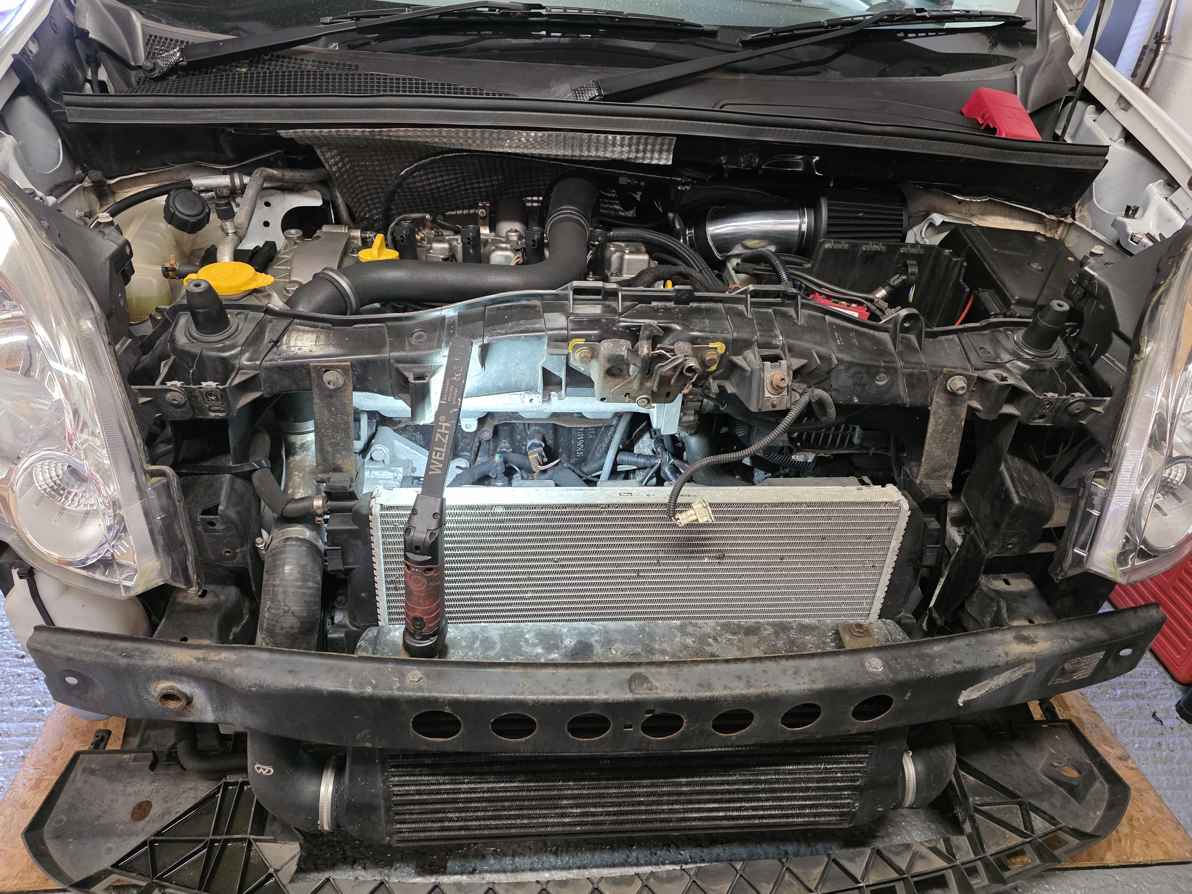

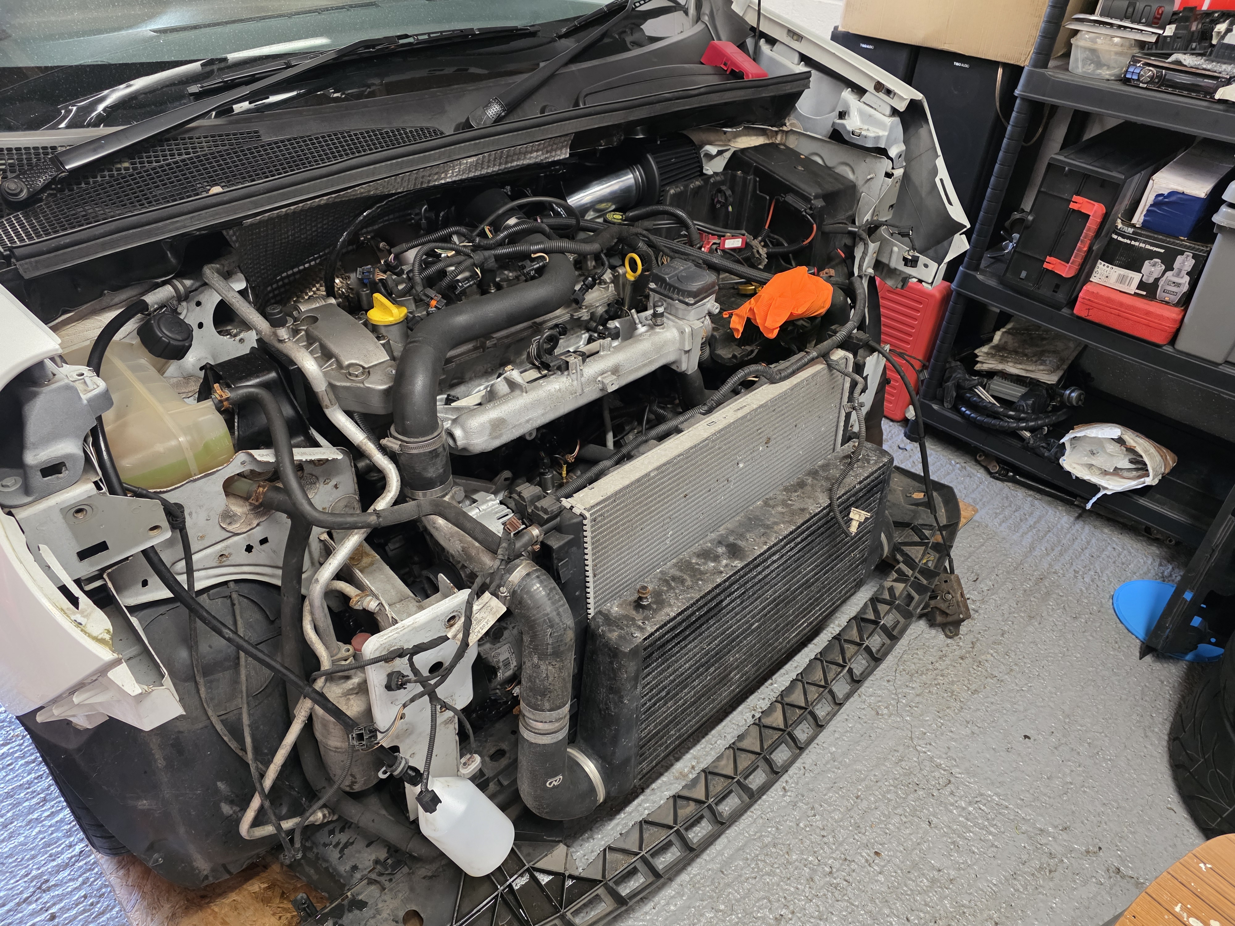

Made a start on fitting the loom today. Bumper etc off.
I was avoiding taking the front off fully, but for how long it takes it was a no brainer. Access is 10x better.
Got the inlet off etc. When removing the fuel pipe from the rail it was still pressured uo from running yesterday, the fuel system is good on this. I then stripped out the loom and a few sensors, and started fitting the new parts. Wideband bosch knock sensor, lsu 4.9 wideband lambda and newly modified wiring back in the hole.
Offered up the R8 coils and they wont fit with the 250 breather plate, so will need to change that for a pms one, same as i run on my clio trophy.
Half decent start for 4 hours work.

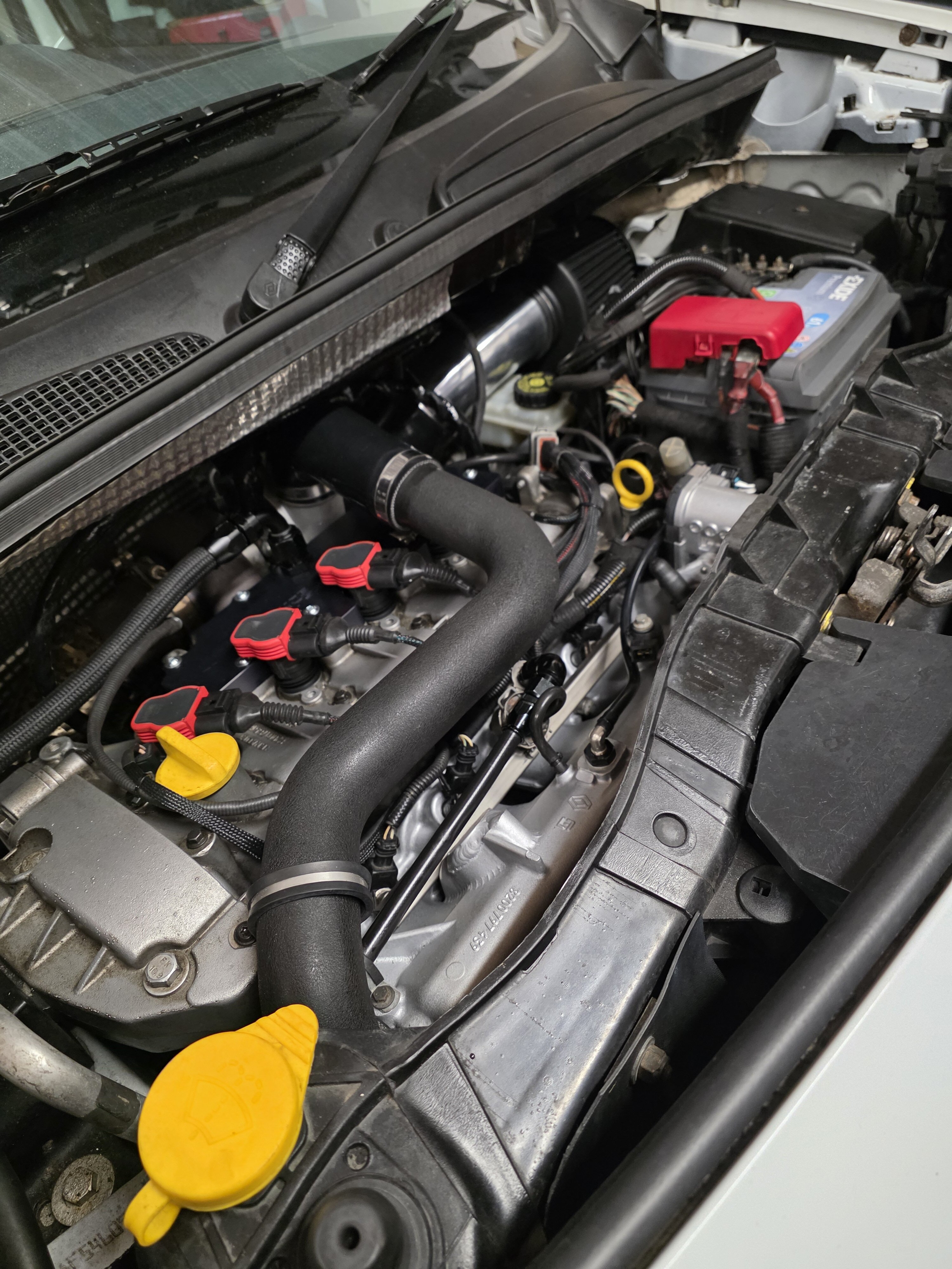

Had a spare hour or so yesterday so got a bit more done.

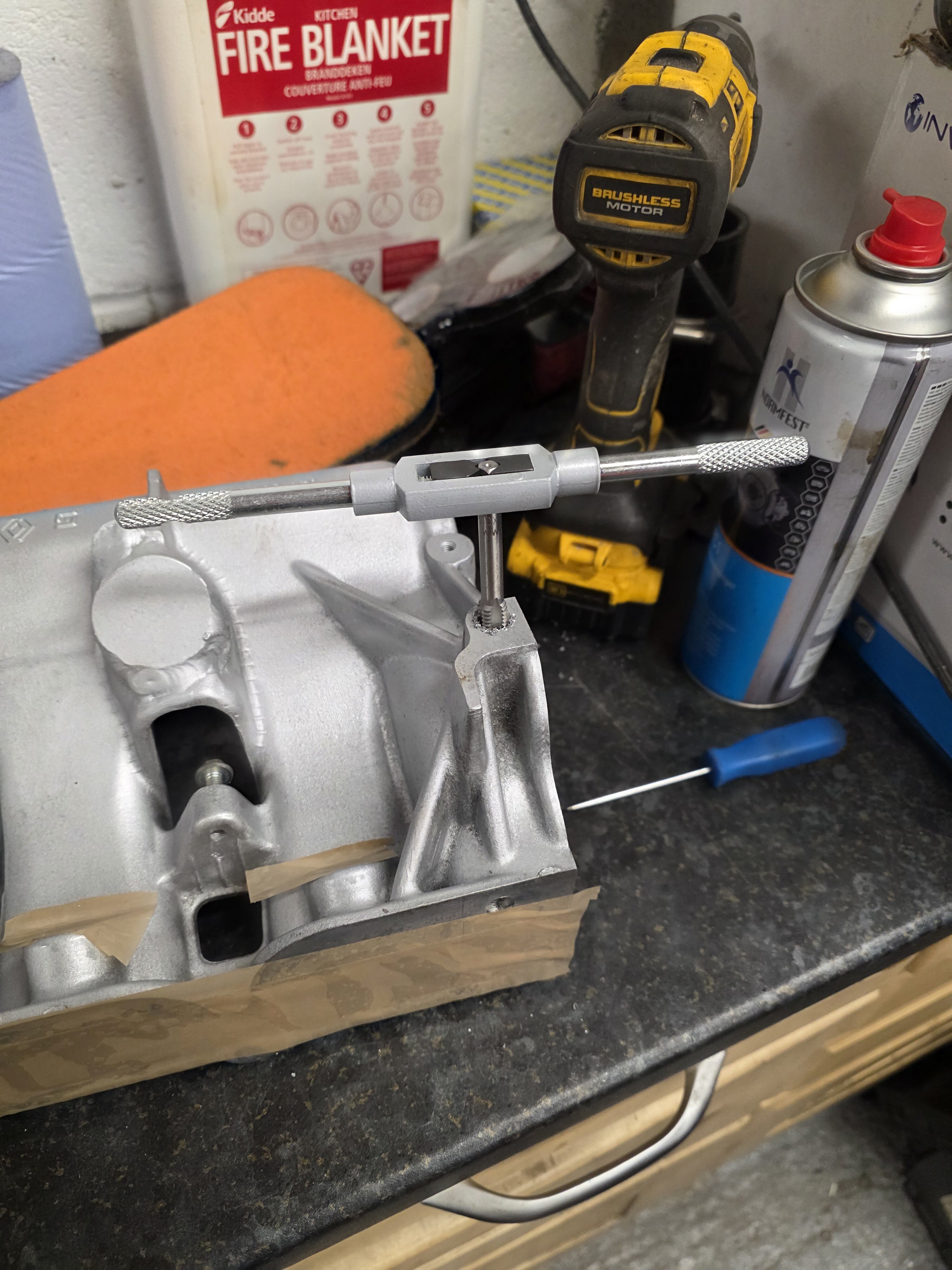

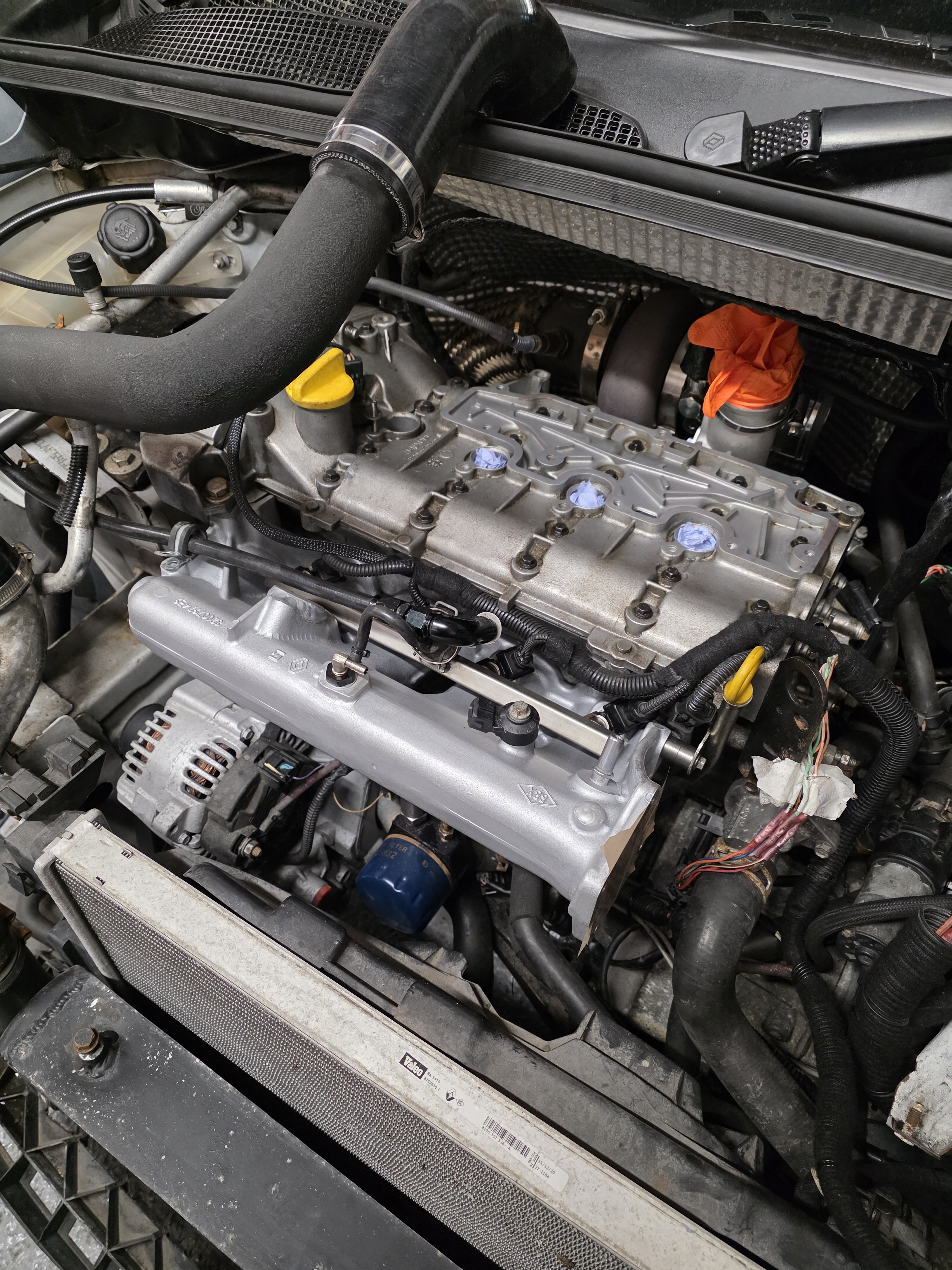

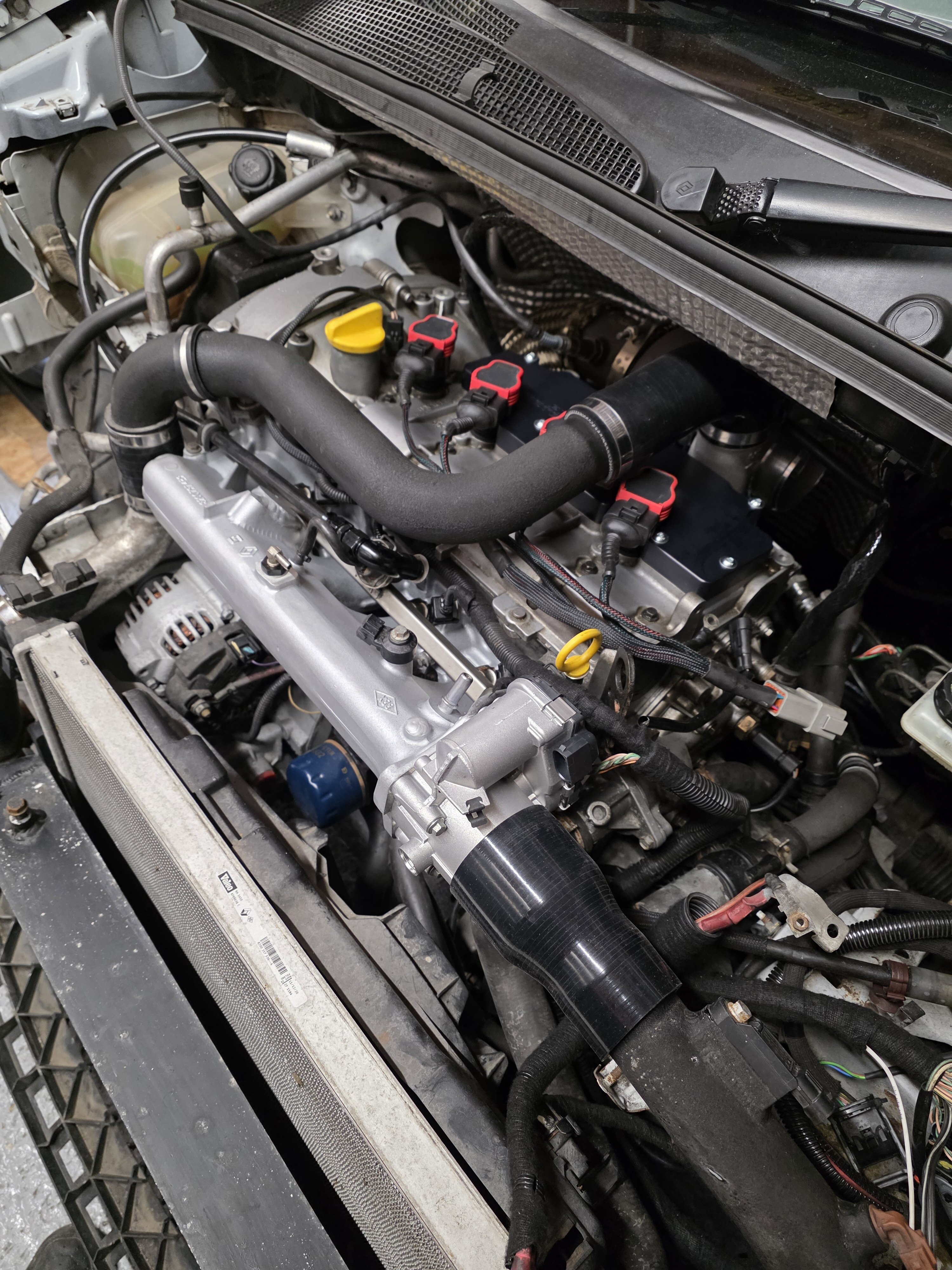

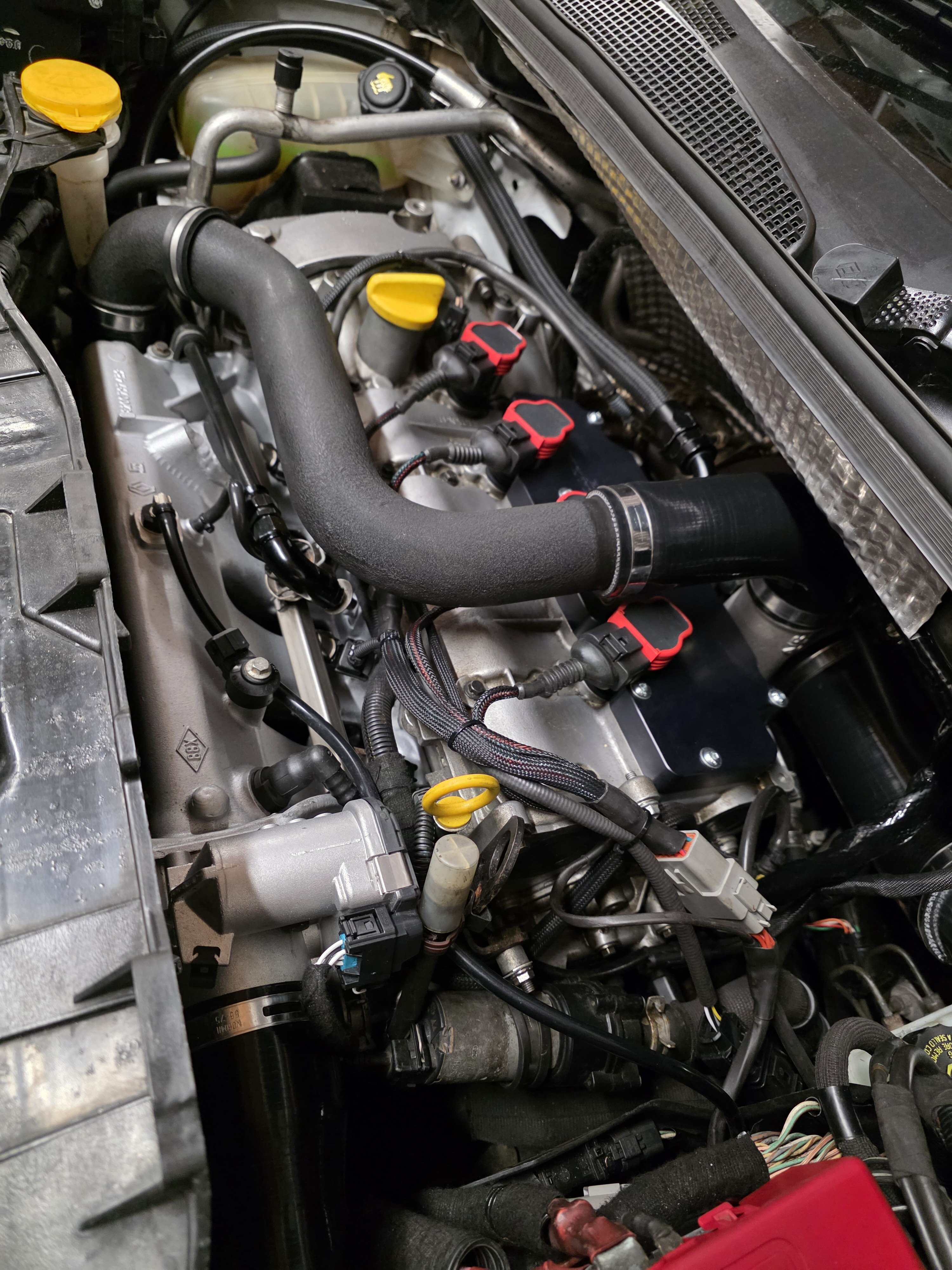

Annoyingly id forgot to drill and tap the modified inlet for the bolt to the top engine mount. A lot of people dont bother but we do stuff right here.
With this done i could refit the modified 250 inlet. Before fitting, i renewed the cam sensor for a new one as due to location on 197 head, it needs to go on before the inlet. Dug out the bosch motorsport 870cc flow matched injectors i bought a few weeks ago, to replace the 630cc siemens deka that i pretty much maxed out with the old hybrid 20t.

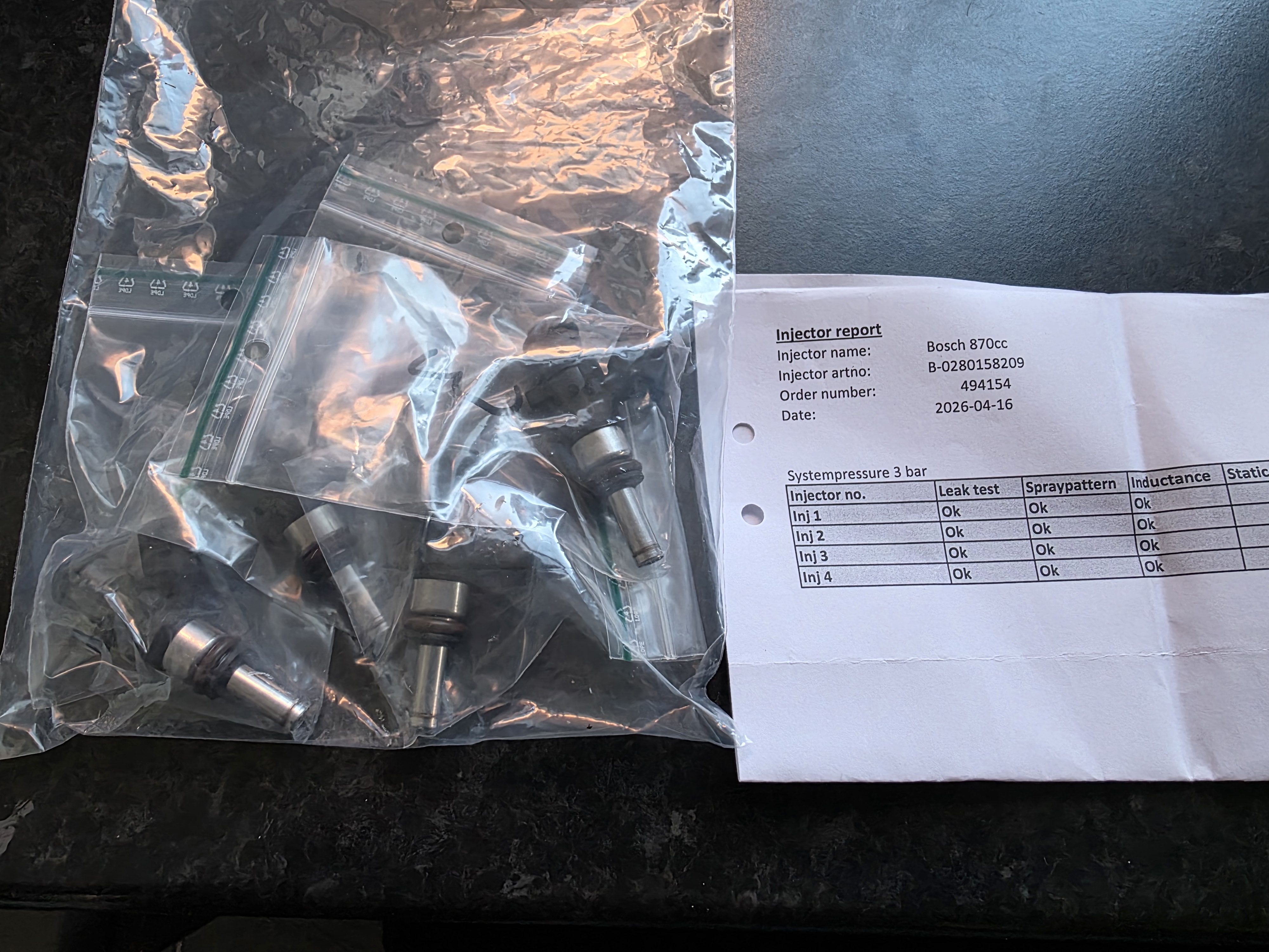

870cc will have plenty of headroom on this setup. I was going to use 730cc but hard to find flowmatched, bosch supply them within 7% tolerance from factory which is dogshit🤣

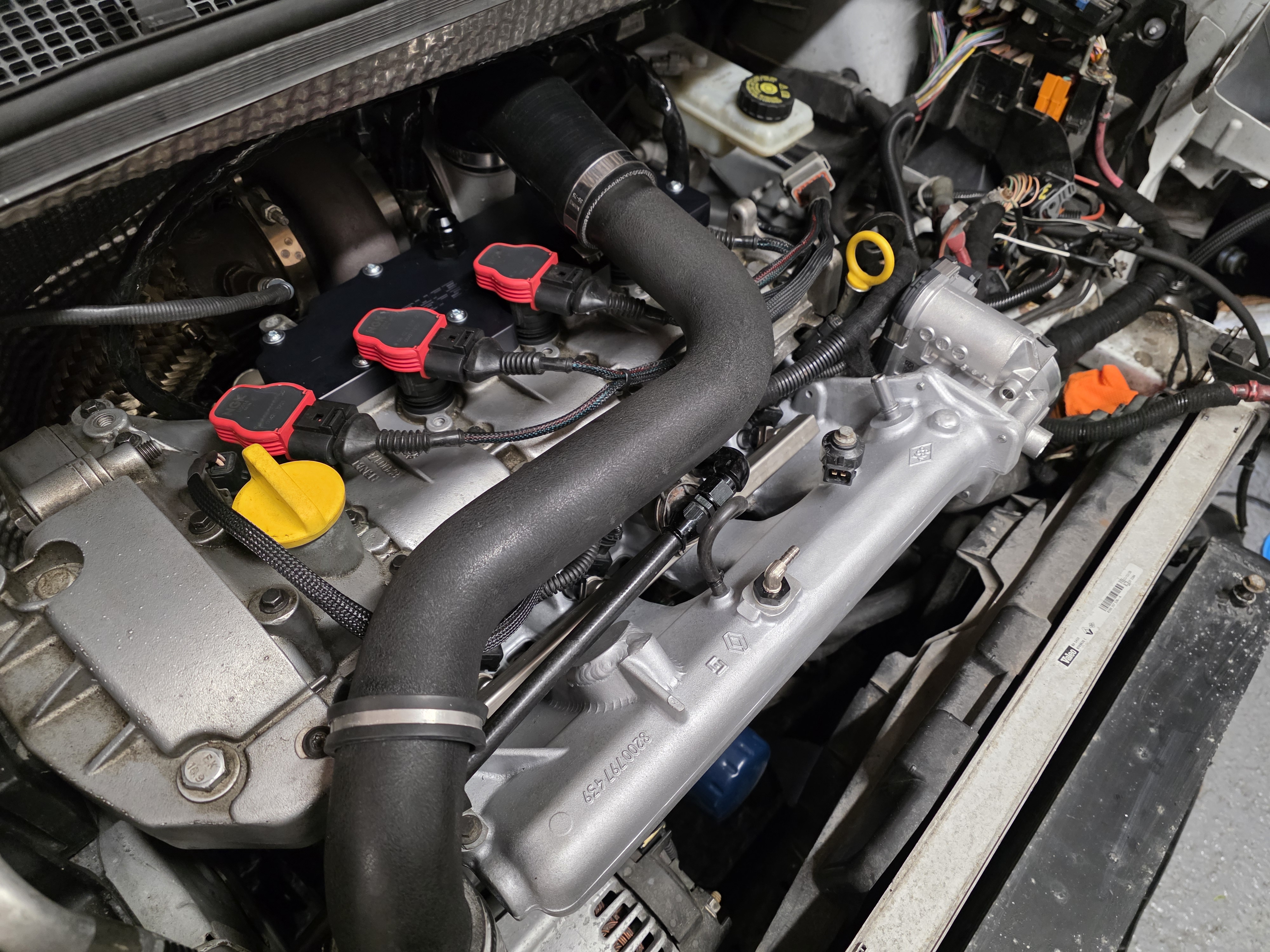

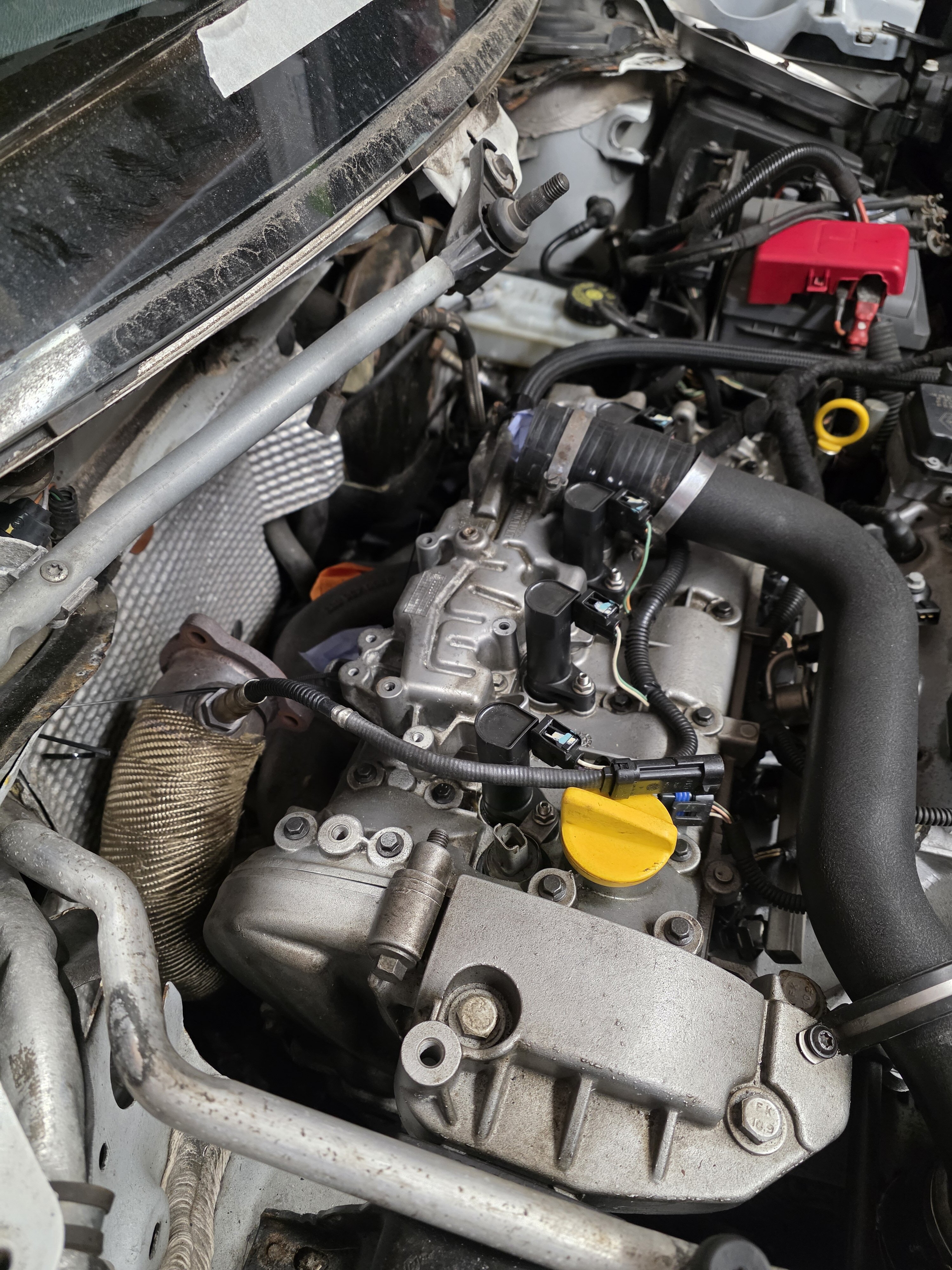

Inlet fitted, new oem gasket to head torqued to spec and 870cc injectors fitted, wiring routed with cam sensor and vvt solenoid connected.

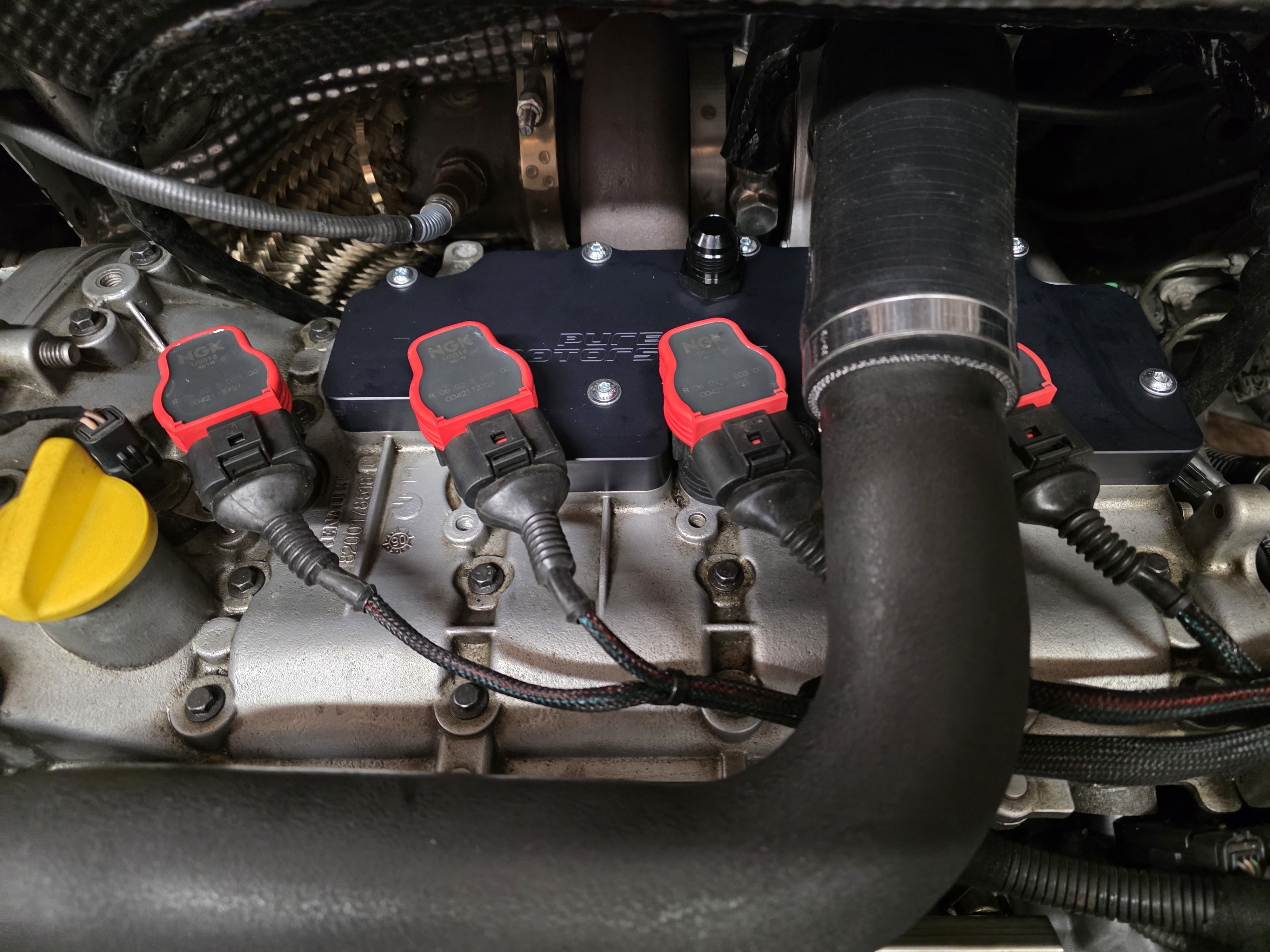

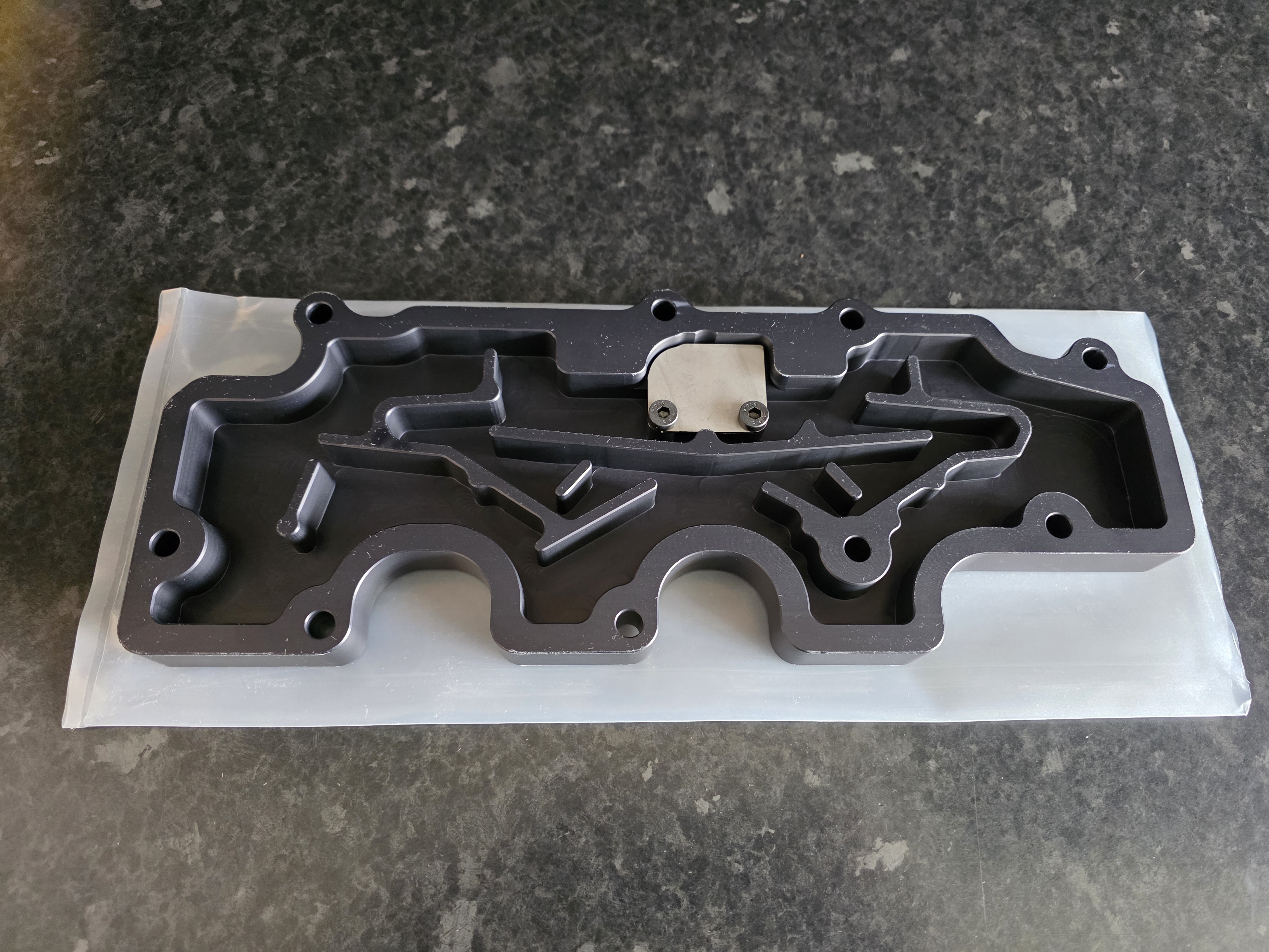

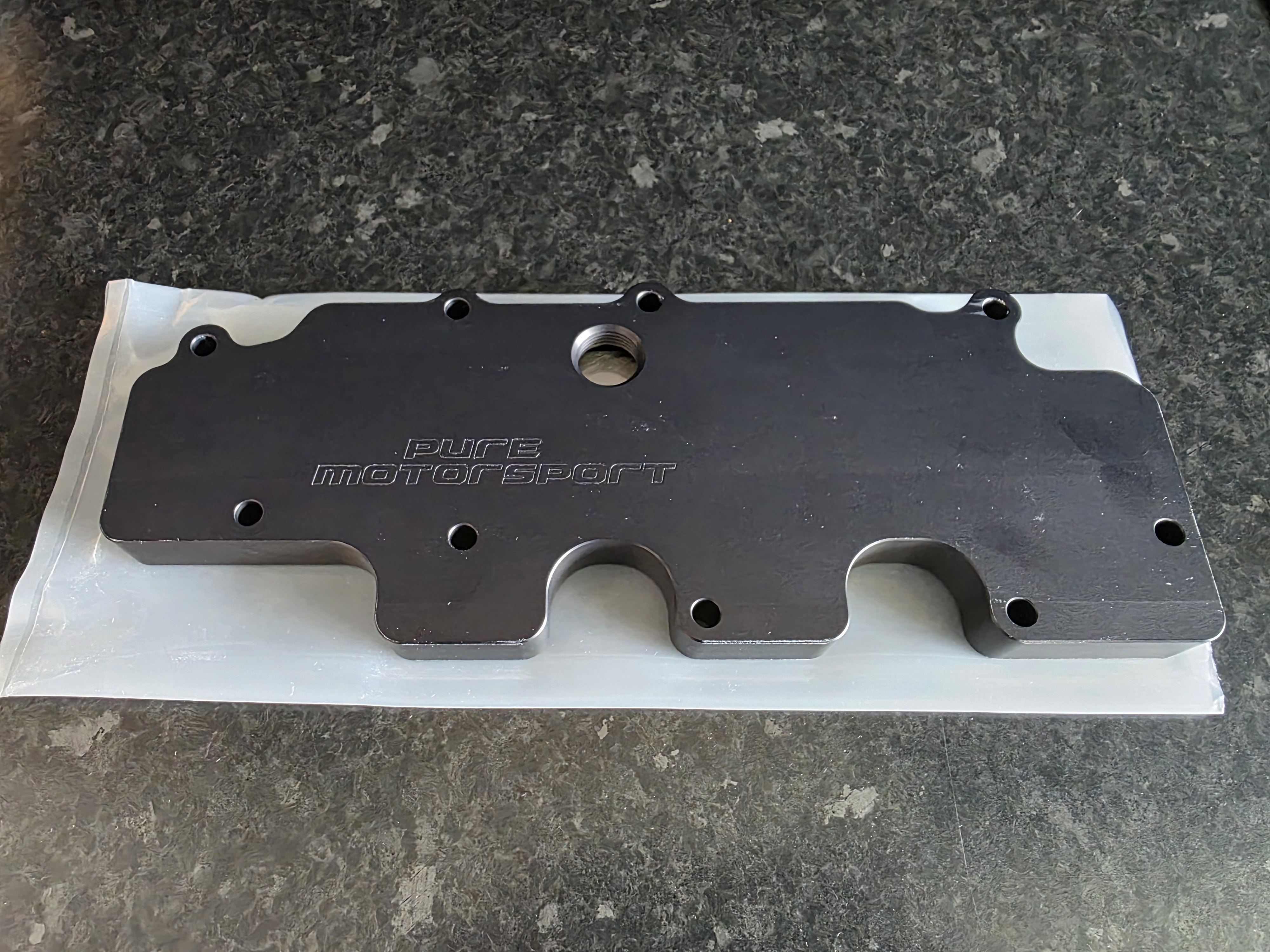

Note breather plate removed off the cam cover. I offered up the R8 coils last week, and they would not locate properly on the spark plug with the extra height of the breather plate. Options were oem 197 or r26 breather plate or pms as it works on my trophy. Pms it is.
Sexy billet machined alloy with baffle. Would have preferred silver but they only do black anodized now. Looks good so not messing about painting, on it goes.
R8 coils fitted for all the spark.

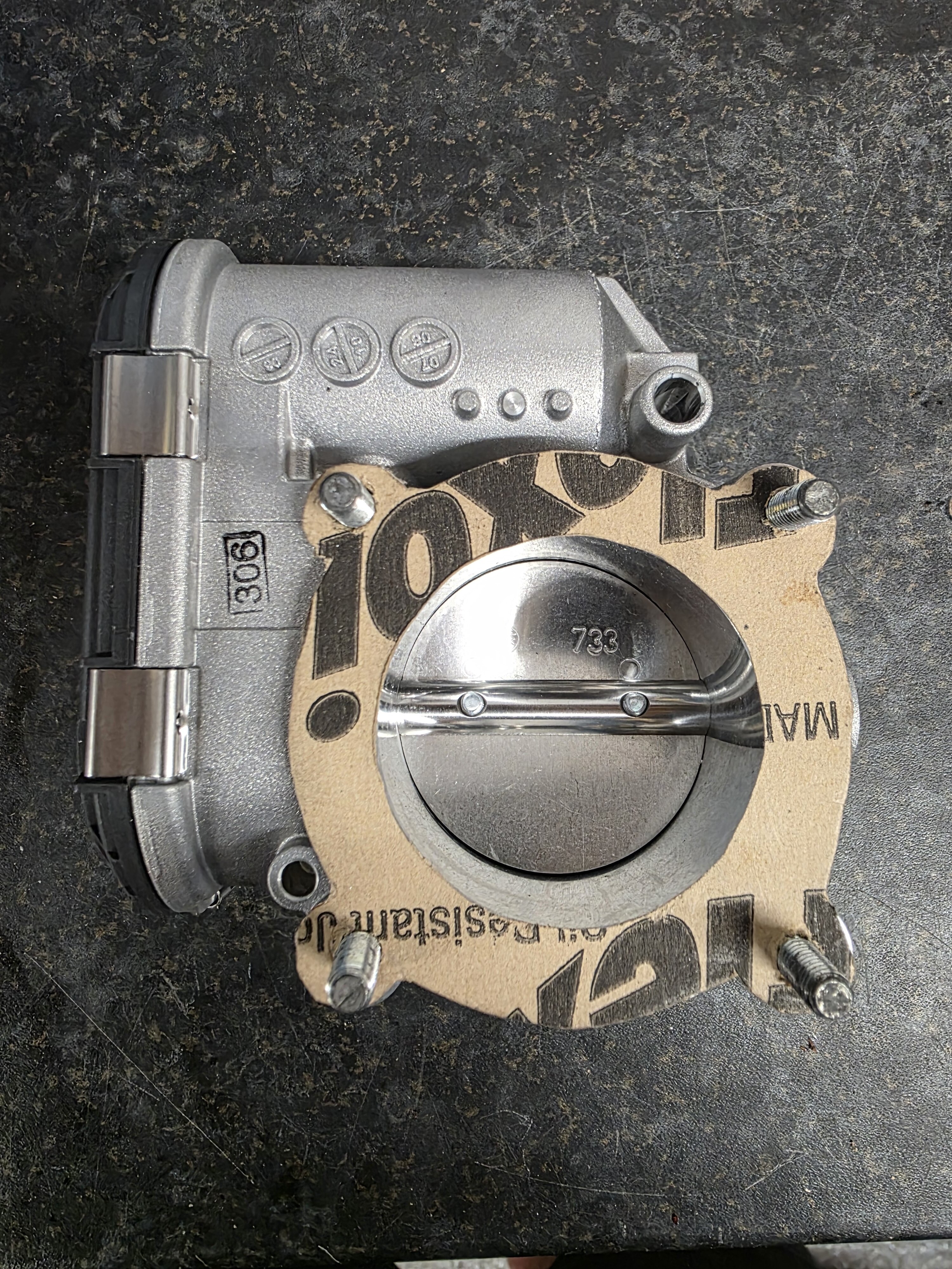

Throttle body needed a gasket before fitting. Oem 250 gasket no good as hole is too small, so dug the gasket paper out. I initially struggled to find my sheet of gasket paper, it almost got the cornflakes box which has served well in the past when in need🤣
Tap tap tap, cut cut cut. Close enough.

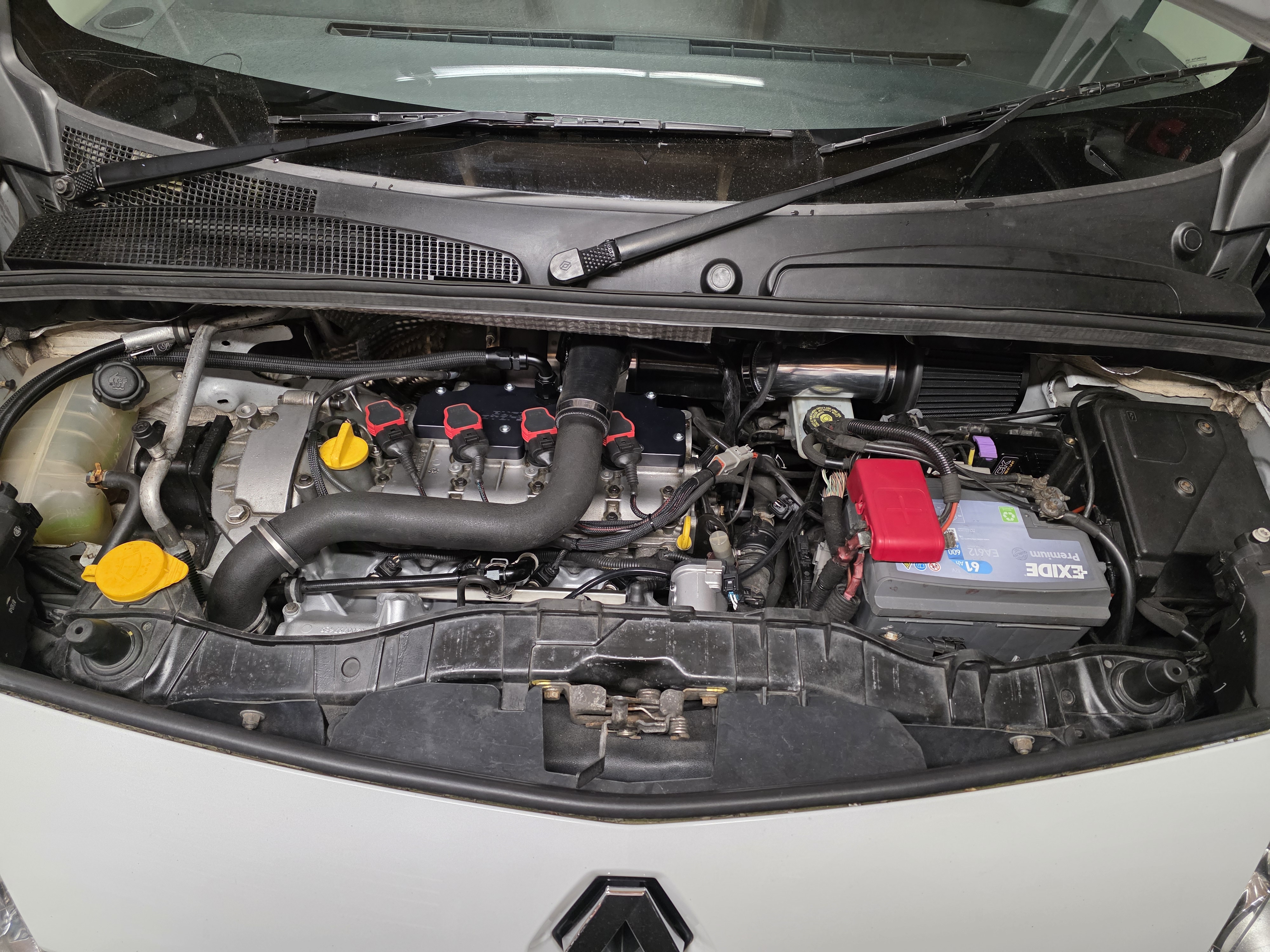

Throttle body fitted and boost hoses offered up. F4r is not a pretty engine, but in my opinion it looks far better than oem with a few bits done.
If all goes well i should be on for a start at some point in the next few days. Until then, more work to be done.

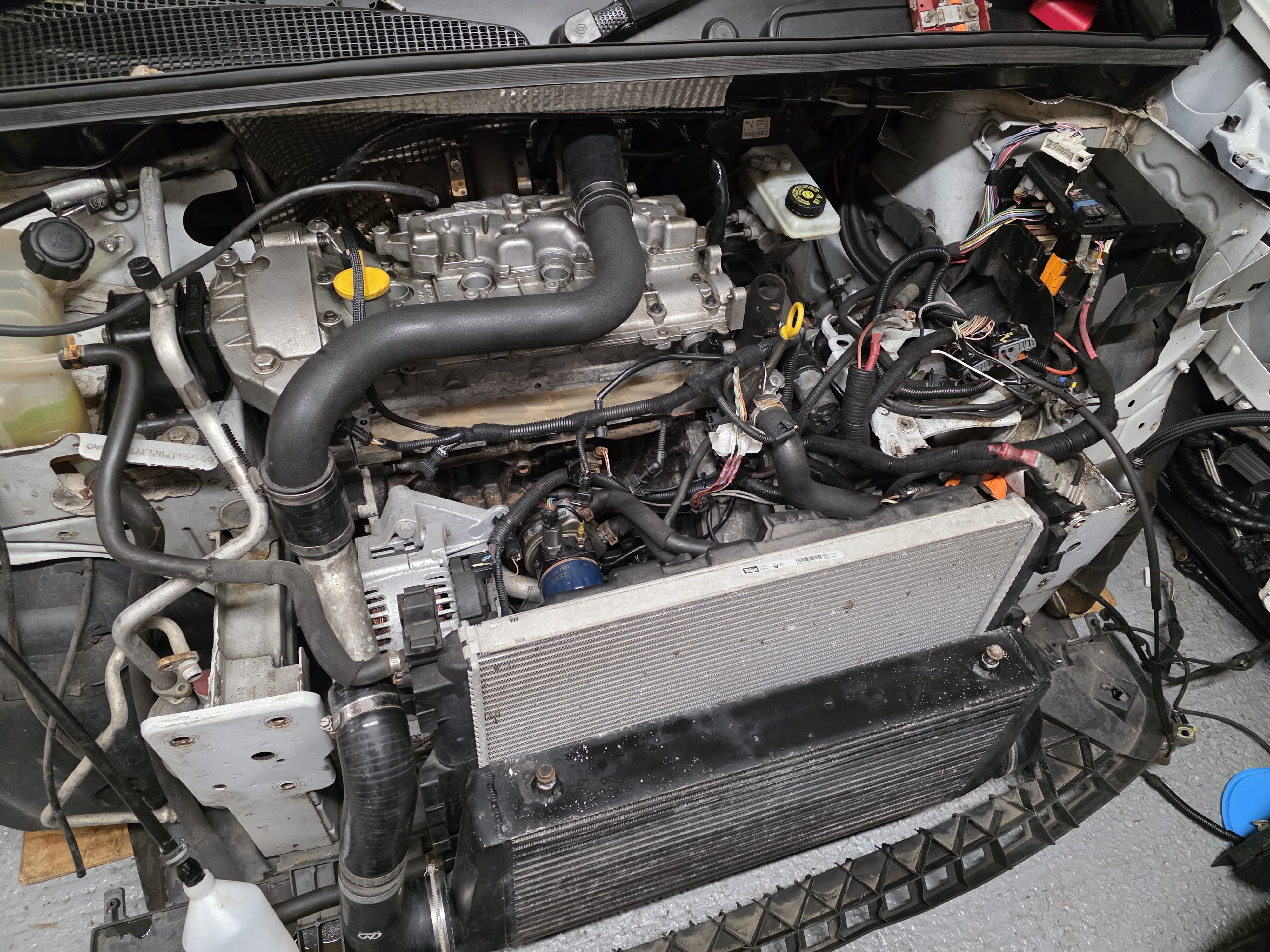

Updates. Big ones.

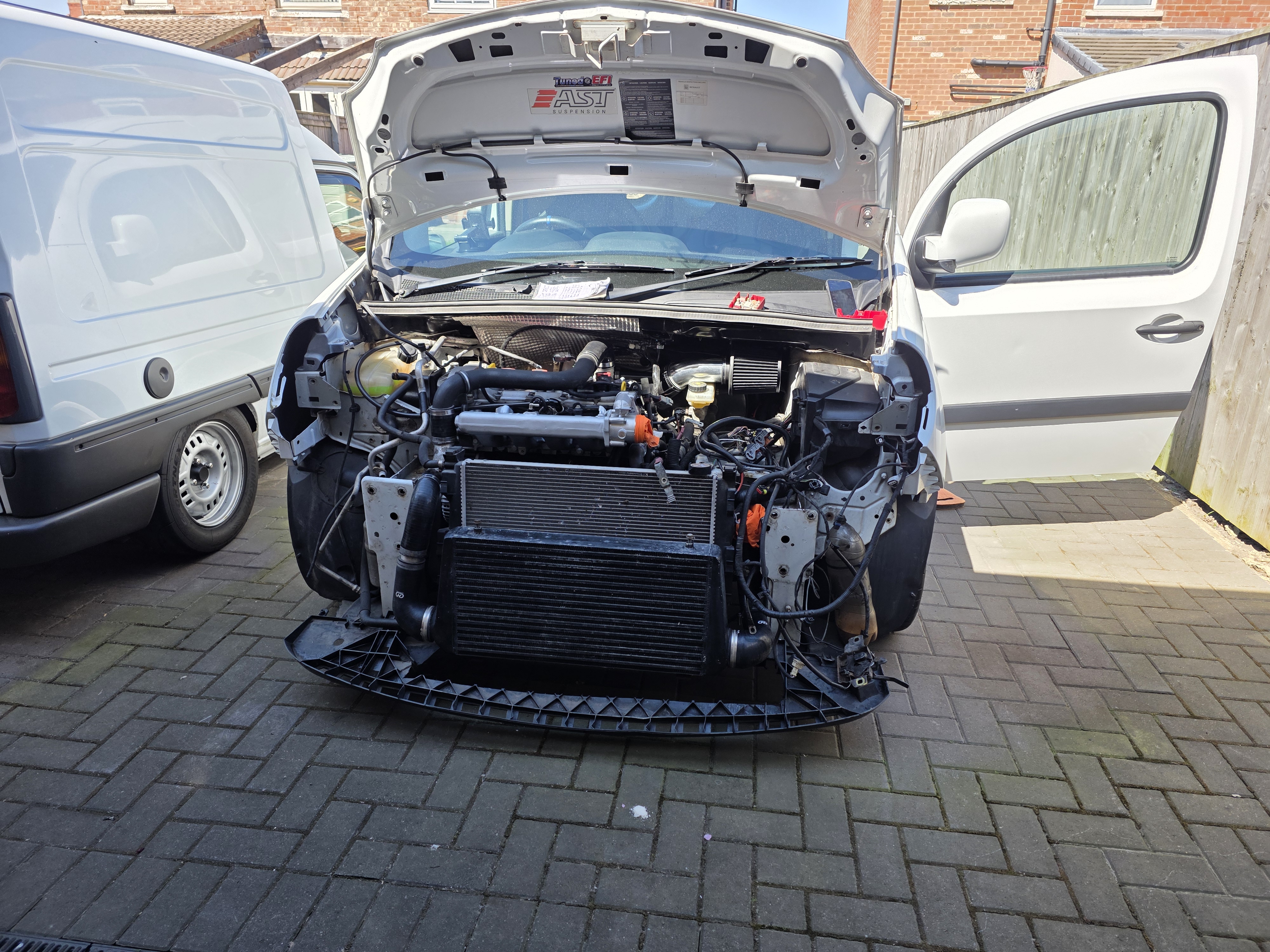

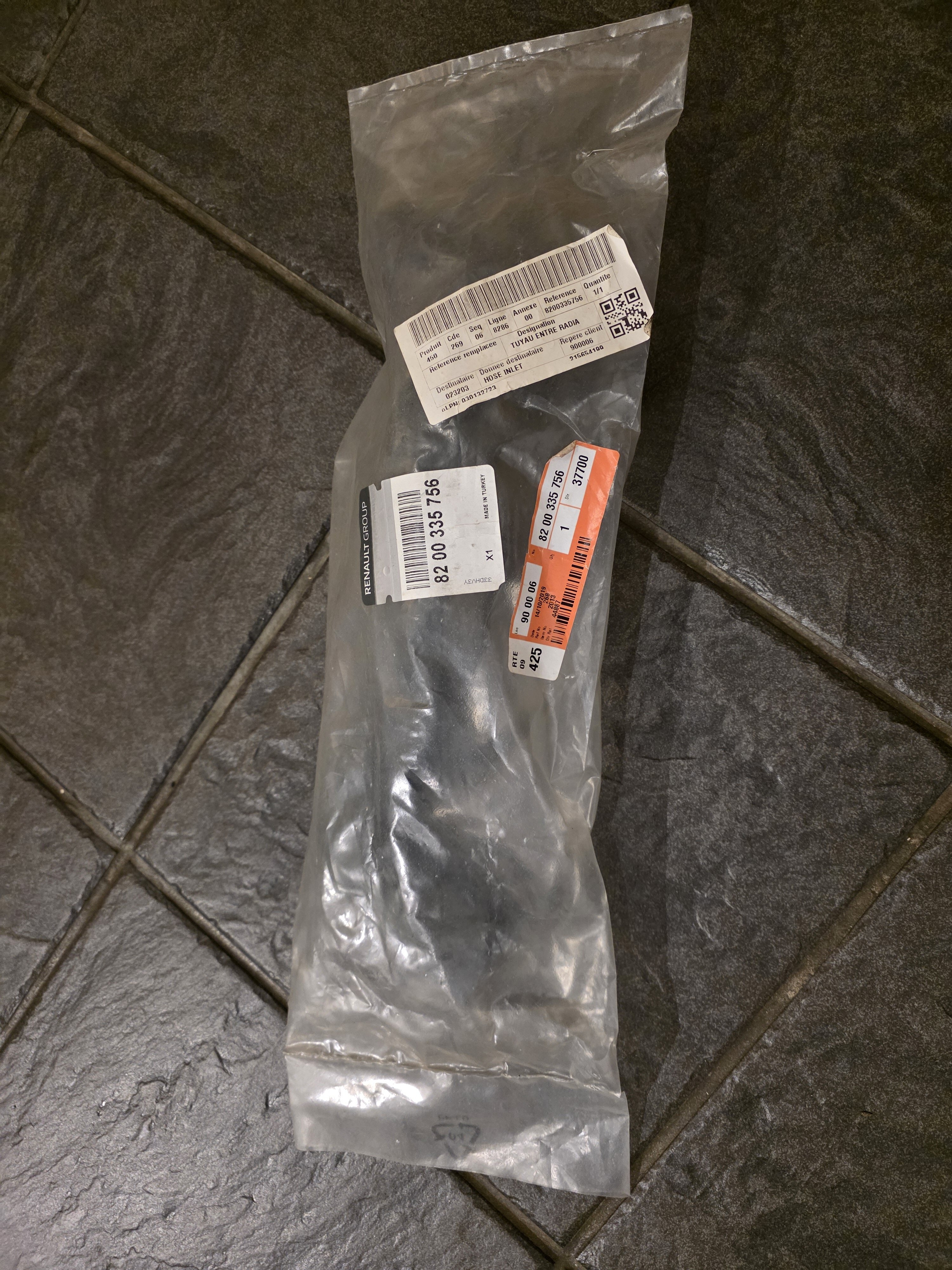

Had a few hours spare back end of last week. Rolled the Kangoo out the garage as weather finally decent, and access required to passenger side.

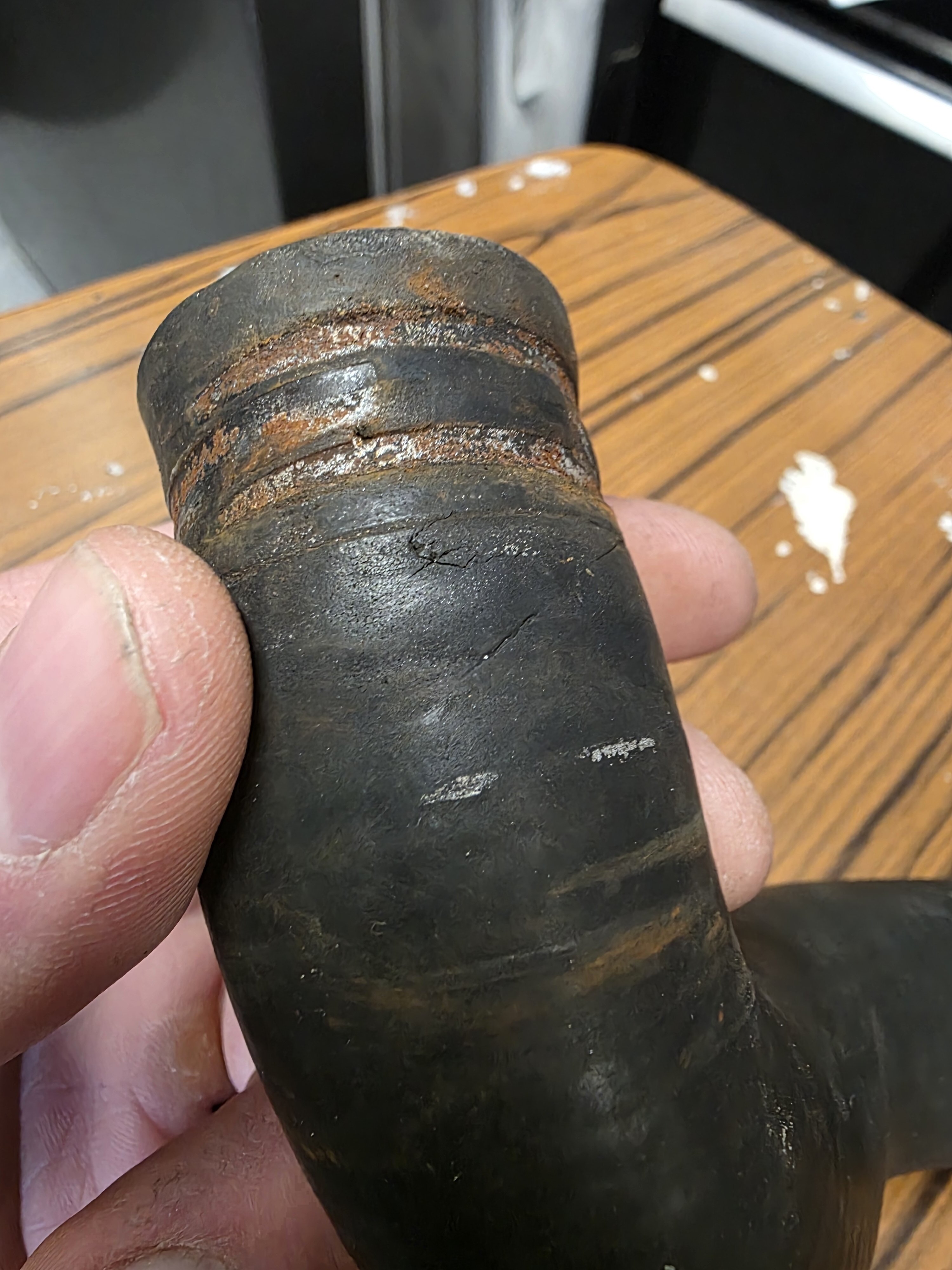

1st job was replace top radiator hose. I had noticed a slight split in the one that was fitted when fitting the turbo kit. New old stock oem hose sourced.
Hose split visible. Doesnt look too bad but almost through.

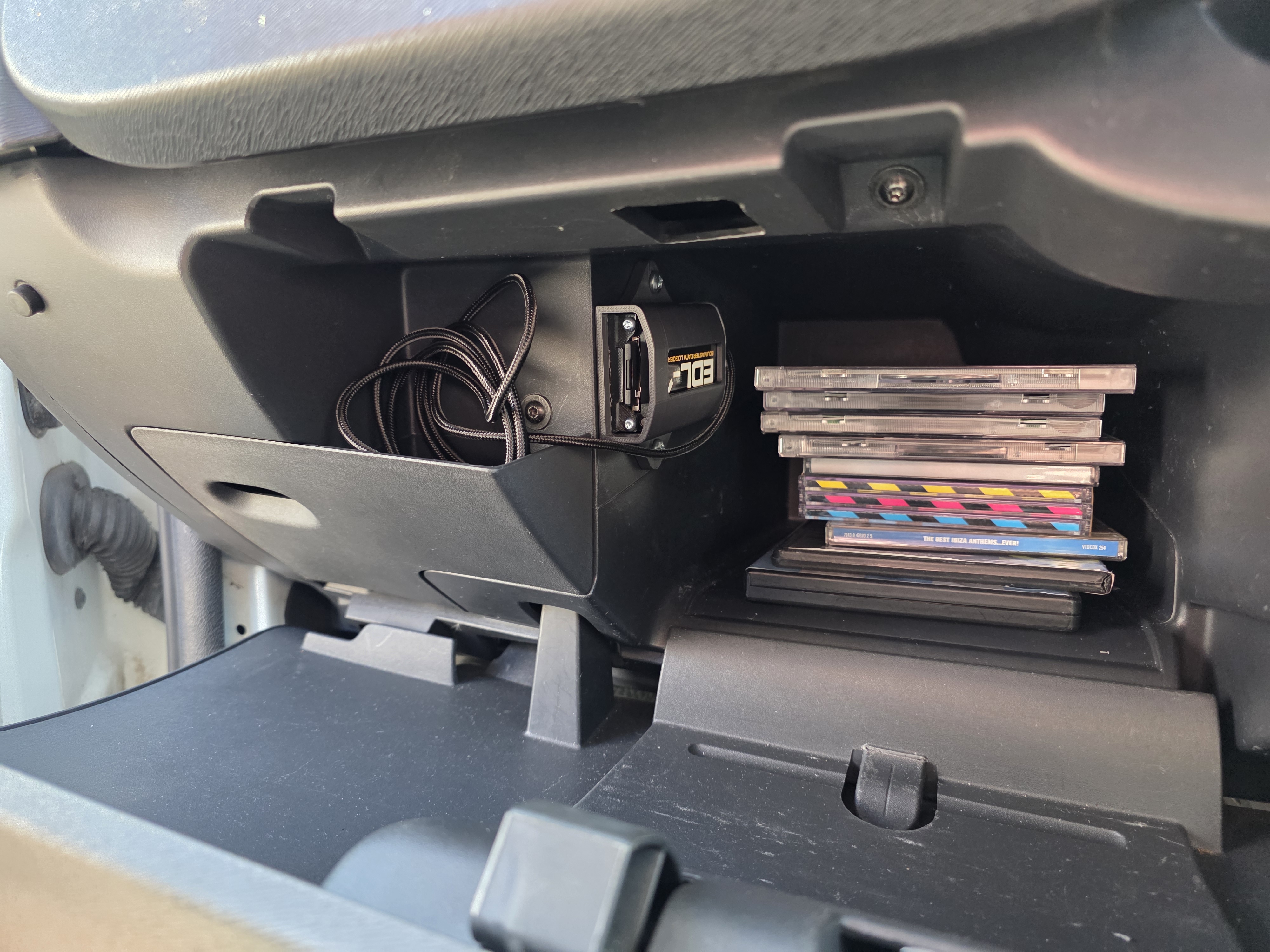

Next job was fitting usb cable to ecu and fitting ecumaster edl-1 datalogger. This was centre console out and glovebox etc, routing wire through bulkhead. Couple of hours work for a tidy install.

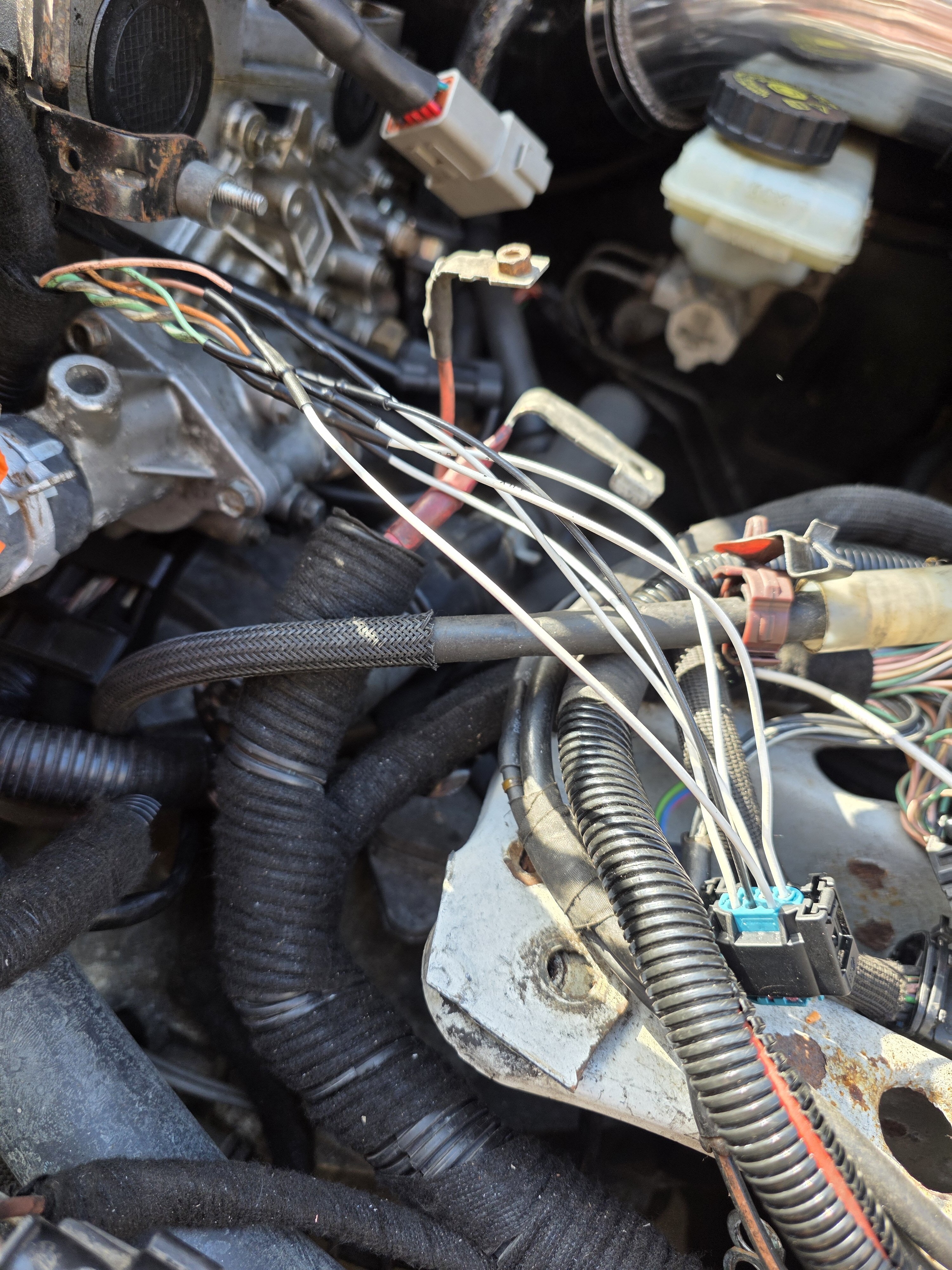

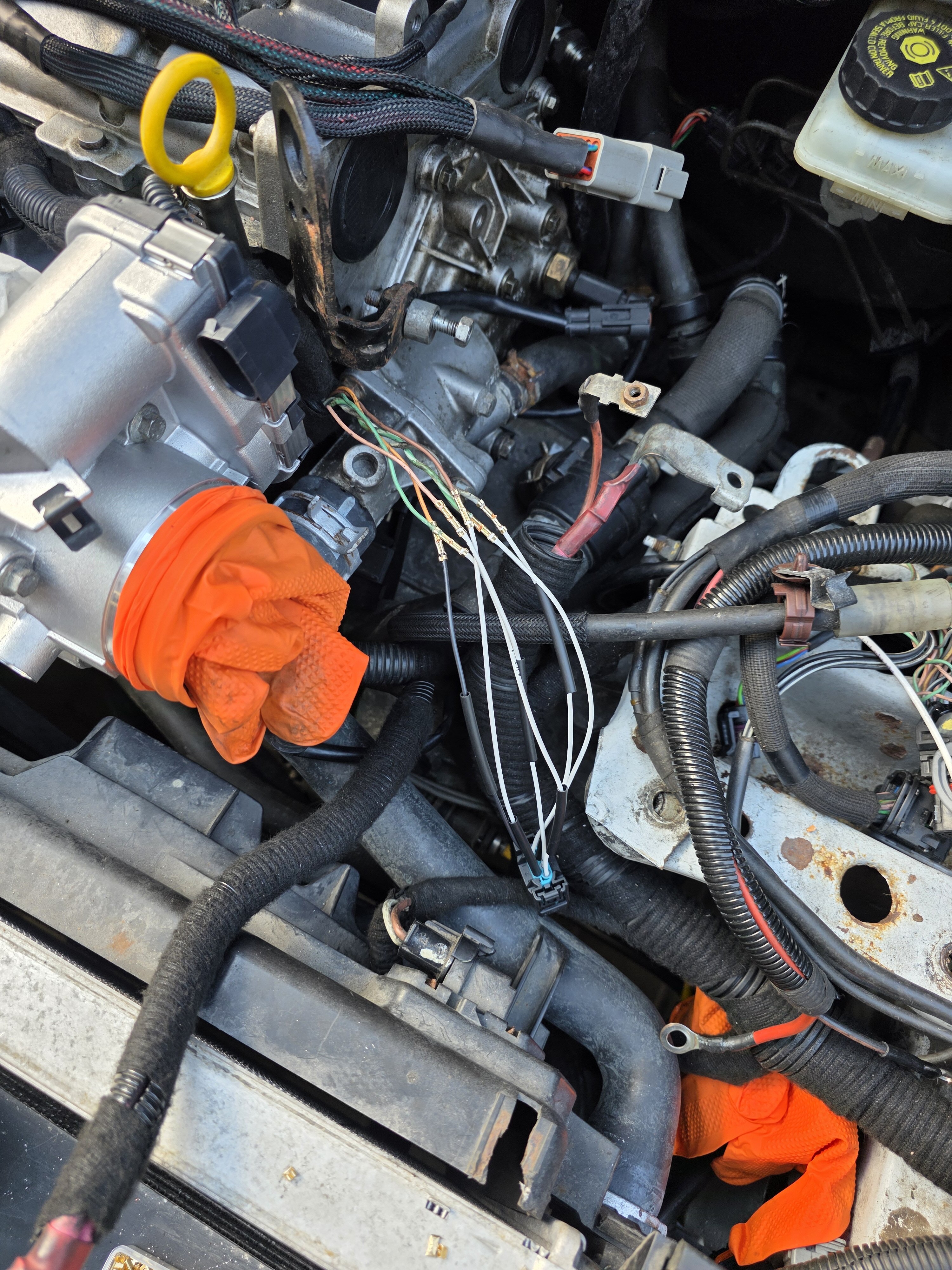

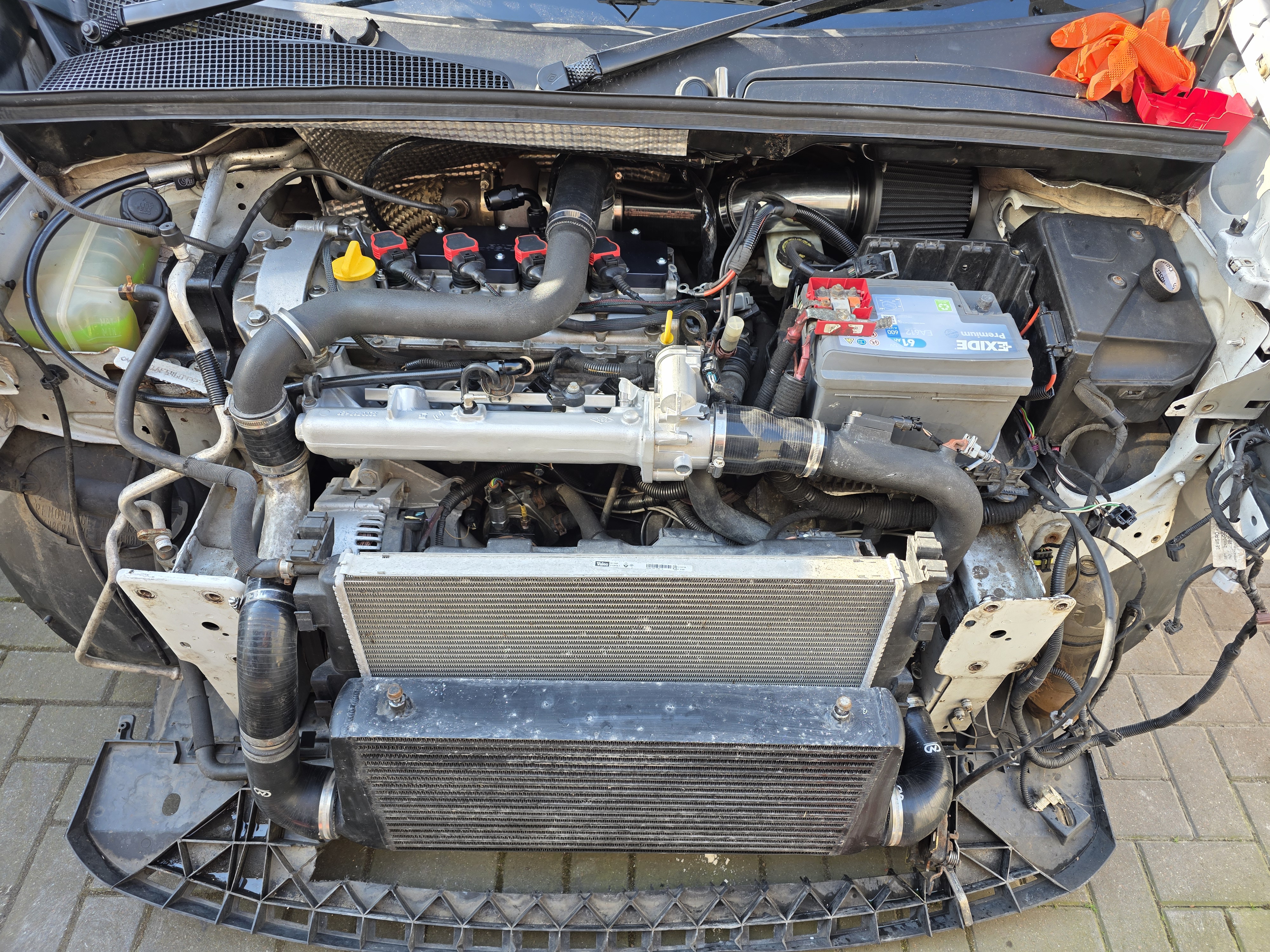

With that done it was time to finish the wiring. Throttle plug needed wiring in, and once id found a good route for the wiring, i knew what length was required. Crimped and dual wall glued heatshrink gives a solid connection.
Also done mac valve and logger connections. With that done the loom was finally complete, I then offered up the battery tray to see how it all fitted.

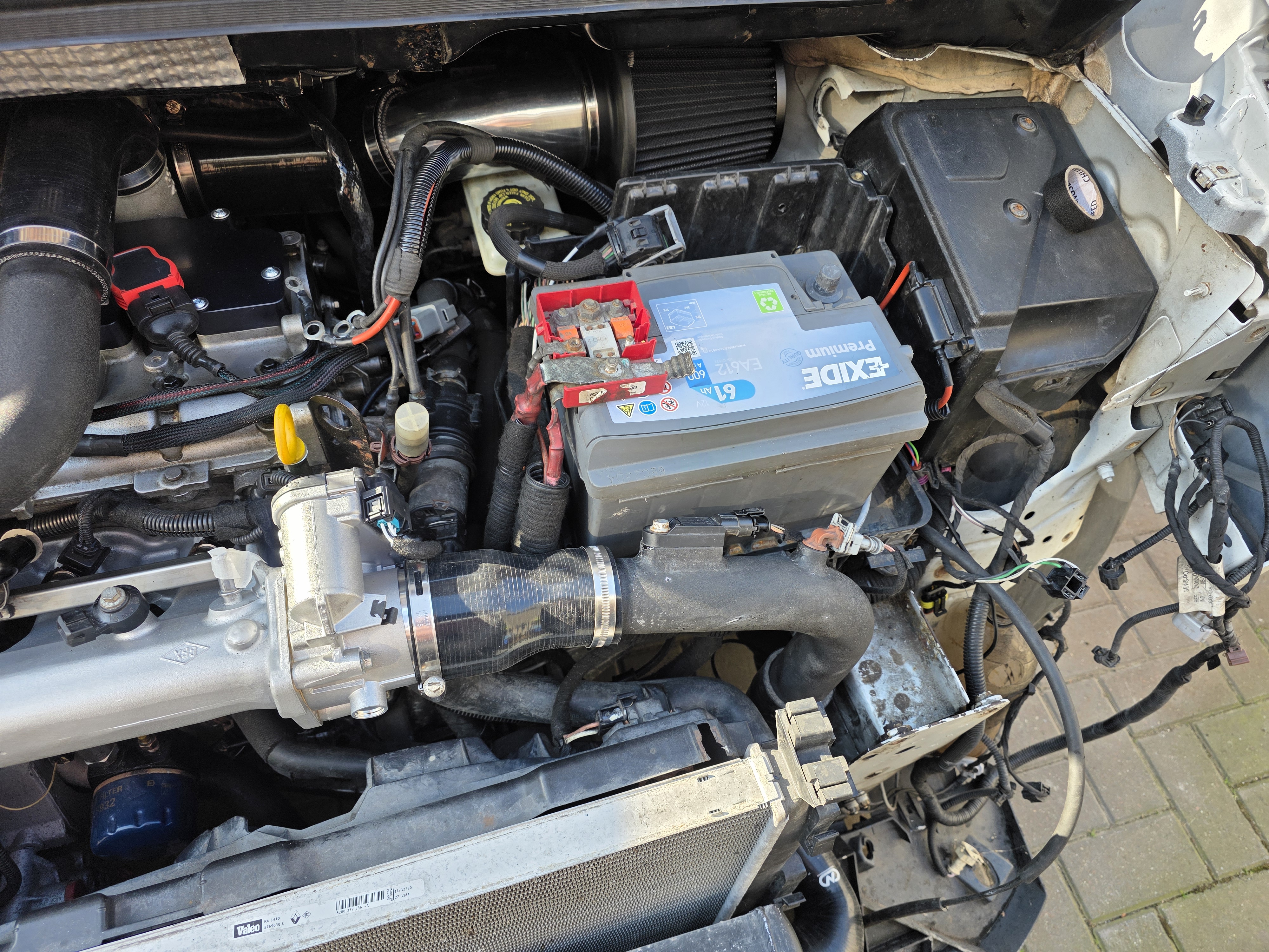

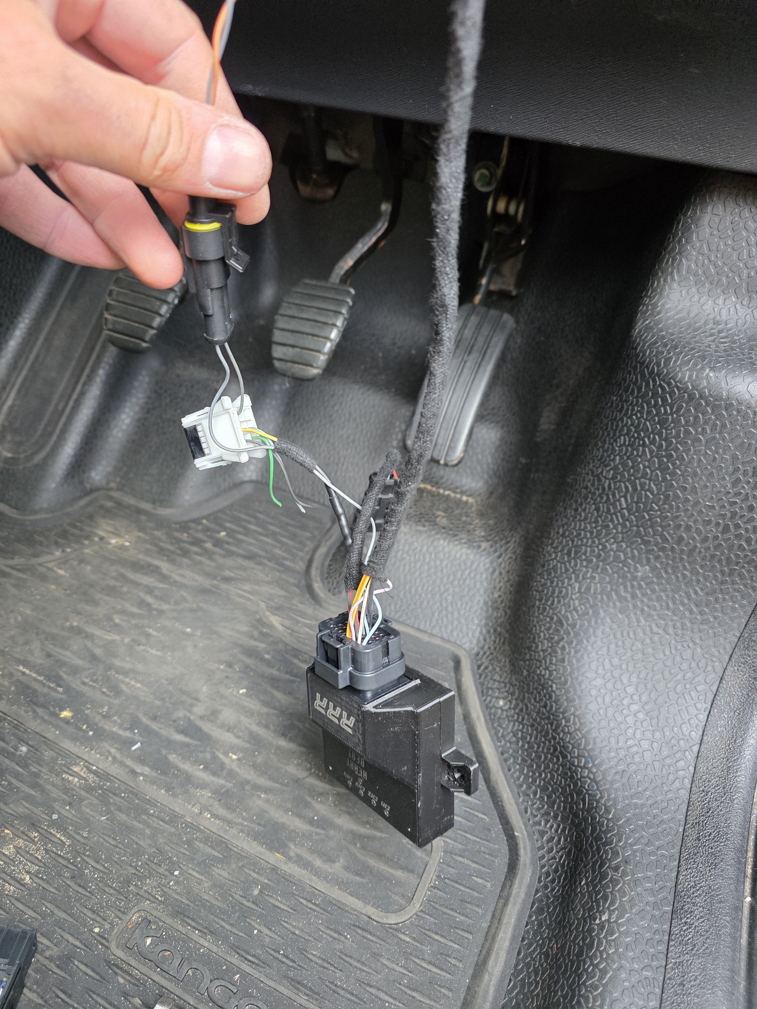

The larger throttle body made routing the wiring to ecu and battery difficult as it was very tight beforehand and adding a larger silicone hose took the available room. The plastic battery tray was offered up and trimmed to suit.

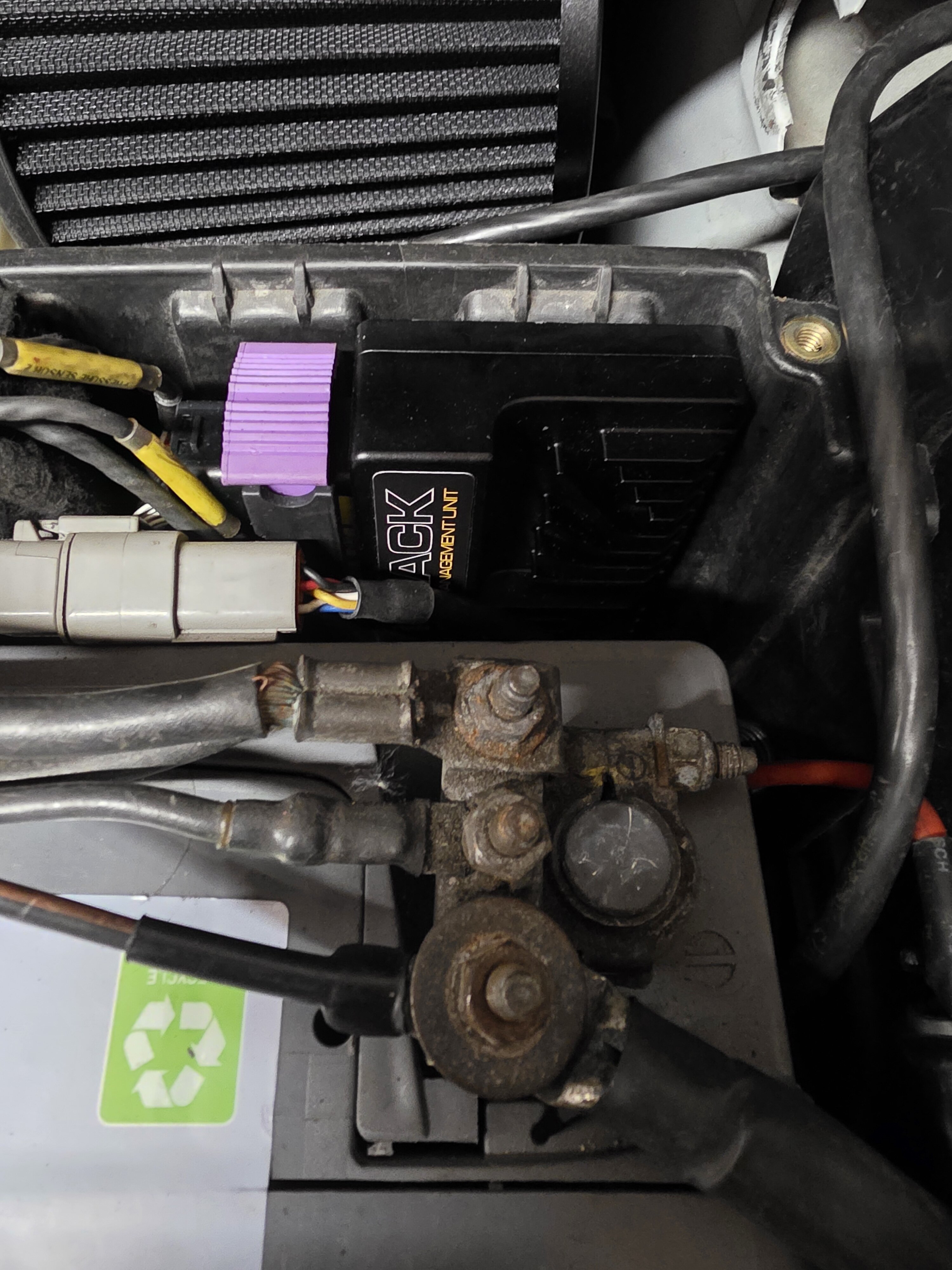

I then fitted the ecu adaptor loom and ecu in the oem location, with a rivnut securing the ecu tonthe back of the battery tray.

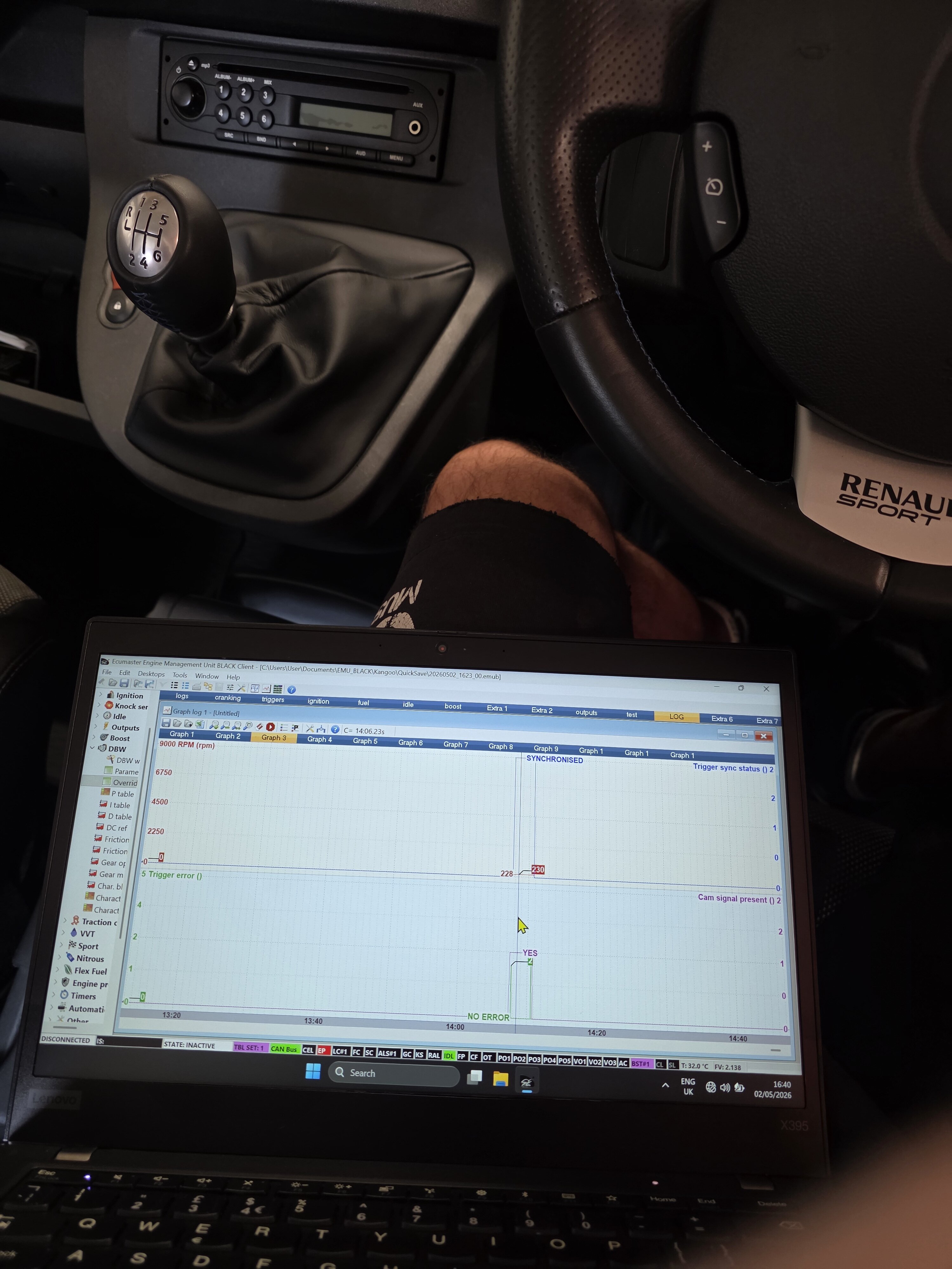

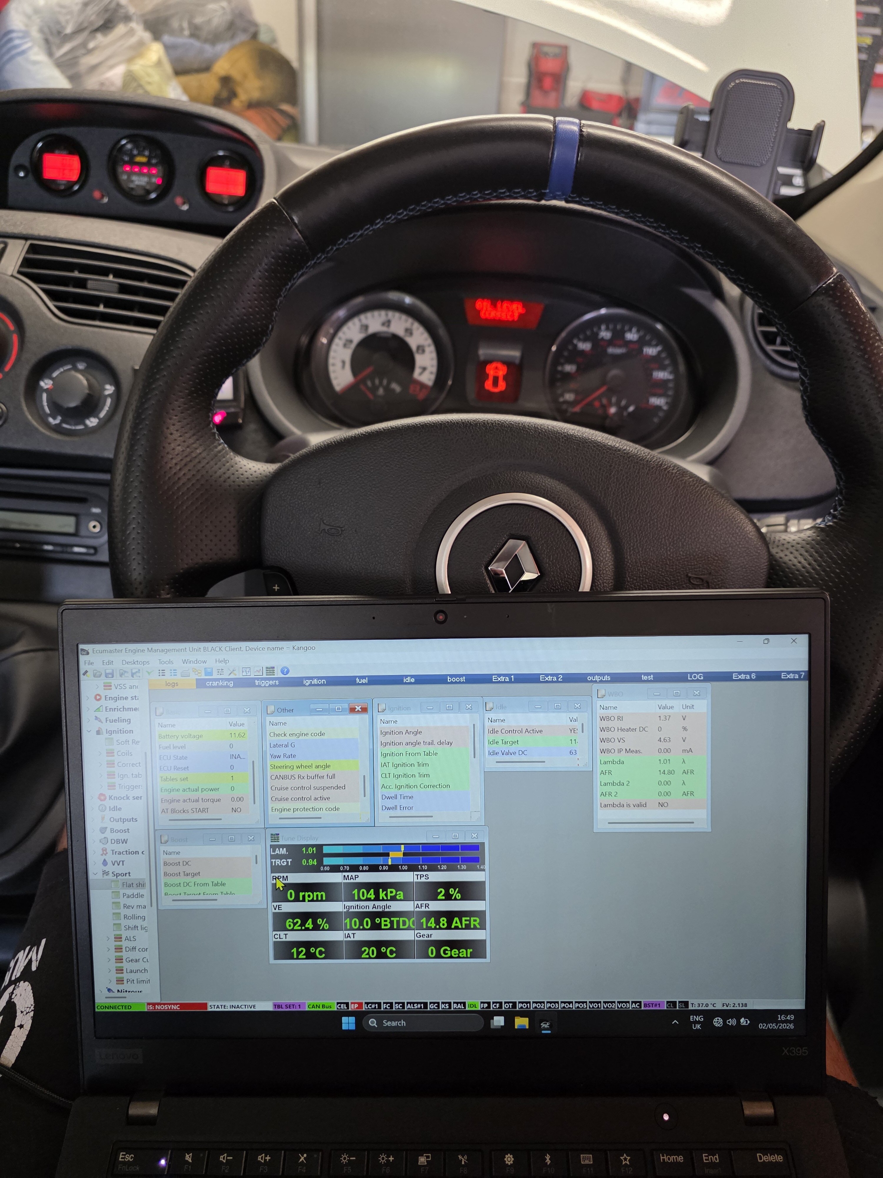

With this done i connected the battery up and energized the ecu. The ecu powered up all good and ecu connected to laptop fine, radiator fan singing away as not configured.

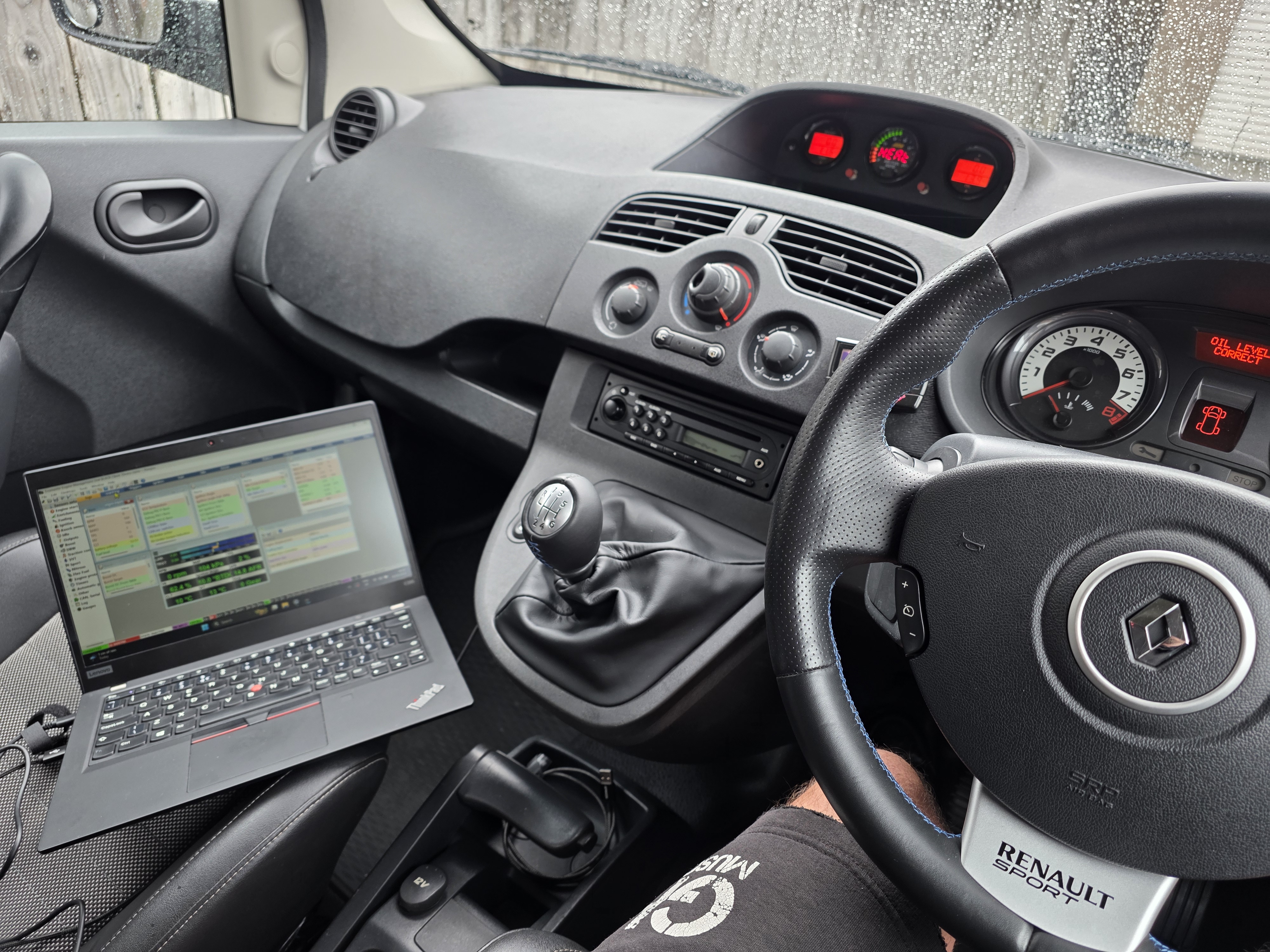

With coils and injectors unplugged, uploaded the modified base map that i have been working on to suit this setup. Looked at sensor data and coolant temp, air temp etc looked good/as expected.
I then ran the dbw throttle calibration tool to set the bosch motorsport throttle up as no pre defined calibrations for the part number i am using. Throttle calibrated fine and operation checked.
I then cranked the engine over on the starter motor to check crank and cam triggers would read and sync.
Checking the logs, all good and both sync fine. No point in messing about, connected coils and injectors and cranked the engine. A few coughs but no start, sounded like it was trying on one or 2 cylinders..

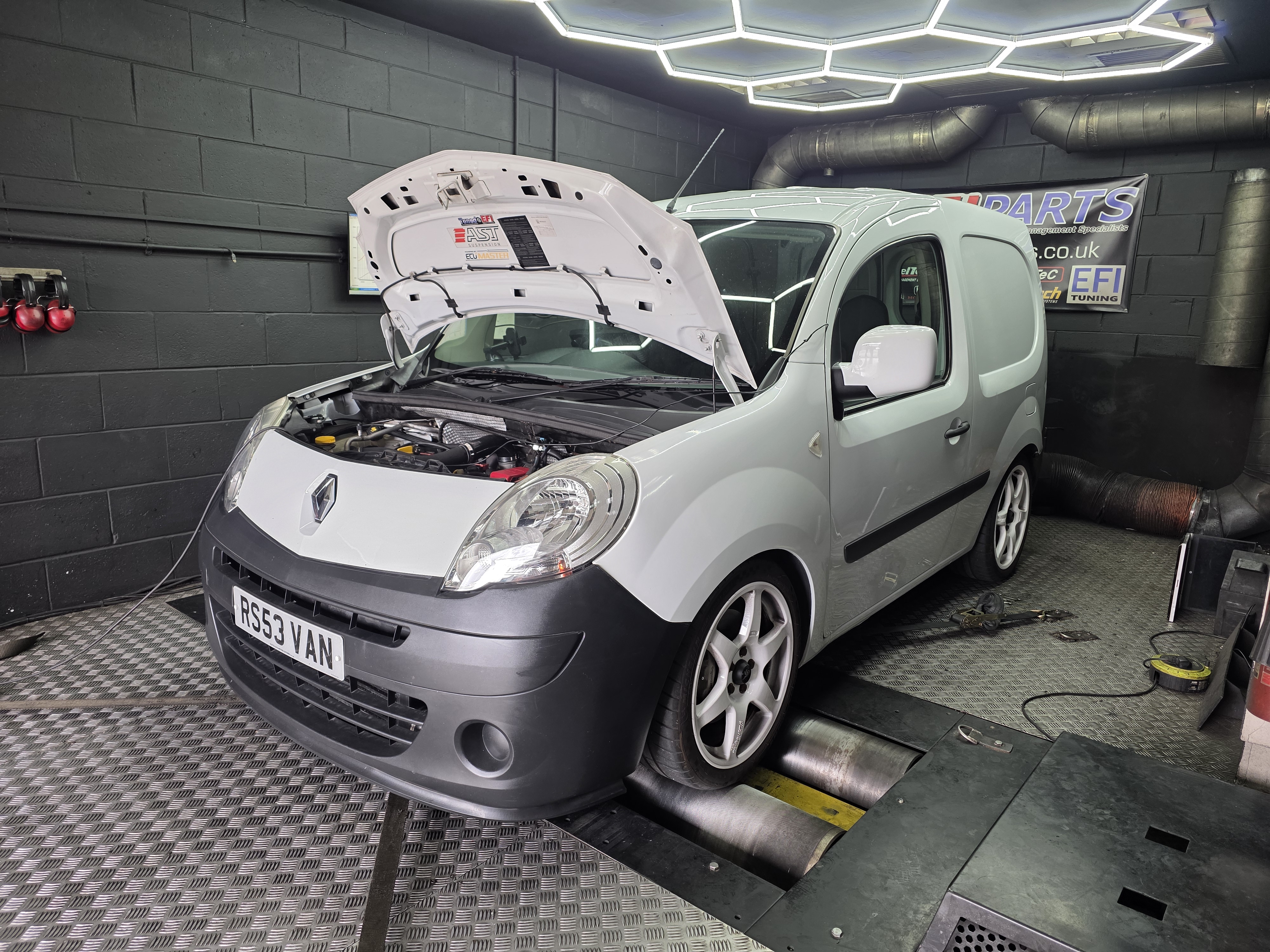

Done some basic checks to ensure coils had power etc. All good so asked Sebimotorsport to check injector phase and firing order were correct. My pnp adaptor ign outputs have been wired a bit different to expected so needed a couple of changes, and tps inputs needed switching on the software. A few attempts later and it fired up running ok on all cylinders. Not the clean start i wanted but close enough. Could tell the map was way off, idling low etc but running.
By this time id pissed the neighbours off enough with noise as it was 9pm on Sat so asked Sebi if he had availability to remote in for cold start and 3500rpm base map to make it drivable up to 70mph to get to the dyno. He said yes 10am Sunday morning. This was goos but I still had no front end on the kangoo so had to quickly refit that and get it in a drivable state. Slight trimming to slam panel for throttle but all went together easy enough.
Sunday comes and its pissing down.

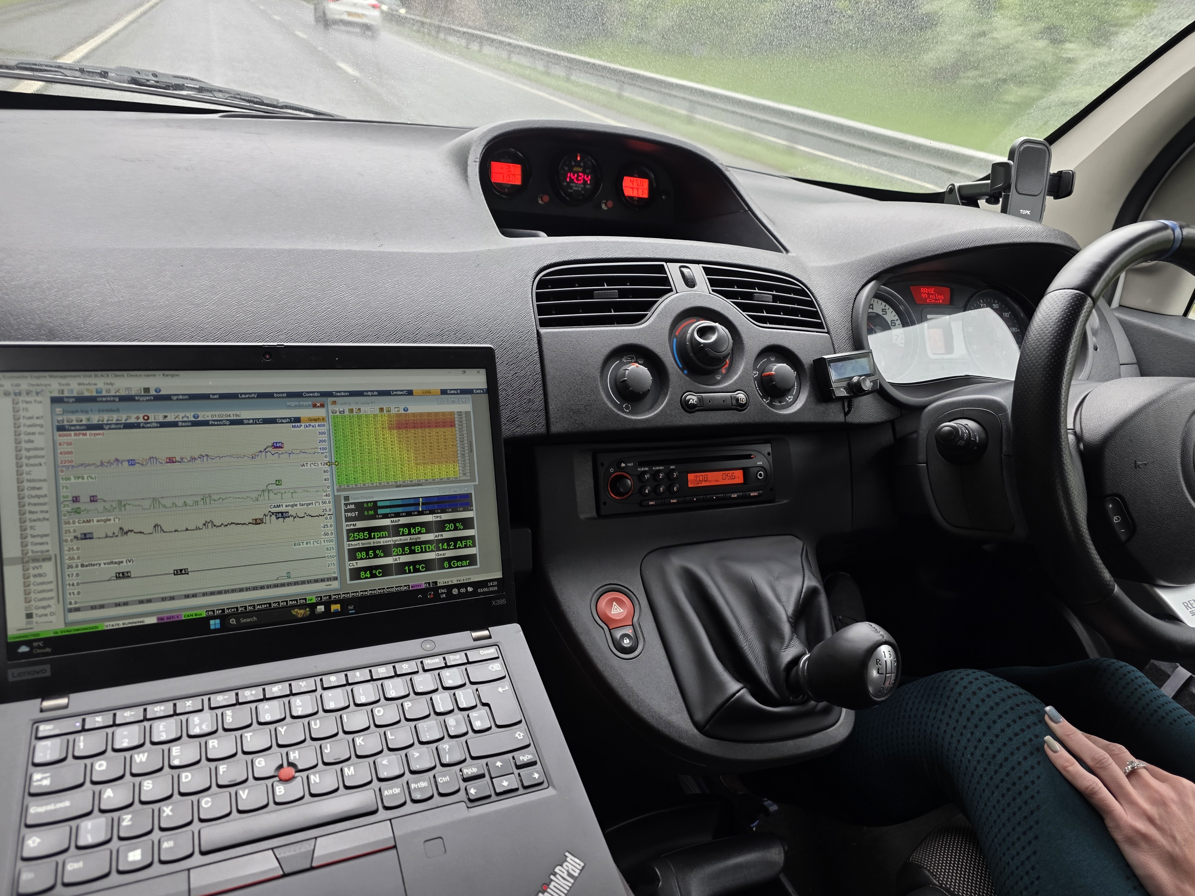

Sebi takes control of the laptop remotely and startes adjusting throttle, fuel ve map etc and communicating via whatsapp.
He asks me to start the engine. Engine starts cleanly and watch him adjust the throttle settings and it idles good. Few revs to check fuelling etc. Next we drive, with laptop tethered to mobile. A few tweaks to fuelling, ign etc and its driving good, very smooth. No warning lights on dash or nothing, rev counter etc working good, abs happy etc. This is good as im using clio3 canbus protocol on a megane engine in a Kangoo so was unsure how this would turn out 😄
In no time at all we are all done, its safe to be used. Cant exactly do any power mapping as the conditions are terrible especially on cup2 tyres and its going to Efi for mapping on the dyno.
Quick stop and the mrs takes control and do a few more miles. I set up the gear ratios/selection so it shows what gear its in.

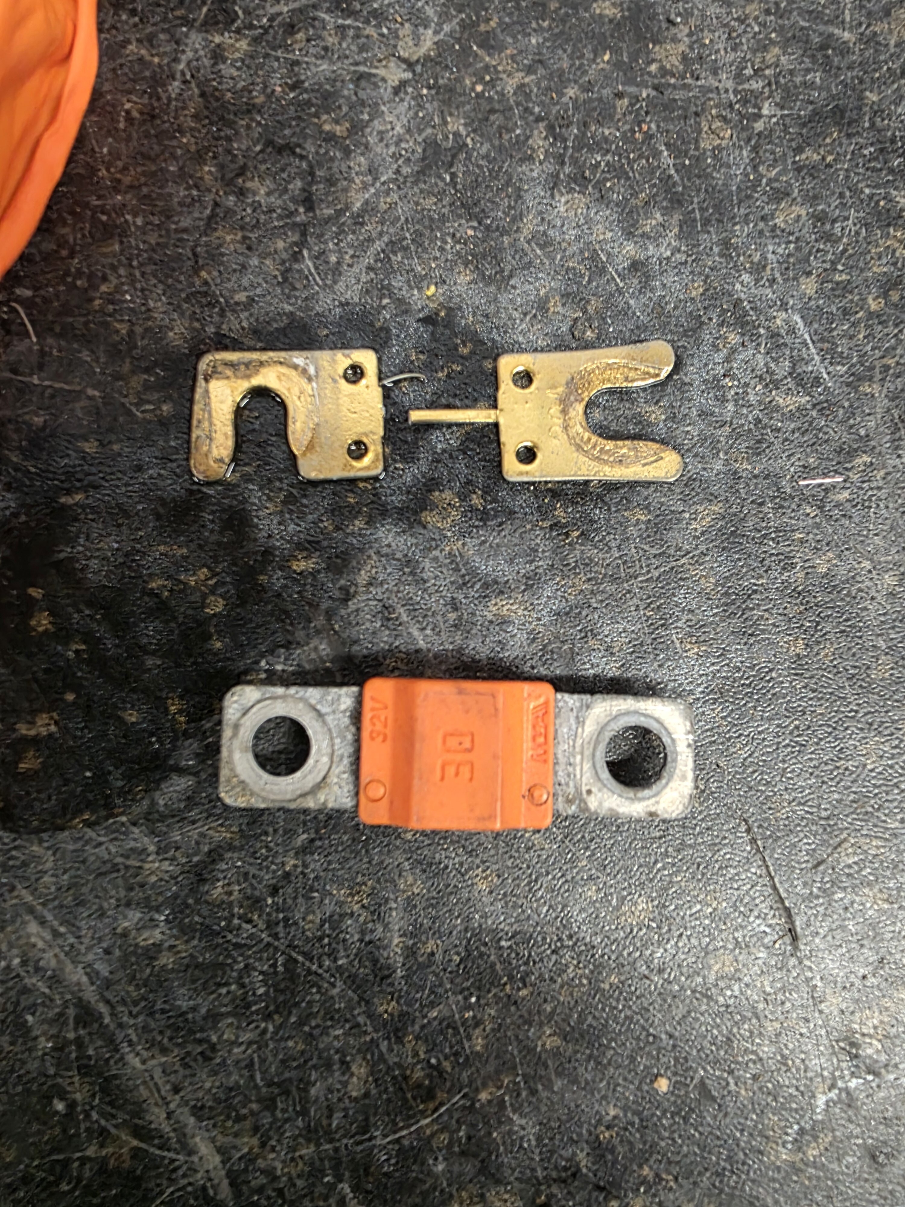

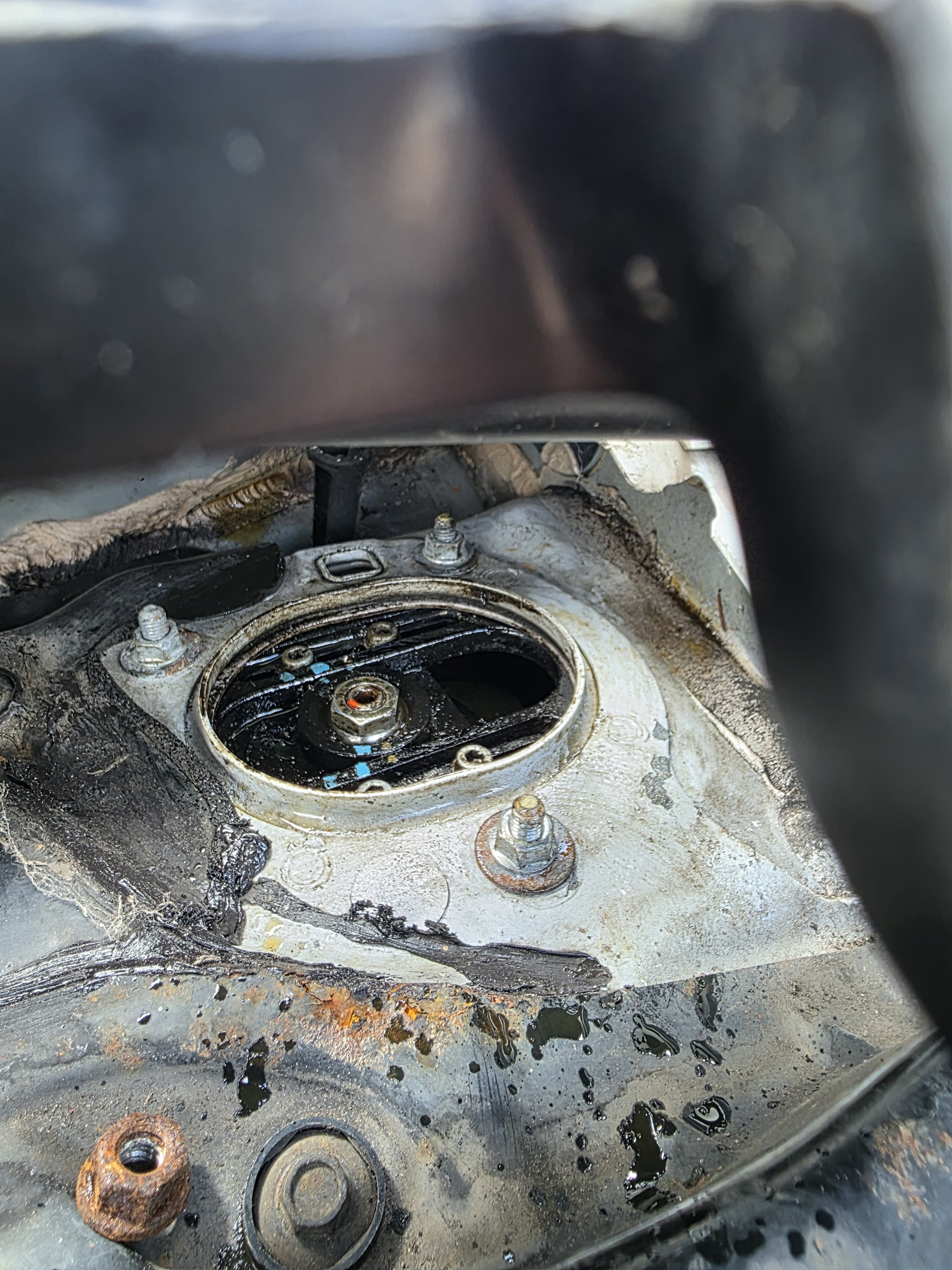

I quickly grab the test meter and start probing the poles on the fuel pump midi fuse..initially no power on output side then next thing it has continuety/ok. I crack ign on and the fcuking pump works. At this point i assumed bad connection on the fuel tank and the thought of dropping the tank with half a tank of fuel in pains me. Sleep on the fucker, its a job for another day.
Get up this morning and look at the midi fuse again. To cut a long story short, the fuse bent slightly when nipping the bolts up the other day and centre plastic was loose, i straightened it out and it looked complete, pump working assumed ok/cheap shite etc but if it works send it.
On removal the issue can clearly be seen, stress fracture, assume slight movement must have made it connect.
Obviously not popped as no burns. Replaced with oem renault which look superior in construction. Pump sounds fine no untoward noises.
Starts straight up on crank.
Bit of a ballache but pretty confident that it was the issue. Ill take some tools for next test run just incase.

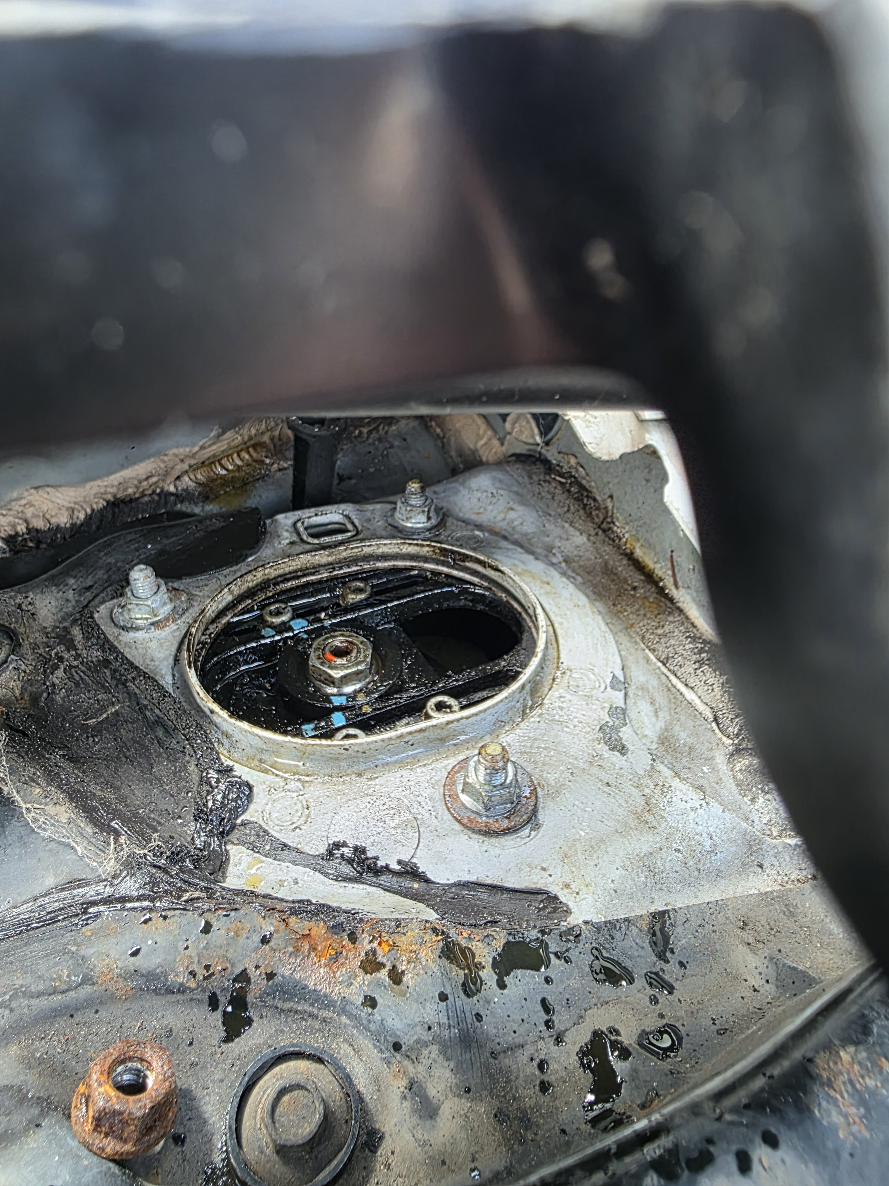

Its got me thinking about fuel system upgrades to a swirl pot/return system though..the nuke combined swirl/pump housing look good.

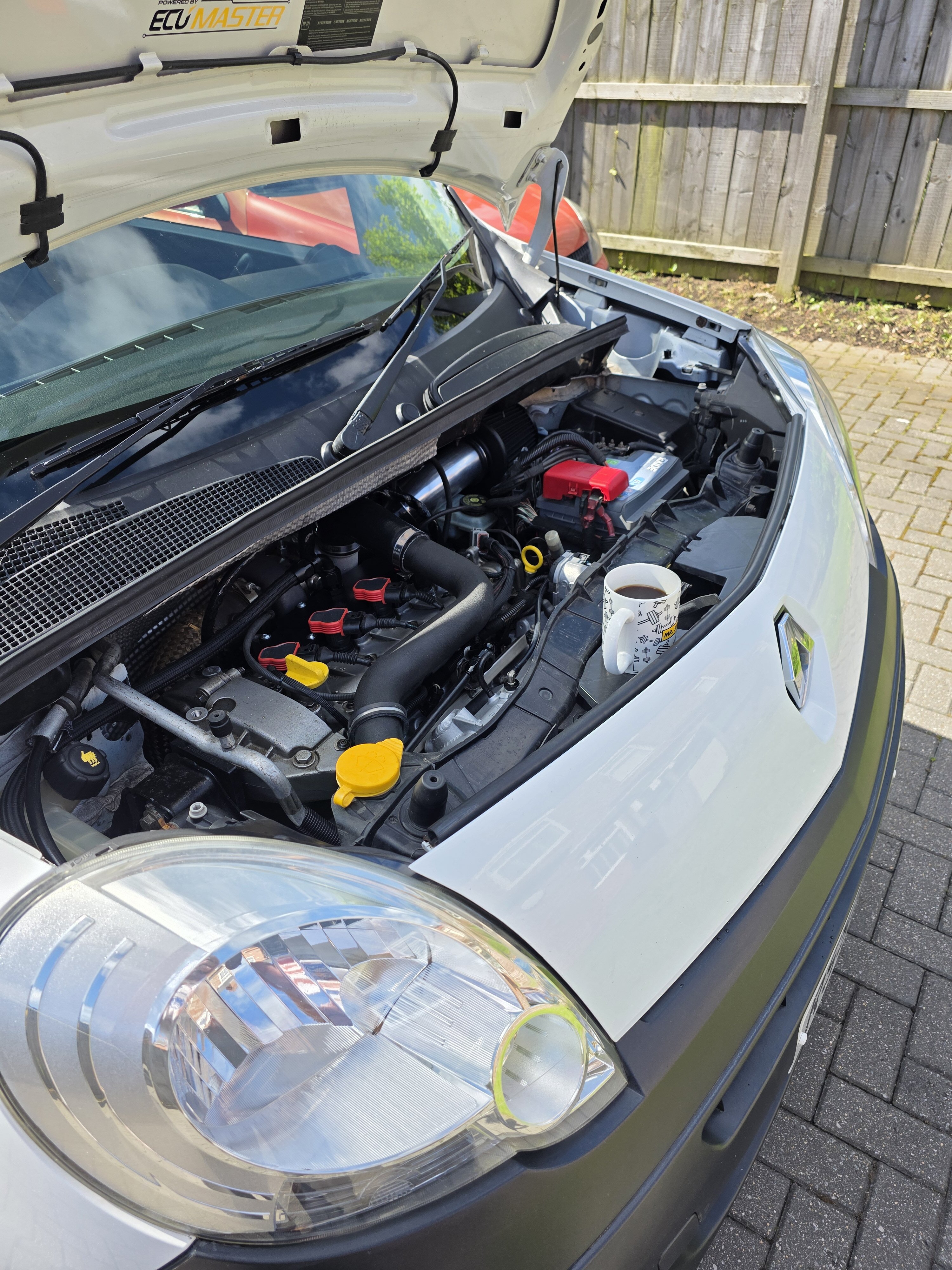

Cleaned on Thursday. Needed it badly.
Took it out this morning for a test run, no issues and confirms stress fracture of the fuse was the cause for no start.

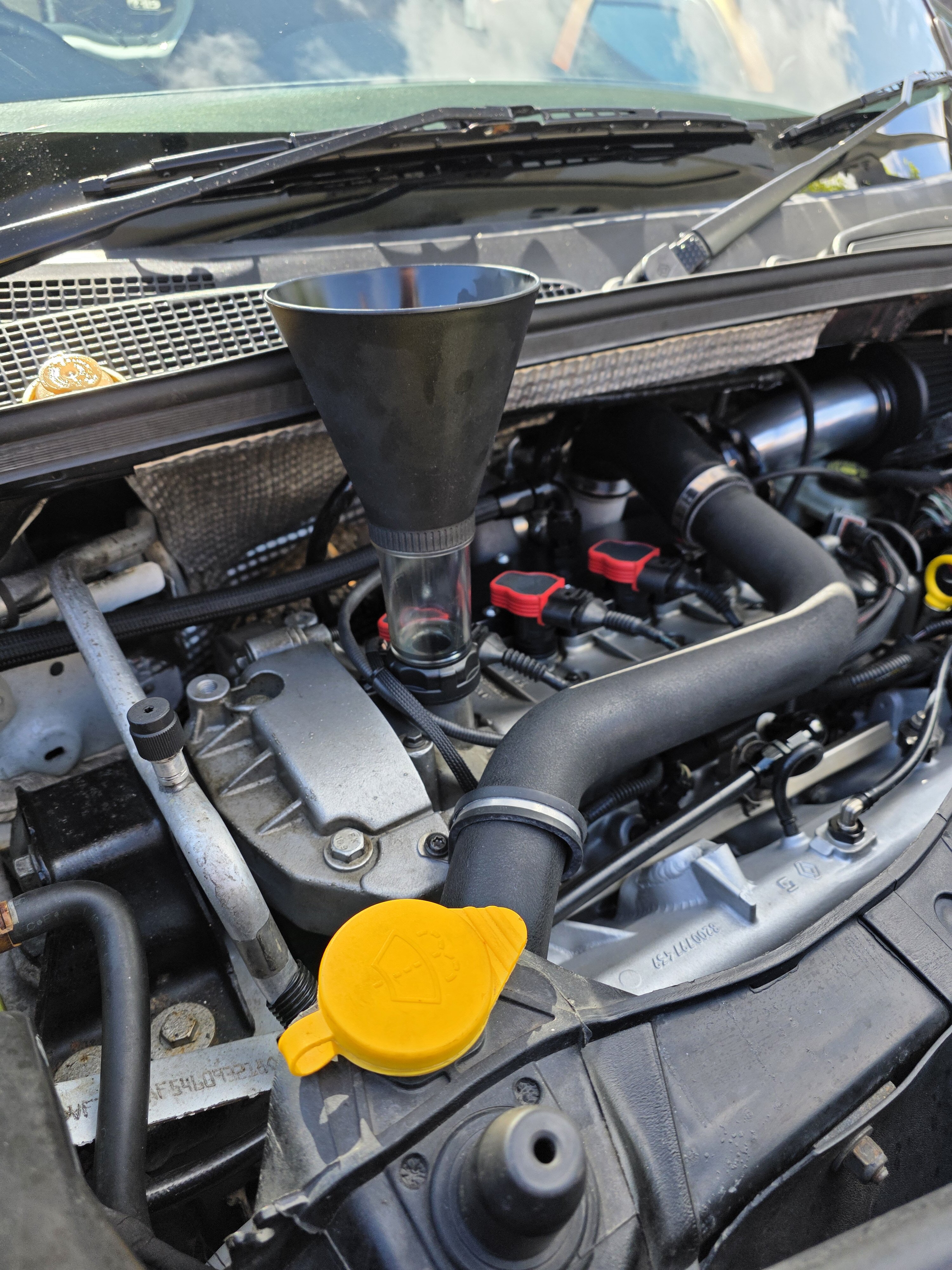

Awaiting a slot for mapping but prep continues. Oil and filter change today. Fresh purflux filter and millers 10/50 nt+.
Ive said it loads of times before but just buy one of these sealey oil fillers for ren if you have a megane. Class bit of kit, no spillage.

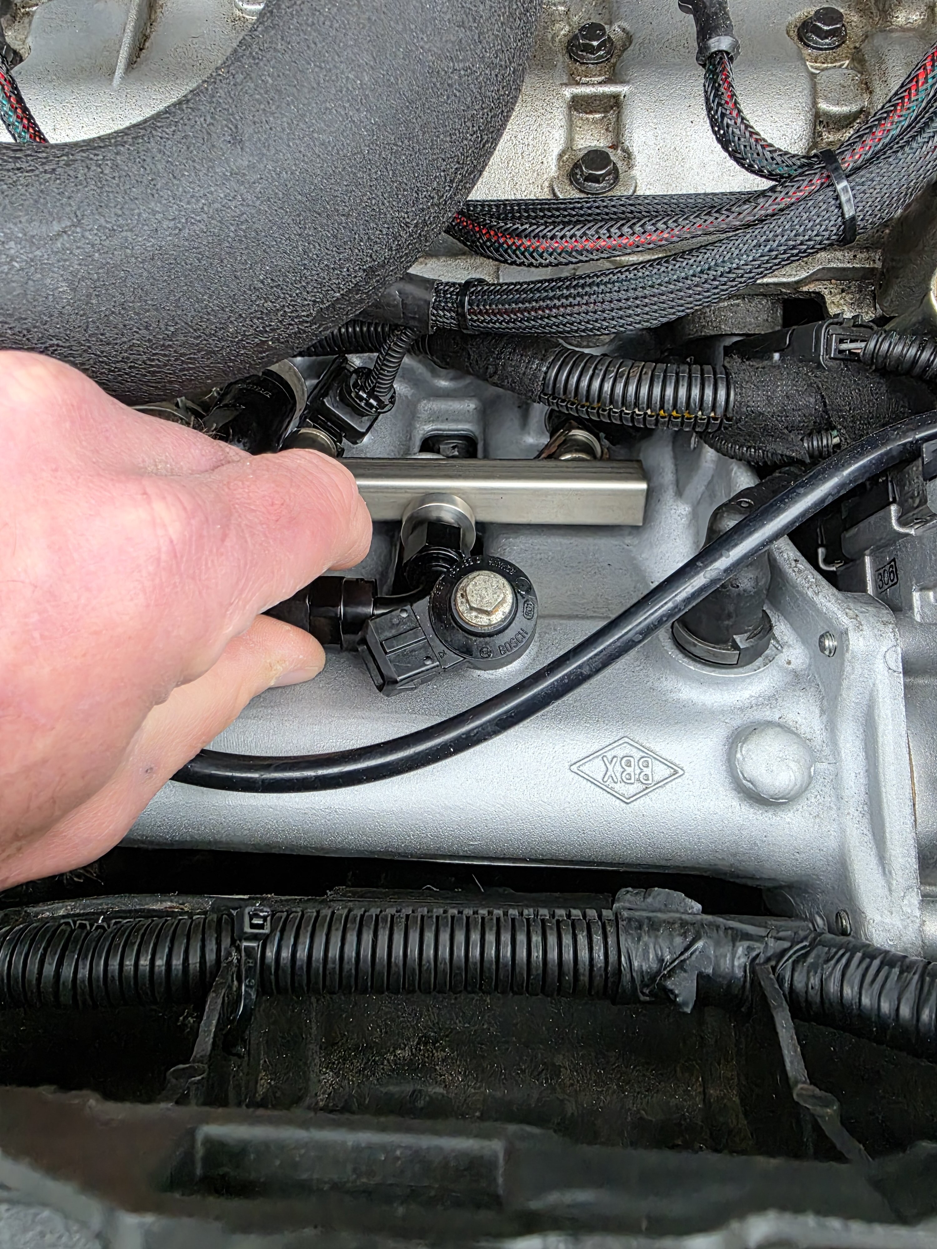

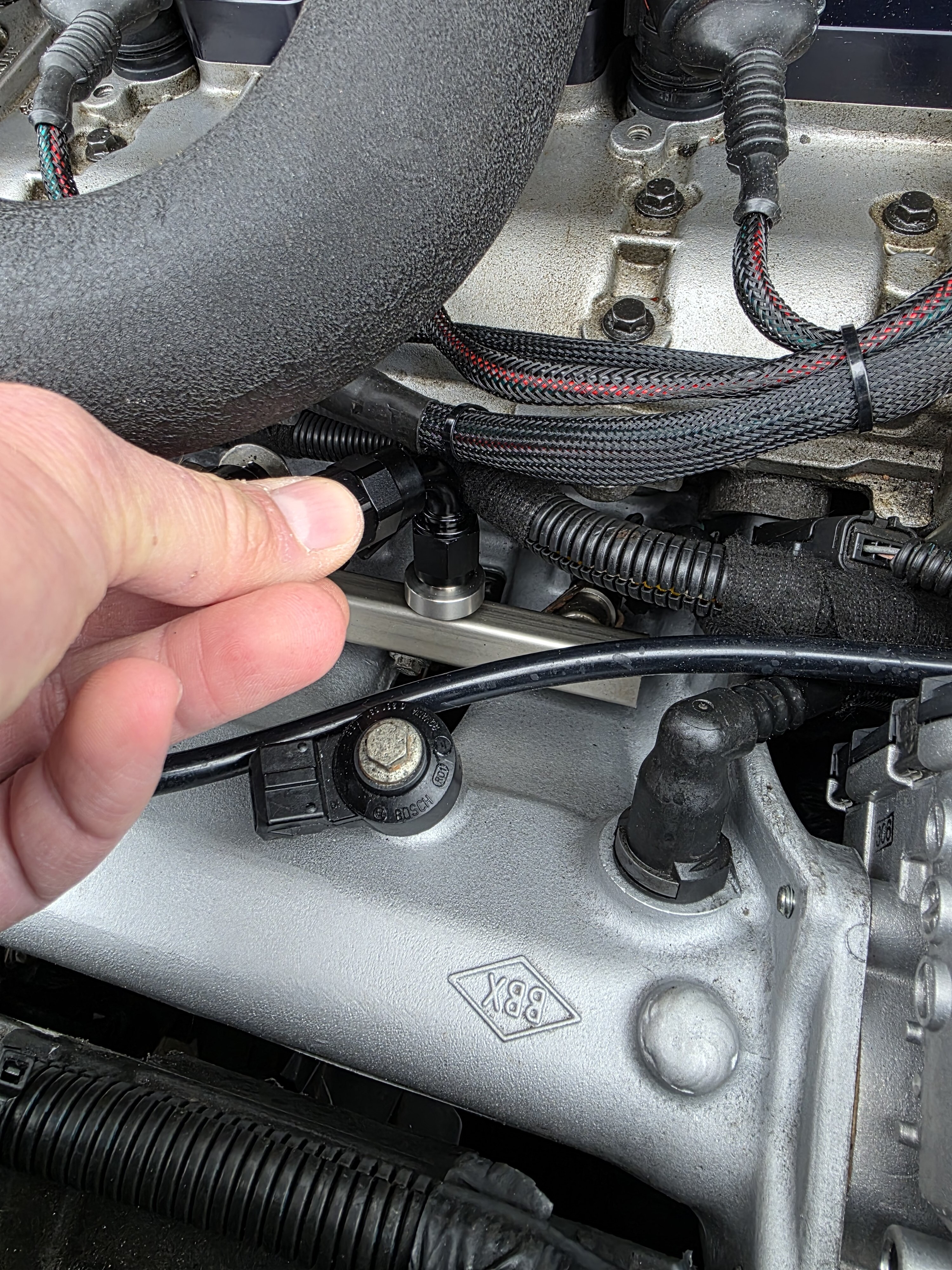

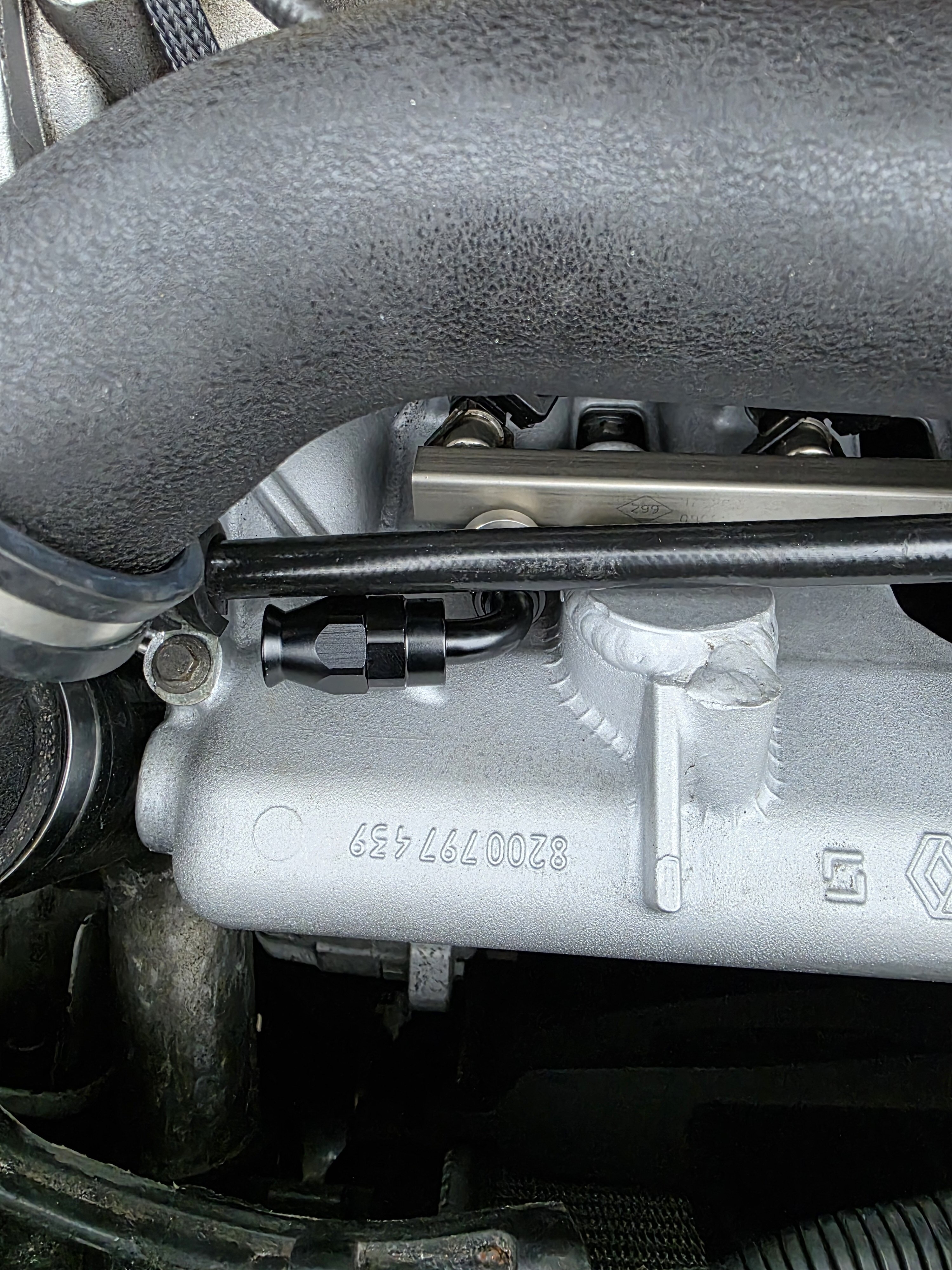

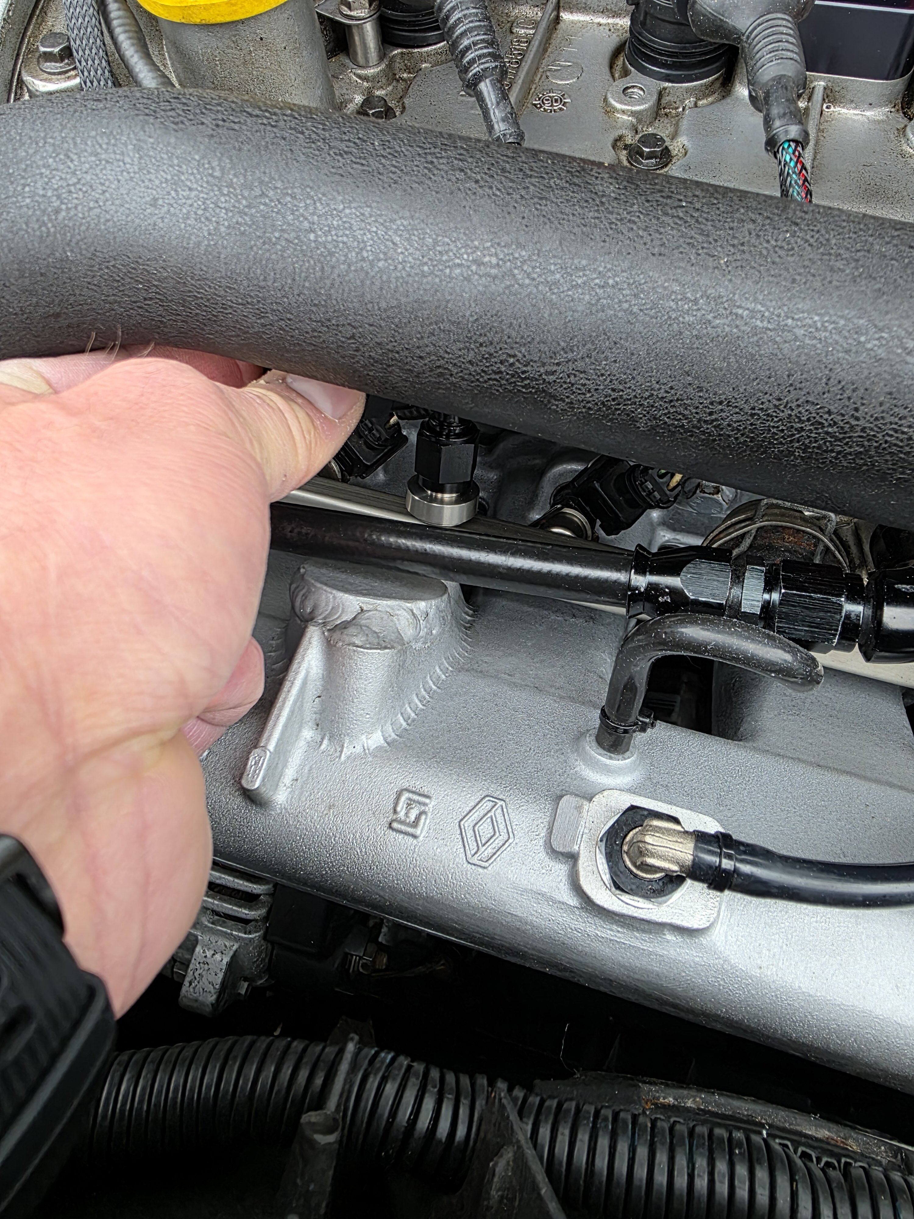

Also been thinking about fuel system upgrades. I have a couple of spare 250 fuel rails here and plan on getting one modified, removing the oem regulator and welding the holes/fitting an an6 inlet and return fitting. The reason for modding oem is to retain the injector holding clips, as a lot of aftermarket megane rails do not allow the clips to fit.
Top or side, both will work in theory. Ill think about it.

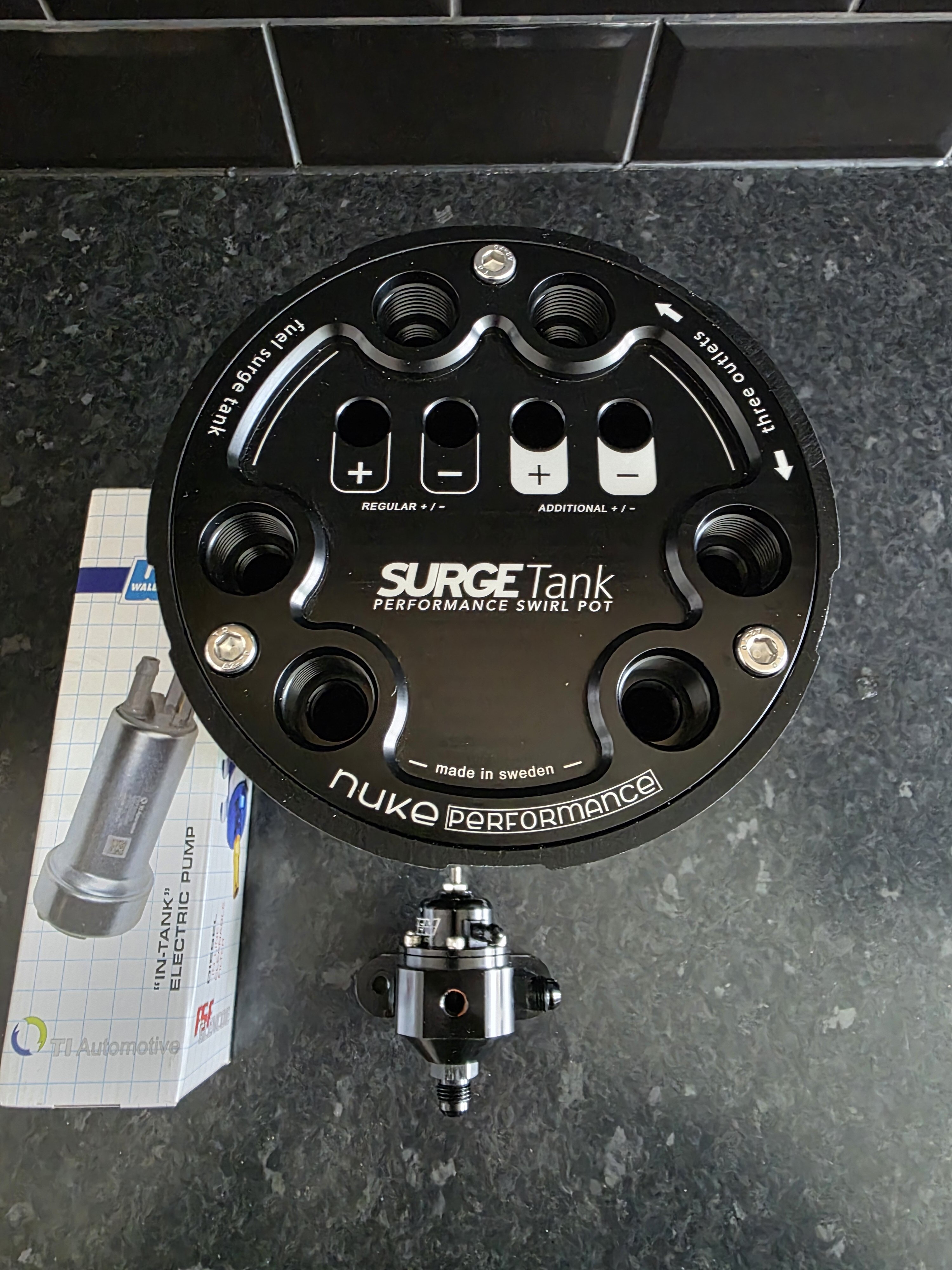

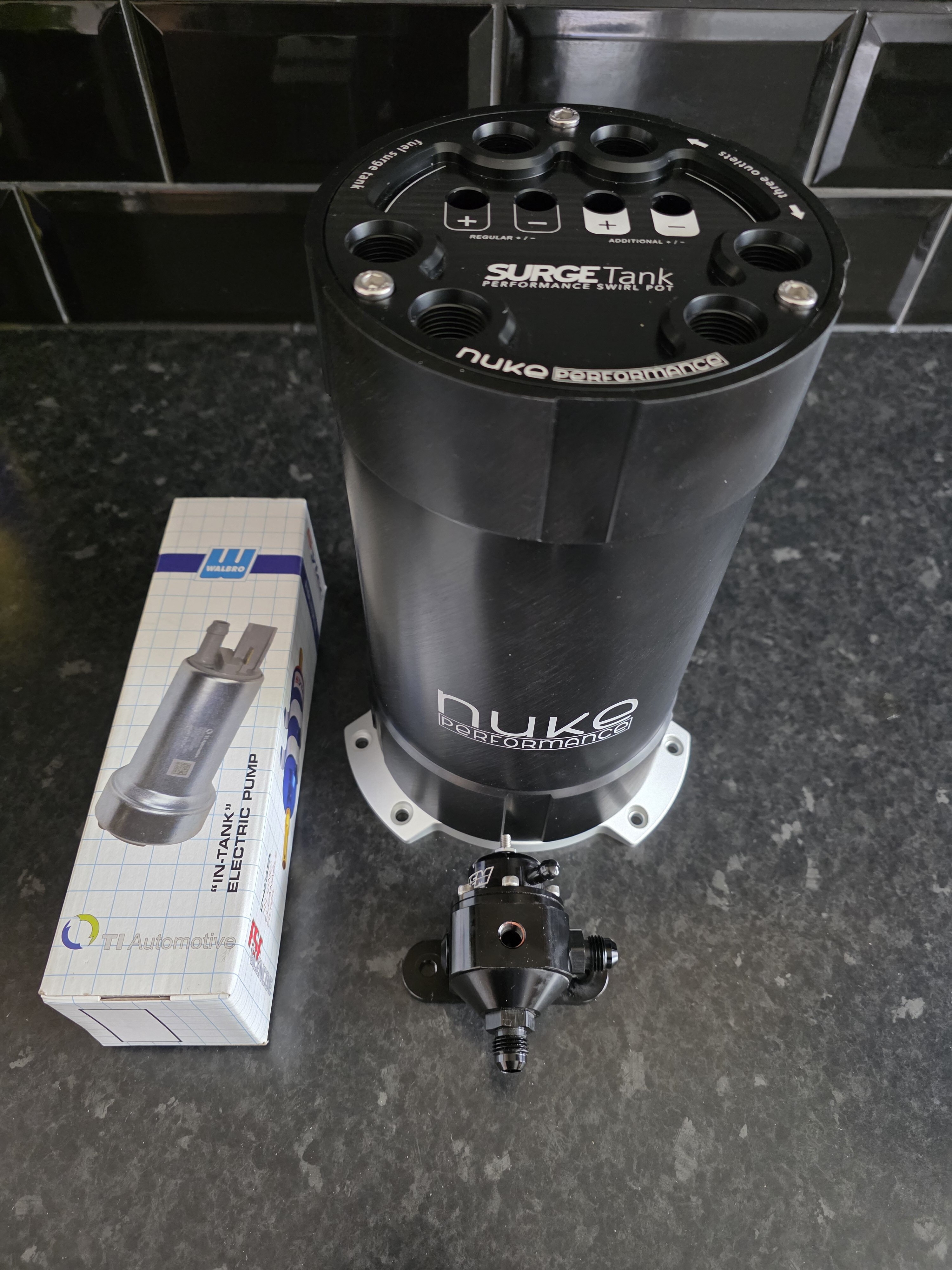

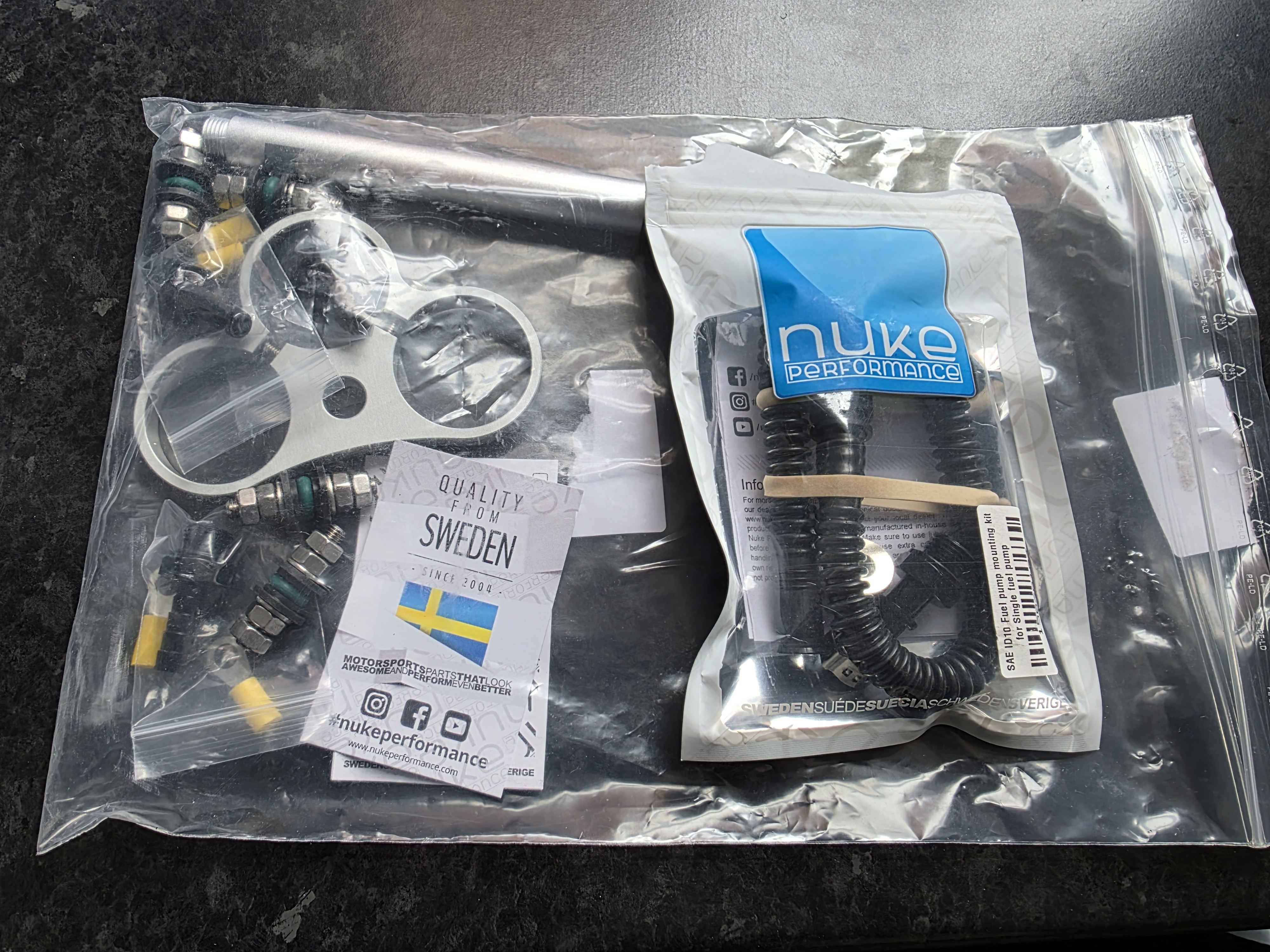

A few bits have arrived for fuel system upgrades. Nuke 3ltr surge pot, walbro 420lph fuel pump and aem fuel pressure regulator.
The Nuke surge pot is a nice bit of kit, really well made, worth the money imo.

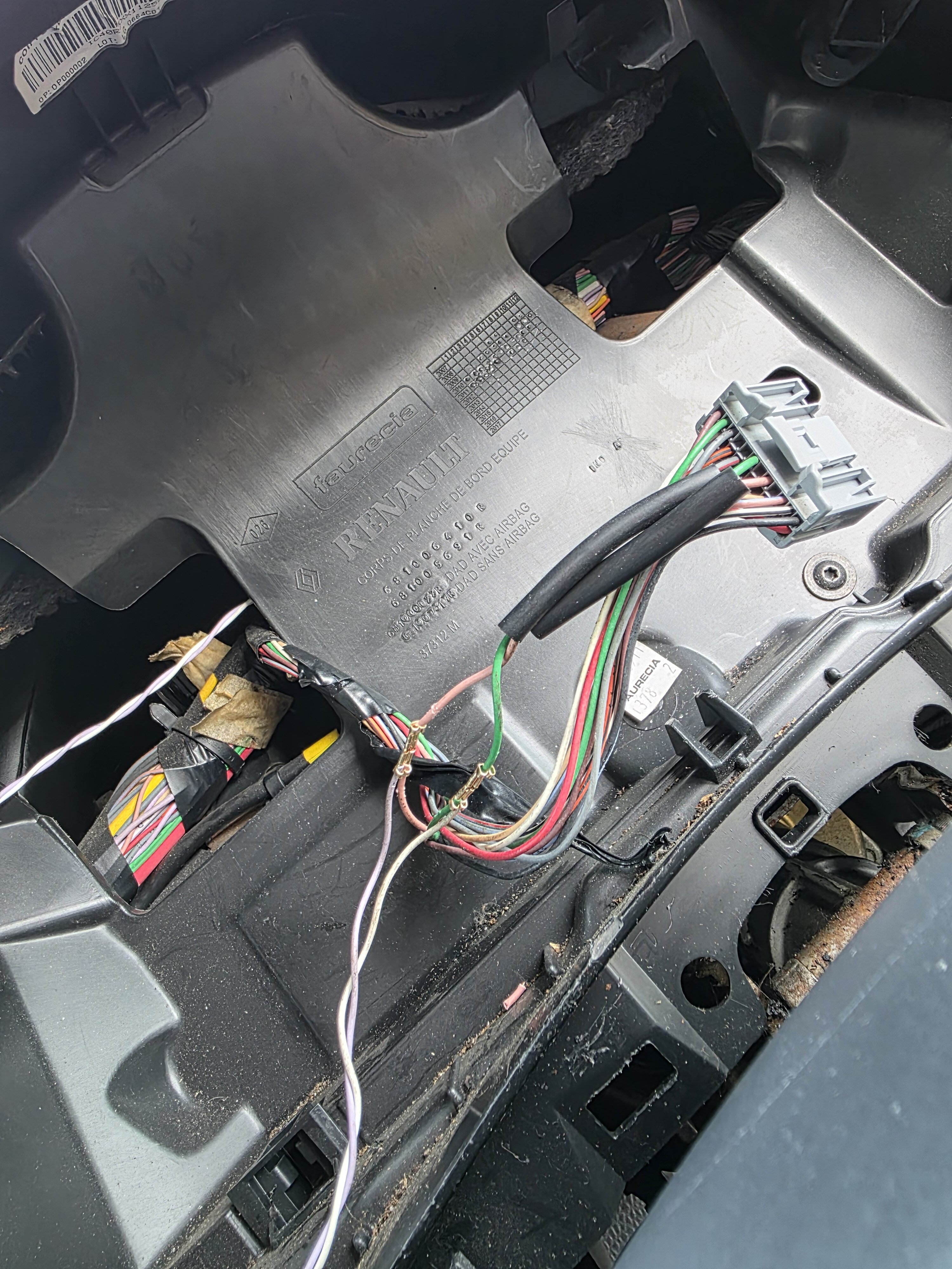

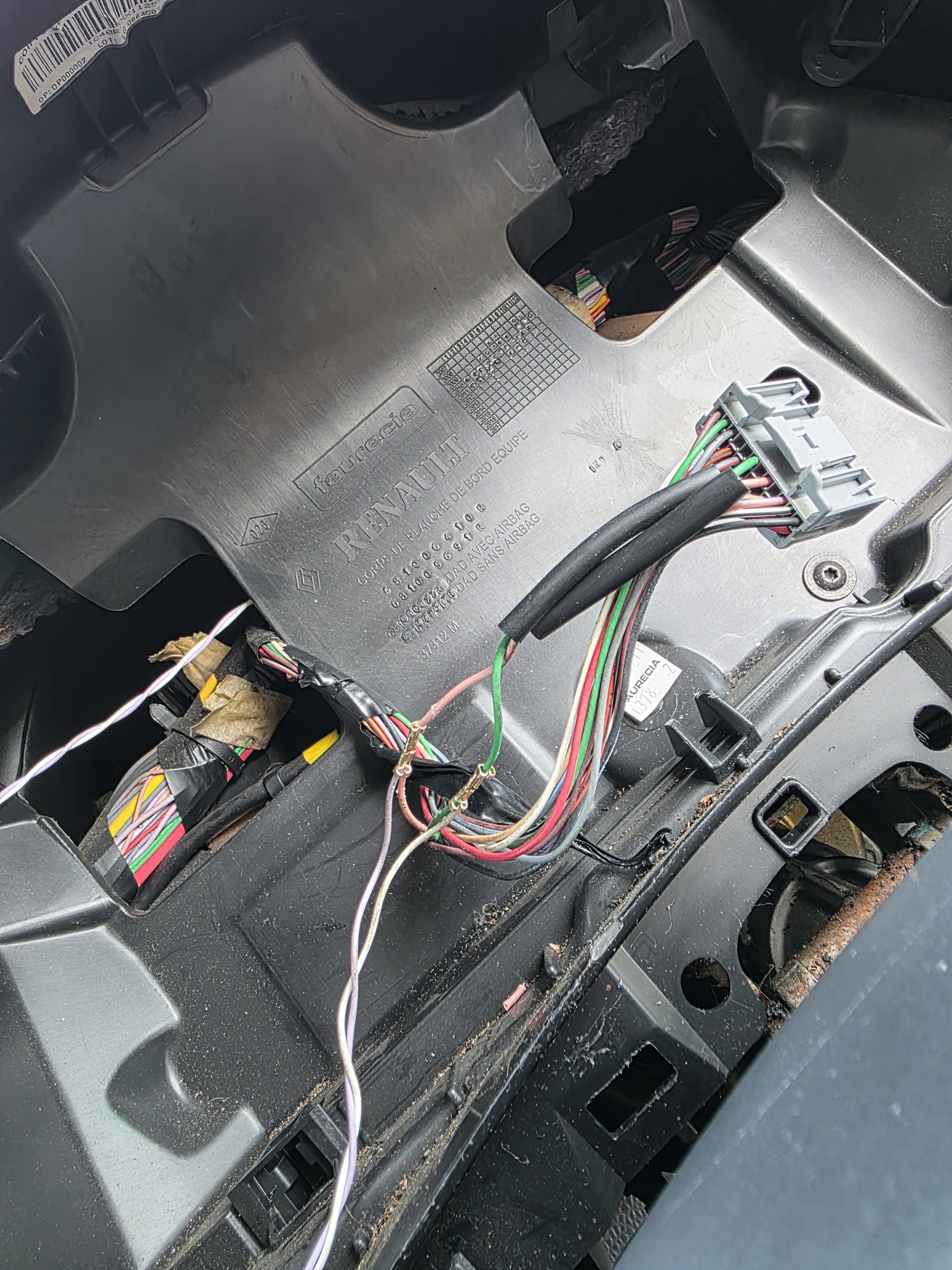

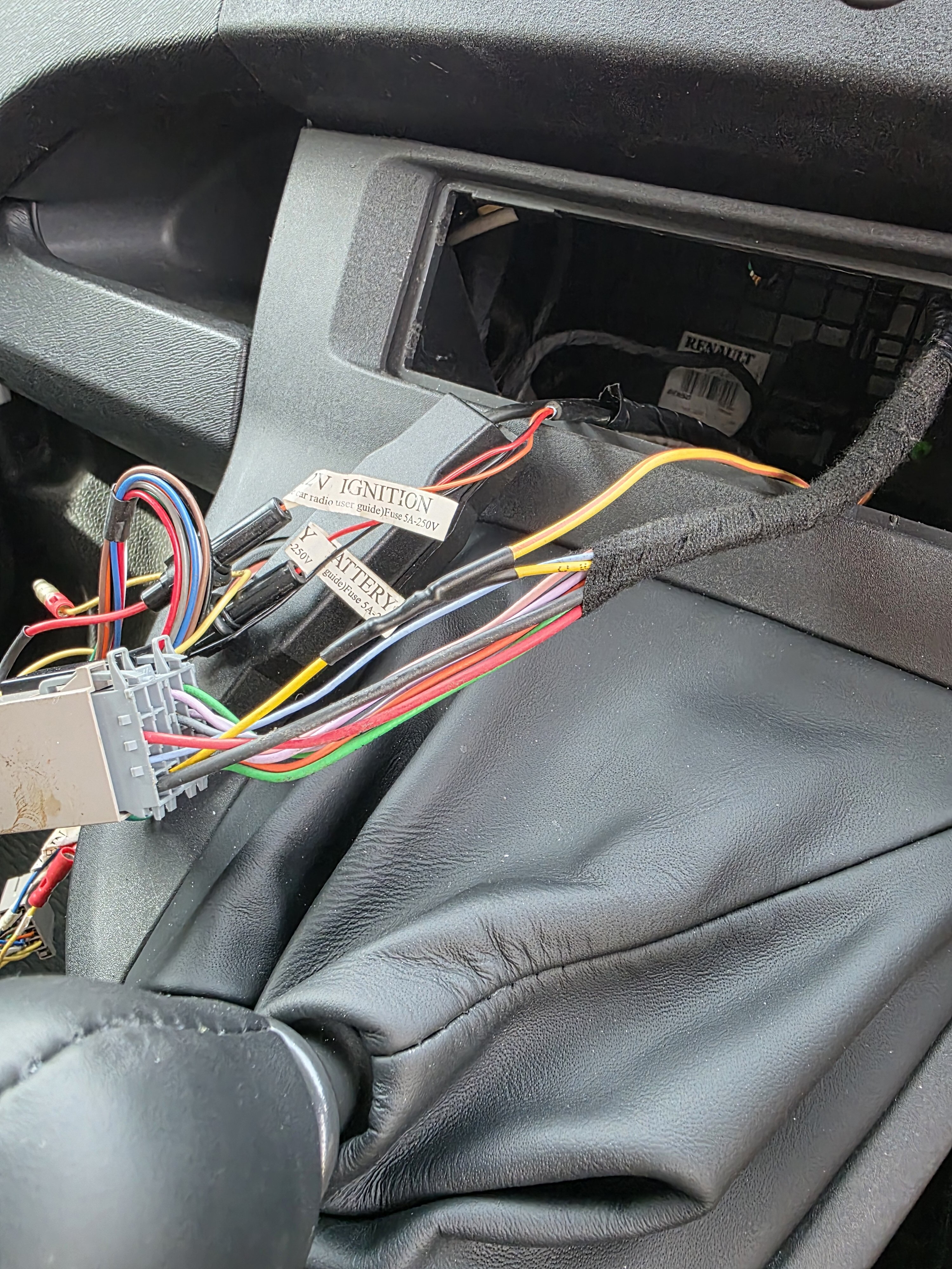

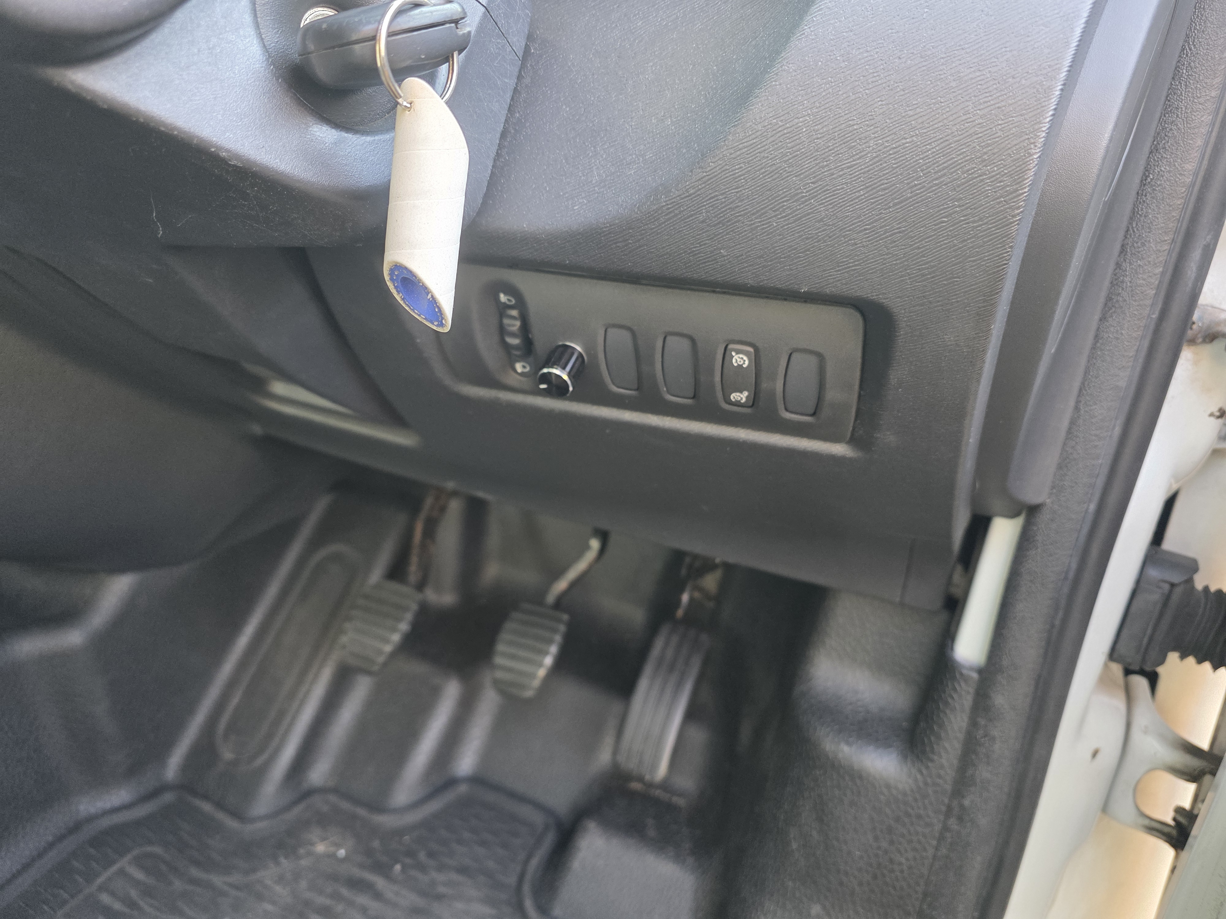

Ecumaster canbus expansion box and rotary boost control wired. These are great, just tap them into the canbus and add extra switches, analogue inputs to ecu etc. No fuss adding loom through bulkhead etc, and most of my outputs on ecu are already taken so needed expansion.
Closest canbus connection was to the dials so tapped into that with a twisted pair.
Dual wall heatshrink
Taped.
Power tapped into switched live on stereo.

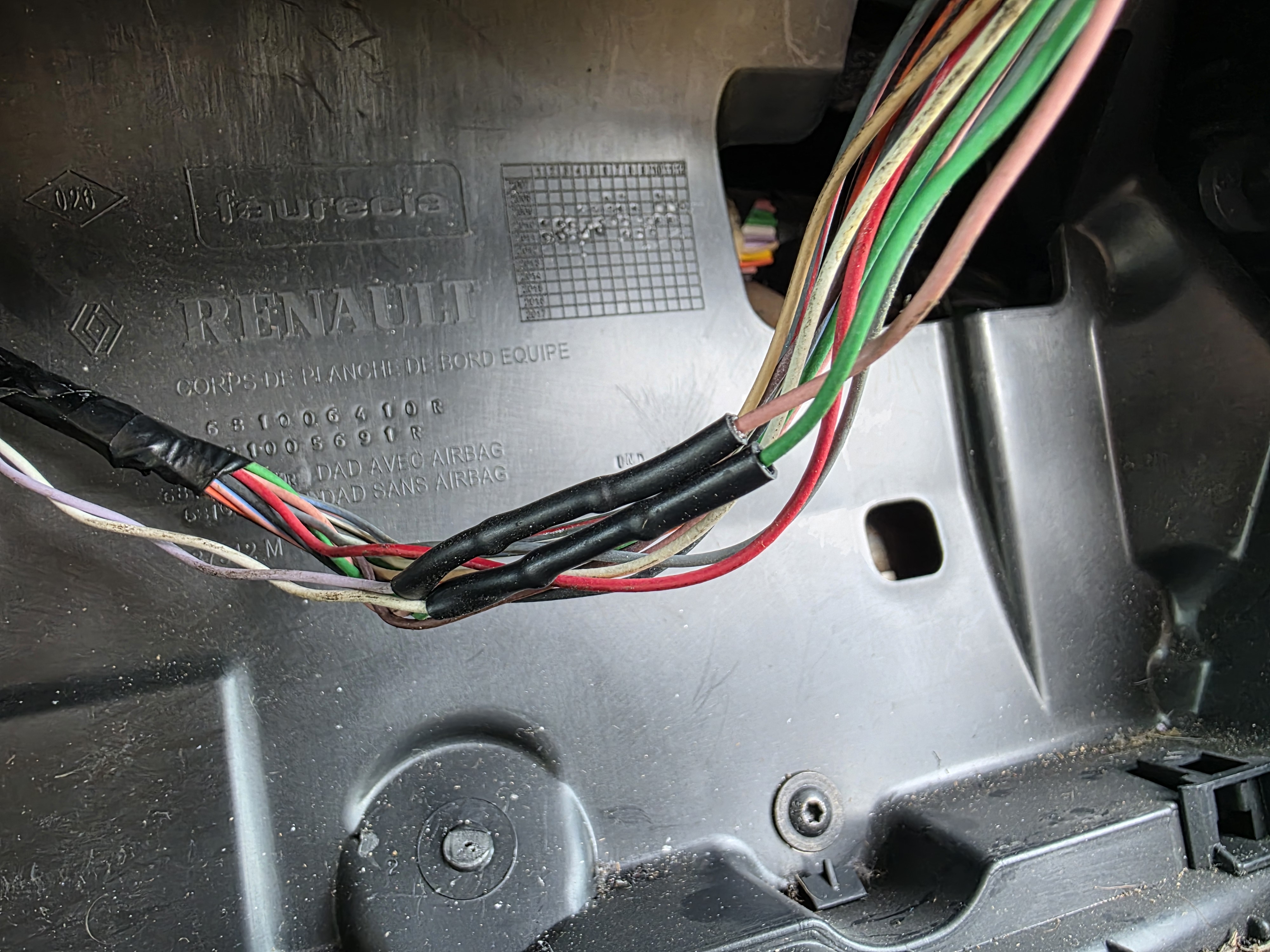

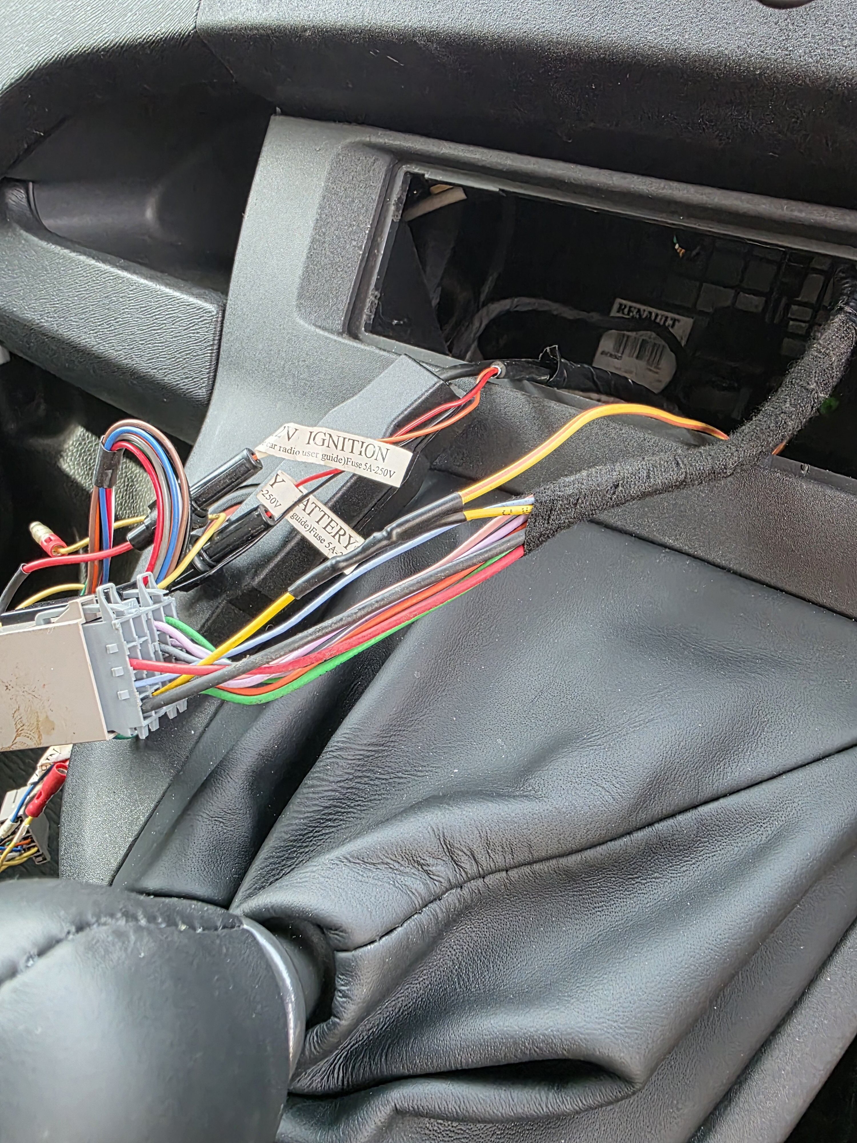

Wires ran to area behind dash switches and connectors added so removable if dash ever needs to come off. Used superseal as got plently in stock.

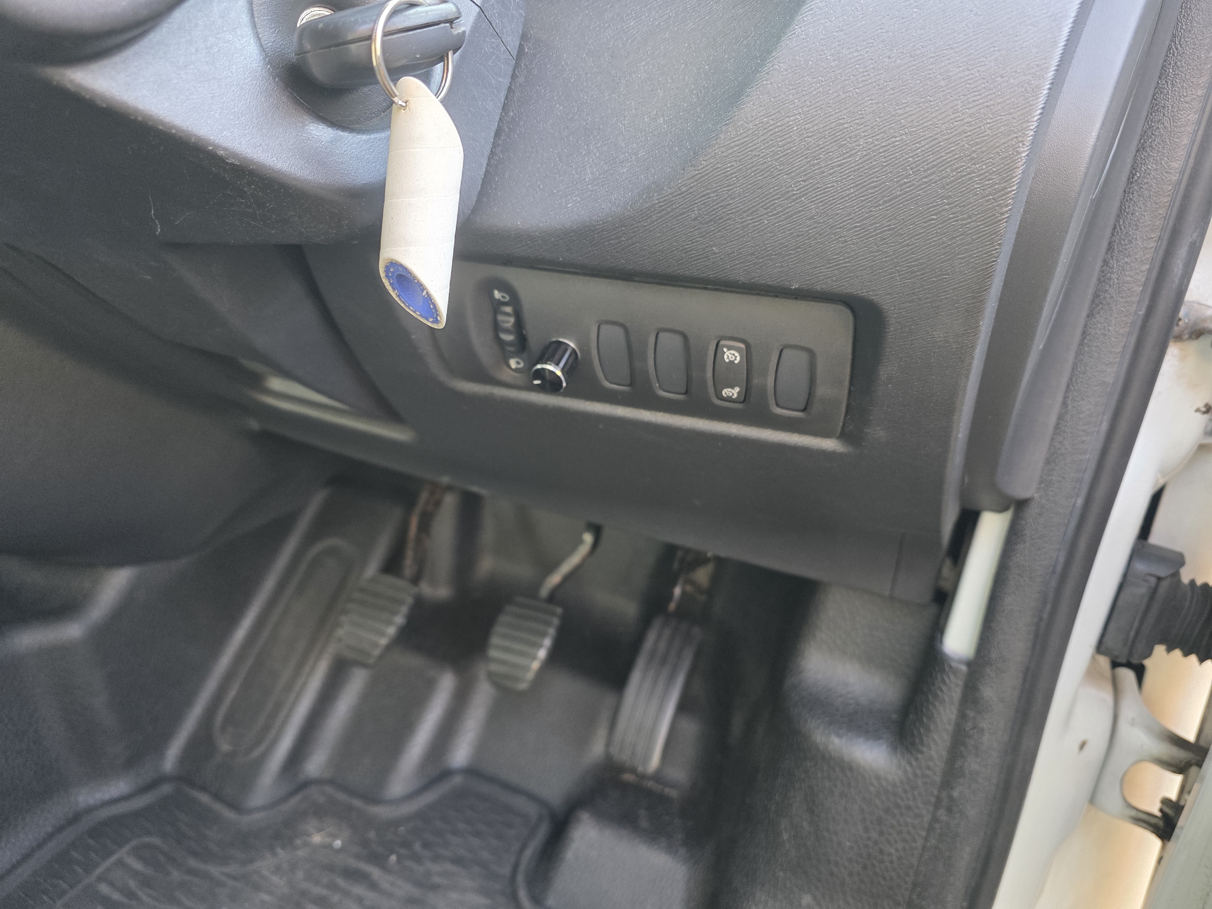

Box stashed behind dash and 8 position rotary switch wired in for boost blend.

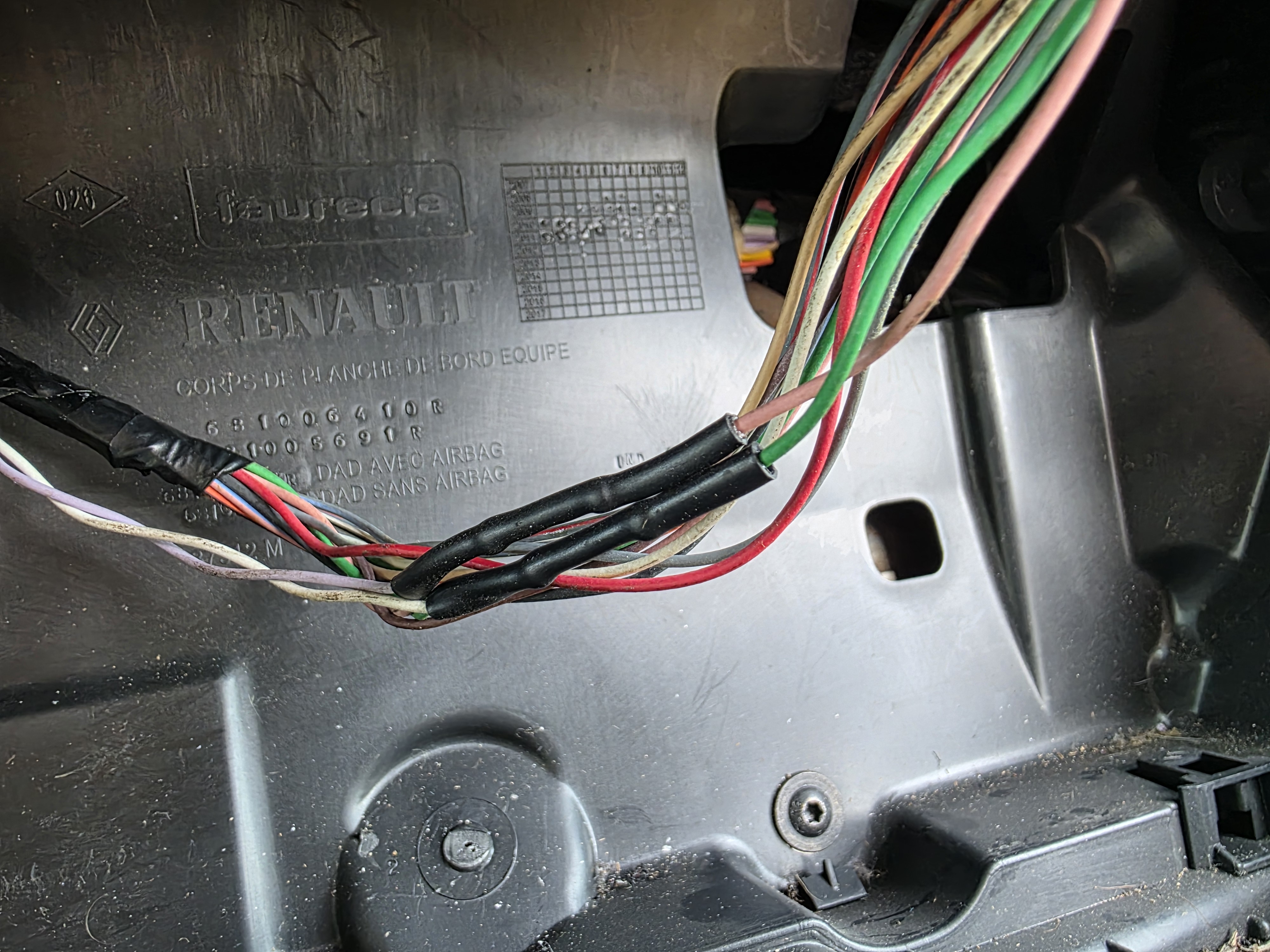

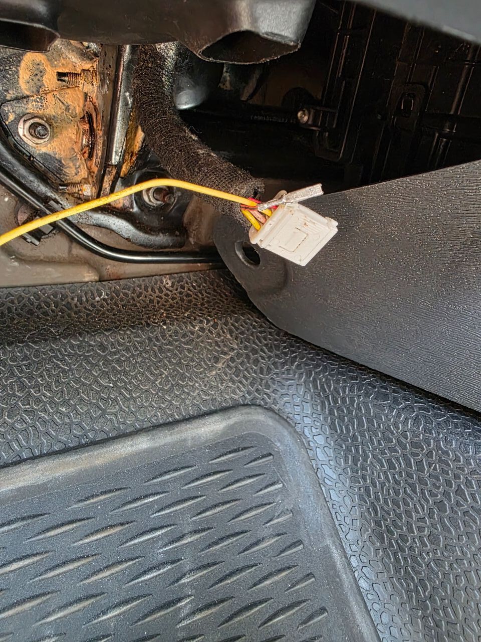

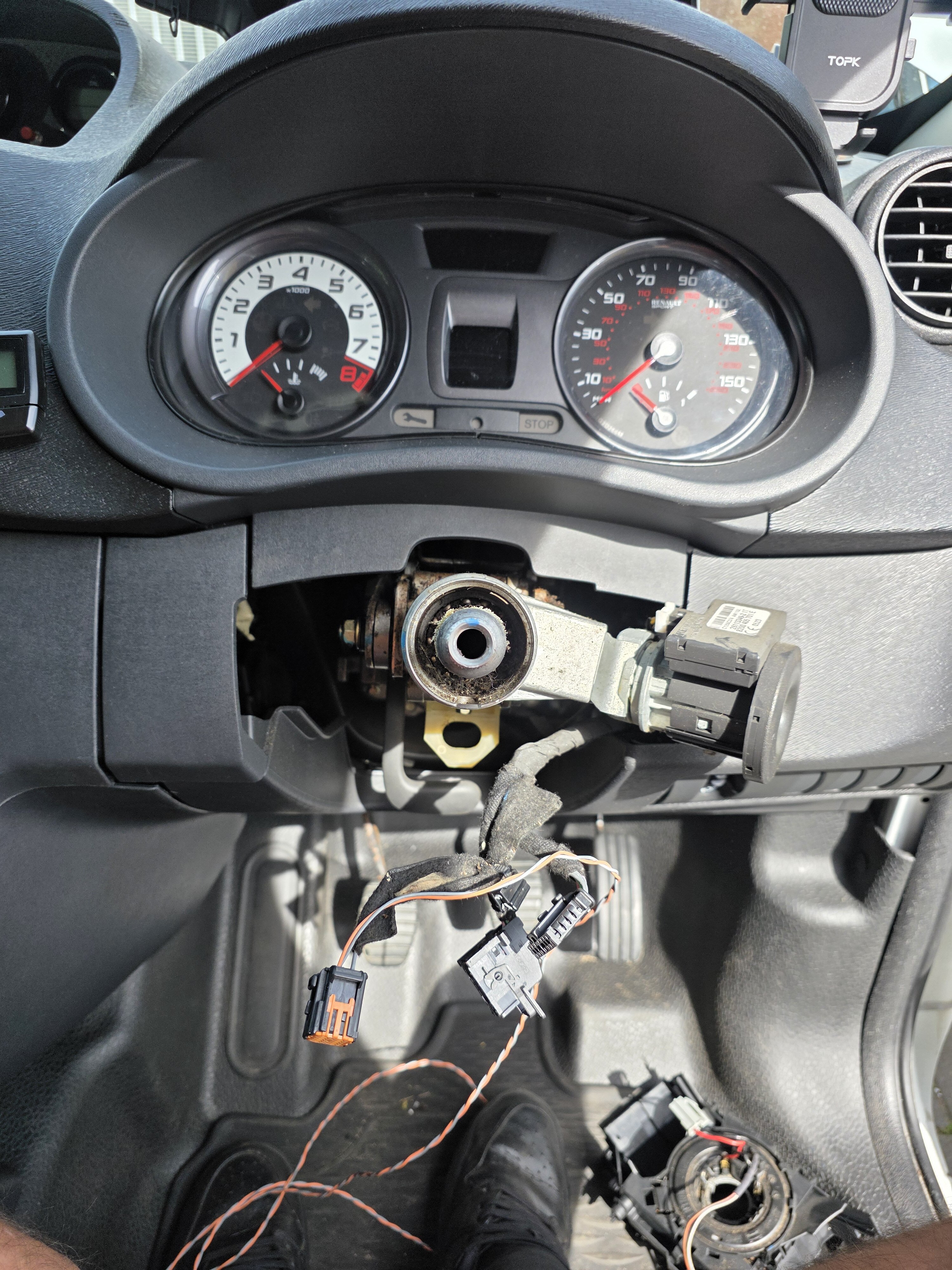

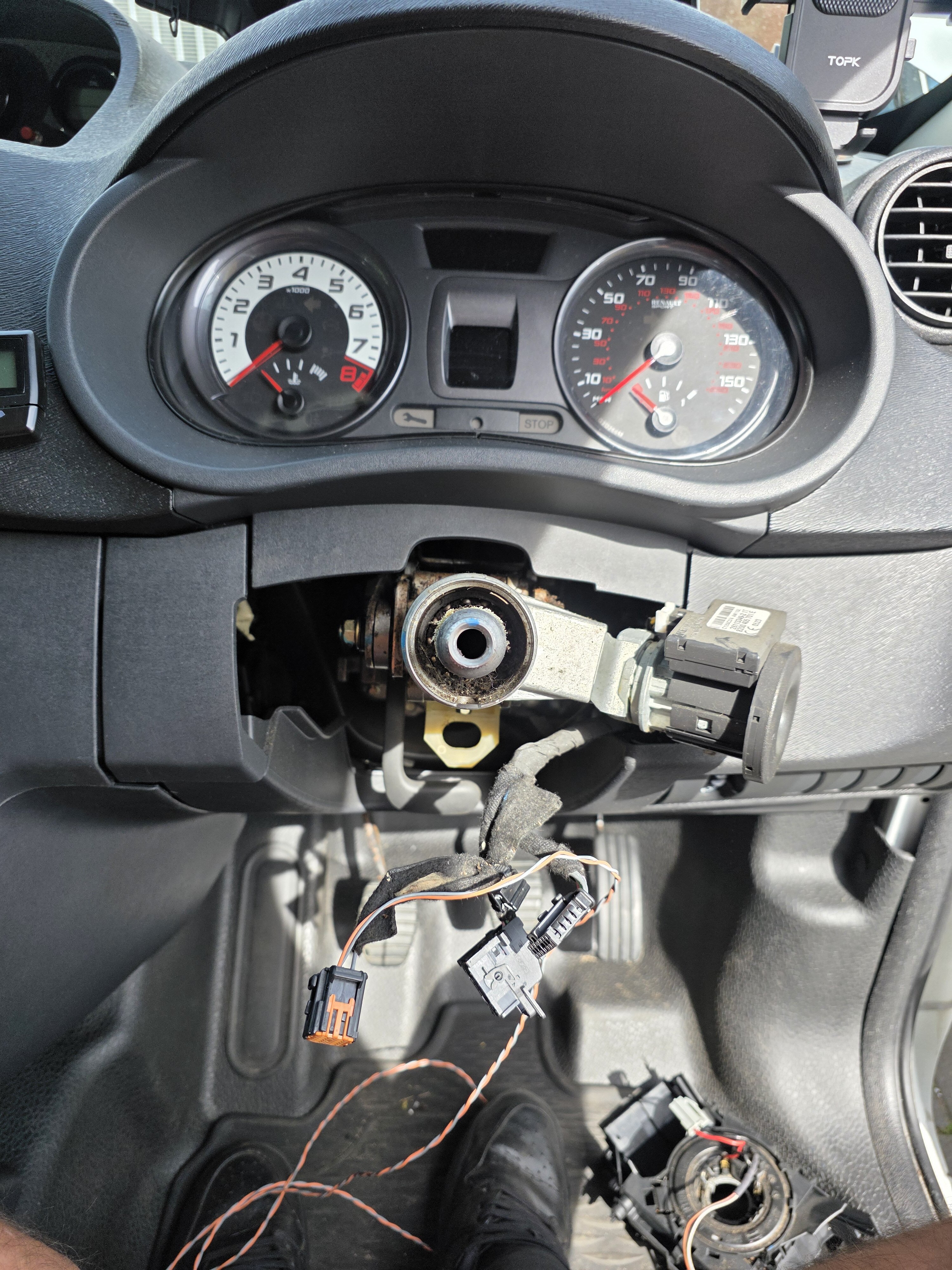

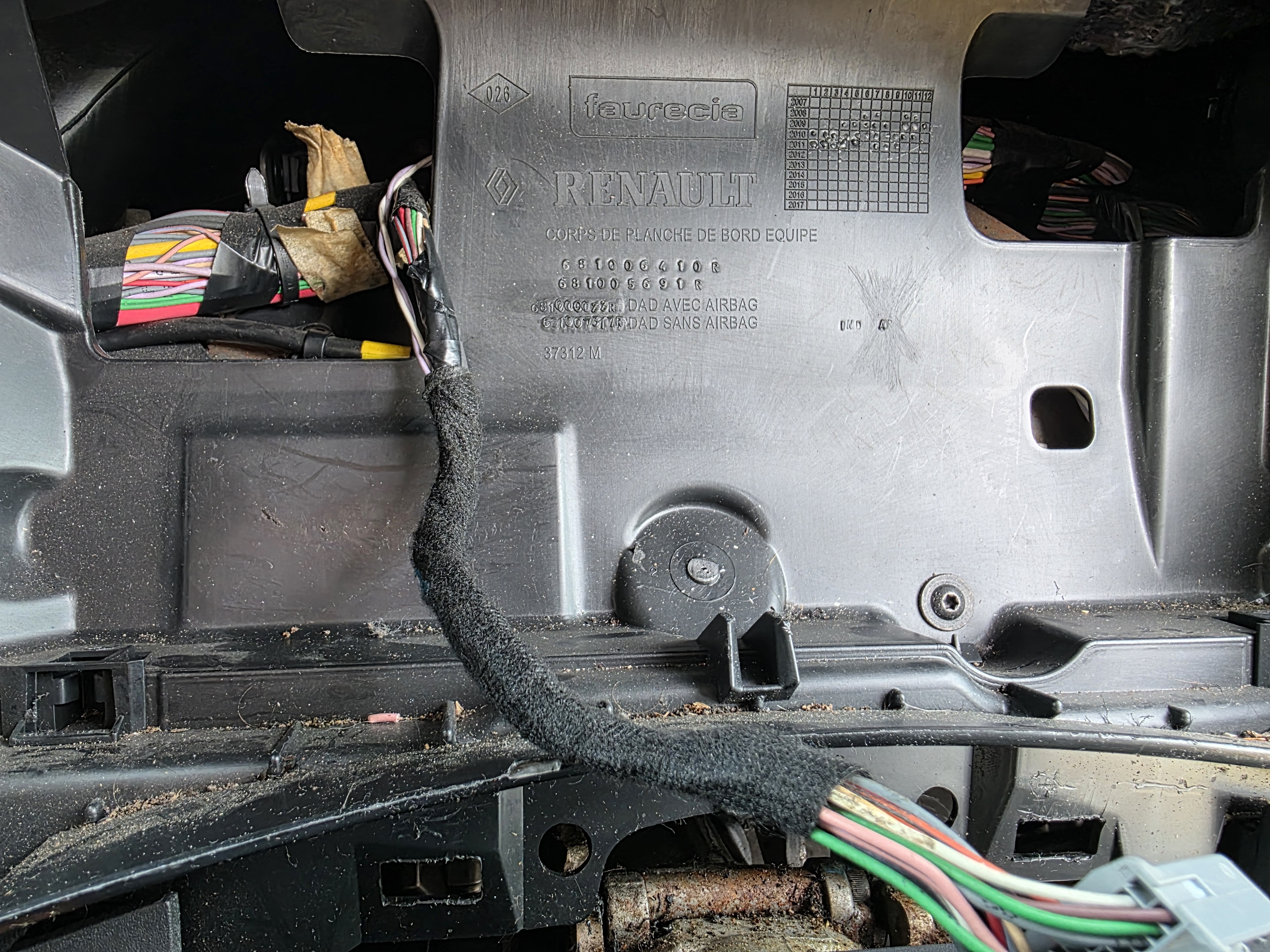

Whilst in the area i done some more planned bits. Ecumaster allows cruise control, i have cruise buttons but no wiring, and possibility of connecting to the ecu via the can expansion box. Ecumaster only requires brake switch, clutch switch, 2x buttons for cruise so the other buttons could be repurposed for push to pass, rolling antilag etc as necessary.

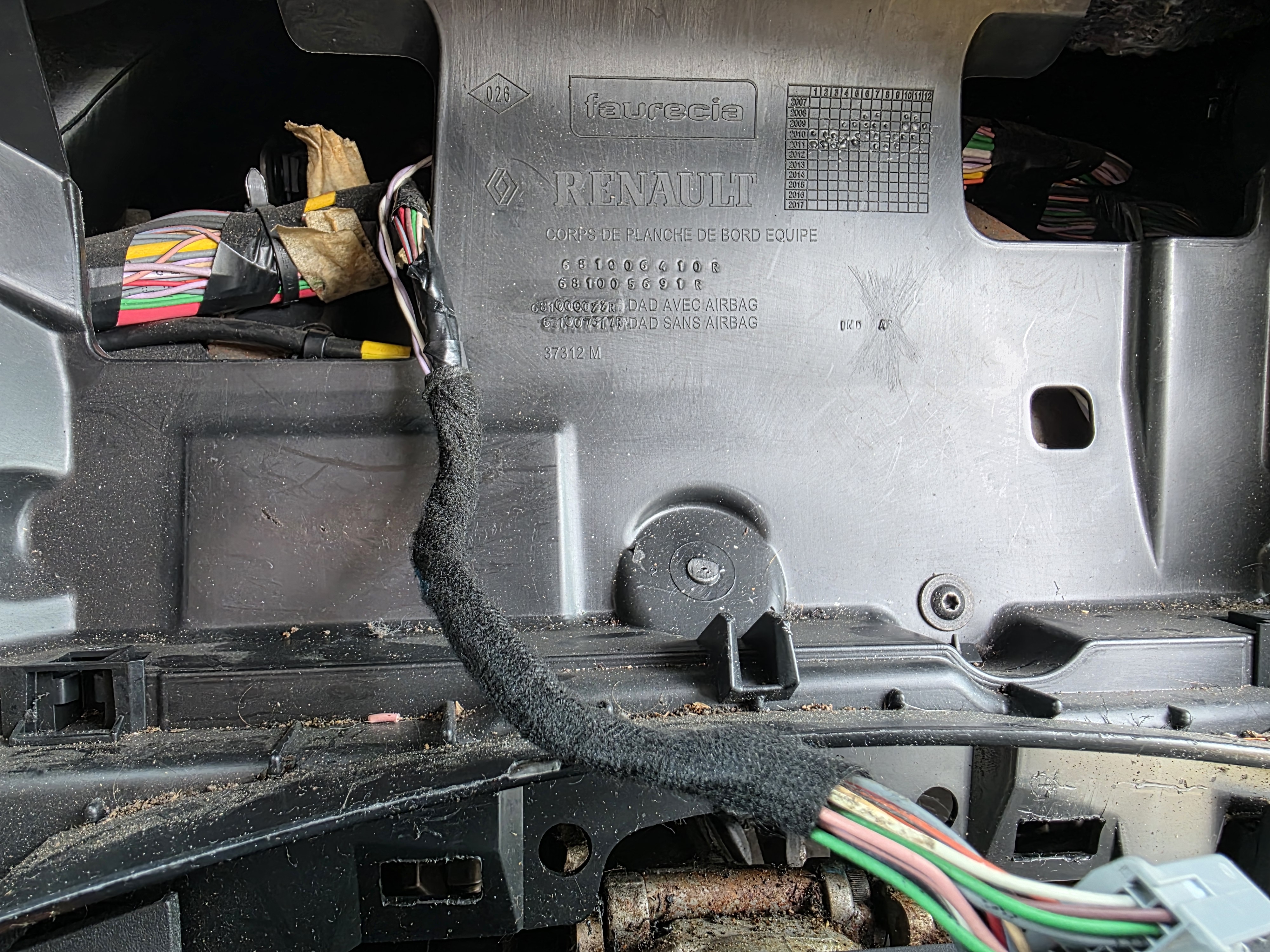

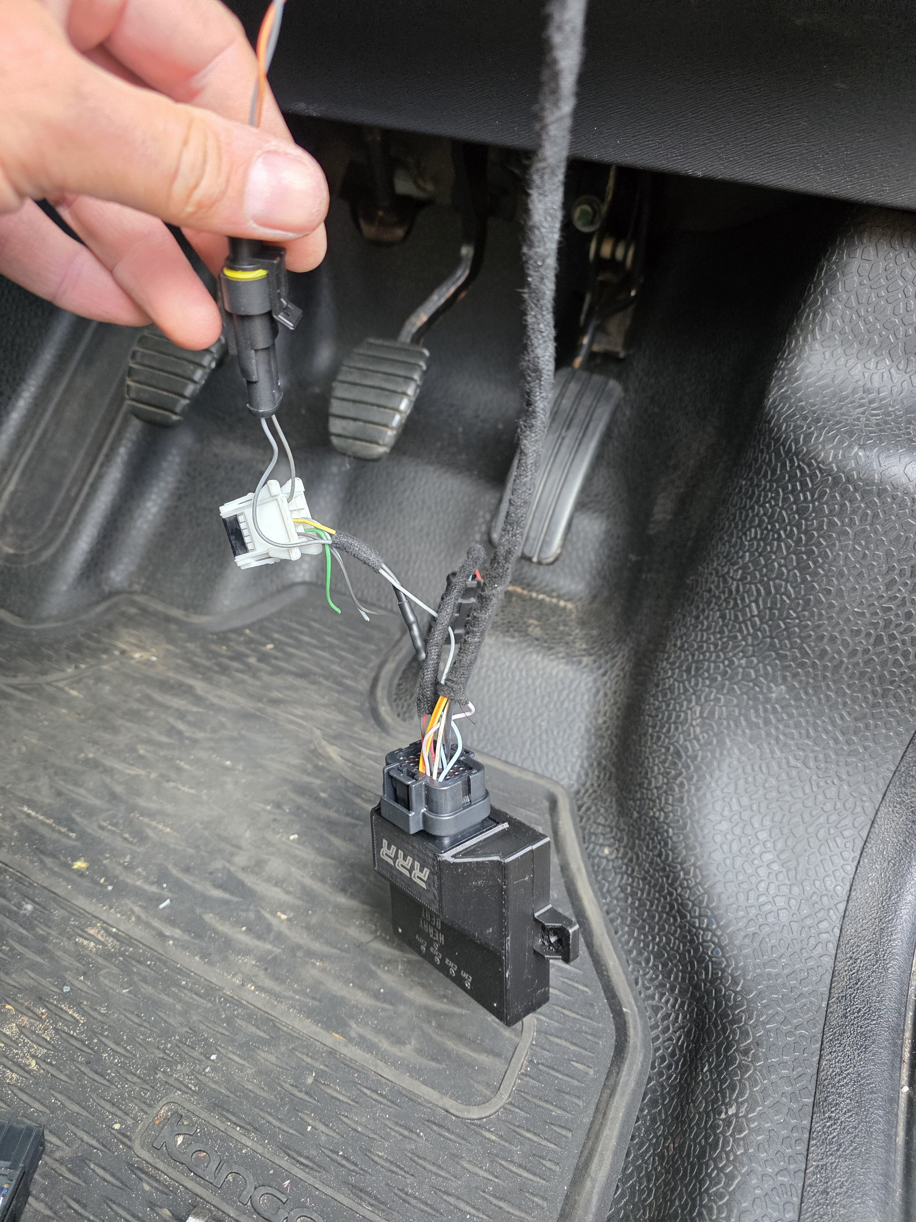

1st thing to do, add clio3 cruise squib which is the same as kangoo with extra wiring.
Kangoo has no cruise wiring so had to add all of it that was required. I have a 182 interior loom here which has the same connector plug as kangoo squib, so depinned the connector with a good length of twisted pair wiring and fitted to the kangoo wiring plug.

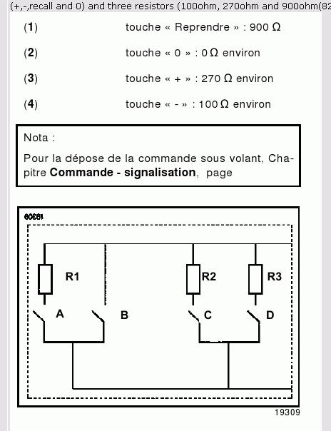

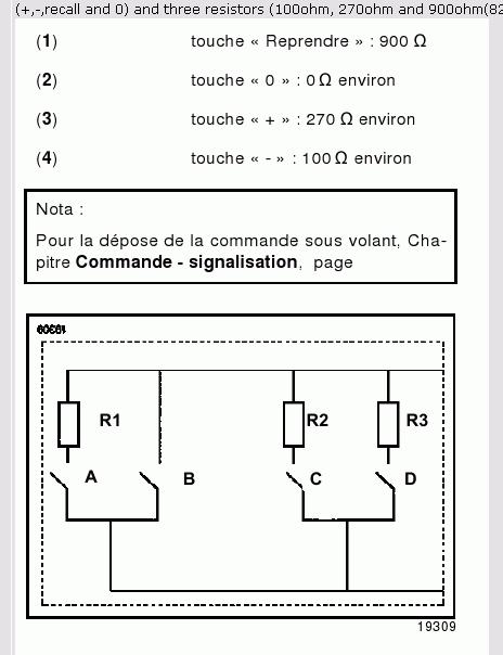

I done a bit of digging on how the 197 cruise control buttons were wired as only 2x wires for 4x non latching switches. The buttons both have 2 wires coming out of each joining together into a pair to to go through the squib. They are basically a mux switch setup, resistance is triggered when a button is pressed to indicate which one is in use.
Resistance example (clio2 i think but basically the same) Verified with test meter.

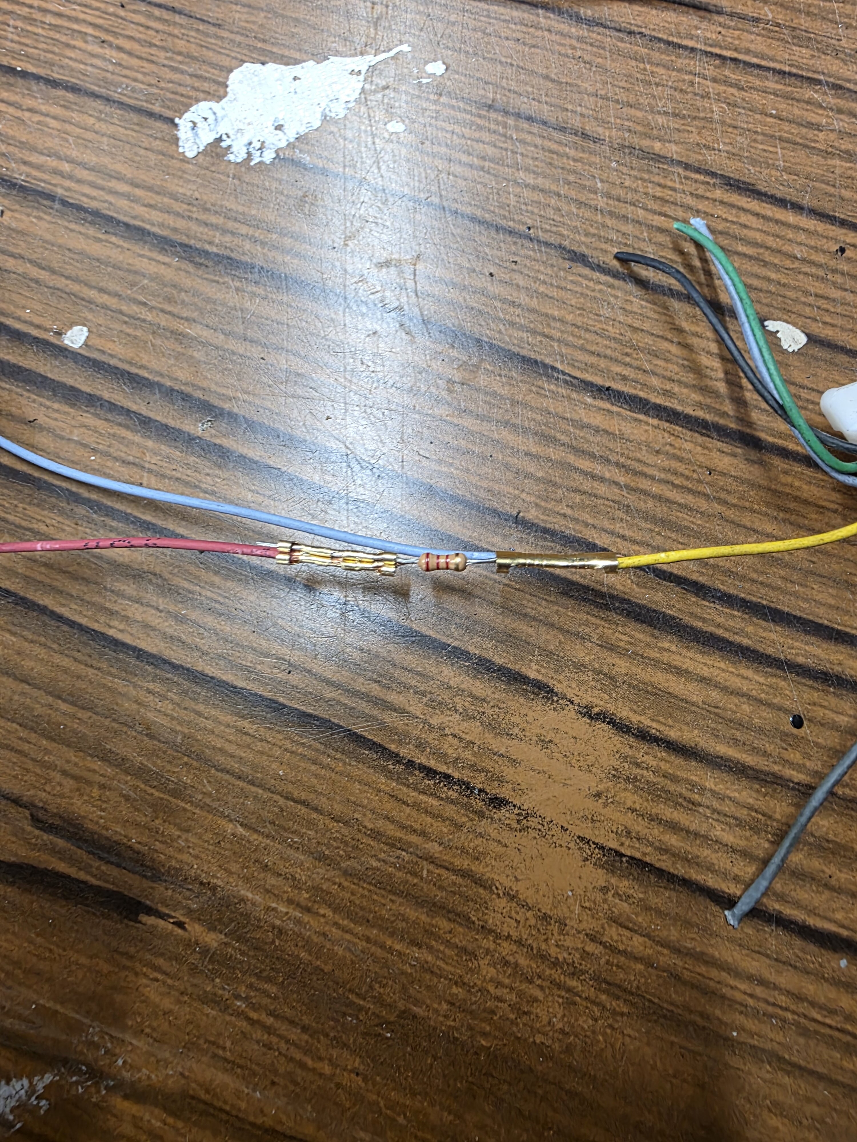

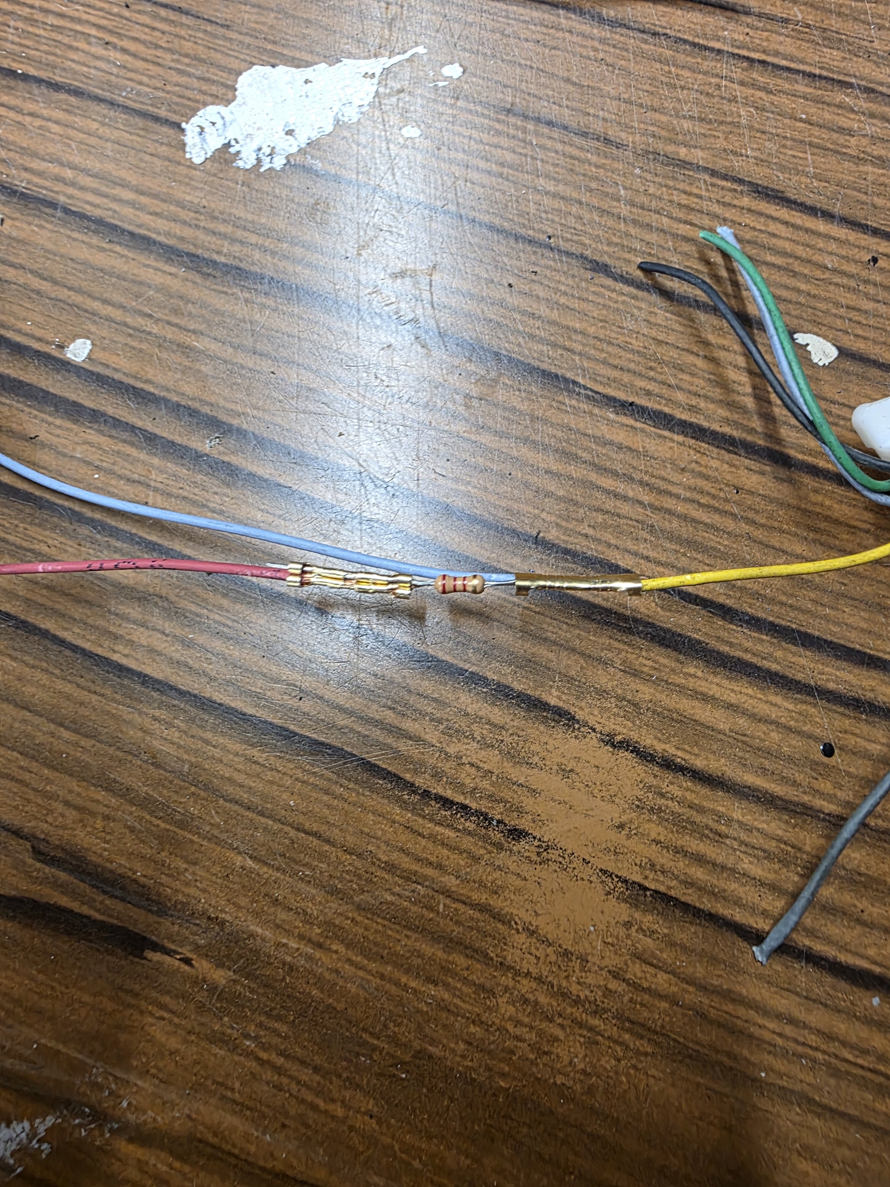

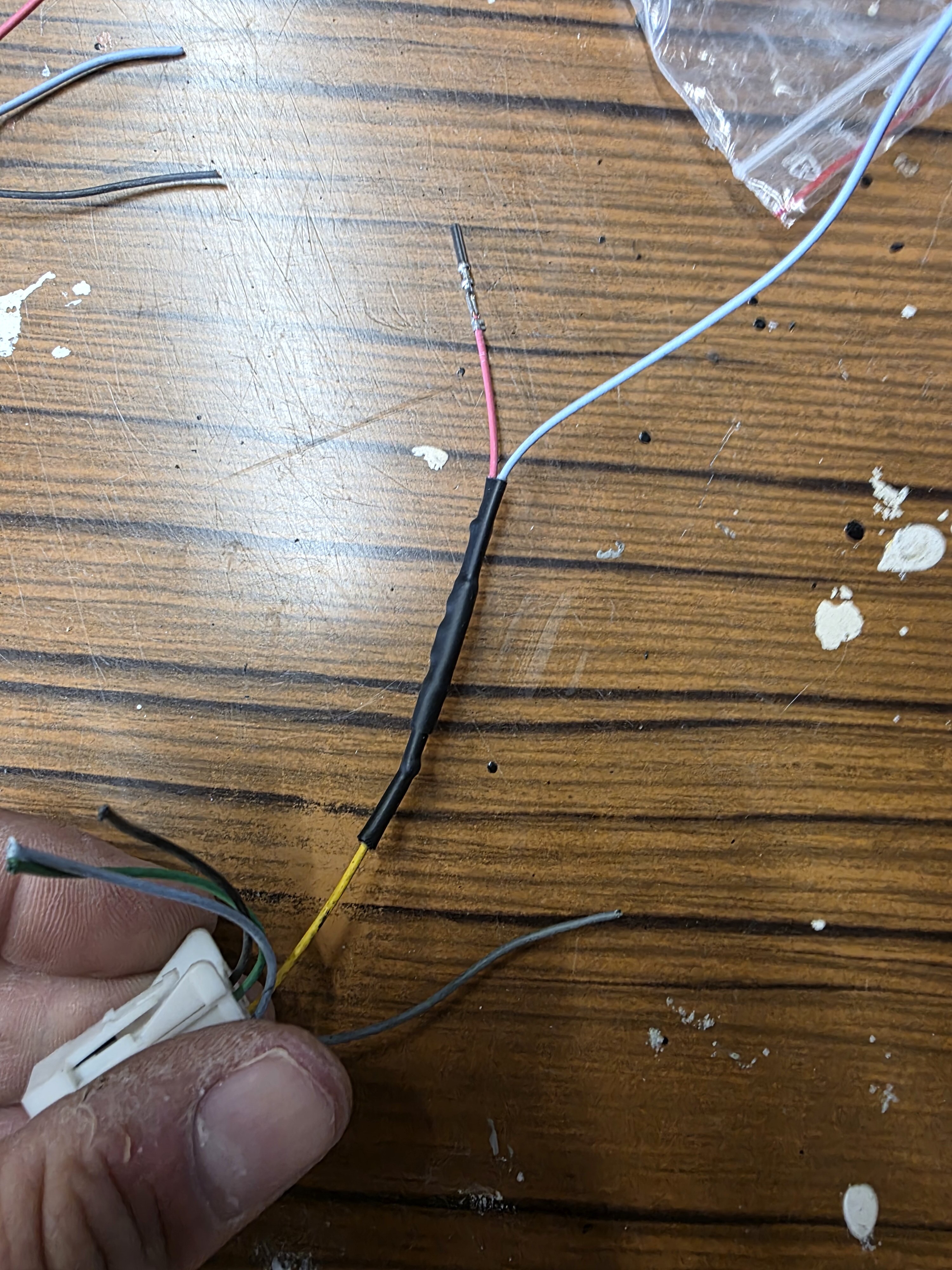

After a bit of thought i reckoned they could be wired up to an analogue input in mux config.
2.2k pullup resistor spliced in between 5v power and analogue. This is necessary for mux to prevent the input from "floating" when the switch is open or disconnected.
I used a megane 2 cruise switch to turn the steering buttons on and off, finding which pins joined together with switch in cruise position, and used a chopped loom plug i had in stock. I could have bypassed the switch but prefer having the option to disable it fully.

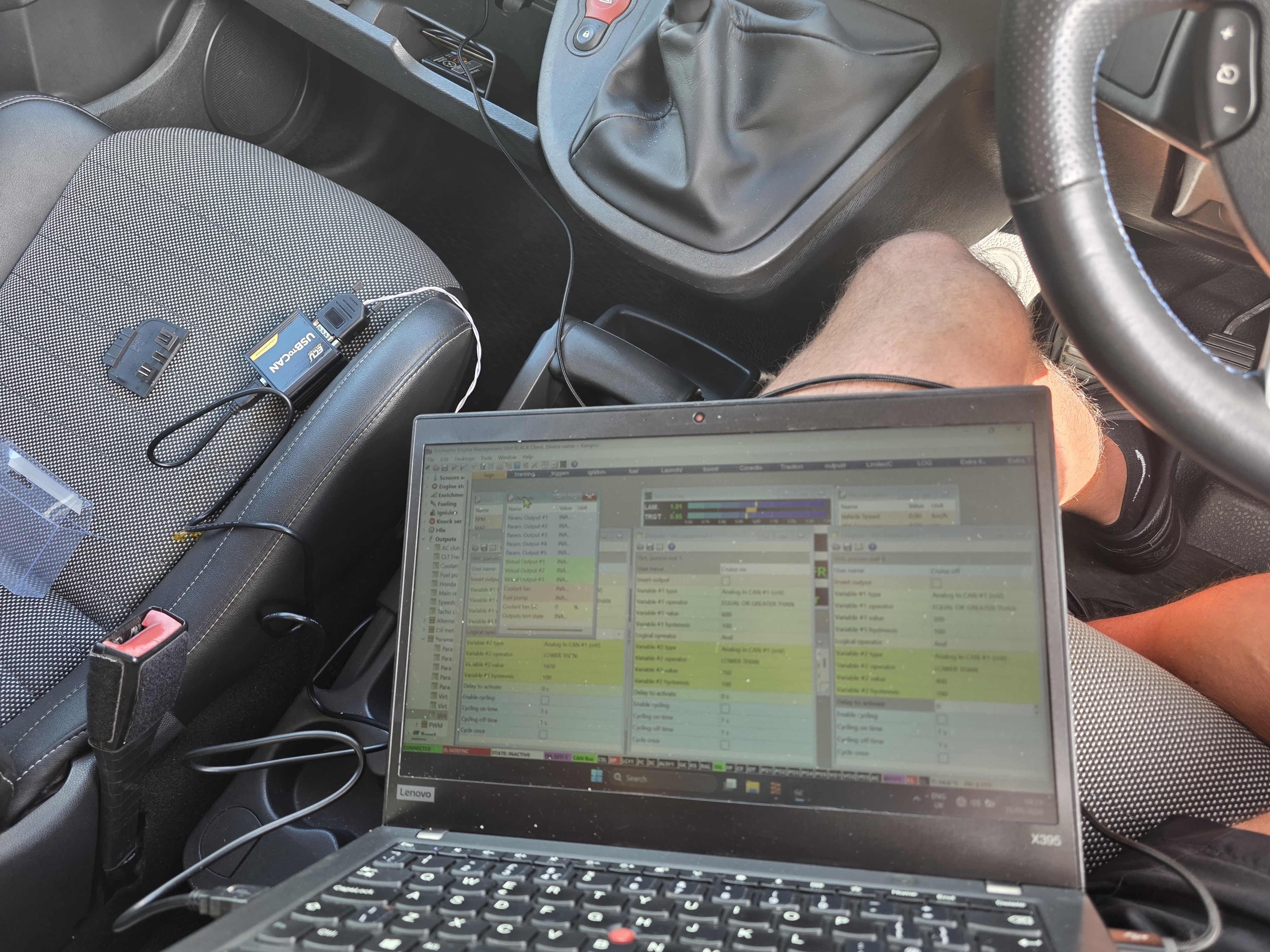

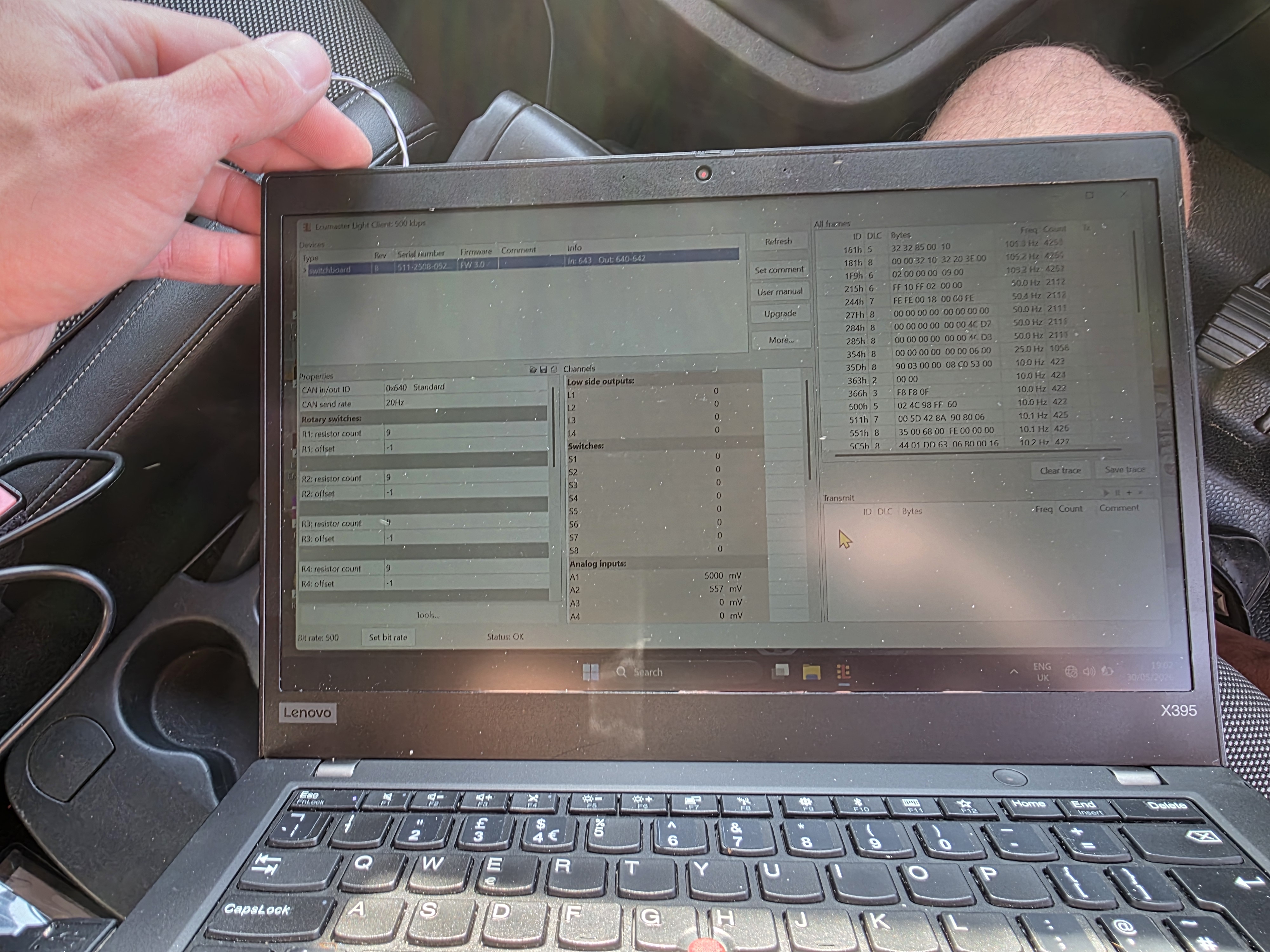

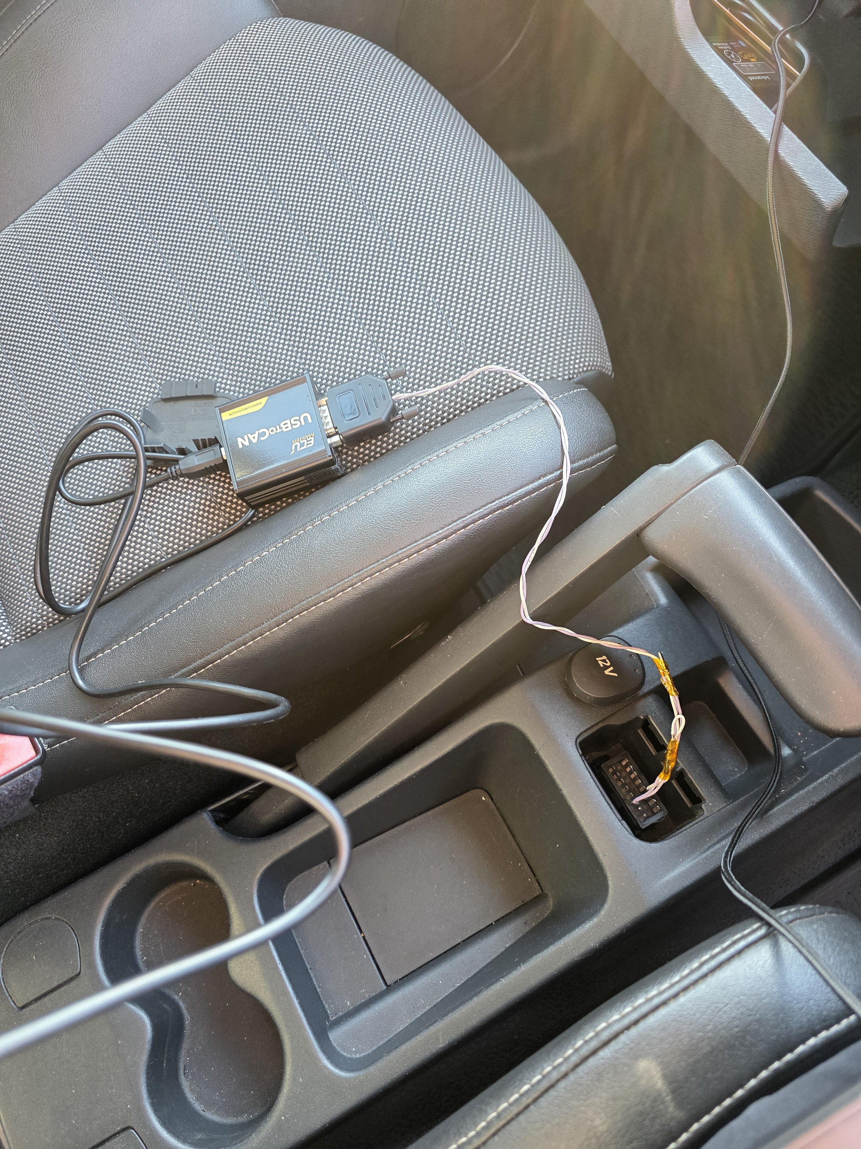

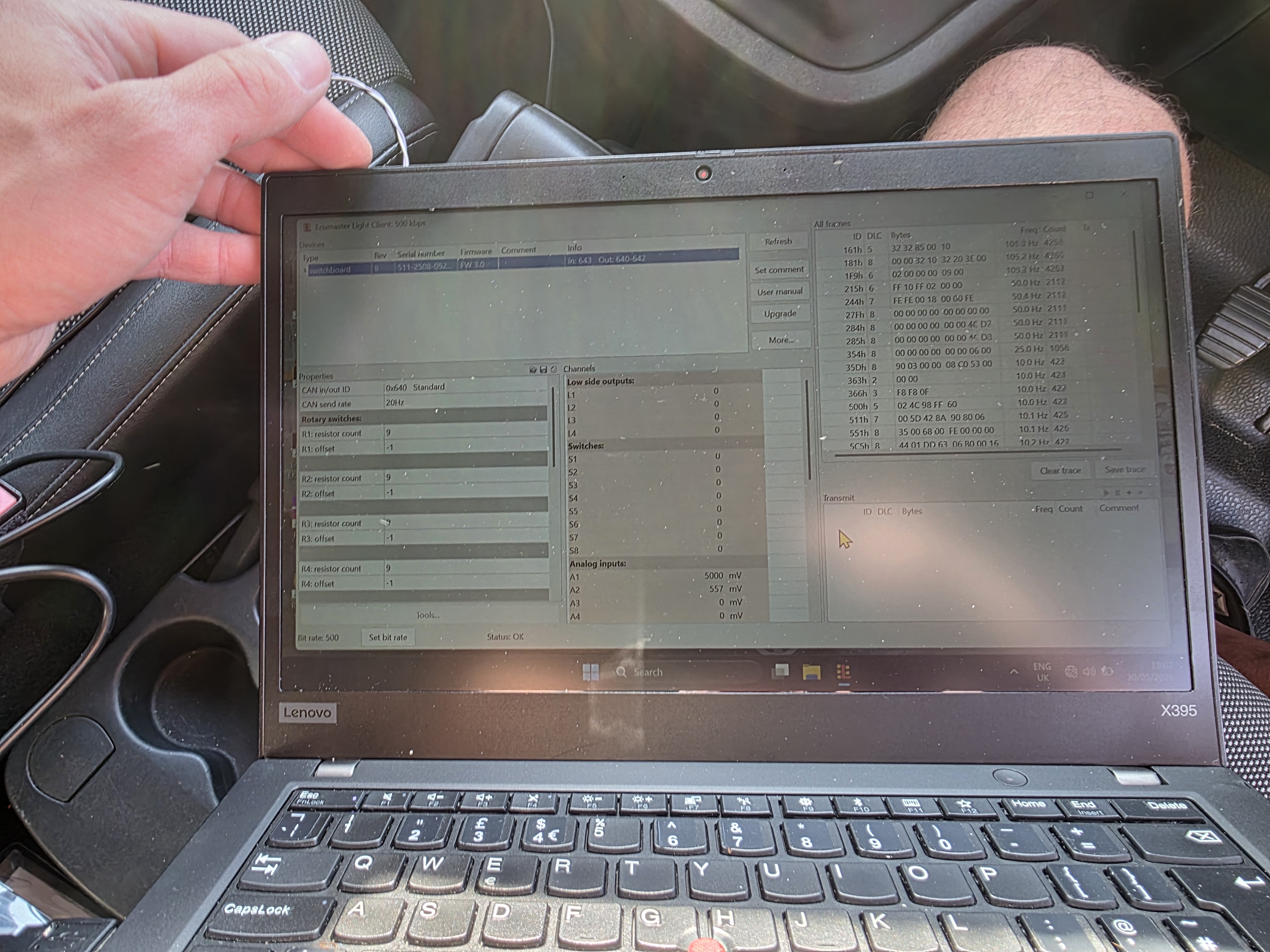

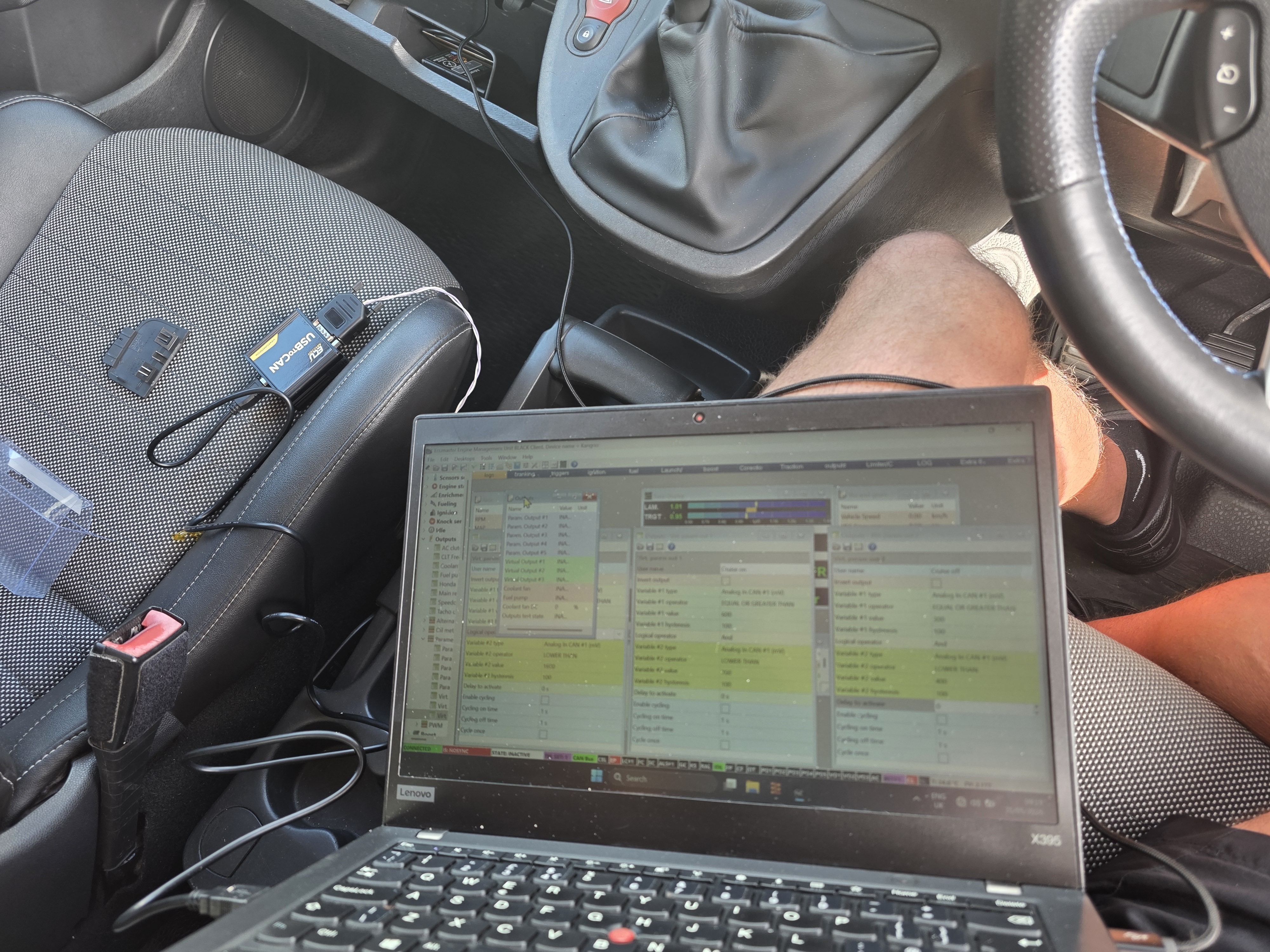

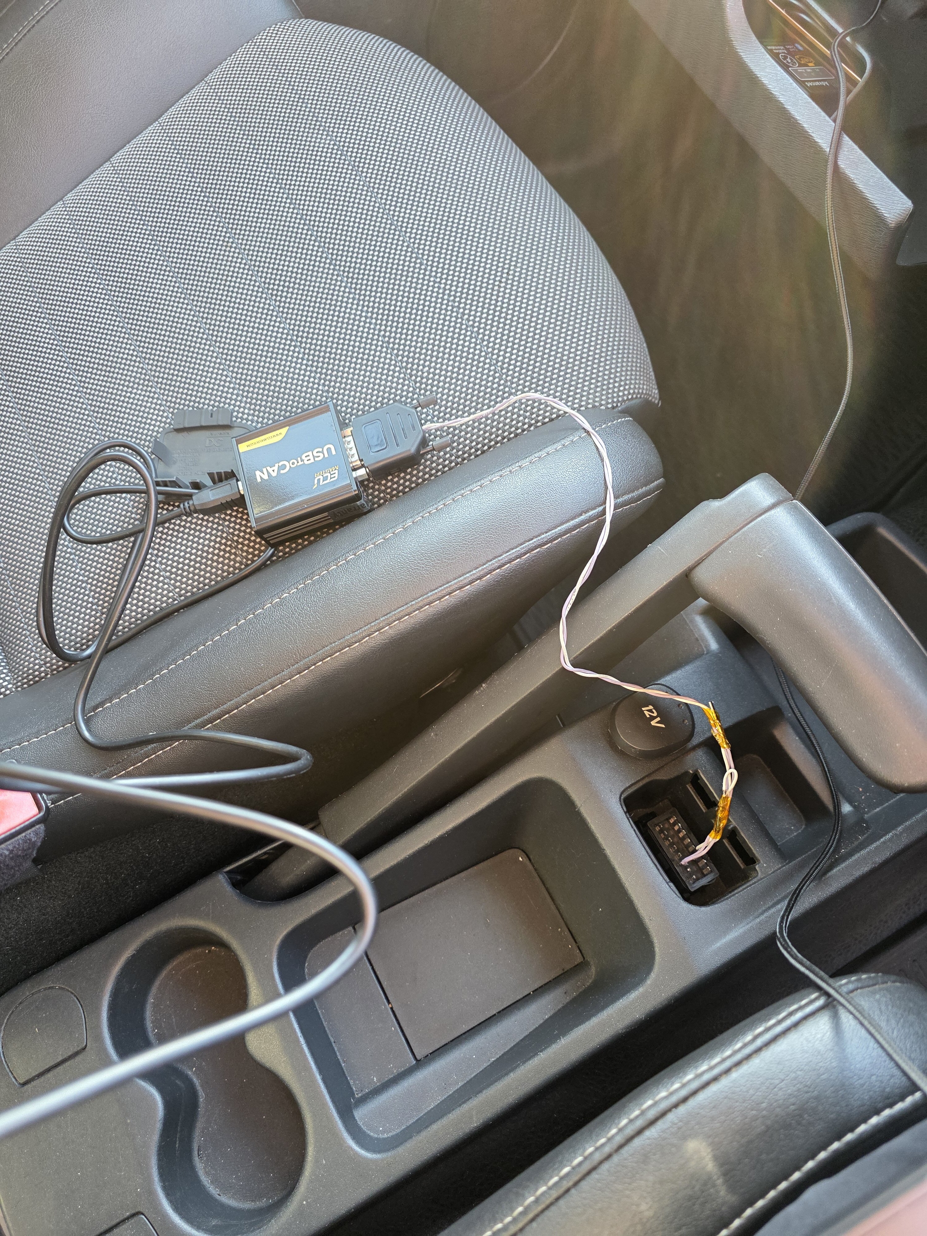

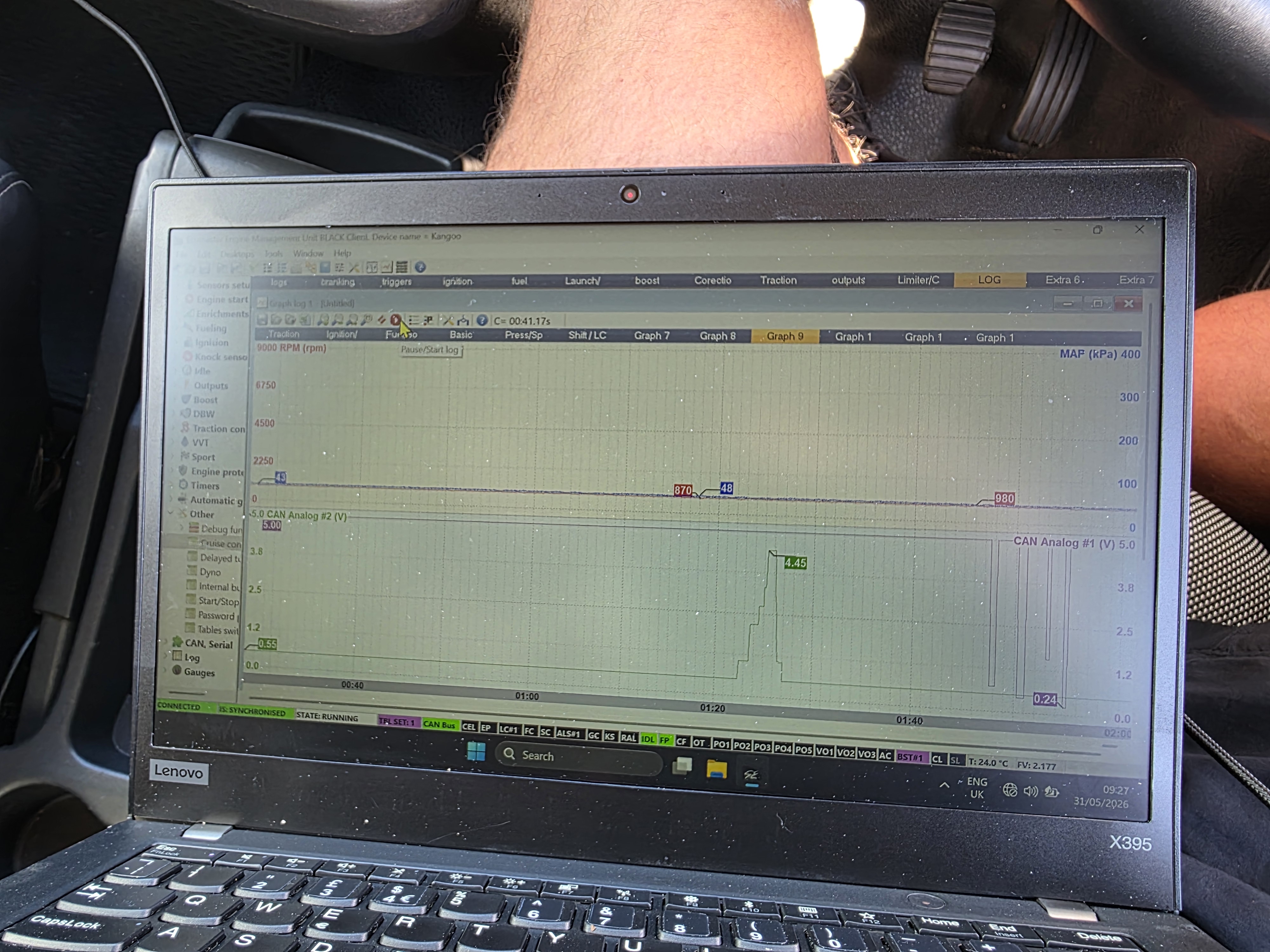

With all wiring done i dug out my ecumaster usb to can module which i used on the trophy years ago. I set it up for obd2 connection last time so can plug straight in and sniff the canbus/communicate to modules on the bus.
Looking on the software, can switchboard was active and working. I could see analogue 1 (Cruise buttons) were responding and voltage moving from 5v when pressed showing relevant voltages as expected and analogue 2 (Boost rotary) responded when turned.

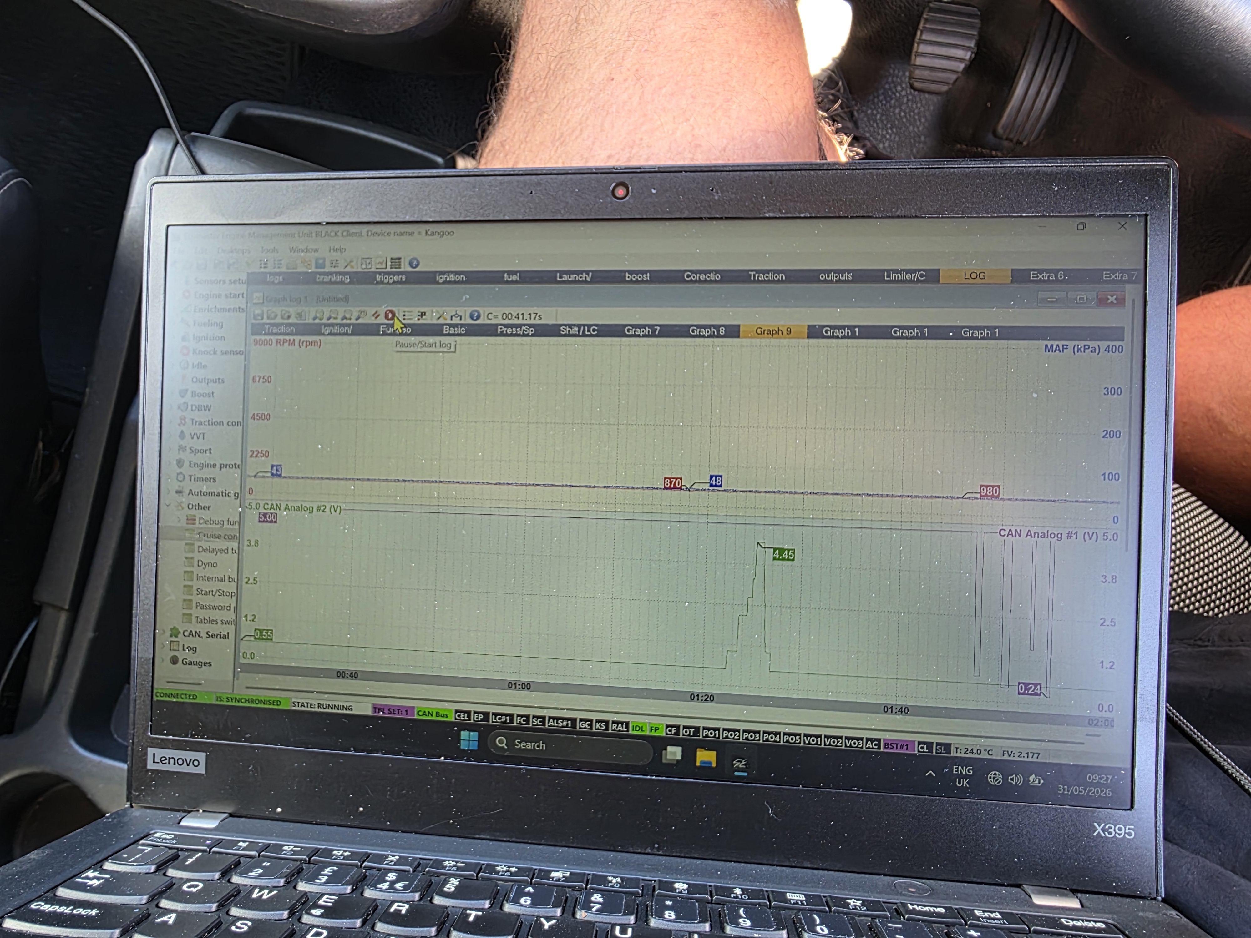

All this left was the software on ecu to setup. At this point i realised it was not possible to correct/adjust the voltages on the mux switch setup as the ecu pre defines them, the voltages on the steering wheel were miles off so any button pressed would register all 3 switches pressed. Bugger.
Que a bit of head scratching. I looked at adding resistors to get me to the required voltages for ecu to be happy but was not straightforward as would require multiple resistors fitting from a few calcs. Stripped down the buttons to see if possible to change resistors but its a mini circuit board with a chip in each, so again not easy.
Done a bit of research and ecumaster has 3x virtual outputs that can be configured to activate on specified analogue voltages. I configured them to work individually specifying the required voltages that were logged on the switchboard
Checking on the logs, they all work great and respond fine.
Activated cruise. This requires 2x buttons, one to start/stop and one to resume. Added some base settings and it actually works. I need to revisit the brake switch wiring as brake needs to go to an analogue as its been wired incorrectly on the pnp wiring (not by me) but for all purposes, its been tested and works.

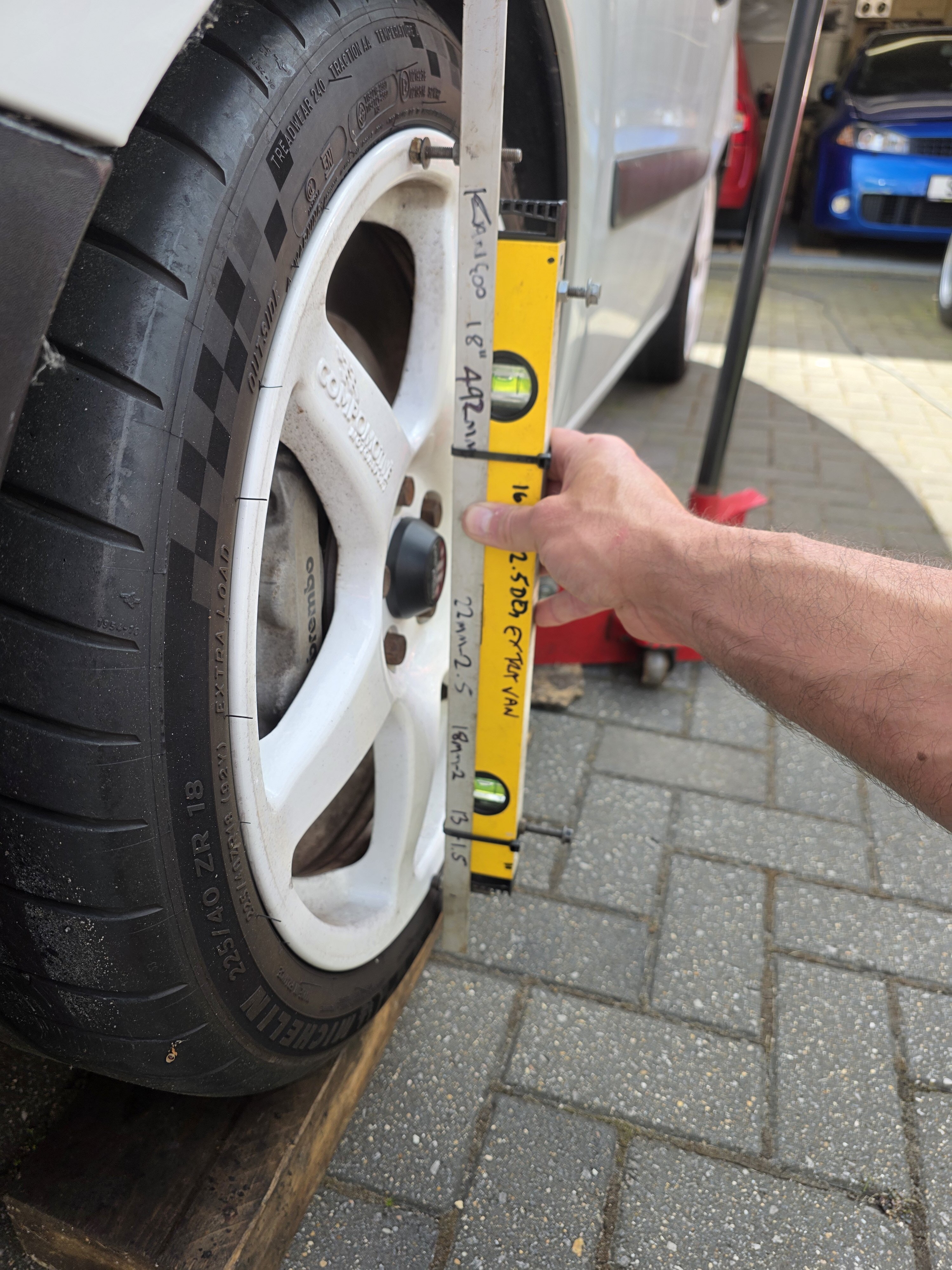

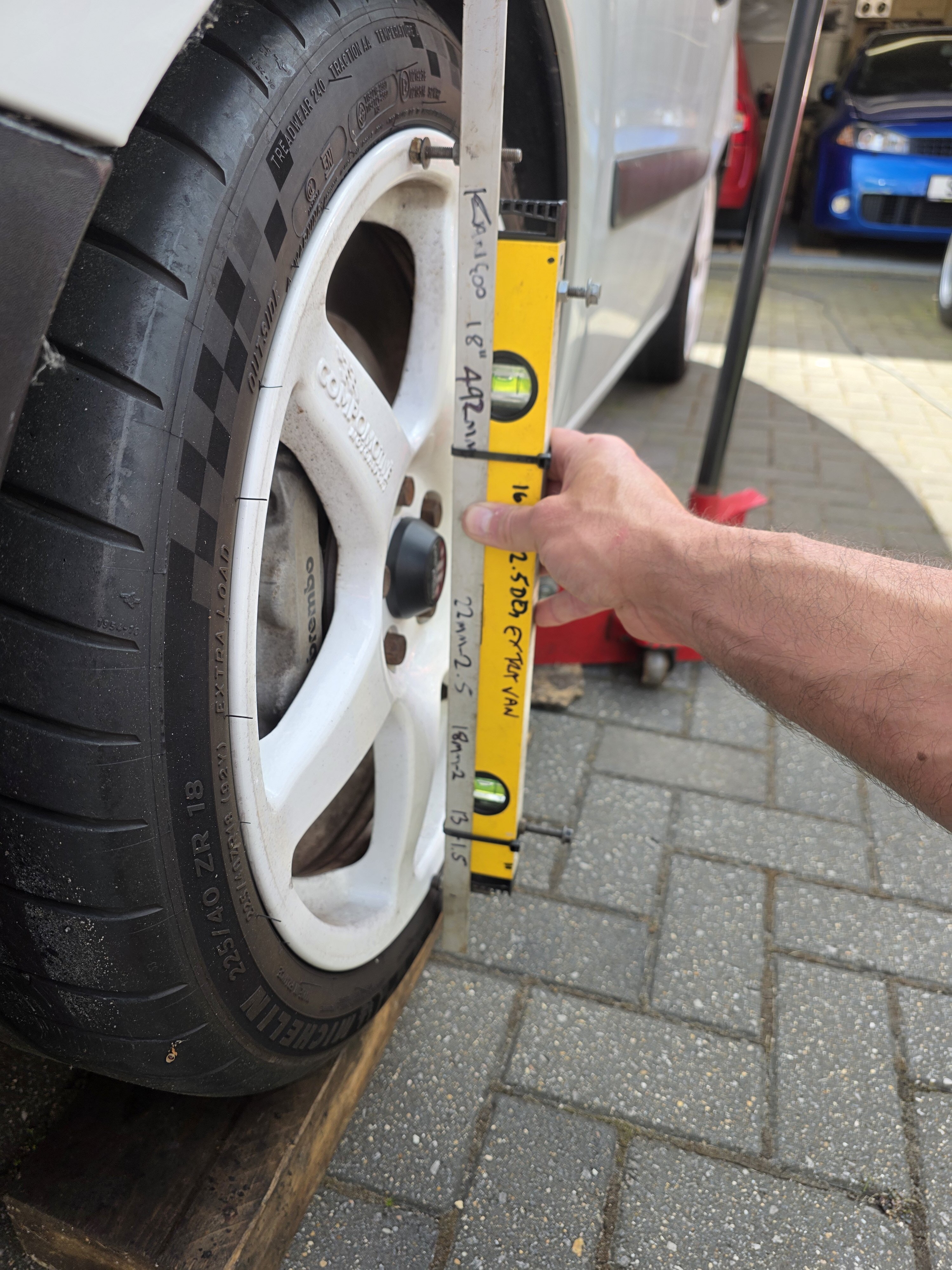

Also had geo done. The geo lift was on the piss years ago when i set it up last and camber on passenger side was reading incorrectly. I adjusted it on the day and it was obvious with a quick check it was a degree out on the passenger side. Always meant to change it but never got round to it, drove OK.
Done a bit of trigonometry and spirit level to set the camber at home yesterday as annoyingly the geo lift does not have a lifting beam to jack up. Scuttle off to access ast top mounts.
Basic but accurate and both sides now match again. Works out -1.7deg.
Closest canbus connection was to the dials so tapped into that with a twisted pair.View attachment 1790060
Dual wall heatshrinkView attachment 1790061
Taped.View attachment 1790062
Power tapped into switched live on stereo.View attachment 1790063
1st thing to do, add clio3 cruise squib which is the same as kangoo with extra wiring.View attachment 1790065
2.2k pullup resistor spliced in between 5v power and analogue. This is necessary for mux to prevent the input from "floating" when the switch is open or disconnected. View attachment 1790066
I used a megane 2 cruise switch to turn the steering buttons on and off, finding which pins joined together with switch in cruise position, and used a chopped loom plug i had in stock. I could have bypassed the switch but prefer having the option to disable it fully. View attachment 1790067
Done a bit of research and ecumaster has 3x virtual outputs that can be configured to activate on specified analogue voltages. I configured them to work individually specifying the required voltages that were logged on the switchboard View attachment 1790077
Checking on the logs, they all work great and respond fine.View attachment 1790071
Ill sort the brake switch out soon, simple change.
Done a bit of trigonometry and spirit level to set the camber at home yesterday as annoyingly the geo lift does not have a lifting beam to jack up. Scuttle off to access ast top mounts.View attachment 1790073View attachment 1790072Basic but accurate and both sides now match again. Works out -1.7deg.

Using an EMU Black right Jon? Is yours in the Engine bay like Clios/Meganes?
I Was looking over them for my Meglio and clocked they're only IP60 rated, so a bit brave to leave them in the bay if used in all weather imo!
Aye Emu black, basically same engine bay as clio and meg. Yeah not totally waterproof but seen loads on motorbikes etc, from a bit of research most mid range standalone ecu's are only ip60.
Engine bay stays dry enough, ive not seen any water inside that area. ld only be concerned if it was swimming with water or front end was absolutely open to elements. Ive been thinking about making a battery cover to tidy that area up as all the wiring looks messy and for additional protection.

I sorted the brake switch wiring on the kangoo. The pnp ecu adaptor is incorrectly wired up and needed the brake switch moving from switch 1 to an analogue input on ecumaster . With renault being renault the oem wiring/ brake switch sends a +12v signal to engine ecu instead of a ground.
Ecumaster switches are switched to ground and i think somebody has tried to wire in a pulldown resistor to do this as it kind of worked. Anyway when brake and clutch pressed it causes switches to be going on and off etc so bit on the piss, which f***s up the gear selected registering on the ecu which i need more than cruise for boost by gear.
I noticed something was not right when activating cruise, as you are supposed to press brake pedal to start and it did not need pressing and fired right up.
The most simple method was to change wiring in car at the brake switch and run the +12v signal to an analogue input on my can switchboard, as they are 12v tolerant. This saves disturbing all the taped wiring on the pno adaptor/ecu plugs. I simply depinned the relevant signal wire off the brake switch plug and dug out the box of wires which is a butchered 182 clio loom.
Found relevant matching connector and depinned/full length of wire. Connector depinned in car and wire ran to switchboard. No pics fitted its all taped up.
20 min job. Reconfigured software and it all seems to work correctly with brake required to be pressed to start, if you dont it cranks with no spark.

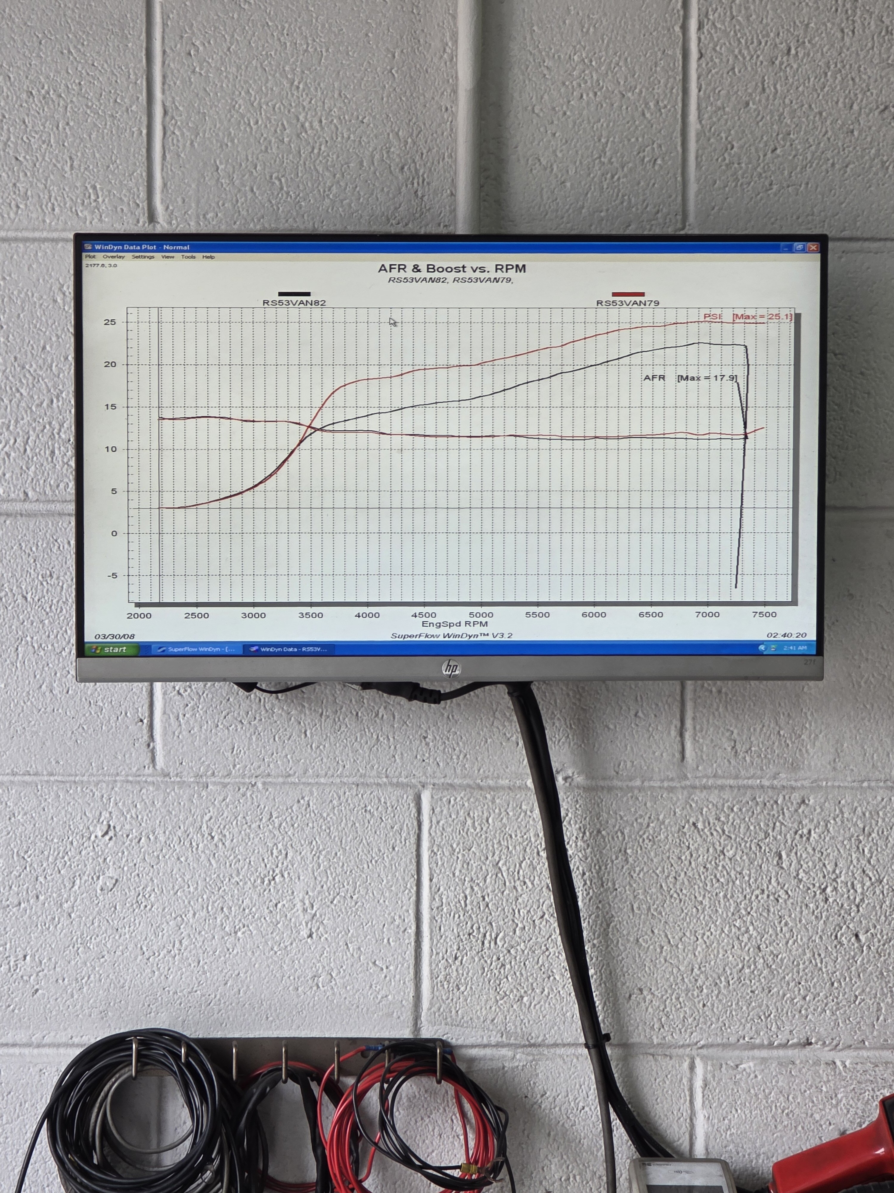

Mapping updates.
Cruise control works great and made the drive easy.

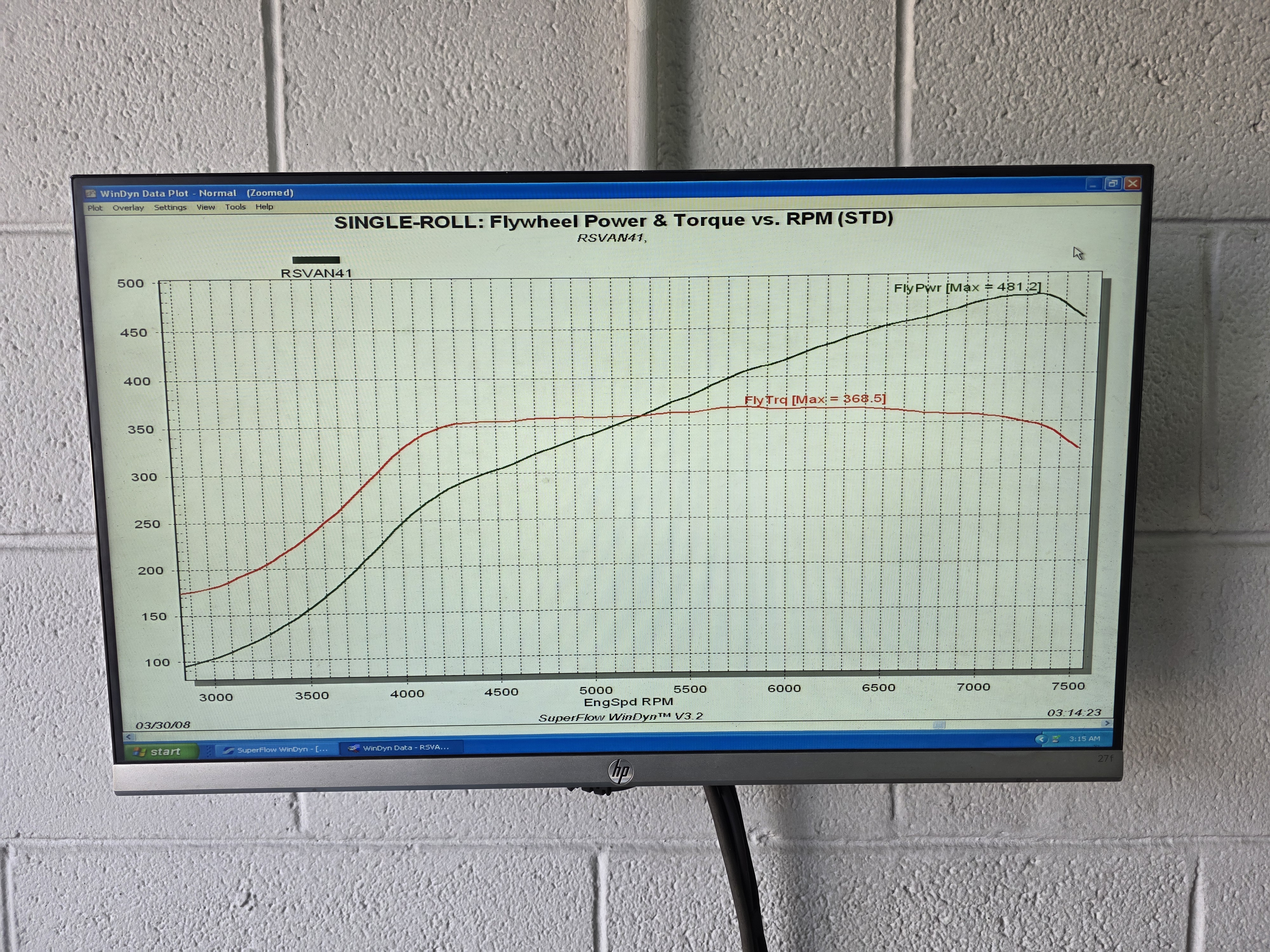

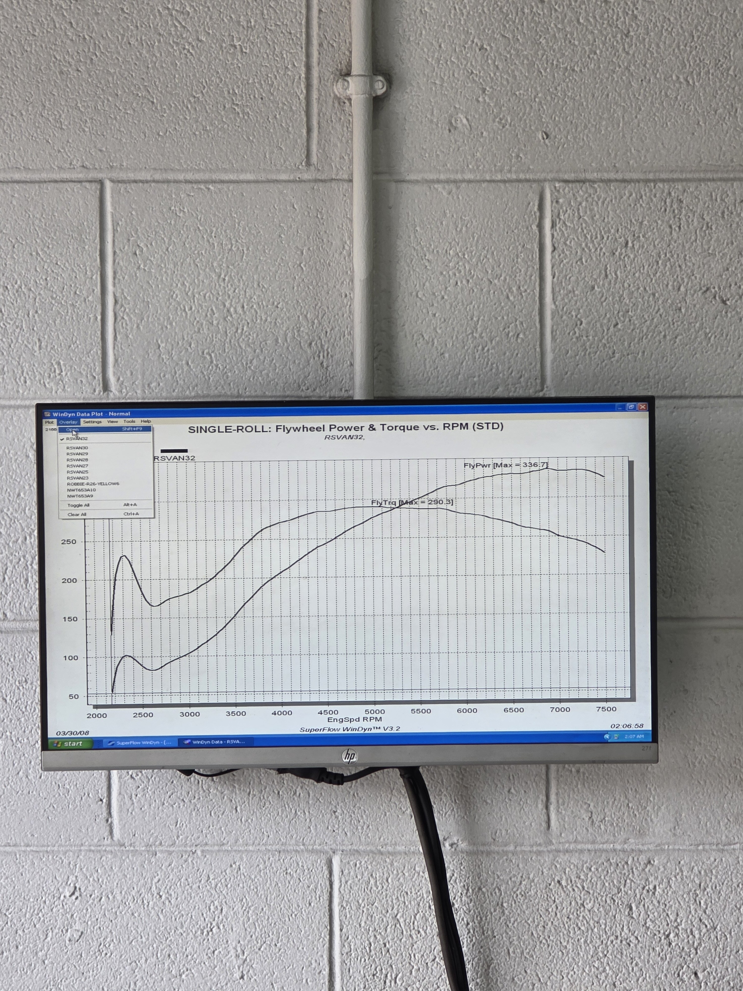

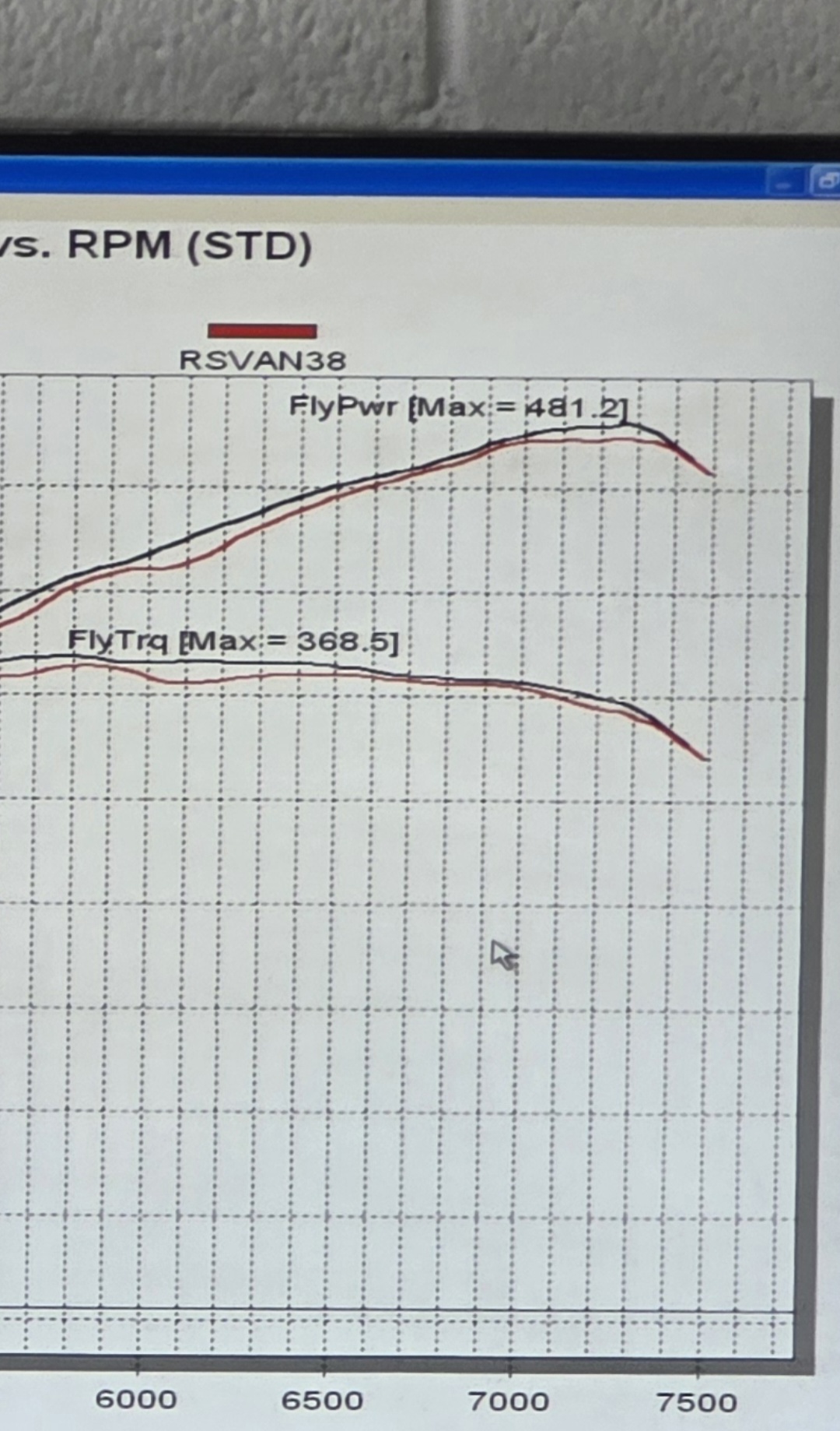

Arrived at Efi Parts - and as soon as i said g25 660 turbo, Chris said we are making some power today and he was not wrong.
Chris done all the base calibration stuff then moved onto power tuning. Initial power runs on wastegate give 336hp / 290ft lb at 14psi which was around what was expected as the engine is reasonably low comp ratio 8.0
With every increase of boost pressure the power ramped up and straight into the 400s.
20psi 414hp
22psi 440hp
24psi 456hp
25psi 481hp
As its still on a 5bar deatschworks intank pump you could see it was starting to struggle a little 23psi and up - 25 psi was the absolute max and we could go no furthur.
The power curve is f**king mega with solid 368ft/lb from 4k onwards. With fuel system upgrade and 2bar of boost 500+ hp should be achievable.
Also set the 2 step/launch up. I cant see me ever using this but another box ticked.
I have not tried 25psi on the street yet as think fuel pump is a bit close to the edge, Chris advised me to be careful with it. I have tried 22psi and it will absolutely bury the speedo at that. Even 14psi is quick, as traction is very good it and vvt working, it feels quicker than the hybrid.
Ill get fuel system, egt etc done soon and revisit.
