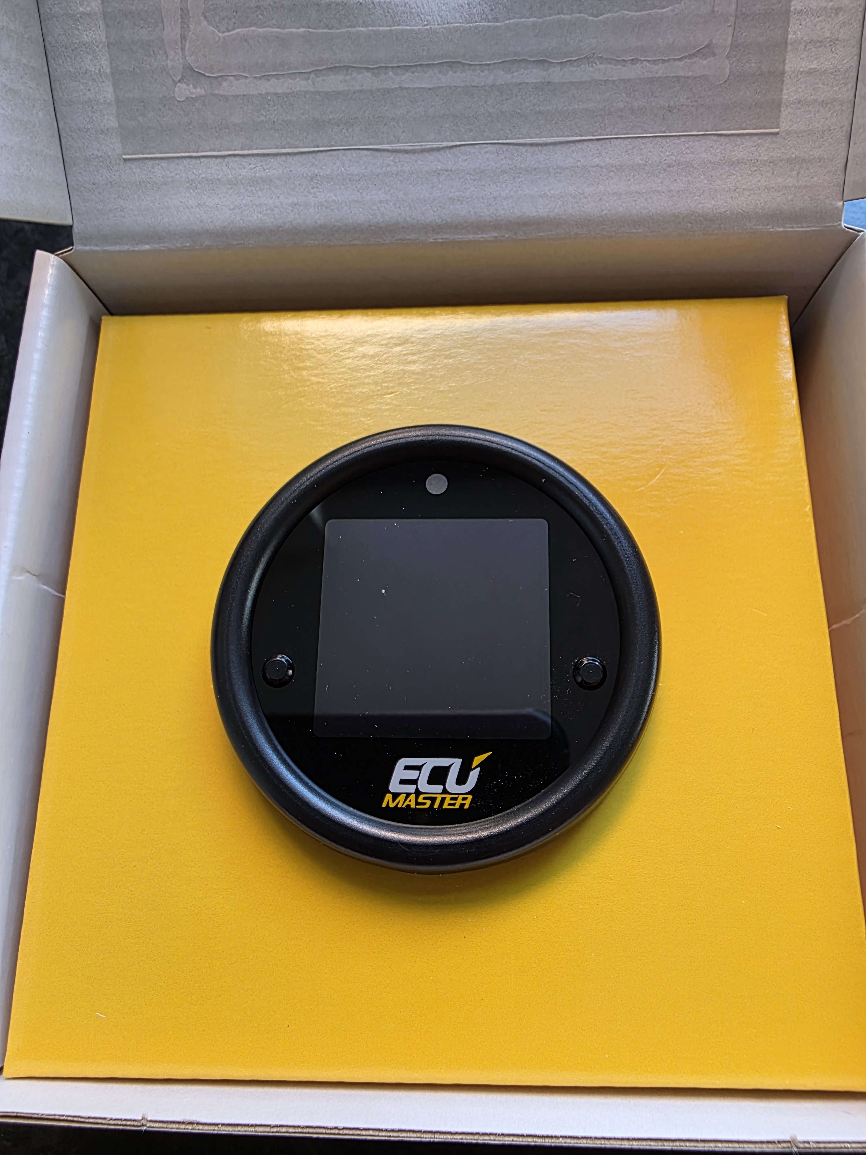

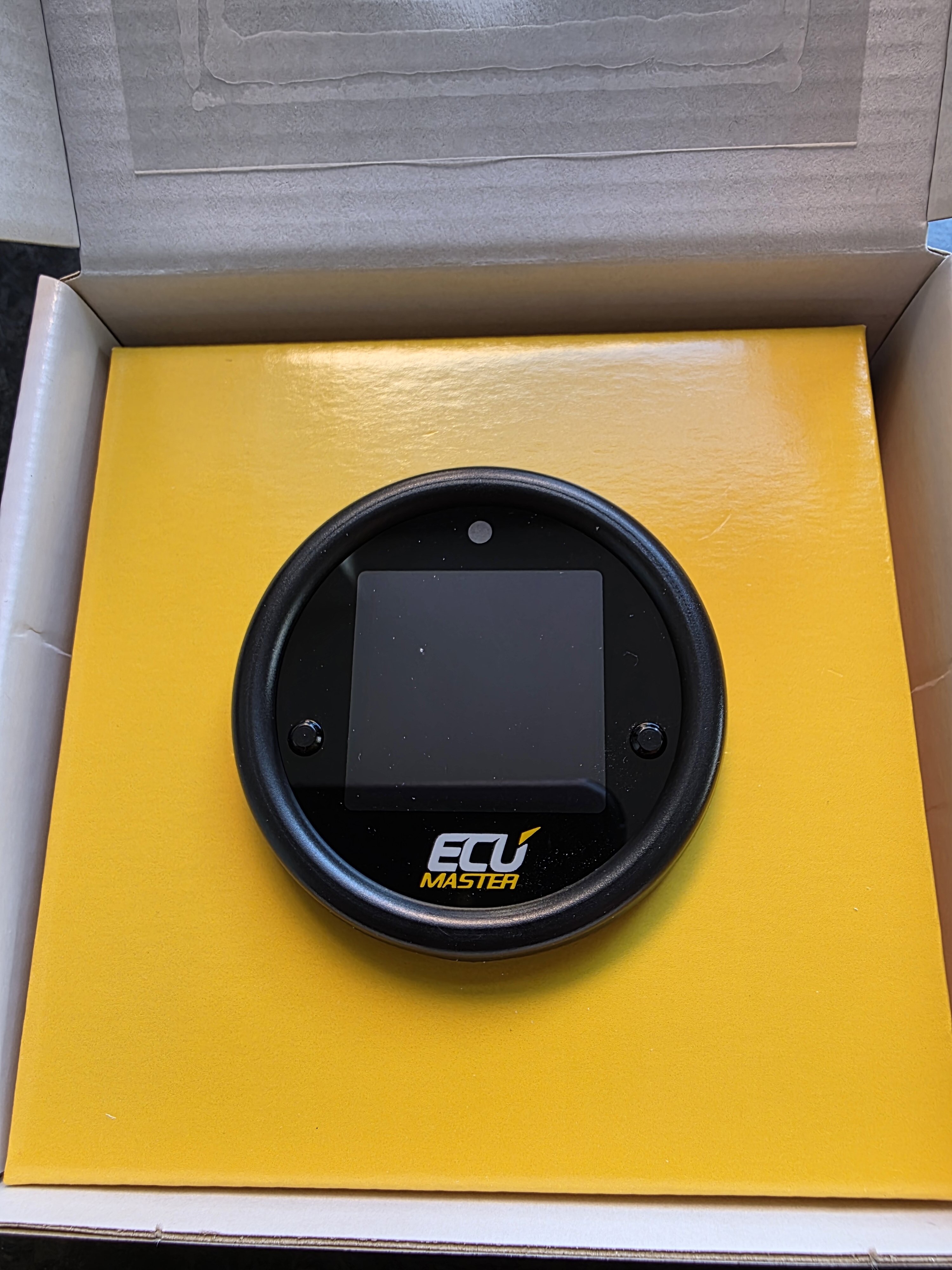

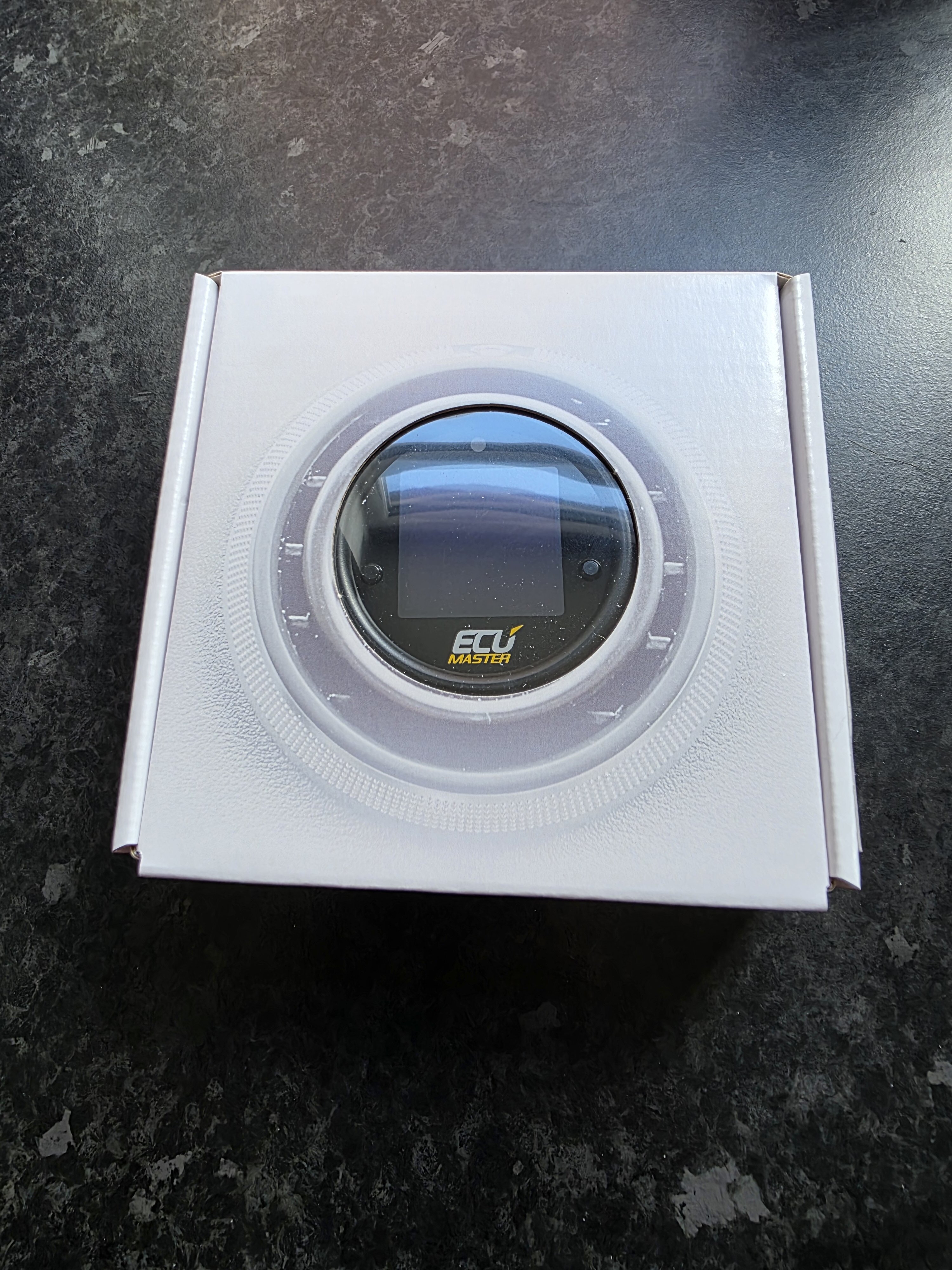

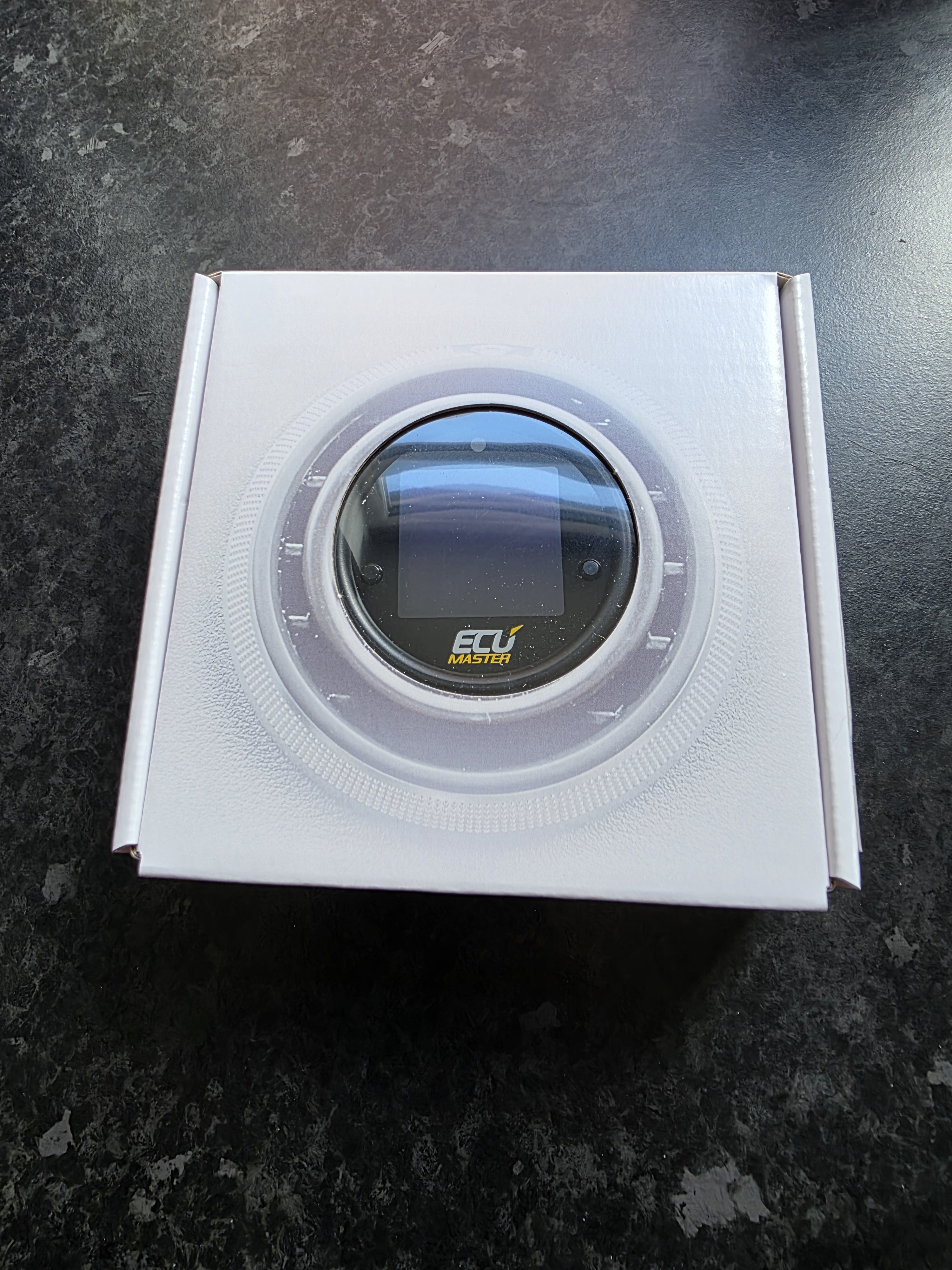

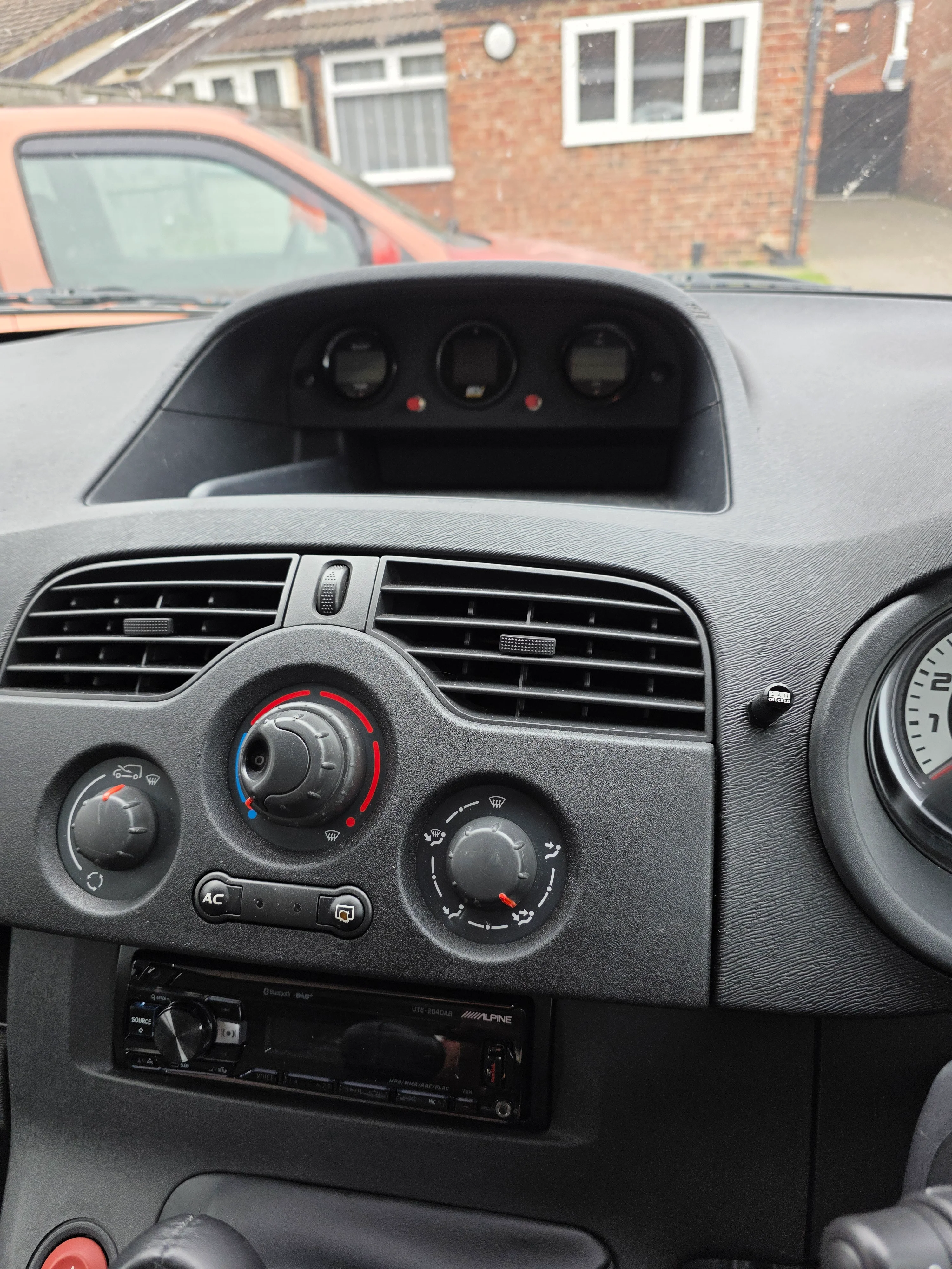

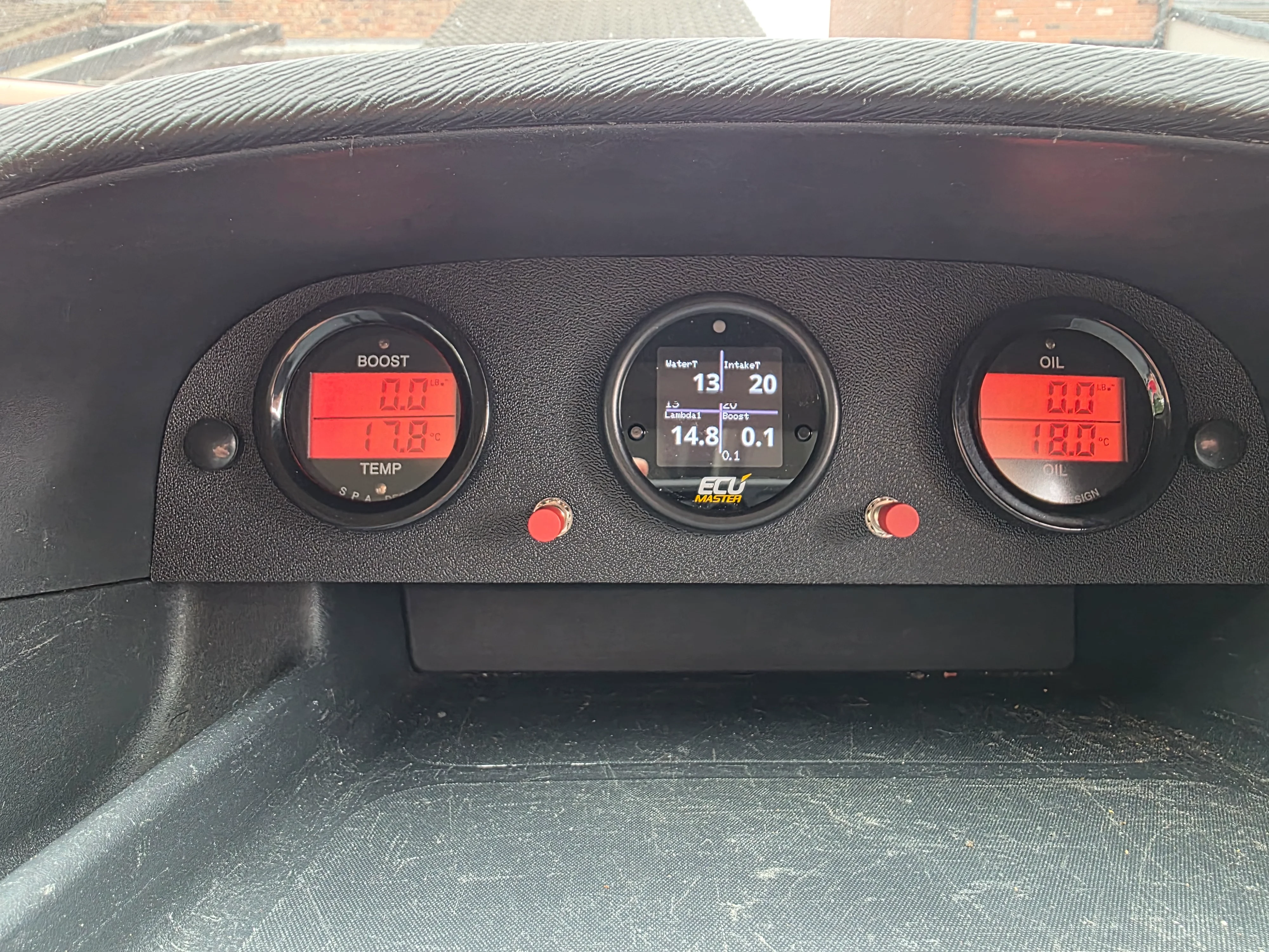

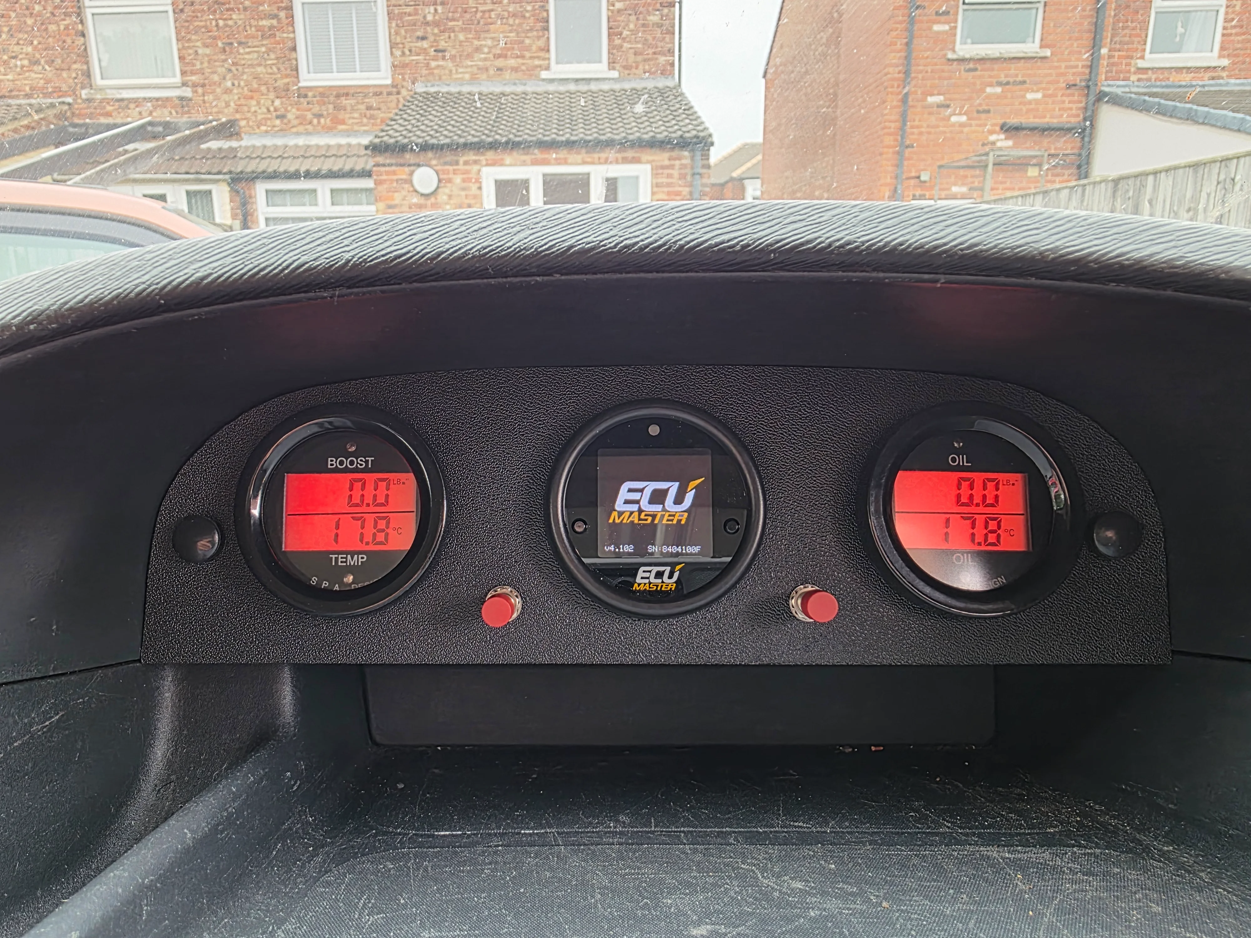

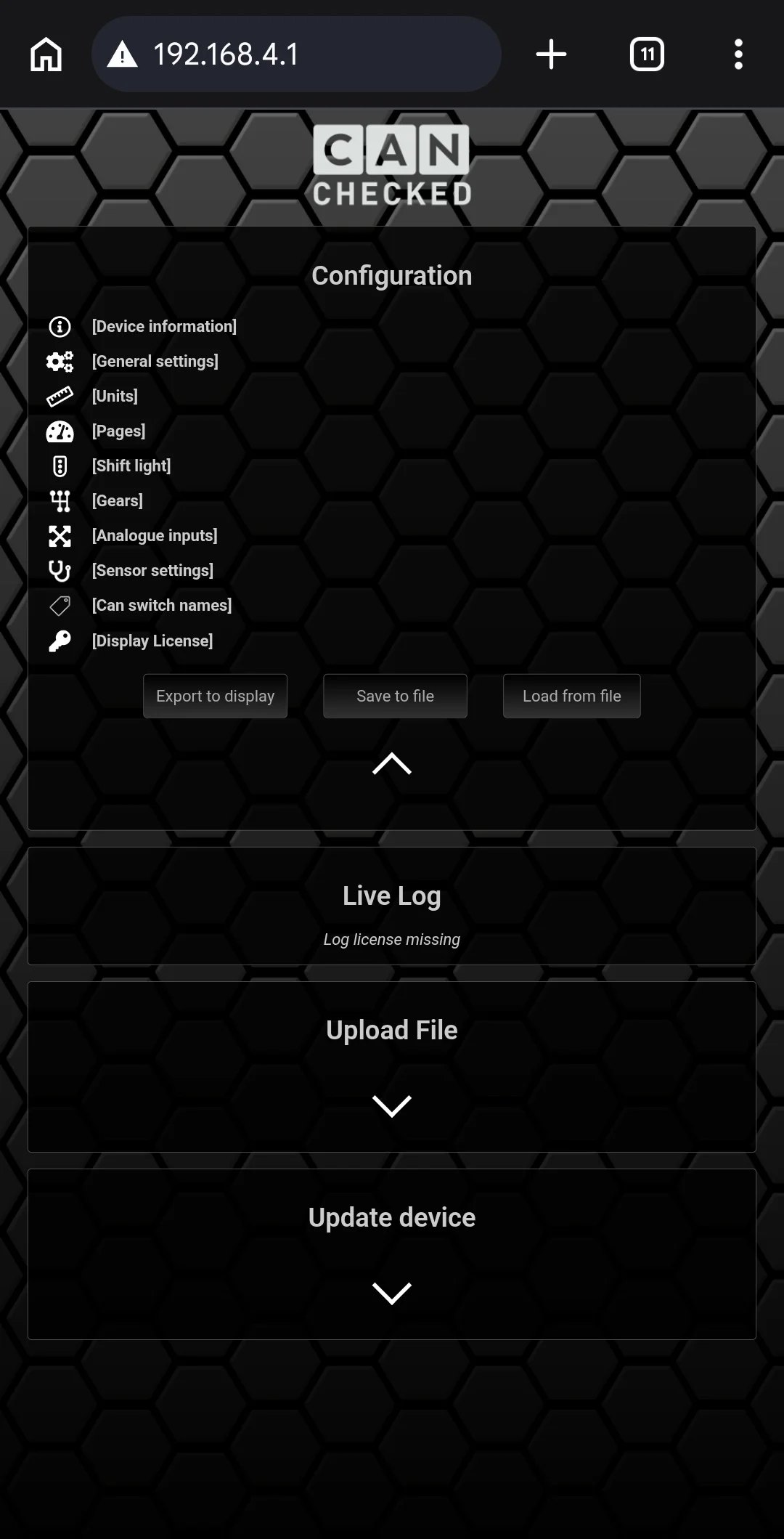

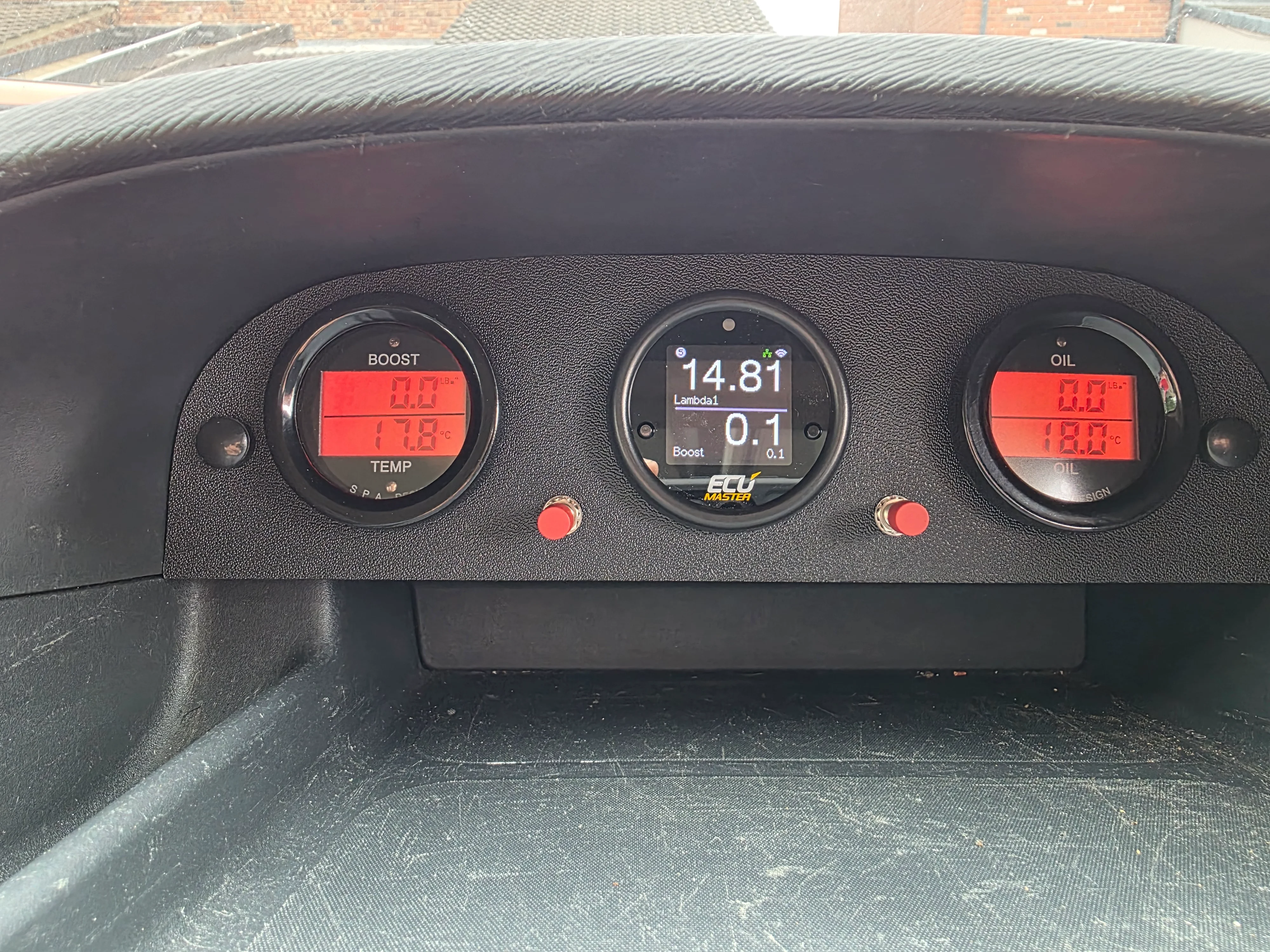

Ive also bought an Ecumaster canbus gauge to display live data. Its a rebranded canchecked mfd15 gen2 gauge. I almost hit the switch on an ecumaster 9" adu instead but i feel the extra money would be better invested in fuel hoses for the fuel system so i can go for more power, not that it needs any more that wastegate pressure😁
Plan is to remove the Aem afr and fit this in place as ecu has wideband lambda on board.

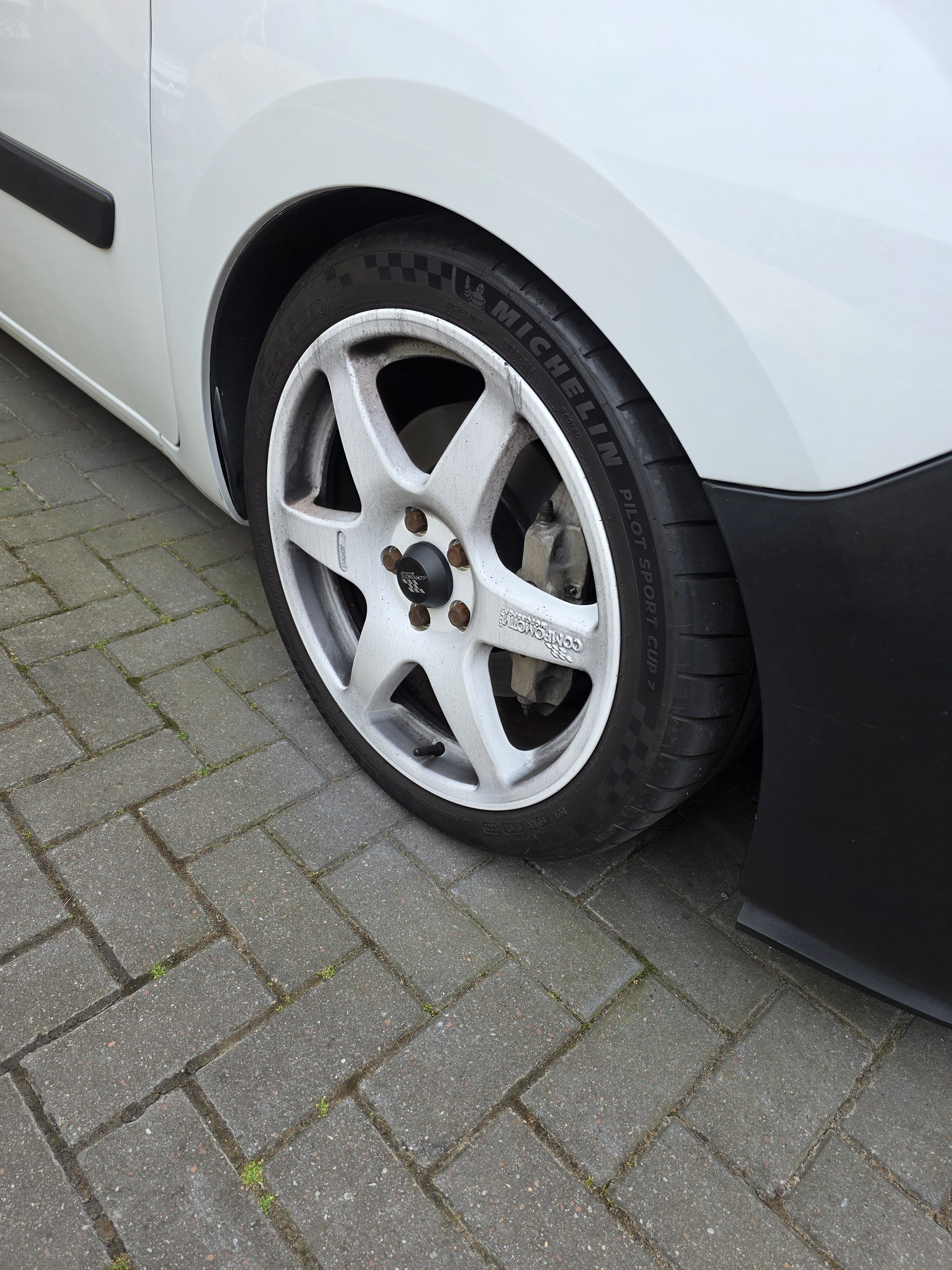

I have refitted the ds1.11 pads to the front as it needs as much braking power as possible. Forgot how bad the brake dust is off them!

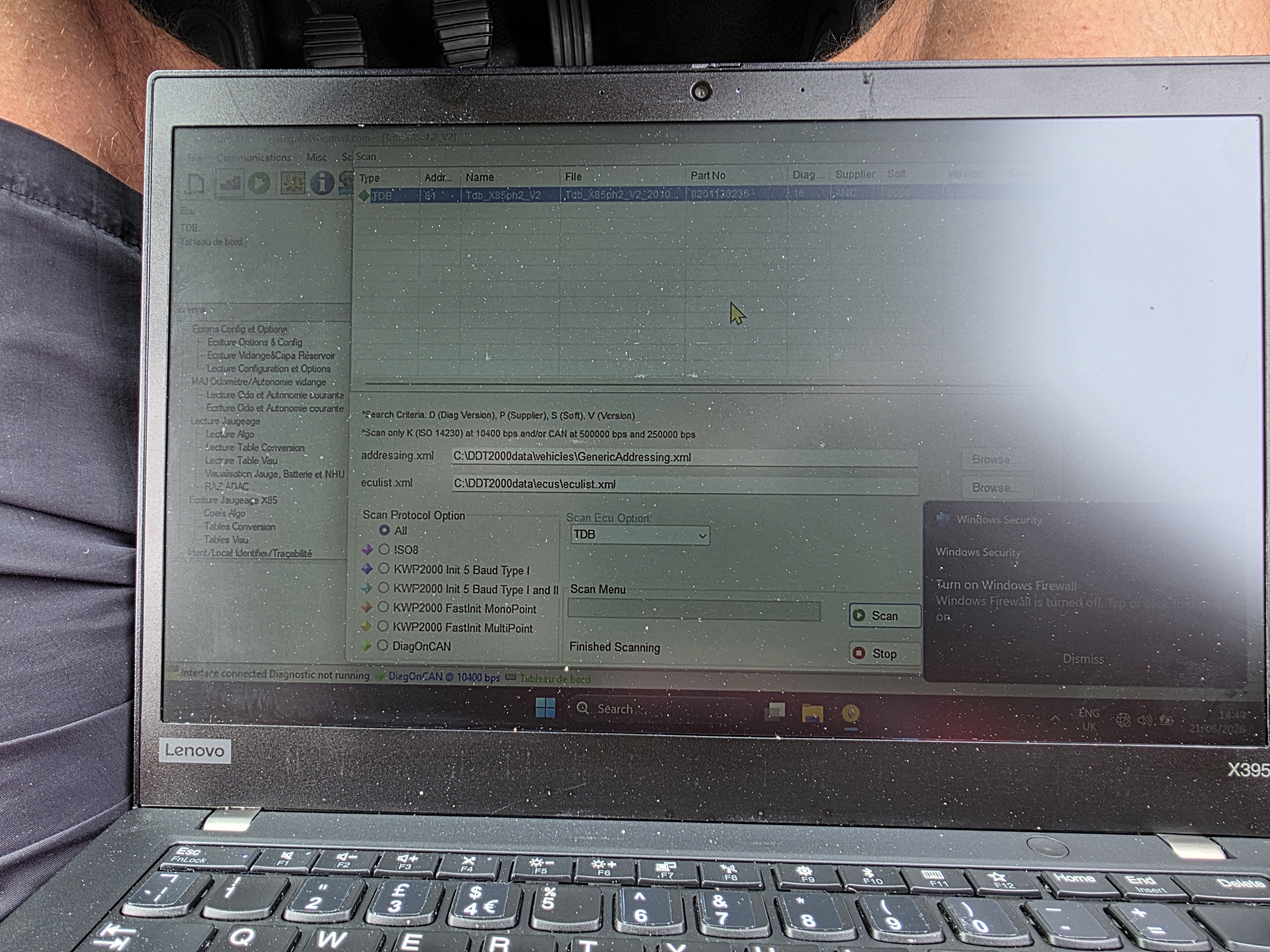

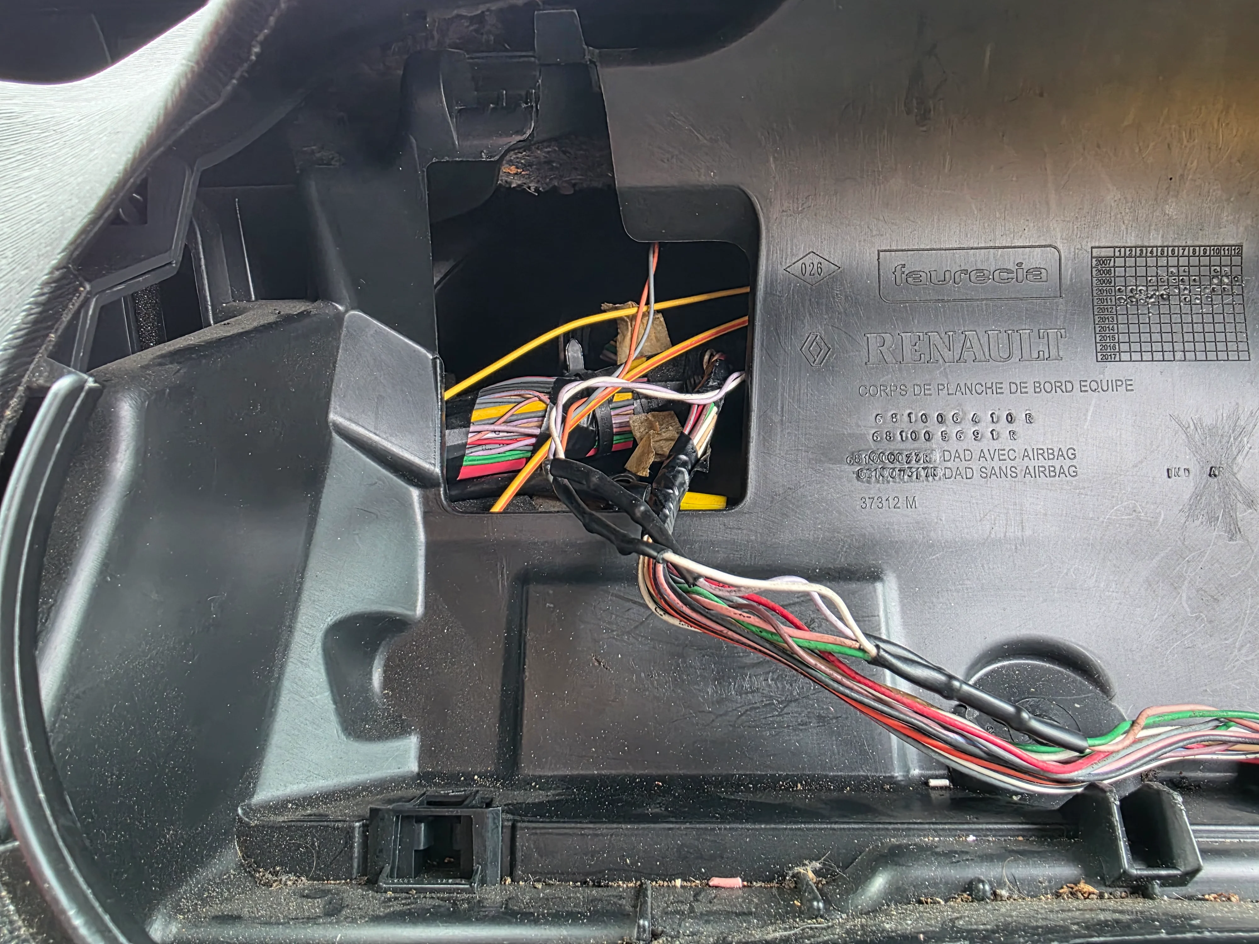

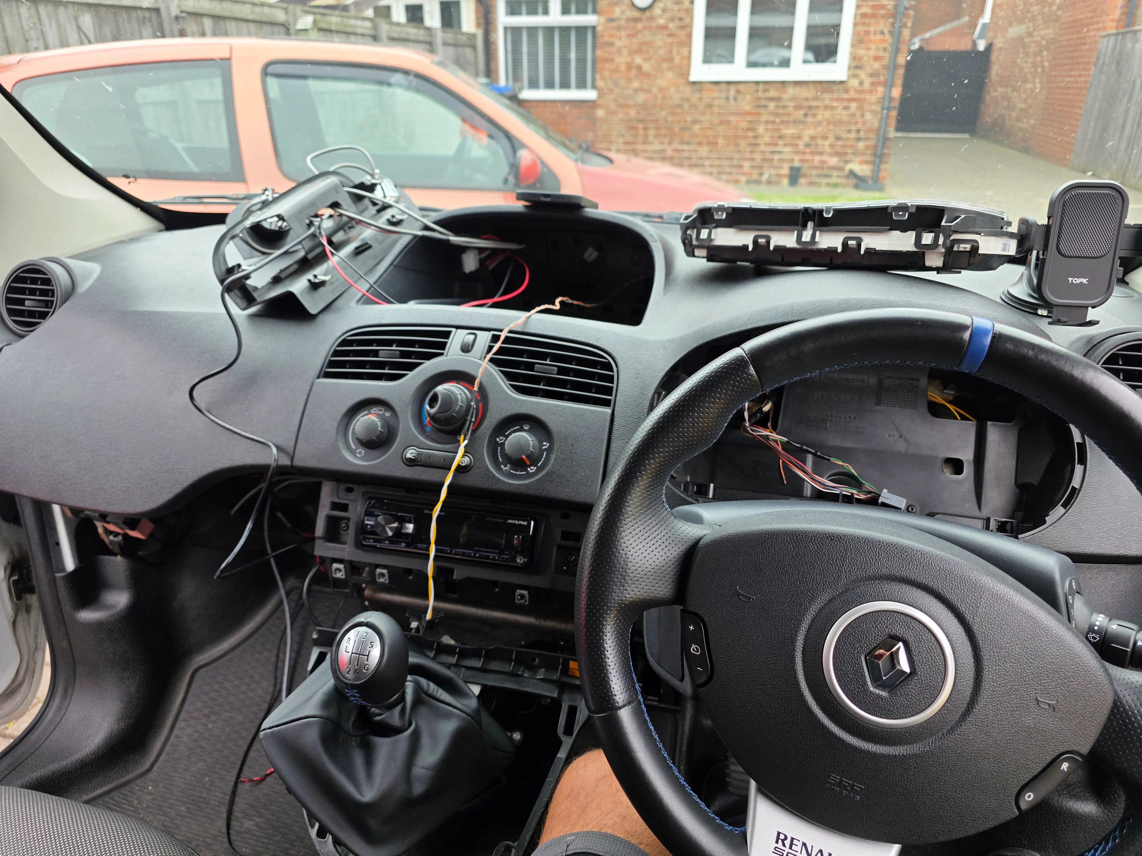

Ive had a sniff round the TDB oem settings on renolink and cant find a way to disable the counter.
Been giving it some thought, and the plan is to intercept the wiring for level sensor at the dials and connect it to my can switchboard so Ecumaster can log fuel level, and show the level on the canbus stream on the gauge. If i disconnect the sender wiring from oem dash totally it will flag errors, so will use a dual station convertor to output correct resistance to both gauges at the same time. Other option is to add a resistor to trick oem gauge but it will render it useless, where it does something currently.
We will see how it goes. I think its doable.
View attachment 1792908View attachment 1792909
