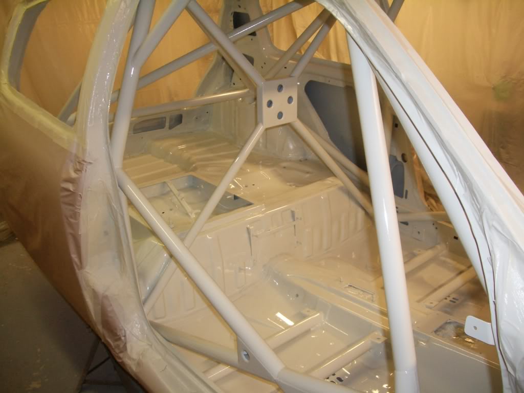

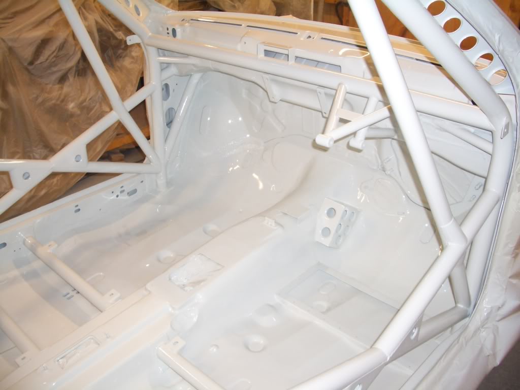

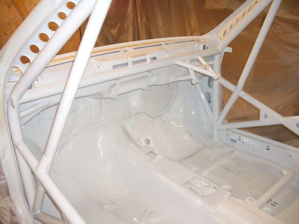

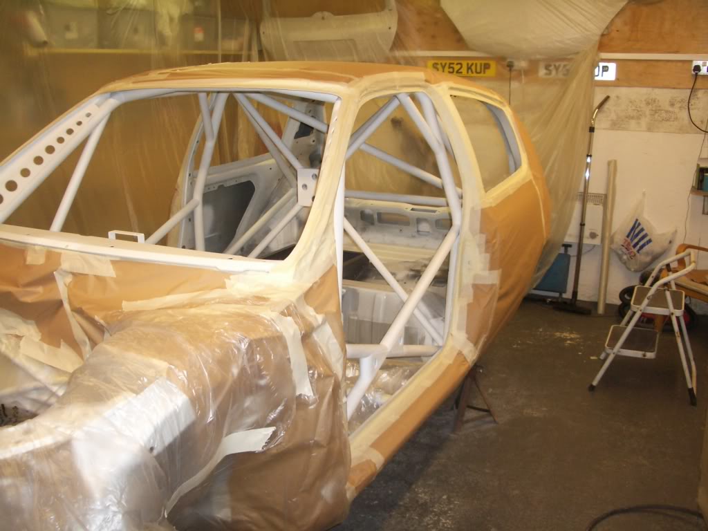

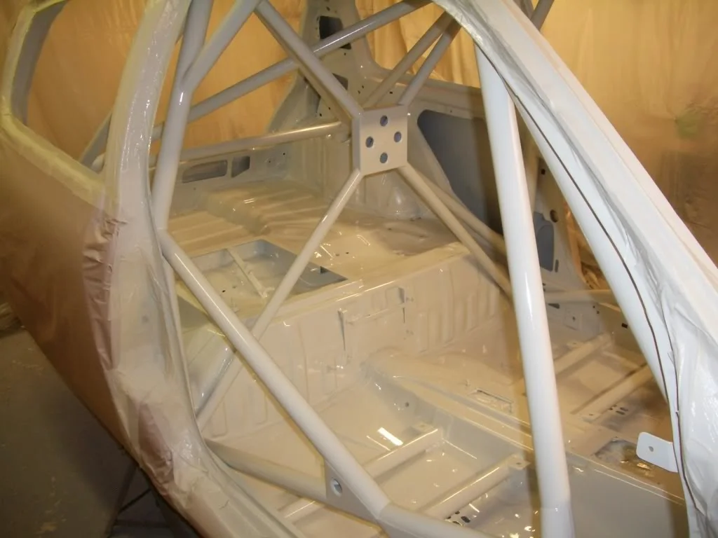

Spent the best part of the day getting the car ready to paint, in the end it took the best part of 6 hours to clean and then mask it all up.
Ready to go
My mate showed up around 5 and set to work, both compressors where running flat out but they just about coped, he's got a puka airfed mask but it uses a sh*t load of air.
They were both getting a bit hot towards the end and some water got past the trap/filters but there's only 3 or 4 wee bits at the back that can be flatted back and polished up later.
The colour was supposed to be mixed up to match the original 369 code that the shell had been painted in the factory but it's nothing like it! Got enough to do the whole car so no big deal, it looks quite grey compared to what was on the shell, will need to get it out in the day light to decide if we like it, but dont really want to be painting it again!
  Cup In bits
Looking good, I was under the impression the shell was just primed ready to paint!
Is it alright to weld tabs to the cage bars like you have for mounting the dash, no issues with MSA etc??
  Audi A6 & 172 Cup
Dont see why not, there's nothing in the book I could see that says or implies otherwise.
I was surprised when it arrived in paint, bit peeve'd the colour we've got is so far off, I'd grown used to whats on the car and was wanting to keep it, as said, whats on the cage is a bit grey looking but I think thats more so what Renault Glacier white is supposed to be so not sure whats going on. Will phone the paint shop today and ask a few questions.

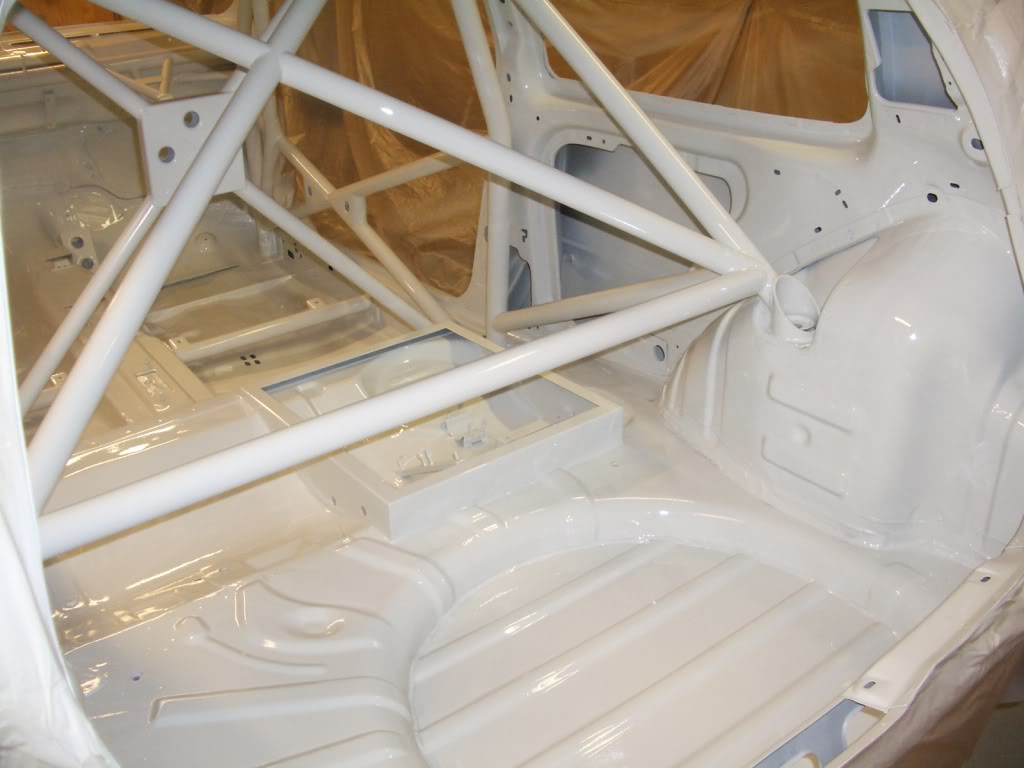

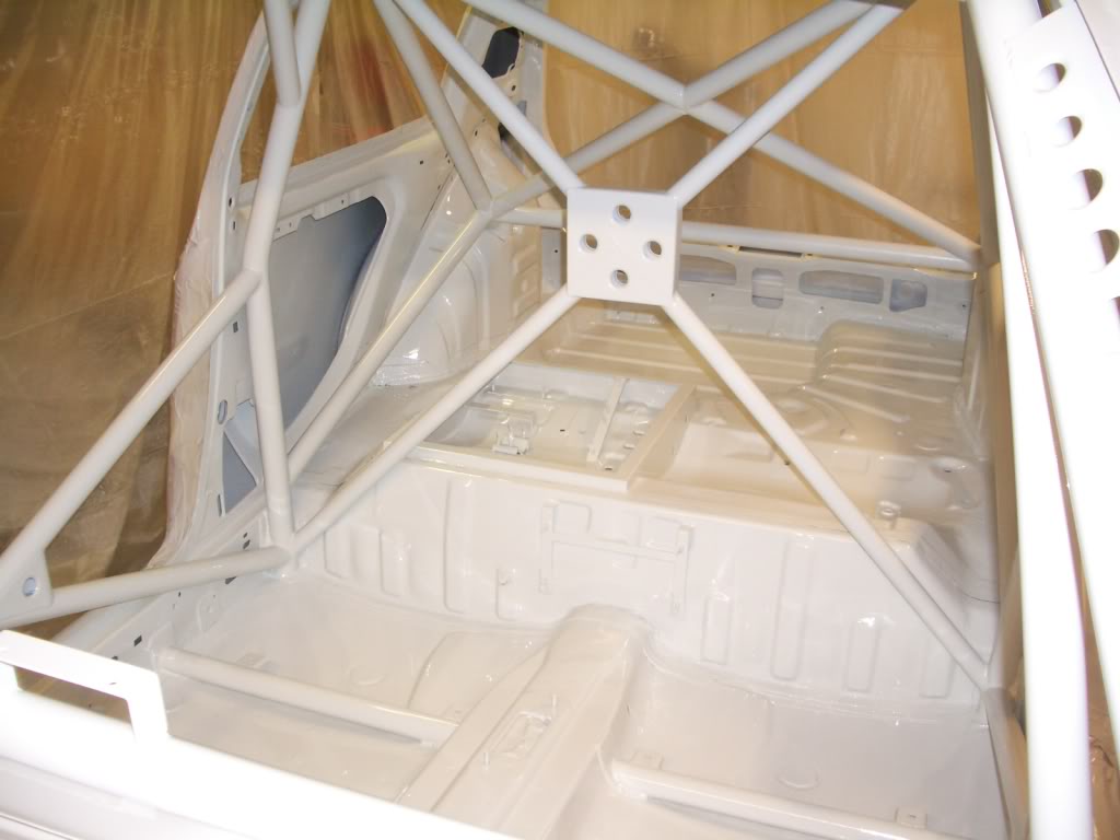

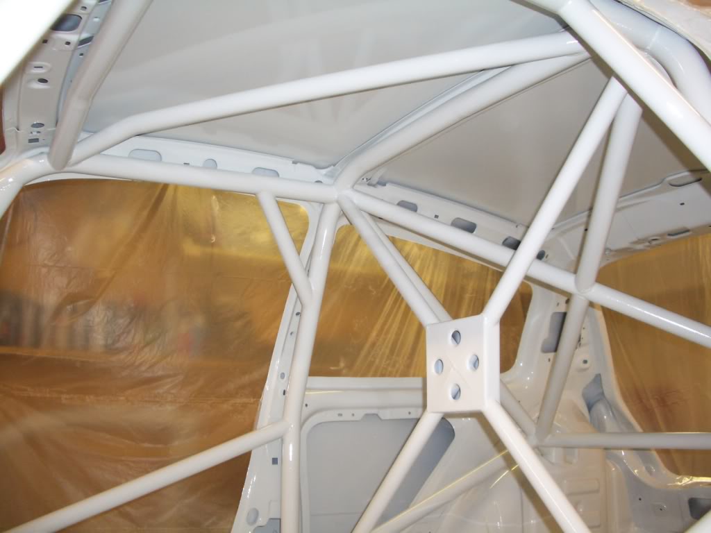

Now that it's dried we've been able to get in for a proper look there are a few bits on the cage that are a bit shy and could do with being touched in but there was so much overspray/mist toward the end he could hardly see! so he's going to bring up his spot in gun to do some wee sections but over all he's done a great job considering it's been done in a shed! there's very little dust in it, pretty sure most of it will polish out.
A rough summary of what needs to be done before assembly can begin:
  • Touch in various bits on the cage.
  • Paint the underside and rear inner wheel arches.
  • Finalise the strut towers ie just bite the bullet and weld the new top plates on!
  • Make new engine & gearbox mounts ;)
  • Tub front inner wheel arches
  • Paint the engine bay and the outside of the shell, panels etc.
Start bolting things on.

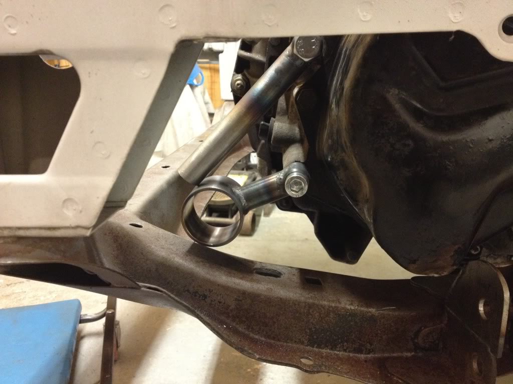

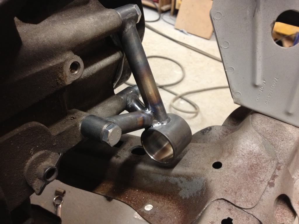

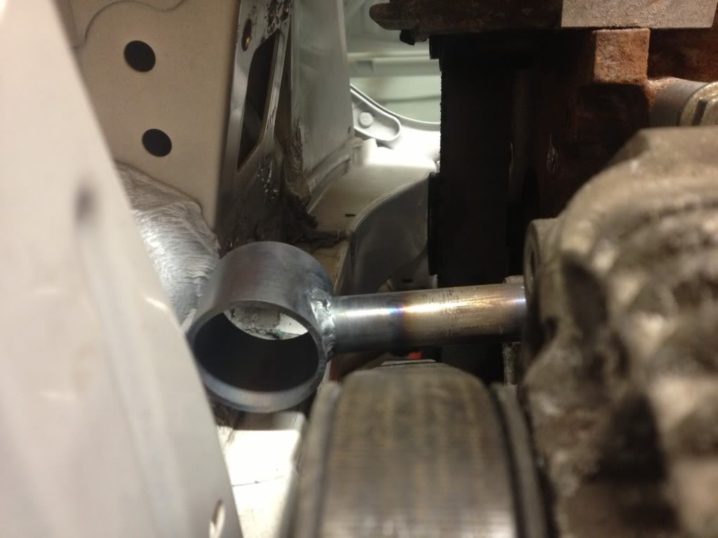

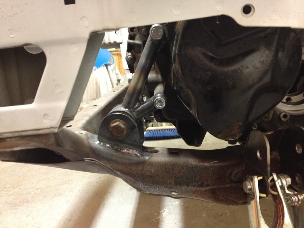

New engine and gearbox mounts underway, picked up a bust gearbox to let me bolt the old engine in, proper box is still being built.

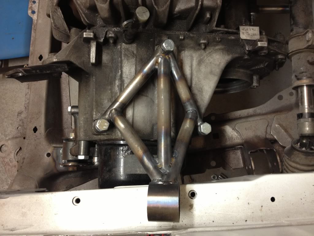

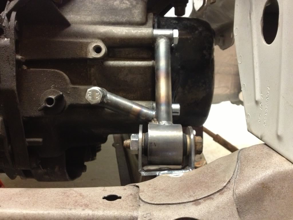

Started off with the front lower gearbox mount,
I had the spacers turned up by a local machine shop, never used the guy before but he only charged me £10 to knock up 12 of them which was pretty reasonable.
First bits in progress, 3/4" 10awg seemless tube and some 40mm i.d seemless tube to hold the bushes, which are Mk1 front wishbone bushes, bought for much cheapness on ebay ;)
I welded up the wee gap you can see in the above picture incase any of you were wondering ;)
Once that was done I then made up the bracket for the subframe
I know the cup cars used to crack subframes but then they had the engine and box mounted directly onto it, I'm still going to have two mounts onto the chassis legs too so hopefully the subframe won't complain too much. Will look at the dogbone mount next, might leave it be or I might make something similar to the cup racers.

Top job. Iv heard of the subframes cracking aswell, was that at all the engine mount points? I thought it would have been the wishbone pick ups
  Audi A6 & 172 Cup
Cheers, didn't take too long to do either, well by my standards any way lol about 4-5 hrs.
If I remember right they used to crack at the front right corner, just back from where it bolts to the chassis leg.

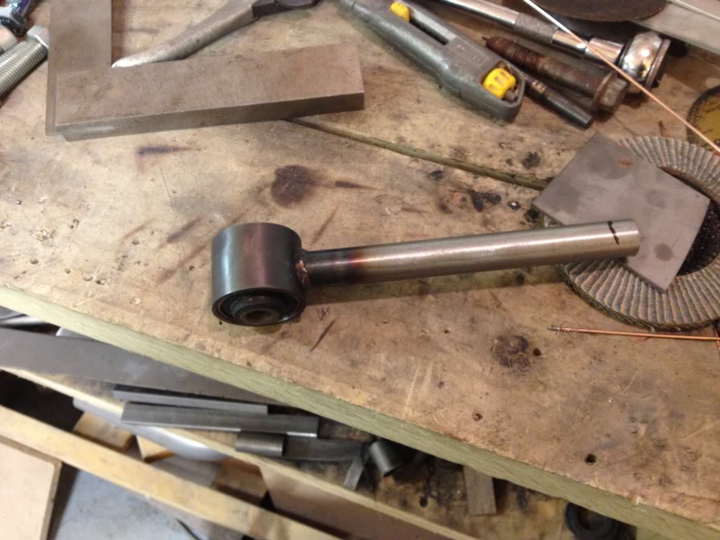

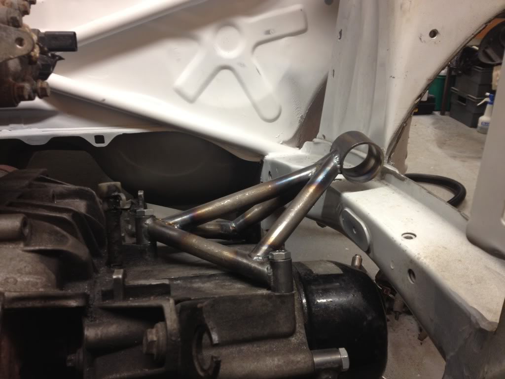

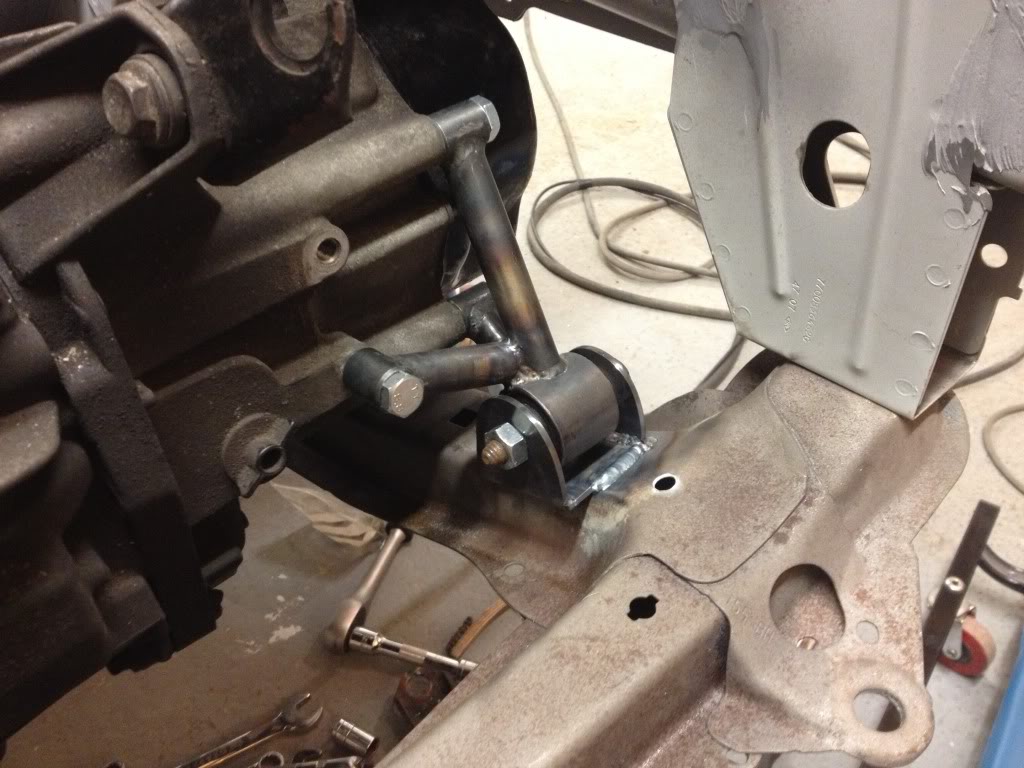

Didn't get much done today, had a few other things to do that took longer than expected but I made a start on the new dogbone mount
Still got to add another couple of tubes to it
It was very nice of Renault to make the width of the dogbone mount the same as the wishbone mountings, just had to open out the bolt hole from 10 to 12mm, made life a lot easier.

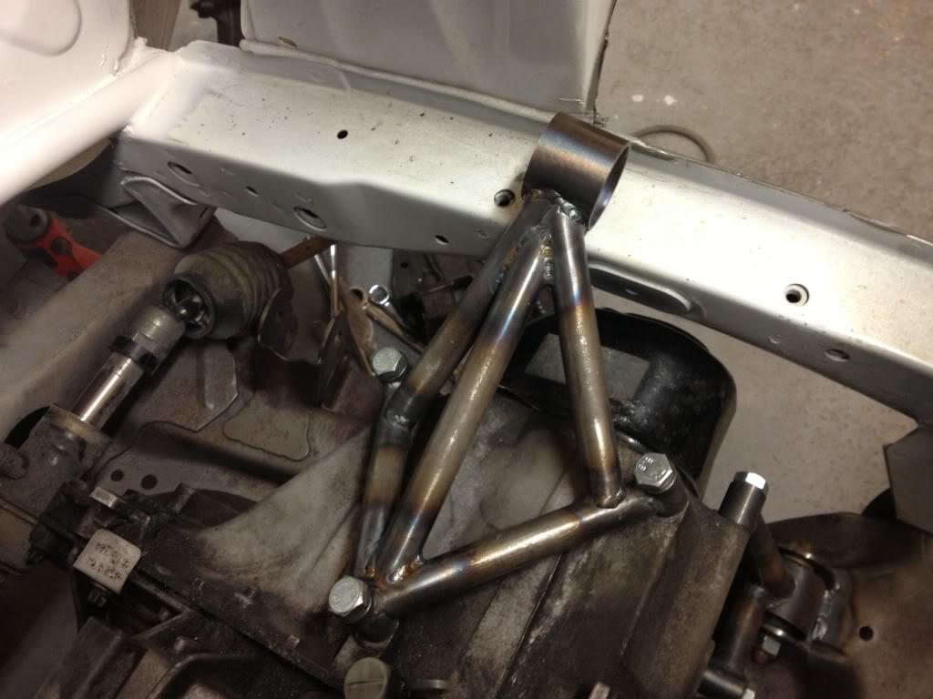

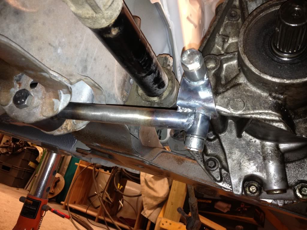

Managed a little more progress today but ran out of gas once I got started on the top gearbox mount, will go change the bottle first thing tomorrow

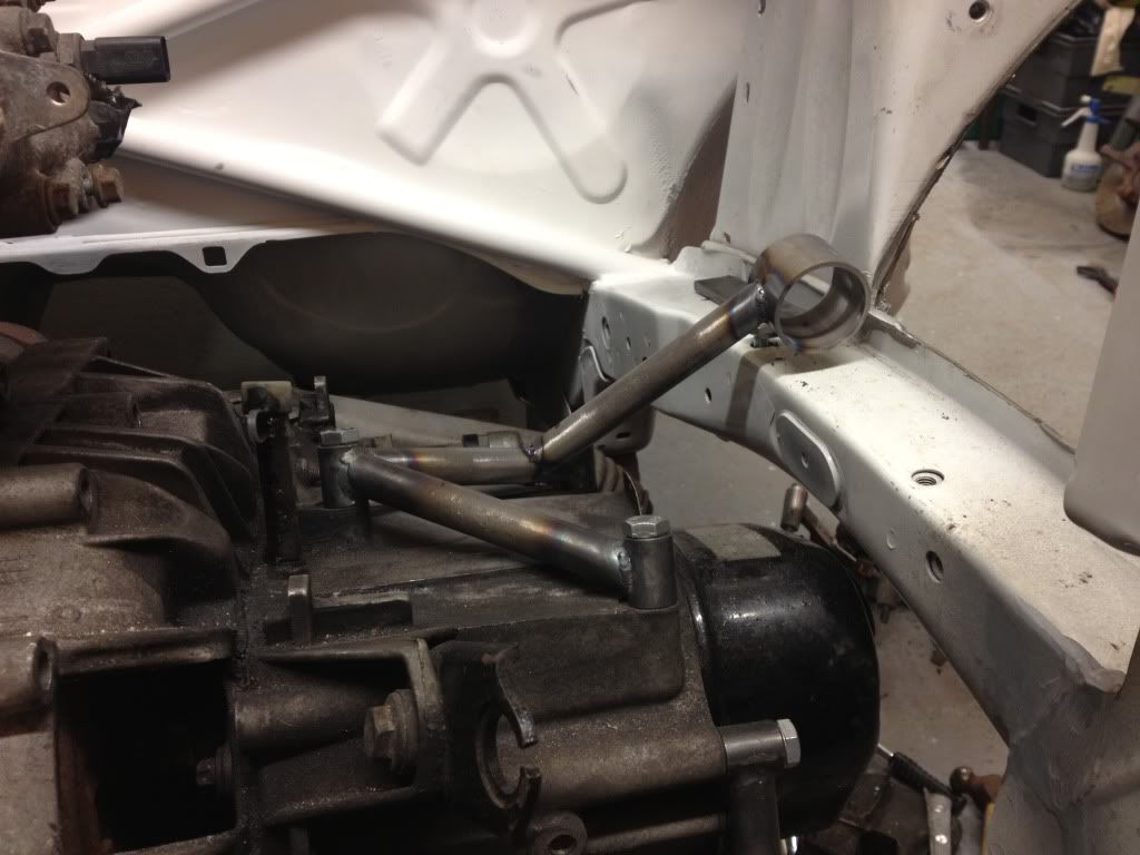

Added another tube to the lower mount, think this will probably suffice but i'll wait until all the other mounts are done before deciding if it needs something extra adding to it.

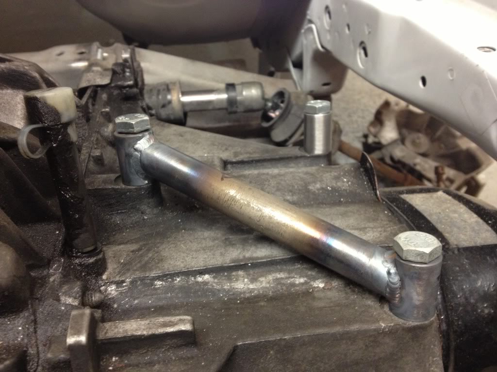

Started on the upper gearbox mount
  Audi A6 & 172 Cup
Still using the wishbone bushes for those, probably use two of them for the gearbox side not sure about engine, depends how much room there is, having had a quick look I suspect not a lot! but i'll get round to that.
Just getting some breaky then time to head out and get some more argon :)
My mate said he's going to pop up on Friday after work to spot in a few wee sections on the cage that we missed so i'll need to get things ready for that too.
  Audi A6 & 172 Cup

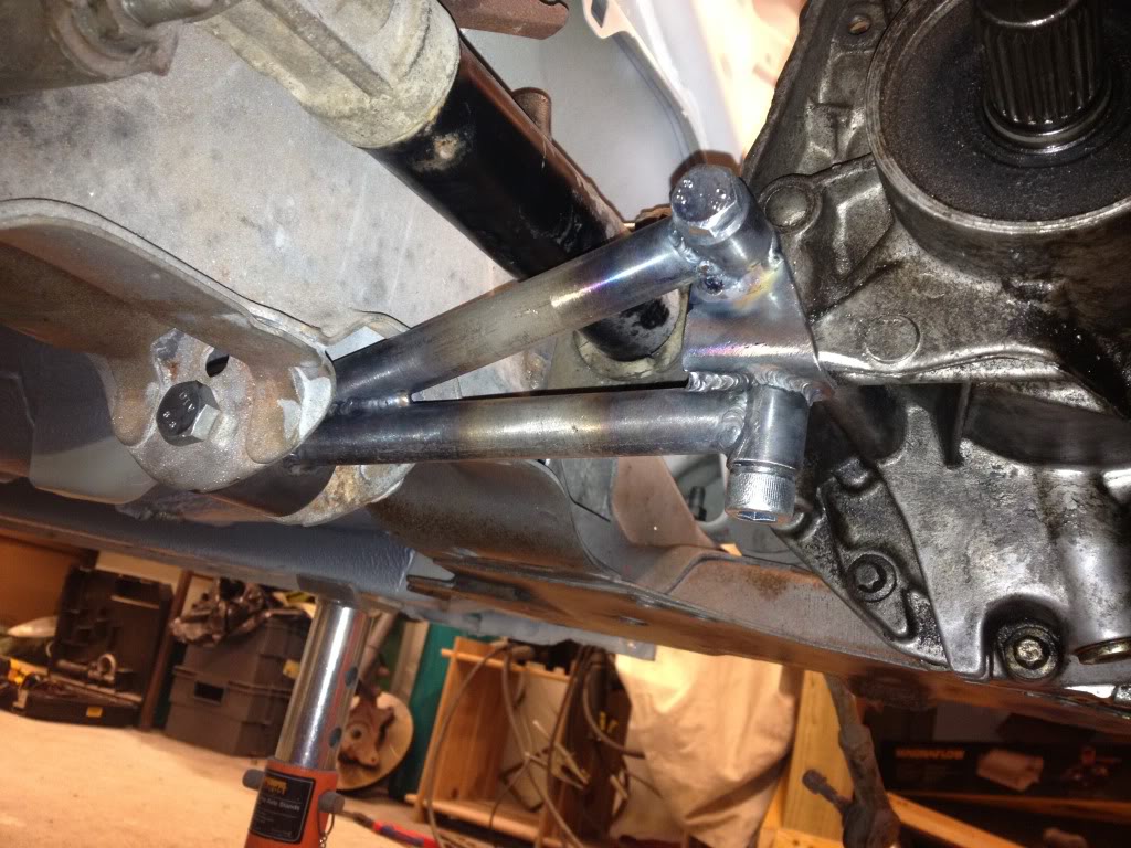

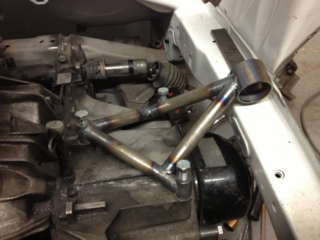

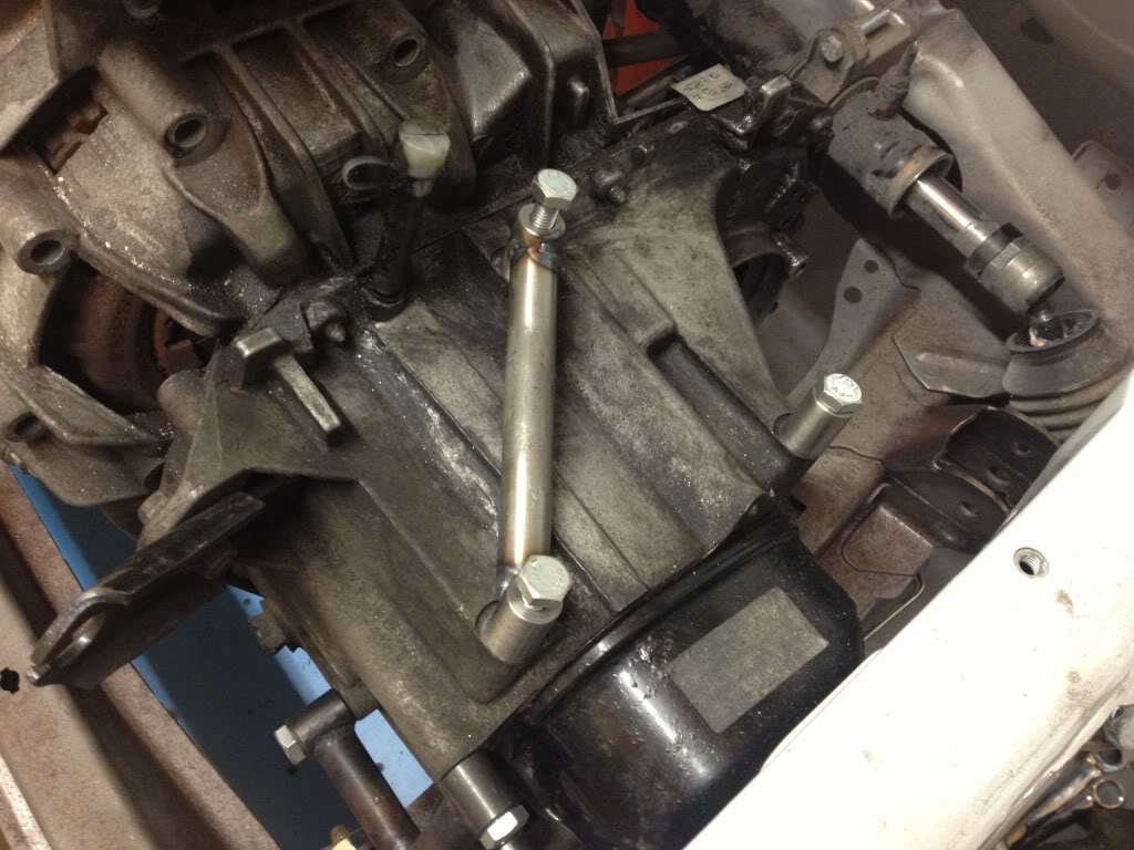

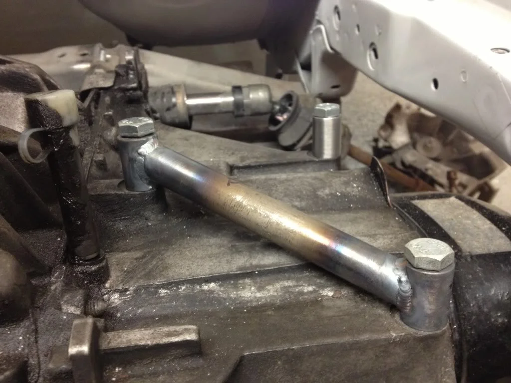

Some more progress on the upper gearbox mounting, decided one bush was enough
Still need to make a bracket on the chassis leg but as you can also see the front section of the inner wing has ben removed ;) will need to rebuild that before I can weld the bracket to the chassis leg, or at least thats the plan, help tie everything together.
As a bonus, the new mounting is just under half the weight of the ally bracket which I was quite surprised about given how hefty the tube is.

Some very tidy fabrication work going on here, whats the reason for making all custom engine mounts?
  Audi A6 & 172 Cup
Few reasons,
The uprated mounts were about £240 last time I looked.
It's not unheard of for the standard alloy parts to snap once you fit harder mounts, especially when the car is used for competition ie taking kerbs.
I'm modifying the inner wings for more clearance so the standard engine mount needs to go.
So far these have cost me £25 for the bushes and about £30 for the tube and other materials, even factoring in a bit of gas for welding it's still cheaper than buying updated bits for the standard mounts.

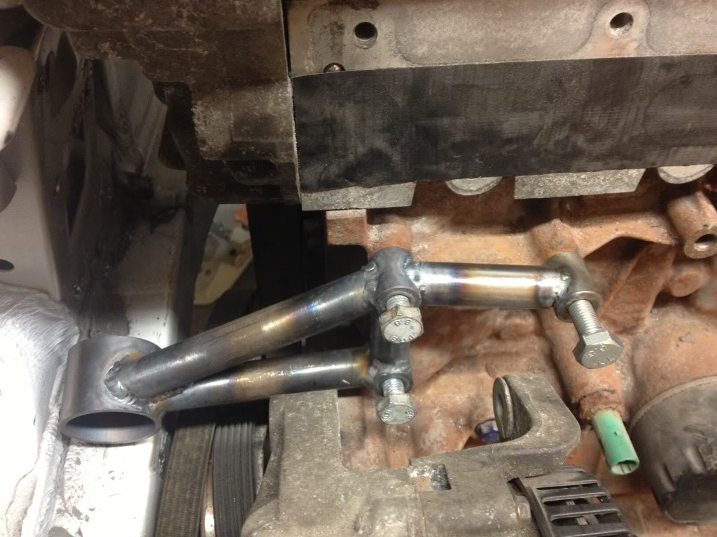

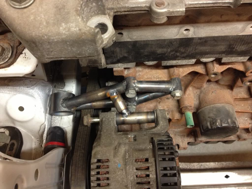

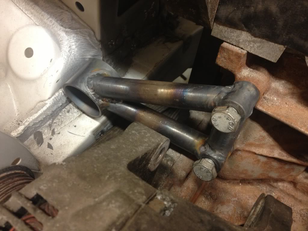

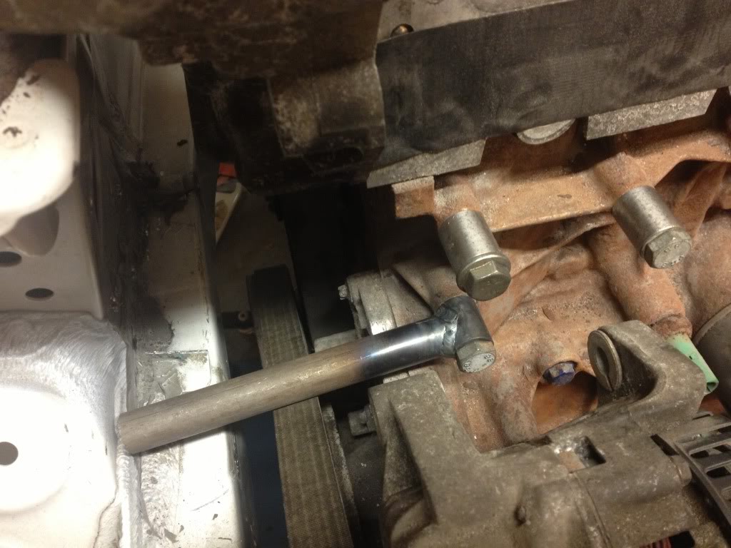

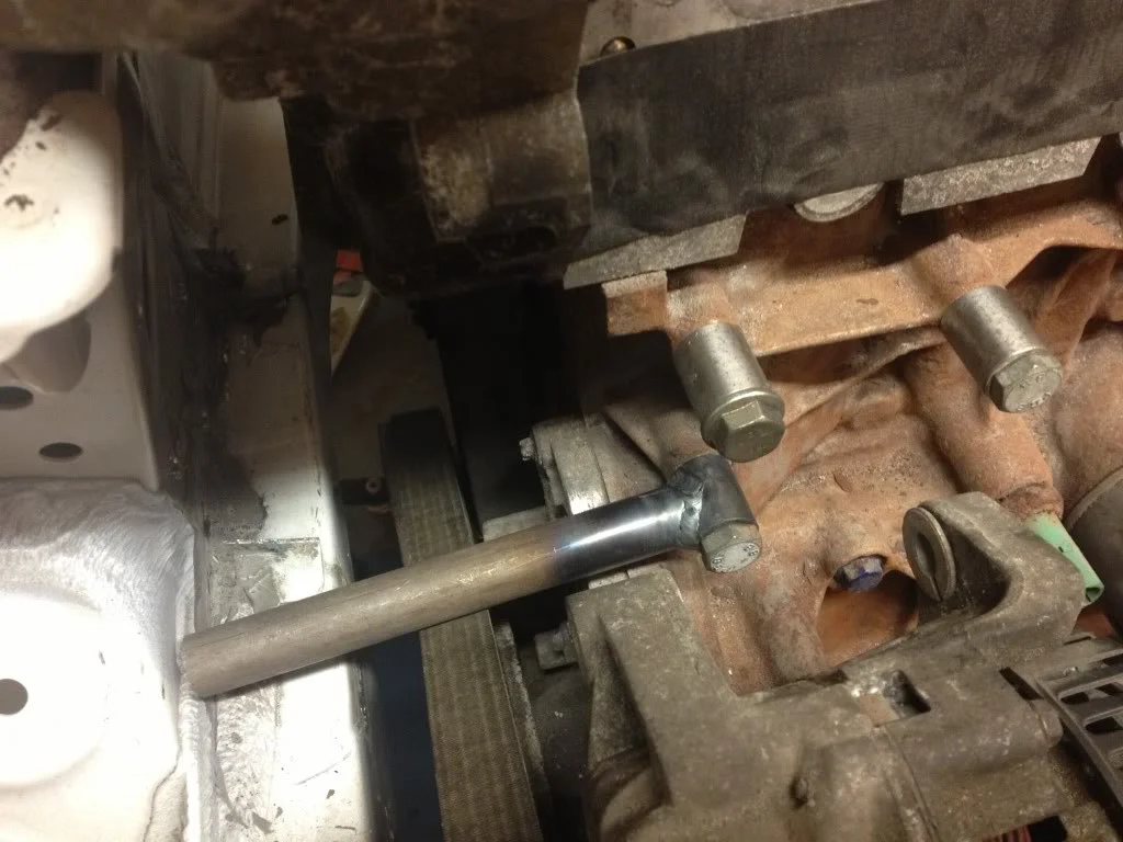

On with the last and probably most important mounting, proved to be quite a tricky wee sod this.
First off I offered up the alternator using the standard alloy mounting brackets, then locked it solid using a bolt through the adjuster slot, confirmed that it hadnt moved by removing and re-fitting the ally bracket, each time it lined up and the long bolt went through no probs.
Once I was happy it wasnt going to move I made up the first bit
With the alternator at the top of the adjuster slot it just clears the belt, realistically it's never going to be there so should be plenty clearance.
Added the top tube and a vertical one between them,

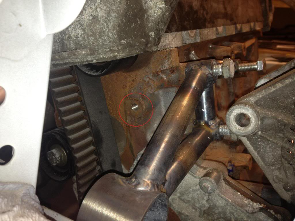

Then picked up the on the 3rd mounting point
I'm also going to take a support off this M8 hole in the end of the block, currently only used as part of the timing belt cover but the cover can live without it.
I've asked the machine shop to knock up an M8 spacer, will pick that up tomorrow.
Made a start on the bit to hold the alternator, tacked on and all lines up, will add another tube in the opposite direction, recon that should do it
Still to make the brackets onto the chassis but i'll need to pull the engine out to clean up the area first.
