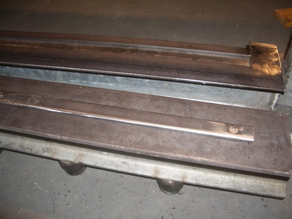

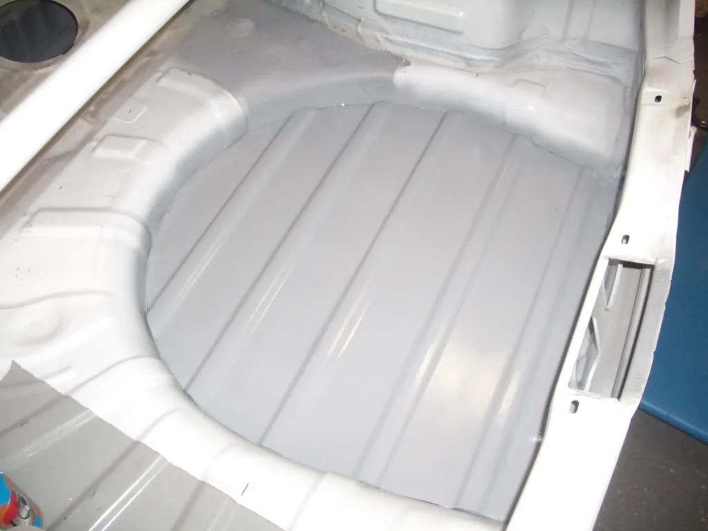

Yesterday and today I have been working away at my idea for making up a new panel for the boot floor.
I wasn't sure how well it would work or indeed if it would work at all but figured it was worth a shot, nothing ventured and all that.

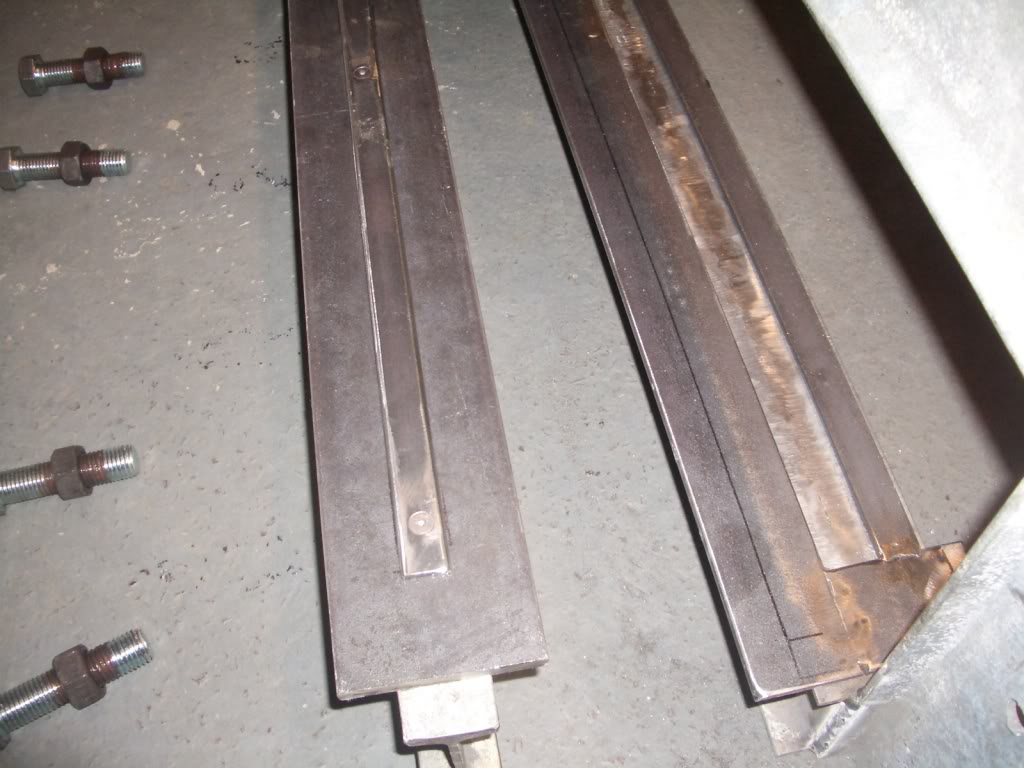

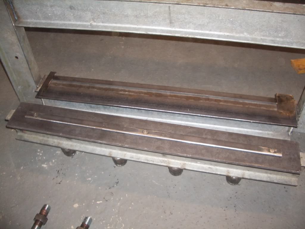

I knew i'd need some chunky bits of steel so I went along to the local fabrications place I've known for years, chance would have it, he had some left over I beams from a job that were going for scrap, gave him £15 beer money for for 5 of them.
Then went to another fabrications place a bit further up the road and got a sheet of 0.9mm, again £15, picked up a few big bolts £5, so it was going to owe me about £35
Not got any pictures of it being made but you'll get the idea

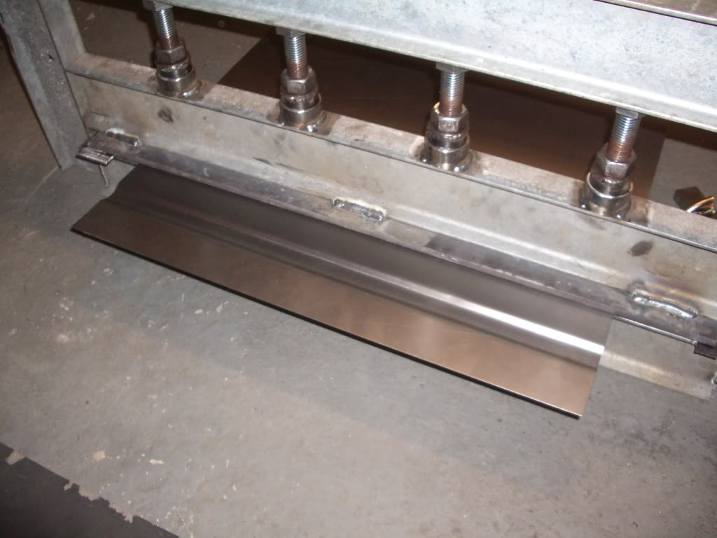

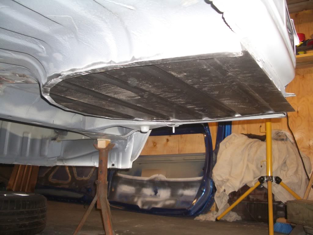

I tested it on a bit of scrap first and initially tried to do a short swage (using a different set of dies, for want of a better description) where it finished before the ends of the sheet but this caused a lot of distortion, tried a few things but no matter what i did, the distortion was going to make it look a mess.
So, I made a new set of dies and decided to swage it the full length of the sheet, obviously this meant it wouldnt be flush all the way round where it met the boot floor but felt this was an acceptable compromise.

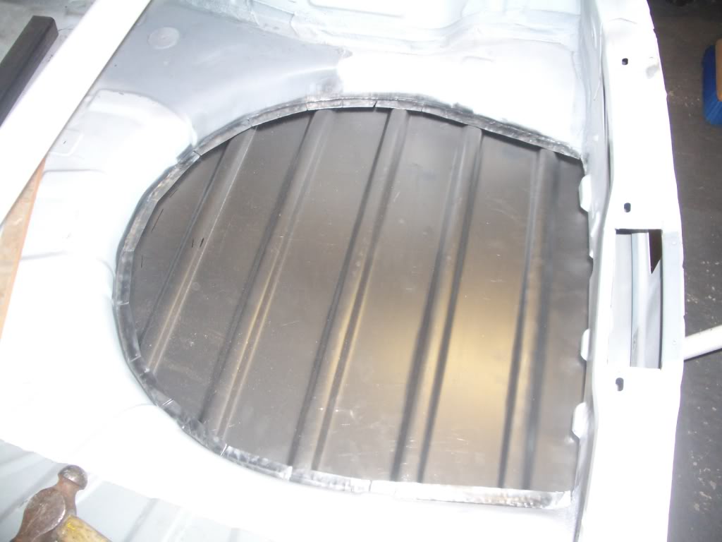

With the full length dies in, I measured up the sheet and made the first swage, pleasantly surprised with how well it came out

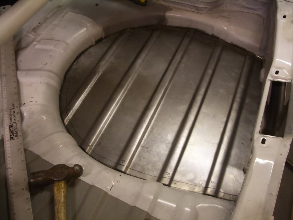

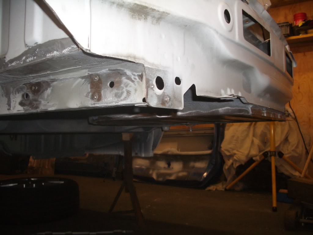

Repeated another 4 times and got this, offered up from below
Marked out and cut to size then slotted in from the top
It's been a long day so I stopped short of welding it in tonight, will check it over again in the morning, make sure it's straight etc then weld it in.

Cheers James, nice to know it's well received. It saved 0.5kg too which I was quite surprised about

I'm by no means a professional panel beater or metal worker/welder, just what I've picked up over the years. I'm actually a sparkie by trade but my old man is a mechanic, I was shown how to change spark plugs on a 1.1 Mk2 Fiesta when I was 7

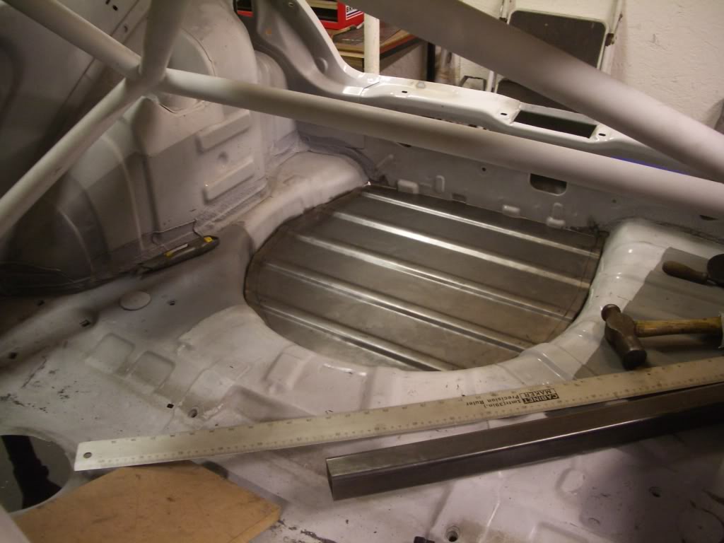

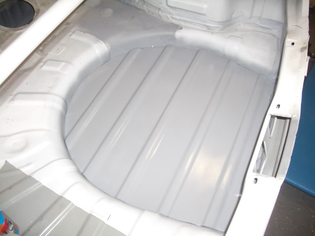

Managed to get the boot floor welded in and primed up, will leave it till tomorrow then seal the seams up

any chance you can get a pic of your hole-sawed/swagered boot? I was wondering if you hole-sawed/swagered over the small ridge in the base of the boot...

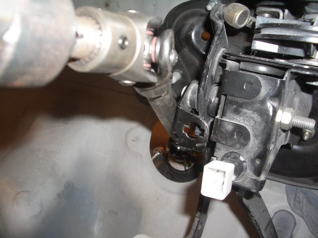

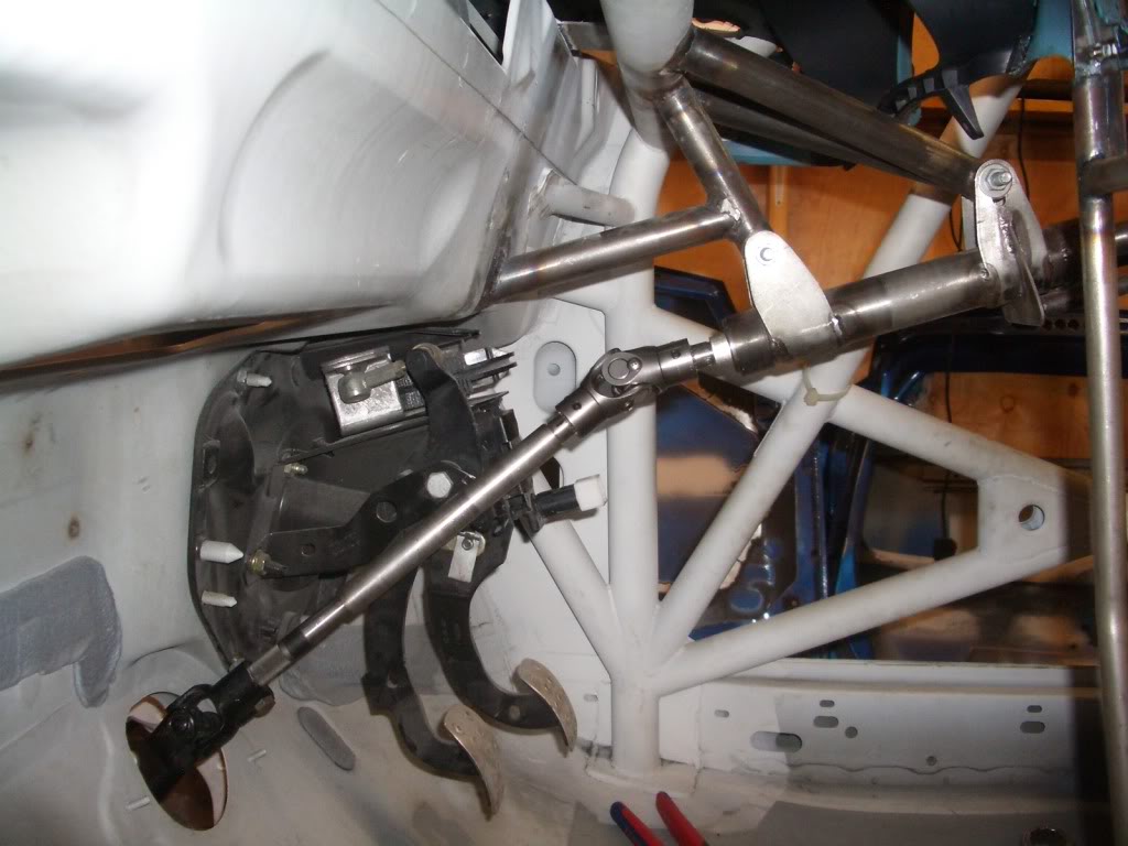

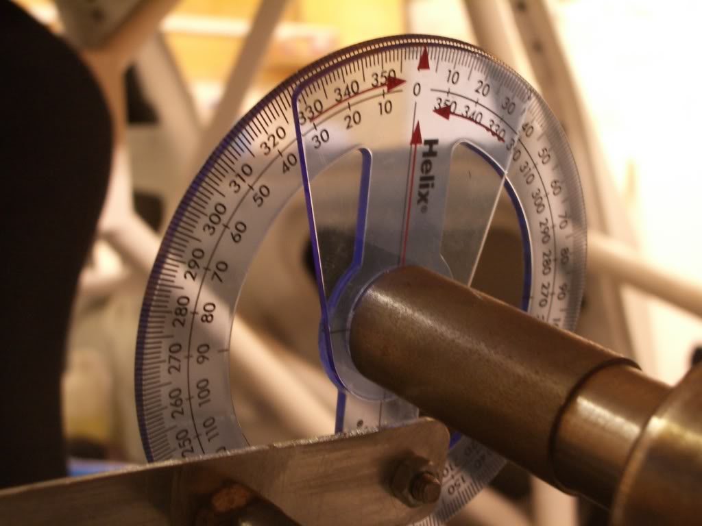

I did a bit more with the steering column the other day but uncovered another slight issue which I was kind of half expecting.
As I've moved the wheel position down and centralised to suit my seat I knew it would have an effect on the angles the Uj's run at.
Without going into too much detail, the more of an angle you put a UJ under the more it's speed fluctuates, ie with a constant speed on the input (steering wheel) the output (rack) will have a fast and a slow phase. This translates into non linear steering, ie turn the steering wheel 45 degs and the rack will move "x" amount, turn it a further 45degs and it will move "x" amount +/- if it's not too much of a difference your not likely to feel it but I think i'm right on the edge of what's acceptable.
My bluepeter steering angle measuring device lol actually works quite well, can only do 180deg sweep though due to how it's mounted but thats enough.
Column currently looks like this
Quite close!

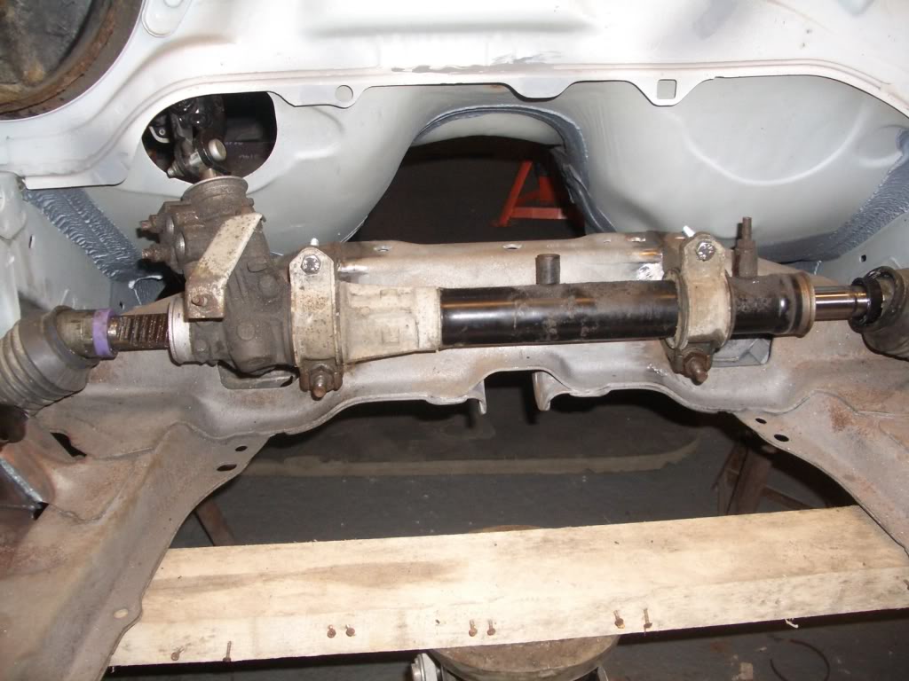

Steering rack raised 20mm
Looks like i'm going to have to put another UJ in the column, directly below the top one, this will half the angle each joint sees and cancel out the speed fluctuations but it means ordering another UJ from the Netherlands and ill have to make a lower column support with bearing or it'll wobble about all over the shop.

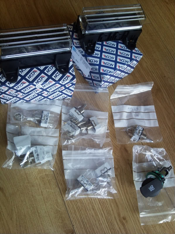

I've finished drawing the wiring diagrams for the car and the ECU, might have to make some minor alterations but for now they're a good place to start from, will "as built" them as I go when I'm making the looms.
As a result of doing that I've been able to work out the type and number of switches etc I need.
There are loads of places to buy stuff like that from but I stumbled across a company called APEM Components, very good to deal with, very helpful and willing to accomodate smallish orders to an individual. There's a short lead time on some of the parts but they should be ready for delivery next week.
I've picked up a Gigavac GX14 contactor to use as the battery isolator, quite reasonably priced and very well made.
Rated at 350A continuous and 500A for cranking so more than enough to start a Clio

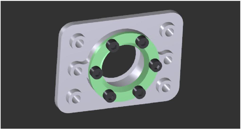

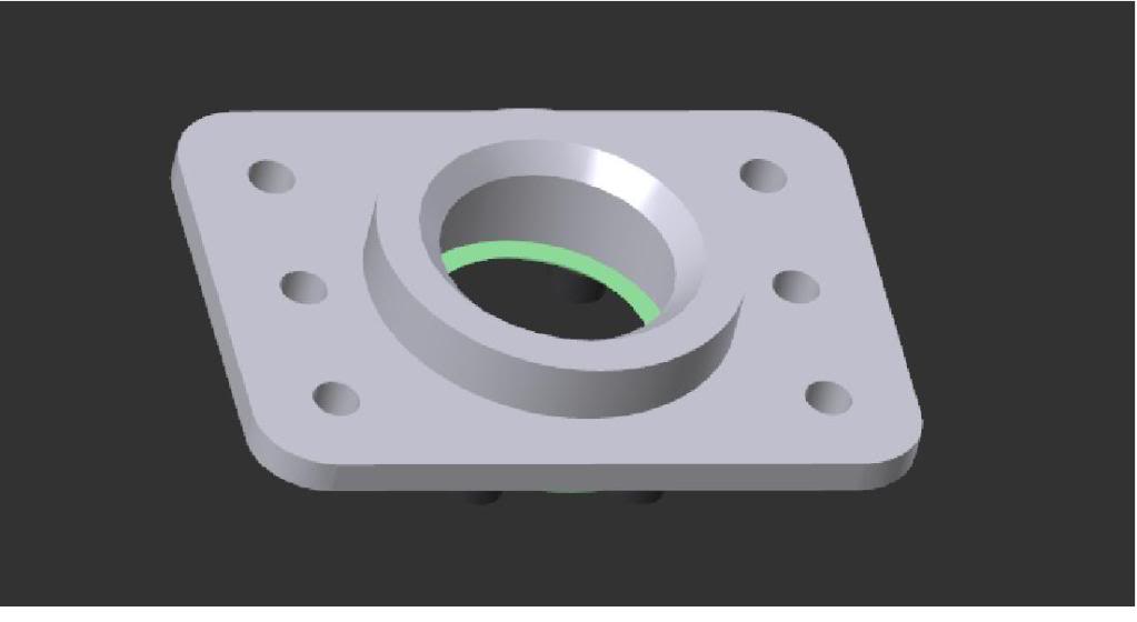

Got a 3D CAD drawing of the top mounts back from the machine shop, they're exactly what I was wanting and all in they're probably going to cost less than the ones I was going to use. Gave him the go ahead so hopefully they will be ready when I get home.
The quality suffers a wee bit but this is a couple of screen grabs from the file he sent
I will then need to get some more steel plates cut out on a water jet. The plate welded to the top of the strut tower will be slotted and there will be another slotted plate sandwiched between the bearing carrier and the underside of the strut tower. This will allow separate adjustment of camber and castor, the idea is to be able to adjust camber at the top and so eliminating the need for camber bolts.
been reading this blog for a while now, some very nice fabrication and thought being put into this...
with regards to APEM i spent a lot of time browsing for reccomended brands when speccing my car, and a lot of people rate them.. its yet to be wired but my switchpanel uses there stuff..
a very nice feeling action to them, both switched and momentary, they have a robust quality!!

Cheers, am I right in saying you're building a 106?
They sent me a few samples, as you say, the switches have a very nice action and feel well made, not all that expensive either.
I've also ordered some of their panel indicators
Using the rectangular ones with insertable legends, different coloured screens depending on what it's for.
They will make up what ever legend you want, text or symbols.
Using these for all the warning lights, oil pressure, charge light, high beam, indicators etc seen them on a few race cars and they look really smart, nice and clear, easy to see.

The Apem 600H series toggle switches are about £6-10 depending on type, you will get cheaper but not worth trying to save a few quid on cheap switches imho.
Think the total order with Apem was about £300! but there's a lot of stuff, more than you would think but when you're wiring a car from scratch there's a fair few things you need. I'm still using stalks on the column so thats saved me a few switches, thankfully!
I've got a wee plan for the switch panel which i'm going to keep under my belt for now ;)
Not going to go that far, would be quite flash but dont know how easy they would be to operate with gloves on?
Already got the toggle switches so it's more to do with what they're going to be mounted on ;) well hopefully anyway lol
Apparently they are not too bad as they have little recesses for fingers so you know you get the correct button :) They are so trick but yes totally unnecessary I can still dream though ;)

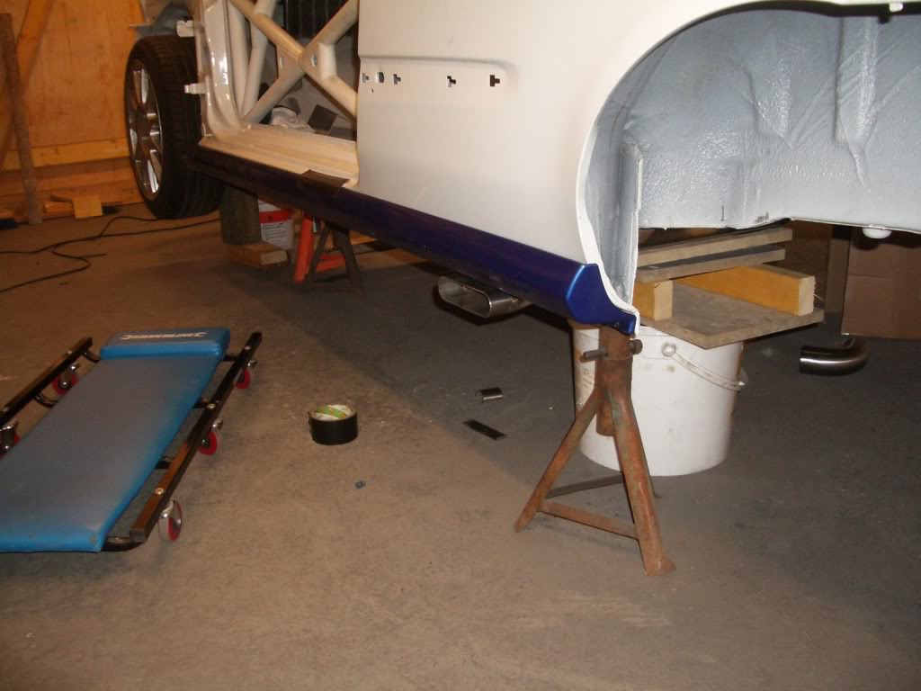

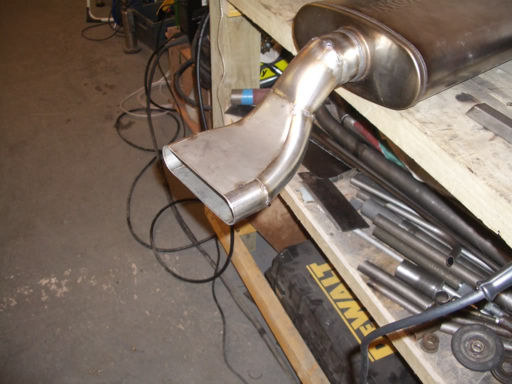

Finally made it back up to the workshop! hopefully home for 3 weeks this time so should make some progress.
I've got so many jobs to do it's difficult to decide what to do, so I opted for a relatively easy one to get started.

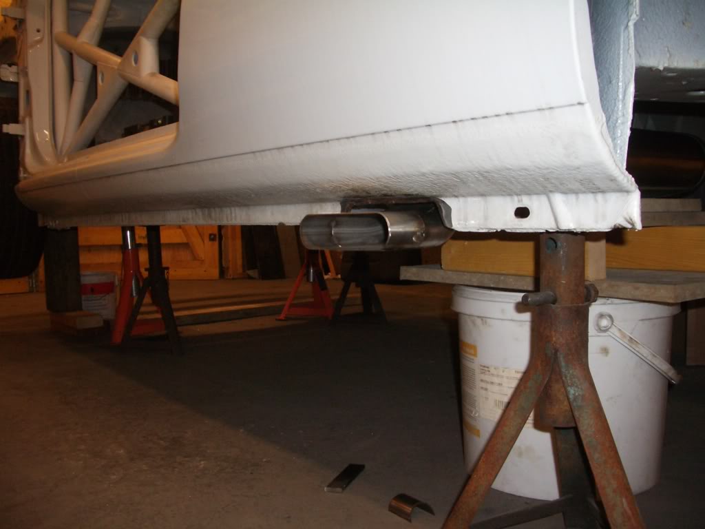

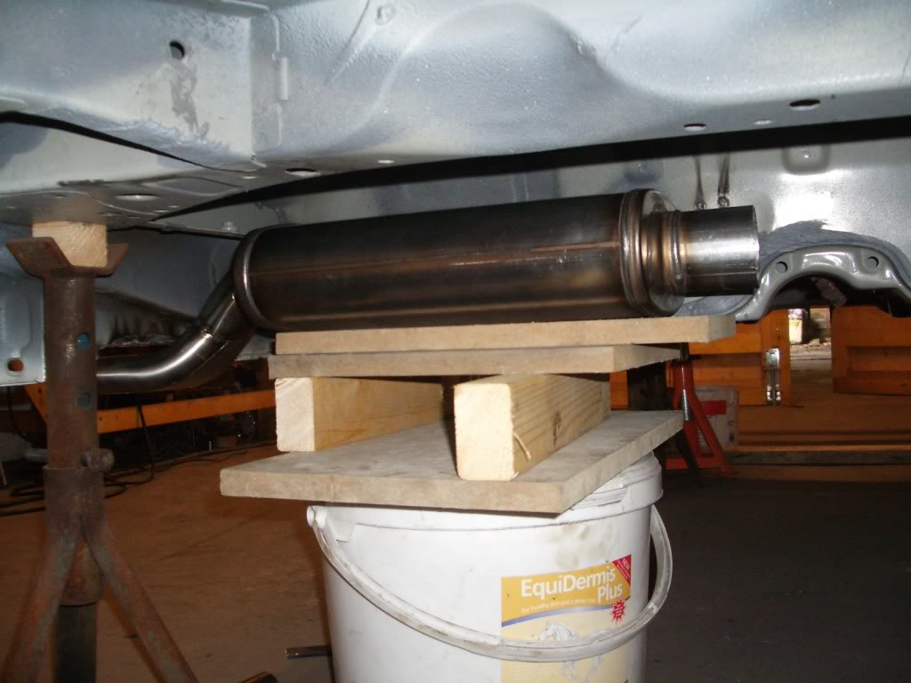

I know side exit exhausts aren't to everyones liking but I have a purposeful reason for going this way which will be revealed later.
The main silencer is a Magnaflow 4x9 14" long 2.5" bore, I'll probably add a 4" diameter silencer in the middle section, it's hard to judge how loud or quiet it's going to be so will just need to take a guess at it, easy enough to add or remove bits as needed.

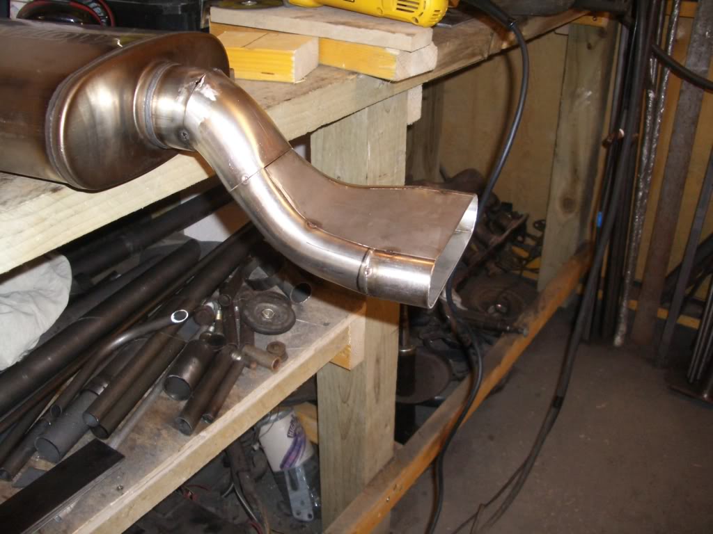

I made a start on this yesterday but typically I forgot to take the camera with me.
It's made from a 38mm bend sliced in half, part of a 45deg 2.5" bend and some flat plate, my mate is going to come up next week after work to weld it, stainless needs to be back purged to get a nice weld so he's going to show me how to set that up too.
