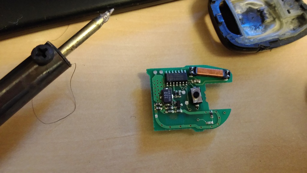

Does the little red LED flash when you press the button?
If not, then the switch has probably broke off the PCB

Any good with a soldering iron?
Take it apart and have a check to see if it's become detached

You need to pull the board out mate. The switch is on the opposite side to the battery

Yeah, be careful because if the switch has come loose, it could go flying and it's tiny enough to be a mission to find. Happened to me! The board is kept in place with what looks like a silicone mould.
Bit of dexterity with a soldering iron did the trick though.

Alright so just solder that piece that come loose to the spot, and all should be good if I don't mess up? :laughing:

Yup, if you want to be sure, you can place the switch over the contacts and press it. The LED should flash.
Couple of blobs over those points was sufficient in my case, and I'm absolutely useless with a soldering iron.

Ah great yeah it flashes! Hopefully I can get it soldered tomorrow somewhere thanks alot

A depressing update, managed to get the switch soldered down and it worked correctly up until the switch decided to open up and break completely! Guess it's time to hop on eBay for a new switch

It's alive boys, switches came today soldered and super glued over completely over the top, but better safe than sorry. The click opened the car.. chuffed to say the least thanks guys.
