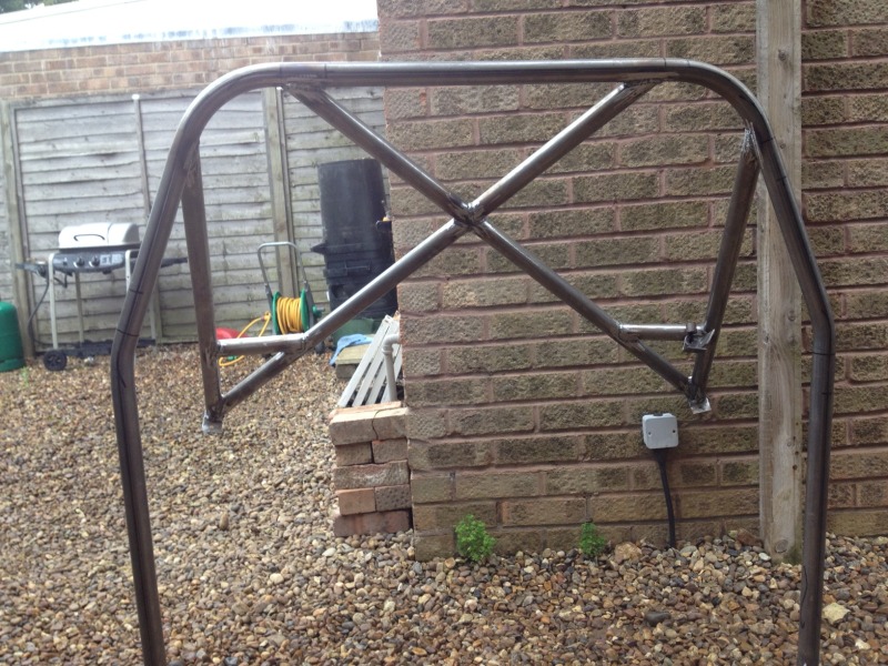

Sorry to hear about your shoulder mate - hope you get the build finished pre-op :)

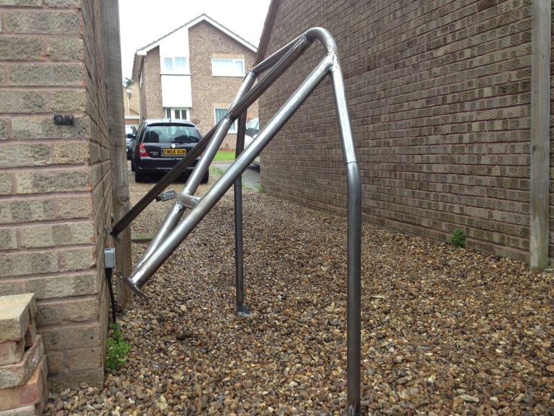

The workmanship on that cage looks good - shame the harness bars are so far down though?
Thanks mate :) It mounts on the wheel Arch's not the floor so shouldn't be to bad :)

Got some more pictures of my cage today as i was clearing out the garage so i had some space to work this weekend. I've propped the cage up so the main hoop is level, so people can see the height of the harness bar for proof it will be fine, i think it's fair to say that the harness will be within the space it needs to be for the correct angle (Not that it matters as this isn't a race car!)

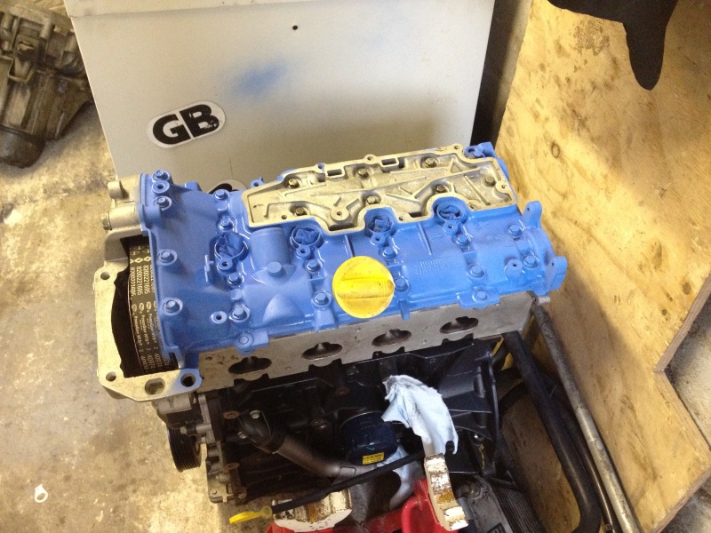

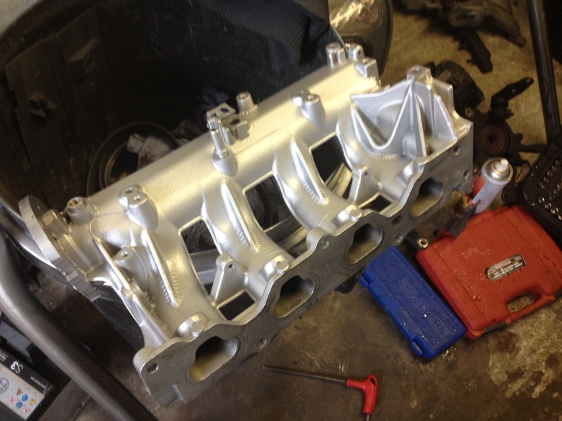

My VHT paint arrived today, engine is looking nice and Fresh now :) (i did have tape to protect inlets, but took it off for the photo as it got spray paint on, been re covered now)

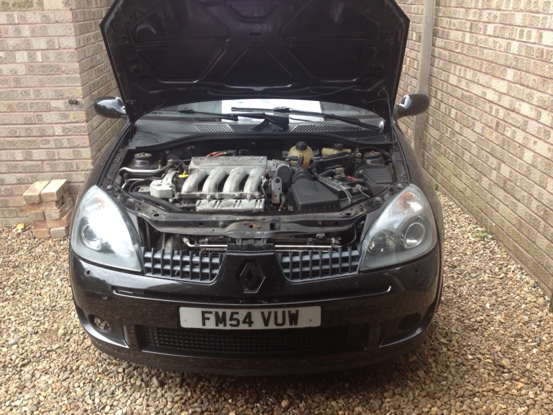

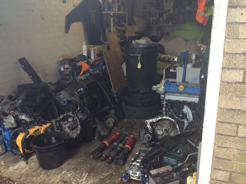

The long awaited engine conversion update!
Didn't make it to CSS due to being offered a good days work on Saturday :) Then last night i stupidly decided to go out on the beers with my mates, so i got in at 4 and needed to be up at 7:30 to get to DannyR's to collect these :D
Got back home about 10:30 and cracked on with it, was really taking my time today as i've like sh*t lol. This is when i started.

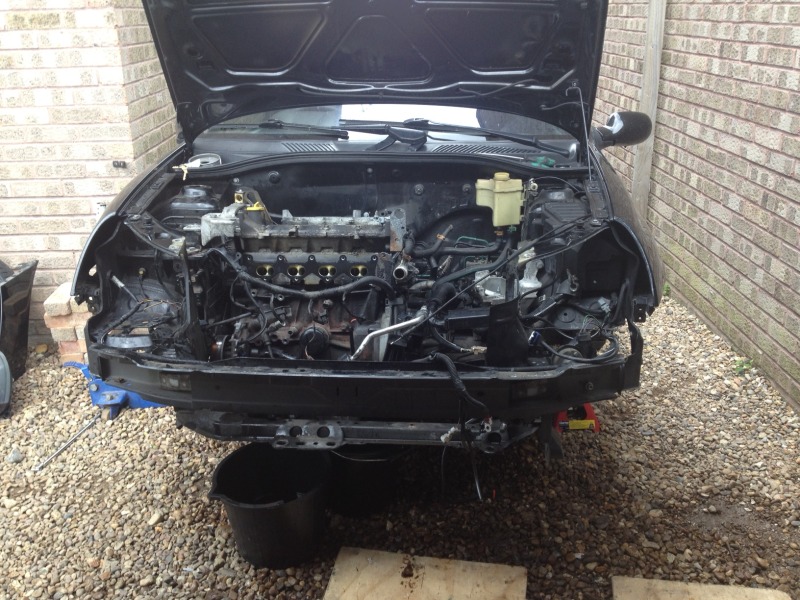

Soon enough it was getting stripped apart.

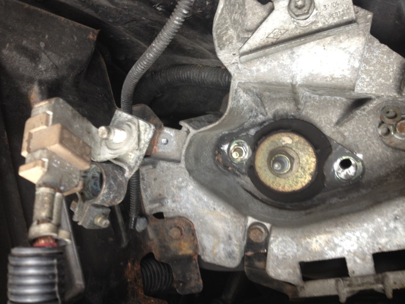

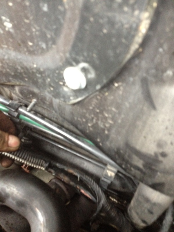

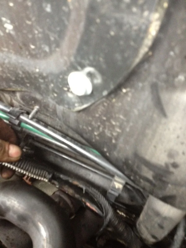

I then found out what had been causing my intermittent stop light coming on, the abs sensor wire had melted out exhaust manifold.
At some point the engine came out for new gearbox and clutch, and who ever done it routed the wires terribly, the gearbox mounts were loose, bolts missing and alsorts! The clutch had seen some serious heat in it's life too!

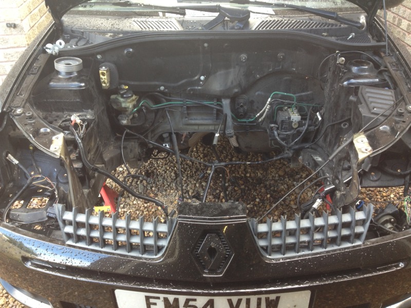

And by about 2:30 the engine was out, i then took subframe off too, for powdercoating, then pollybushing before refitting.
I then spent what time i had left putting bits on the engine, flywheel, clutch, 182 cam cover and top engine mounts. I also gave my 225 inlet manifold a coat of VHT paint :)
So by the end of the day my garage now looks like a clio brakers yard lol.
It was also nice to find a K&N panel filter and that i had RS stamped lower inlet :) Next update will be once i've cleaned up engine bay and engine is built up, need to get lots of parts off for powdercoating too!

Your inlet needs to be powder coated. The VHT on there will not cure and go hard as it'll never get warm enough!
