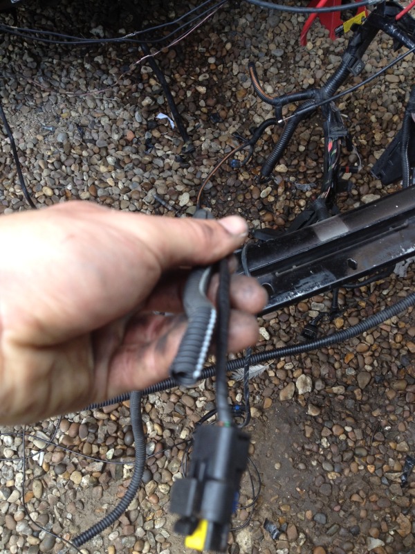

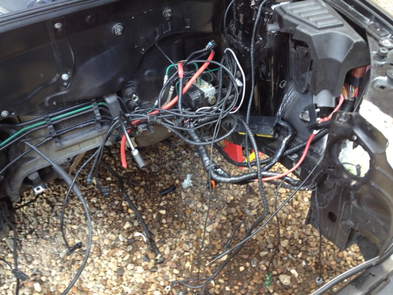

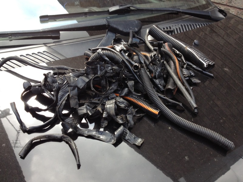

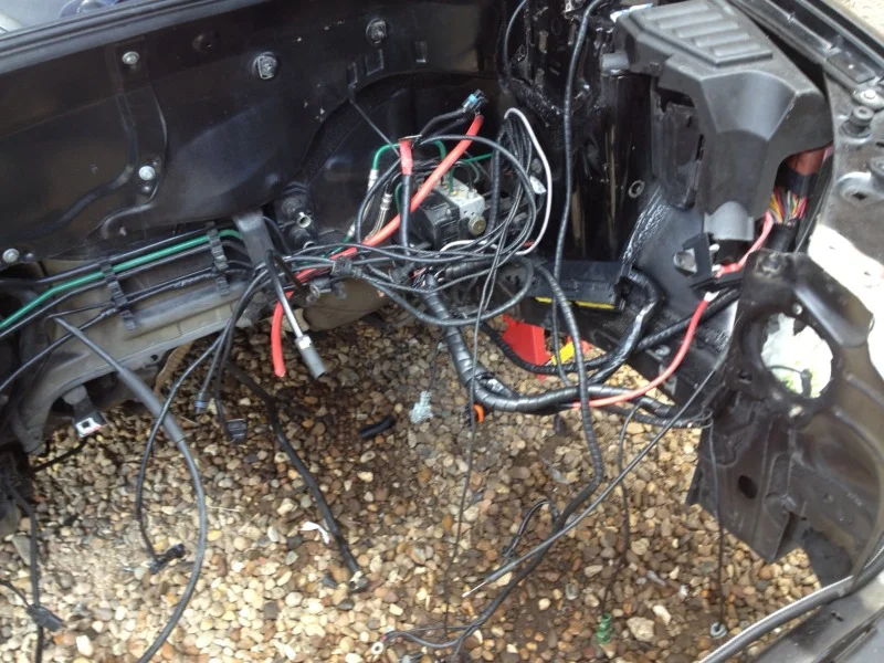

First of all, as you know i bought the spiral wrap for my engine loom, well completed that tedious job Thursday, not much to look at yet untill the engine is in when you will notice the difference, but so far it looks alot tidier, and looks like there is less, so i'm happy. I also repaired the ABS sensor wire that had melted on my exhaust manifold, as well as the earth that had melted on the exhaust manifold.

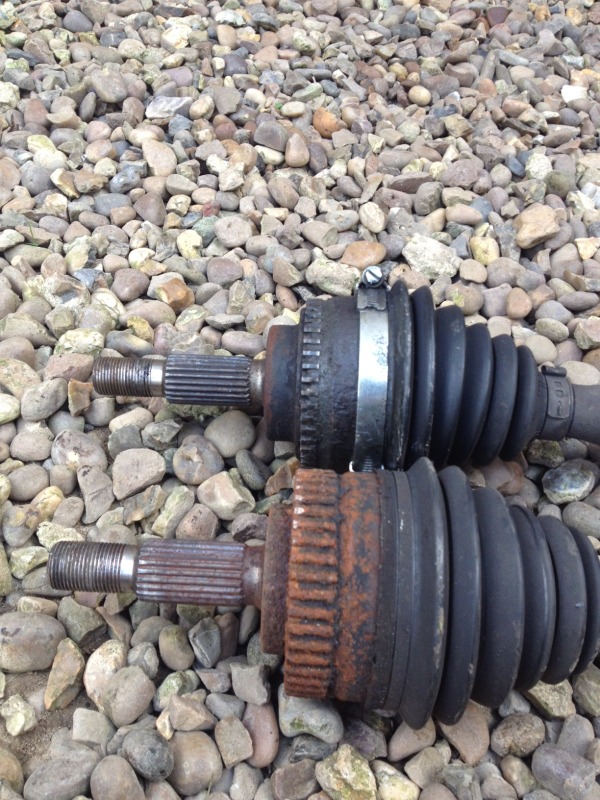

Sent a few PM's to Chip as i knew he was doing some research into driveshafts/hubs/wishbone combinations, as with the 182 cup the drivers side driveshaft also mounts to the back of the engine block, this won't work with a Megane block, so he has suggested using a 172 cup drive shaft and swapping the the cv joints as the 172 cup doesn't have ABS and i need the sending ring. So that's a job for this weekend.

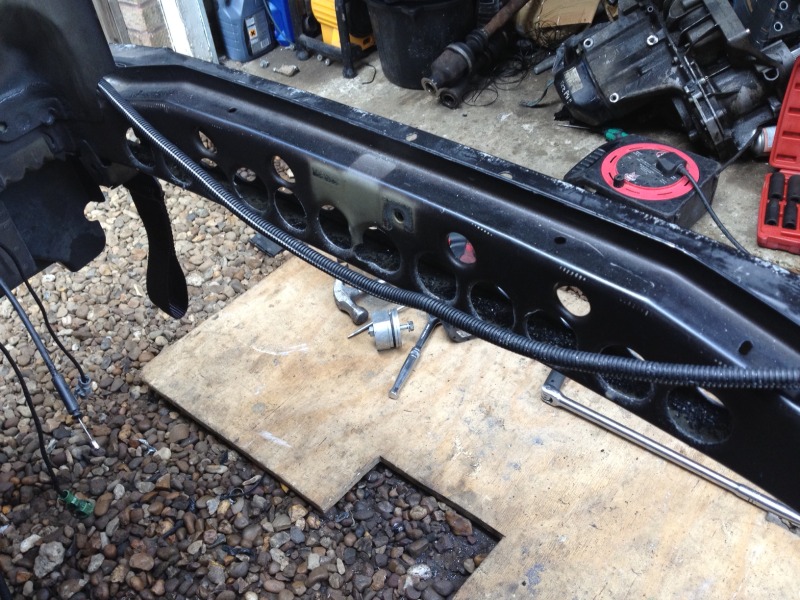

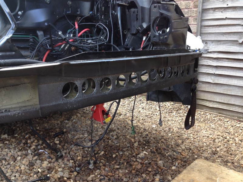

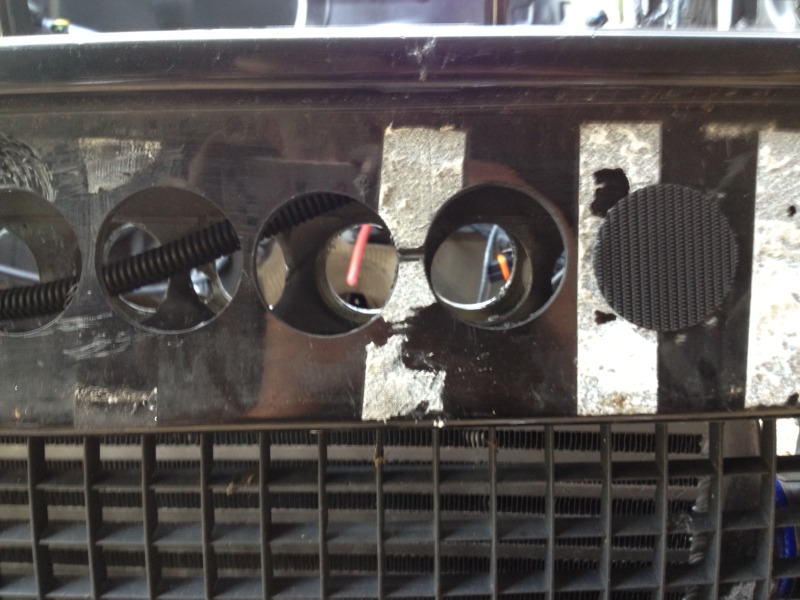

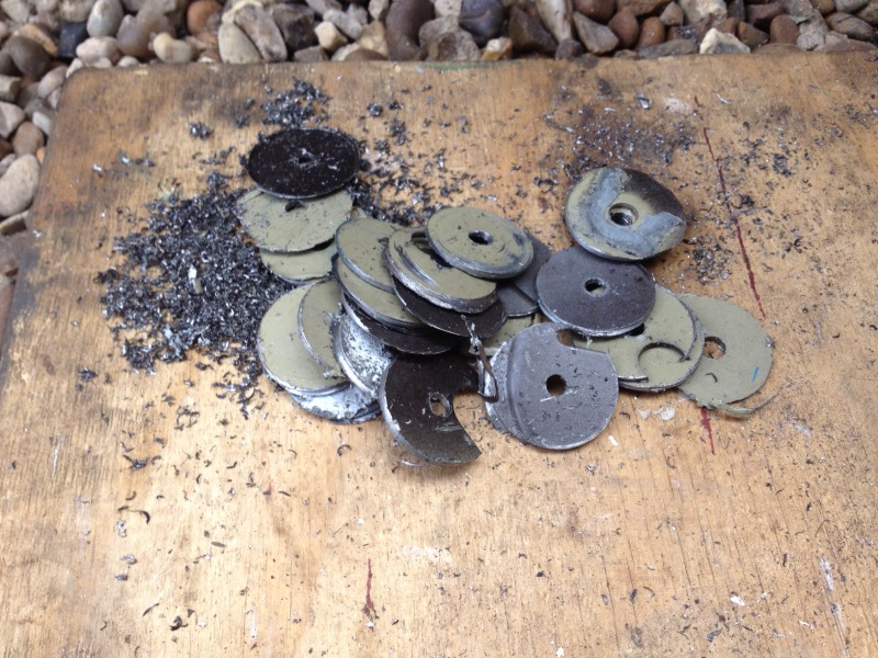

Next job was hole sawing the front beam, i didn't particularly want to do it, as it will weaken it, but i was swagering as well which adds some strength, and it will make my life 10x easier mounting the IC. Here are all the disks i have cut out.
The end product. I will be threading the light wire through the front beam once it's all been cleaned.

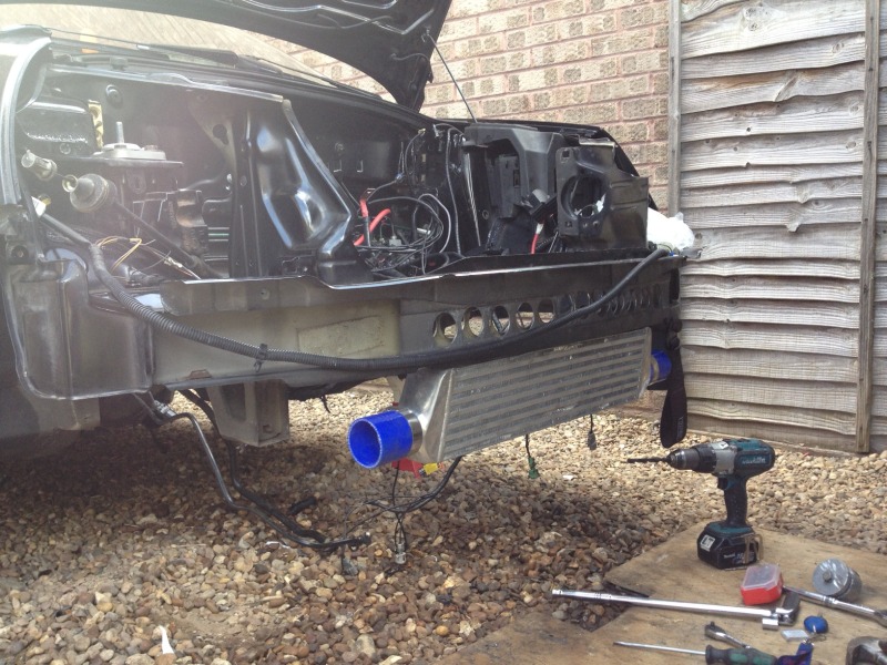

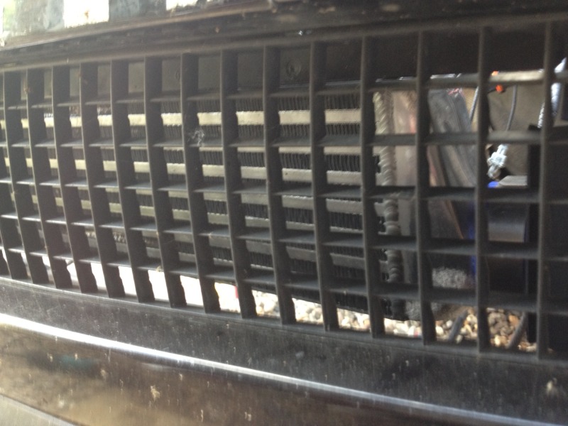

I then mounted my FMIC.

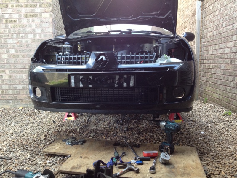

Then a trial fit of my bumper, the holes behind the number plate line up with the holes in the front beam very well, hopefully will aid cooling of the rad slightly.

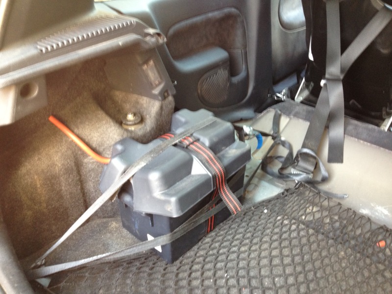

I also relocated my battery to the back of the car, although when ratchet strapping the battery box down i managed to crack it, opps
so need a new, better one of them.
